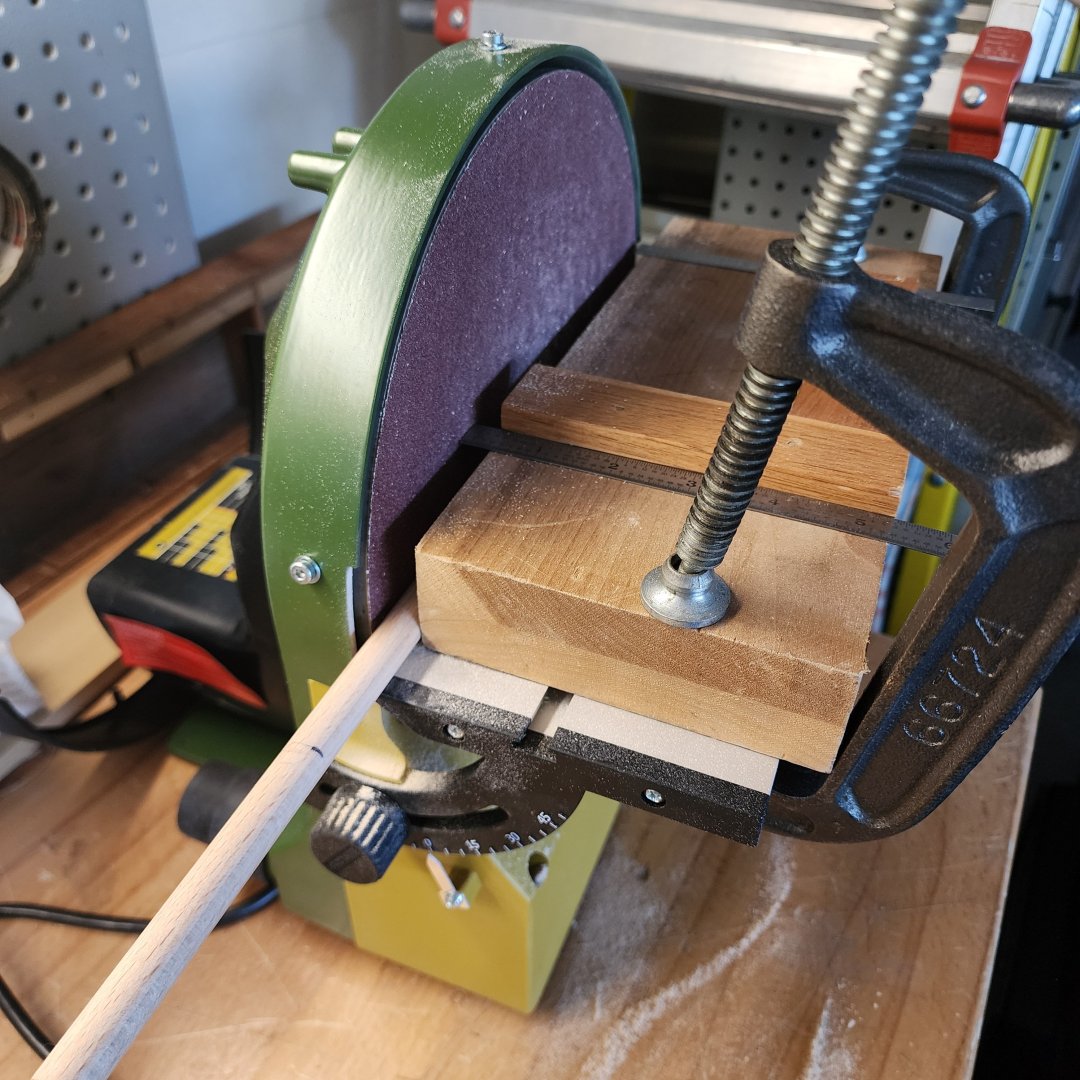

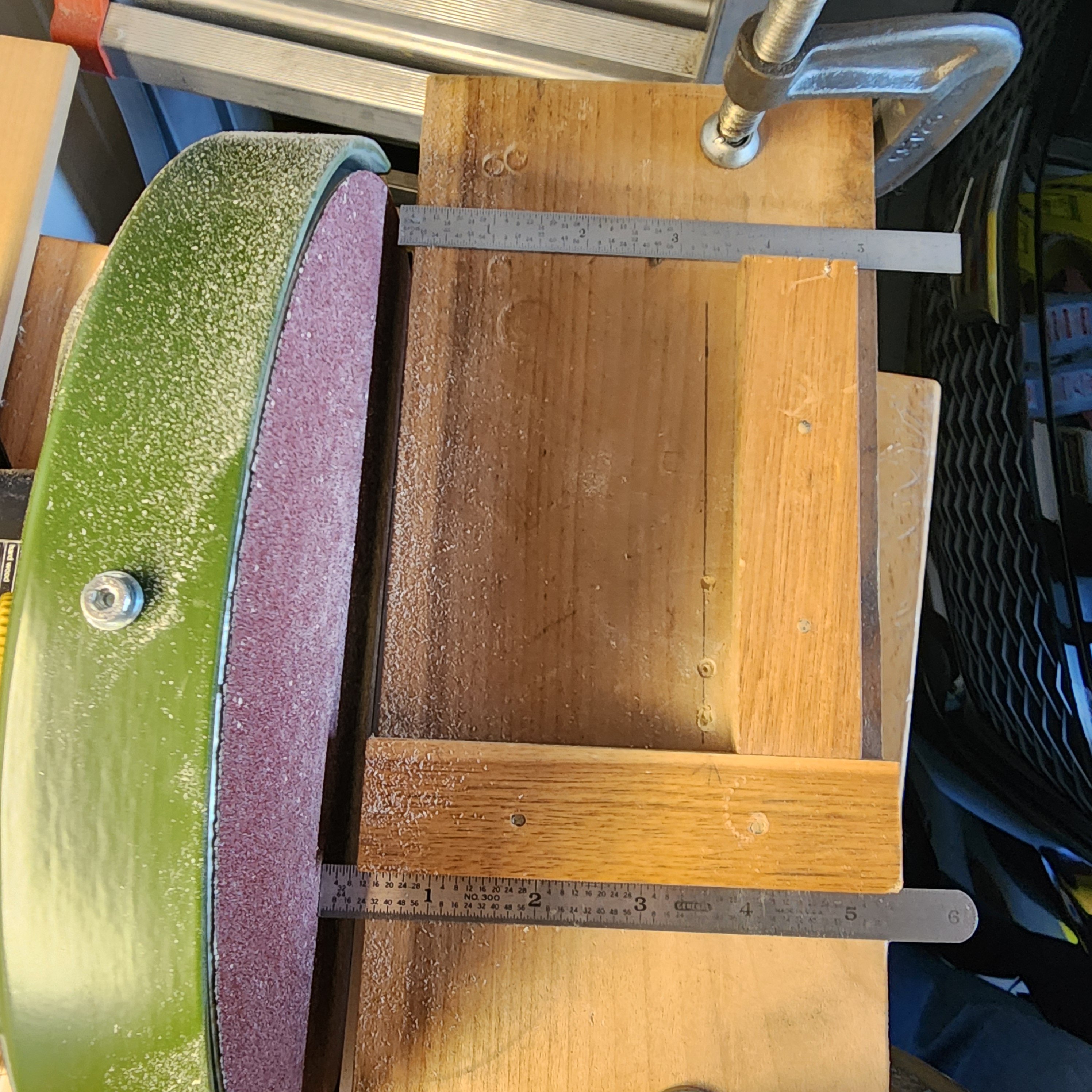

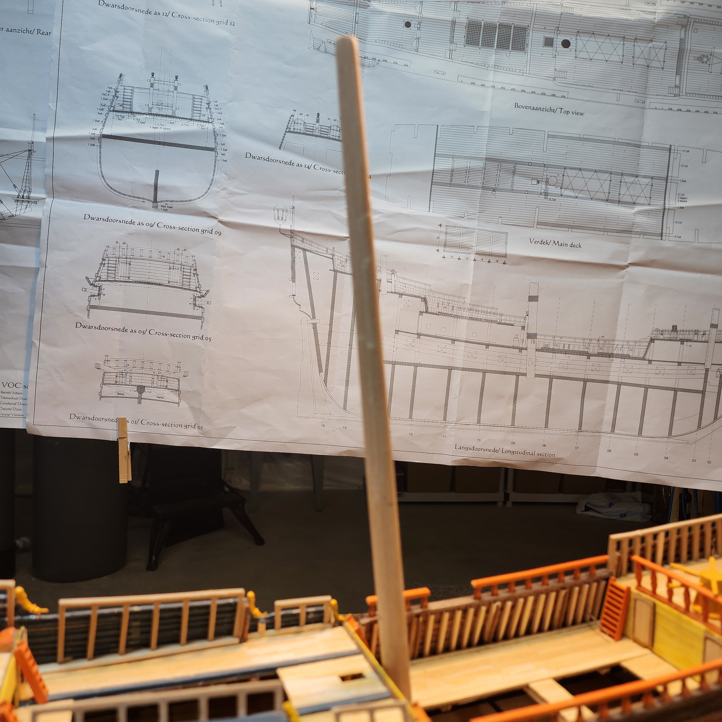

Attached is a picture with two scales. If you measure the gap between the block and wheel you can set up for the exact finished diameter and it exact every time. It is easy to change angles by simply repositioning the block.
It is east to repeat angles and for yard arms both ends are exactly the same. For pros this may be easy but a novice like me has a difficult time getting matching angles sometimes, and it is time consuming.

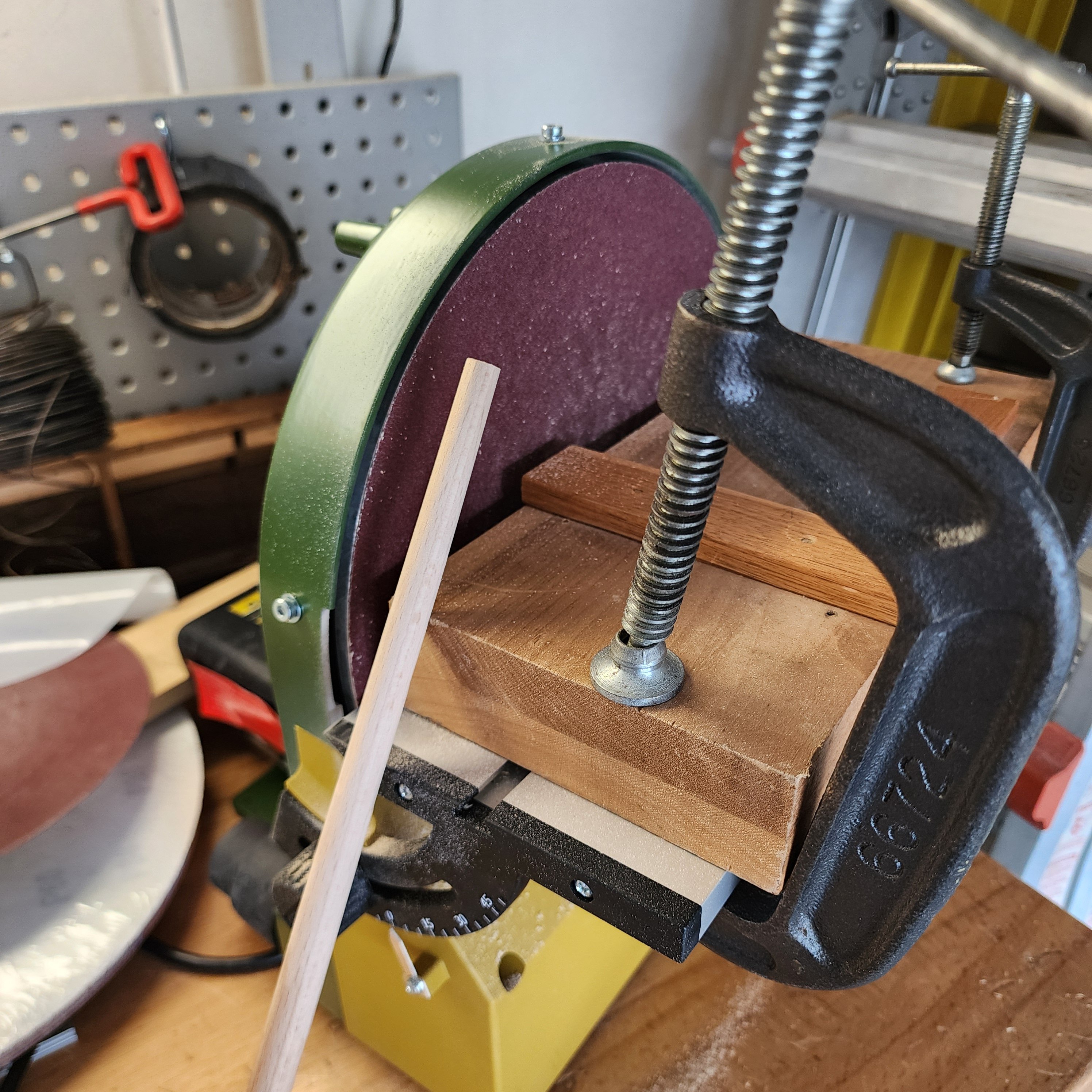

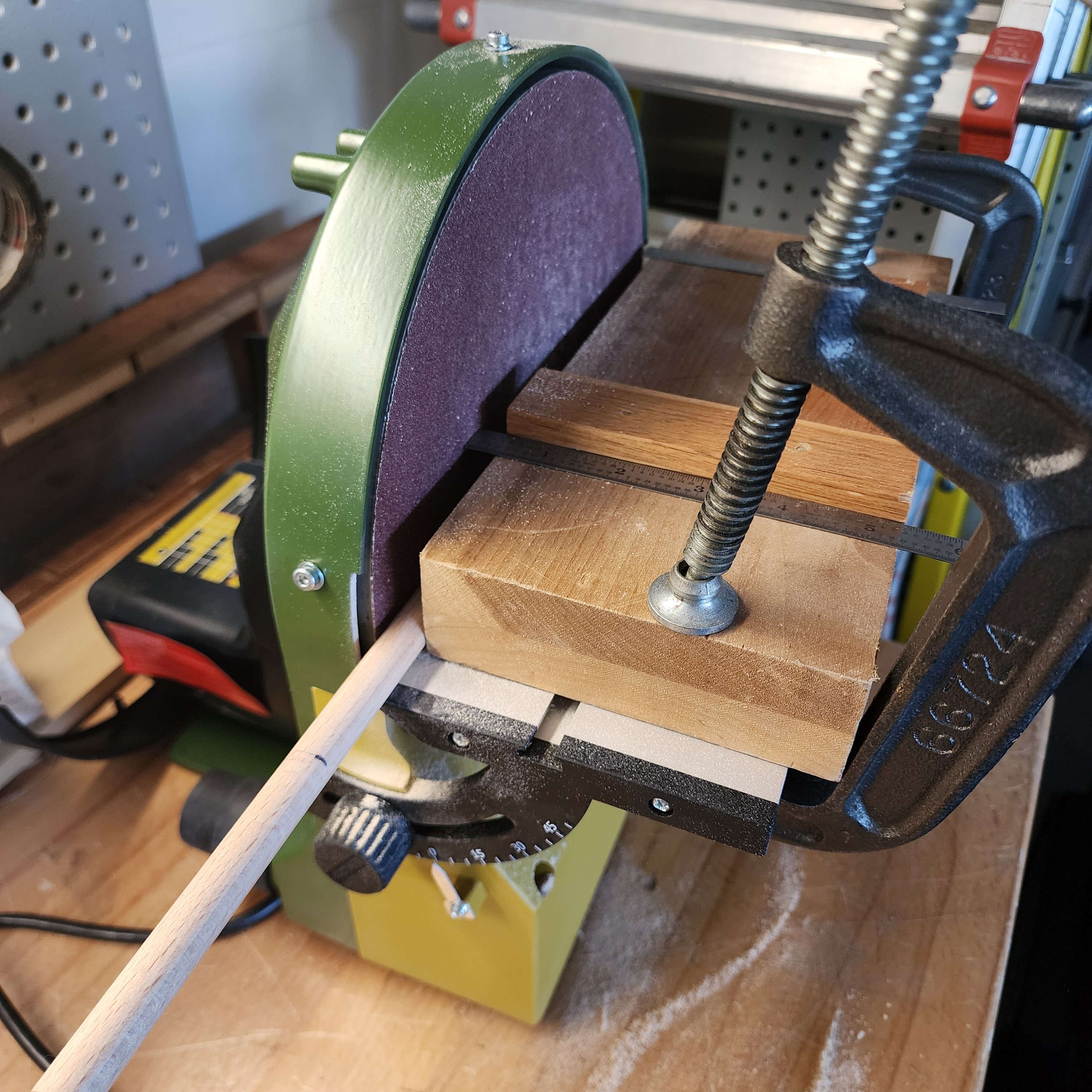

Another picture shows the mast in the sanding position.
I thought I might have a feed problem doing it by hand while turning the mast but it was surprisingly easy and was no problem. You just have to be firm and steady with your grip and feed and have the sanding disk do the work. Don't force it. I was thinking I might have to add something to help turn the mast while I fed but found I did not need to.
The first mast I ever tried is in the picture and did 3 more yesterday. All are spot on.
I found it best to use 80 grit paper.
That sounds aggressive but needed to get the job done.
It is easy to use 220 by hand to finish.

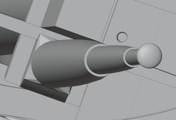

 Attached is a screen shot of my PC.
 I do an Auto cad or Solid works drawing of some components on my builds.
I do this so I can capture more detail than is on the original plan. Doing this on a 1/1 build scale is very helpful. I also use the 3D STL files to 3D print parts if needed. I did this with the turnstile ladders and some hatch covers. I found a wood infused filament that is very authentic looking.
I want to understand the taper you described.
In the lower left, in blue, is the basic shape of the Batavia main mast.
The top one is straight sided as I have now and the lower one is the taper I believe you describe. Is that correct?
Thanks again for your input.

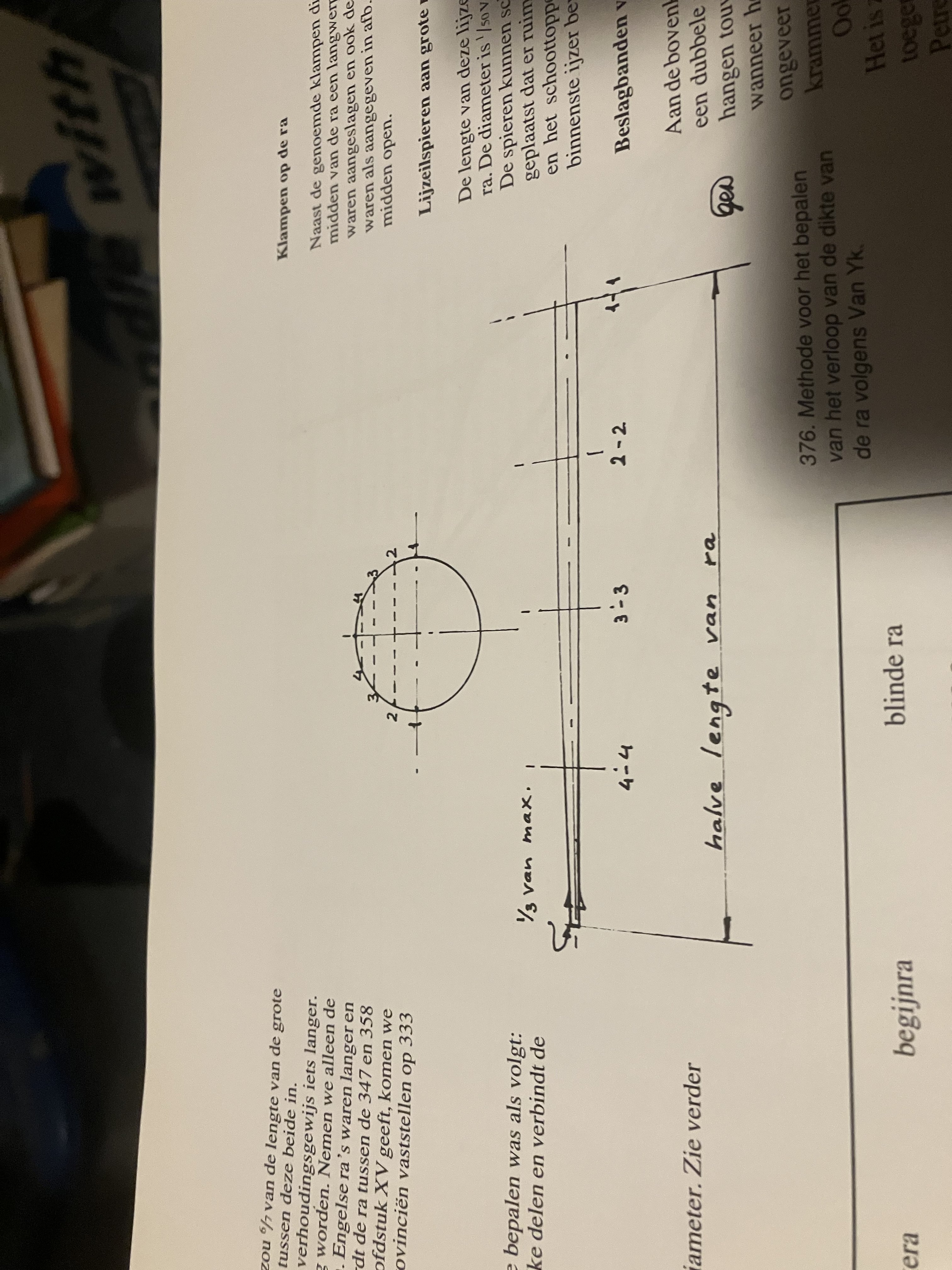

Below are three pics from my books. Not terriblt goods pnes, but I guess they will do.
First the method Van Ijk (famous dutch writer on shipbuilding describes with respect to the tapering of the yards.
take a circle inthedismeter of the spar. Devide the circlehalf in 8 equal parts, and connect the dots. The lenght of these lines give the thickness of the yard at the corresonding points (each half of the yard devided in four)

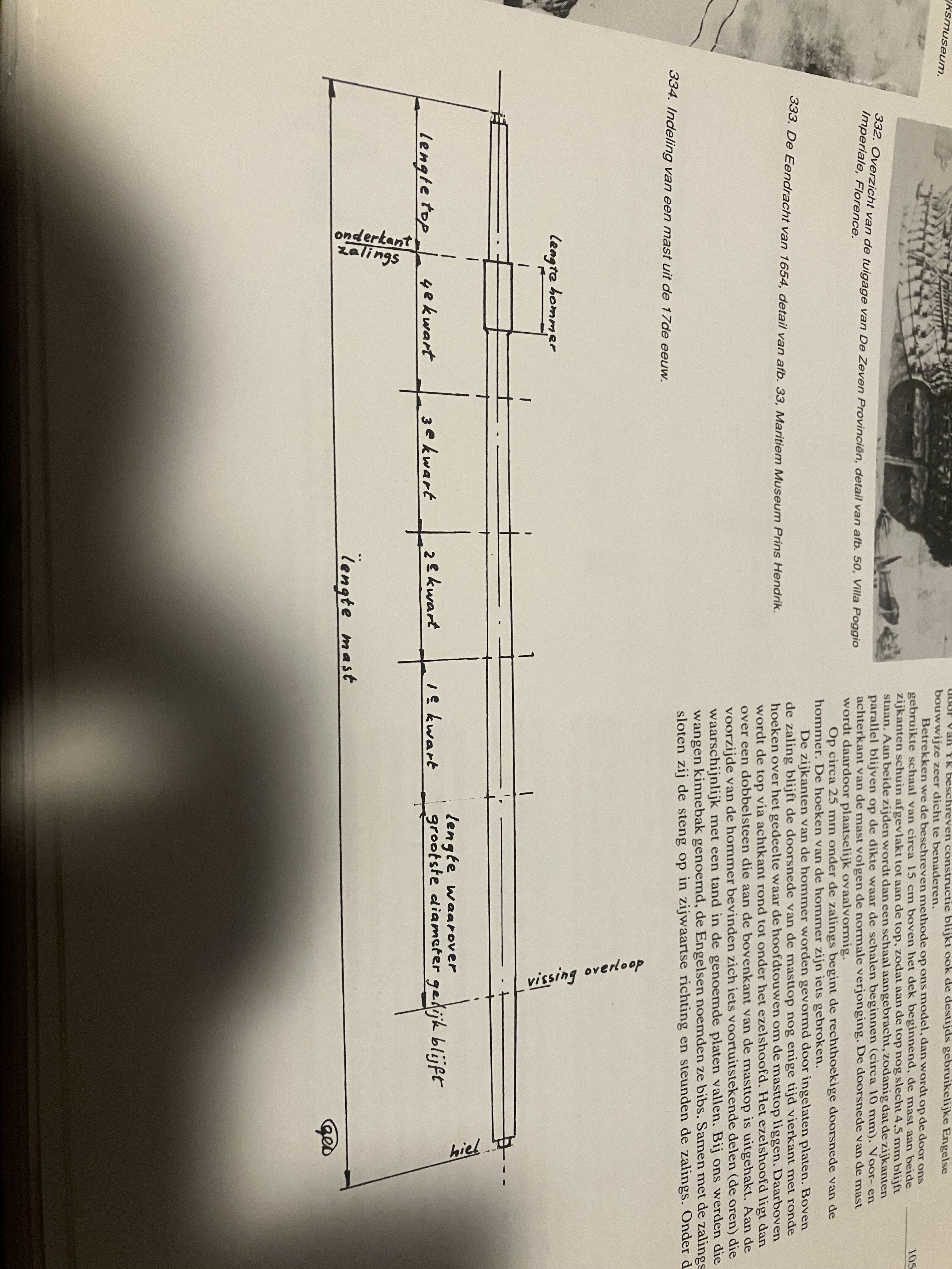

with respect to the mast Van Ijk is a bit cryptic in his description. (And some interpretation is needed: measuring from the overloop (wich is the deck below the upper/main), the mast does not taper at all over a lenght of twice the length of the top. Above that, the taper is determined with the use of a cricle: but slightly different: not the circle is devided in 8, but the baseline in four parts. The remainder of the mast is diveded infour parts. The discussion is: where ends the ‘remainder’ His illustration suggests below the top, but in that case the top becomes very thin, as the taper continues till the end. taking the end of the mast gives a better result, but still ends up a bit on the ‘narrow side’
And with a slight variation, but showing the profile somewhat clearer: relatively thin at the mastfoot, thickest at the level of the overloop, no taper above, and a ‘circular’ taper above.
the same ‘circular’ taper is used for the upper mast-parts. For my Prins Willem I used something like one-third without taper, and some taper above that.
For the upper parts the taper is relatively small, so the difference between straight and circular was’t very noticeable. On the lower masts it certainly was visible.
On the yards the difference between linear an circular it is very noticeable. They end up way too thin when a linear taper is used.
