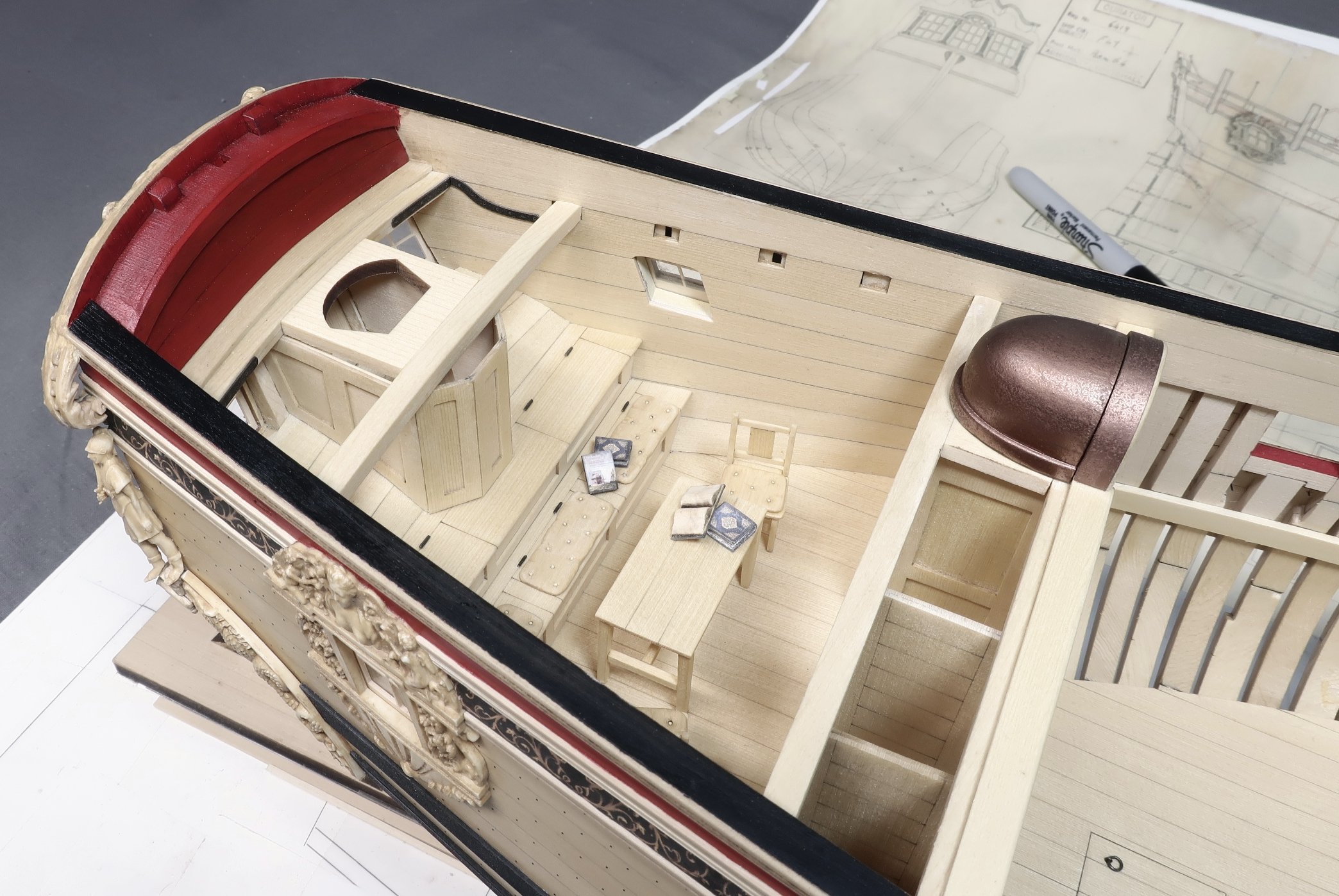

I used a copper color to paint the top of the cupola for my Speedwell.  I didnt want super shiny so I buffed it after adding some light brown weathering powder.
