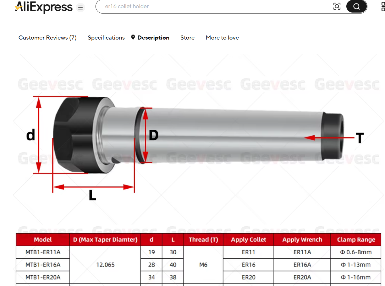

Speaking of collets for Sherline, I just purchased ER16 collet holder on AliExpress. Sherline uses Morse #1 cone. This holder costs CAD 16 with shipping. Set of ER16 collets from 1 mm to 13 mm I got for CAD 27. This is just a small fraction of what Sherline charges for their collets. And the ER collets also more useful than ones they sell to my opinion.
Remember that double-slotted collets, such as the ER-type are designed for holding tools or round stock. The material has to go through the whole length of the collet or nearly so. Pieces of less than half the length of the collet cannot be securely clamped, as tightening the collet has the tendency to squeeze the part out of the collet ... there is also the risk of damaging the collet in this way.

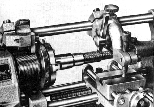

I would normally never dare to contradict wefalck, but the 'old' Unimat DB/SL had a (metric) thread-cutting attachment (no. 1270) available years ago. Examples are still available, for a price, on the second hand market.
Oh yes, you are right. I had been thinking of lead-screws and changewheels, but the UNIMAT one was of the cartridge-type, where are cartridge with a master-thread that is screwed to the  lathe spindle and there is a follower on a bar behind the lathe that engages with the master-thread and moves the cutting tool along. It the kind you would find mainly on lathes for the optical industry, where short, but very precise threads are needed.
Here is a picture from www.lathes.uk.co:
In nearly 30 years of scanning the Internet for lathe attachments and the likes, I have seen may be two units for sale.

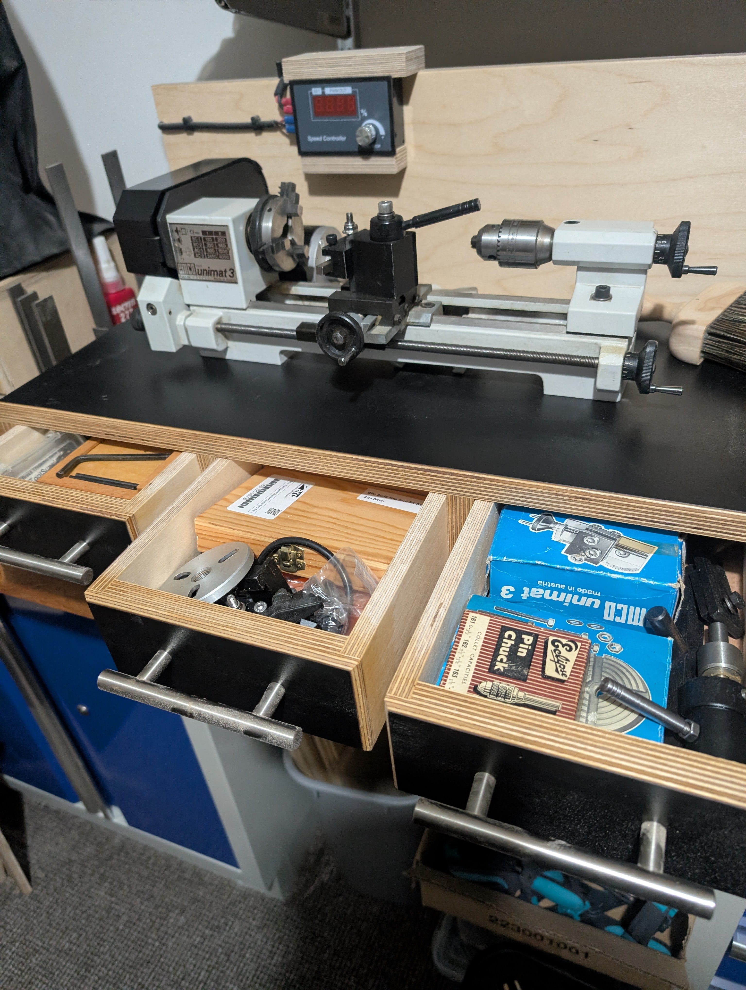

  Since my Unimat was given to me free from my Dad (I don't think he ever used it) I've hung on to it for a variety of odd jobs: e.g. turning aluminum barrel extensions and parfocalization rings for 2" telescope eyepieces (about the limit for the little lathe, using a 4 jaw independent chuck and light cuts all around for the o.d. and i.d.);  altering large caliber brass casings for an antique Spencer carbine (3 jaw universal chuck comes in handy);  turning small diameter steel parts for antique gun locks.  (The underpowered lathe can only handle small diameter/light cut work in mild steel ... seems the unit was intended for brass & aluminum.);  turning and/or tapering masts and spars for ship modeling.
  I found some largish rubber o-rings to use as belts, and generally set the belts for the lowest speed.  Some tooling can be found on line, like a milling table, tool bits, etc.  I should look for a live center.

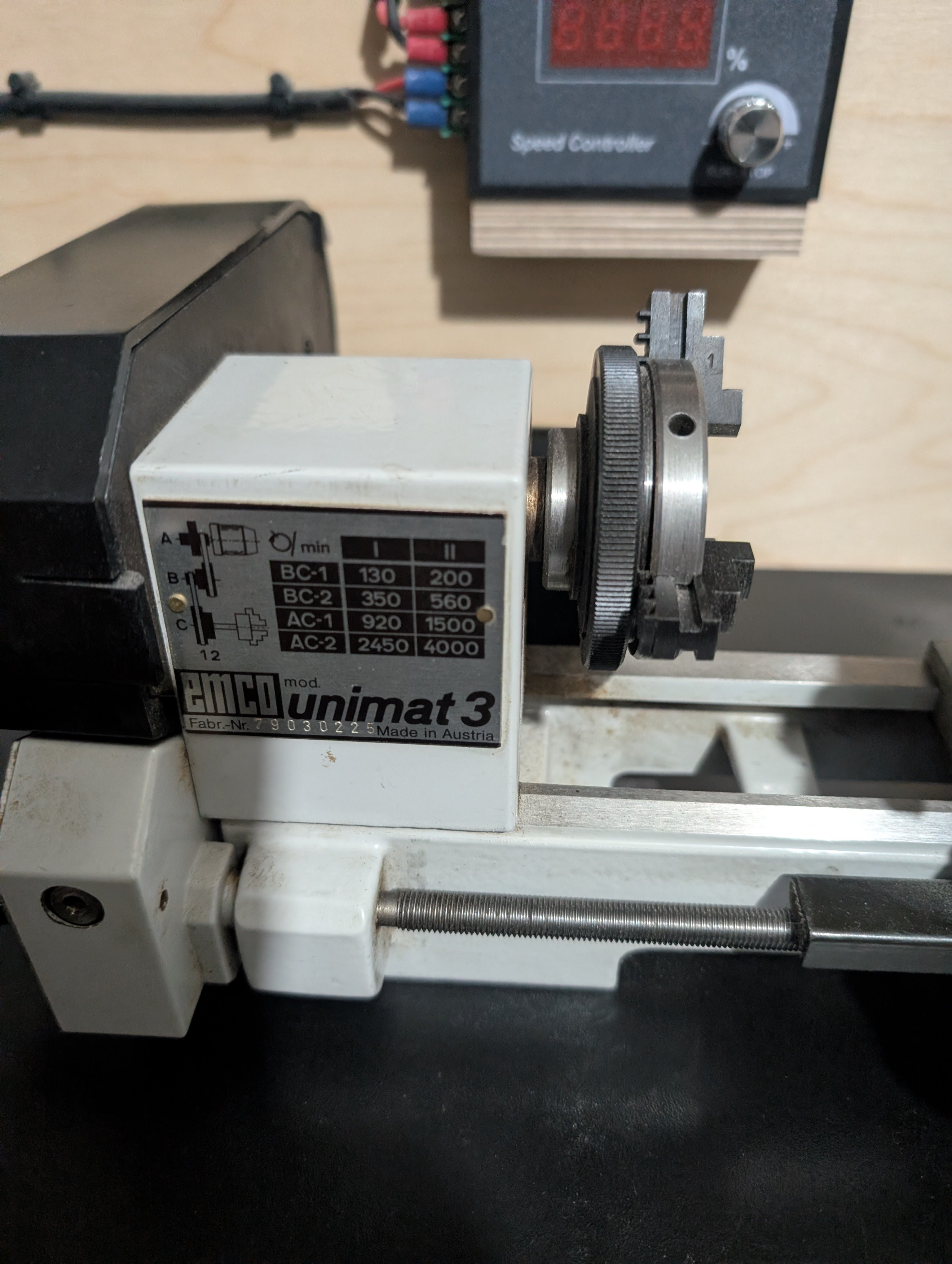

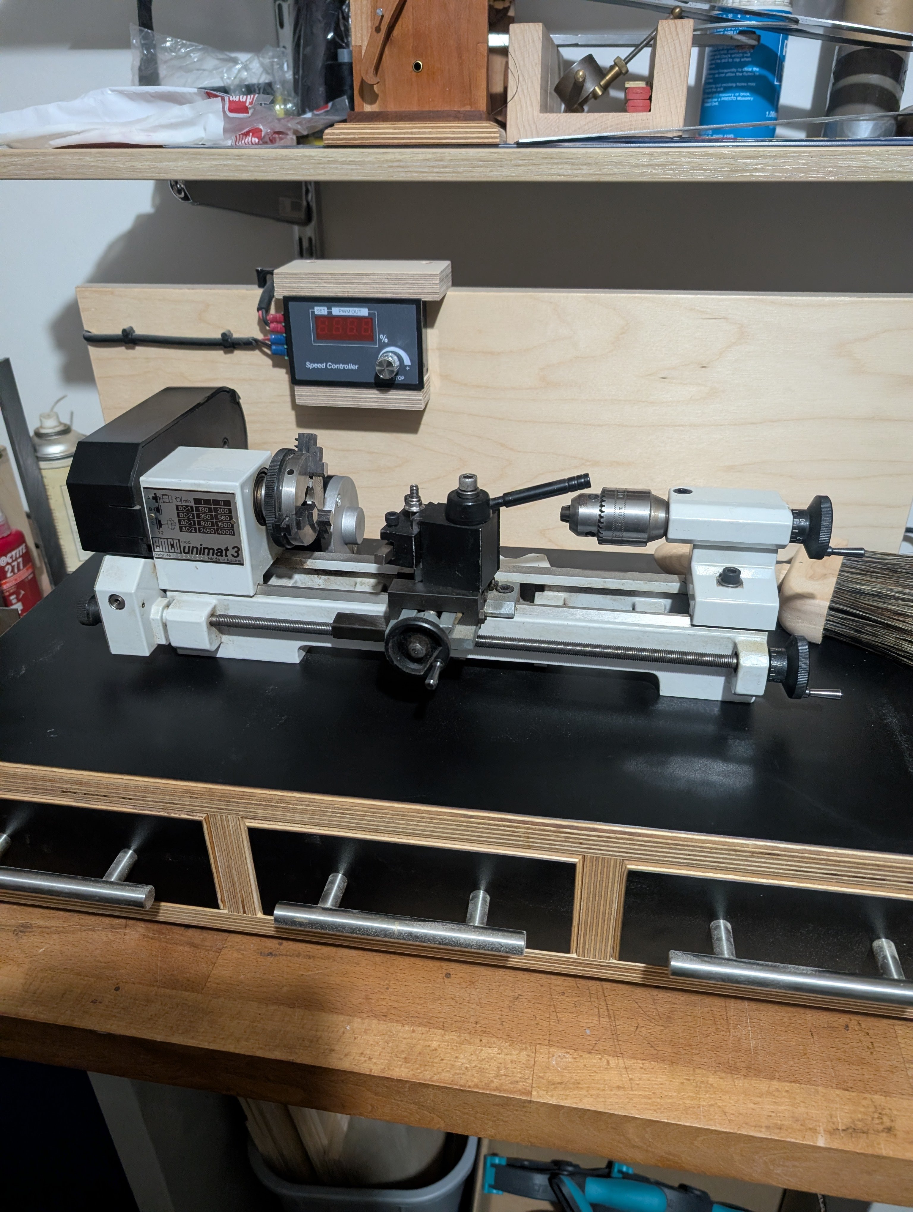

It is not necessarily a bearing issue. Unimat I have has a pretty loud motor. Louder than Sherline.

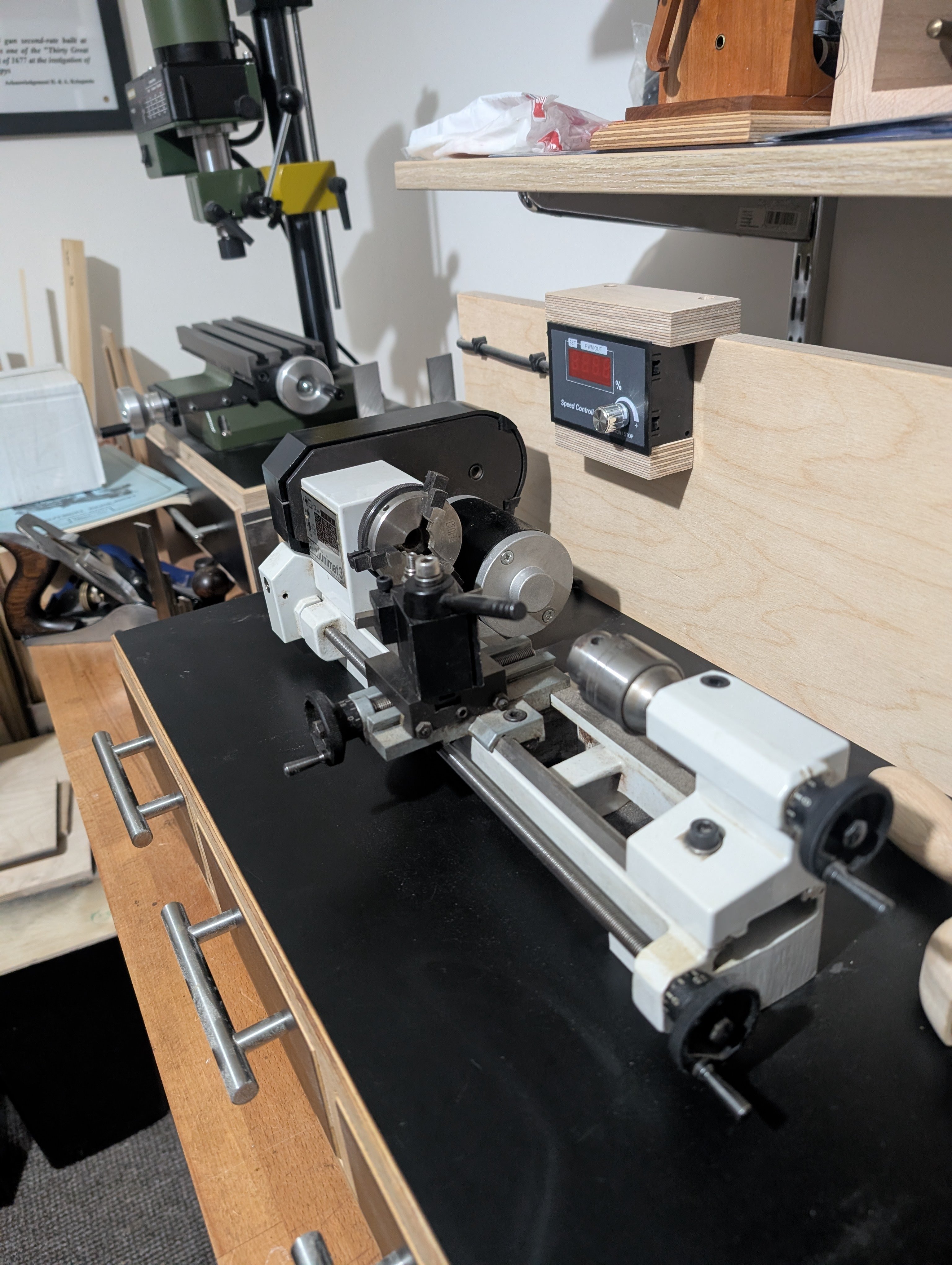

Unimat 3 Austrian made.....more than accurate enough for ship model making and any other small turning jobs.
Works with wood and metal.

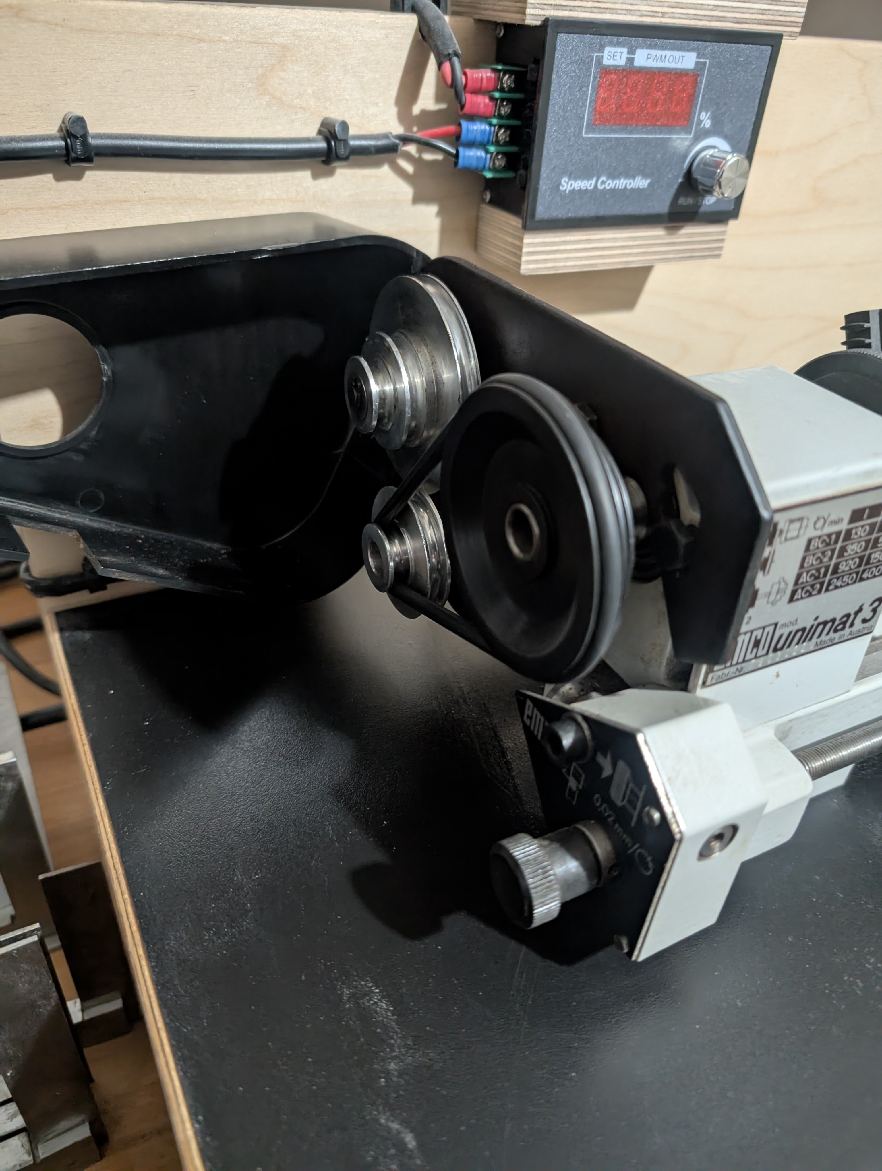

The original motors have a limited run time and only two speed settings.
Then you have too mess about changing belts.
Changed the motor for a continuous rated DC unit.......nothing wrong with old motor keep that as spare.
Loads of accessories available online.
