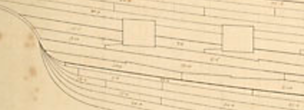

Reviewing the drawing of Berwick 1775 referenced above, I count roughly 5.5 full pieces from end to end (in the 3rd strake in the main wale). As a very rough estimate of the length of each piece, I divided the length on the gun deck (168' 6") by the number of pieces, for 30' 6" for each full piece.
Taken together, this suggests that pieces of the heavier strakes would be longer than the 24' minimum specified for the plank of the bottom.

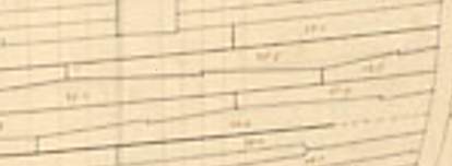

The Berwick stem main wales length ratios are somewhat similar to what I had but they show a hook in the shortest piece... no straight runs.
The Berwick stern shows the bottom most piece being quite long.
Queen Charlotte stem are longer straighter runs, and the stern bottom most piece is short.
Could they be more opposite?
The double hook shape is growing on me. The longer pieces translate to fewer to make and possibly fewer errors(?).
The straight runs at the stem and stern help with fitting and are a cleaner finish at both ends.

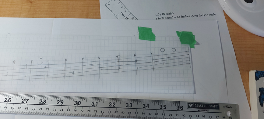

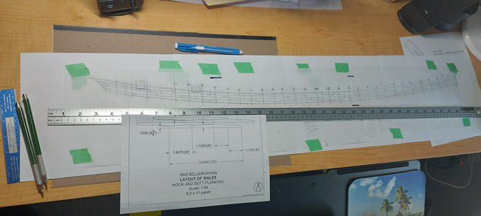

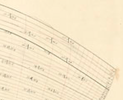

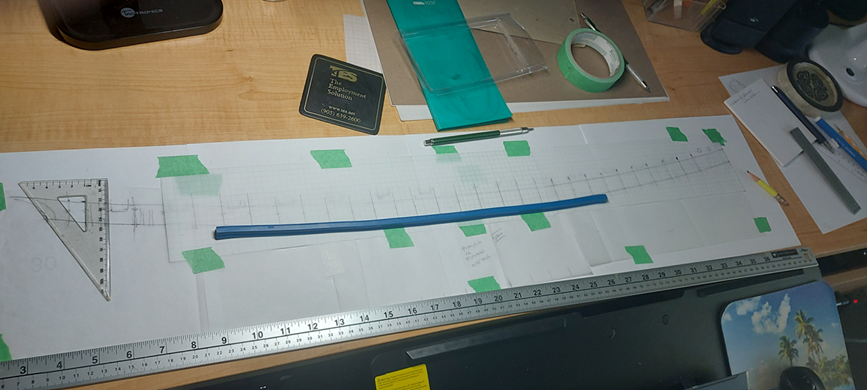

Completed the main wale edition 3 layout with the slightly more complicated double hooks.
In the first photo you can see the tools used. Not so obvious is the straight pin used to hold a point of the printed sheet so it could be spun a little to help make it all follow the curve of the wales.
I have a flexible curve from my pencil and paper drafting days, works better in this instance than my French curves to make a long gentle curved line.
I copied (traced) my original boundaries (taken off the model and onto tracing paper) onto a new fresh set of overlapping tracing sheets.
I slide the printed layout of the wales under the blank sheets and went to work with a 2H pencil.
You can see the results in the second sheet.
On the third photo is the bow layout.
Now I have a dilemma. Do I head downstairs to the basement and start cutting and sanding to thickness new stock, and start tracing, cutting and sanding new pieces... or do I spend the last few sunny days of post summer (fall) outside. Tough one!

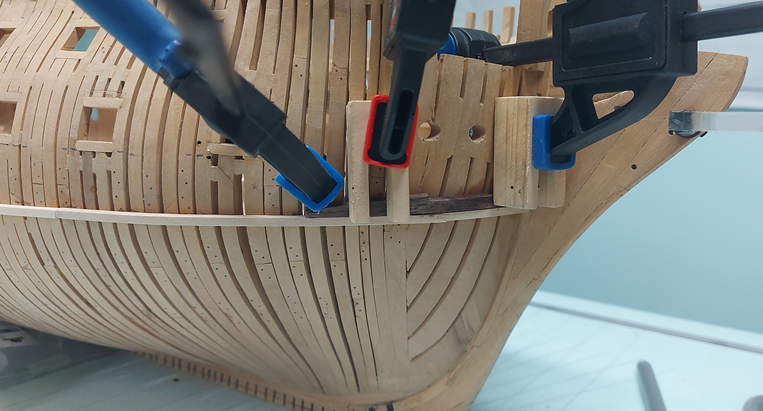

I started with the lower most forward piece. Marked off the chamfer to fit to the stem post on both port and starboard pieces. Shaped the first one.... pretty good.
Shaped the second one... darn it, I did the inside rather than the outside. Made a new piece and did it correctly.
Tried to bend them with a new 30W large round head bender... wouldn't work.
Tried wetting it and then bending with the new tool... still wouldn't work.
My guess is 30W is inadequate heat for the thickness of the part.
I soaked them in boiling water and clamped them onto the frames.
I'll use my soldering iron barrel tomorrow to put that little bit more bend to them to seat properly.

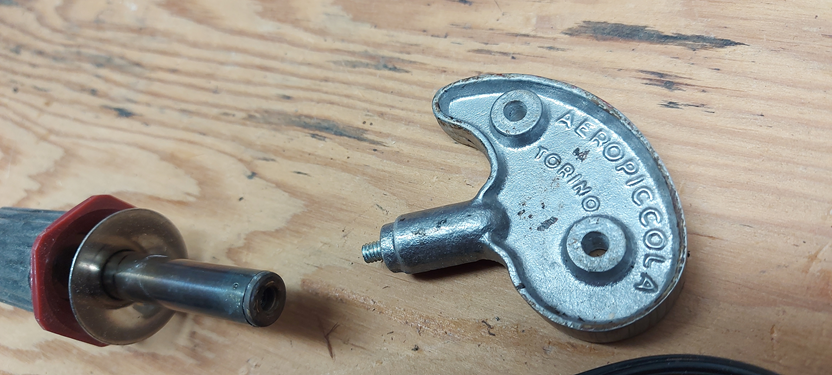

A member of our club gifted me a Areopiccola bending head but it doesn't fit my irons.
The irons have a small threaded hole
The Areopiccola head is 10mm diameter and split to slide into a barrel with a 10mm hole.
I need to find a soldering iron that will accommodate it. With adequate heat it should work.

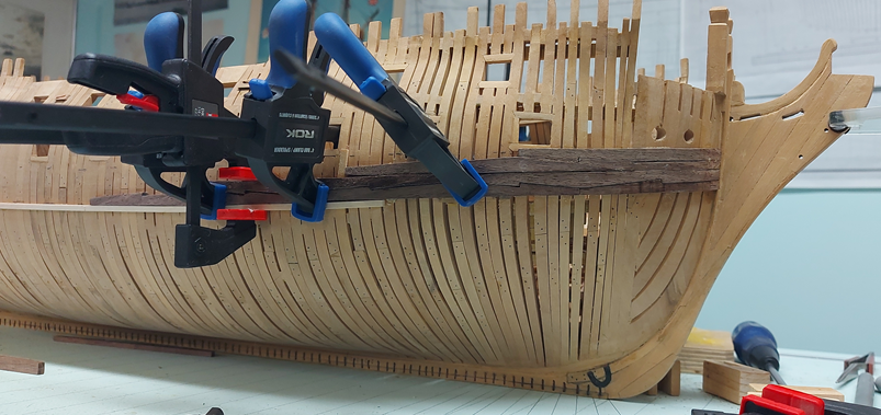

I've the one set glued on now and two other sets soaked and clamped presently.

Soaking the pairs in boiling water then clamp them to the frames, one on each side of the ship (port and starboard).
Once dry they come off and the soldering iron gets used to remove the spring back.
Then they get glued and clamped in place.

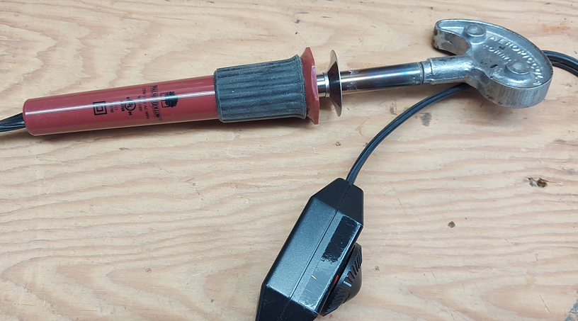

I managed to get the gifted Areopiccola bending head adapted to my soldering iron.
I cut off the  two tabs, filed and sanded it flat and no sharp edges.
Drilled with a #29 bit and tapped 8-32 thread, then inserted a screw, cut off the head and filed that edge.
Then just screwed them together. (Thank you Mort!)

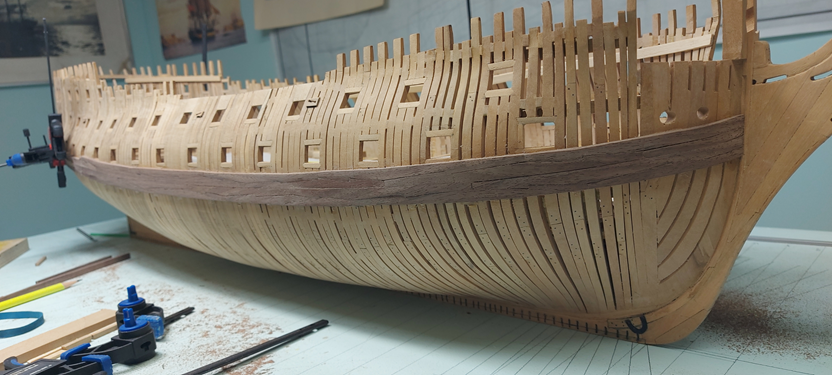

Getting near the end of installing the main wales.
I'll be away from the shop for a few days.
When I get back I'll install the last 2 sets and then work on planking the lower transom and sanding the wales to the planking.
