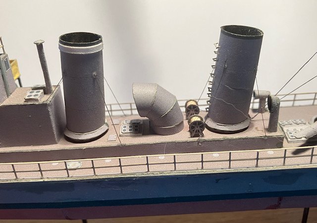

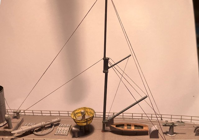

  21. Rigging was a bit difficult. The thread is flytying thread (mostly 8/0), wich is almost thinner than my eues can see :). Also, it’s glued using CA, and CA and I are no friends Both antennae were done twice. Took me a whole afternoon. But it was worth the additional work: adding the antennae ‘explain’ the relatively long masts. again thanks to Chris for his tutorial on this ship/kit. Very helpful indeed. Jan
  22. And today, I finally finished the V108 (apart from the flag, that should be there, but was not included in the download). The antennae were a bit of a struggle, but they meet my standards. Hindsight: I did not take the model completely serious in the beginning, so the hull is a bit sloppy, with painted patches. Apart from that: I’m content with how it turned out. Jan
