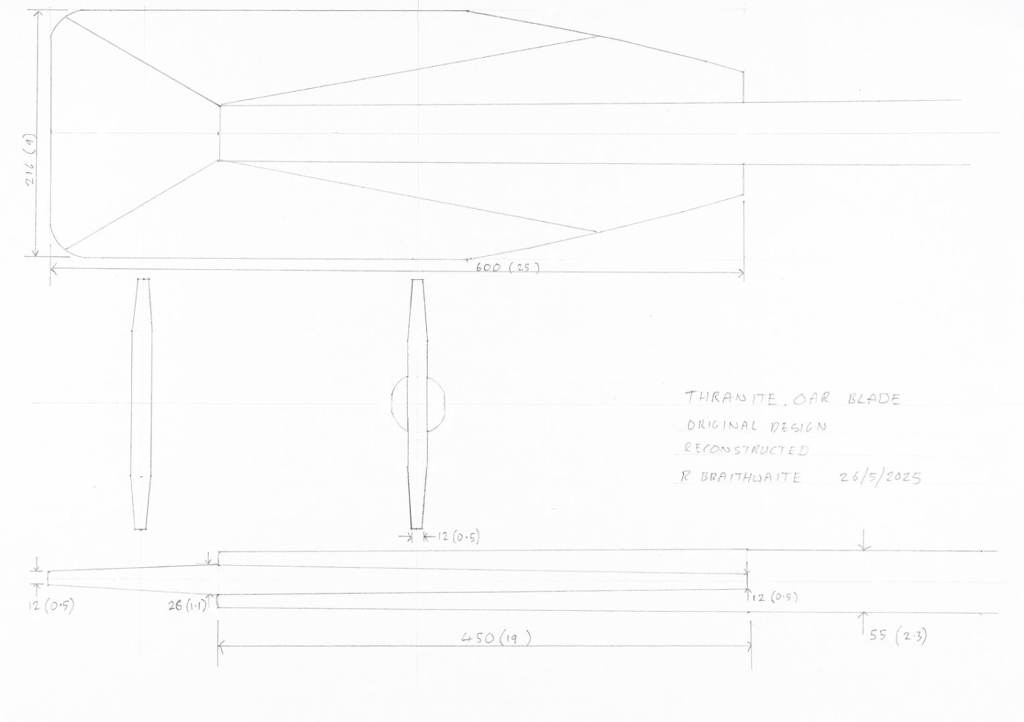

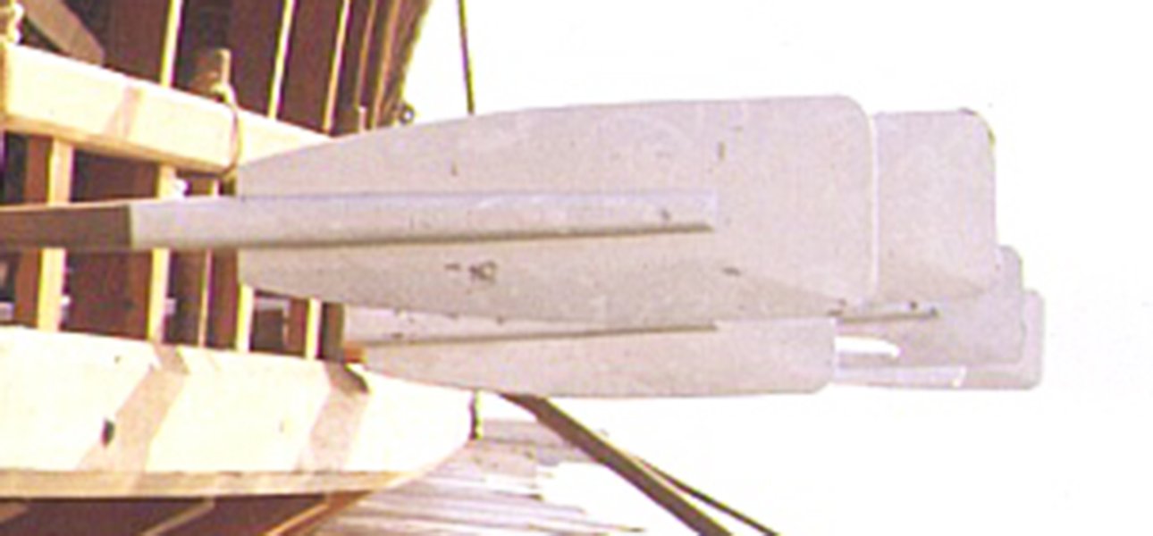

Now rethinking the blades.

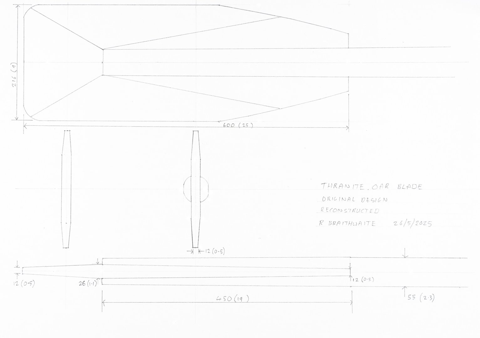

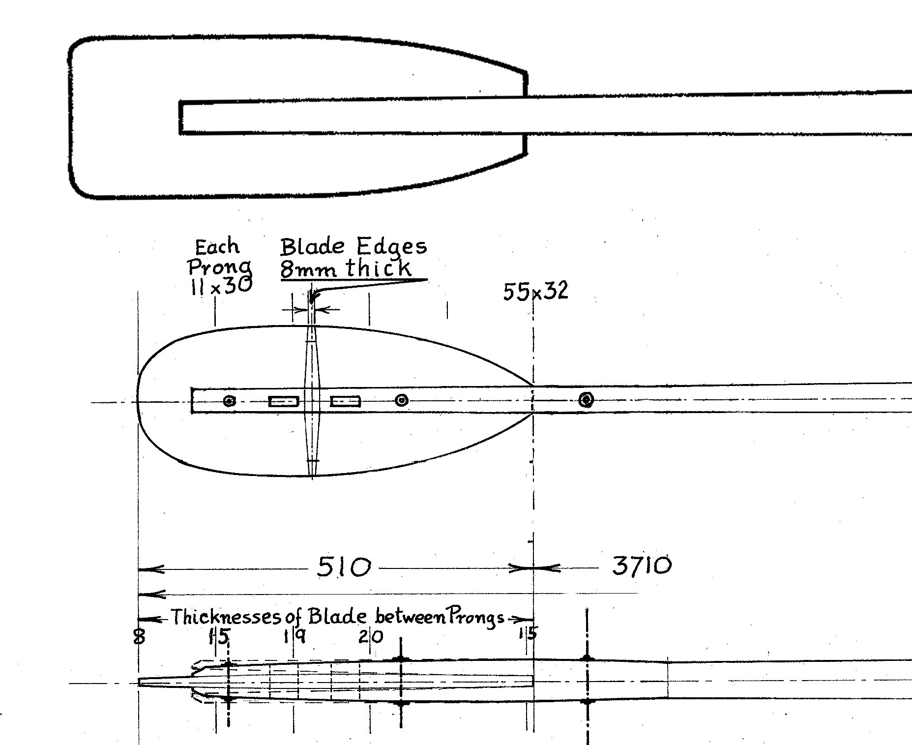

I havent been able to find drawings of the original Thranite oars in the Trireme Trust Archive. However there is a drawing showing how these were modified in 1989 to reduce their weight from 17kg to 6 kg by shaving down the shafts, and reducing the thickness and area of the blades. Extracts from the Midhsip Section (Plan 8 ) and the Modified Oar drawing (Plan 15e) show how the form of the blade was altered. The upper plan view is of the original form and the lower plan and section shows the modified blade.
Extracts from Plan 8 and 15e( © Estate of John F. Coates, reproduced with permission)
The oval form of the blade was also intended to make them slide over one another more easily to reduce entanglement.
As you can see from the section view the blades were not simple flat pieces of wood, as I had originally planned for my model, but were tapered. The form of this tapering in the original design is sugested by this image of the full size ship.
Ive reconstructed this form in the following sketch for my model:
The lines in the plan view radiating from the end of the shaft prongs show the edges of the tapered faces which I will need to machine in the blades, although the photograph sugests that the inner faces were faired to remove any hard edge.
So, I now need to make up some more jigs...
Edited by Richard Braithwaite

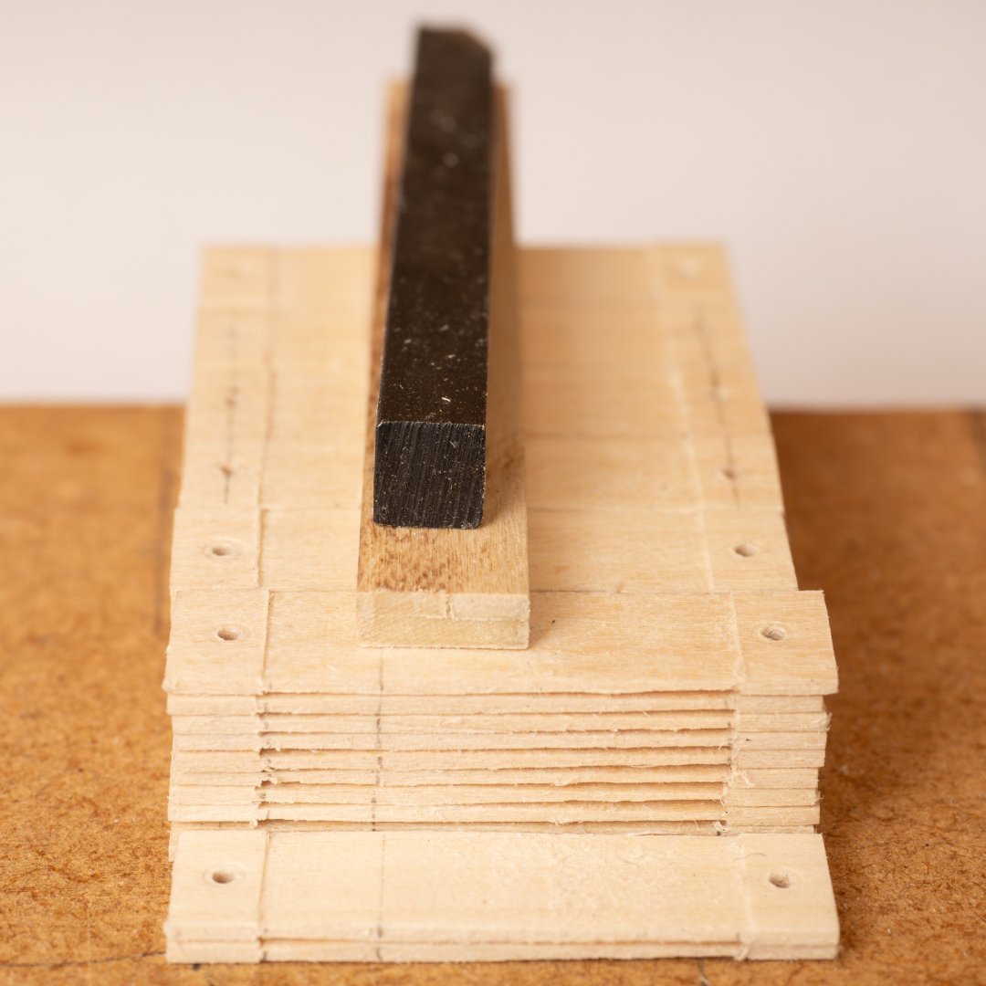

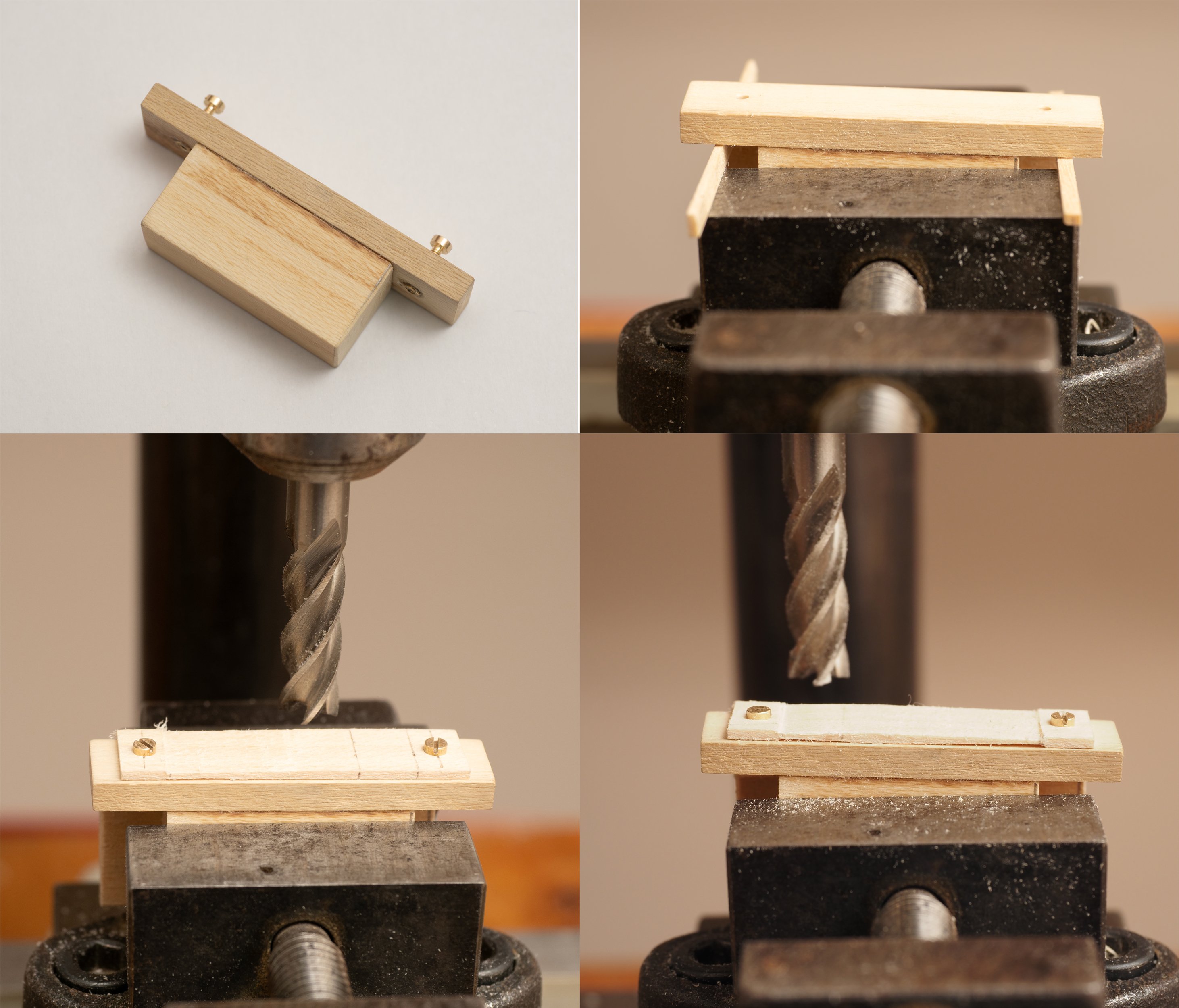

Tapering of oar blades:
  • Image top left:  jig, made of holly to make it (hopefully ) robust enough for use with all 62 Thranite oar blades.
  • Top right: set up in machinists vice on Unimat with spacers cut to incline the top surface or the jig correctly for the taper to be cut. In hthis case it is set up for the short taper which means a 1.25mm difference over the 30mm length of the vice. (0.4mm difference for the long taper).
  • Bottom left: Long taper being machined (both sides)
  • Bottom right: Short taper being machined (both sides)
Finally 62 Tranite blades tapered (about 16 mins/blade...)

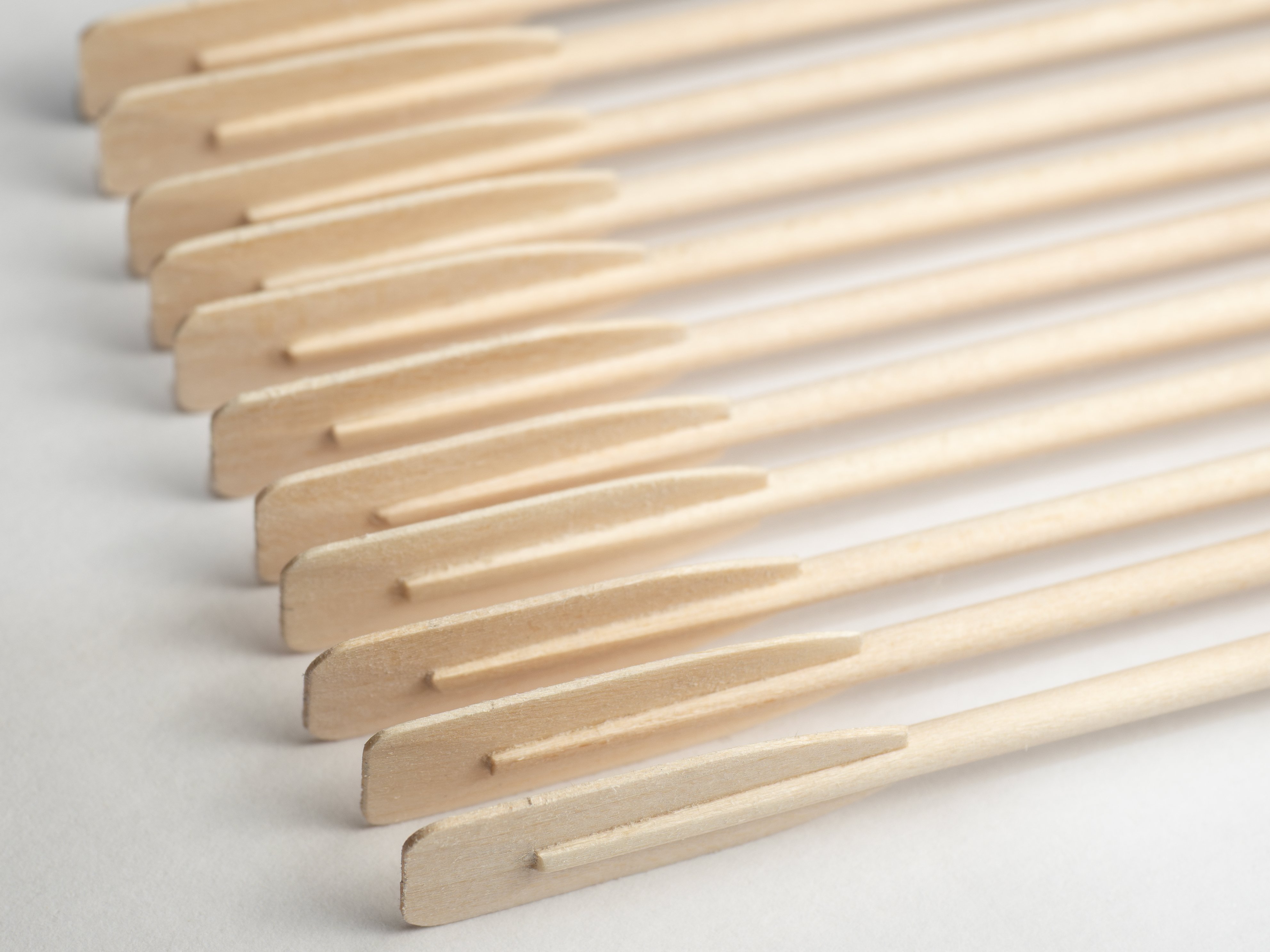

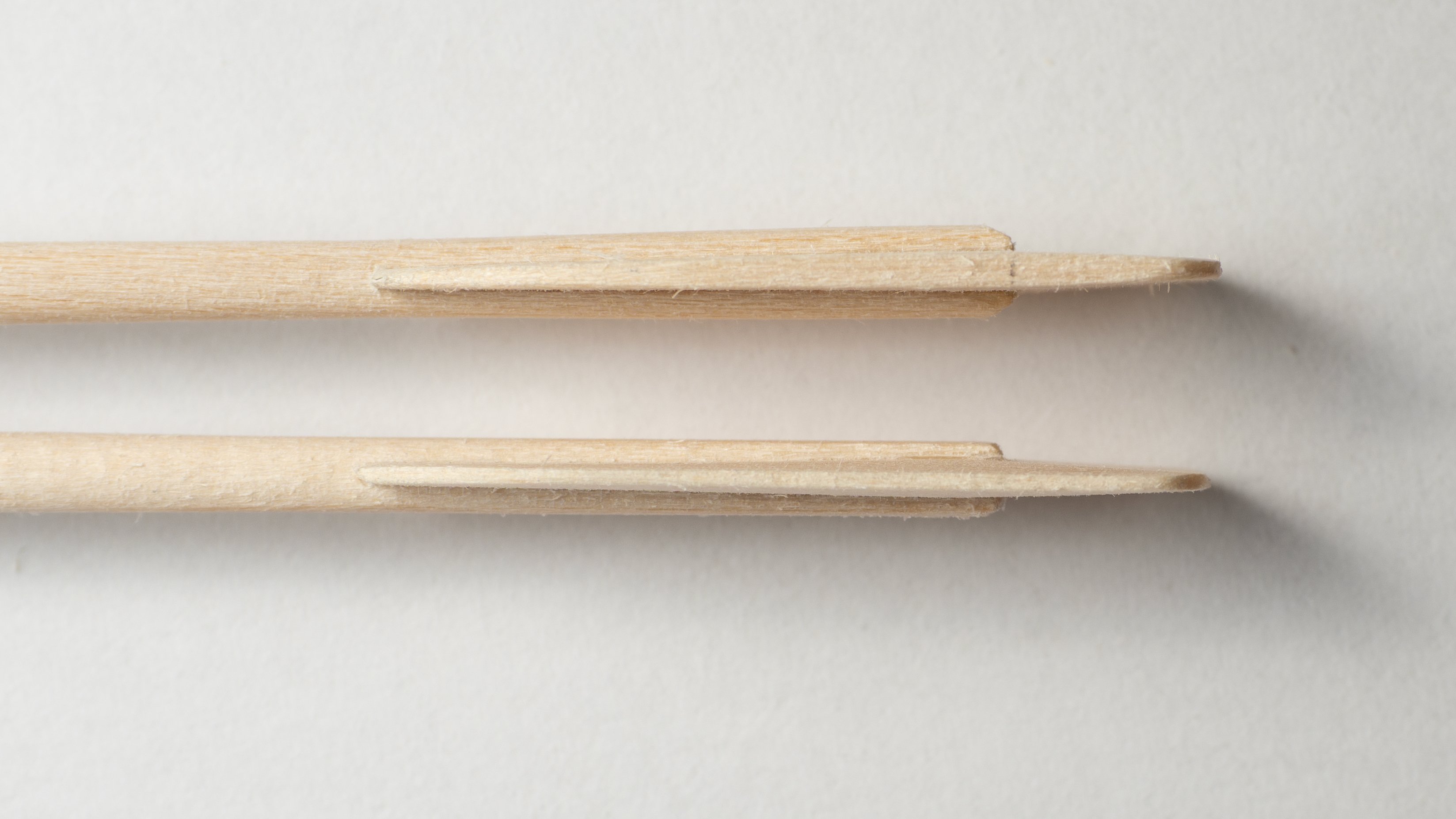

Next steps:
  • Jig fixing tabs removed from blades and blades shaped to plan view using a ply template pattern (that same 0.5mm ply I was originally planning to use for the blades...)
  • Blades fixed to oar shafts between prongs. As the slot between the prongs was milled to 0.5mm the prongs flare to accomodate the long taper on the blade (0.5 to 1mm thickness...) as can be seen in the upper part of the image below.
  • Prongs tapered along the long taper of the blade to remove the flare (see sketch reconstruction of blades in previous post)
  • the side taper (to bring the edges of the blade down to 0.5mm all round) was then done using a file and sandpaper by hand, as can be seen in the lower part of the image below.
Total time taken for all this approximately 40 mins/blade. Quite a lot longer than just fitting 0.5mm ply blades and probably almost impossible to see the difference once they are finished and painted white, but so be it...

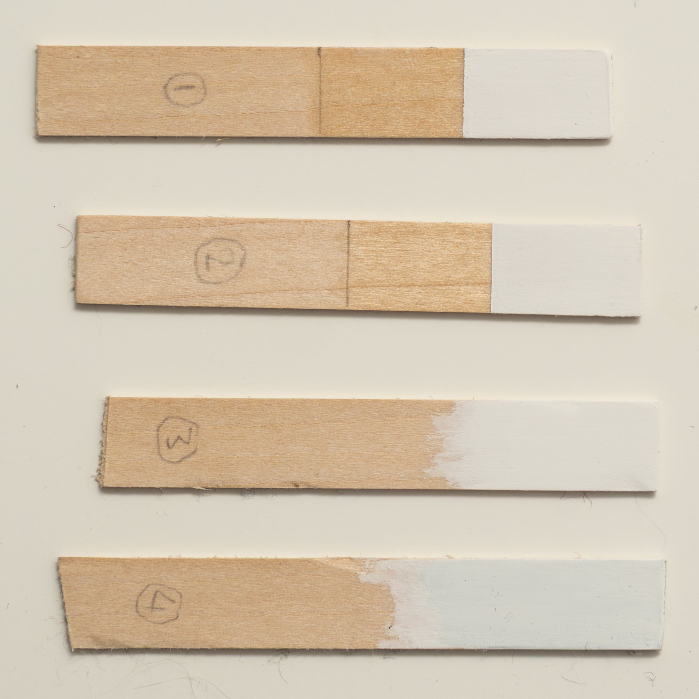

An exciting post about paint!

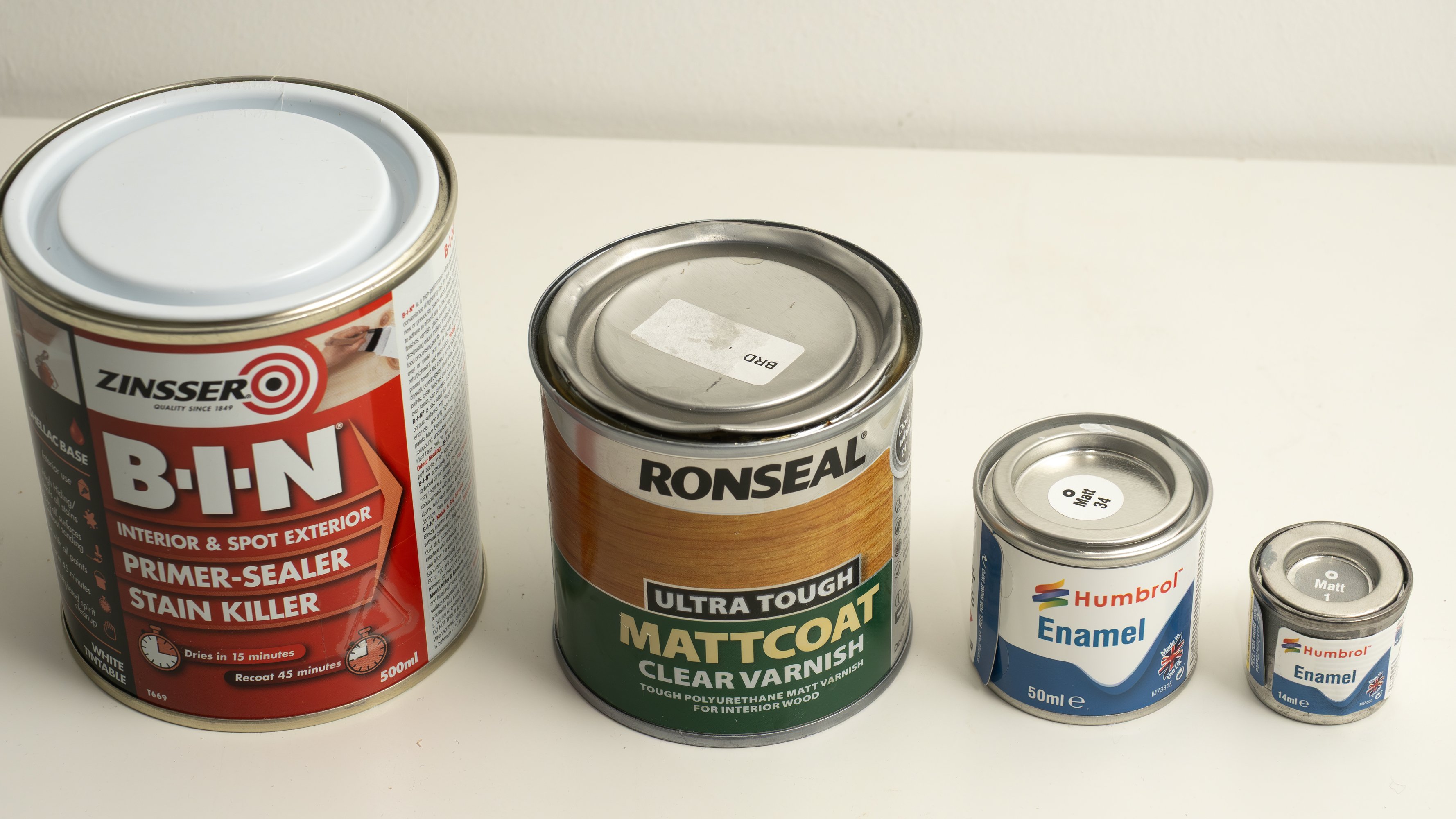

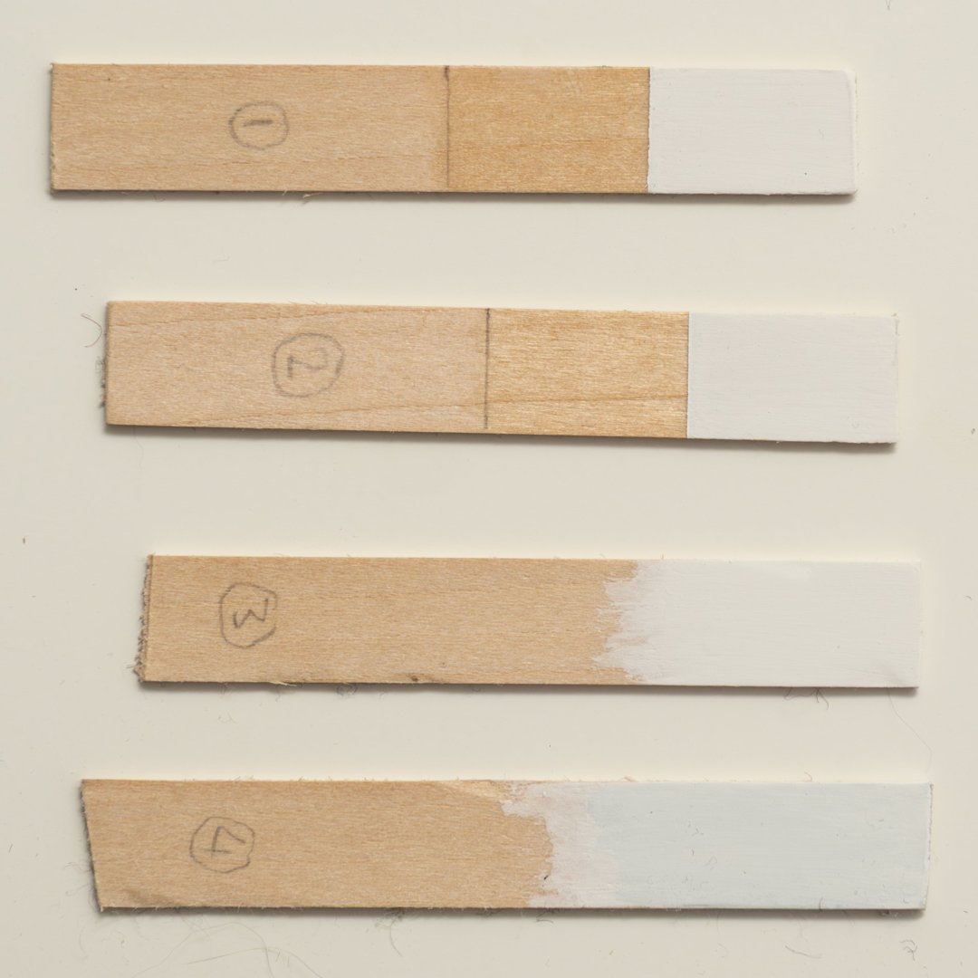

I need to coat my oars. Shafts varnished and blades painted. Products Ive tried below:
Four different trial combos below.
1. 4 coats of varnish just belond the boundary. 3mm Tamiya masking tape at boundary (with a varnish seal along edge) then 1 coat BIN primer (on bare wood) and 3 coats white matt enamel.
2. 4 coats of varnish over bothe areas. 3mm Tamiya masking tape at boundary (with a varnish seal along edge) then 1 coat BIN primer (on top of varnish) and 3 coats white matt enamel.
3. 3 coats white matt enamel on bare wood.
4. 1 coat Humbro undercoat (on bare wood) and then 4 coats of white matt enamel.
The grey Humbrol undercoat seems to need a lot of coats of white enamel to cover it (it still looks a bit grey with 4 coats).
Apparently the shellac in the BIN undercoat will slow the discoloration of the white paint by blocking any oils coming out of the wood, so Im probably going with option 1...although it seems a shame not to use the Humbrol Undercoat with the Humbrol paint...
From what you describe, I think your choice of option 1 is best also.  In the end though it is your choice Richard. Is this just for aesthetics or to waterproof them? If the latter, I think you ample coats to do that.
cheers
Pat
Yes the philosophy throughout has been waterproofness, hence use of expoxy for bonding and polyurethane for sealing. But aesthetics are just as important (probably more so now, given how much further Ive ended going with this model than I origianlly envisaged...)
