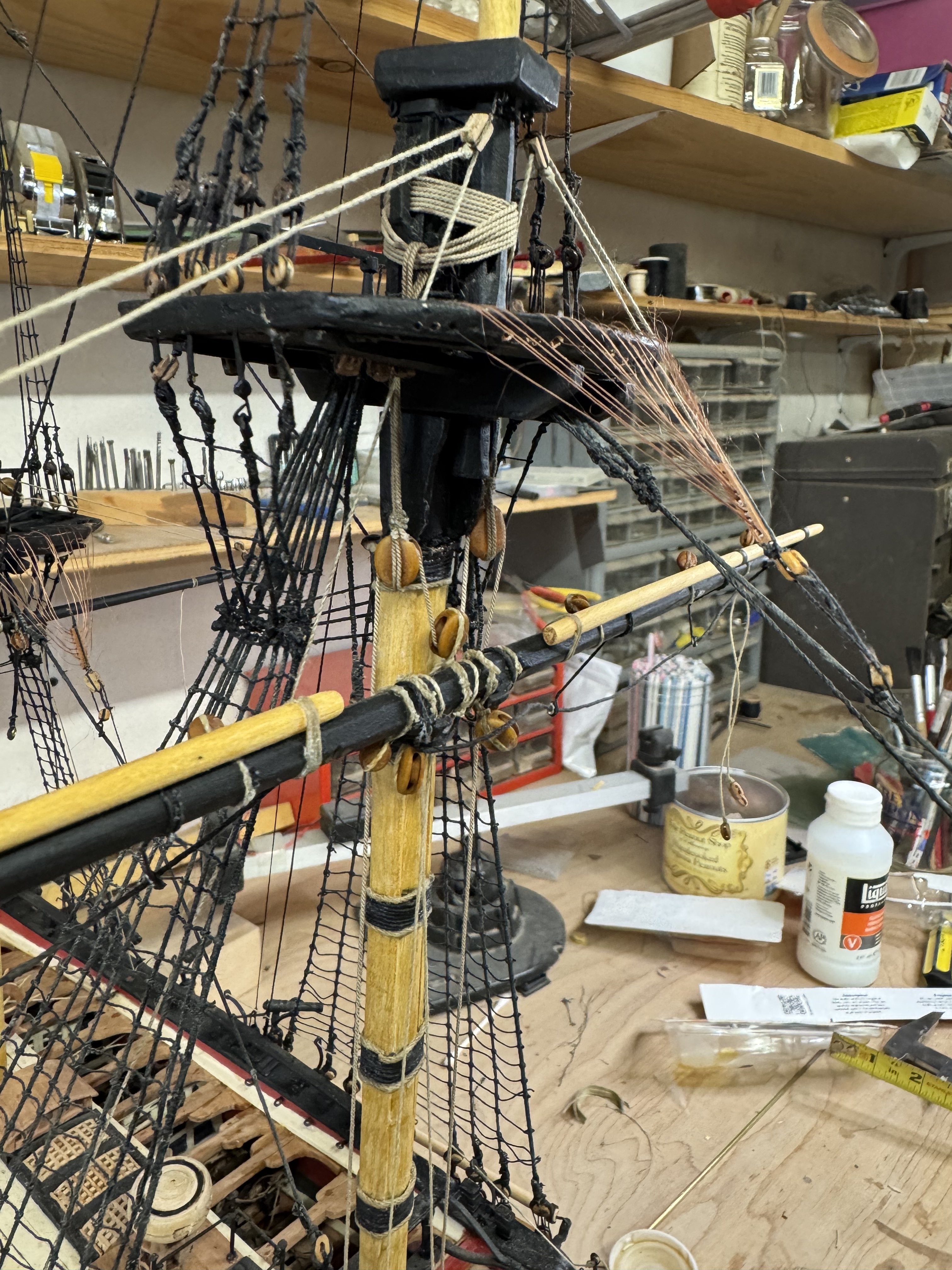

Euphroes and crows feet were a challenge. I followed Dave’s advice and used 6/0 thread from my fly tying bench. #26 drill with the milling machine. If the holes in the euphroe are too close together, the thread saws its way through from one hole to the next. Leave a distances about equal to a hole diameter between holes. The thread I tie flies with in brown is not mono thread, and it readily comes apart into many tiny filaments unless it’s treated with dilute PVA. After many painful hours of trying to thread that 6/0 thread through the holes in the euphroes, I got a sewing needle from my wife and a needle threader and that made a big difference, especially when trying to reverse thread the holes in the tops. I also learned the hard way to keep tension on the crows feet during threading. Otherwise the euphroe has a habit of rotating, which gets quite confusing as one progresses causing the lines to thread the wrong way at times and losing parallel alignment. I spent about 15 hours over 3 days doing this and must have started over on each mast several times.

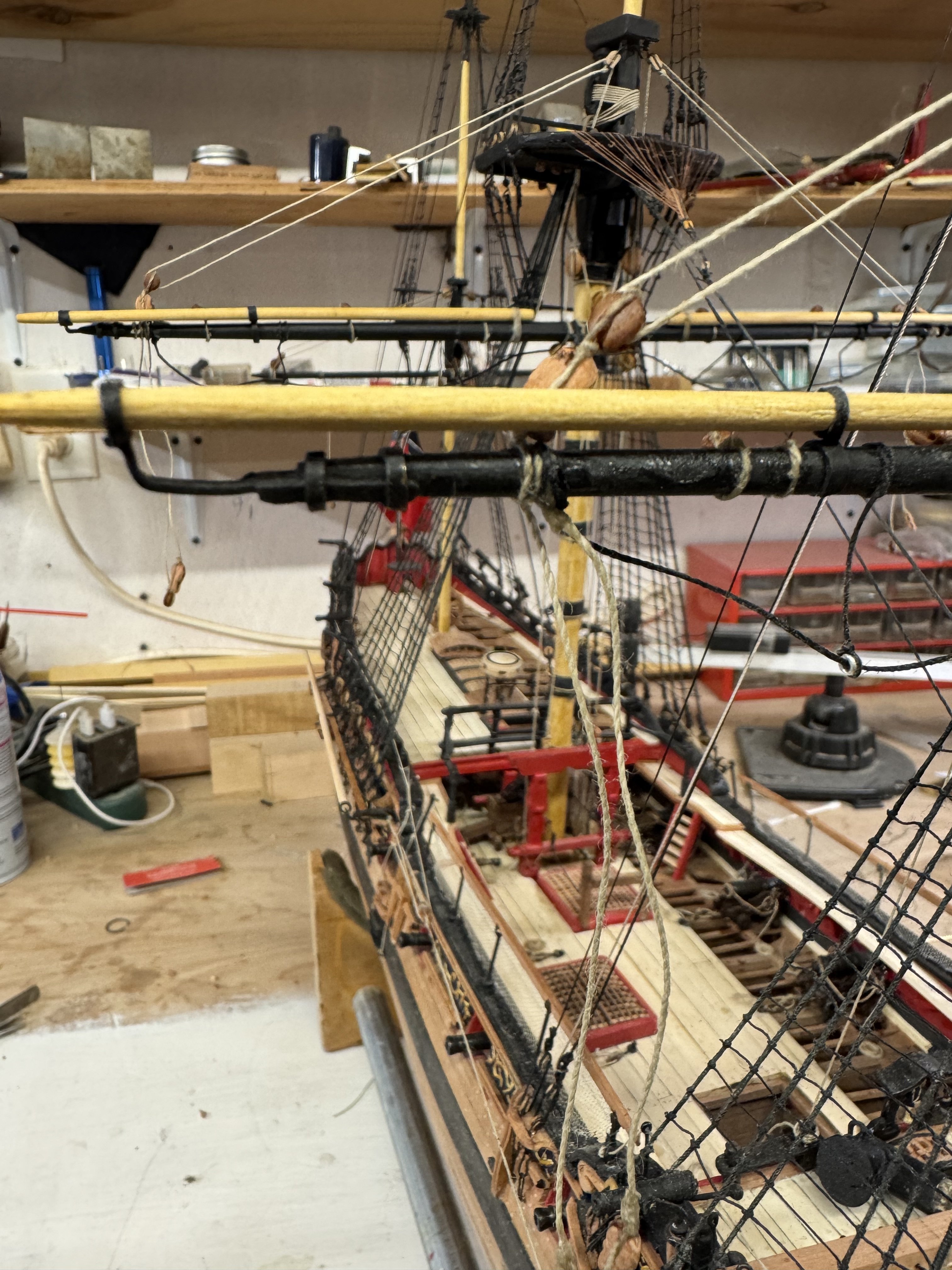

I followed David’s recommendations for the fore top spritsail netting. Here’s the jig, which seems essential, and the results.

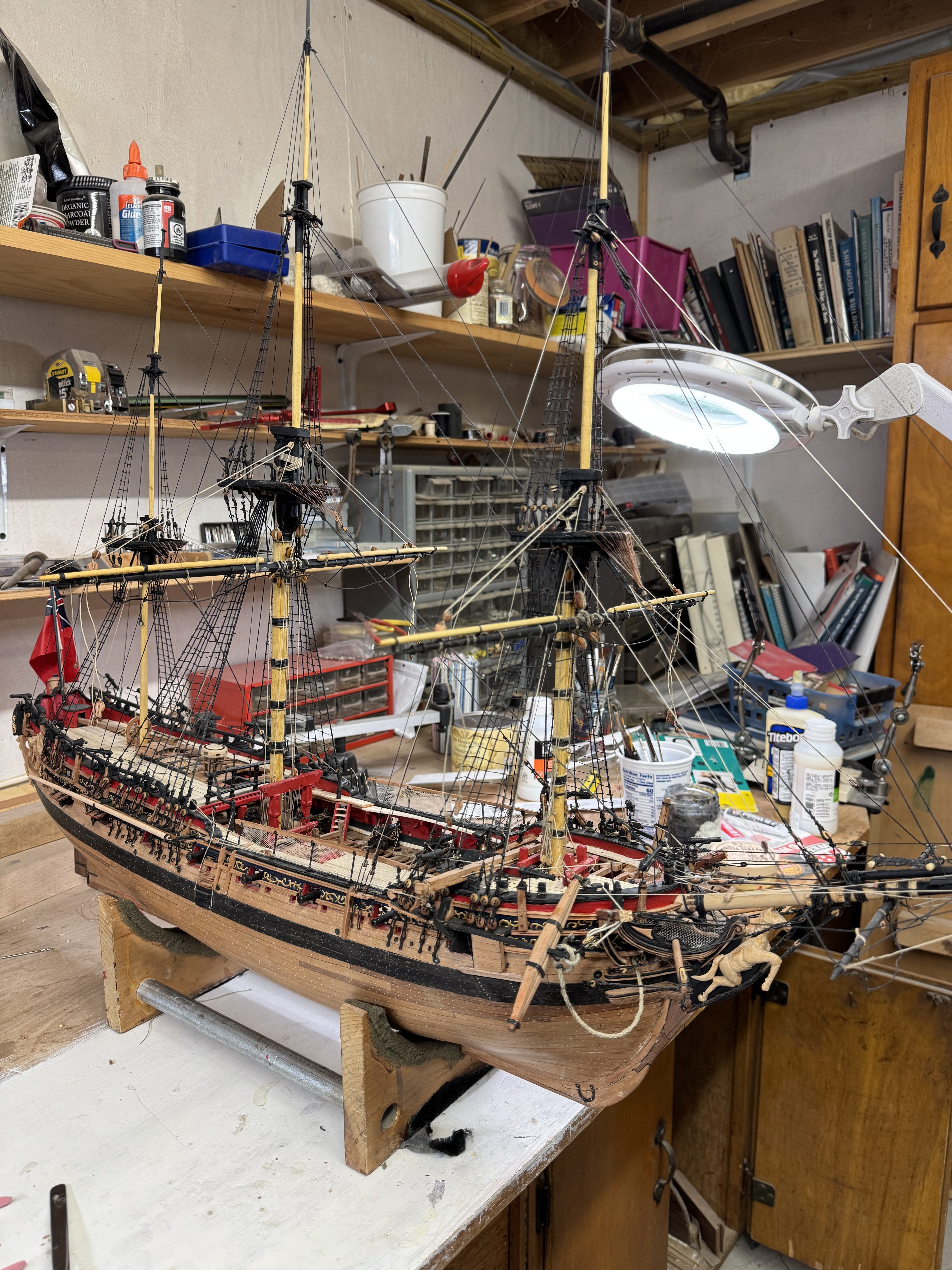

Significant error discovered. I should have added a fifth deadeye to the mizzen channels to accommodate the mizzen topmast backstays. But didn’t recognize that the 3-D computer images omit a mizzen top gallant. Instead, I used the deadeye aft of the quarter badge for the topmast backstays, leaving no deadeyes for the top gallant back stays in my version of Pegasus. We’ll, it seems that my choices now would be to 1): redo the entire mizzen and its channels , or 2):  redo the stool aft of the quarter badge to accommodate an additional deadeye. I’m leaning for the latter, but would be welcome to hear from the group.
Somewhere in the pages of David’s book he likely addressed this issue in order for those like me to avoid just this goof and is now saying “I told you so”. 🤦‍♂️
Hi Henry,your Dilemma is easily solved. You can fit an item called a deadeye plate,one of these can be seen in Blue Ensign's HMS Pegasus build log part 9, 6th pic down.  Dead easy to make,just an eybolt through small circular piece of wood (Slice off a bit of dowel). The bottom deadeye just hooks into it. I had exactly the same problem rigging my Speedwell build. The Mizzen backstay and Main T'gallant backstay and attaching fittings are totally missing on the rigging plan although they can be seen on the NMM model. It was BE who put me in the picture.
Hope this is of help,
Dave :dancetl6:
Edited by davyboy
Great! Will do. Thx.

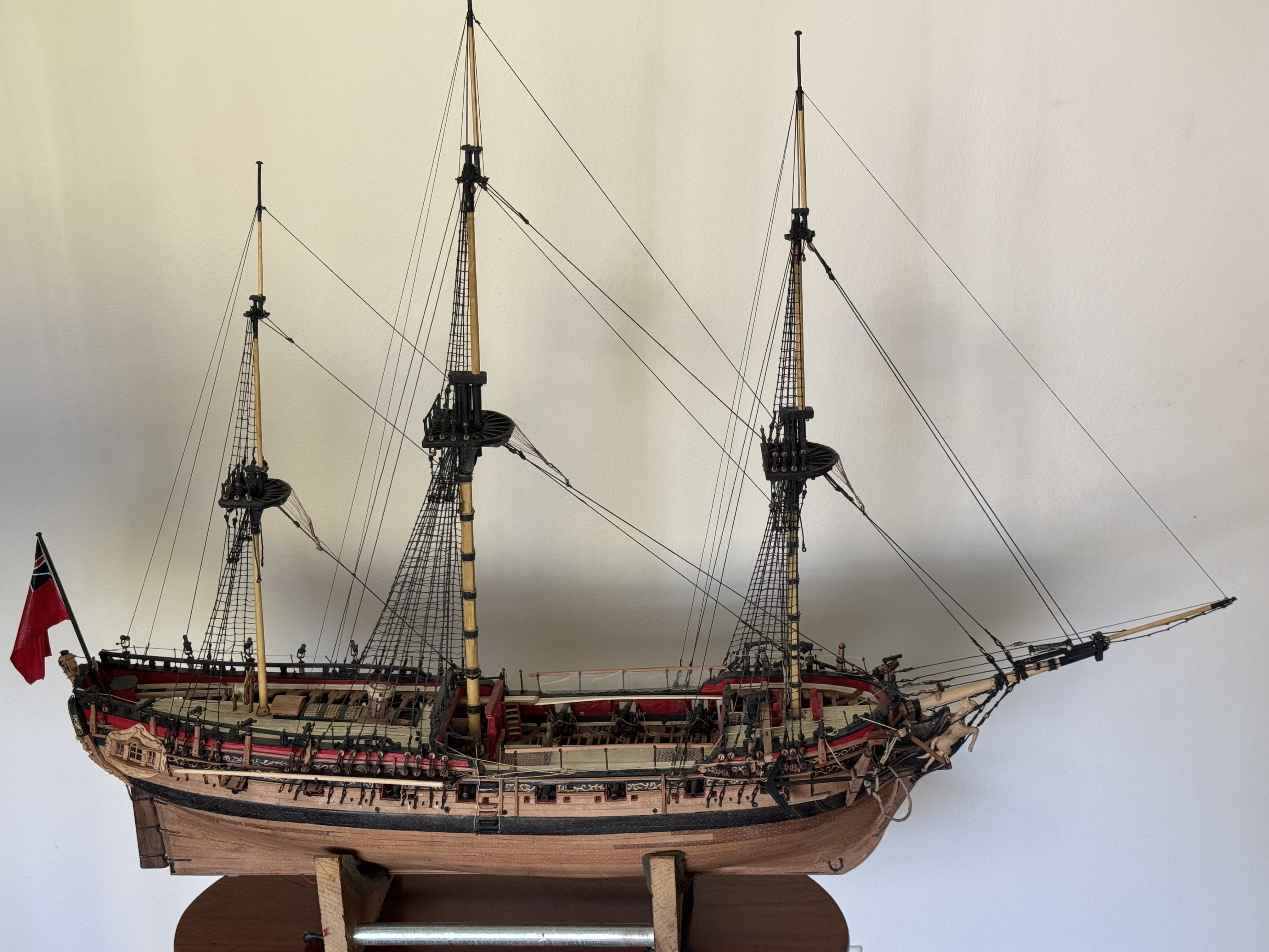

 That completes the standing rigging for this build. I can identify with Blue Ensign’s comment about the effect of rigging on the back and neck. With Spring now upon us in southeastern Massachusetts, I think I’ll take a break and prepare for the eminent Striped Bass arrival. We live on property that extends to the banks of a tidal river on the coast where the Spring migration of Stripers offers excellent fly fishing opportunities from shore, a good diversion from endless hours in the basement.
Henry
