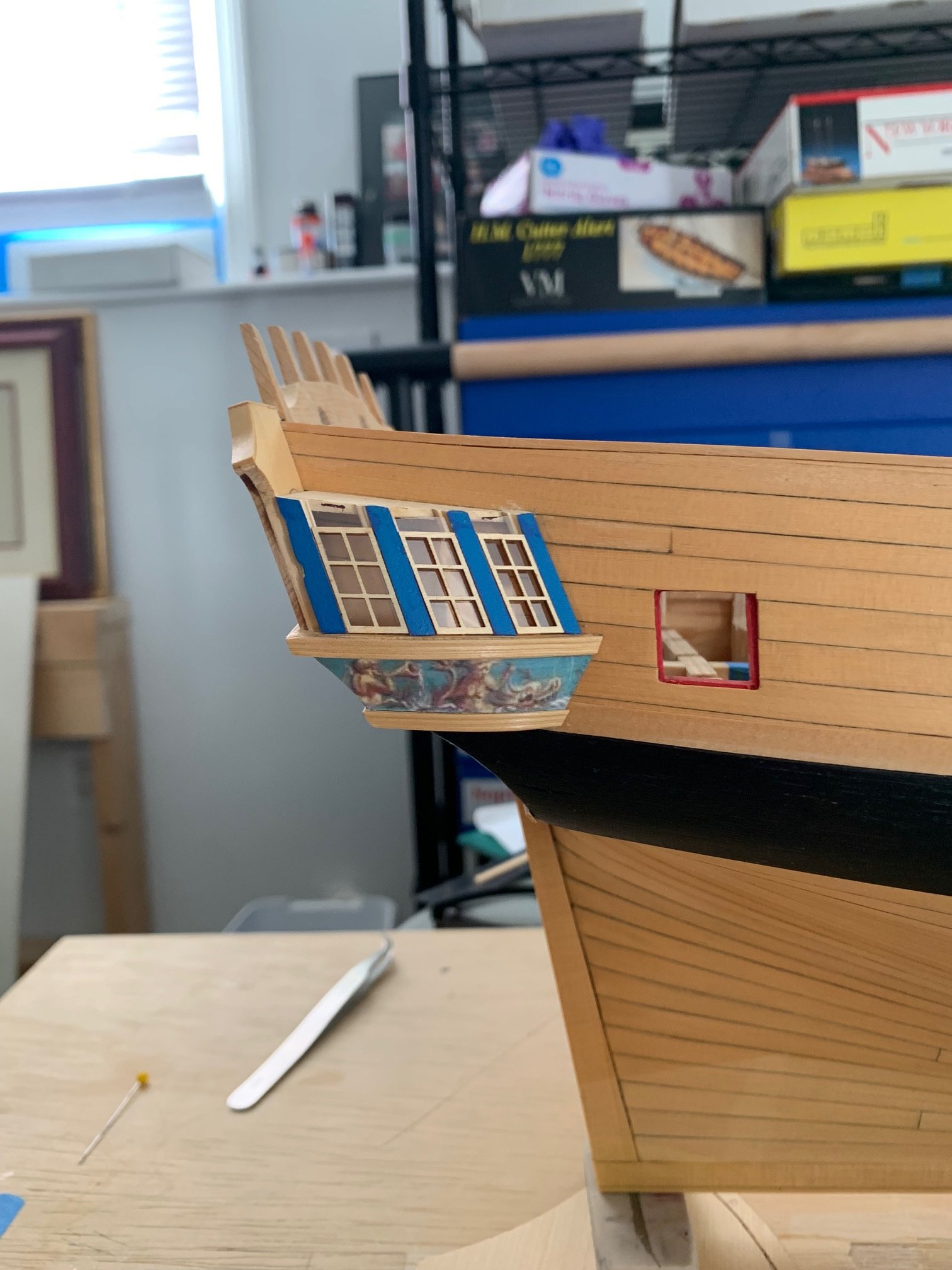

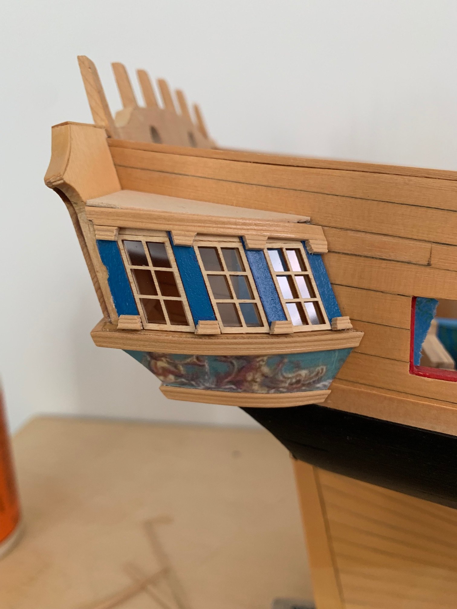

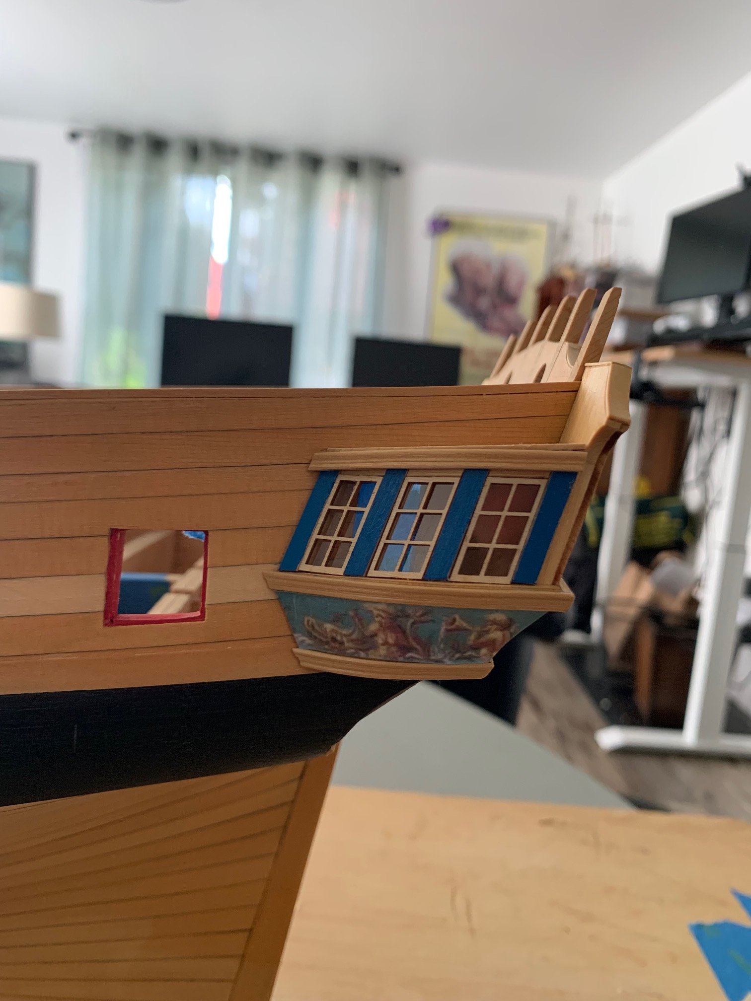

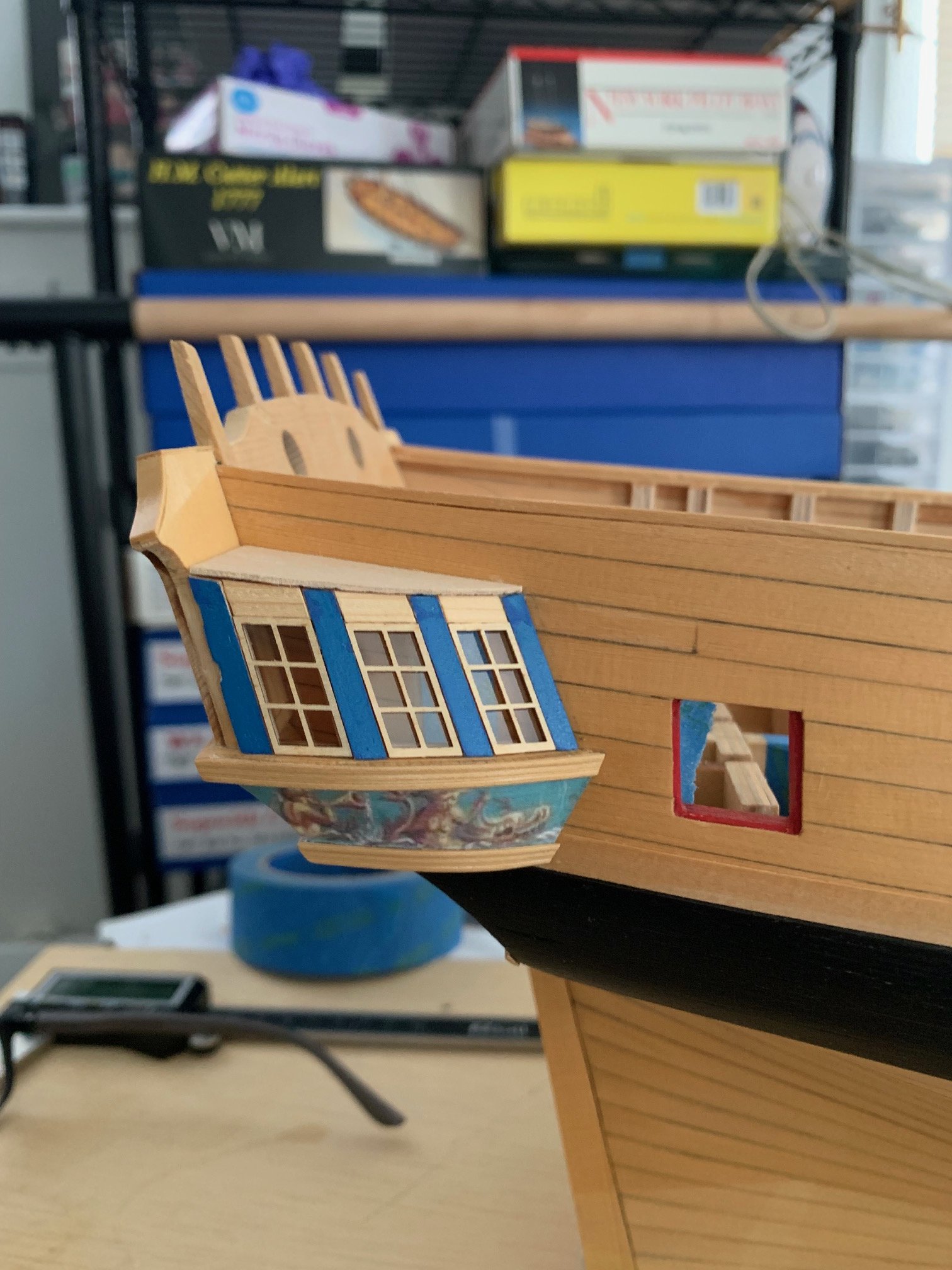

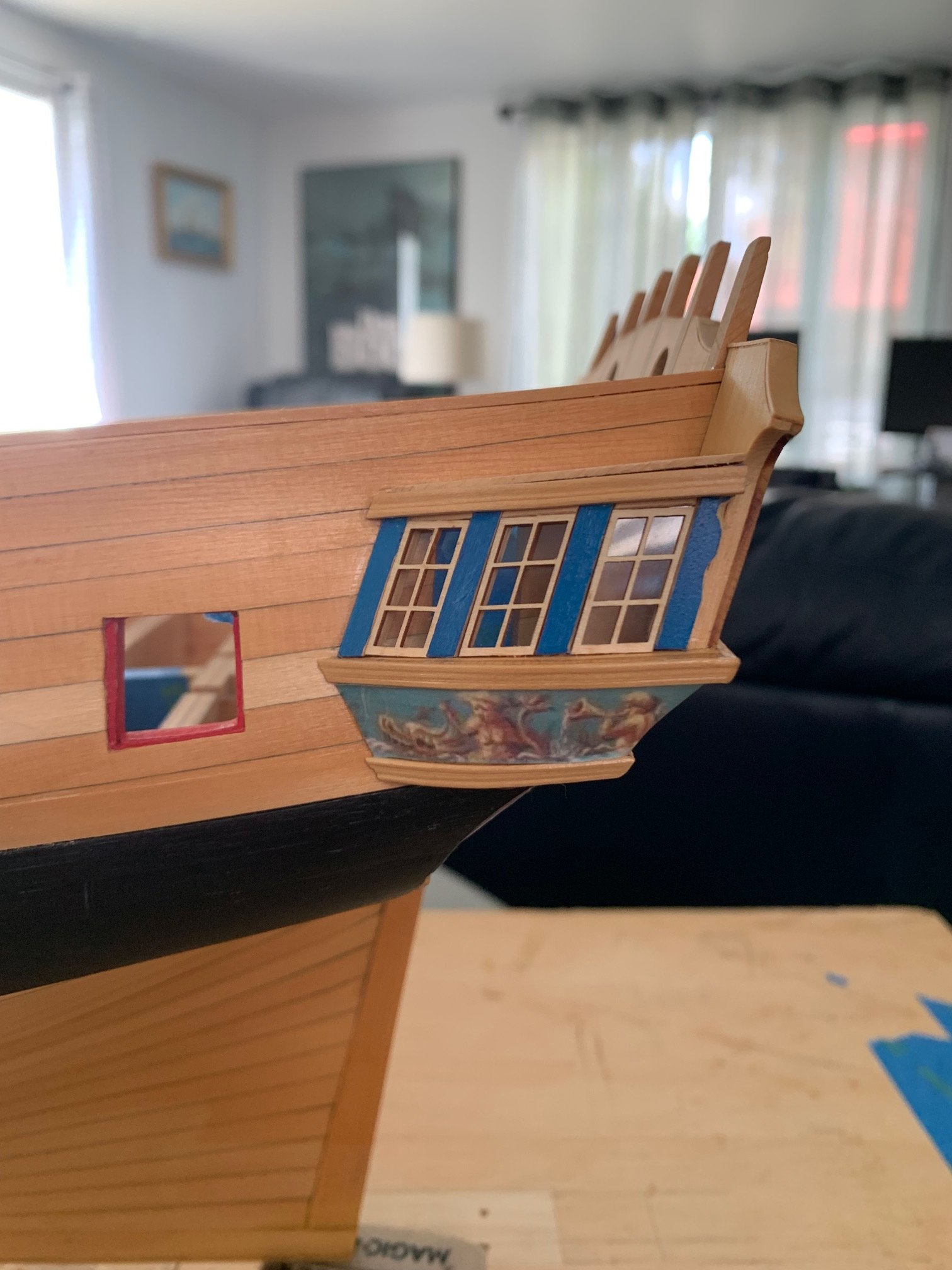

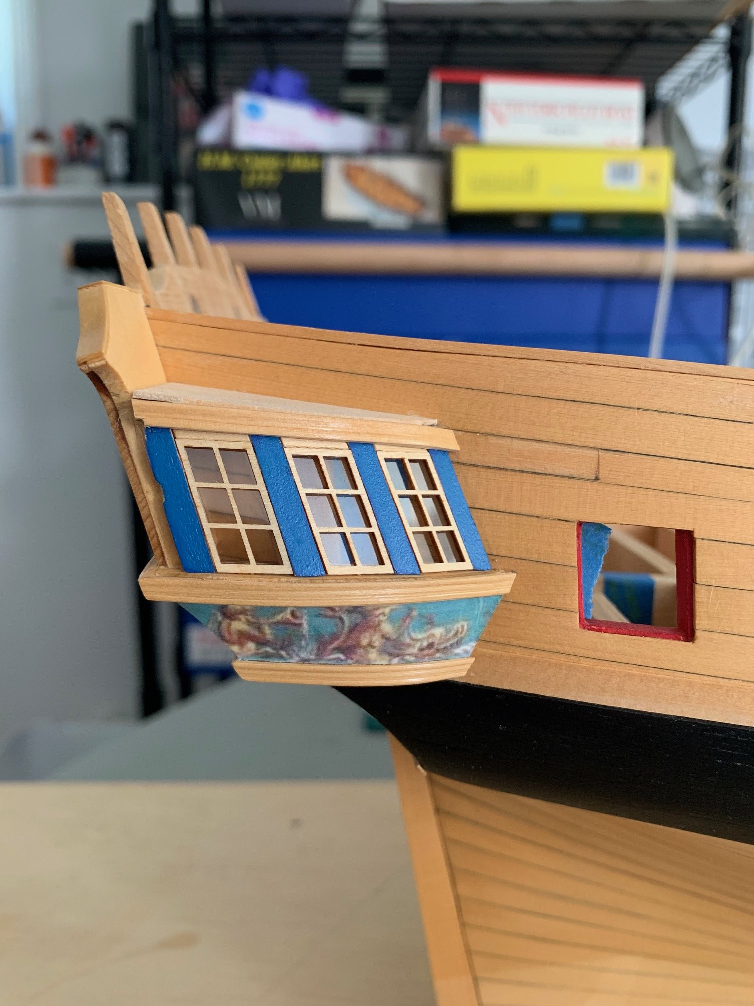

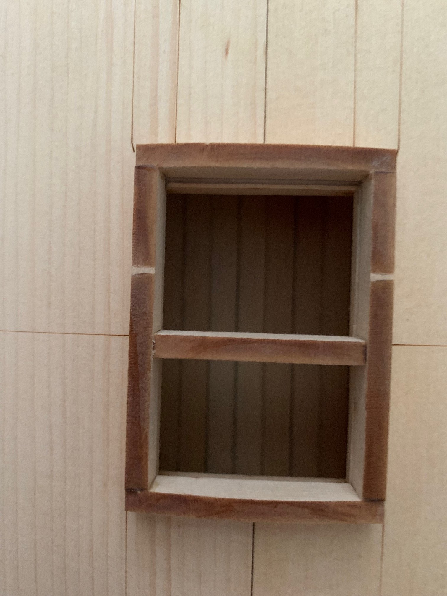

Window Installation time.  I’ve been looking forward to this and stressing in equal measure. There was a little curveball with the acetate that ended up making things simpler for me in the long run.  When I pulled the acetate sheet for the windows out of the bag, I discovered a long scratch all the way across the center.  $10 and 24 hours later, I have enough .005 acetate sheets to last me 4 or 5 lifetimes.  I started to think there’s a greater than 0% chance I may have to replace a window at some point in my lifetime, so I tried to put this part of the build together in a semi-permanent way so I could replace a window without needing to rebuild the gallery if I had to.
Before I started this step, I grabbed a can of compressed air and got every little bit of dust I could out of the galleries.  I then donned some gloves and started by cutting a piece off acetate almost to the height of the roofline and then set it in the groove without any glue.  I tack the window in place with a spot of wood glue at the upper right, upper left and bottom of the window.  Once set, the window is solidly in the groove and there’s no chance of an accidental glue smear on the acetate.
I cut the acetate long to act as a guide for the filler piece which I cut out of 1/32” cedar.  This is the same thickness as the windows.  I shaved the filler pieces to height rather than sanded as I didn’t want any dust to get in the galleries through the little gaps in the top.  I also cut a little dust cover and taped the doors to the gallery.  I think I spent a bit too much time trying to get the perfect bend on the moulding and it really marred the finish on the uprights, but this gets hidden.
Mouldings went on smoothly once I stopped fighting with them and focused on a straight run along the filler pieces.  It looks like it’s drooping at the front, but it’s the camera angle.  The moulding is only held by a dot of glue at both ends and it sits flat.
The ends of the columns had a bit of a learning curve.  The funky angles kept throwing me off thinking I was doing something wrong.  The bottoms are floating a tiny bit as well., but It isn’t noticeable at a normal viewing angle.  I’ll wait until I finish up the other side to see if I will have the same issue there and then determine if I should add a little bit extra underneath the columns.
Added the column bodies and then carefully gave everything except the window frames a brush with WOP.
Finally, a little cleanup and poster tack for the figure and the drop to make sure everything is lined up properly.  It’s not perfect, but I’m pretty happy all the same.
I'll finish up the columns on the other side tomorrow and then on to the roofs.

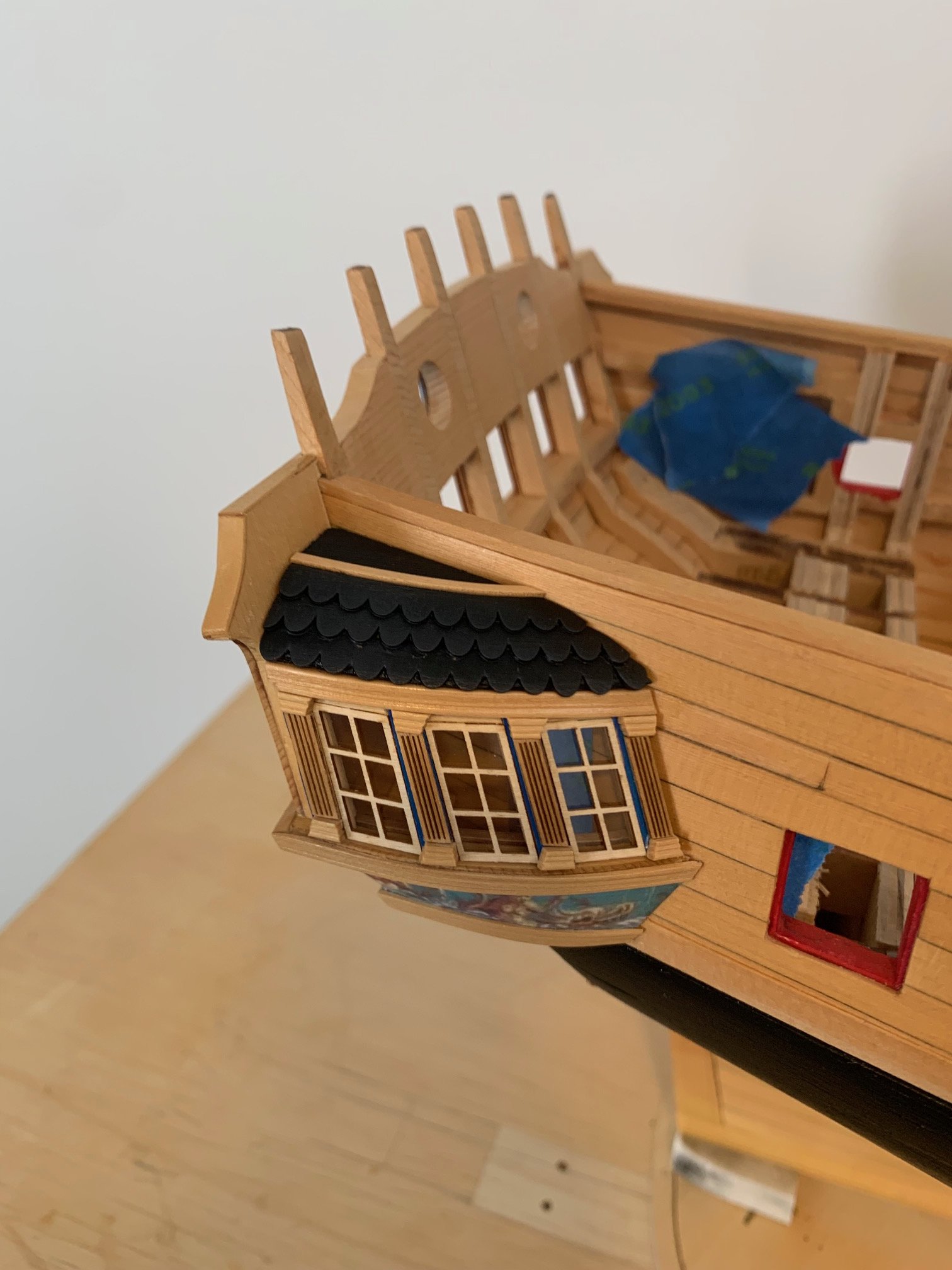

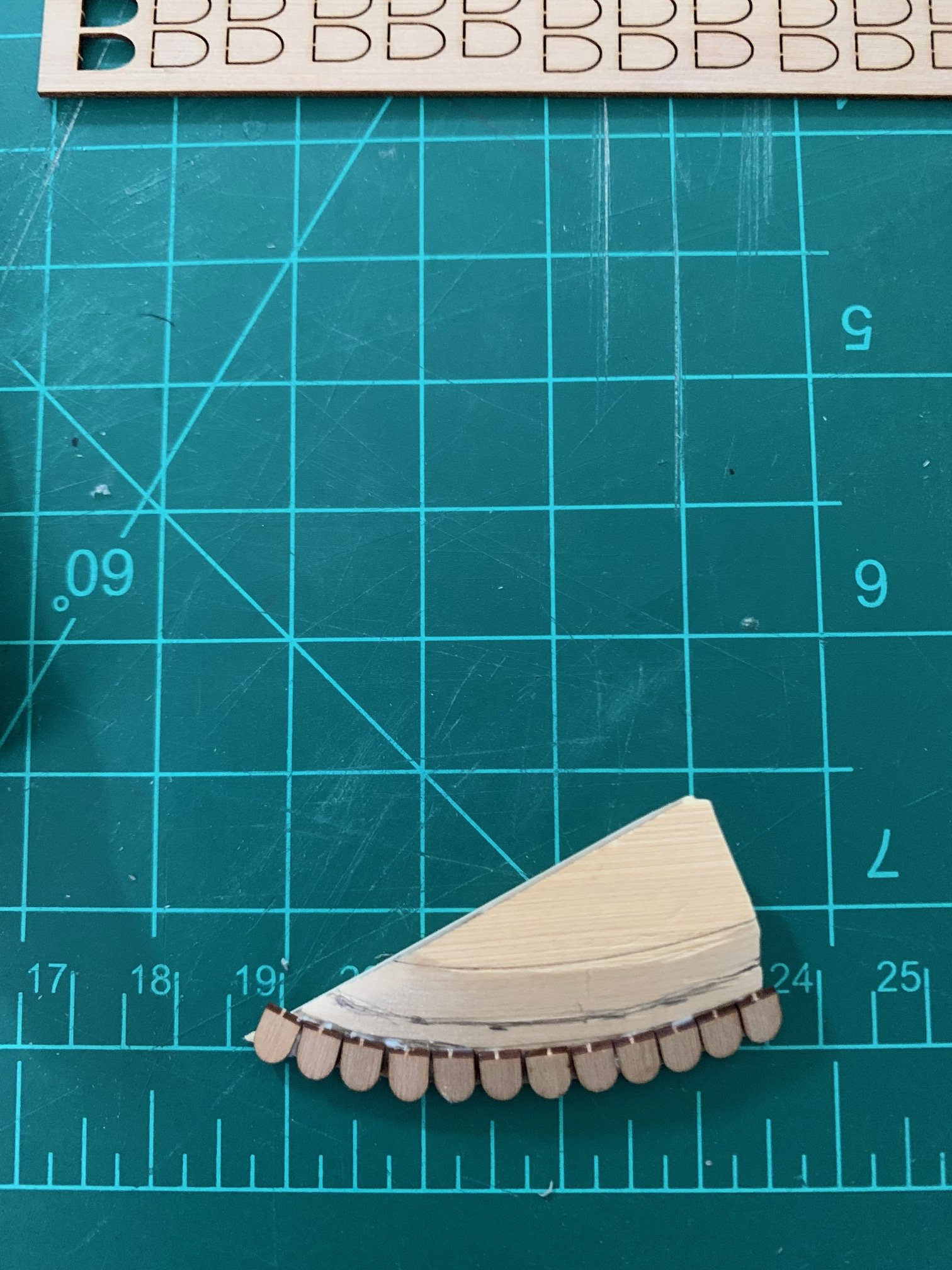

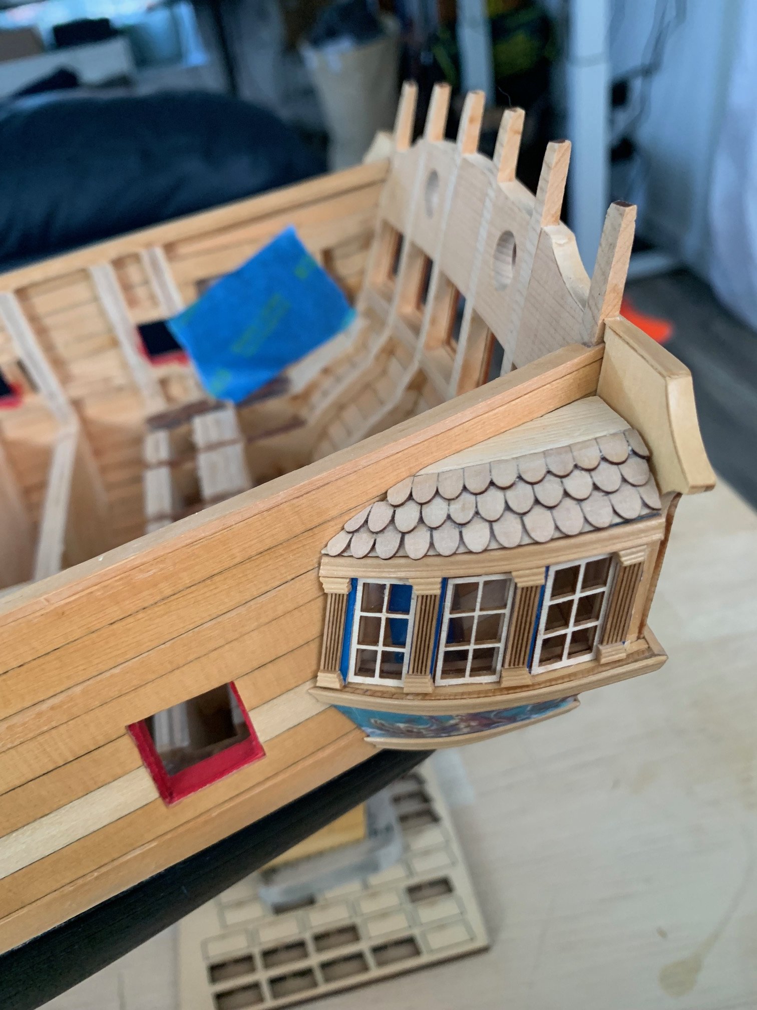

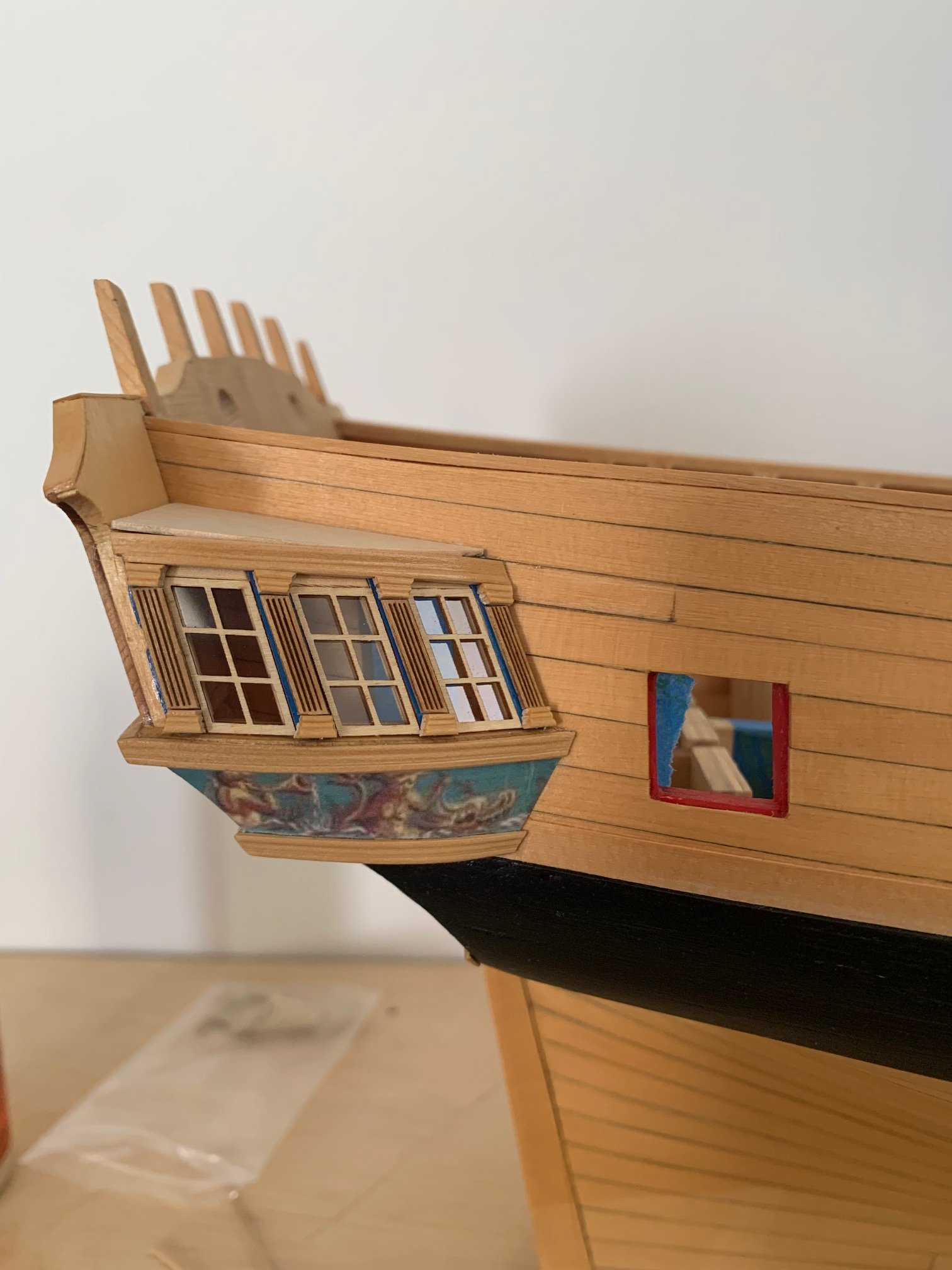

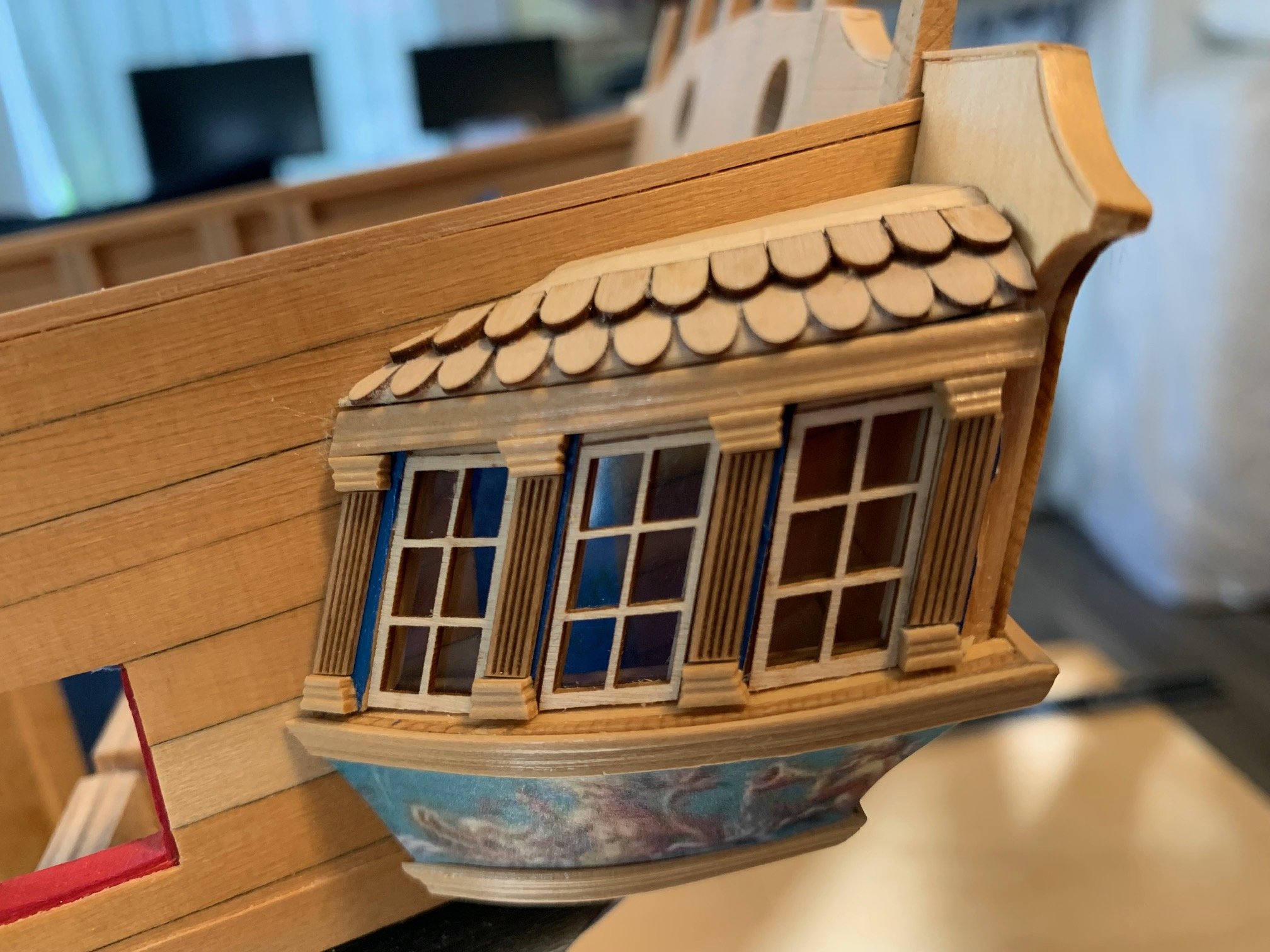

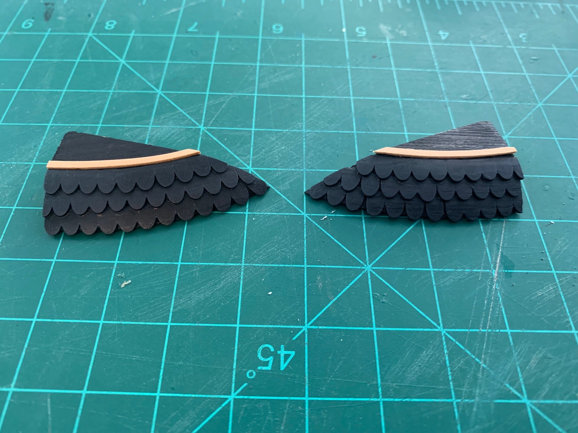

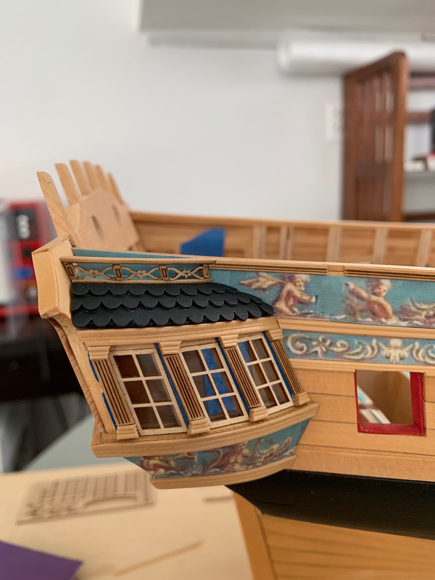

I spent the better part of the last week constructing the roofs.  I still can’t get over how much easier it is to work with boxwood than any of the usual kit woods I've worked with in the past.  It's sanding, cutting and durability make It feel like working with a high quality resin rather than wood, but without the brittleness of resin.  I can’t believe with the amount of sanding and handling needing for the roof tiles that not a single one chipped or broke.
I thought I had a great idea where I would use my calipers to scribe the lines for where the tile ends would rest.  Worked great for the first row, but things went off the rails for the second row.  That line below did not stand.  I found starting from the fore end created a much cleaner run.  One thing I noticed after the fact was the instructions had 11 tiles for the first run and I used 12, which made for a tight squeeze for me by the 3rd row, but I managed.
I bought a pen sander thinking it would be useful for fairing the inside of the frames and it was pretty worthless on the heavy plywood I used.  It has been one of those tool purchase regrets that has had very little use until now. I feel like it was designed for just the purpose of sanding the roof tiles.  It only took a few minutes to consistently thin out a row of tiles.
One thing I didn’t discover until I was almost done is it was a lot easier to sand the tops of the tiles flush and then worry about thinning the tile overall rather than trying to thin them first and then sand the top flush.
I painted them black, then dry brushed with a couple shades of lighter grey.  I found after I applied WOP, I needed to hit the roofs with a coat of Dullcote as there was a lot of shine coming from the shadows between the tiles, which made them look odd.  I added the trim and sanded them down a fair bit.  My run on the right one was a tiny bit off which is why there is a small gap on on the far right side; I may add some filler and paint, but I didn't want to force the trim to conform to the run as I'm sure that would make installing the fiddly rail more difficult.

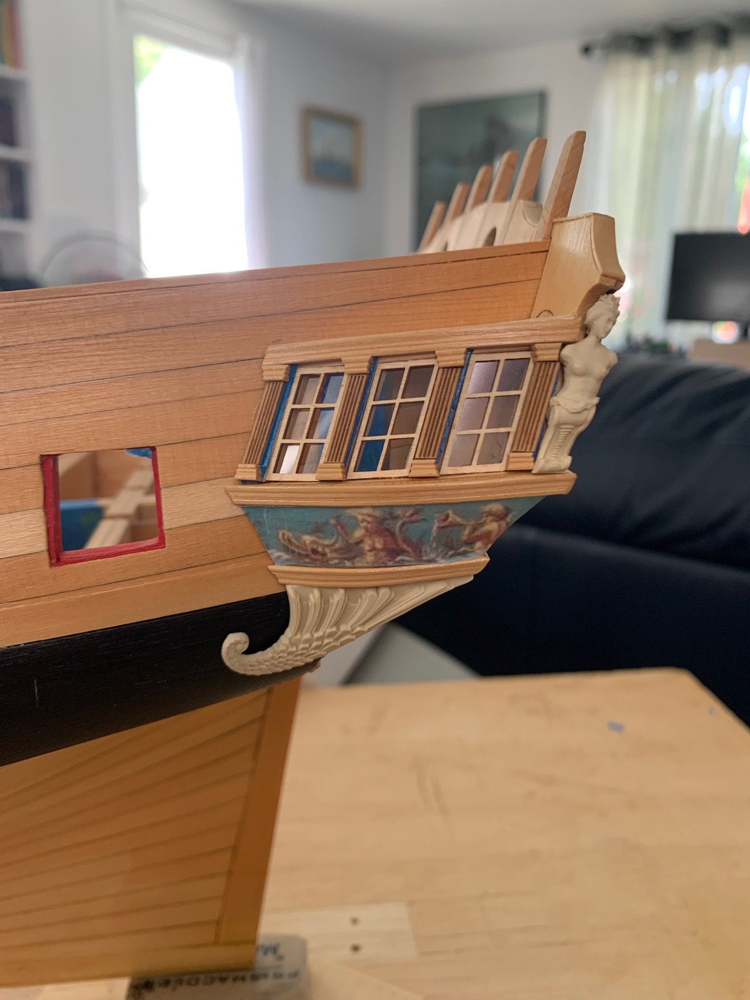

Test fit - starboard
Test fit - port

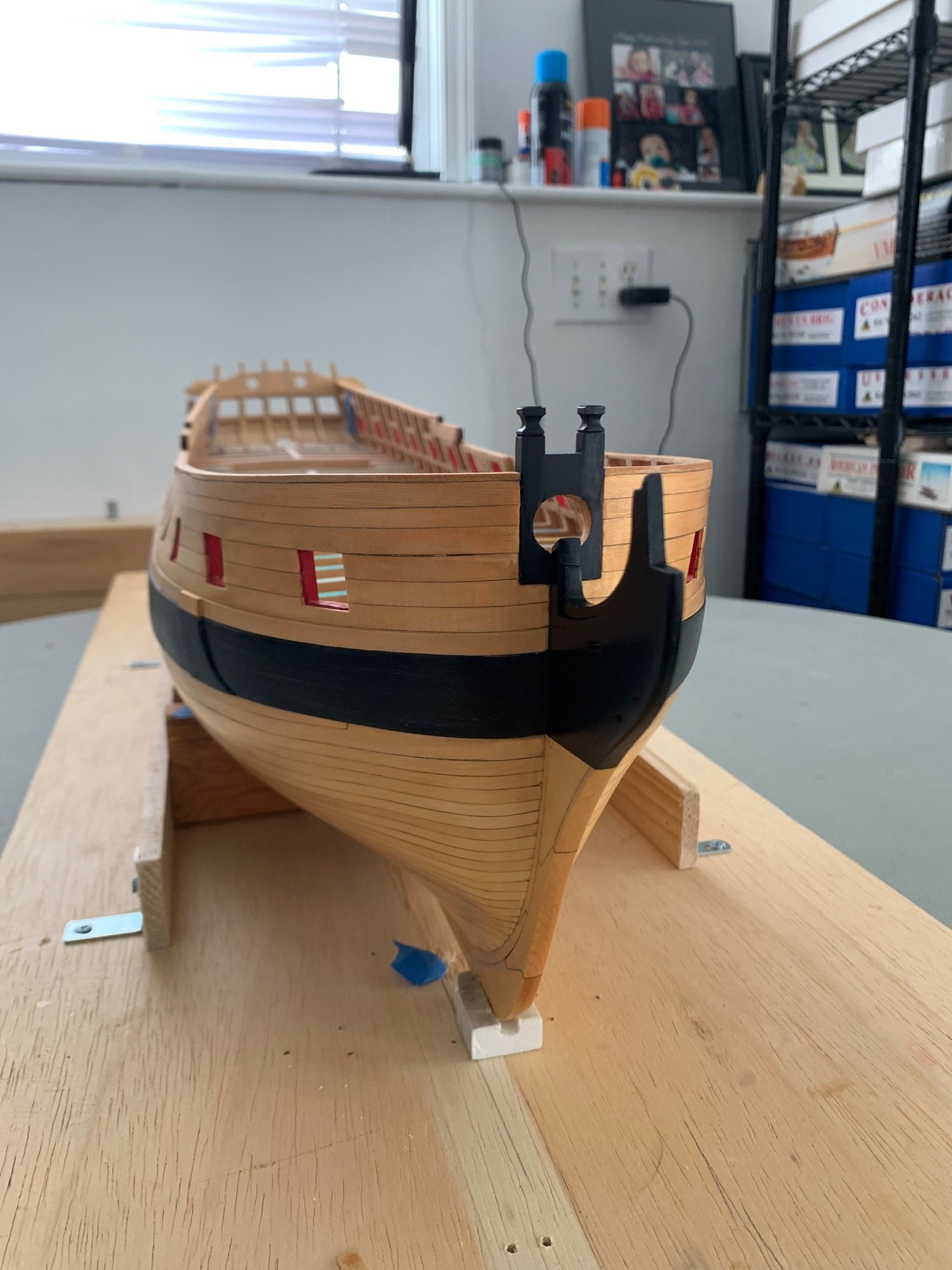

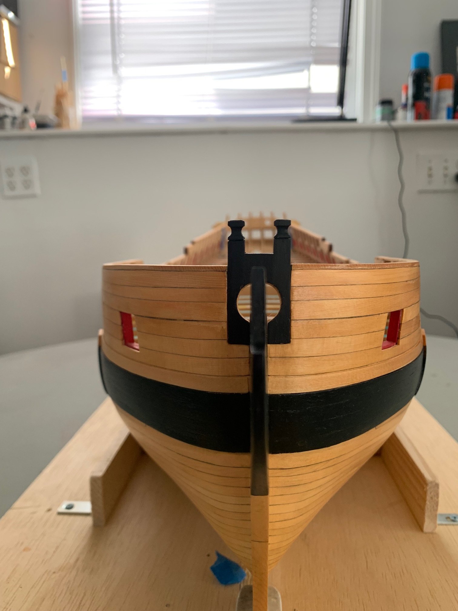

Looking way ahead at the finished model, I figure now is a good time to paint the stem and bollard timbers black (plus install them finally) and assemble the channels; debating whether to paint those as well as I rather like the contrasting black/natural look.

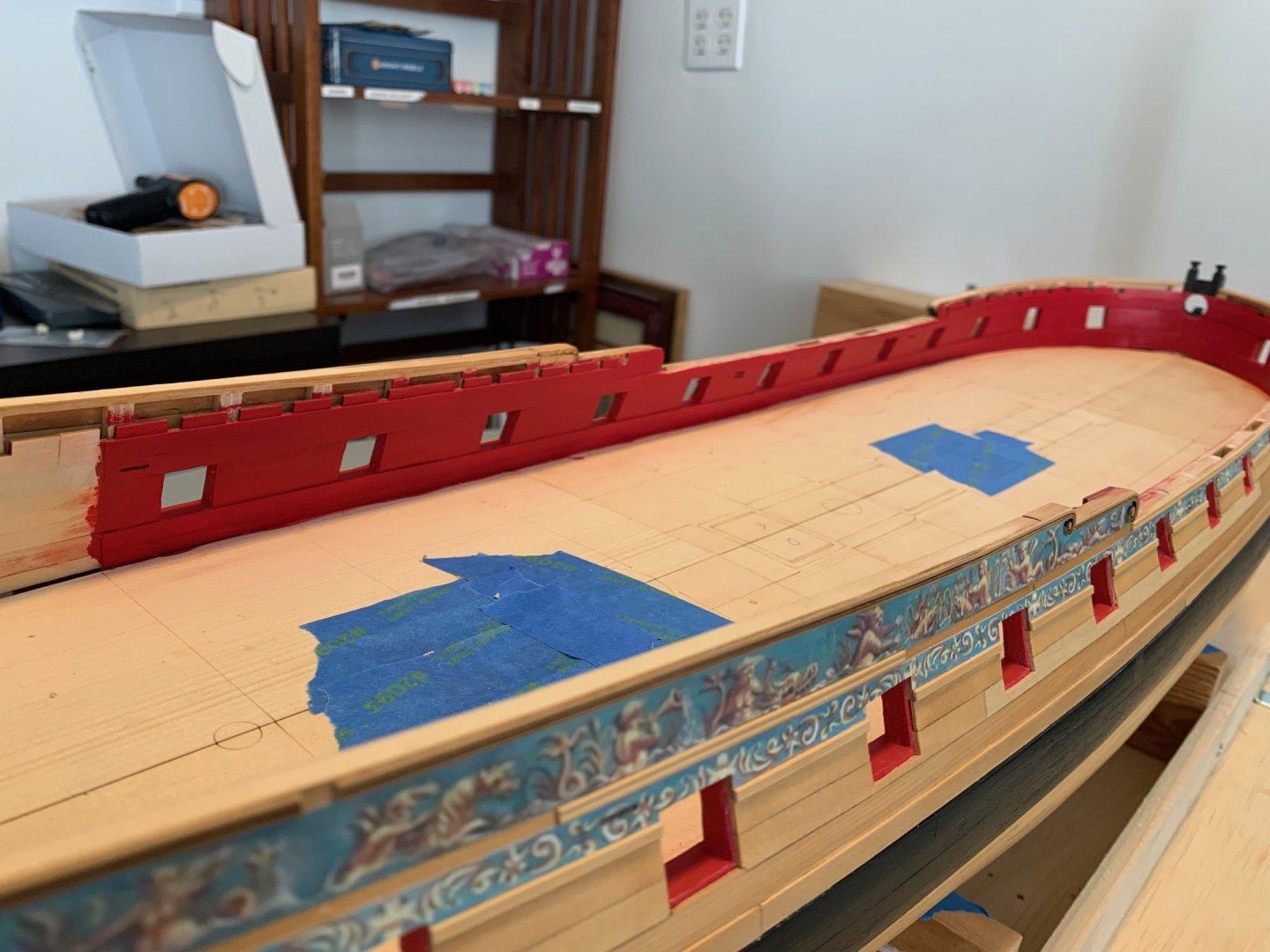

Thank you all for the continued likes and motivation.  I managed to work through my list above a few days earlier than I expected and there were no big surprises or gotchas.
When I brought my Winnie outside on Sunday to fair the decks with the mouse sander, the natural light showed just how bad the finish looked above the wales.  I think in hindsight I only sanded to 220 and applied a single coat of WOP expecting to clean it up before chapter 3.  I realized I had to completely strip the finish and start fresh.  I also had the problem with the Elmer’s school glue that had turned white. The picture is a good example of what I had to deal with.  I used 320 grit sandpaper to remove the finish, giving special attention to glue stains, rough patches and scratches.  I followed this up with a lot of acetone on the seams, patience and scraping with a piece of cedar to remove the glue.
Then I applied 3 coats of WOP and the finish looks quite a bit nicer.  That's one item off the list.

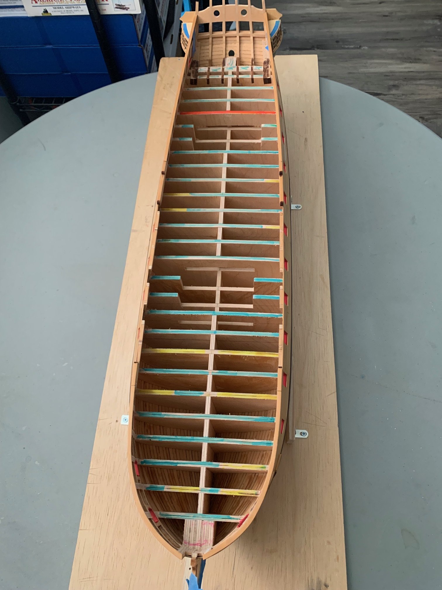

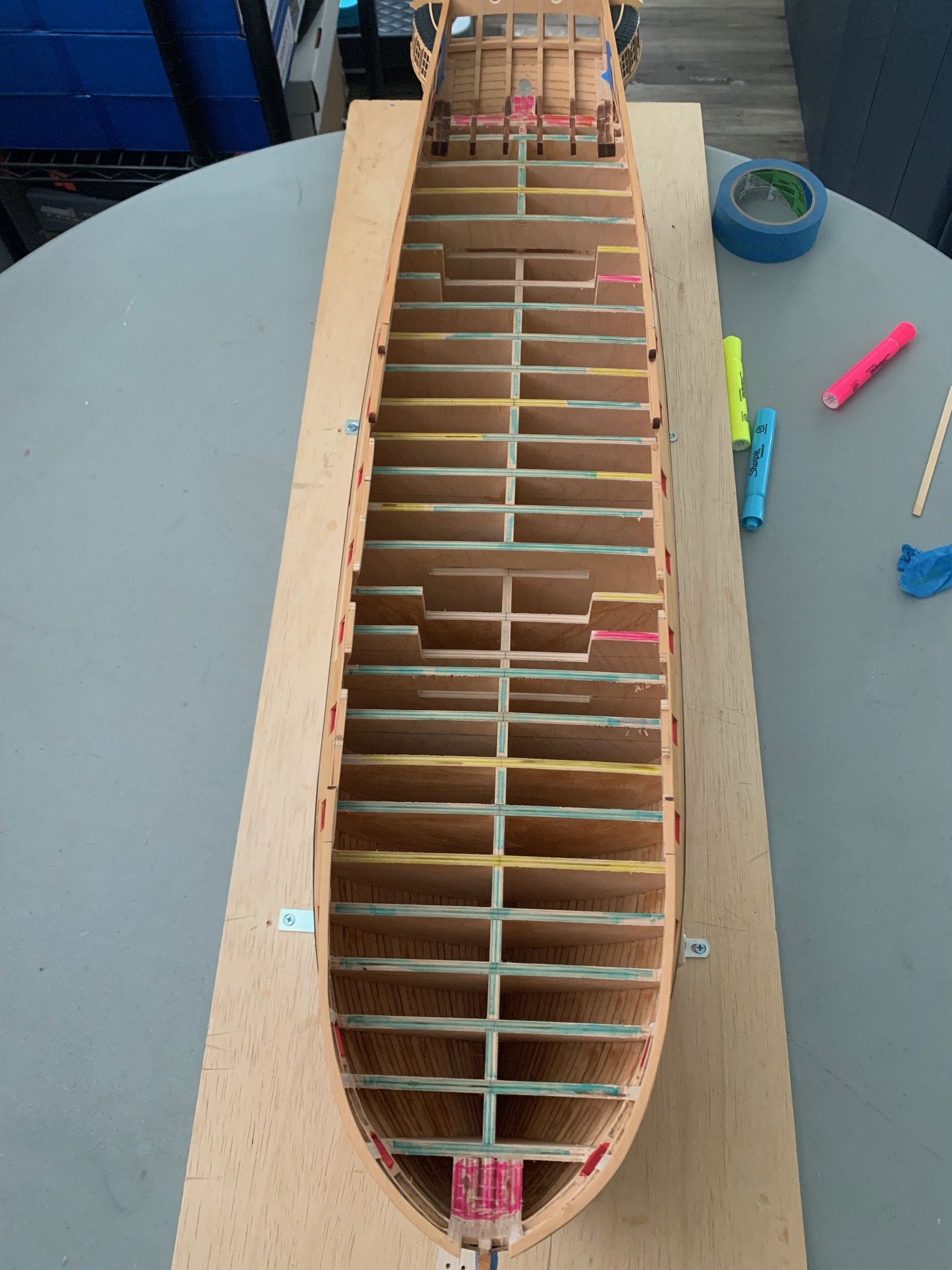

Moving on to fairing the decks.  I decided to color code the work I would need to do thinking it would make this process much easier.  Pink is high, yellow is low and blue is about right.  I figured the mouse sander would make short work of the job and I got hold of some 40 grit sanding pads which is where I made a bit of a mistake.  I really only needed 40 grit for the pink areas which are for the most part the bow and stern and pretty beefy pieces of plywood.  What I should have done is used 40 grit on the tip of the mouse and 120 for the rest of the sanding pad.  The 40 grit absolutely rips through the aircraft plywood including areas I didn't want to take much off.
The mouse faired the deck in about 5 minutes what would have taken me a full day or more by hand.  It did a wonderful job of smoothing out the stern and waist, but the bow was a bit of a struggle and the 40 grit chewed up some of the builkheads a bit.  The orange bulkhead is because it did such a great job at the stern and waist, that bulkhead is now a little bit high.
120 grit on just the tip of the mouse and no sandpaper on the rest smoothed out that frame in no time.  Some 1/32” basswood filler strips and a sanding block were all that was needed to smooth out the low areas.  I might need to fine tune a spot here or there and tested the false decks.  They'll require a little trimming, but there shouldn’t be any surprises come chapter 4.
Finally, I installed the bollard timbers.  Painting the stem and bollards took a while as all the time I had spent giving them a nice smooth finish also made them resistant to the acrylic paint.  I should have scratched the finish with some 400 grit first.  It also solidified my decision that I'm going to leave the channels natural color.

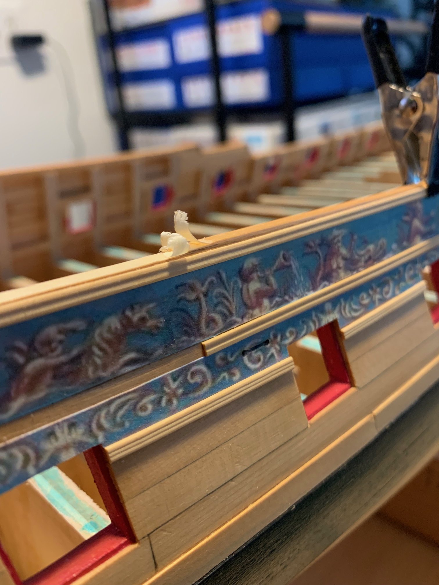

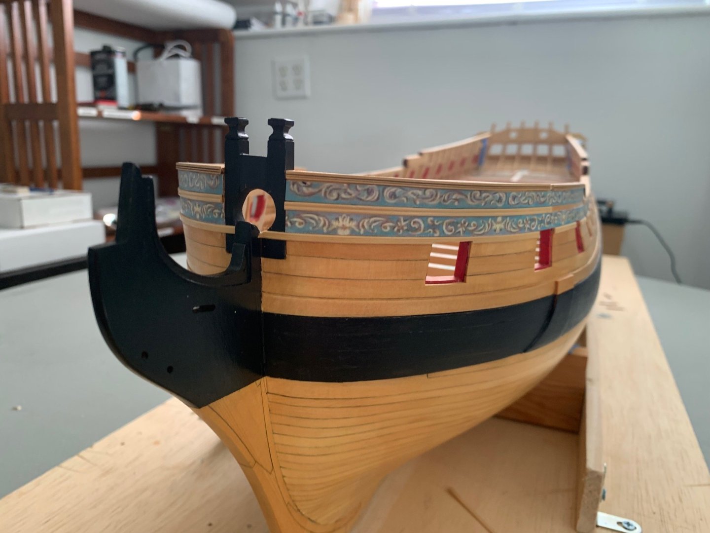

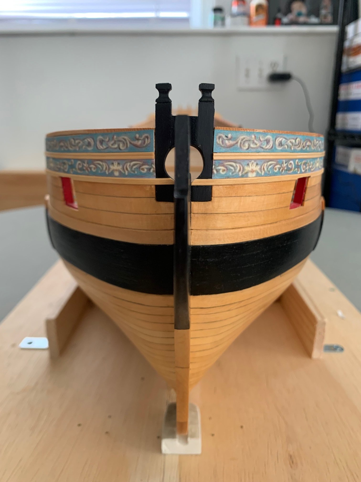

Thank You everyone for the likes.  The friezes and moldings are so expansive I thought I'd put out an update midway through.
started with a Chapter 11 detour and spent a fair bit of time cleaning and assembling the channels.  The end result is amazing, but there were a few nervous moments cleaning up the veneers as they seem so fragile.  Such a cool way of assembling them.  Rather than attaching them directly to the hull, I cut and shaped some 3/32” cedar strips Io match the profile.
All the channel placeholders are installed and getting ready to shape and install the center molding.
Of course, I forgot to take a picture during/after installing the center molding.  Before starting on the friezes, I removed all the channel placeholders thinking it would make installing the friezes more forgiving and this turned out to be a good idea.   One little problem creeped up; way back when I was planking the hull, I had to add some filler pieces on both sides above the last 4 gunports before adding the cap.  I didn’t think much of it at the time as there was symmetry, but I should have cut the frames down instead of adding filler bits.  Shouldn’t be too bad as it’s about 1/32” at it worst (right above the sheave) and it’s only between those 4 gunports.  I’ll take care of this after the lower moldings are complete.
I’m patting myself a bit on the back on this one; there’s no glue or tack or anything holding the channel in place, just a tight joint between the molding and channel.  Not all of the channels will stay in place on their own, but they all fit nicely.  I still can’t get over that one off color plank is cedar.    Definitely lends character to the hull and I can claim it’s an at sea repair.
The friezes are installed and I’ve cut out the gunports and the sheaves.  These were much more straightforward than I expected and I’ll have better close ups once the moldings are complete.
WOP is an excellent PVA repellant.  I had to scuff up the hull to get the moldings to adhere well and I also discovered that the bollards wouldn’t take paint or glue well as I had finished after constructing them.  I had to pull them, sand them down to bare wood and repaint so the molding would glue up and the paint wouldn’t flake.  So far, I installed the lower molding at the bow and it’s about 1/16” too high so I had to trim them a little bit for the bowsprit, but it still looks nice and this will be covered later.
I think just a few more days to finish up the bottom molding, clean up the hull and install the top molding.

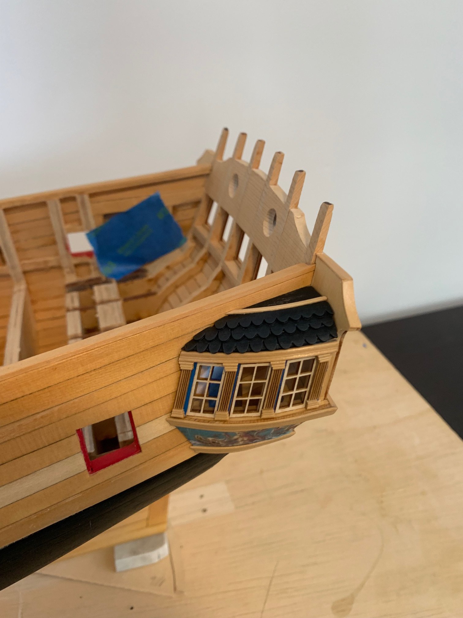

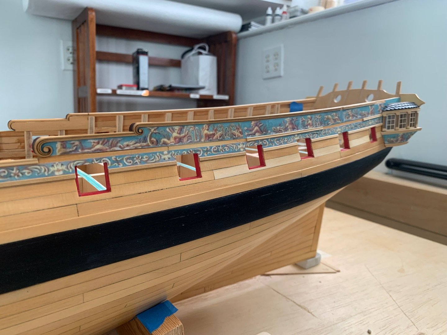

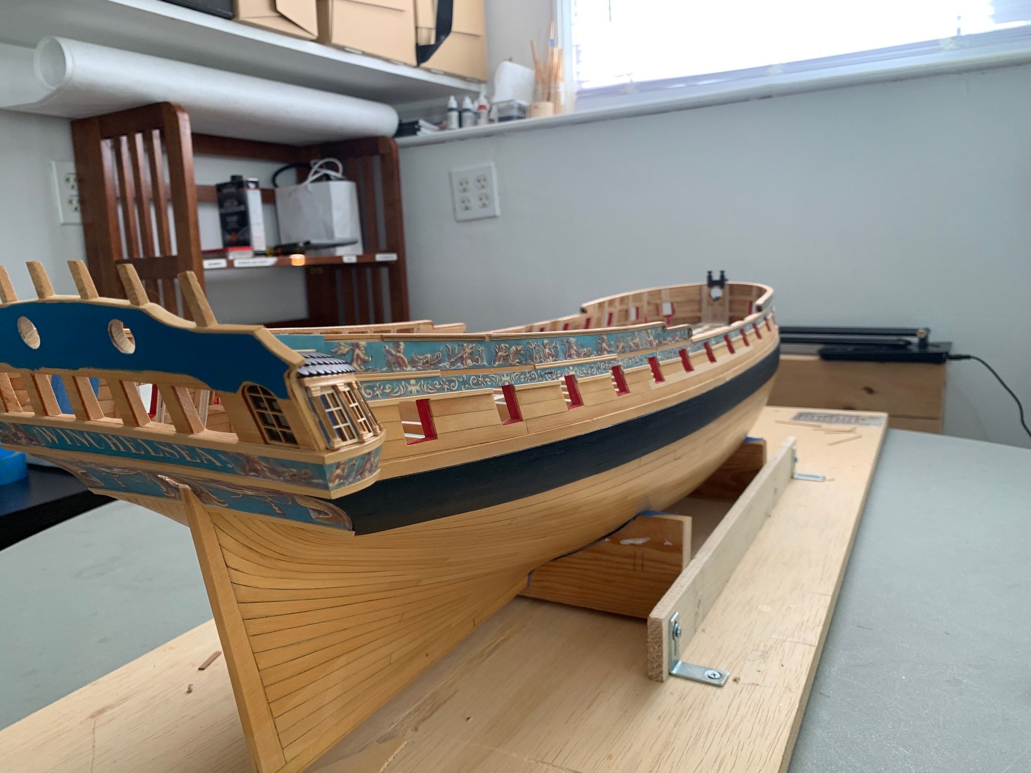

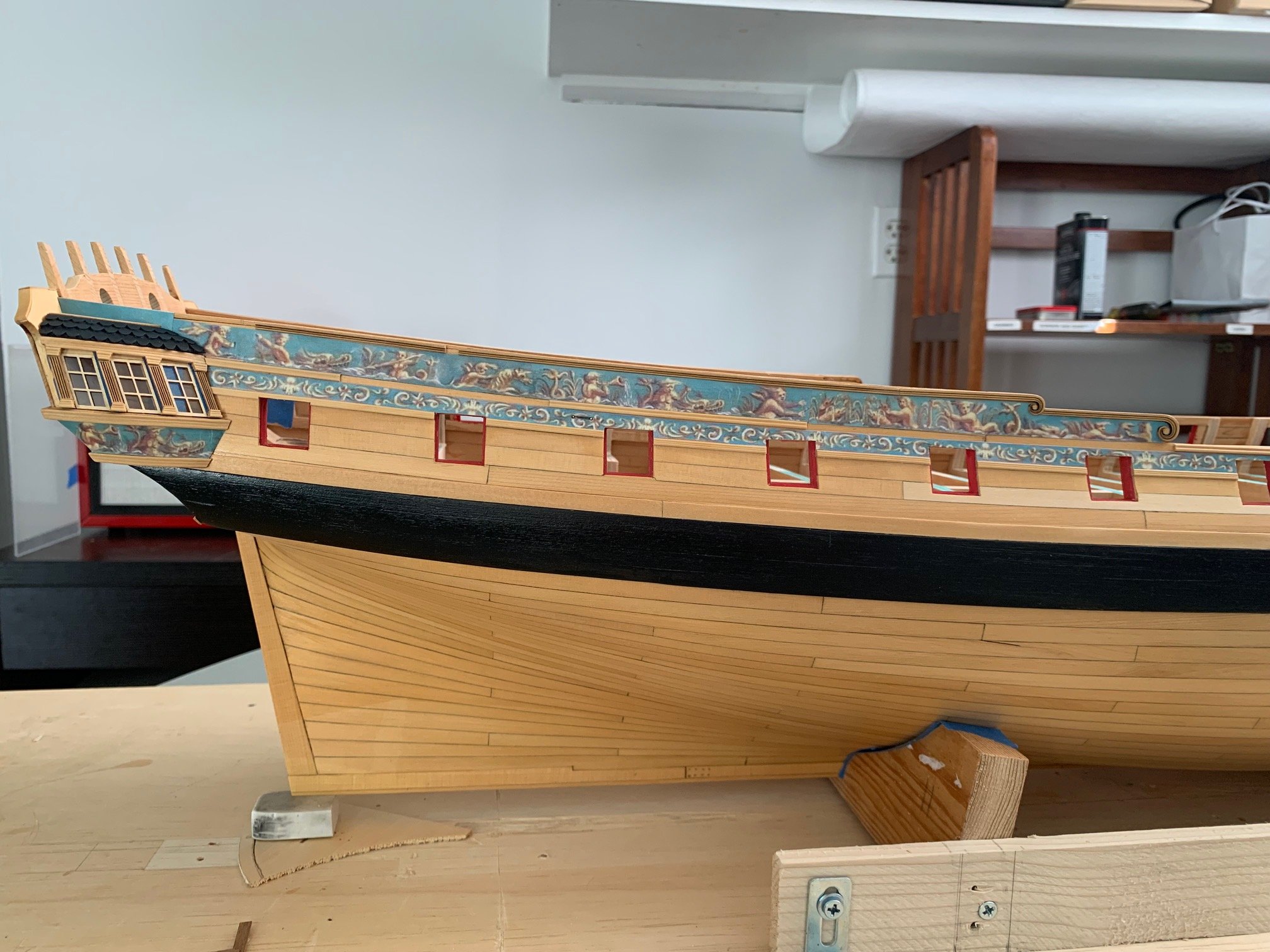

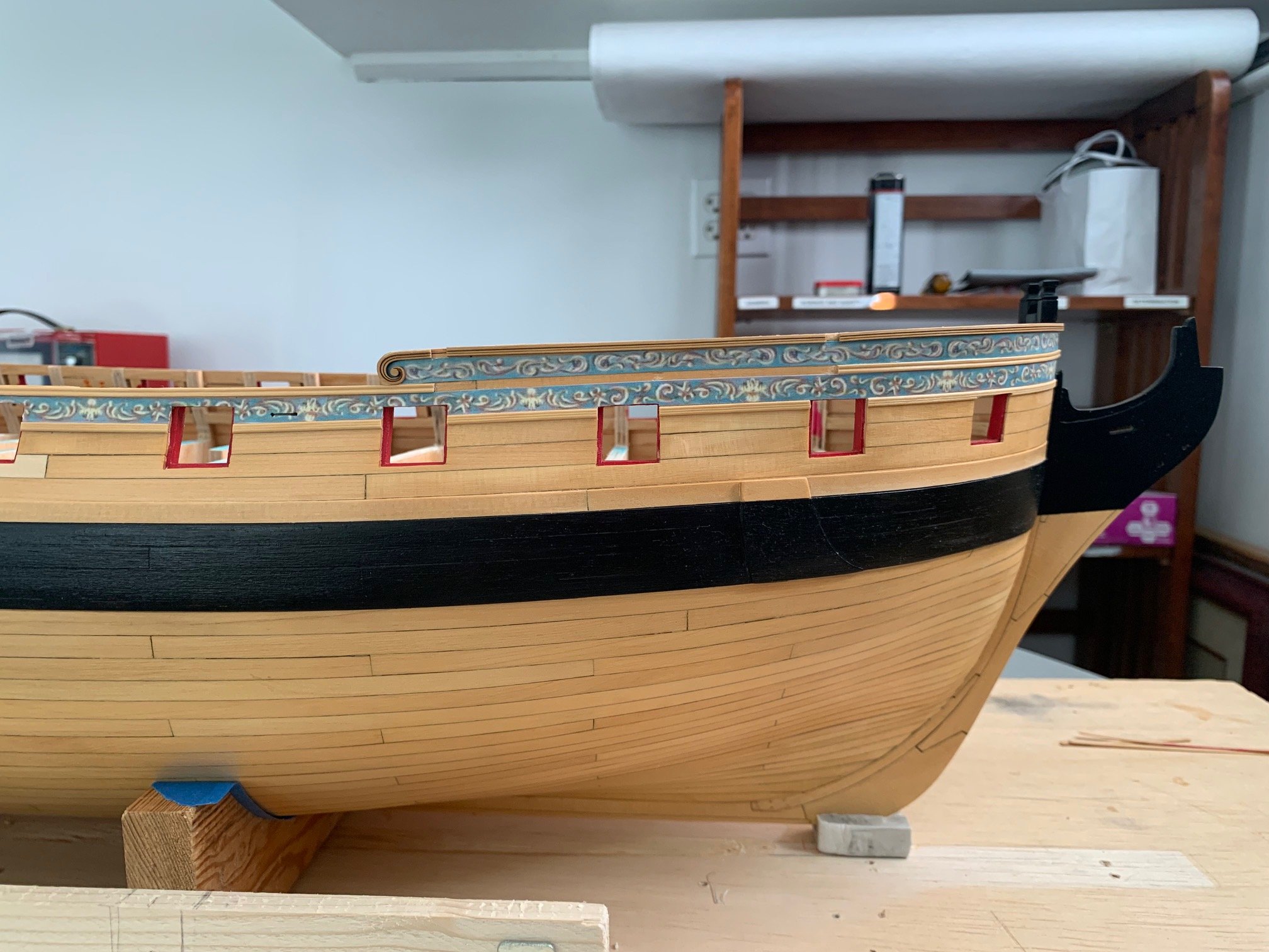

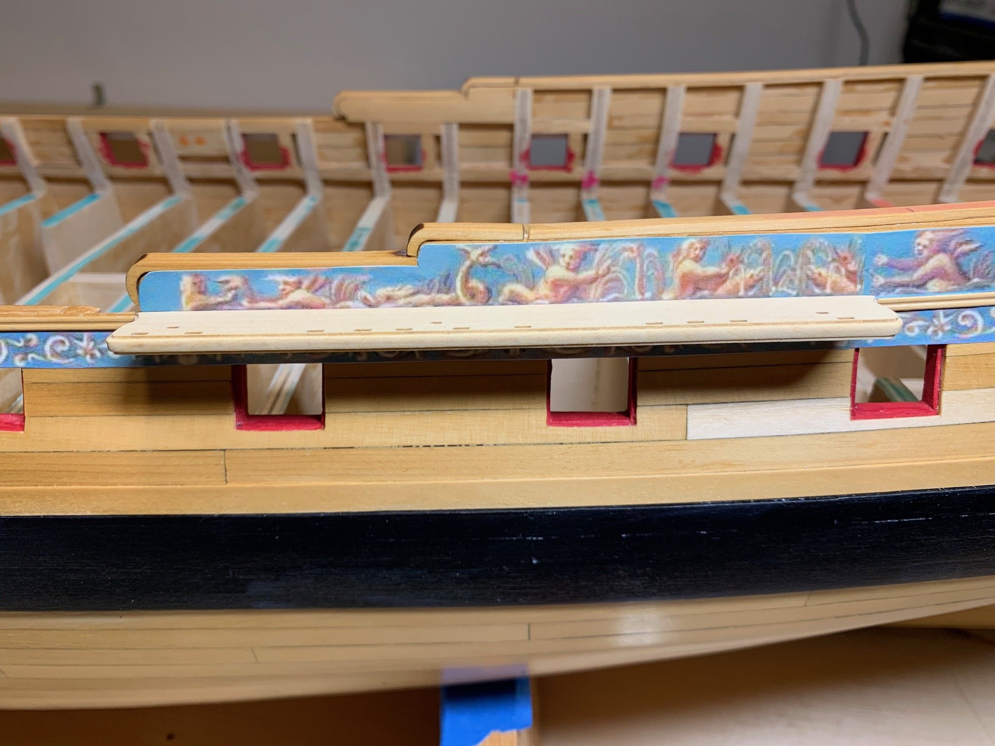

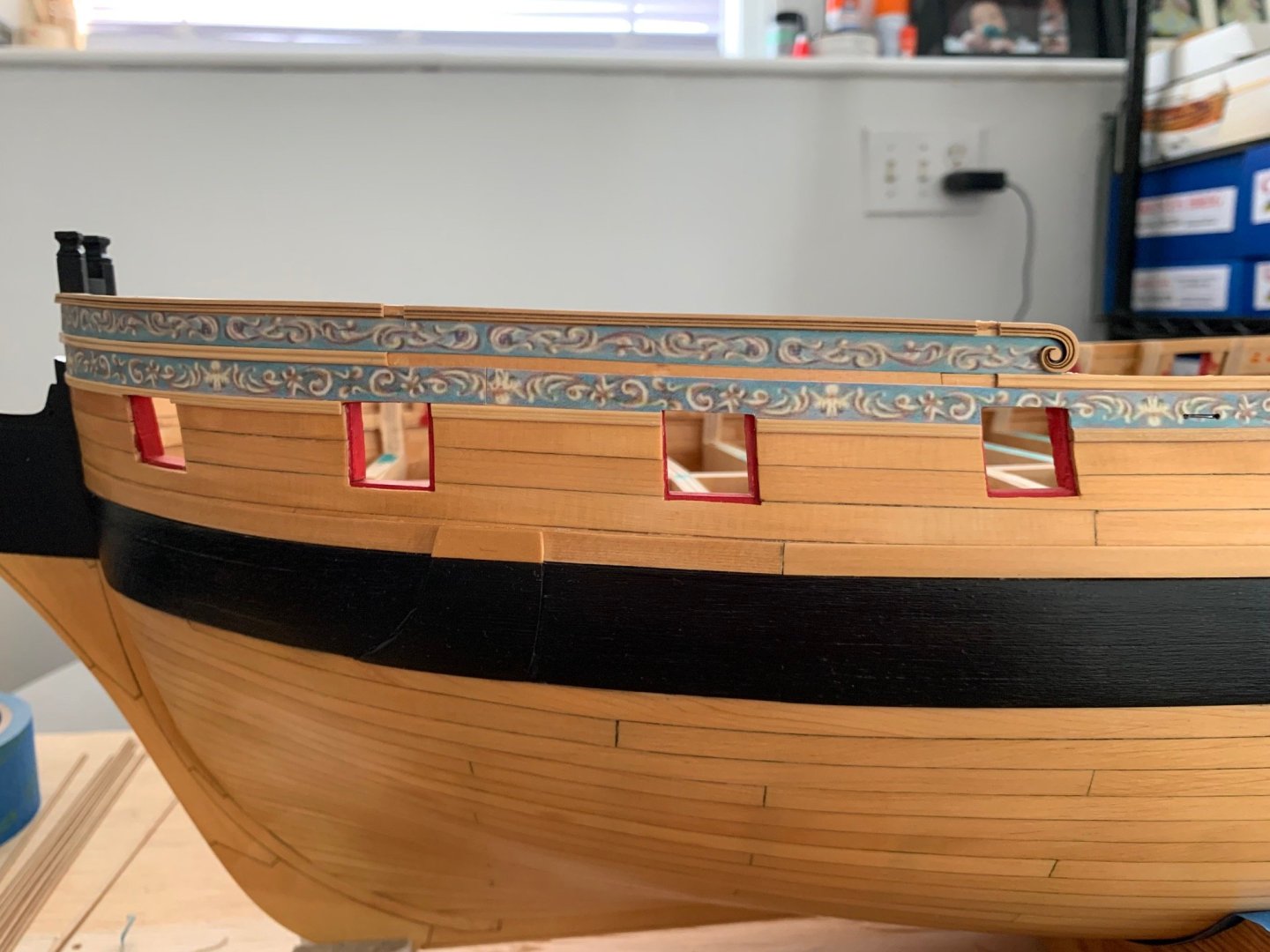

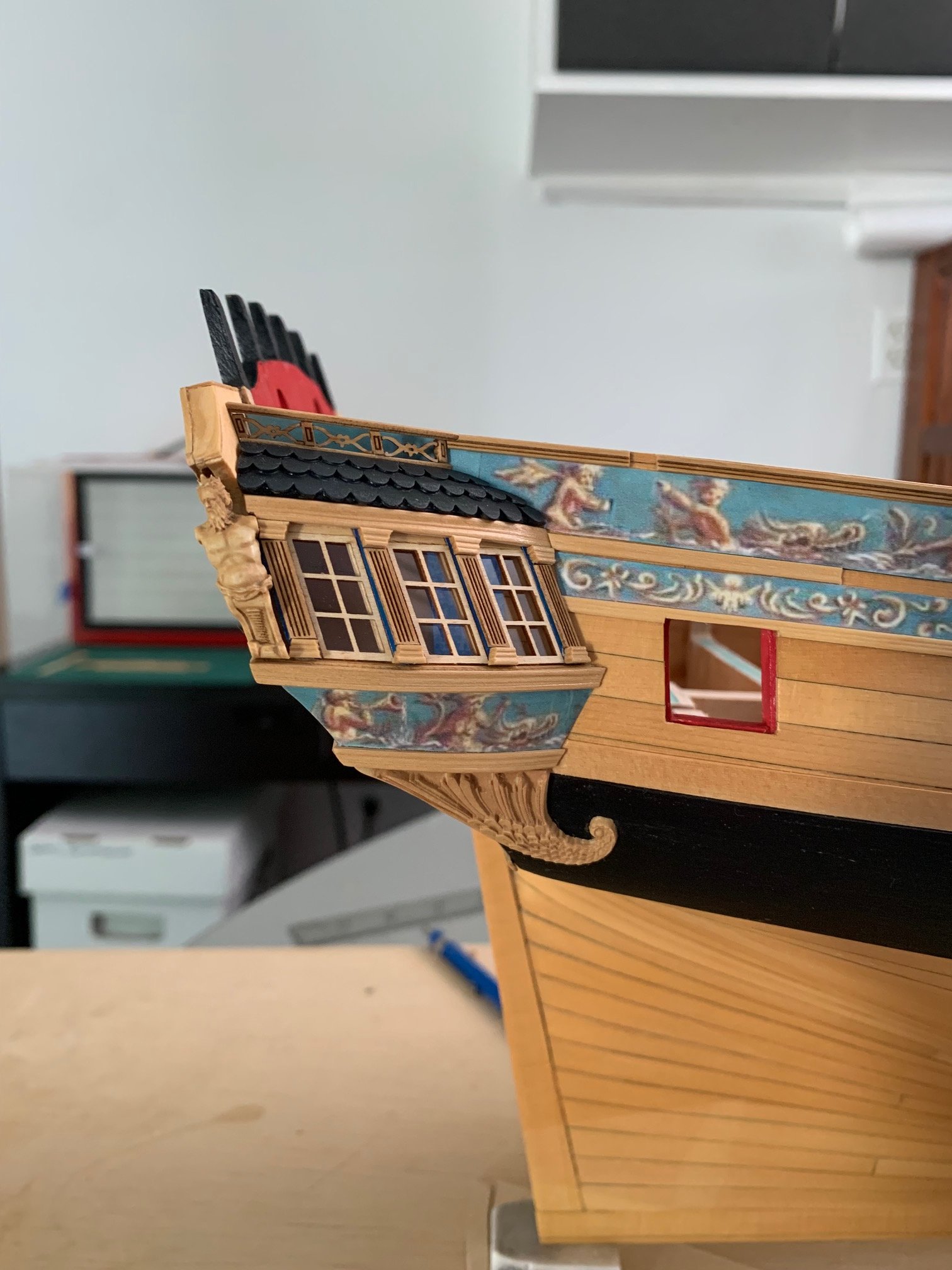

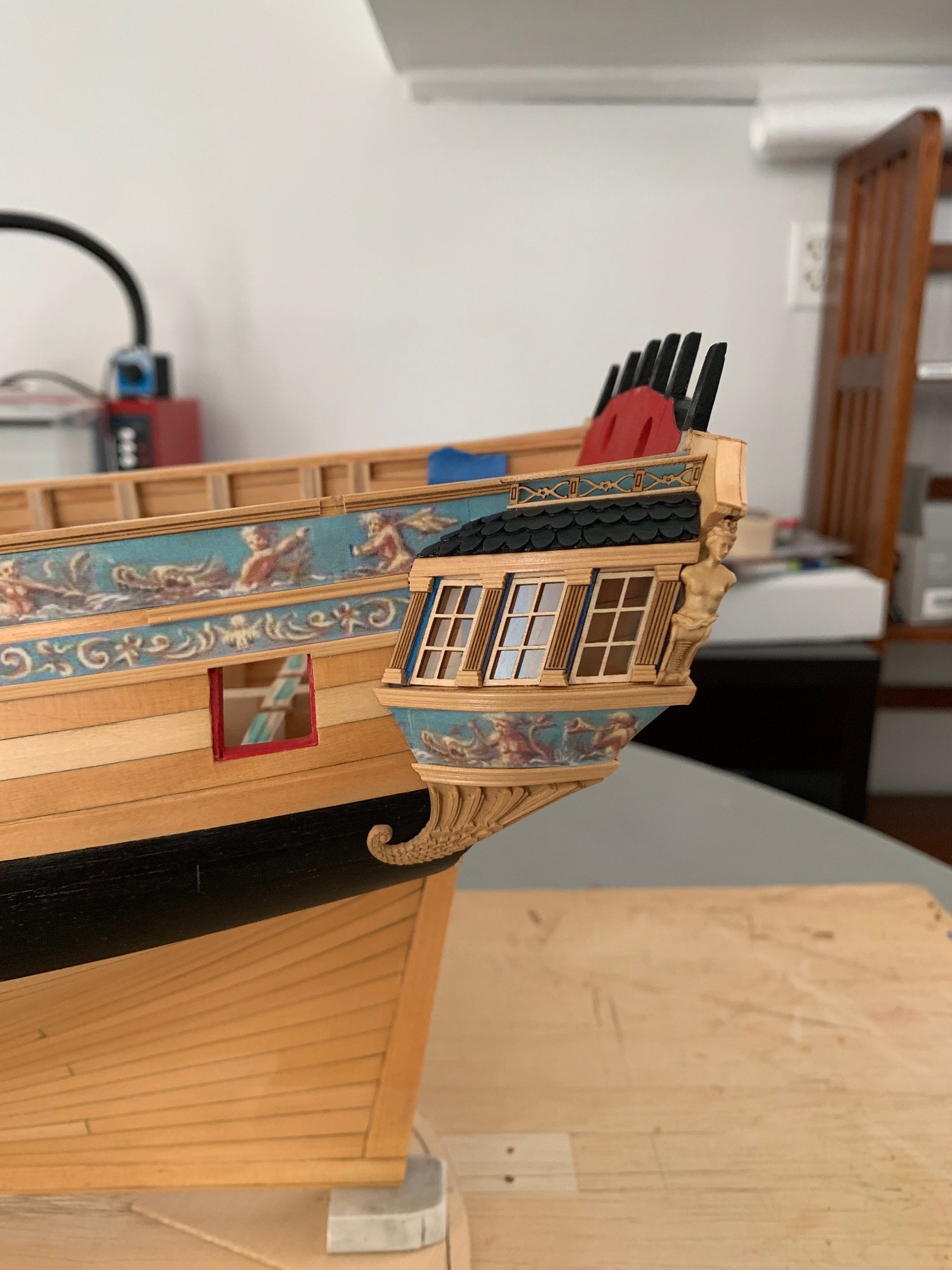

This is going to be a long update, but I’m happy to say the friezes and molding are complete and I’m about ready to move back to the transom.  The end of Chapter 3 is in sight.

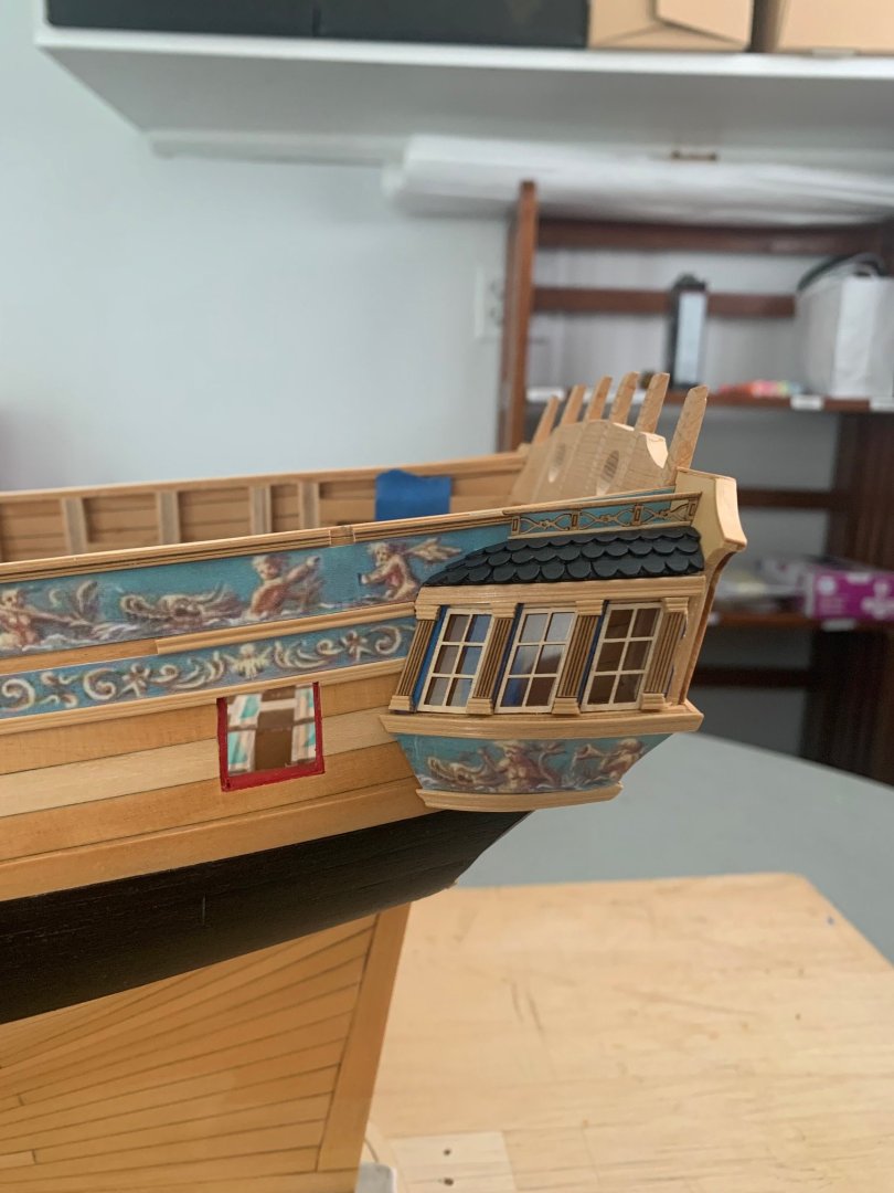

I took a bit of time to clean up the inconsistency with the shear using a piece of scrap molding.  A fresh #2 blade sliced the extra off in just a few minutes and then a bit of 220 grit sandpaper smoothed it out.  Then I was able to get back to the business of installing the upper molding
I thought it was a good idea to install the upper molding with the swivel guns in mind as it would go a long way towards hiding transitions between the pieces.  I also decided I will install both of the bow swivel guns.  It was easy to tack some 5/32” strips keyed off the channels before installing the molding at the bow.
The ones toward the stern was a little trickier due to the angle and the locations, but I realized the mounts were at the same angle as the gunports and without a channel getting in the way, it was easy to clamp a strip of wood that would allow me to cut the molding at the right angle and length. Once, the molding was in place, I then replaced this strip with  a 5/32” piece and kept working my way aft.
The molding is almost complete.  Taking into account the swivel guns and channels mean there is only 1 seam on each side of the ship across all the different moldings.

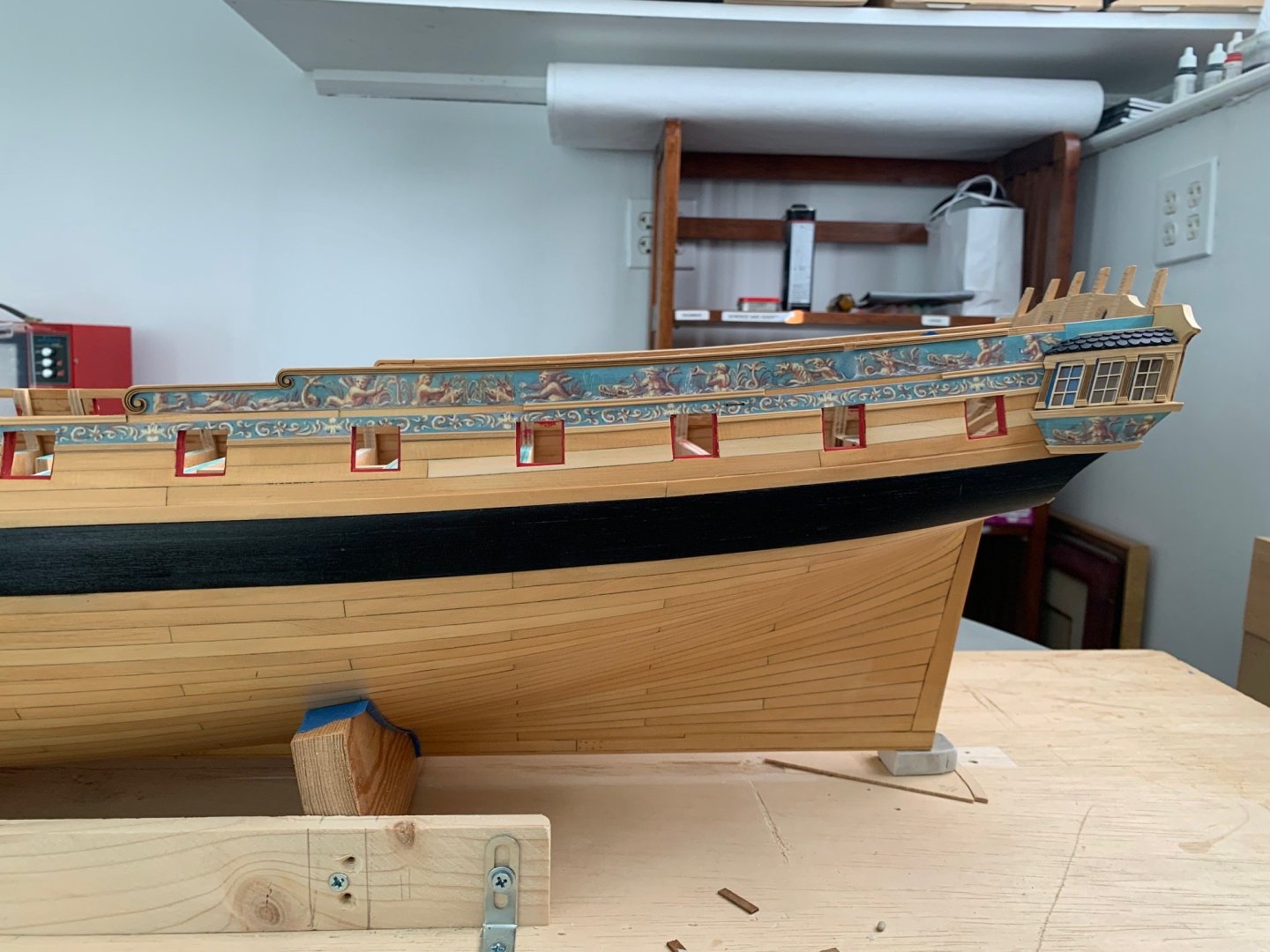

Series of shots starboard.
And the same series on the port side.

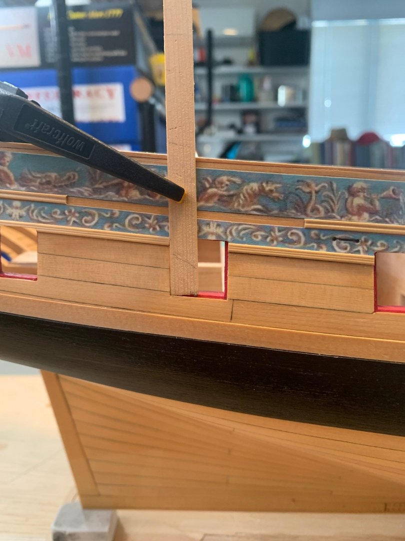

I changed my mind about waiting until further in the build to do the q-gallery rails as there was still a little piece of molding I couldn’t install until they were in place. and it just wasn’t sitting well with me to not be completely done with the molding.  Although it stretched my cross lock tweezer capabilities, putting the rails together was much easier than I thought it would be.
Port side.  I'm surprised at how strong they are.

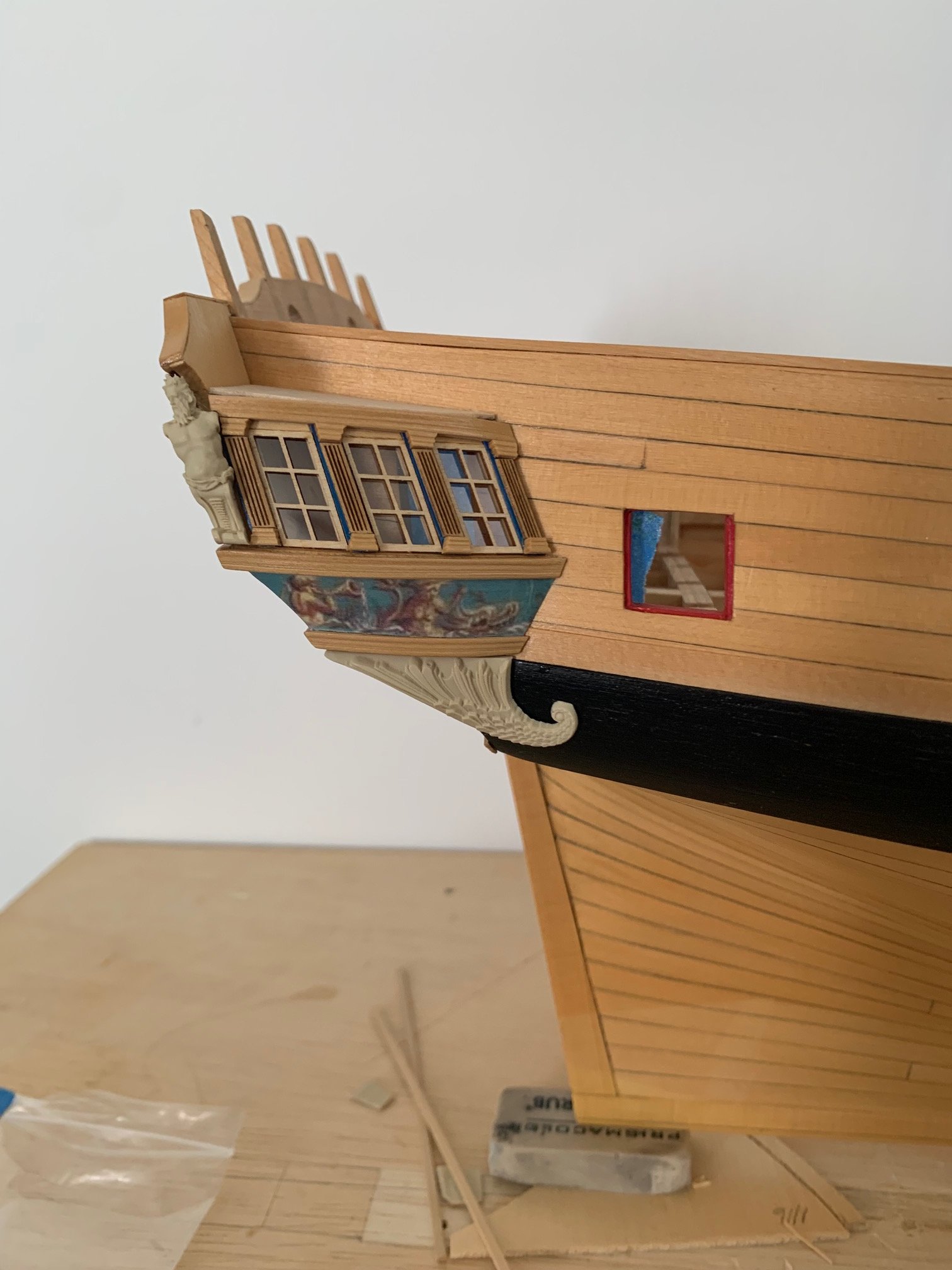

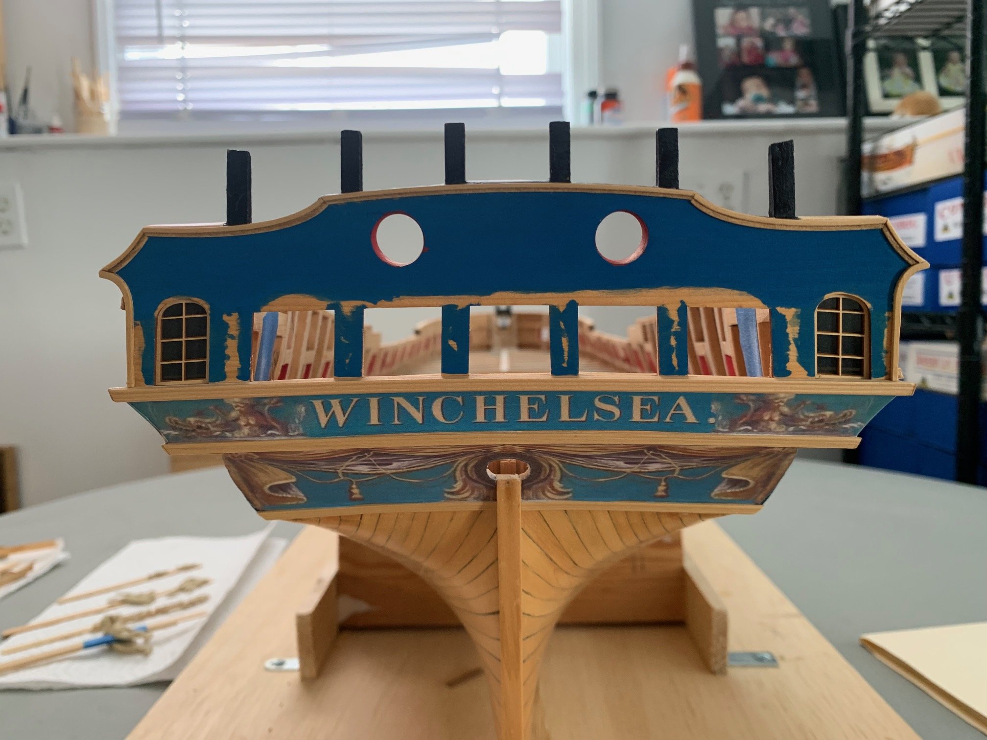

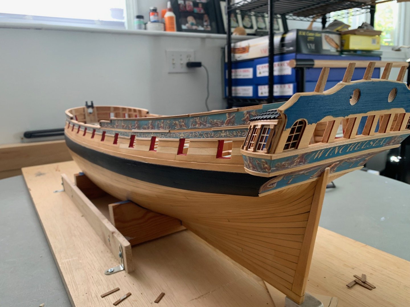

Chapter 3 is now officially in the books.  There were definitely a few moments when finishing up the transom that I thought I was about to ruin it or I had messed up real bad.  There are also some mistakes I wish I could take back and details I wish I had done a better job on, but it still feels like a bit of an accomplishment getting through the chapter.

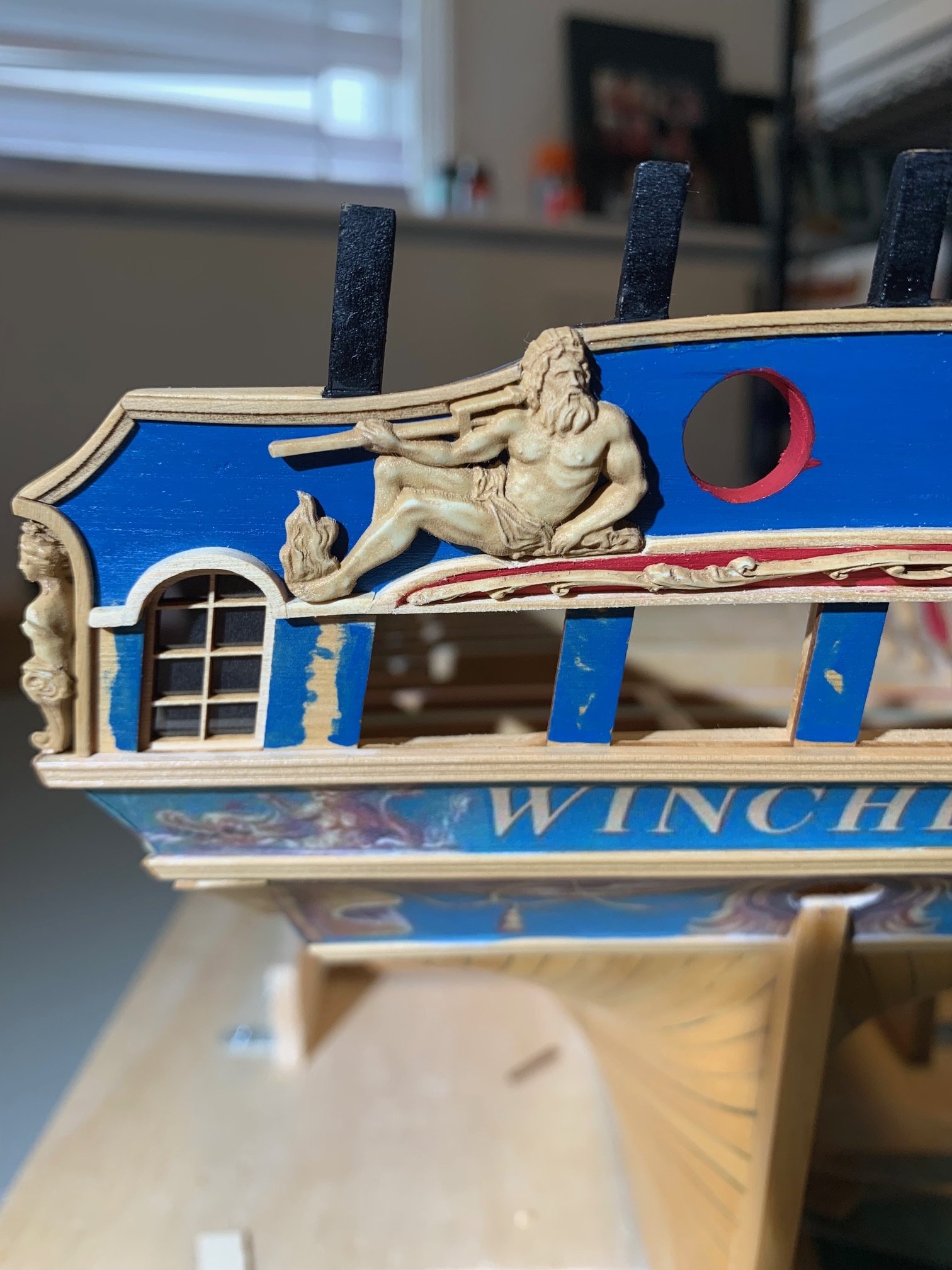

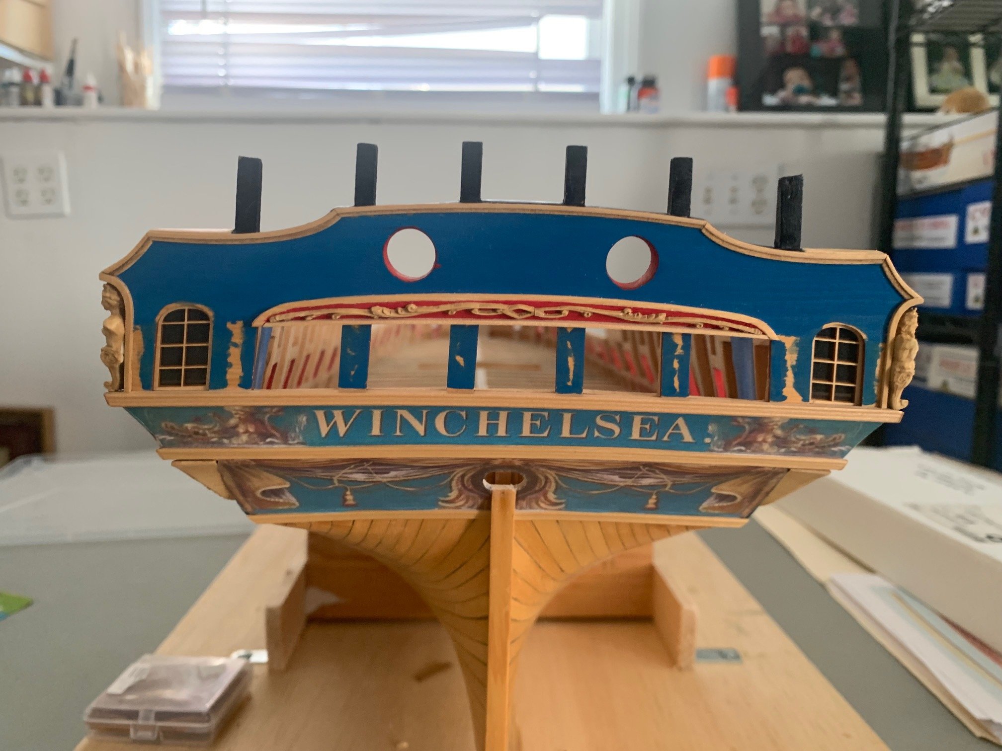

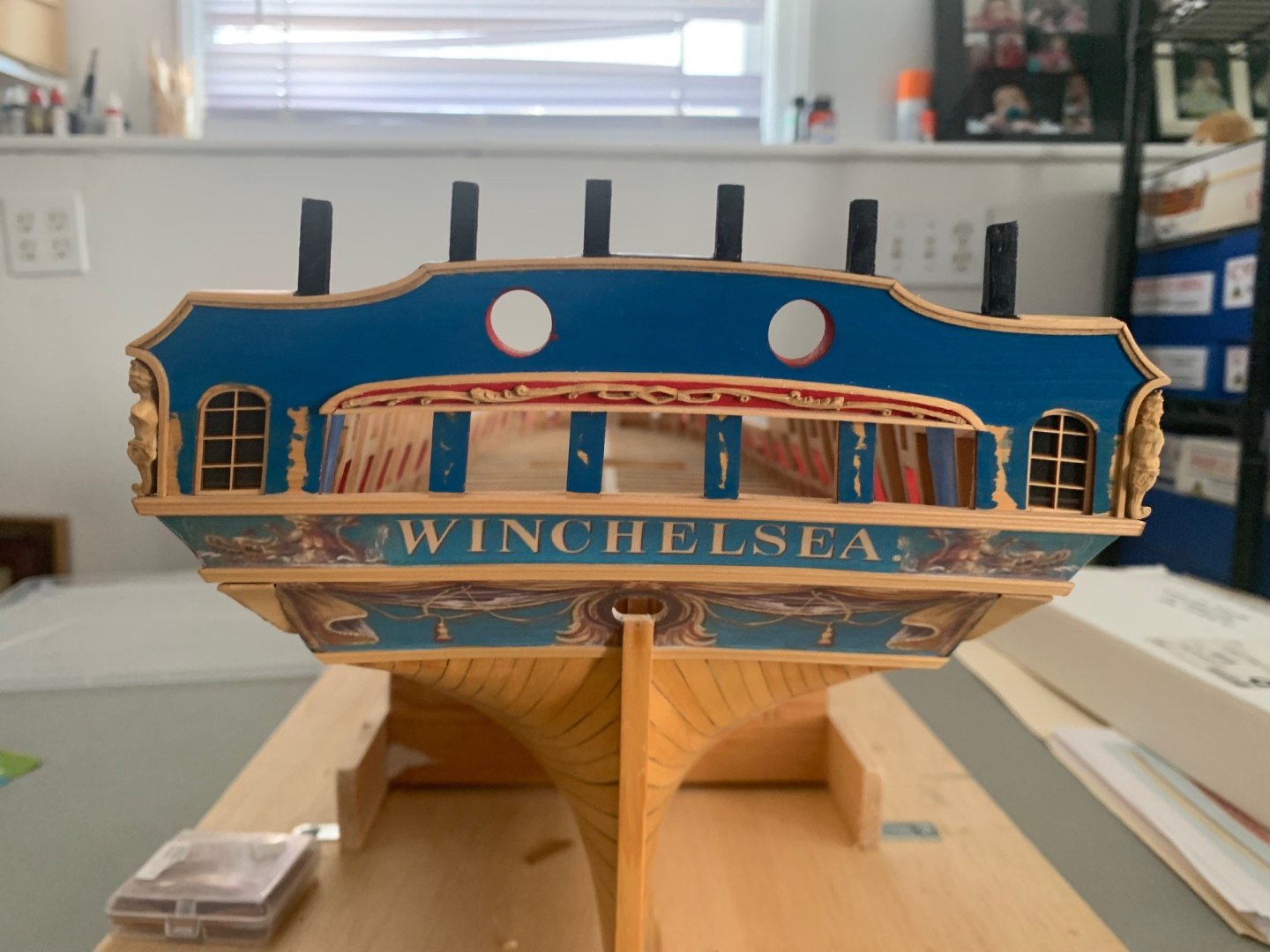

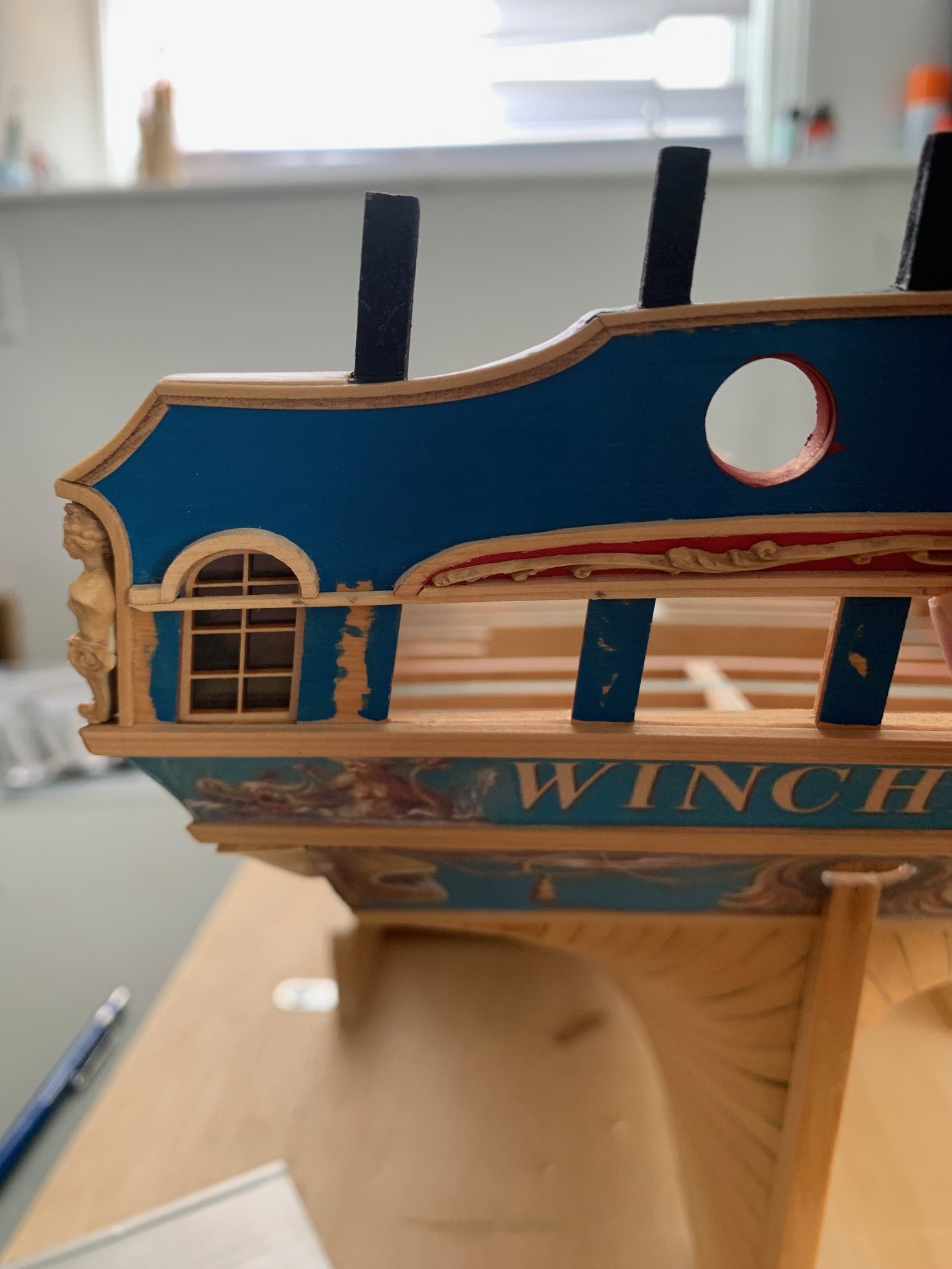

Without further ado; I painted up the transom with a mix of 1 part Vallejo Flat Blue to 2 parts Vallejo Blue Green.  I also took the time when I painted the gunports red to paint the the inside of the transom that gets done in Chapter 7.  The molding installed without too much difficulty.  Cleaning it up was pretty time consuming, but so much easier than trying to scrape and bend it myself.
I’m also pretty impressed with how well gel stain works on the resin.  I was pretty skeptical, but the overall results are pretty amazing.  I’ve painted up a fair number of resin miniatures and have had my share of paint adherence issues even when primed.  Not needing to prime or paint and seal is pretty awesome.  The only downside is you can’t use green stuff or any filler to fix mistake.  Green stuff would have been helpful with the scrollwork in the cove due to the seam, but that’s the only piece that would have benefitted from traditional paint and primer.  I also used this opportunity to drill a 1/16” hole for the lantern in the casting between the gunports.  At least I won’t have to worry about marring the carving in the final step of the build.

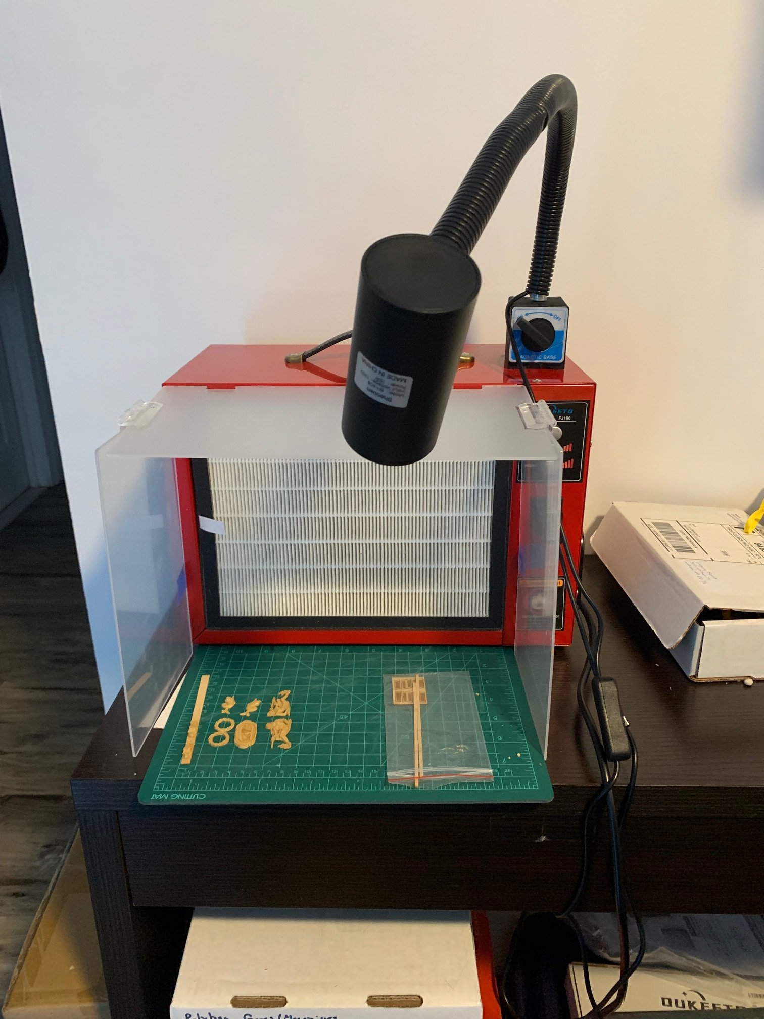

Between the resin dust, stain fumes and fine sanding, I picked up a portable ventilation system and the attached magnetic work lamp.  It’s working great with all the  sanding and char removal in this chapter; plus resin dust is no joke.  The work lamp really improved my spot lighting situation and helped find all the little strands of q-tip that got stuck in the carvings when I was removing the excess stain.

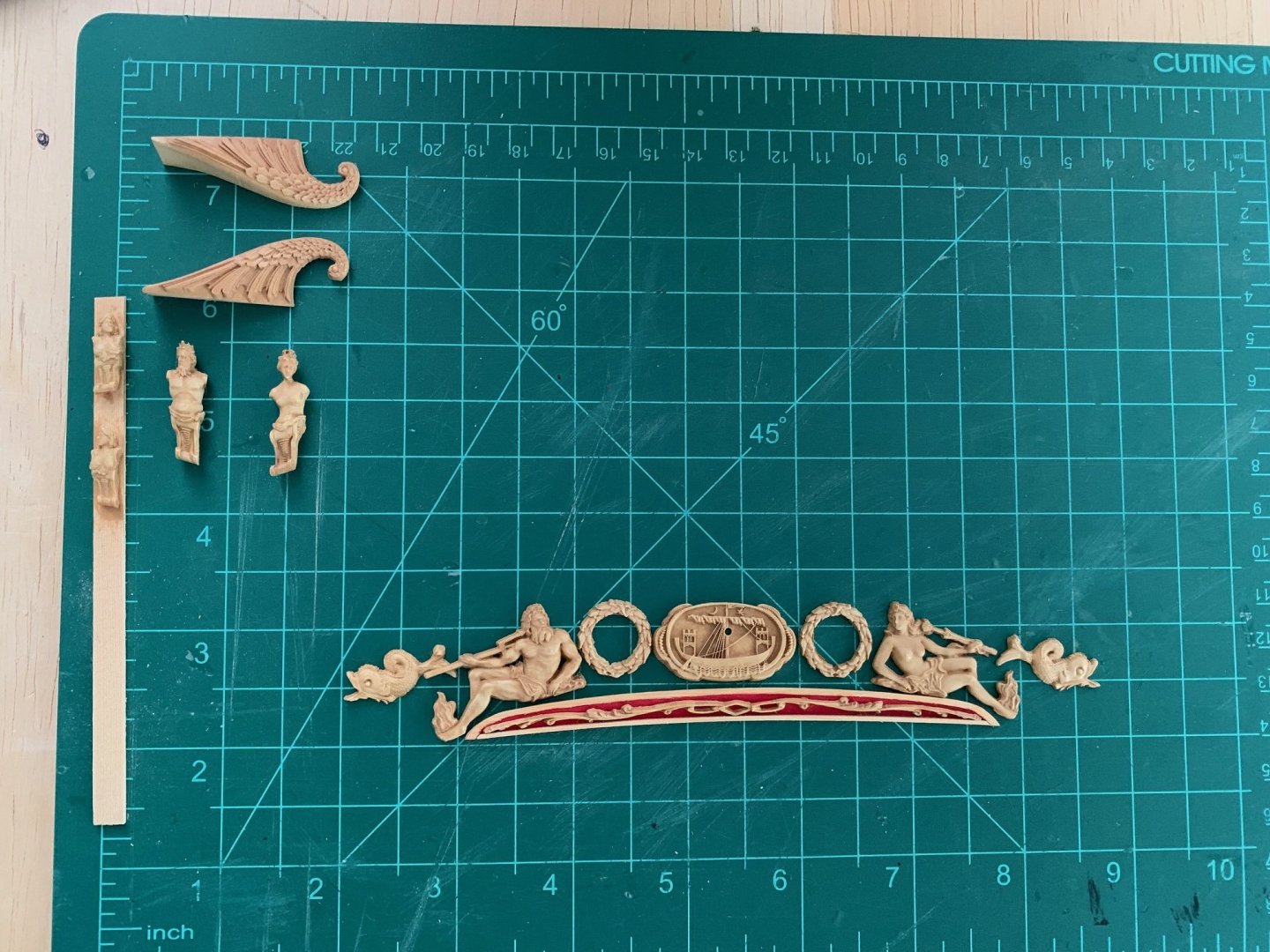

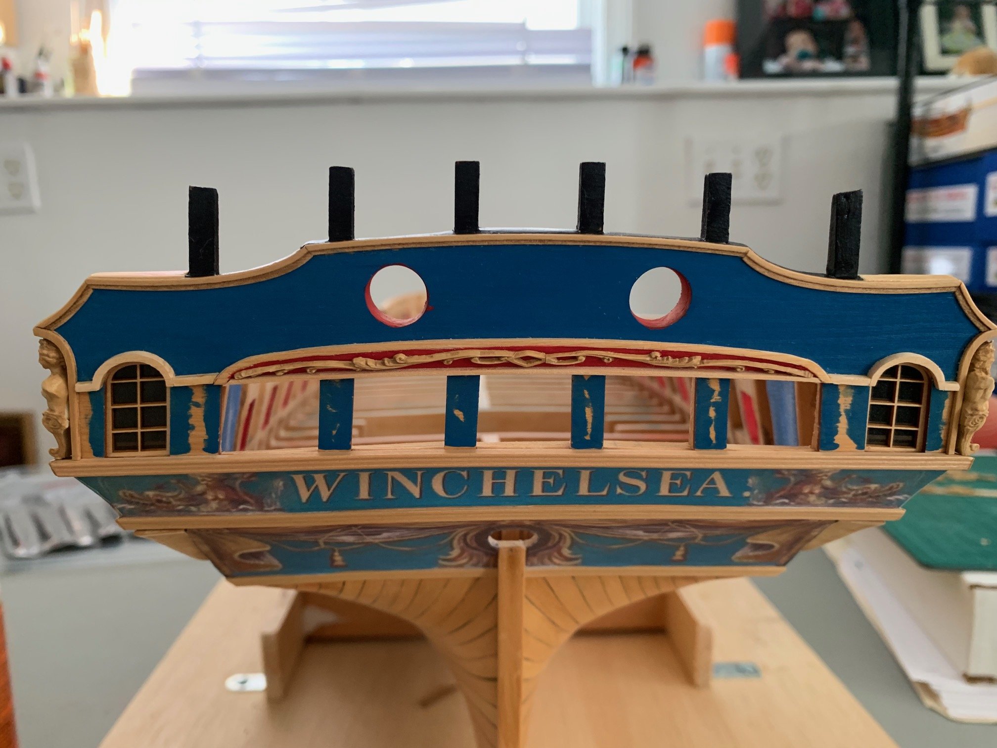

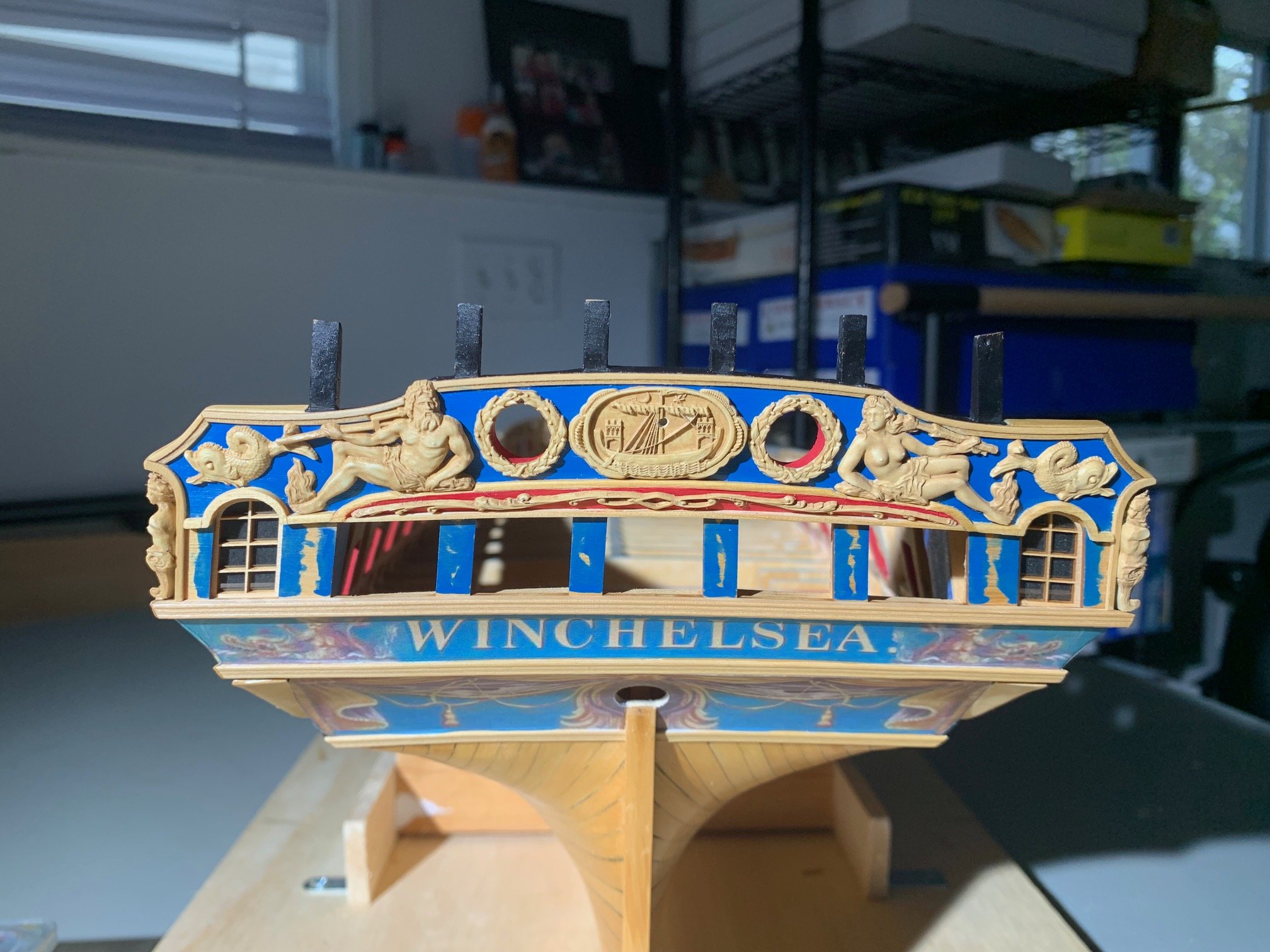

I started by installing the drop and qgallery figures.  I will need to do some cleanup on the edges of the transom above the figure on both sides, but there’s no rush for this.
Port side

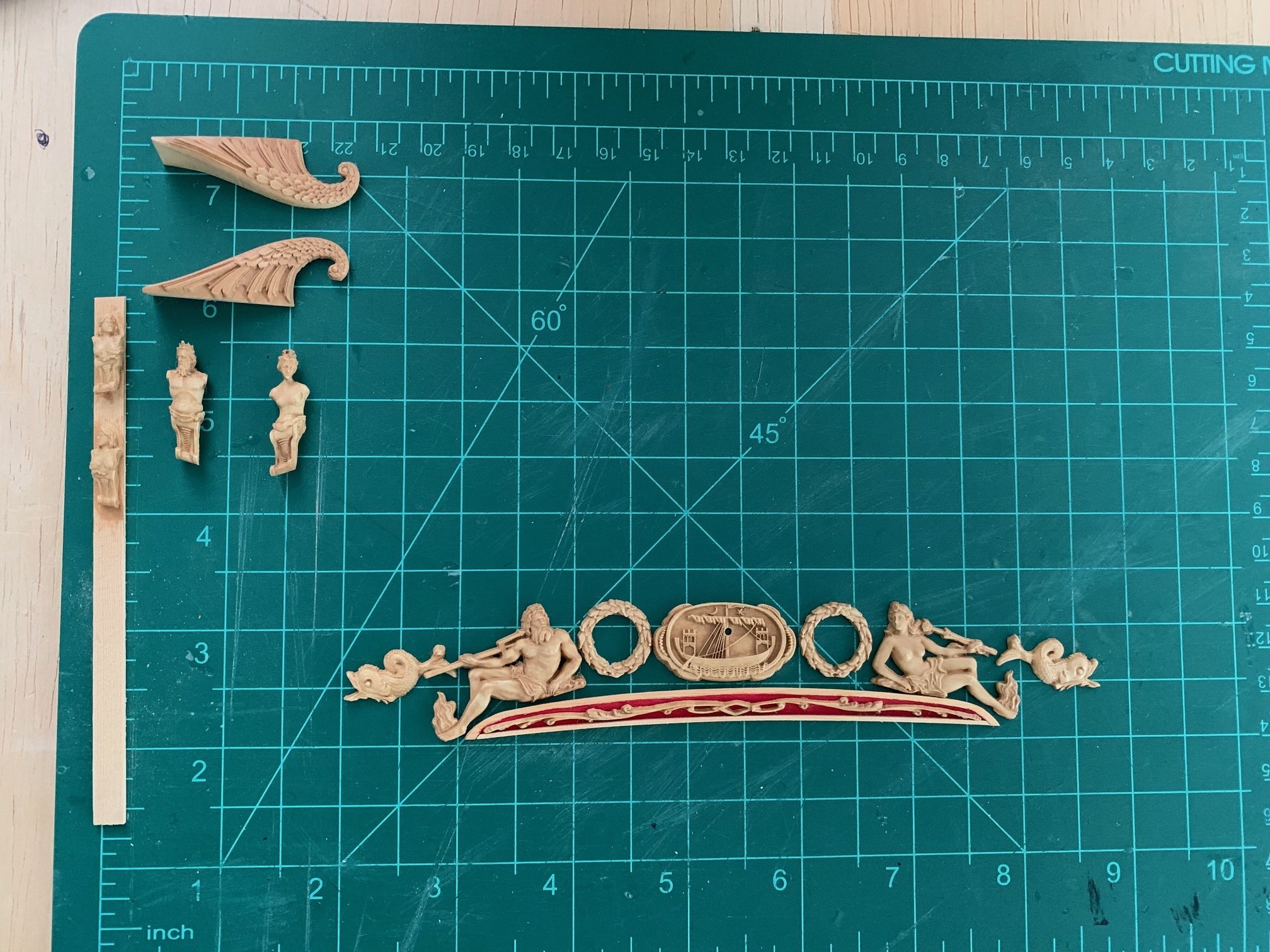

I tacked up the wreaths and the center carving and removed them after installing the cove.  It’s a lot easier to remove any excess glue and touch up the paint without the moldings in place.
A thin batten under the cove helped ensure the placement of the rest of the molding.  I discovered this after installing the starboard side and having to go back and rip out and replace the port side molding.
The rest of the molding is in place.

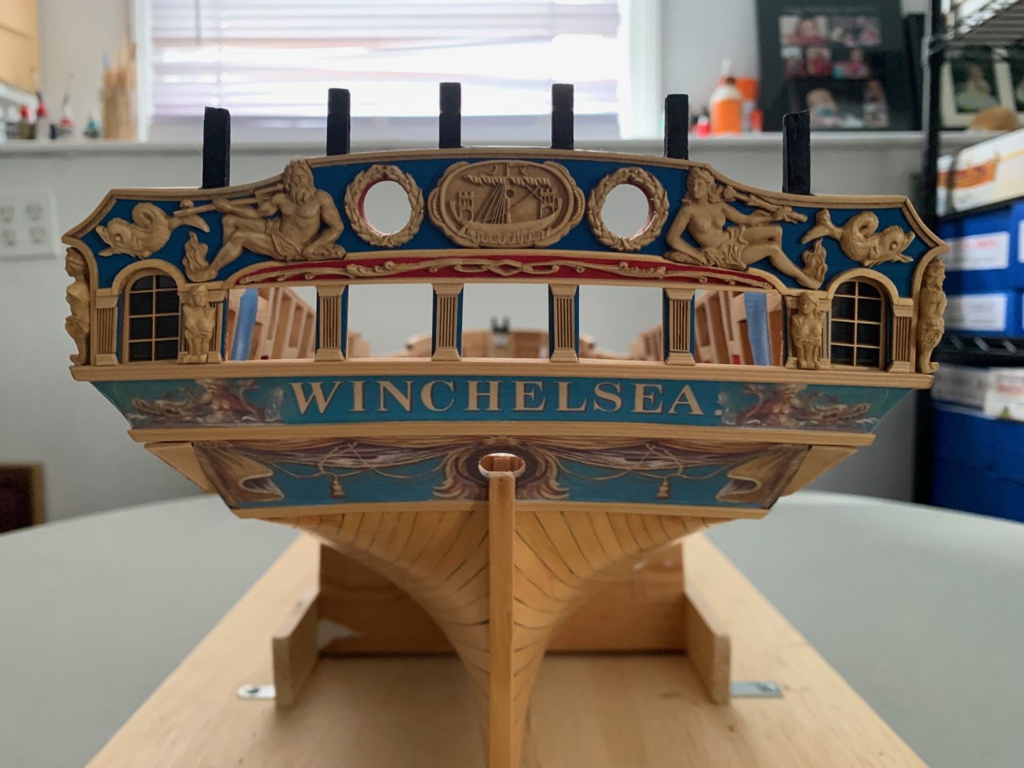

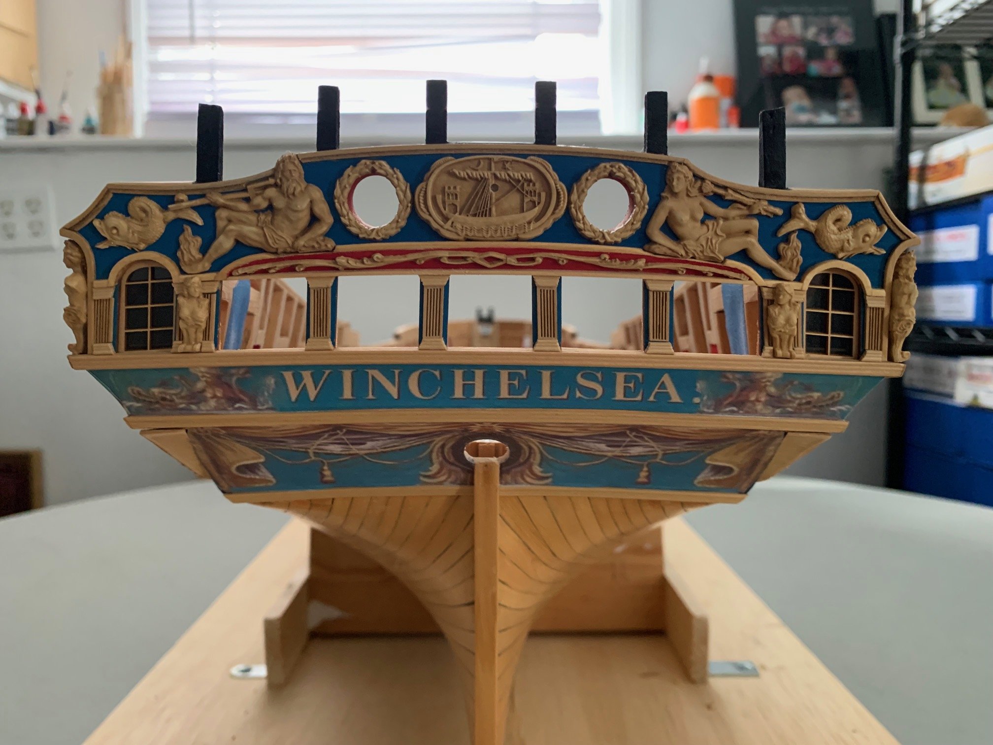

I couldn’t figure out a good way to notch the sitting carvings and get them to lie flat, so I opted to carefully carve out the cove.  I must have made a mistake with my cove and it was too thick overall.  It’s not ideal, but it looks fine once the rest of the carvings are in place.  I still need to thin out the trident.
Carvings are all installed.  Getting close to the end.
And we’ve come to the end.  I am a bit confused by the 2 carvings on the pillars as they seem taller and sit higher than the ones in the prototype.  Regardless, I’m happy with the way it came out.

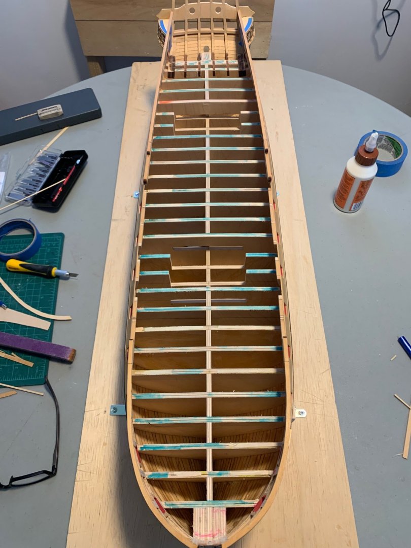

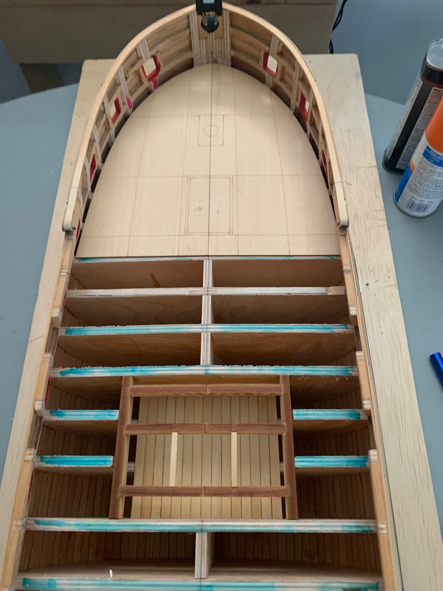

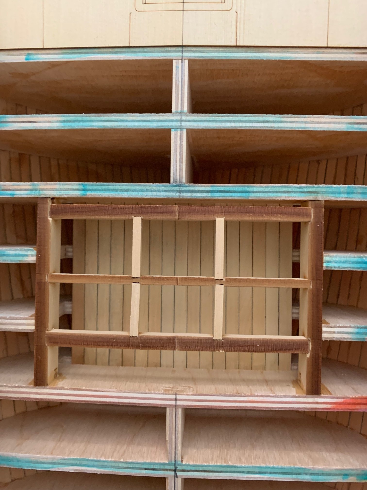

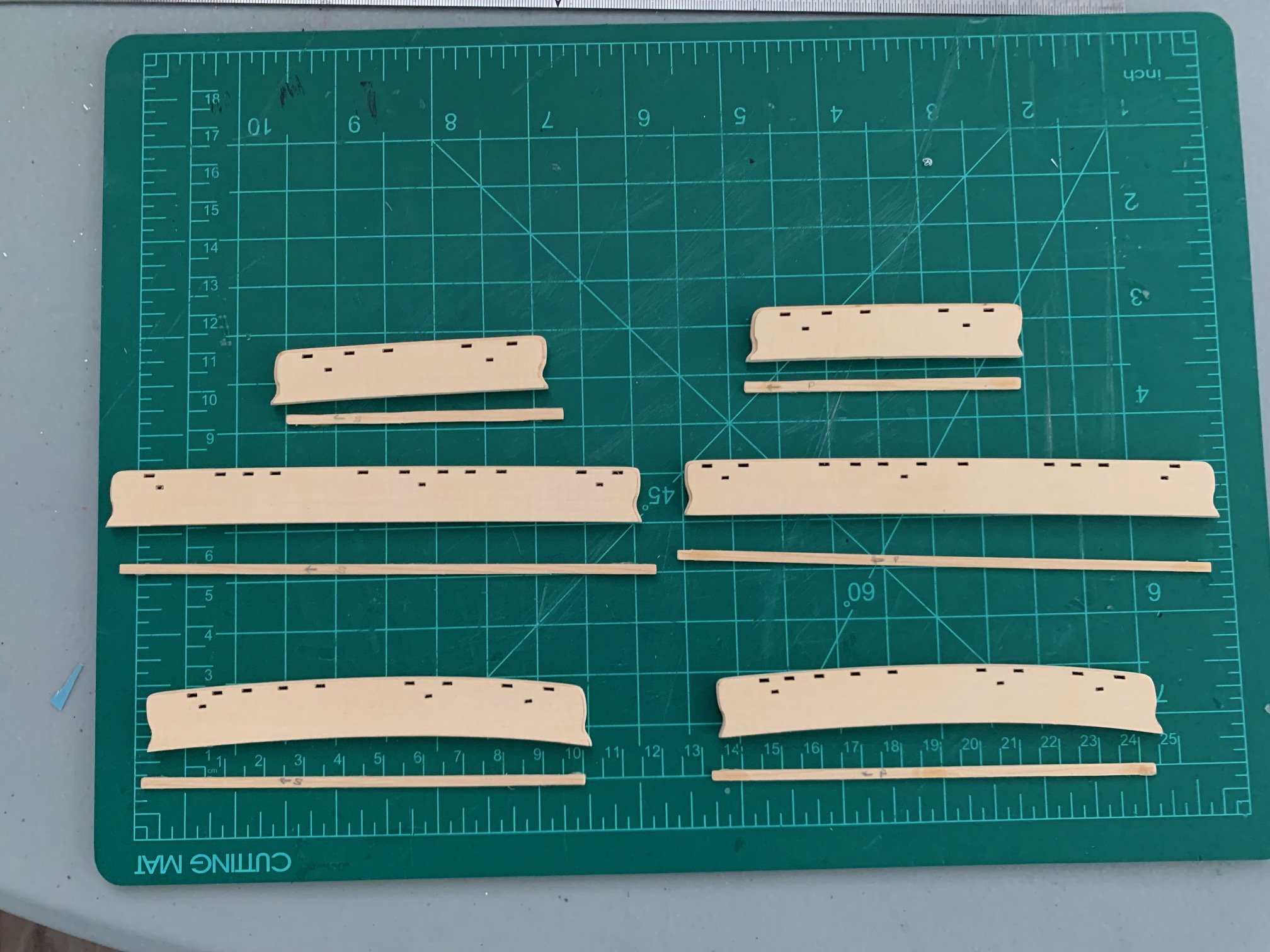

I had plenty of off cuts leftover from planking that just needing a trim so installing the subdecks went extremely quickly.  The supports between the bulkheads all needed to be trimmed about 1/16” so instead of making a best guess how much to trim at each end, I decided to fit the decks at the same time as the companionways.  First order of business was to find the centerline.  I centered a pin as close to the bow and the sternpost as possible.    I then put a small loop in a piece of string and put it over the bow pin.  I made a much larger loop in the other end of the string and put it over the pin at the stern.  Finally, cutting the hole for the rudder helped here as I fed the end of the stern loop through it and then applied tension to it.  This gave me a nice line where the string was centered on the pin rather than wrapping around one side of it.  I used the machinist square to mark the center point every few frames and the ruler to connect these marks.  I have a  straight line down the center that I could key the deck pieces off.
I made my final adjustments to the false deck and then installed the 2 pieces at the bow.  I found the false decks was shifting a little bit when I was trying to take measurements for the beams and installing those pieces ensured there was no movement and it made tweaking the beams easy.  The forward companionway went extremely smoothly.  I cleaned out the mortises and taped the beams together before cutting and everything was square up and centered on the first try.
I then faired it and installed the center decking (which I forgot to take a picture and this is the final test fitting of the deck before fairing and glueing it down).
I repeated this process with the stern companionway.  This one had a small issue with the aft most beam and required some tweaking to the starboard mortis to get it to seat properly.  The photo is before tweaking and really just involved scraping the mortis a little more.
After adjusting the aft beam and making sure everything was square, I then faired it and installed the final deck pieces.
The aft companionway is about 1/64" off center, but everything else looks fine.
I assembled the coamings and the aft one requires just a very small adjustment.  I’m not going to touch the opening where the grating will sit.

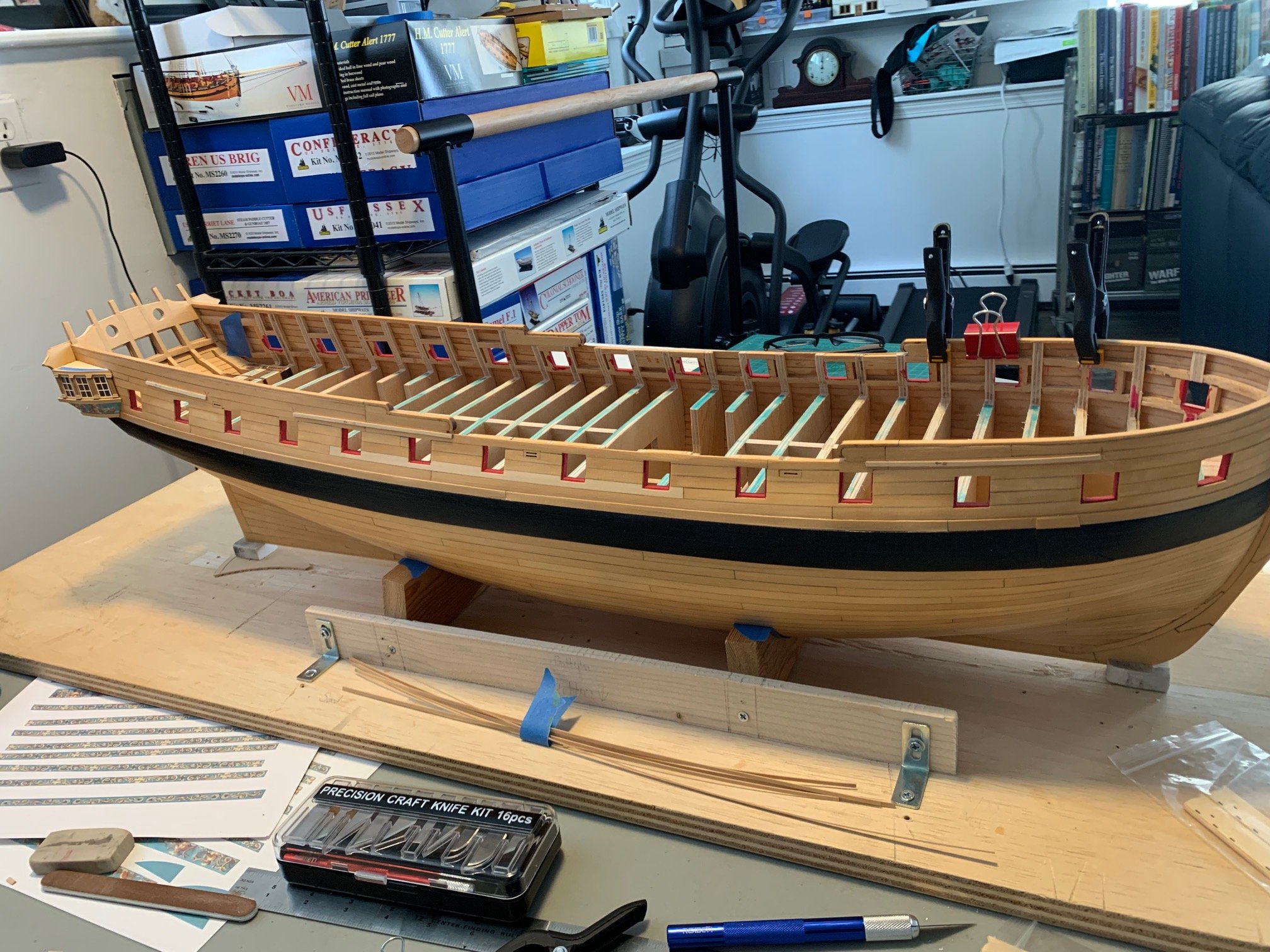

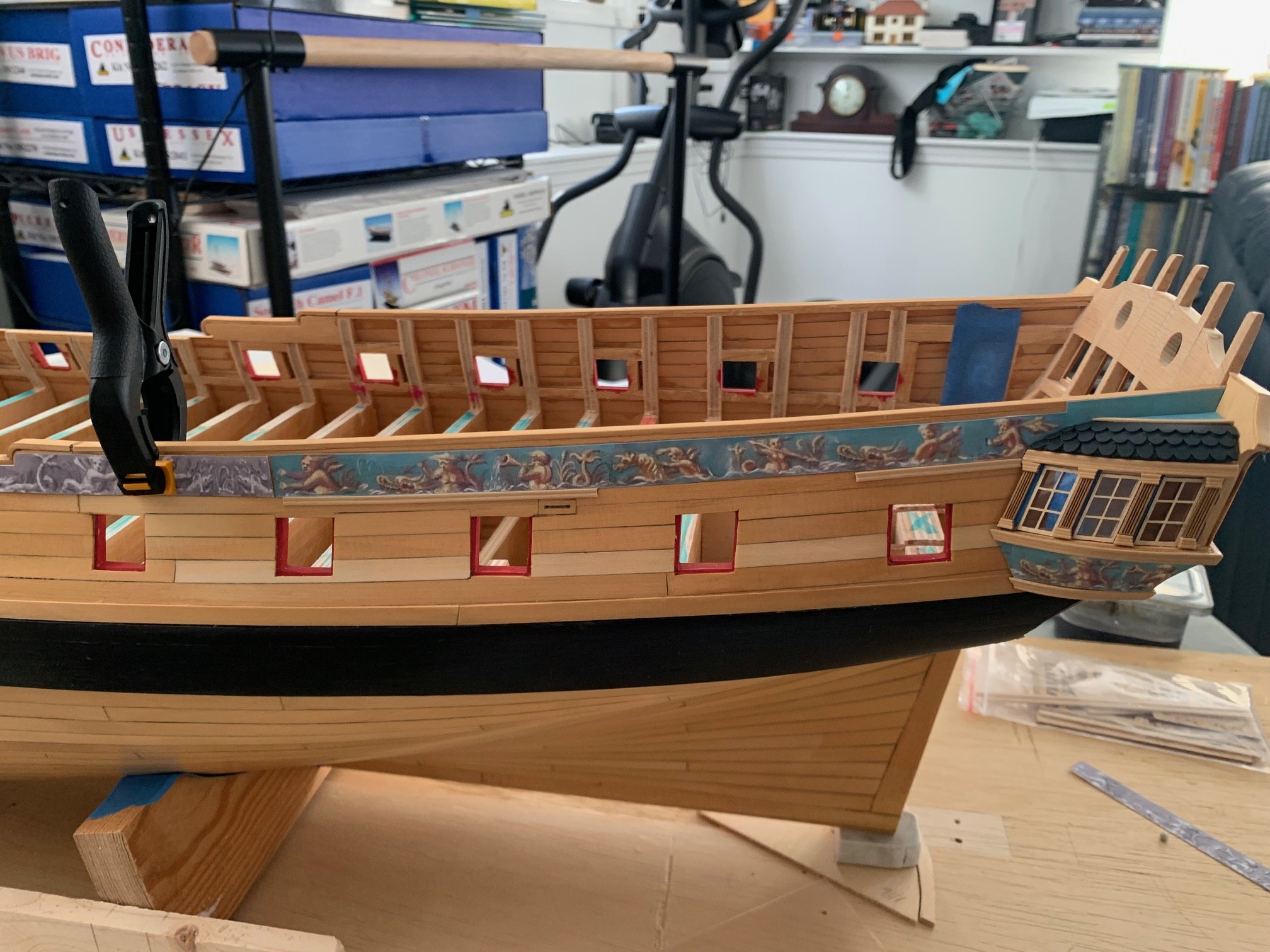

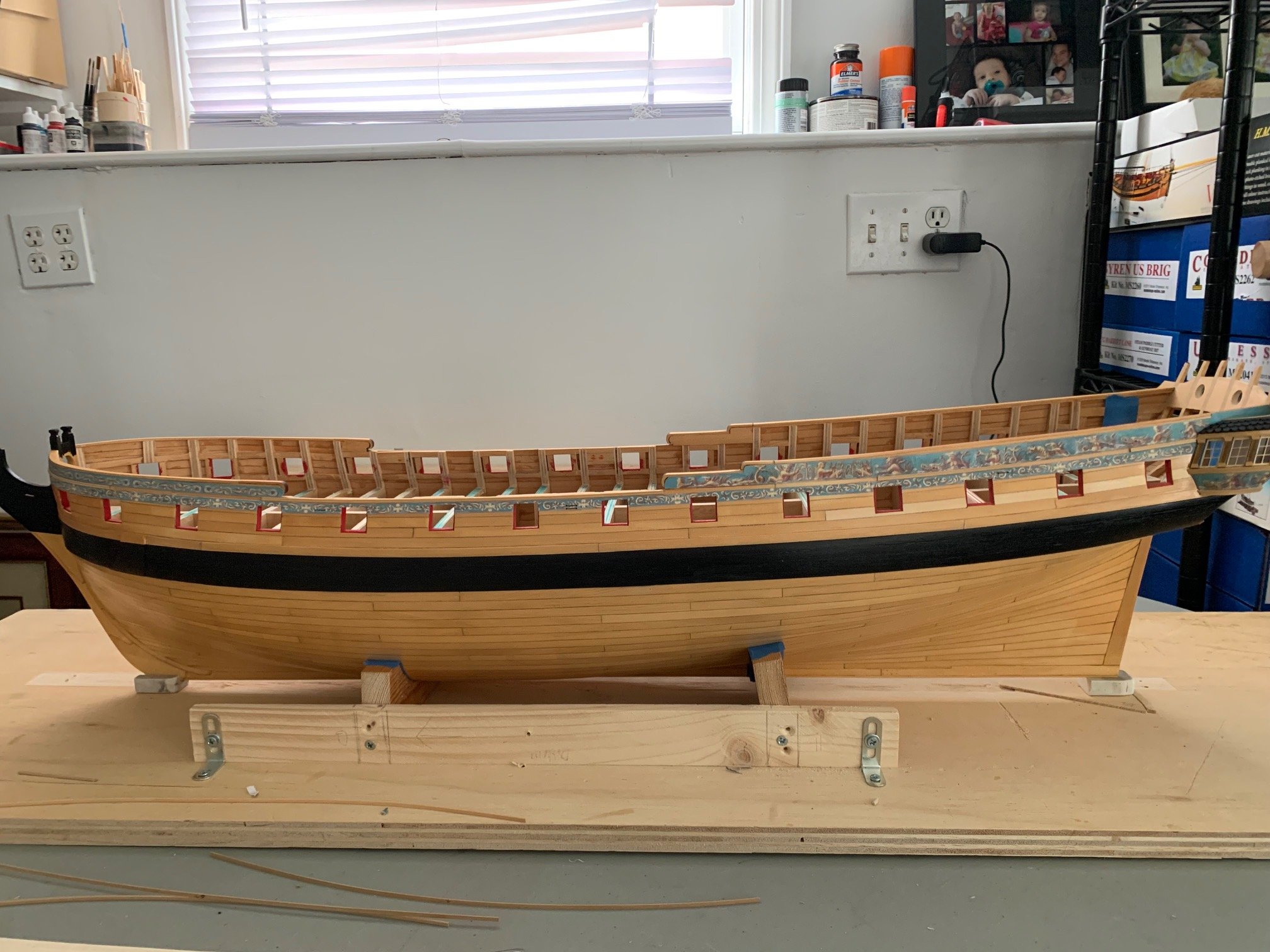

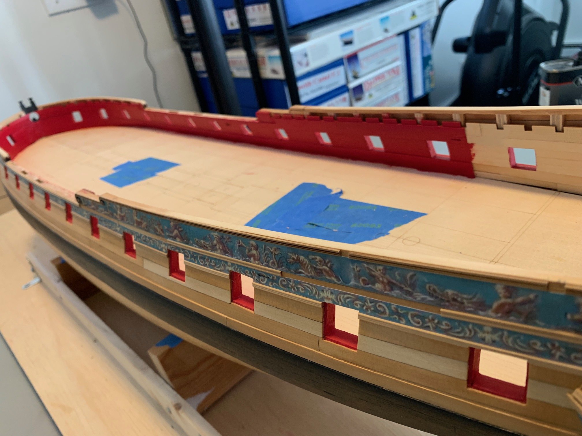

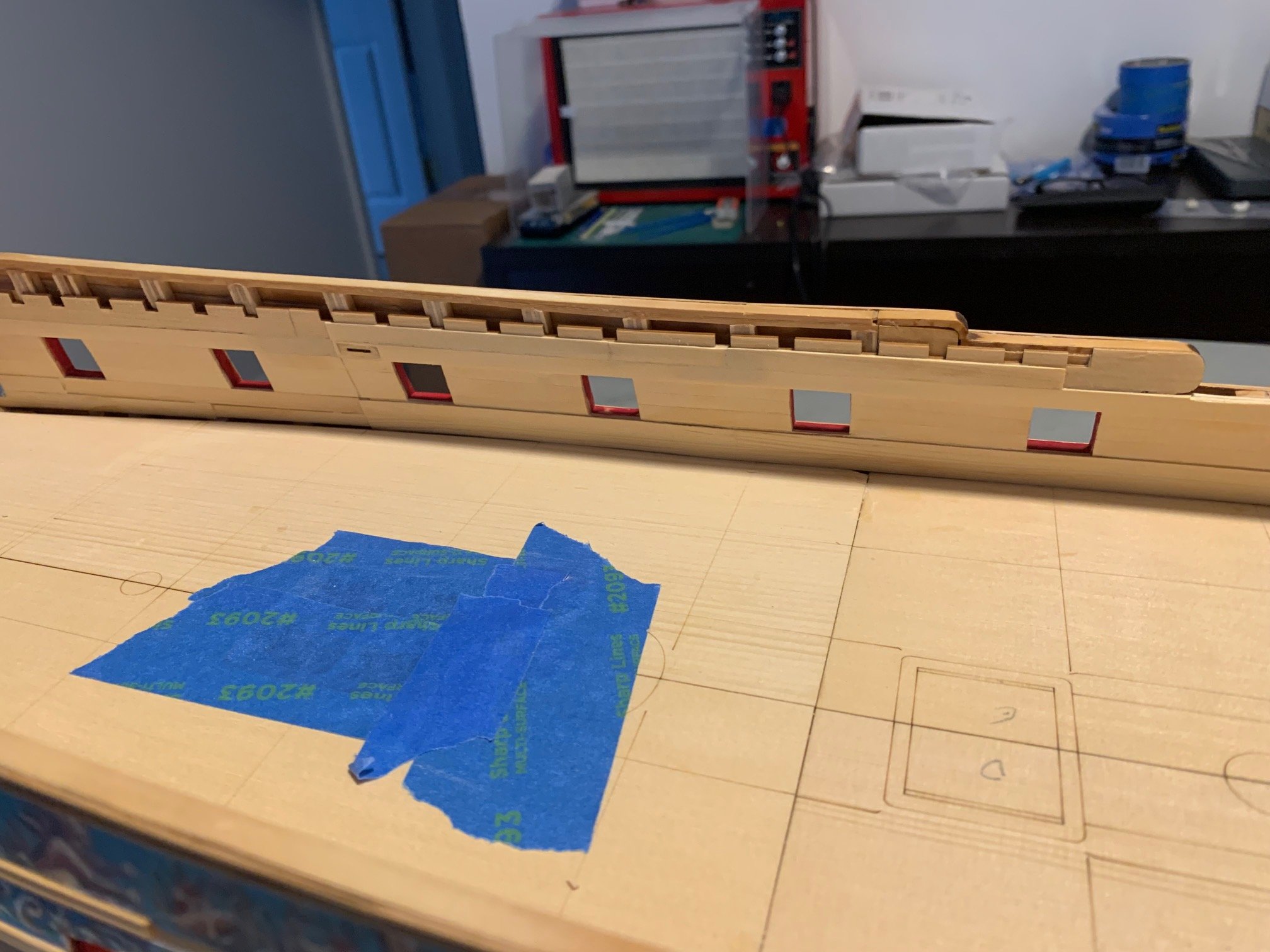

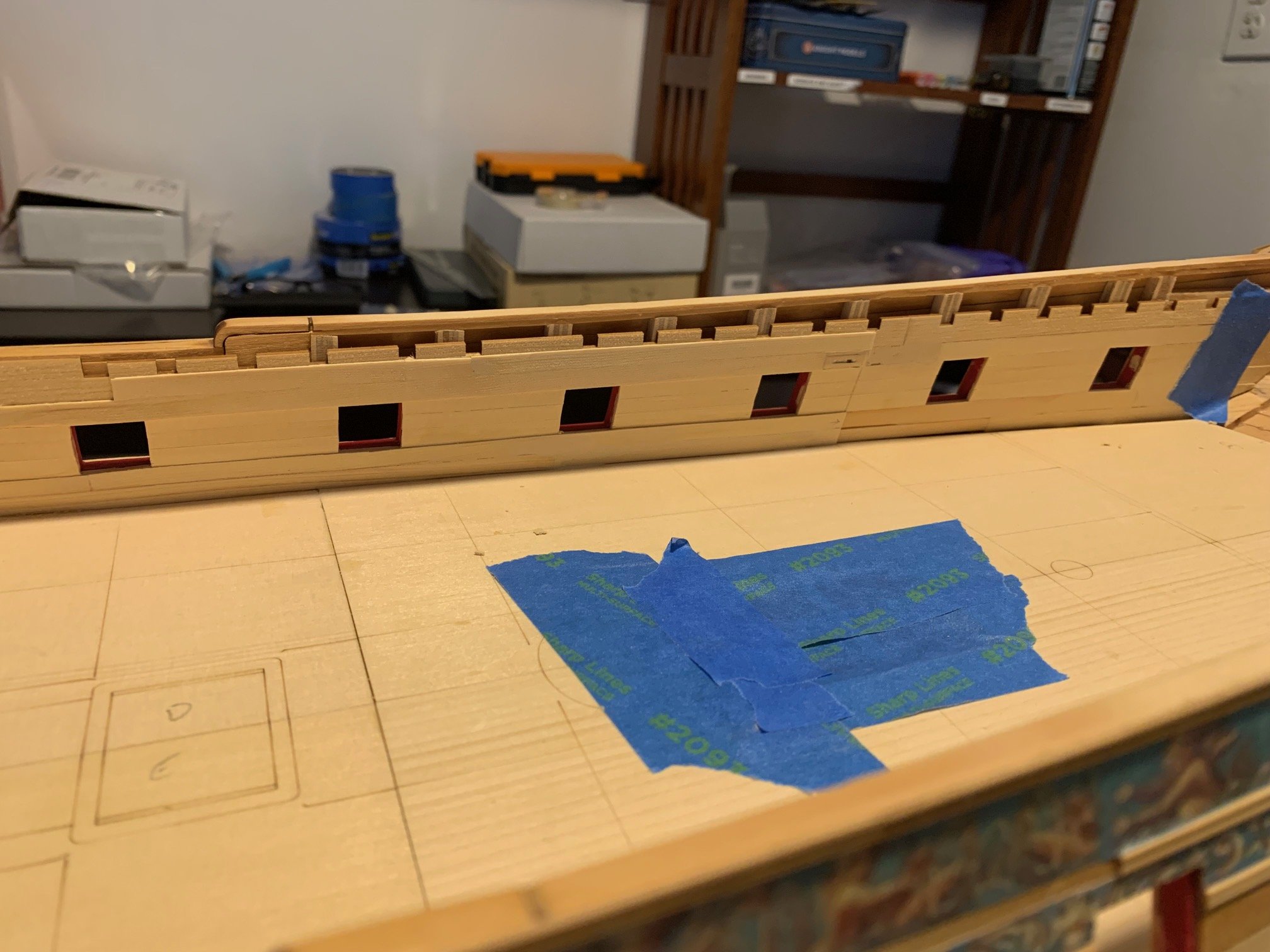

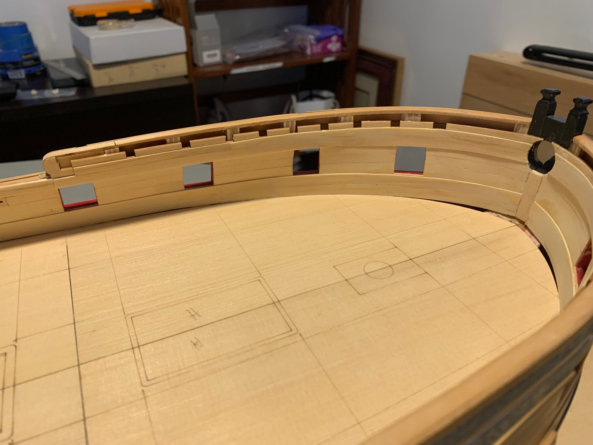

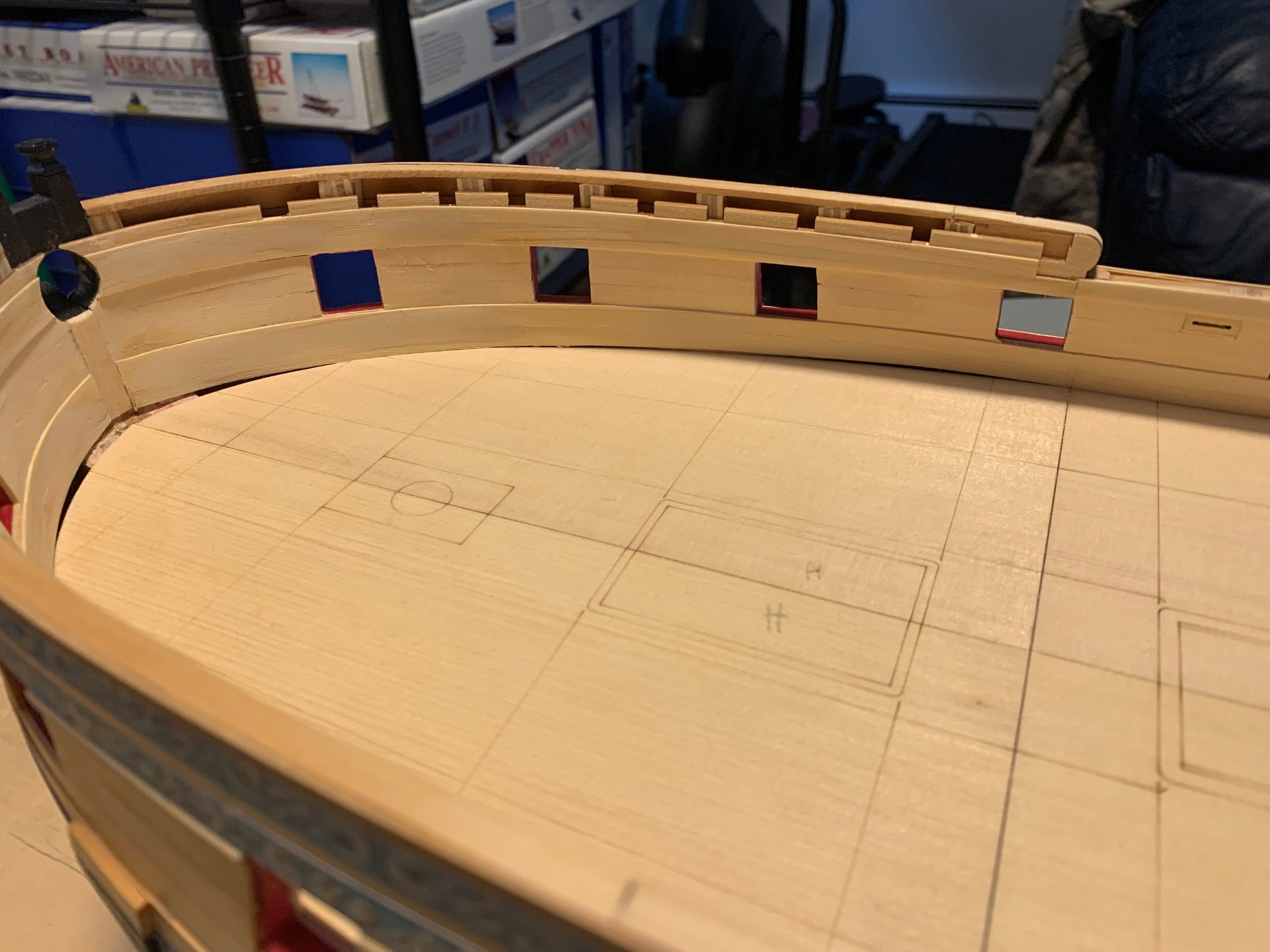

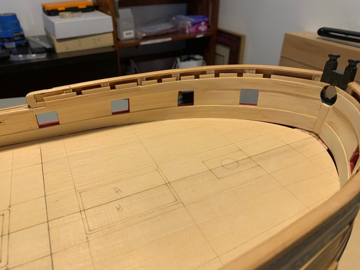

Thank You everyone for the likes.  I debated whether to take pictures at all until the bulwarks were planked and painted as I knew the work in progress on this is going to be messy.  Aircraft plywood is definitely off my list of modelling materials as fairing the bulwarks to the degree needed is next to impossible .  At least at the stern and bow there was enough access to use a Dremel , but the waist below the gunports required a mix of hand sanding and chiseling making it very difficult to get a clean run.  For the spirketting, I installed the 1/4” top piece first in short segments (typically 2 gunports long).  After that, I installed the lower piece with 3/16” except at the ends where 7/32” worked well.  There were also areas where I need to shim the frames as I had undercut them so much.  There’s a lot of gaps in the first layer, but my goal is just to set up for the second layer.
Once I finished the first layer of spirketting, I tackled the port side first and started planking from the stern and working my way forward.  Due my fairing difficulties, I measured for the caprail at the waist and need to be extra careful to make it too chunky.  The plank under the clamp from just aft of the fixed block forward is 1/32” thick and the fixed black has a 1/64” shim under it.  This creates a little ledge and will make it easier to get a thinner plank for the 2nd layer.
I test fit the panels to make sure they would fit ok.
I worked my way around and finished up on the Starboard side and didn't have any difficulties.
The port bow was straightforward.  The area between the forward most gunport and bollards needed extra care, but I went slowly and kept test fitting the clamp and measuring until everything lined up properly.  The thinner plank under the clamp really shows.
The starboard side was tough getting the clamp to perfectly line up at the bowsprit; ugly planking and all.  I found fully painting the bollards black helped with eyeball math.
I had a moment where I thought I really made a mess of it when I noticed that I hadn’t glued the bollards in securely enough.  Before getting too far on the starboard side there was enough spring left in the clamp to have pushed them forward a bit.  Carefully cutting the clamp and plank below it was enough to relieve the pressure and allow me to glue it back up in the proper position.

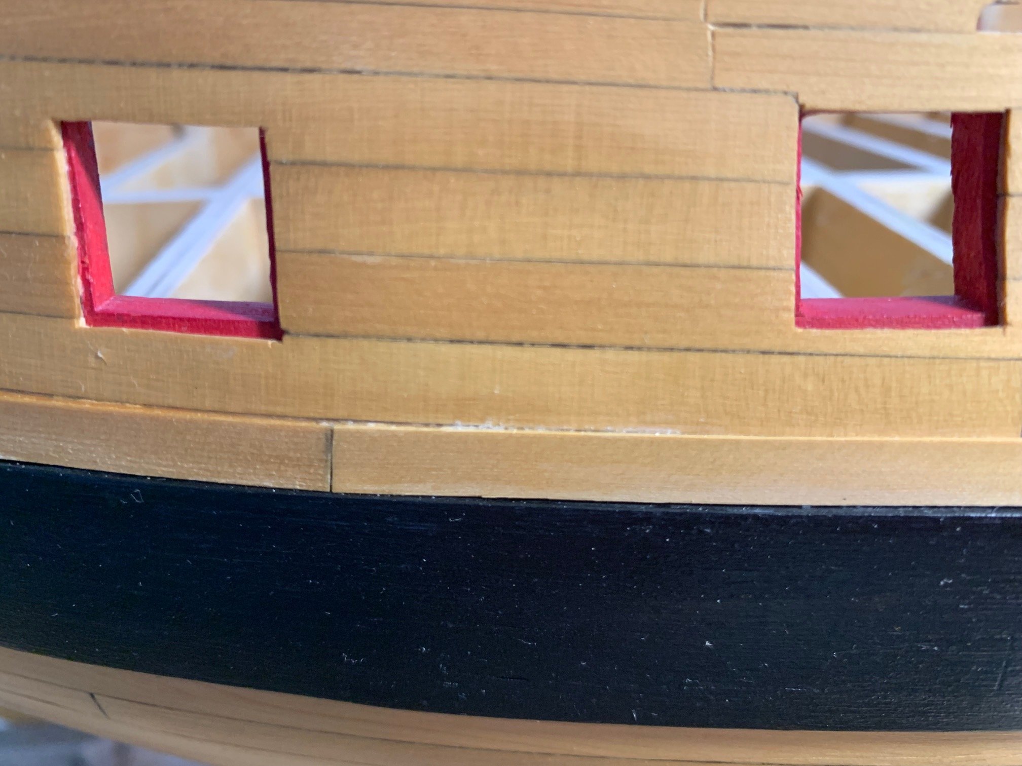

I brought the Winnie outside to clean the bulwarks up.  A pen sander with 120 grit took care of a rough fairing of the bulwarks.  I sanded all the high points off the spirketting and smoothed out the planking between the gunports.  I didn’t touch the clamp or plank below it other than where it will be covered by the panelling.
A better shot of the light touch above and below the gunports and the heavy touch between the gunports.
My next step is going to be to clean up and paint the gunports and the bulwarks between them.  There are a few gunports that need some filler and they all need a couple coats of paint.  I also want to take a trip to Chapter 7 and test fit the deck beams now.  I glued the starboard clamps with small dots at each frame, so I can pop them off still and make adjustments if need be.  I did some  tests for level with a few planks at different points and I’m sure they’ll be fine, but if I wait until I get to Chapter 7, I’m sure they’ll have magically moved.

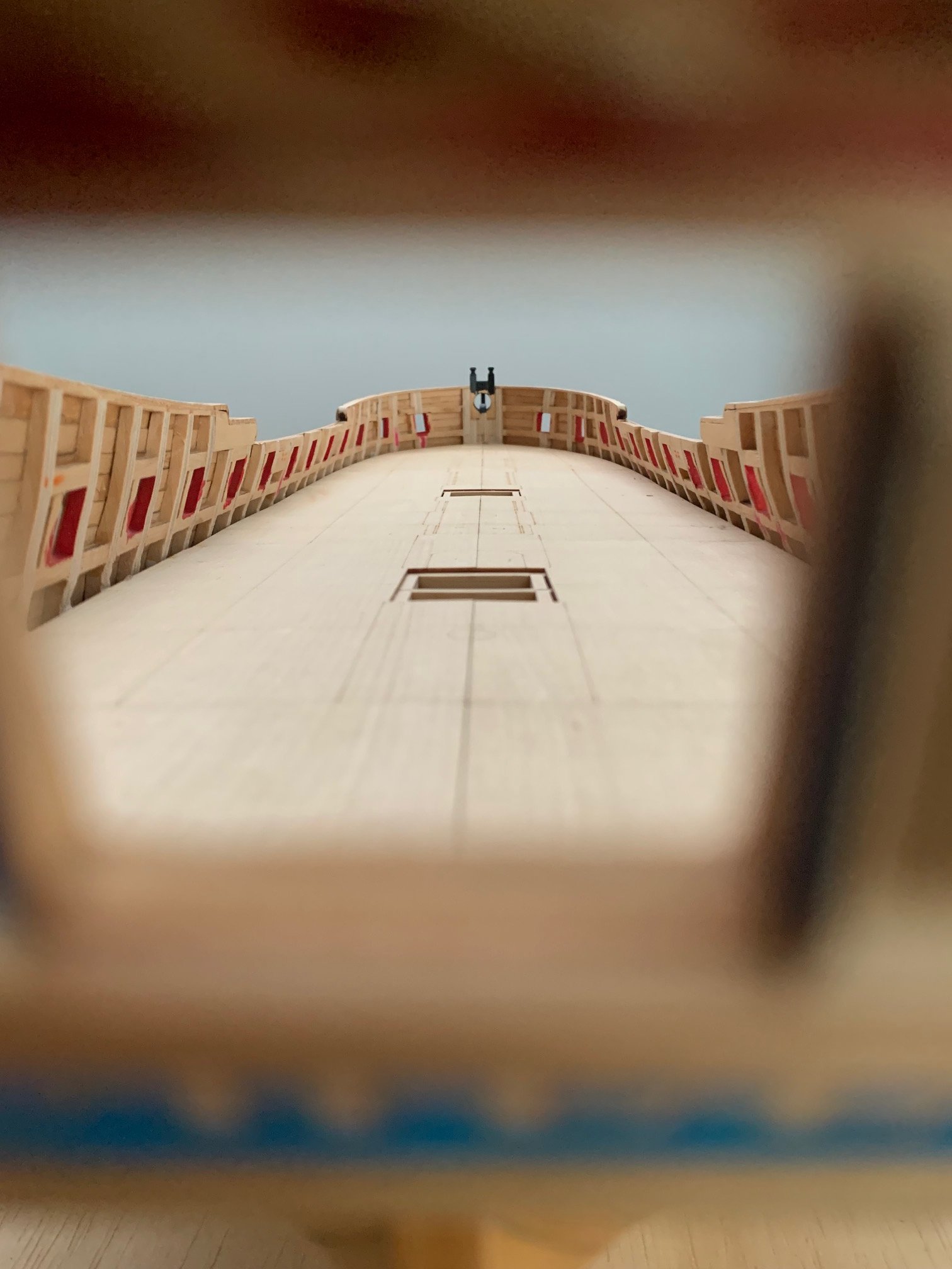

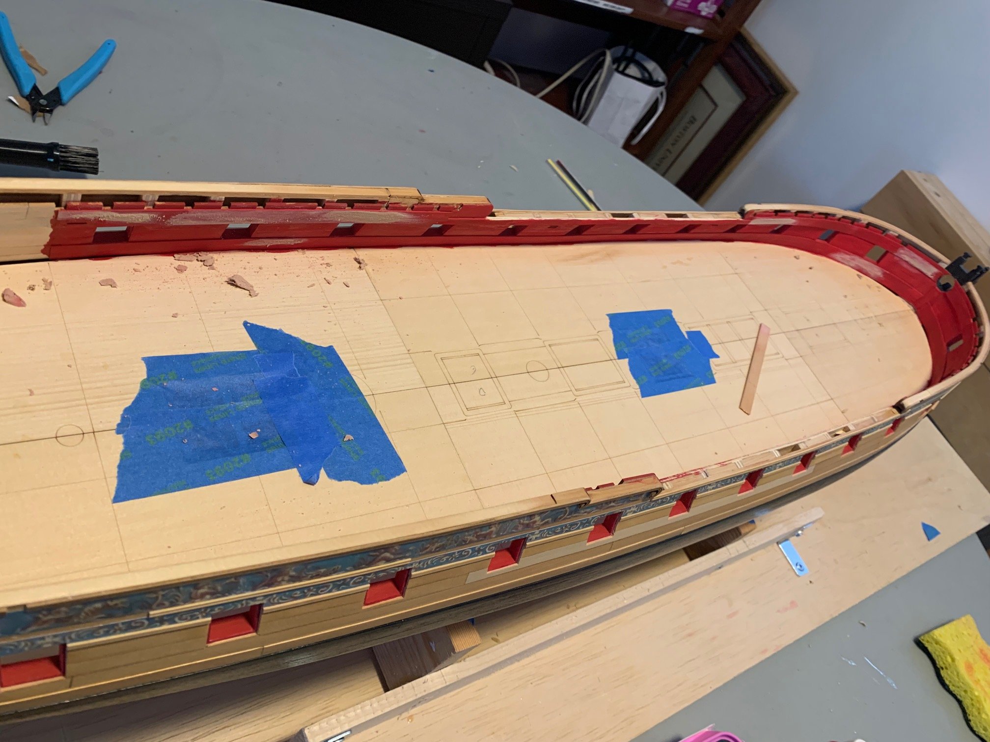

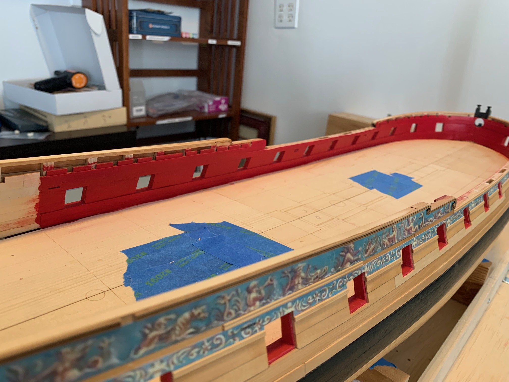

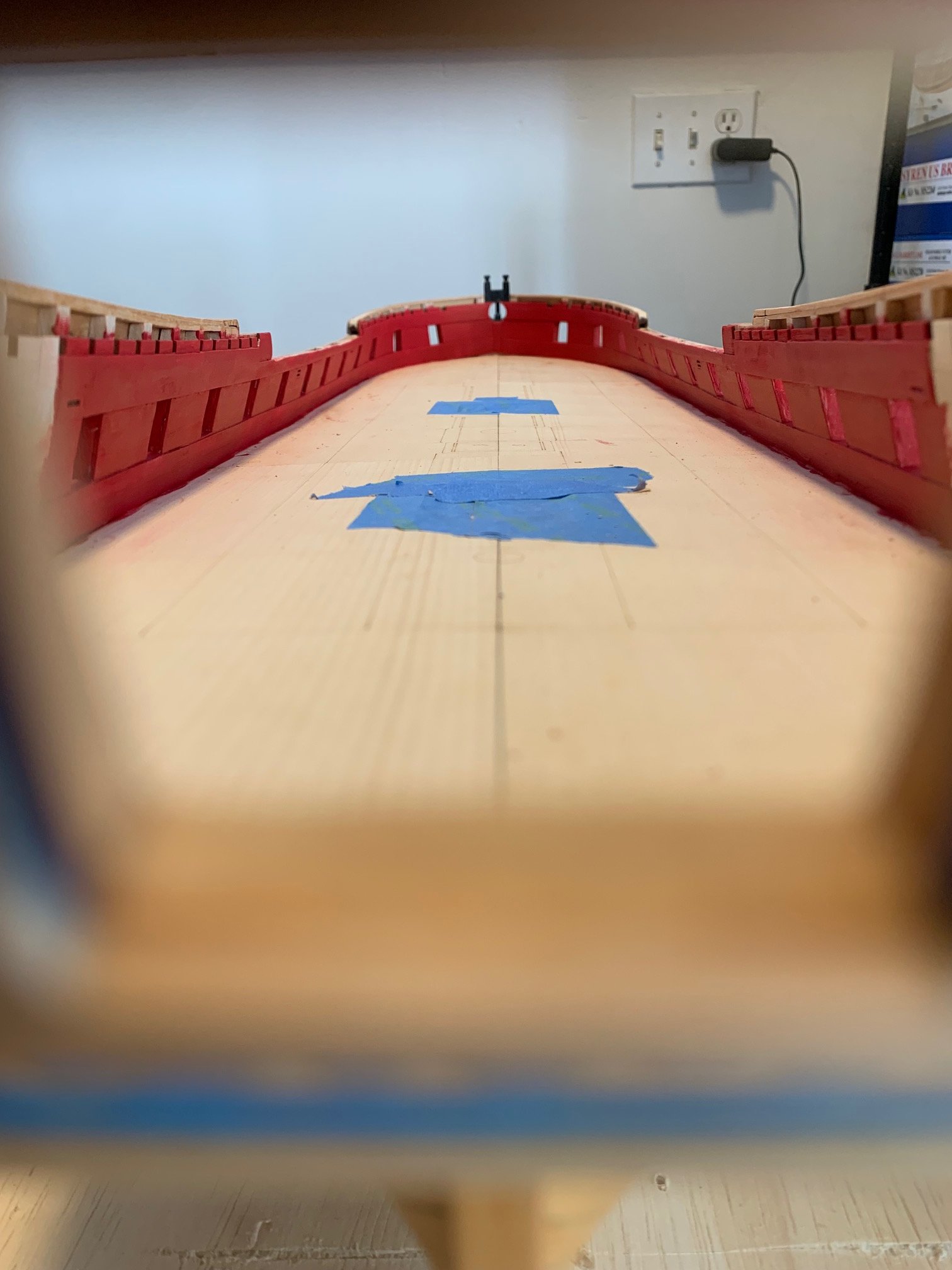

Thanks JJ.  Now that the plywood is almost completely covered, it feels like I finally have cleared the trough of despair.
The spirketting and the planks above the gunports were installed and the most obvious gaps puttied.  It’s already a huge improvement.  I used 3/128” plqnks for the second layer of spirketting.  The thinnest I’ve been able to consistently mill wood with a slitting blade is 1/32”, but I found using the metal sanding block that came with the Sand-It tool, double sided tape and a hard surface were all I needed to get uniform planks.  The Sand-It tool is rubbish, but the sanding block has a little bit of a recess for the sandpaper and taping a few 1/32” planks down to my workbench and sanding until there was no wobble on the block gave a consistent 3/128” plank.  I also spent some time making sure the waist was consistently narrower than a 5/16" plank.
I measured for the panels and planked up to the point where they will meet so I won’t have to worry about errant brushstrokes once I start painting.

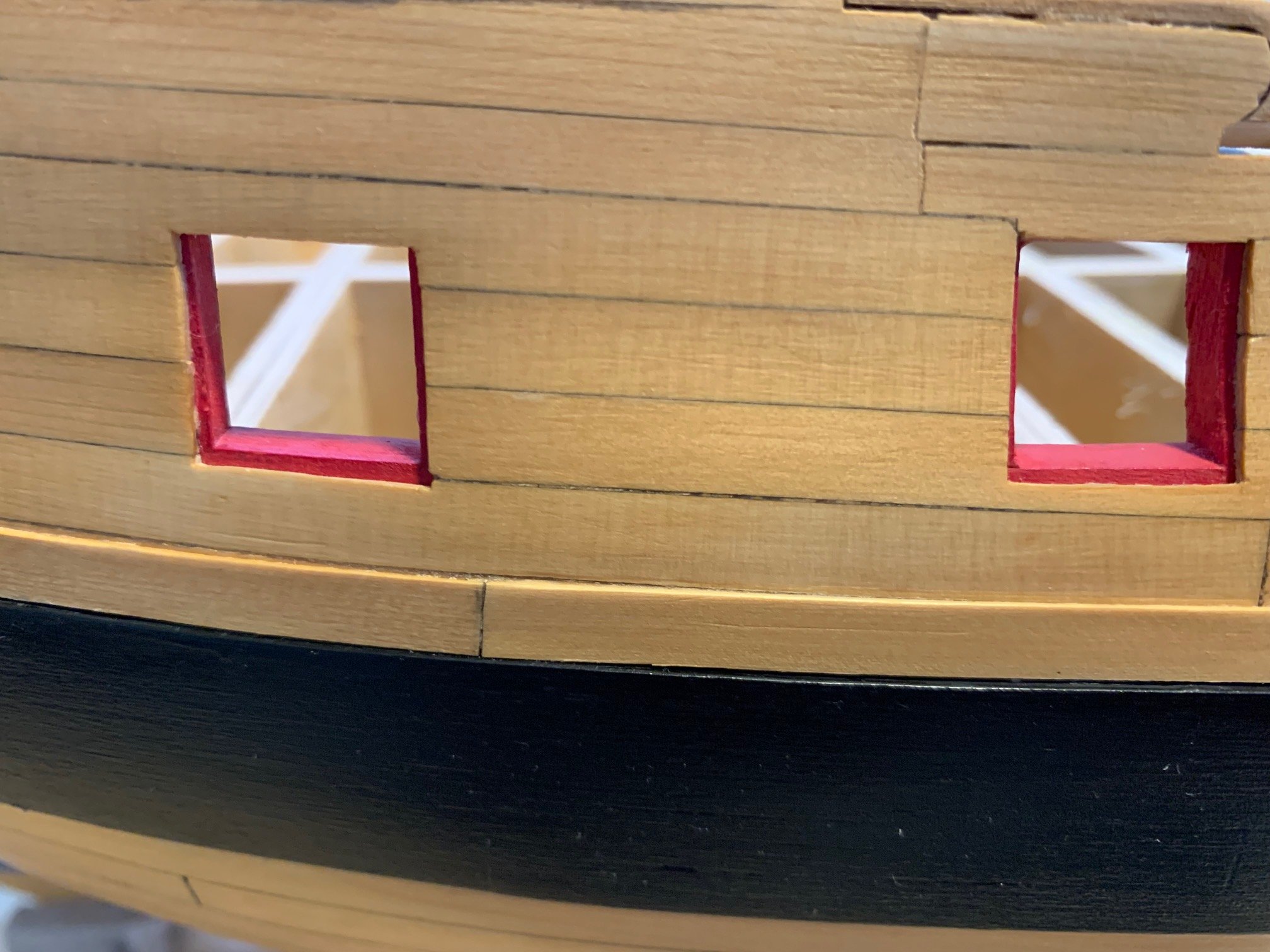

I cleaned up and painted the gunports then applied a coat of Vallejo Model Color Flat Red to the bulwarks.  I looked for any seams that were still visible at all and puttied those, then sanded with 220 grit.
After applying a 2nd coat of paint, I gave a light sanding with 320 grit sandpaper to knock down any raised grain, then applied a 3rd topcoat of paint followed with a coat of WOP.
I’m glad I applied the WOP now and not after the panels were in place as there was a bit of paint transfer that would have made a mess on the panels.

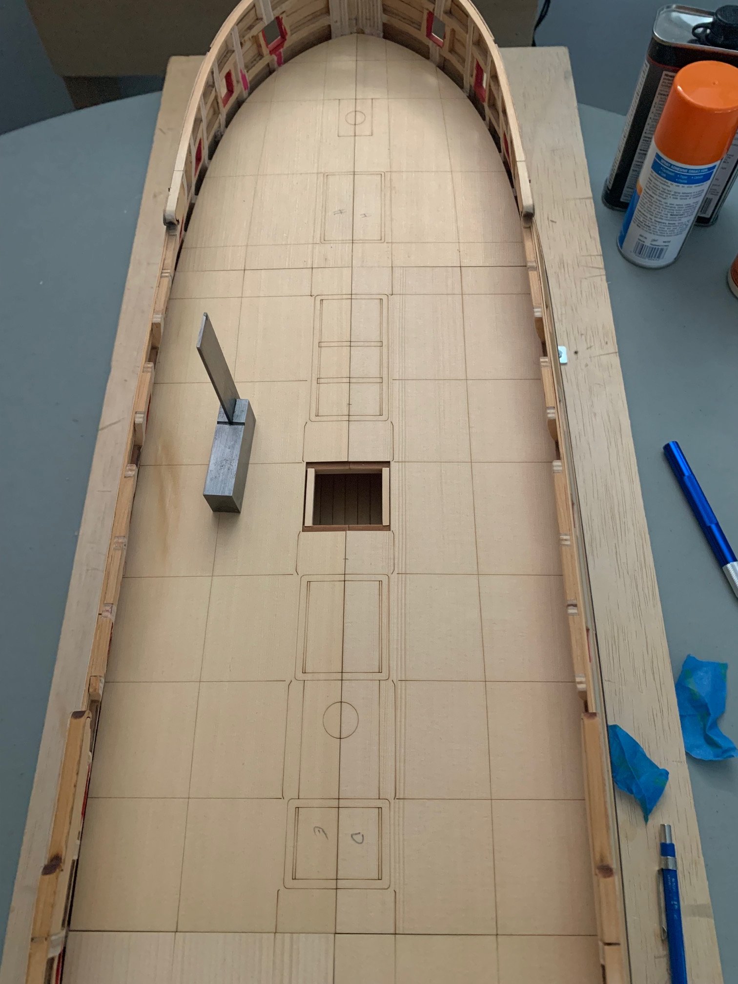

I kept working my way back and knew the fit of the cabin flor was going to be a bit of an issue due to the gap on the port side.
Trying to juggle the scarf joint, matching up to the margin plank at the stern and balance the margin plank where it meets the floor was going to be pretty daunting. I decided to split the final margin plank in line with the front of the floor where the bulkhead will rest, which will hide the seam.  I got a nice fit and with the waterways installed, nothing looks awry.
Regarding the waterways, it’s interesting how much more polished things look once they are installed.  I made sure that all the joints will be hidden by a cannon or bulkhead.

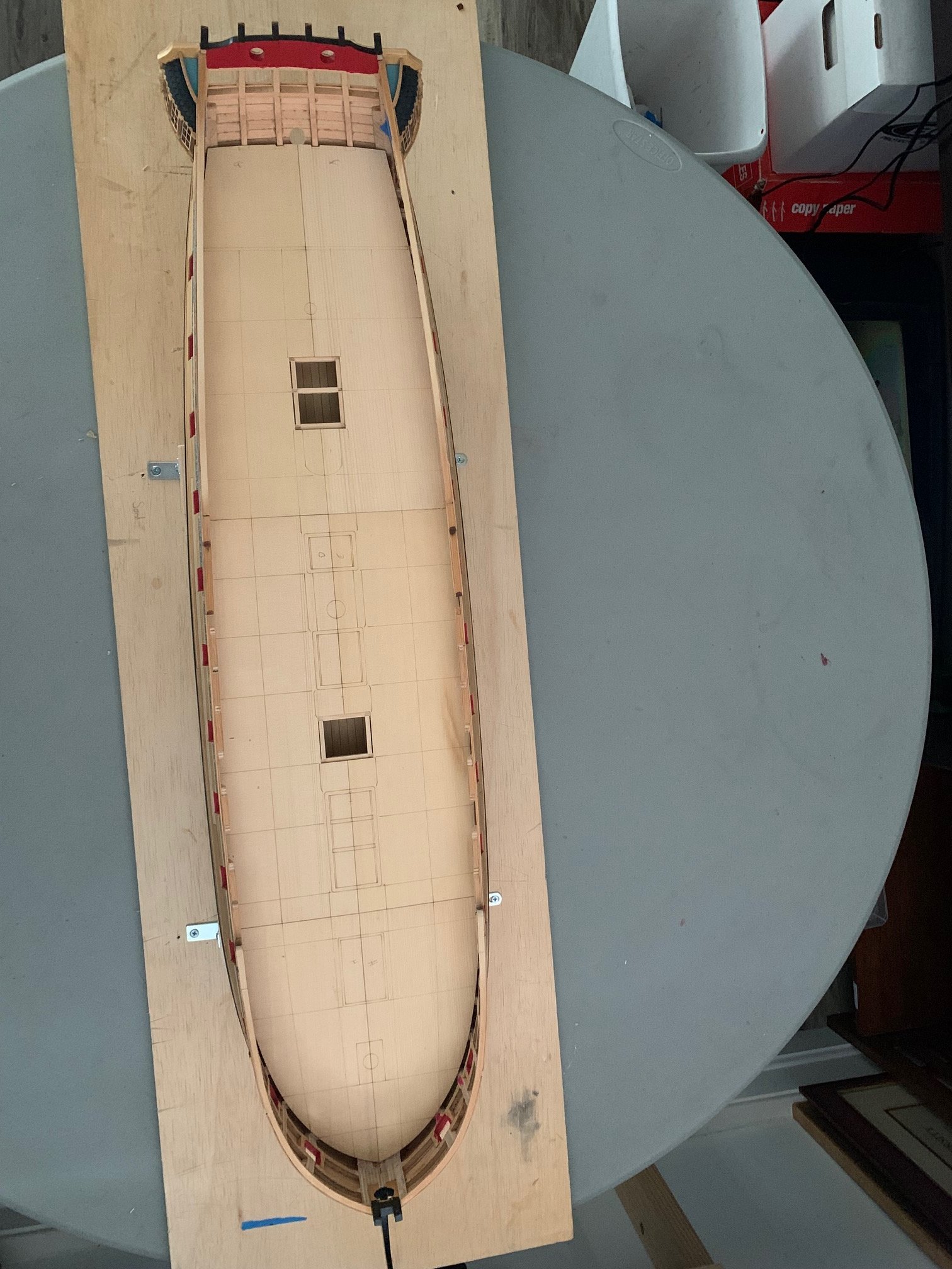

Thanks Steve.  Made me realize how long it's been since my last update as it looks like you are very close now.

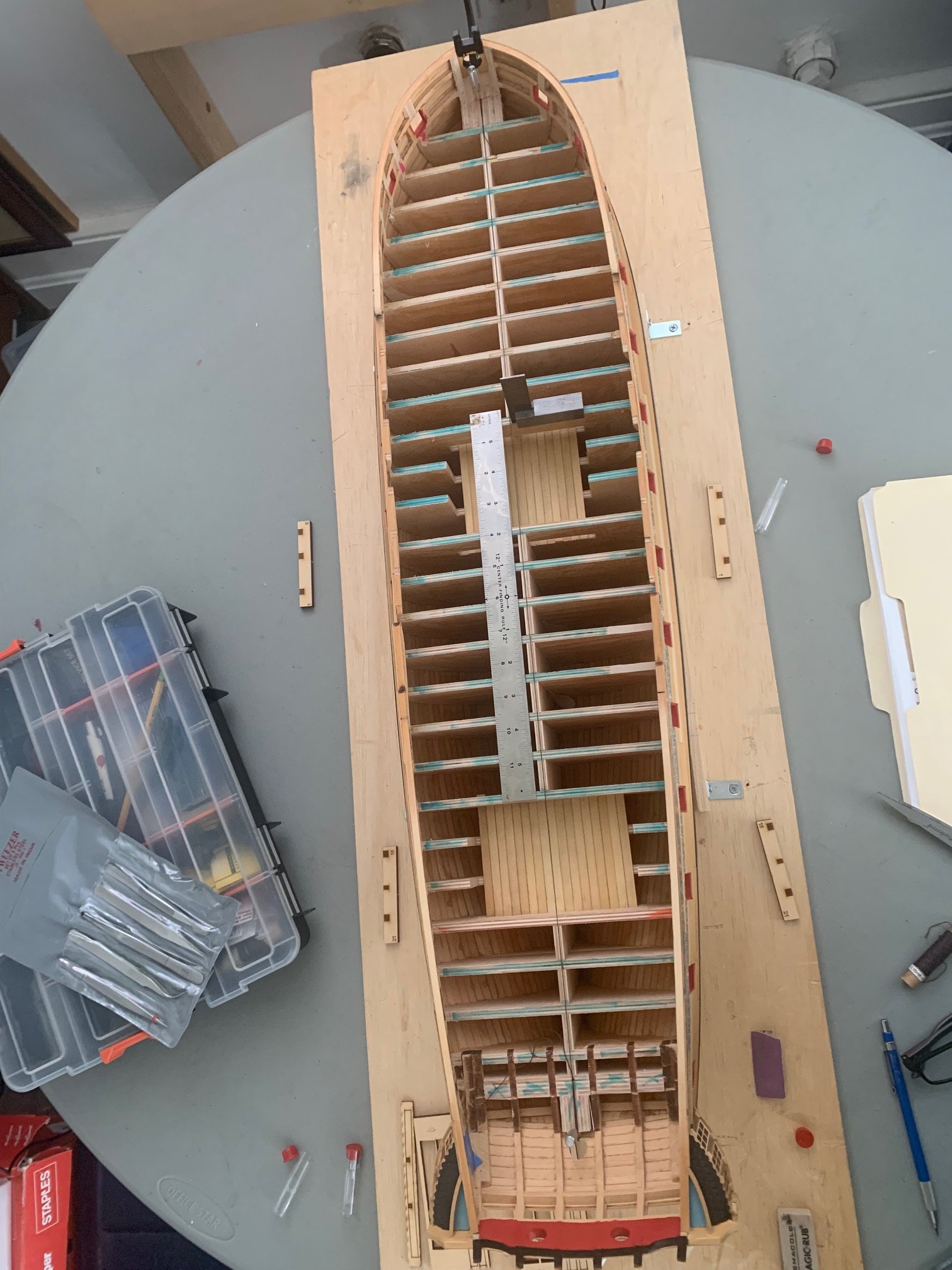

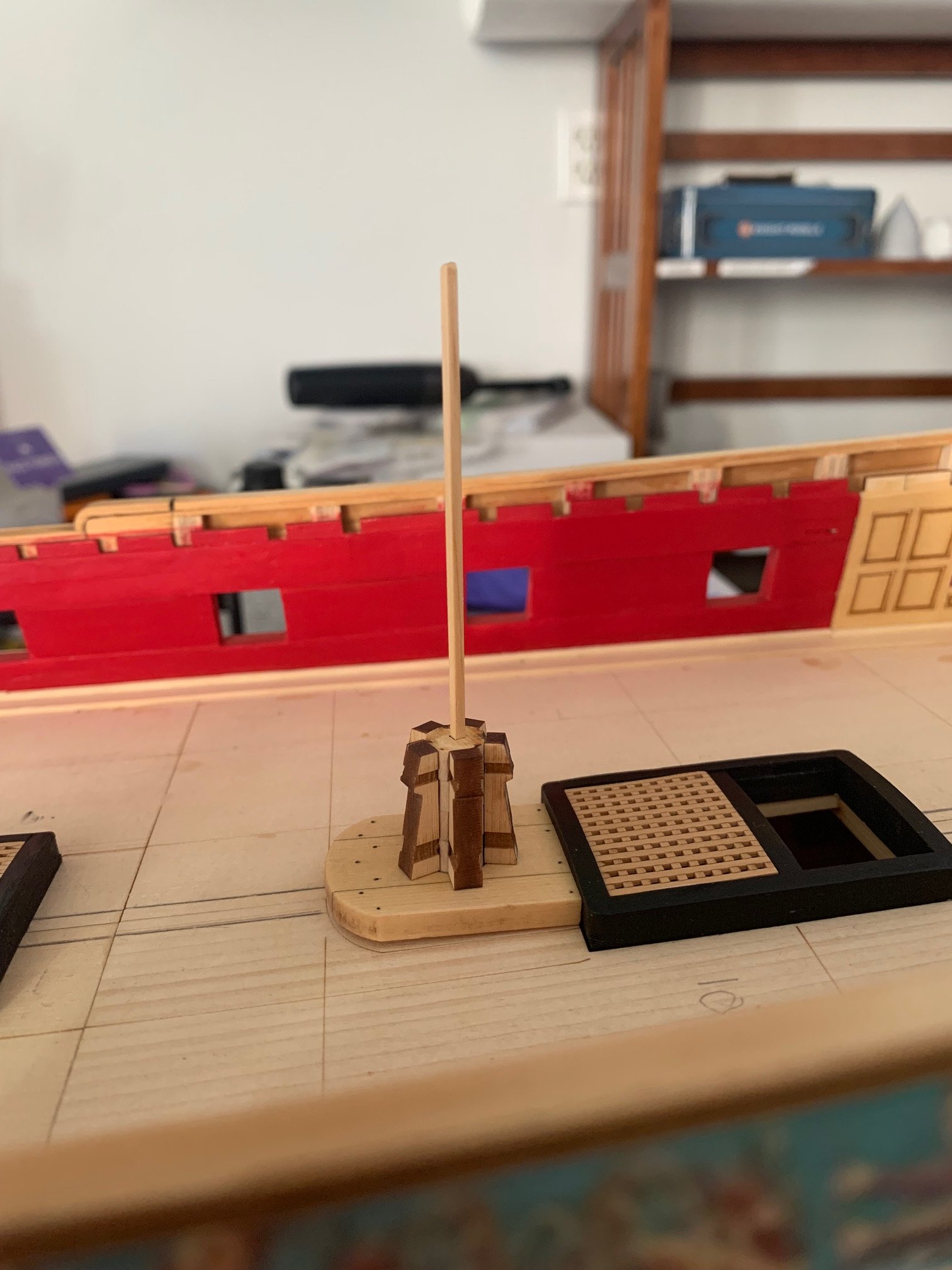

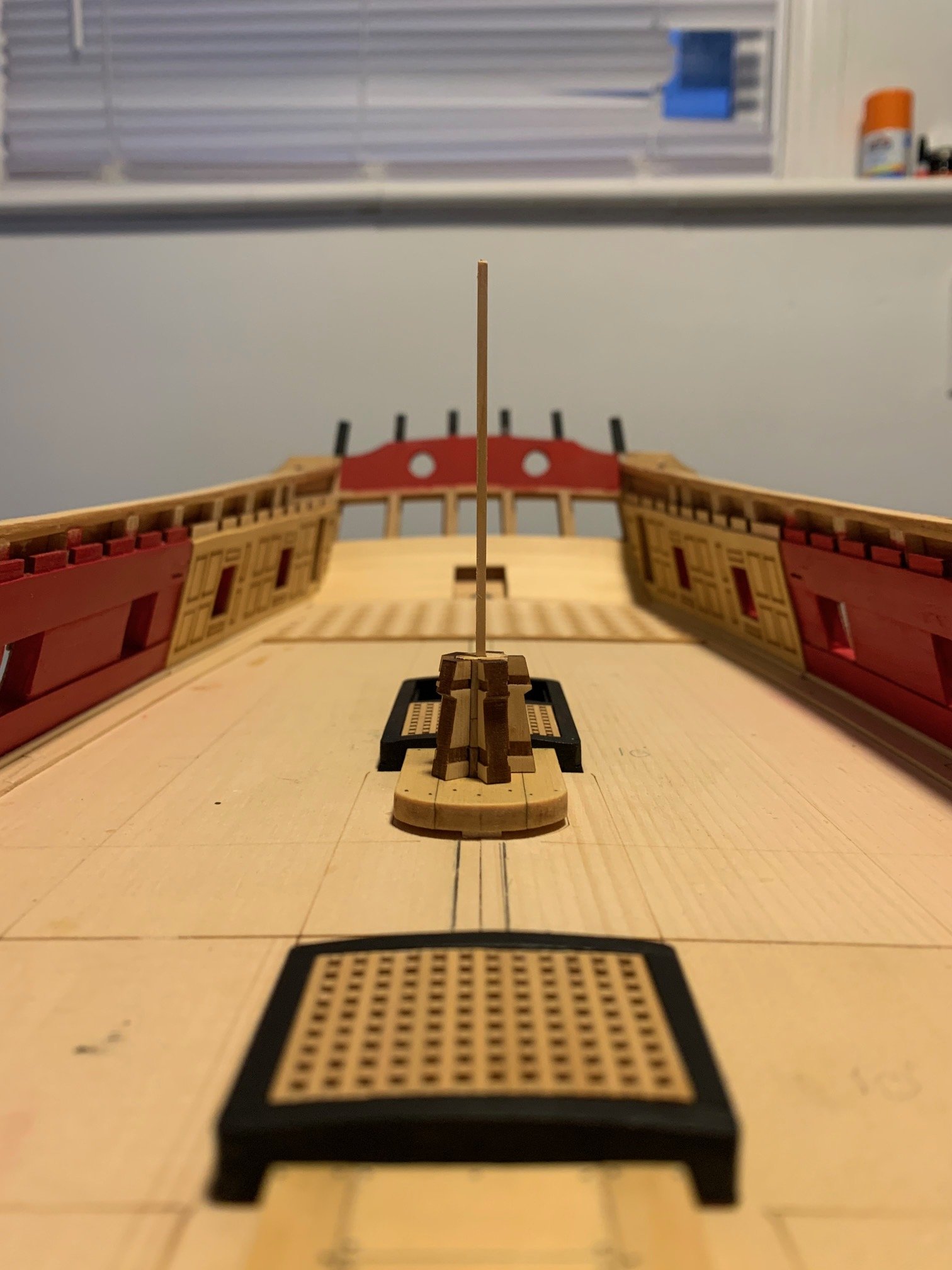

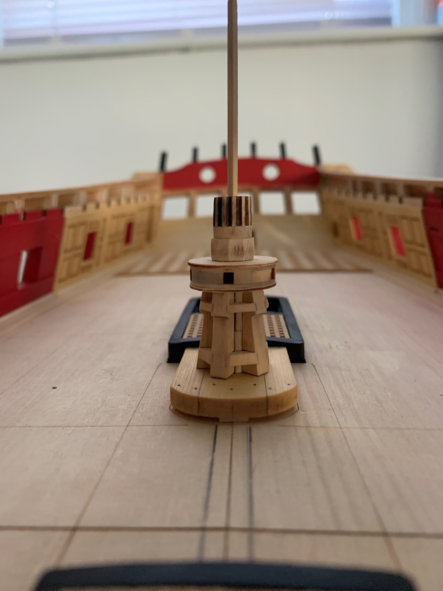

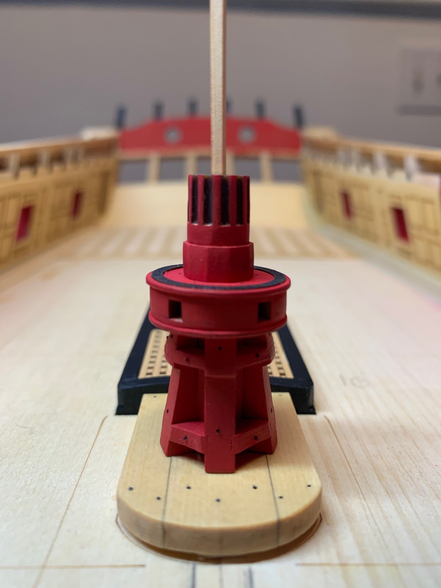

Work has been surprisingly busy the last few weeks, so progress has been slow, but I’ve been plugging along.
I started by lining off the center plank and then assembling the coamings.  The provided jig is so simple, yet made this step pretty effortless including shaping the corners to the proper depth.
Moving on to the gratings, the jig made these extremely easy to assemble as well.  Once trimmed, I found the watered down glue didn’t create a very strong bond for the strips on either end, so I made a habit of applying more glue after trimming them up.  The aft most grating threw me off for a moment as it’s one strip narrower than the others.
Sanding down the gratings, I found I could be fairly aggressive with a 180 grit sanding stick  and then once I saw the char start to sand away, switched to folded 220 grit.
I chose not to thin the gratings at all as I thought it would probably give a bit better view of the false deck and they look really good.  I did open up the false deck for the masts and carved back some of the plywood and then painted black.  This would have been a LOT easier if I had done it before installing the false decks.
Finally I taped some 220 grit to the deck to sand the camber in the bottom of coamings (and platforms).  It only took a few strokes and removed any wobble.
Platforms have been assembled and everything (with 1 obvious exception) has been given its obligatory WOP bath .  Final dry fitting part 1
Part 2
Part 3.  I decided to use the unfinished side for the stove
Glued down and everything looks aligned from the stern.  I only used a few dots of glue with each component in case I do need to adjust.
From the stem, it looks aligned as well
Overhead appears fine as well.
The only piece that is not glued down is the capstan partner.  I'm going to take a little diversion to build the capstan and mock up that area of the quarterdeck before shimming and glueing it down.
CurrentHMS Winchelsea
FinishedPhantom New York Pilot Boat
I’ve spent the last week working on the lower capstan.  What a fun mini kit!
It turned out to be a good time to level and glue down the capstan partner once the whelps were glued on.  I used the fore edge of the gunport as a visual guide and  a 1/32” piece of scrap worked perfectly to level it just as the instructions called out.  There's a lot of play where the whelps sit on the partner, which should make fine tuning straightforward for matching up the lower capstan with the upper capstan partner when the time comes.
I’ll get some shims under the edges of the partner once I start decking as it’s only lightly glued down with the shim at the center.
I used a very light hand with 320 grit to sand away the char so as to not distort any of the angles.  Much easier to add another coat of paint to remove any contrast.
Once painted, I touched up the gear with pencil and installed the bolts and hoop to finish it up.  Nothing has been glued up yet and I’m going to save the upper capstan for a later chapter as a change of pace.
There are no excuses left to avoid the decking any longer.  I’m taking the last 2 weeks of the year off from work, so my game plan is to finish up chapter 4 before the new year.
