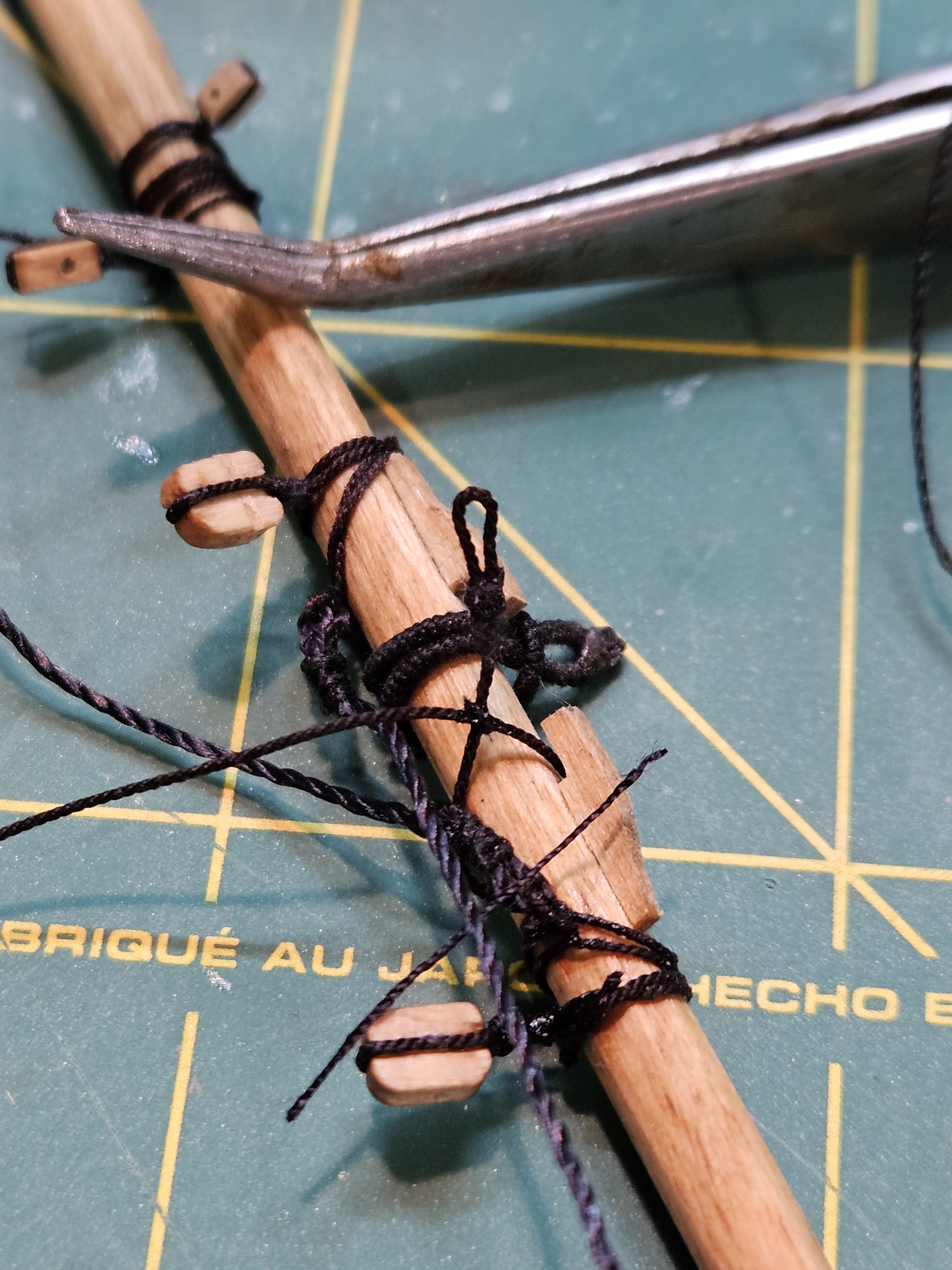

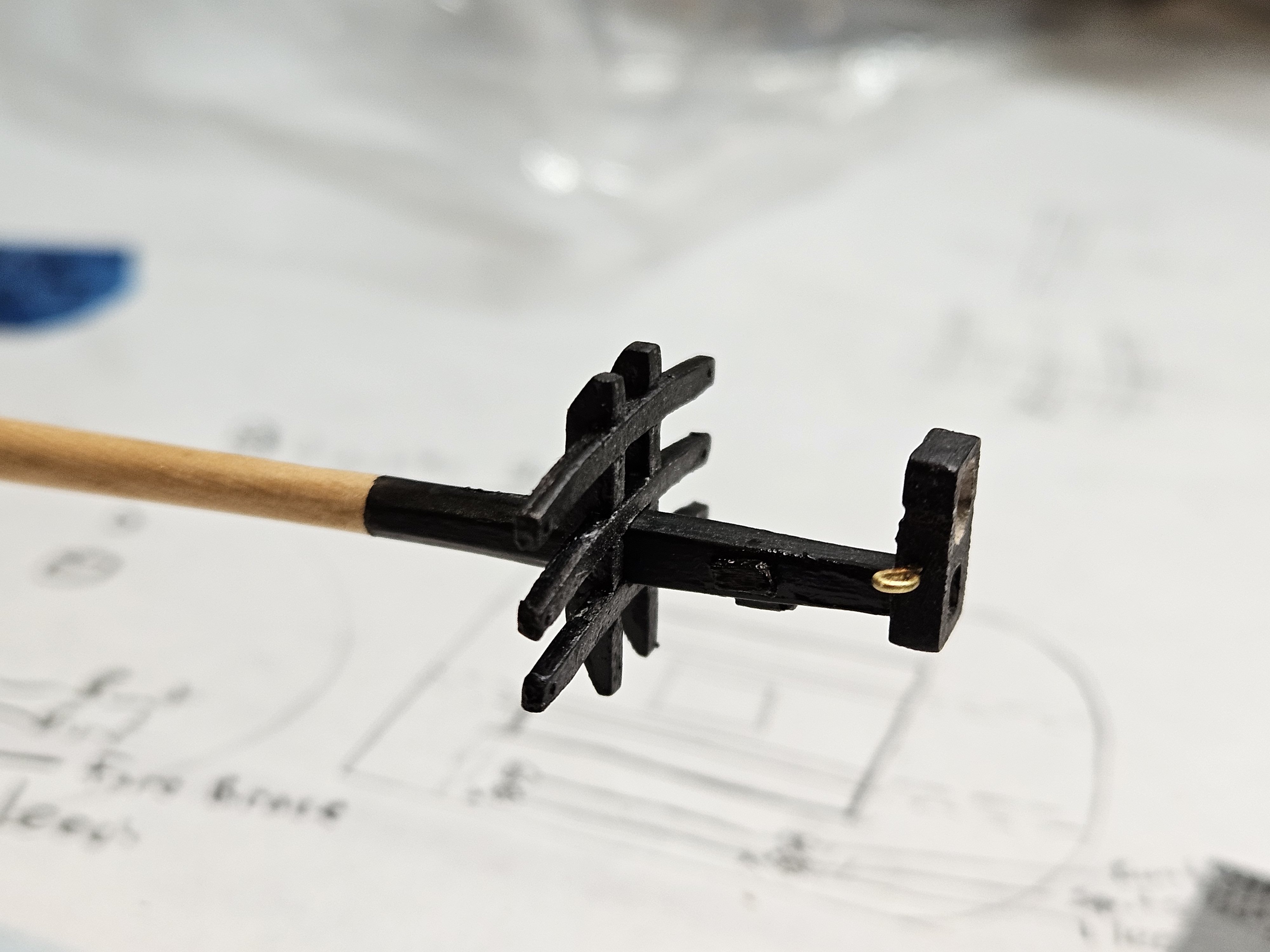

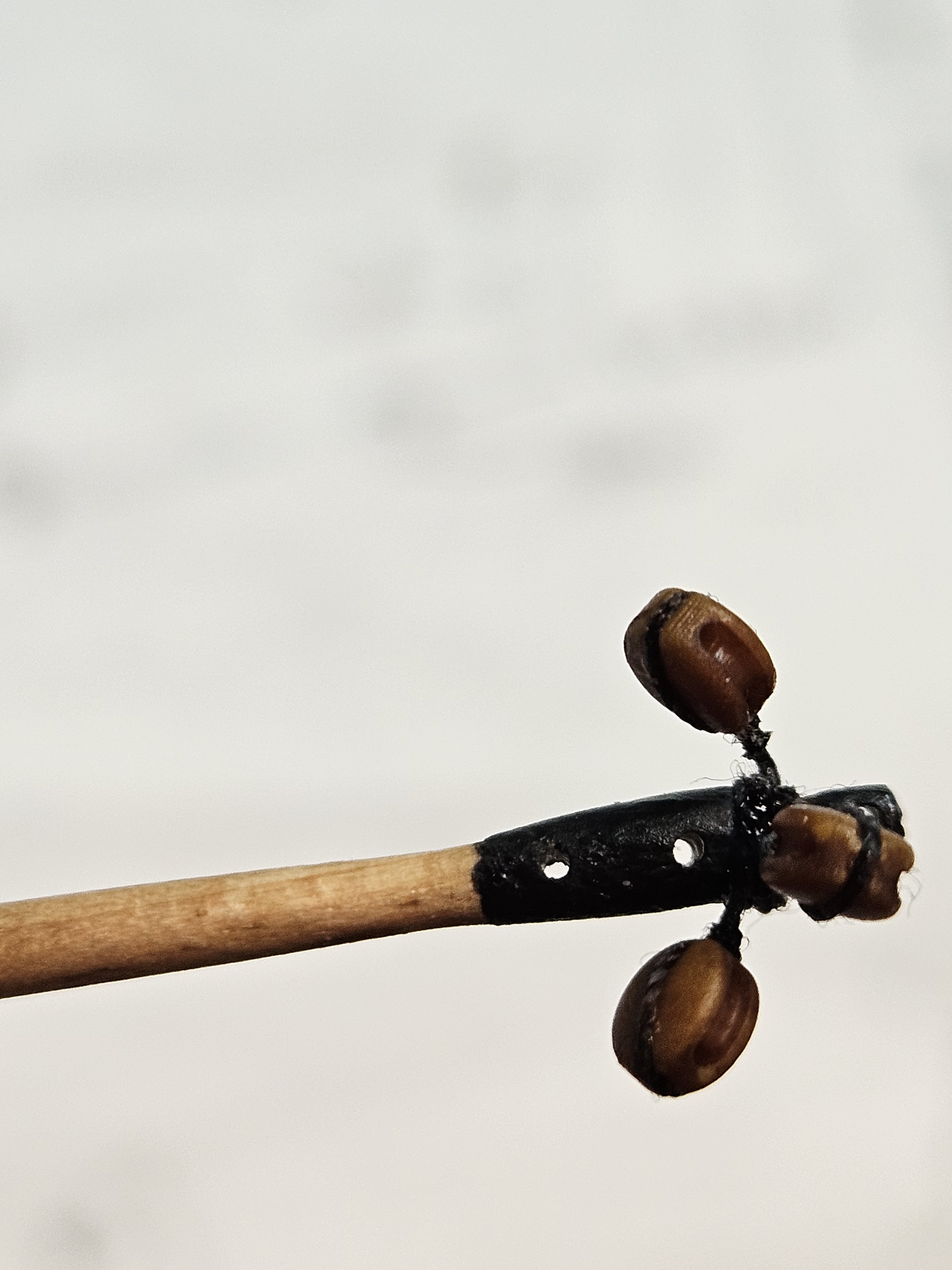

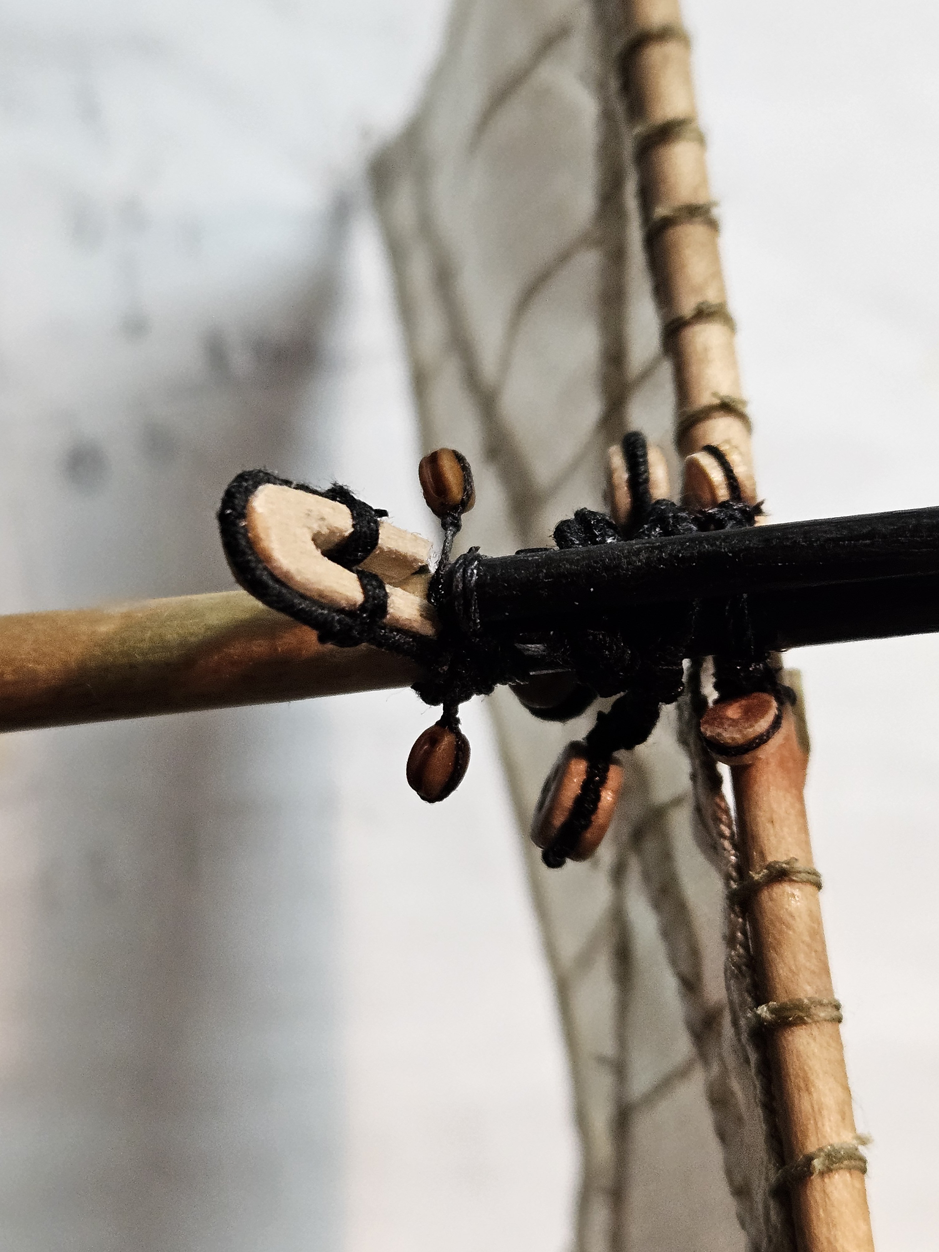

Anyway, I'm starting on rigging the yards, with the Main Lower Yard.  There are 2 buntline cringles on the sail, so I need two blocks each side. these are 3/32" Singles. Looking at the Niagara plans I purchased, these blocks are nearly vertical above the cringles, or at a slight angle, so thats how I arranged them on the mast
Of course once I attached them, they're facing the wrong way. They need to have the block holes going vertically, to allow the rope to pass straight up to the top. This was because I only used a single knot at the top of the block when stropping. I didn't think about that.
So I removed that block and added another knot, making sure the ropes go parallel to the block holes.
Now when I added them to the mast, they're facing the right way. I also had to tie them so they stick forward just a little so the rope can reeve through nicely, while also being aware of the orientation of the foot ropes and cleat side, so it's not backwards.
Here is the finished yard with buntline blocks and then a single leechline block on the outermost end of the yard.

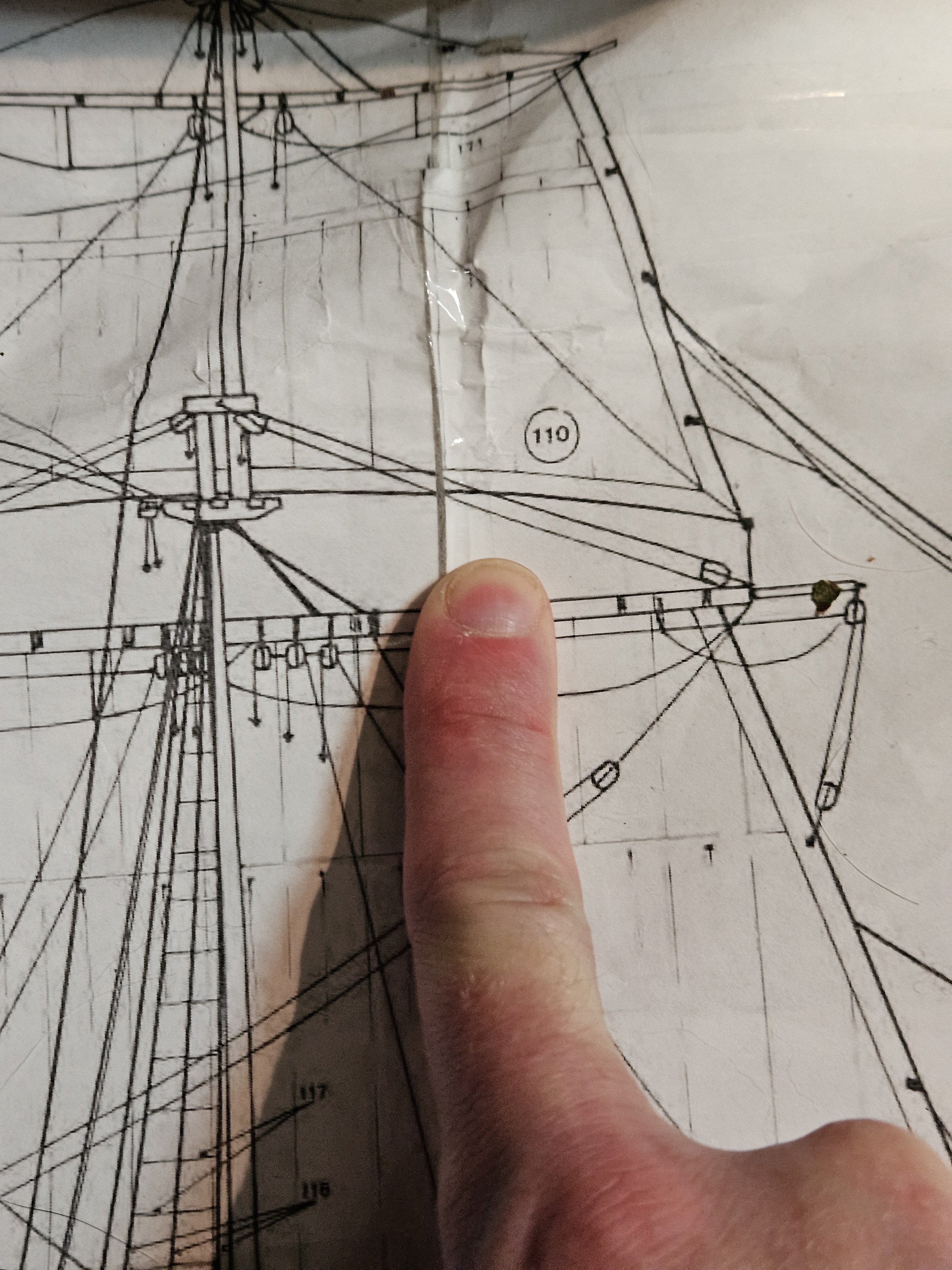

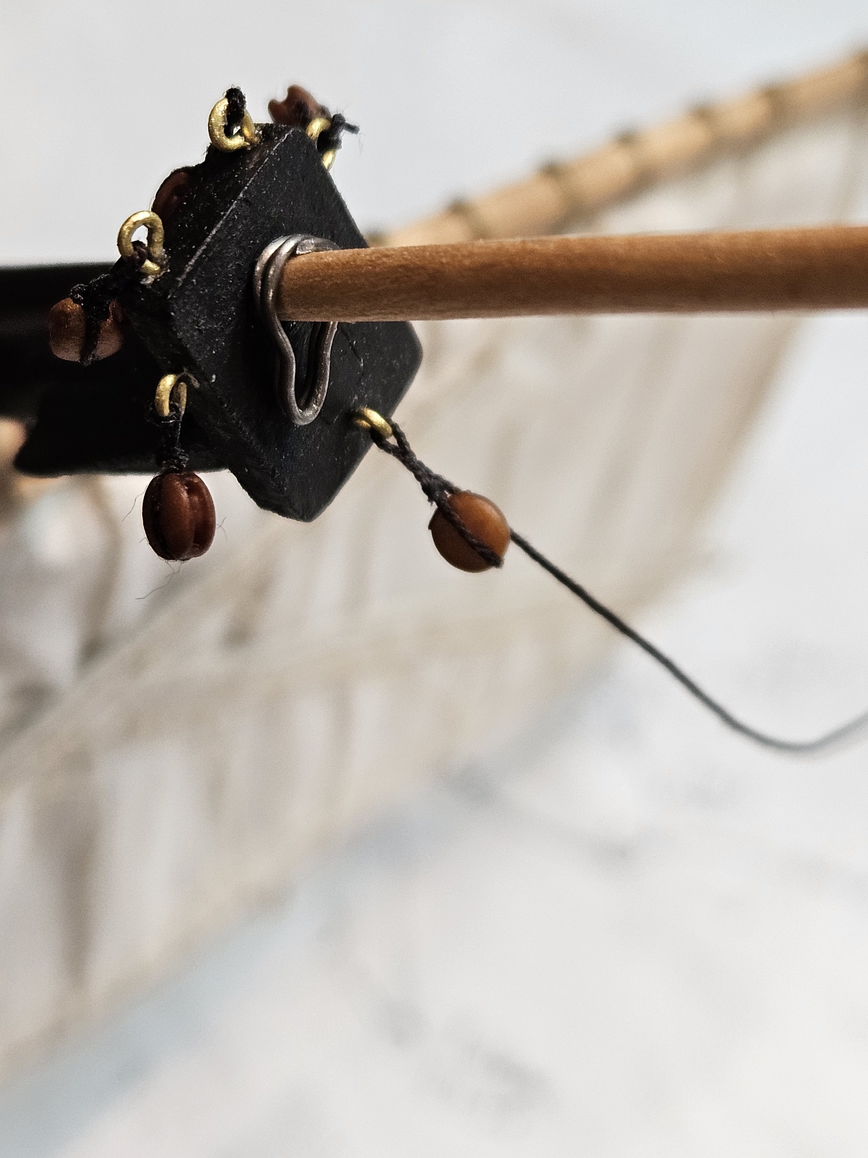

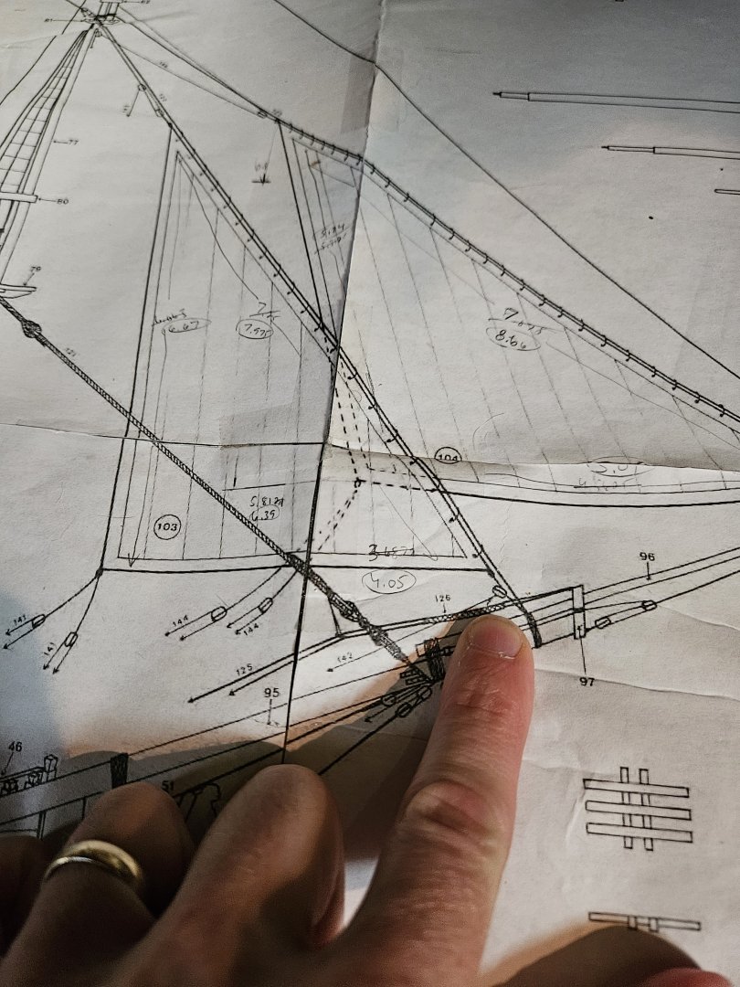

The sheet blocks were next. I used 5/32"blocks for these. The rigging plan doesn't specify sizes of blocks, but I later found an excel sheet that ''someone'' created that I used for a guide of rope size and blocks, shown later....

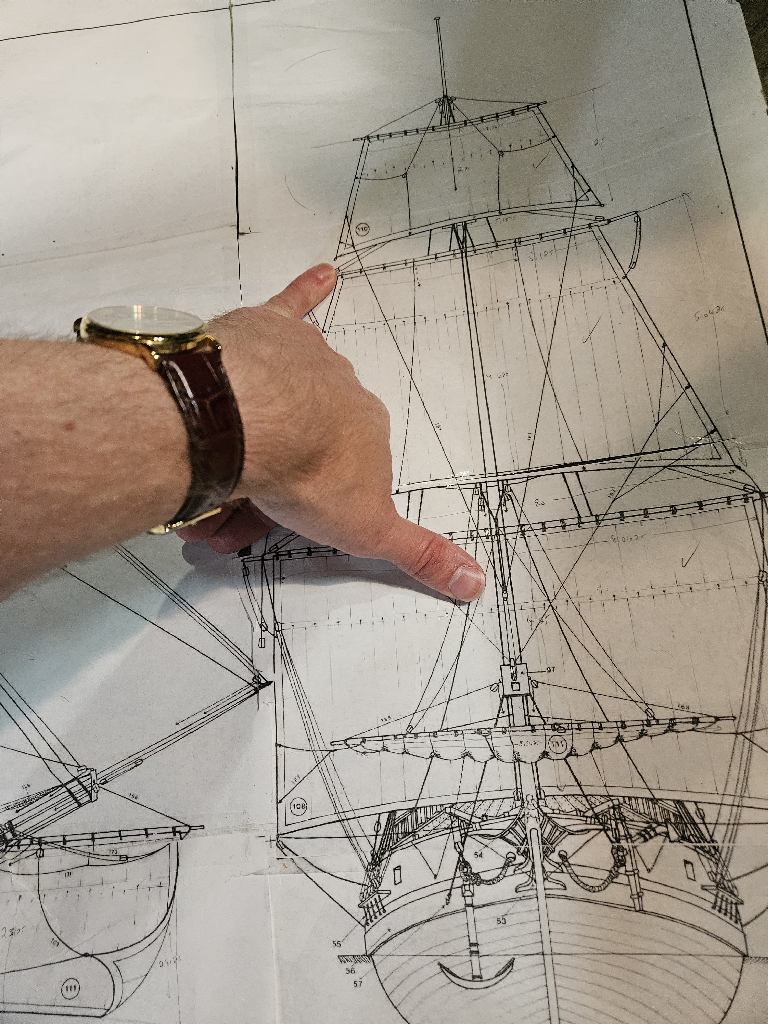

Additionally, during my research and learning about model ships, I saved this snippet about general rigging. It shows some basic blocks and locations on the yard.
On the Niagara plans, the Clueline block is on the Inside of the yard, and the sheet is outside of that. In other ships, I've seen it the other way, where the sheet block (the bigger block, is the one closest to the center of the block. For mine, I tied it off outside the cleat, where the foot rope ties in.
The sheet was 5/32" and the clueline block was 1/8" single block. Tied and glued in place.

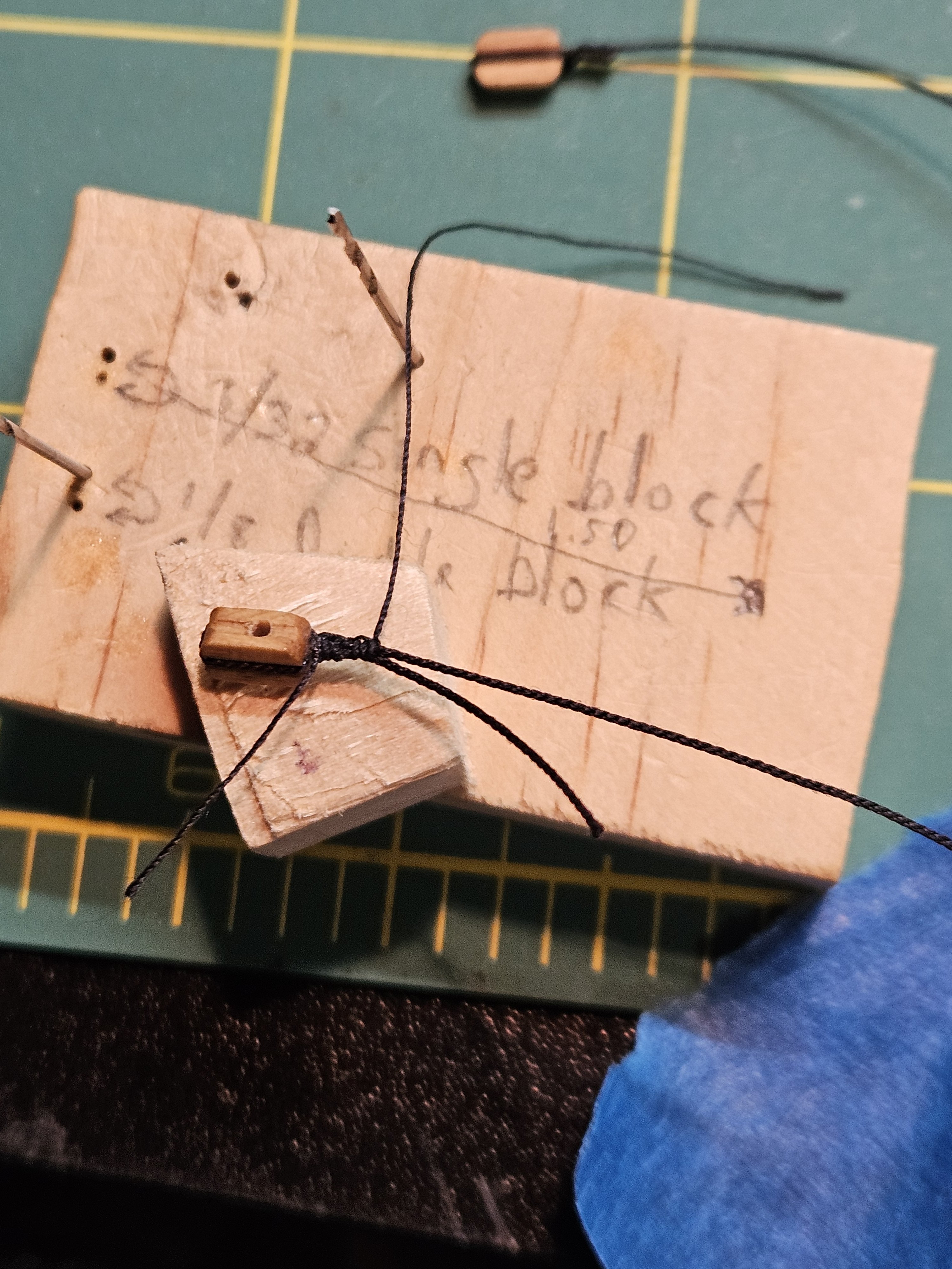

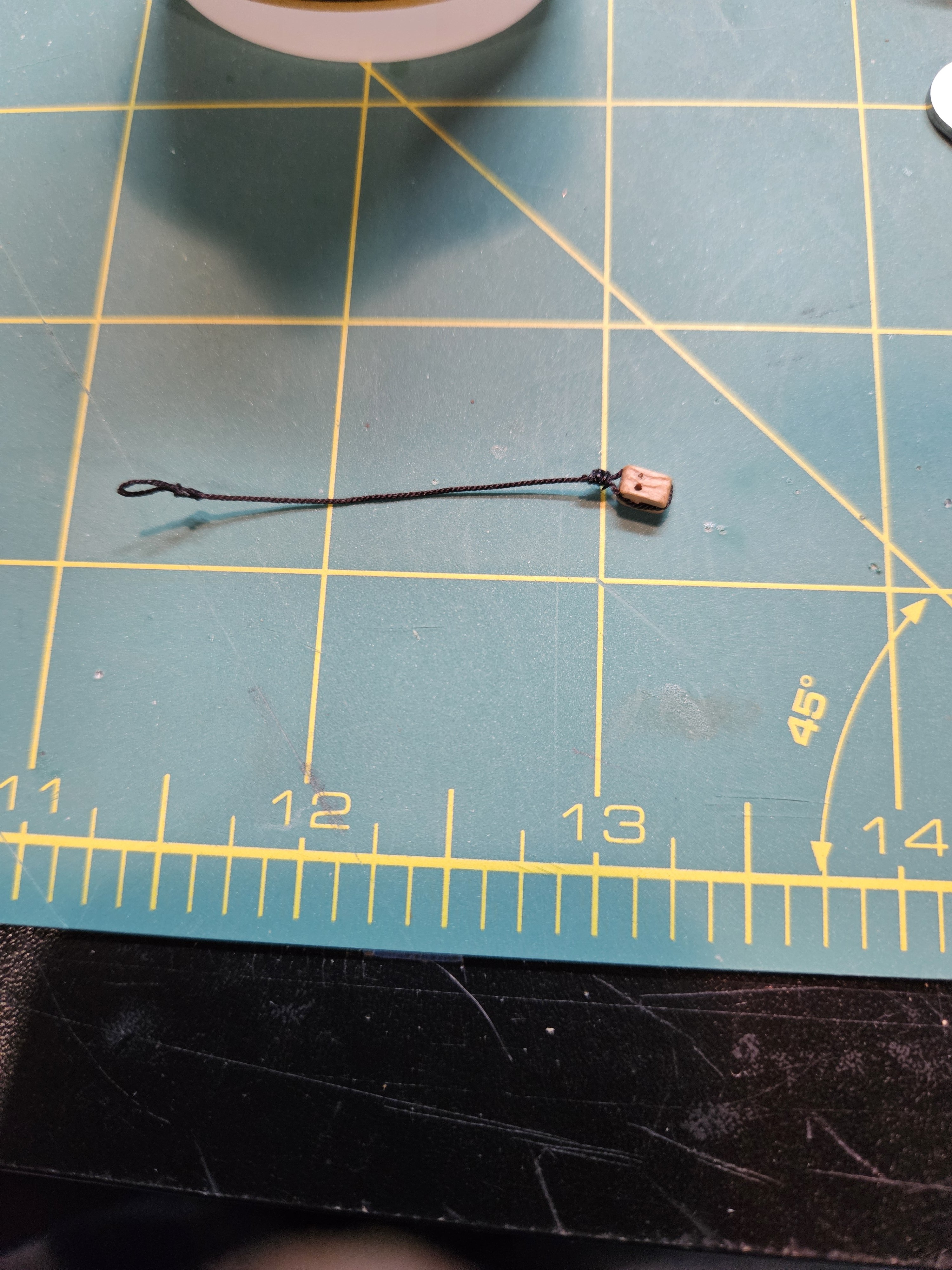

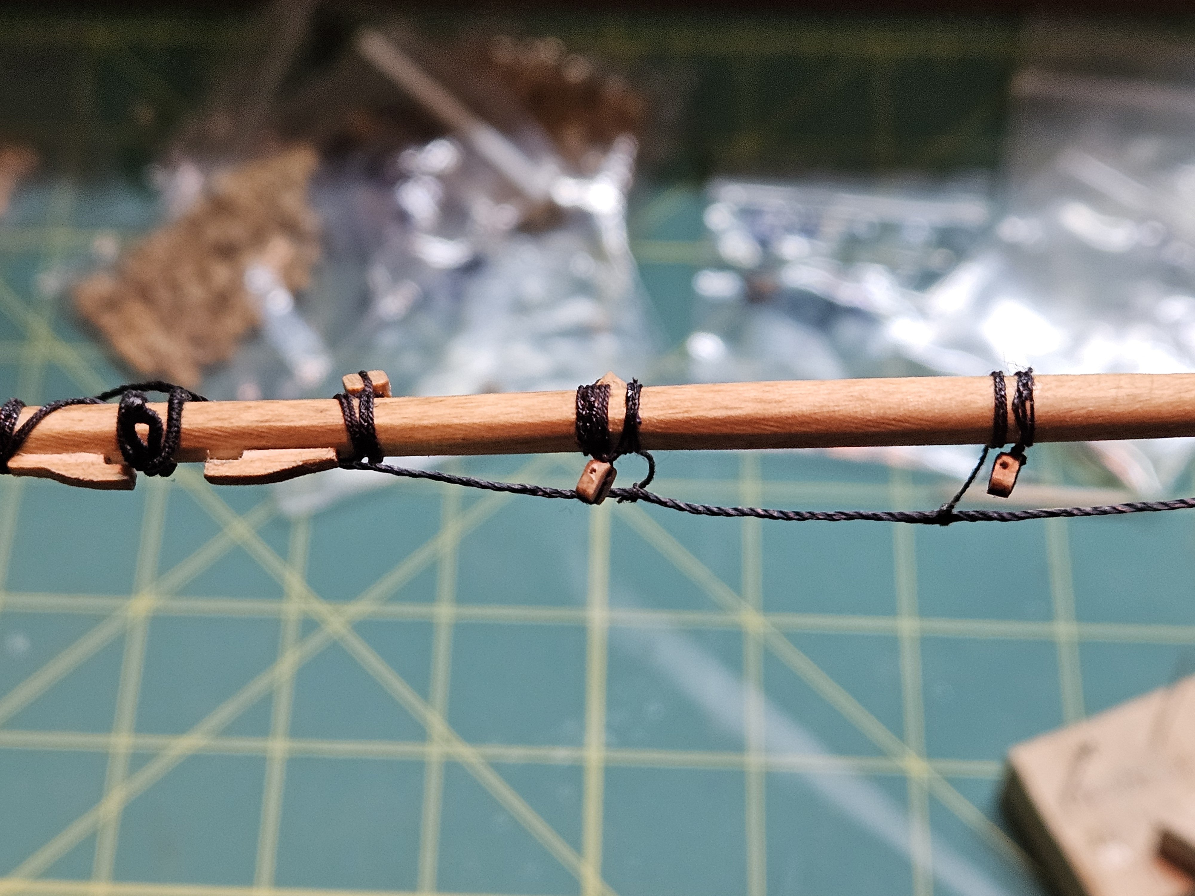

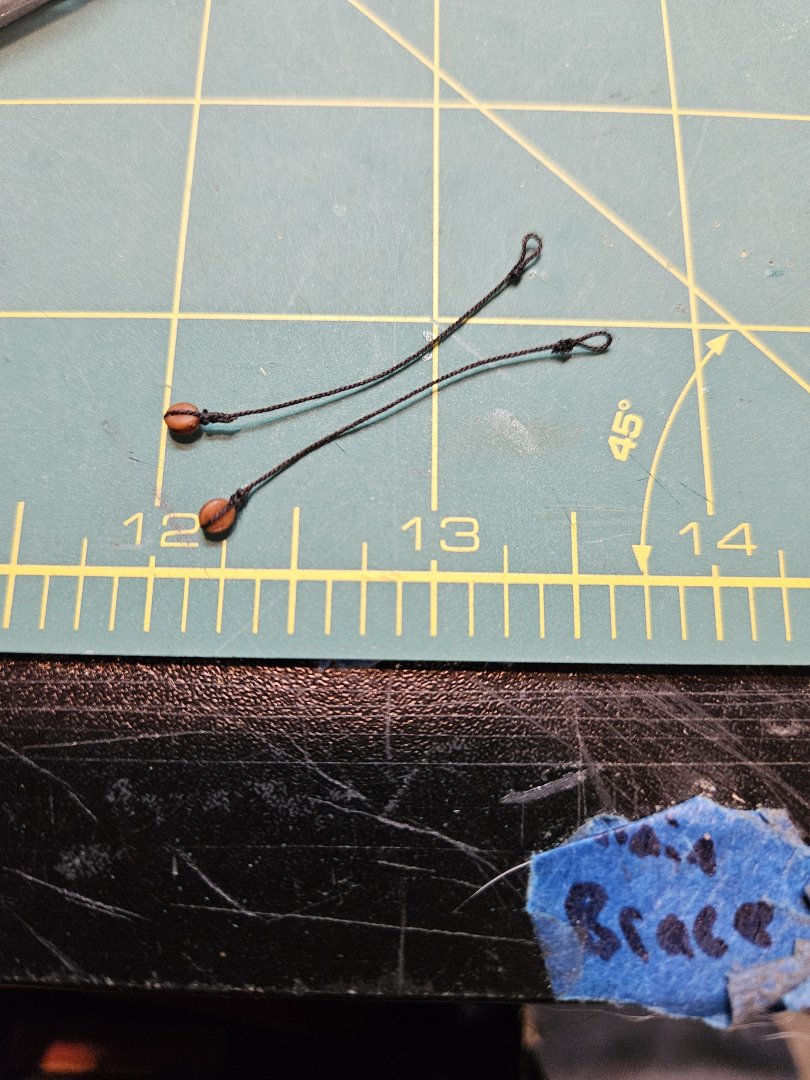

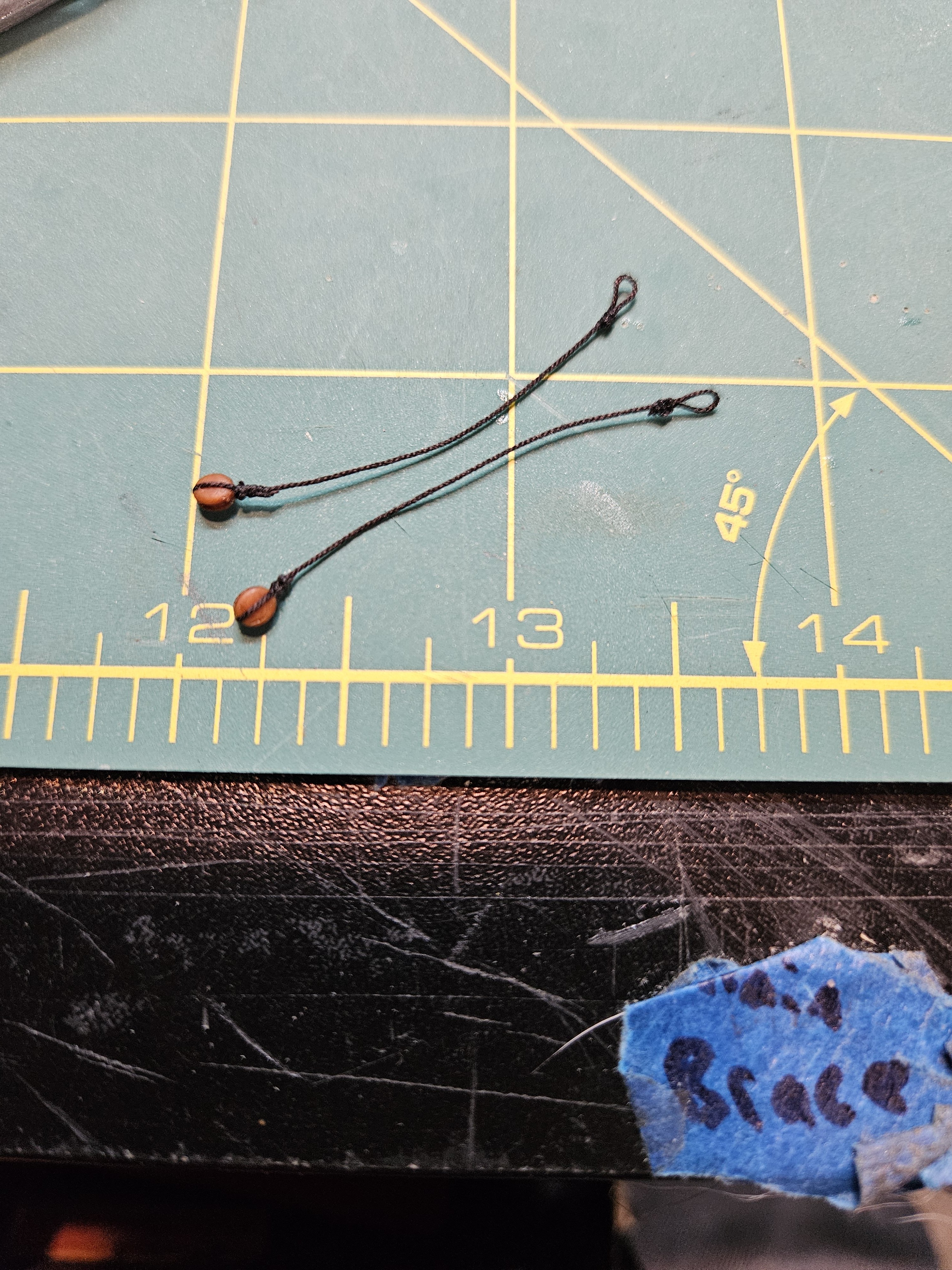

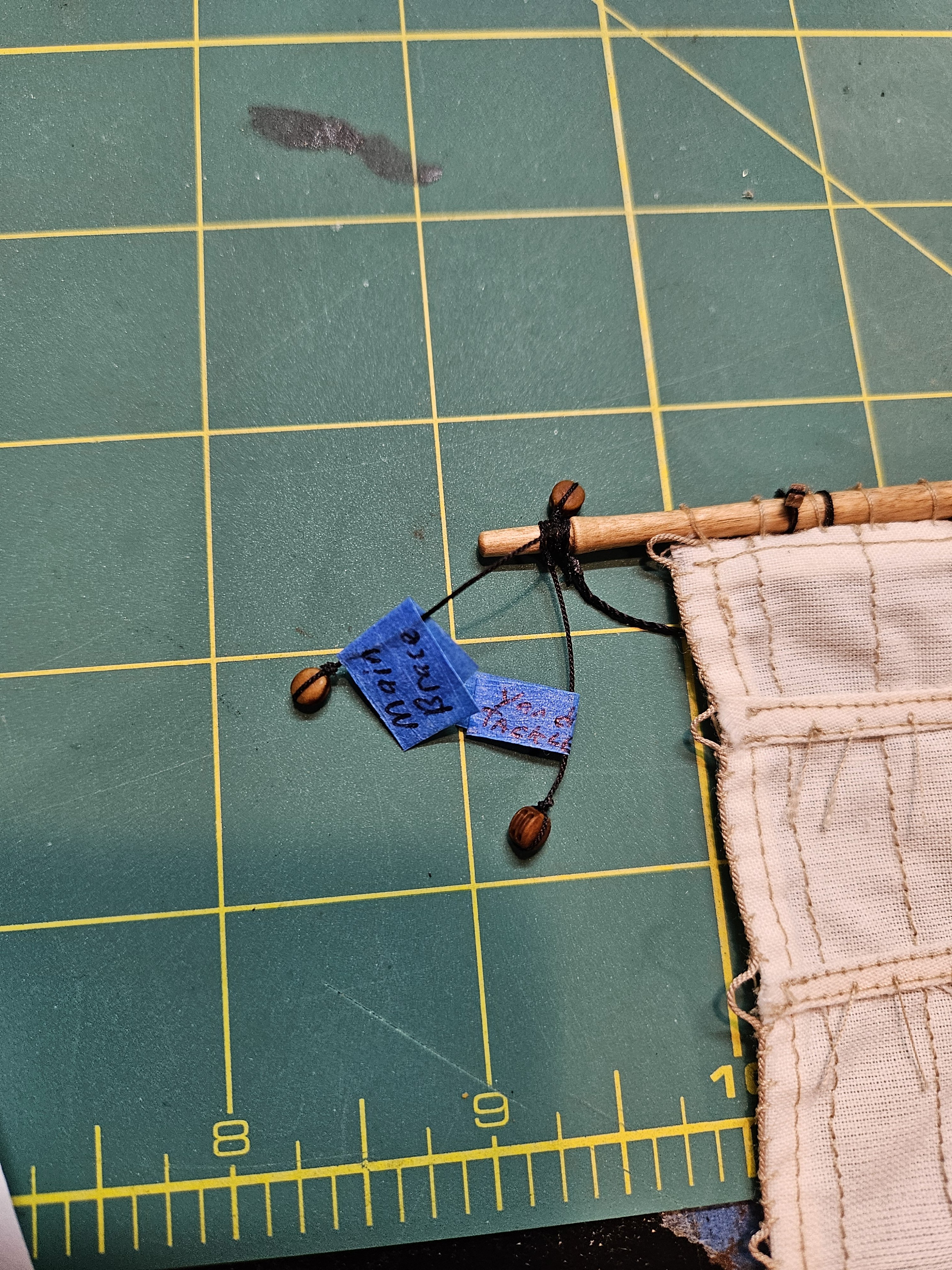

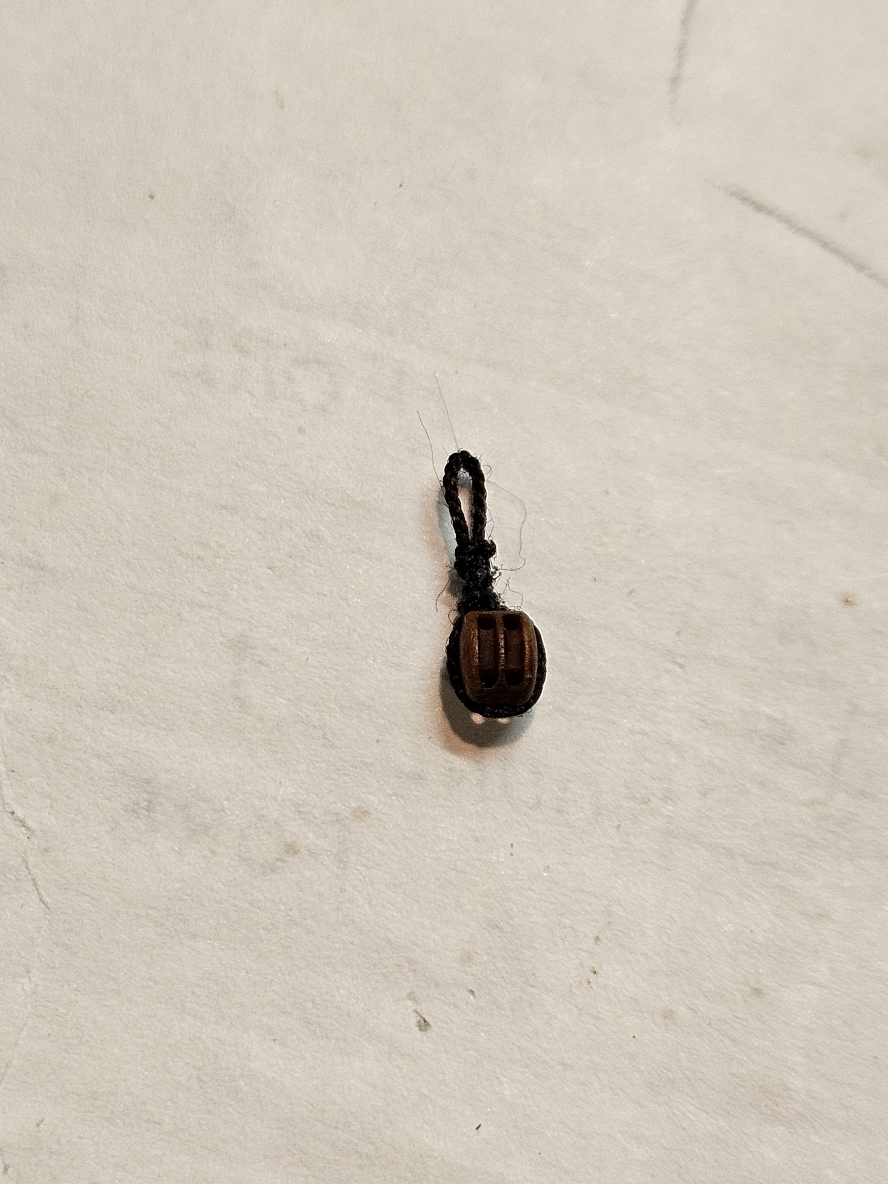

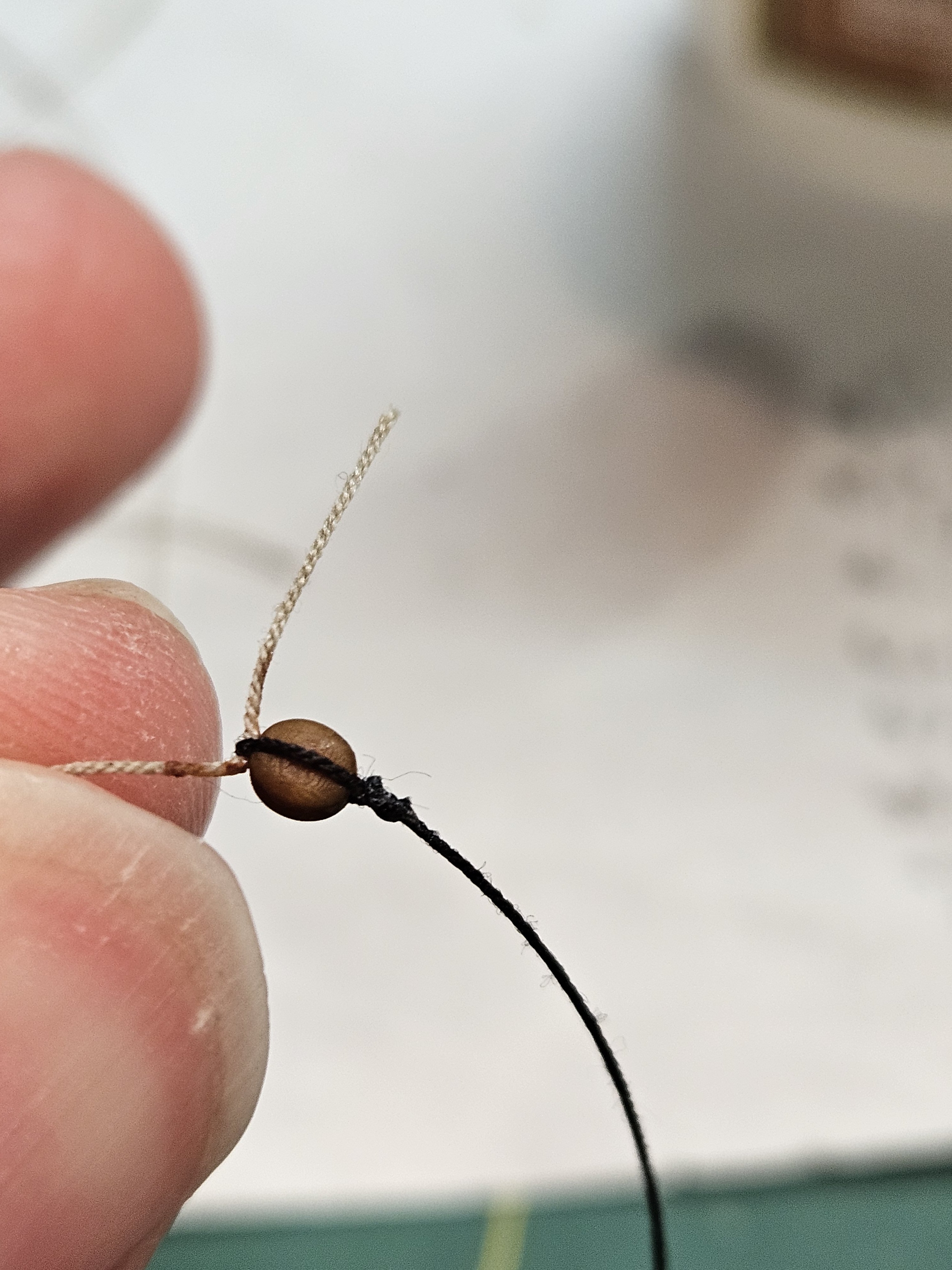

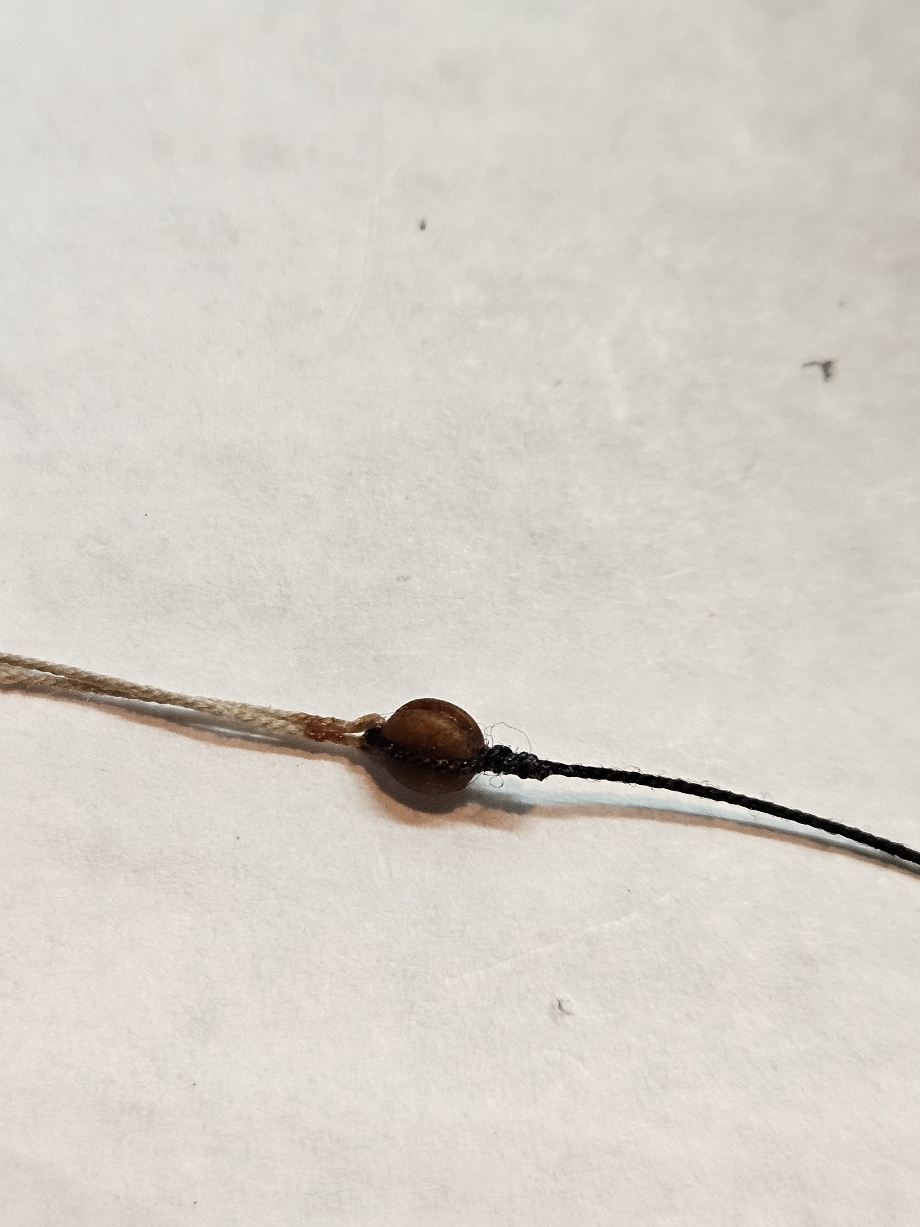

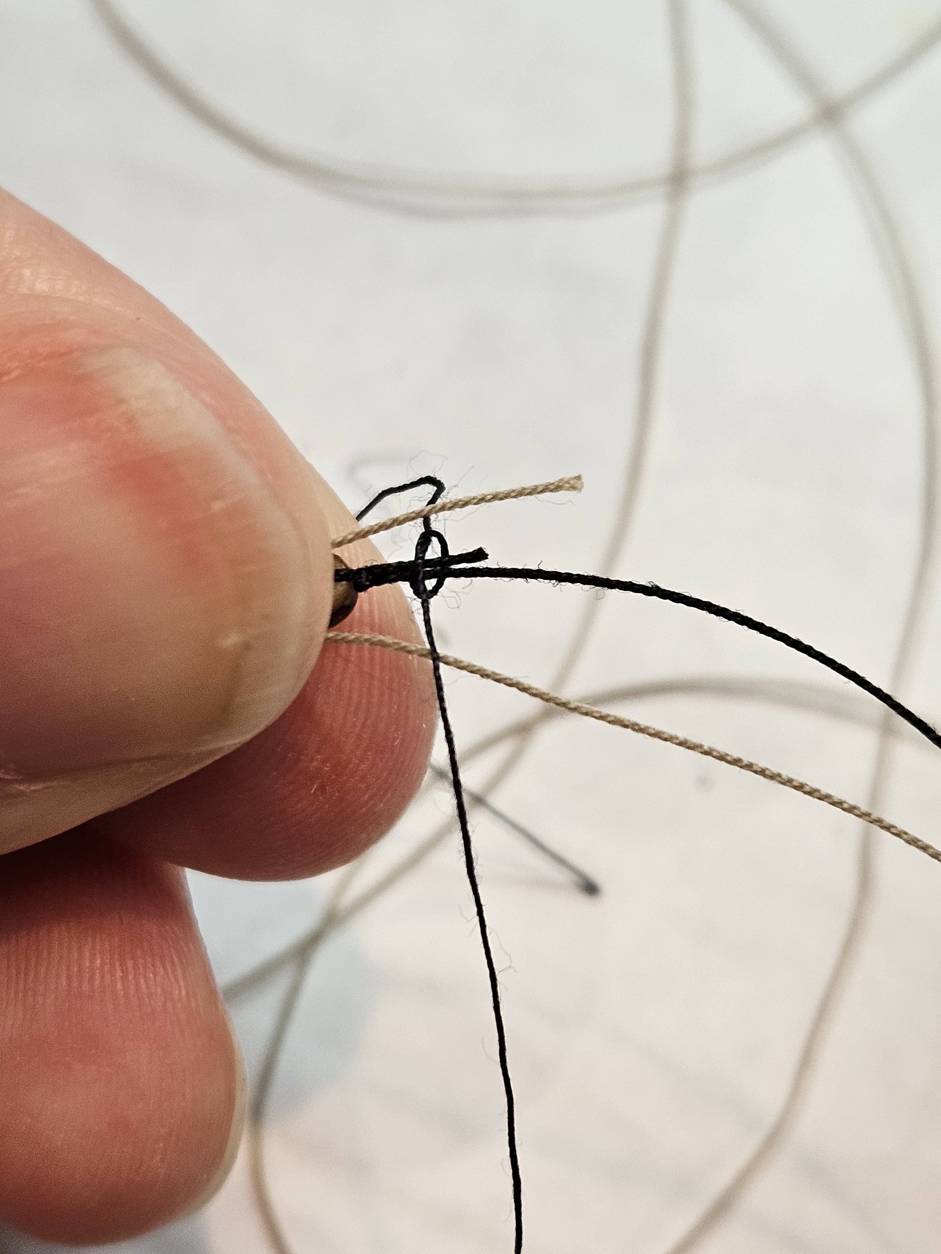

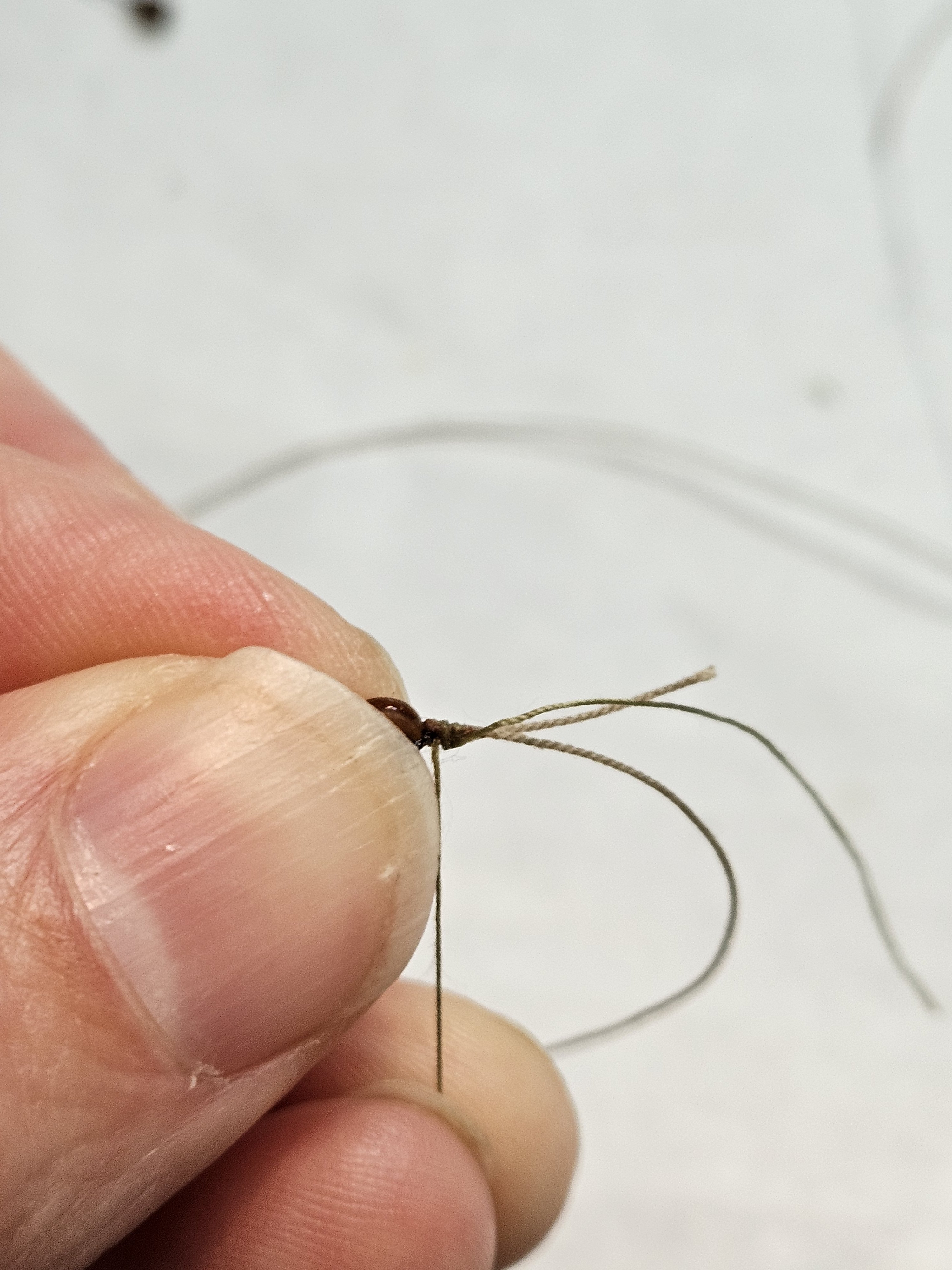

The braces were next. How I strop the blocks is, again, fairly simple. I'll take the rope starting at the bottom, over hand knot it on the top...
Then add some CA glue to secure it.

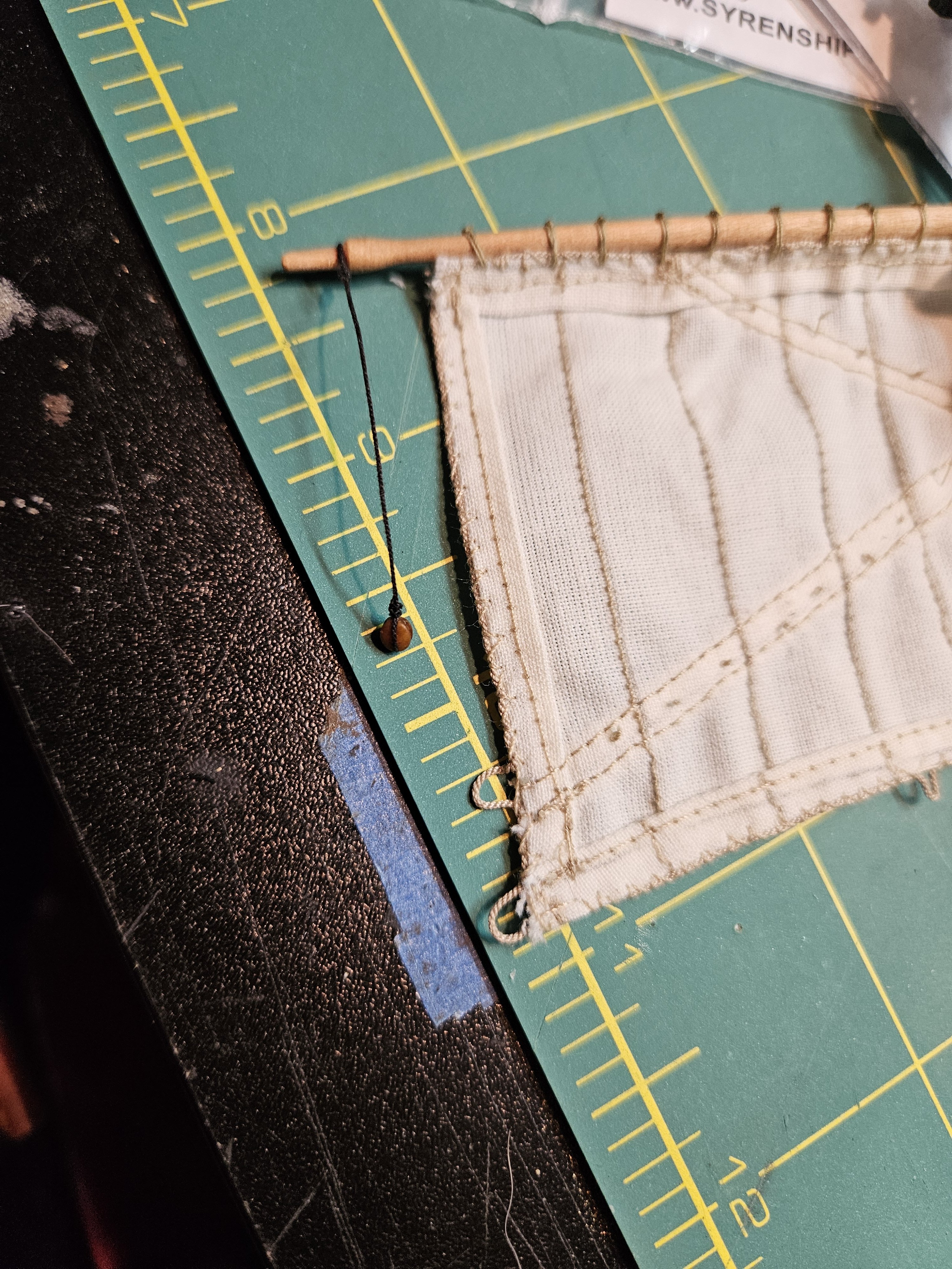

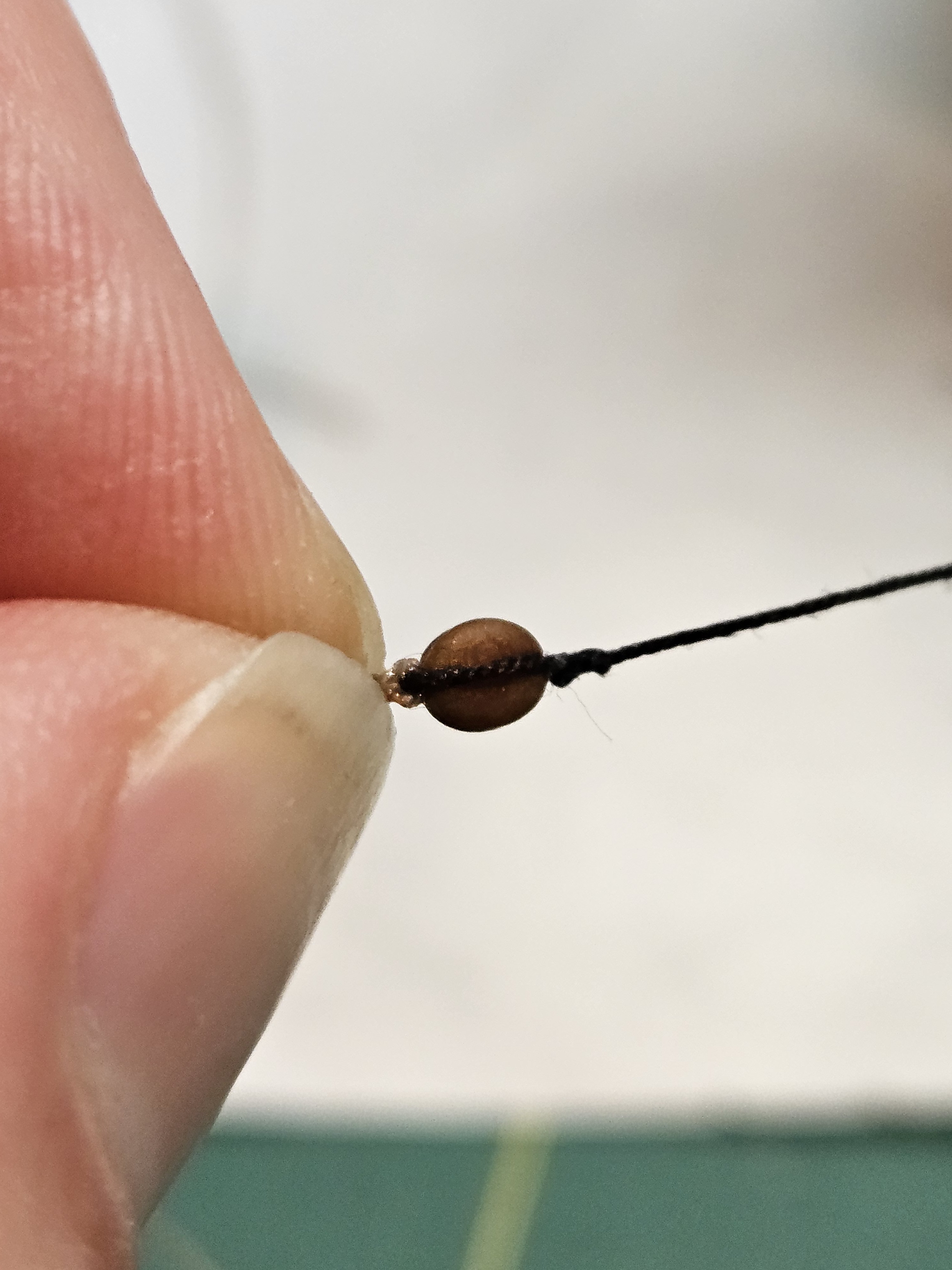

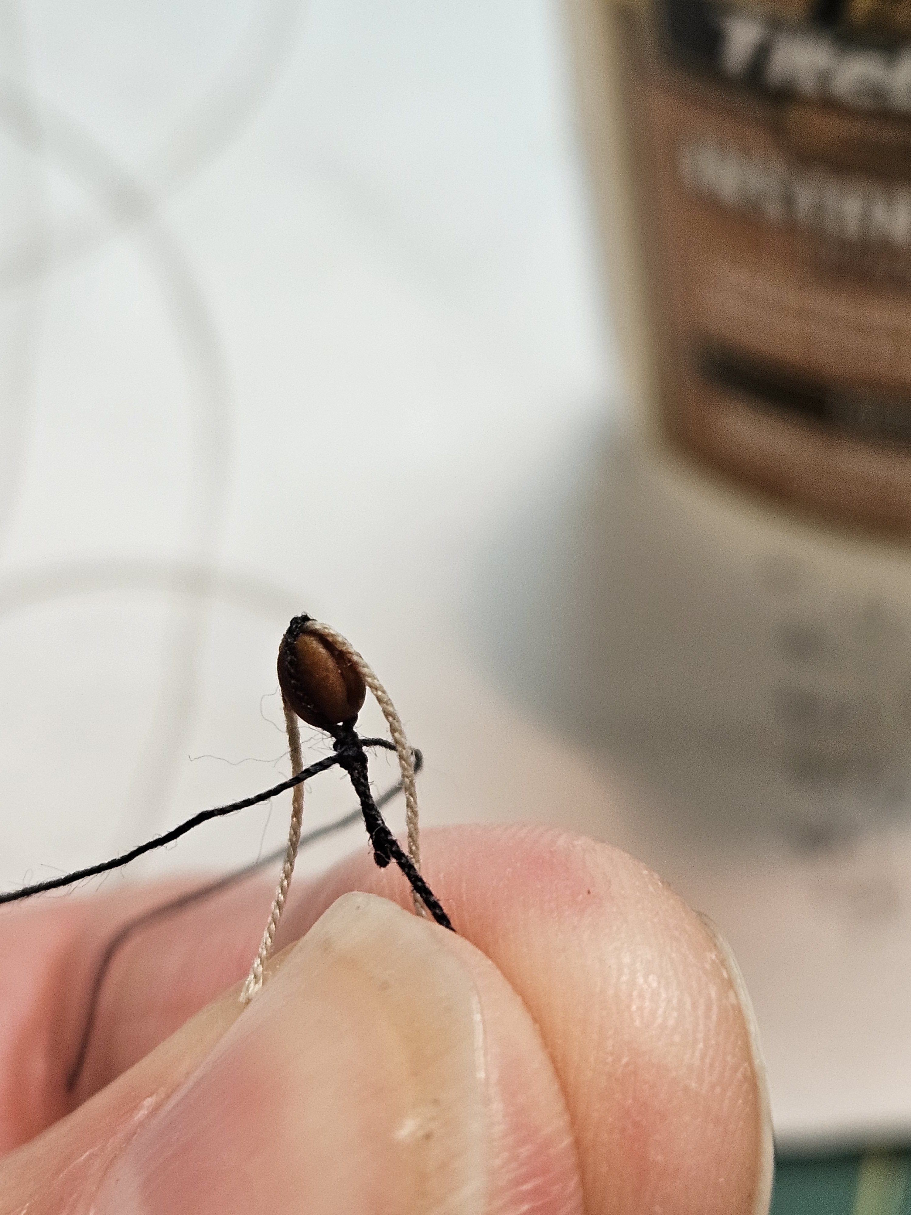

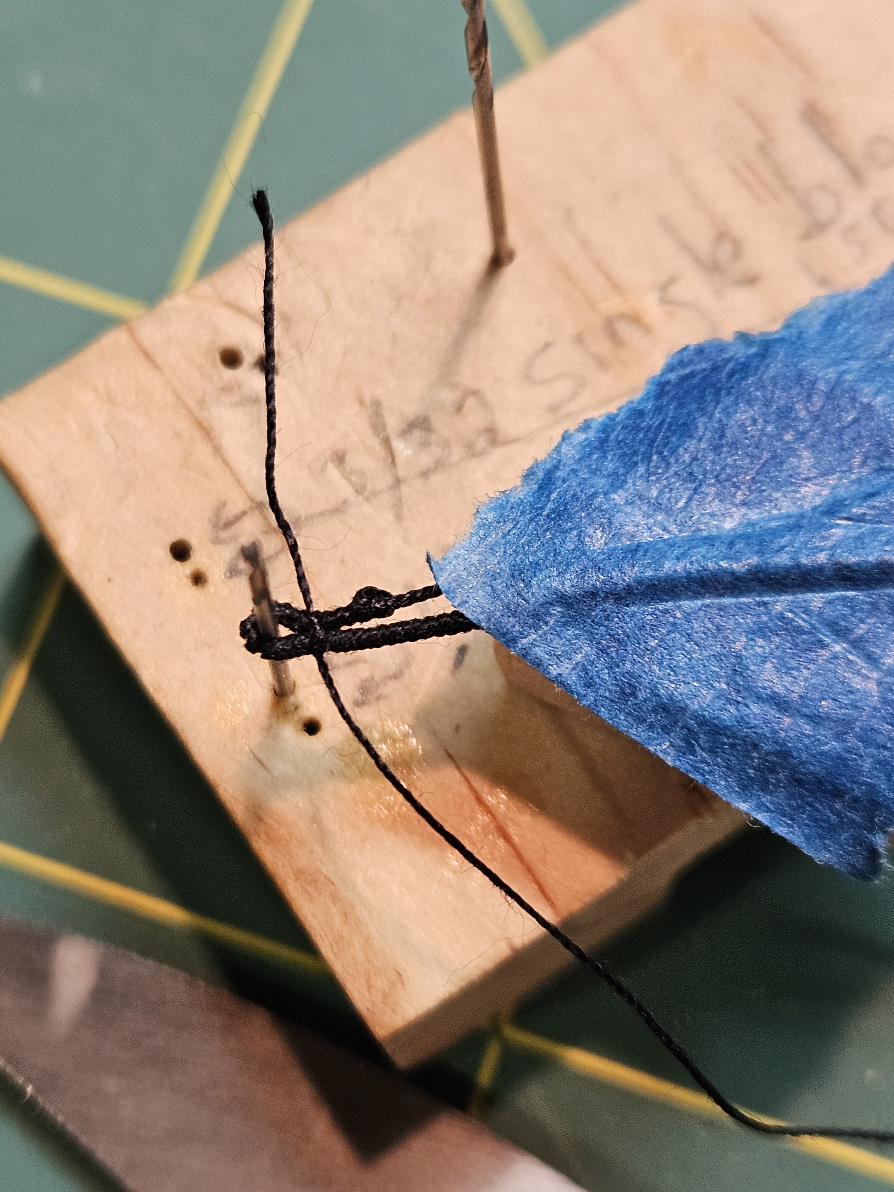

I'd put the trimmed/stropped block into a little jig with .031" drill bit, and hold the two ends with tape. Then pinch and CA glue them close to the block and let it dry.
Then I can take small black sewing thread and make a neat little seizing. I have to knot the first loop and glue, make a couple more loops, then knot the last one and glue. After which, I'll trim all the loose ends up. I'm pretty happy with the look.
That's one!!!

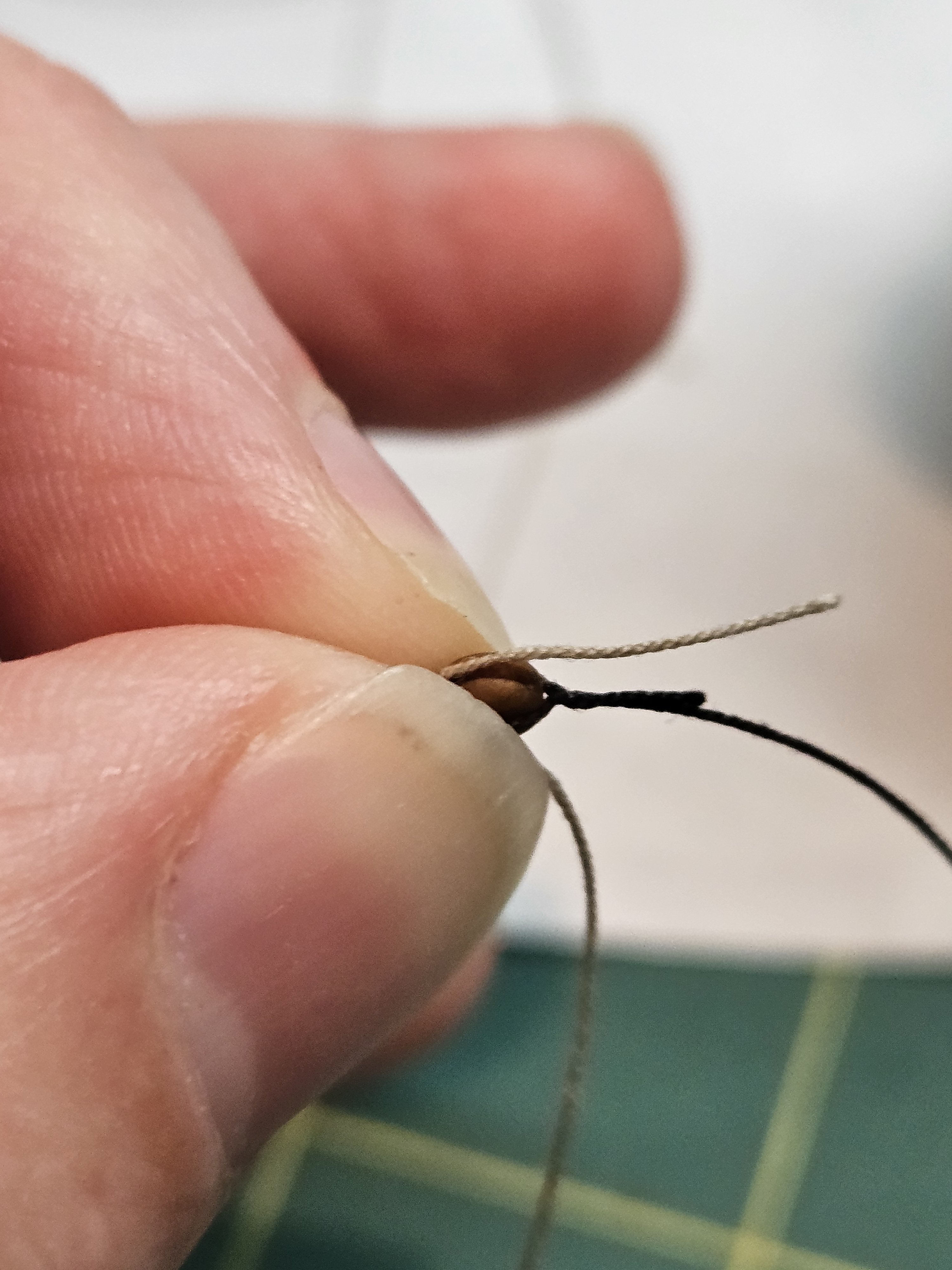

I'll look at the plans for the lengths of the braces and try to make a loop to that size.
This is trickier. I had to sort of guess the diameter of the loop before I knotted it, so that it will fit over the end of the yard and not be too tight or loose.
But I made it work on my little jig. The reverse action tweezers were handy with adding some small amount of tension before I glued things.
2 braces done....
The first time I added them and glued them to the yard, they were facing the wrong way!!! Luckily I noticed/remembered the orientation of the main yard - according to the rigging plans these ropes are braced on the Foremast, so they need to go forward.

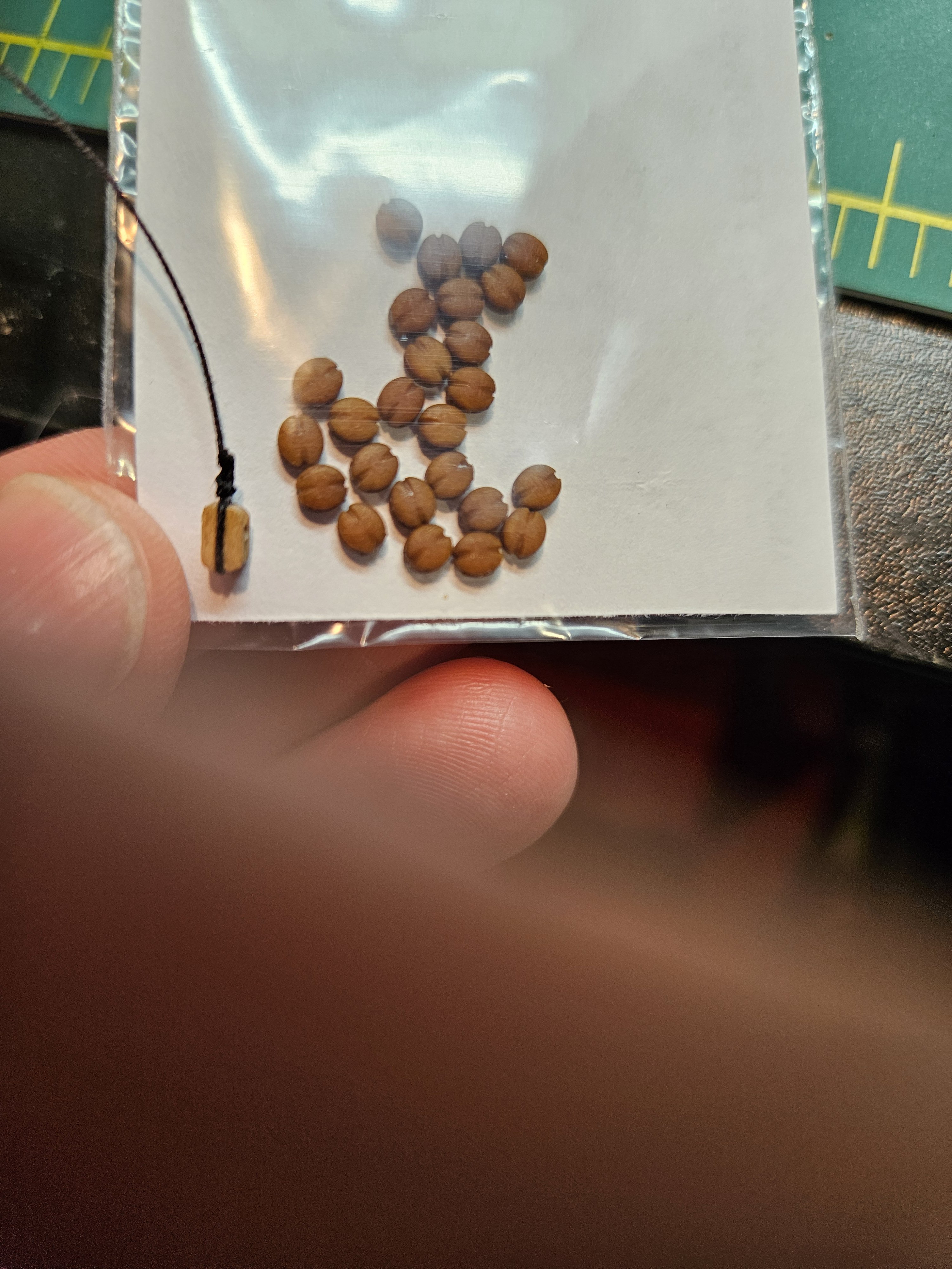

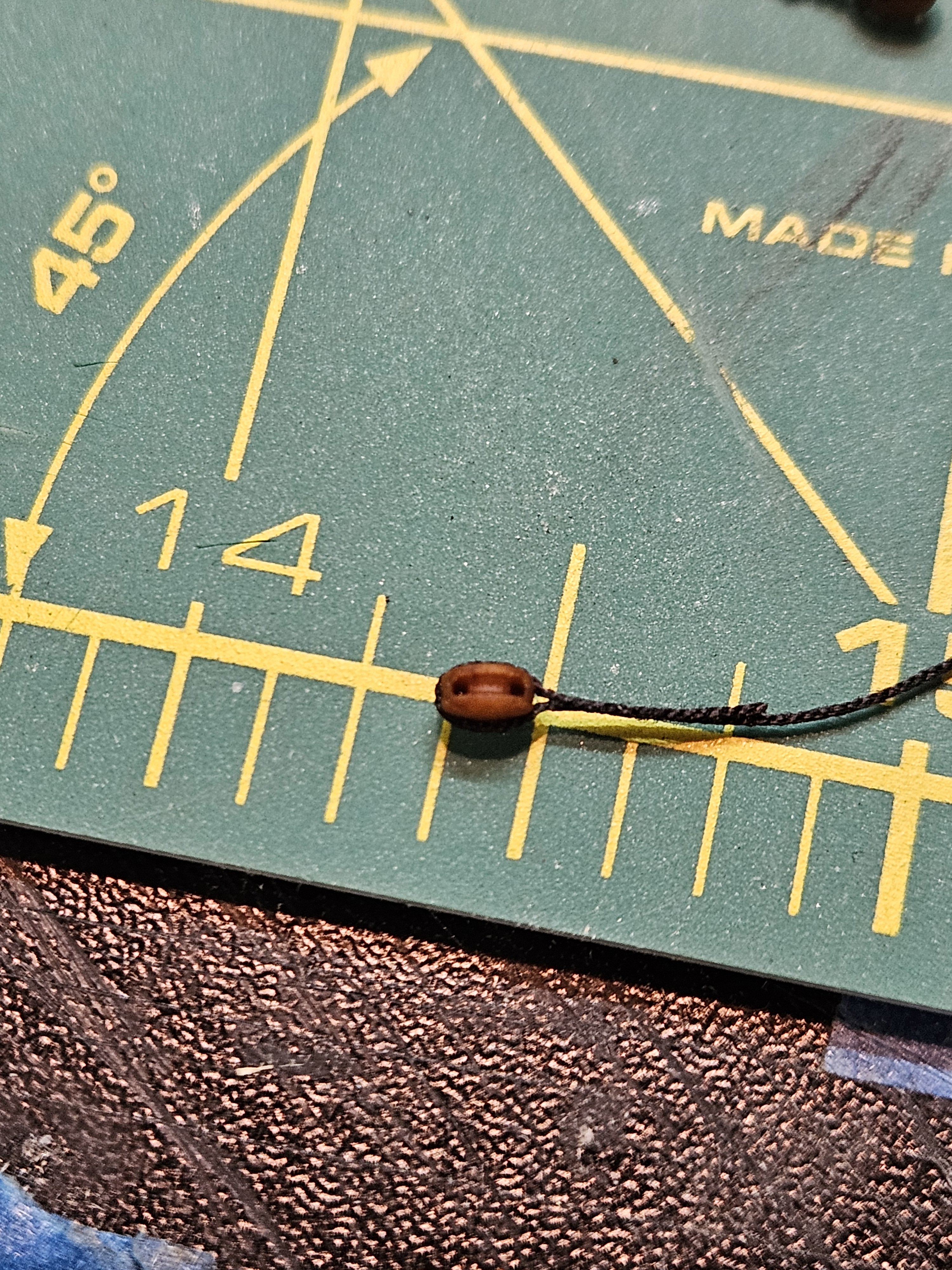

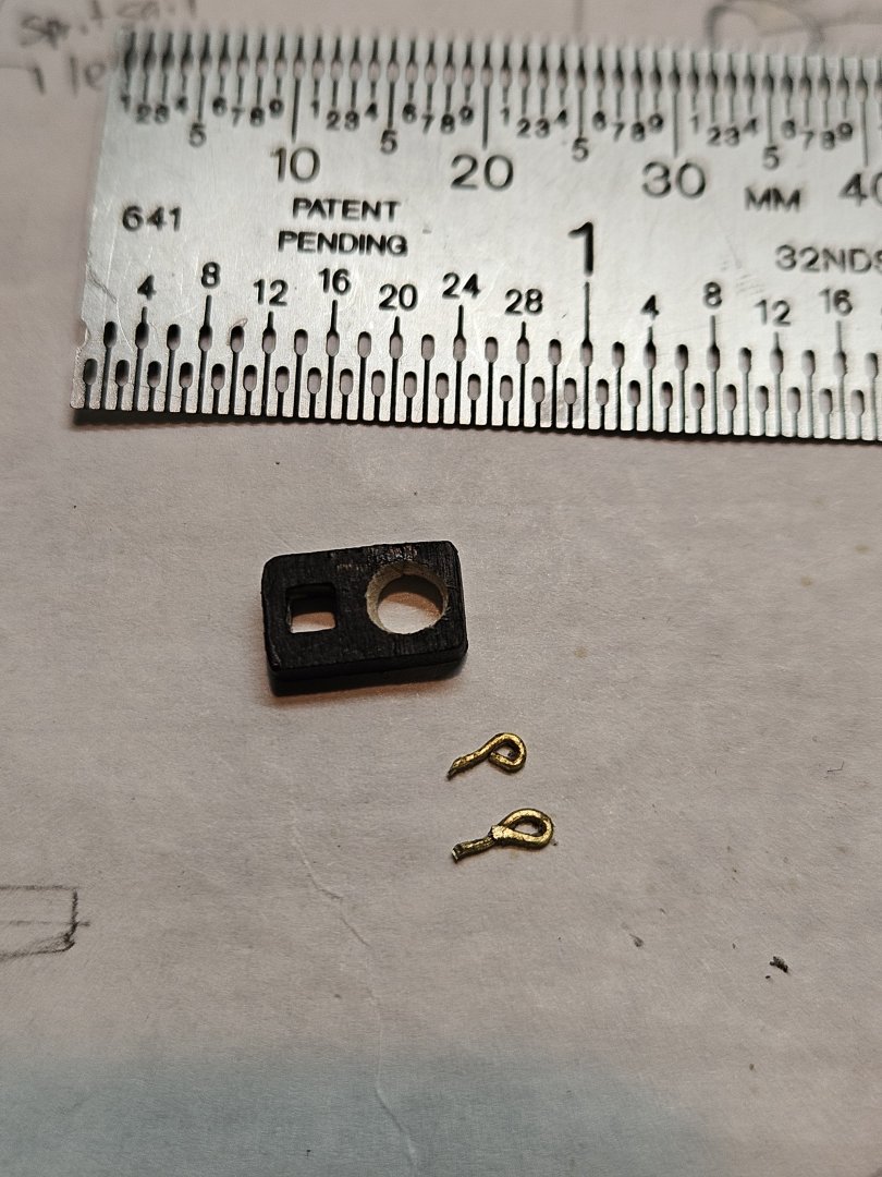

Slow, steady headway on the Fair American Model ship:

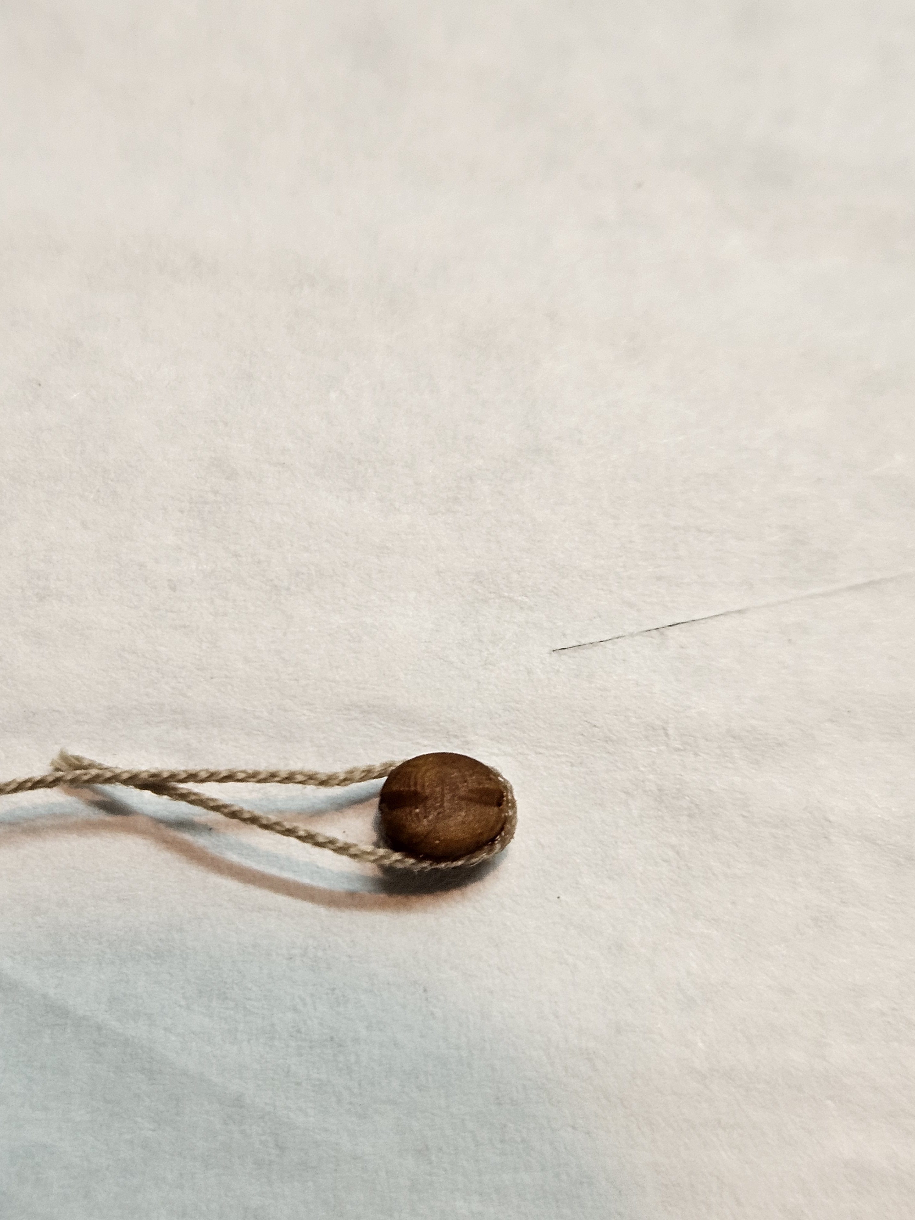

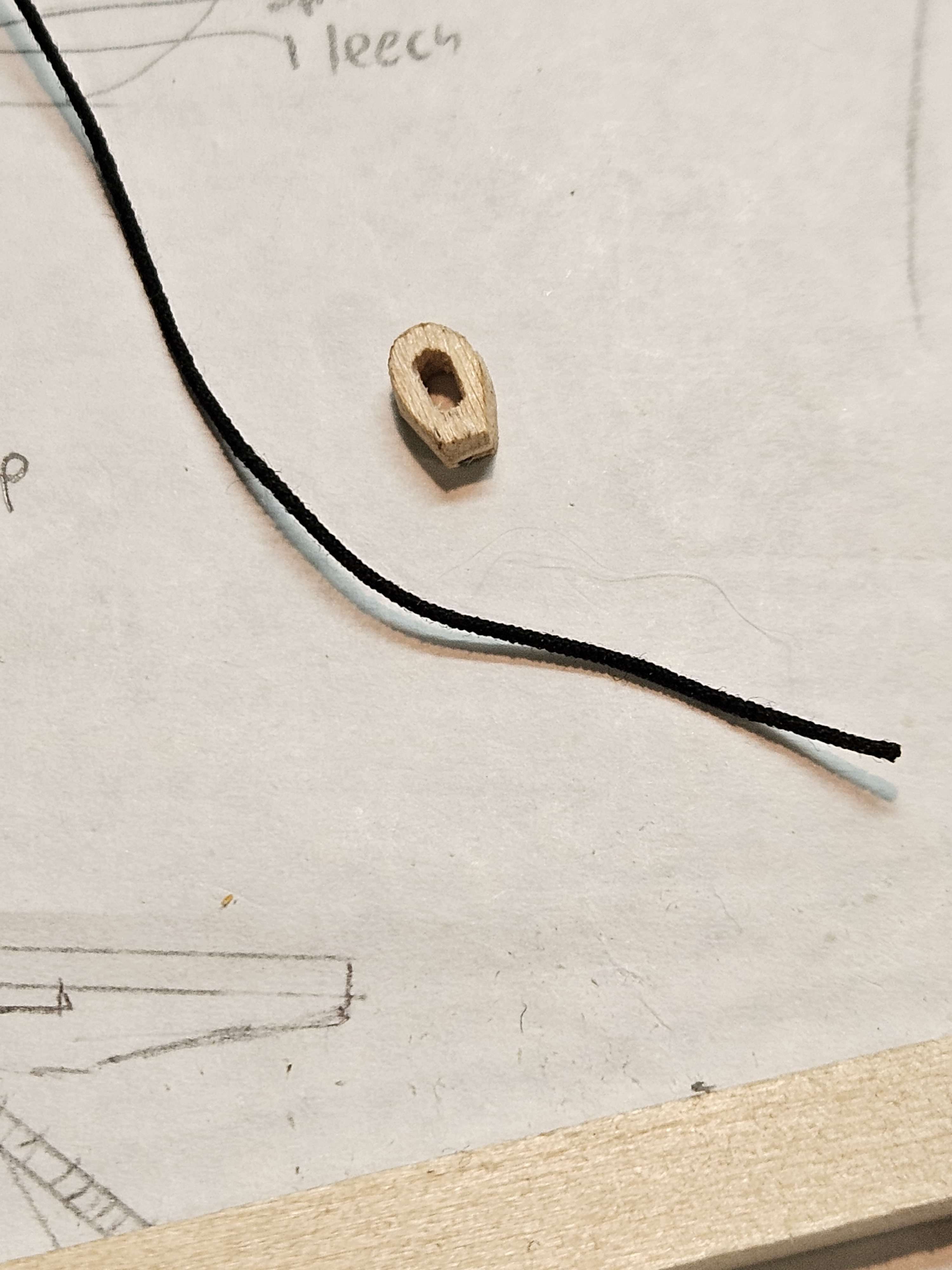

One thing I've noticed is that I don't have enough blocks, primarily singles for all the sails, sheets, bunts, leeches, etc. I had a bag of 100 of 1/8" and 3/32", but they were doubles. I could order more from Model-Expo, but they've taken a while to deliver in the past, so I'm opting to make my own.

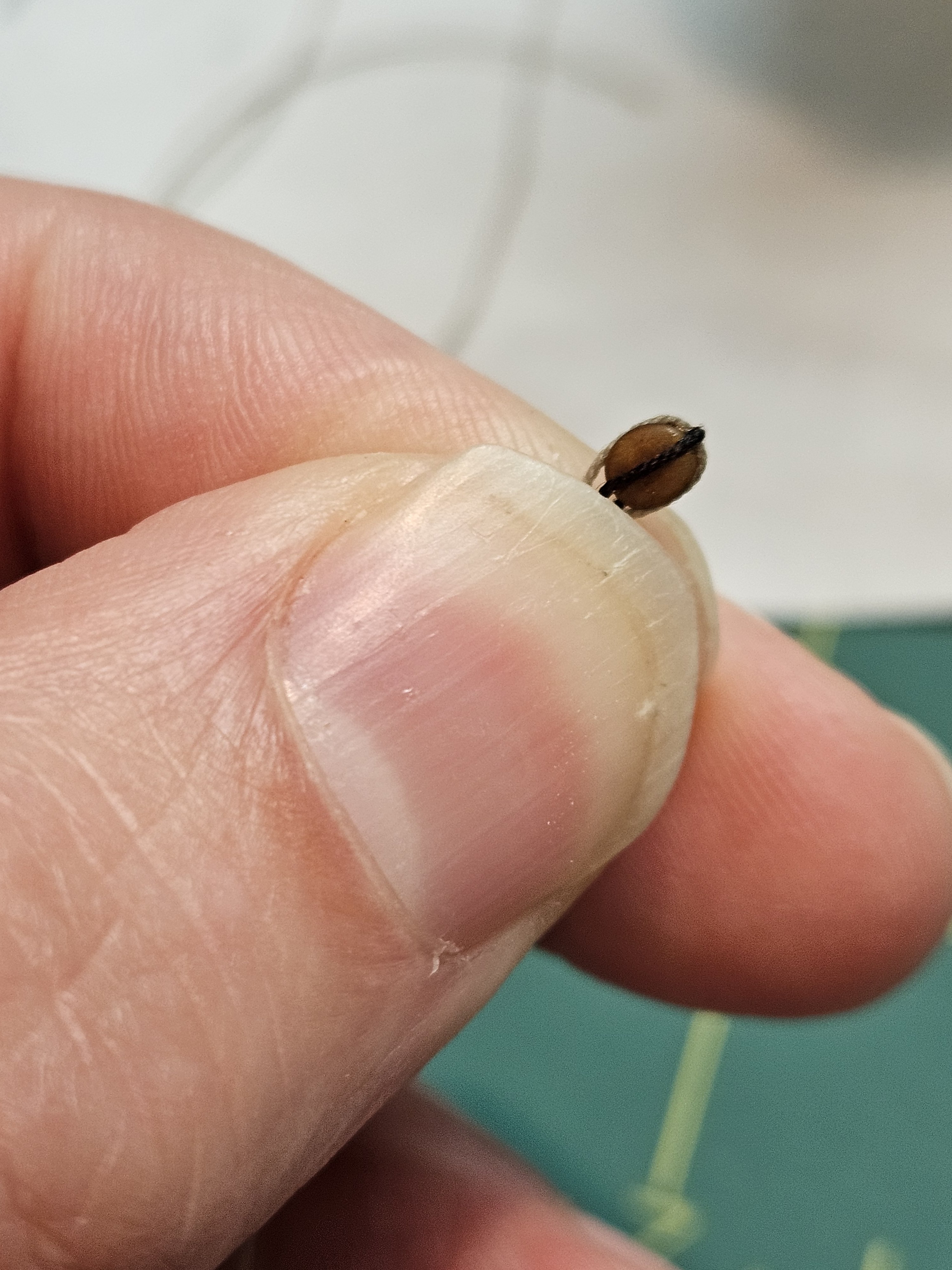

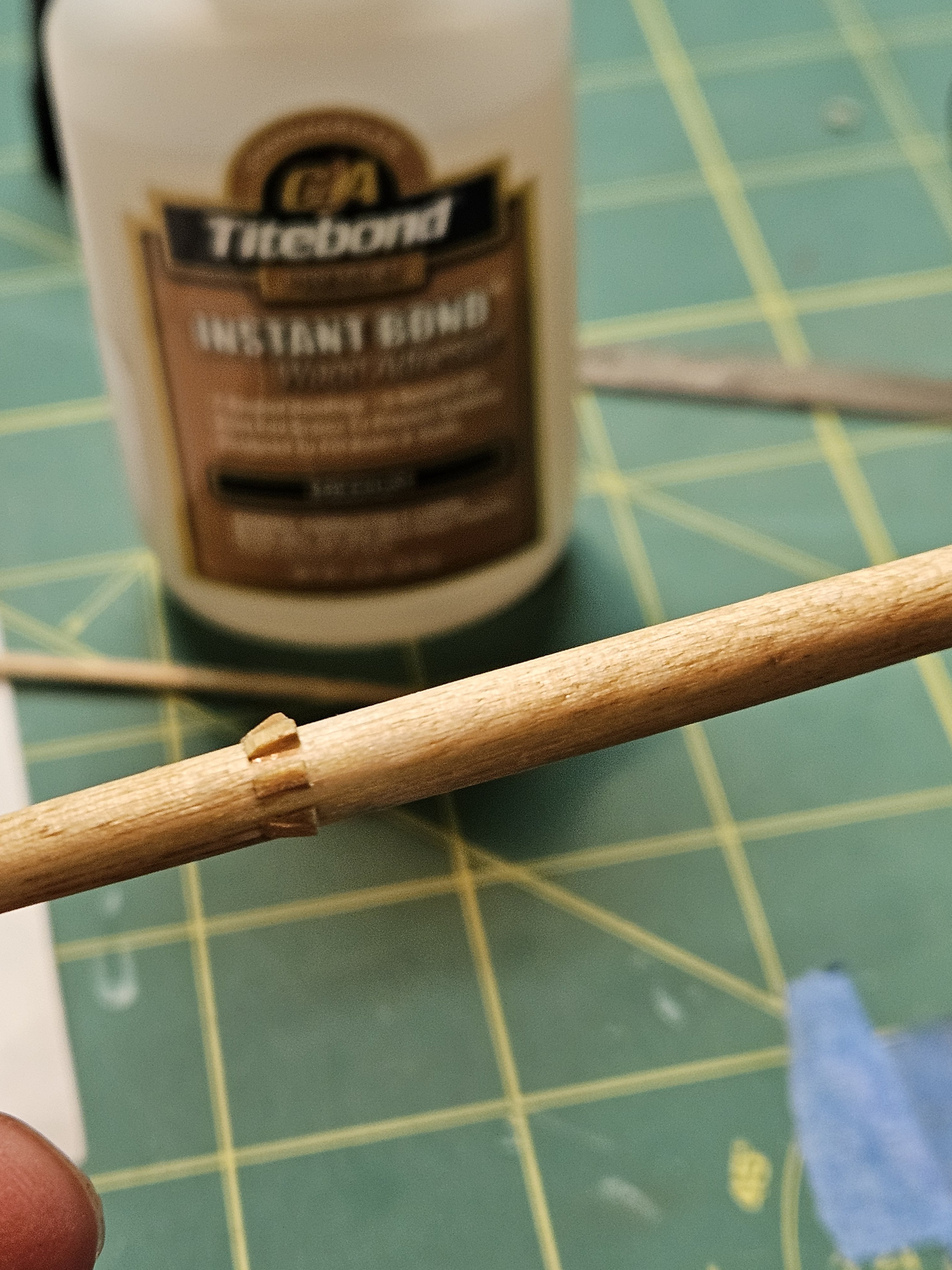

My approach was to cut down the sheave hole of a double, with a saw:
Pretty crude:
Then on one side, I use a small file to create a groove to help grab the rope, when stropping
I made a bunch. I'd stick them to the back of some painters tape, and stain them with Golden Oak.

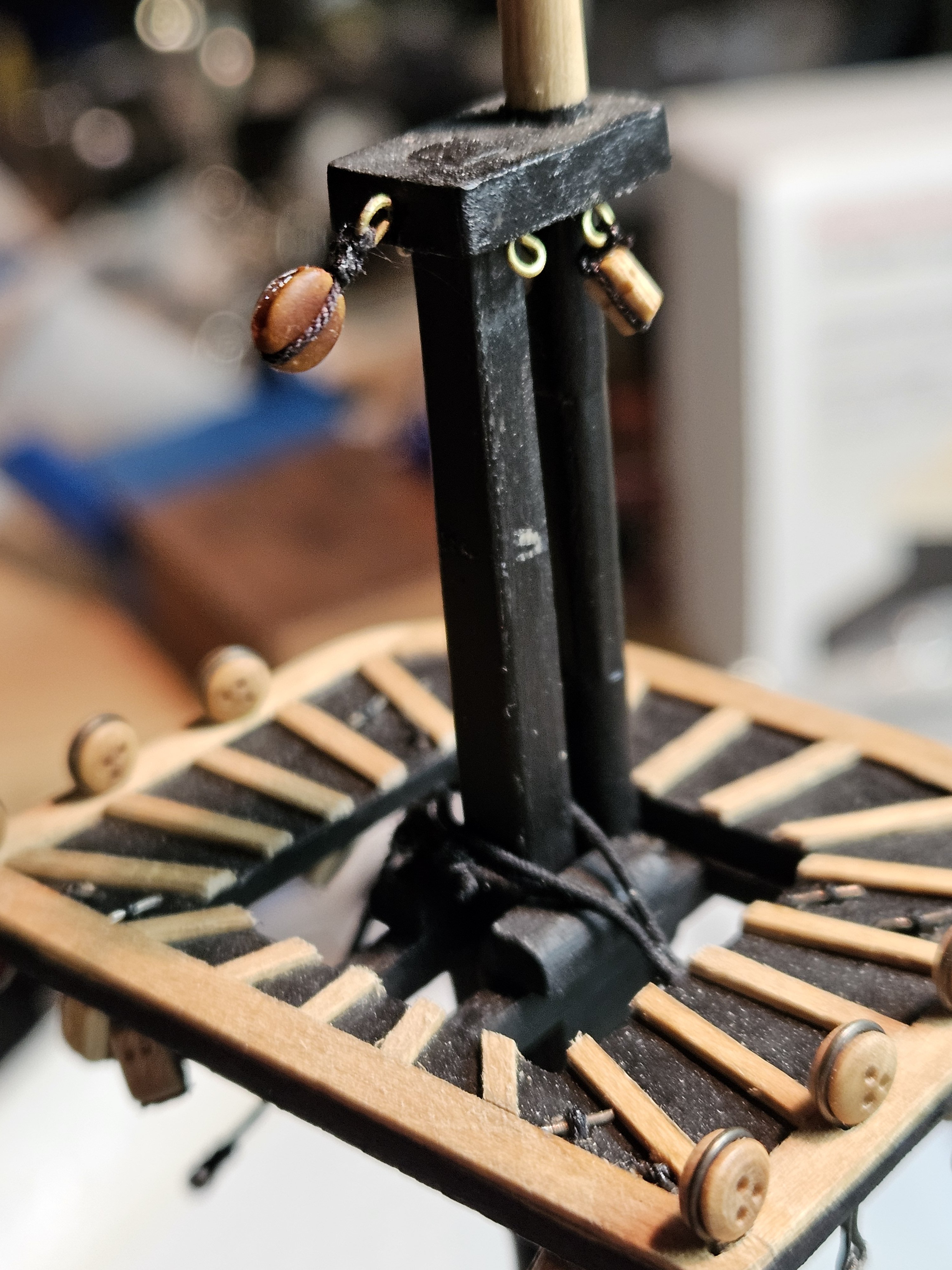

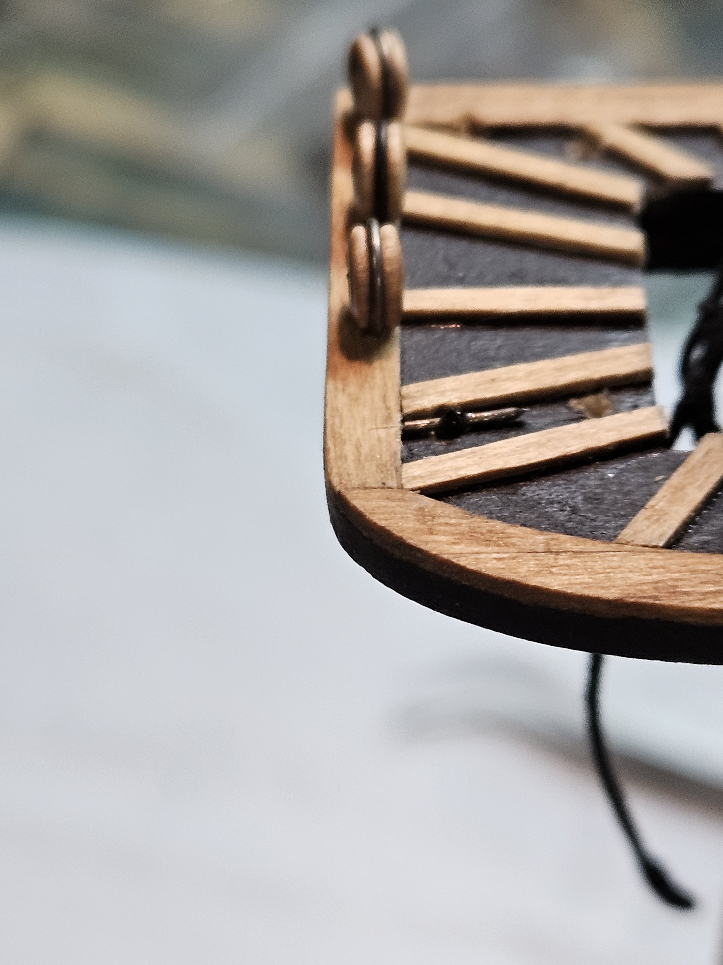

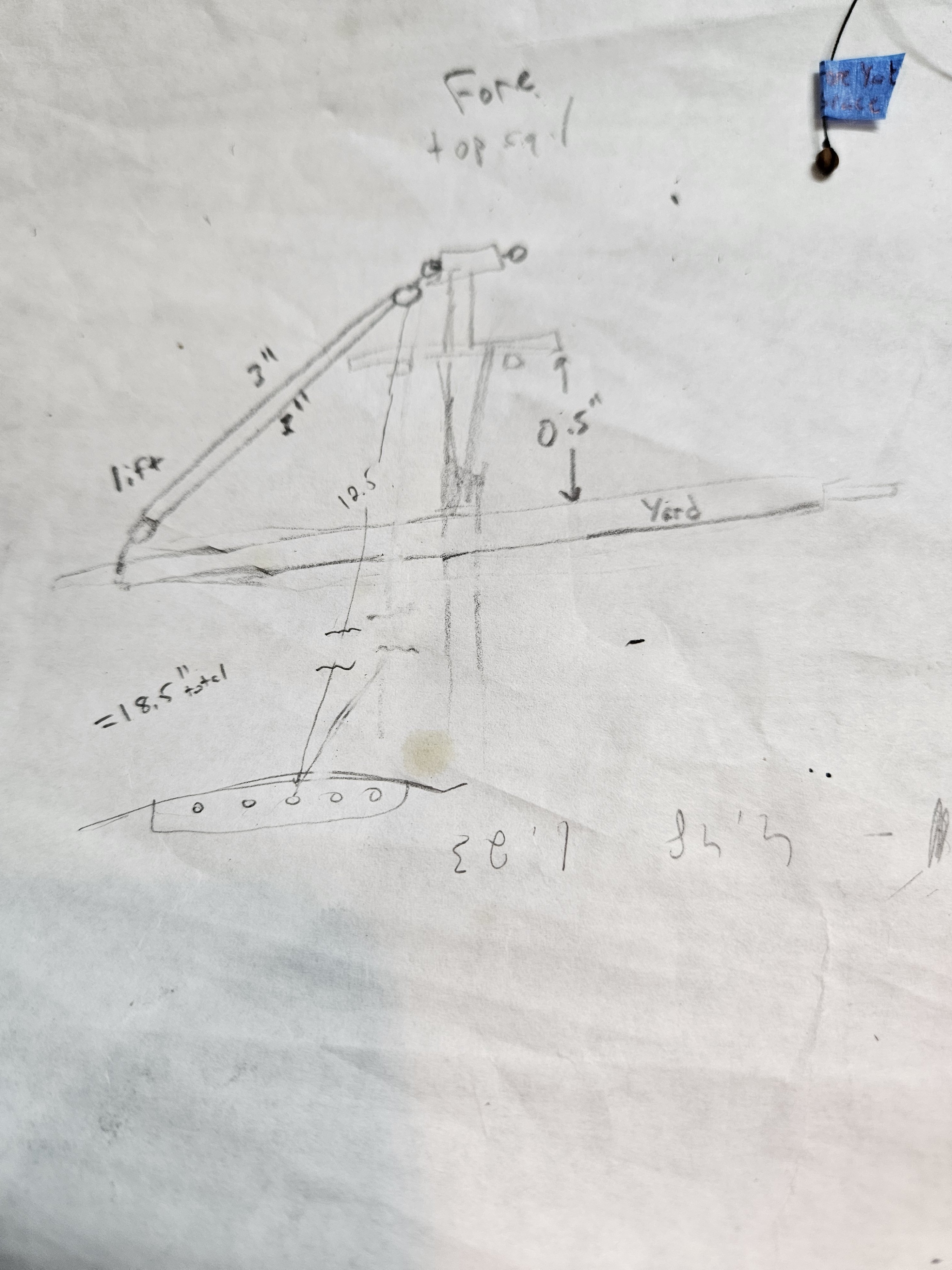

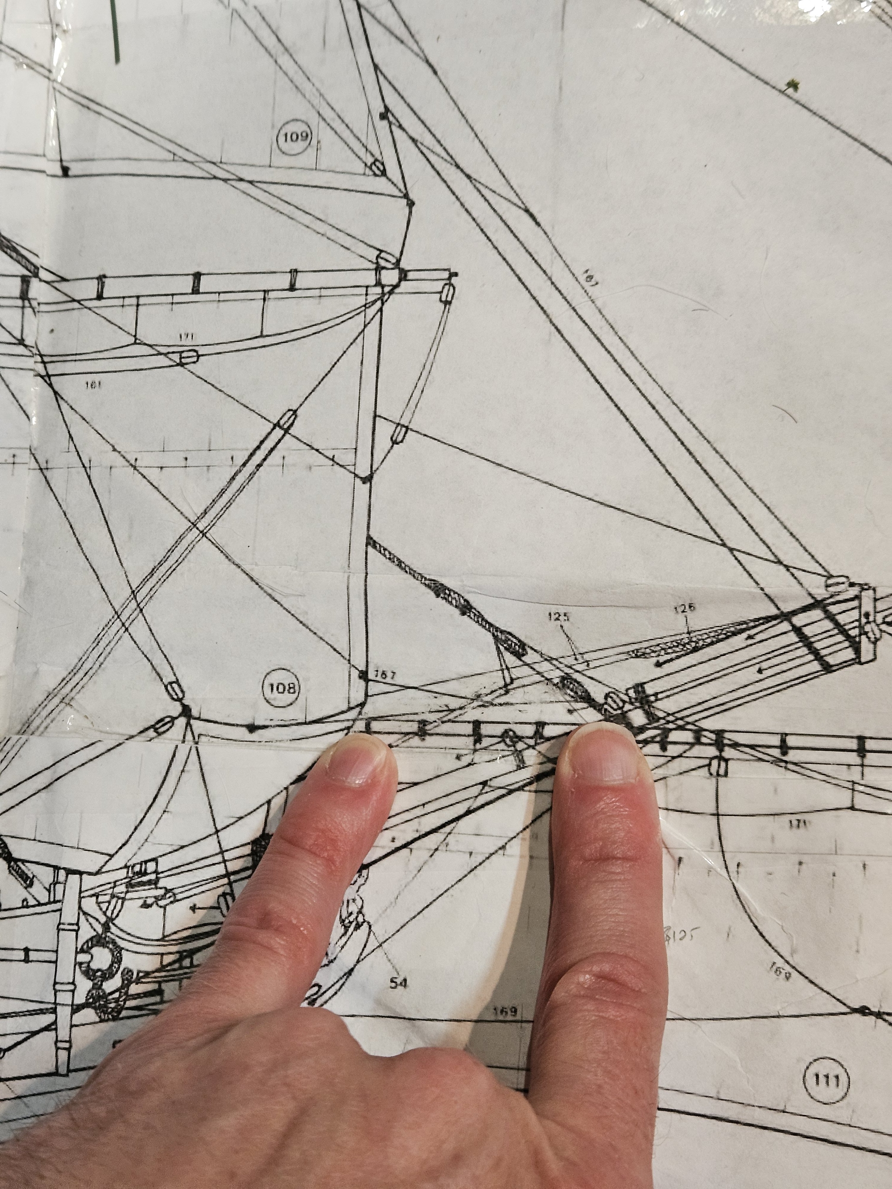

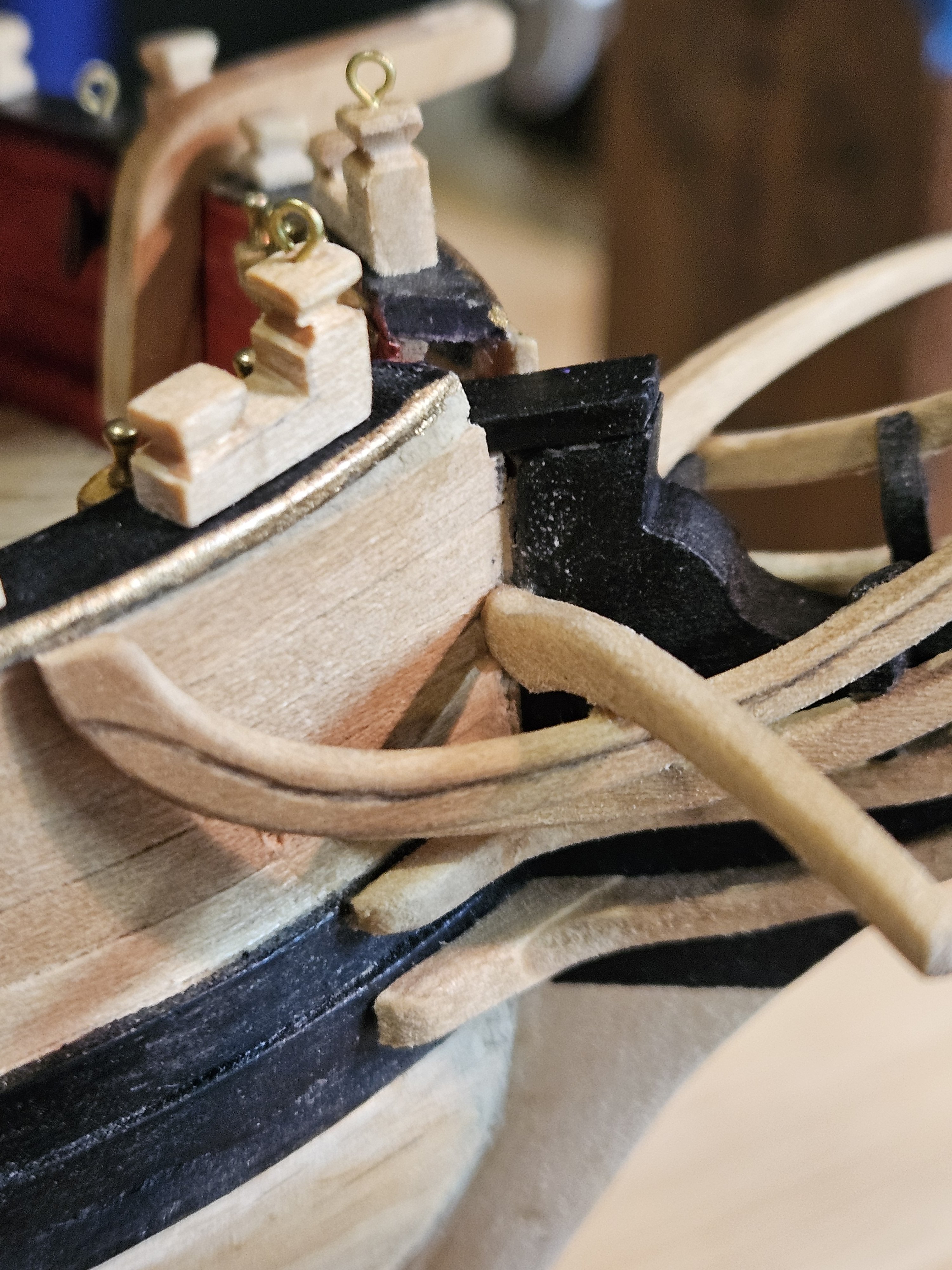

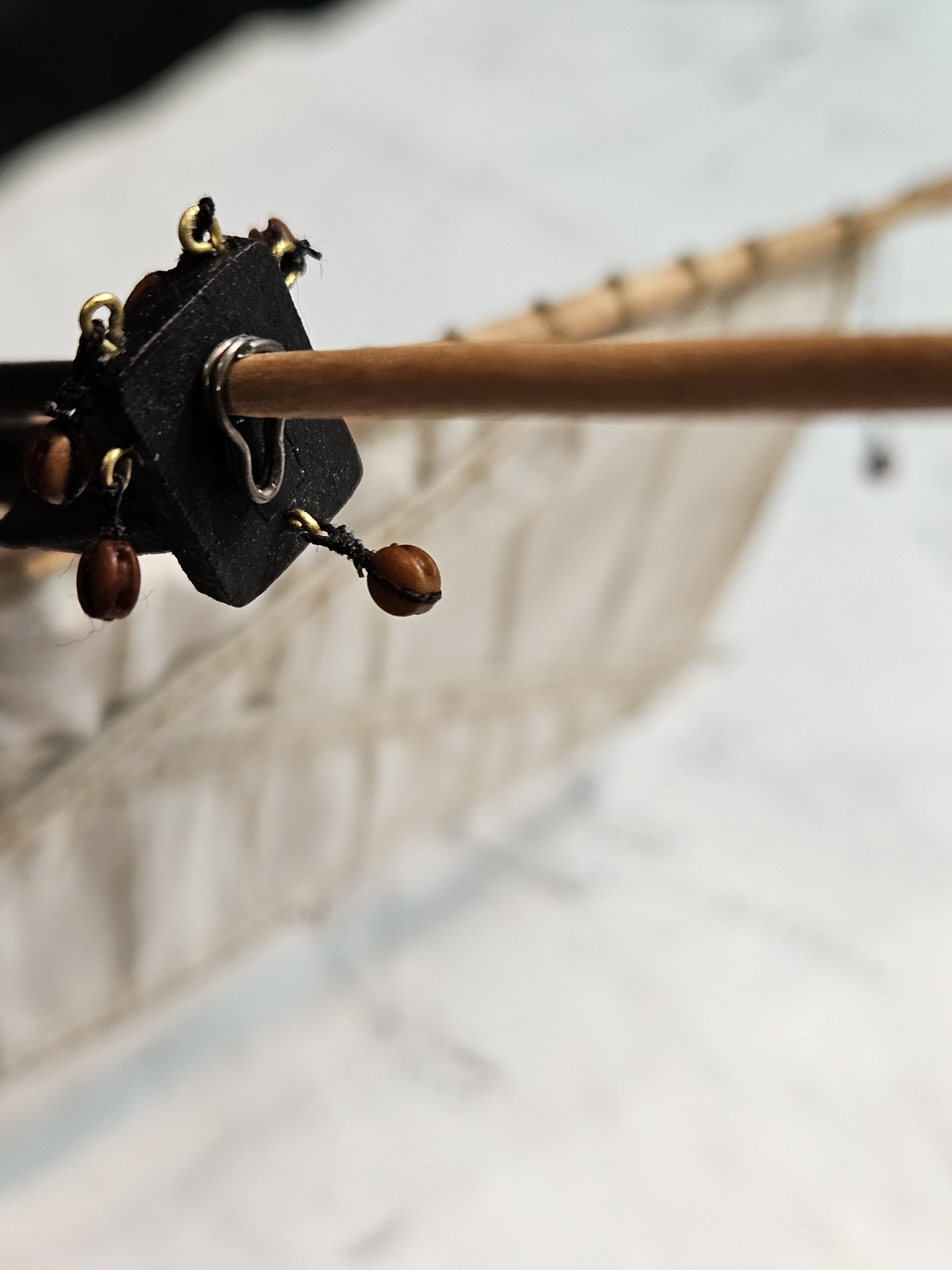

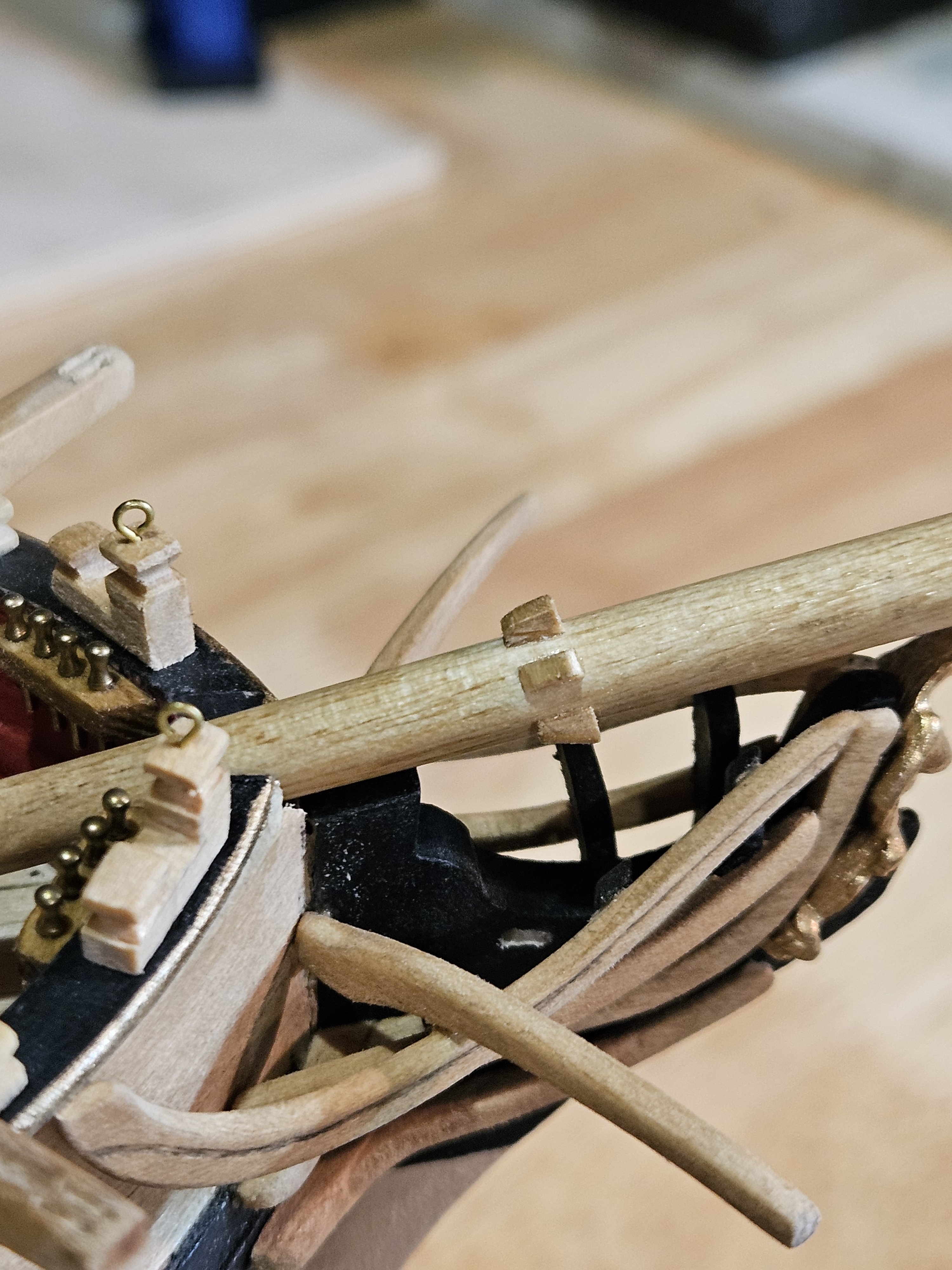

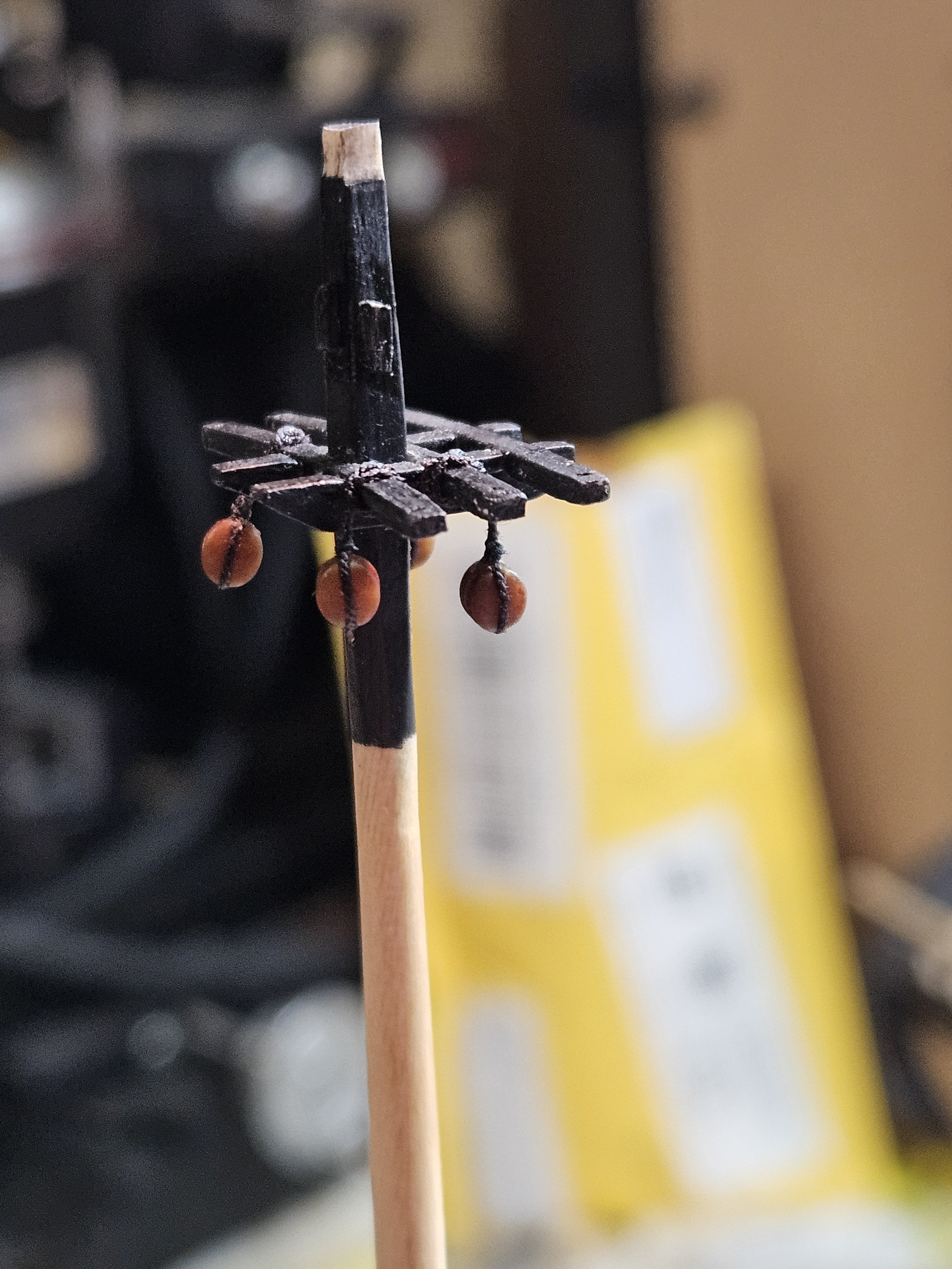

From the plans for all the yards and masts, the mast cap showed 4x eye hooks, 2 on each side. On the rigging plans, they aren't used for anything that I can see.
From other models I've seen, the lifts are rove through single blocks attached to these eyes.  The instructions show them going over the mast cap in a saddle and cross sides, but they'd likely chafe horribly in actual use. I'm going to use single blocks as shown.
Again, I'm not sure how they're supposed to be tied to various parts, so for ease and time, I'm just doing square knots.
Have to remember to do both sides....

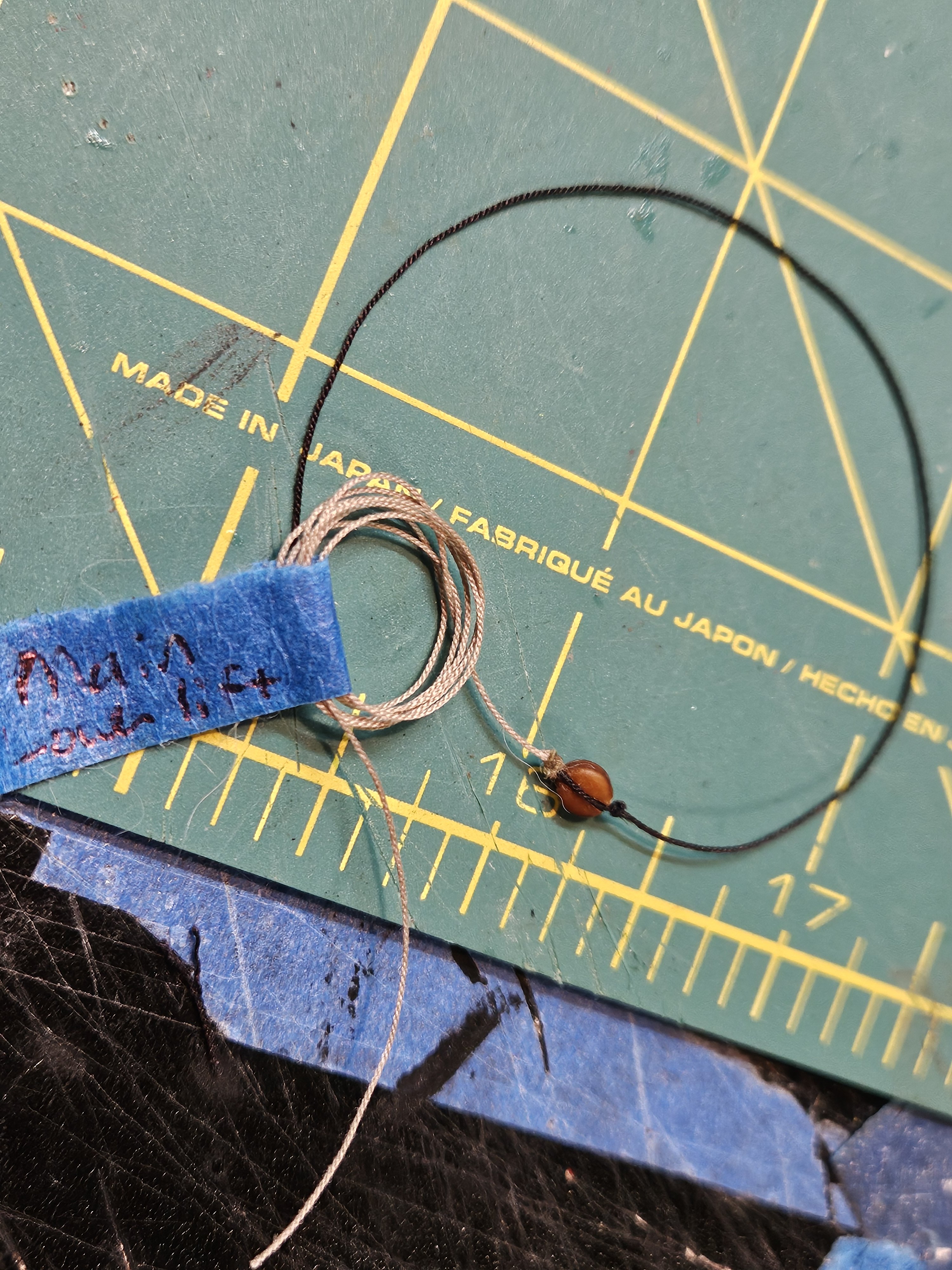

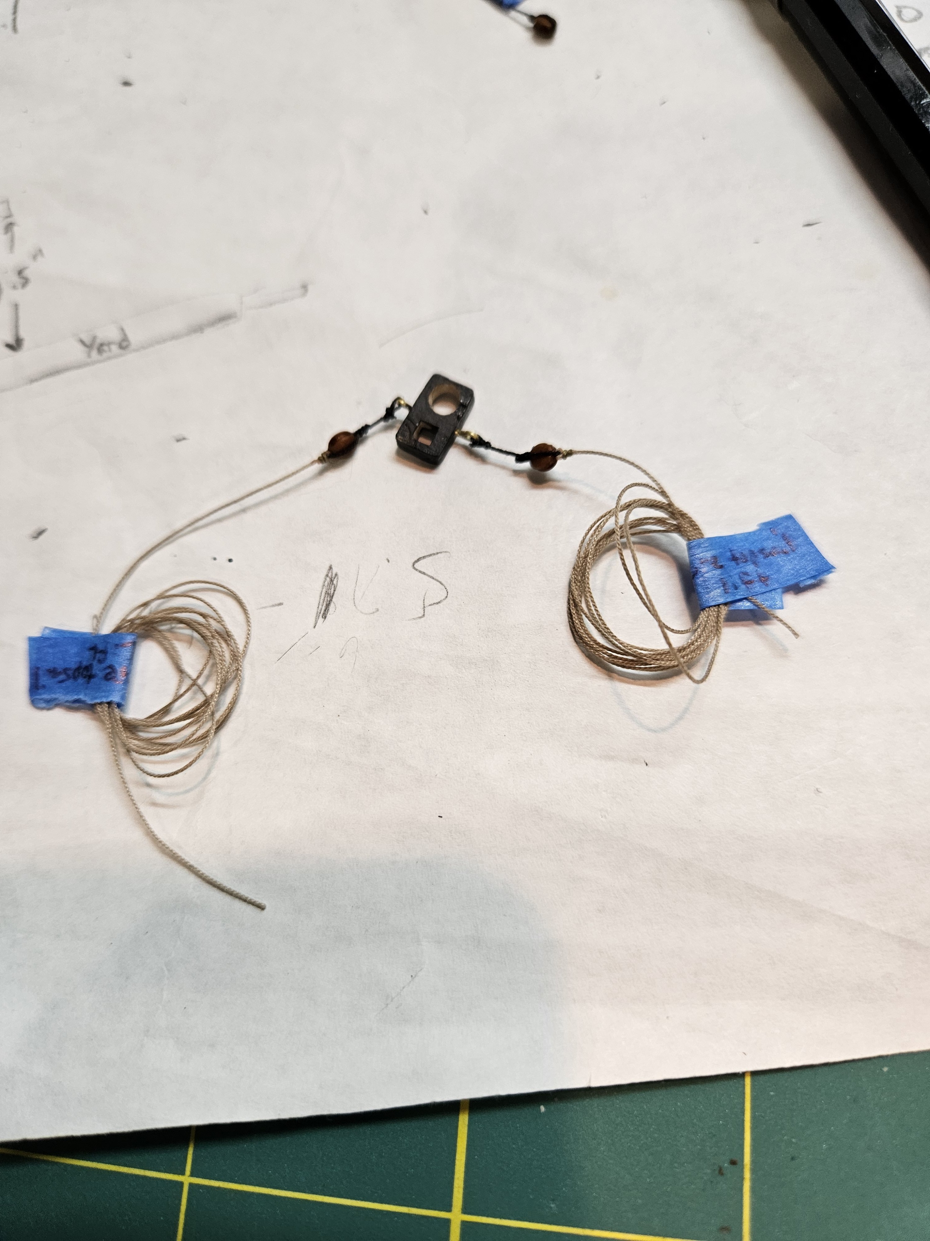

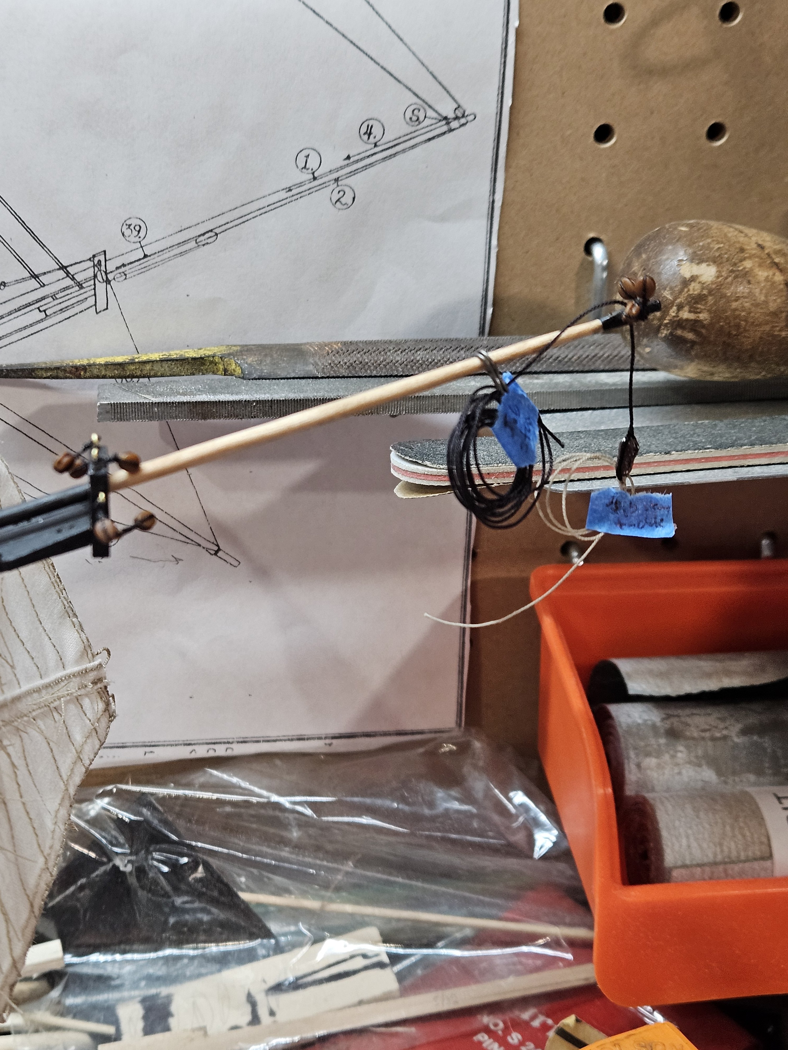

On the starboard side of the main lower yard, is the yard tackle. I needed a nice rope eye to go over the yard end, and be partially served. So I'm using fine black thread to create some laddered loops to make the effect. Each loop is actually another overhand knot to keep it from unraveling. I makes for a relatively neat look.
I did the same mini-serving for the double block. I made the length close to that on the plans.
I would loop it over the end of the yard, and shoulder it next to the brace line. Just a dab of CA glue to tack it in place.

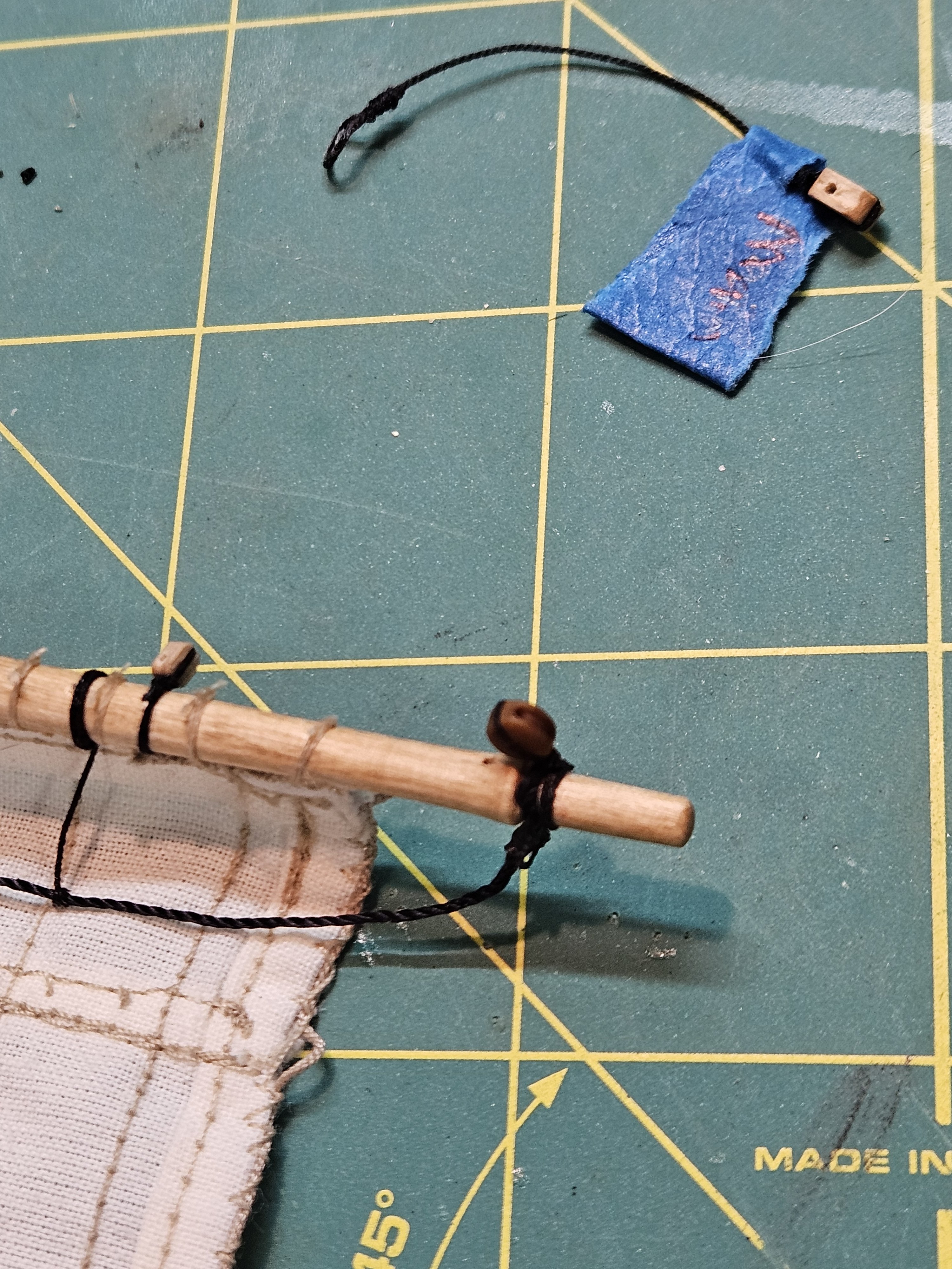

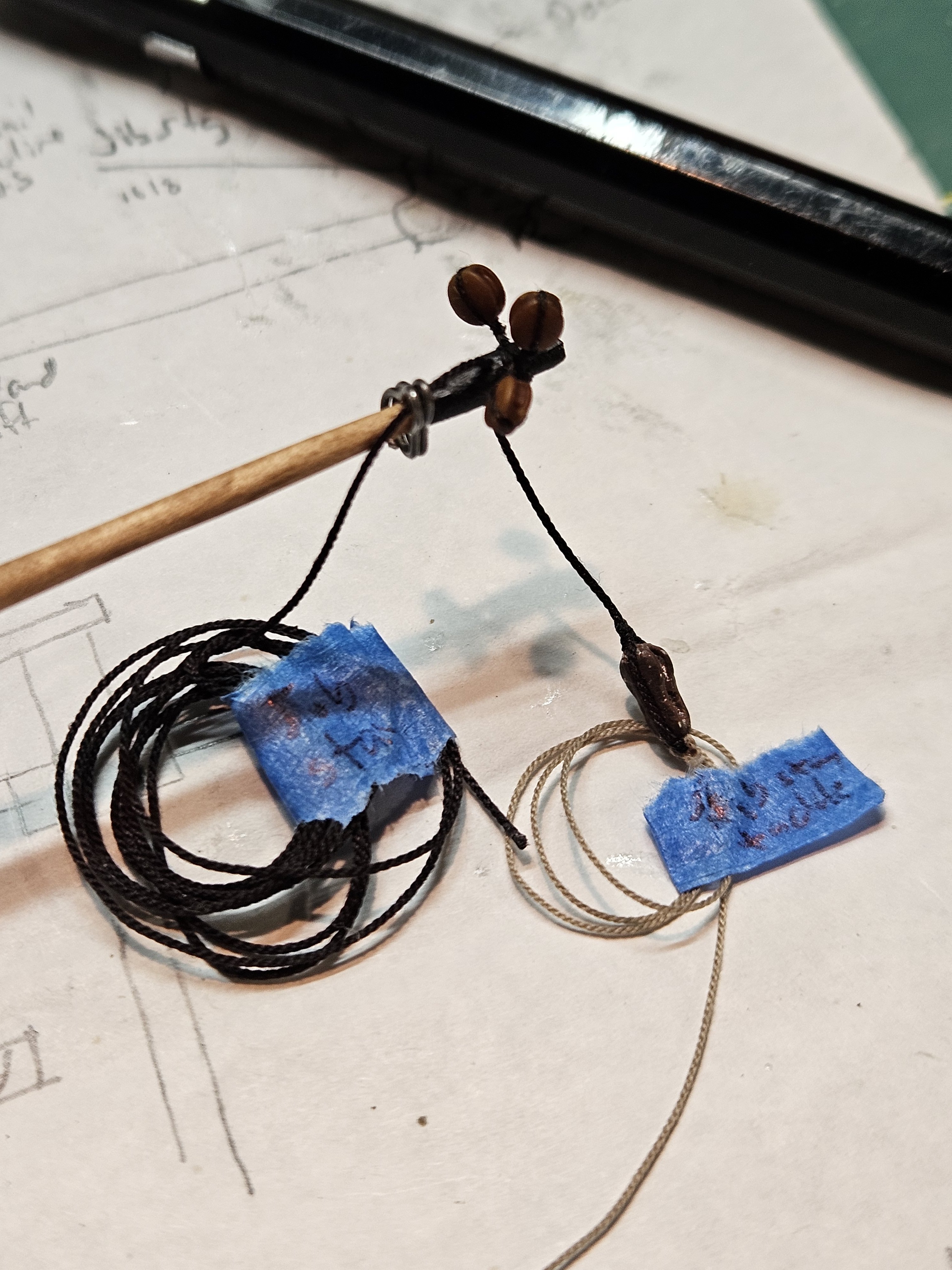

I make sure to add a little label, so I know that the black one is the brace, and the other black one is the tackle. Next up is the lift....which is ......black?

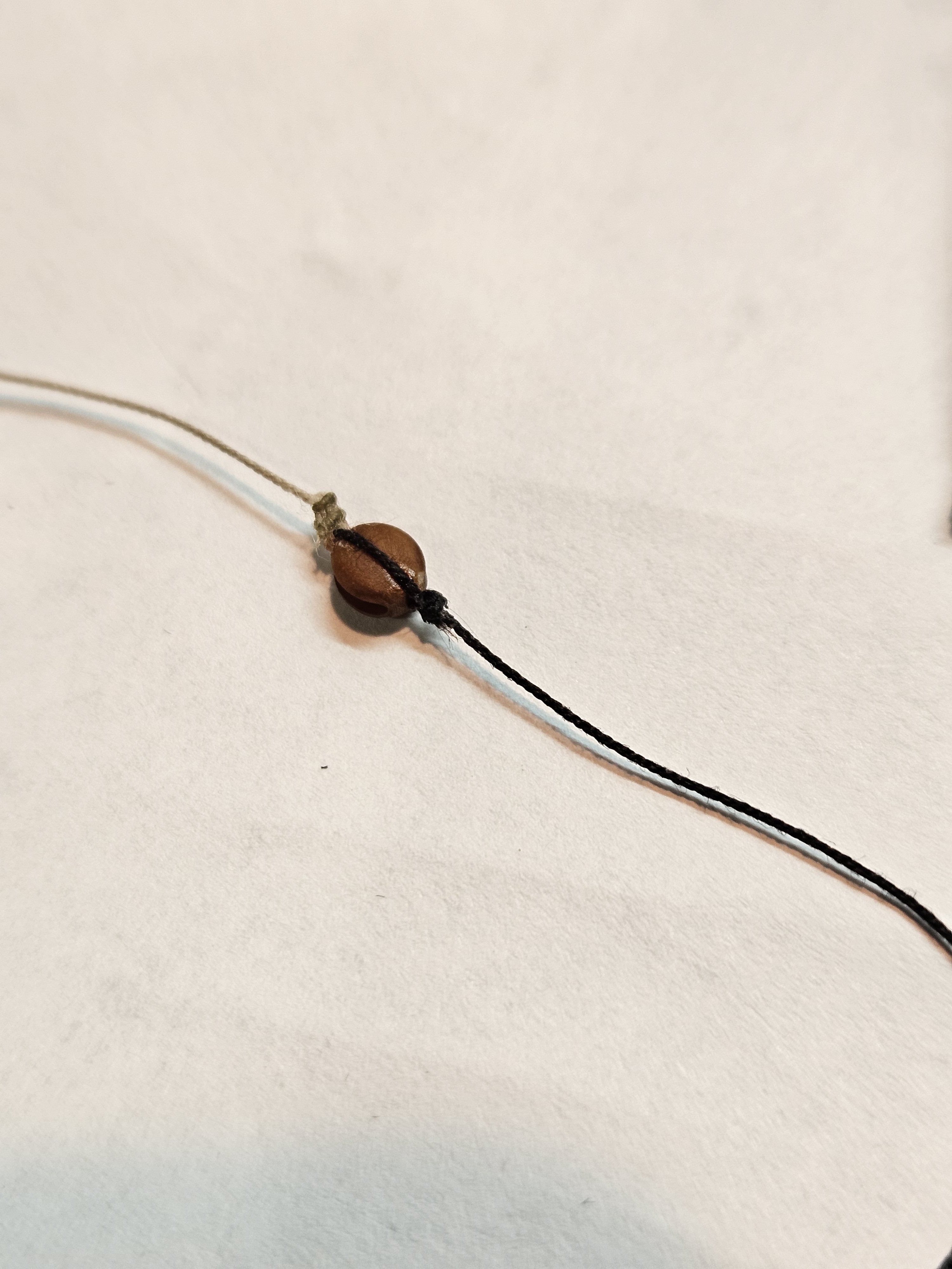

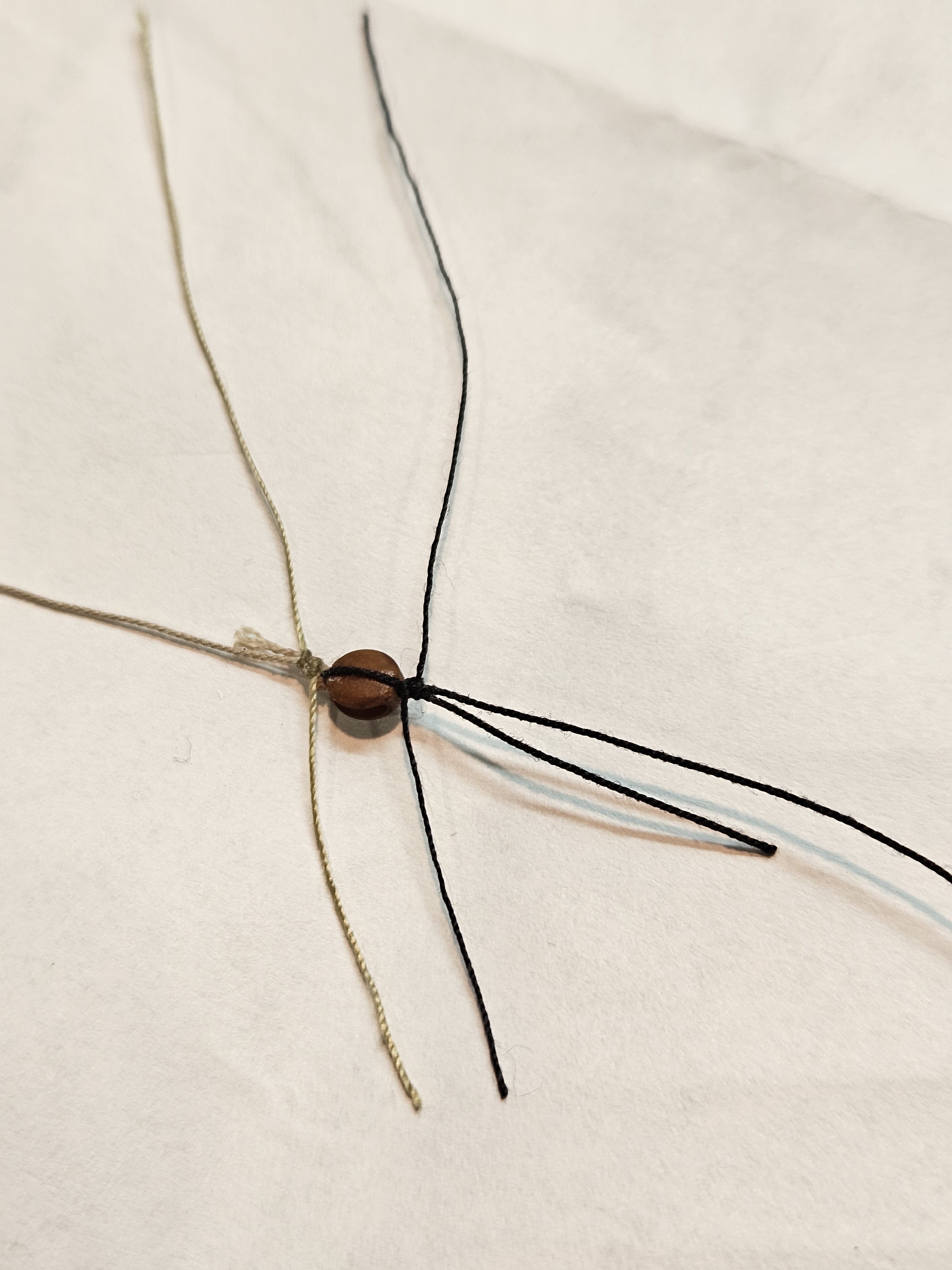

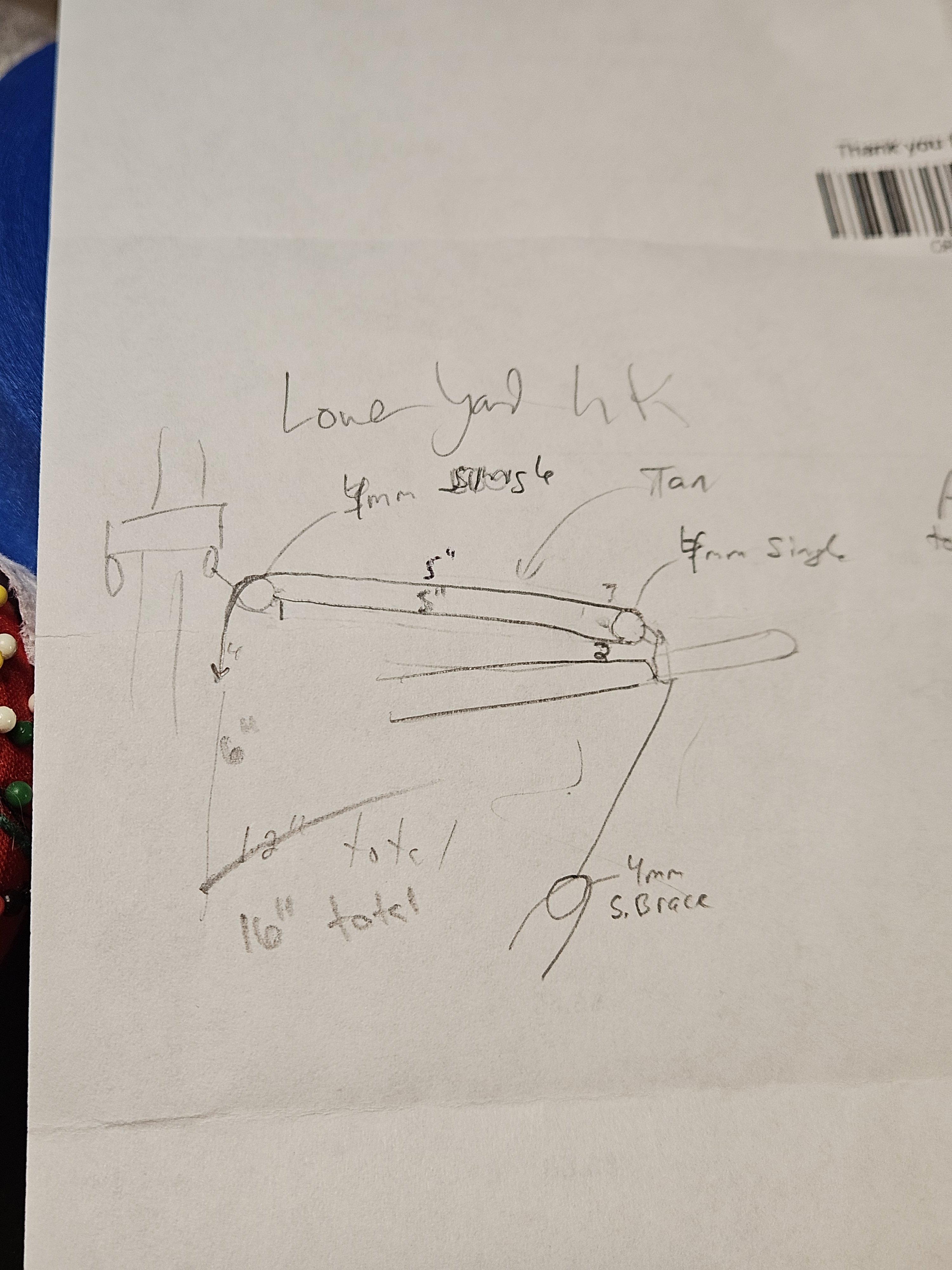

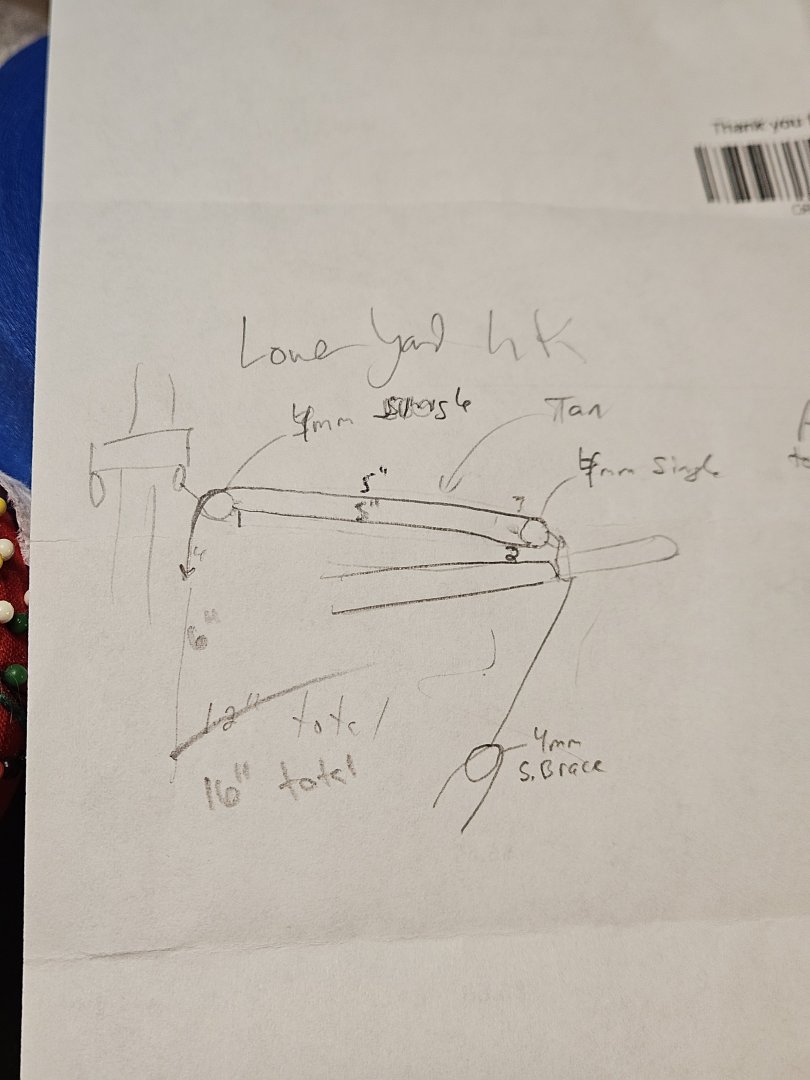

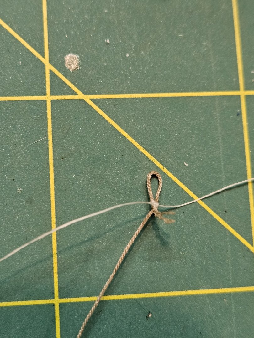

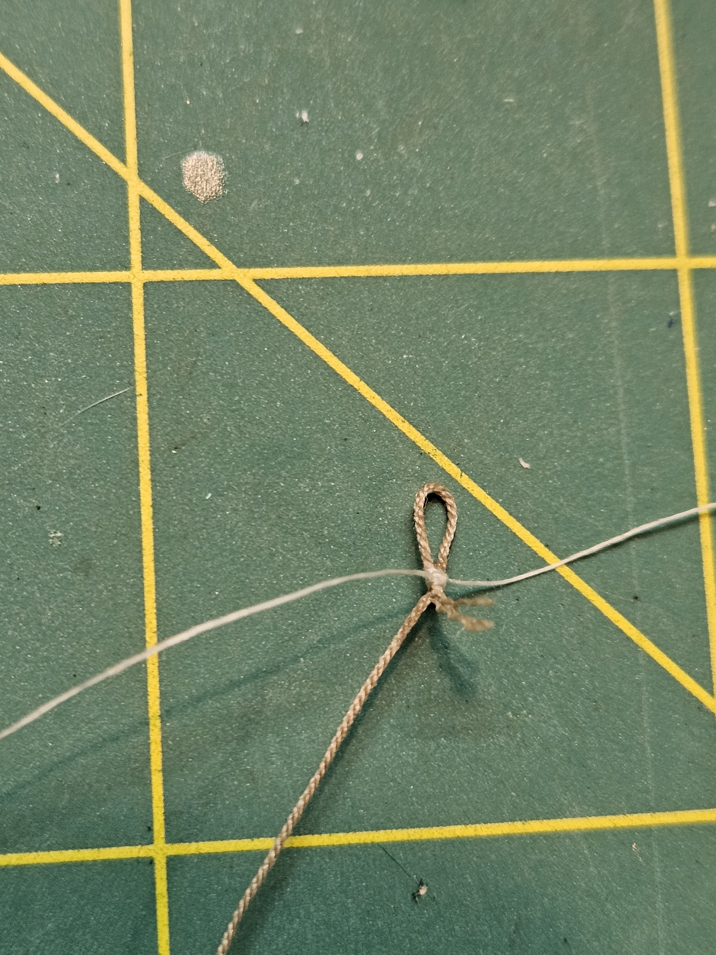

Using some fine tan thread, I start making the loop for the Main lower yard lifts.
Making subsequent overhand knots as each loop of the mini-serving.
The ends look good enough, after the ends are trimmed.
I made a pair of them, P&S, since I'd like to be able to lift both sides.  Making coils will help when attaching the yard later, instead of letting them dangle.
I'm trying to do as much yard work, no pun intended, as I can so I'm not limited on space later. This is tough enough OFF THE MODEL!
This is the last thing for the yard ends...more CA glue to tack in place on both sides. I have to remember to have them point UP.
And yes, I later realized that the lifts were supposed to be black rope. The rule of thumb I was following was any rope that goes through a pulley, is running rigging, hence tan. But Lifts are standing rigging, and according to the instructions, its 'tarred' so black.
I later removed the tan lifts and remade them in black rope, shown later.

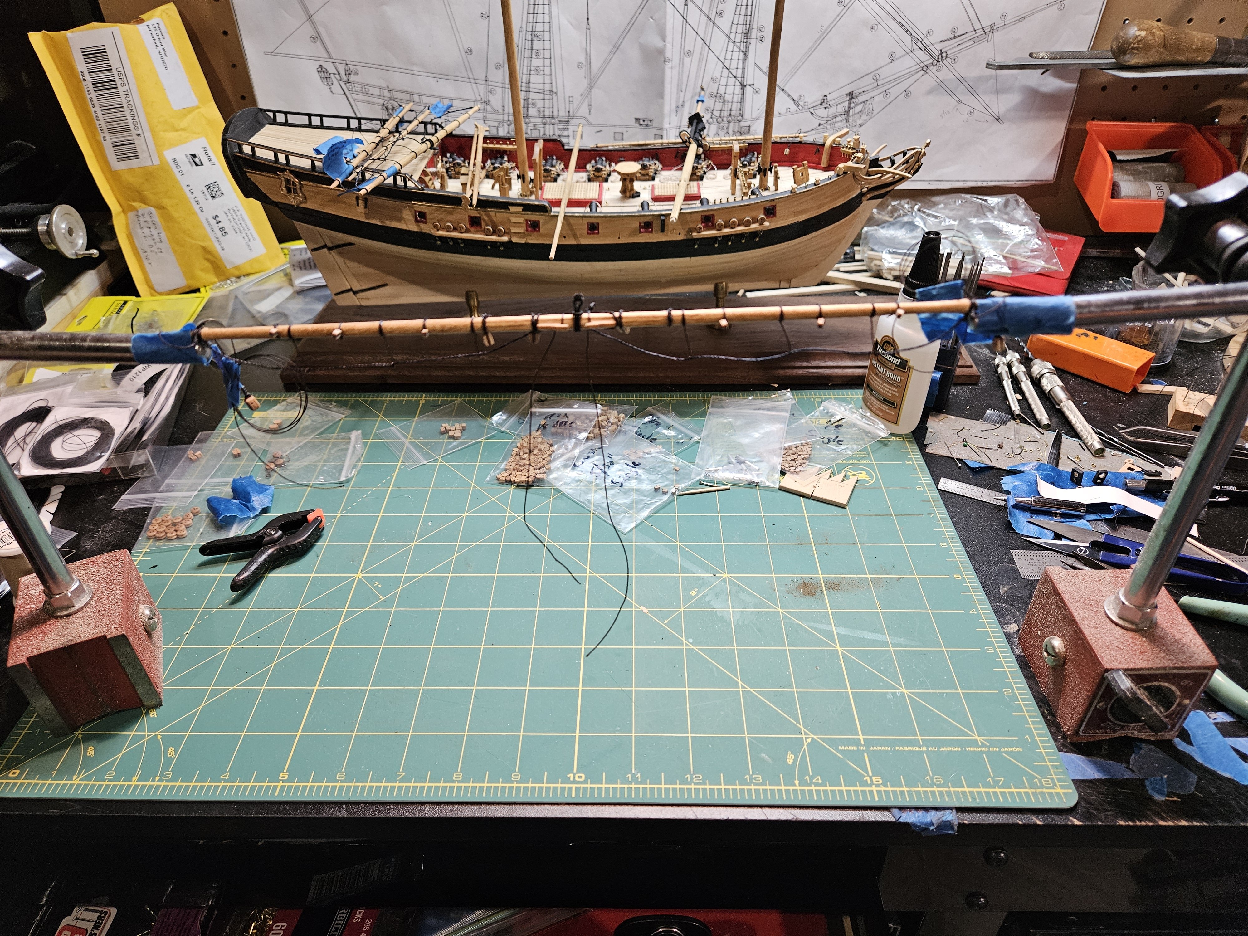

Continued Rigging on the Fair American Model ship

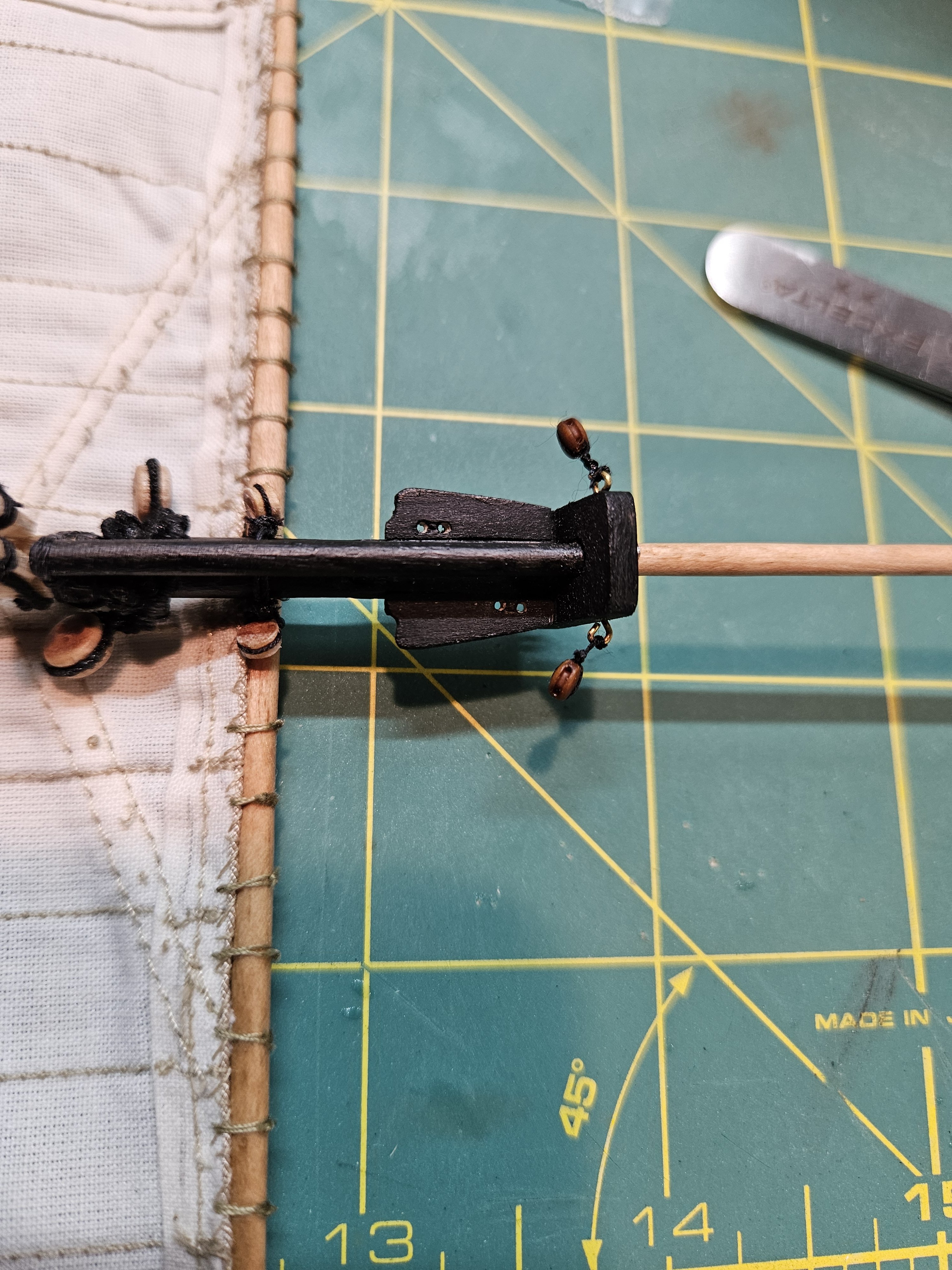

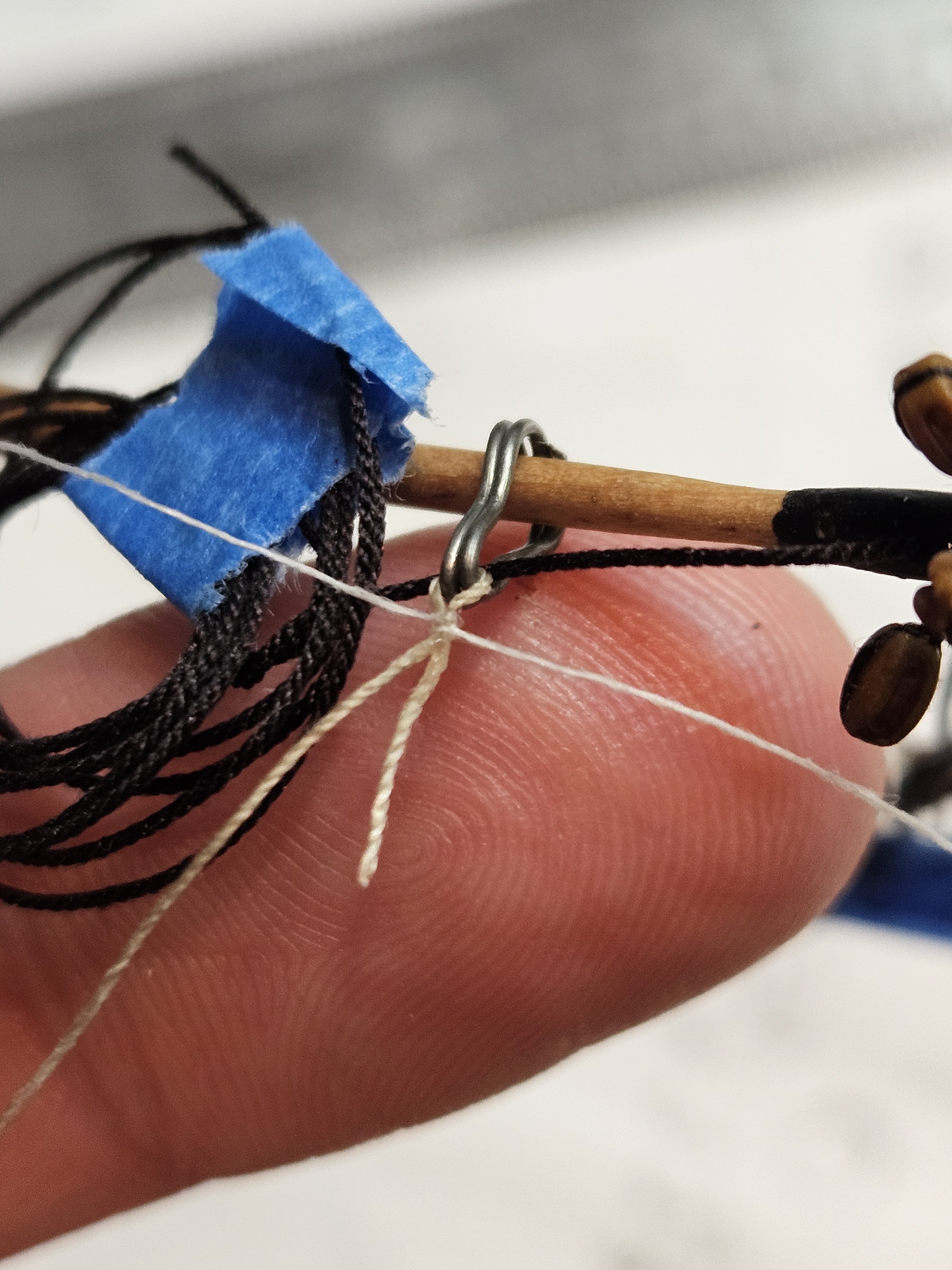

I went to work on the lower yard trusses next. These were kind of tricky to do, and I'm only going to start them, and not fully rig them to the mast until the sail is attached first.
So I made two ropes with small eyes. I haven't found a ''neat'' way of making eyes that's not bulky at this scale
I started them with single overhand outside the cleats, then moved them inside.
There's a lot of other foot ropes, blocks, etc that are attached to, so space to work is already tight.
once both sides are 'in place', I secured them with fin black thread and a dab of CA glue, as close to the yard as i could manage, and as tidy as possible. Then, trim the ends close with scissors.
But they're both secured as close to the eyes and yard as I could make. I left the running ends dangling, until I'm ready to attach the yard later.

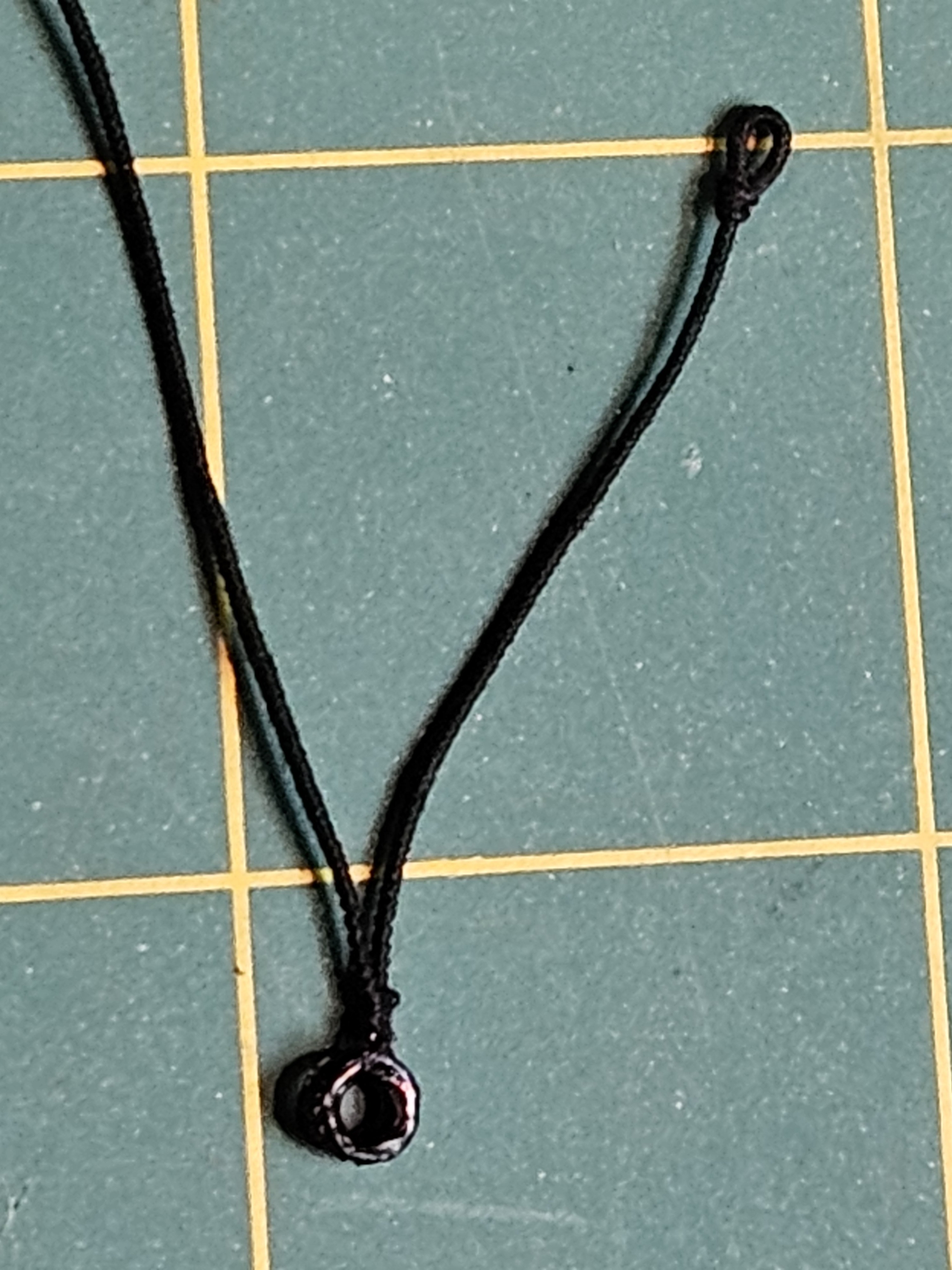

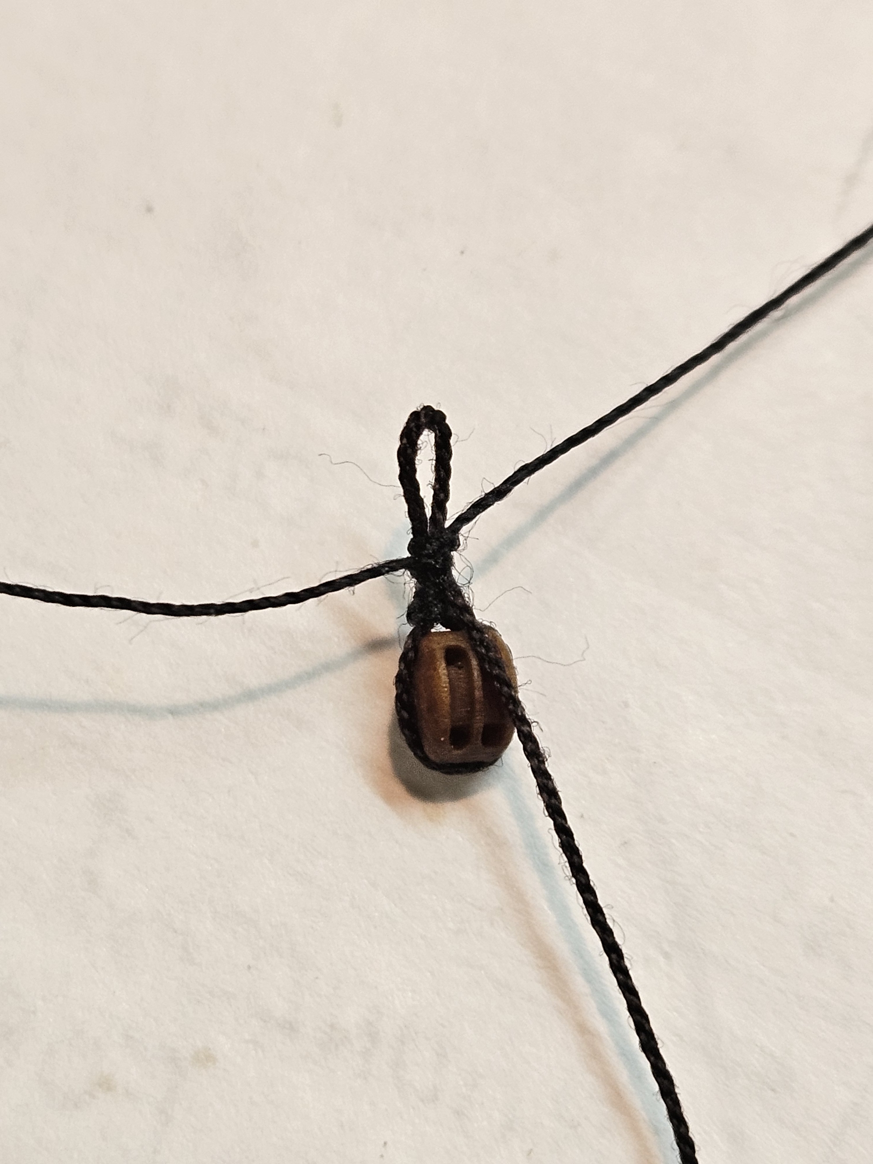

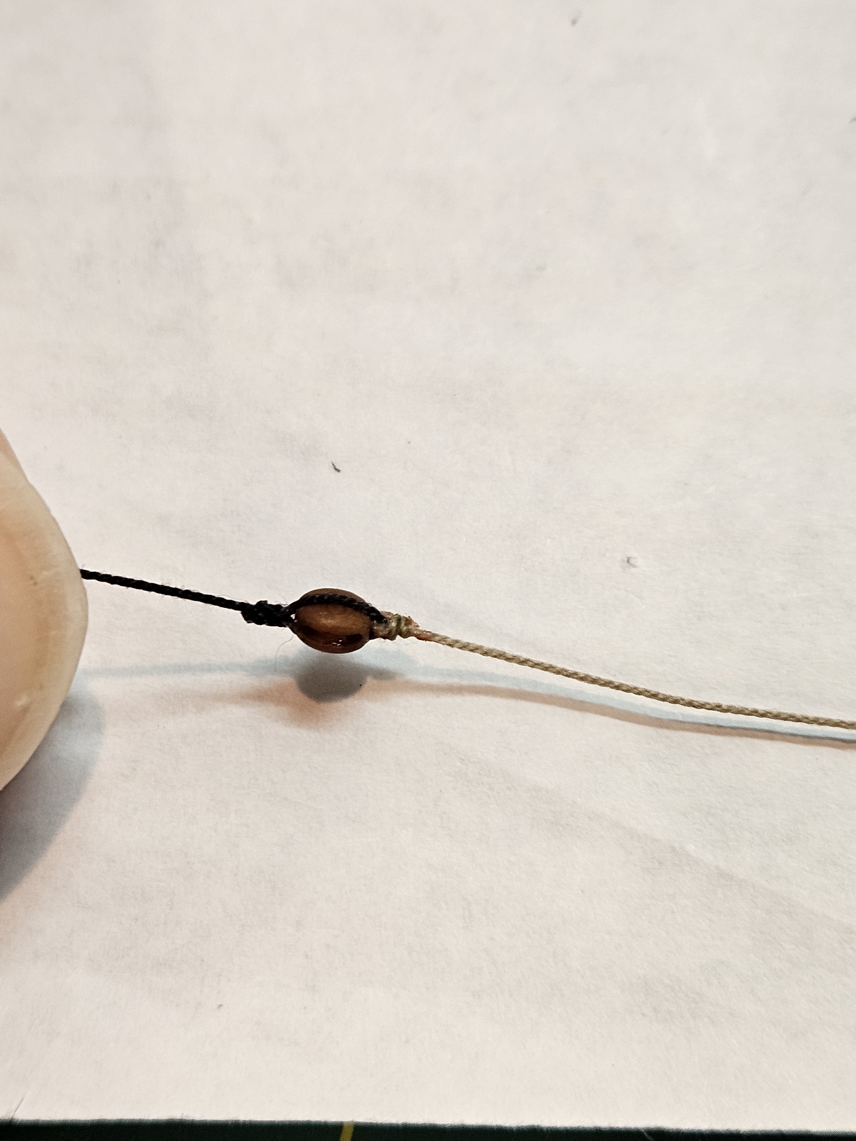

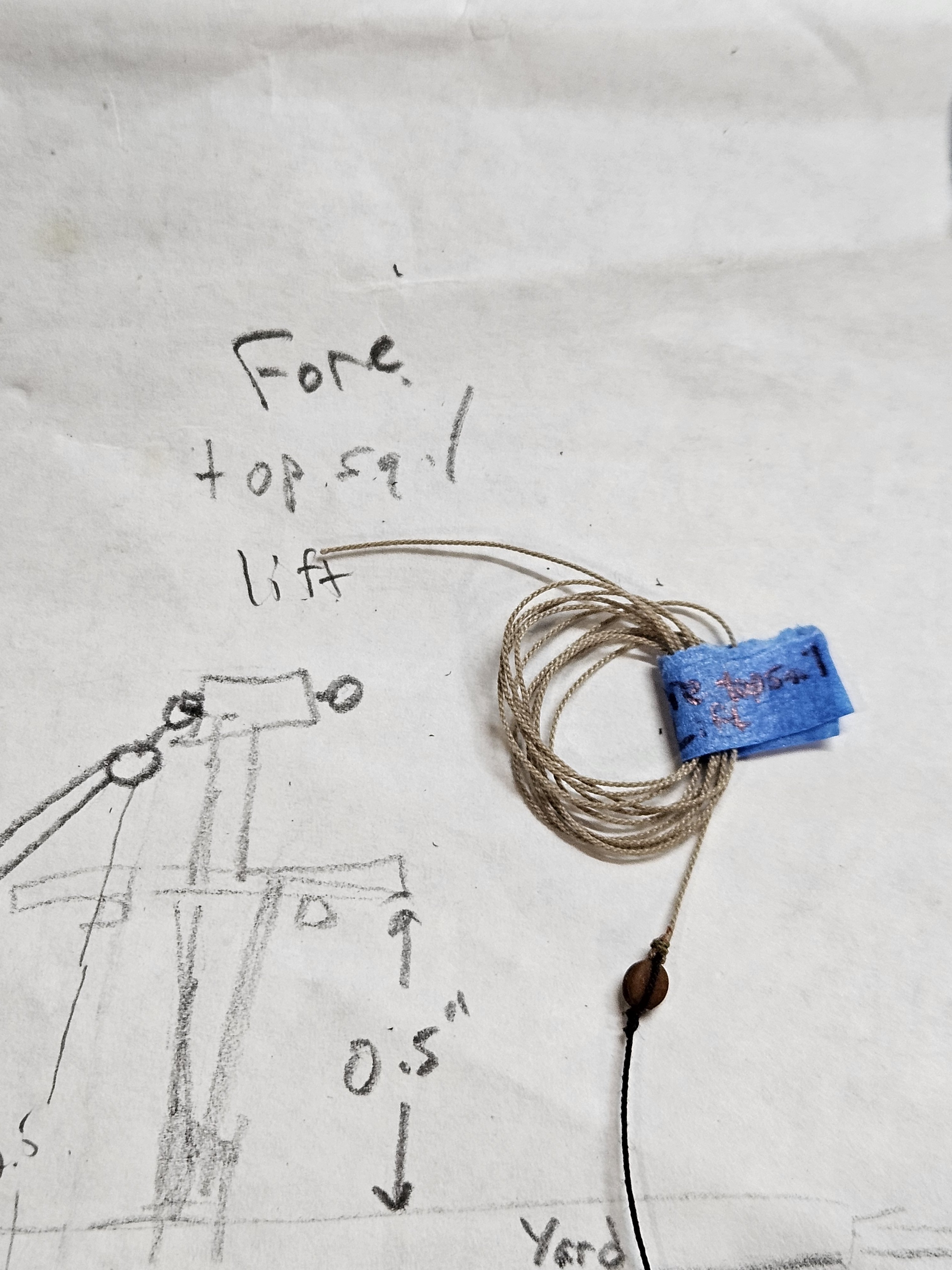

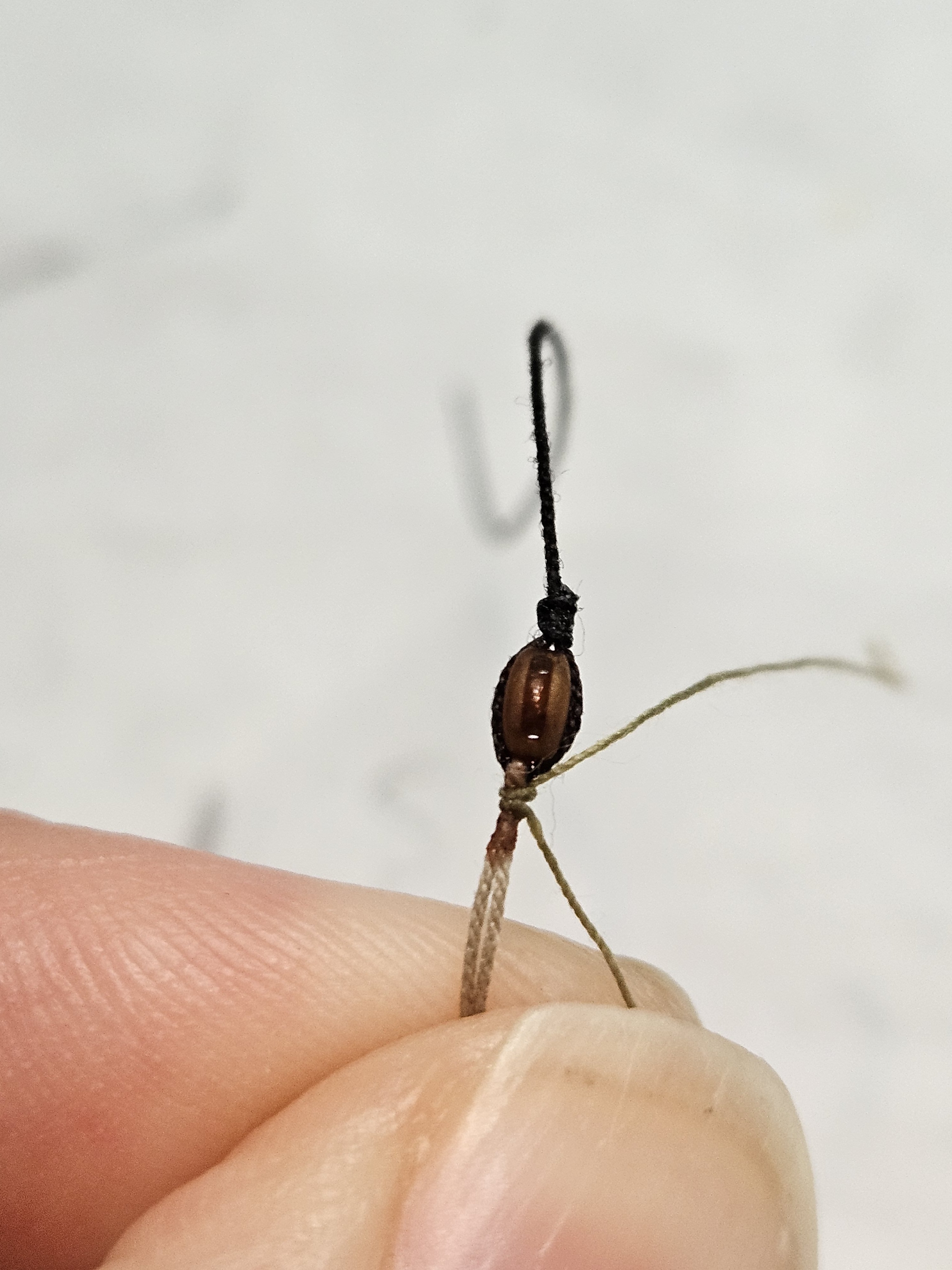

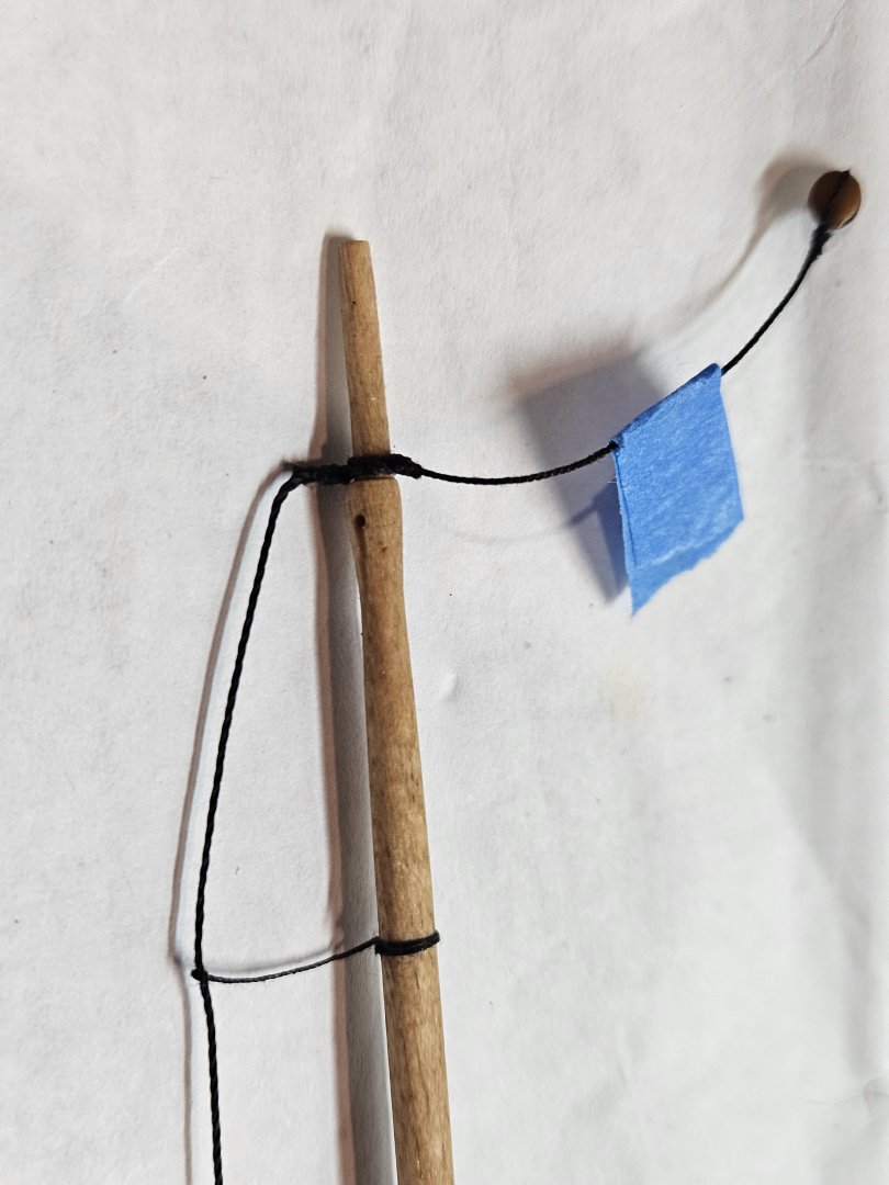

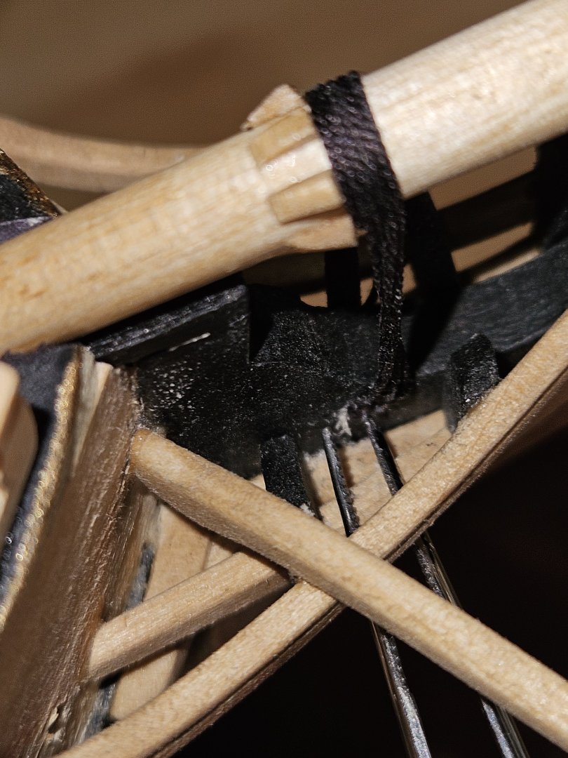

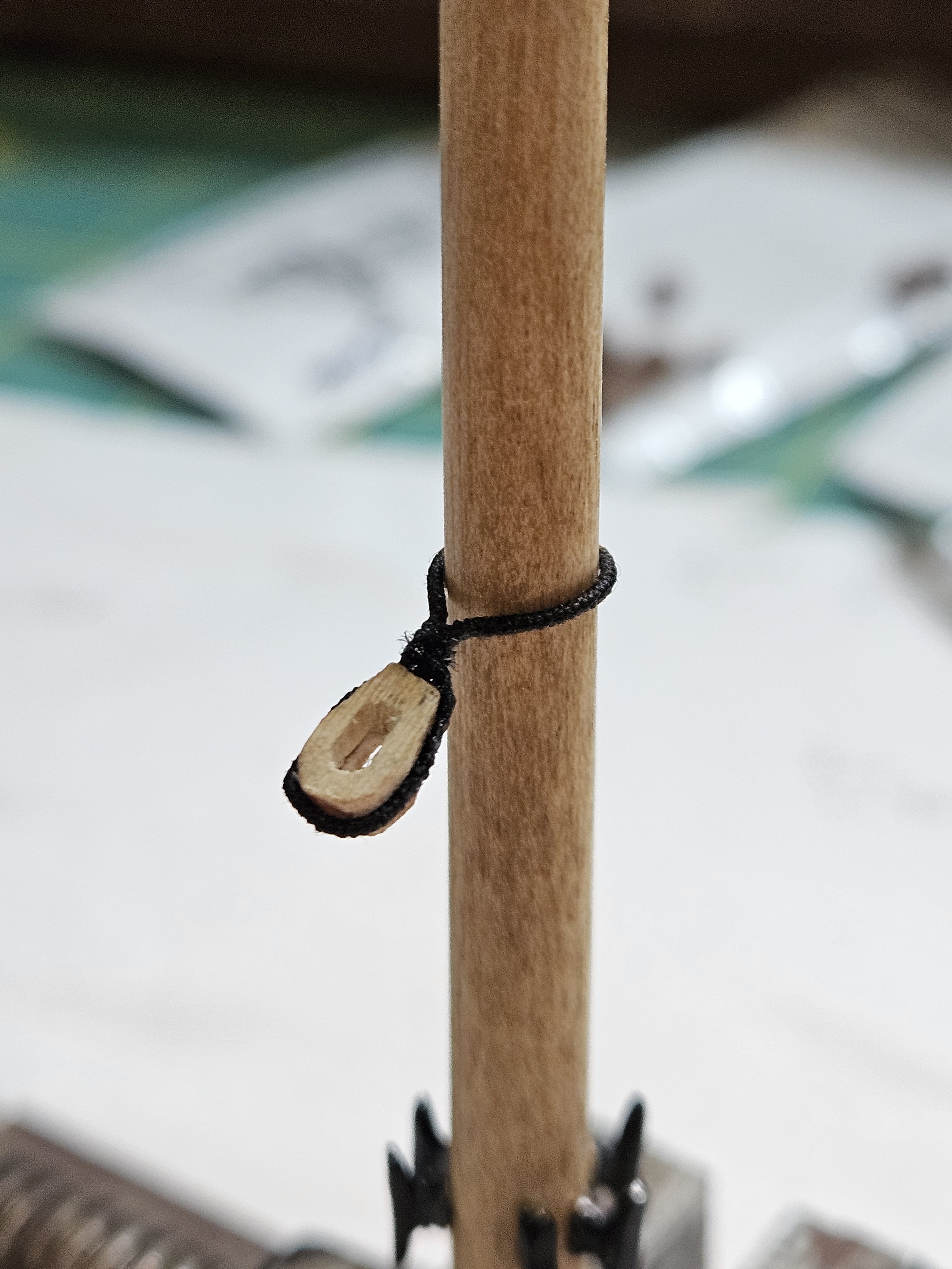

The Yard sling was next.   I want to add this to the mast now so that I won't have to work around a ton of other rigging later. It may not be best practice or order of operations, but it will make my life easier.

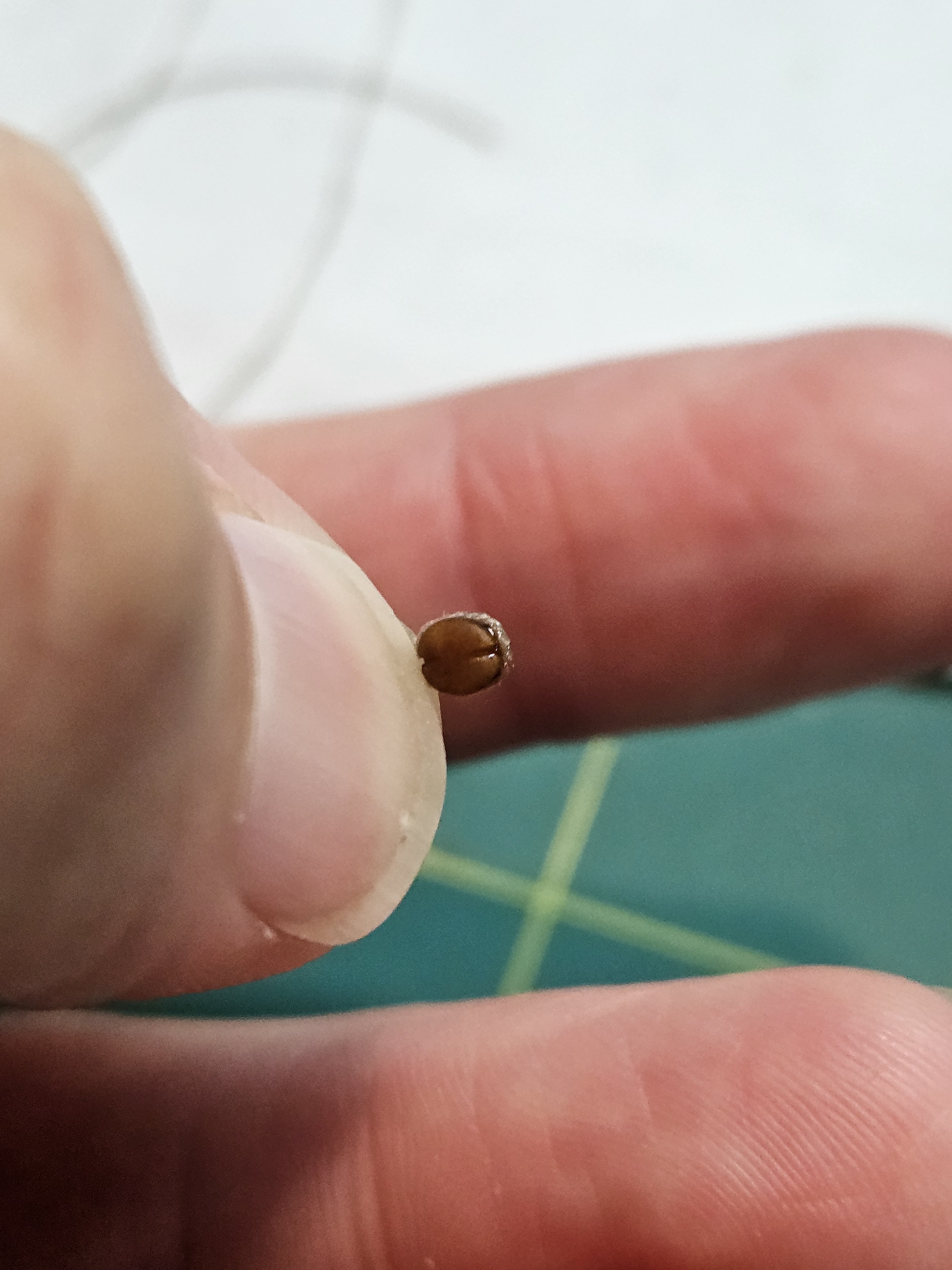

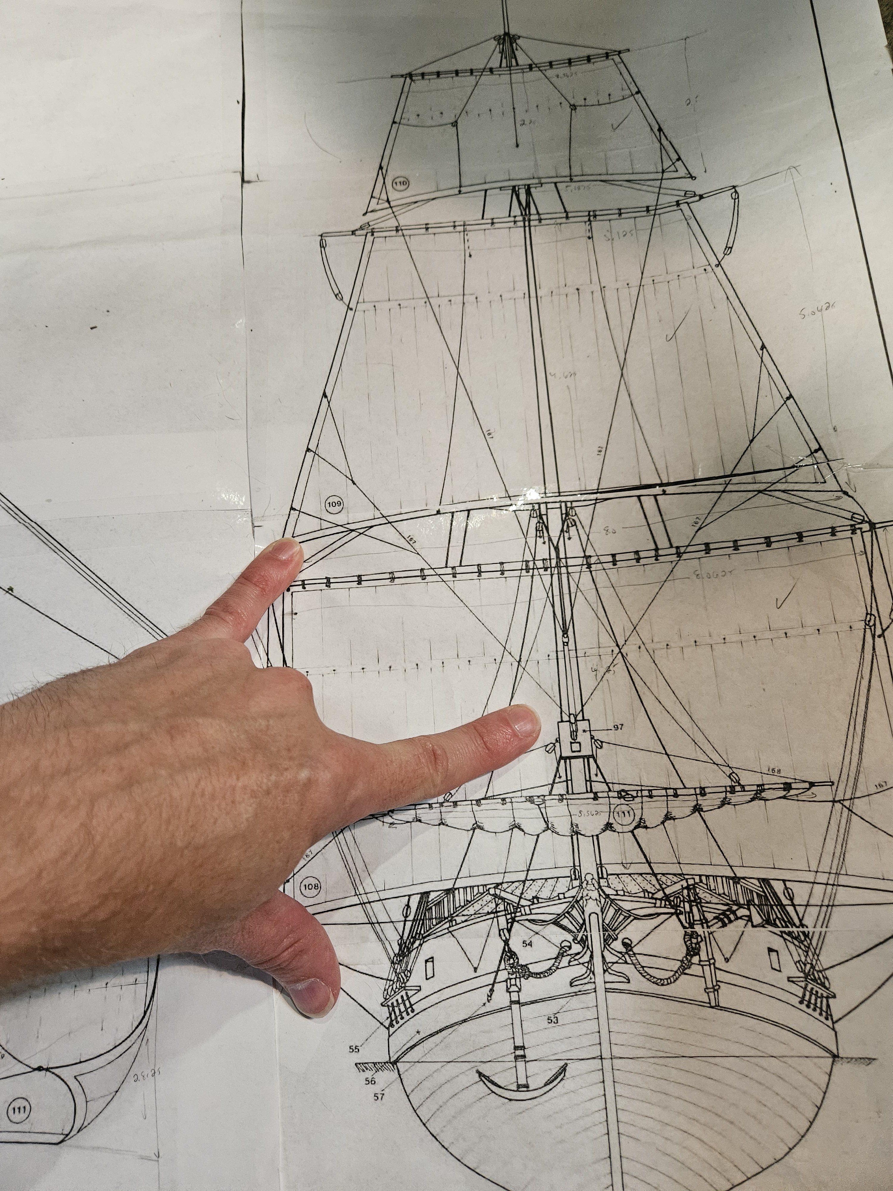

The thimbles are shown, but no description on how to make them or what they're made from. I made some small wooden ones that were a bear to make, and I need something better.
I saw a fellow modeler had made thimbles from small cuts of brass tube, which he used a center punch to flare, so that it catches the rope. I managed to mimic that approach for mine.
I bought some 1/16" ID tube, and cut a short 1/8" section. Then filed it flat as I could
I took a nail and filed the end down to fit inside the tube and used that to ''hopefully'' flare both ends of the thimble.
I'd hammer it on a hard steel block from both ends. It took a little bit of effort but I was able to make it look ''decent''.

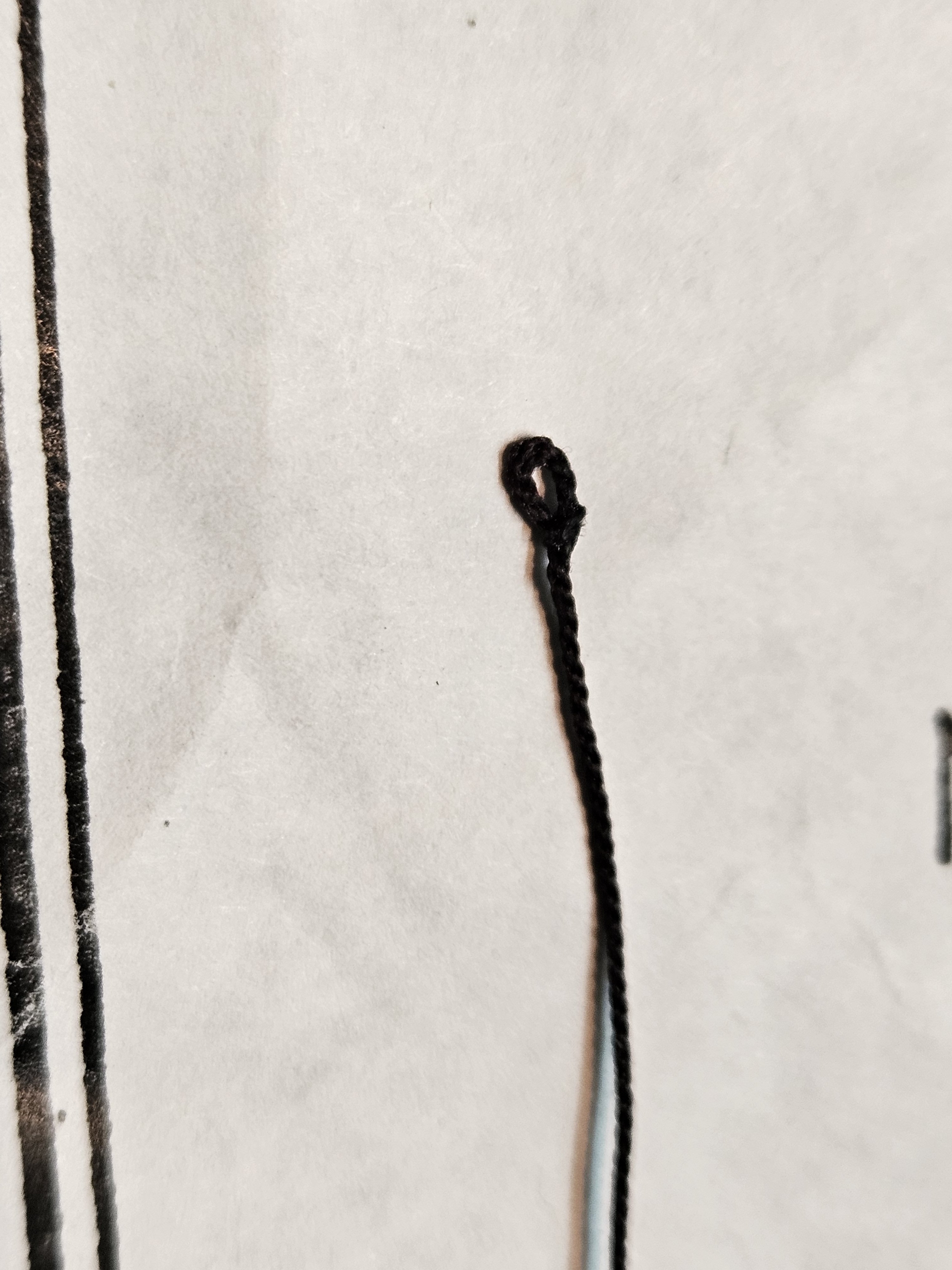

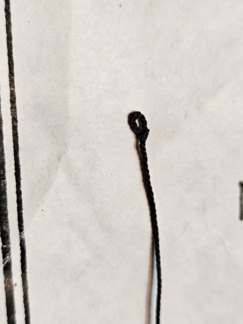

Next, I went ahead and served some 0.012in rope with fine black thread of about 0.008in. So after serving it's about 0.027in, and the instructions call for 0.025in - close enough.
I used tweezers to pinch the rope close to the length I needed, and it stays pretty well.
Then, seize it as close as possible so the thimble doesn't fall out.
With an eye on the opposite end, it looks pretty good.  Getting the length right was really challenging to estimate, since it needs to loop over its own eye and hang and the right length.
I finished it by painting the thimble black. It will be somewhat covered with lashing later, but still want it to look right.

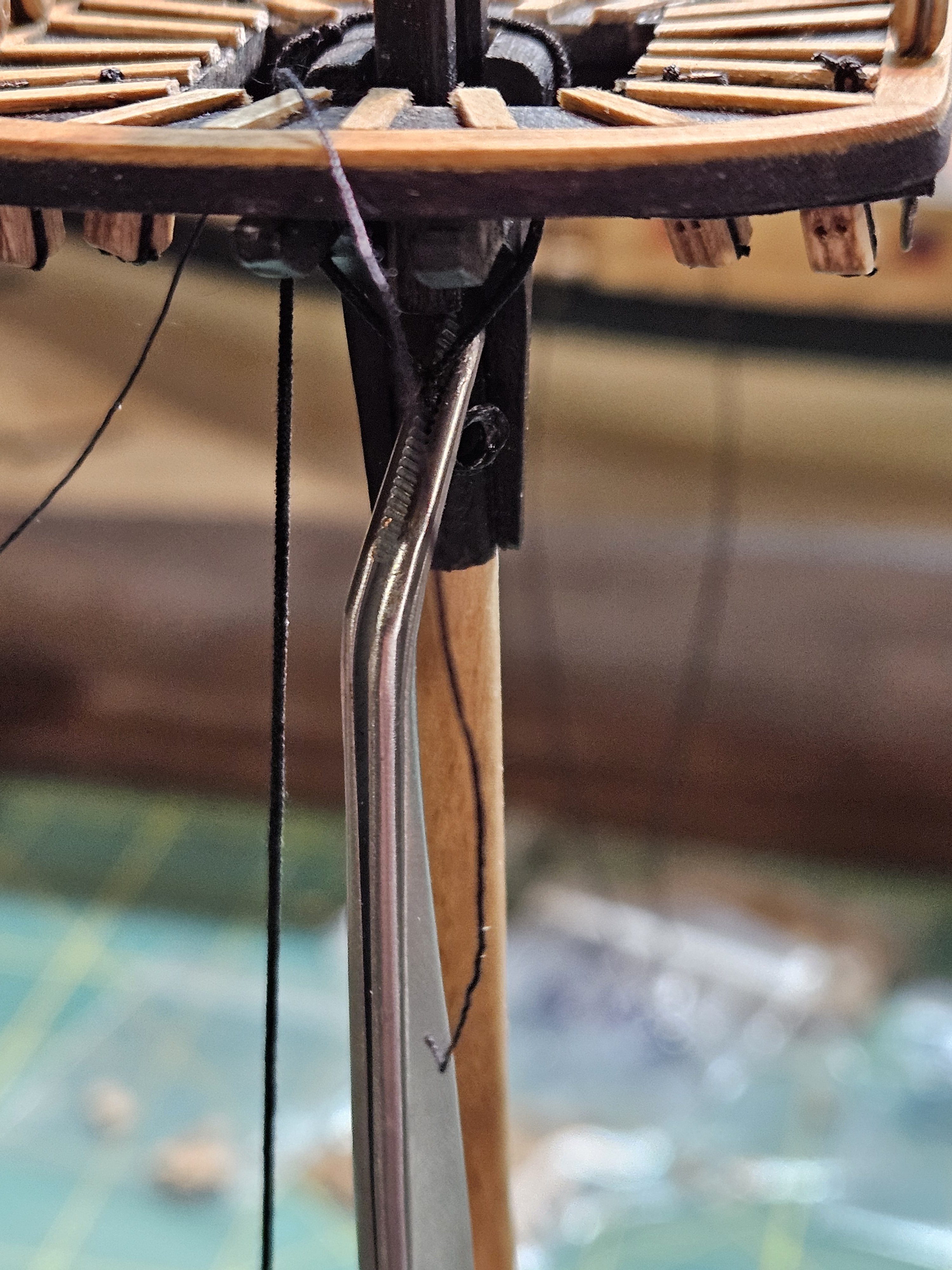

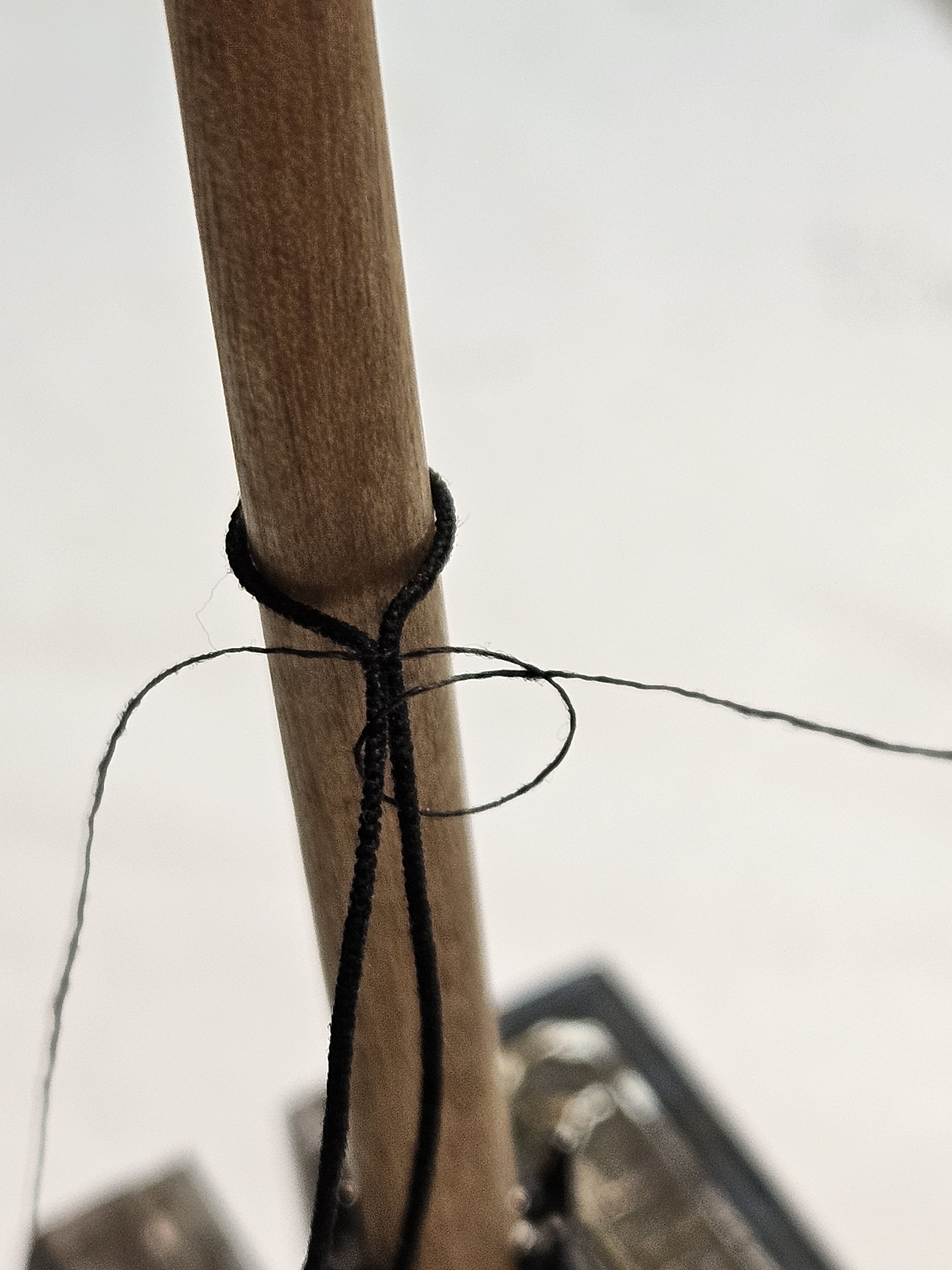

Now it gets tricky, and tight - the main reason I'm doing it now. I wrapped it around the mast, so that it hung in the front properly (centered), and held in place with tweezers.
The yard will be lashed right there, so I held it in place for an eyeball location reference.
I used reverse action tweezers on the long end to hold the rope taut and in place. I used a fine needle to start the thread to secure it.
I did two seizings in black. It kind of blends in, but its the same as the plans show.
20250201_132103.thumb.jpg.7661da8c382e4da8e43345d11f691097.jpgta
Over all I'm happy with the yard sling, especially the thimble - now I know how to make it.

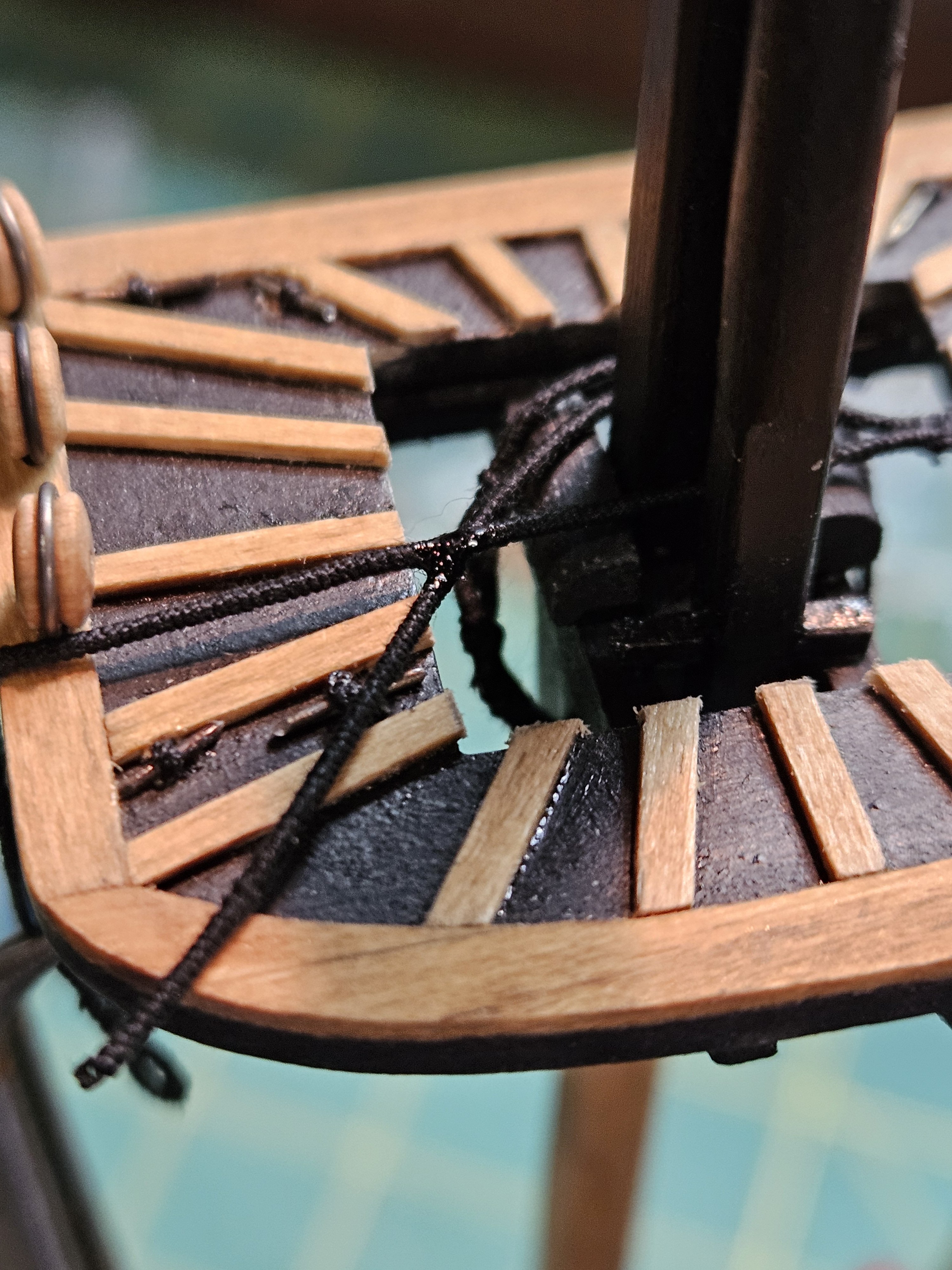

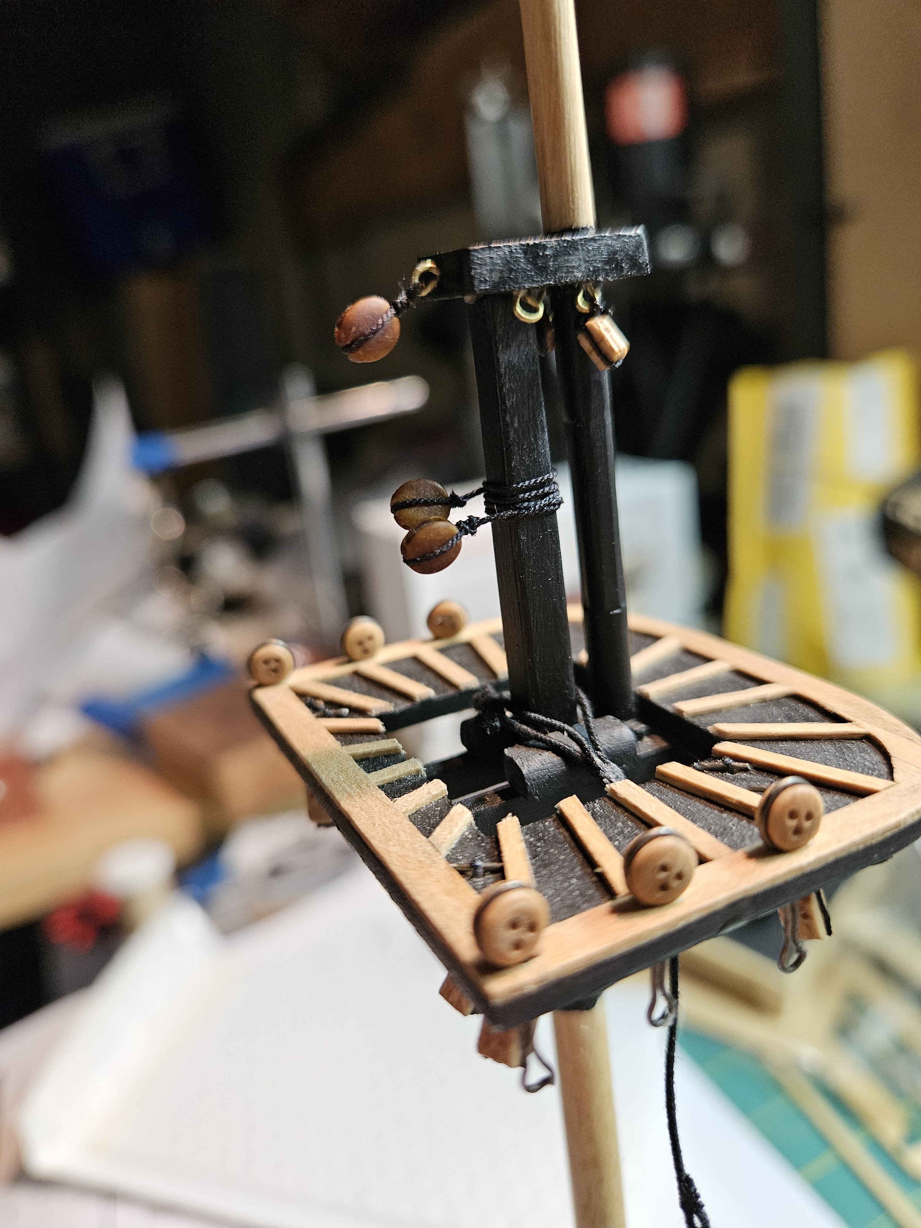

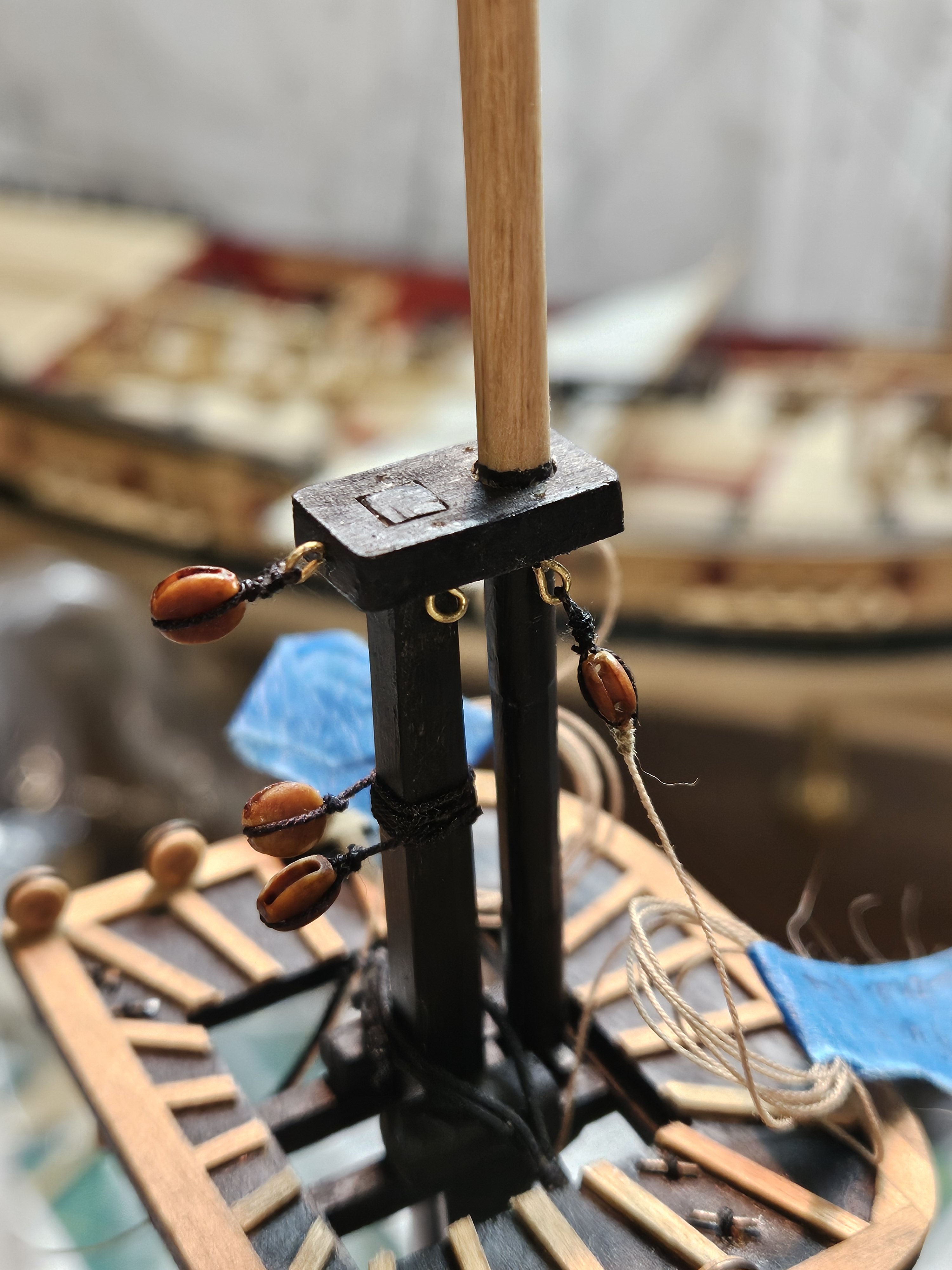

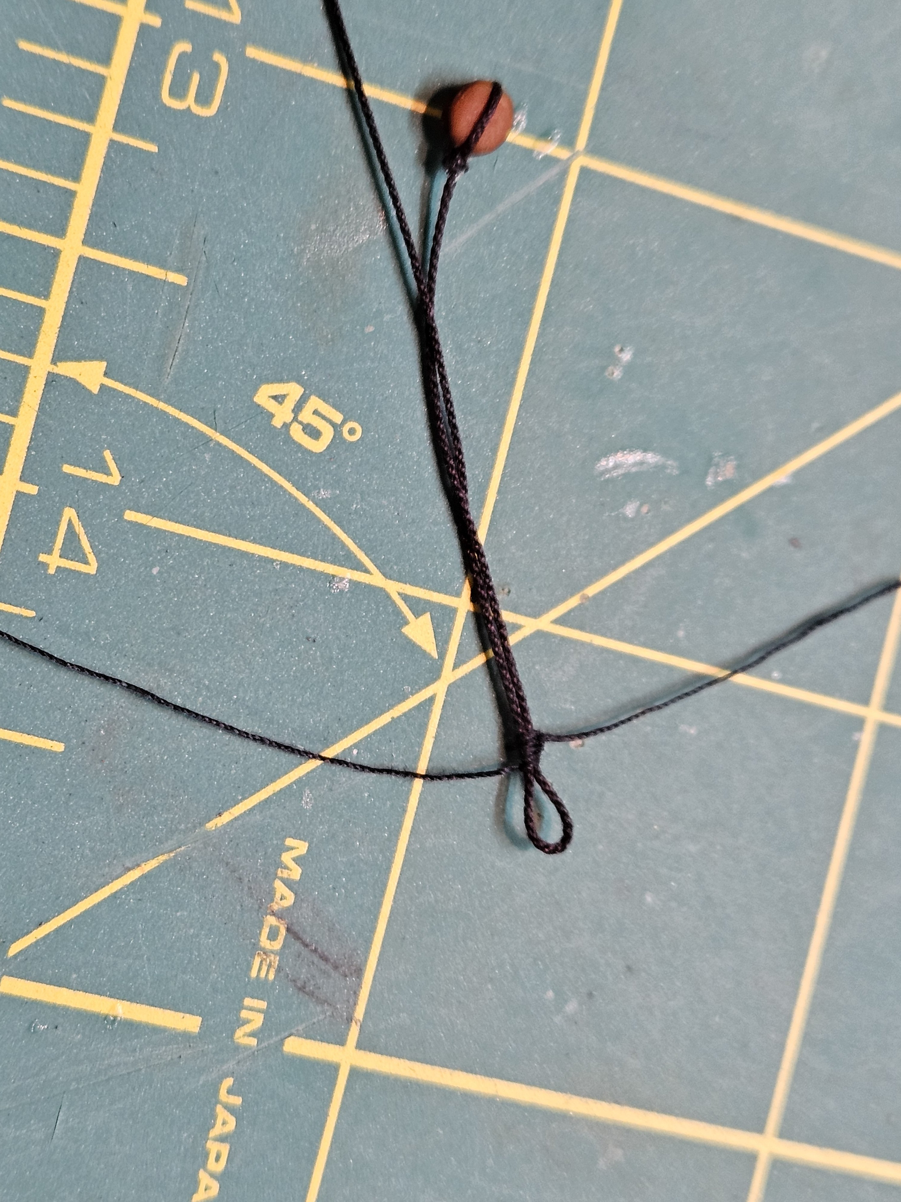

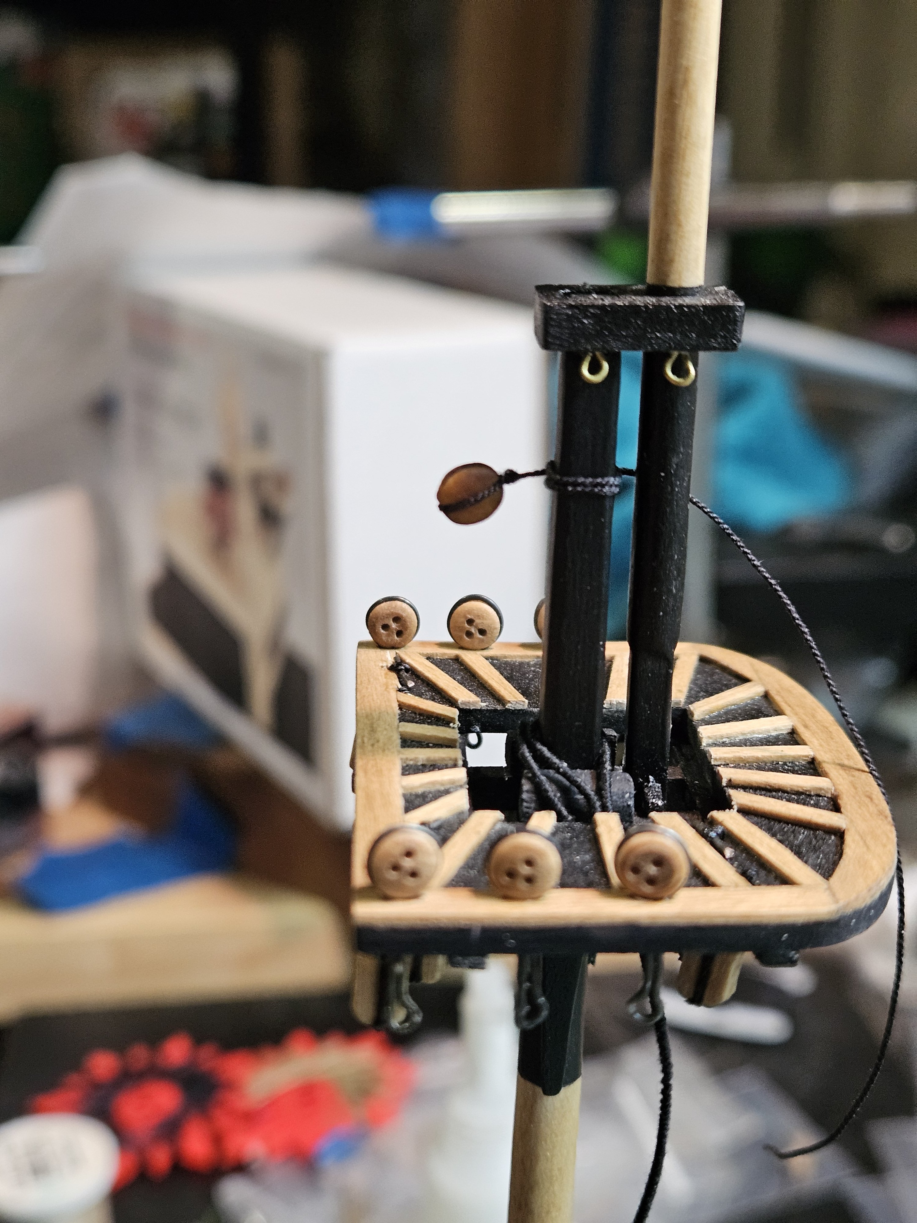

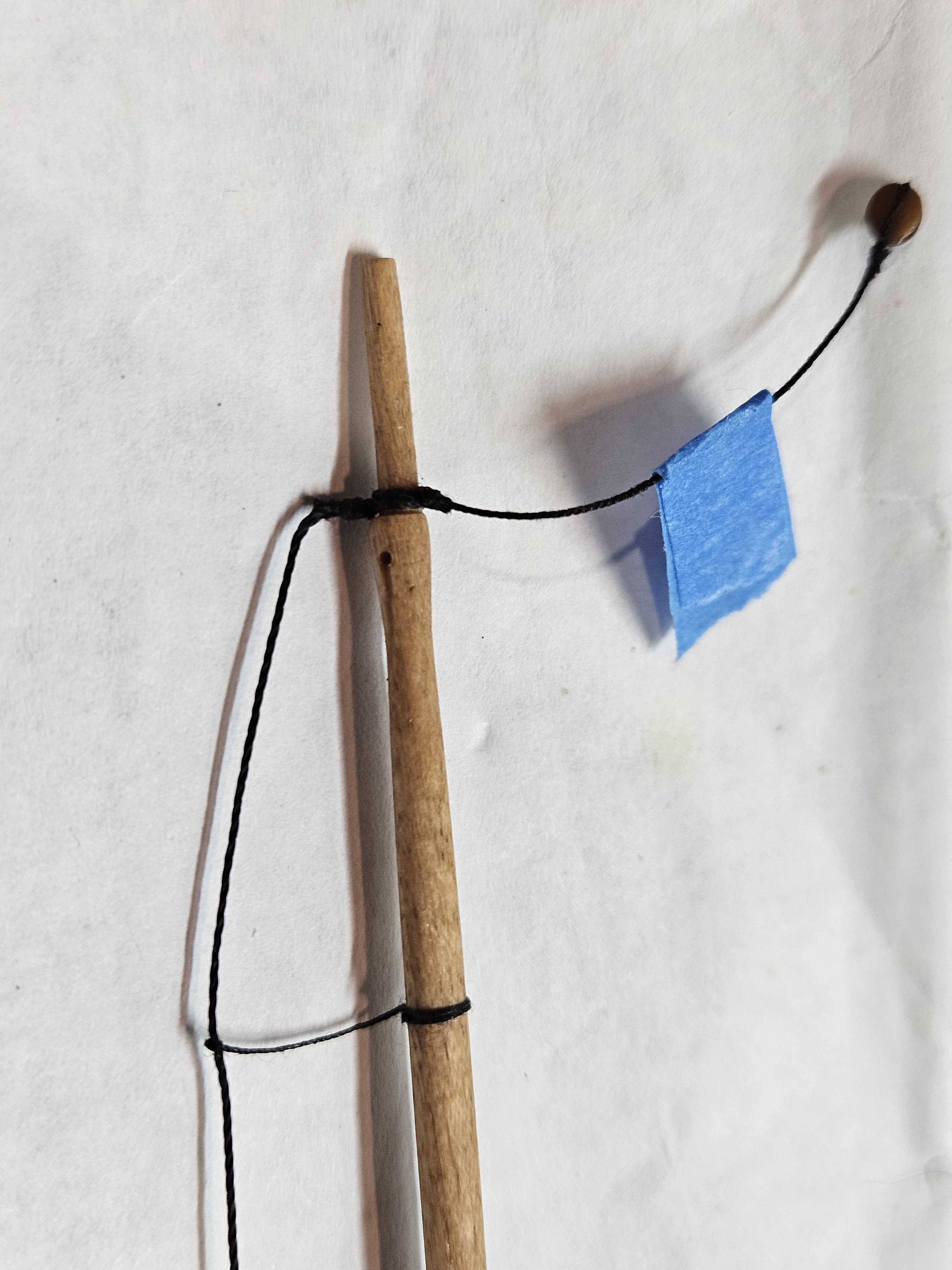

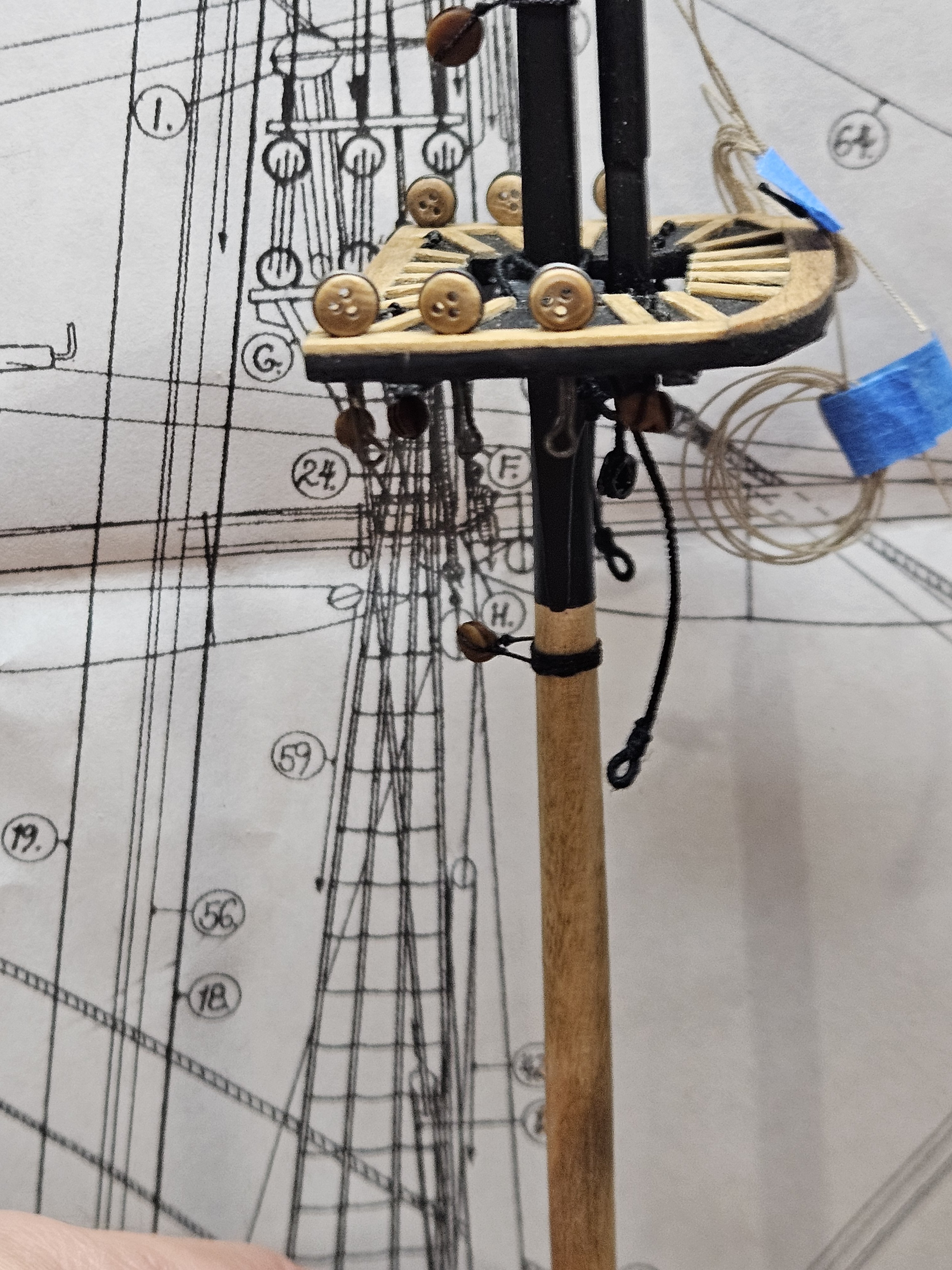

Continued progress on the Fair American:

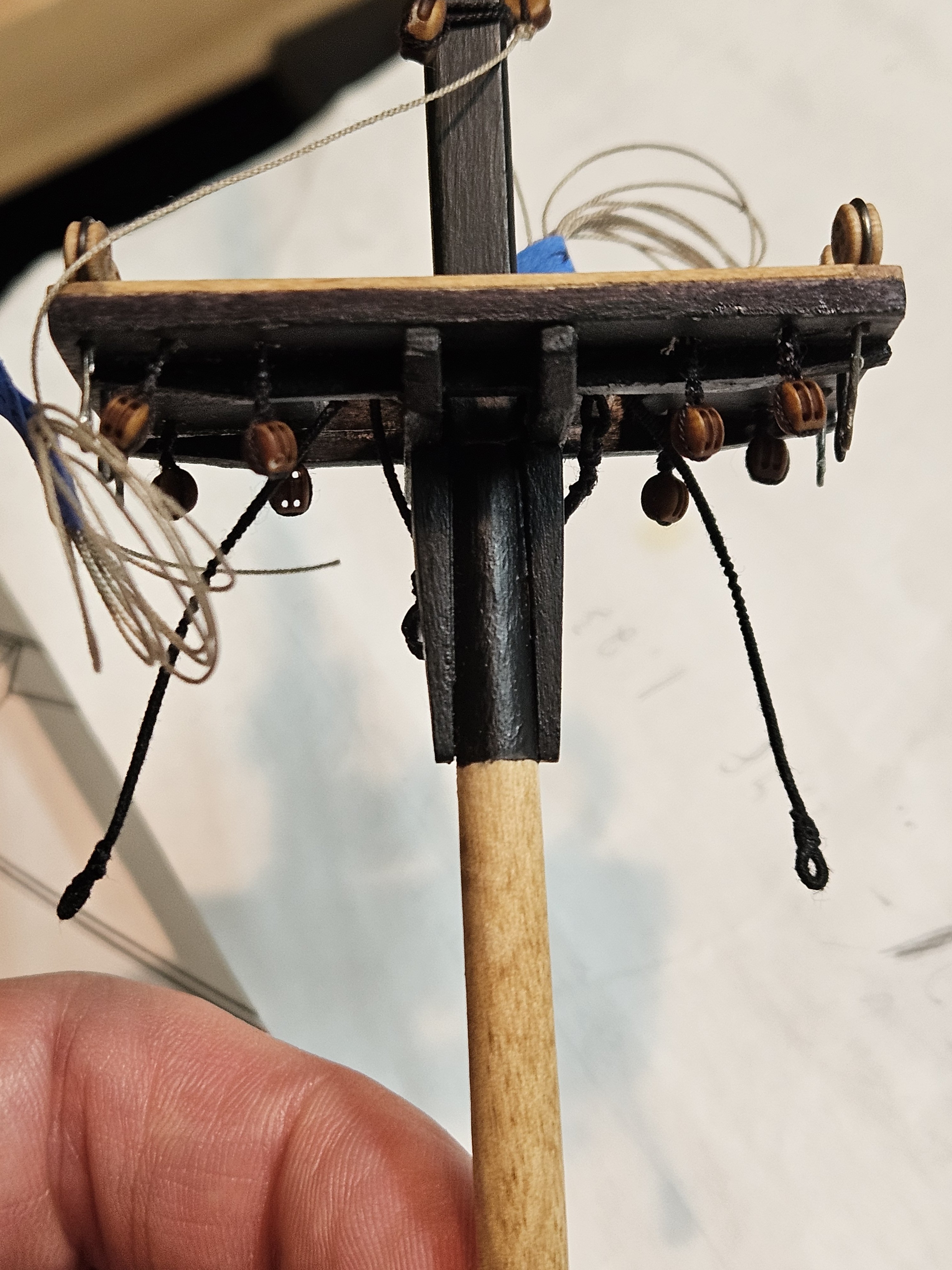

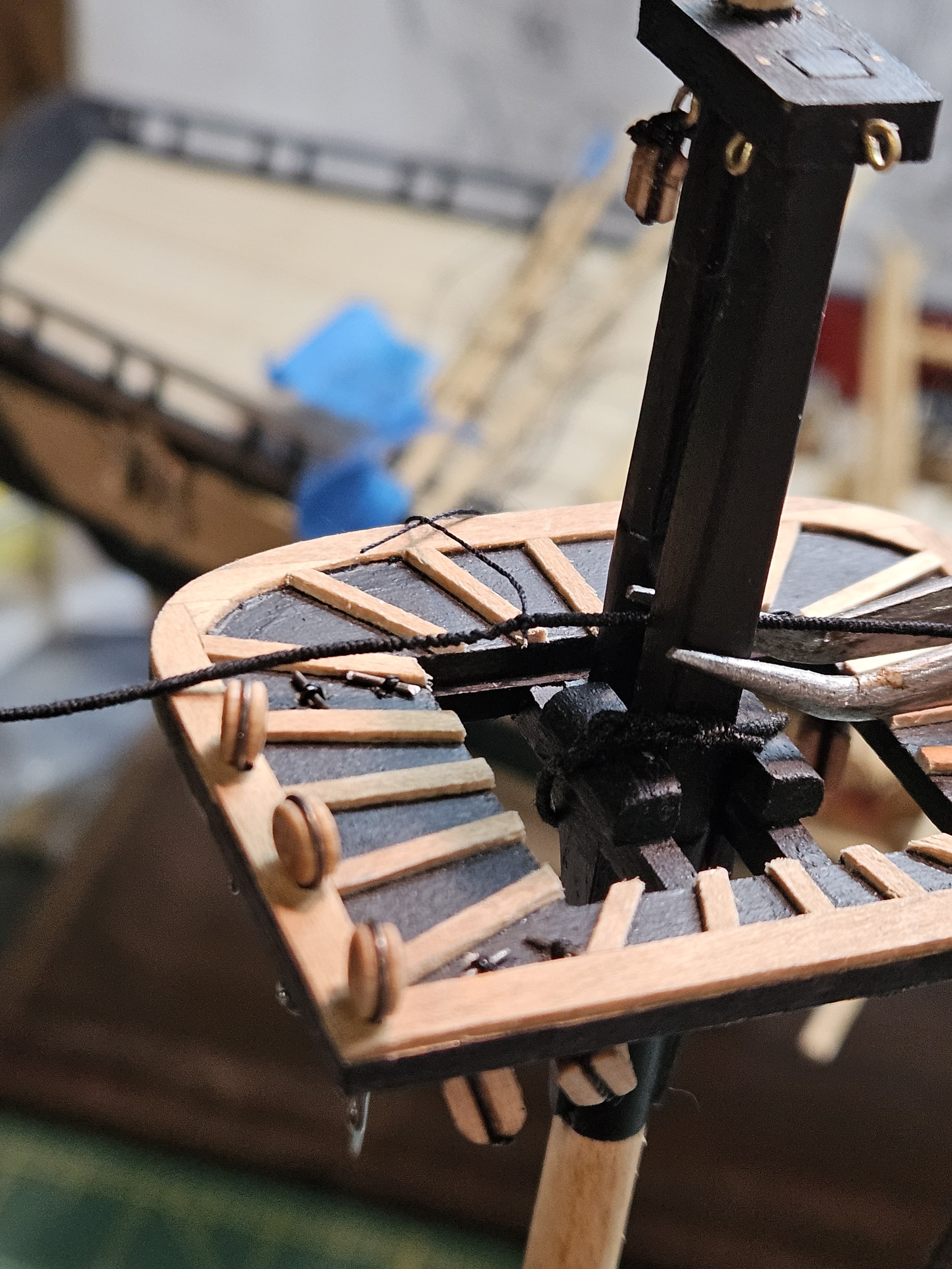

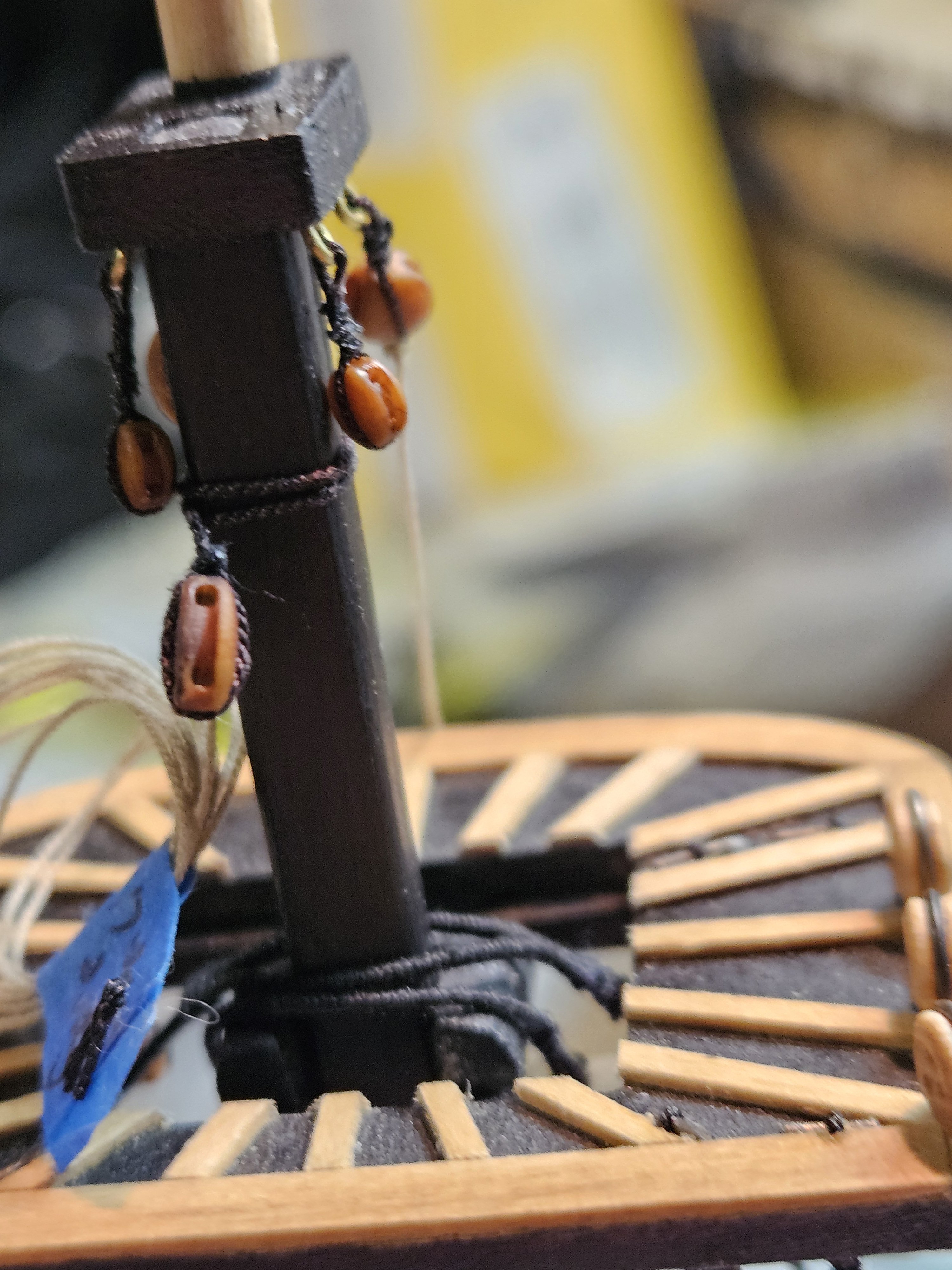

As mentioned previously, the mast tackle pendants needed to be added now, before any other rigging is going to be in the way. From the instructions, these are to be 0.025in served rope, and are seized into an eye around the mast head. No real idea of how to do this, so this is my take.

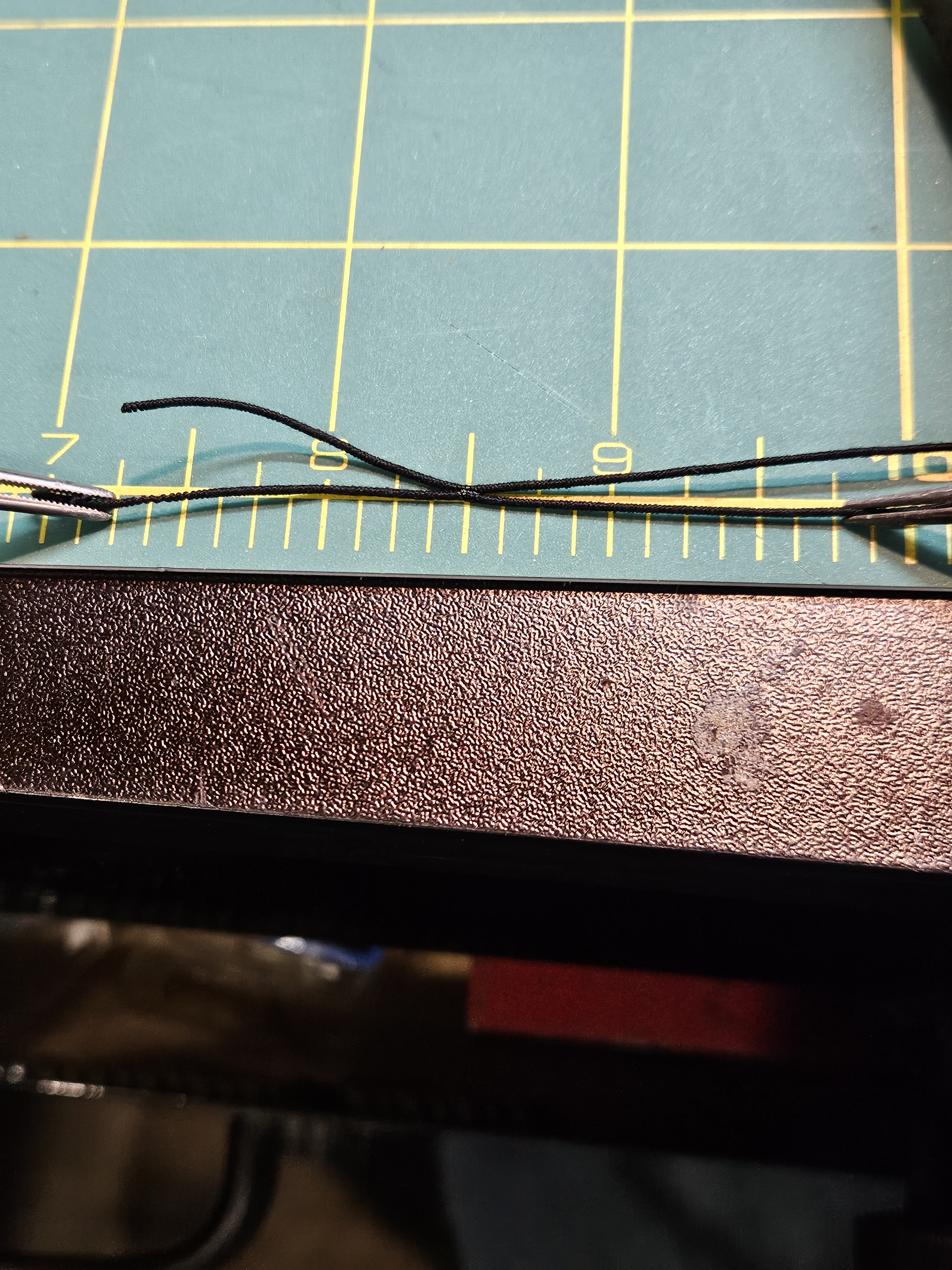

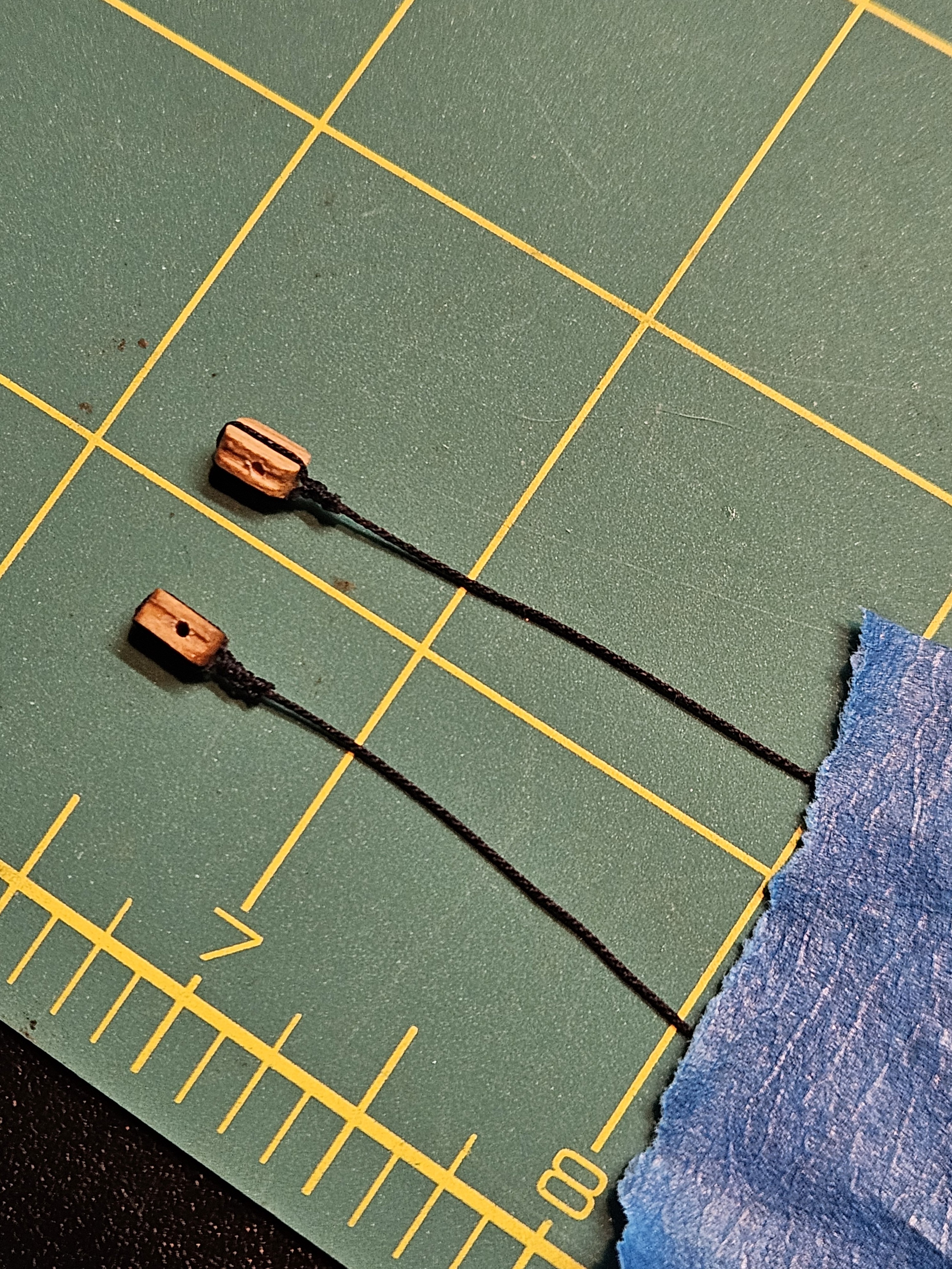

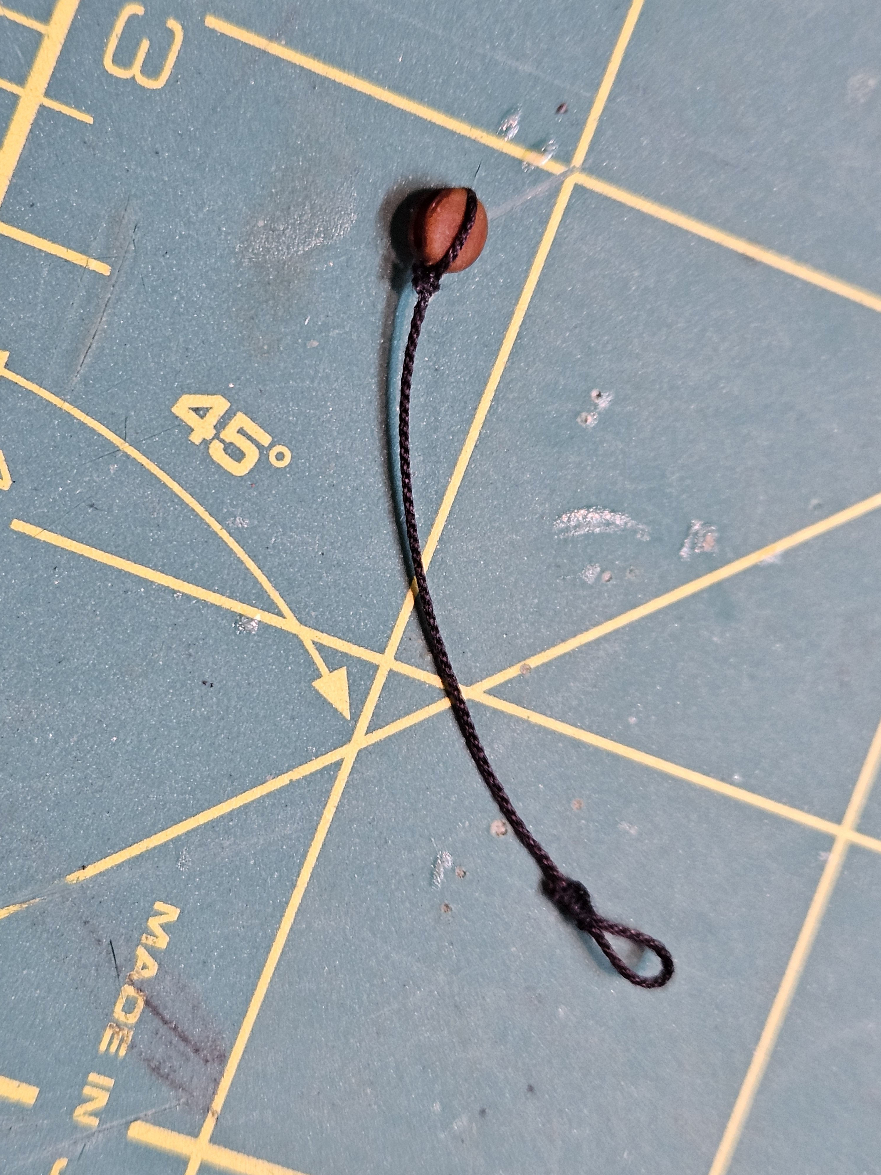

I started with using .012in in rope, and serving some long lengths with 0.008in black thread, which makes ~0.028in size. I used my little jig to form the eyes first, with long running ends to work with later...
I went pretty close to the end of the serving, where you can see the knot close up. I'll trim this off after it's secured with thread.
As always, I do as neat of a job as I can manage, and trim...

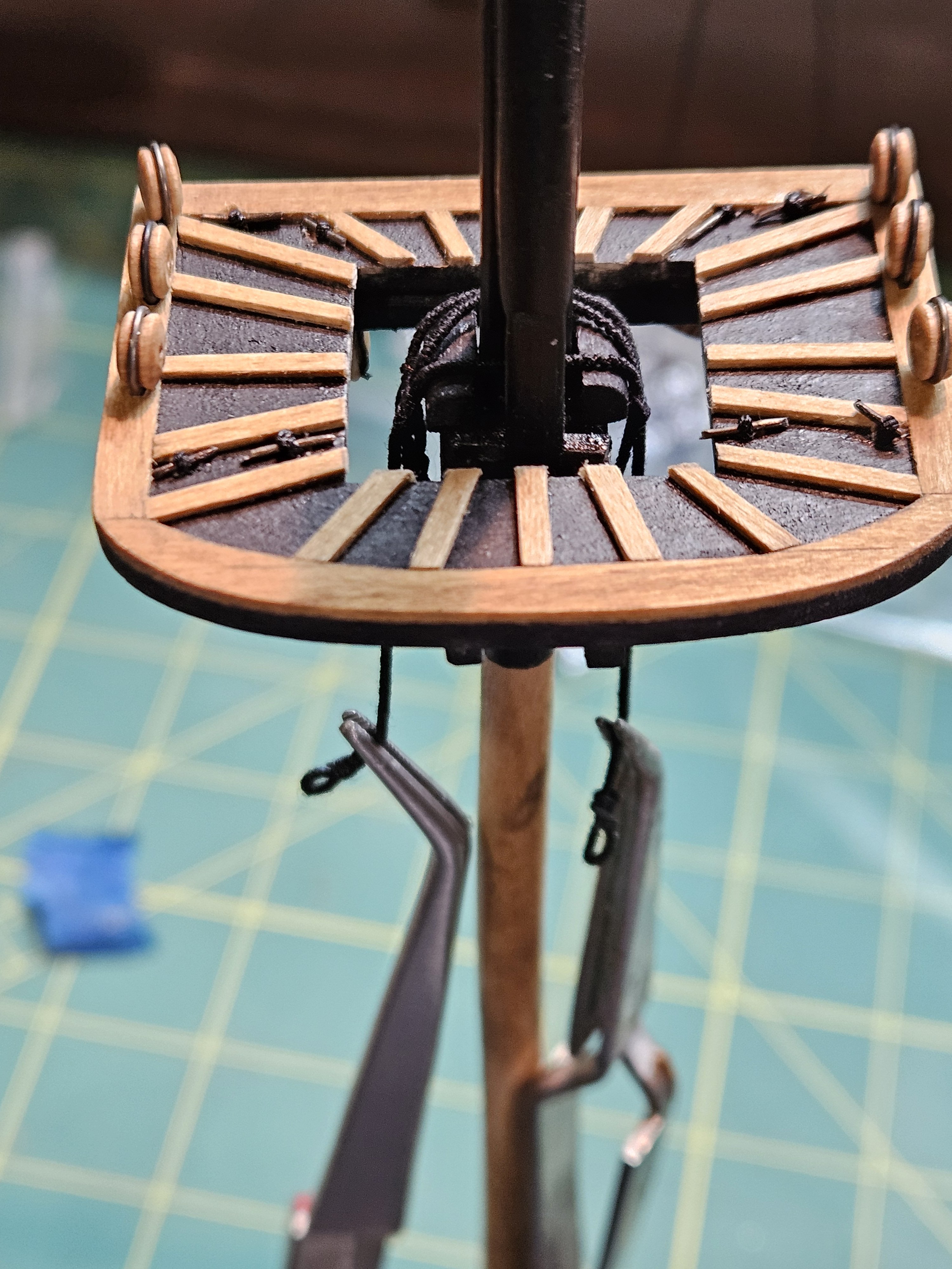

Using the pinch tweezers, I'm able to hold the pendant in the approximate spot hanging down, according to the plans.
I started some black thread in a spot where I could attach the other pendant rope to, also making sure it hung to the correct length. The serving started to unravel a little bit, even though it was dilute-glued as per the serving machine's instructions. Not much I can do about it now. It just happens.
Now off the model, I could finish securing this side of the eye with thread.
Again, I'm leaving the tail end long so I can work with it on the model next.

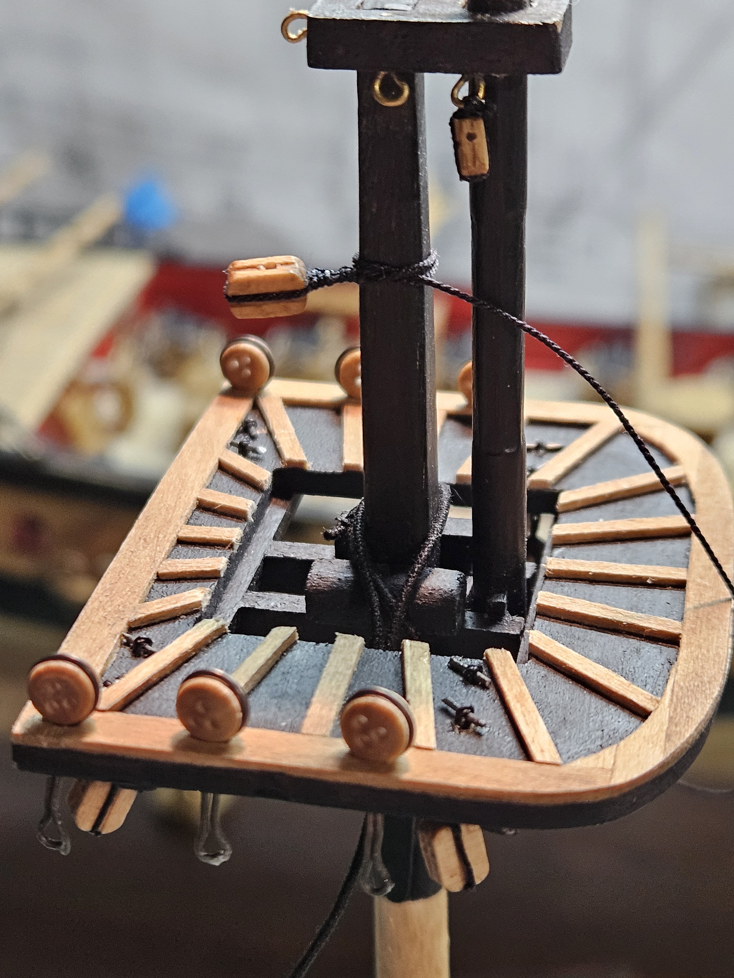

Now wrapping around the mast head, bringing the port side of the 'mast eye' as close to the mast as possible. The tail end I crossed over close on the starboard side.
The best approach I could muster, without pulling my hair out, was to 'tack' with CA glue, and let it dry.....for a LONG TIME, before handling it.
Once the glue was dry, I could start using the thread to finish the eye, as neatly as possible. I'm not sure how this is meant to be done, but this is my method, which worked well for me.
Couple of stacked turns and knots got the job done.
With some plier smashing and glue, trimming, etc, it forms a relatively neat knot
Tucking the pendants back through the hole in the top yields a very attractive profile, if I do say so myself.
Lastly, using pinch tweezers to hang the pendants so they're not so stiff. I'll leave them overnight to settle

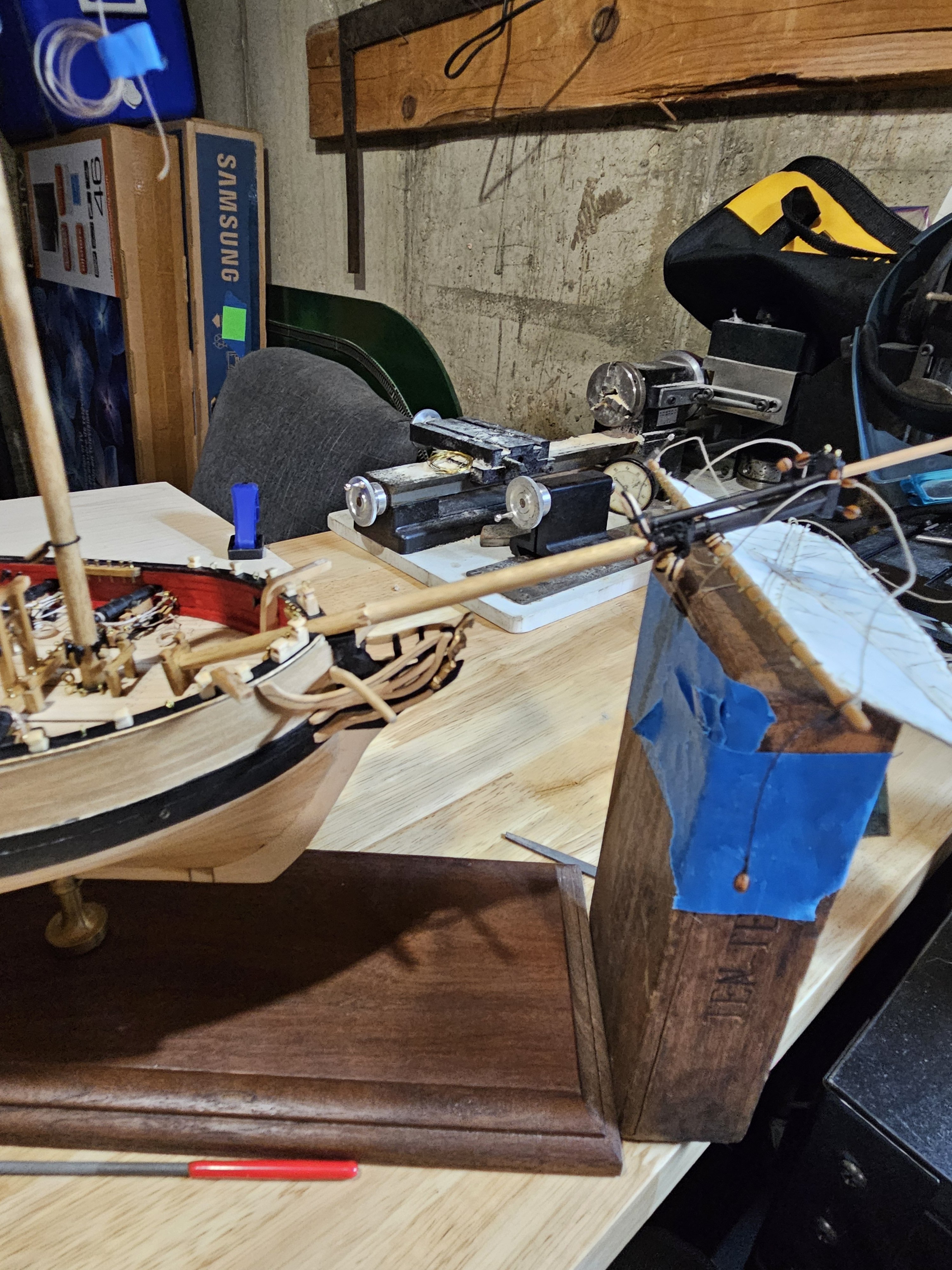

Displaying the Fair American at 42nd Annual Joint Club Conference in CT...
I decided to bring my mid-build model to the conference this Saturday.  Fellow model ship buddy Cisco will be there too.
It actually fits in the original kit box pretty nicely - I'll be zip-tying it down to keep from moving, and I'll have the Bowsprit, Main and Fore mast tucked inside for traveling.
The remaining/loose yards I've taped to a white carboard sheet to display nearby. They'd be all lonely by themself if I left them at home.
Not museum quality, obviously. It's meant to look mid-build, and I'm proud of the work thus far, so I'm bring it along.
I mostly worry if it'll survive the car ride up. Fingers crossed!

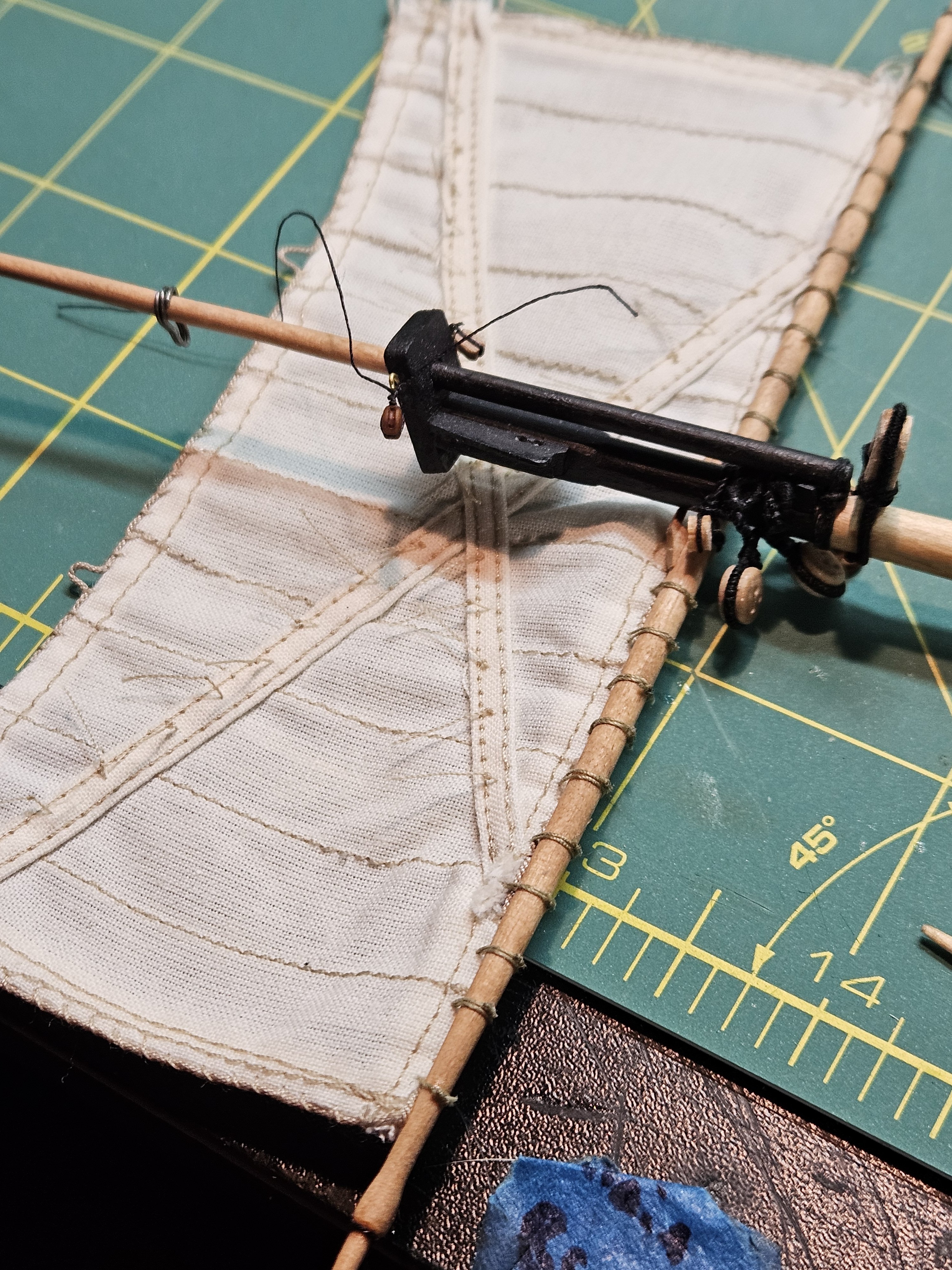

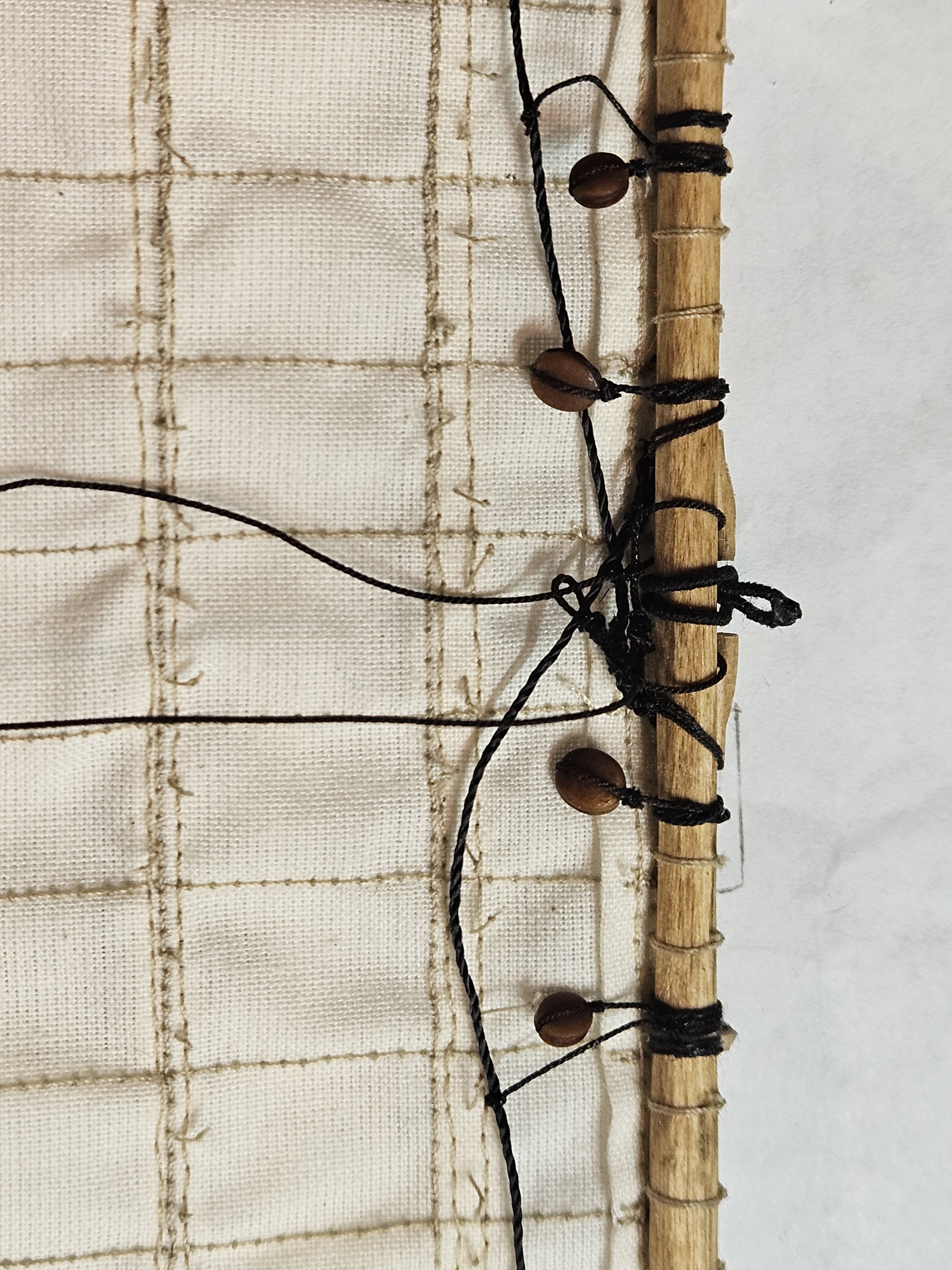

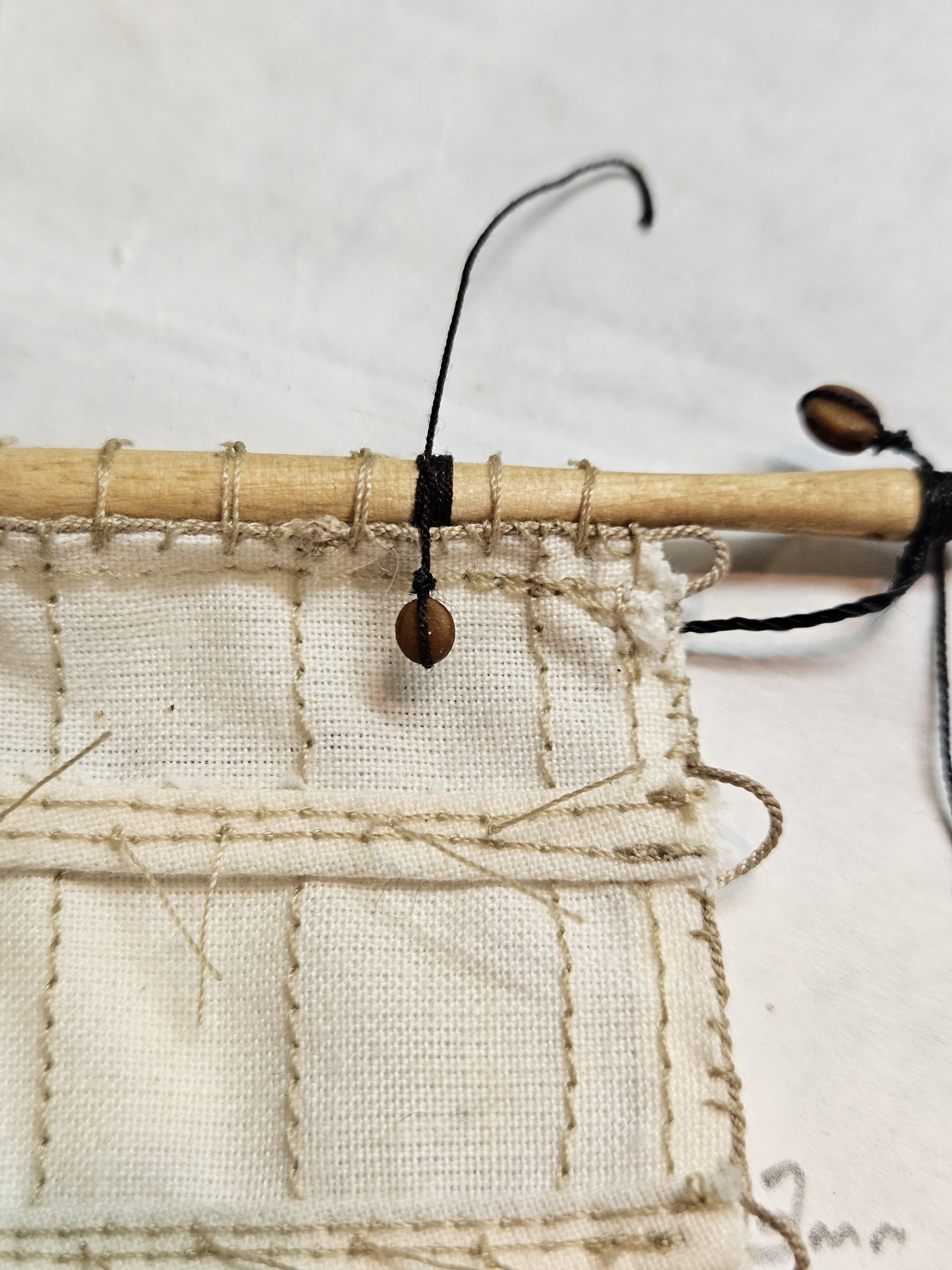

Progress on the Fair American
Its been a while since my last post - I wanted to include some back detail on the Main and Fore Lower yard and sails, which happened before the Conference.

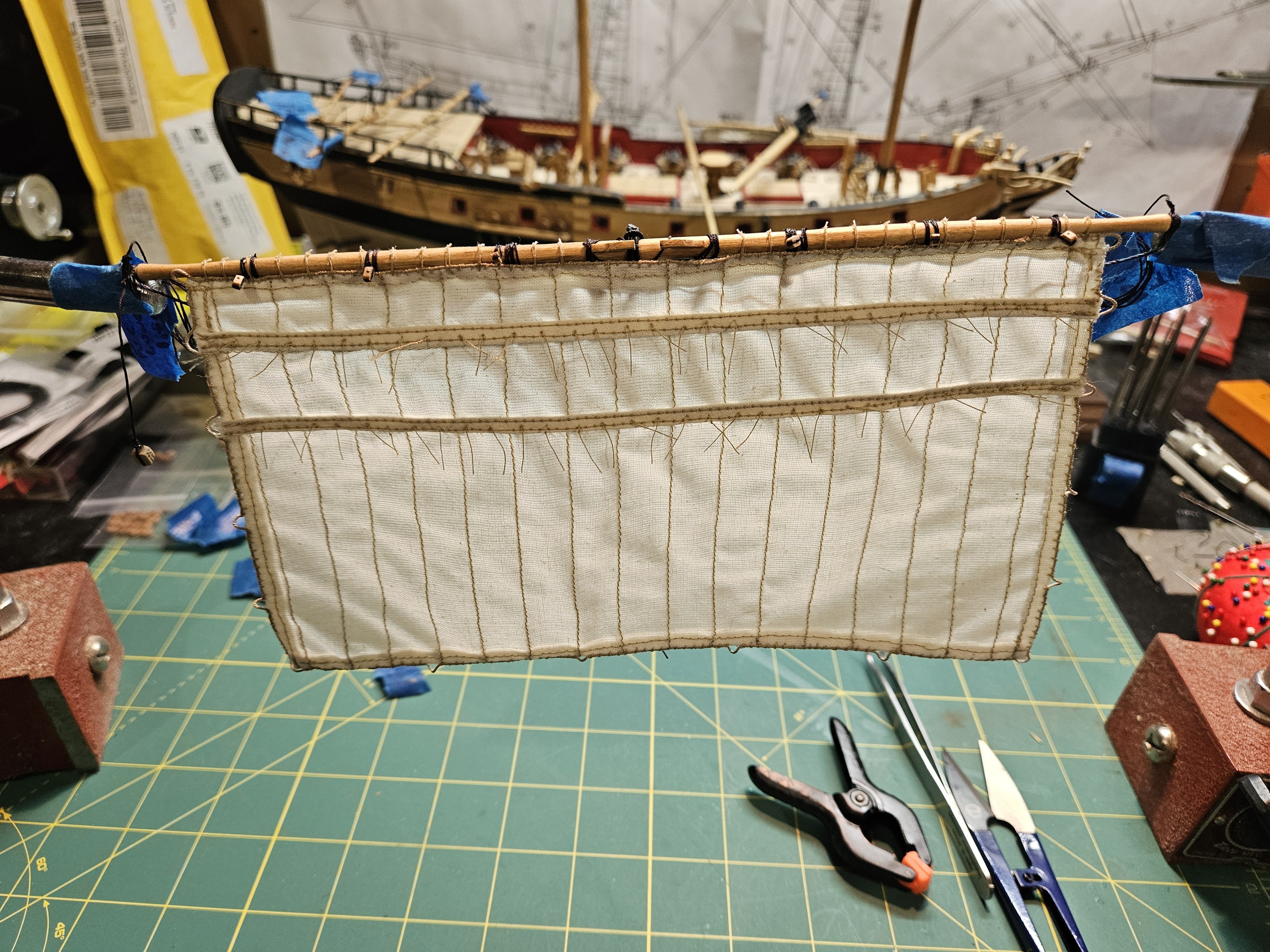

In short it went well. Of course it rained on the day, so had to get creative on how to cover things without breaking them, but I got all set up. First time displaying my ship felt pretty good - not museum quality, but proud to have it there anyway. Fellow modeler Cisco set up shop right next to me - his all Holly AVS is pretty impressive work, I have to say. Conference was better organized than when I went 2years ago. Having talks and demo's in a separate room and distinct times made the day go smoother. The last 5min packing up was the most attention I got. Several people apparently were building this ship, or had. Greg Herbert, was kind enough to send me his two Fair American Instructions, and suggested I replace the kit blocks with some better quality ones. I have since started doing that - more on a later post

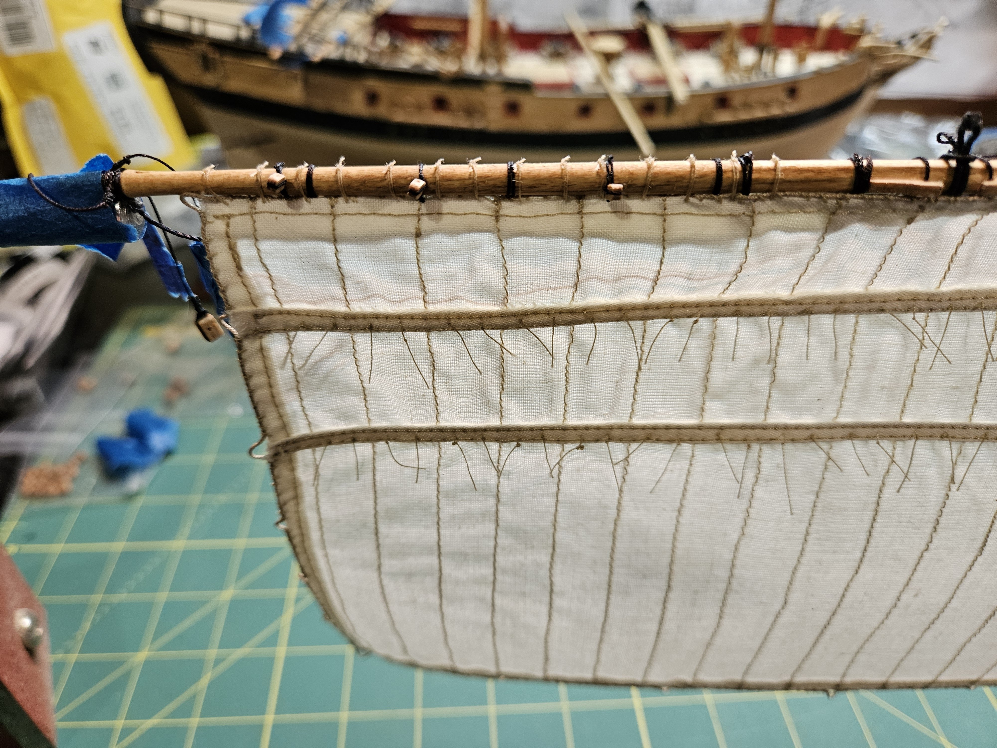

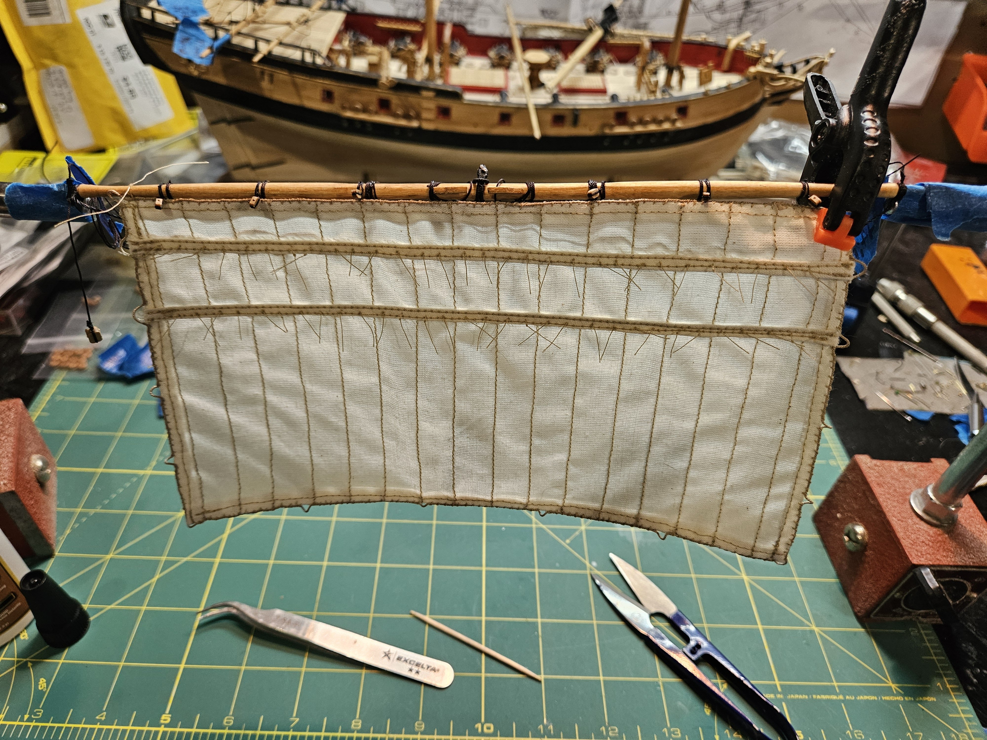

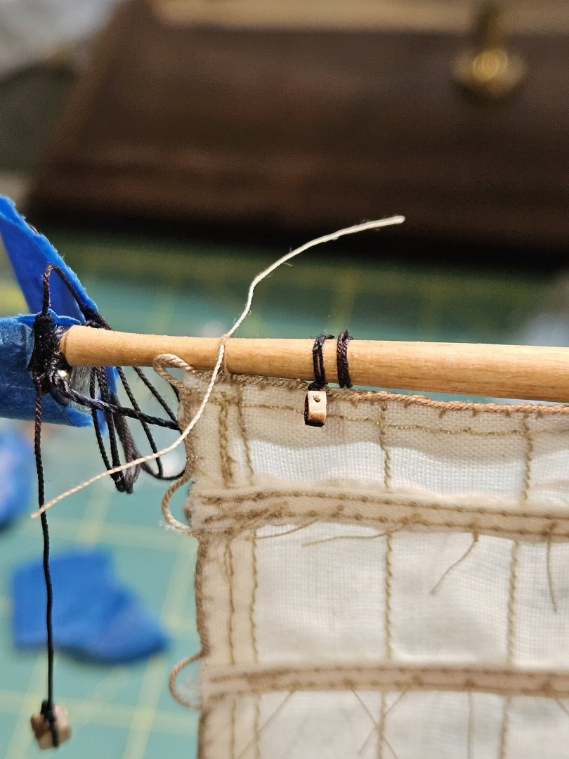

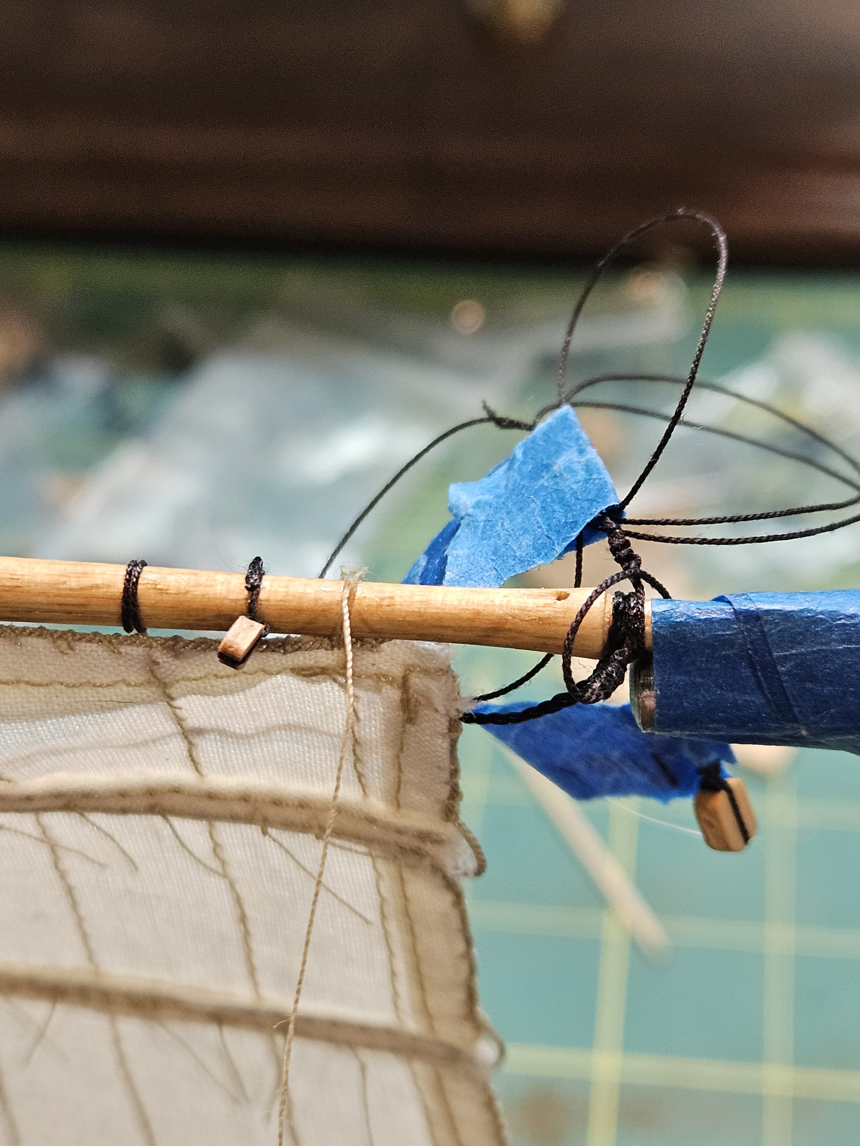

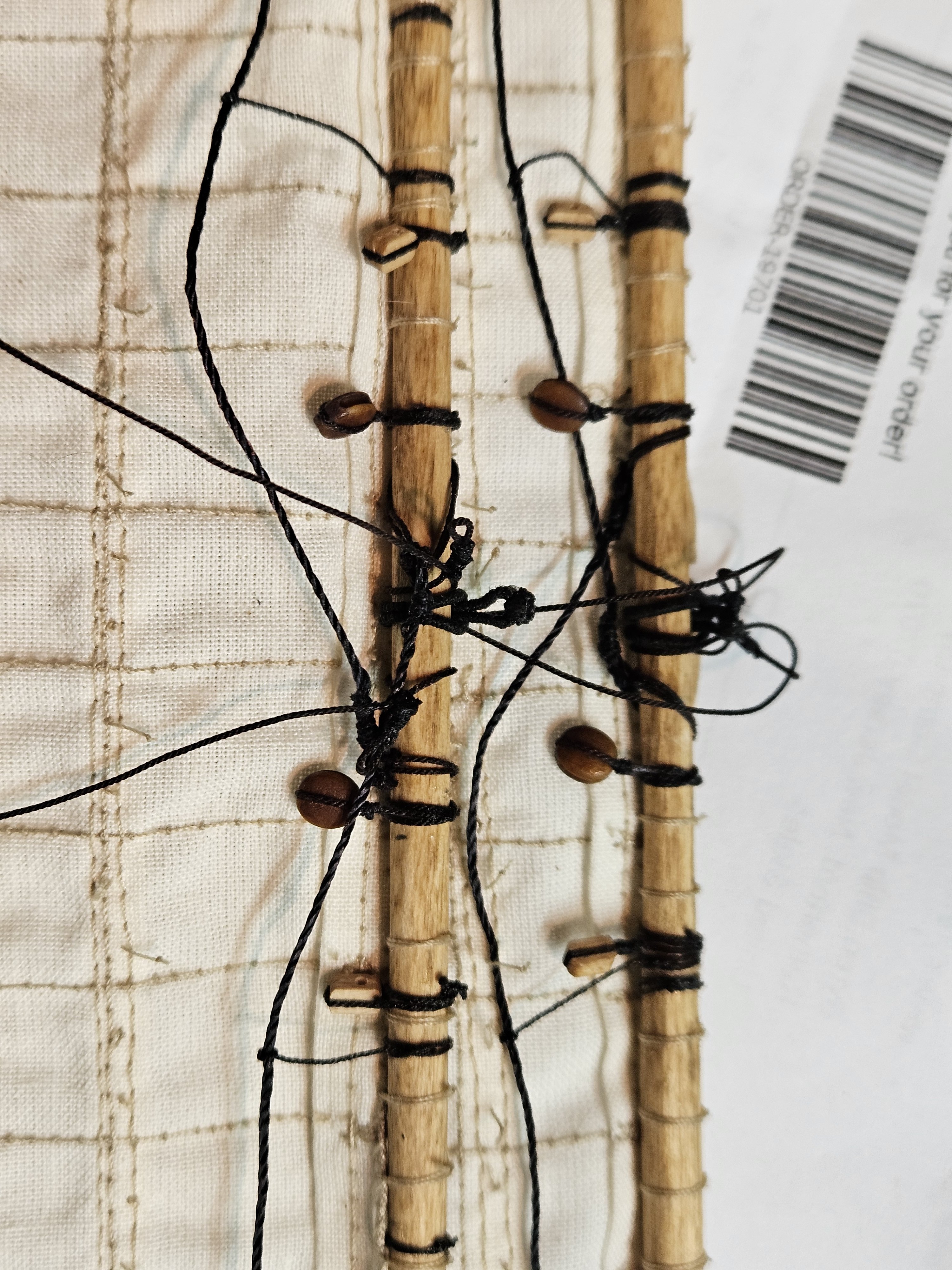

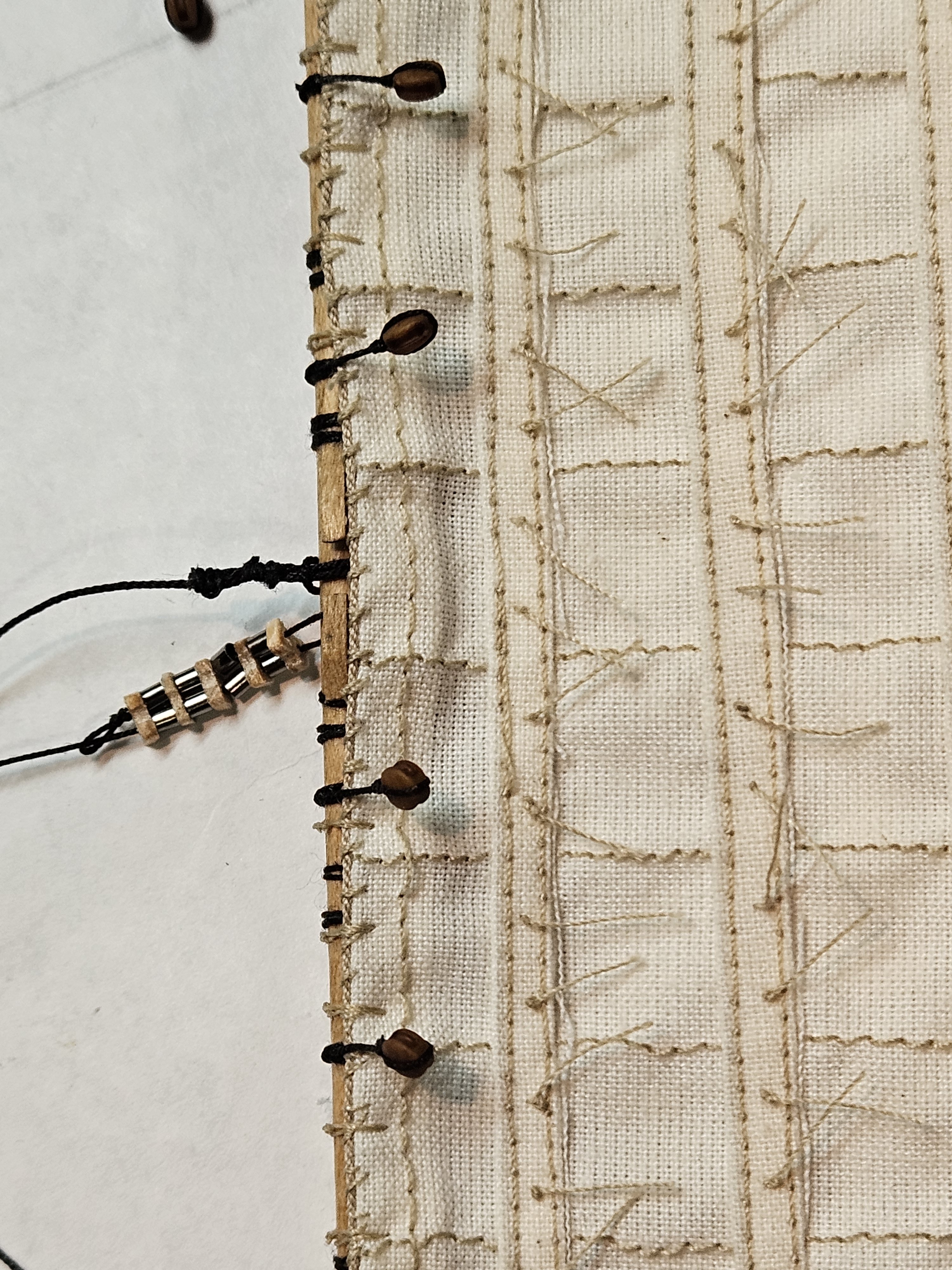

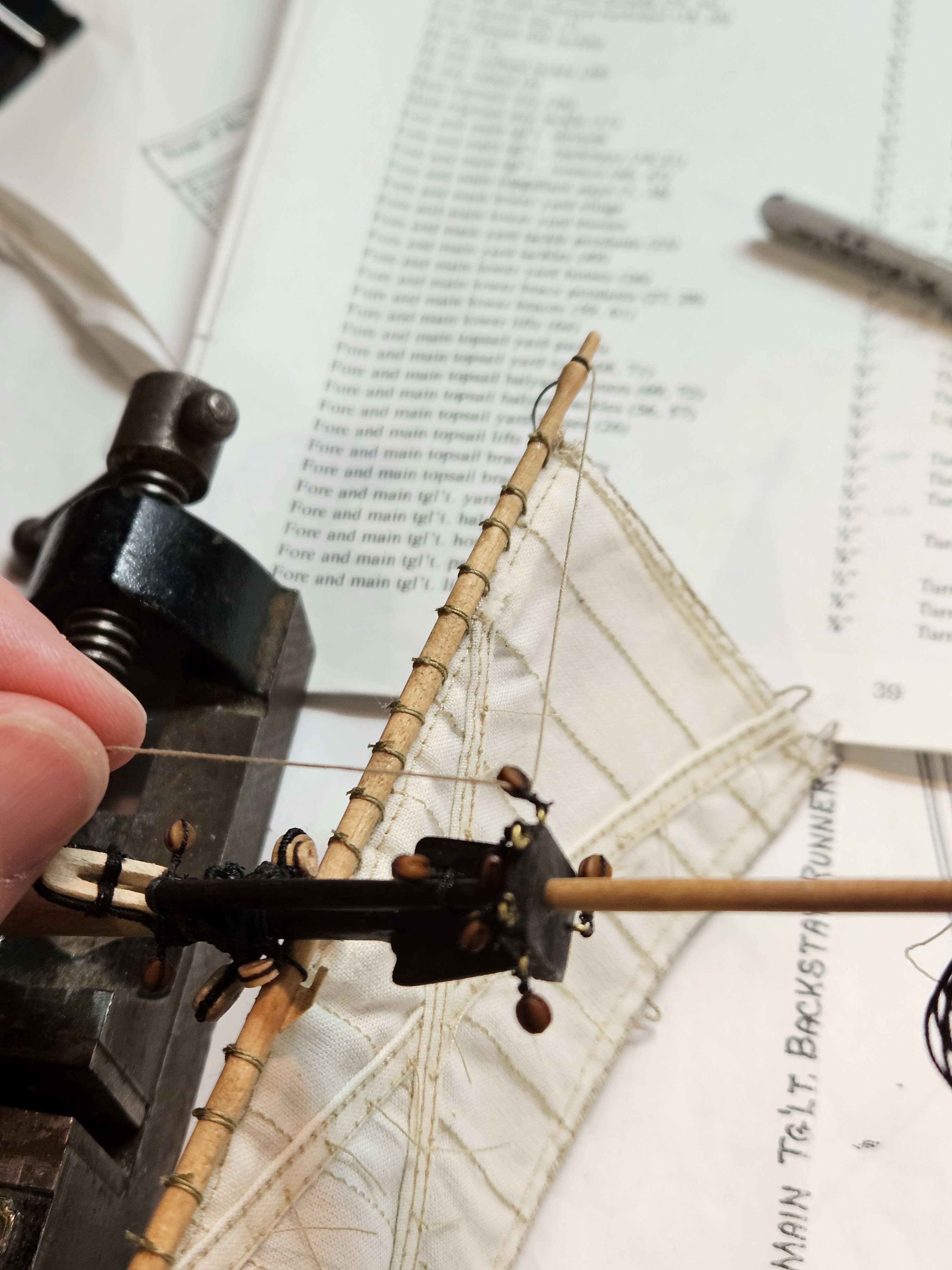

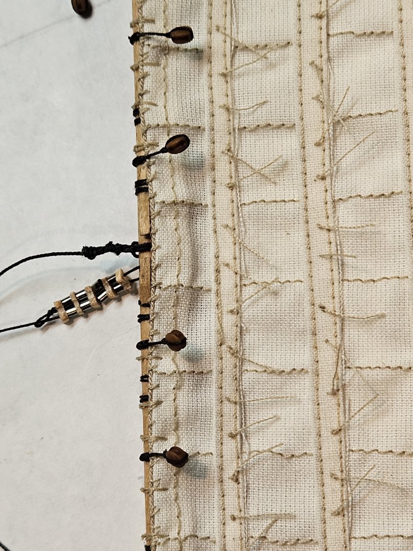

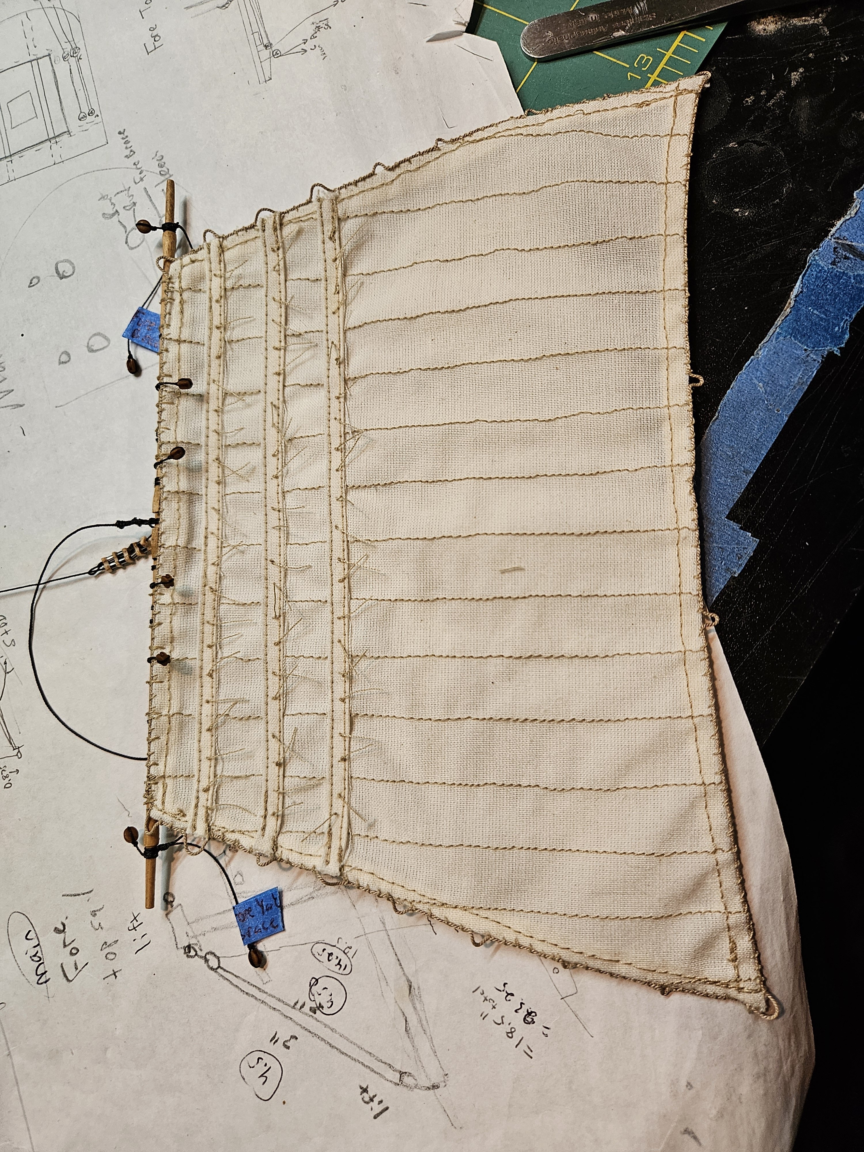

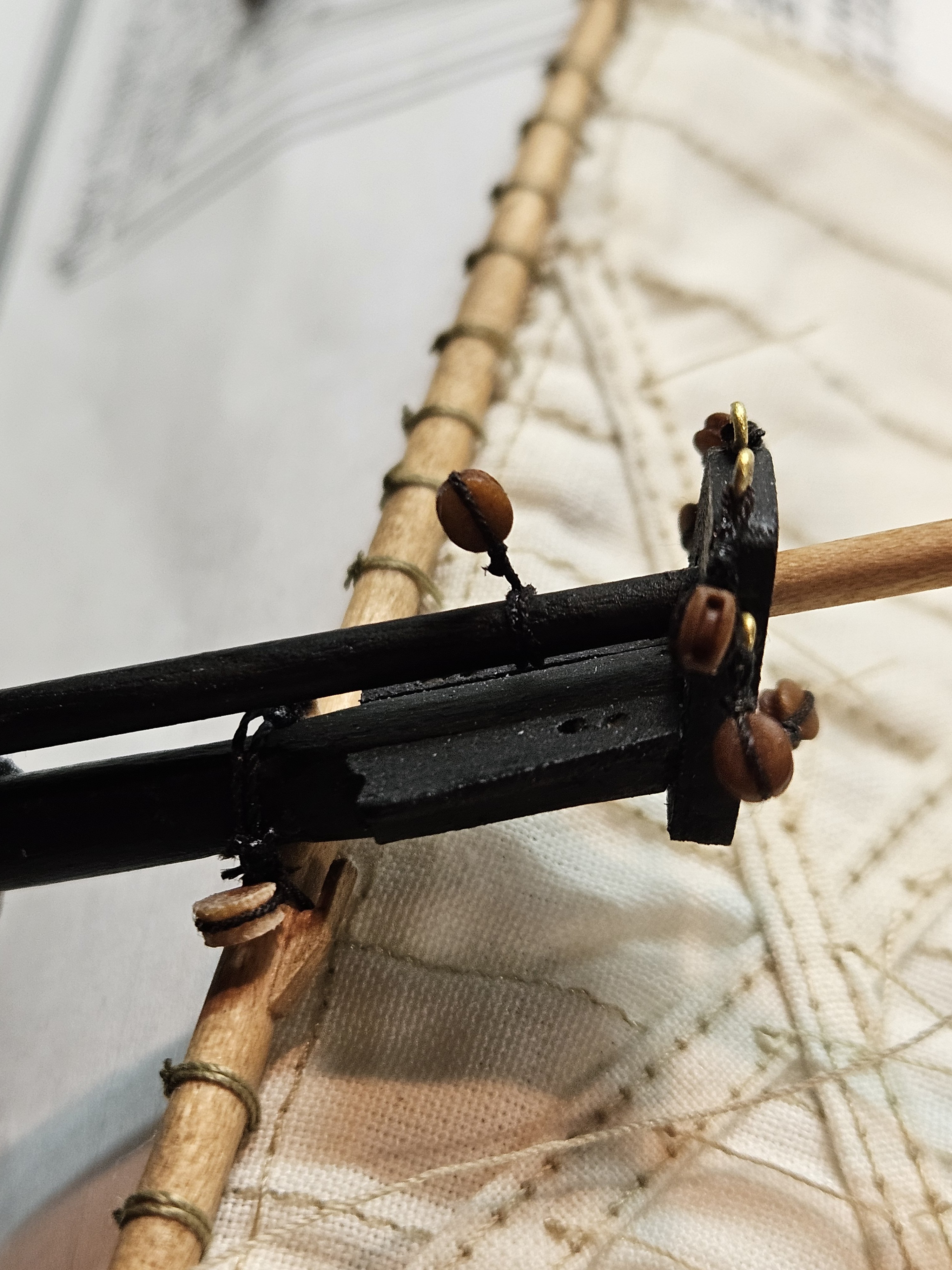

for the Main Lower Course, I held either end of the lower yard with some old magnetic lathe stands and some painters tape. Crude but effective.

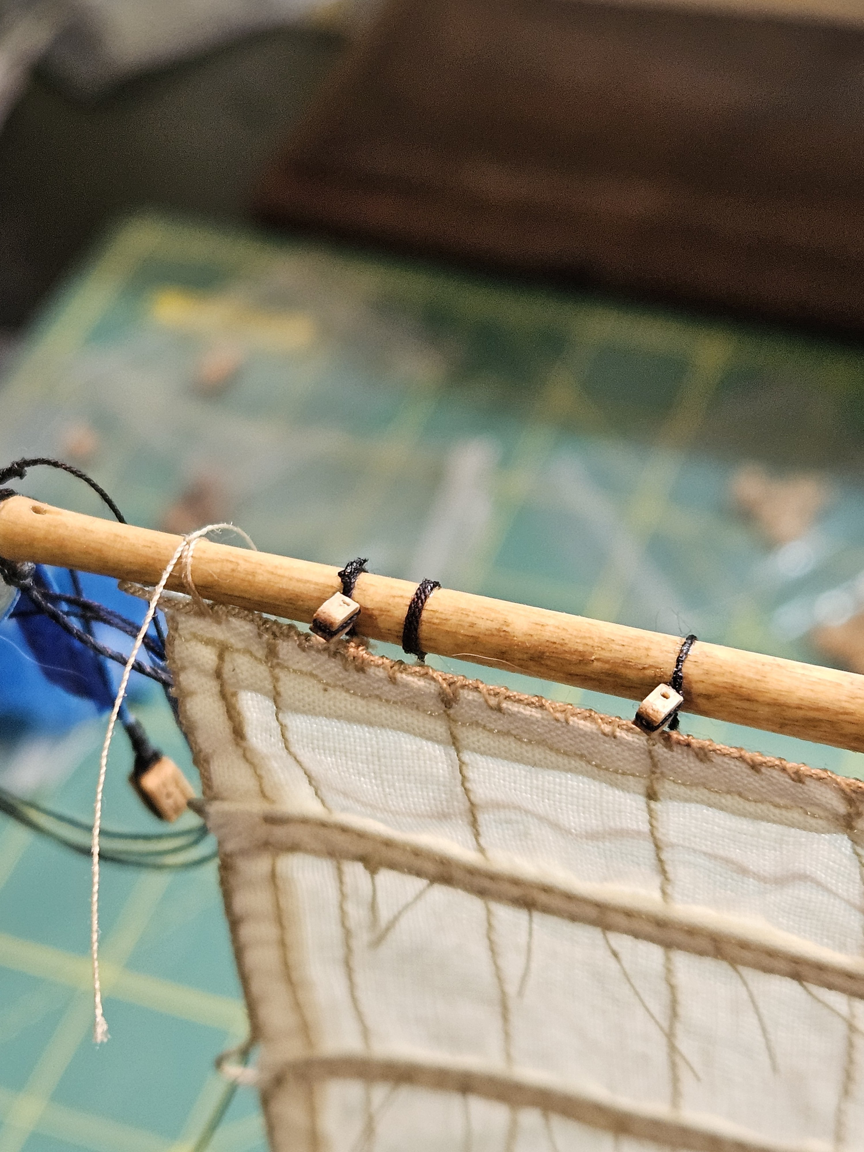

I'd star with tying a robband around one corner of the sail...
And then the other side. Now I have it suspended, and I can finish the robbands, working from either end.
I followed some illustrations of the robbands from Steele, where it showed two per strip of canvas. So that's what I did, using a needle to make 2 turns around the yard, through the same hole, and finished knot on top. Tedious, but I got it done.

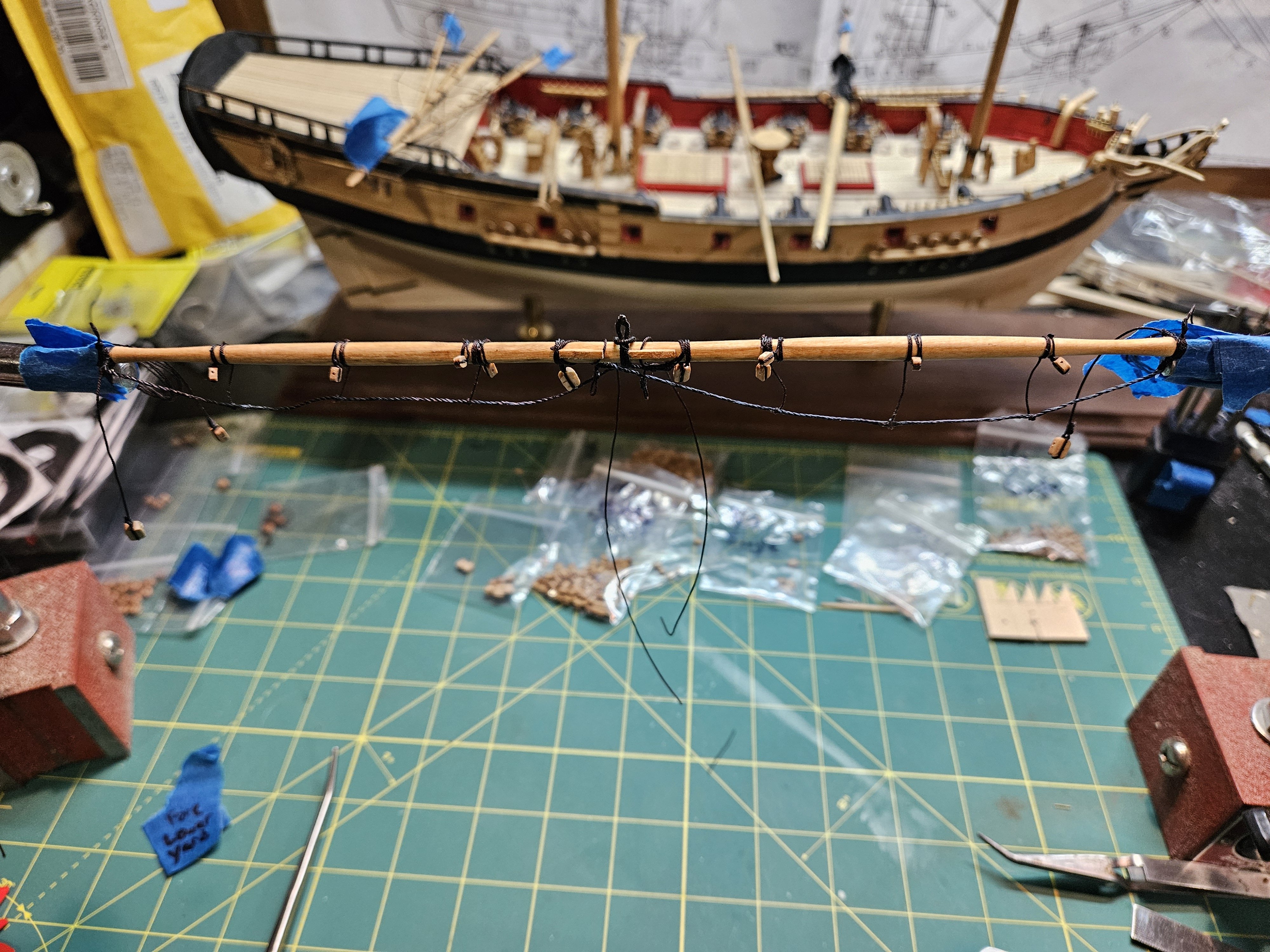

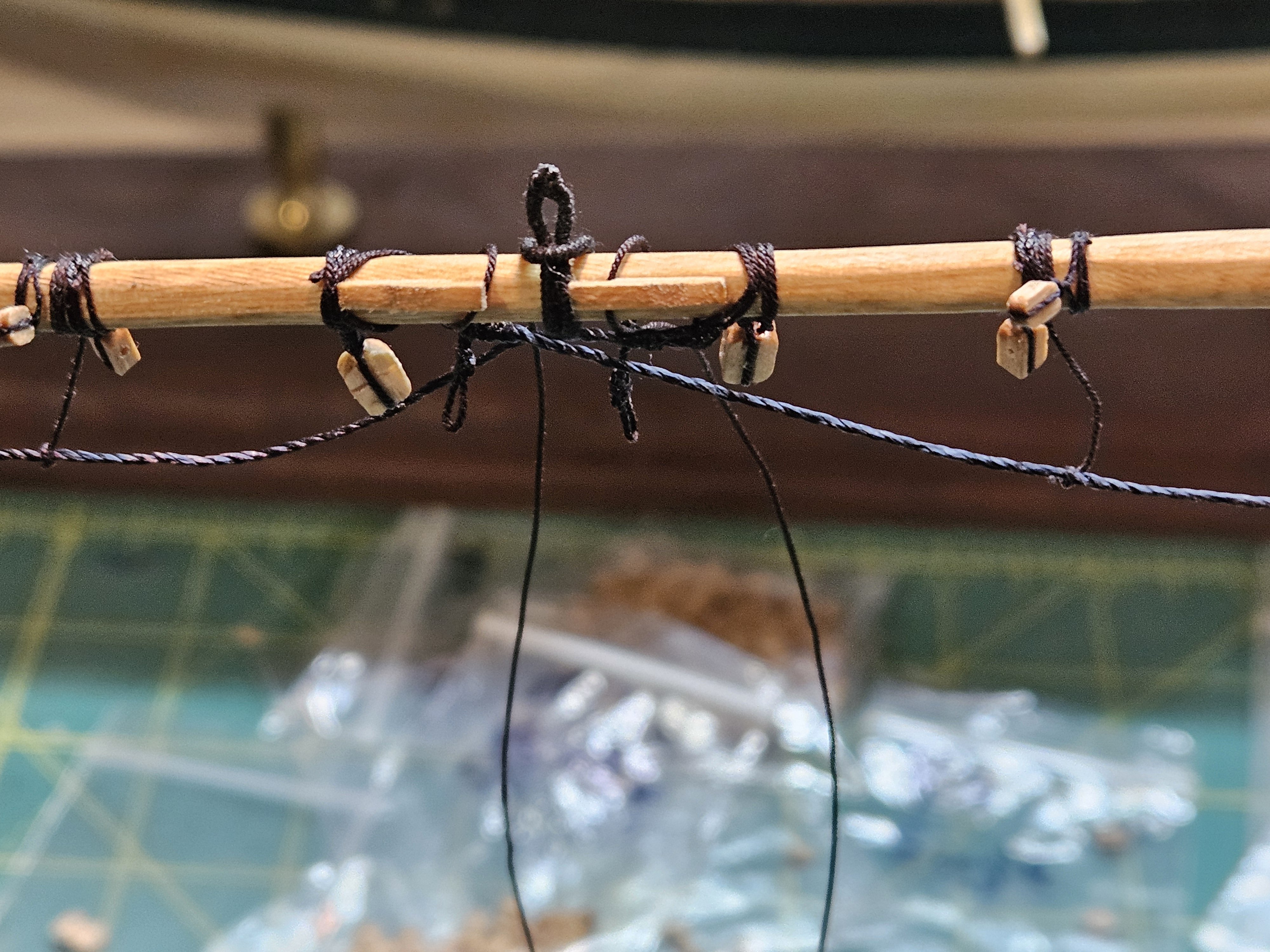

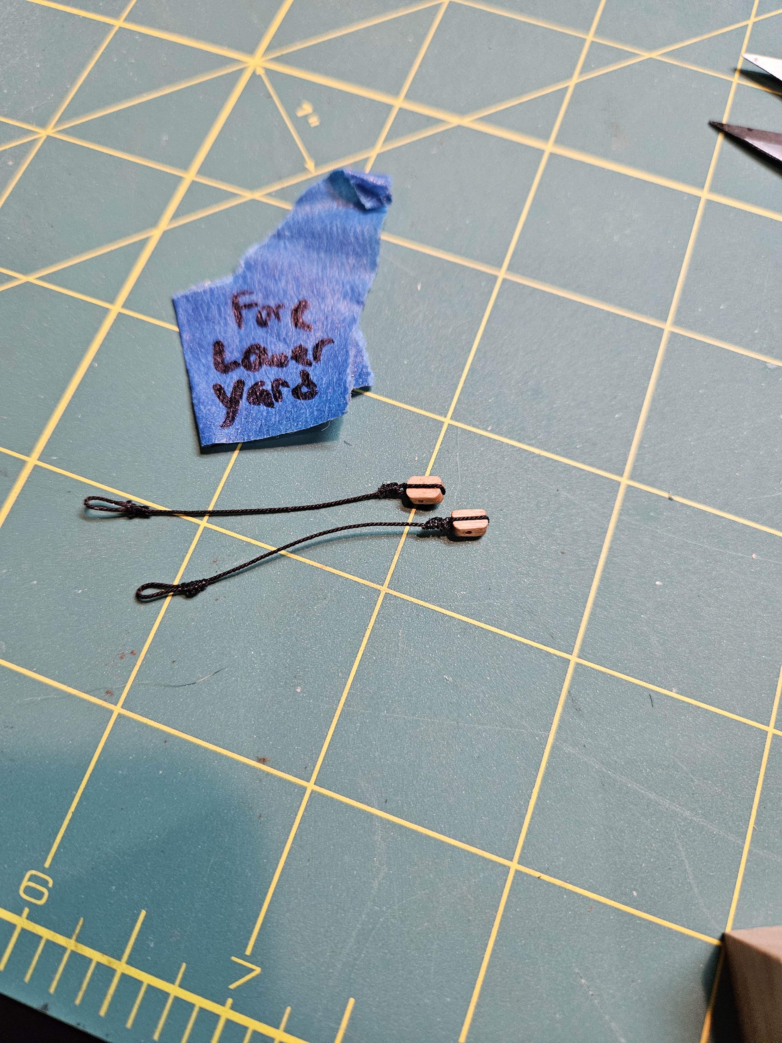

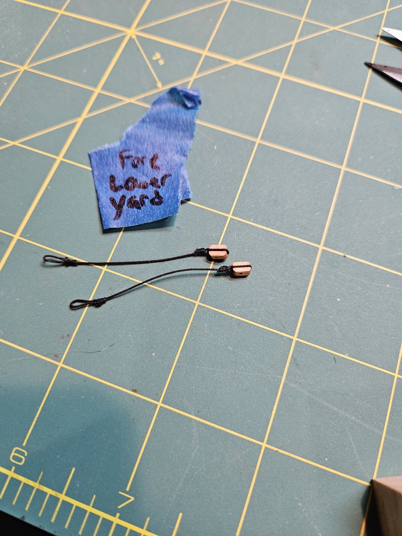

Preparing the Fore Lower Yard was next up. I added all the bunt line 1/8" blocks to the yard, with clove hitches and trimmed close. I tried to angle them in such a way that when they are rigged, the lines wont chaff the yard, but instead belay to the blocks under the mast top directly. This means they stick forward a bit.

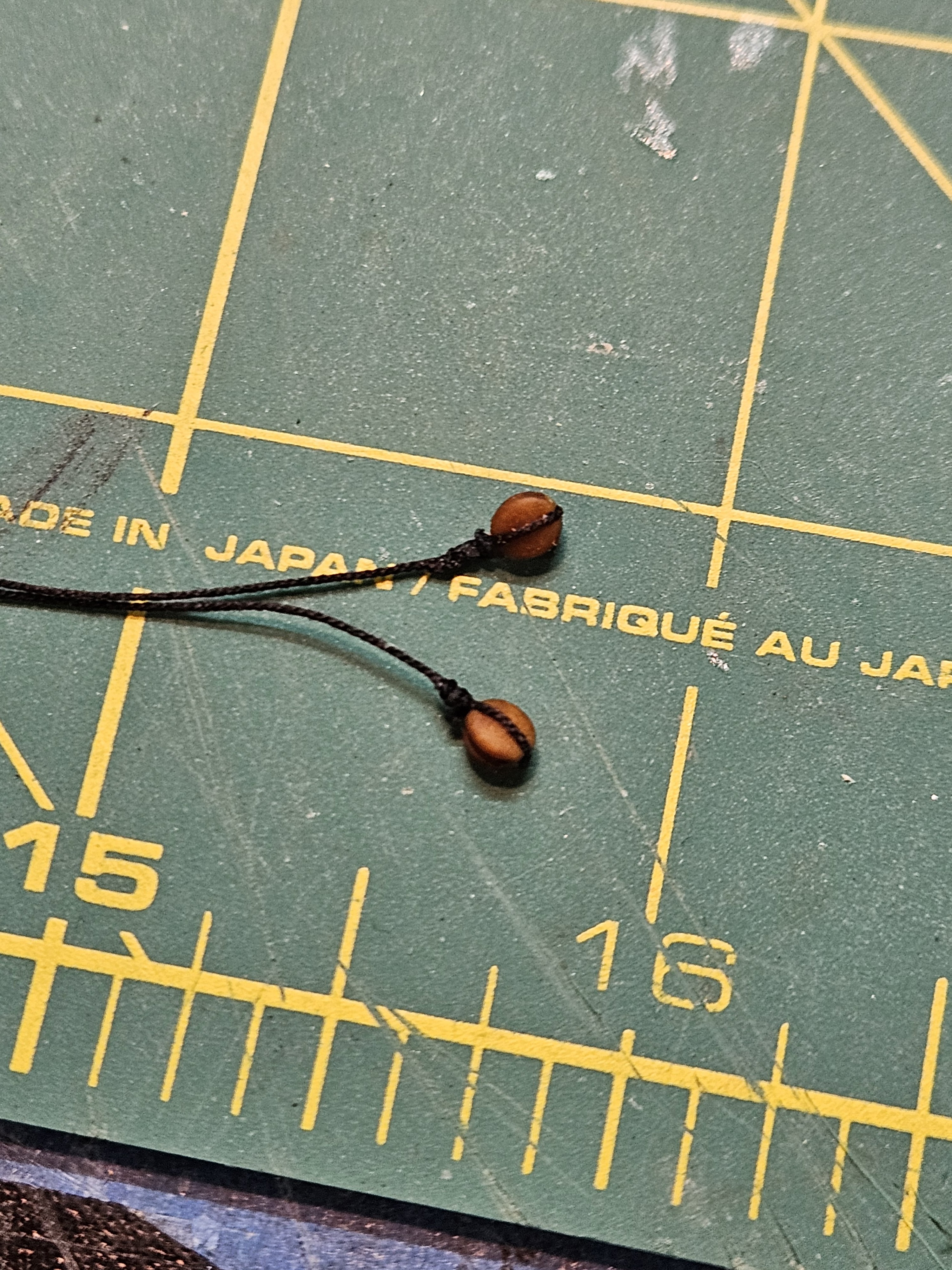

I also made the Fore Lower Yard Braces, using 5/32" Single Blocks. They are about 1.5in long pendant, so I seized the eye so that it would fit tight over the yard end. I add some simple tape labels so I know which block is which.
I fashioned the yard trusses from .012in rope. Seizing the individual eyes close enough to the yard was very difficult. You only get one shot, to get them the right length.
Also didn't forget the Fore Lower Yard Tackle Block. This one was 5/32" Double block, and the pendant was about 1.25in long. I had to remember it's only on the starboard side, as per the plans.

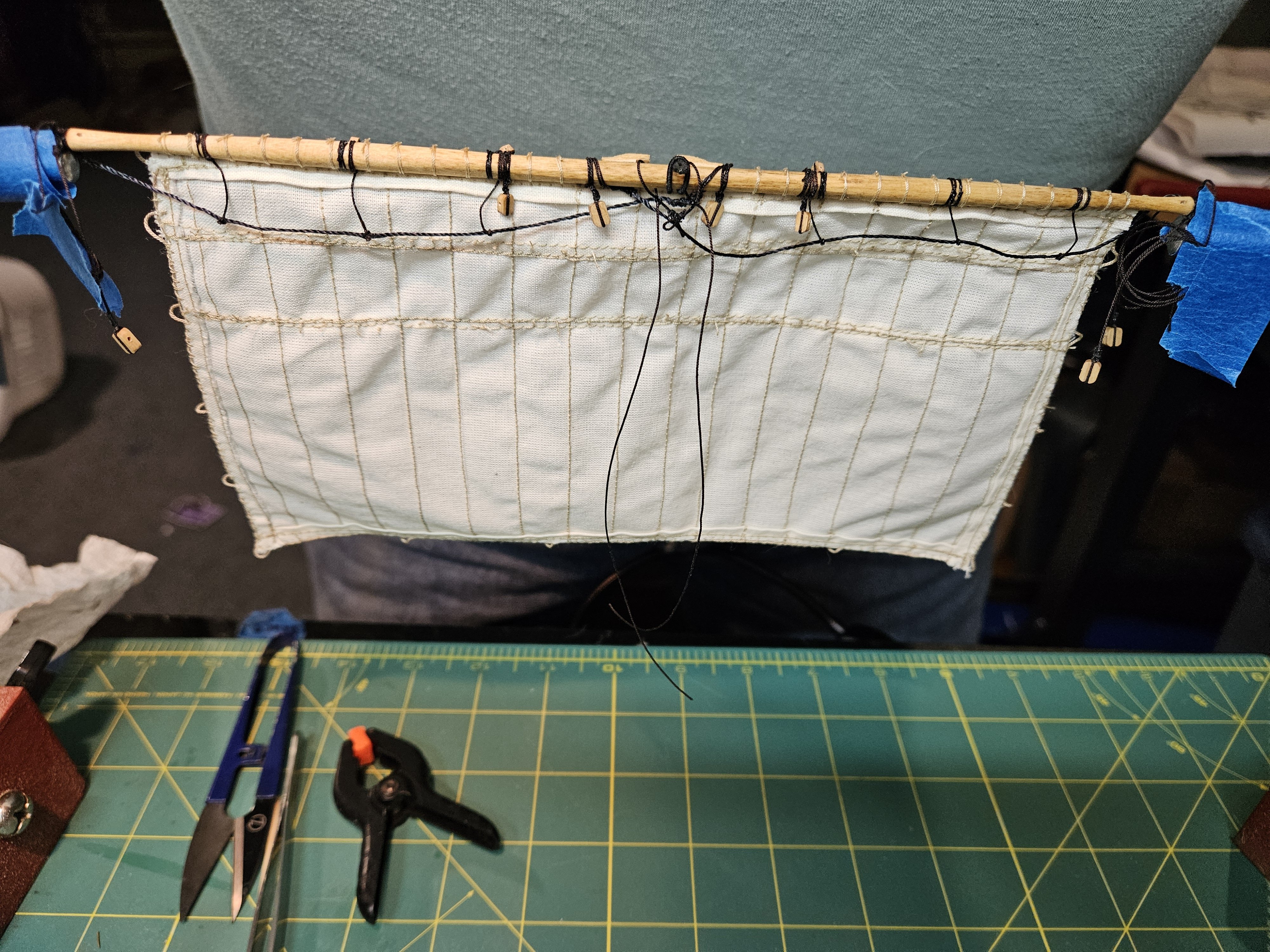

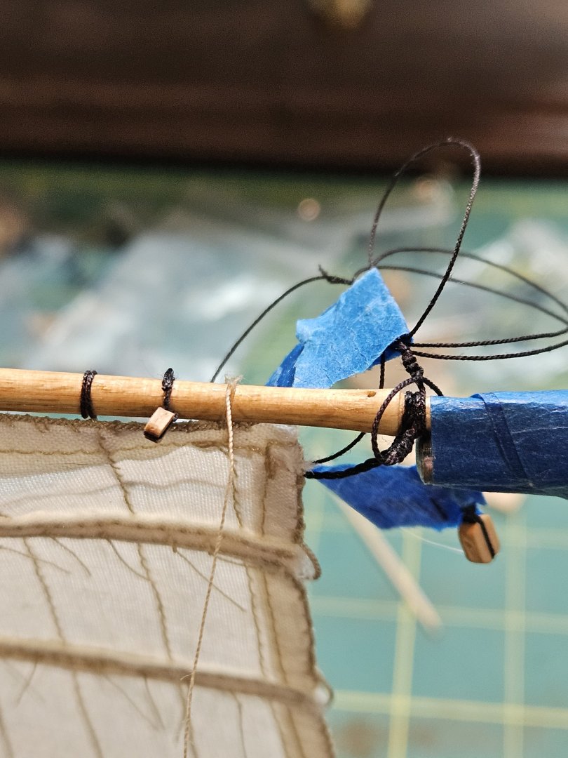

In a similar manner, I suspended the Fore Lower Yard between the stands. It really makes it easier to handle and rig certain pieces when you don't have to also hold other things.
There's a lot of stuff going on near the center of the yard: cleats, slings, trusses, footropes, Sheet block, clue line block,
Like the Main Sail, I attached one robband on one side then the other. I had to use a clamp to hold the port side, while tying the starboard.
You can see a close-up of the starboard side robband.
Once they're all rigged, the sail is secured!  I did make sure the sail was a bit forward on the yard, so it didn't ''walk'' aft and get in the way of other rigging elements.
The seam of the sail loosened a bit on the aft side. In hindsight, I probably should have dilute-glued it to keep it down. I might do that later

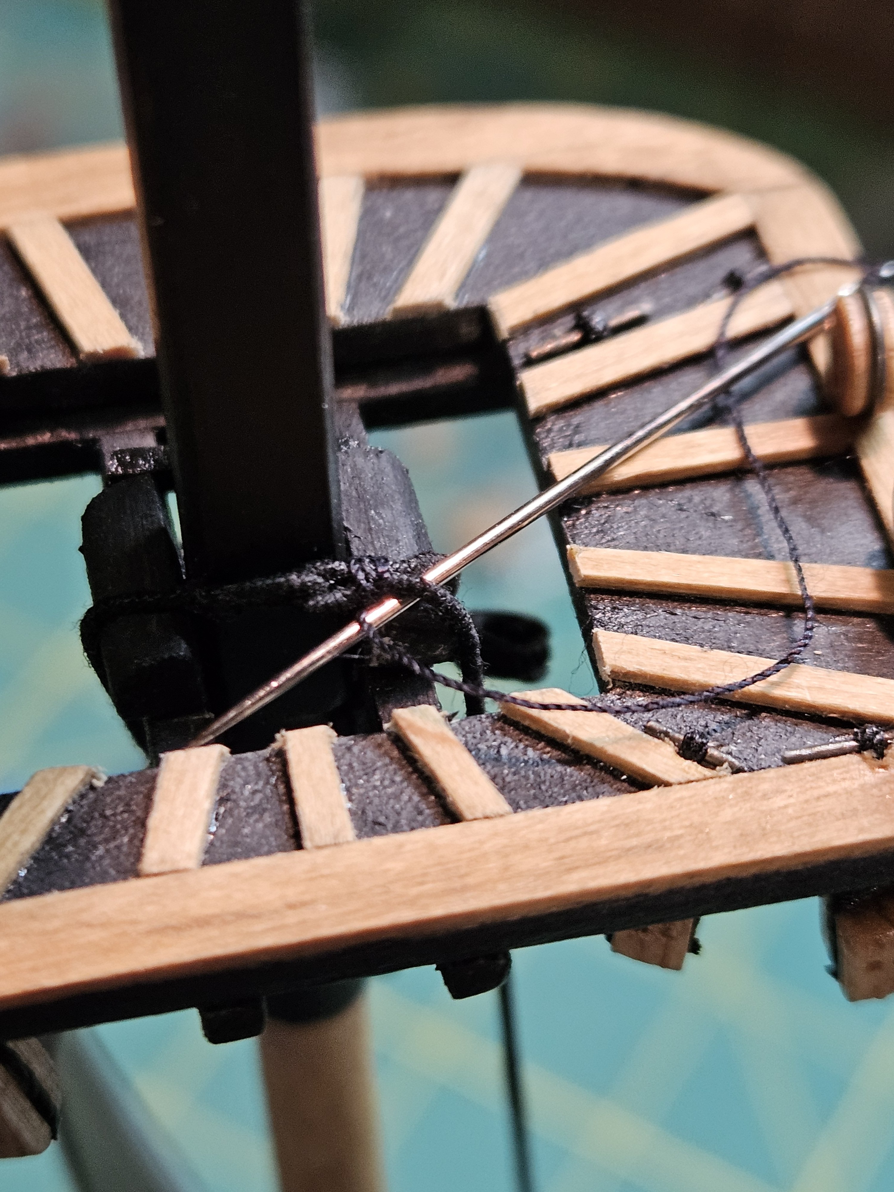

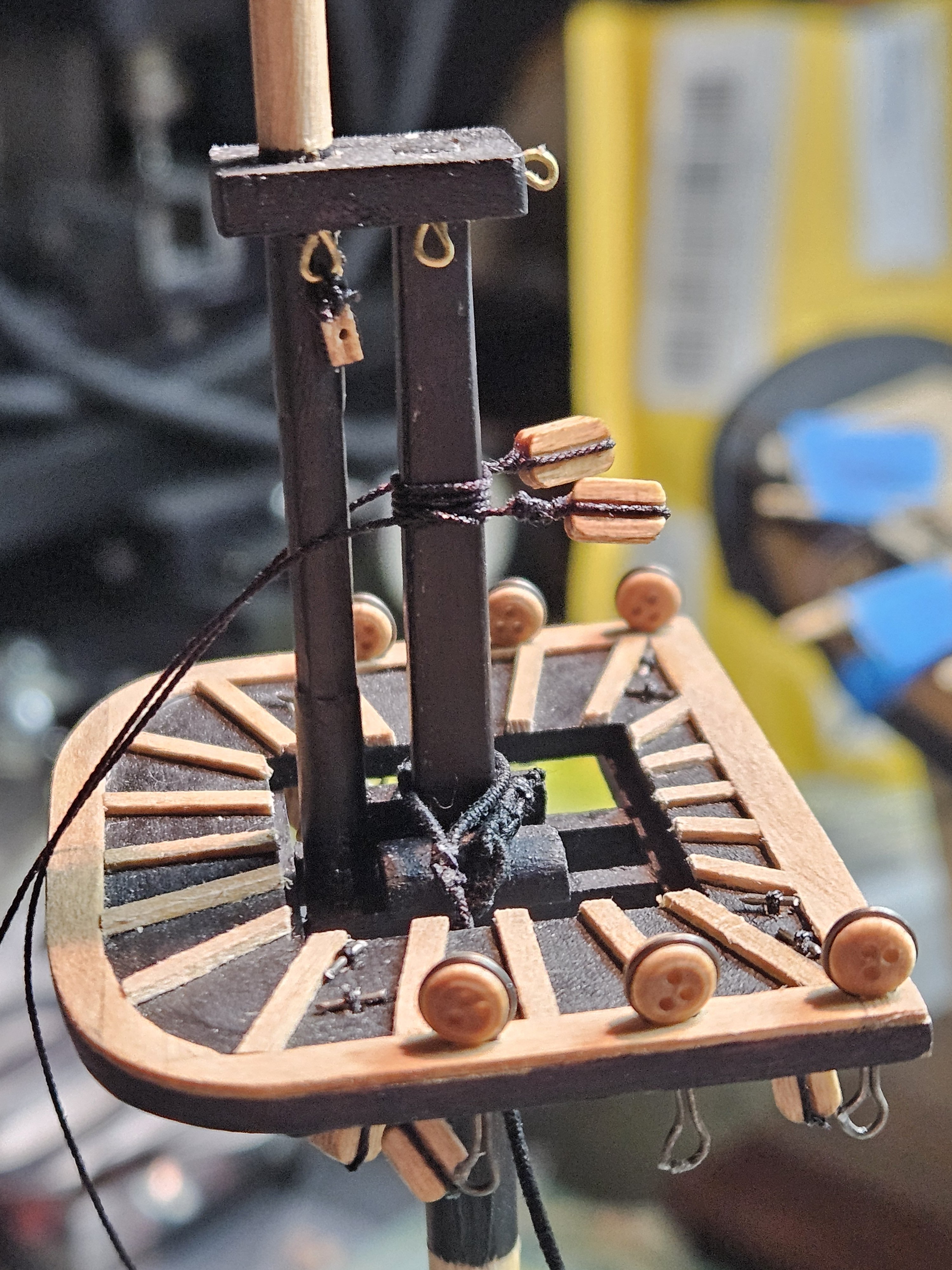

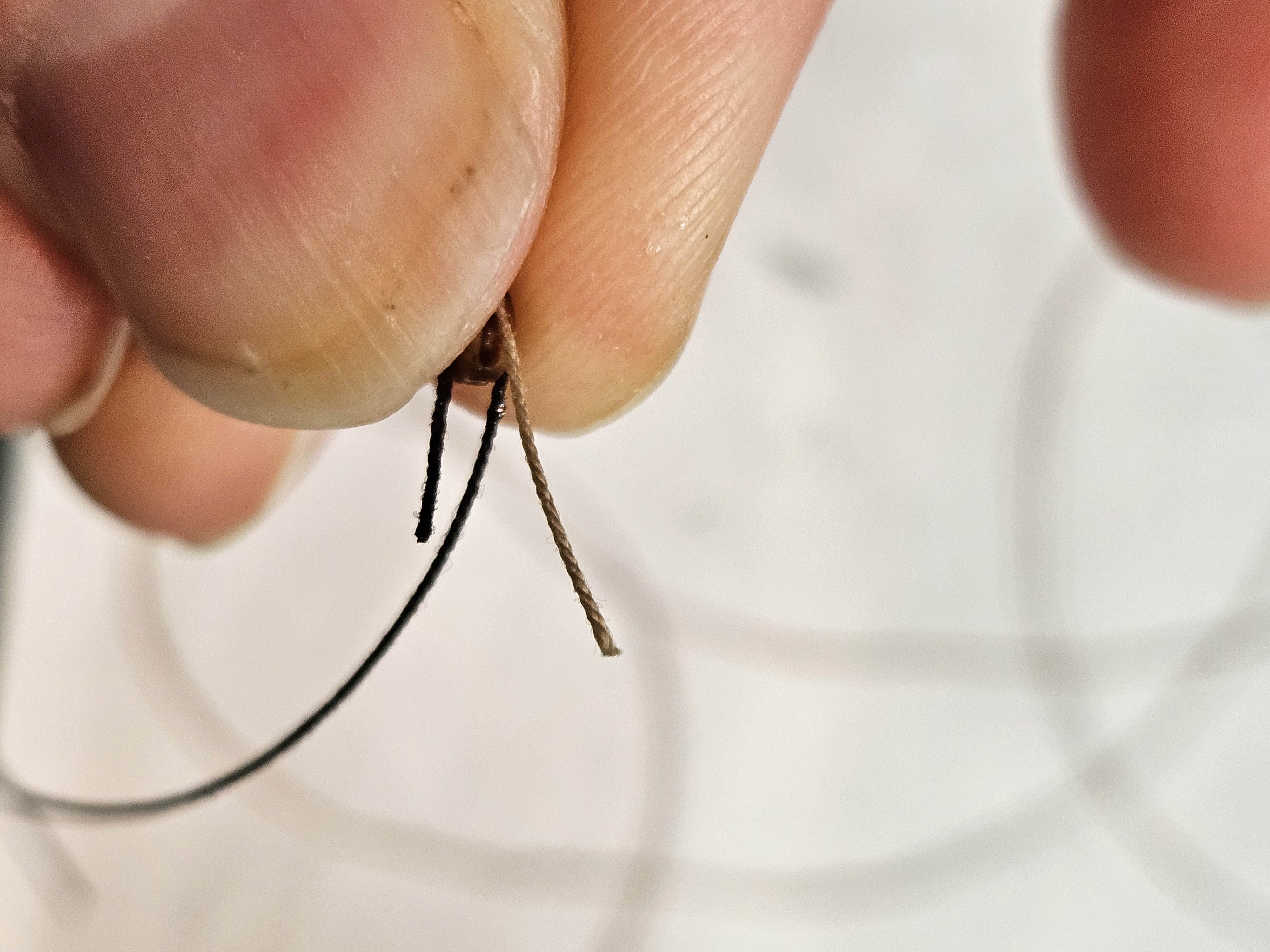

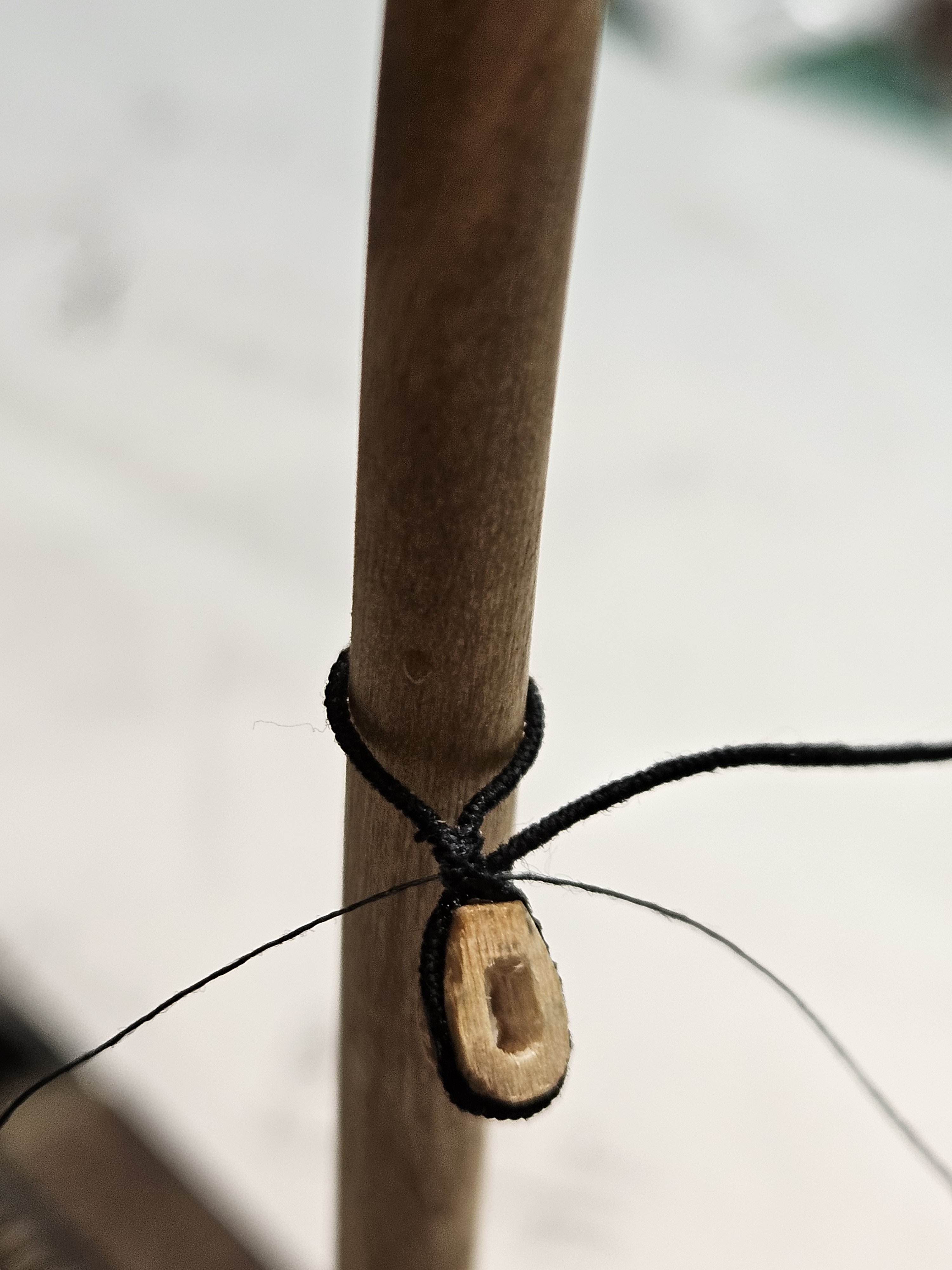

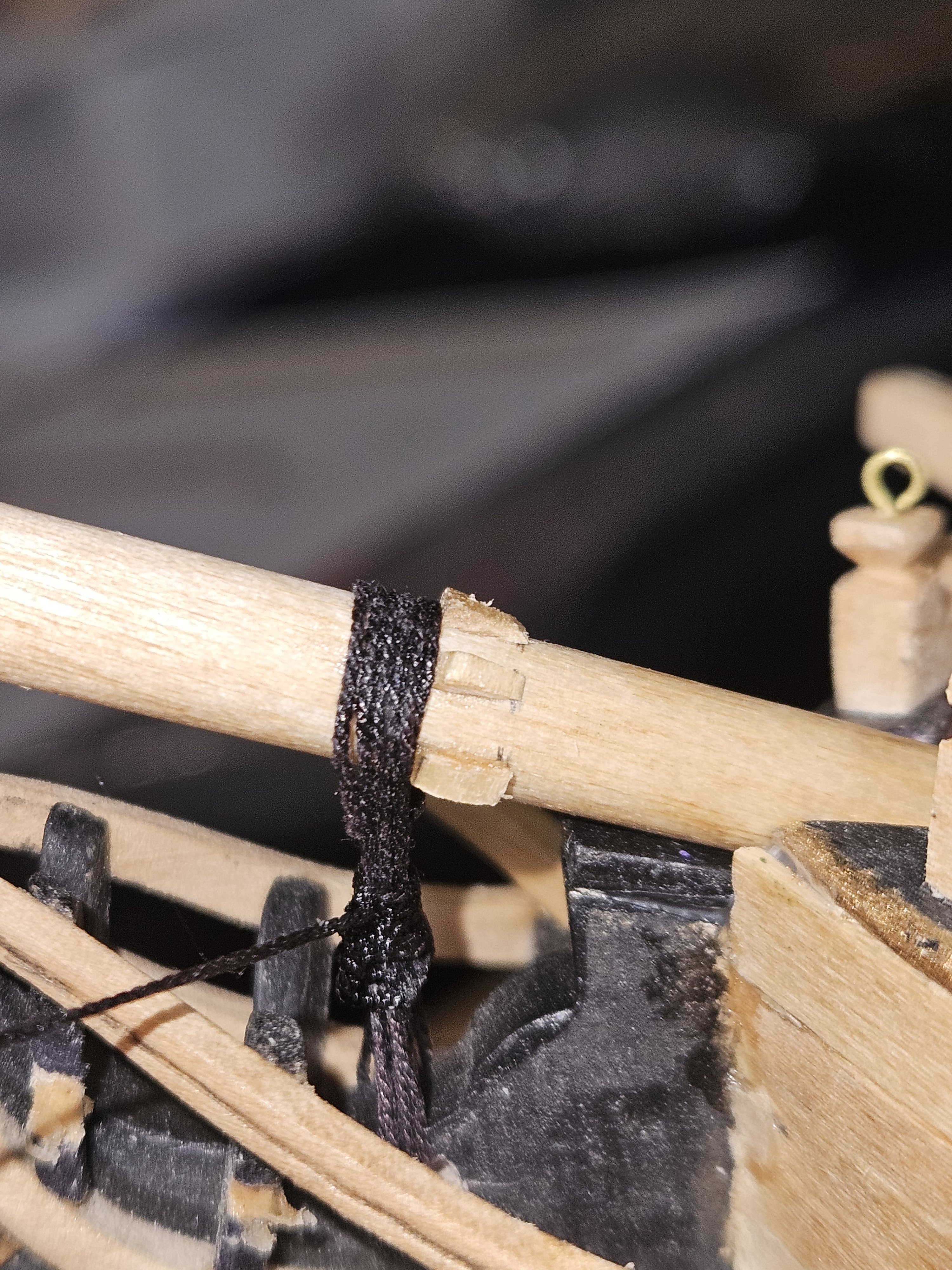

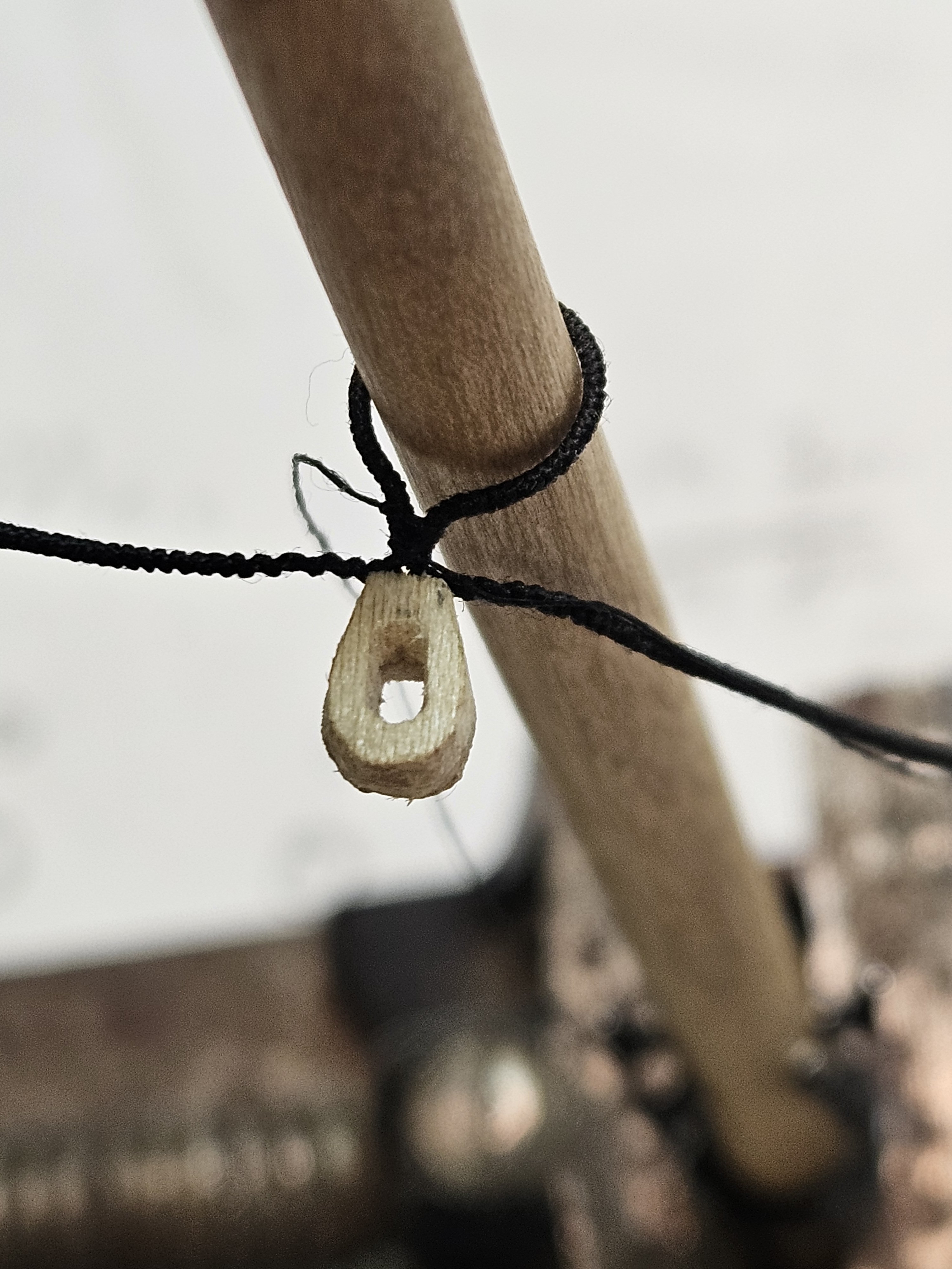

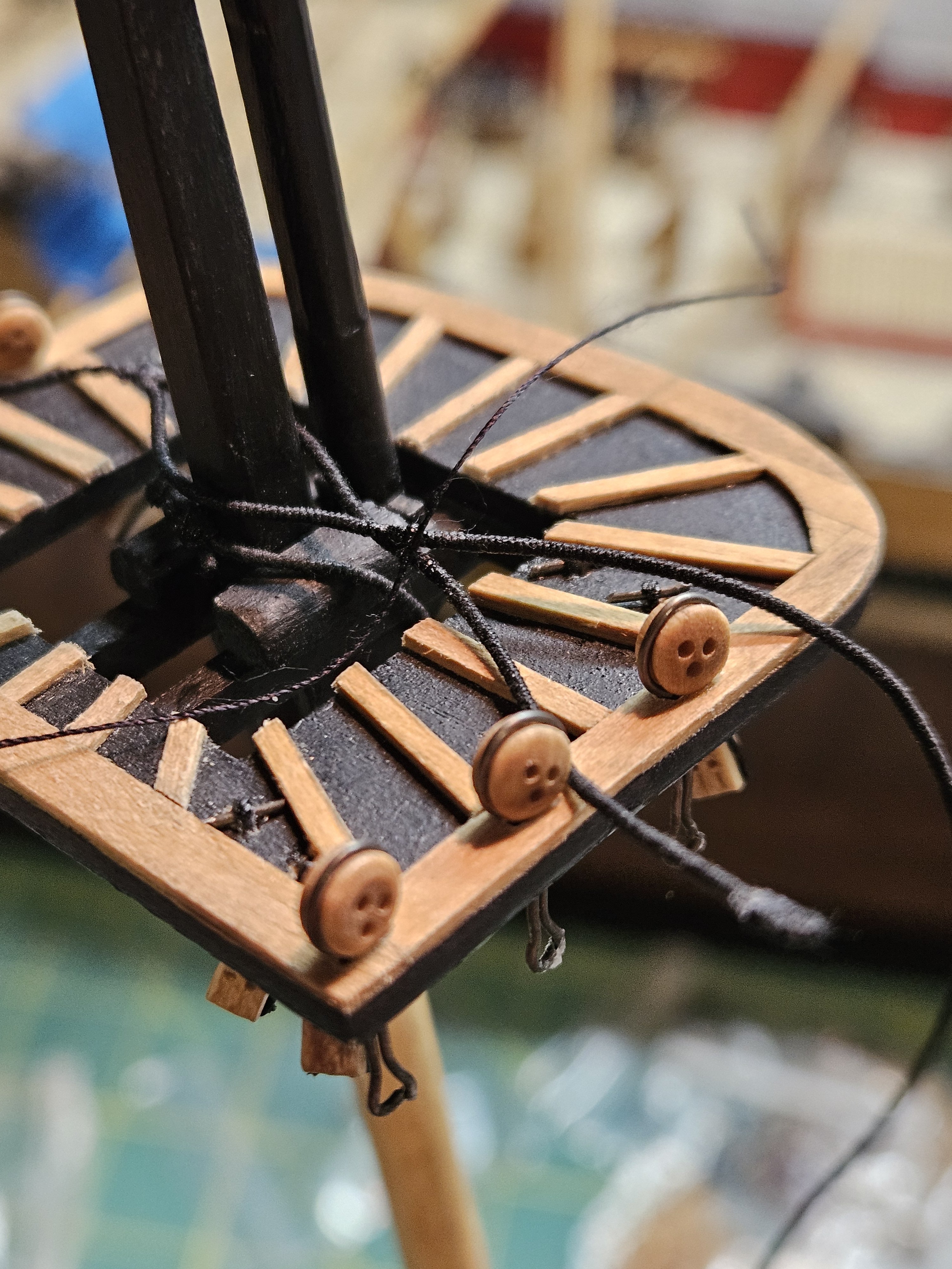

The Fore Yard Sling was next up to be added to the mast. Like with the Main Mast sling, seizing a metal thimble into served .018in rope. Making tiny eyes, and measuring the length right, to wrap around the mast....
Looping around the first eye to form a second, and seizing it with fine black thread.
Holding it at the right height with reverse action tweezers was challenging, while tying everything, but I got it done.
Using a needle to help serve/seize the ends made things a lot easier. I wouldn't be able to do it with tweezers as readily.
After its done, it's kind of a knotty mess, especially having to trim things close. Again, I wanted to make it as close to how its shown in the instructions, all perfectly blended and served down.

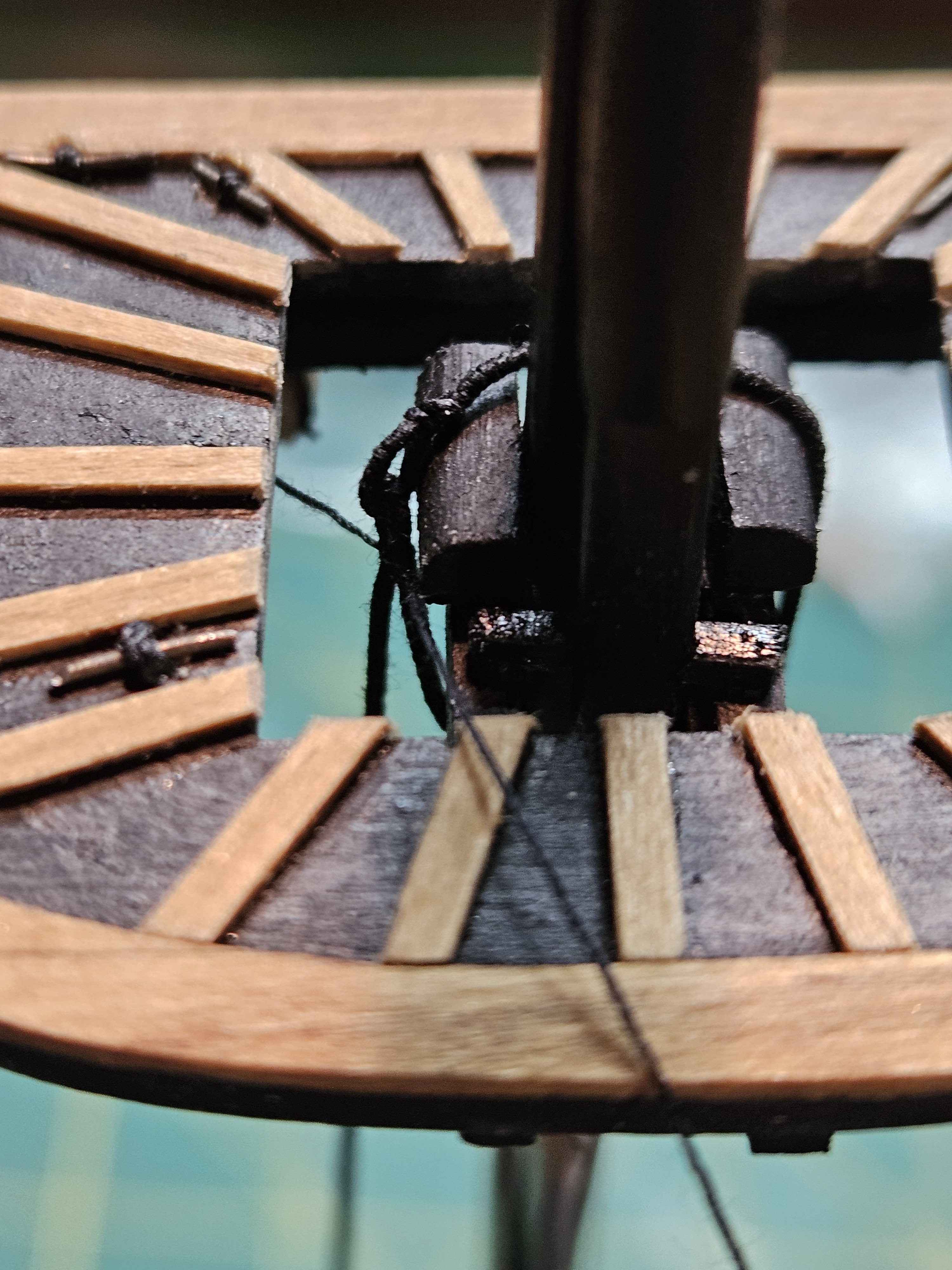

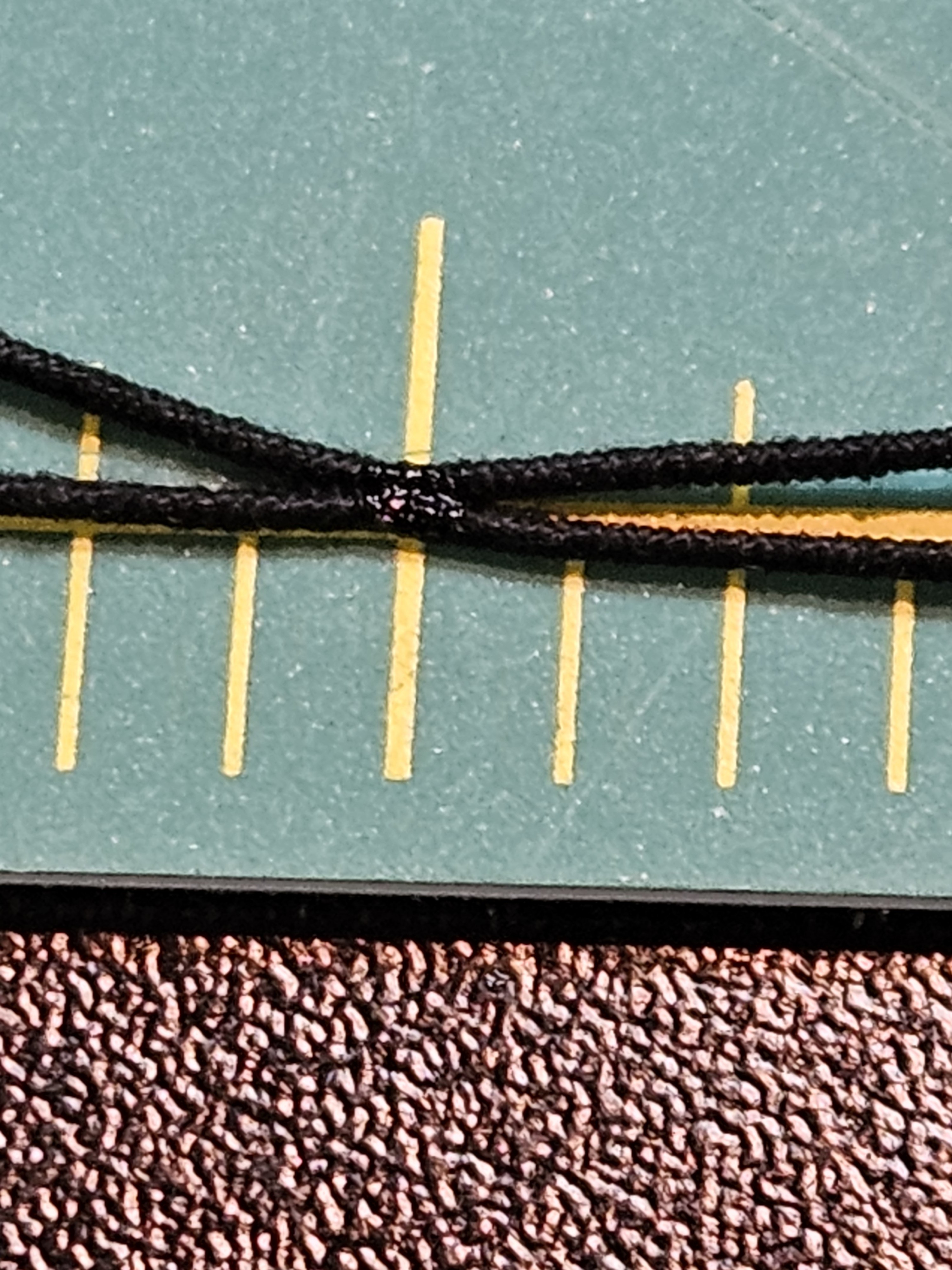

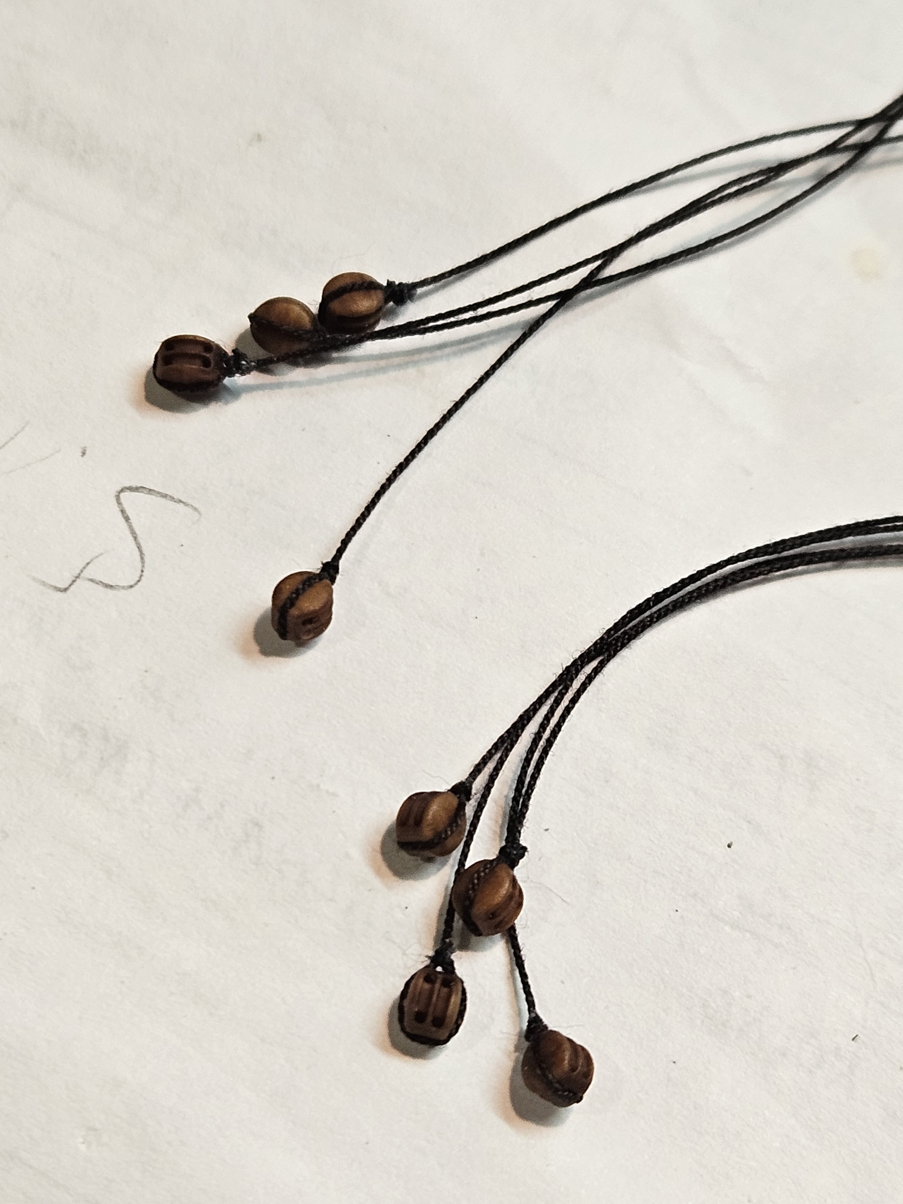

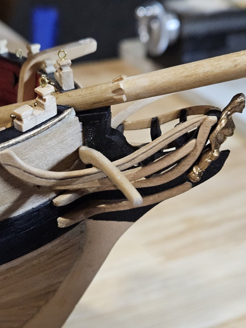

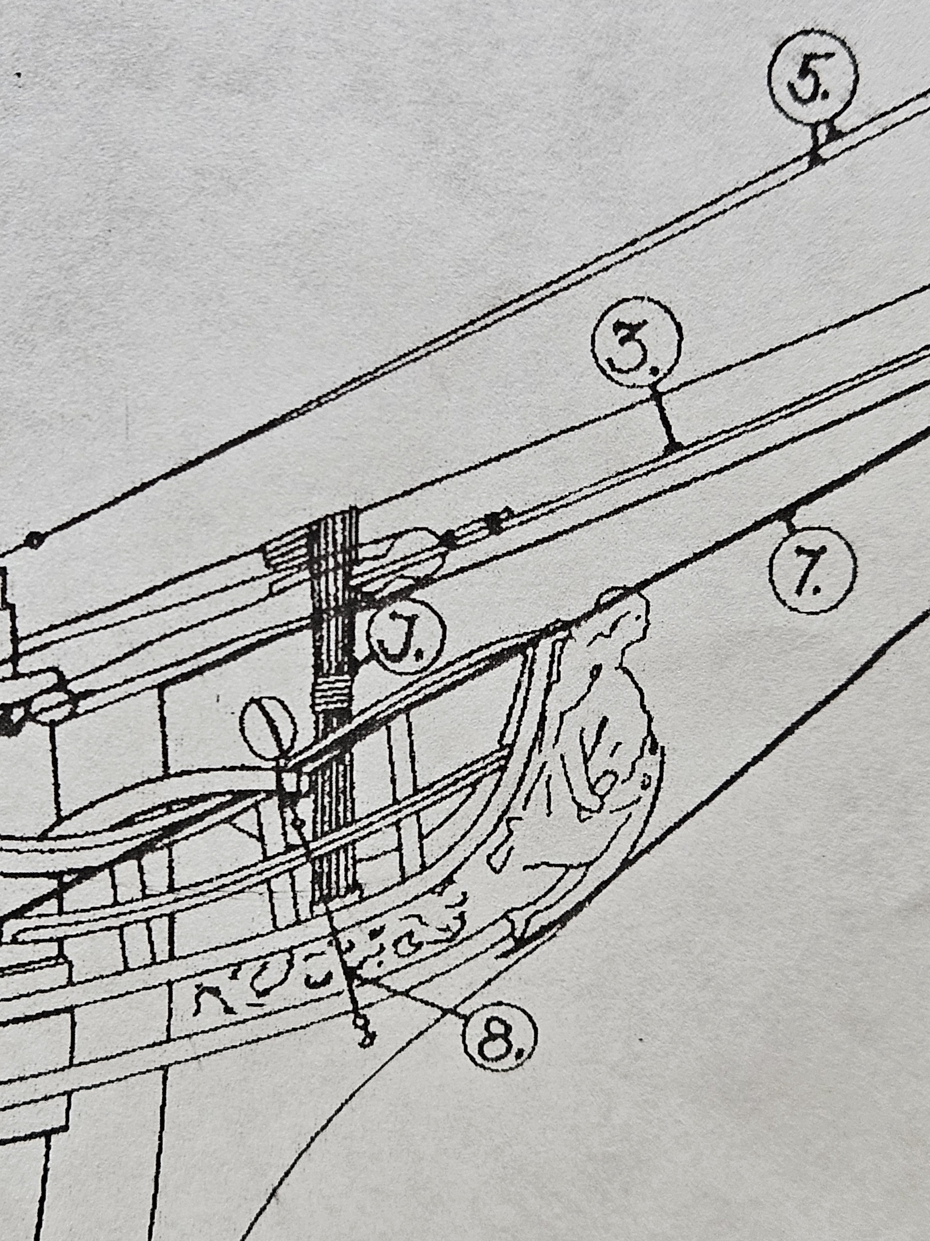

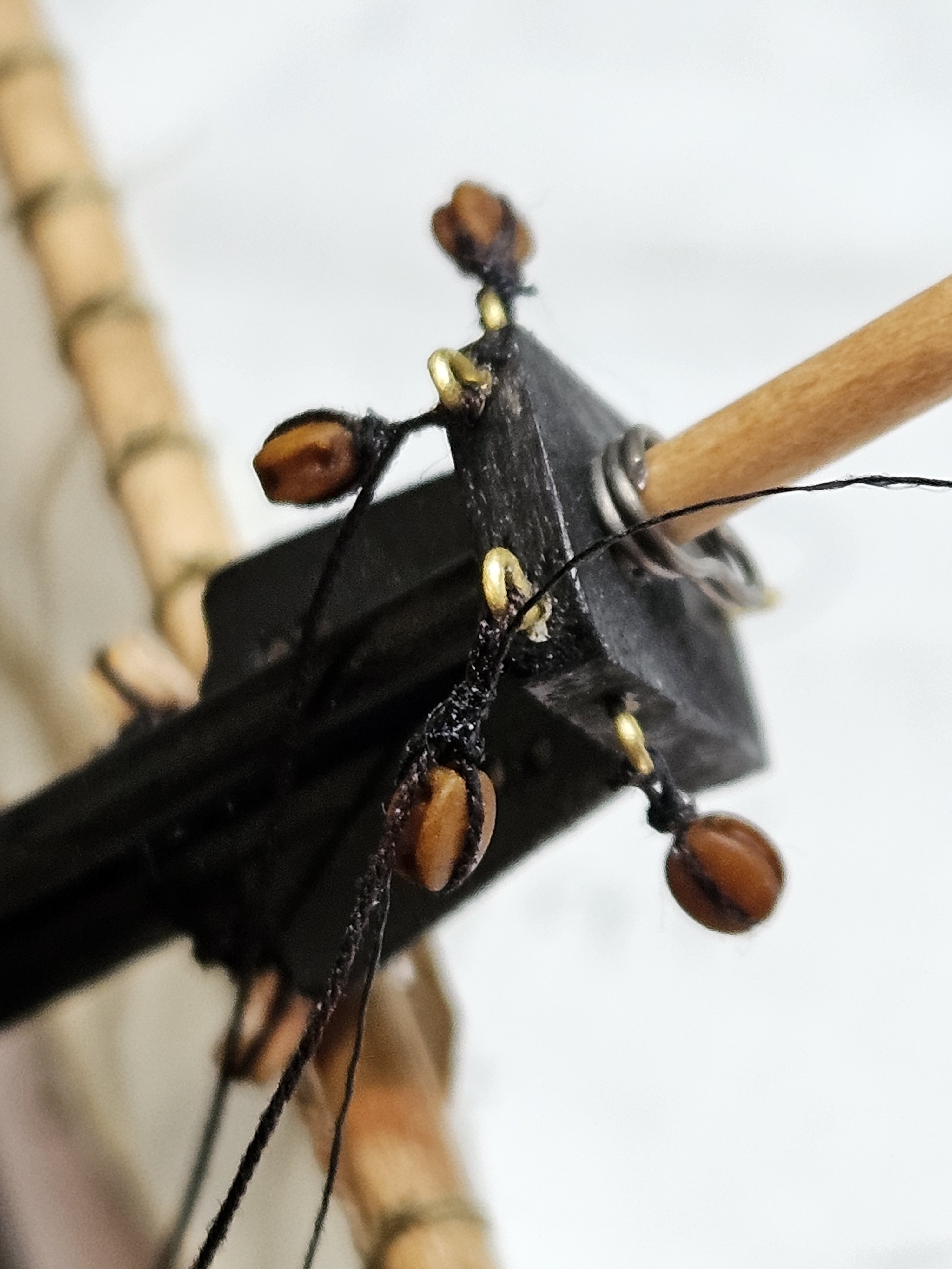

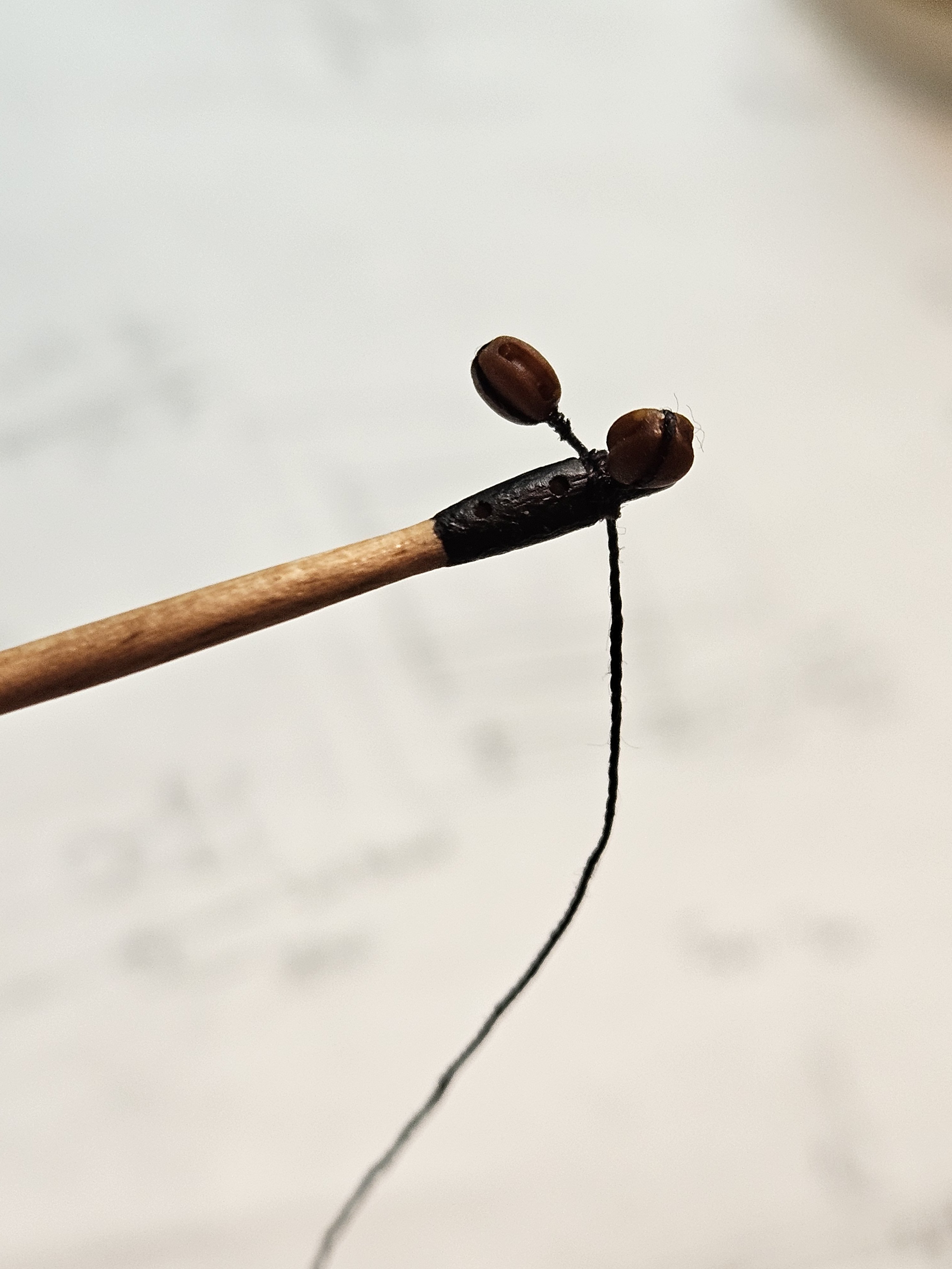

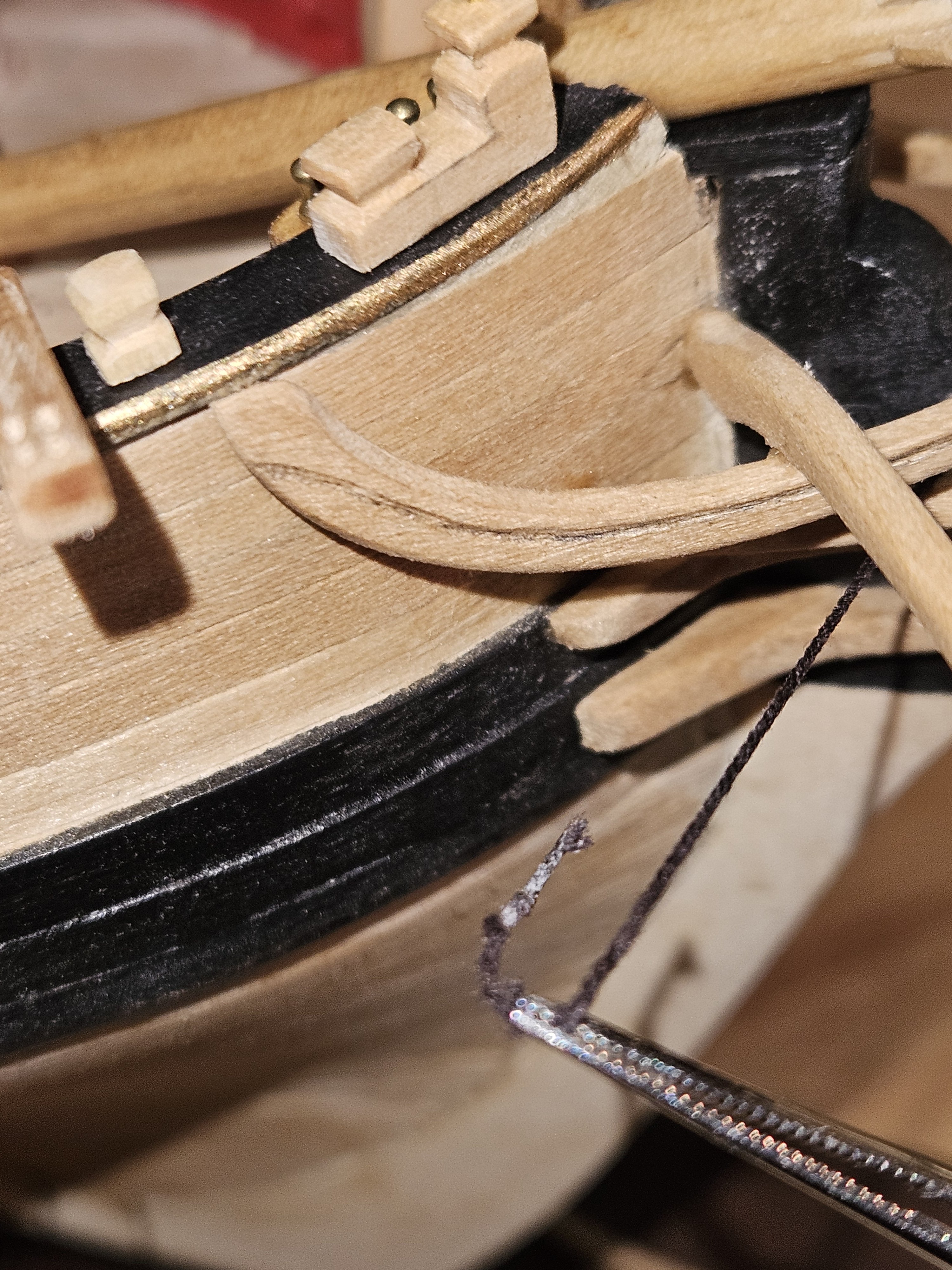

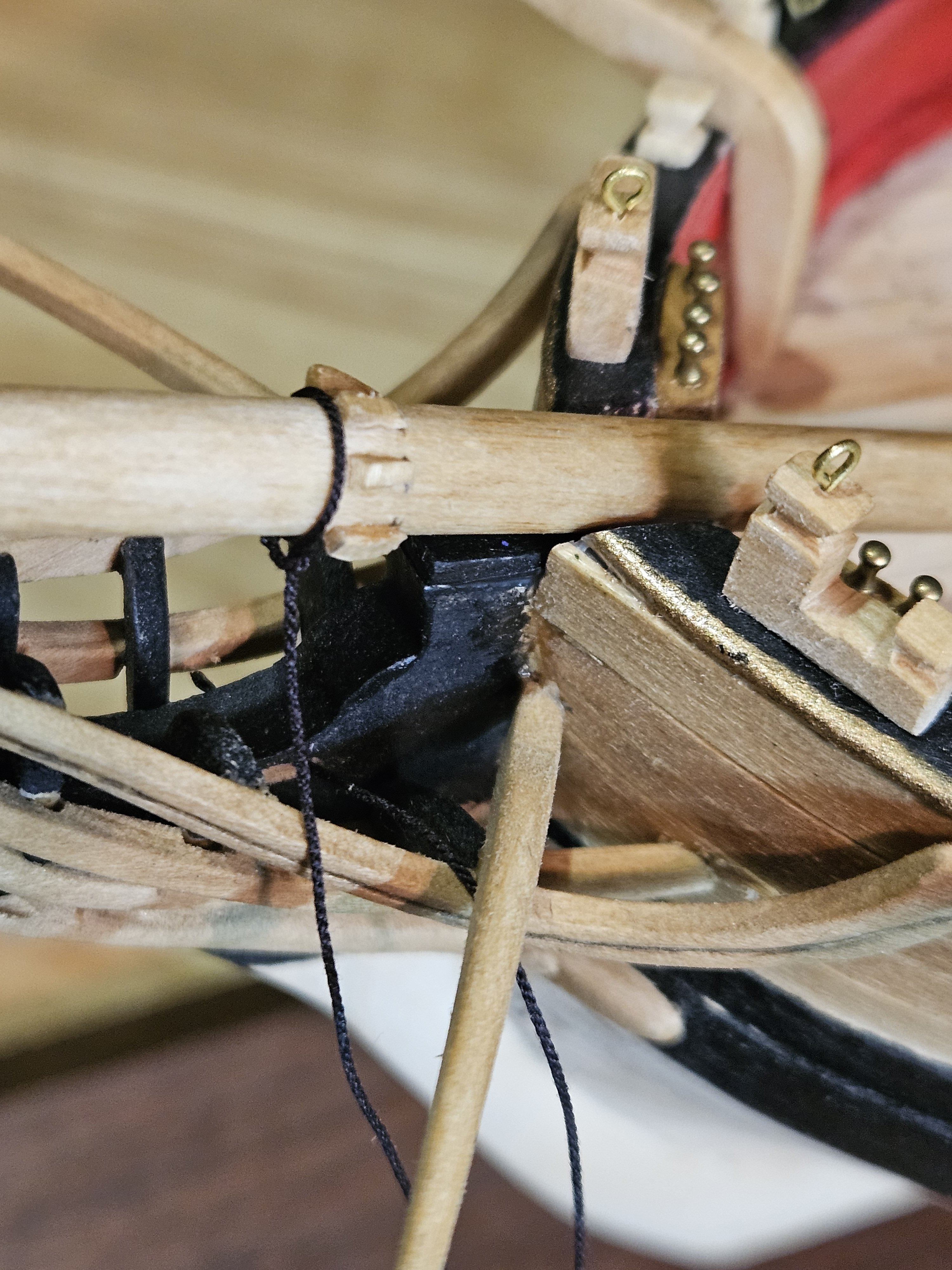

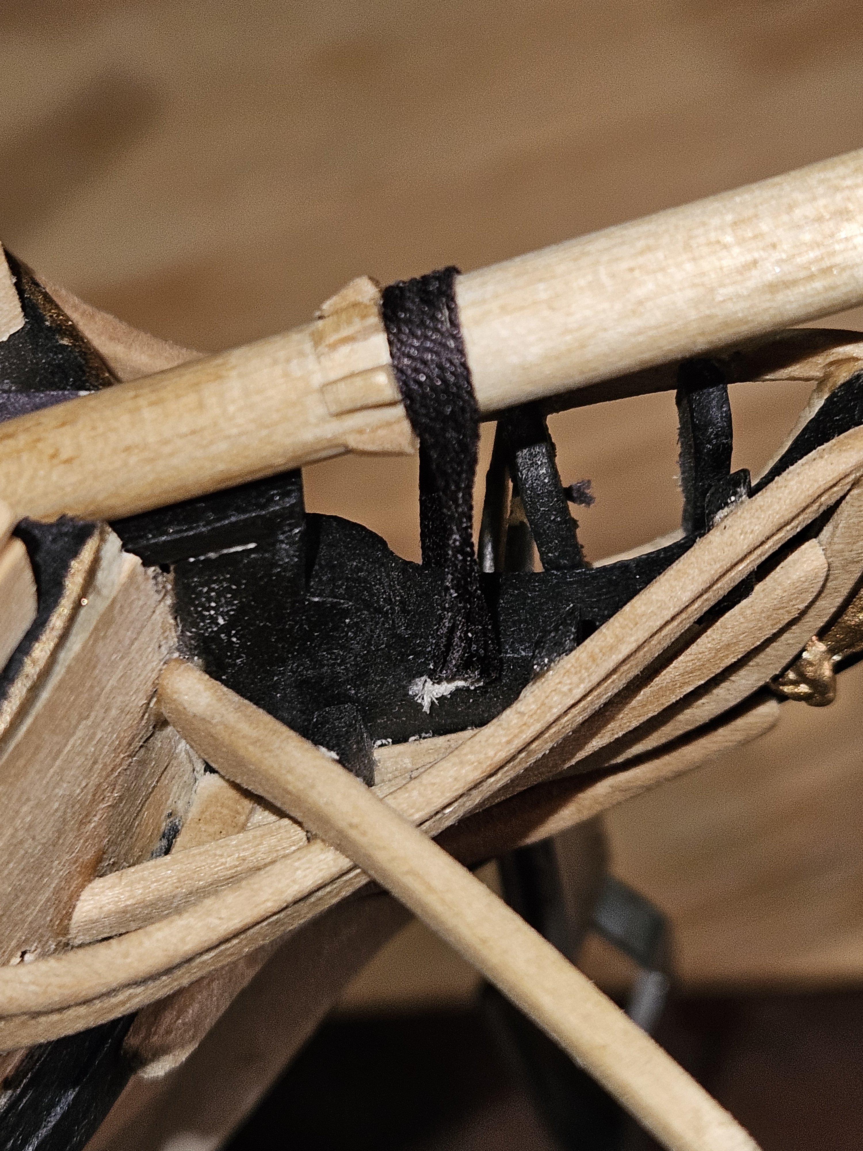

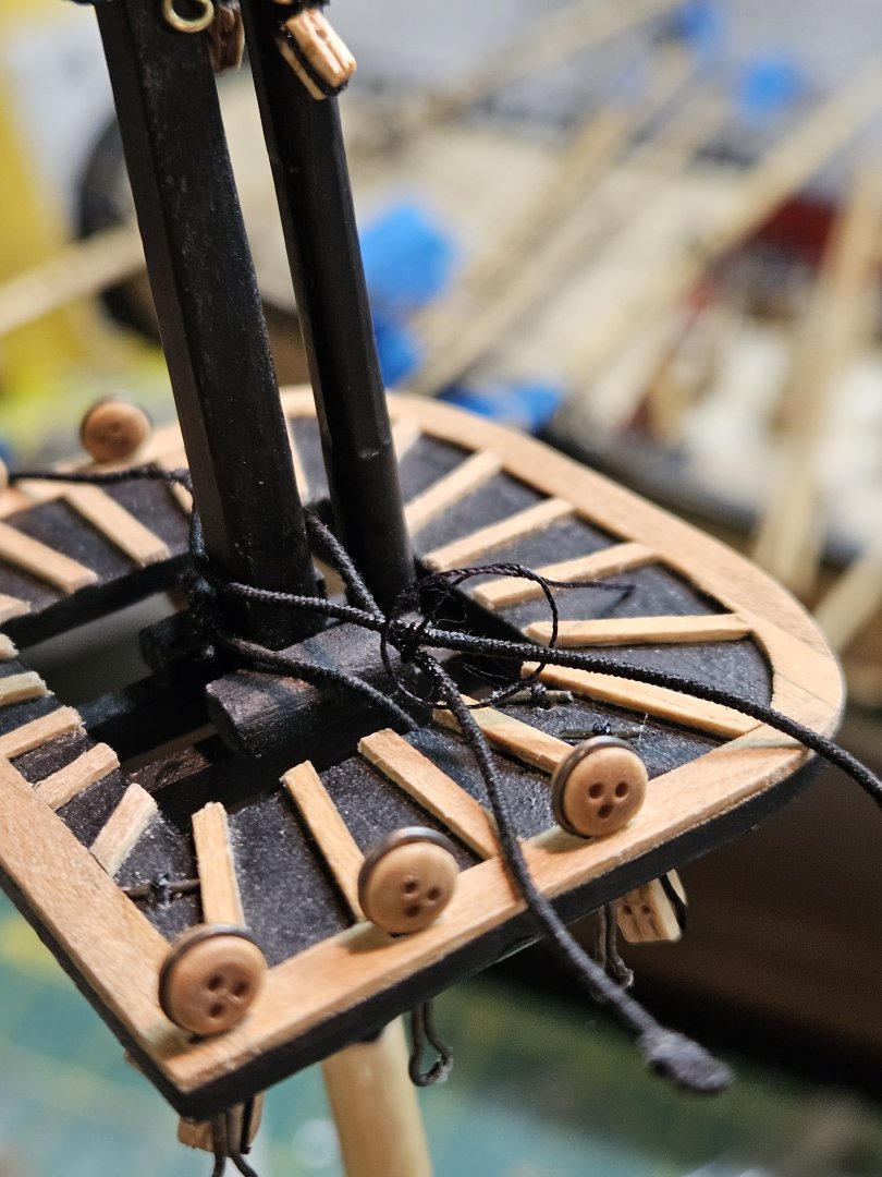

The bobstays were up next. Again, like the main, I served .018in rope in two lengths. Then tacked on side together with CA Glue, so that the middle was at the right distance I needed, or estimated from the second.
This is just to hold it together for when I seize it with thread. I let it dry over an hour just to be sure it didn't pop apart.
Afterwards, I'd seize one side with black thread, as neatly as possible.
Then I'd wrap the other two ends around the top mast, and seize the other side, tacking with glue first.
Once both sides are done, I'll use tweezers to hang the ends so they drape in a more natural manner.

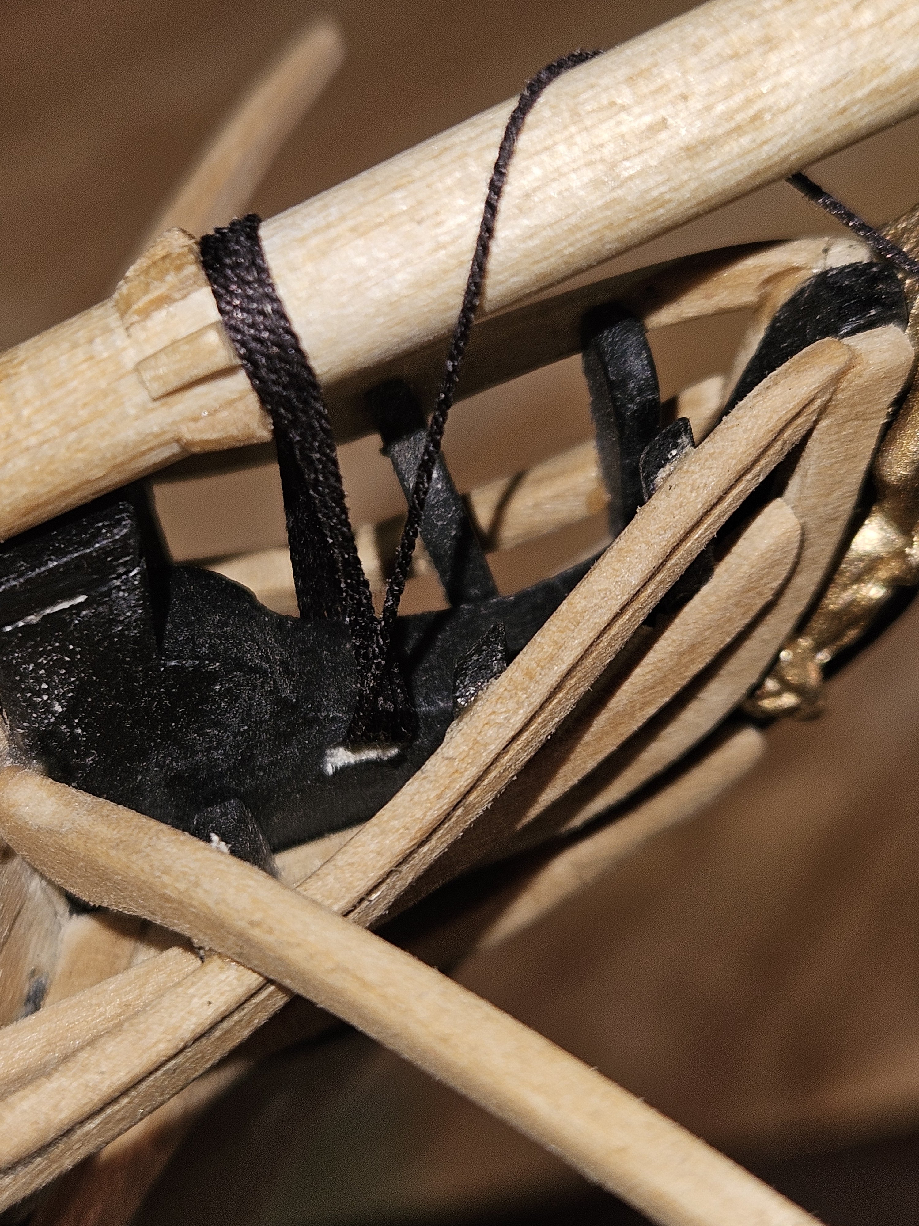

Also started stropping 3/16" single blocks for the Main boom. It wasn't easy to see from the rigging plans, but apparently there are two. One for each side. Since they'll both be attached nearby to each other on the Main Mast, I can't really understand how they'll be useful - they won't act like braces.
Anyway, I'm using .018in rope to strop the block, and seizing with several turns. Then once its got some CA glue, I'll trim the threads close.
A matching pair of Main Boom Topping Lift blocks. These aren't pendants, but long stropping rope to hitch to the mast. The rigging plans don't show HOW.
The best way I could see to rig these to the mast, was to use a simple clove hitch as close as I could with the each block on either side....
You can see each blocks have their hitch on one side, so they're not crammed together.
After they've been glued, I'll trim the ends close, so it looks neat.

labeled each bag with metric sizing for my own reference.
After listening to Chuck Passaro's talk about his block stopping technique during the conference, I followed something very similar. Tacked the rope with CA glue on the left/bottom, and blotted with my finger immediately so it's not glossy looking, but matte. Then dabbed glue between the two opposite ends and pinched it between my fingers to get them to tack.
After it dries for a minute, I'll use fine thread to make two overhand knots tight up against the block. Added a dab of glue and blotted with my fingers again, as per Chuck's method. I couldn't just make a few turns and stop, it came unraveled for me. So two small knots was enough.
Once the glue dries, I would hold the block with two fingers, and use my pinky and ring finger to hold the thread ends taught, so I could trim them close with a razor blade. This became the best method to strop blocks from here on out. Much much neater than using the sewing scissors to cut.
These two are spritsail braces
I removed the old-block ones, and replaced with the new Syren block versions.
Also added 3mm single blocks for the lifts, on the cap eyebolts
I made sure not to add too much glue to the ropes, so they can naturally belay from the yards.
These blocks also have top and bottom holes, which is what real blocks would have. I really like these, over the kit blocks.
For the boom topping lift blocks, I need 3/16" or 5mm single blocks. Somehow, I only ordered doubles - two bags of them. I need singles.
If you remember my posts in February about cutting double blocks in half? I did the same thing here, except after cutting, I painted the cut side a matching brown. The block will be stropped anyway, and you'd have to look really close to see the difference.
Besides, I'm going to have the ''good'' side facing starboard - I'll likely have the finished model's port side facing the wall, when its mounted.
Here's one of the topping lifts on the mast cap, in the way I described. Again, much better quality than the kit block you see in the background.

For the main lower yard lift, I decided to use to single blocks, though the instructions just have the lift ends going over the mast cap. Other models use lift blocks, and I think this is more correct.
I used a 4mm block, and .018in black rope for stropping and attaching to the yard/eyebolt. I used tan for the running end, coming from the same block.  So Black rope, black thread knots, tan rope, tan thread knots.  I'll post later in detail how I made these - they're tedious.
Once all the thread ends are trimmed close I have a ''short'' stopped end of rope, and a running end on the same block.
For later rigging, I like to coil the running end and label it so I know what's what. These are also Syren Model Ship Co. ropes, which are very nice quality.
Now I've got the lift attached to the eyebolt on the mast cap. It's a little messy because I fold the standing end through the eye, and back over itself. Then two thread knots to secure and glue, and trim.  My seizing thread is about .008in diameter. It works just fine, but I wish I could find something smaller.

Starting with the Main Lower Yard, I'm replacing the braces, and lift blocks with new Syren ones. These look so much better.

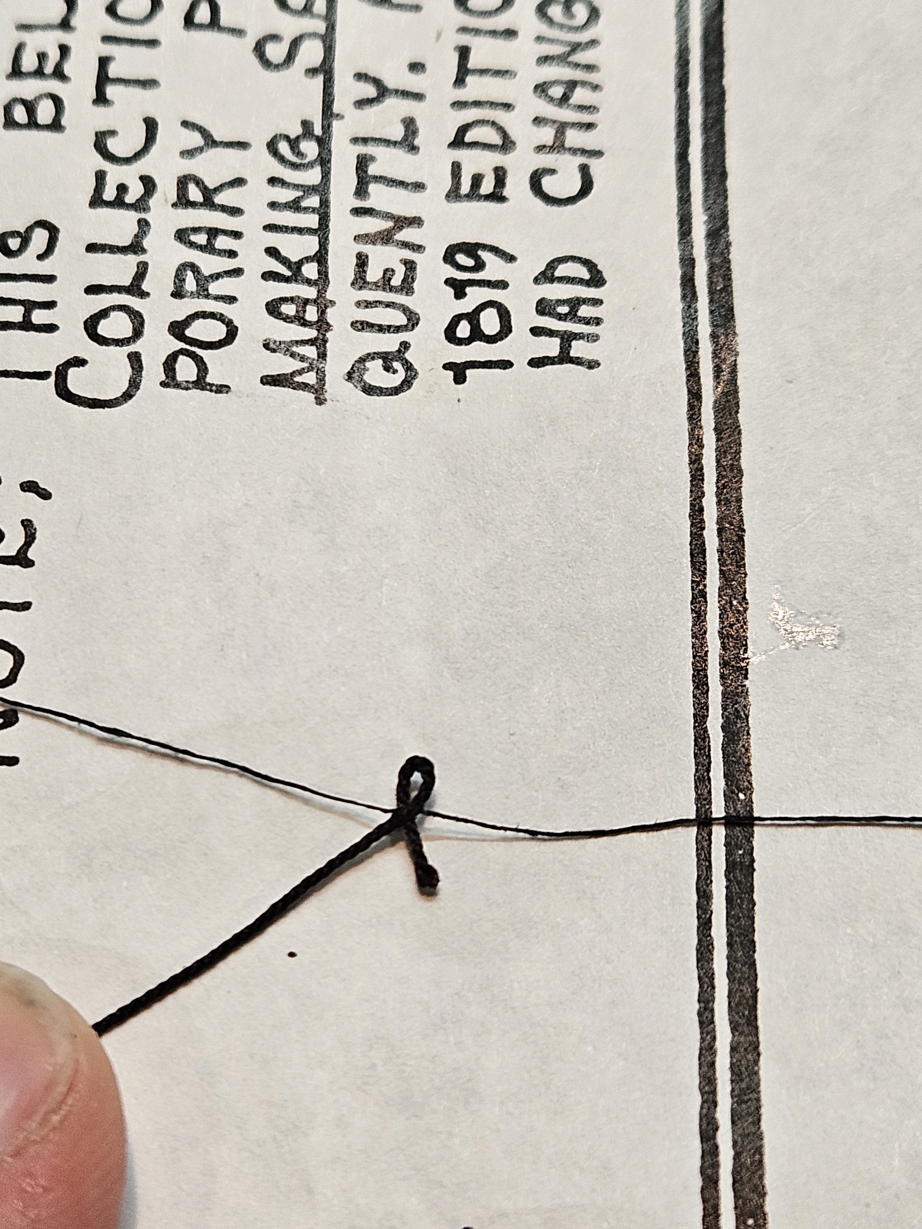

Short serving of the brace pendant with neat little half hitches. I still cannot manage to simple do turns and then glue without it unraveling, so I'm doing tight hitches. It serves...hehe....me well.
After trimming everything, I made the other brace. These will be rigged forward, not aft, as per the rigging plan, but it doesn't make much sense to me.
I also replaced the yard tackle block with a 4mm double. I will continue to label each so I know which block is which as I go along.

Kept working on replacing the clue and sheet blocks on the Main and Fore Lower Yards. There's a nest of yard slings and foot ropes in there too, so I had to be careful with seizing to the right black rope.
Methodically removing old blocks, and replacing with the better Syren blocks. Because of the square cross section of the mast, I can't (easily) seize the block in the middle. Therefore, clove hitching it just to one side is sufficient. I left the standing end with a little tail, so it can 'find' center once it is rigged later. Again, it doesn't say or show HOW to attach the blocks to the model, so I'm coming up with this as I go.
A quick note about running rigging length. That whole measure twice, cut once thing? - Needed to follow that more readily. For the yard lift, I measured approximate distances from block to block and to the deck. What I forgot, was that rope goes down, AND BACK through blocks, so I need to count twice, plus extra. A crude drawing, but I labeled 1,2,3,4 for the path the rope takes. In this case 5in + 5in + 6in to deck. I had to remake one of the blocks seized with running rope because it'd be too short.
I hope I got the others I've made right too!
For replacing the buntline, leech line, blocks under the tops, I went ahead and made them in sets of 8 (2 port, 2 starboard, 2 fore, 2 aft)
To attach them to the the underside of the tops, I need to strop them with a little loop at the top. This will feed through the hole, and a little pin will be glued to keep it from pulling out.
Its hard to prevent fraying at this scale, but it's very small, so to the untrained eye, it won't easily be noticed. This is the final double block...
Thats one!
You can see the little pin I put on the top side, to hold the loop. Then it gets glued.
This is all of them in place under the top. I also had to battle with making sure they faced forward correctly, so when they are rigged, they won't be twisted. I didn't want to add too much glue and make them stiff, but I did the best I could. They will hopefully self-center when they're rigged later.

Replaced buntlines and leechlines for the lower yards.  I'm using clovehitches to attach each block to the yard, and leaving a short tail so it moves more freely with rope.  Once tight, a drop of glue and blotting with my finger a few times so it isn't too shiny, then trimmed short.
Also, the sheet and clue blocks turn out looking very nice now.

Moving along with replacing on the topsail yards with new Syren blocks.
According to the Fair American plans with sails I found online, the topsail yard lift has two blocks, one on the mast cap. So I'll need to add some eye bolts there.
I've shown this a long time ago, but I bent the eyes myself with fine needle nose pliers. They look crude up close, but they're rather tiny as you can see.
The cap isn't glued in place yet, just visualizing where it'll be.
As before, I made a drawing of the rigging layout, approximating where the yard will be, once raised. Also making sure to measure correct length of rope for the running end, which starts at the mast cap lift block
The following is an account of how I stropped blocks from here on out. Now that I have the ultra fine thread, I can make very neat blocks.
I'm sure there are many other ways to do this, but its the most effective, yet tedious method I came up with.
I have to attach the running/tan end first, where the black stropping rope is going to loop around later. My method is to wrap the running end around the block, perpendicular to the notches, covering the holes in the block. I'll pinch it in place, and add a drop of glue to 'tack' it, then blot with my finger a few times, so it's not too shiny when it dries.
Now it's tacked on there and won't fall off while I do the next part...
Now I can wrap the black stropping rope around, feeding it into the notches, and going OVER the running end, trapping it.
On the opposite end, I'll add a small drop of glue to the black rope
Before it dries, I'll pinch the ends together with my fingernails. When I release, it's tacked together temporarily
This allows me to make an overhand knot with fine thread, and pass it over the pinched ends, up close to the block.
I'll make two overhand knots, pulling tight. Afterwards, a dab of glue, and blot with my fingers a few times so this 'seizing' is set.
Then it gets trimmed close with a razor blade - both the thread ends and the short rope end.
Once that's done, I can fold the running rope back over itself again so I can repeat on that side...
Dab of glue, and pinched between my fingernails until dried/tacked.
Adding two knots of fine thread, as before....
This is the key technique for trimming that works the best (for me):
I hold the block with my thumb and forefinger. Using my pinky and ring finger to hold the thread end, and pull down by stretching my fingers.
This is the Vulcan-Trim. Star Trek comes in handy here: ''Live Long and prosper" I'm doing that with my fingers, practically.
It adds tension to the thread.  I'll take a scalpel and slice the thread as close to the knot as possible. Then I'll flip and do the other side. I have to remember to keep the thread ends long, so I can grab them. Too short, and my fingers won't grab.
So that's how it's done. A stropped block with a running end seized-in, Vulcan-Trimmed.
Its tedious, and that's just one, but I feel very confident in the method. I give the ends a good tug to make sure they're snug.
I make sure to coil the running end and labeled properly, so I know what it is later.
An finally, secured to the mast cap on both sides. It takes a while to do all this, but worth it in my opinion.

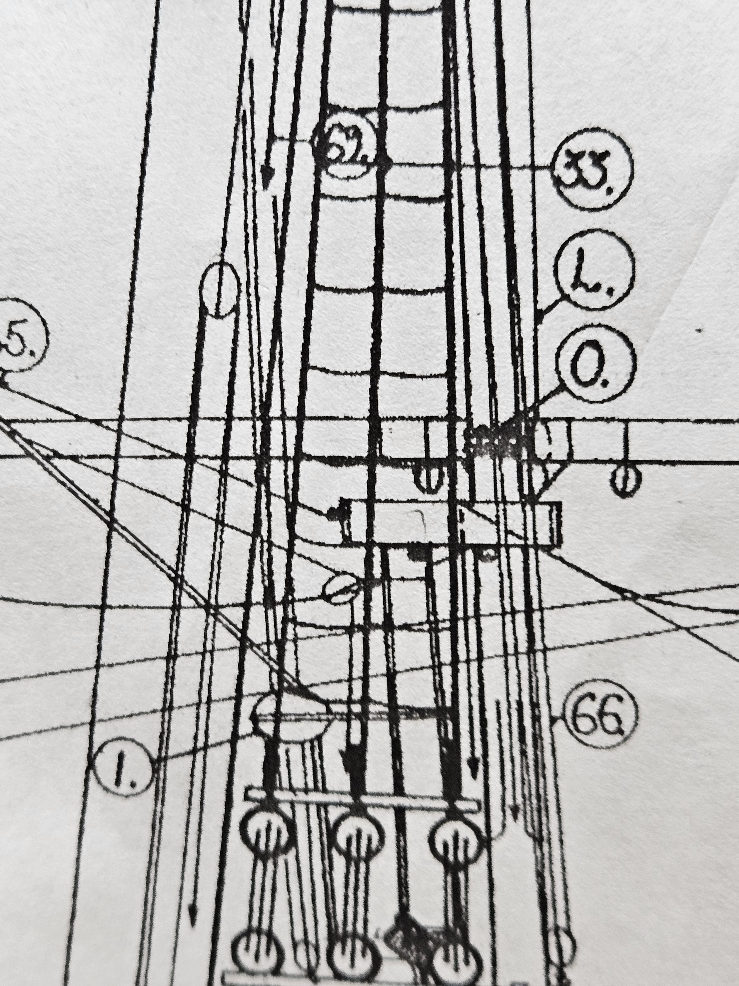

I've moved on the to the Fore Topsail Yard sling. I had to study the plans to attempt to understand how it's rigged. I made a drawing of how it looks like it goes. The runner goes to a single block, which then goes to tackle on one fall, and the other fall goes ??? somewhere. The instructions are no help either.
I cannot for the life of me, understand where this fall goes. Because of this, I'm going to omit the runner block entirely and have it go directly to the tackle double block. This will not apparently be accurate, but I will be able to sleep at night.
For the tye, as per the plans, I turned it round the topsail yard, and double seized it as neatly as possible, and made the running end extra long, so I can seize a double block for the tackle later, once its gone through the topmast sheave.
Getting all the blocks and ties on the yard, before I attach the topsail.
Using the Vulcan trim technique I described previously, I also made the lift blocks for the topsail yard. Coiled and labeled for rigging later.
As before, looping the standing end rope through the eyebolt and over itself again, before seizing with fine thread. When it's done, it will hang and move more freely once the lifts are rigged.
Again, making it as neat as possible. I did both sides, then hung the cap on the topmast until I'm ready to secure it with the topgallant later.
Moving on the the yard parrels. These will go around the topmast and down. I am not adding the yard yet, so I'll build the parrel and loop it around just one side for now.
I'm going to try to make the eye small, by looping one end through the rope itself, then seizing with thread.
It didn't turn out too bad, but I was only able to get one loop through, instead of the two I wanted. It just means I'll have to trim the end off super close.
Best I can do....
For the beads, my wife had some small ones for making bracelets. They come in a set of many different colors and shapes.
These little 1/16" ones will do just fine for me.
The ribs for these things are really small. I had some left over 1/32" planks, so I just roughed out a shape from there. I drilled the holes first before shaping them. I won't be able to hold these little things to drill later...
This is what a scaled rib looks like, compared to the instructions.
I used the needle files to make the B shape, while it's still attached to the plank. I need 6, but I'm only making 5, since I broke a couple.
Frustration is winning out here.
Finally cutting it free with a scalpel, then I'd grab the round ends in my fingers, and file the flat end straight, since the cut is a little crooked.
Once they were all made, I fed 5 ribs and 4 beads/trucks through the top hole, up to the eye.
Then around the yard between the cleats on the starboard side.
So that it doesn't come unraveled later as I handle the yard, I eventually run the running end through the eye temporarily.
After the Tye and parrel is done, I went about securing the topsail to the yard. I used my ''clamp one side, and robband the other to get it started'' technique as before.
I add two robbands per strip of canvas. I make sure the sail is mostly forward, and not hanging under the yard too much. The thread gets trimmed close, once the dab of CA glue is dry. The scalpel makes 'sharp' work of that. The scissors can't get close enough, I've found.
The Topsail bunt and leech lines go to a double block, attached to the cross tree. I'm also following Steel/Peterson for where the blocks should reside.
Those were just 3mm double blocks, one for each side. I make the standing ends an inch or two long, so that I have enough to clove hitch them to cross trees.
I'm attaching them close to the mast. Afterwards, I'll blot with CA glue twice to make sure the knot doesn't come undone. Then I'll trim the end close.
While the glue dries, I use tweezers to grip and hang the blocks so they're not sticking forward. They actually need to hang.
The finished product makes them look like earrings.

Prepping the fore Topsail with buntline and leechline blocks. It's much harder to clovehitch these underneath the sail, once the sail is on the yard. I could have attached these first, and tucked the sail underneath, but I felt that they'd get in the way. I ended up using a needle to help feed the rope under the boltrope of the sail. Sort of worked, but still difficult to 'grab' the ends and also have them dangle in a way I was happy with.
But it's done, and I'm happy with how the blocks hang. The leechline blocks are about halfway along the head of the sail, on the yard. The buntline blocks are not directly above the cringle, but just inward. I also placed it between other existing ropes for clue/sheet blocks, which are aft.
In continuing to prep for the sails and all it's components, I am also going to add bowlines. The blocks for these need to be in place on the masts before I really get to the rigging.  I'm doing all of this up front - i hope it pays off.
We have the Fore Topsail bowlines, which go forward to the bowsprit cap ''somewhere''...
The Fore Topgallant bowlines, which go to blocks on the Jibboom
And Fore course bowlines reeve through blocks behind the Fore Stay...
On the Jibboom, I already had a block for the Topgallant stay, but I am repurposing it as the Jib staysail downhaul, and the existing holes/sheaves will be for the stay itself. There is VERY little room up here, so attaching the block(s) were extremely challenging. The strop-rope kept un-looping. itself.
Kind of crammed in there, but I got it done. Two bowline blocks ready for 'service'.

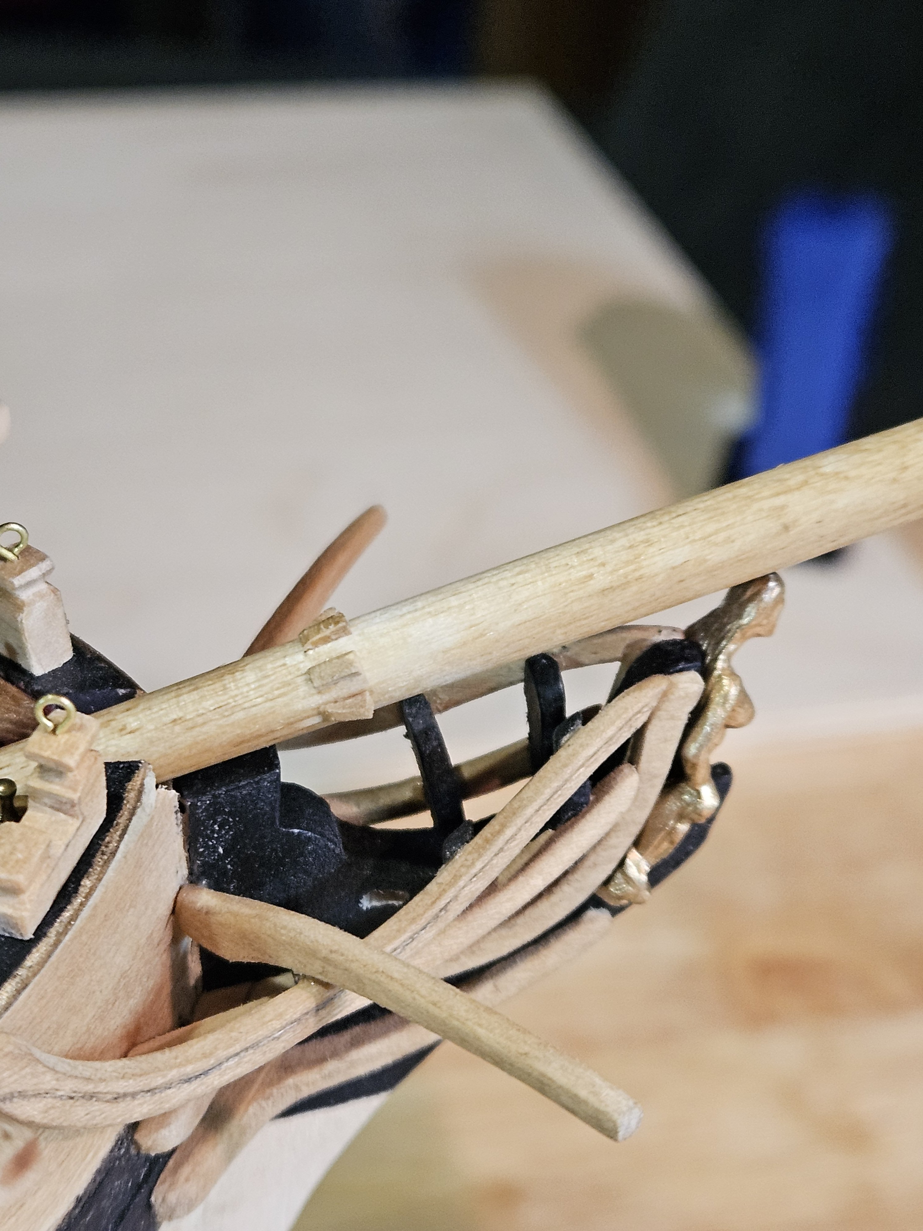

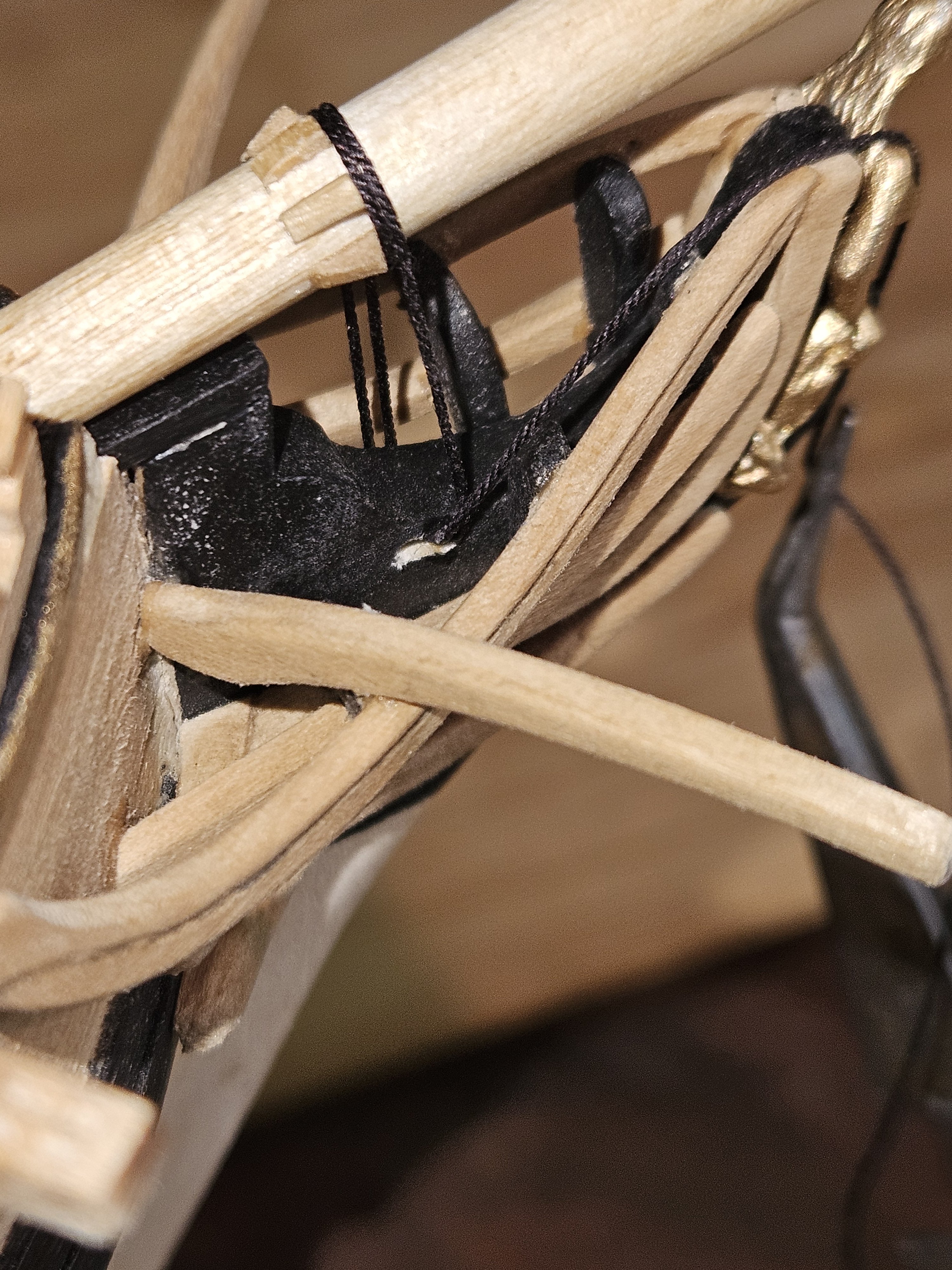

Though they don't exist on the original plans for the bowsprit cap, I added two eyebolts to attach the topsail bowlines blocks to.
Forced some room in for the remaining Fore Course bowline blocks. I'm looking at the wealth of books and plans I have for the belaying points for bowlines. With the existing pins on the ship now, I may end up doubling up on some pins. More on this later.

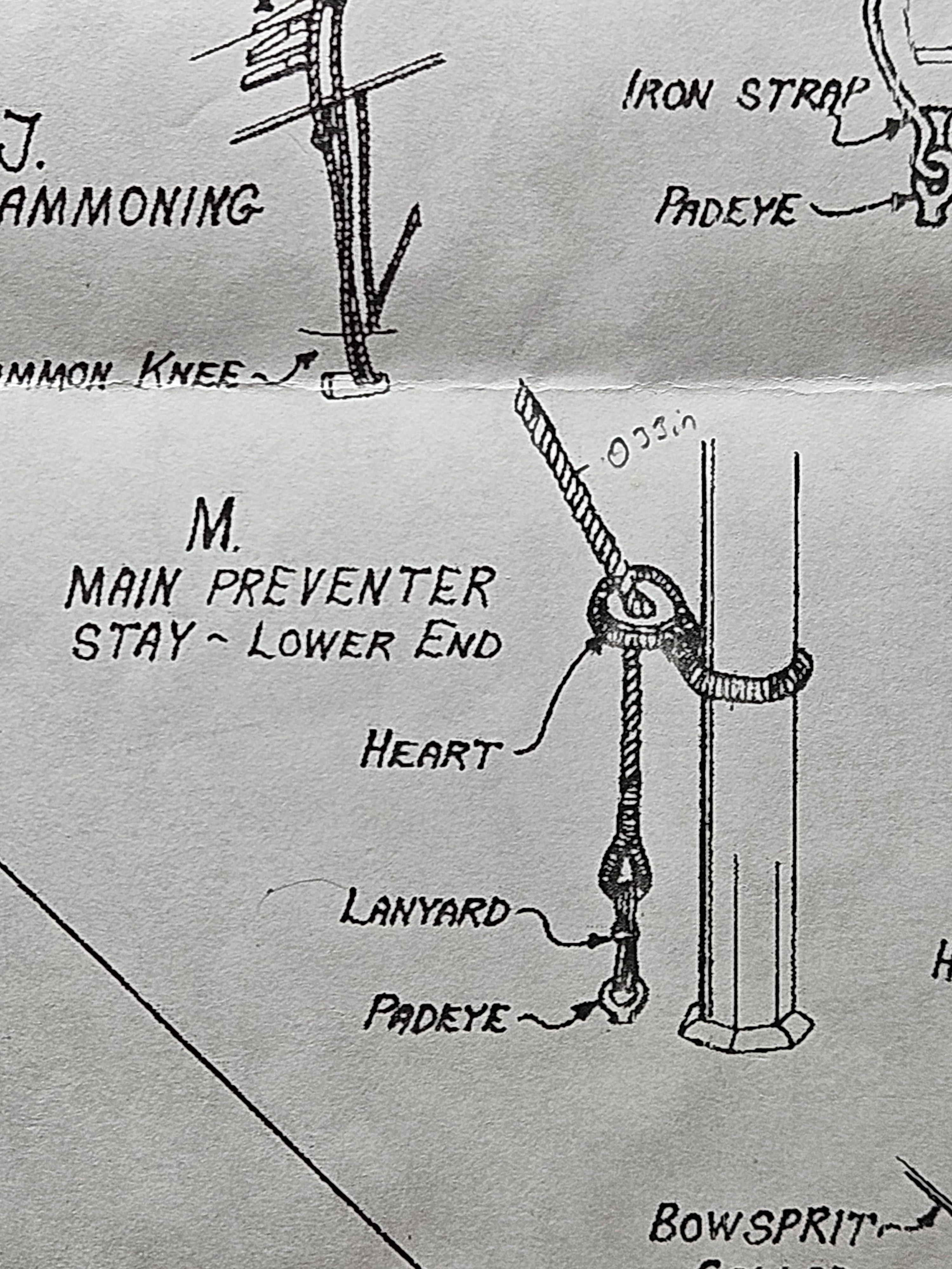

Moving on to the preventer stay and heart next. Once the lower shrouds are rigged, I won't be able to get access to attach this little guy, so I'm doing it now. I'm not sure what size standing rigging rope to use here, so I'm going with .018in. After serving it with .005in Mara 220 thread that Chuck suggested, that adds .010in in diameter, so it's about .028in
I carved the heart to this very specific shape and dimension. It was very easy since the plans and instructions provide absolutely no measurements whatsoever.  This is best attempt.
I'd wrap around the mast, and add a drop of CA glue and ''tack'' the rope ends together, and let sit overnight. I don't want it coming apart when I add the heart. I added some turns of 220 thread to keep it together.
Then I spread the running ends out forming a 'flat' of sorts, and a blot of glue to tack the heart in place. It worked initially but then kept falling out when I went to finish the long ends around. VERY annoying. The serving also started to unravel, so I needed to fix it...somehow.
I ended up abandoning this two rope end approach, and cut one off. Instead, I wrapped the long end all the way around the heart past the flat spot. I fashioned a sort of throat seizing there.
Getting it tight enough and not-falling-out-enough was very difficult. Tweezers and rope and fingers got in the way everywhere.
Finally got something satisfactory, and kept seizing with fine thread.
Trimmed the end close....It turned out better than I thought, but what a pain.
I also added a small drop of glue to the mast below where it will finally rest, then slid the loop down. I don't want this thing sliding up and down the mast, so it's where it belongs now.
I also managed to add the main topgallant brace blocks, for the running ends to the Fore trestle trees.
The final thing I went about making was the Lead block for the Main Topmast stay (Letter I.)
This needed to be a 3/16in block, so I used .018in rope to secure it to the mast.  Because of the square cross section, it was difficult to clove hitch and have the block at center, so having it just to one side, and a slight tail - it will be centered enough. There were no chocks on the mast to support its height, so just a few dabs of CA glue, blotted with my fingers was sufficient.

Progress at the bow of Fair American...

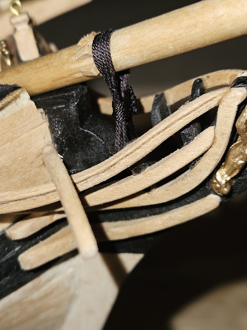

Continuing from last week, another little block to stuff in 'somewhere' is the inner jib staysail downhaul block, as seen below. It goes aft of the cap, forward of the horse netting.
Not the prettiest work, but it'll do.

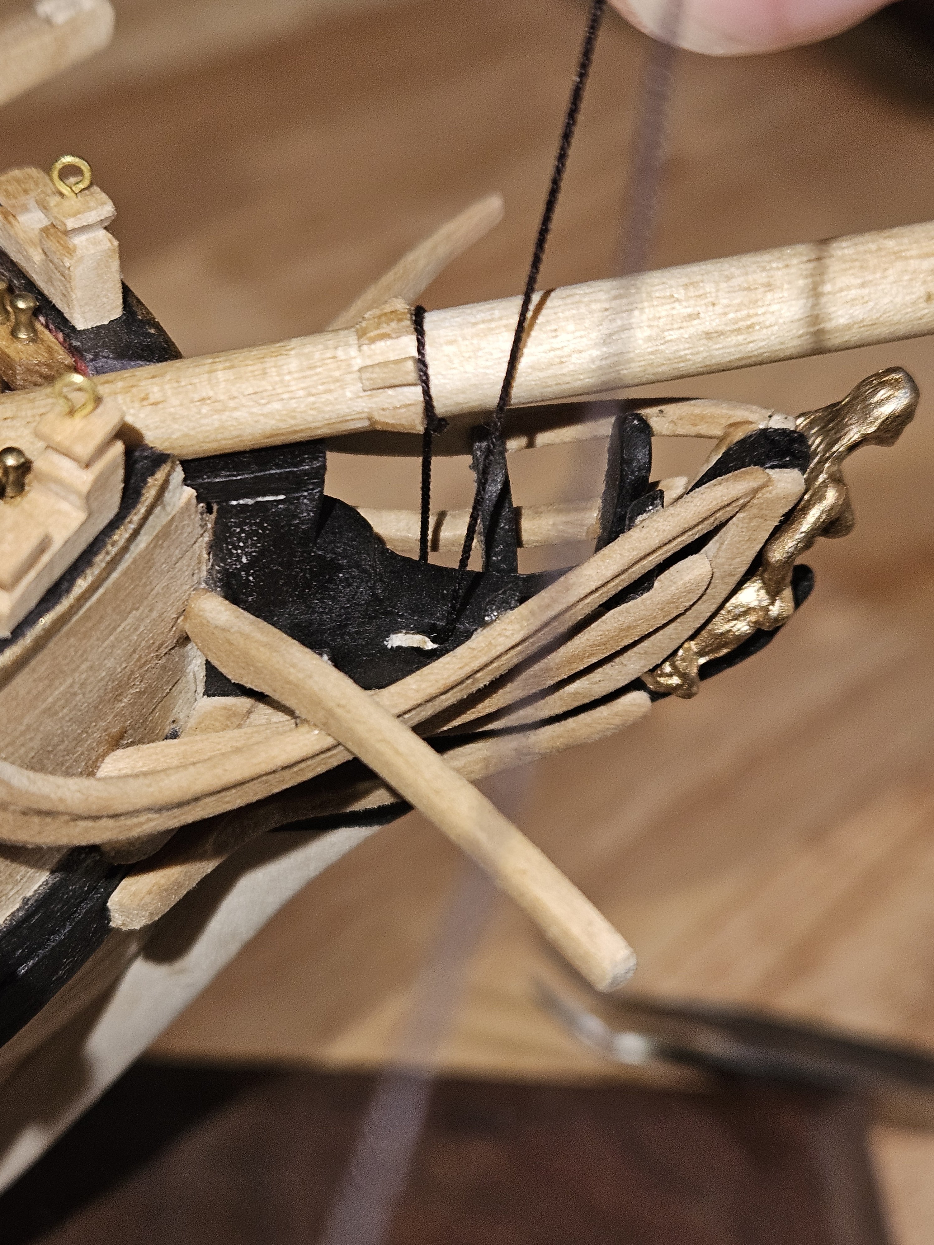

I am also starting to work on the Jib stay tackle. I made sure to add an eyebolt on the front of the cap to attach this block. Again doing the 'tack' the rope ends with CA glue first.....
Then seize it with fine thread.
I rigged the fid block with the running end, and the long standing end of the Jib Stay.  I rove the standing end through the sheave in the jib boom and coiled it for later. I really didn't want to try to seize the block at a later time and risk bumping into other elements.
It'll dangle a bit for now, but I'm okay with that. It also gets fed through the traveler that I smartly added to the jib boom before attaching previous blocks. I don't want to have to bend it to shape WHILE on the boom.
Another thing needing to be added was the traveler downhaul. I'm using .008in tan rope for this, and the fine white thread for seizing.
After the glue dries, it turns the white a little darker, so it blends pretty nicely once it's all trimmed up.
Next came the spritsail yard lifts. I made small eyes with .012in tan rope. All the ends get trimmed neatly before adding to the yard, obviously. Just showing the technique, a bit...
Now I was just having some fun, after feeding through the block. Seeing how the lift adjusts the yard by pulling on one rope or the other, was too cool. Maybe in a future build, decades in the future, I'll have a motorized rope action of some sails/lifts/halyards

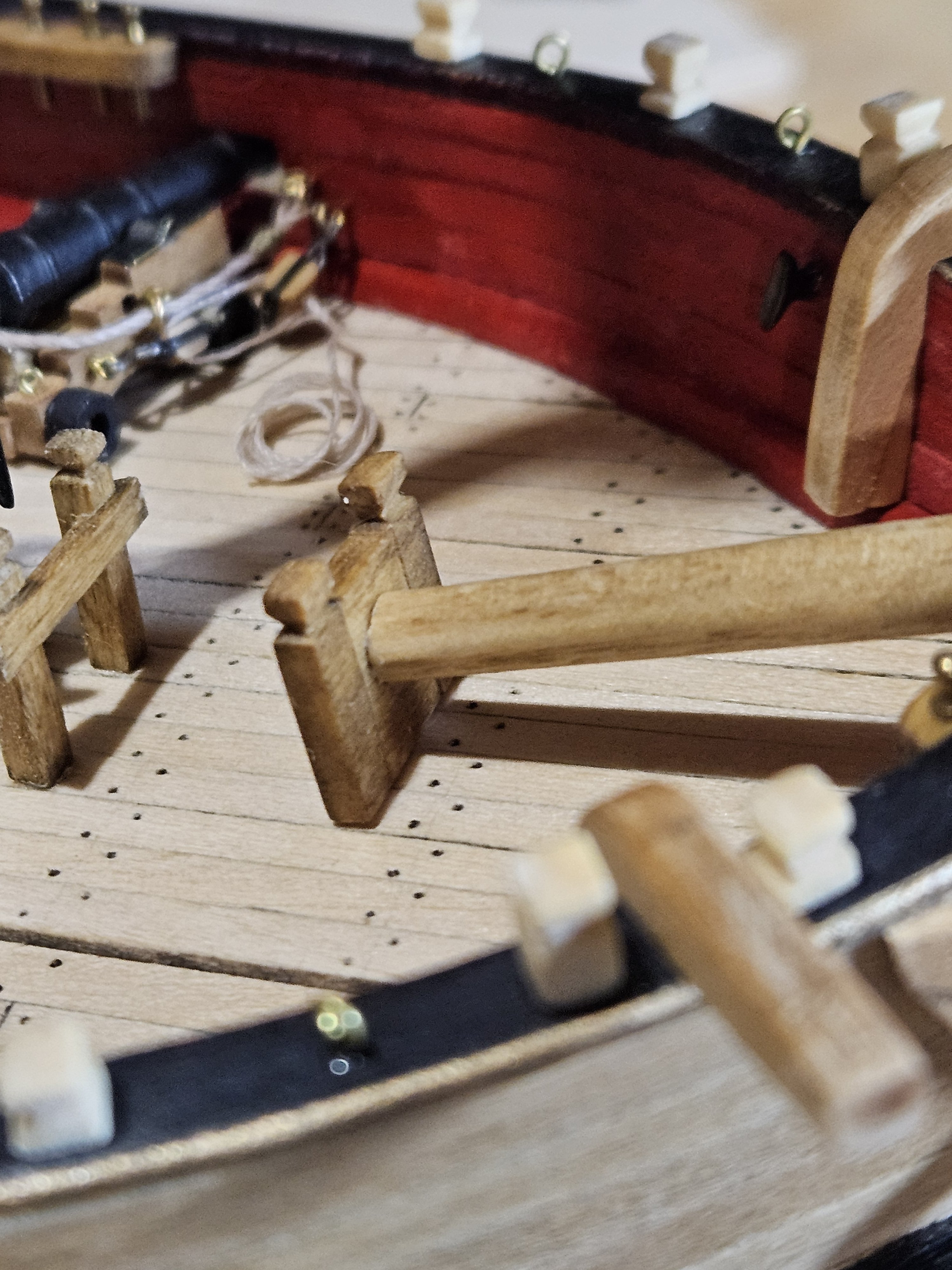

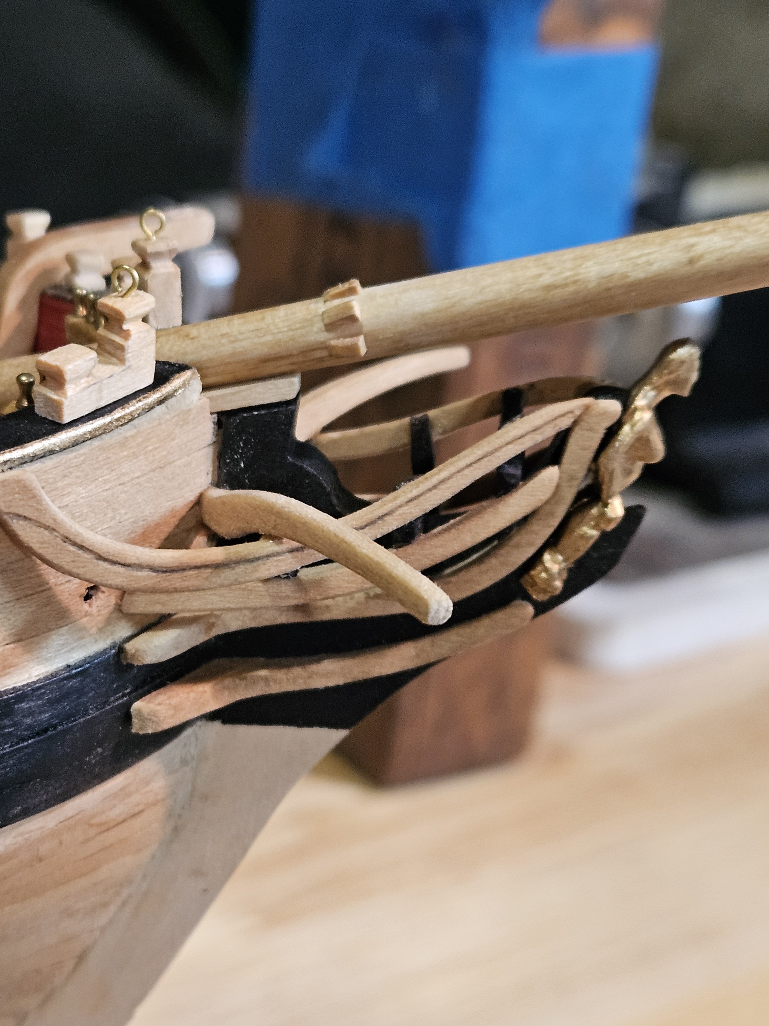

I am just about ready to mount the bowsprit to the ship, and add the gammoning. Nervous and excited.

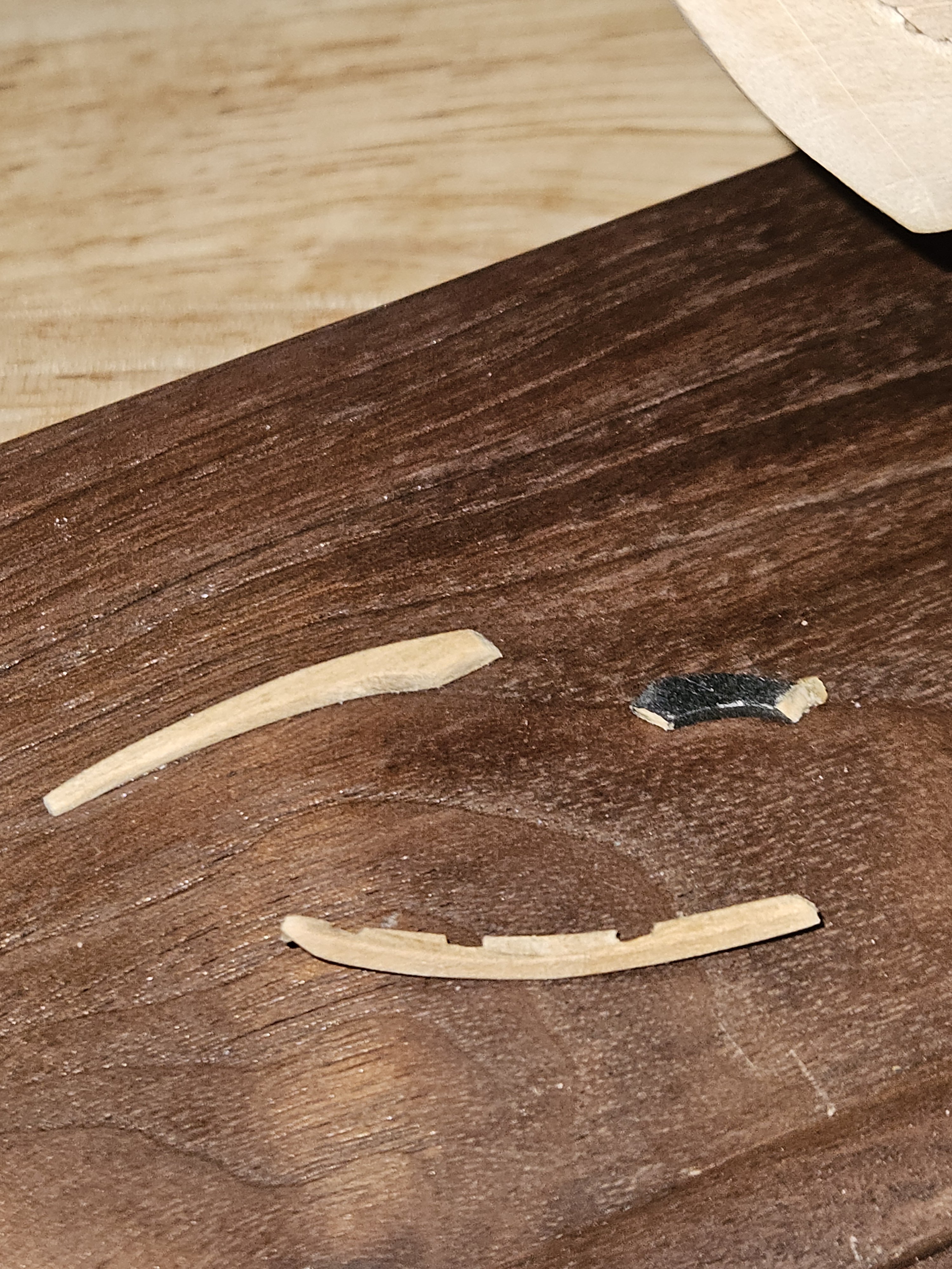

HOWEVER - the chocks for the gammoning rope is too far forward on the bowsprit.  You can see the unpainted gammoning hole, just above the head rail. If I leave it, the ropes will be overly angled forward, and not in a pleasing way. They have to be moved back.

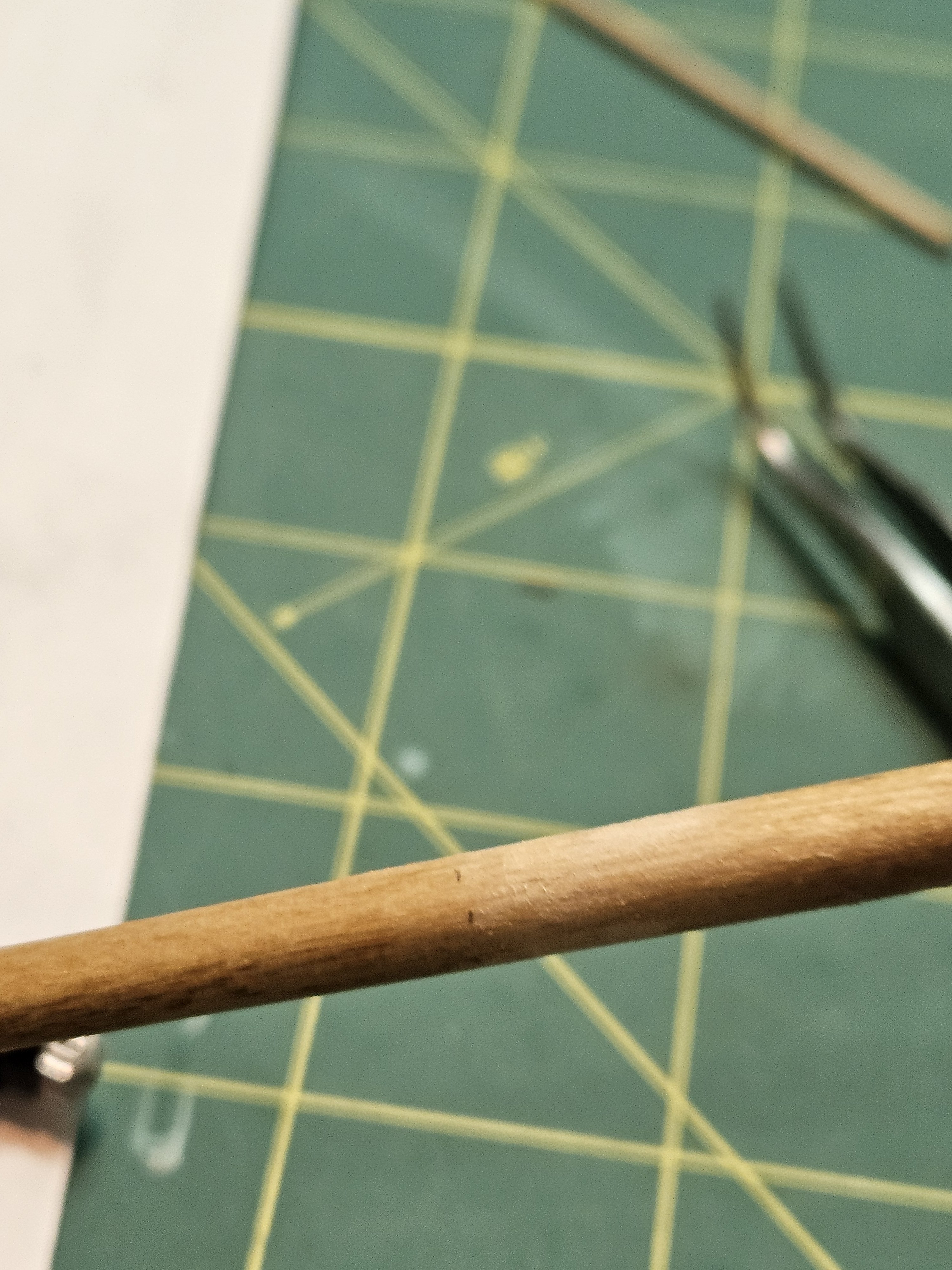

So I took them off, leaving most of them intact, and sanded the mast down smooth. I marked with pencil lines where the aft ends of the chocks are supposed to go.
Then I reglued them. They actually look a bit better than they did previously, in my opinion. I added a little bit of golden oak stain to the original sanded spot, and it blends in nicely
So now they're back in a better position...I'm happy with the fix.

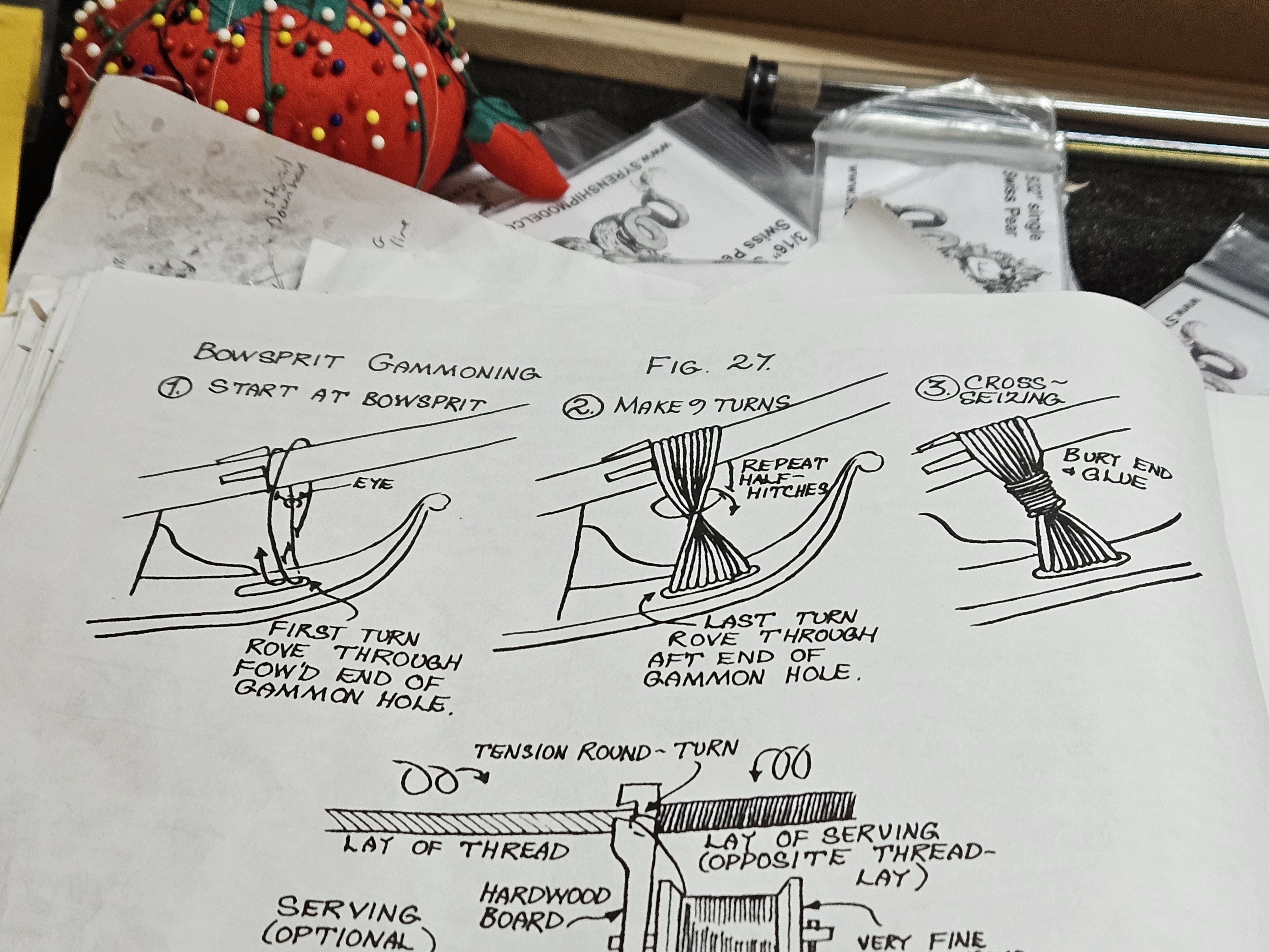

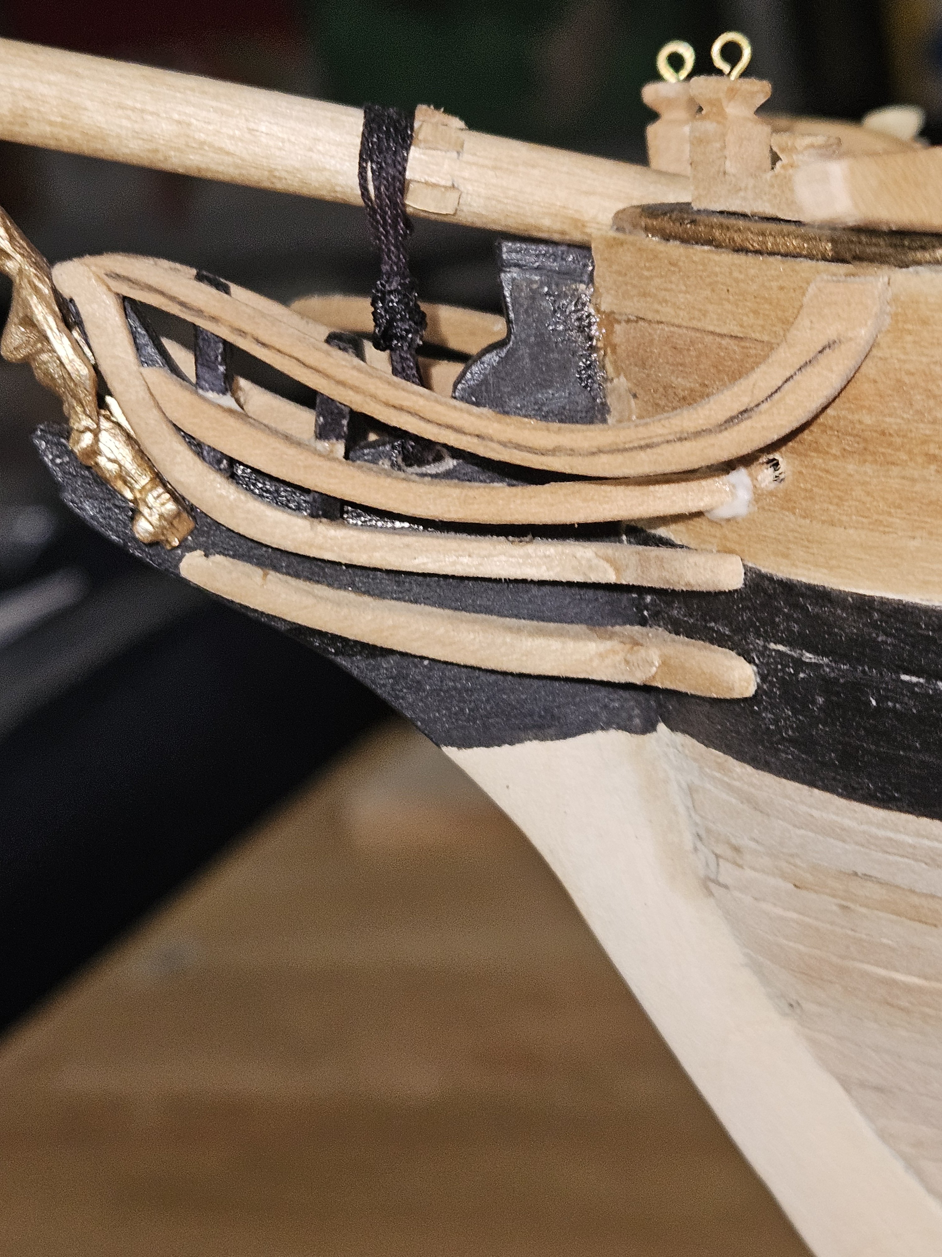

According to the instructions, I need 9 turns for the gammoning, using .025in rope. I could only manage 5, as you'll see...
To start, I needed an eye, so after roving it through itself, I seized it with fine thread.
And then trimmed it close. I doesn't need to be super pretty, since it will be primarily hidden in the gammoning, all said an done.

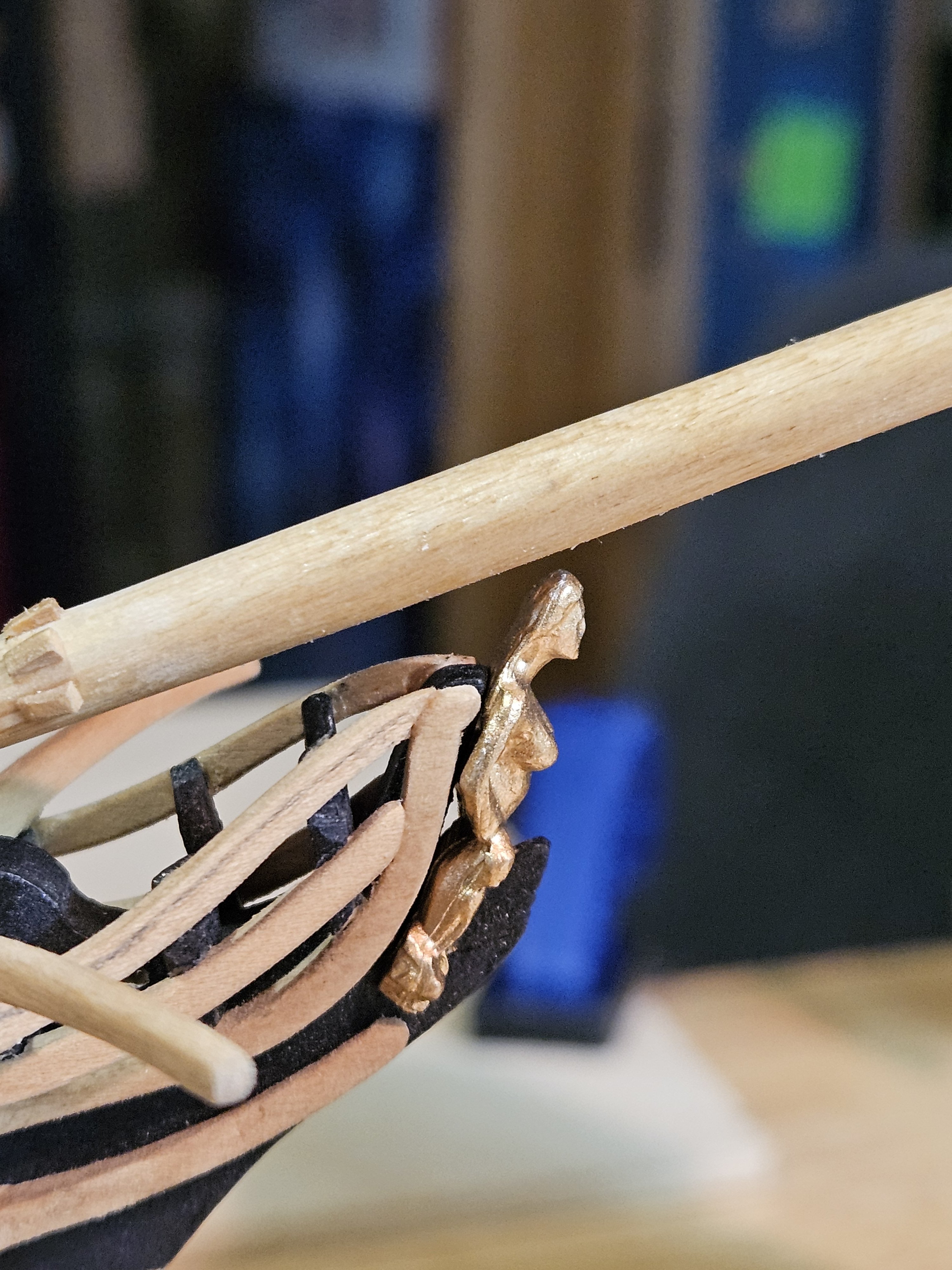

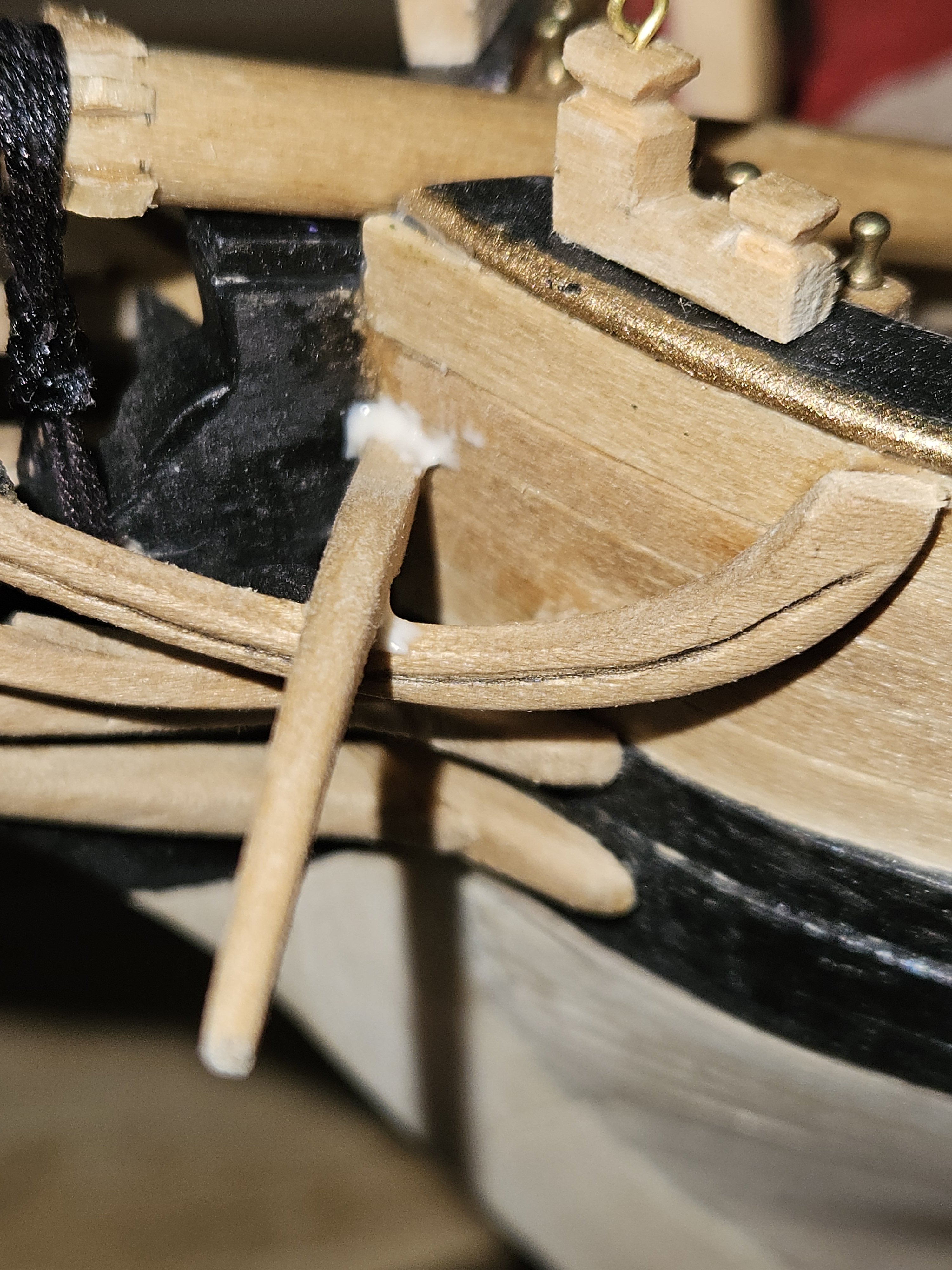

I noticed one problem though: the bowsprit is very close to the head of the figurehead.
According to the plans, it is supposed to be farther raised up. So I needed to fix this somehow.
My solution was a small chock of 3/16" wide scrap basswood. With this underneath the mast, it looks more correct.
So after sanding and painting, it actually matched up pretty well, even though this is a really close-up shot.
Much better. I feel confident in the placement, so I can move on with mounting.

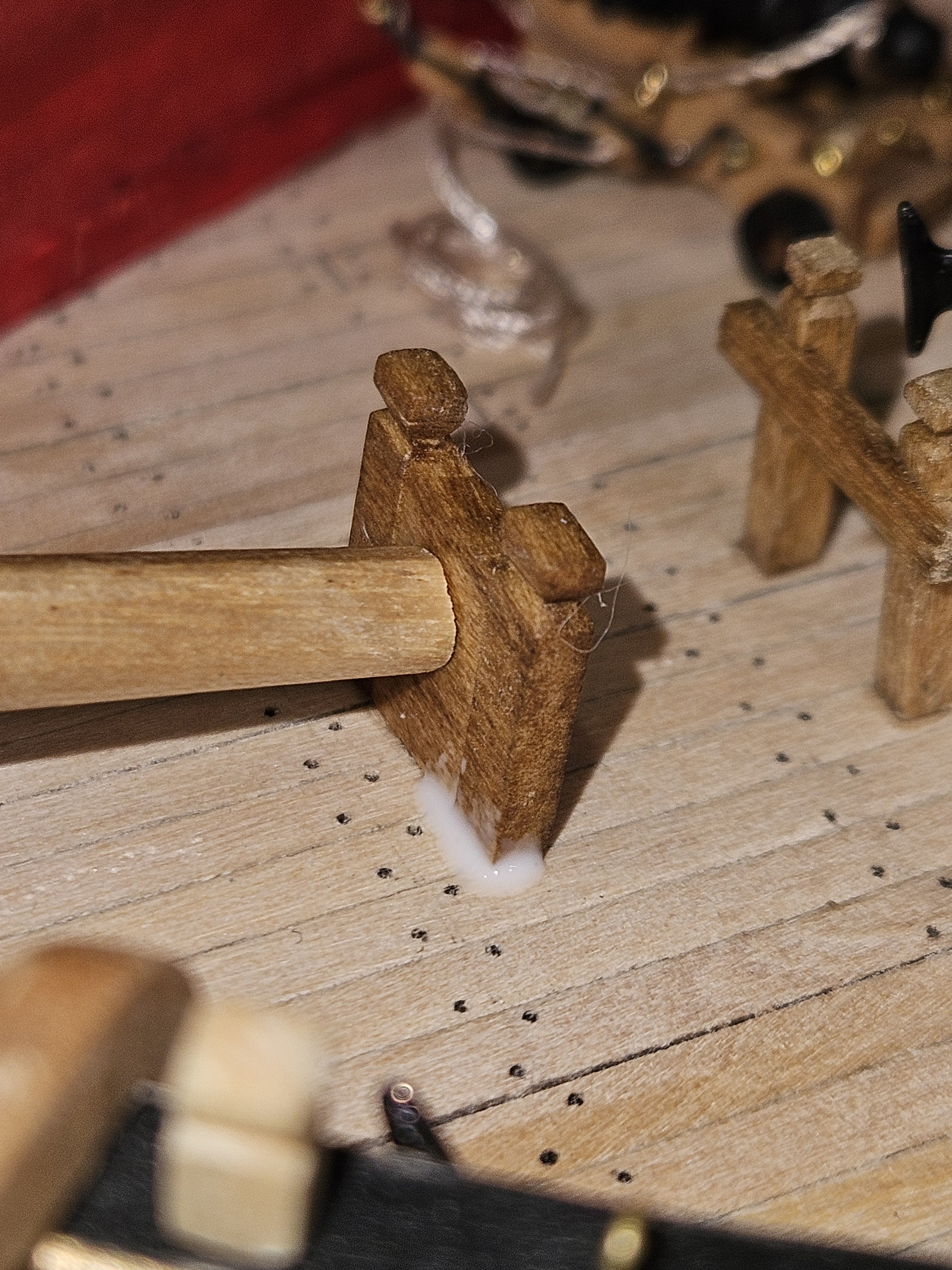

I glued the bits to the deck, and the bowsprit to the bitts. This is my one shot to get it right, I can't/won't unglue it after this.
I've been putting this off for a long time, so that I had all the blocks and other pre-rigging done before attaching this.
While it dries, I propped it up on a little lathe tool box so that the bitts doesn't dislodge from the deck.
I have to be EXTRA careful as I move the ship around now, so that I don't bump into the bowsprit and break something off. Up until now, I've been able to remove the bowsprit whenever I wanted.
Now its time to start the gammoning. Making one turn over the mast, and then through the gammon hole.
Following the steps in the instructions for working forward on the mast, and backwards on the gammon hole.
After each turn, I would dab the rope with glue and let it ''tack'' before starting the next turn. I wanted this to be as neat as possible, so I'm pulling on the rope end as it dries so it won't sag later.
I'm also tacking the gammon hole with glue so that the rope doesn't fall out of place as I wrap it. You can see how I've used reverse action tweezers to add tension while it dries.

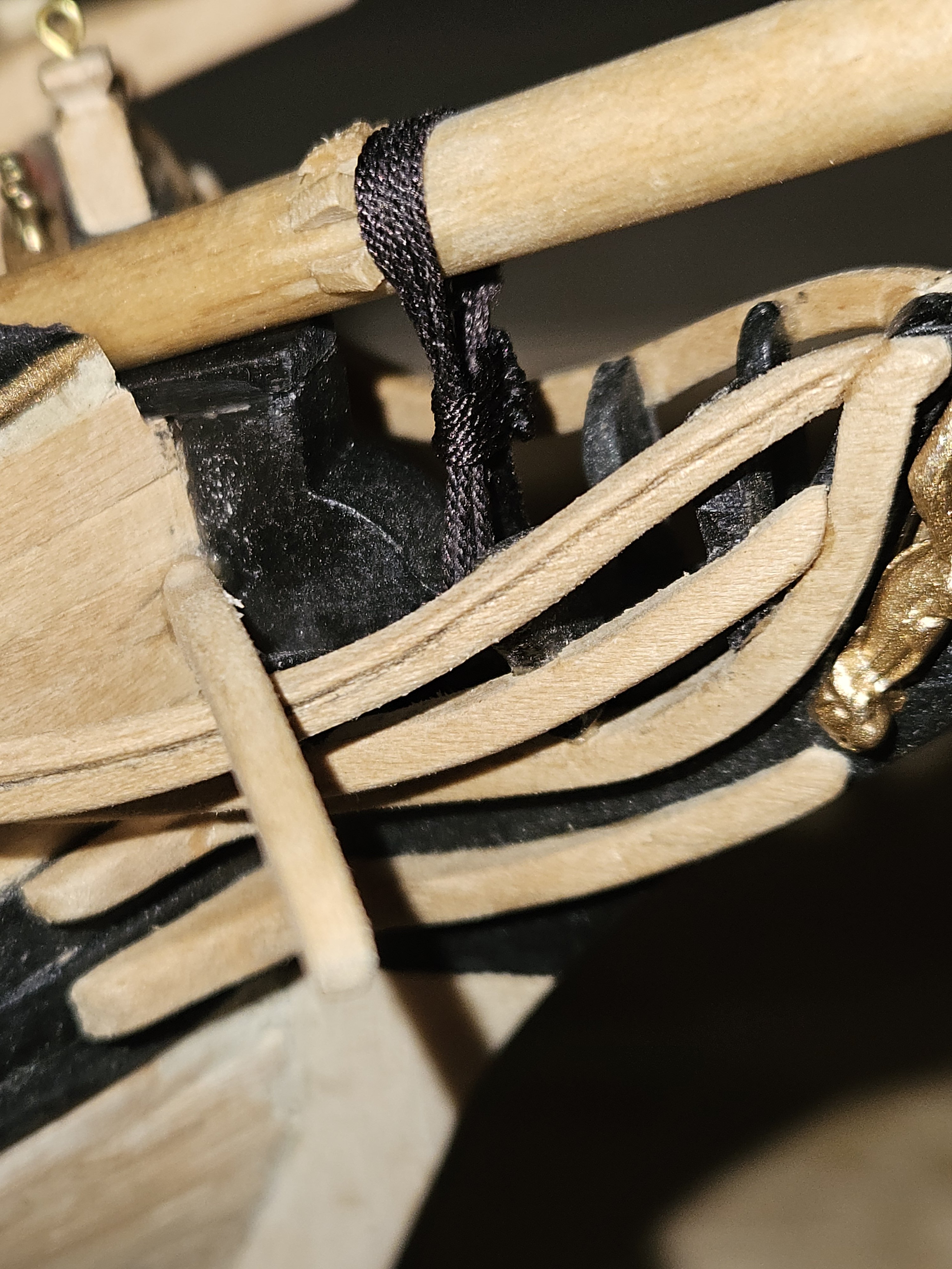

When I got to the 4th turn, I realized the gammon hole is not long enough to carry 9 full turns. I might get 5, if I'm lucky.  There's no way for me to expand this now. The rails are already in place and I am not taking them off. There's no angle for a drill or a file to reach either without damaging existing rails. I'm going to resort to just 5 turns.  This was a oversight 6yrs ago when it got drilled.
The 5th turn almost broke me, and the ship.  The 4 turns of rope were already really stuffed in the gammon hole, that I couldn't get it through.
I literally spent 2 days trying before I fed it through. This consisted of stiffening the end of the rope with CA glue and stuffing it in the hole. Then it got stuck....majorly. I also attempted to use a needle to push it through - wouldn't budge. I also couldn't grab it with tweezers, because it wasn't long enough.
I had to walk away one night, and come back the next day or I'd lose my cool.
Finally after 3hrs of pushing with a tiny drill bit, there was just enough of the end peeking through that I could grab with tweezers.
After it came through, it was really shredded. What a relief, though; I got it through.
In the process though, on the port side, some things broke. Nothing important of course....
I decided to deal with this later, after I took a few days off to cool off. I needed a mental break.
Of course, I also didn't make the gammoning rope long enough to finish the cross seizing, so I just tacked it in the middle on the port side.
I used a separate length of .025in rope to do the cross seizing, then trimmed it short.
The bitts needed to be glued some more, since it came loose. I just used some white glue on the deck line which dried clear overnight.
Even though there are only 5 turns for the gammoning, it still turned out okay-looking.
Last thing was glue the rails and knee back in place
A lot of frustration, but the Bowsprit is mounted! A milestone for me! Now I have to not bump into it and break off the jib boom.
