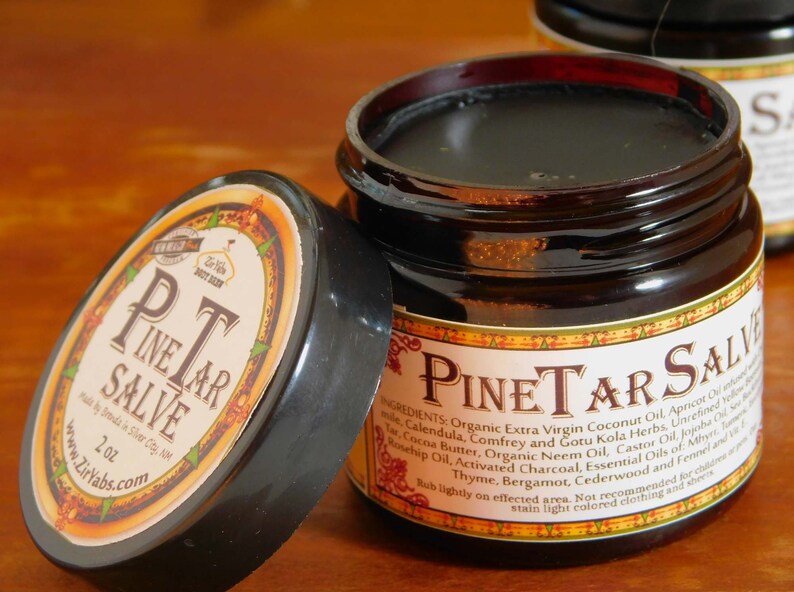

It's only "amber" when it's been thinned like all get out, as in when it's applied to fibers when making rope. All the "Stockholm" or pine tar I've ever used around boats has been very, very dark brown, virtually black, before thinning. The more it is thinned, the lighter it gets. Hence, when repeated coats are applied, the amber color deepens to black as the coats build up.
Pine tar is widely used for dressing horses' hooves and for veterinary medicinal purposes:
See the source image
It's also traditionally used as a sealer on bare wood in Scandanavia:
swedish pine tar
And it's the traditional method of treating wooden baseball bats to provide a sticky grip for the batter:
Image 1 - Rawlings GPT16 Genuine Pine Tar Can 16 oz. Baseball Softball Bat Grip Enhancer
Dark, dark, dark brown... virtually black.

And if you really want to get the ladies' attention, try some pine tar cologne: A.G.A. Correa's 'Seized' (tarsmell.com) :D
