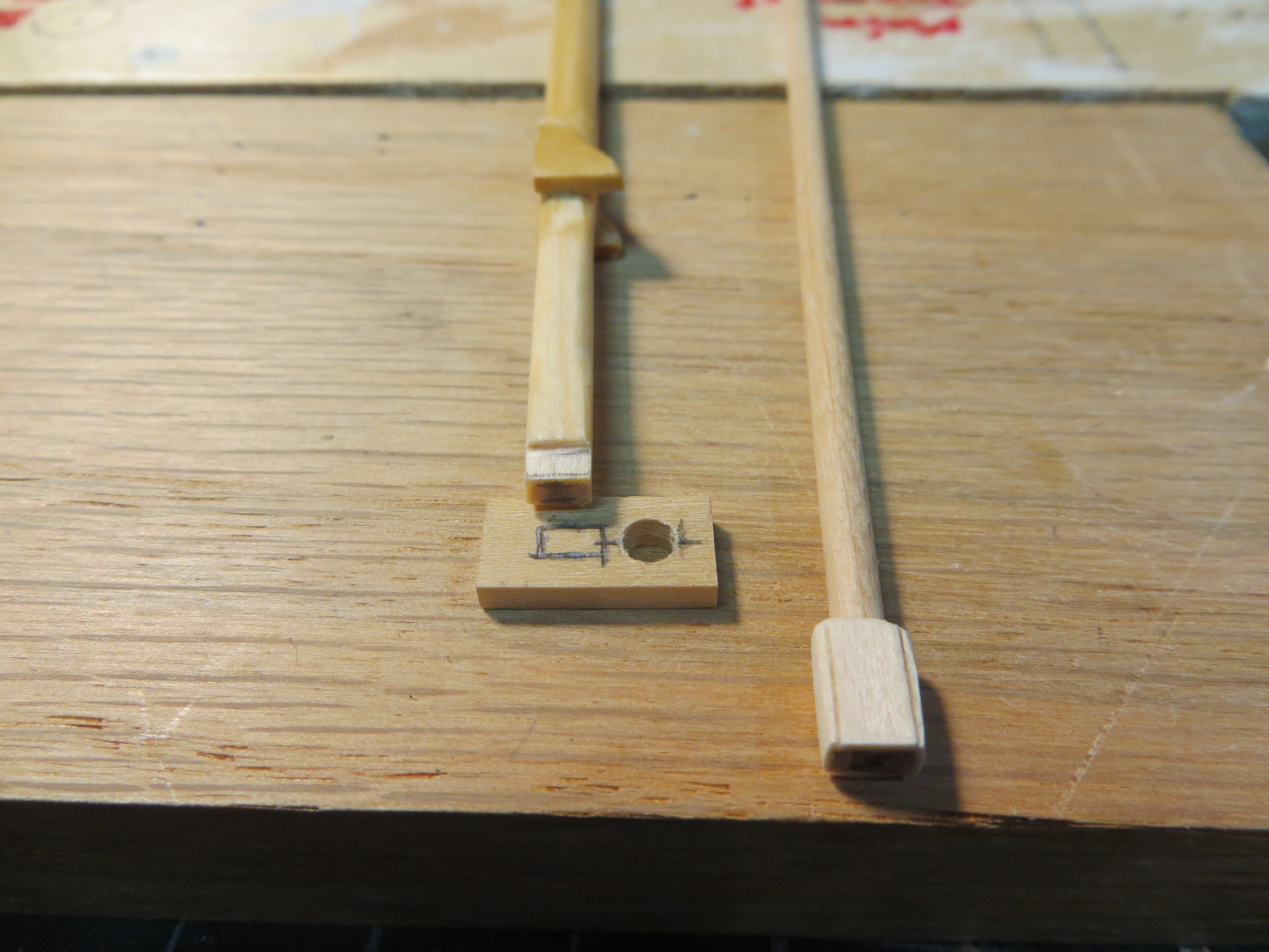

Next up was the fitting of the Bow Platform.  I found a suitable piece of flat 1” x 1/32” thick basswood and sanded it to fit in between the railings.  A support was required at the stem to lift it up
flush with the railings.
I added another ringbolt to the bow platform and applied a coat of wipe-on poly to protect and seal the wood.  It’s really starting to take shape now!

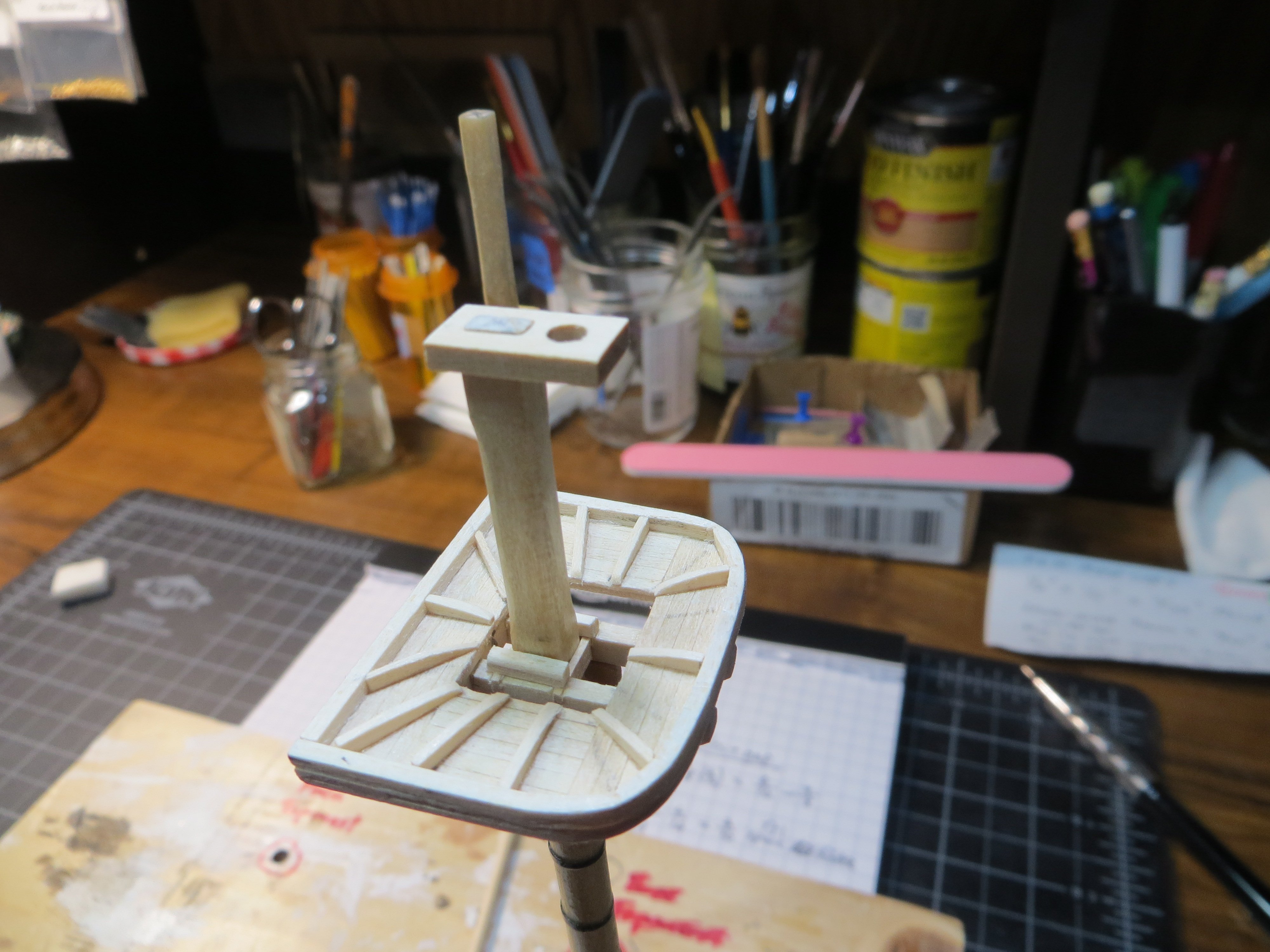

I’m circling back to my previous post.  Here is a picture of the lower masts, dry fitted after adding the mast rings and applying 2 coats of poly to seal the rings.
Next up, I plan to drill all the holes for any rigging that is attached to the tops now.  In addition to adding trestletrees, crosstrees, aft rail stanchions with their netting, futtock shrouds, plates for deadeyes, etc.  There’s a lot going on with these mast tops!

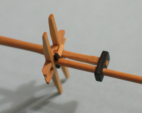

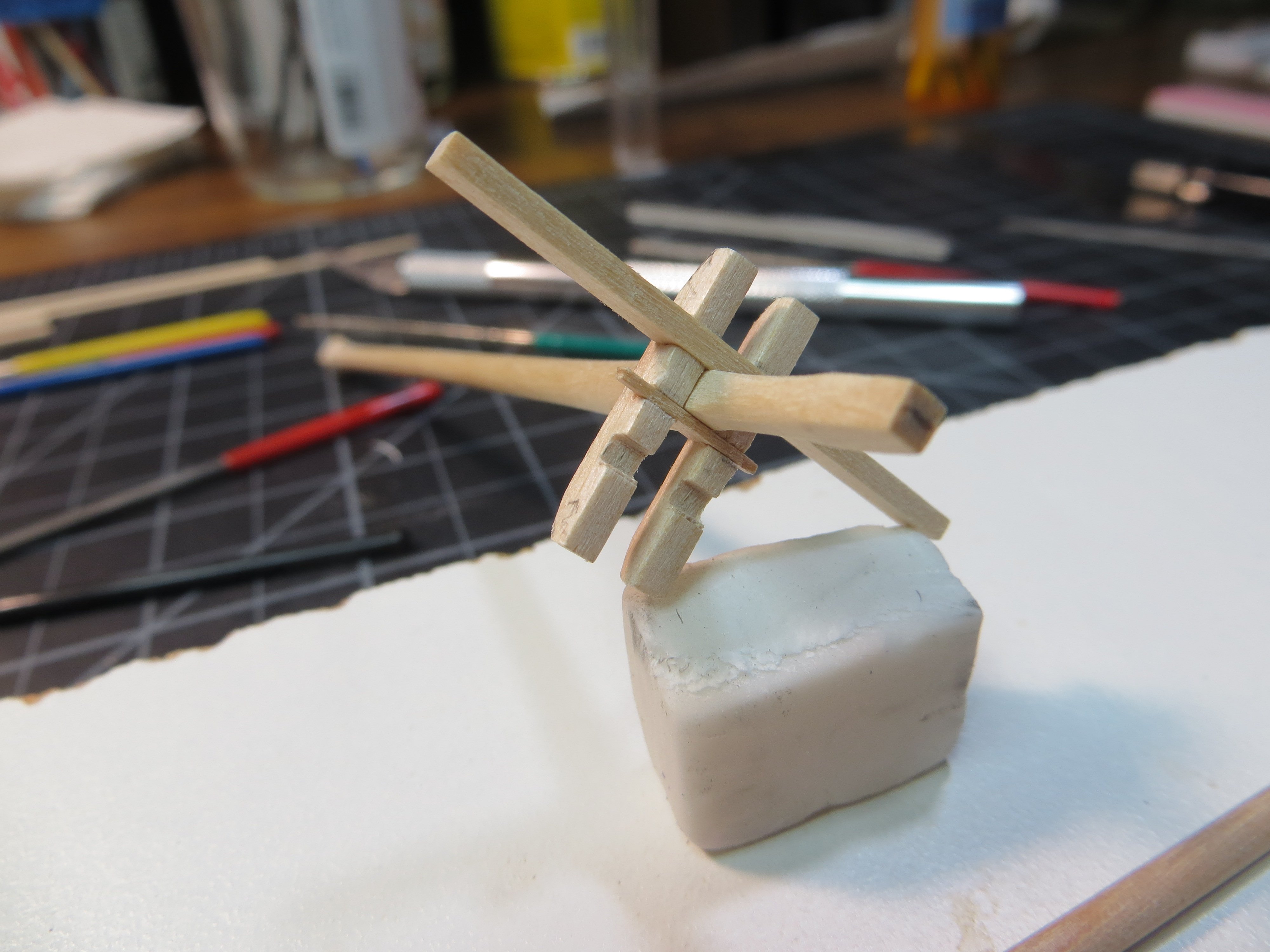

The Crosstrees & Trestletrees

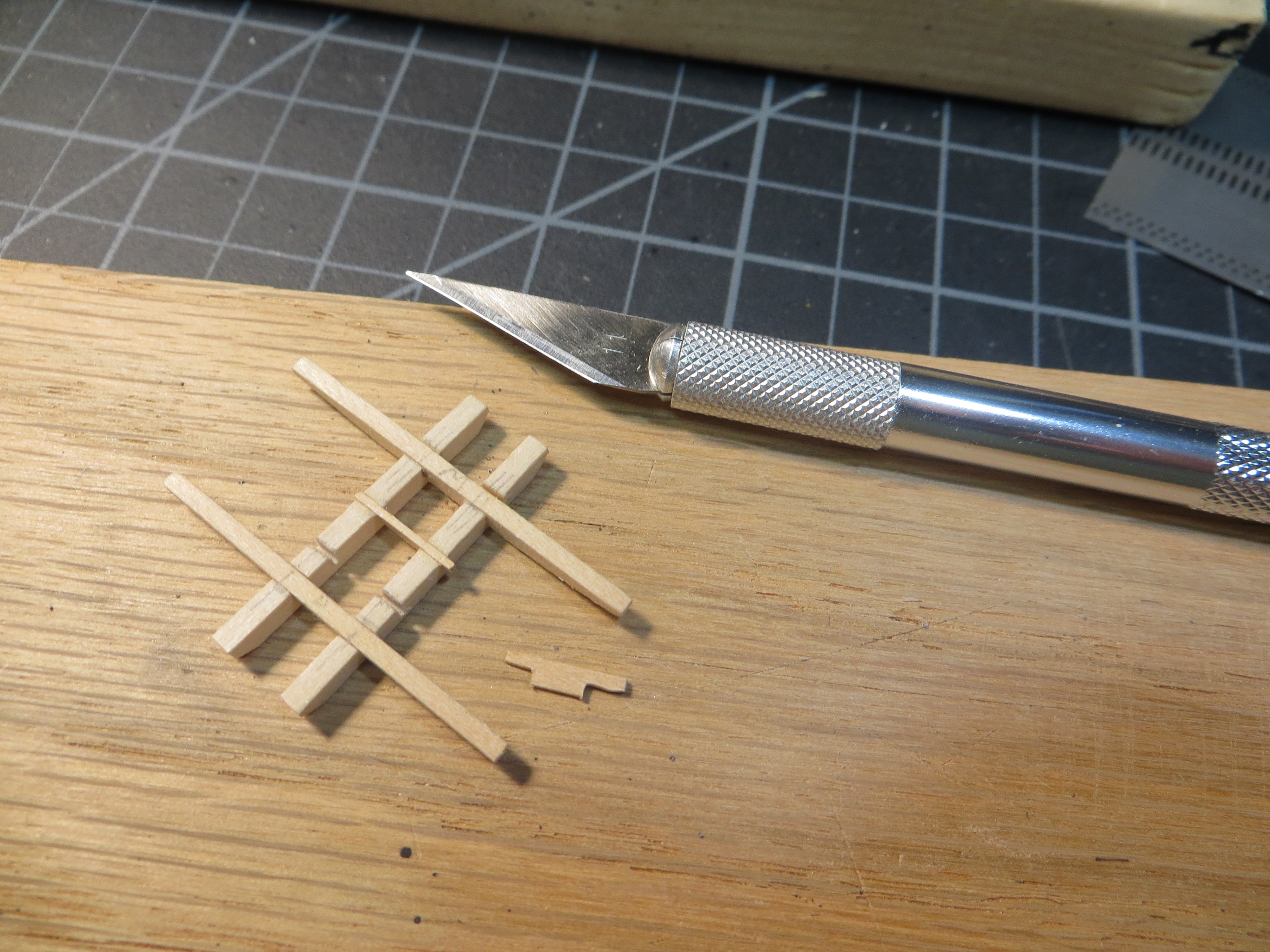

The Crosstrees (CT’s) and Trestletrees (TT’s) hold the Tops to the masts.  These pieces must fit the rectangular opening of the top and also are centered and fit the square top section of the lower masts!  The trestletrees are heavier and run fore and aft, sitting on top of the mast cheeks.  The crosstrees are a bit smaller and run side to side.  Making the notches and getting it all square is the hard part!
1.       The practicum says to cut all the pieces from 3/32” x 1/16” stripwood.  Jon Gerson, whose build log I’ve been following, says this is not correct.  The trestletrees should be made from 3/32” x 1/8” stock.  And the crosstrees are 3/32” x 1/16”.
2.       The practicum says to make the TT’s 1-1/8” long and the CT’s 1-1/2” long.  But in reality, the TT’s are as long as your tops and the CT’s are as wide.  Since they are essentially custom made, I did them one at a time.  I started with the fore mast and cut out the 4 pieces according to my measurements.
3.       I started with the TT’s.  Notches are to be made so that the inside edges of the notch match the inside edges of the opening fore & aft in the mast top.  The notches are 1/16” wide and 1/32” deep.  Make an angle on the end that is 1/16” in from each end.
4.       The Crosstrees also need to be notched so they match up with the notches in the TT”s.  They are closer together.  They need to encase the mast and hold everything together.  They have a different cut on the bottom.  Measure 3/8” in from the end and make a mark.  Shave an angle from that mark outwards so that the crosstree is 1/32” thick at the end.
Foremast Trestletrees & Crosstrees dry-fitted and 4 pieces of stripwood cut out for the main mast
Test fit the assembly on the foremast
At this point I’m supposed to make the Chocks.  Two per each assembly.  They sit in a notch between the trestletrees just like the crosstrees are fitted.  One goes between the square section of the mast and the aft part of the rectangular opening.  The other one goes in front of the lower mast but behind the hole for the topmast.  I realized that I needed to make the Topmast now so I could use the heel to measure where to place the first chock.  So, I’m going to show making the Topmasts next.  I will continue with steps for the Chocks & Bolsters afterward.

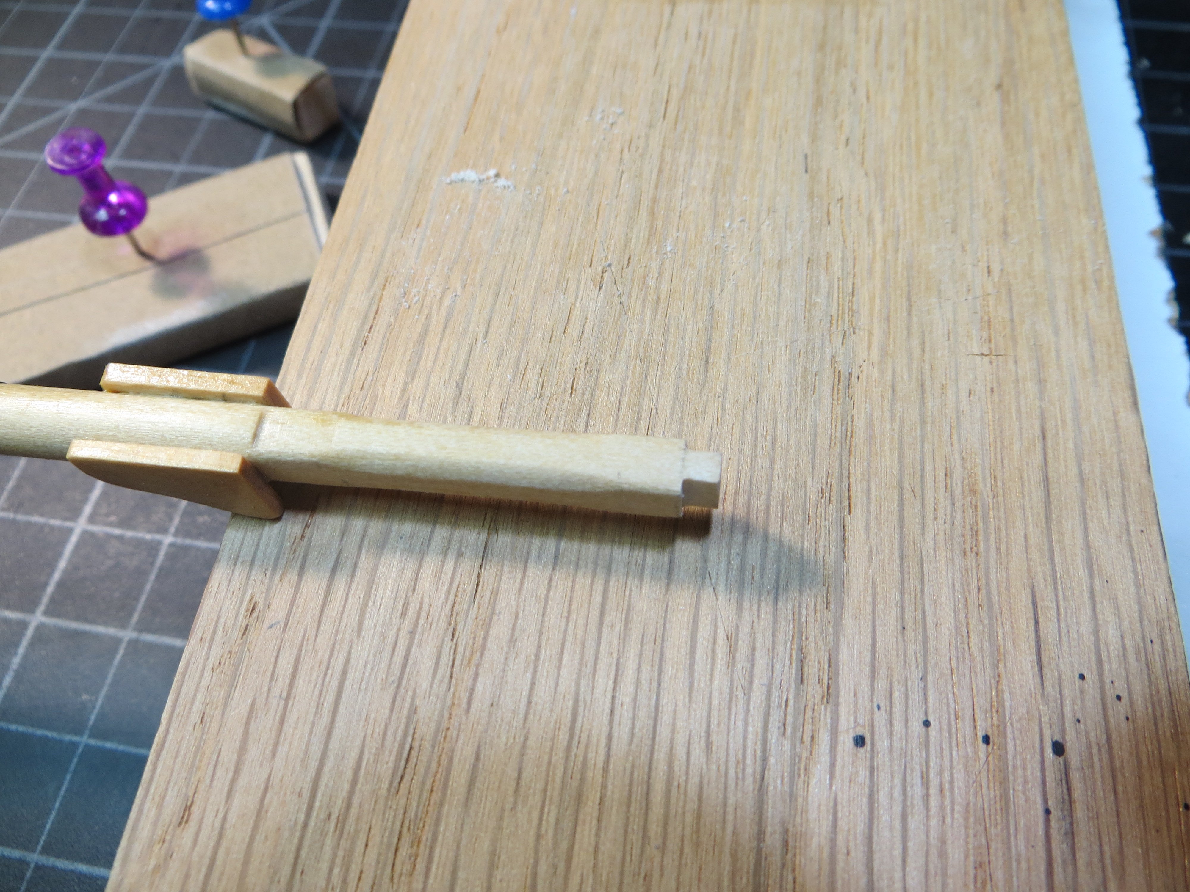

The Fore & Main Topmasts
1.       The practicum says to use 3/16” dowels for the Topmasts.  The MS parts list says to use a 5/32” dowel for the Fore & Main Topmasts.  Since the 9” piece of 3/16” supplied in the kit was already used for the Mizzen mast, I went with the 5/32” dowel.  The Fore Topmast is 5-3/4” long. The Main Topmast is 6-1/4” long.  The Mizzen Topmast is 1/8” x 4-9/16” long.  I cut them an extra 1 inch for a new technique (at least for me) that I wanted to try.
2.       The top is square, like the lower masts.  Mark the top of the dowel with a square to create a 3/32” square.  Measure down 11/16” and make a mark.  I locked the dowel in the vise and used the mini block plane and a sanding block to make the square top.
Dowel secured in the vise and the indispensable mini plane
3/32” squared off section at the top of the Topmast
3.       From the bottom of the square to the 9/32” long X 3/32” square mast heel the topmast needs to be tapered to 1/8” round.  I had a difficult time hand sanding the tapers on the lower masts.  This time I decided to try using a method I’ve read about in other build logs.  I taped off the top and bottom of the dowel that needs to be square.  Inserted end with the extra 1” into my power drill.  I squeezed sandpaper around the dowel and ran the paper up and down with the drill spinning the wood.  This worked very well for me.  I kept checking the diameter until I had an even 1/8” topmast!
Here is the dowel in the drill
A little hard to see, but here is the mast after tapering

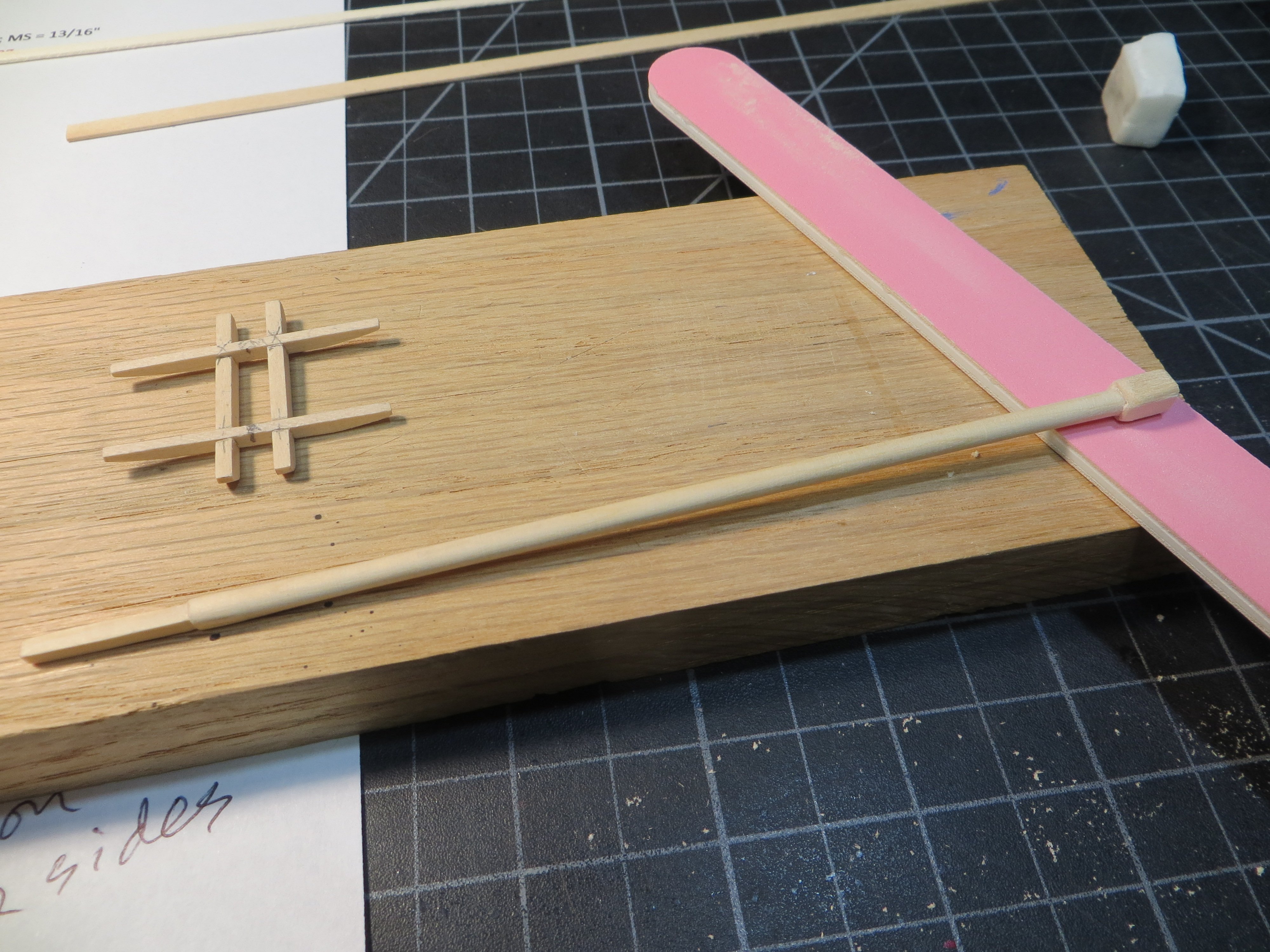

4.       I used another new technique to hold the square top end of the mast in the vise with some flat blocks of wood on the squared off sides.  I sanded the heel end down to a 3/32” square.  This is the best way I could think of to make sure the squares on both ends of the mast were lined up.  This worked well for me too!
View of the set-up in the vise.  A 3/32” square laid on the bottom keeps the sides parallel when the mast is held above.  Pic #2 with the mast locked in place
IMG_4792.thumb.JPG.4f215ac84c69a027a19bad2dfa213f3e.JPGIMG_4790.thumb.JPG.585c9786d5ce6bdd01a1d22b4e055c83.JPG
Pic with first two sides flattened with the sanding block in the background

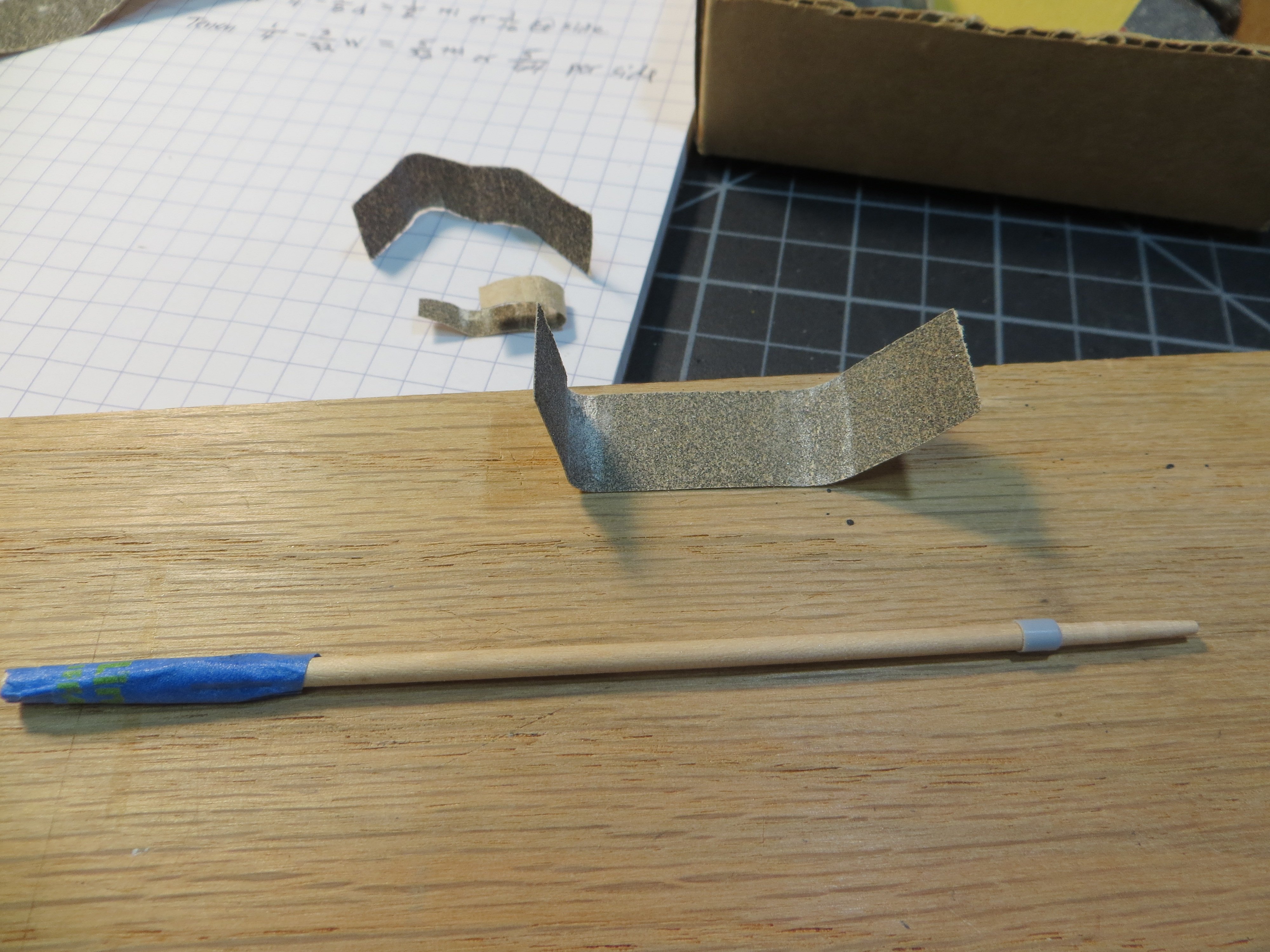

5.       The bottom heel of the mast needs to fit into the mast top, between the TT’s, forward of the lower mast.  The sides have to be built up to fit this space.  I glued pieces of 1/32” stripwood to the bottom square.  It was sanded down to smooth off the edges.
6.       At the top end, the square needed to be sanded into an octagon shape.  I used the MS plans for this area.
The space between the topmast and lower mast up to the mast cap needs to be parallel.  Now that I have the topmast, I was able to take a measurement for the chock behind the heel.  The heels of the topmasts are fit tightly into the trestletrees.
IMG_4794.thumb.JPG.27620ed6aad77418d604237b28ae534d.JPGIMG_4795.thumb.JPG.34c4e9489ca5de04f977c47df63ba13b.JPG

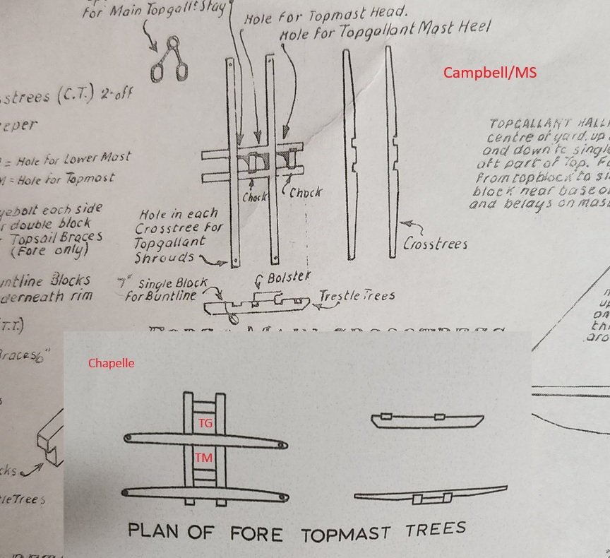

I have a question for Team Rattlesnake.  I'm working on the Trestletrees for the topgallant masts.  The MS plans show the topgallant mast heel positioned in front of the forward trestletree and a chock in front of the TG mast heel.  The practicum says to center the chock in the hole and fit both masts inside of the TT's with the single chock in the between them.  It seems odd to me to put the topgallant outside of the TT!!  What do you think is the correct way?
Thanks & Best regards,
Ed Kutay
Current build: Model Shipways "Rattlesnake"
Completed build: Model Shipways "Bluenose I"
I have plans drawn by Chapelle as well as the MS Plans drawn by Campbell.
I think the problem with Chapelle and Campbell is that they are only showing two cross trees where according to Lees there would have been three after 1706.  I would expect Colonials would have followed British practice at this time, so Chapelle and Campbell may have got it wrong.
How did the practicum draw the trestle trees and cross trees?   If there are only two cross trees, I would model it after the plans as shown.
Here is how  Petersson shows the topmast cross trees, which is how I would model it if I wanted to follow practice; with a cross tree in the middle and not a chock.
I wouldn't follow the practicum unless it calls for three cross trees.
Edited by Gregory
― Jimmy Buffett
On Hold:    Rattlesnake
I would follow Gregory's advice and install three cross trees.
I have Petersson's book. Zu Mondfeld also says essentially the same that Gregory mentioned referencing Lees, except Mondfeld's date is around 1720 instead of 1706. The Bounty (the same period as Rattlesnake) had three crosstrees.
John
Current Build: Rattlesnake (Model Shipways 1:64)
Gregory,  Here is how the practicum shows the crosstrees/trestletrees.  This is a picture of the Fore Mast showing the connection at the top of the Top Mast and the heel of the Topgallant mast.  Both are inside of the crosstrees with the chock in between.  The more I think about it this arrangement seems pretty straightforward.
I never noticed that some ships had 3 crosstrees at the topgallant!  I’m kinda leaning toward doing it like the practicum.  Mainly because it is a simpler design.  But I’m still thinking about it.  I really appreciate your feedback and the references to the historical data.
Thanks,
Ed
Ed Kutay
That certainly looks good.     I agree to keeping it simple when possible.
I personally would not sweat the historical thing unless you find yourself in a situation where a client is going to pay $50,000, only if it is "historically accurate"..😁
Edited by Gregory
― Jimmy Buffett
LOL!!  THAT'LL BE THE DAY!!

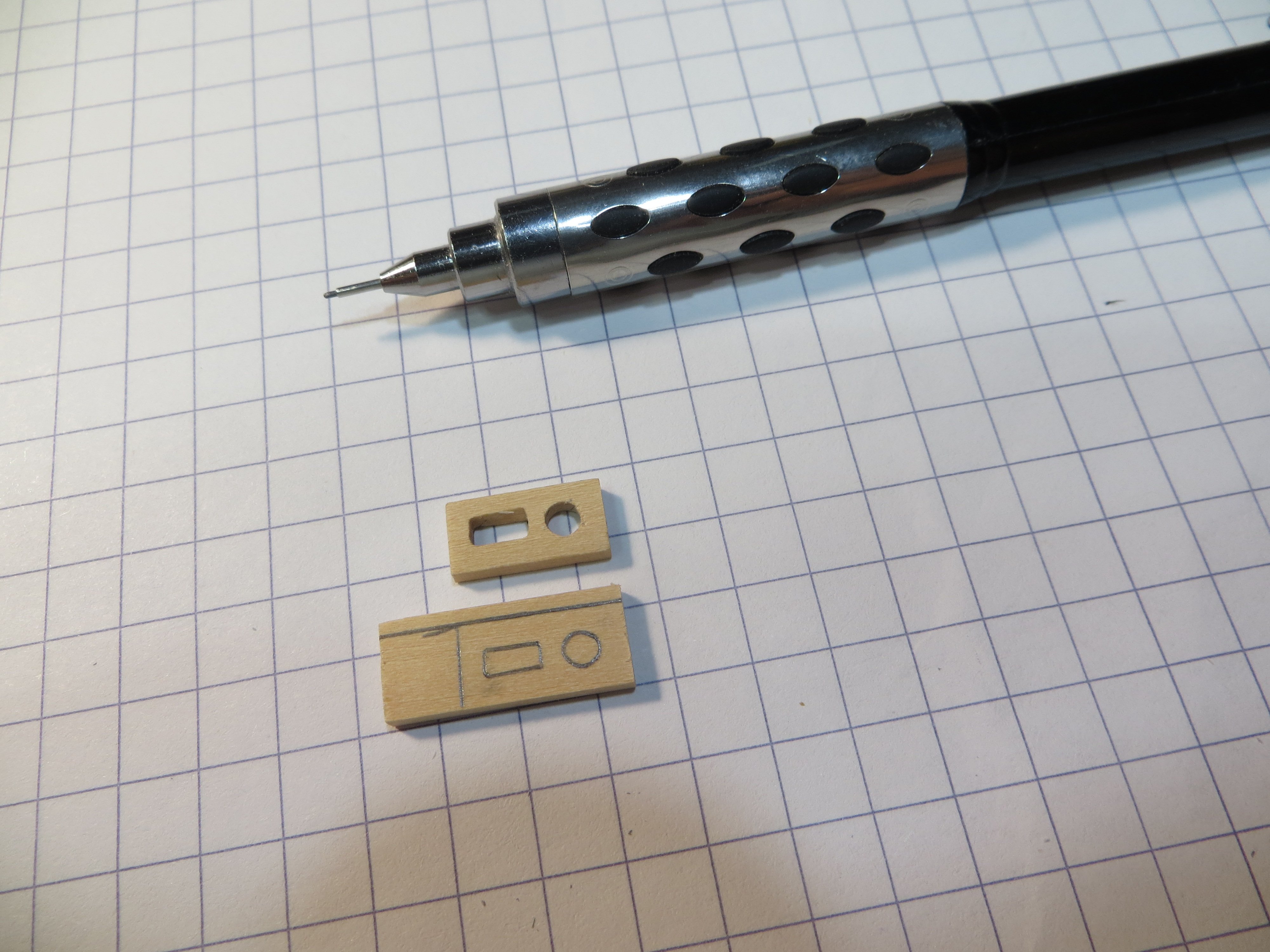

Fore & Main Mast Caps
My next task is to prepare the mast caps for the Fore & Main masts.  The mast cap holds the lower mast and the topmast together at the mast top.  These caps are provided in the MS kit as laser cut pieces.  The round hole for the topmast in the kit mast caps are 3/16” diam.  My topmast at the spot where the cap holds it is smaller, at 1/8”.  It looks like I’m going to have to make the caps from scratch to get the right size.
First, I cut the tenon on the top of the lower masts to fit the mast cap.  I cut the Foremast tenon at 3/32” wide and left the full 3/16” for the length.  I first cut a shallow line on each side with the Exacto knife 3/32” below the top end of the lower mast. Then I cut an even amount off each side until I had a tenon 3/32” wide.
Fore mast after cutting in the tenon
The fore & main mast caps are exactly the same.  The size for the mast cap should be 1/2" x 1/4" x 3/32" deep per my calculations.   In order to get the 3/32” height needed I had to use a wider piece of stripwood.  Part # 3628; is 3/32” x 5/16” wide.  I marked a line and then used the disc sander to reduce it down to ¼”.  I cut the piece off with a little extra length so I had something to hold onto when making the two holes.  The hard part is to get the two masts to be parallel between the mast cap and the top.  I measured and marked the positions of the 1/8” round hole for the Topmast because I thought it would be easier to drill this hole first.  Then I drew a rectangle for the tenon, the required distance from the edge of that hole, to get the masts parallel.  I started by drilling 2 holes side-by-side inside the rectangle and then used mini-files to square it off.  Finally, I cut the excess off the end.
The two mast caps.  The fore mast cap is done and the main mast is ready for drilling & shaping
The mast cap dry fit on top of the Lower Fore Mast section. (In case you're wondering...that’s the mizzen mast on the build board behind it)
Please Note: This is not mentioned in the MS instructions, but is in the practicum.  I will need to cut the mast caps in half, the long way, to get them on the topmast.  Cutting them with any kind of saw would remove wood with the kerf and change their dimensions!  I did a test run on a scrap piece with a chisel that did not work! The cut was uneven & ugly.  So, I tried using the Exacto knife by slowly deepening the cut.  This seems to work.  I will try this when its time to assemble everything.  Nothing has been glued yet.

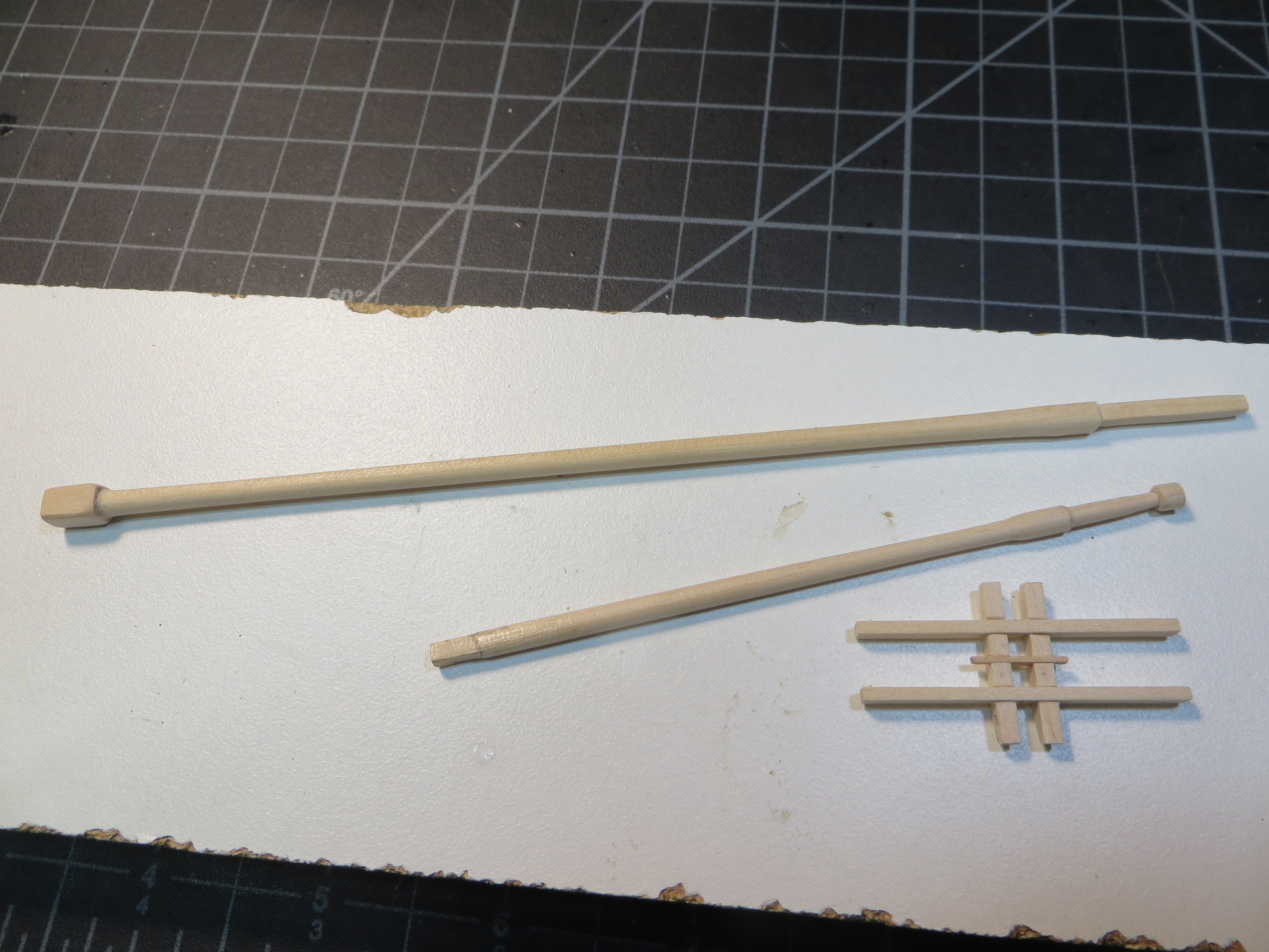

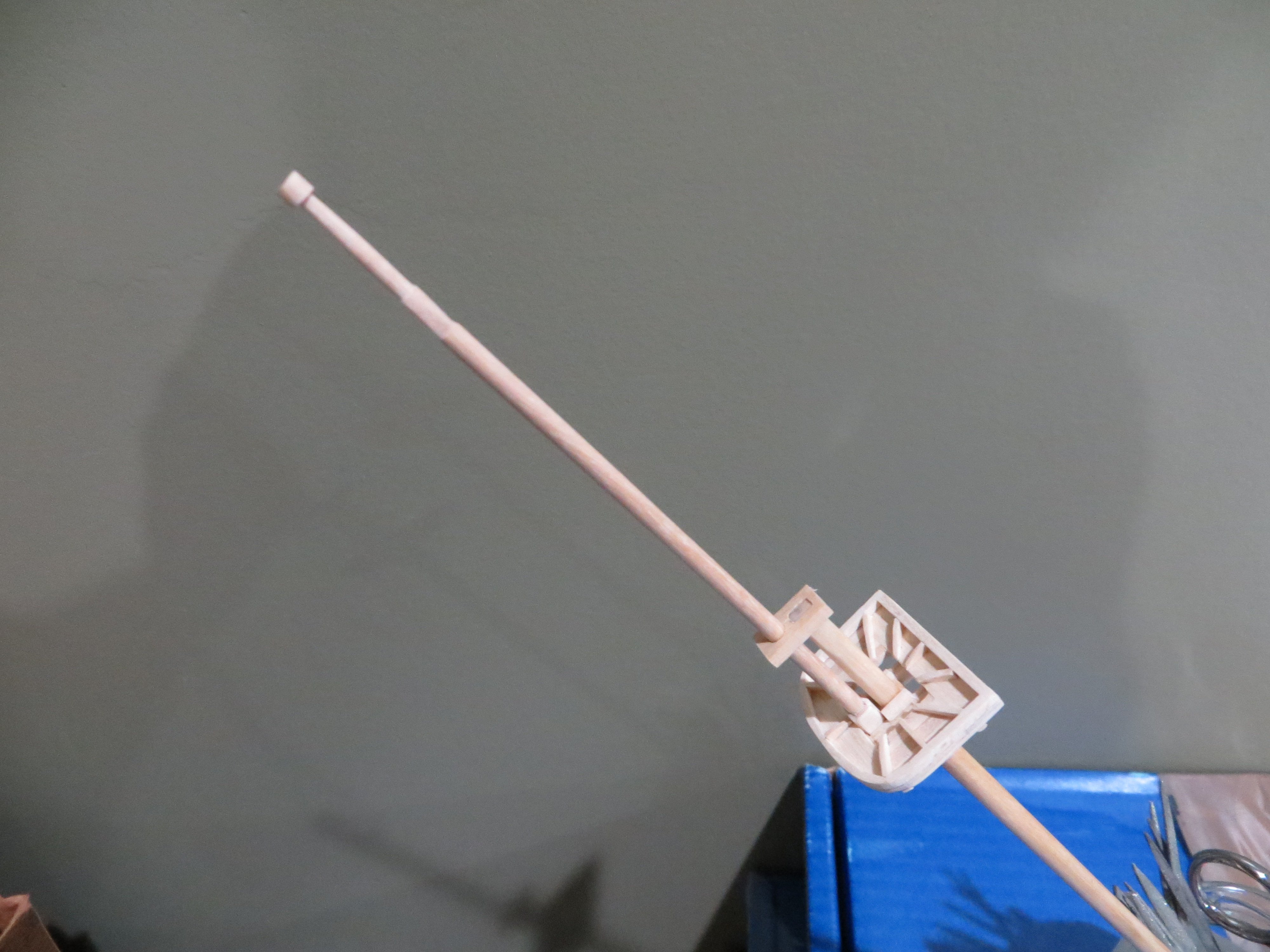

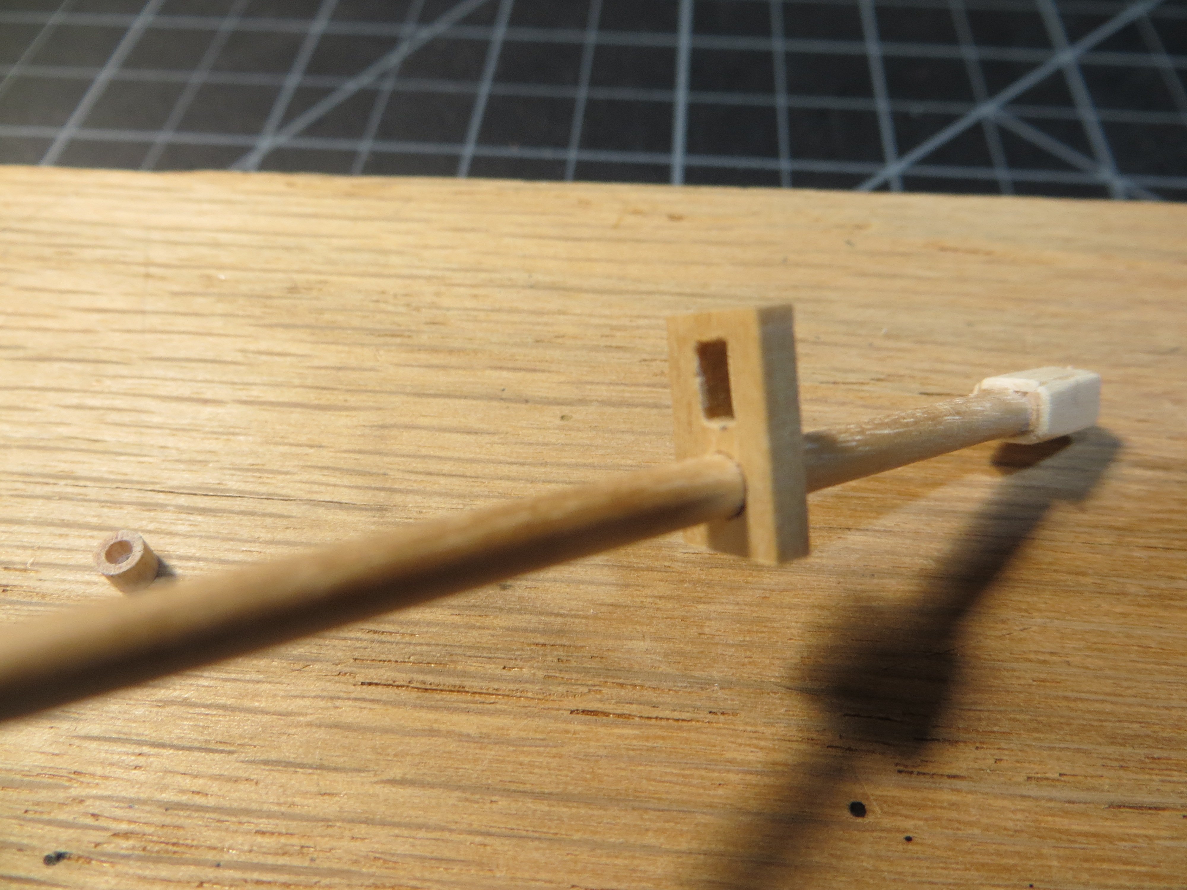

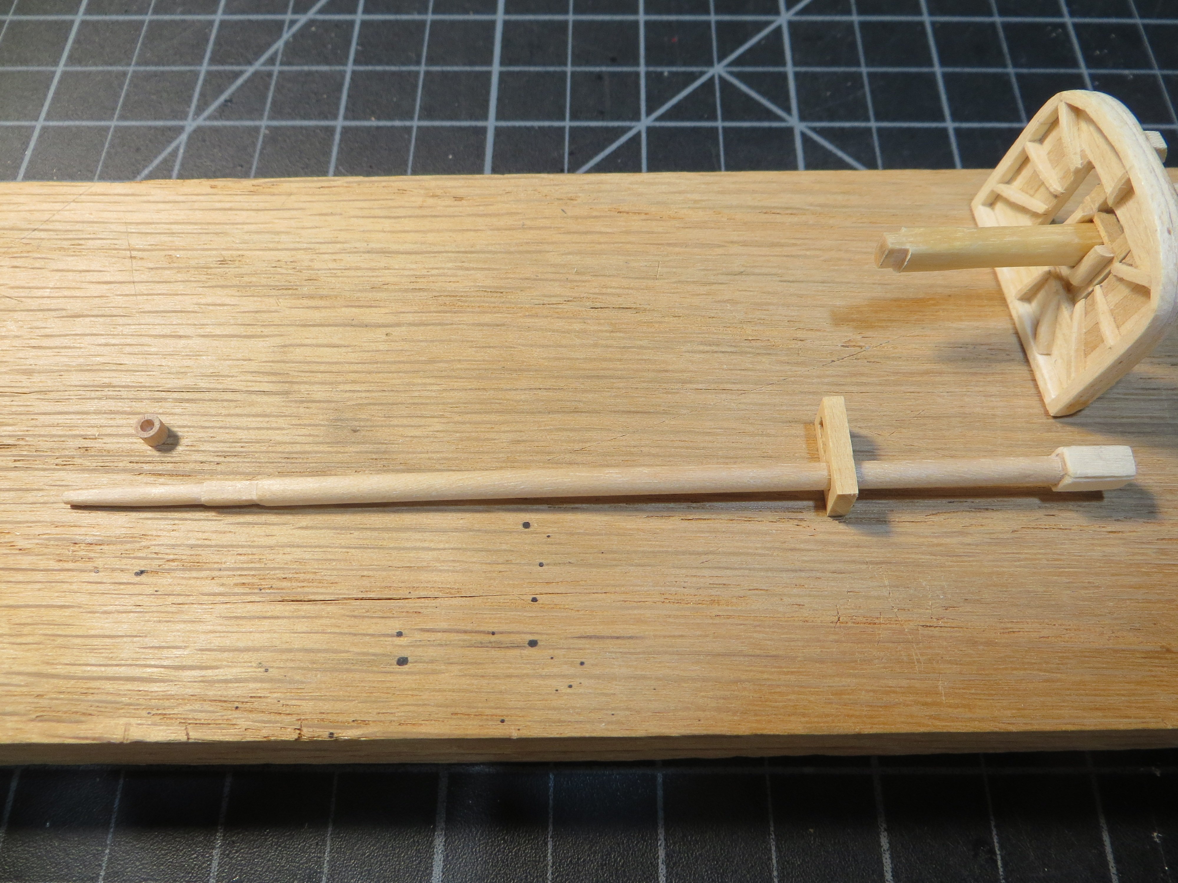

Mizzen Topmast
Since the Mizzen does not have a Topgallant mast, I decided to make the Topmast for the Mizzen next.  Then I will make the Topgallant masts together.  The mizzen sizes are different from the fore & main topmasts.  But otherwise, the technique is the same, except for the ball at the top.  The ball will be on the Topgallant masts for the two larger Fore & Main masts.
Here are my steps for making the Mizzen Topmast:
a.       Use a 1/8” dowel that is 4-9/16” long.  I cut it an extra 1/2” long for insertion into the drill chuck for sanding into shape.
b.       Measure 1/32” down and make a mark for the ball at the top.  Measure 5/8” down from the top and make another mark, which is the top of the shoulder. Tape off the heel area and at the bottom of the shoulder area.  Then taper the section in between from 1/8” to 3/32” in diameter where it meets the square section.  From the top of the shoulder, it goes from 3/32” to 1/16" at the top just under the ball.
c.       Make a square shape at the shoulder a ¼” long.  The practicum says to make this square into an octagon, but the MS does not show this.  I left it square.
This picture shows the tenon cut into the lower mizzen mast, the built-up bottom of the topmast before final sanding and the mast cap that is still under construction.

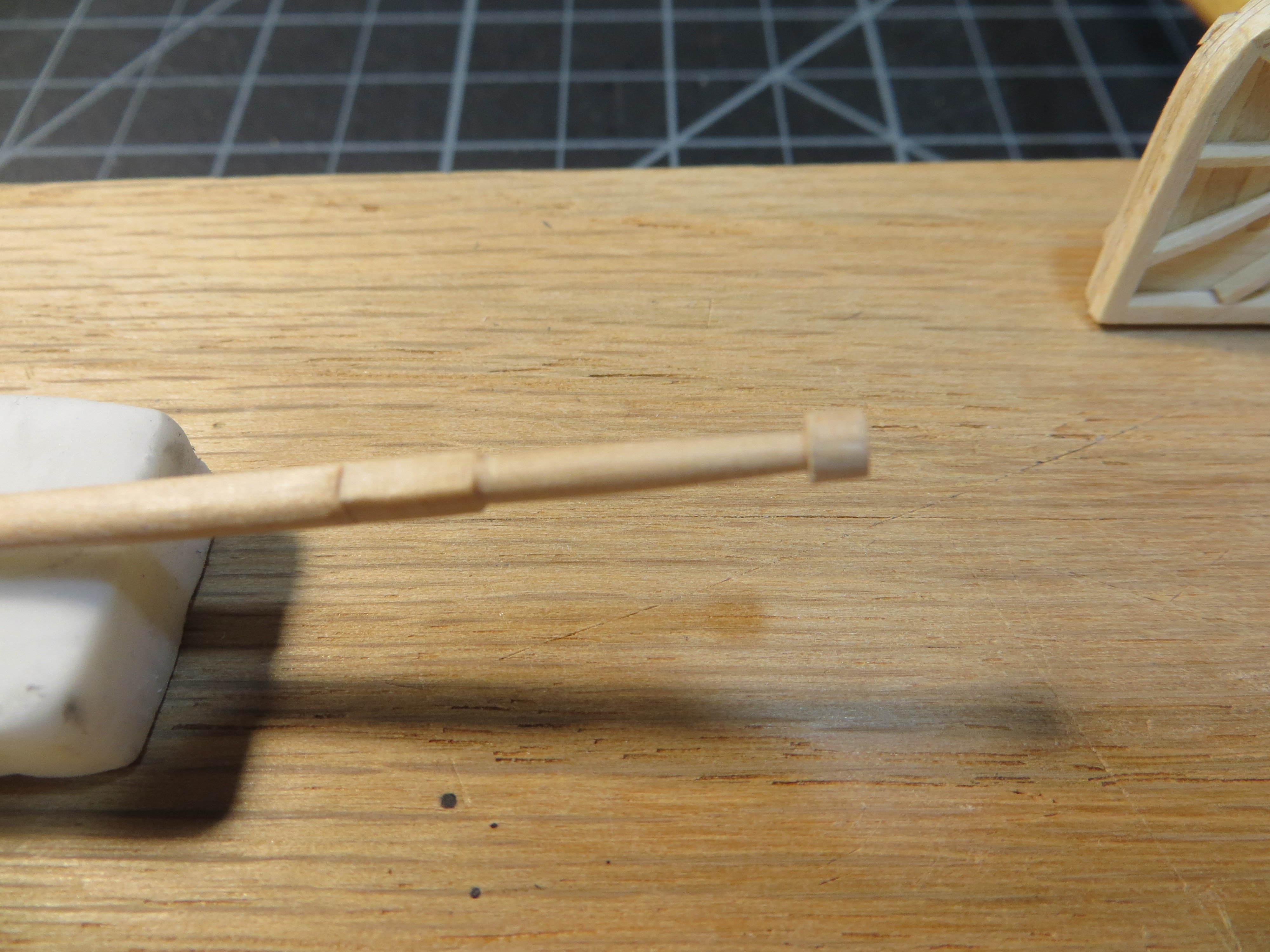

d.       The practicum says to shape the top 1/32” into a ball.  Although their picture looks more like a round disk.  My first attempt to do this resulted in breaking the ball off while thinning the mast below it down to 1/16”!  So, I decided to use the same method as I did on the Bluenose.  Make a round disk separately and glue it onto the top of the 1/16” point at the top of the mast.  This also has the advantage of allowing the mast cap to be slipped onto the mast from the top without having to cut it in half.  I started with a 1/8” dowel.  A small hole was drilled in the end of the dowel and expanded gradually to 1/16”.  I cut off a 3/32” length, with the hole being about half that depth.  I thinned the top of the mast until the hole fit snuggly on top.  I could have made it into more of a ball shape, but I actually like the way the disk looks.
Here is a close-up of the round disk dry fitted onto the topmast. (sorry about the focus) This won’t be glued on until after the mast cap is glued in place
e.       There is a 3/16” long square section at the heel that needs to fit into the Trestle Trees of the lower mizzen mast.  I glued 1/32” thick pieces of stripwood to build up the mast heel.  Two sides are 1/32 x 3/32” stock and the other 2 are 1/32 x 1/8” stock.  This was to allow for the overlap.  This was sanded to fit into the hole formed by the chock and trestletrees
Here are the finished pieces for the Mizzen mast.
Mizzen Mast Cap – I used something closer to the MS plan measurements.  The practicum dimension was way off on the width at 1/16 W x ½ L x 3/32” D.  The exact dimensions after final disc sanding: 29/64 L x 17/64 W x 3/32”.  Otherwise, the steps were the same as with the Fore & Main.
Mizzen Mast Cap dry-fit on the topmast
The completed Mizzen Mast dry-fit together

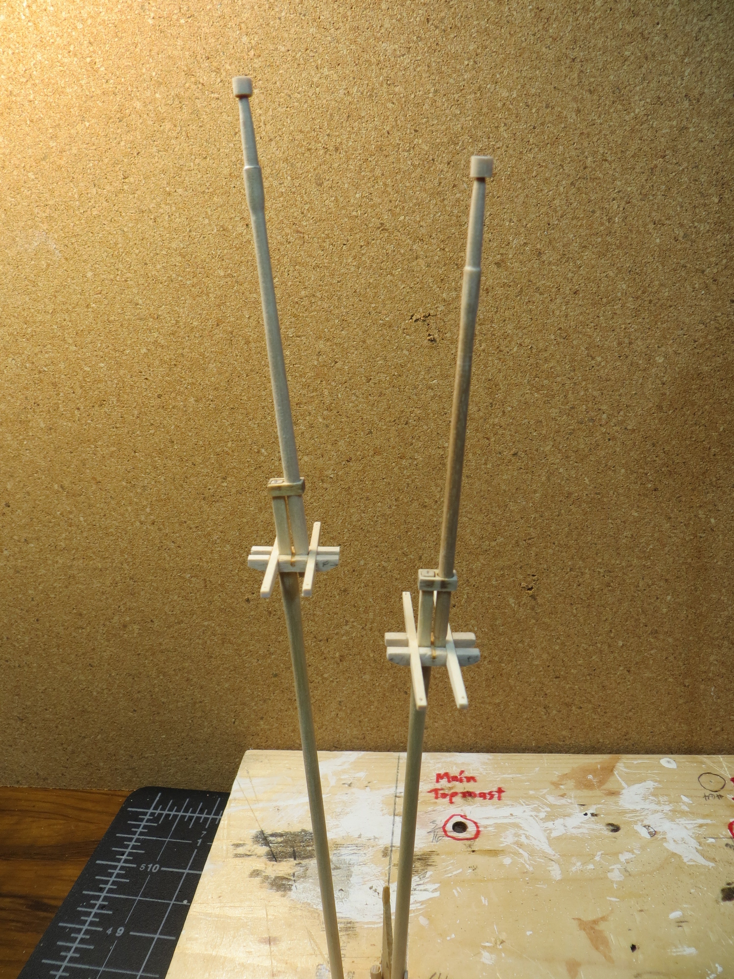

Fore & Main Topgallant Masts

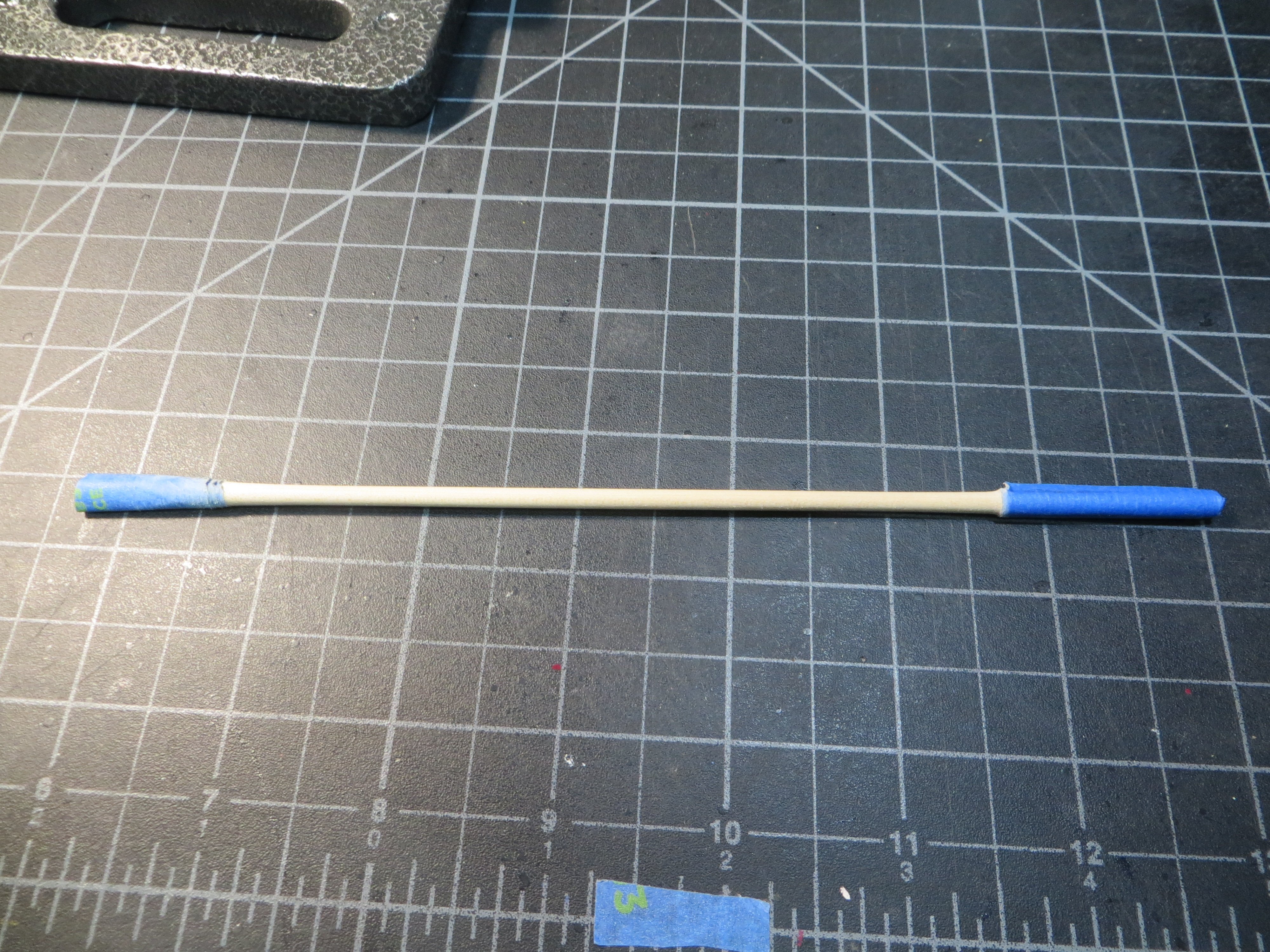

These two masts are made using 1/8” dowels.  The Fore Topgallant is 3-5/8” long and the Main is 3-3/4”.  I added an extra ½” to each for insertion into the drill chuck for tapering as with the other masts.  Otherwise, it is shaped very similar to the Mizzen Topmast.

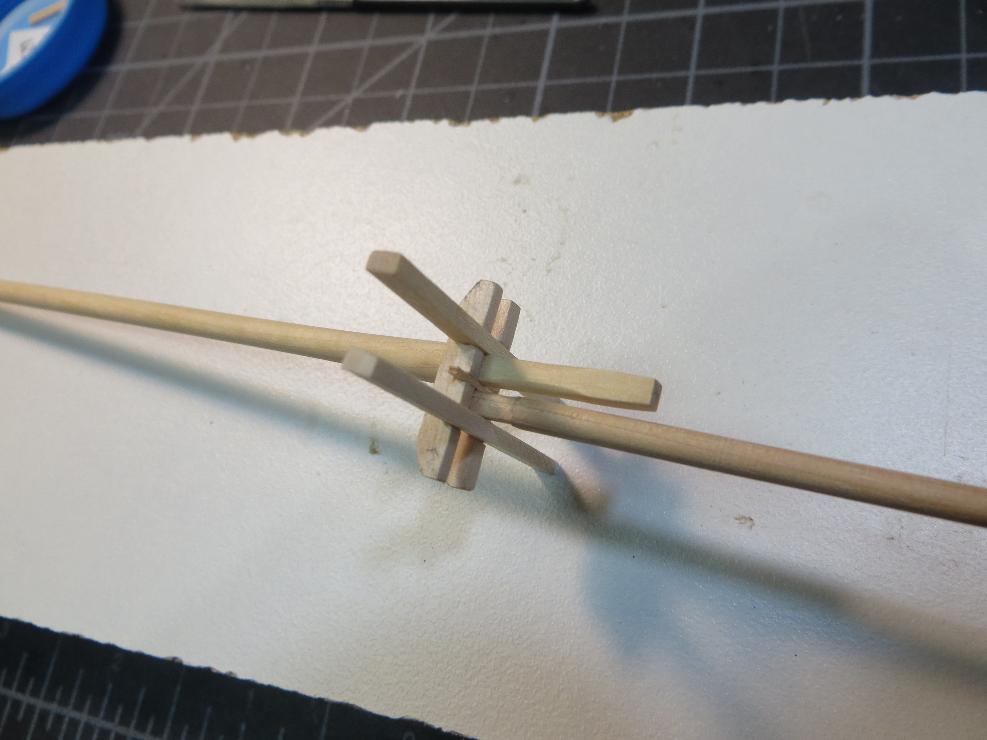

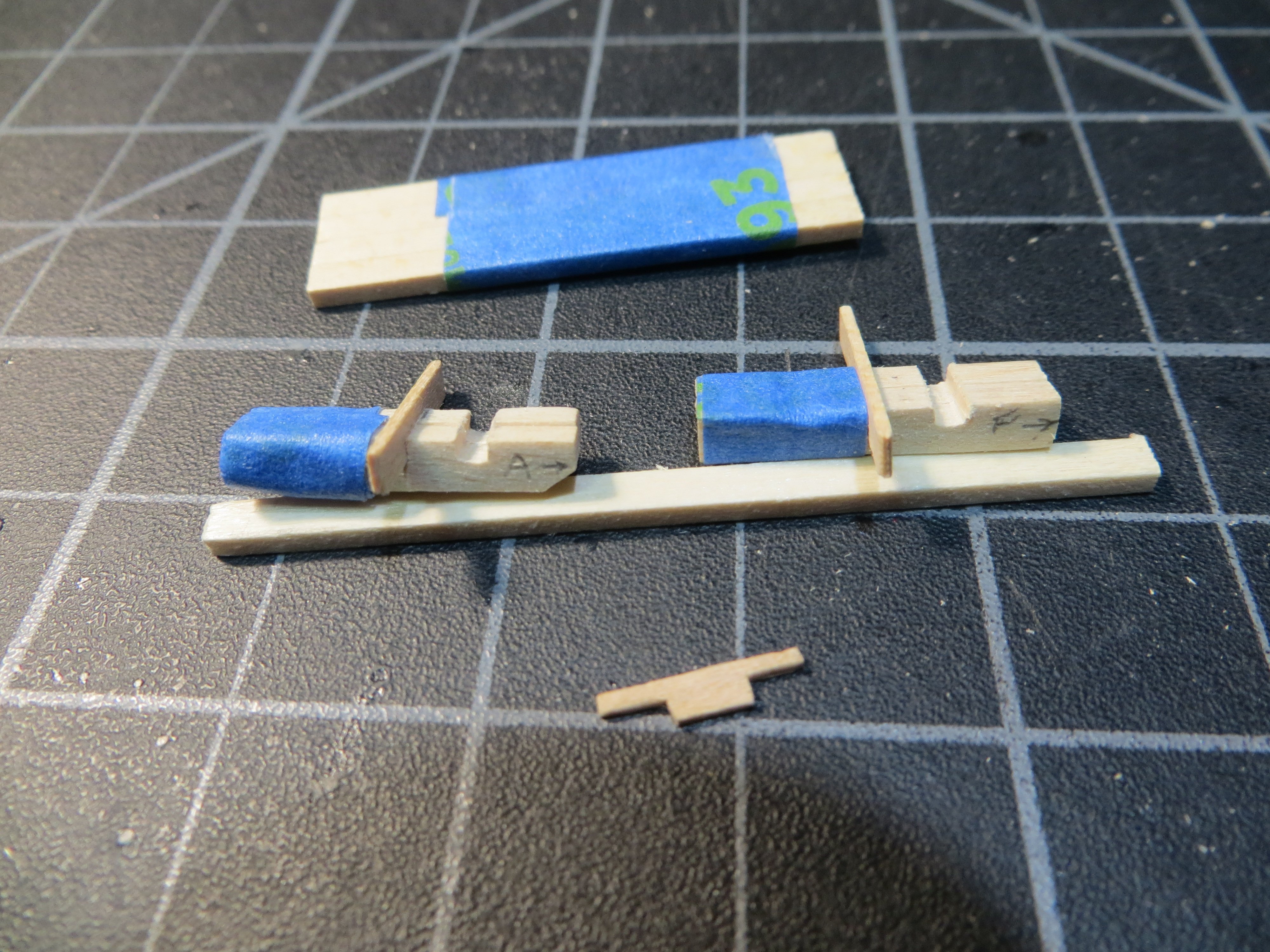

After the Topgallant masts were sanded to shape, I made the Trestletree & Crosstree assemblies.  I learned from making the lower top mast TT’s/CT’s that it is important to be precise on the cuts where the 4 pieces intersect.  I had to remake a couple of pieces because they were not square and flat.  You can hide imperfections a little easier on the lower mast because it is glued under the mast top.  But, I wanted these to be as precise as I could make them because they are exposed right there at the top of the model!  I achieved this by cutting all the pieces at the same time.  Taping them together with masking tape.  Sanding the ends on the disk sander to make them the exact same length.  Using a 1/32” thick strip in the chock slot and tape to hold the TT’s together while cutting the grooves.  Labelling the parts so they stayed in the position they were made for.  Those are just a few of the steps I used to make them as precisely as I could!  Still not perfect, but I think they will pass inspection!
Here is a pic showing what I described above.  I also made the bottom tab on the chock the exact width needed to fit the width of the topmast tenon and the topgallant heel
IMG_4814.thumb.JPG.db5f19fa53d22d83ab56aab03630c5bc.JPGIMG_4815.thumb.JPG.9bc573fae9b536ba8fa078552cf93361.JPG
Dry-fit of the assembly
Main Topmast, Topgallant & Trestletree pieces are completed
The last thing I completed in this step was the two mast caps.  I was able to use the kit supplied laser cut mast caps.  I even discovered that I could slip these on over the heel of the topgallant.
Here are the finished Fore & Main Topmast & Topgallant Masts (still only dry-fit!)
I have not glued anything yet.  I have to drill holes in the tops for the deadeyes and the stanchions that hold the netting and numerous eyebolts.  I will do these now before gluing.  I also intend to paint and stain everything.  It seems like it’s taken forever to get these masts built.  According to my log I started the lower masts on Feb. 19th.  Almost 3 months ago!  Patience is a virtue!
