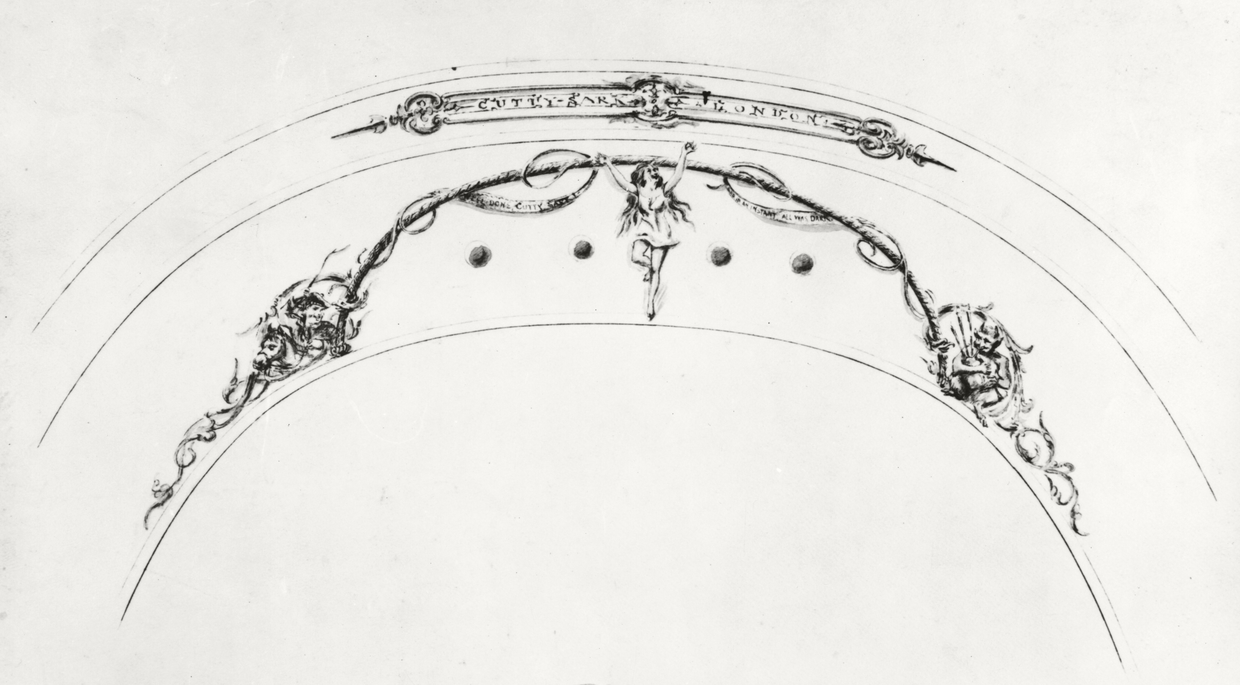

I found a drawing of an early stern decoration for this ship - one featuring a cavorting Nannie Dee. It is posted at the Royal Museum Greenwich's site in an Object Focus section (https://www.rmg.co.uk/stories/blog/conservation/object-focus-star-india-stern-decoration)
https://www.rmg.co.uk/sites/default/files/cuttysark/wp-content/uploads/sites/13/2015/05/Stern-design-for-CS-by-Linton.jpg
The article has a number of very interesting anecdotes about the past and current stern decorations.
The current Star of India and associated filigree is nearly microscopic at the scale of this model but Radimir Beseda at HISModel has reproduced it in fine detail. However, note the full scale image...
https://www.rmg.co.uk/sites/default/files/cuttysark/wp-content/uploads/sites/13/2015/05/L6301-001.jpg
The red fill behind the star proper and the blue ring pose interesting challenges. In the photo-etched decoration for the model there are voids where the red should be, which is something of a boon. If I paint a piece of silkspan with red paint I may be able to place it behind the star and, if I am lucky, the paint may actually "bulge" a tiny bit and fill the voids. Even if it does not, it should be visible in the voids.
The blue is a matter of luck. My painting skills at that level of detail may be deficient - we'll see. It also appears elsewhere in the decoration so I pray my hands remain steady.
As for Nannie Dee, there's no way I could reproduce that decoration. My daughter is an artist however, and I'll show it to her and convey the scale if for no other reason to hear her laugh derisively and maniacally.
