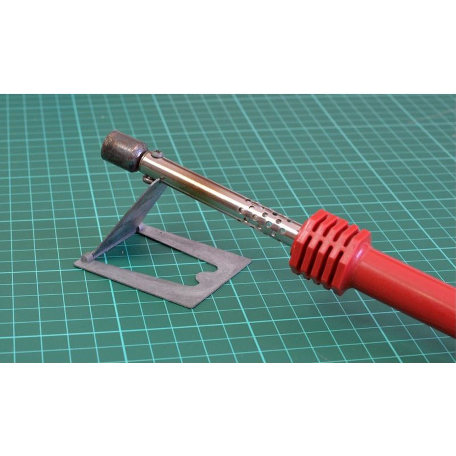

I'd only add that if your plank is properly shaped before it is offered up to the framing, use of an electric plank bender or the equivalent to apply heat to the plank at the point of attachment will speed the evaporation of the PVA's water-base and hasten the PVA's taking hold. Care must be taken not to scorch the plank face, of course.
