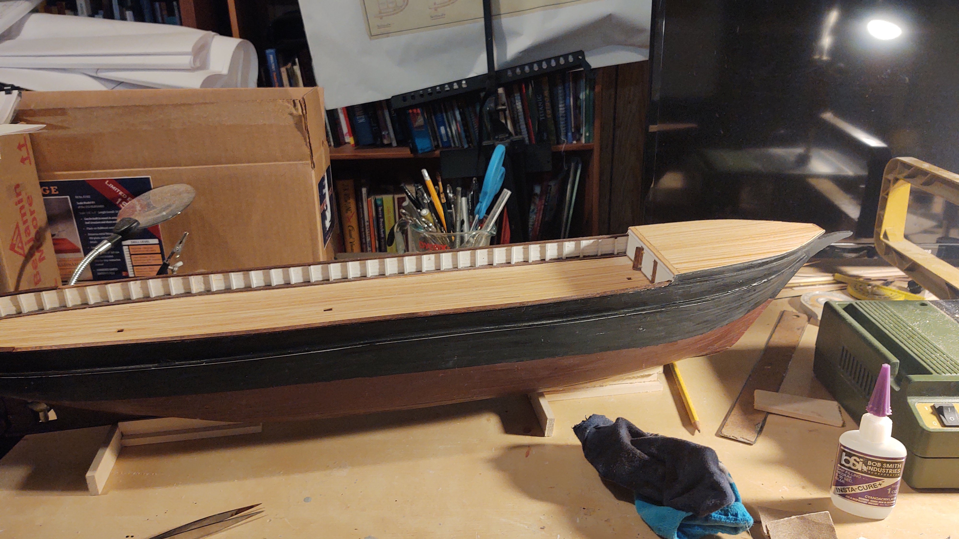

Back to the actual ship (which had been sitting on the side for a bit while I did some work on the Kearsarge. The forecastle on Discovery is closed off, so I needed to build up a bulkhead with two doors. Here is a photo of the real ship (from the Scott Polar Institute website):
It's hard to see (although not on the original) that the bulkhead is made up of vertical sections of wood that appear to be about 3 feet thick, and there are two doors. The insides of the doors are white, but it looks like the outside is darker (and that is the way the ship is today - although that is of questionable value for here. I want the bulkhead on the model to be 1/16 inch thick and still show the vertical planking.
First thing, was a took a piece of 1/32" thick stock and fitted it to the opening to the forecastle. Then I took my 1/32" stock and made 6 mm wide strips, which I cut and glued onto the piece I had cut out and fitted to the opening. Here it is partially complete:
And here it is, complete, partially sanded.
After sanding it to fit, I cut out the openings for the two doors, put some scrap behind the openings for the doors to fit into, and painted it white, as per the photograph. Then, install into the opening:
The base of the bulkhead is 1/32" square basswood stained red oak. I made the doors out of some scrap, scribed decking I had from another project, backed with 1/32" basswood. The doors were stained with red oak, so that the scribing still comes through, while providing some contrast. I glued a bit of stained 1/32" square bass on the base of the door as in on the bulkhead, and used leftover belaying pins for the doorknobs. The hinges were made out of brass. I didn't paint the hinges because they were within about 30 feet of the magnetic observatory, and would have fallen under the "no ferrous metal" rule, like the fore chainplates, which were made out of brass. One door was closed and the other left ajar:
Finally, I mounted a bit of 1/32" square stock painted white across the top of the bulkhead, a similar decorative touch is visible in the photograph.
All in all a lot of work, considering that the vertical lines are practically invisible. BTW, one of the reasons that the port door is open is so I can get to the anchor points for the lower forestays which are in the forecastle. So, the door should swing open more, but since there is nothing to see in there, it will likely stay only ajar once the stays are in place.
