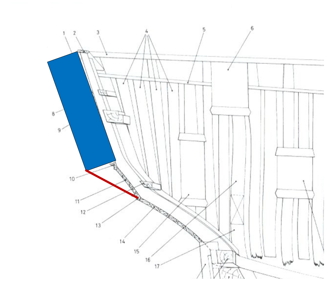

Moving onto the stern area, this needed some manipulation to how the paper model is constructed.  Hopefully my explanation of how I achieved this is not to confusing.
Firstly for context this is how the paper model is done
image.png.c8d2cef64f027fed9ce55339fa88aa93.pngimage.png.17edeb44e7cd67db42af73f643621f95.png
This formation allows for the modelling of the internals and for a moment my ambition threatened to overrule my ability, eventually, however reality prevailed and I decided against going this far.
This means I have to change parts H1 to H4 (top left) to accommodate the fixing of the stern fascia.  The paper model simply has this glued on top of part 6 (top left) and to the bulwarks and relies on the flexibility of the card to get some curvature.
Although there are no corresponding parts to what I need to achieve, there is enough information provided for me to fashion the parts needed and this explained (hopefully) below
Part G (above top left) is the transom and this was fashioned out of some hard maple 5mm thick by the template provide in plan view and the curvature determined by the markings on bulkhead 17 (horizontal markings).  A chamfer was then  created for the planking
image.thumb.jpeg.2d3612f5c2459837f0fad59c960a5821.jpegimage.jpeg.6d4f97c697495427eb30696385427e4e.jpegimage.thumb.jpeg.b9e1c7208df6e8c9ecb5d64cbe466dfd.jpeg
Next was extending parts H1-H4 to allow the forming and fitting of the stern fascia at a later date.  To achieve this I used common features of two templates to give me the final shape
Middle picture above....X, Y and the deck level are common on the formers H1-H4 and to the bulwark templates.  These were glued one on top the other to produce a single template shown in the right.
Blanks were then cut from hard maple using the template ...I'm only using H1 and H4 on both sides of the stern post and omitting H2 and H3
The only difference in the finished parts of H1 and H4 is the length that attaches to the transom to give the curvature of the stern fascia and this was cut to the correct size
H1 and H4 templates were then used by subtracting 5mm for the transom to give me the shaping for the planking below the transom. Below shows these fitted and then filled with balsa and shaped
image.thumb.jpeg.132256b3b490c4d781c3832b1eca4b03.jpegimage.thumb.jpeg.d56c6f5f044923297fc57c0808ed9c55.jpeg
Finally H4's are  glued in place, with a bit of additional padding (3mm mdf) to help with the run of planking.  This will be sanded for a fair line.
I'm not installing the H1's at this stage as they will interfere with the planking
Hope this all makes some sort of sense.

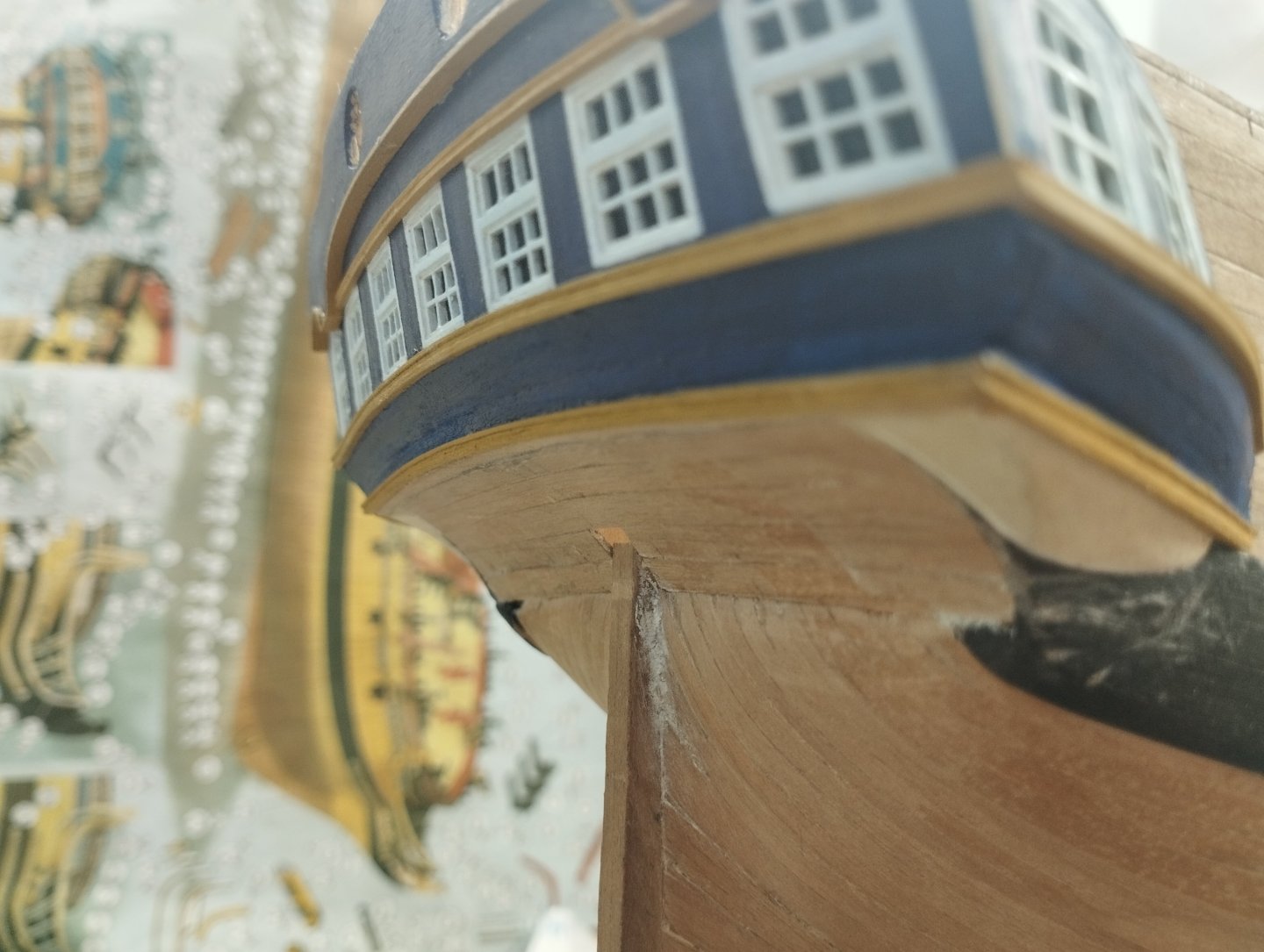

Planking has been done with cherry at 4mm x 1mm and in 100mm lengths.  I've used a 4 shift butt shift.....not sure if this is historically accurate but I like the pattern.
I've a little work to do in finishing off and it needs a sand but the following photos show the progress
Side view.....there are a few gaps 3-4 strakes below the gun ports   but this was rough planking as they will be covered by the wales
To ensure the ports were all the same size, I made a "tube" and sliced an appropriate length to go through all layers of planking (internal and external).
First step was to create a former off the correct squareness  and then used 1mm cherry to "plank" around the former
   Following shows the ports installed
Just some more photos showing the planking
image.thumb.jpeg.2daa01d4335b6f55880109e65f98000d.jpegplanking4.thumb.jpg.7746757ff26d97940f812c1d347099c1.jpgimage.thumb.jpeg.d1336bbf388514132092108a5643cf58.jpeg

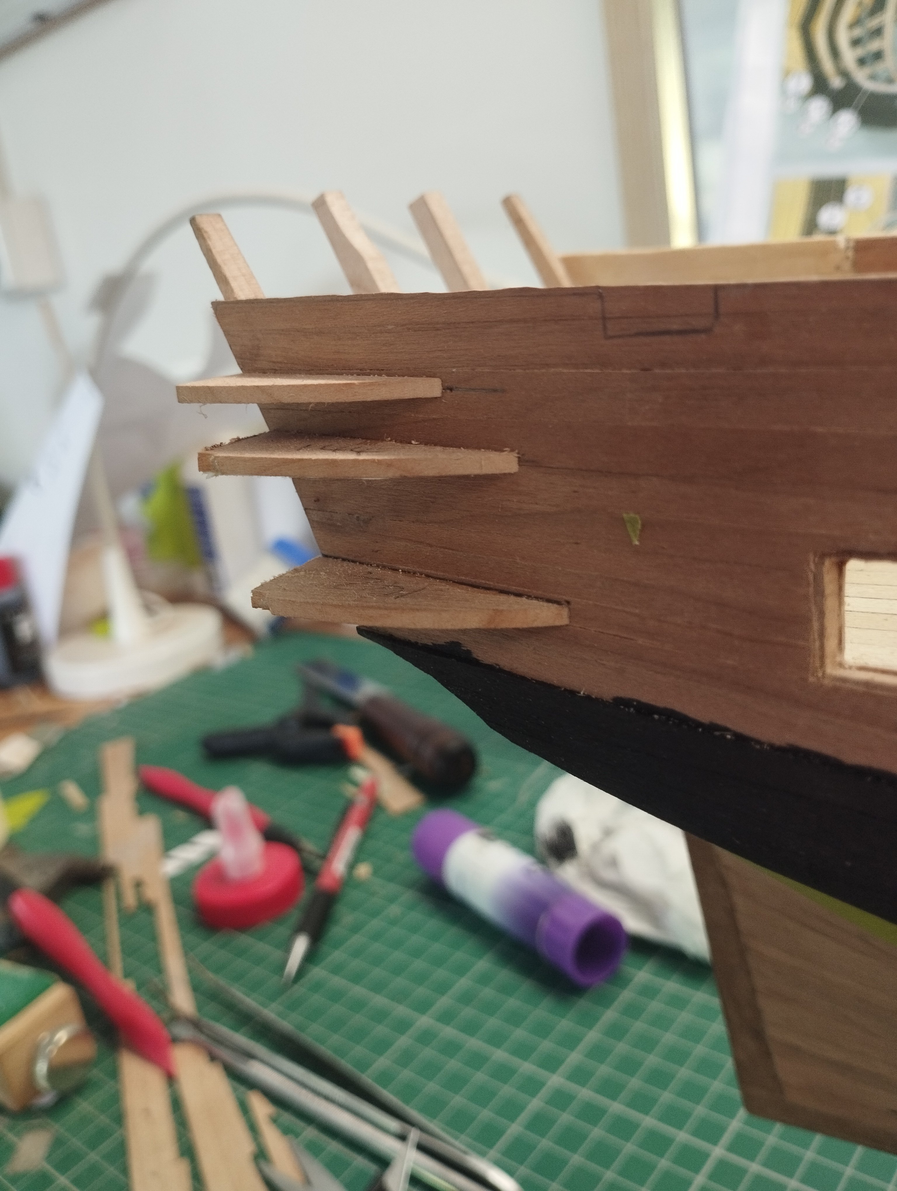

Wales are now complete.  The paper model simply has a paper template glued to a sufficiently thickness of card and stuck appropriately on the model.
The template shows a hook and butt planking and I've used this to provide the shape of the planks for the wales
I taped the template to some carbon paper and this was then taped to some Alder milled to 1mm.  I used Alder for no other purpose than I had some deep  enough (50mm) from stock that allowed the template to fit.  The lines were then drawn over with a 0.3 mm pencil to provide the cuts required.
carbon.thumb.jpg.b3ff1b414add98f64133b63b4da5fcae.jpgtraced.thumb.jpg.9d2ea982373fc3be1ecb326362cfab30.jpg
The planks were individually numbered and cut out with a knife, below shows the work in progress
inprogress.thumb.jpg.d1f122b74dff136a2718787aad79c8c5.jpgfinishednotstained.thumb.jpg.3a5deeb27dd066b415b79b20caee3d62.jpg
Once complete I masked off the hull and used black wood stain to finish.  I didn't use paint as I wanted to keep as much definition of the planking  as possible seeing as how I had put the effort in.  Masking tape will stay in place for the time being as I work on the quarter galleries and there is a further row of planking required just above the wales which I'll complete later.

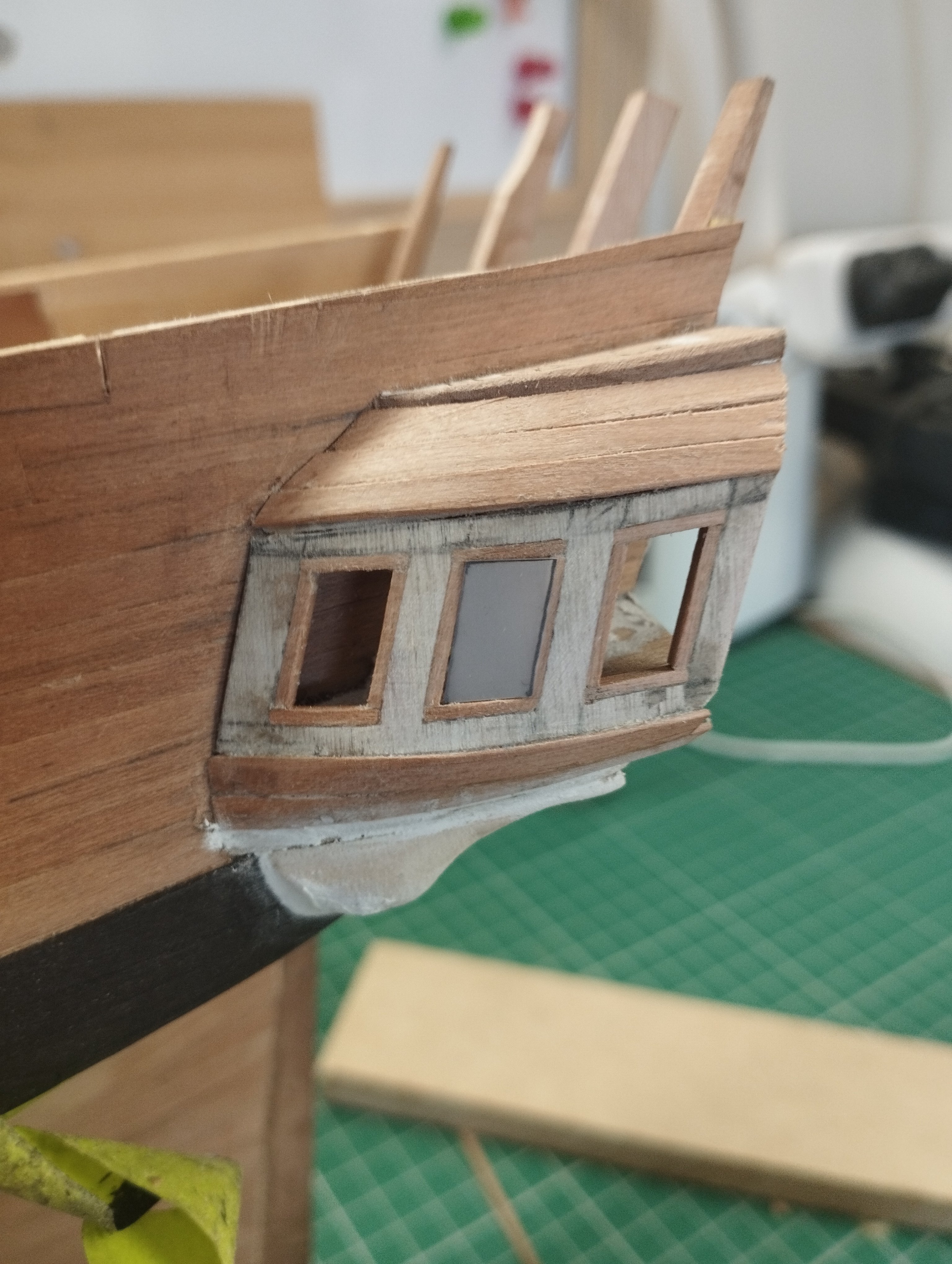

Must be time for an update.  I've been working on the stern and quarter galleries and was hoping to combine these into one post but but time available will mean I split these into two.  I'll concentrate on the quarter galleries in this one and show where I'm up to...generally I like to complete a section before posting but this is an update on where I'm at and is more of a work in progress than a finished piece of work.
In all my models to date I've not had to deal with constructing quarter galleries so this was venturing into new territory.

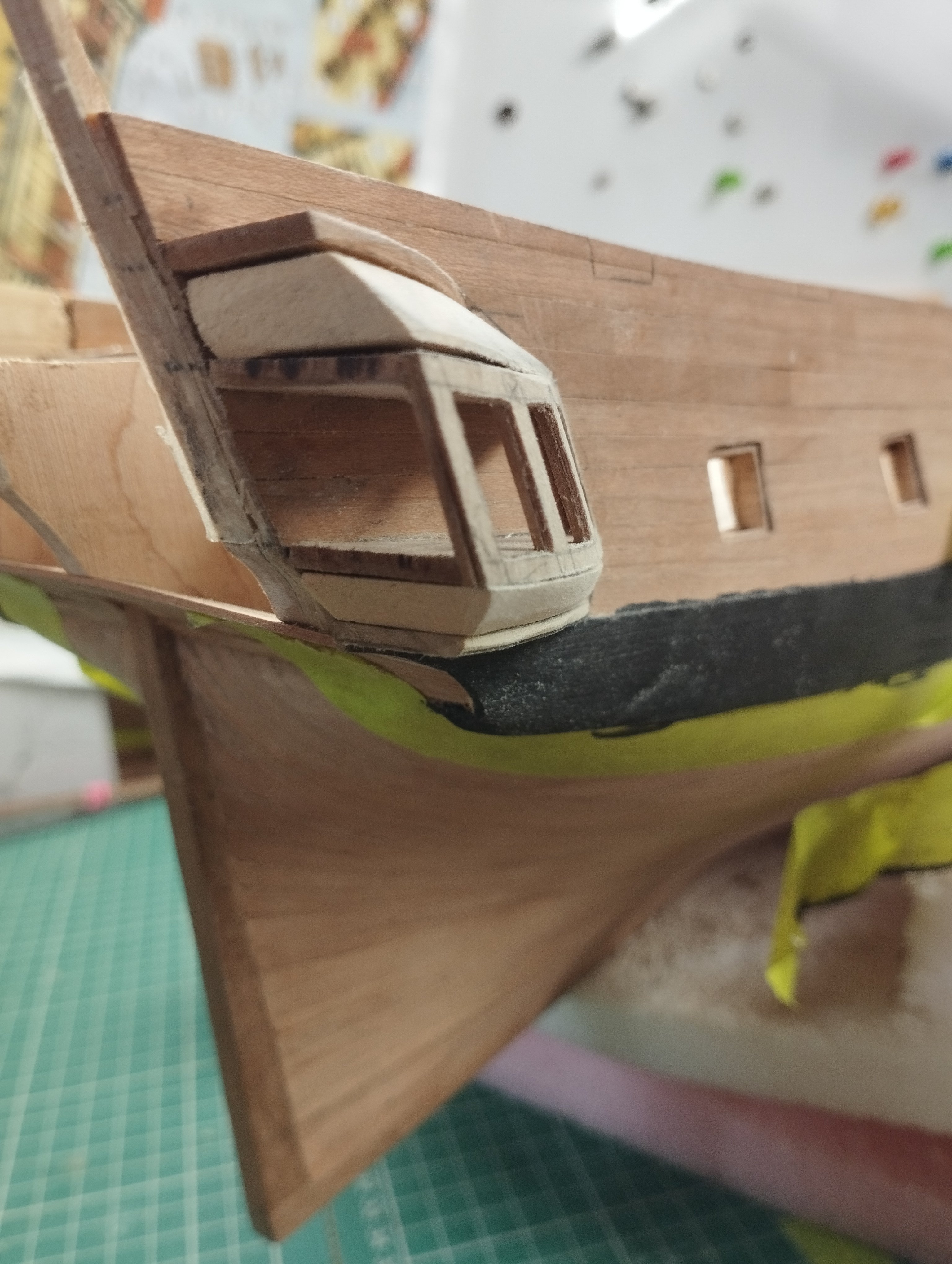

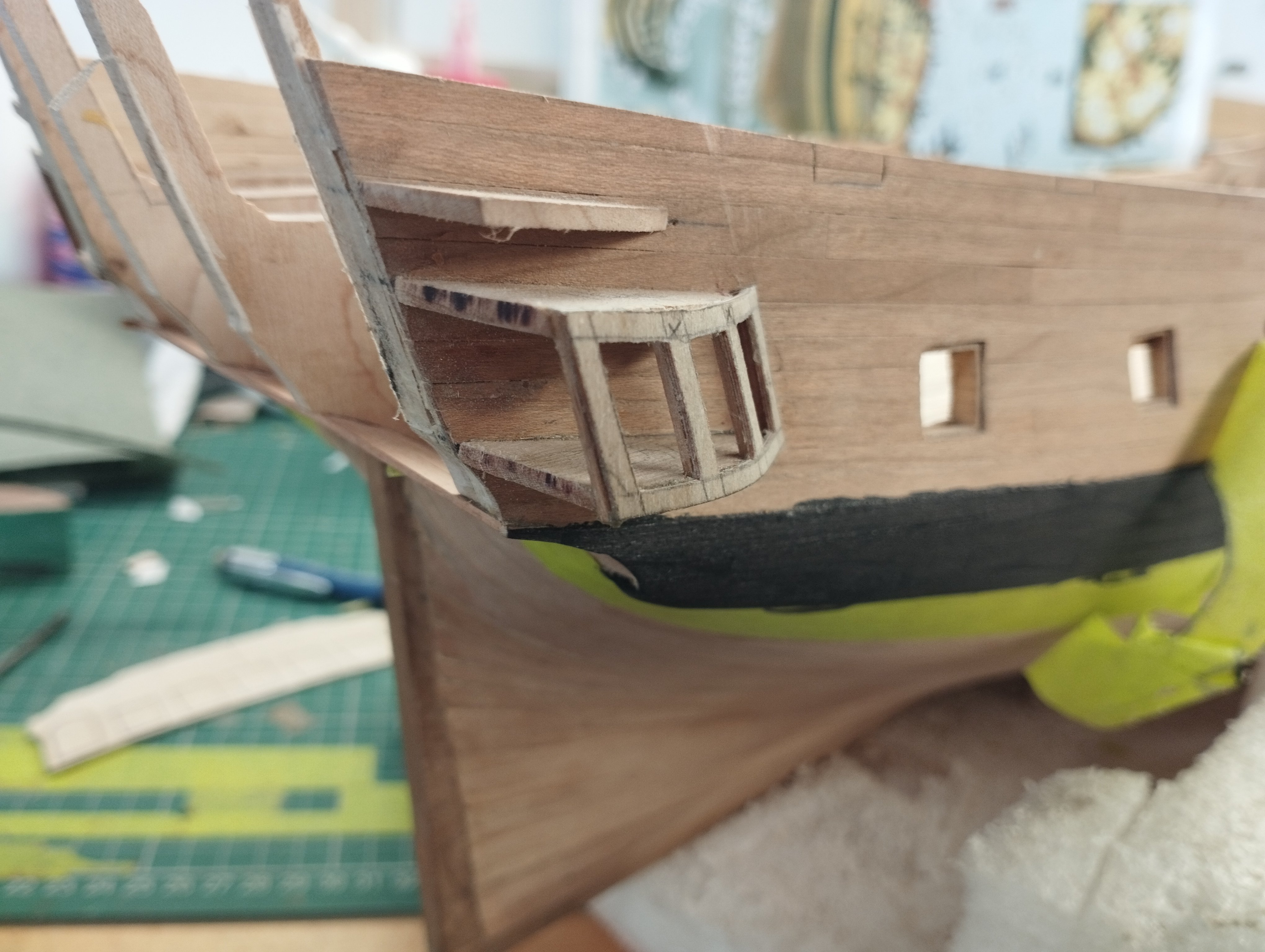

Using the parts depicted in the paper model for the formers (left photo) and the side template of the ship (middle) for placement and a pictorial view (right) on what it should look like
formerpieces.jpg.a01cb80d0b65c79663169420446f9f30.jpgplacement.jpg.44689d38e9db2c859362f6f03908c486.jpgplacement2.jpg.075b30a740fc8542614281fae6bc17b7.jpg
The formers were made of 1.5mm cherry,  simplified as I'm not showing any internals  and glued to the side of the hull.  Having no scale plans available it's critical to maintain reference points along the hull so that correct positioning of the hull template is maintained
Next came the forming of the window frames using 1.5mm ply and the paper model parts as a guide
windowframe1.thumb.jpg.ad09108697f2f5782bcbcf22d5a8d8e7.jpgwindowframe2.thumb.jpg.69e8dd7f5b1f238eba5877ccf29b9aeb.jpgwindowframeinstalled.thumb.jpg.98d16b02eac220414e2dc9db30b5d8c8.jpg
I then used 1mm x 2mm cherry for the external window frames.  Some planking was also completed at this stage aided by filler blocks between the formers
framing.thumb.jpg.3467f17f8d0bce511c035ad3a4846e3c.jpgimage.thumb.jpeg.477c5d4cfa17022a99d0052acb23fbea.jpeg

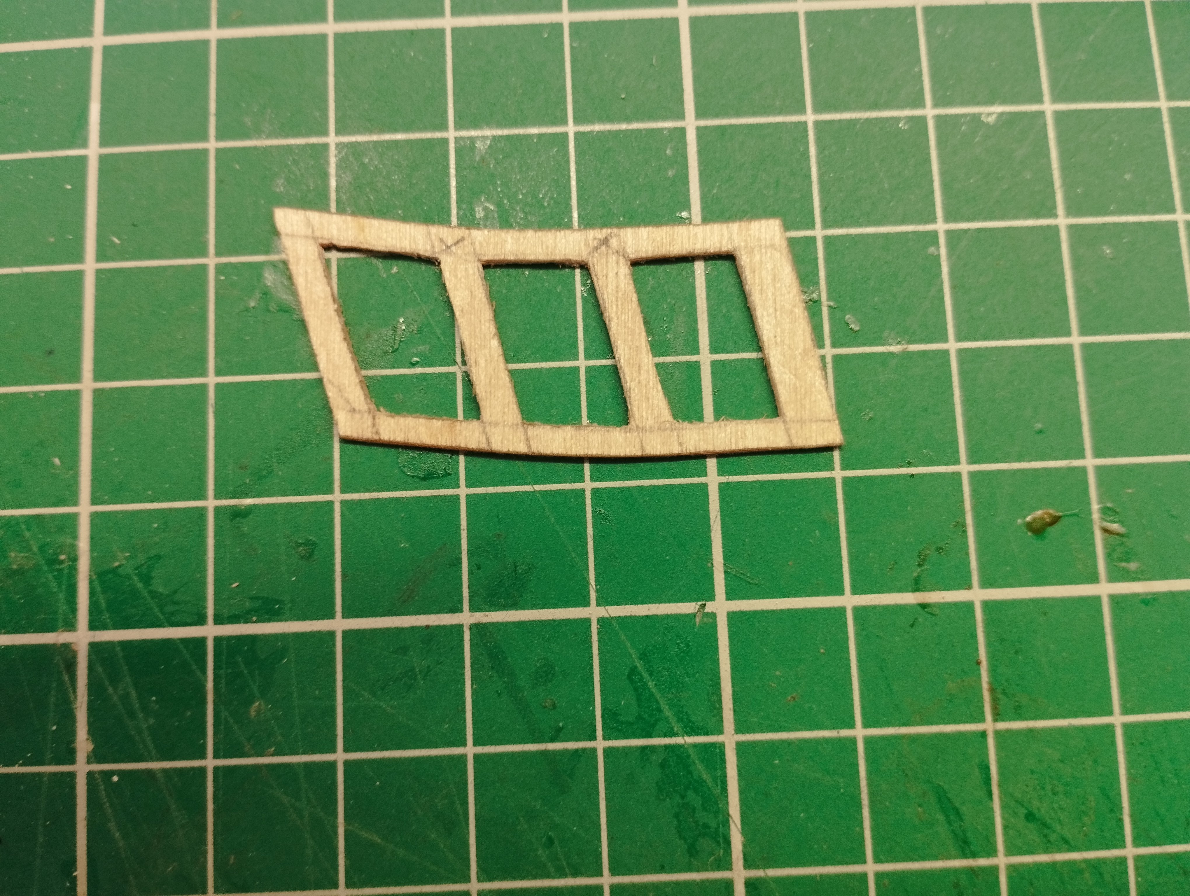

Modelling the internal frames was  more tricky and I'm sure there are far better ways of achieving a better result.
Using see through film I marked the corners of the widows and drew the shape of the frame and cut this out double checking that the shape was a good fit
internal1.thumb.jpg.f0732142115894f0594f4f48edfbaf16.jpginternal2.thumb.jpg.10ffb43d31d817f2e0b125e5f965203b.jpginternal3.thumb.jpg.d8401aab8e06e0785e4cbde90bad19fc.jpg
Using this template I glued 1mm x 1mm cherry so that roughly half was overhanging the template, apologies the photo below is not the best but hopefully you get the idea
Once the glue is dry it's then a matter of sanding the "external" wood back to the template and fine tuning to fit the window opening.

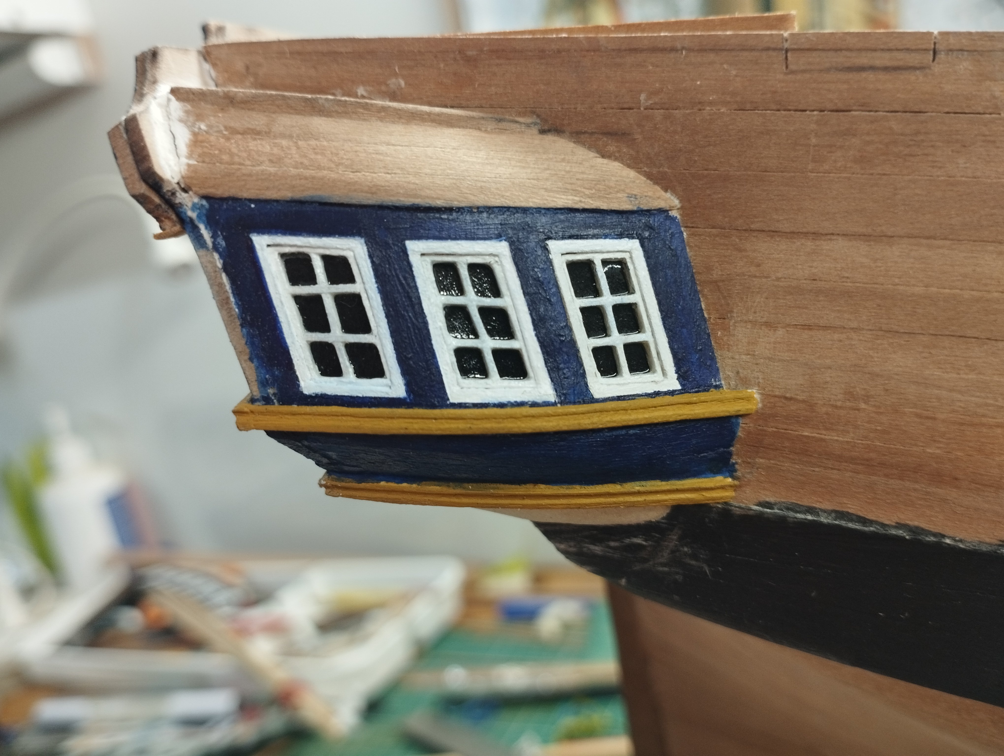

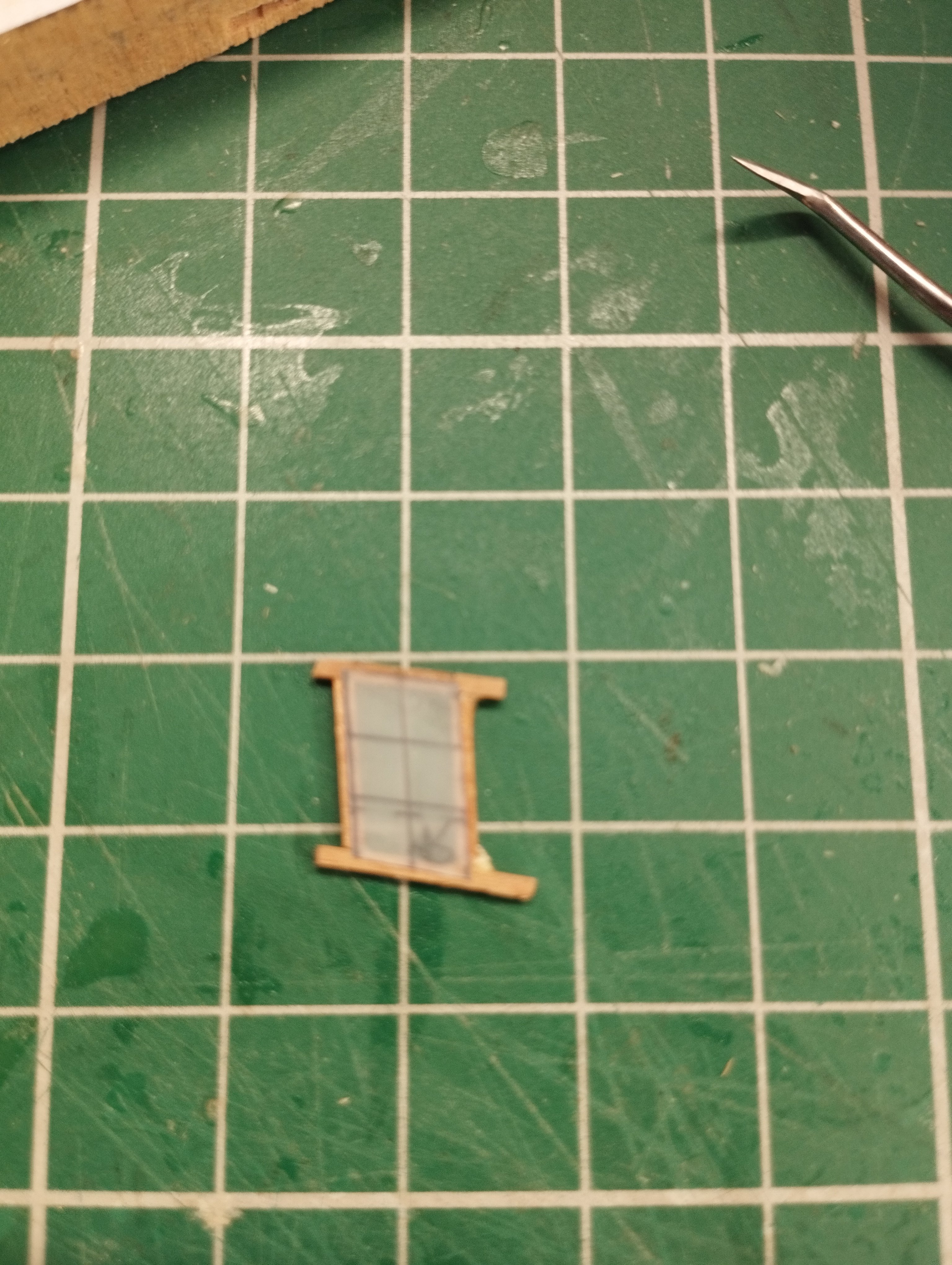

I then used 1mm x 0.5mm cherry to make the individual widow frames (and I can't find any photos of this)....but if you imagine from the photo above  that the lines marked are the actual pieces of wood then I first glued the vertical piece  and then the individual cross pieces.
This was all painted white and backed with black card an clear craft glue used to simulate glass (white glue would give the same result).

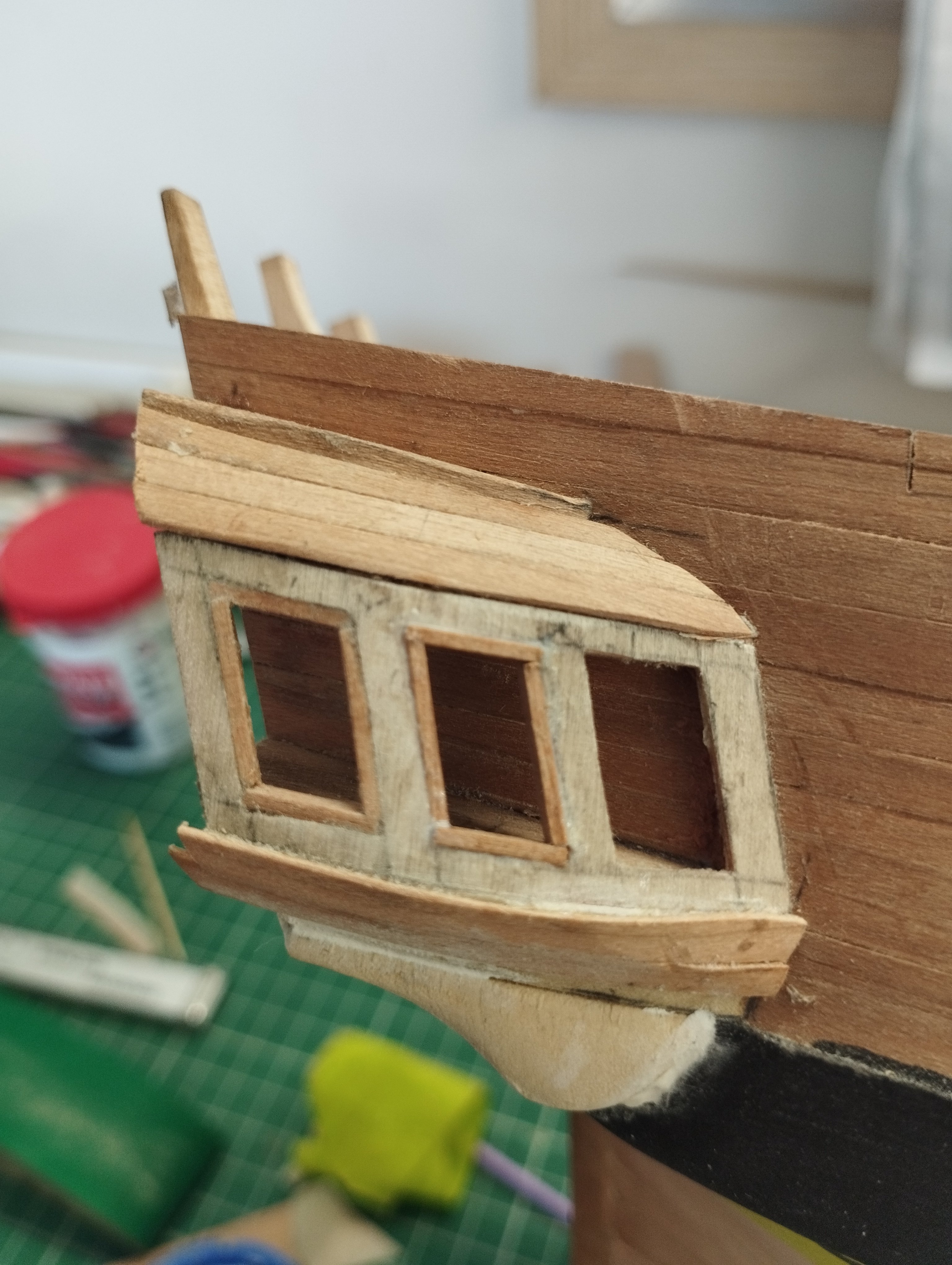

Because I used 1mm x 2mm for the external frames this gave depth that allowed the internal frames to be set back a little to give some definition
side.thumb.jpg.903885e252e72563bece80df1b9e3ac5.jpgbottom.thumb.jpg.f739f46597a62d7927aced25592a4e72.jpg

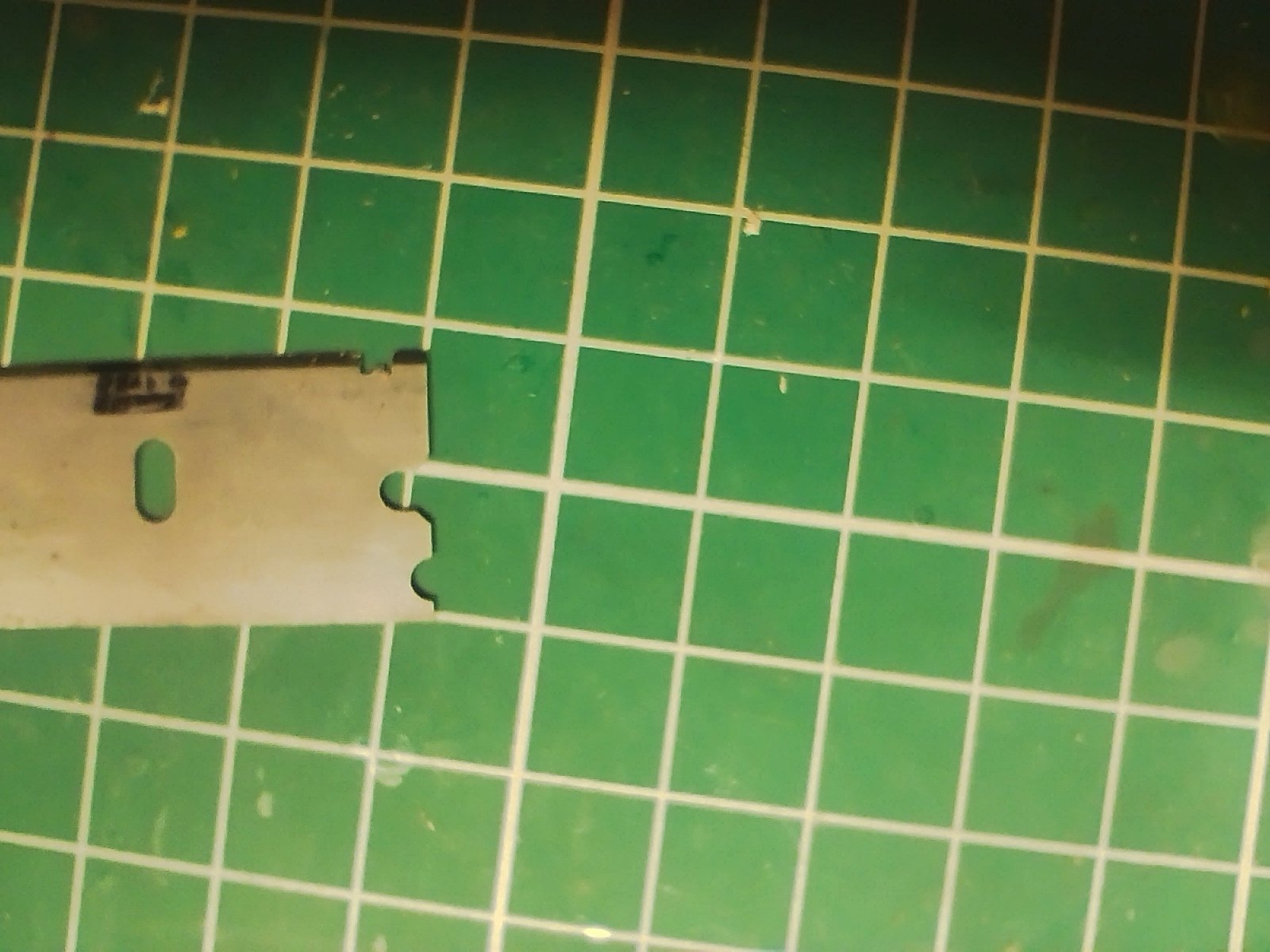

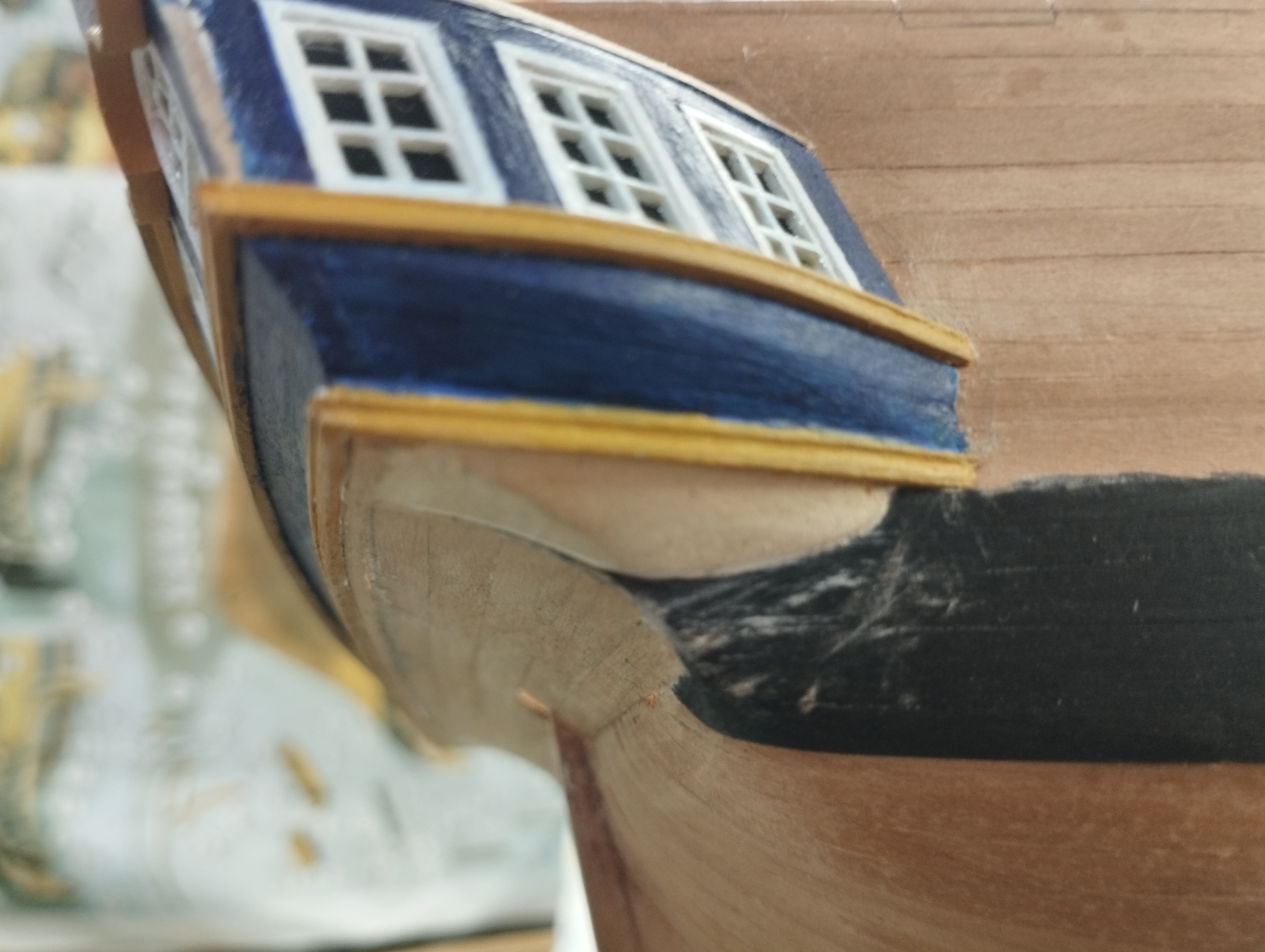

The rails were made from 1.2 x 1.5mm cherry and a simple scraper was made from a razor blade

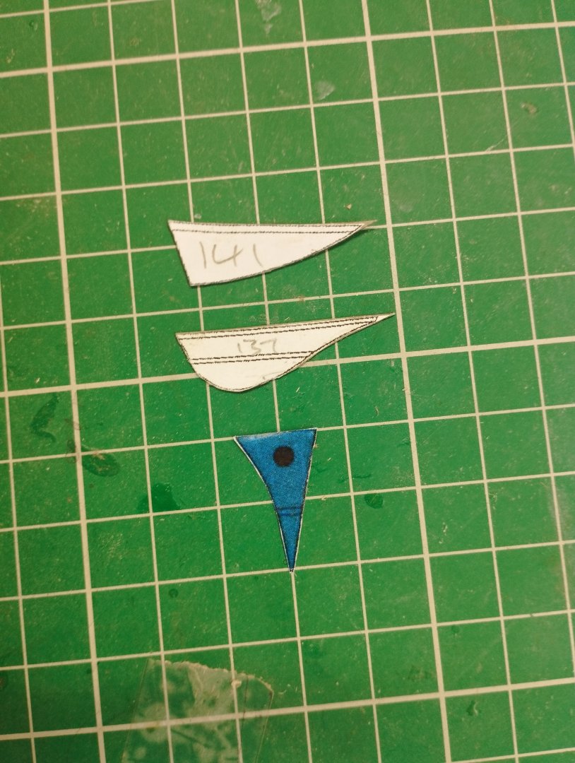

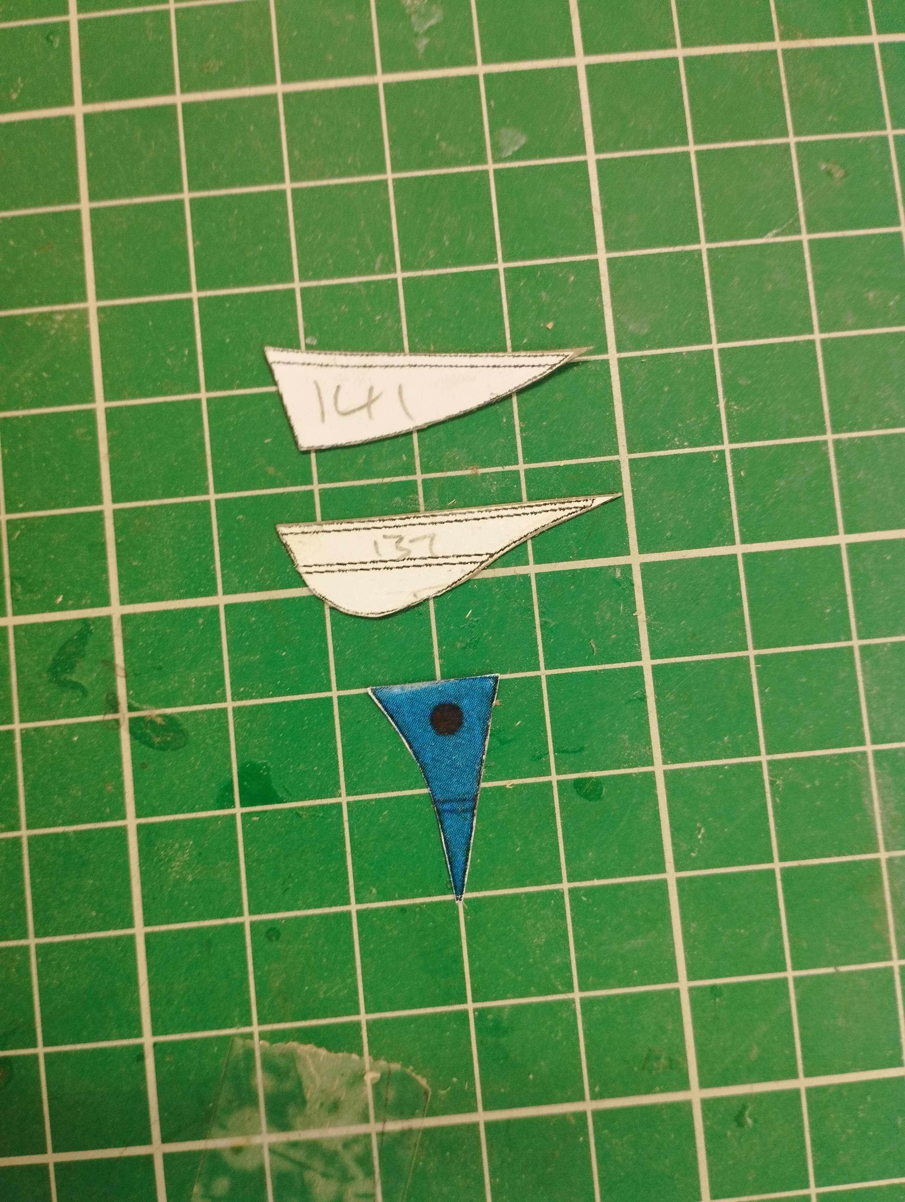

The making of the "bottom" of the galleries (not sure what this rounded part is called) which you can see in the right hand photo above  required the use of 3 templates to get the required (or close to) shape and fortunately although not the intended purpose there is enough provided in the paper model to fashion this piece.
Part 141 below is a former piece of the galleries
Part 137 is the shape againt the hull
and the blue piece is the shape that ties into the planking
These were glued to a block of Jelutong and sanded top a shape (or at least what I thought was to shape) and glued to the hull and over the wales.
bottomtemplates.thumb.jpg.c6619ec2135185fed4d9bc077c5e91fd.jpgroundpieces.jpg.a7ea3f958f757e26bf4d6ce215df338f.jpg
If you look at a couple of photos above where I'm describing the marking of the external window frames this originally was quite chunky and required quite an amount of shaping to get a better look.  It's far from perfect but I'm quite happy with the result and will look a lot better once painted.

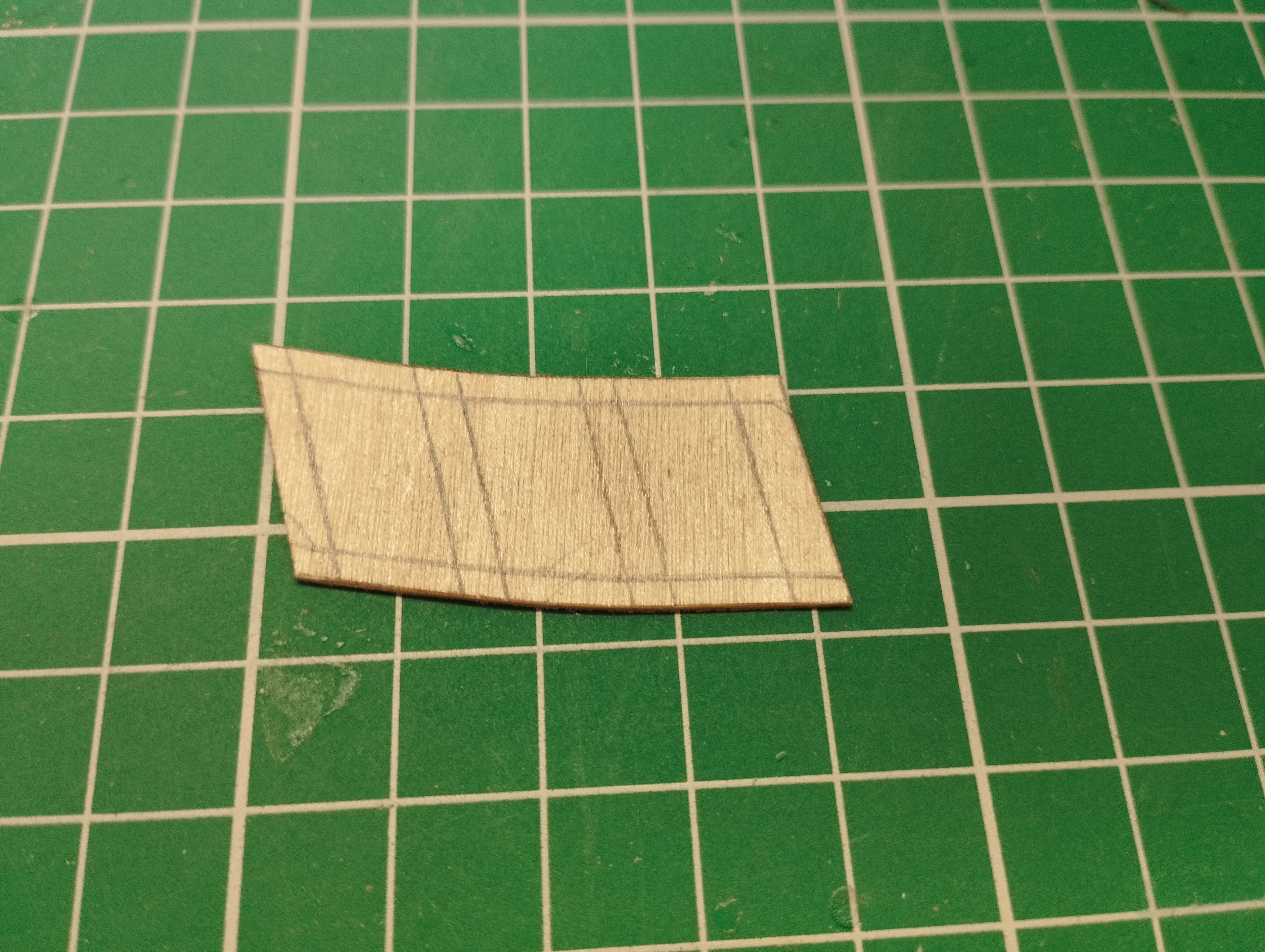

Work has been continuing on the stern area.  The paper model gives the below and this is the look I'll be aiming for with some slight differences in colour scheme
First things first was to determine the template to make.  I'm slightly wider than the paper version due to the width in planking, I'd purposefully not made allowance on the bulkheads for the thickness of the double planking compared the requirements if this was been made out of paper and also referring to post #9 we can see the back has flared out a little (picture with ruler).
I wanted to keep the shape at the edges so I cut two templates from those provided and slipped one behind the other to get the width whilst keep the height and edges correct.  Once this was done it was a matter of arranging the windows to cater for the increase in width
makingtemplate.thumb.jpg.323630515df729e4fc62614e9b9a6f67.jpgmarkedout.thumb.jpg.116749a3227f147fbff1e26060a7f4bb.jpg
Windows were then drilled out and a the fascia made and holes created for the stern chase ports.  Its worth noting at this point that the piece  was made with 2 x 1.5mm ply resulting in a 3mm piece and the facia made with 1.5 mm ply....more on this later
image.thumb.jpeg.824deb58c3591a6eed9c44b5146fb126.jpegfasciaaddedwithchaseport.thumb.jpg.c9d8dc89b8731fd83e78d02ef228fddb.jpg
Widows were then created with 1mm x 1mm cherry for the outer frames and 1mm x 0.5mm for the inner.
The small arches in the window frames were made with the aid of a 2.5 mm drill bit in a soldering iron, wetting the wood and using the heat to bend into shape and then cut to size

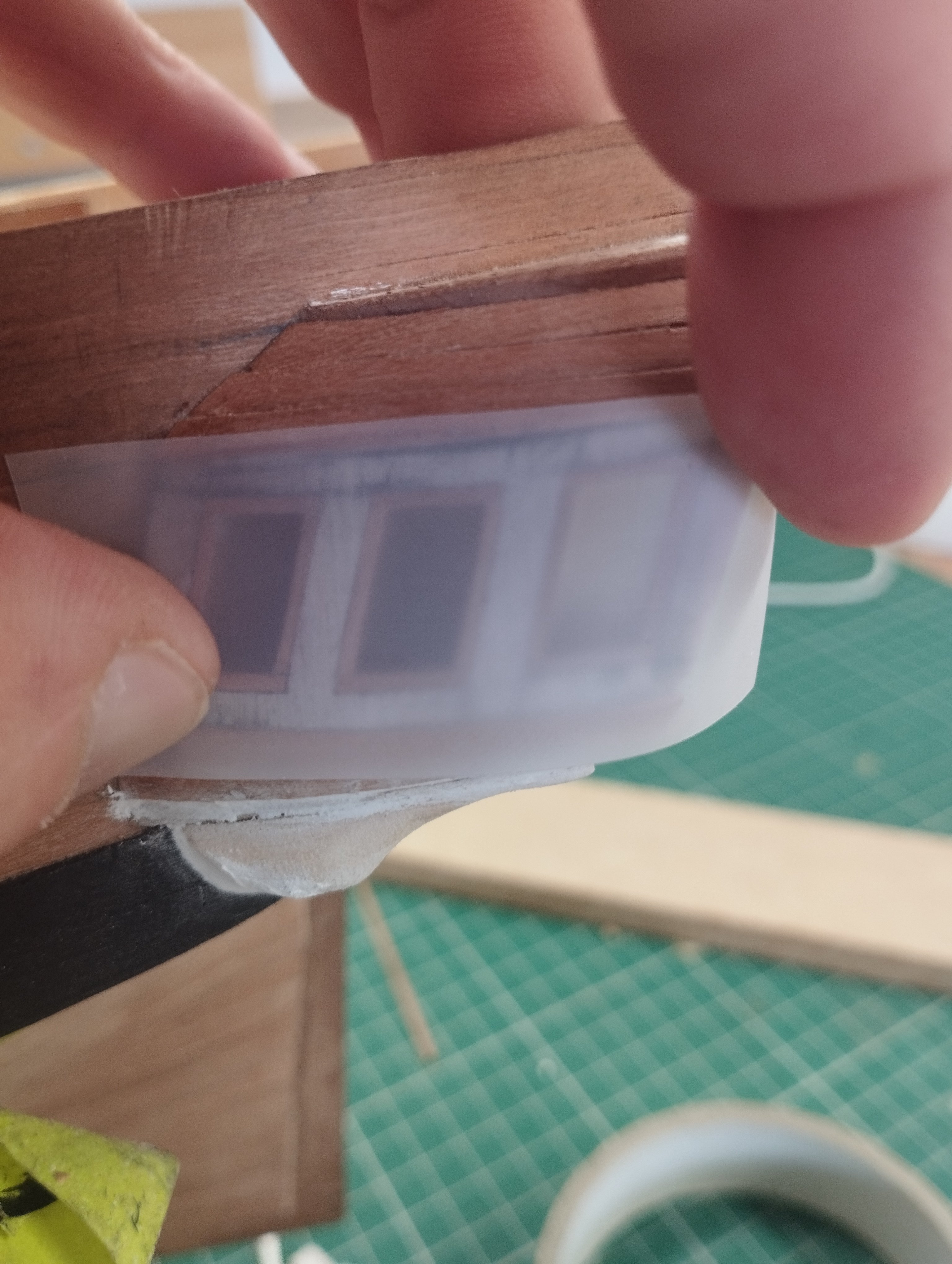

So far so good....until coming to fit it on the ship!!!.
With making the piece 3mm thick it didn't lend itself to fitting in with the planking on the upper counter.  I've tried to show the issue below using Diana from AoTS as a background with the blue rectangle representing the 3mm stern piece and the two options I considered
Option 1 on the left would have left the stern piece proud of the planking
Option 2 on the right would require a single piece fitting to marry the planking and stern piece together as shown by the  red line.
Neither option was ideal but option 2 was closer to reality...despite knowing I wouldn't be happy I tried it in any case.
I tried hard to convince my self that with a bit of filling, sanding and painting that I could live with it and also acknowledging the angle of this piece would make it difficult to see the name of the ship, but who looks at the back of the ship I kept telling myself.
 After days of inner turmoil in trying to persuade myself that everything would be good and I that I could live with it, I elected to remove it an start again.
This time I stuck to a single piece of 1.5 mm ply and went through the processes above and that allowed the planking and stern piece to come together nicely.  I don't have a straight after photo but this is how it came together
