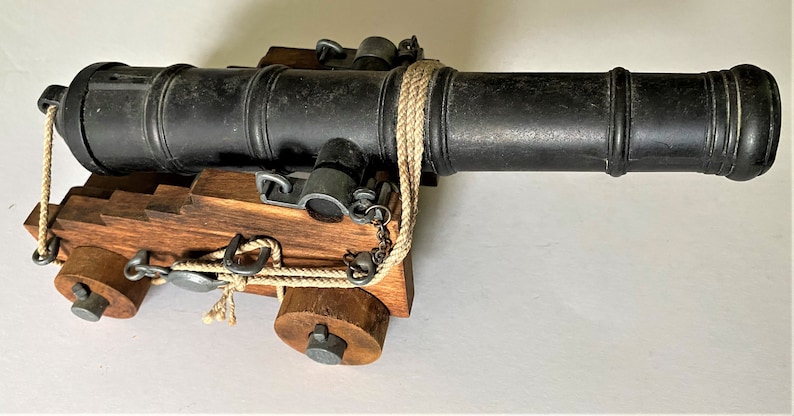

For the purposes of modeling, the modeler may well decide that in the case of a smaller scale model, that a bend around the ring isn't a sufficiently noticeable detail to merit the work to tie them, while on the other hand, in the case of larger scales (and especially "gun station models") a proper commitment to accuracy at the finest level of detail possible will mandate that a proper bend and seizings are done.
The below contemporary drawing of heavy guns shows what appears, albeit unclearly, to be breaching ropes that have been bent around the ring, much as a cable was bent around an anchor stock ring with an anchor bend finished with the bitter end whipped.
In the below drawing the use of some sort of bend (an "anchor bend" it might appear) is used to secure the breaching rope to the ring in the same fashion as would a cable be fastened to an anchor stock ring with a bend and three whippings, the first being a throat seizing.

Here again in the below photo of a gun station on an unknown museum ship, apparently perhaps of later construction than your late 18th Century, a purpose-built toggle and clevis fitting with the clevis passing through a thimble about which the breaching rope is simply seized with a throat seizing and two common seizings. Here, the thimble precludes the bend about a ring and provides a neater, more elegant connection.
Method for attaching breaching rope to cascable - Discussion for a Ship's Deck Furniture, Guns ...
Detail of above arrangement, albeit without a throat seizing:
This cordage helps to keep the cannons in place, on the deck of the USS Constitution. | Wooden ...
Below are photos of guns rigged "for sea," rather than "for action."  (Modelers always seem to depict all their models' armament rigged for action, even to the point of all guns run out port and starboard, which would only occur on a rare occasion when the ship would be "breaking the line" and firing as her guns bore simultaneously on the enemy ships of the line to port and starboard (and to devastating effect as Nelson demonstrated at Trafalgar.) When the guns were not manned and rigged for action, they would be rigged for sea, meaning that all extraneous tackles and implements would be stowed (likely below), the barrel would be secured, more likely in the fashion shown in the first picture, than in the second, which isn't clear as to what is being used to secure the barrel, although it is not the breaching rope), and then the gun would be secured to prevent its movement on the deck in a seaway perhaps with its tackles set fast. (If the ship were sailing in any fashion which would cause her to heel when the guns were in action, the leeward guns would have to be restrained from rolling "downhill" towards the rail by their inhaul tackle, while the windward guns would have to be restrained from running backwards inboard by their outhaul or "training" tackles.) In the first picture below, however, the positioning of the gun is incorrect. In a seaway, the guns would not be stowed run out through the bulwark or through open gunports. Not only would open gunports be hazardous in a seaway (the lower deck ports often being only mere feet above the waterline) but the stability of the ship would be enhanced by bringing the weight of the guns as far inboard as possible.
Naval Cannon Model 18th Century British Navy 1800 10.75" Real Rope Breeching for sale online | eBay
The above "stowed" options may warrant more research as to the exact practice common in a given navy at a given period. I included these for the sake of completeness. Although cannon depicted as rigged for sea are rarely seen on models today, they can be a lot less work to model than gun stations rigged for action and, if one must, there's always the option to combine the two conditions, with a couple of chase guns run out and perhaps two, four, or six stations rigged for action as if the larger modeled vessel were running down a much smaller quarry.
