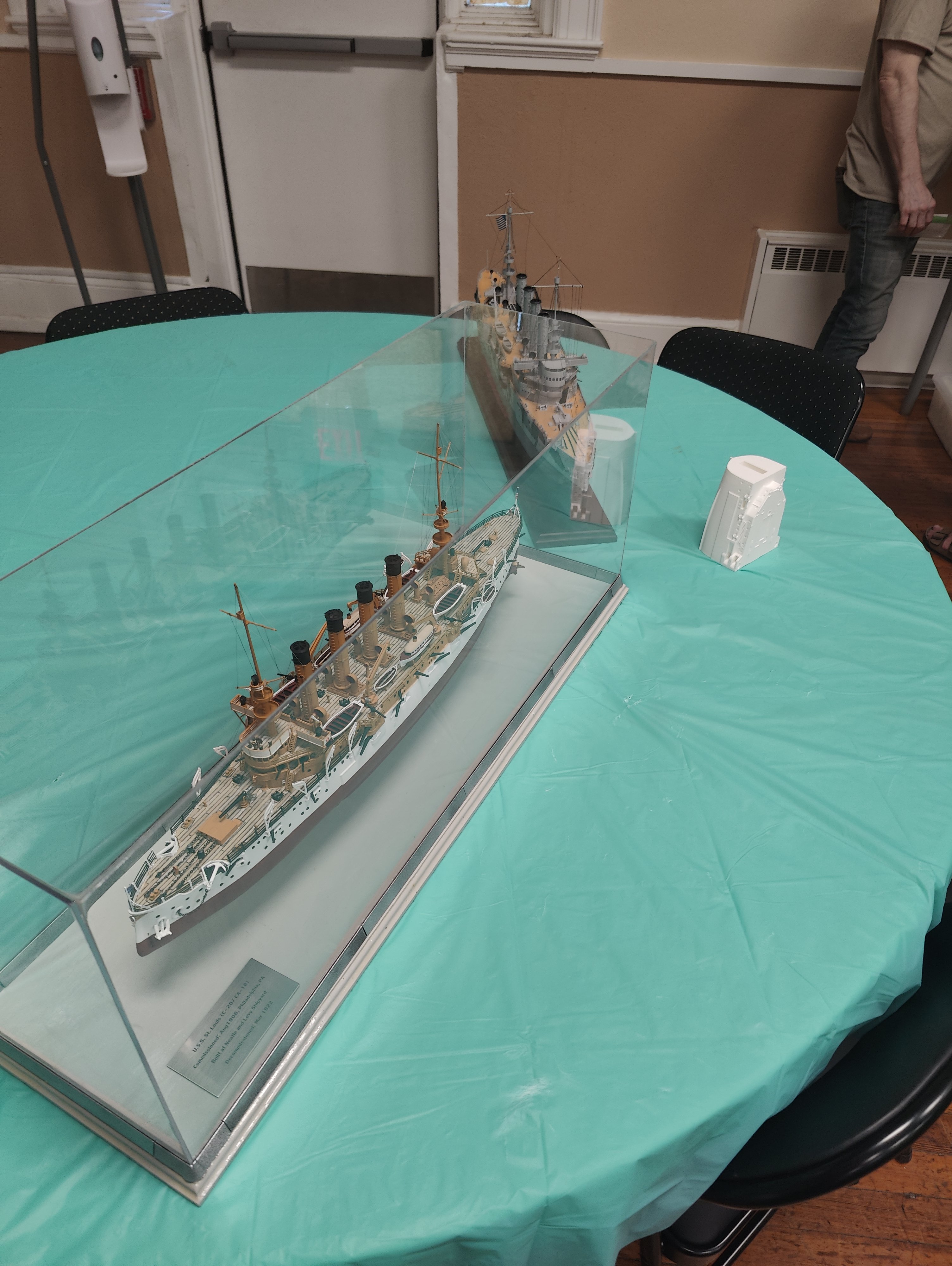

Back to my build. Work on the pedestals, case, and side gun mounts . I managed to router some scrap wood and find some UV resistant acrylic sheet which I welded with poly chloride bonding agent.
I painted the base gray and layered on 3 coats of polyurethane. The pedestals were printed to fit and painted bronze. I then layered over brass wax paint with sealer. The model was screwed into place using 3 inch self tapping.
