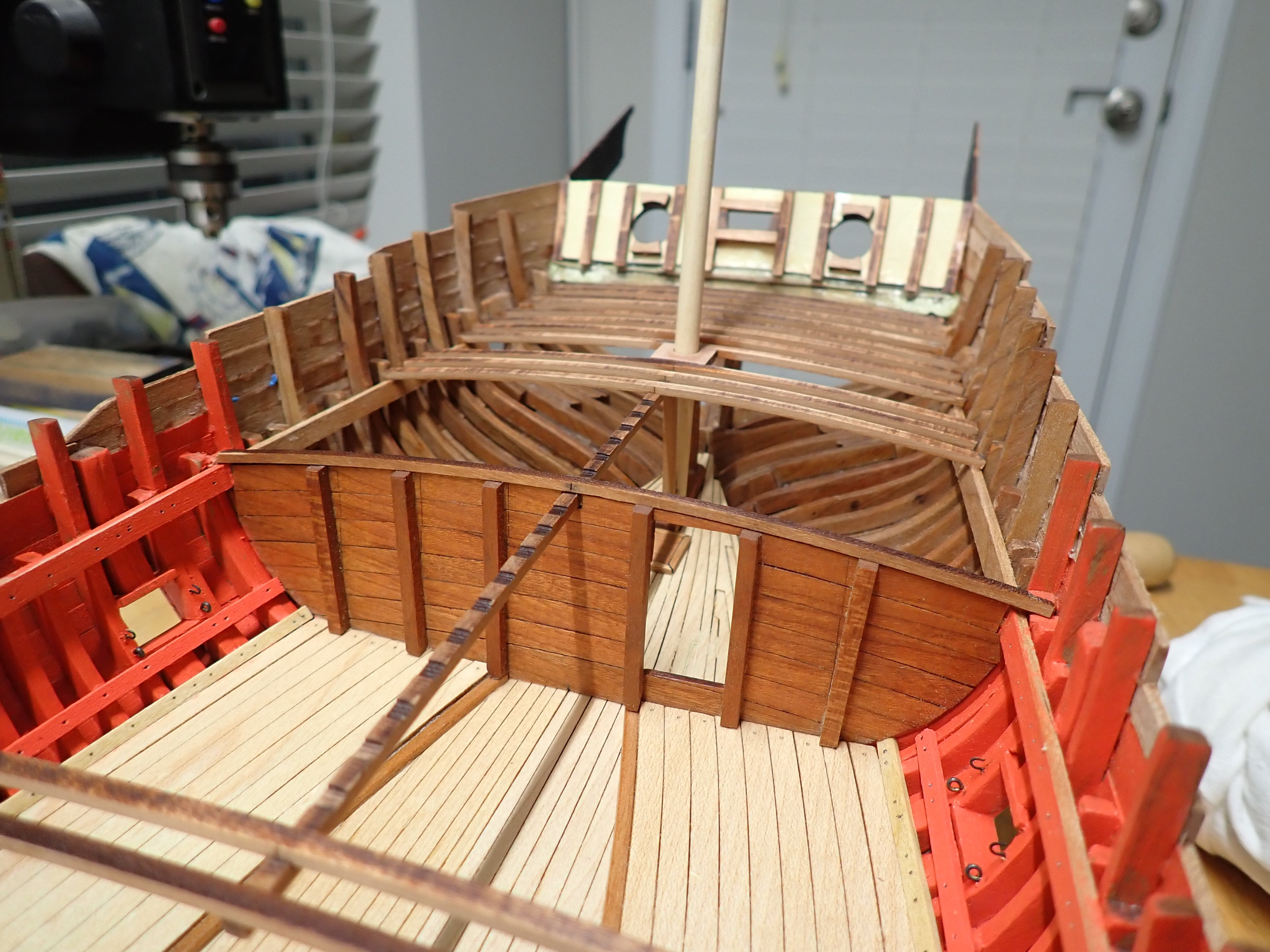

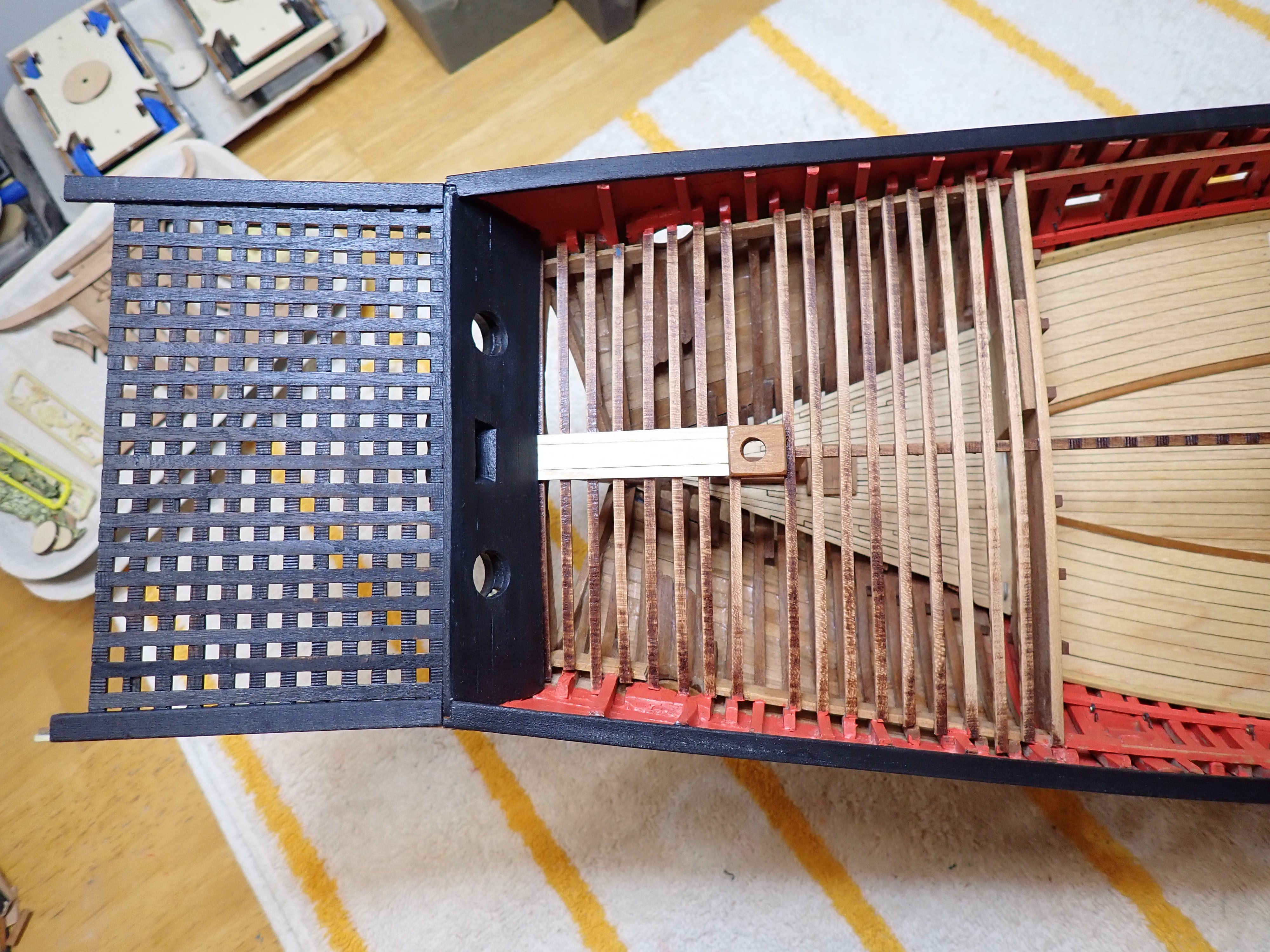

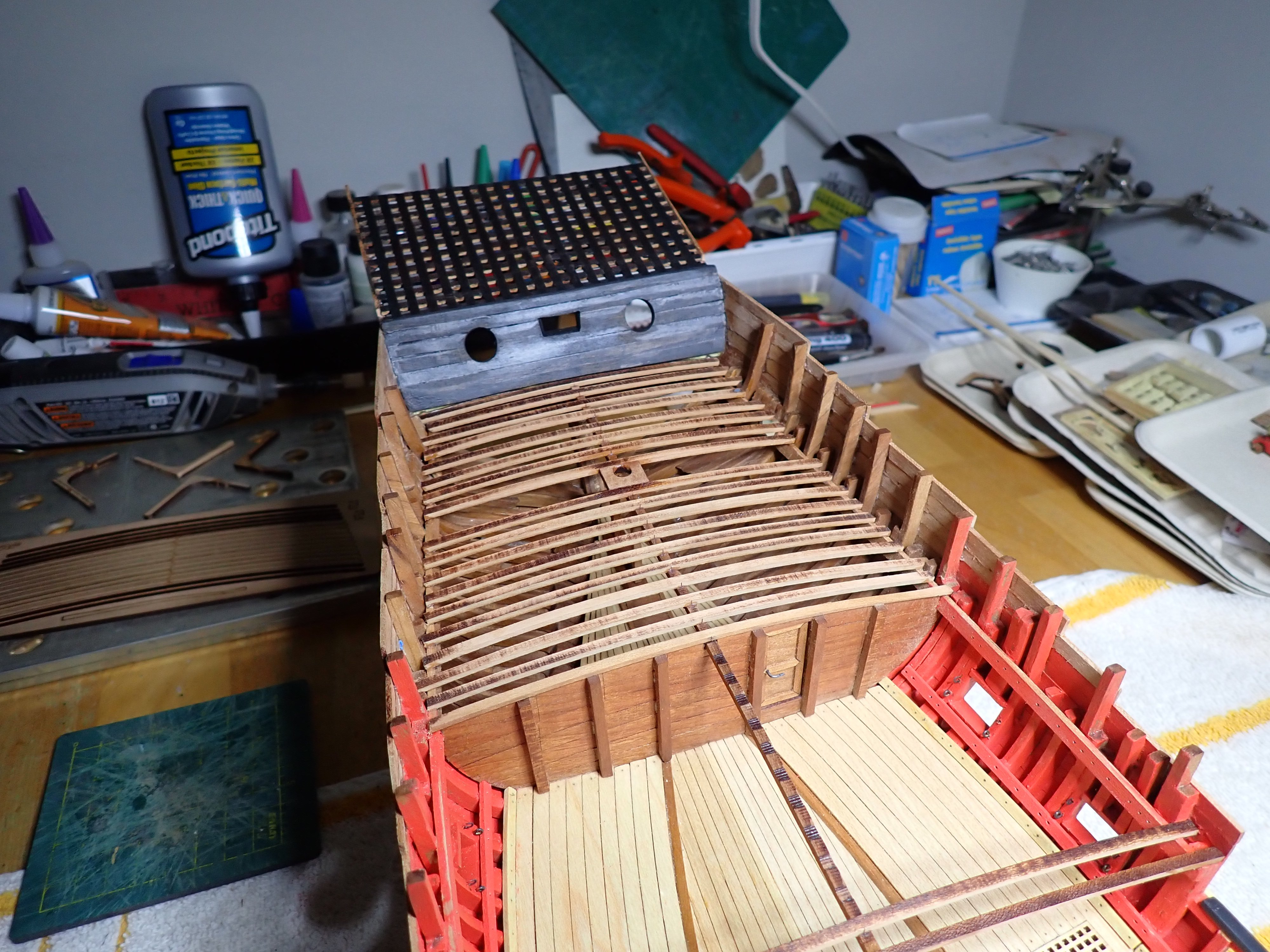

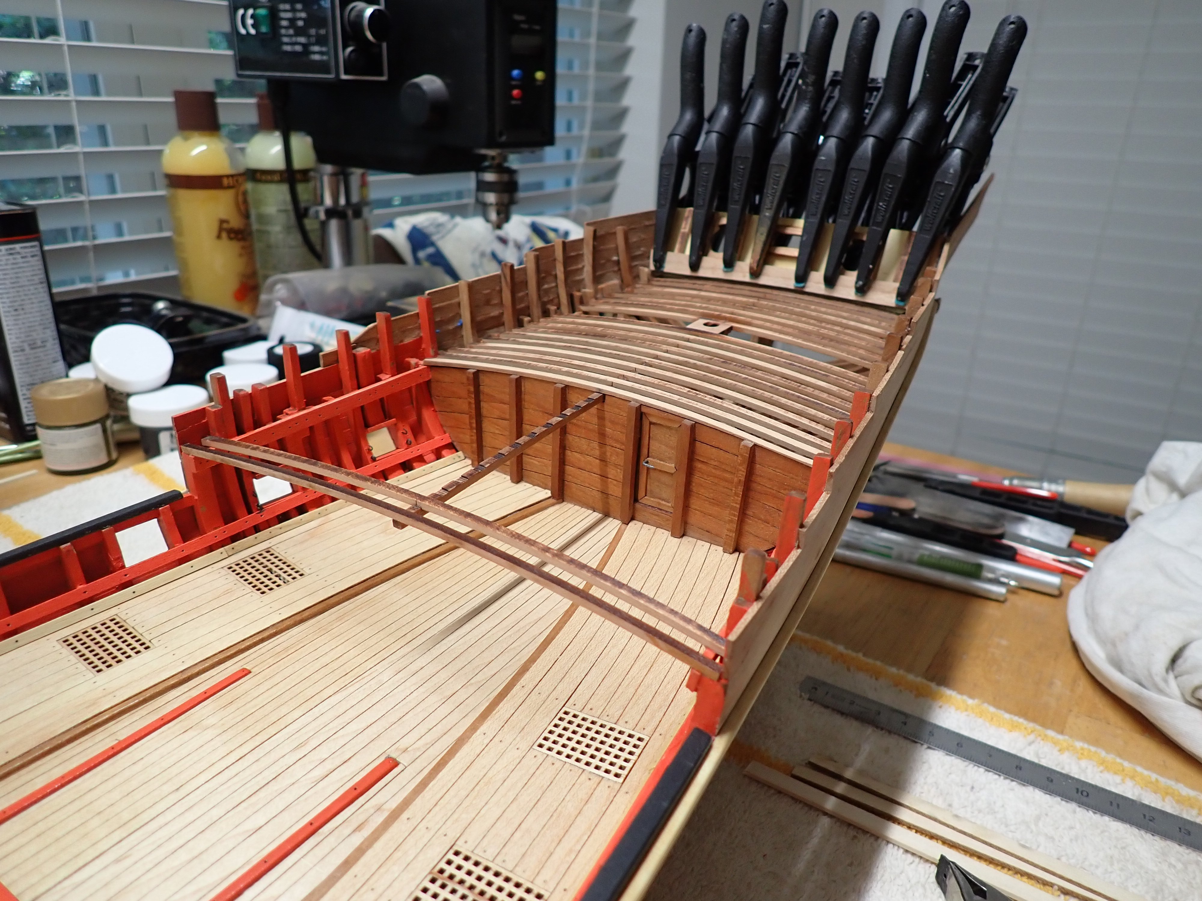

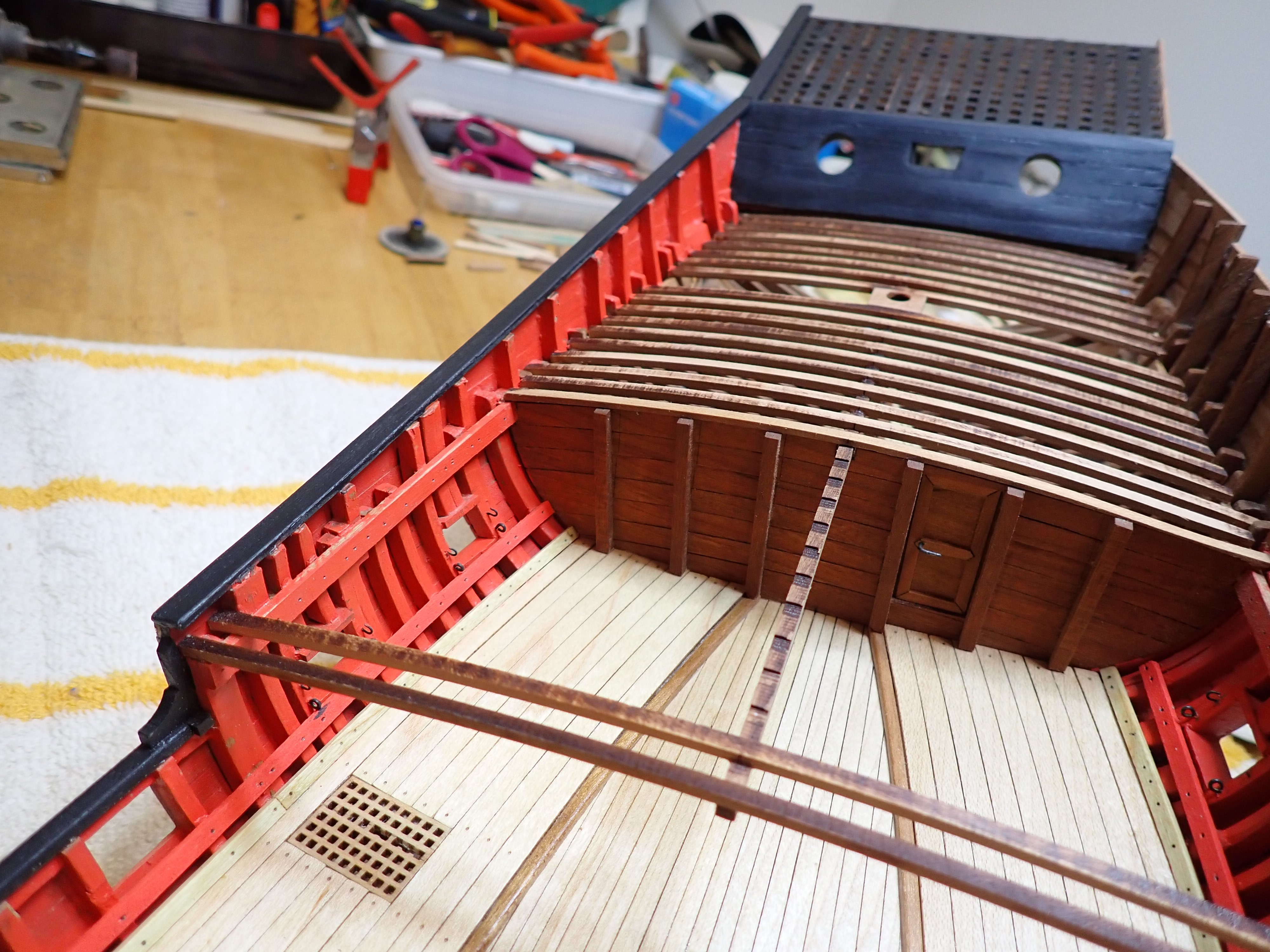

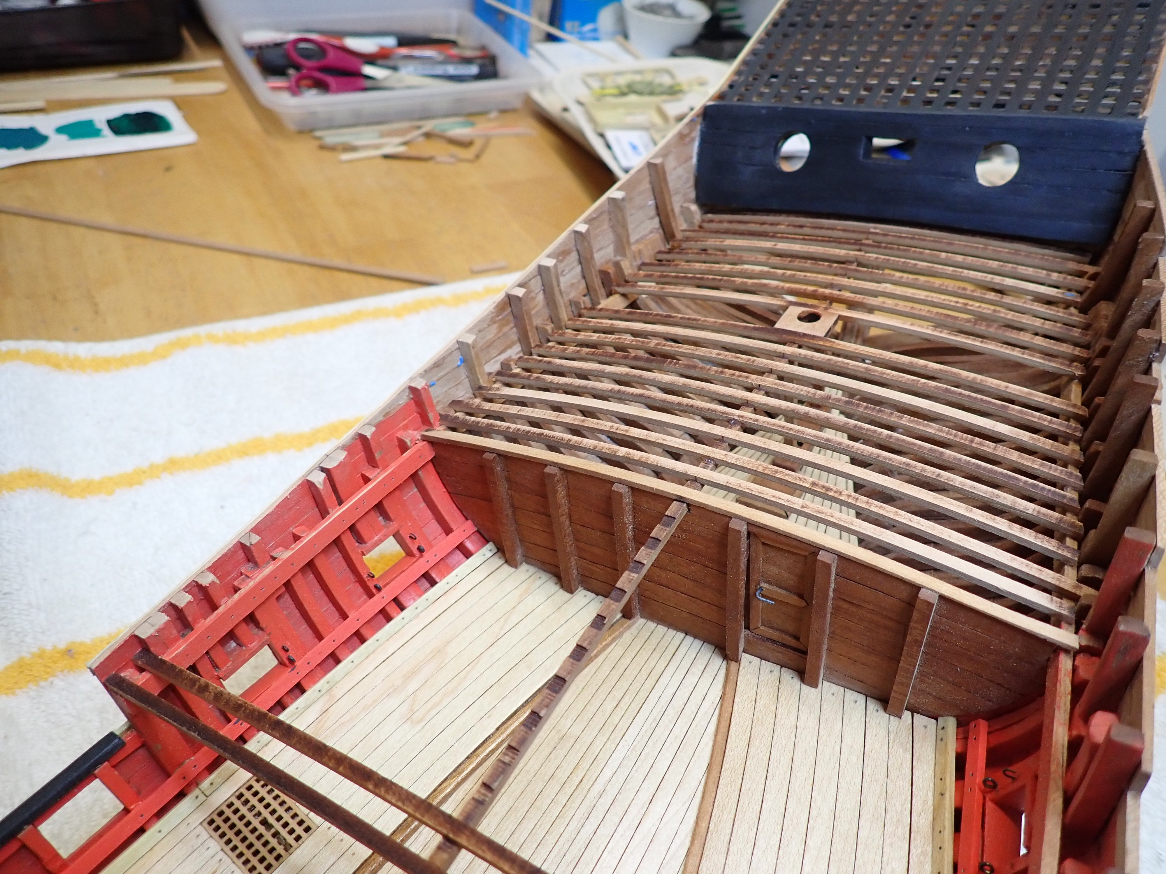

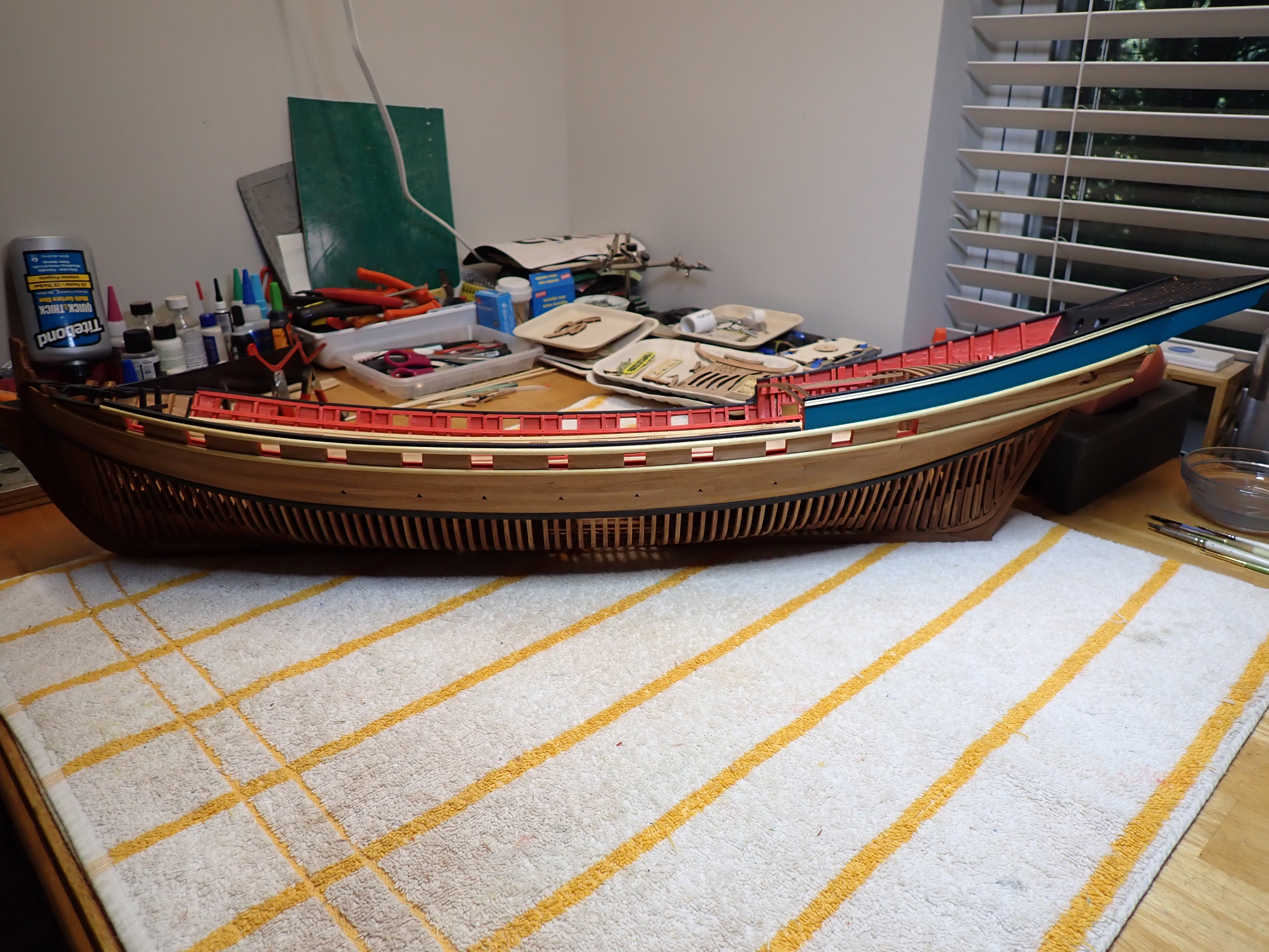

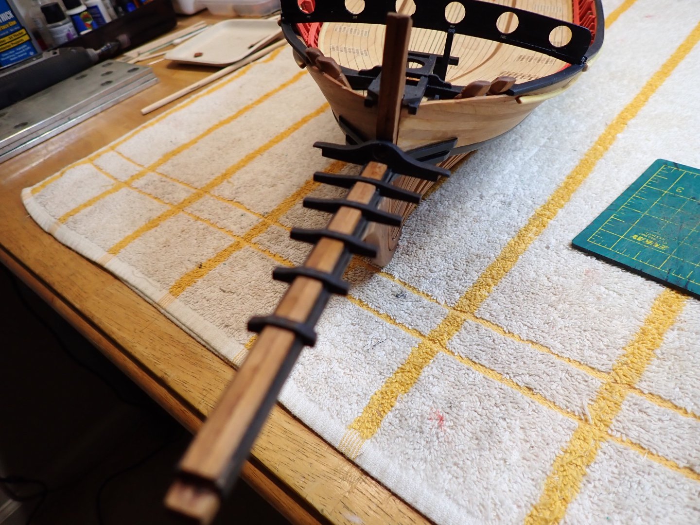

Moving on with the installation of the beams supporting the quarter deck.

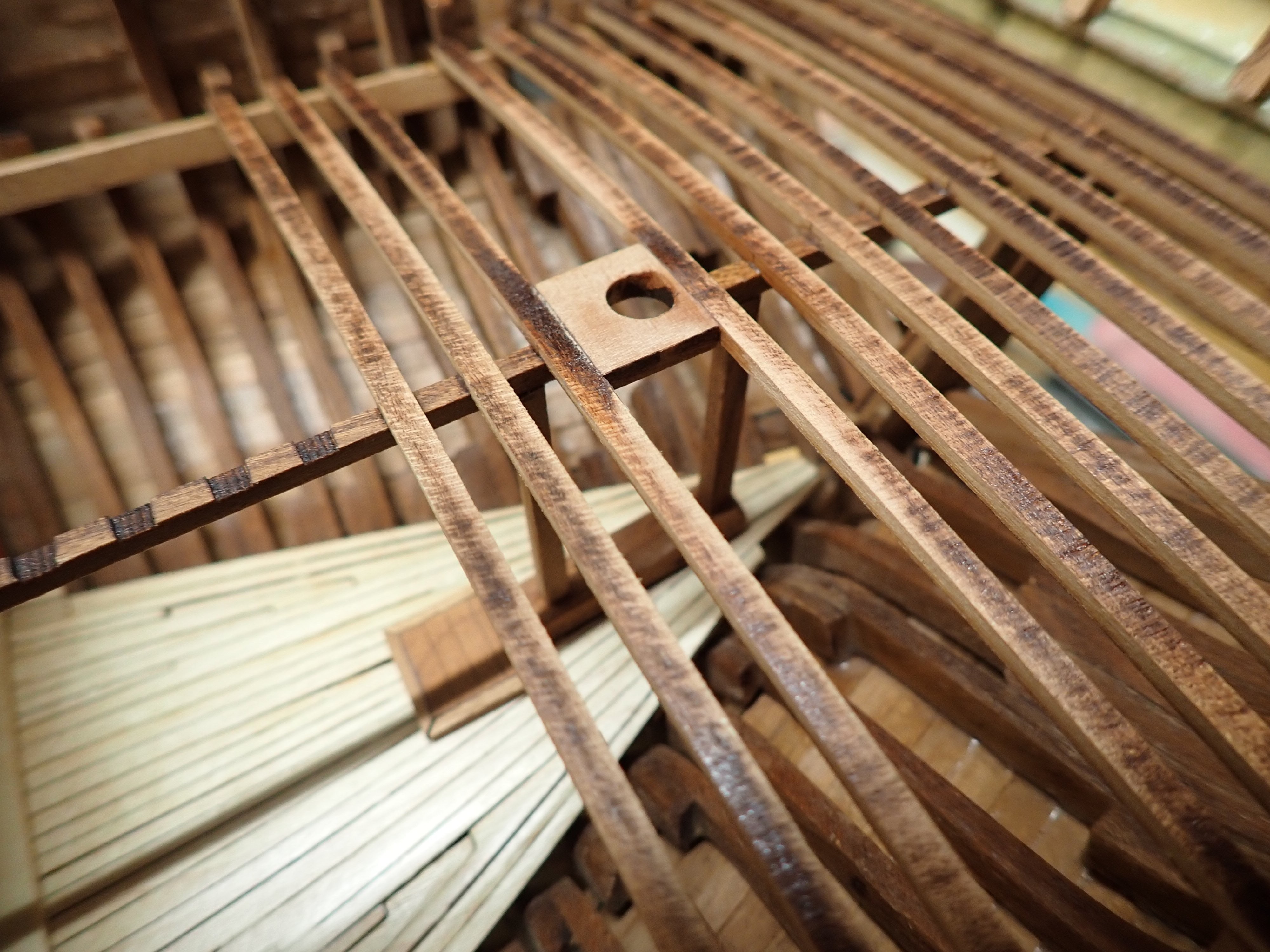

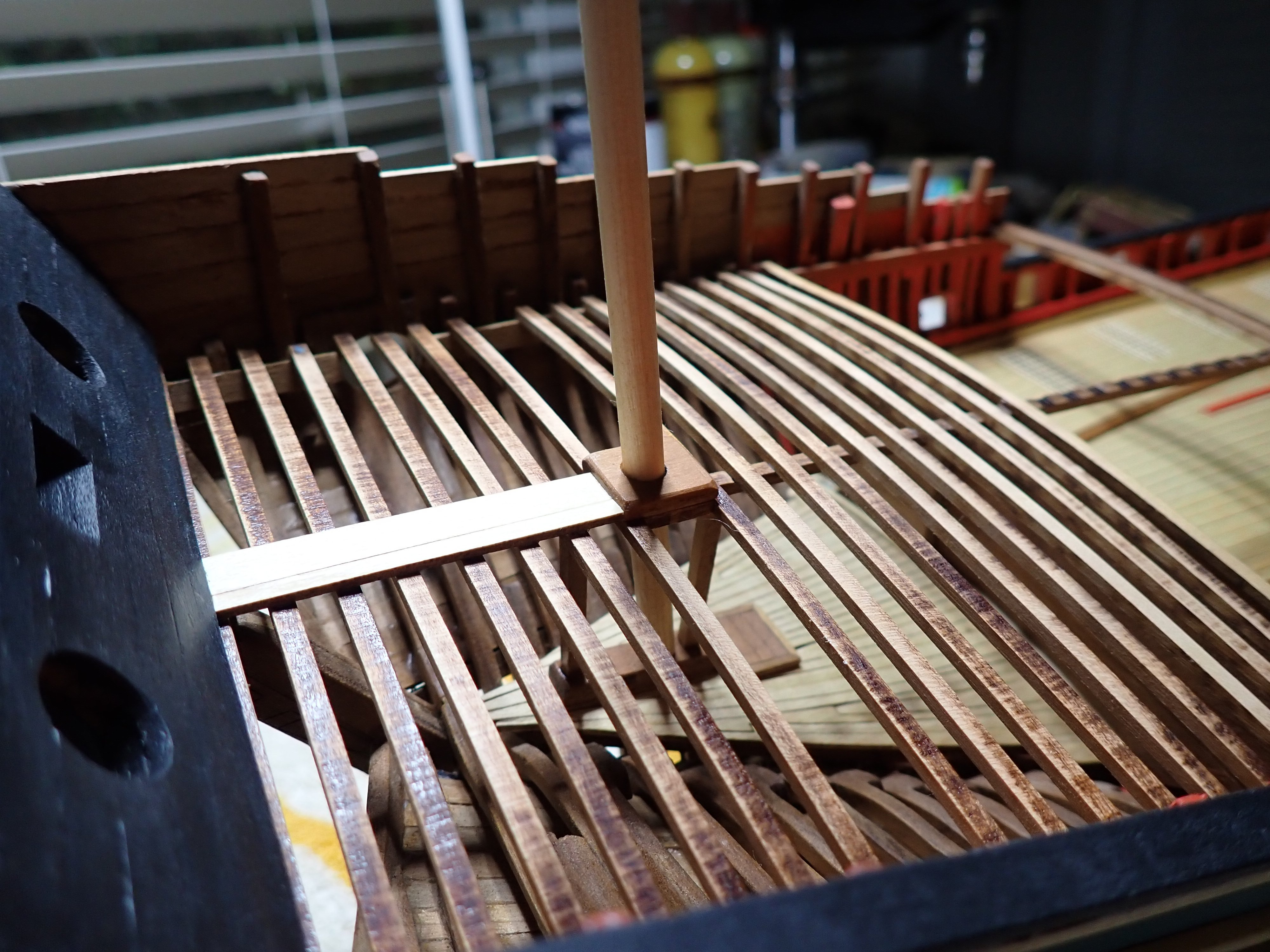

The guide holding and aligning the mizzen mast has been installed. I also added a couple of poles underneath to make it sturdier.

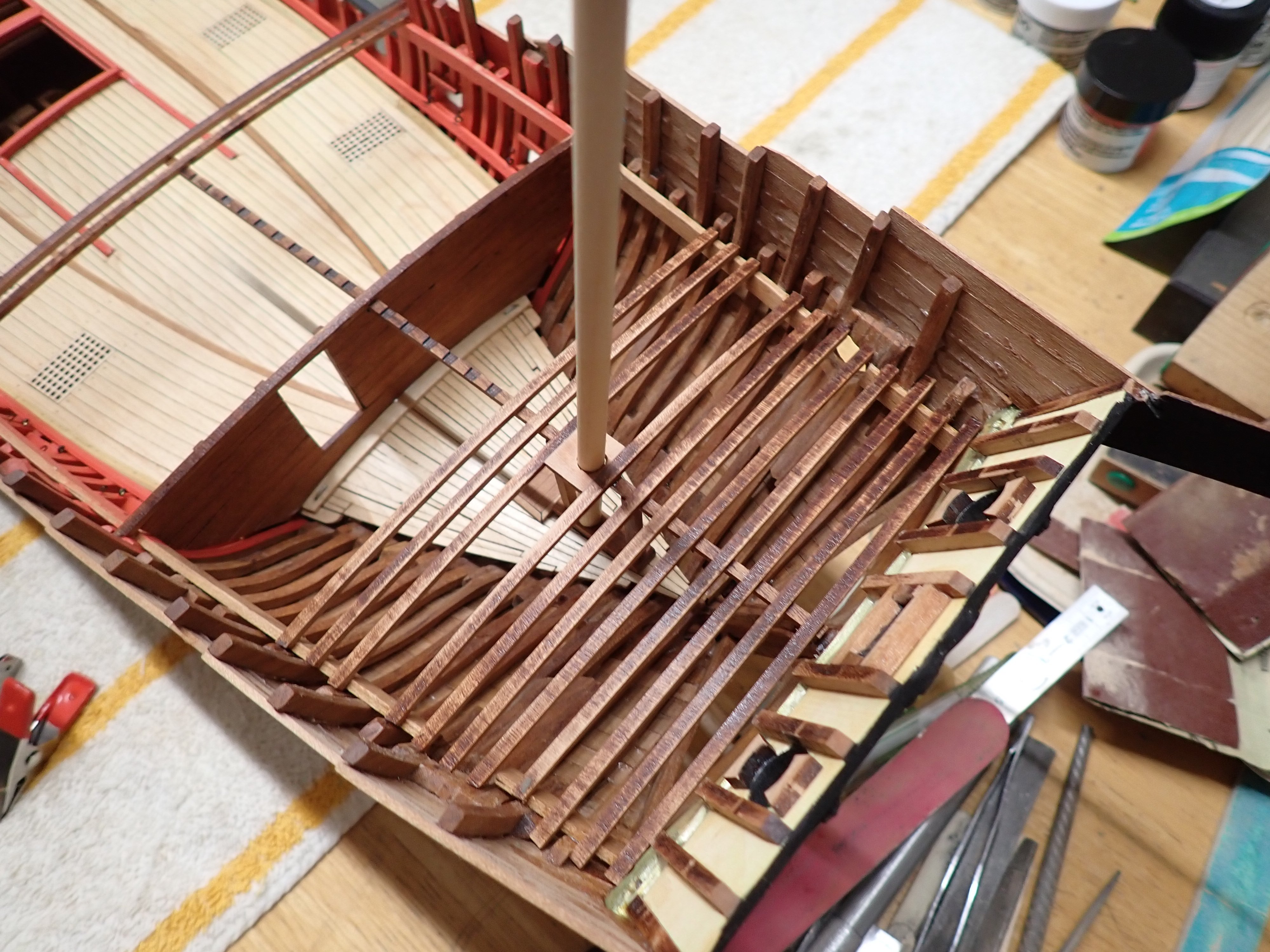

Now, I have to finish the door, glue it to the cabin wall and complete the assembly of the beams, at least up to the wall of the cabin:
Below, you can see the extra support. Once the deck is in place, it will be quite solid, but you never know....
Yves

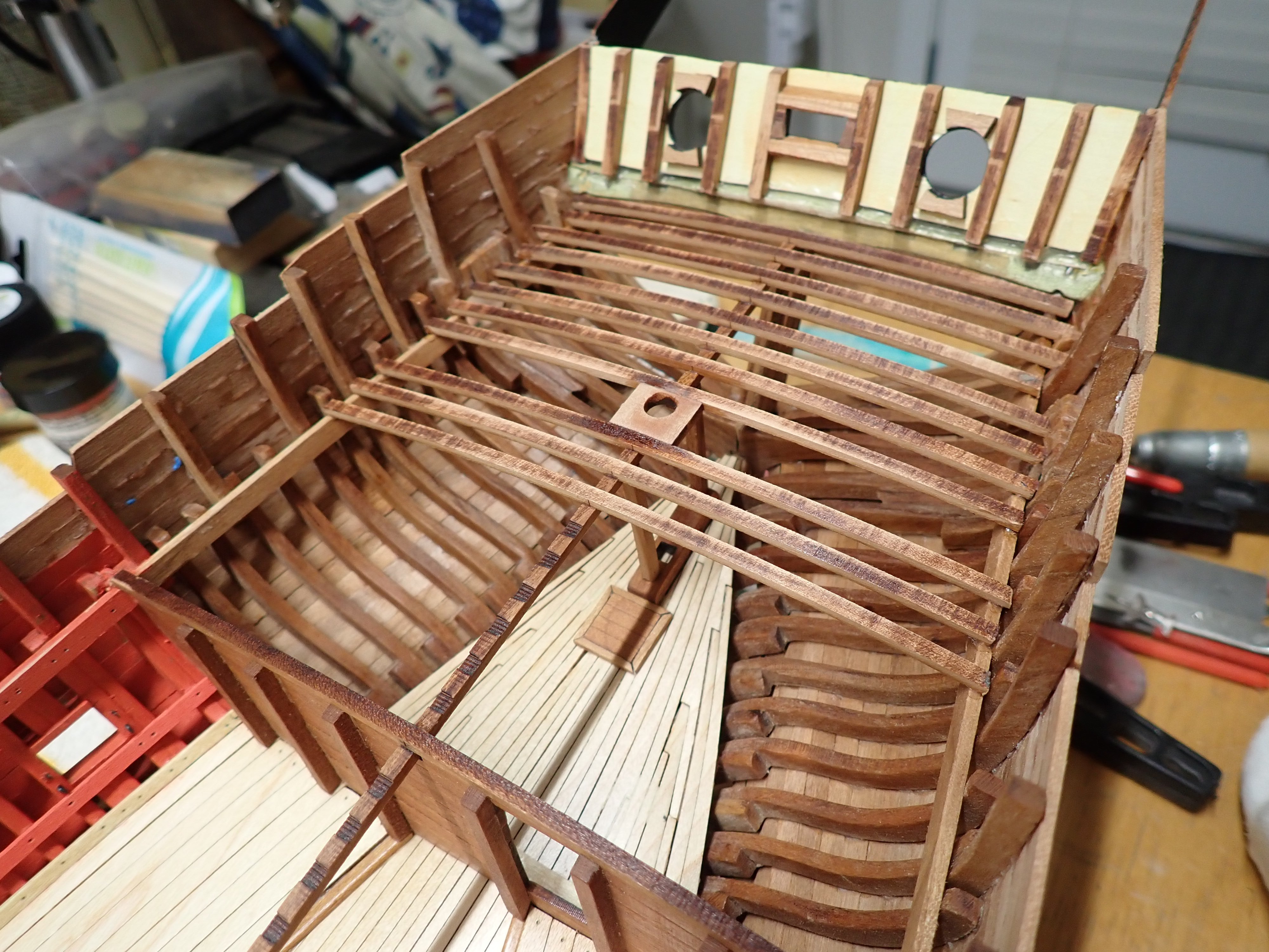

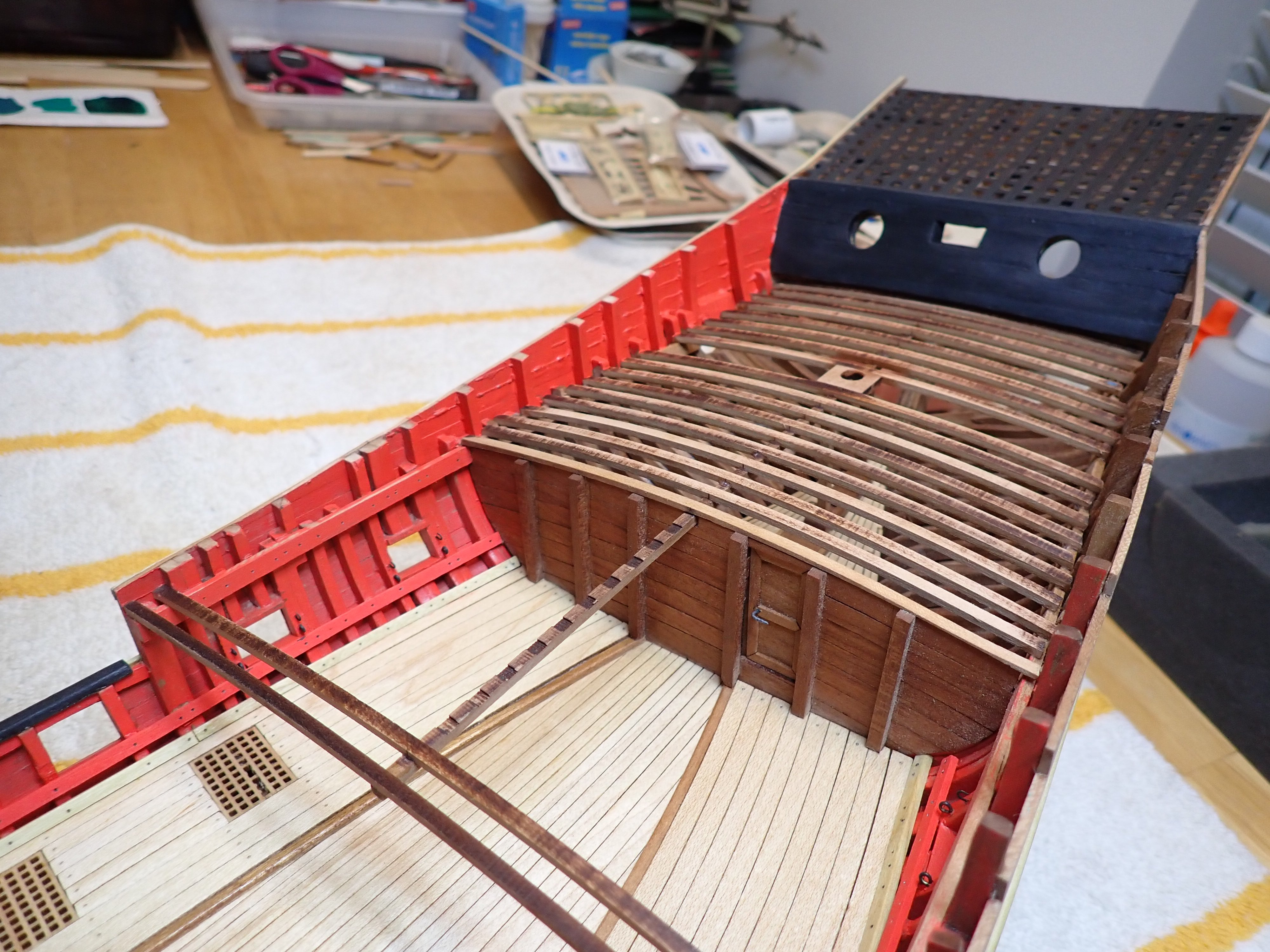

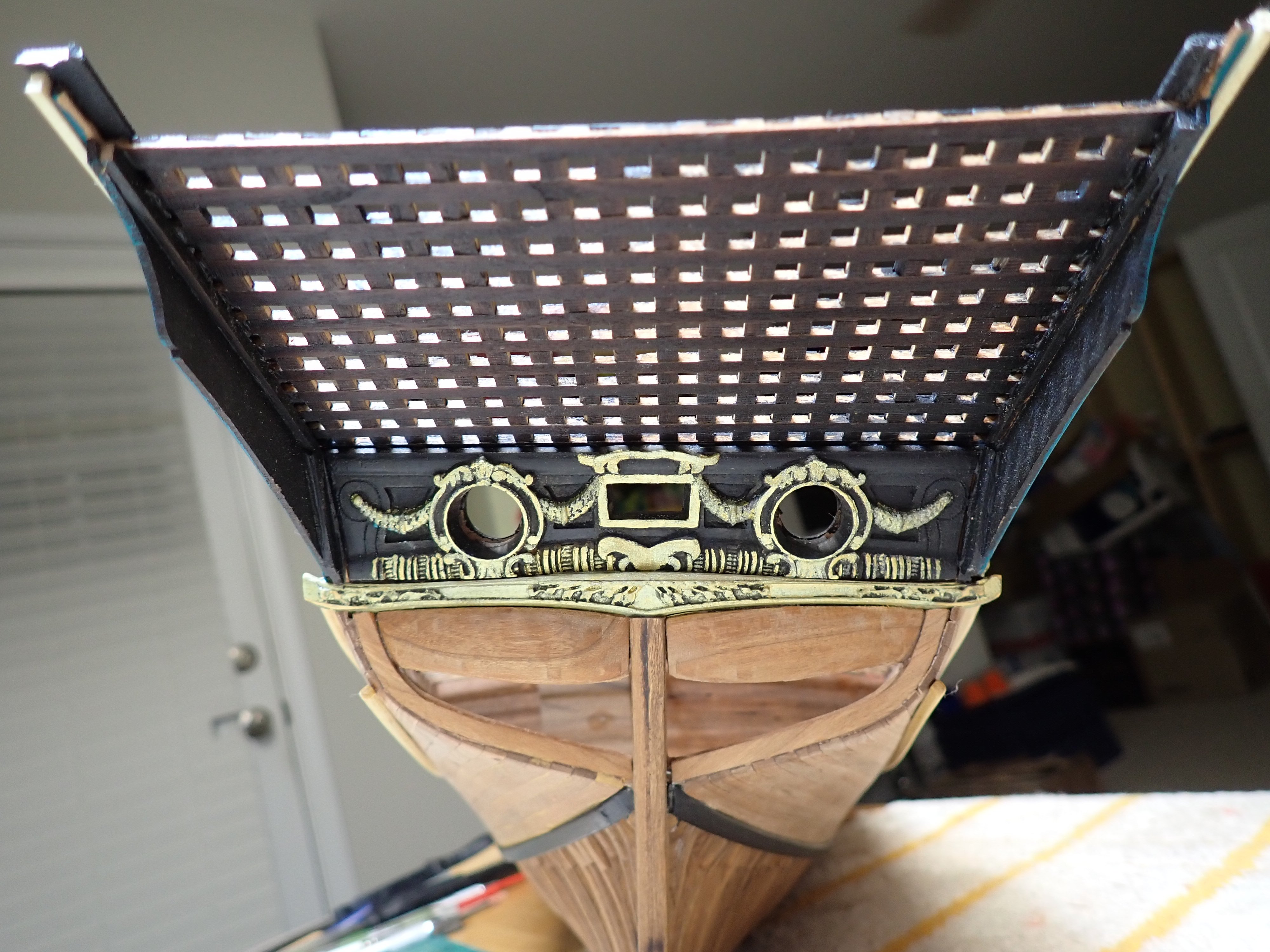

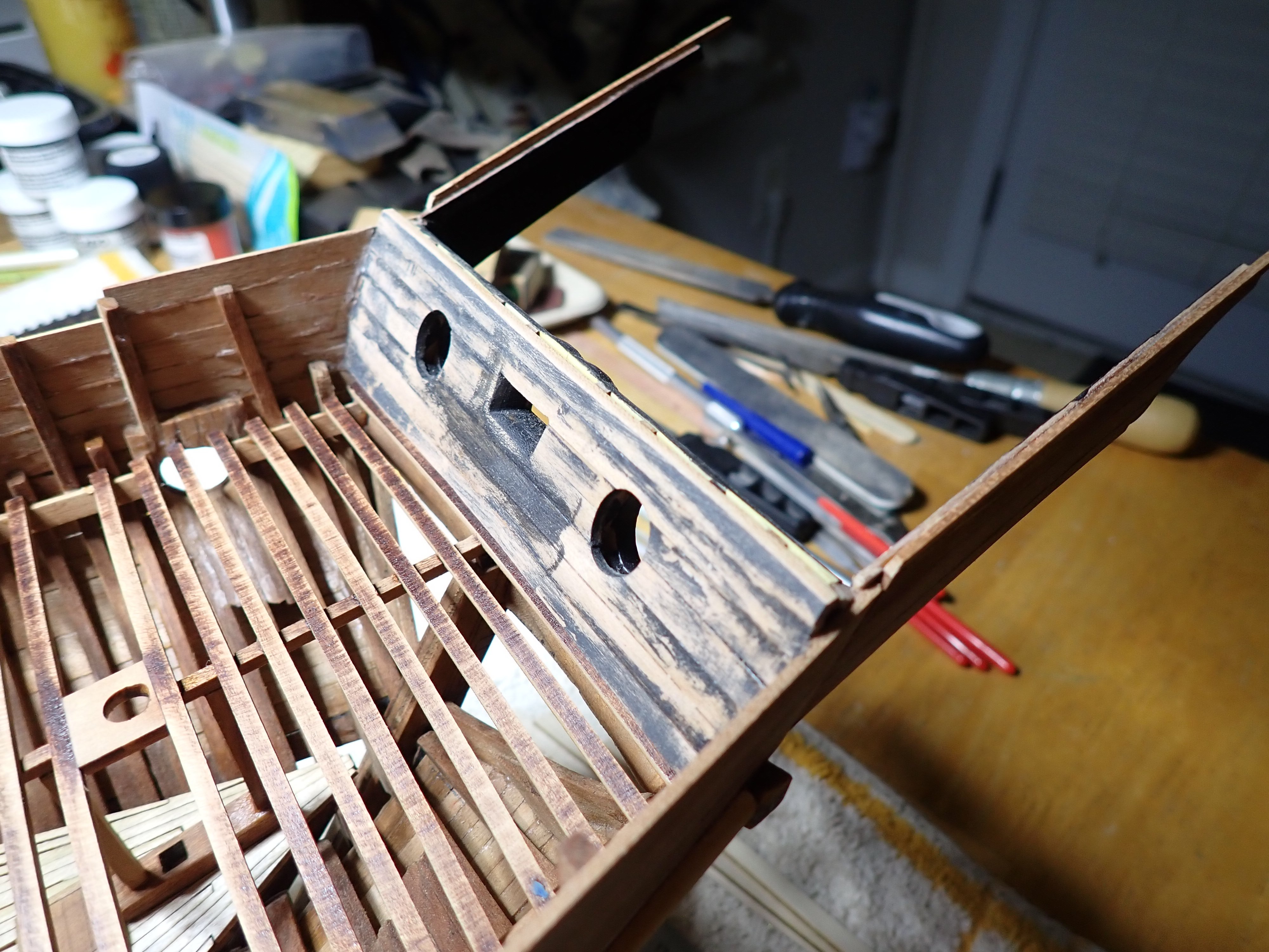

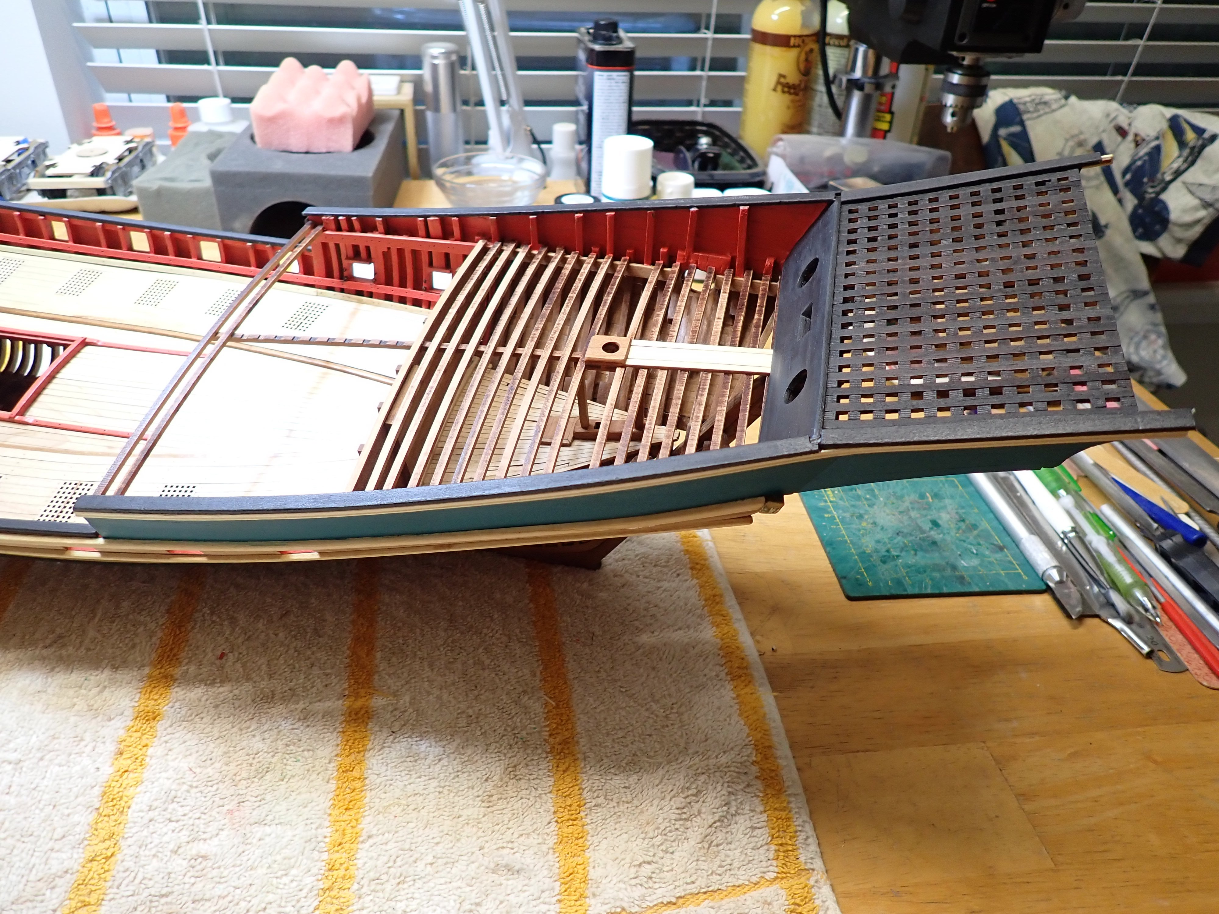

Installation of the door and the remaining deck beams to the cabin wall. The other beams cannot be installed yet, because of the guns.

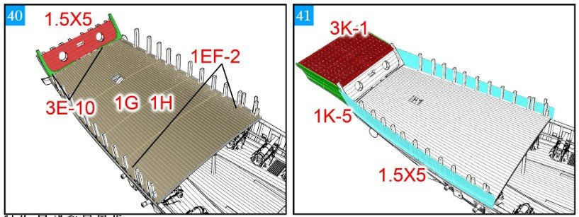

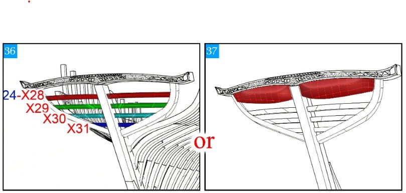

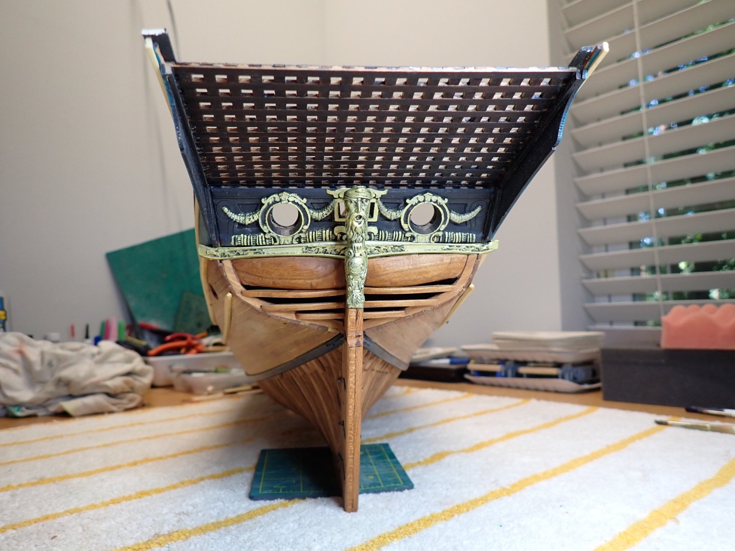

I started building the planking of the rear bulkhead, after using some spacers to account for the quarter deck planking.
I am approaching the construction by mixing elements of the instructions:

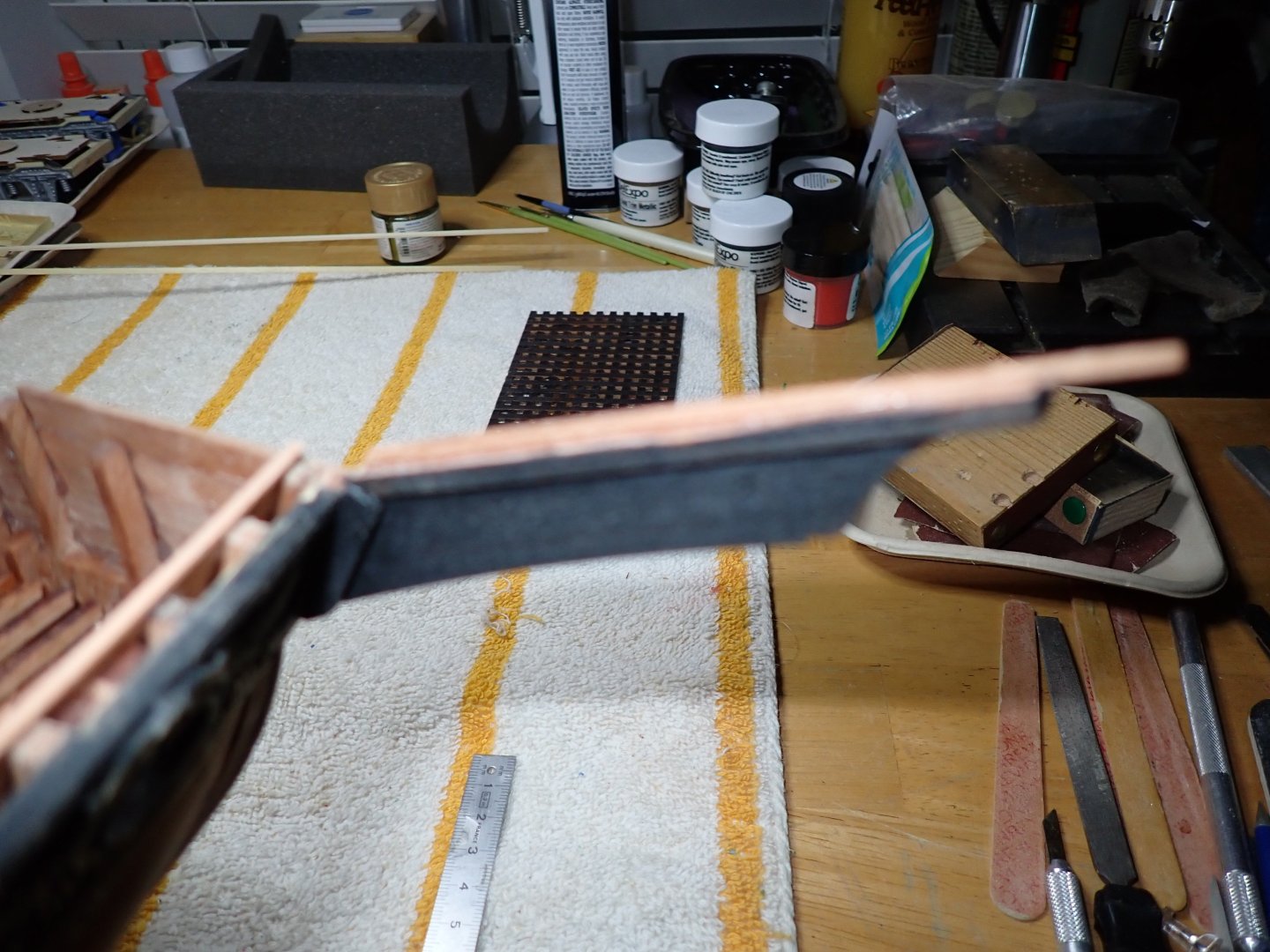

 I am also modifying very slightly the rear wings (1K-5) to better accommodate that platform on the stern (3K-1 on the picture). I am adding a small strips to support the platform, on both sides:
I am also adding a 2 mm strip to increase the height of the "wings" and compensate for the thickness of the platform:

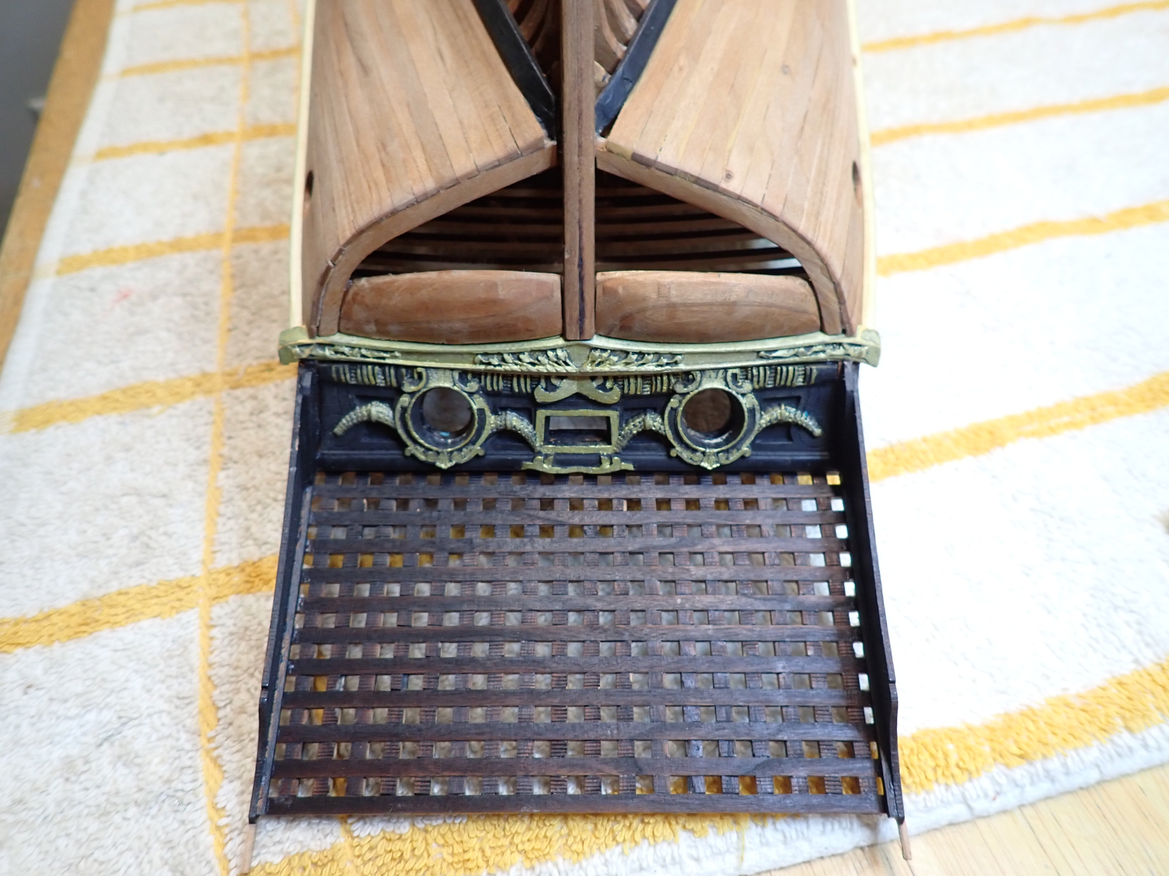

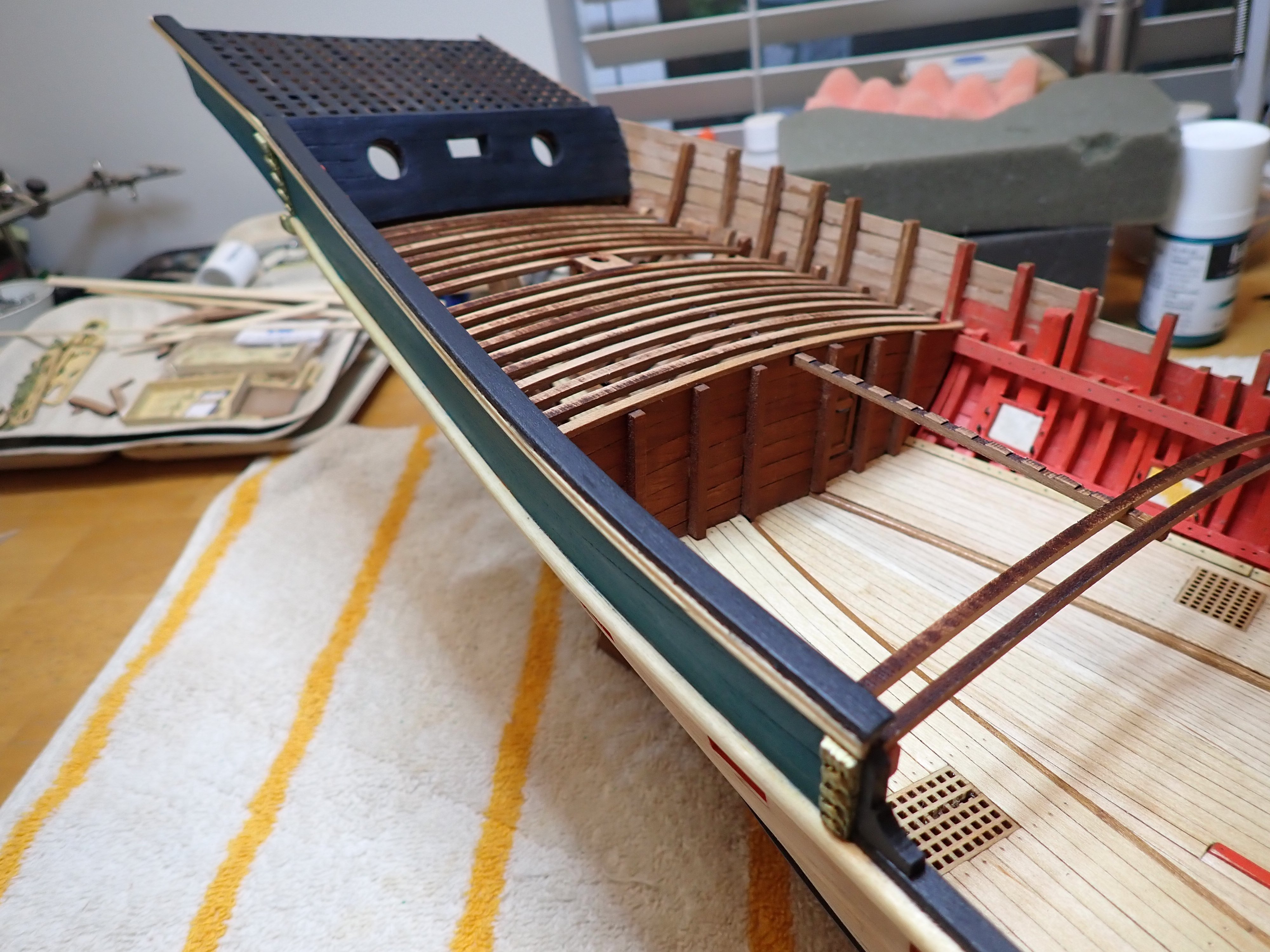

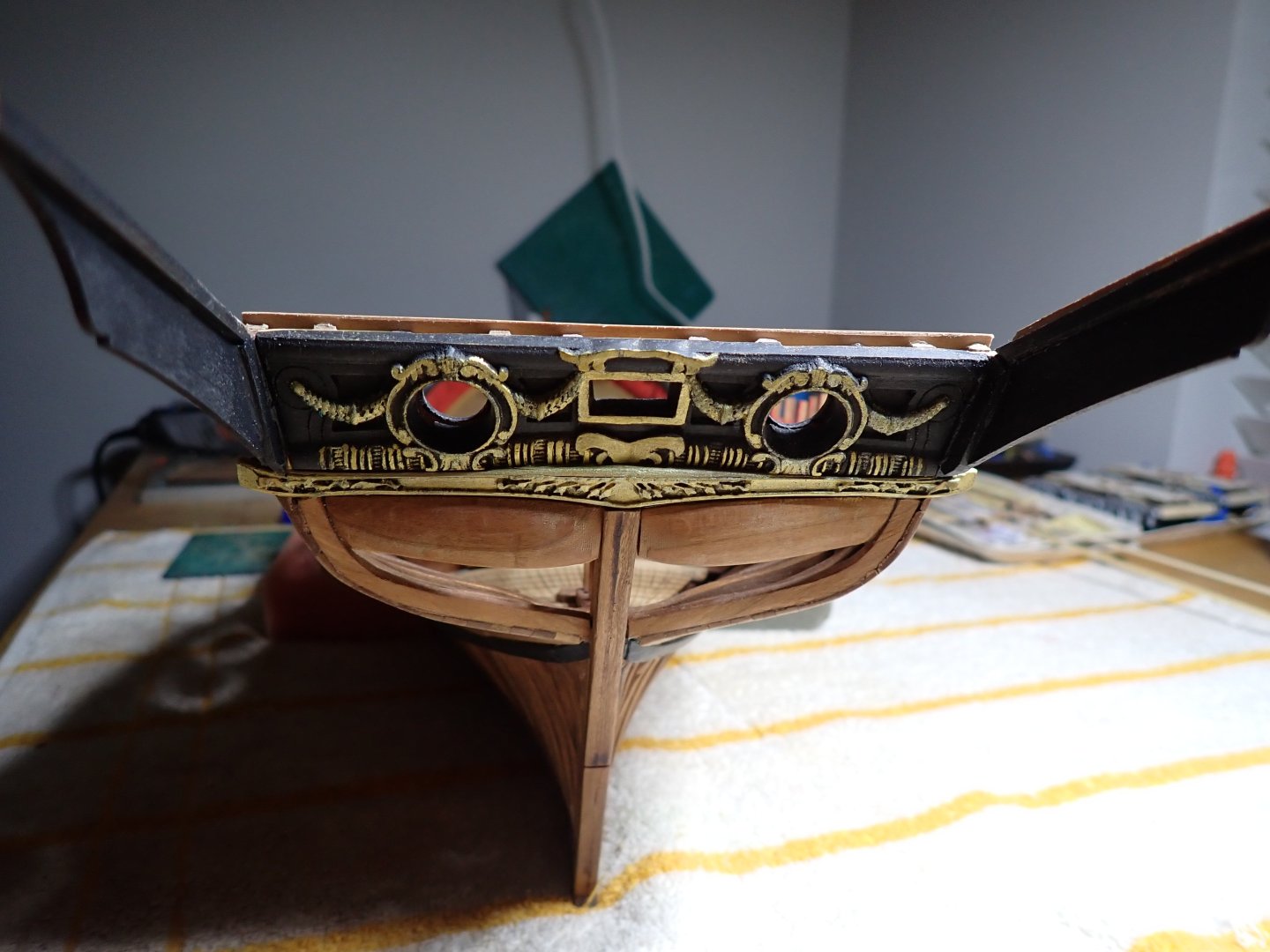

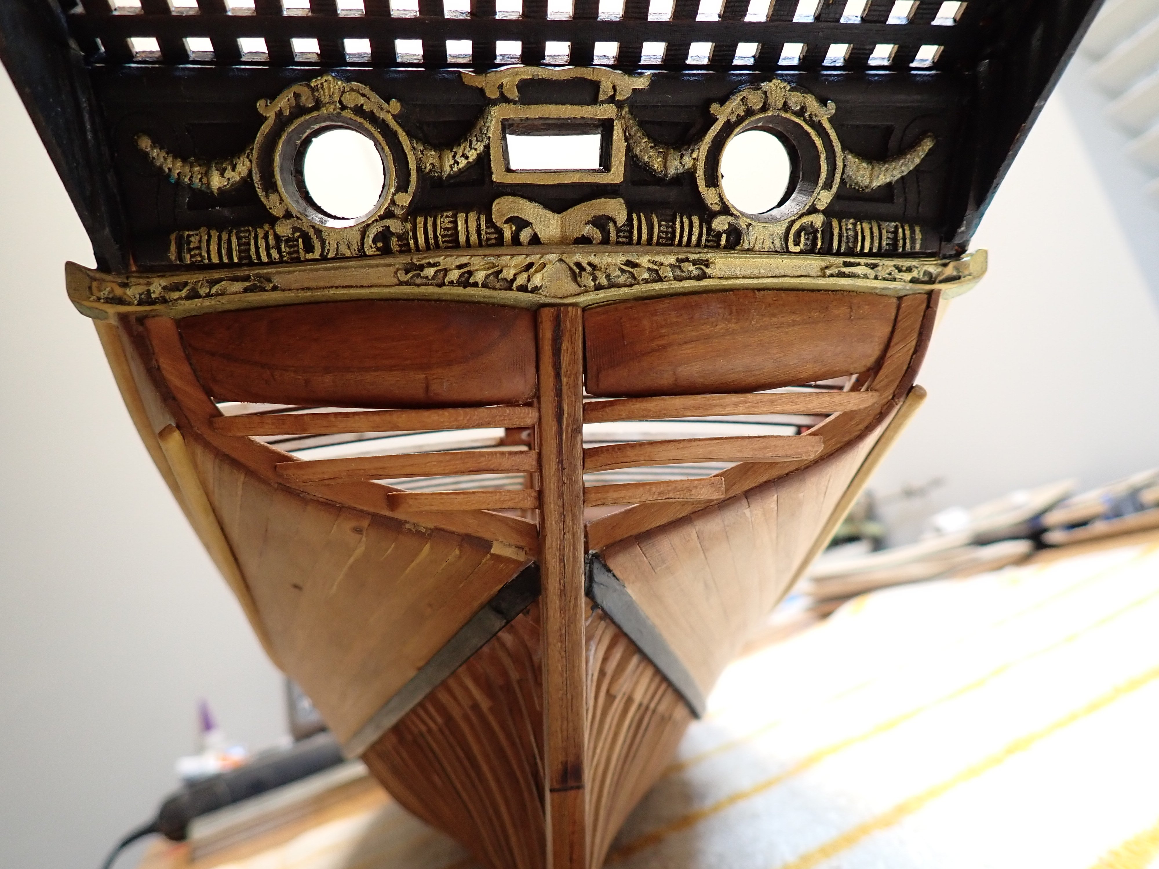

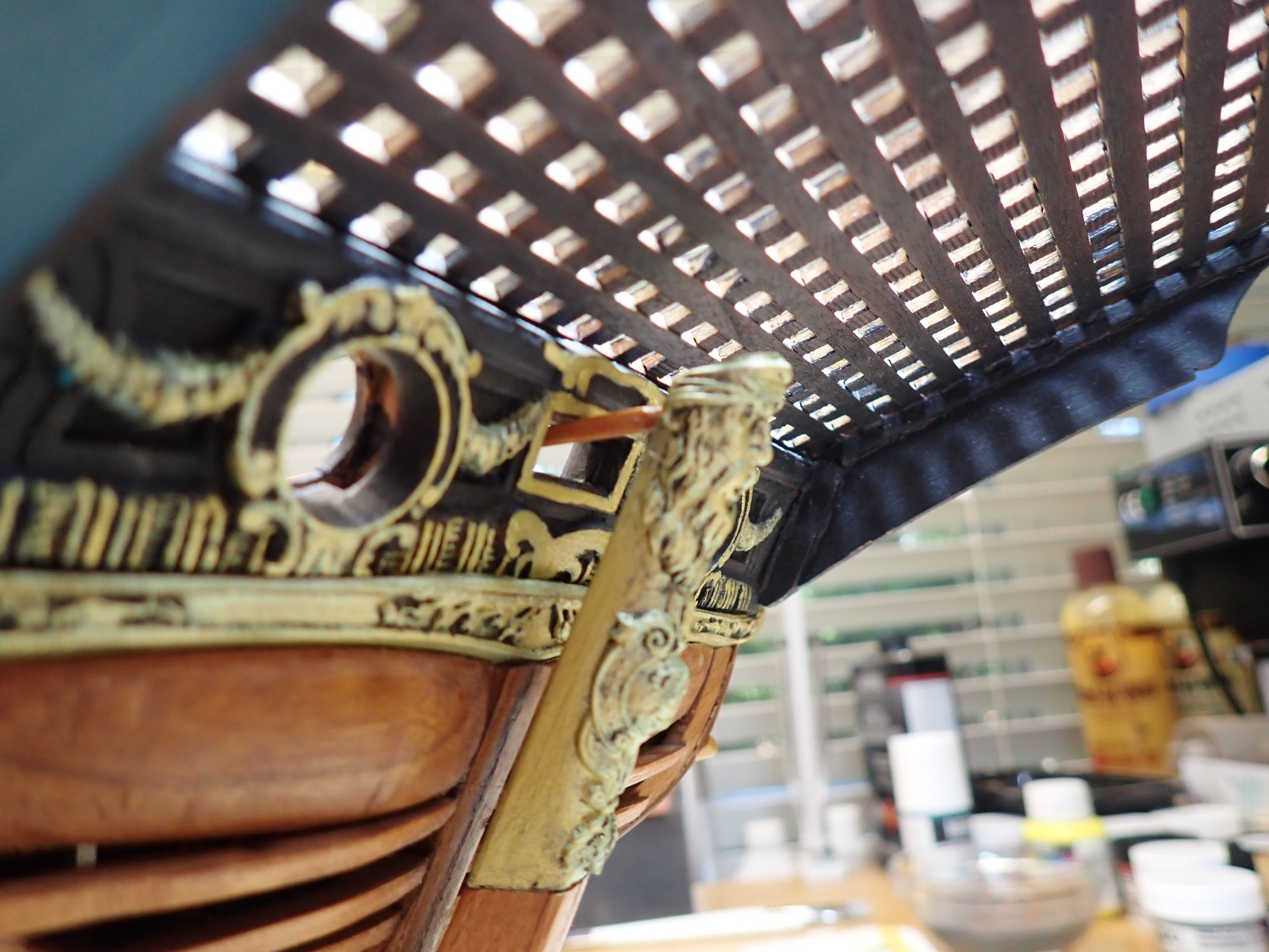

Before gluing the platform, I am trying to finalize all the gold painting of the freezes, that will be hard to reach, once glued:
Finally, the platform is glued, making the stern a lot more solid and sturdier:
There is still a lot of sanding and painting that has to take place, to make it presentable.
Yves

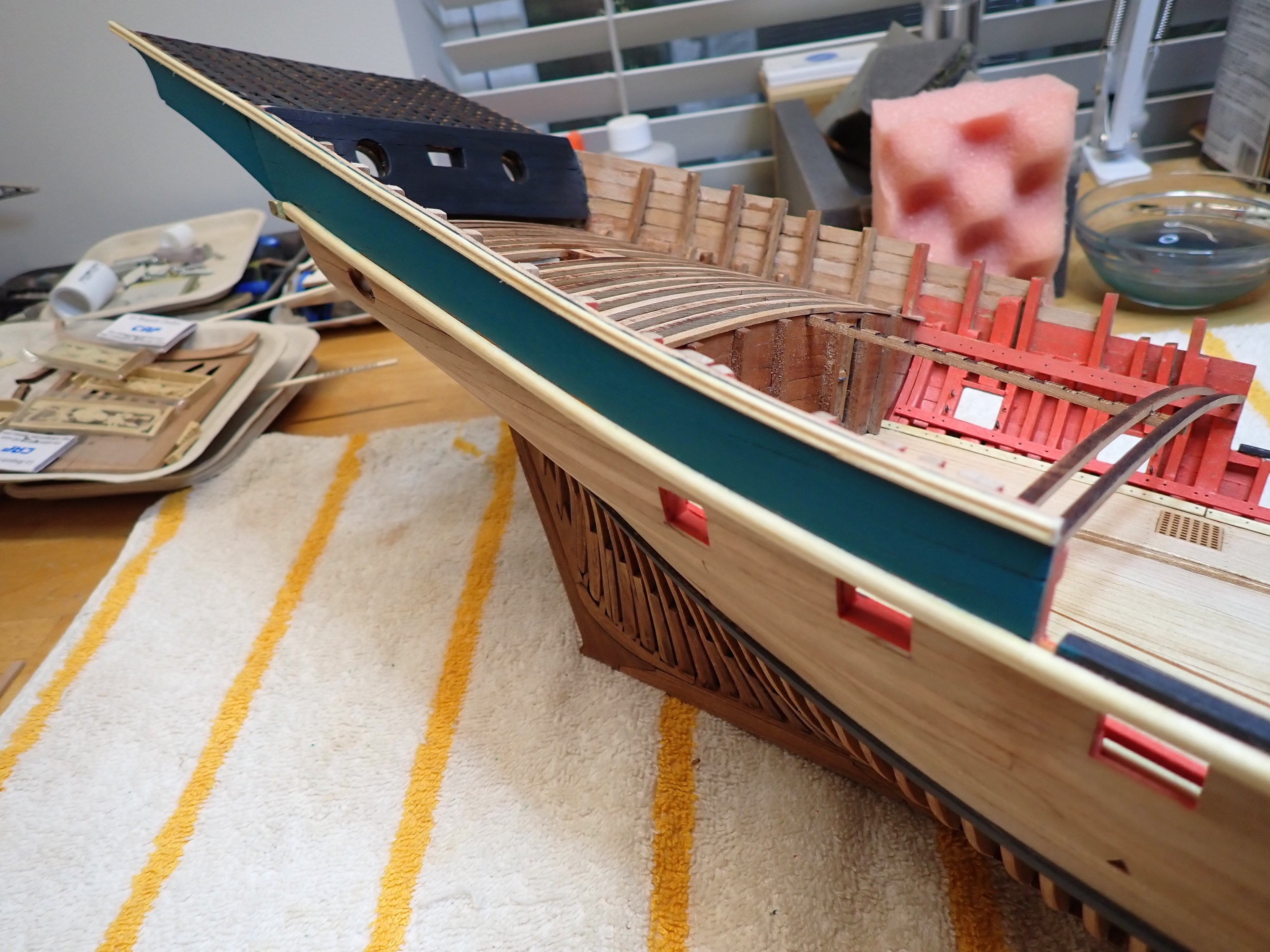

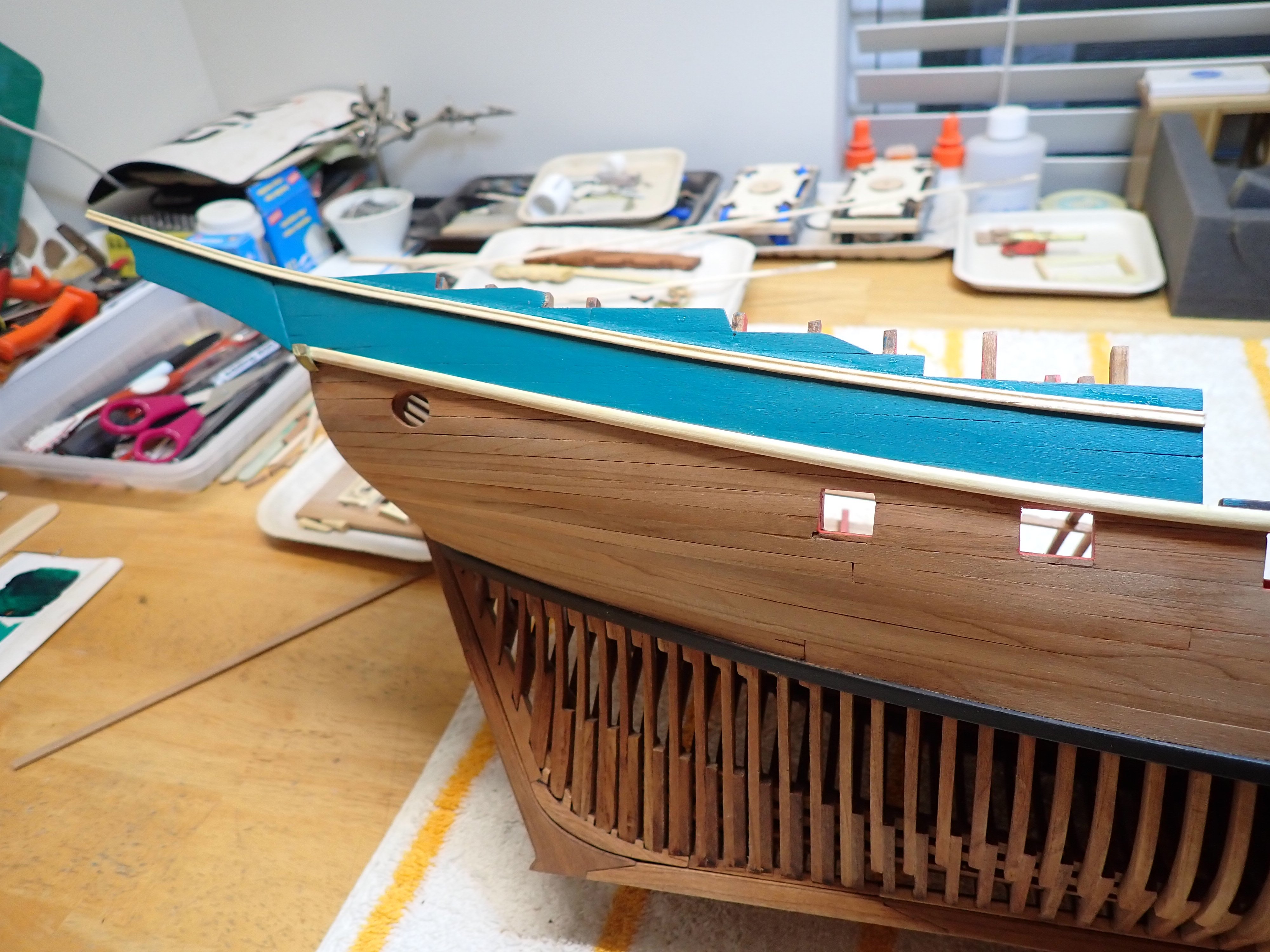

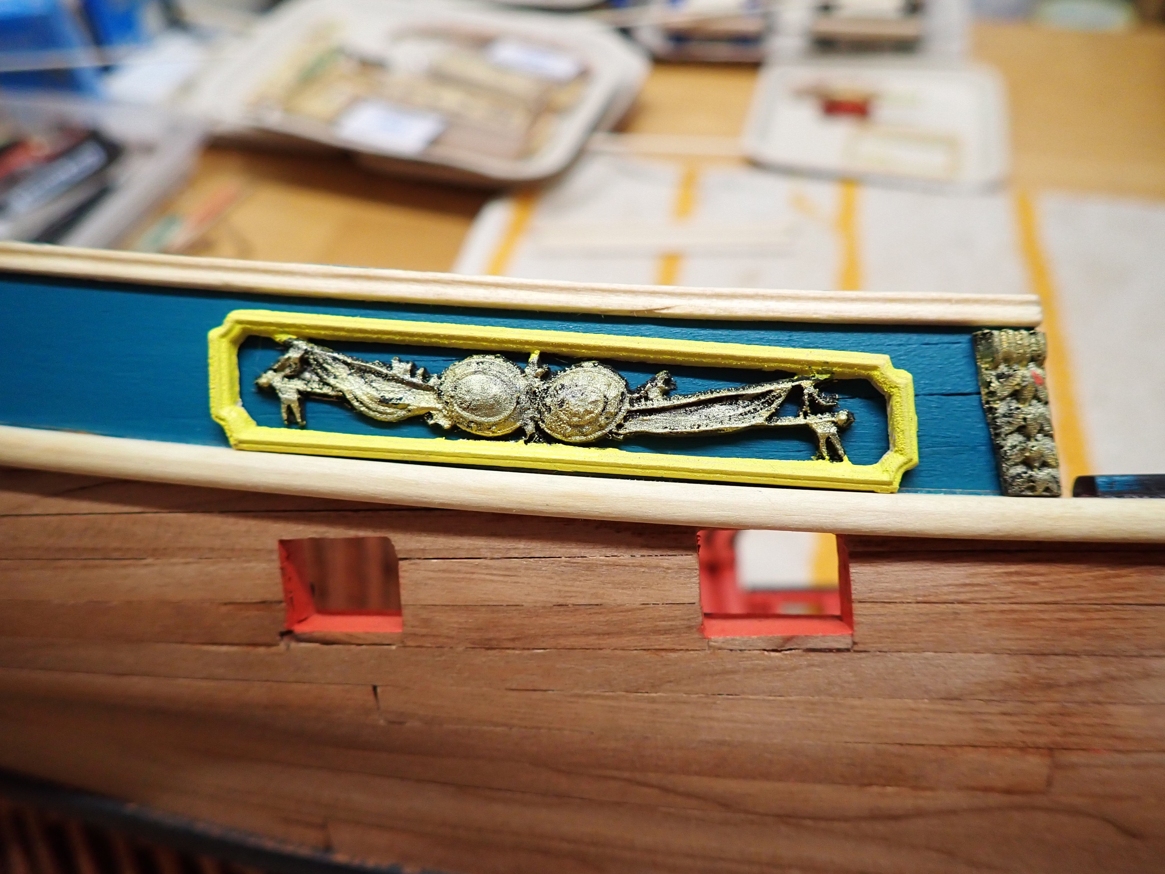

I have been thinking about the railing of the rear quarter deck. If the planking was done in a curved and harmonious way with stealers and all the necessary stuff, the shape of the planking would follow the curvature of the railing. That is a view of the mind and it does not happen too often.

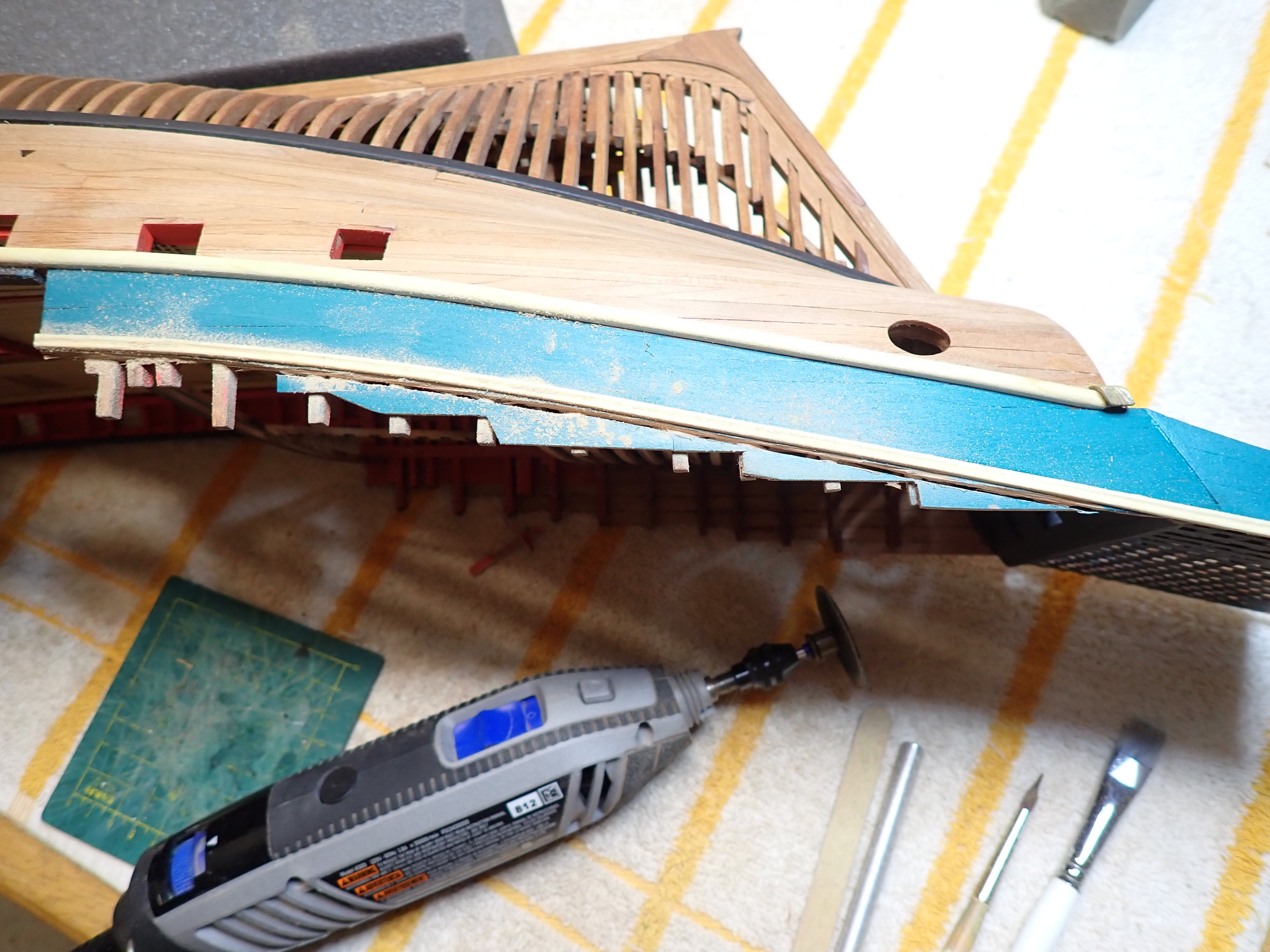

So, after postponing this stage for a while, I decided today to jump into it and go "Crazy".
The first thing to do is glue that nice strip (not included in the kit) that is supposed to delineate the hull from the railing. That is done after many dry runs and positioning of the freezes and ornaments. The rear of the hull is painted with that rare greenish blueish color described in the Monograph and that was in fashion at that era, in the French harbors. The strip is then positioned, secured and glued with liquid CA (1-3 seconds), carefully dropped from the top. The glue runs gently following the strip, without leaking underneath. I have used that technique with the HMS Bellona and the strips are still holding fine.
Another final checking that all the ornaments are fitting between the two strips..... And then we go crazy..... Using my Dremel with a cutting disk, I am butchering all the planking and framing above the top strip:

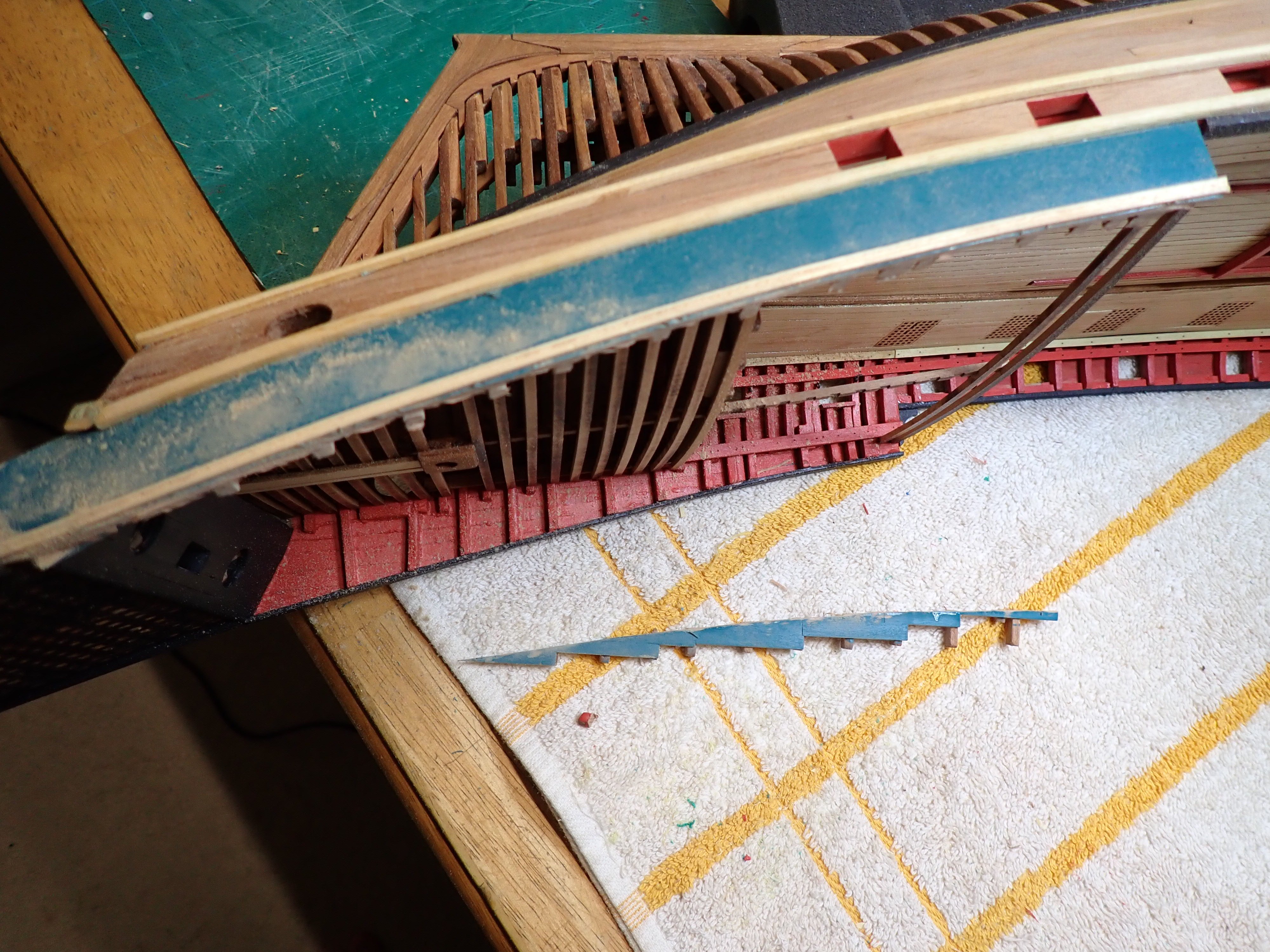

You have to be super careful and hold your Dremel with two hands to prevent an irrecoverable slippage of the cutting disk....
This is it. Now, we have to sand to bring everything to the level of the top strip.
From that point, I will install a flat rail that will be my base for building the decorative railing comprised of freezes and other CNC carved parts. The original ship (and the kit) uses the frames as holders for the railing. My model will not have that. I think I can live with its absence.
A little bit of painting, to make things more elegant:
I kind of like that deep cobalt blue/green. Below is the other side, which has not been butchered yet. You can clearly see that the planking would never align with the elegant curves of the stern.
To make your mouth water and as an appetizer of what to come (it will be a while...), here is what it will look like:
The White Coats have arrived and I must go....
Yves

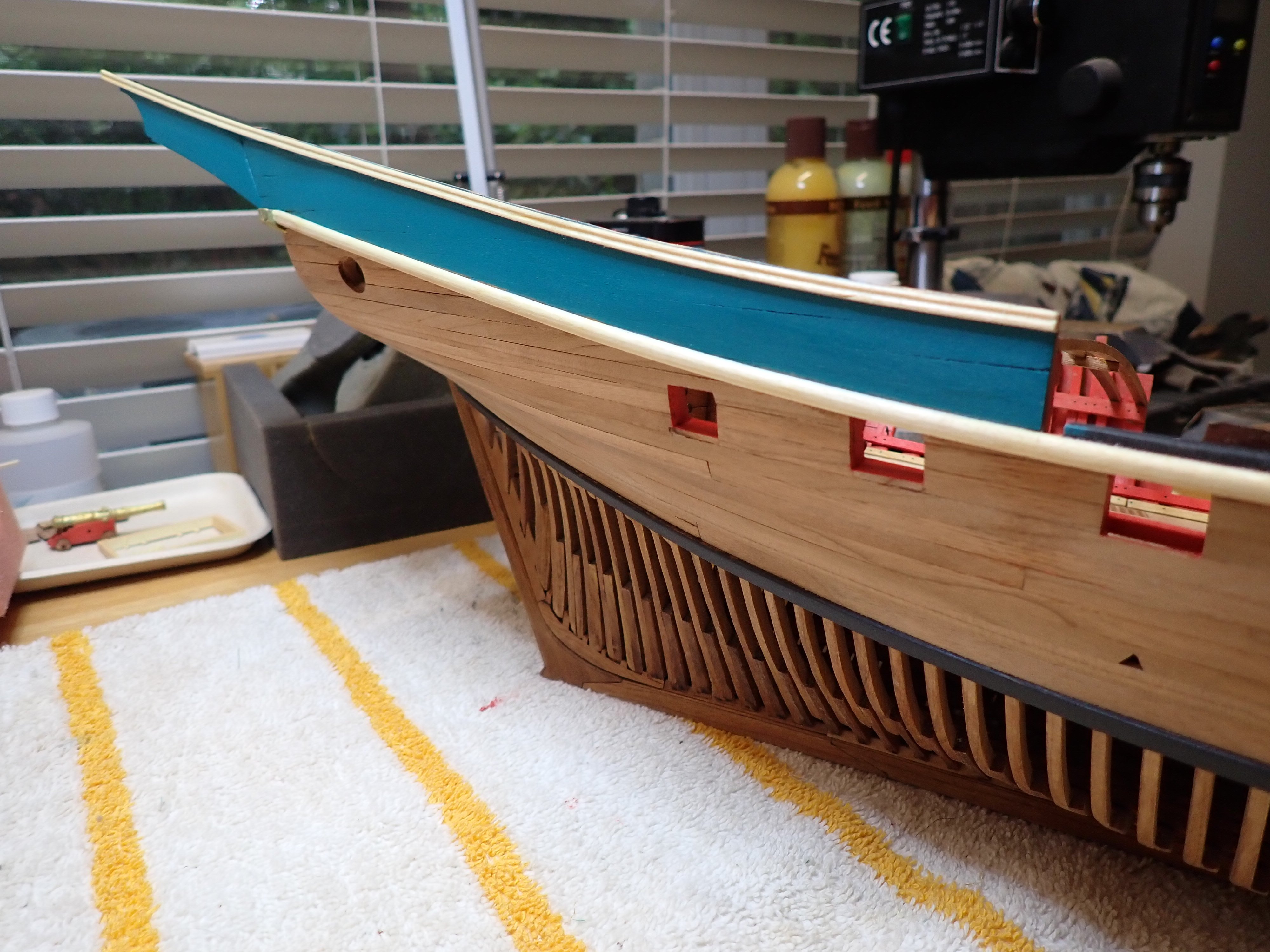

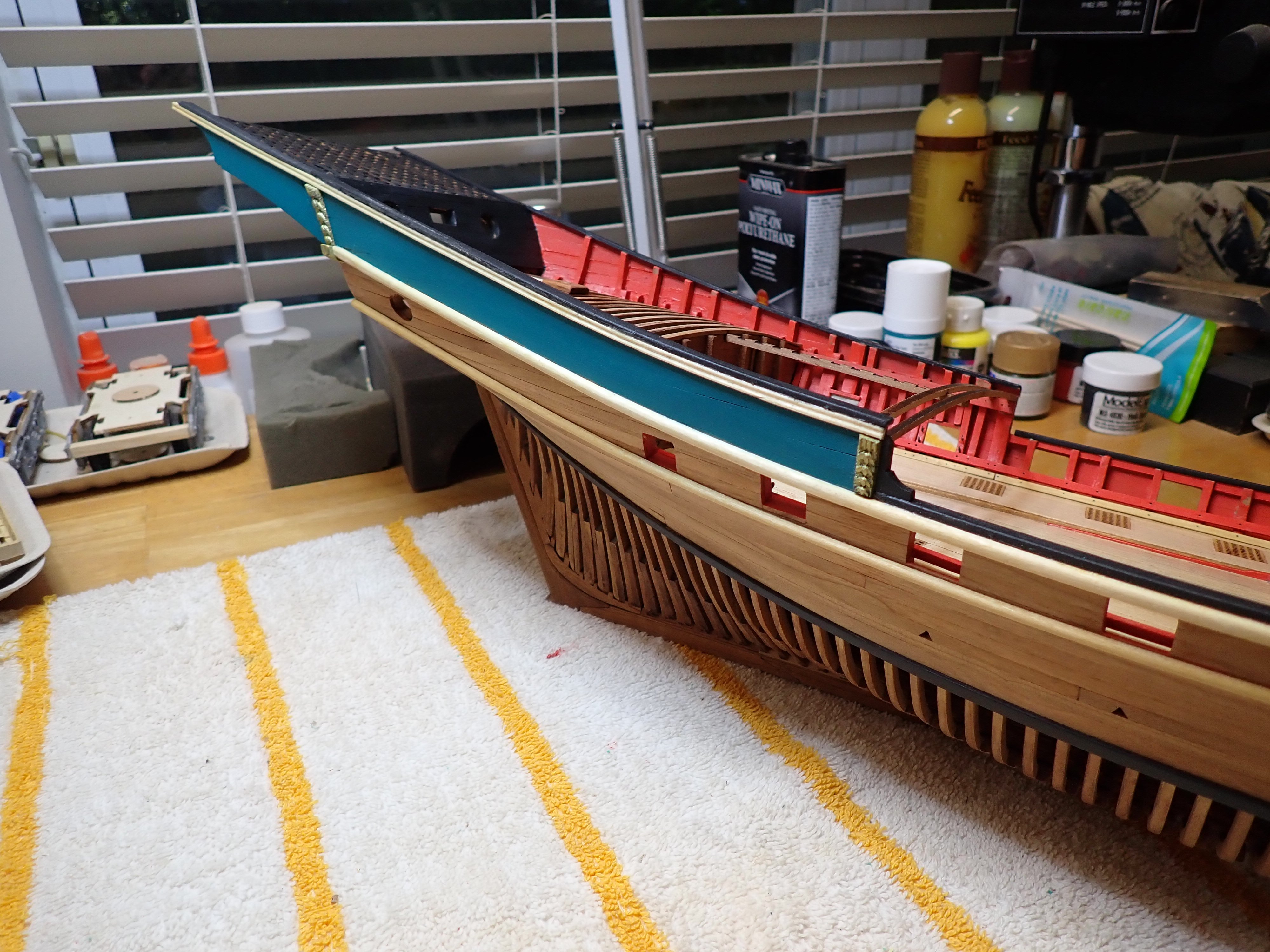

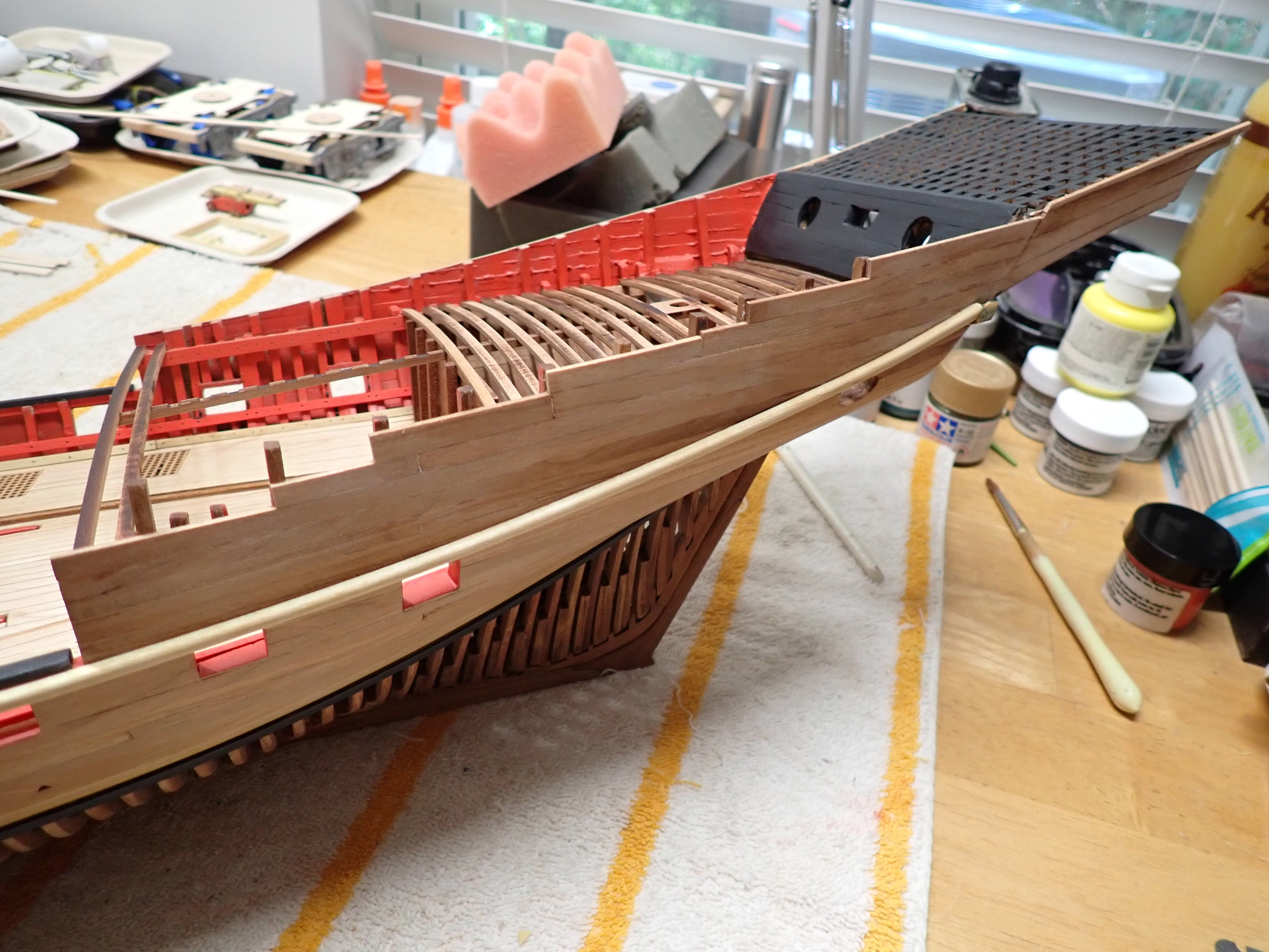

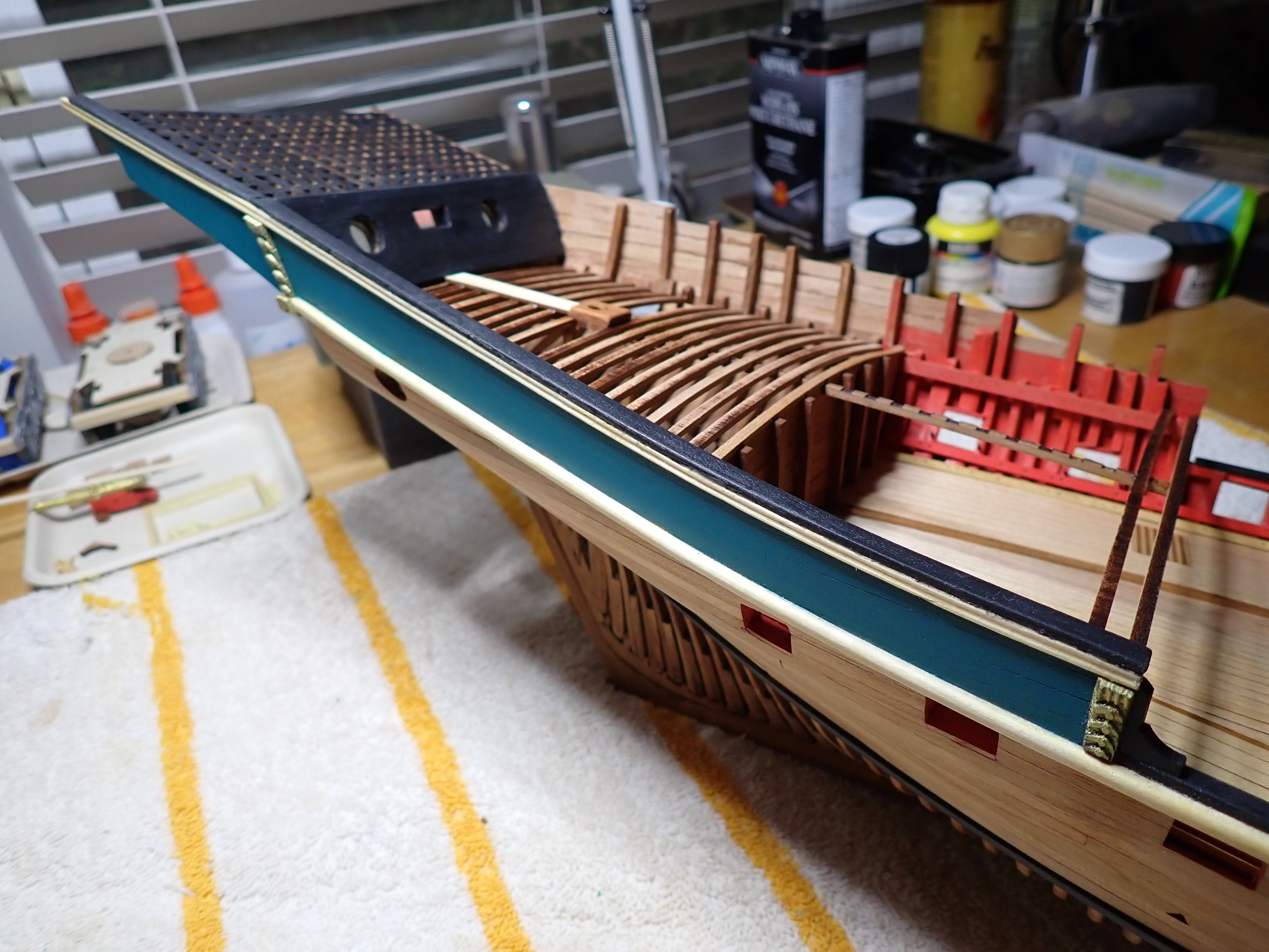

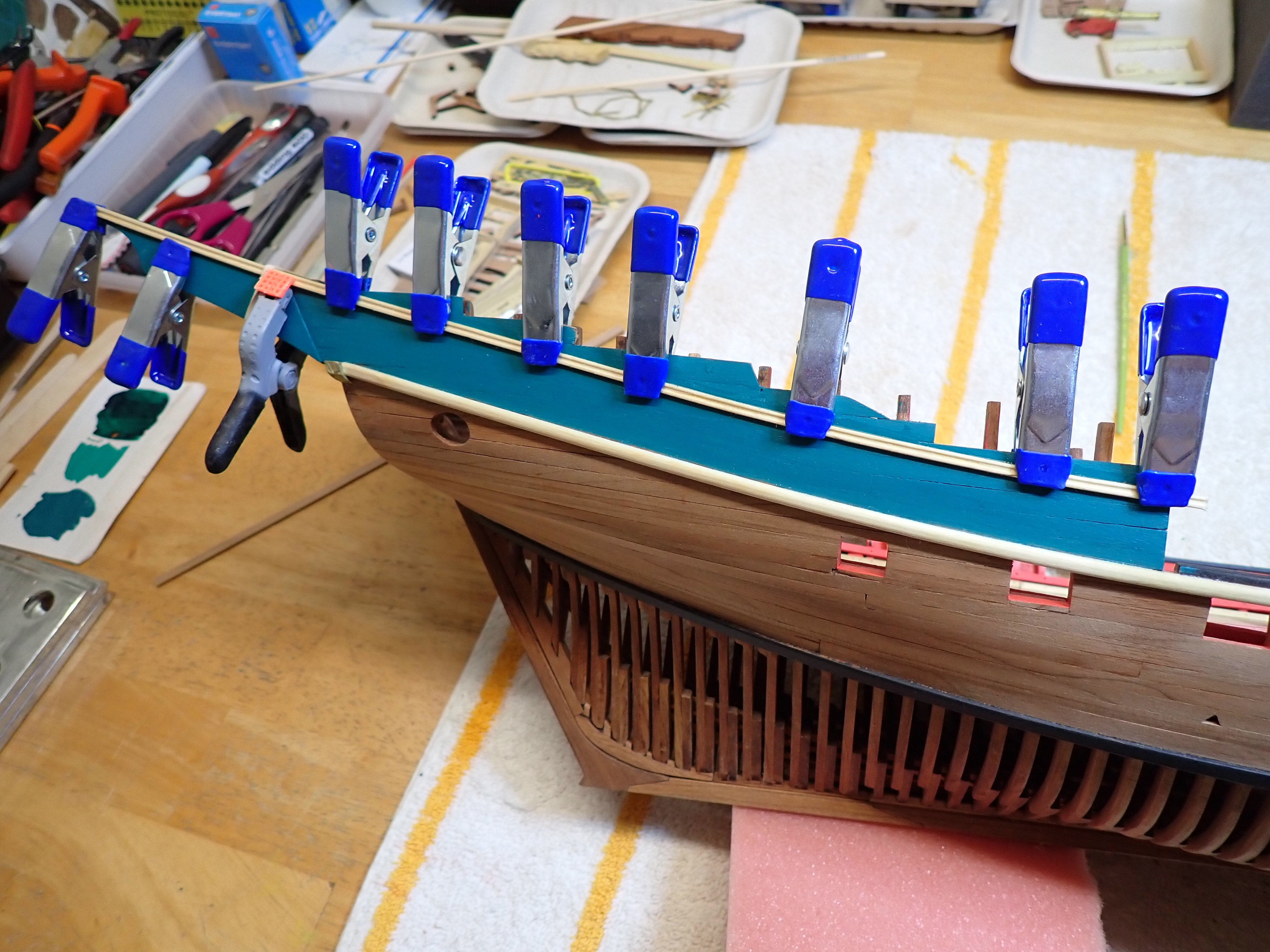

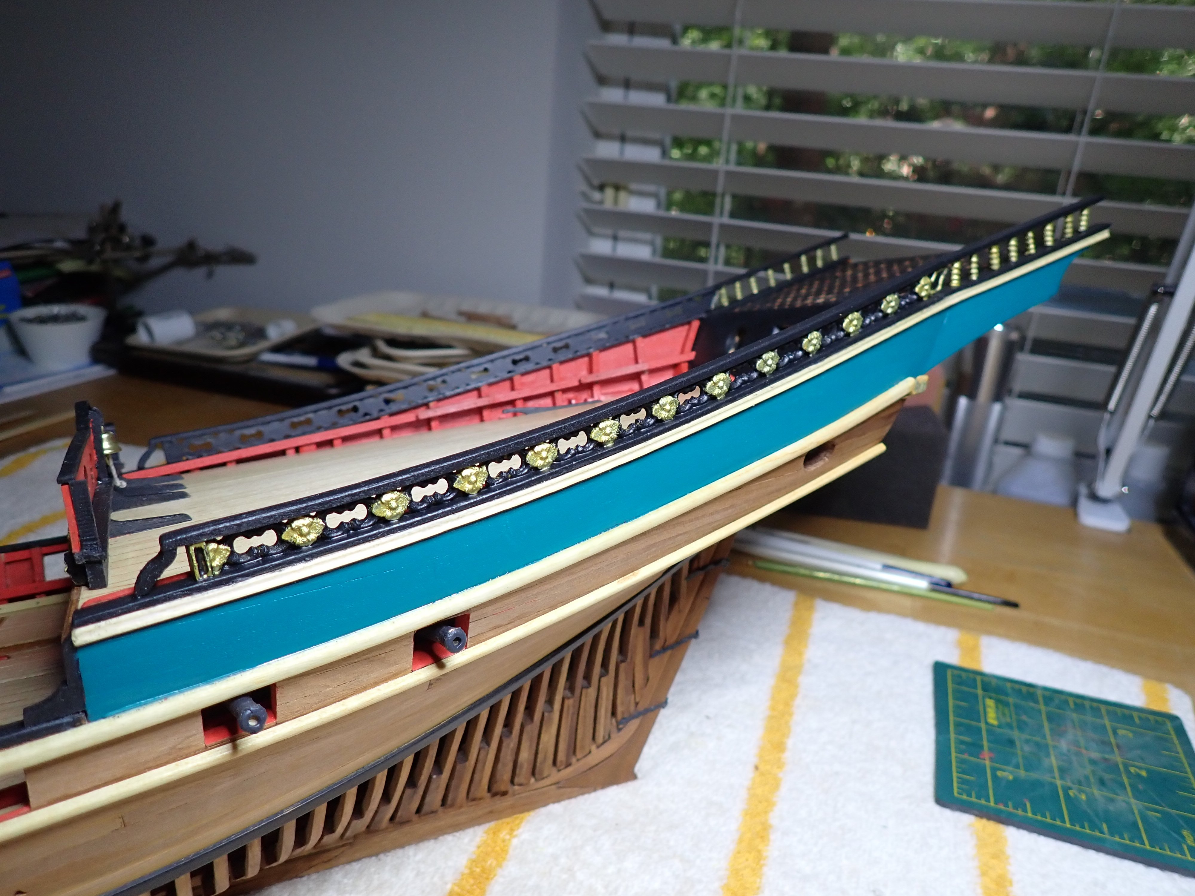

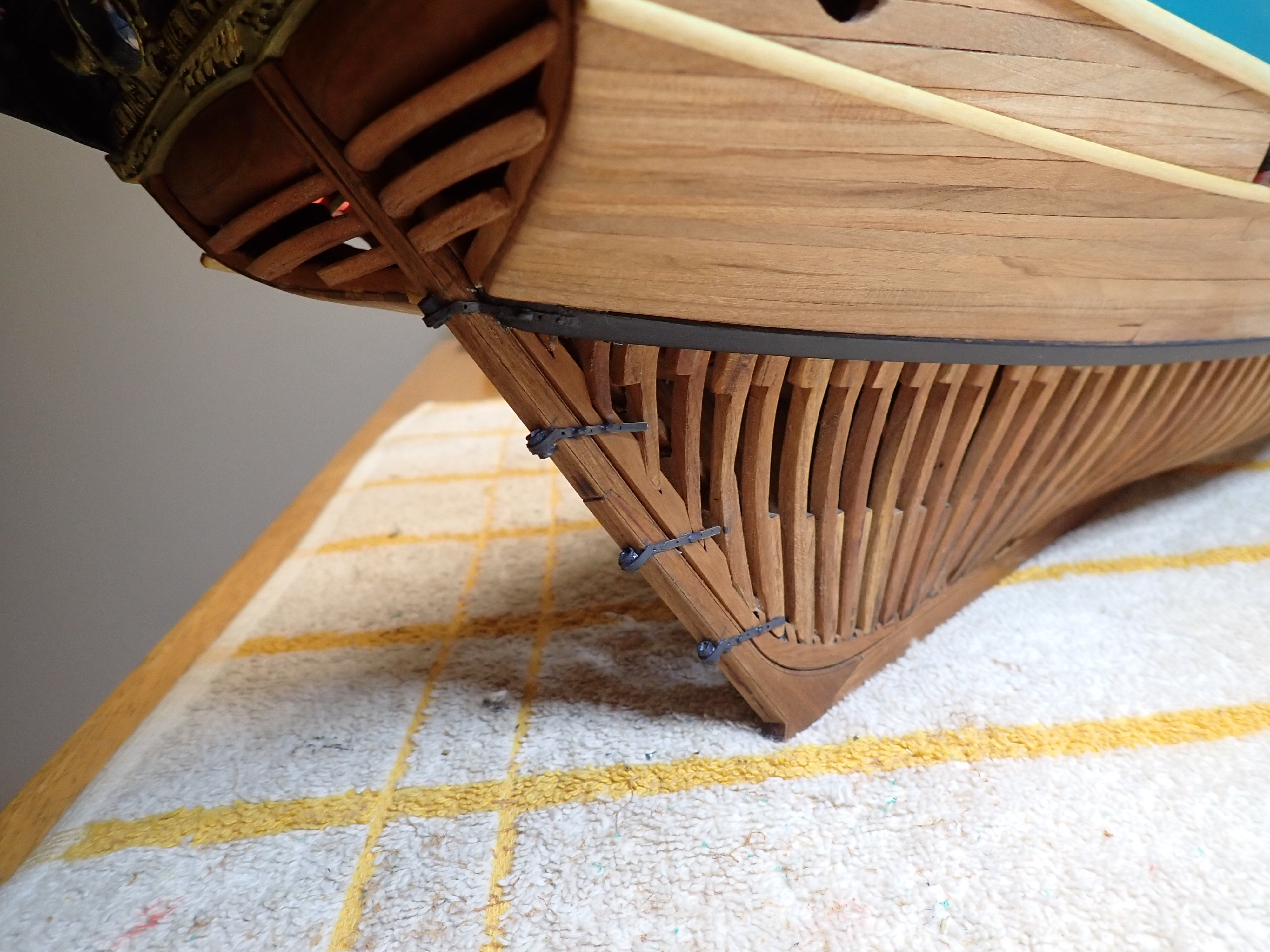

A quick update: I have installed the lower "toe" rail that will be used as a platform for all the ornaments of the railing, around the quarter deck.
This was done with a strip of 6 x 2 mm (not provided in the kit), slightly bent with isopropyl alcohol and left in a jig for a few hours. The strip is pre-painted and then glued in place.
Now, I have to redo the same crazy and dangerous cutting on the port side. In the meantime, I also installed the base of the mizzen mast and started planking two small strips on the deck:
We will revisit the material offered for the planking, but I had to install a Master Plank (in the middle) of 7 mm wide, since the two sets of planks provided in the kit are not covering the entire deck. It is missing about 8 mm in the center and I used some left over wood to create that Master Plank.
Anyway, at that point, I cannot move forward with the planking yet, as I need to install the guns under the deck. And before installing the guns, I need to finish all the rails on the hull. Therefore, It will be a while before we plank.

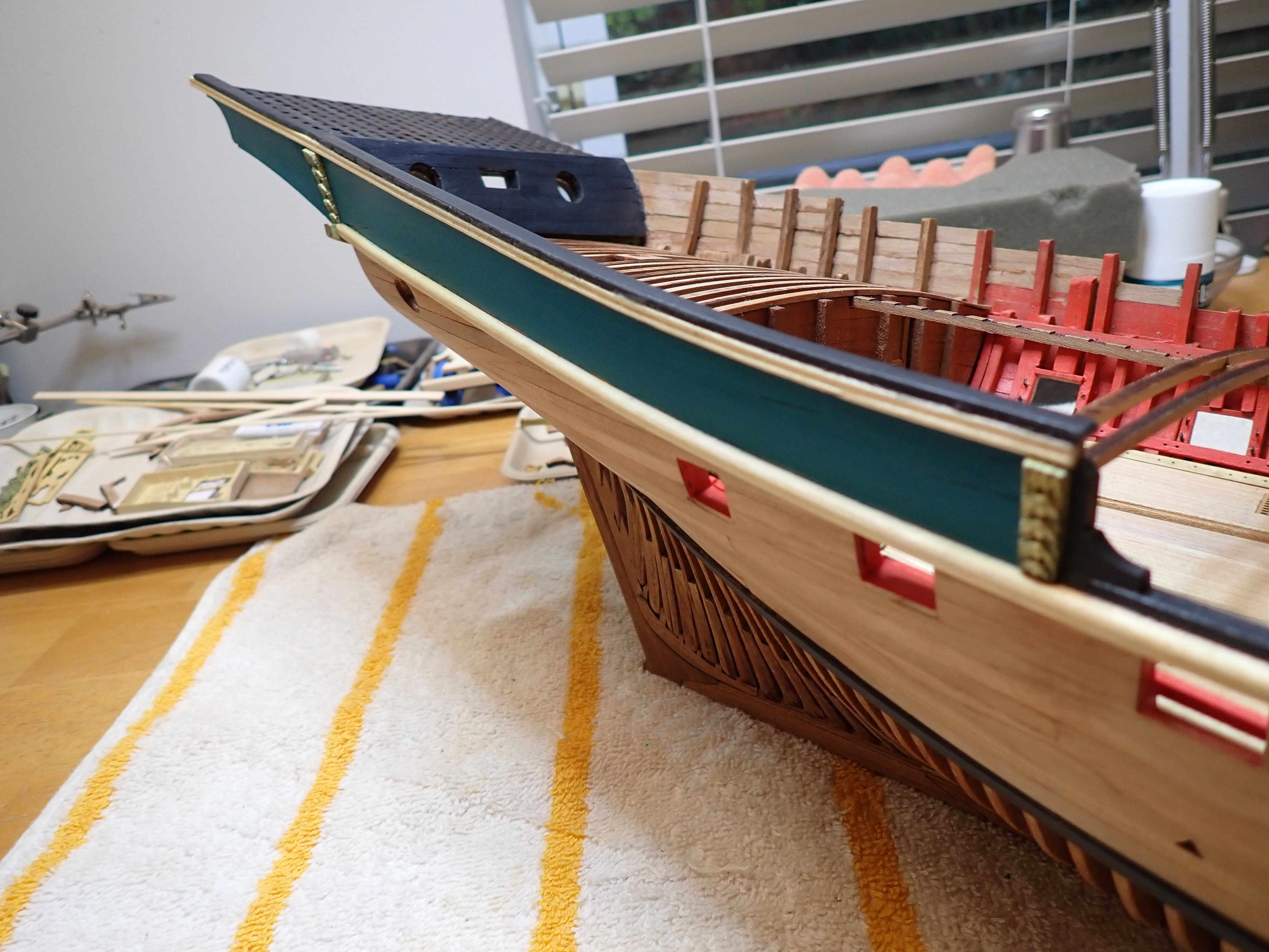

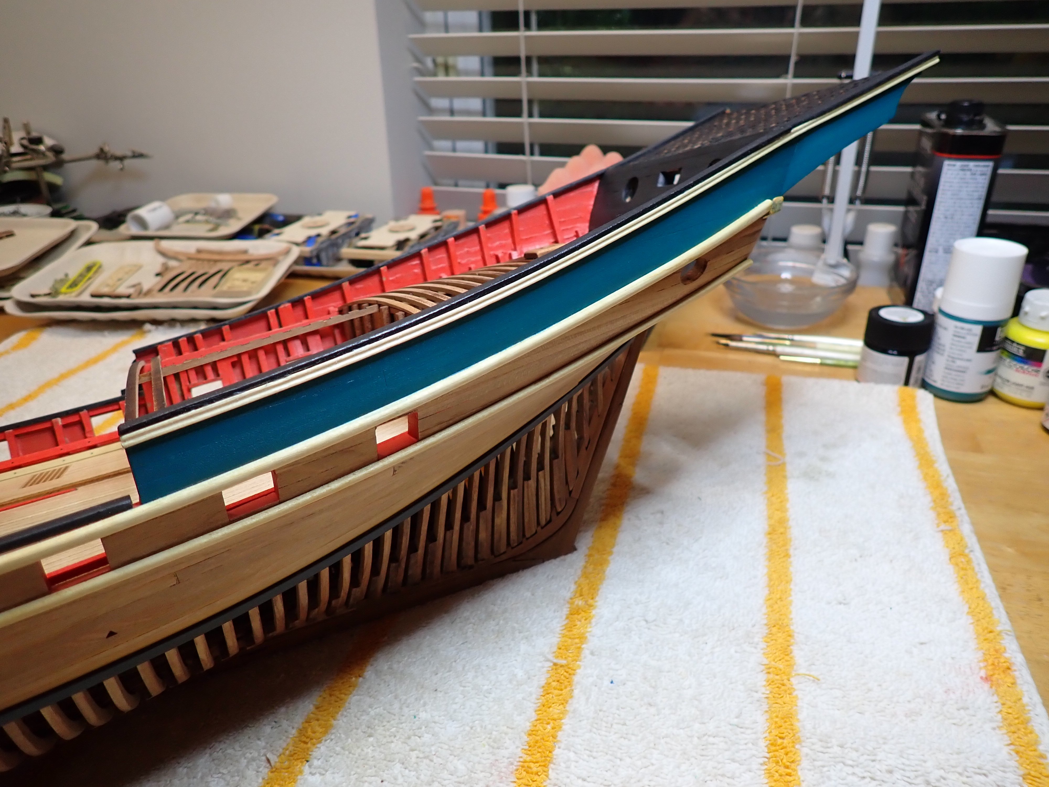

The Port side has been completed as well. During the dangerous cutting phase.....
And finally, after a lot of sanding, bending and gluing:
I have also added the strip under the gun ports.

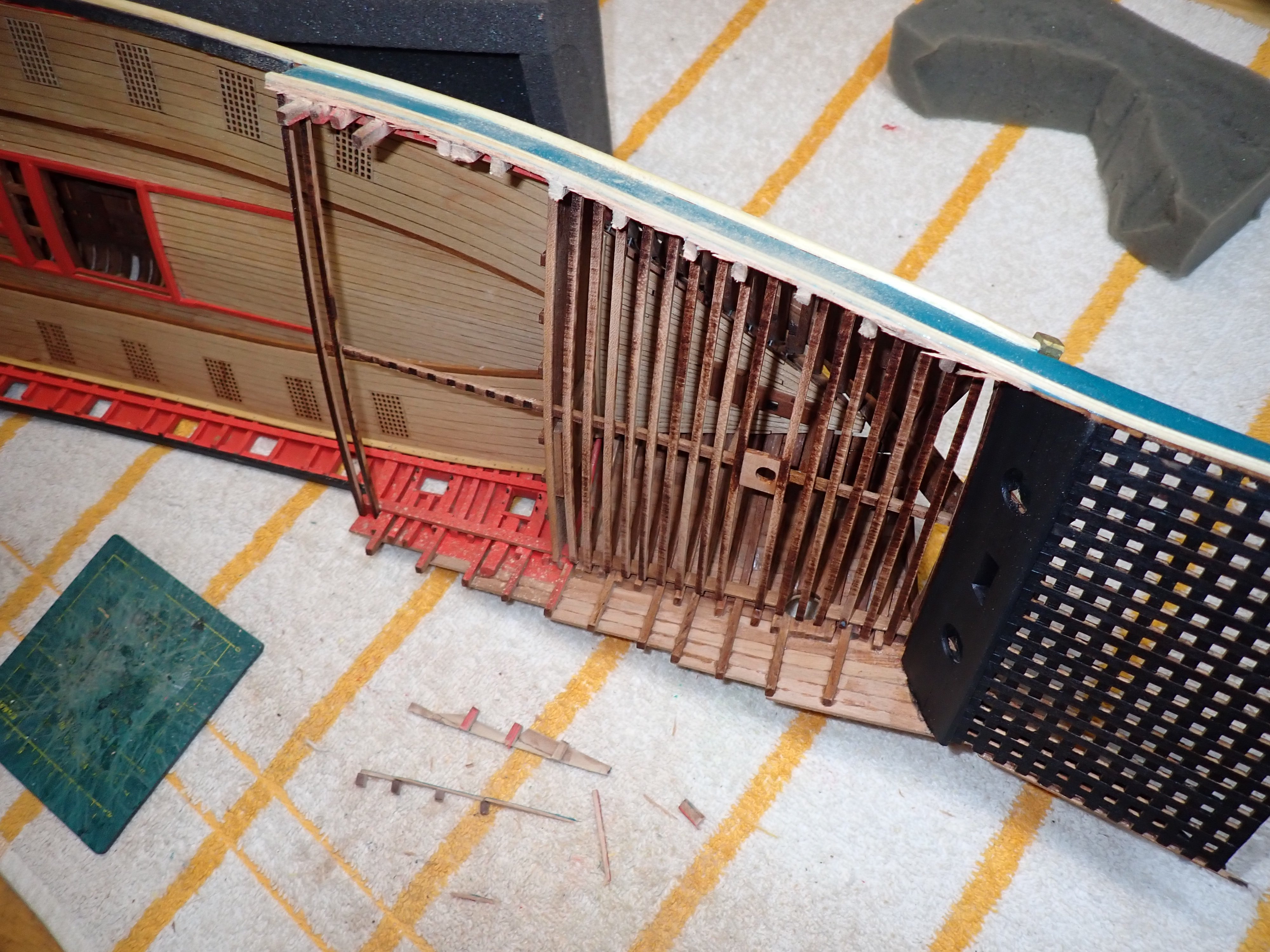

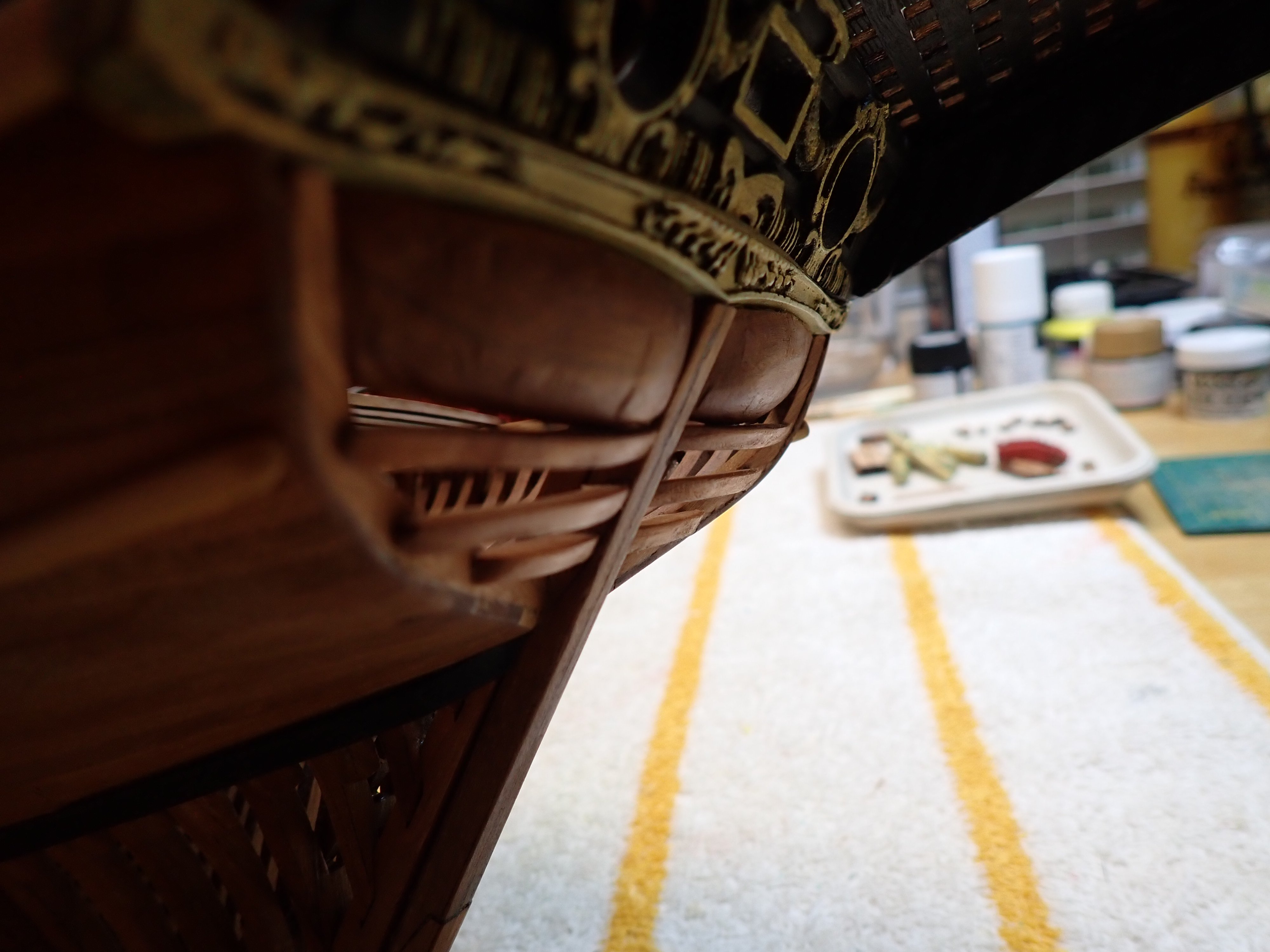

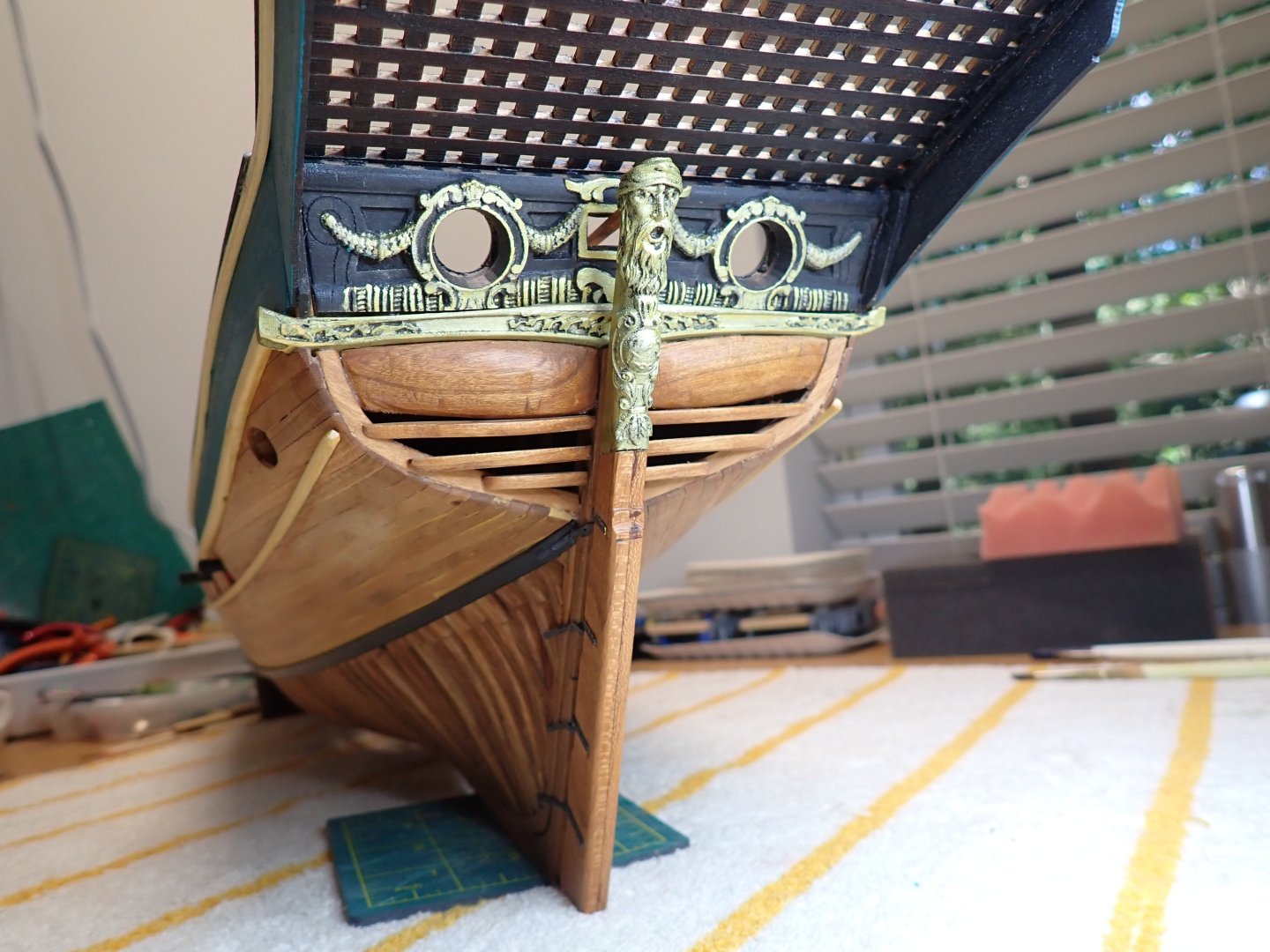

I need to complete the stern framing. I would recommend leaving it open until you have reached that stage, as this open space is very convenient for clamping parts.
Yves
Stern has been completed, finally. This phase belongs in fact to Phase 1, but I would recommend to not assemble it until your hull is completed. The opening provided by the stern are so helpful when clamping planking and other parts.

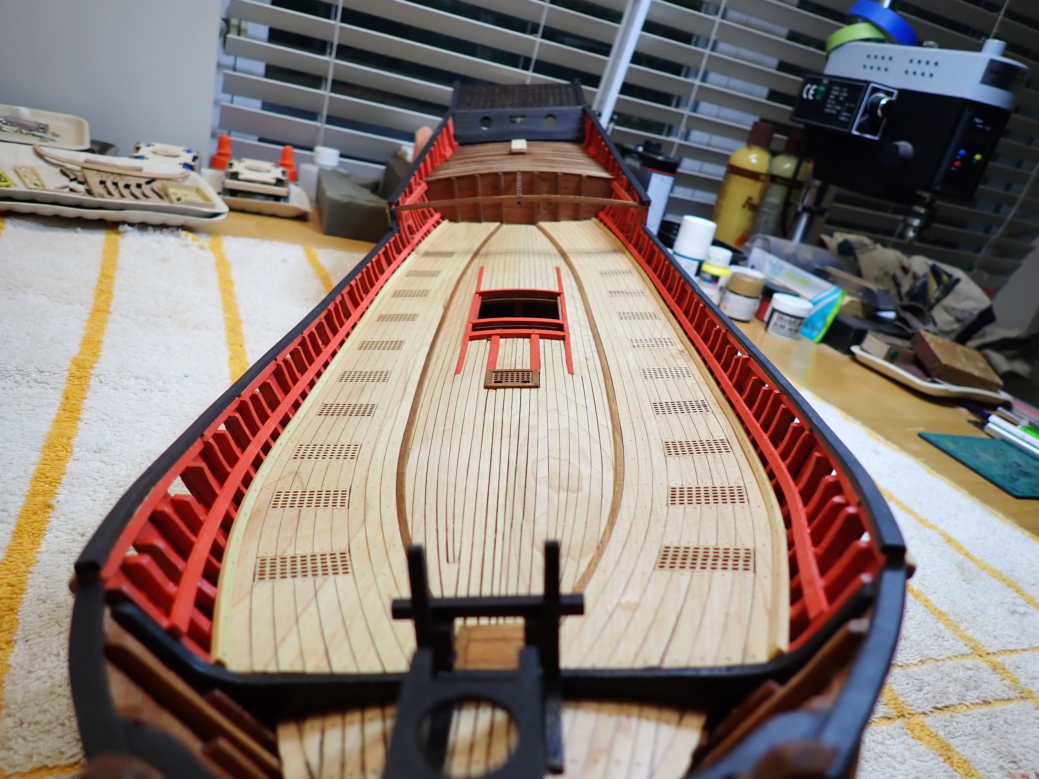

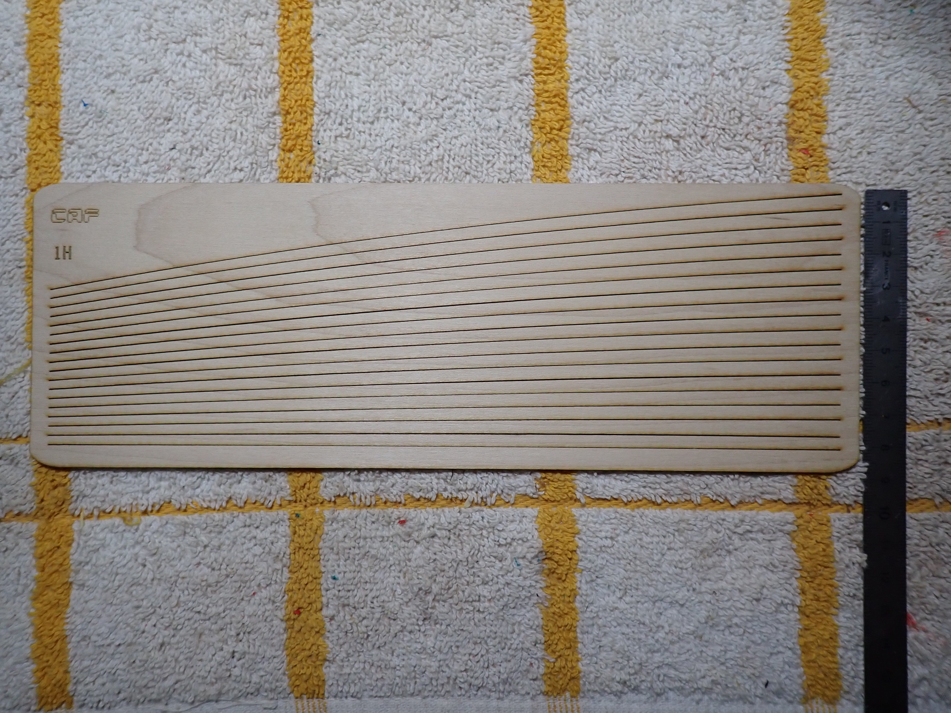

I just started the planking, using the nice maple pre-cut planks, provided in the kit. From the instructions below, you can see that I have derived from the recommended directions, once more.
As mentioned, the planking is too small (not wide enough) as provided in the kit. I used a wider master plank of 8 mm wide to go in the middle:
Proper alignment is done using additional side planks. You want that master plank to be perfect in the center.
And then, it is the slow process of gluing one plank at a time.... until we come to the entire half:
Now, I have to do the other side, which will not so easy since I cannot use the open space for my clamps. Quick CA will have to come to the rescue.

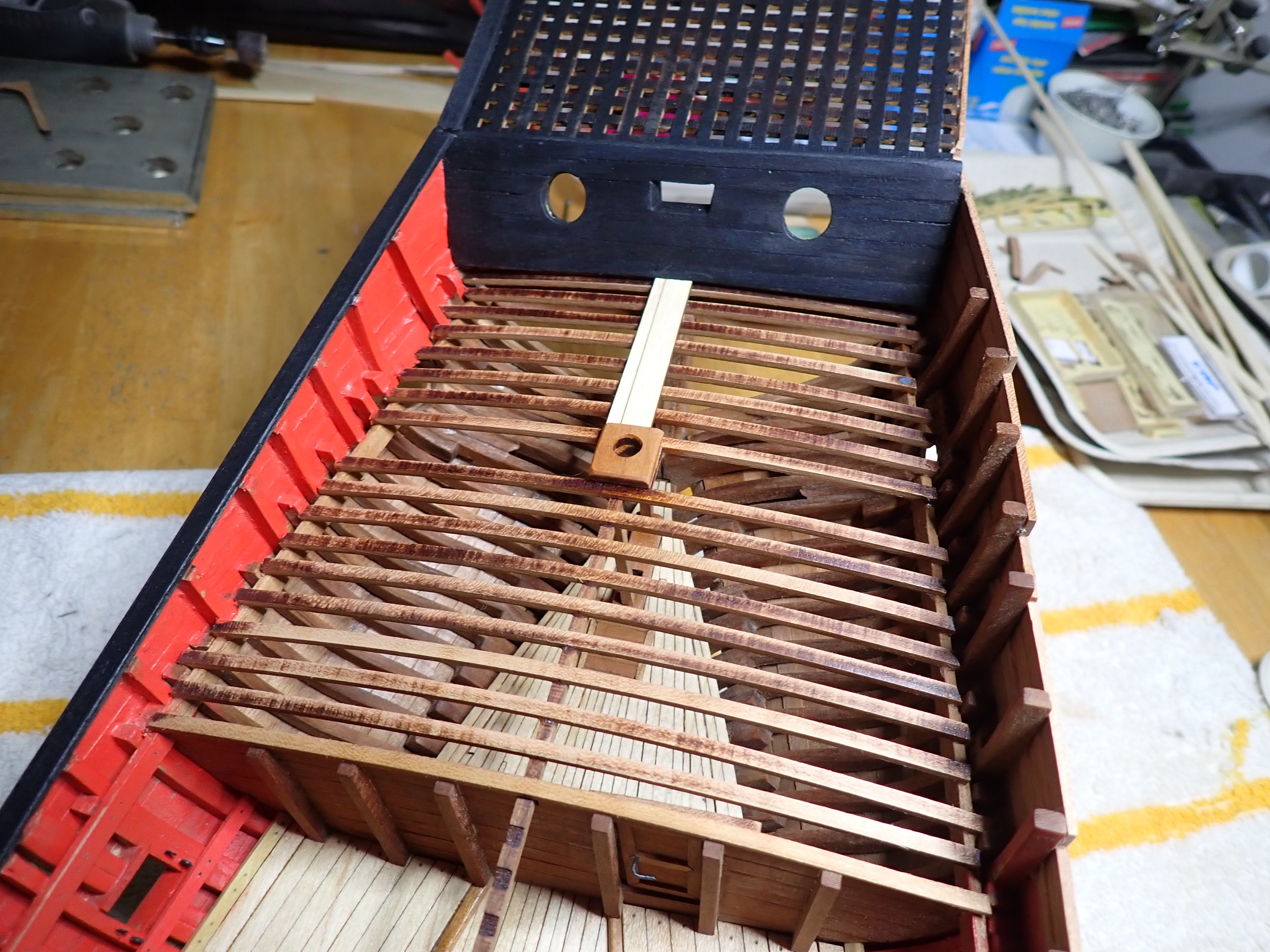

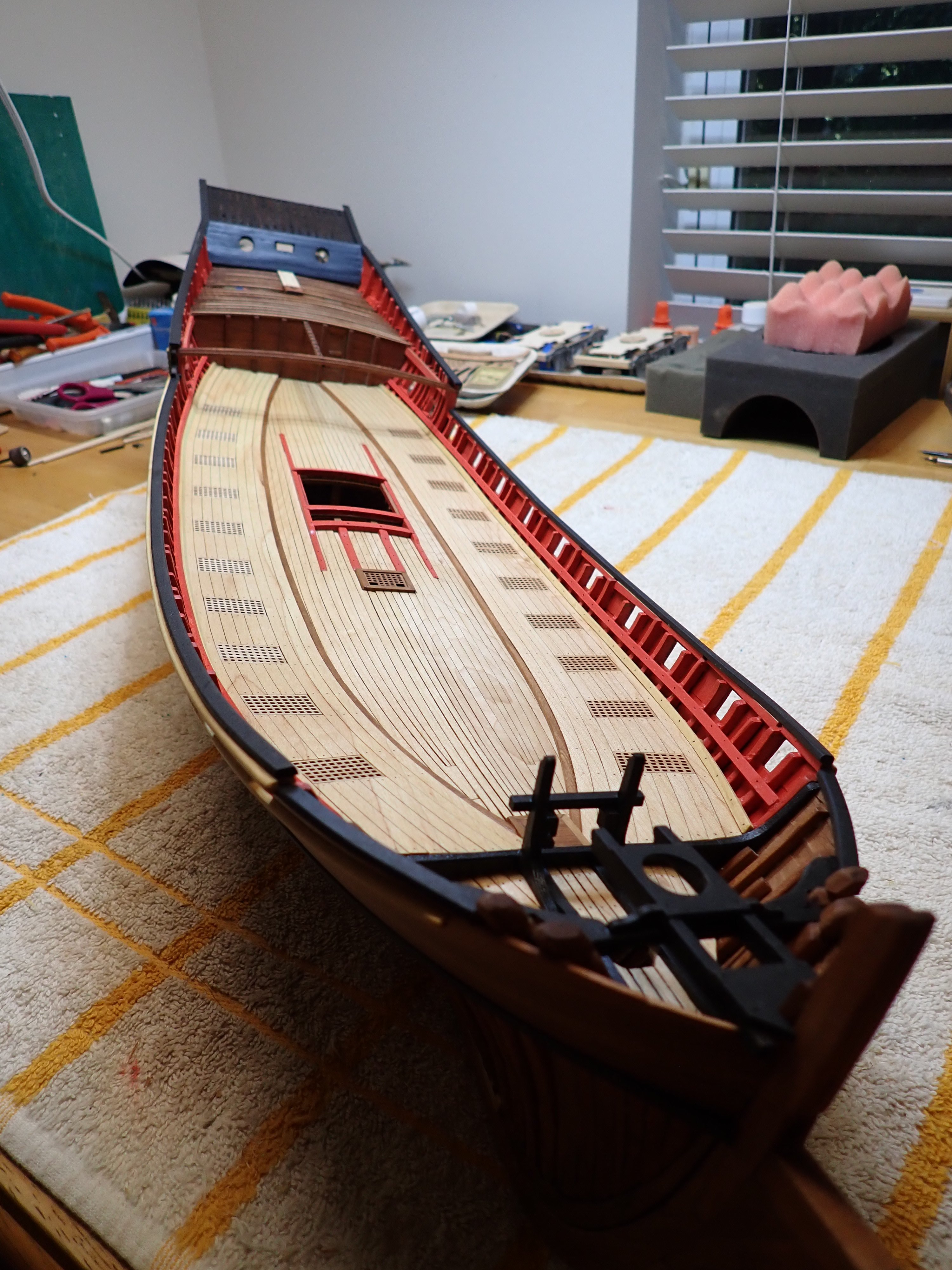

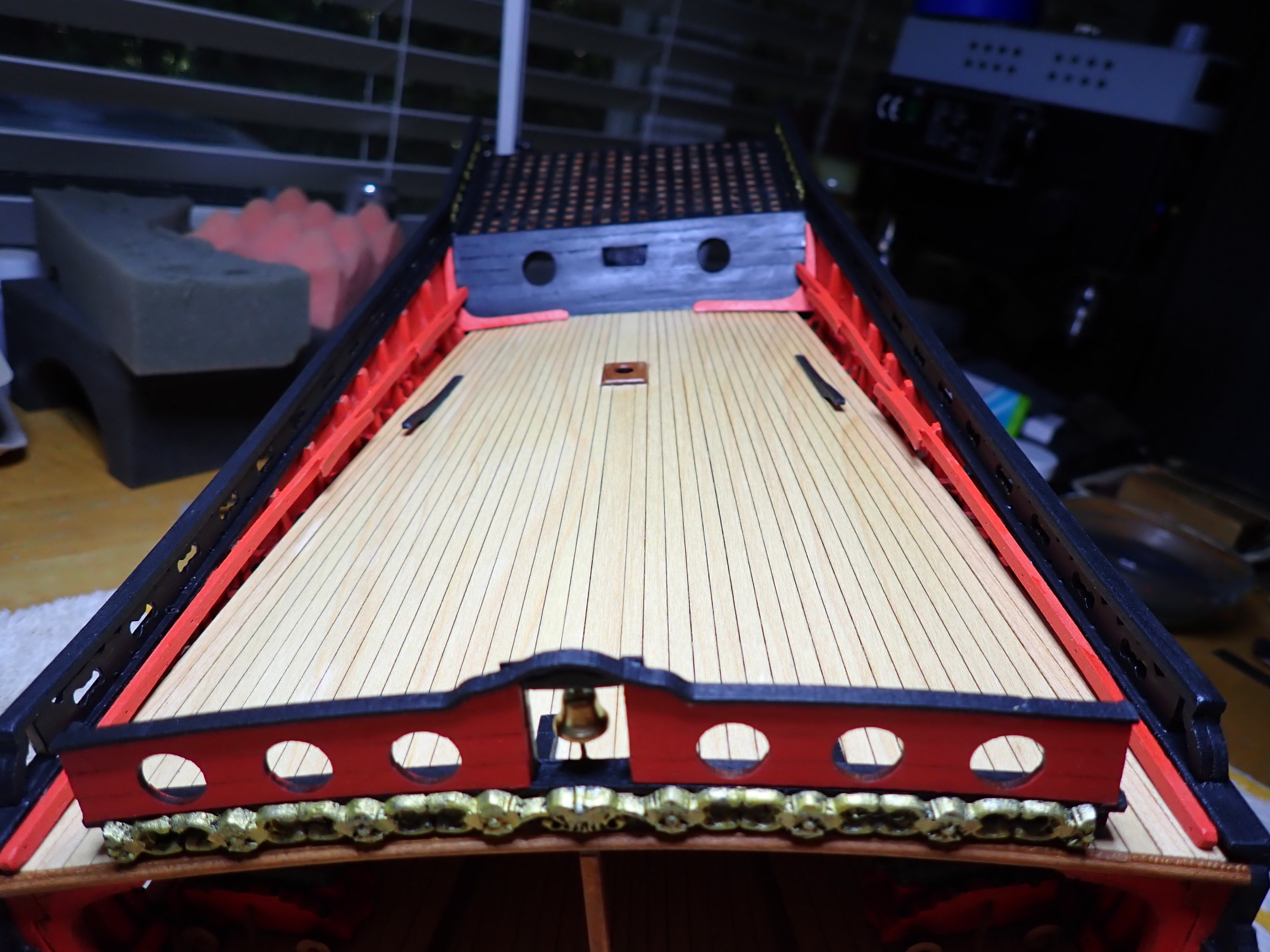

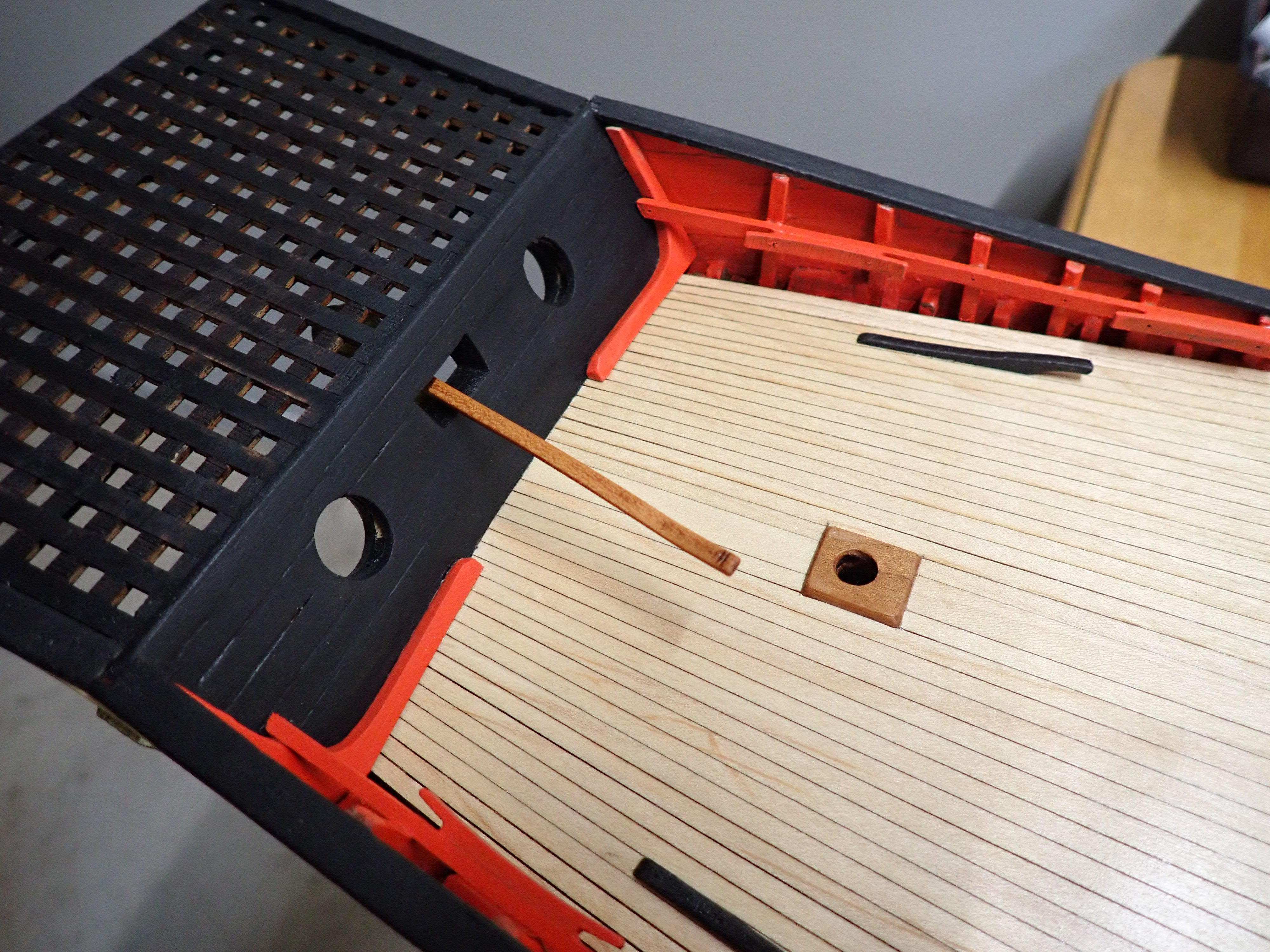

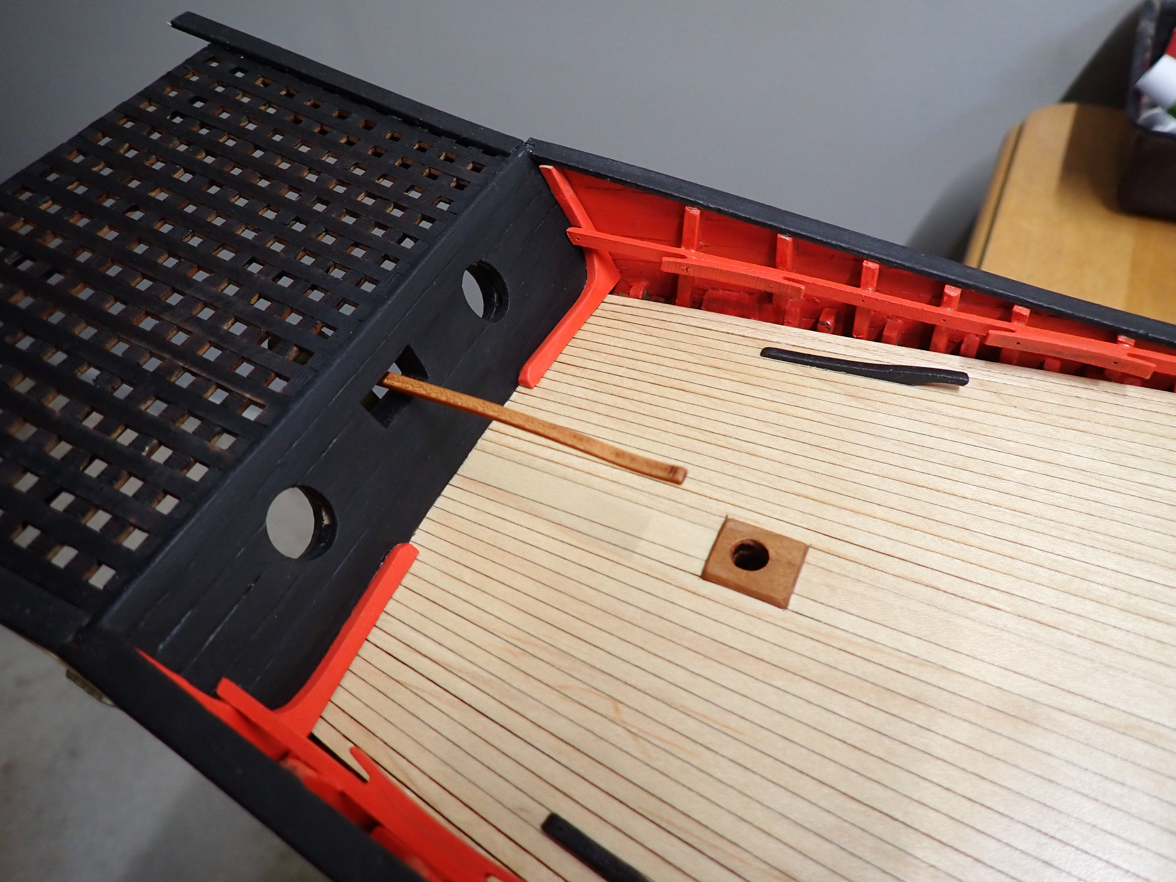

Finally, planking of the rear quarter deck is completed: 38 + 1 planks, total.
After a fine sanding and a good vacuuming, the deck can be protected with a few coats of Wipe On Poly: You can see how the color changes....
Now is the time to finish some details on the rear deck.
Yves

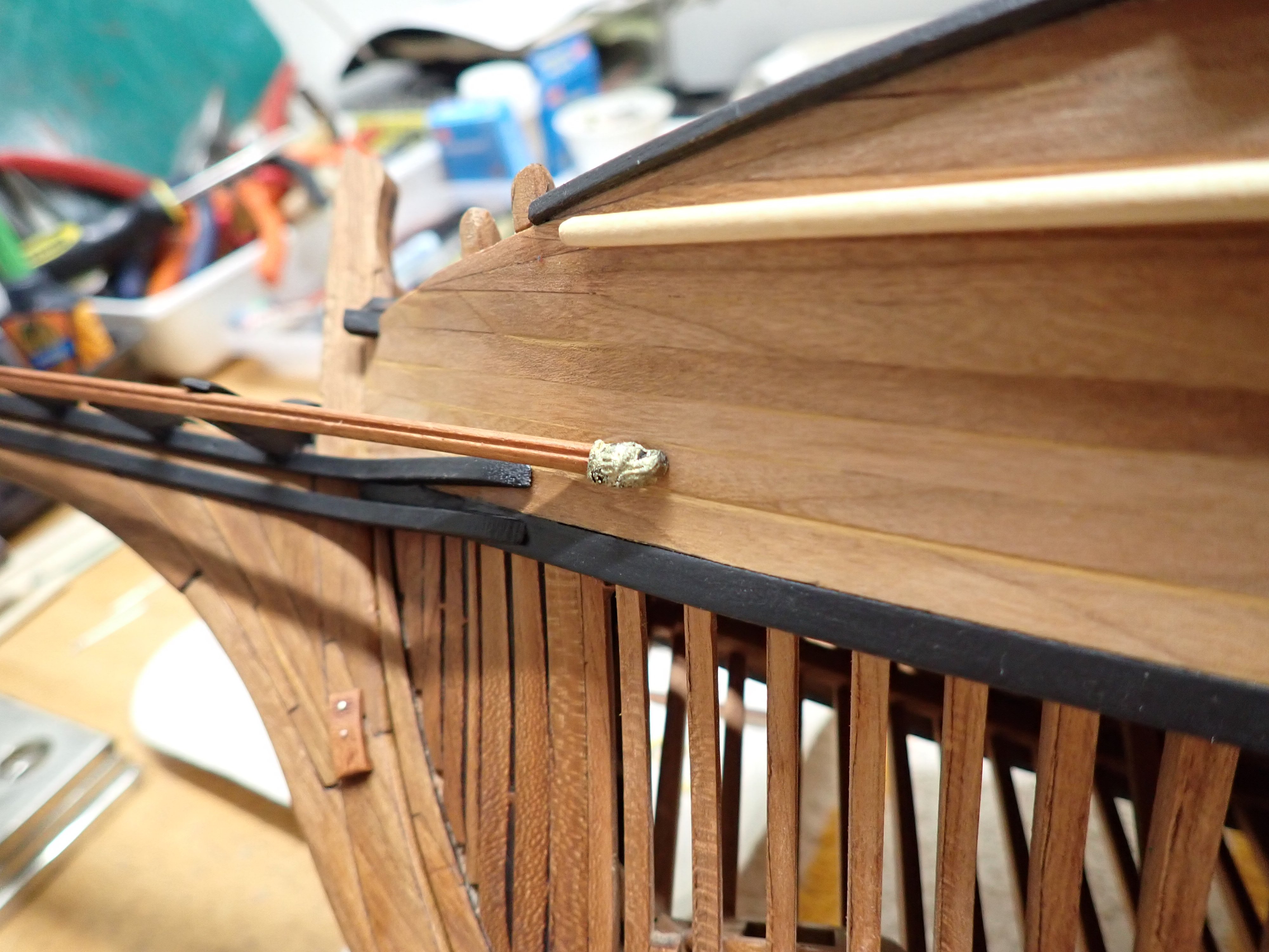

A few progress on the rear quarter deck. Rather delicate assembly due to the dry and thin wood:
The first step is to glue the decorative railing in the front of the planking. 2 x 3 mm soaked in alcohol and left bending on a jig:
Installation of the stiffeners under the deck:
Following the instructions.... all parts are pre-painted, of course:
A little bell to attract the attention of the crew:

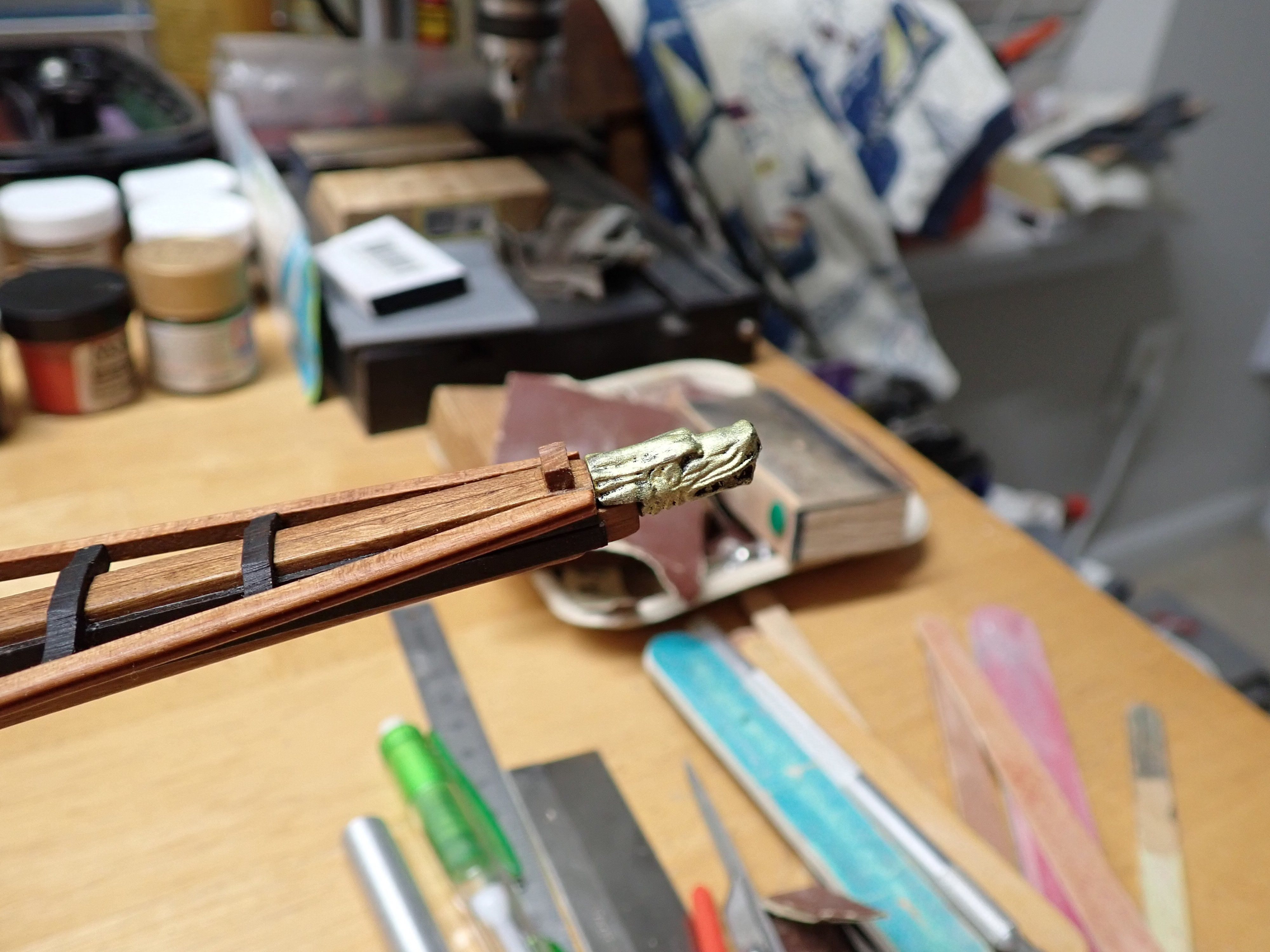

The kit does not provide the end pieces of the freeze. I will have to think about something.....
Overall view:
Yves

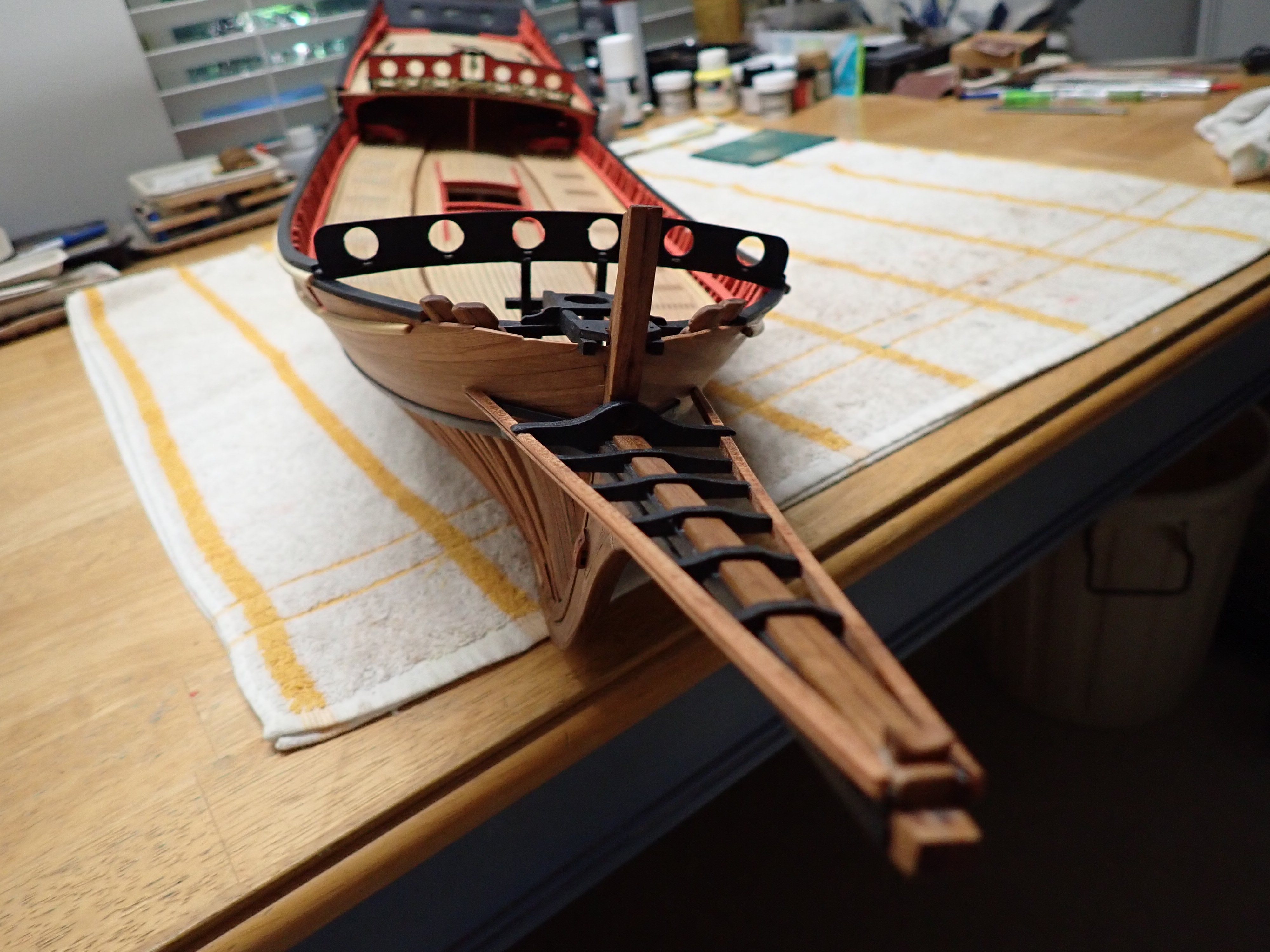

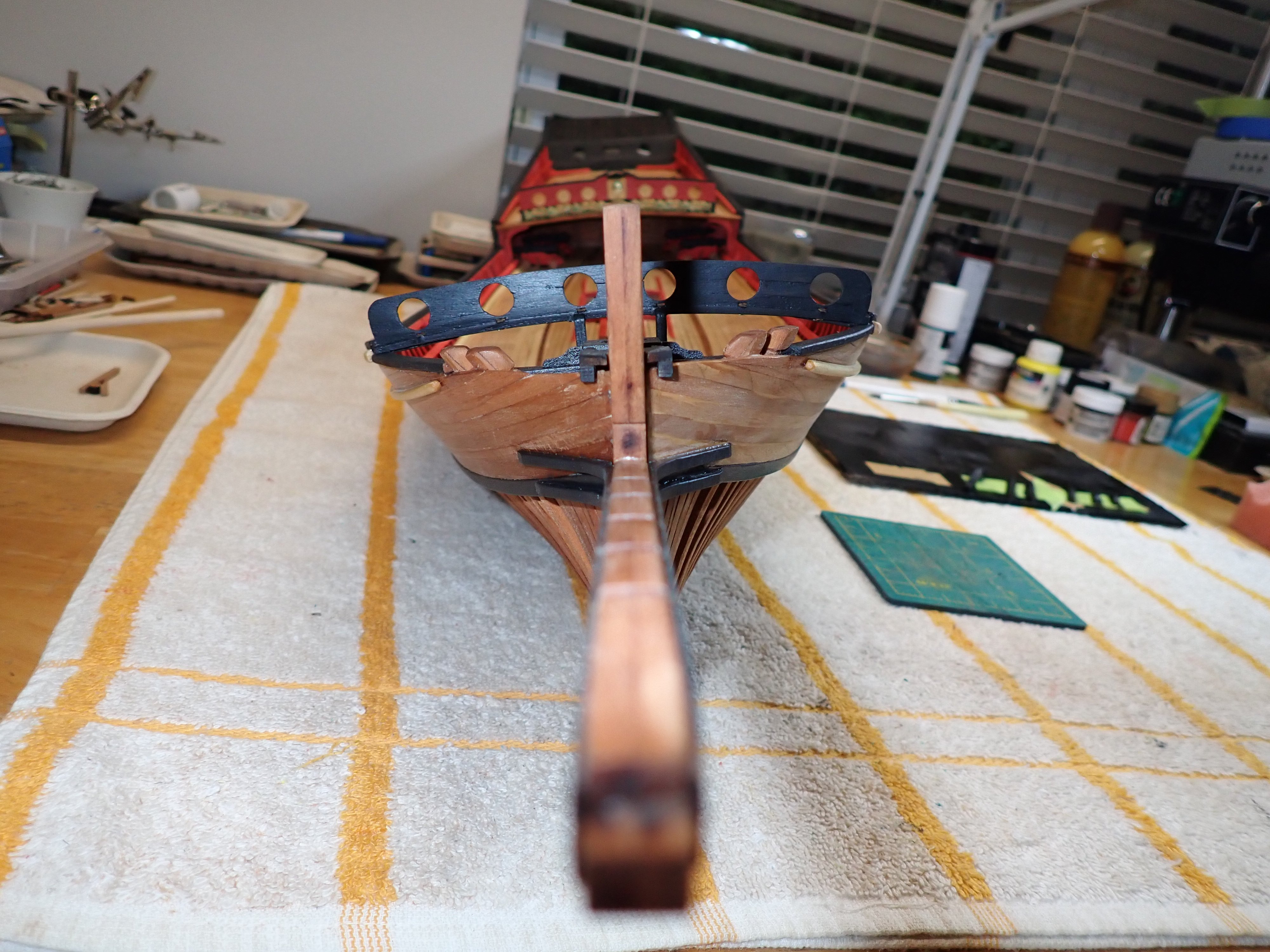

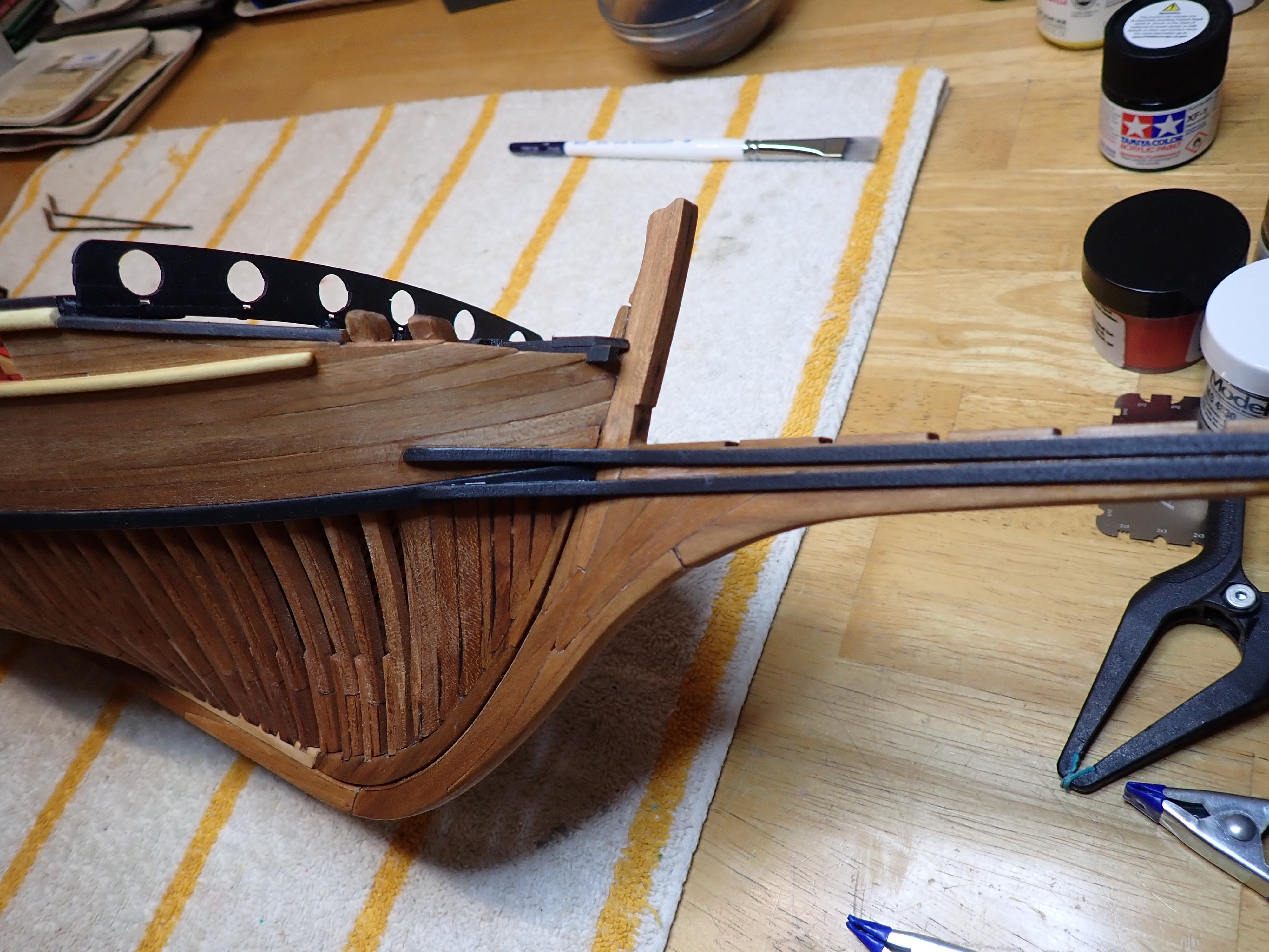

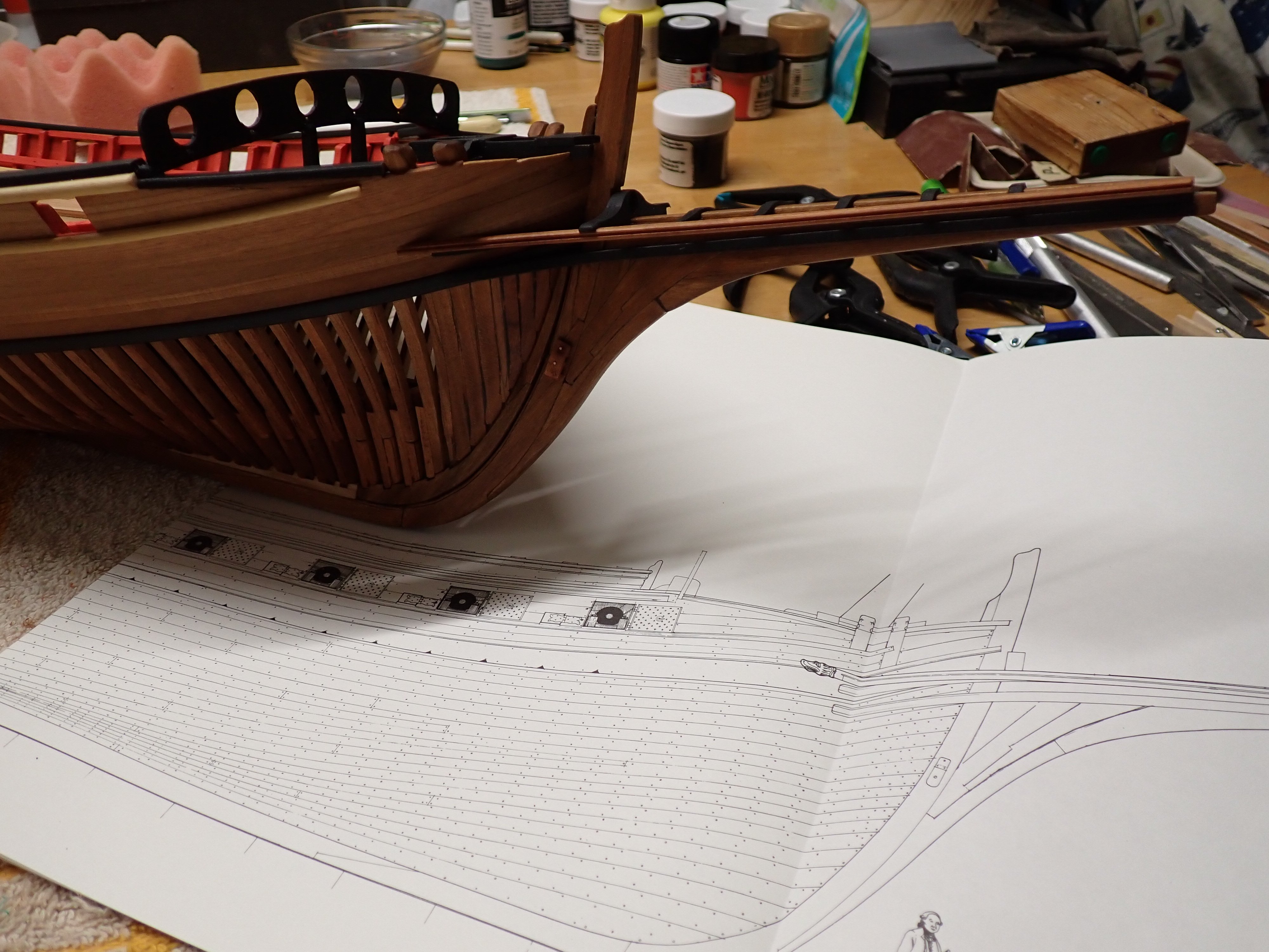

Moving our attention to the bow. For Javelin, a few more round holes....
Each hole has a tiny PE part located at the bottom, and used as a holder for a portable cannon. The hand held cannons are not part of the kit, but I have seen some models with them.
I really like the intricacies of that bow, with its tilted mast. It makes for a rather interesting and unusual section of the ship.
And the overall view....
Yves
Edited by yvesvidal

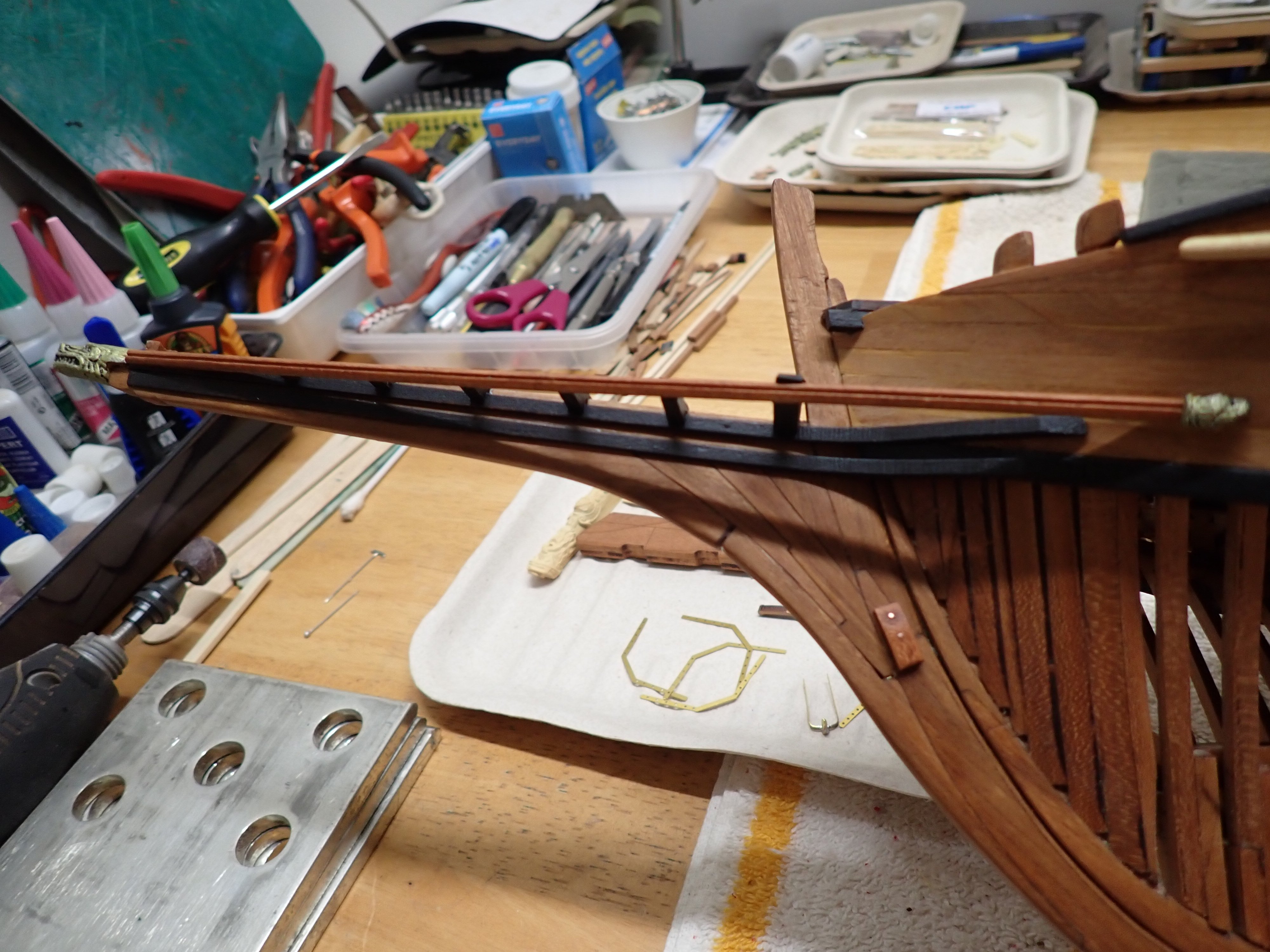

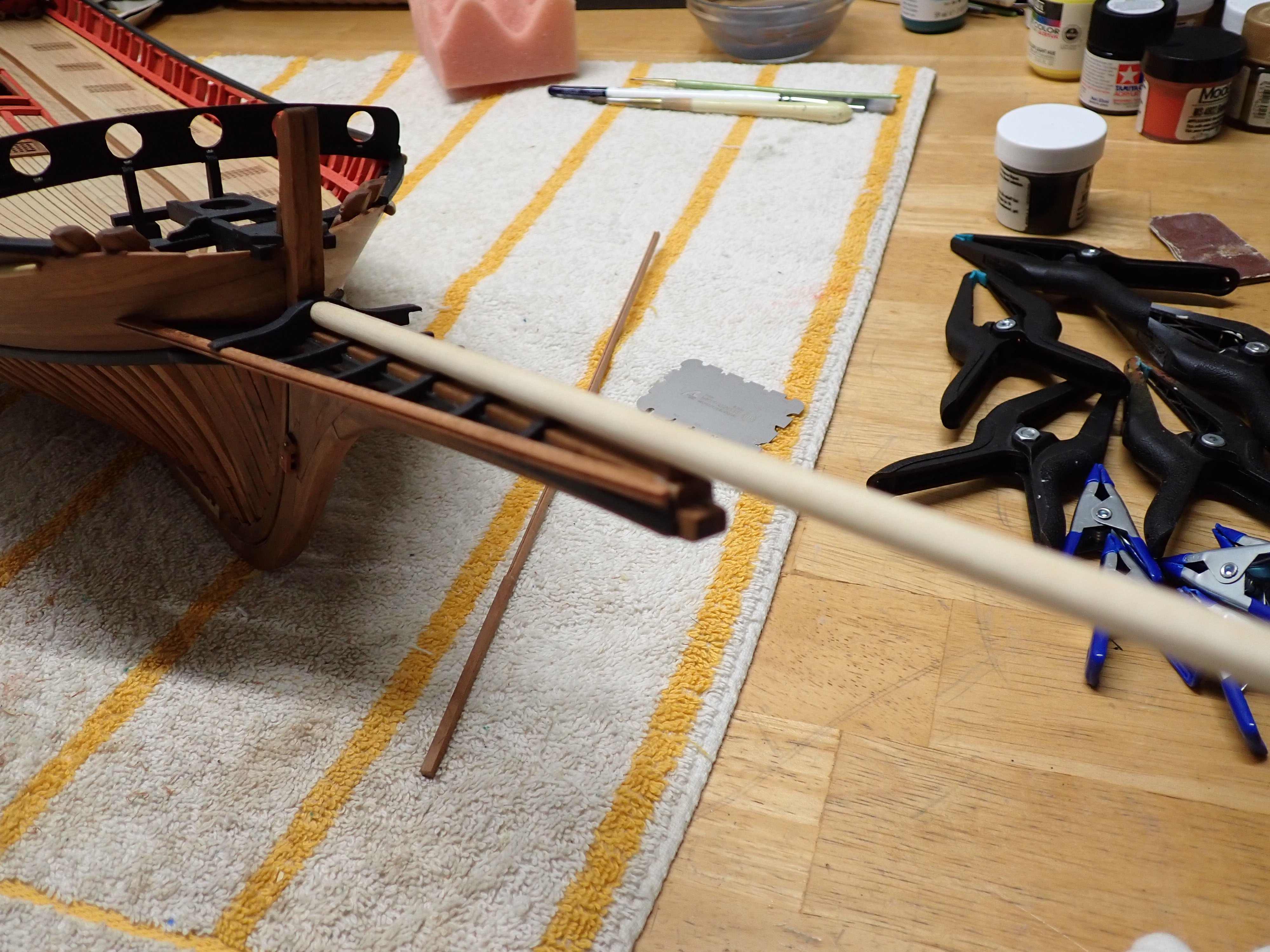

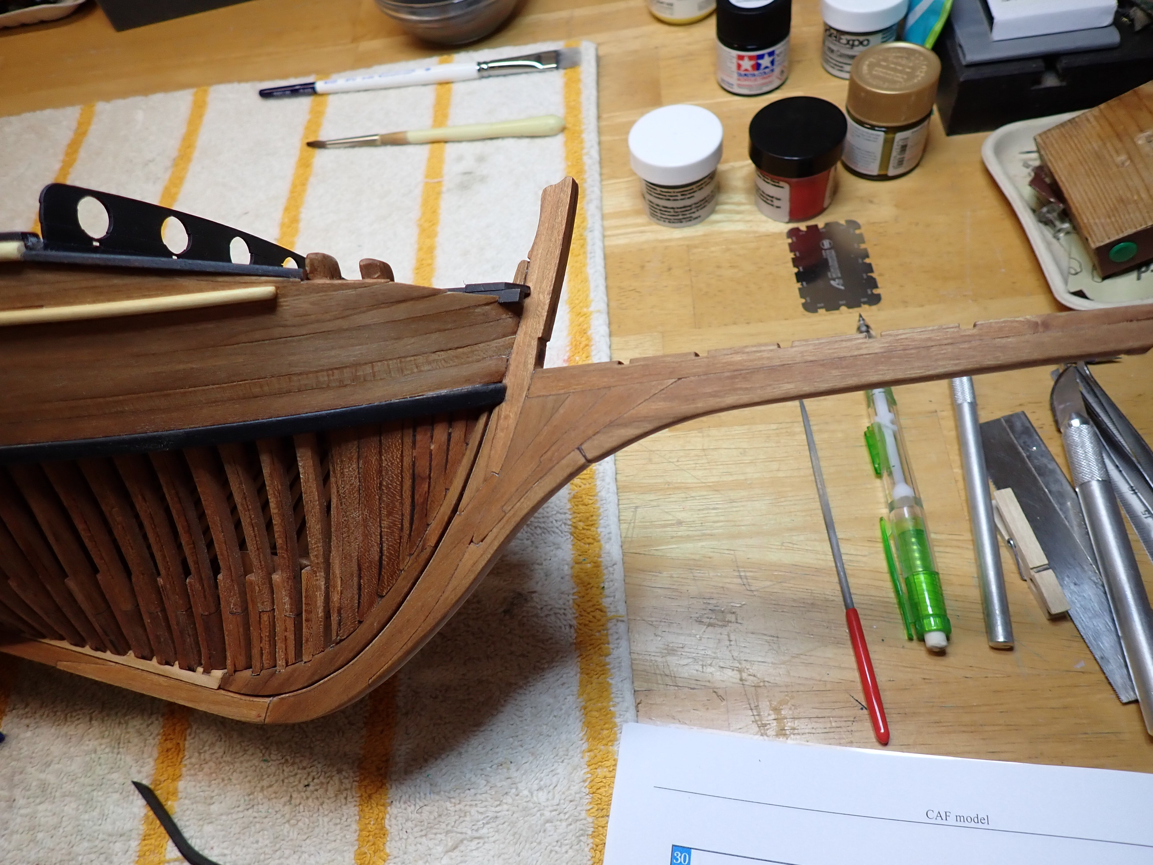

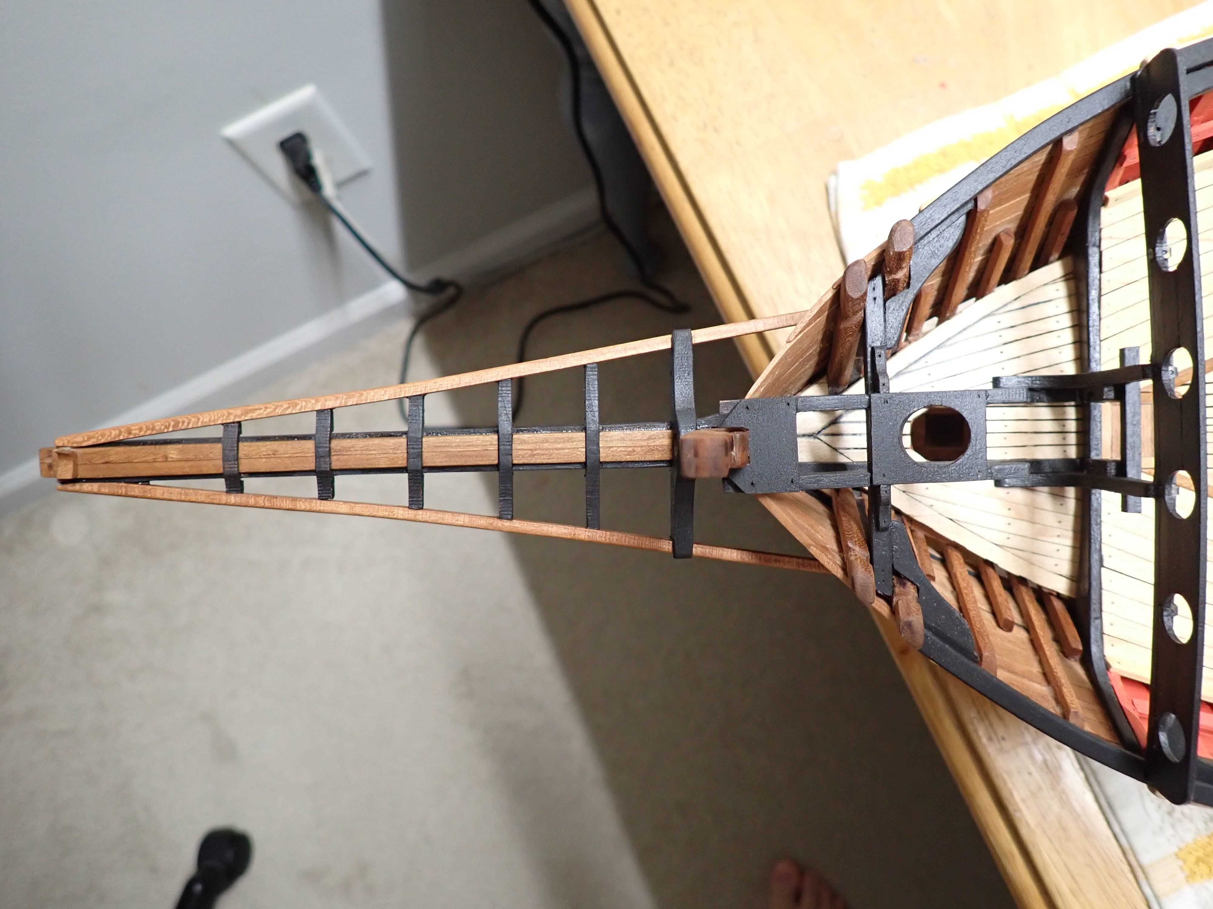

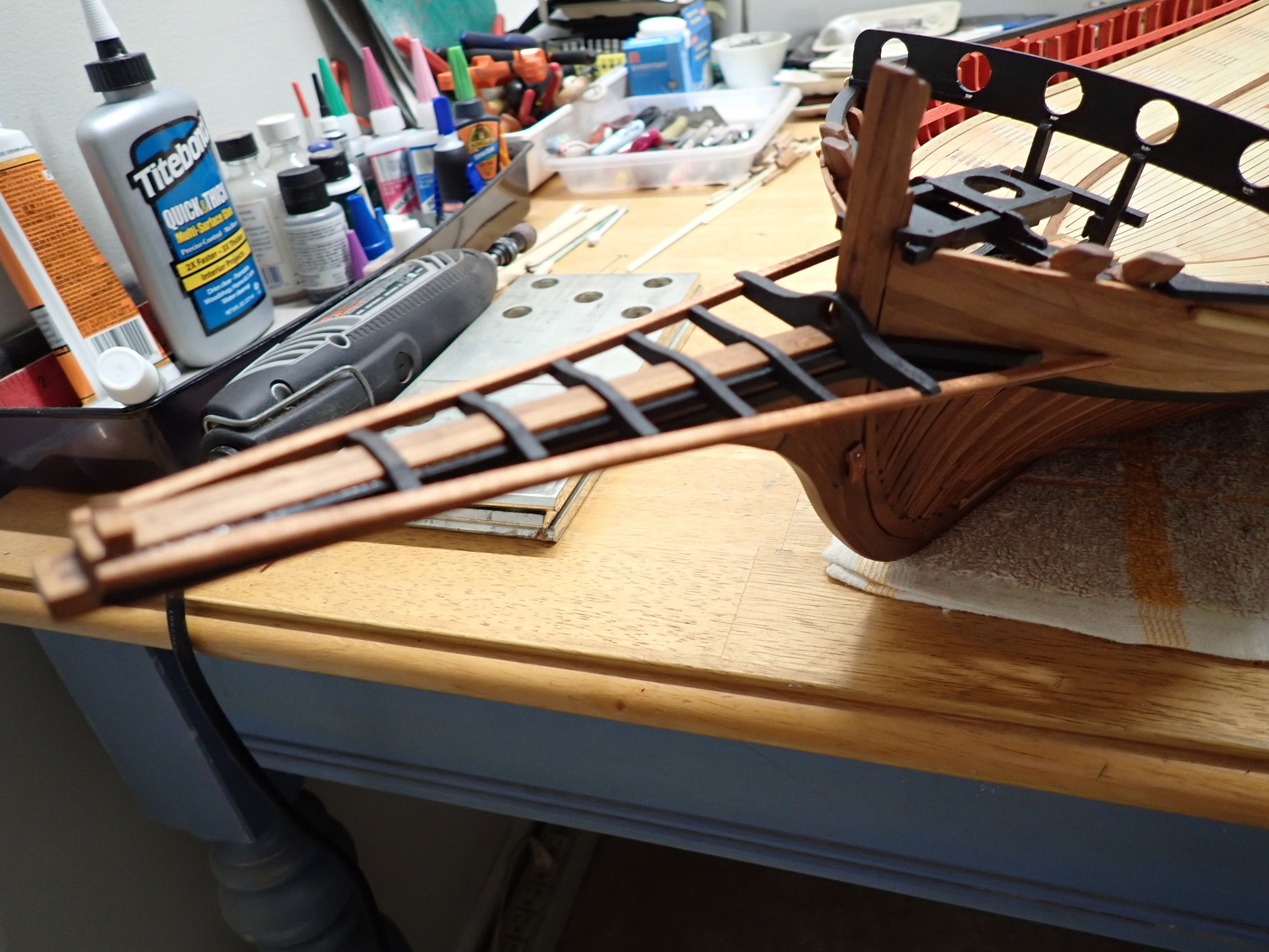

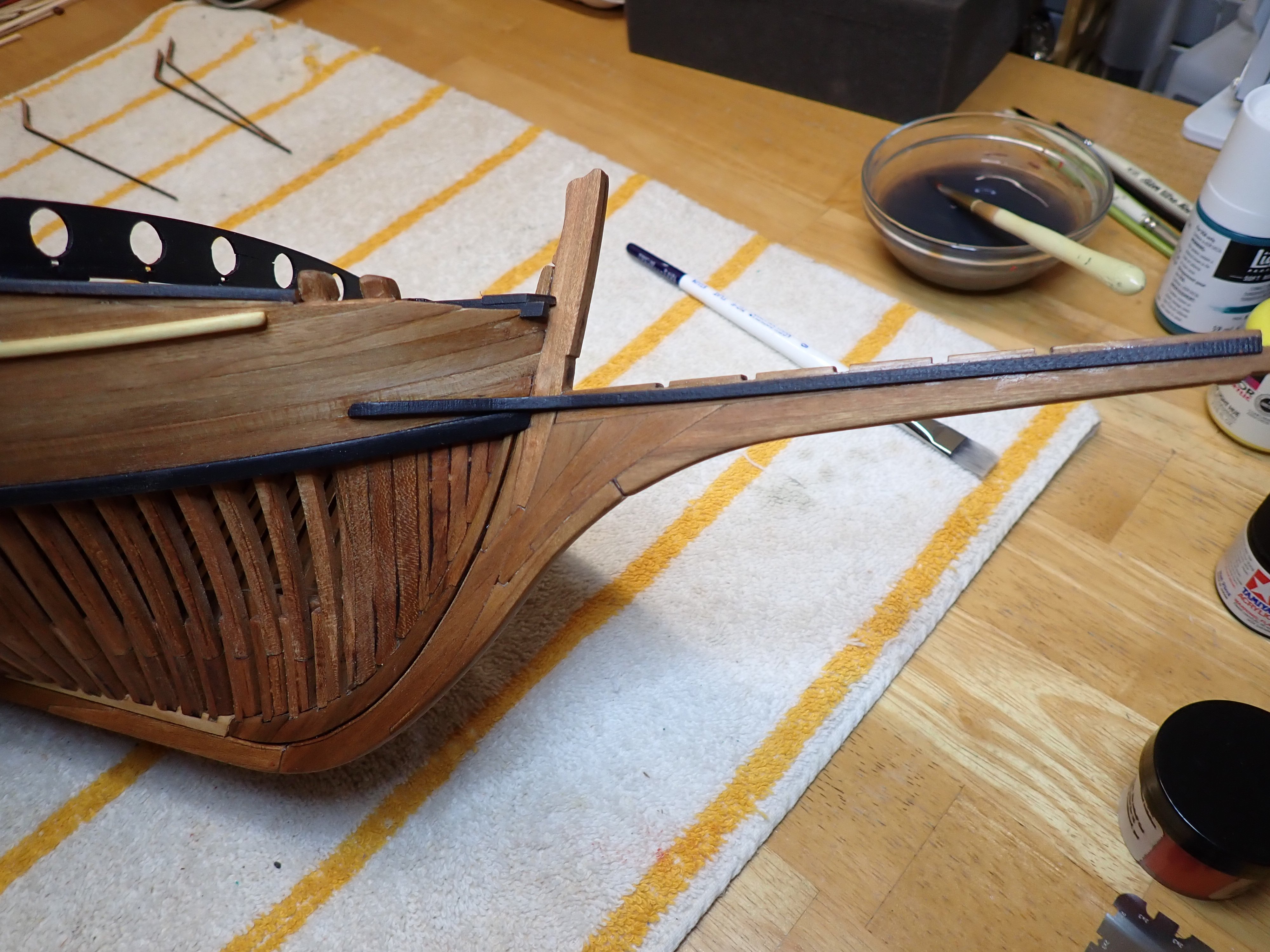

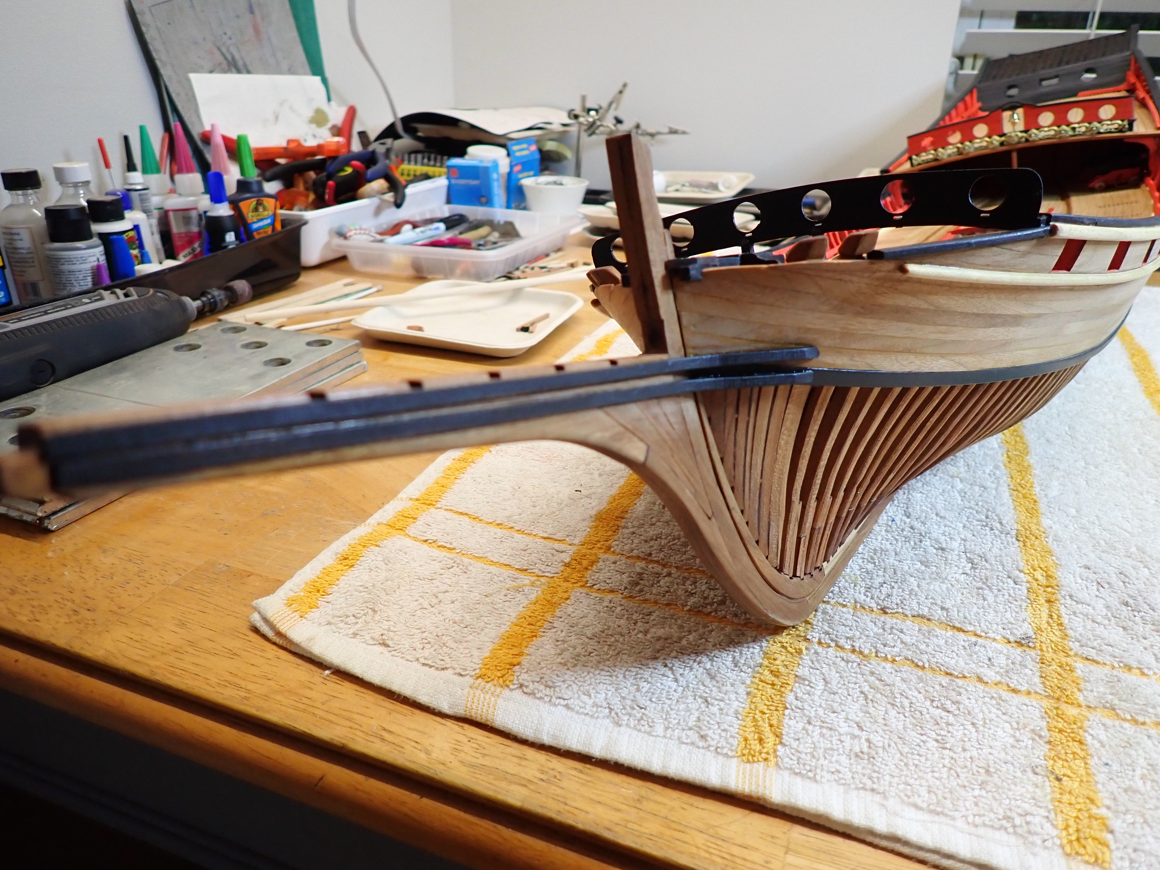

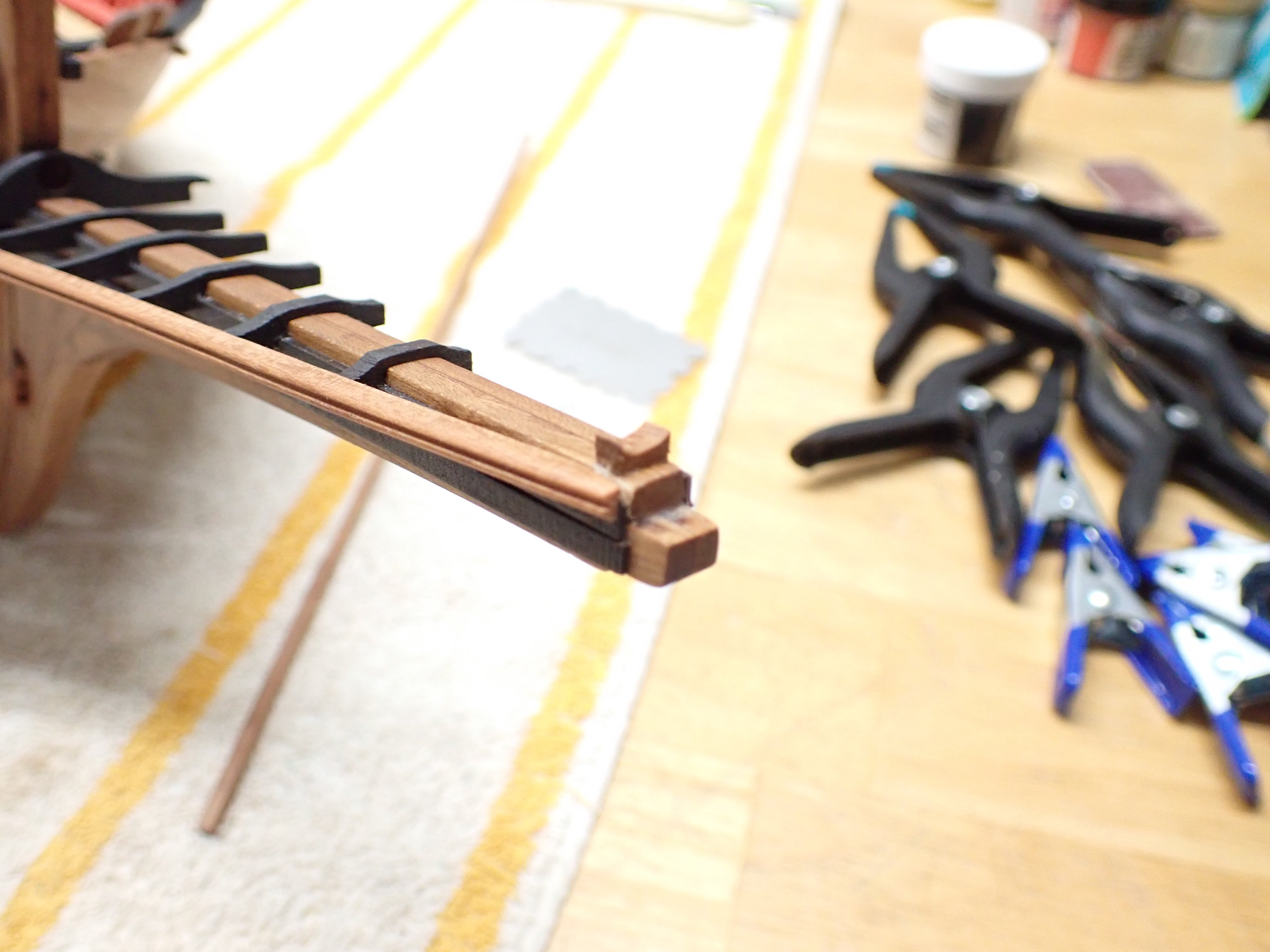

A few progress on the bowsprit:
This is a delicate assembly and I approached it in stages:
The tiny part above is not included in the kit, but helps tremendously in stabilizing and aligning the front bowsprit. Highly recommended.
The figures have not been installed yet, as I am afraid to damage them (at least the one sitting on the tip of the bowsprit).
Yves

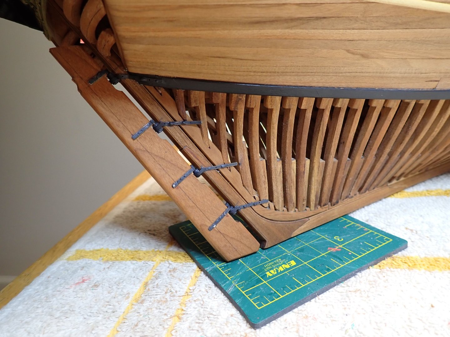

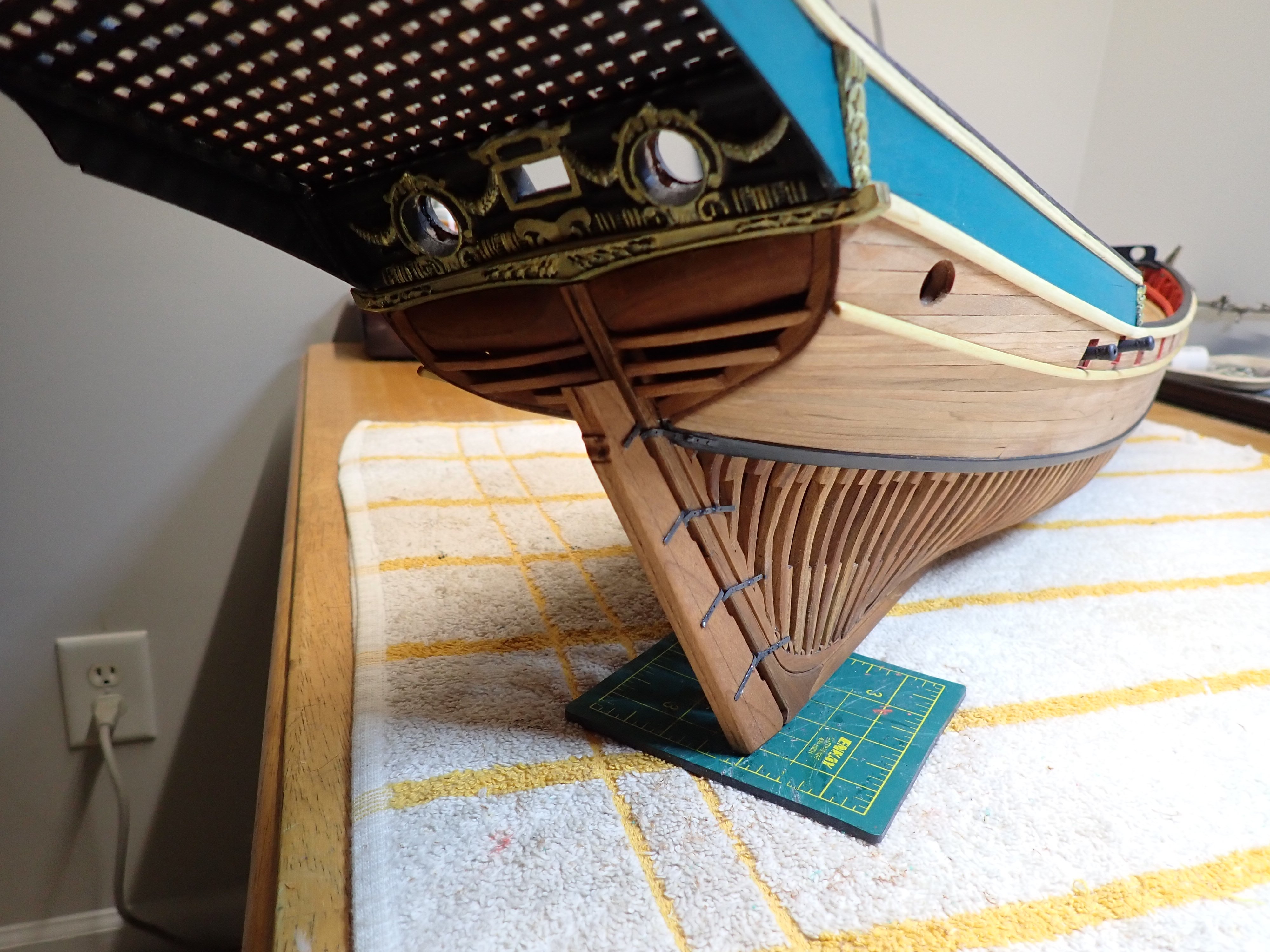

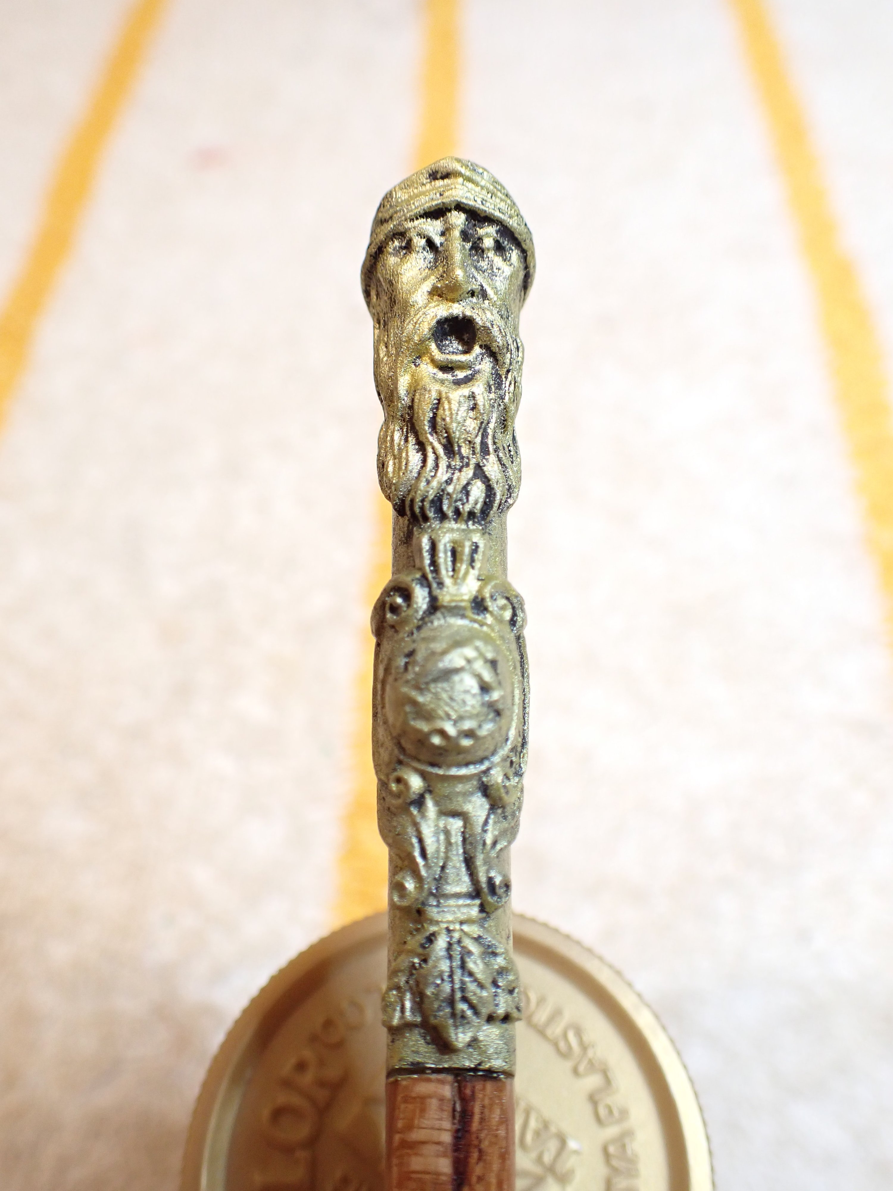

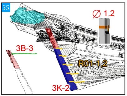

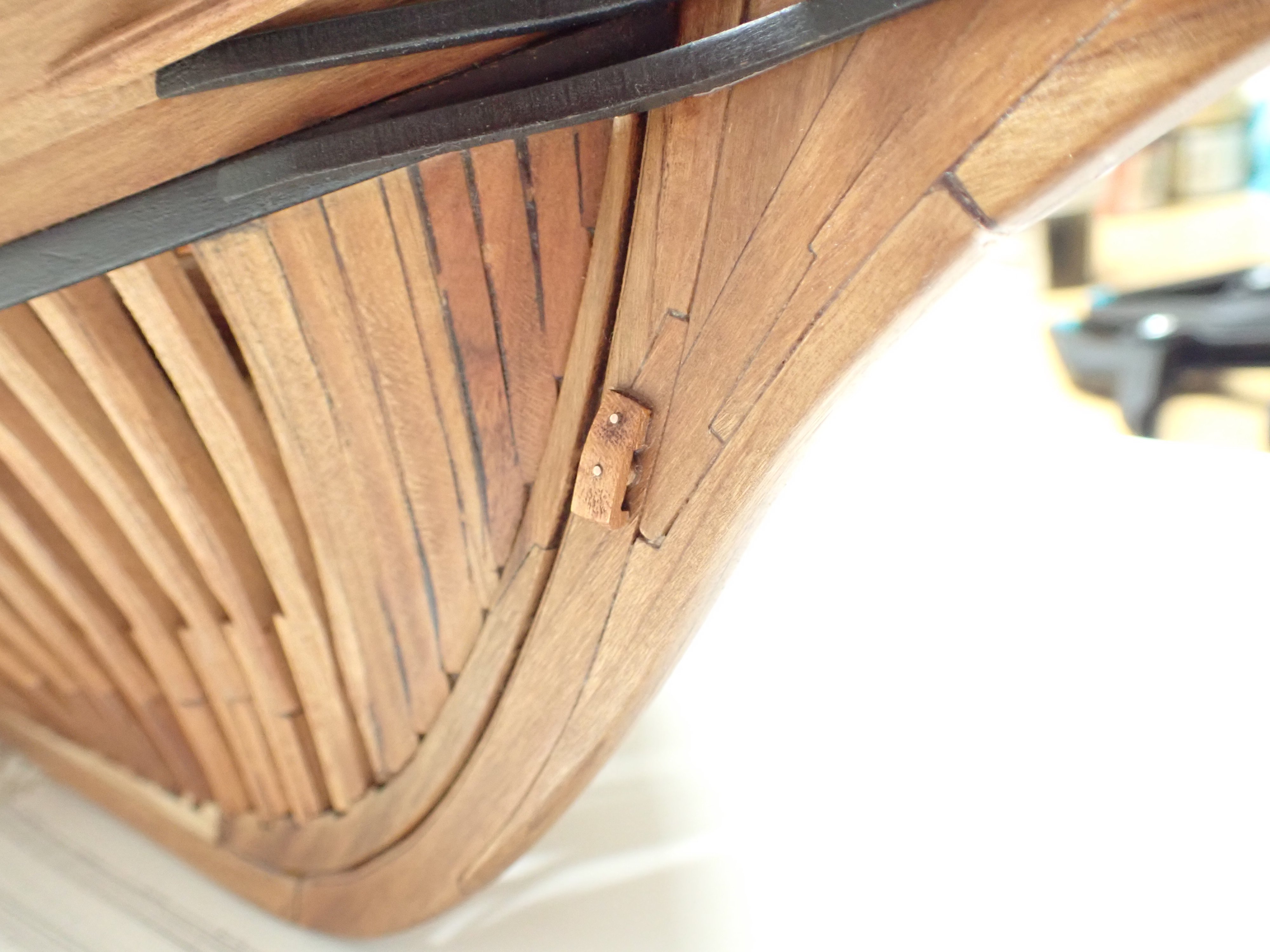

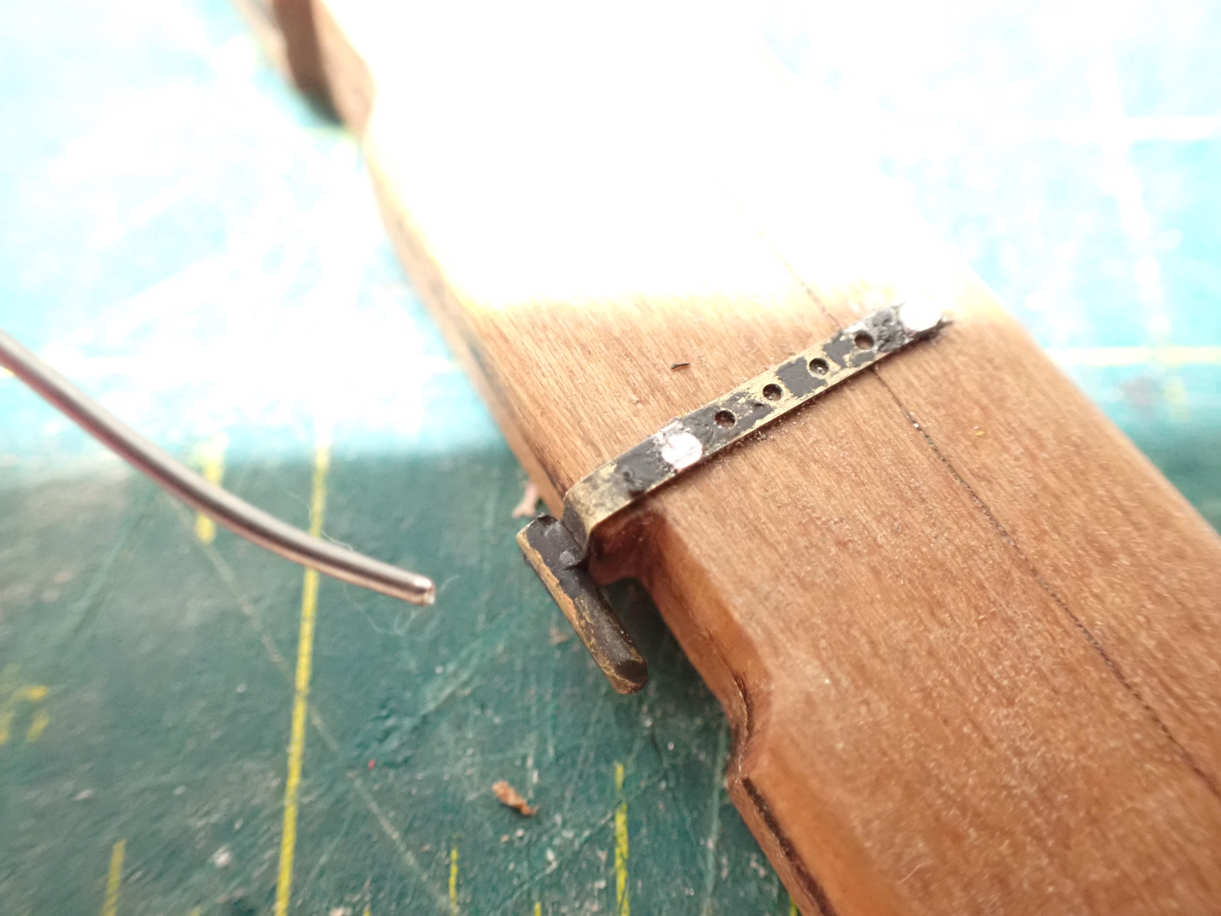

I just completed a very delicate phase of the build: the rudder and tiller. I wanted these to be movable while keeping the capability to take them apart, as this assembly is very fragile.
The hinges are photo-etched parts which is not the easiest for making something sturdy and working. The kit of the HMS Bellona offered brass cast parts which are a lot more solid and well designed than what the Chebec kit offers. This is how I approached the conundrum:
A small piece of brass ( diameter 1.2 mm) is soldered against the photo etched parts provided in the kit. This is then chemically blackened (and later on painted...) and placed in shape around the rudder:
Using electronic components pins, I insert the pins into the wood (diameter 0.7 mm), solder the pins to the PE part in about 4 locations. A little bit of sanding and painting on top, make it look decent. I could not find nails small enough to fit into the PE parts. Of course, while soldering, you want to make sure the wood is not burnt or overheated. It is all very delicate.
The female parts going along the stern keel are the most delicate to adjust. Again flat PE not easy to put in form. Here I am using small pieces of tube (material similar to teflon) and I glue them in place along the stern. The rudder pivots very smoothly and there is no jerking.
Then the same approach (pins, soldering) is done on the stern, making sure the PE parts are hugging tight the small piece of tubing. Additional CA glue is used to keep everything in line and happy.
Verification of the rudder motion:

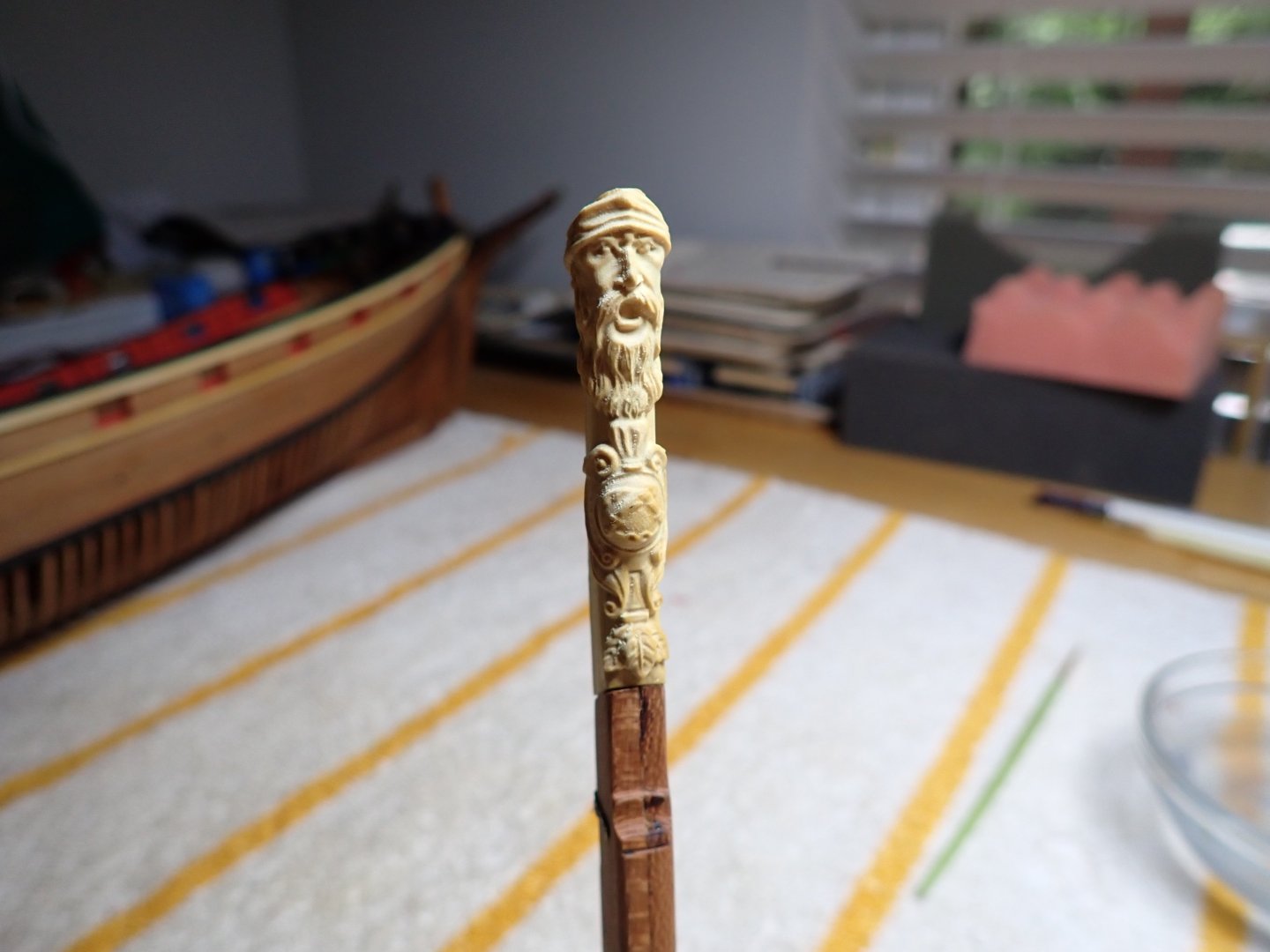

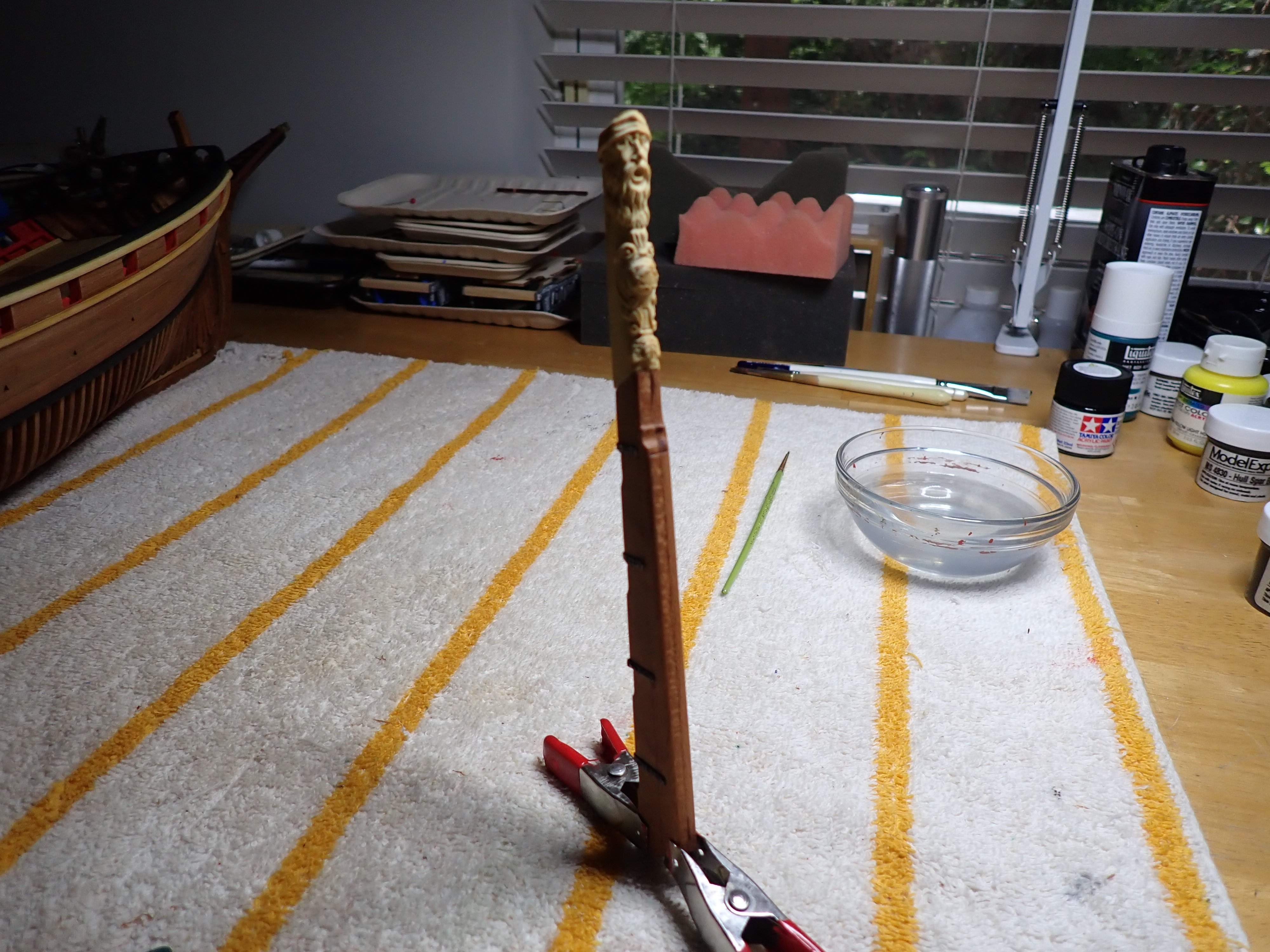

The Boxwood carving is then glued to the rudder and painted black and then dry-brushed with Tamiya gold leaf.
CAF Model did a great job at 3D machining this little carving:

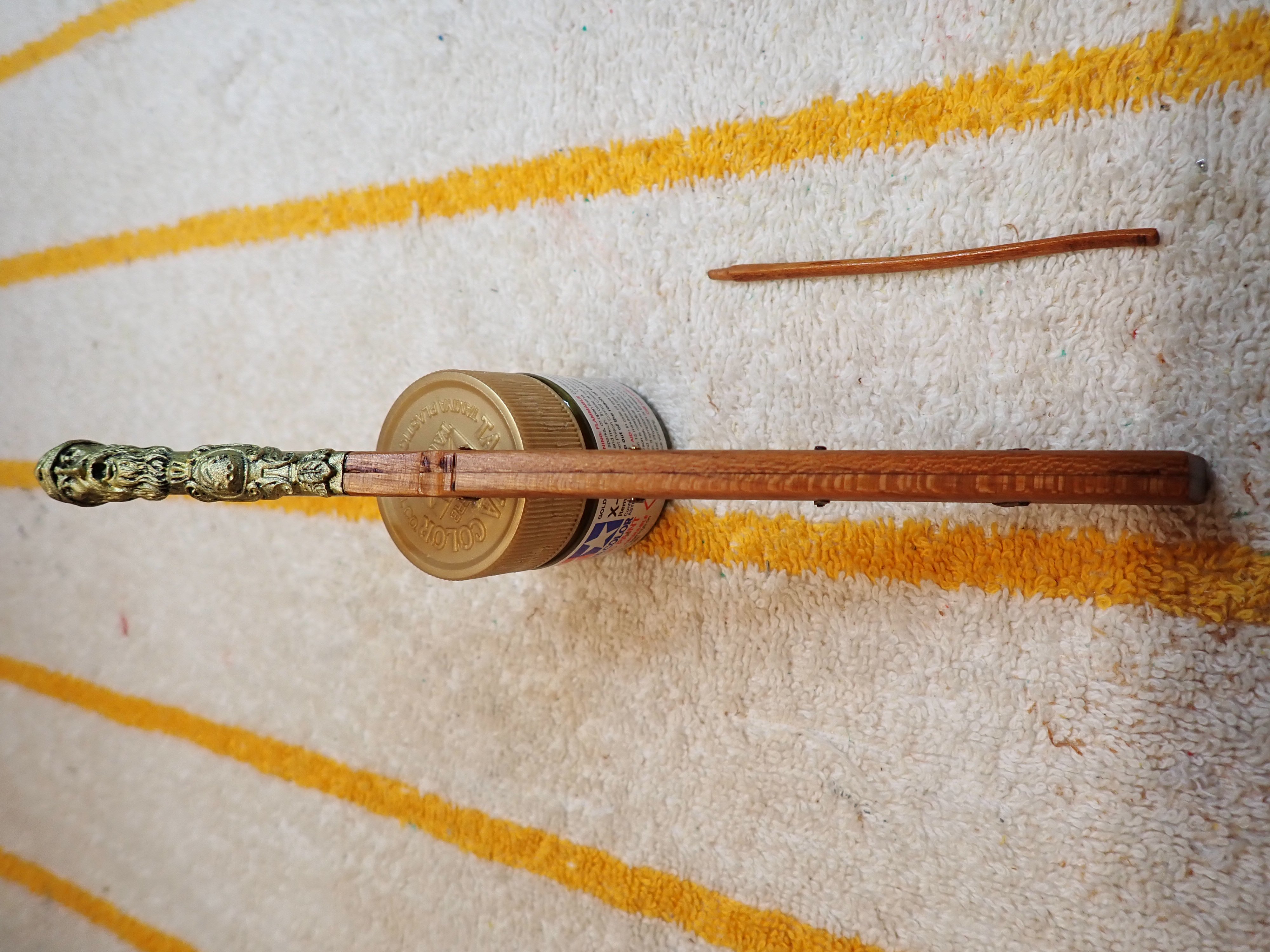

Once installed, the tiller is inserted into the rudder:
The hole is tight enough and holds the tiller without any glue. Motion is possible:
Et voila. Needless to say, this assembly is going to be removed, stored and will be back on the model, when is it completed.
Yves
