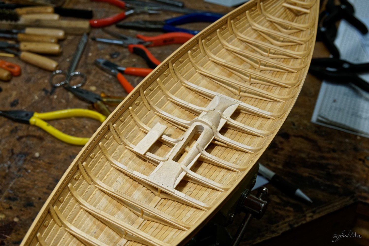

today I finished the knees. That was a nerve-consuming process. But now it's done. The next not so easy work would be the stand, standing in front of the mast.

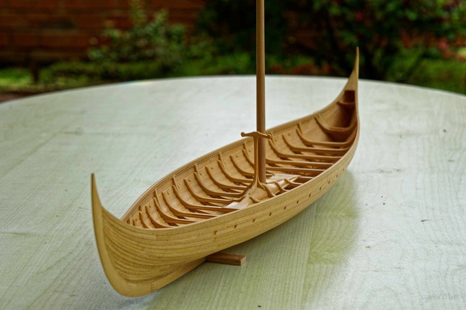

Hello,

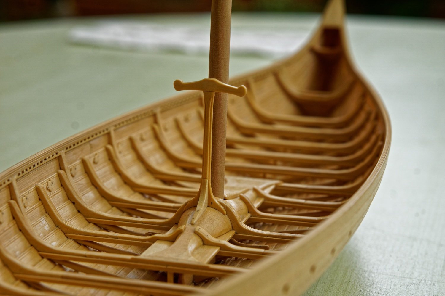

the first stand (?) is installed. This is the fourth version of it. 😟  I worked here after a drawing from Frederik Johannessen, he reconstructed the ship.
And at least the whole ship
Regards,
Siggi

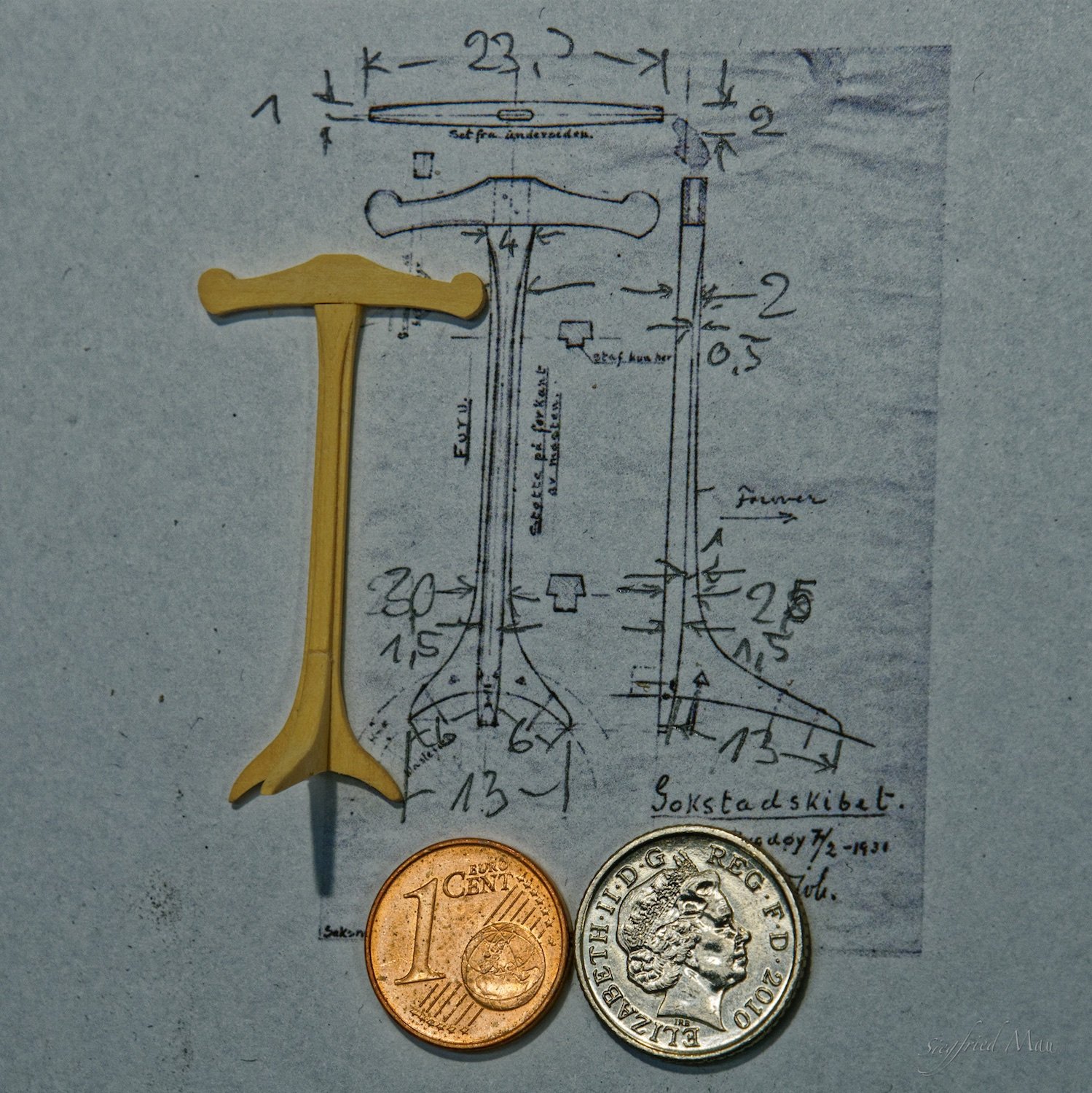

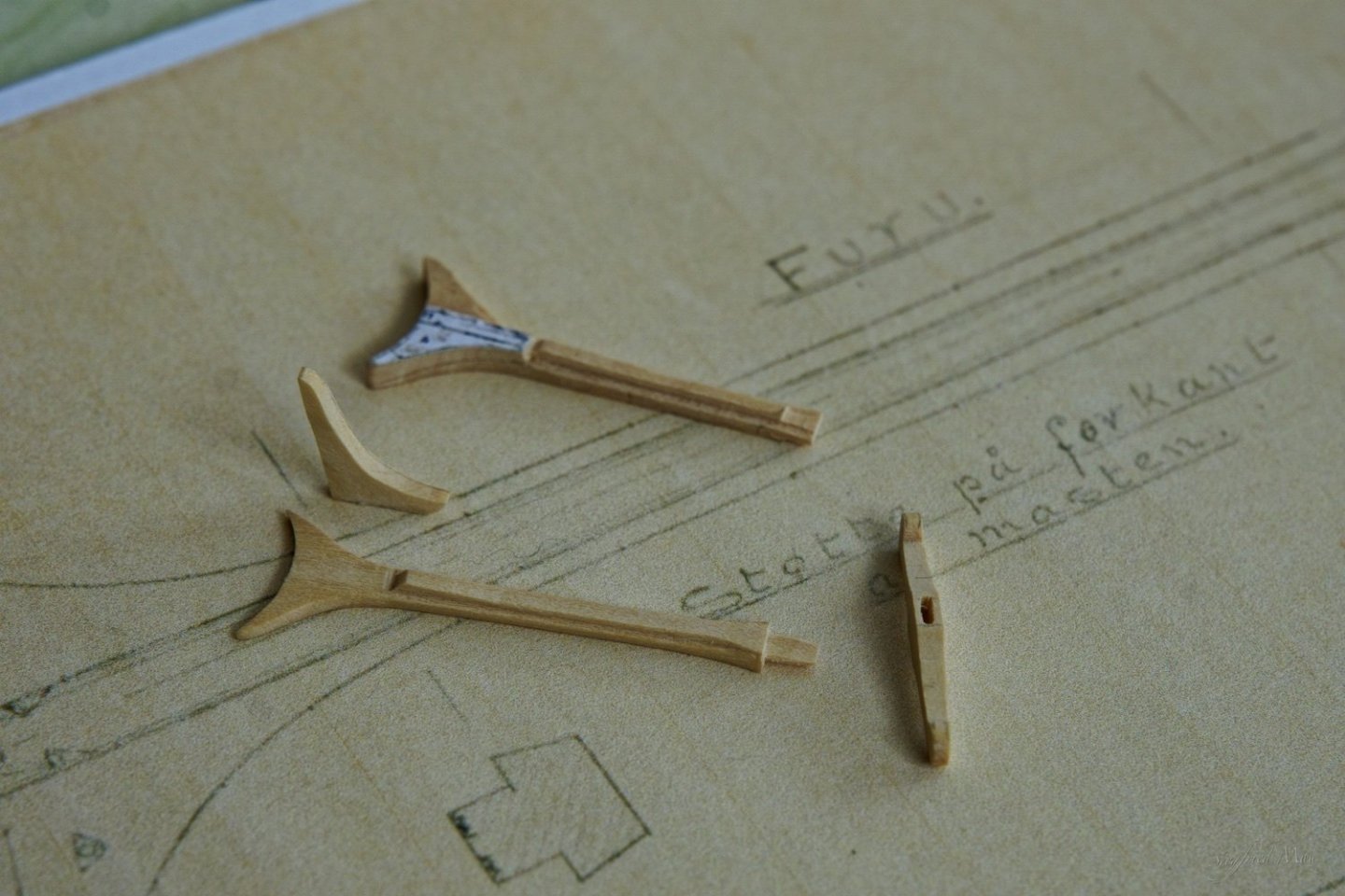

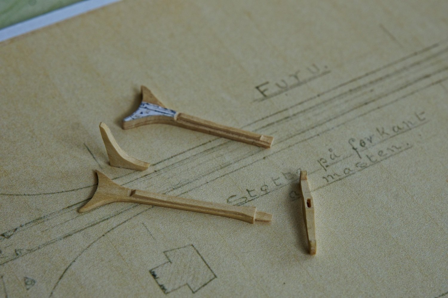

Hello Cisko,
as you can see in the picture, the stand is made of 3 parts. I haven't found more parts in the trash bin anymore. In this case, the stand itself must first be dressed. That's the difficult part. Everything else will explain itself, hopefully.
Regards,
Siggi

Hello,
After a short break, we continue now. The last two stands are now ready. Since nothing is straight here, they got me really busy.
But it's done now. Next is the deck to be made. That means, cutting wood first.

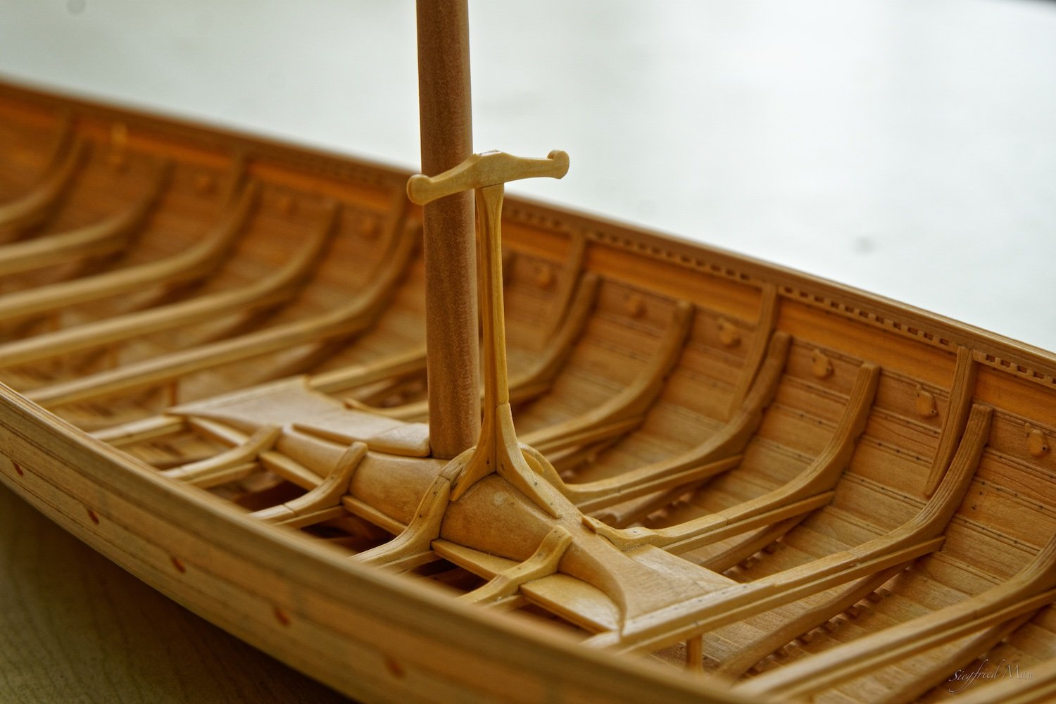

Hello,
it is done, the deck is finished. That was no easy job, at least in the stern and stem. I'm waiting now for the second oiling, and build in that time may be the rudder, some cleats or toggles.
And that is all you could see from the interior. Just some frames and parts of the mast step. But I have the pictures.

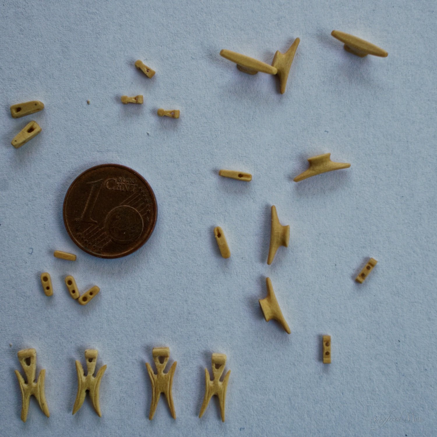

Hello, and thank you for your comments and likes
today I started with an experiment to create the shroud pins. With some branches from my boxtree. Let's see what's going to be.
The arrow shows one of the Gokstad ship in the scale, it is 13mm long!

 Very nice blocks and cleats, Siggi. I know how difficult it is working on small stuff that size.
