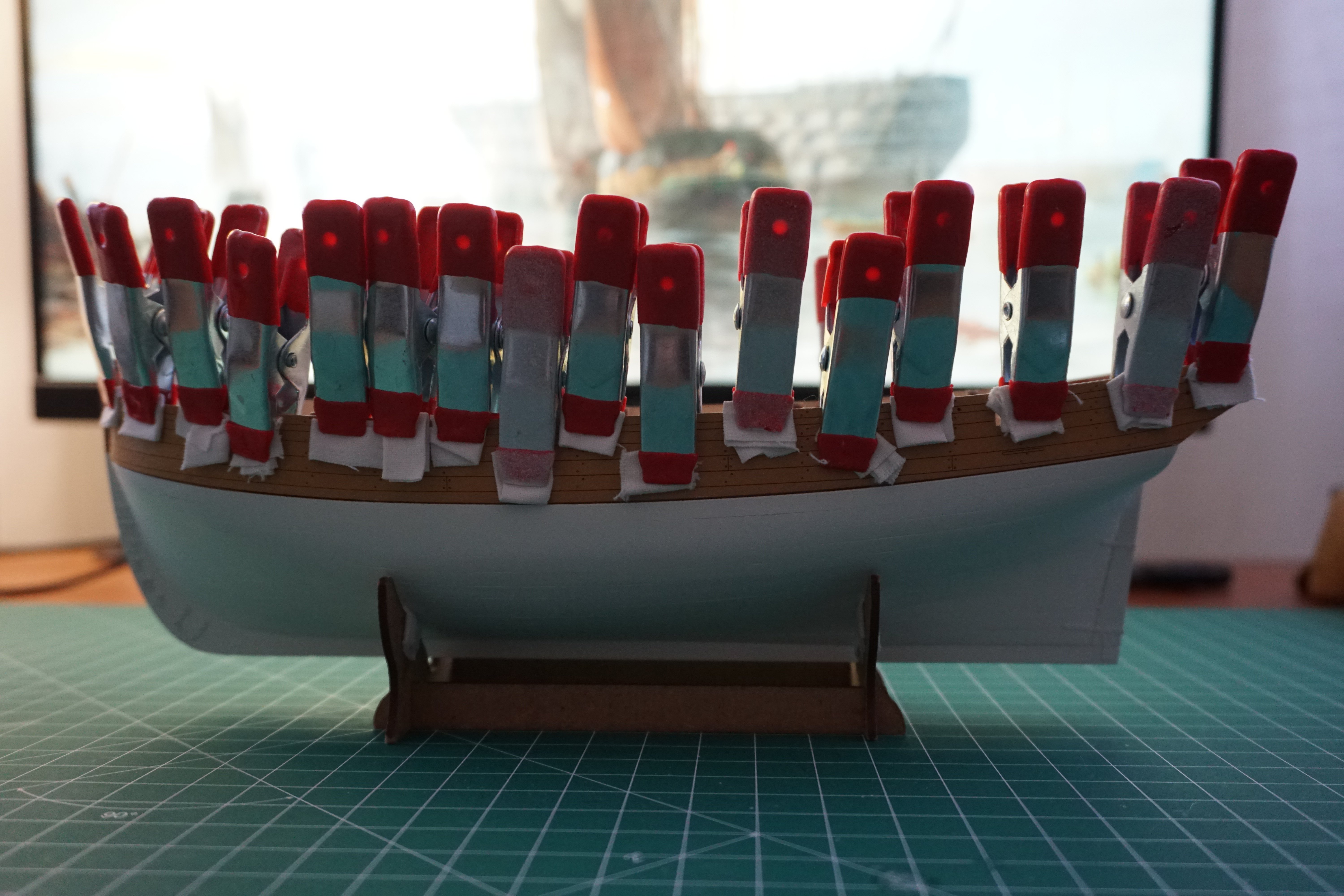

I'm now past the halfway point on the second planking and have been able to get away with fairly little clinker. I've used @Jase's spreadsheet method and re-measured after every few planks. Only some small adjustments to the spreadsheet have been needed.
I've primarily used PVA again, with some CA for the bow and stern.
“Clinker” happening means the width of the plank needs to be reduced, or tapered, towards the stem.  The taper starts about the third bulkhead aft of the stem, the plank width will end half the width or less at the stem.
At first you can get away with not doing it, it will catch up to you.
Find one of the many postings on this site to see how to do it.  My Constitution build log talks about it.
Nice work, so far, good luck.

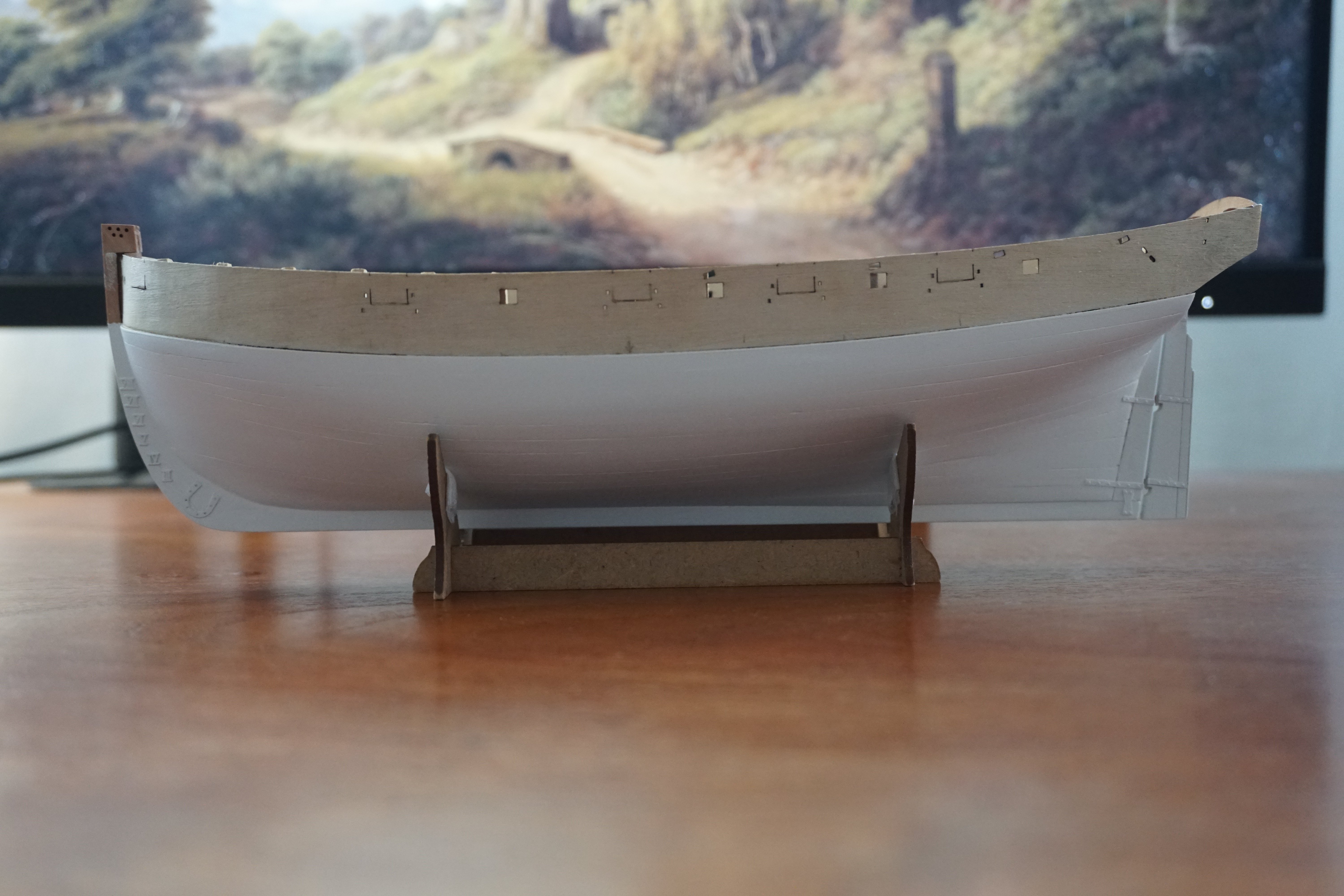

DSC06806.thumb.JPG.5ce0bd9e021d61151ec869d151c7fb74.JPGDSC06813.thumb.JPG.91a2cad097f05e6ad66933959c40b216.JPG

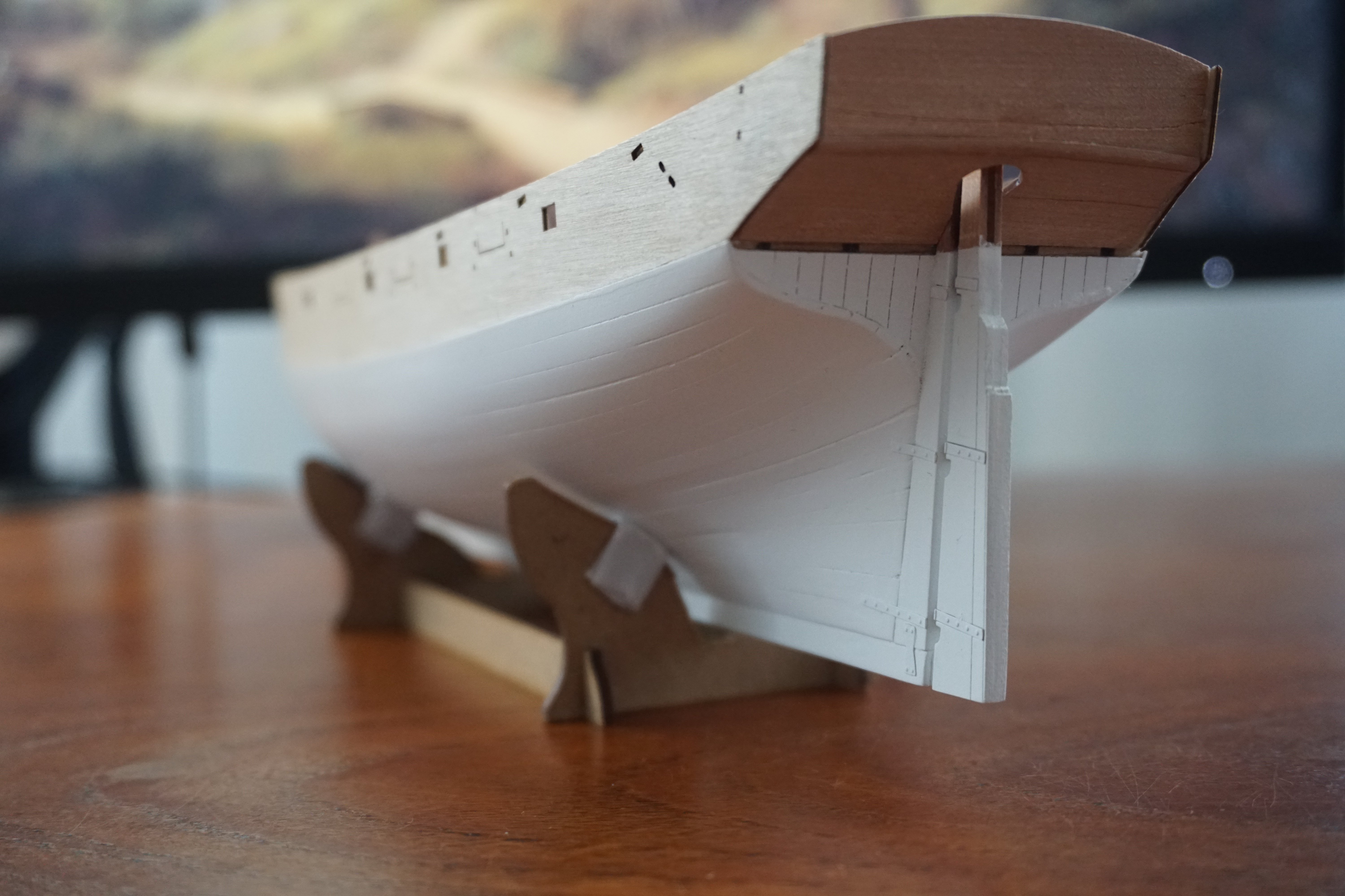

The hull is now primed, but some of the gaps seem a bit large. Do you think that I should use some watered-down filler, or will layers of top coat and sanding in between be enough? I'd prefer planking to be visible in the finished model, so I'm concerned that using filler might be too much.
Edited by Nightdive
Sometimes - in my very limited experience - gaps only pop visually after a first coat of primer (I think some of the Vanguard instructions actually note that too, if not in the Sherbourne, then in the Ranger instructions). I'd try to fill and sand large gaps. I could be wrong, but the goal isn't to make it seem like a smooth fiberglass hull, because it's fine for some of the details of planking to show through the paint, but you also don't want large gaps - as you said. If you look at photos of real painted wooden ships, you can see the planking, but you don't see gaps or holes for obvious reasons.
If you use some really watered-down filler, it can get into some of the tiny pinholes you have, which would be the things I'd be most inclined to want to fill.
I first tried using a Minwax wood filler and it was way too grainy when watered down. Maybe fine for large-scale, but terrible for small scale. I found the Elmer's (water-based) wood glue to have a finer grain and it waters down a lot better. Would be interested to hear if other have different recommendations. You can apply it, let it get into the tiny holes and gaps, and just gently wipe the surface.
(You can also get yourself into a death spiral of adding filler, sanding, adding filler, sanding. Don't ask how I know.)
Edited by palmerit
Thanks @palmerit, I used a tiny bit of filler at the bow, but think I'll leave the plank seams alone at this point. We'll see where it goes after a couple of coats of acrylic.

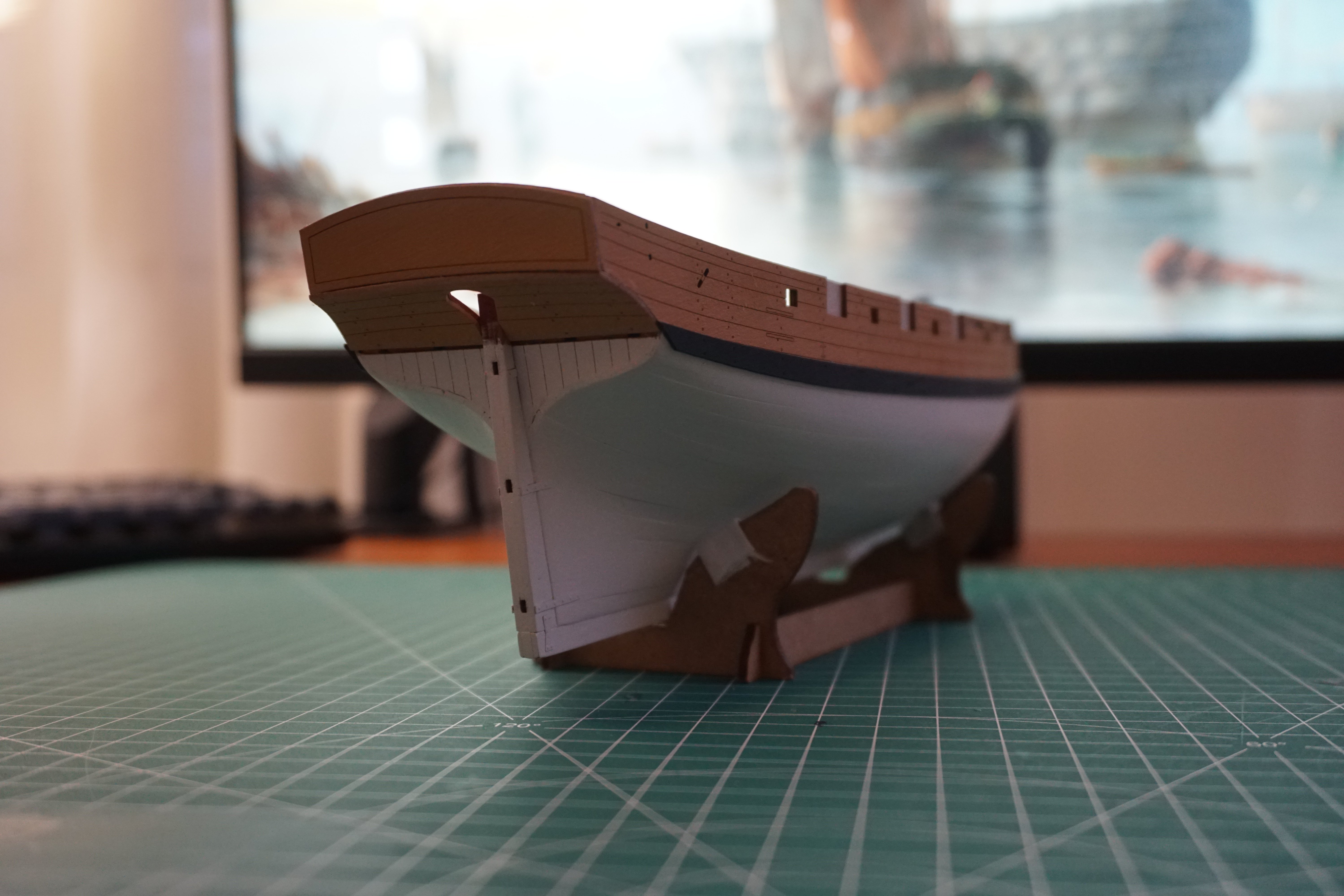

Below-waterline painting completed, time to celebrate a little.

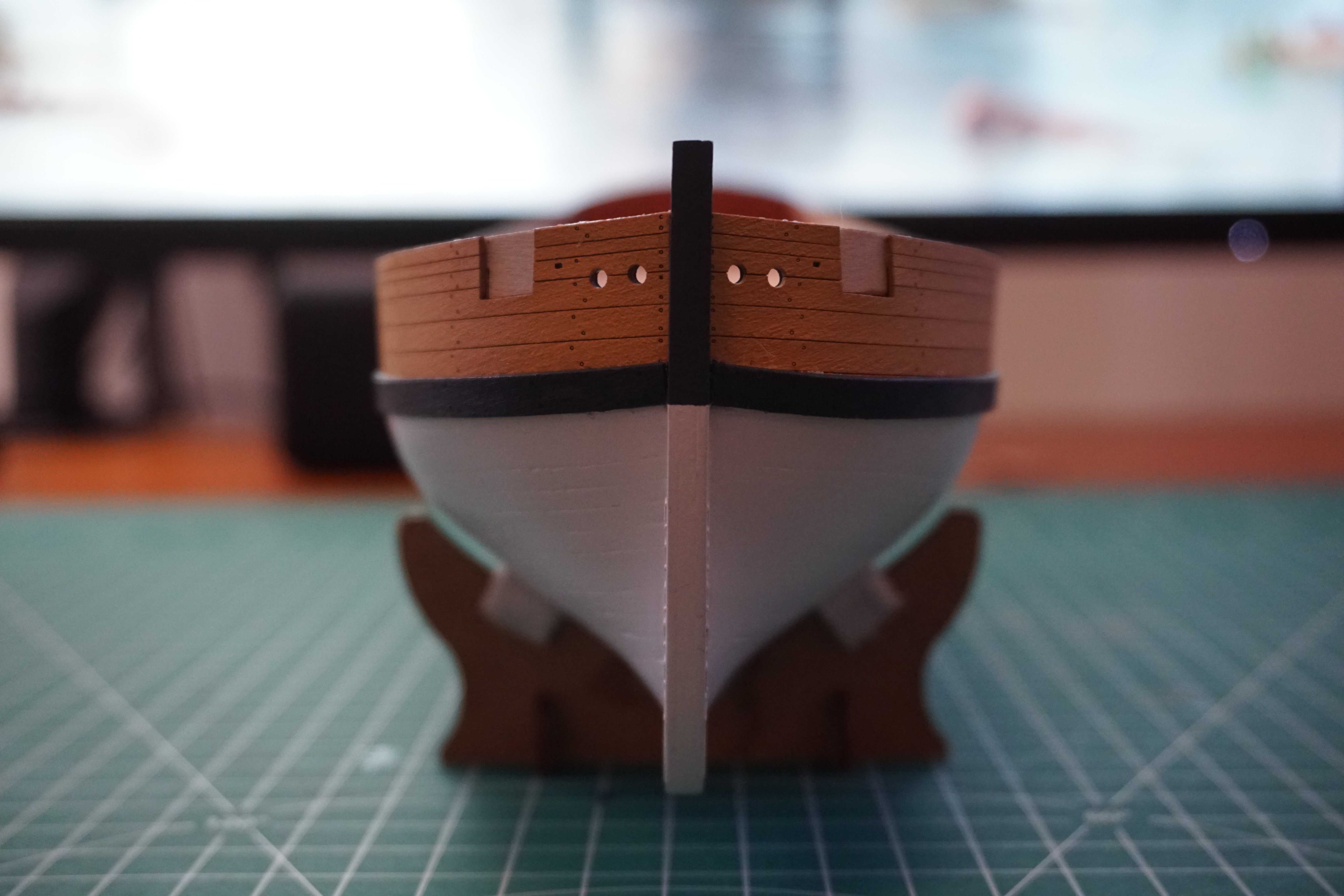

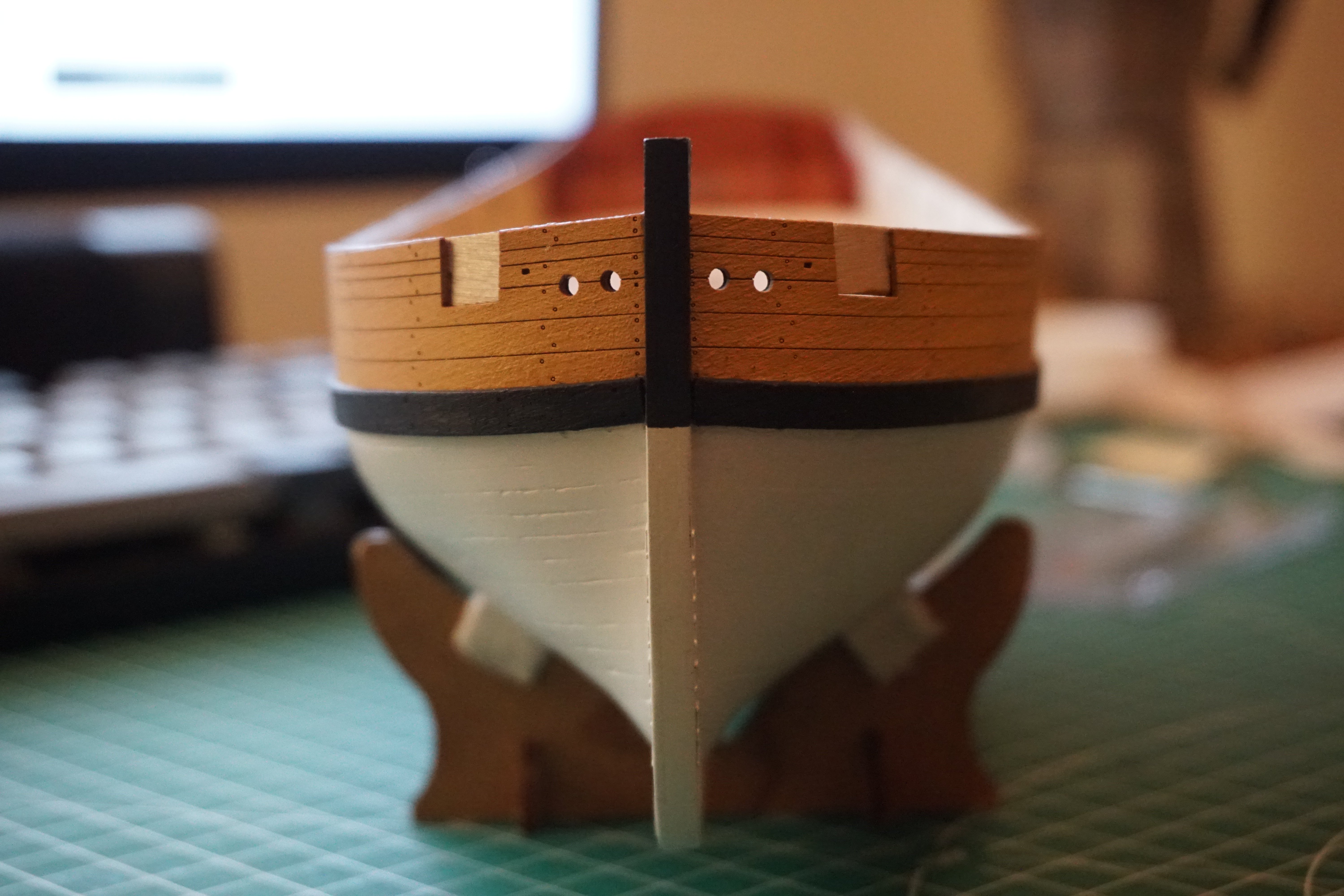

DSC06831.thumb.JPG.dc98337a4adc76faefd7cdda4ca506cc.JPGDSC06898.thumb.JPG.26e7f2f79a94358539a12adcf3a39958.JPG
After two layers of acrylic, I opted to touch up the seams with a brush. I lost count of how many airbrushed layers of paint I applied, but before the final two ones I attached the PE parts with CA. Too much CA in fact, some of the depth markings had to be removed, bathed in acetone, and re-primed.
DSC07019.thumb.JPG.894f45dffb9a6e3ba62ac421073f0f08.JPGDSC07009.thumb.JPG.8c3af57121d05631cccbbef26a60df70.JPG
I think that there is a nice amount of woodwork still visible. I would have preferred more consistent lines of planking, but for a first model it's close enough to the real thing:

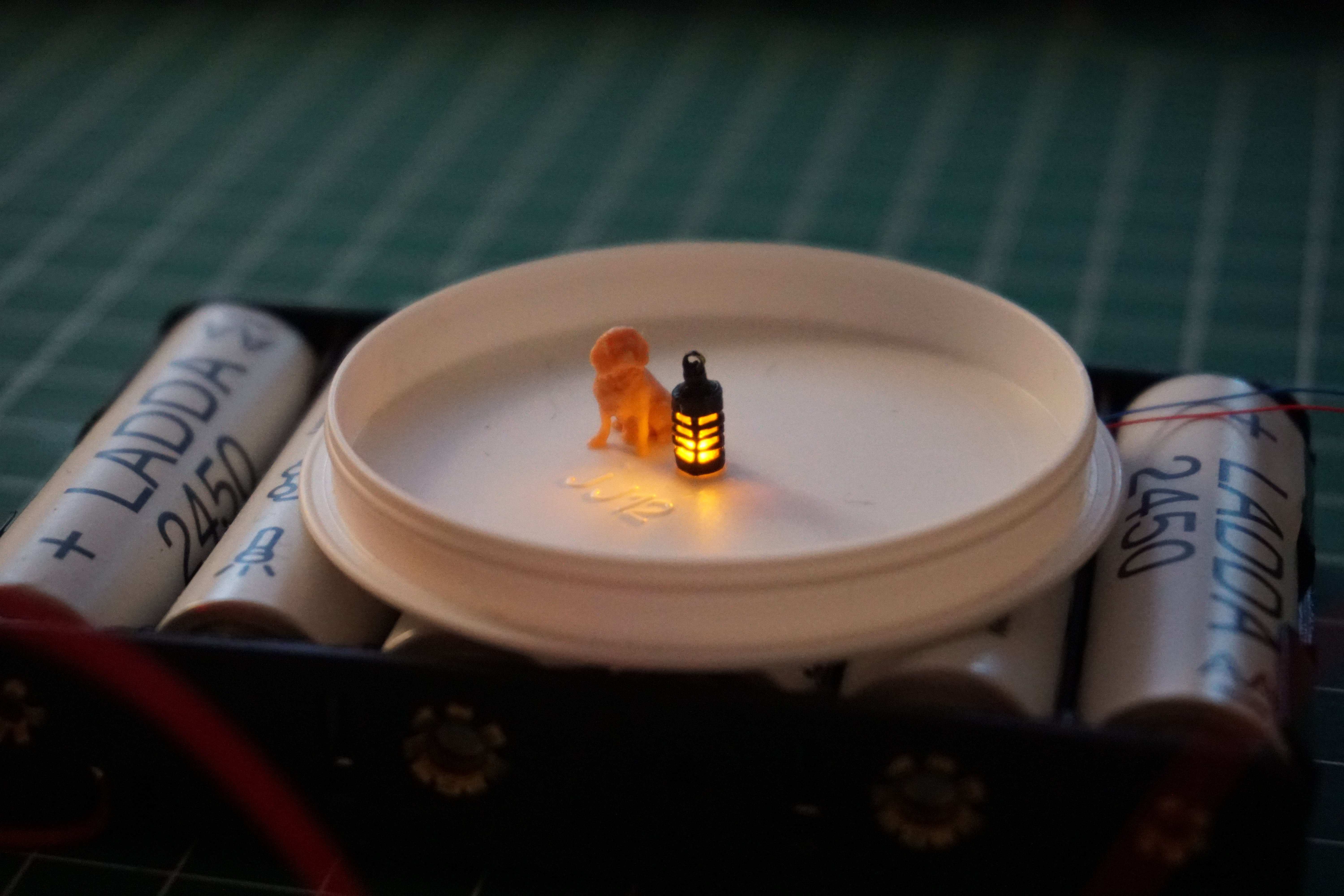

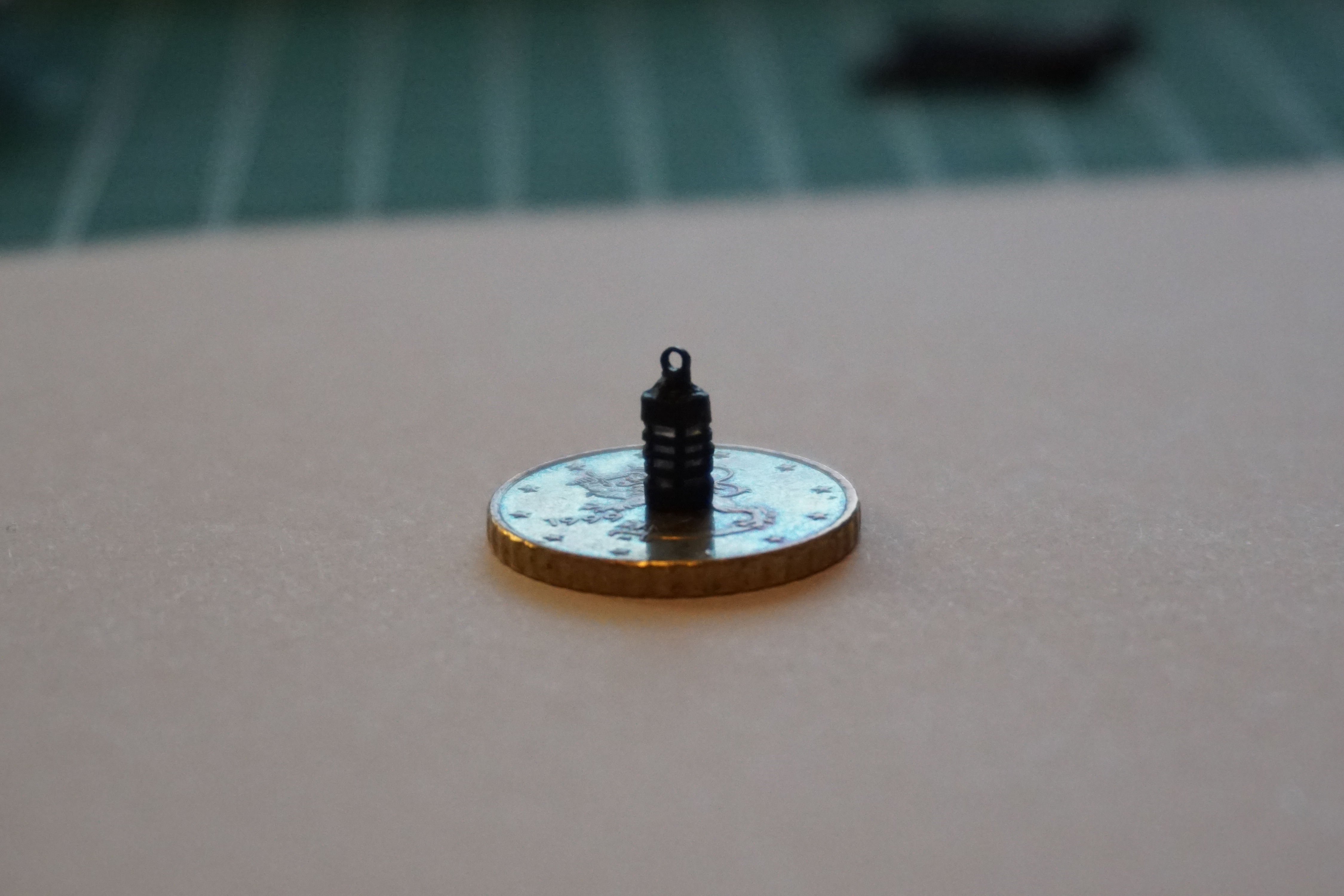

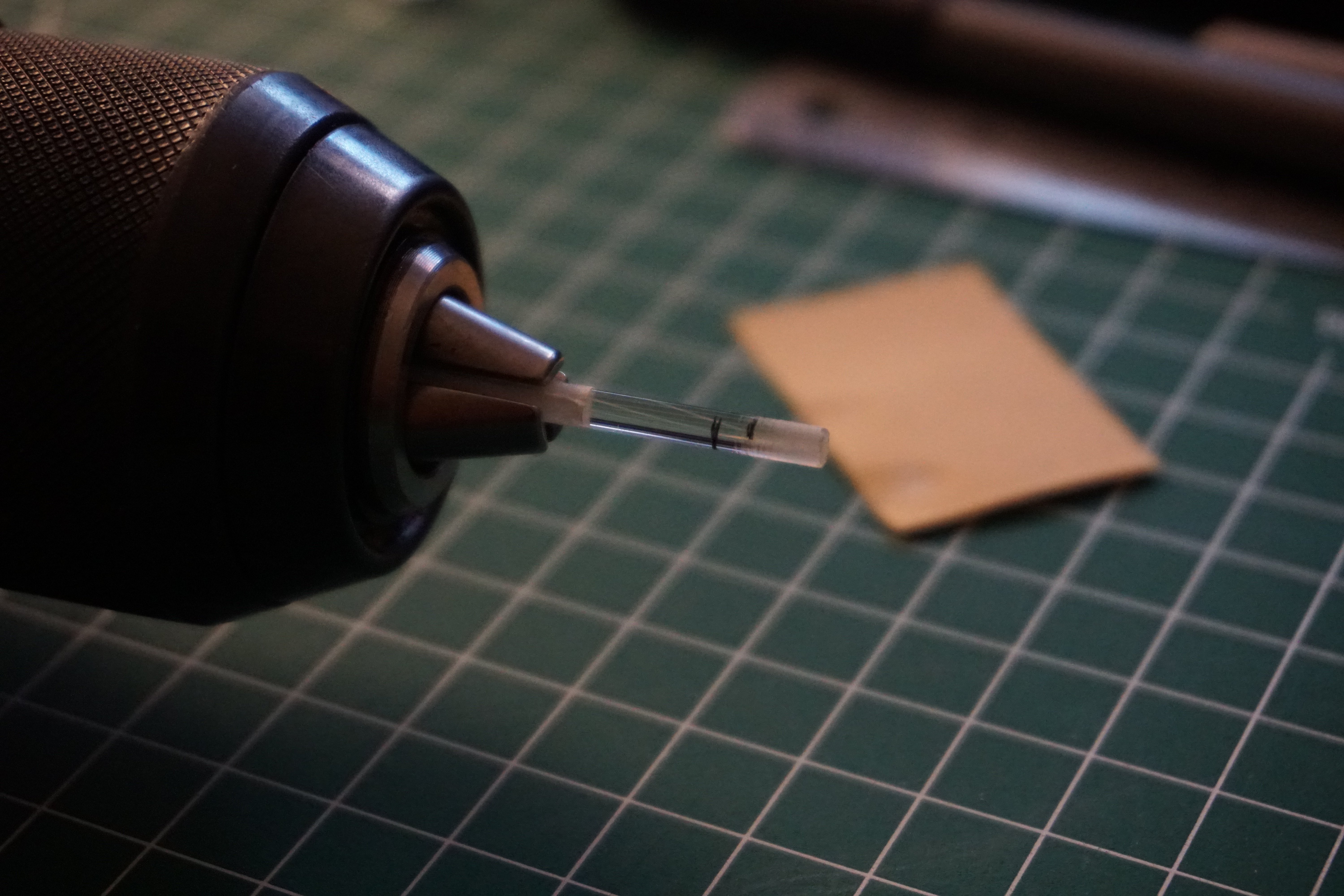

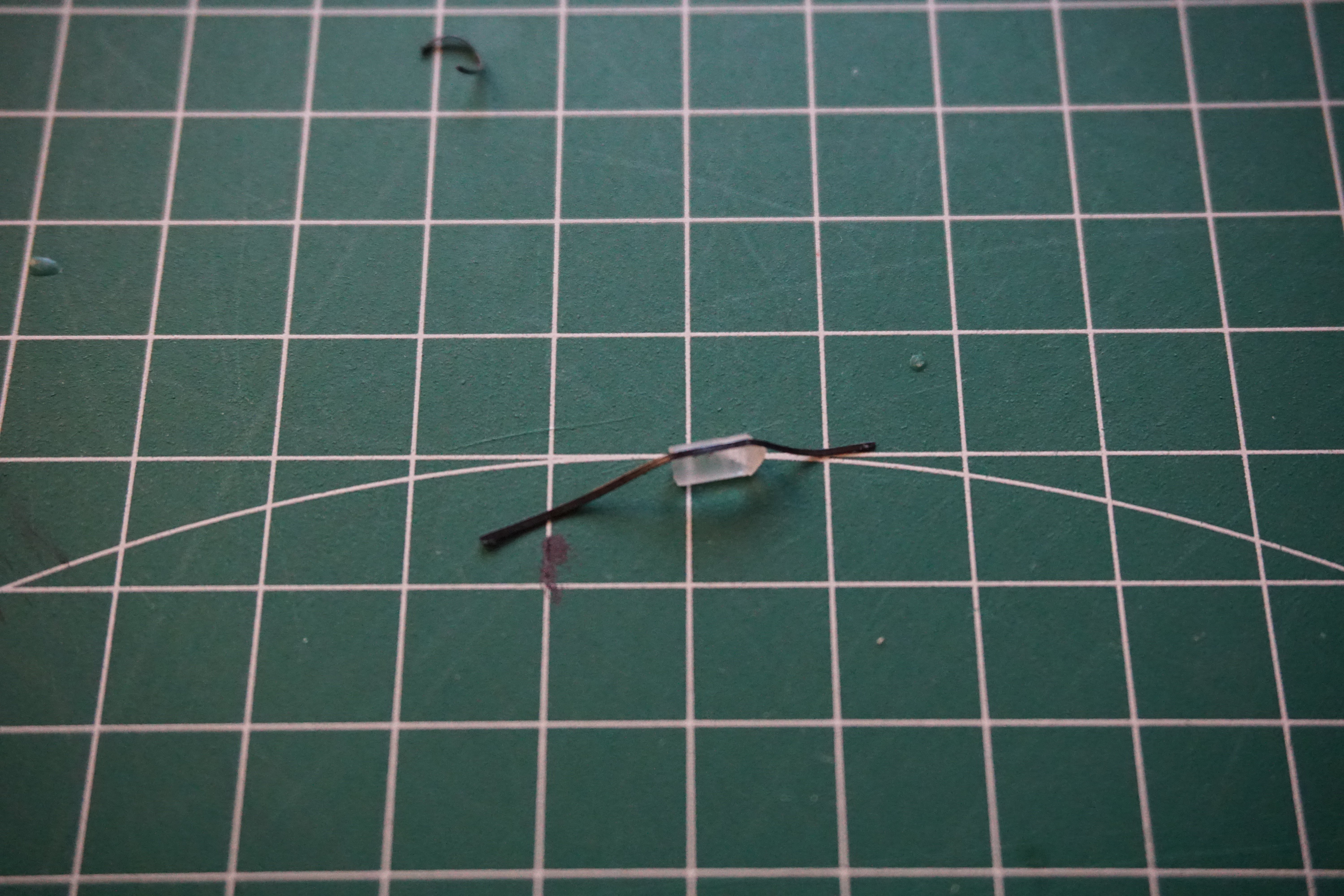

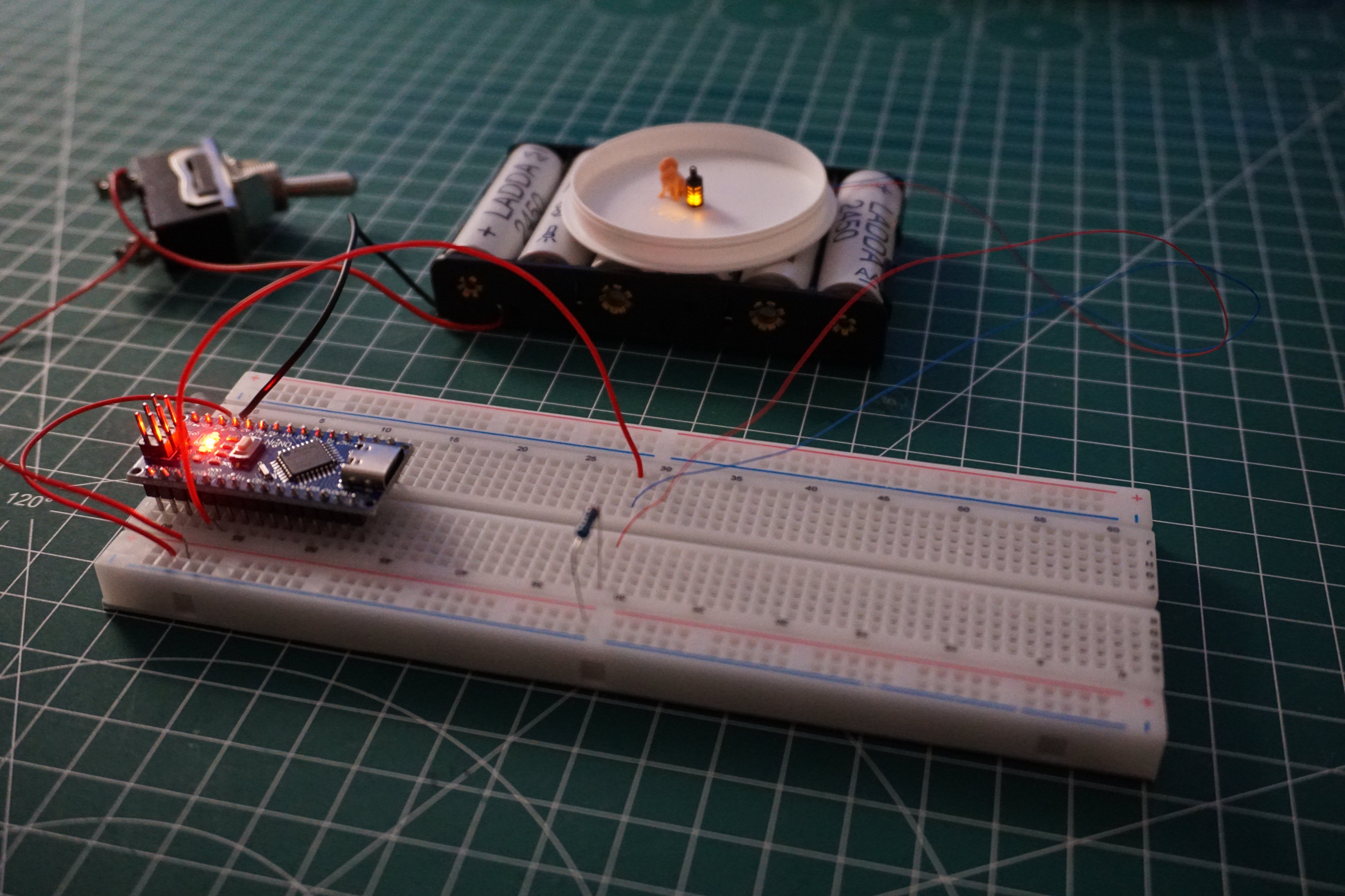

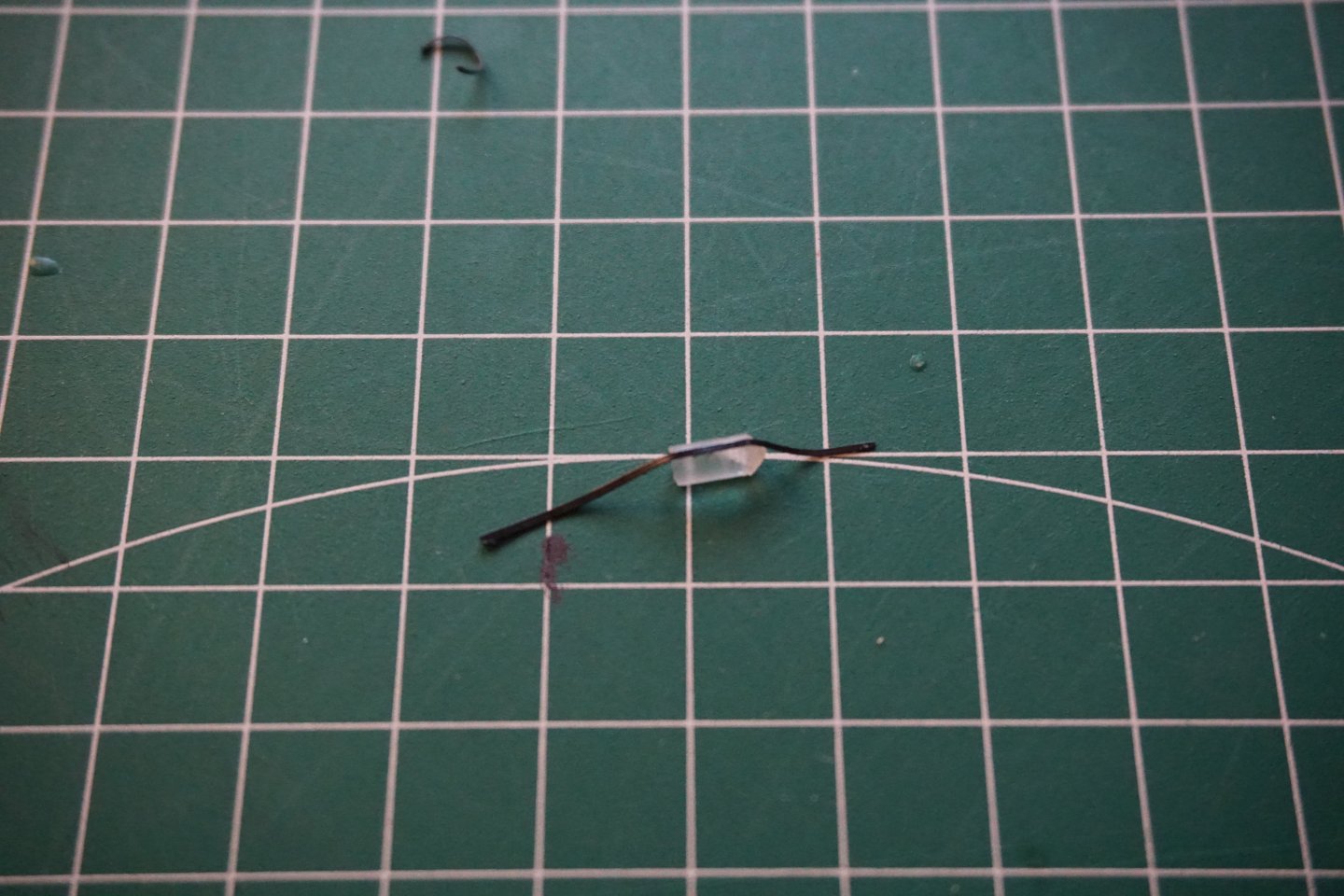

In the meantime I started another side project, creating some lighting with an Arduino. I'm planning to place one or two leds below deck, plus one on the deck, but as the Sherbourne doesn't have any fixed lights, I decided to create a portable lantern. I used HMS Victory's lanterns as a model, with dimensions sourced from this website:
https://www.invaluable.com/auction-lot/a-painted-tin-and-horn-lantern-from-the-gun-decks-c-ce640afa9a
It's made of 3 mm acrylic rod, electrical tape, shrink tube for the horizontal bands, plus some paint and scrap brass.
edit: After making my post, I realized that the top part looked a little off. So I went back and removed an extra piece of brass from underneath the loop.
Edited by Nightdive

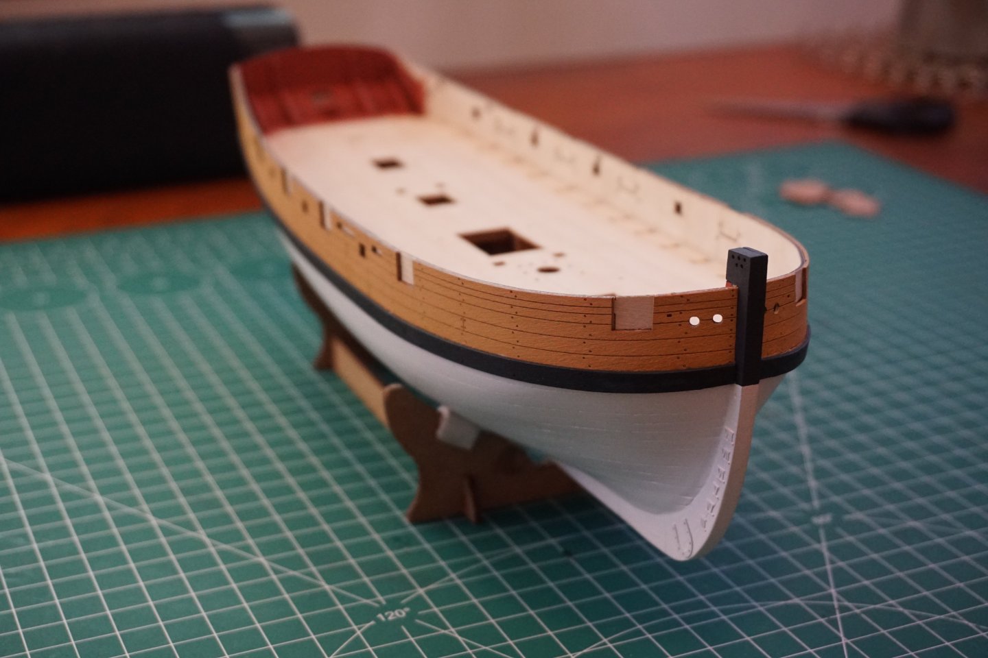

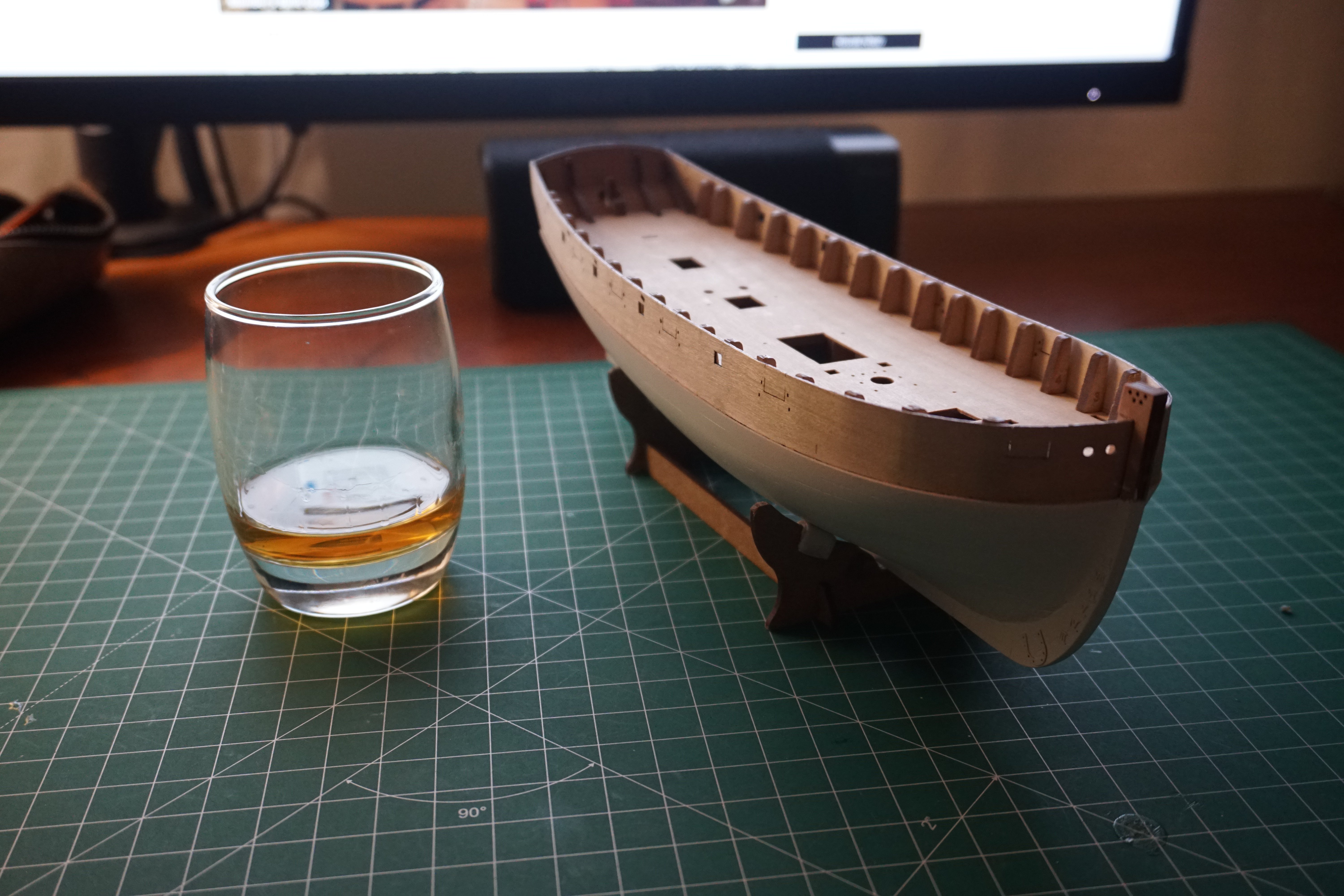

I'm finally back to modeling. The yellow ochre turned out to be a little darker than I'd expected, but I think that it still looks great.

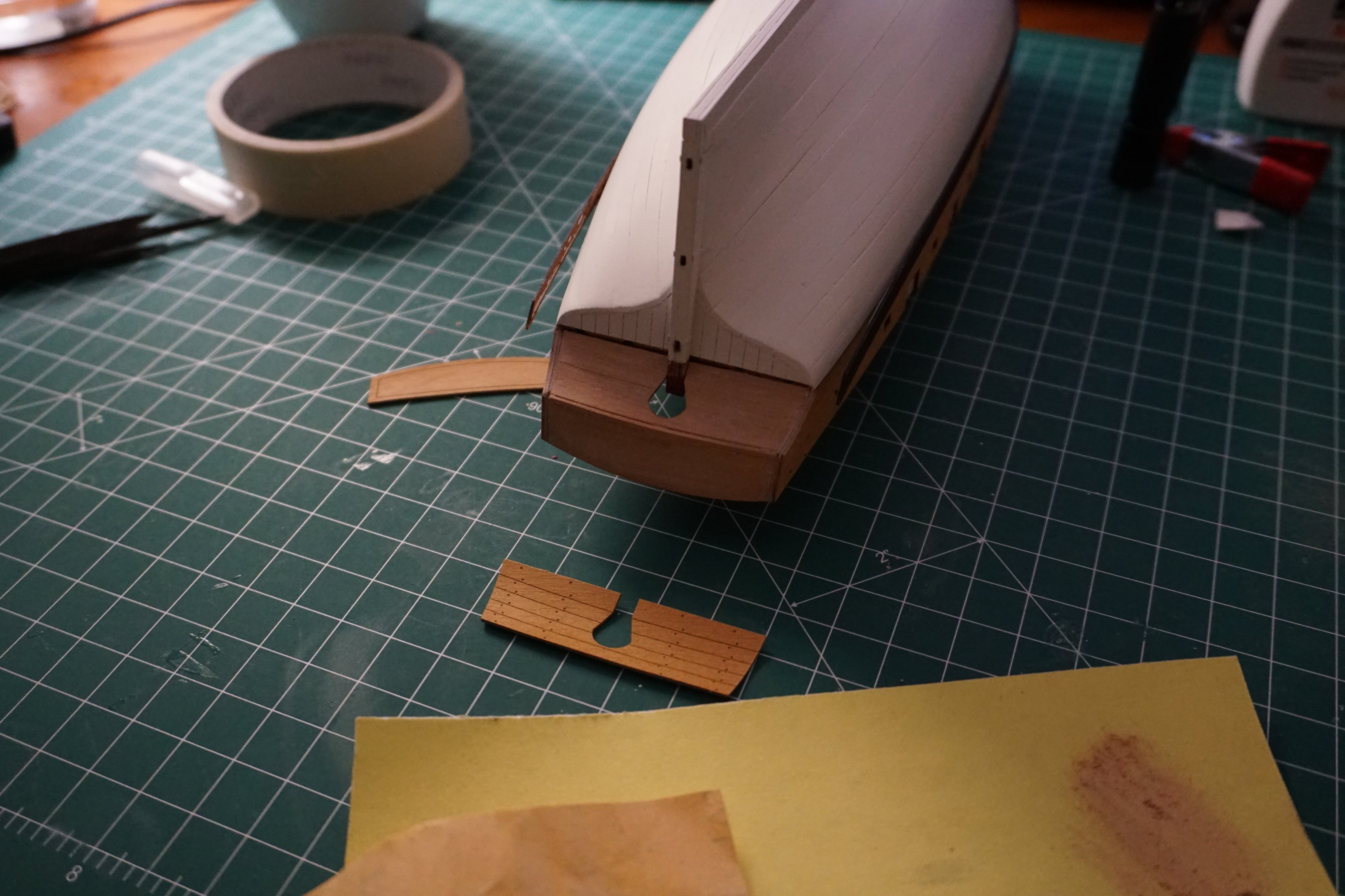

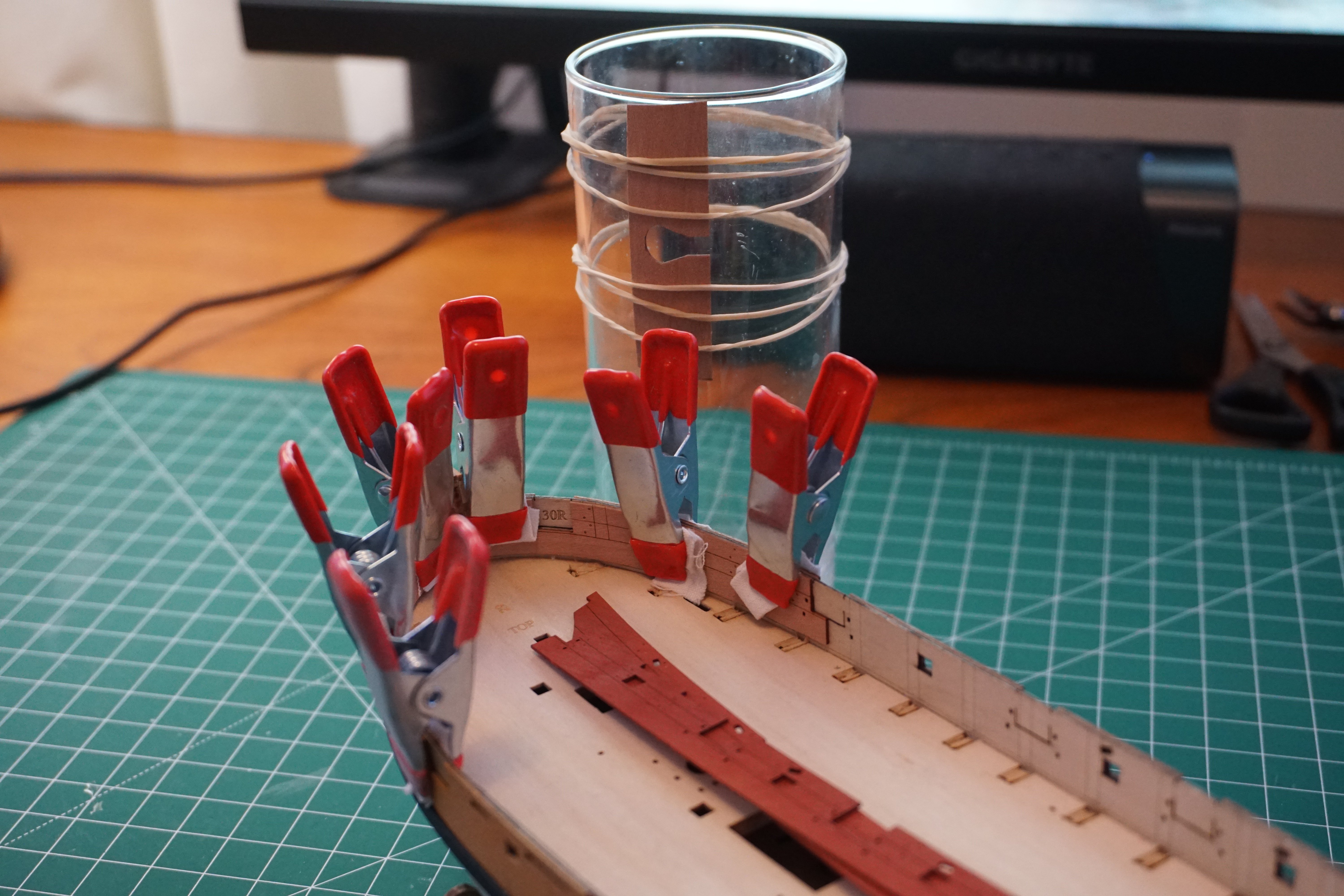

I deviated from the manual and attached the wales early, but then I realized that they make trimming excess wood from the stern and lower counter very difficult. Luckily I had only used CA, so the ends detached easily.
DSC07387.thumb.JPG.7712aead327c458a86421ee68f5af76e.JPGDSC07398.thumb.JPG.d91f7e085a5d6ce1cdd6962447c74950.JPG

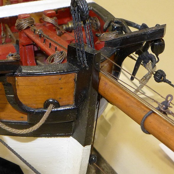

I painted the prow by hand after this contemporary model. The other side is red, but I might change that before I put the bulwarks and spirketting on.

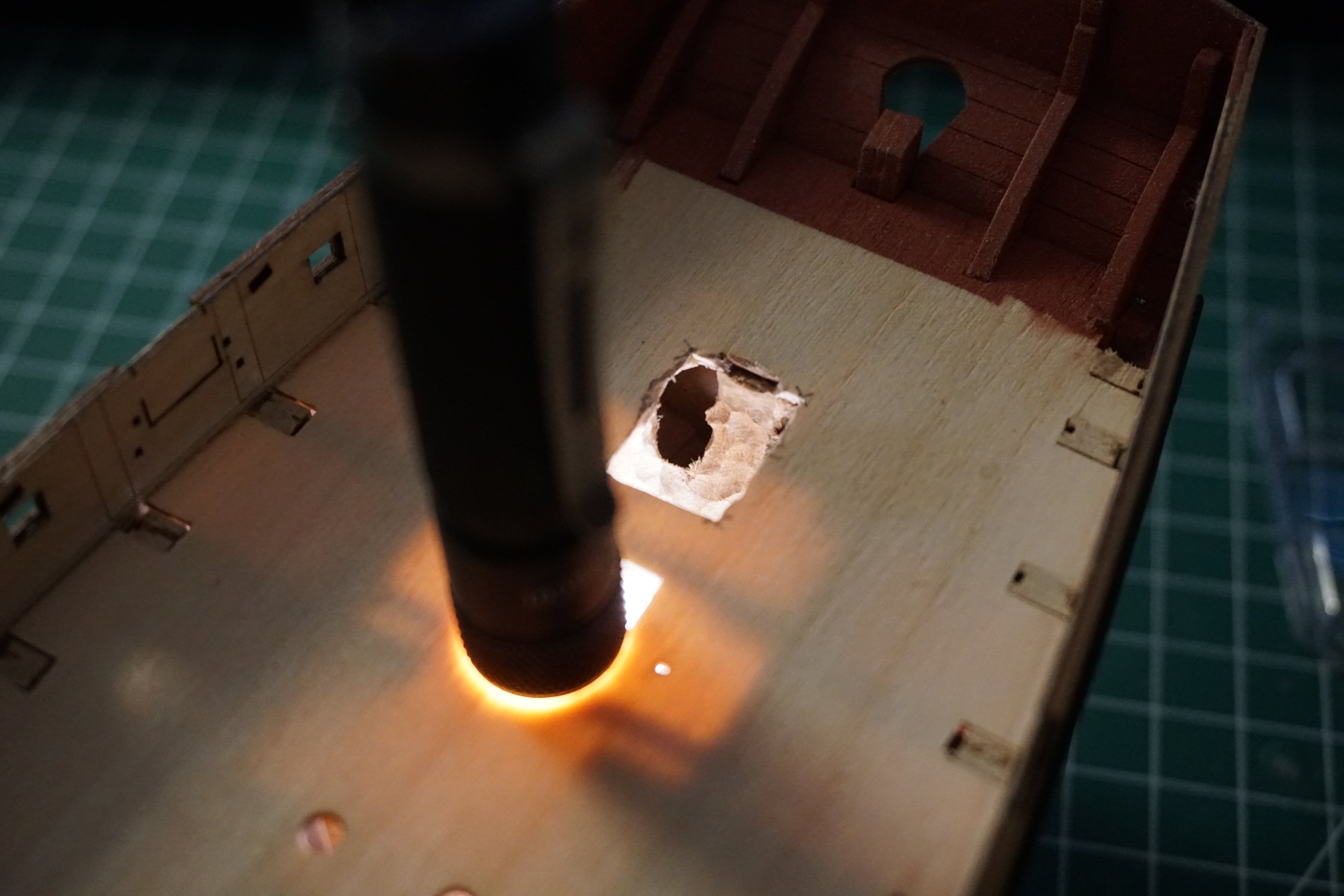

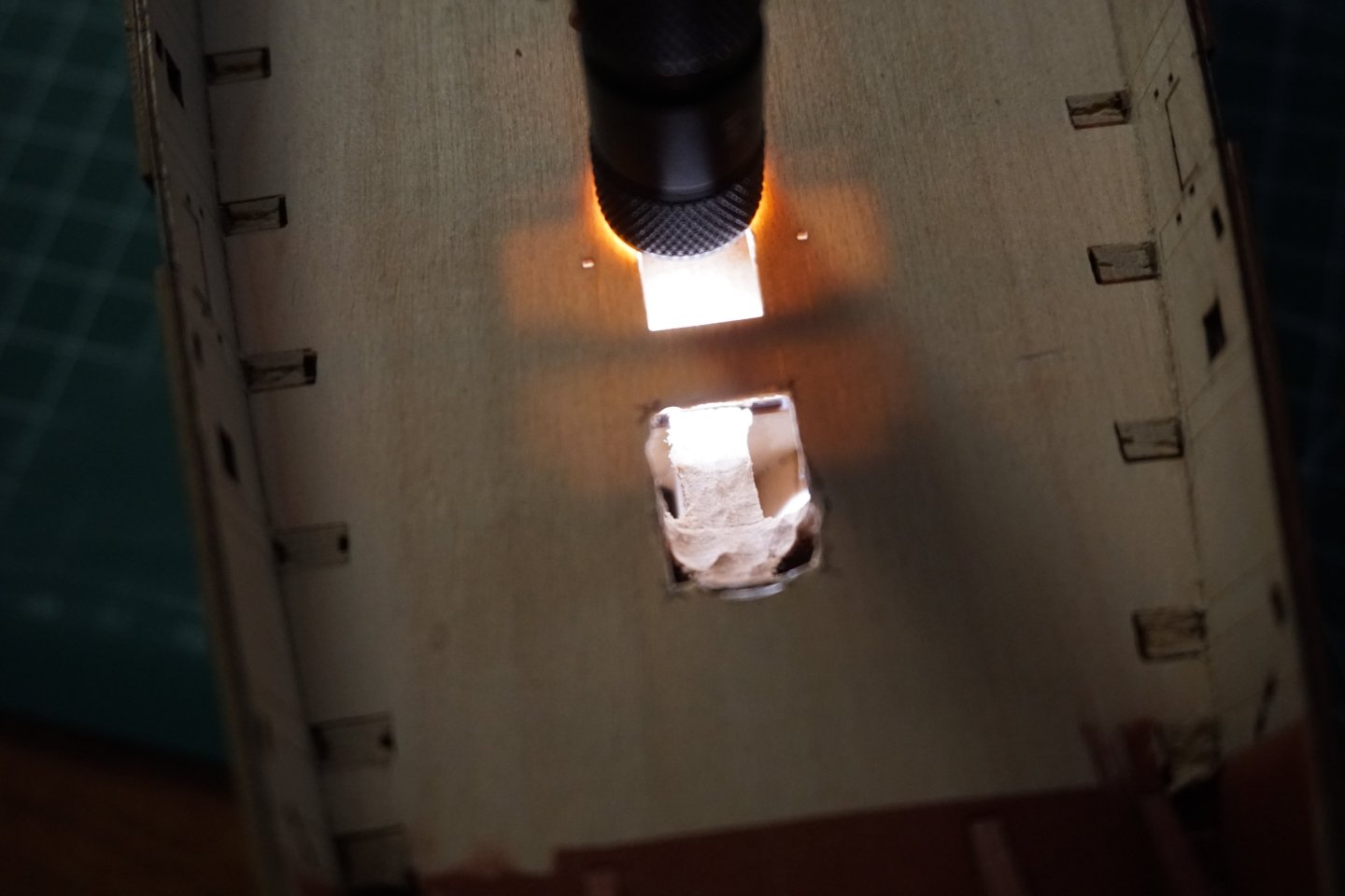

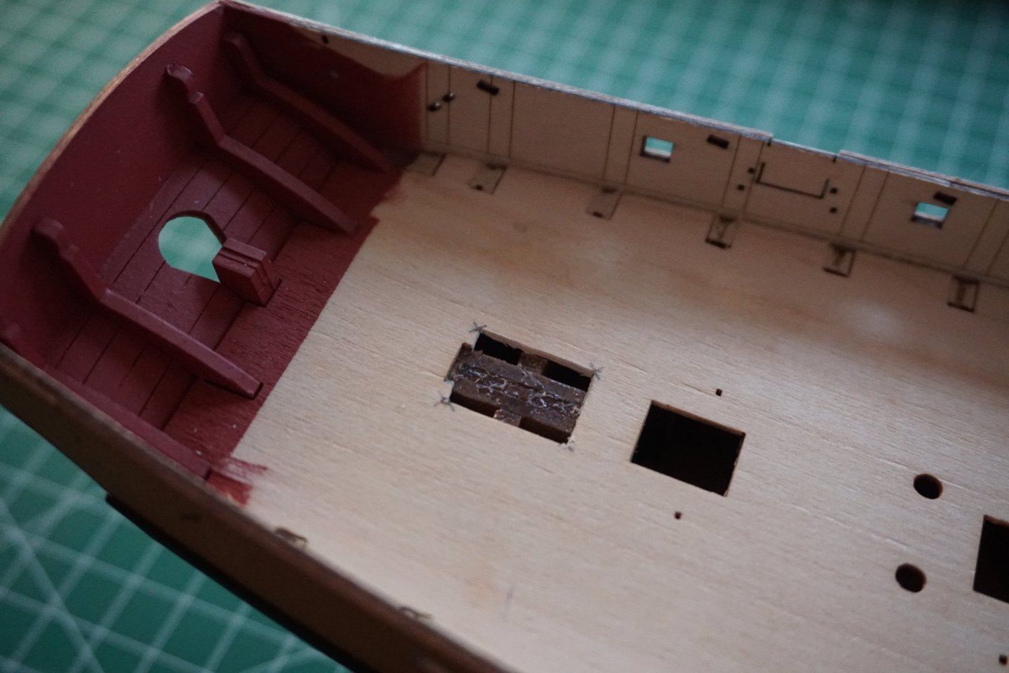

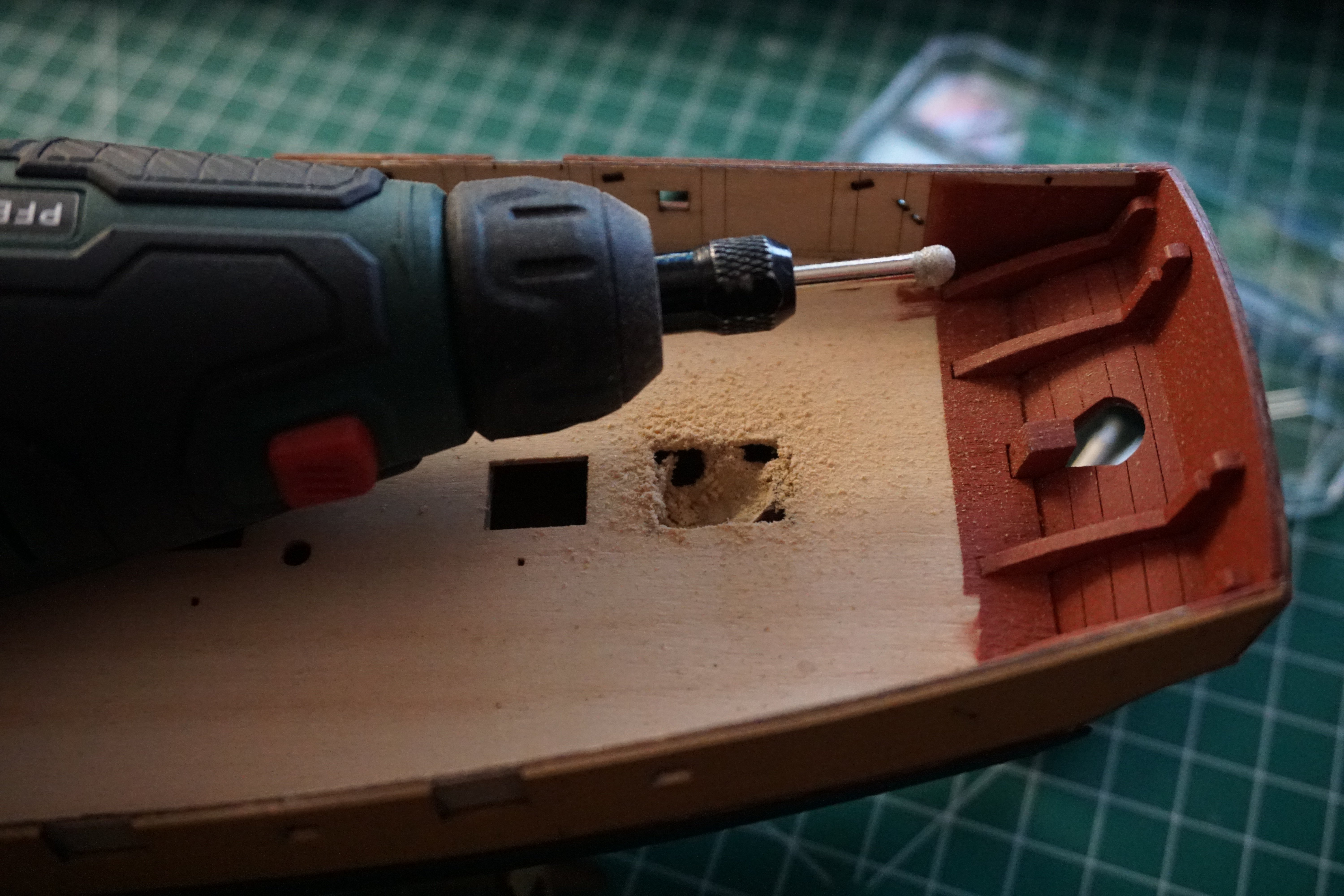

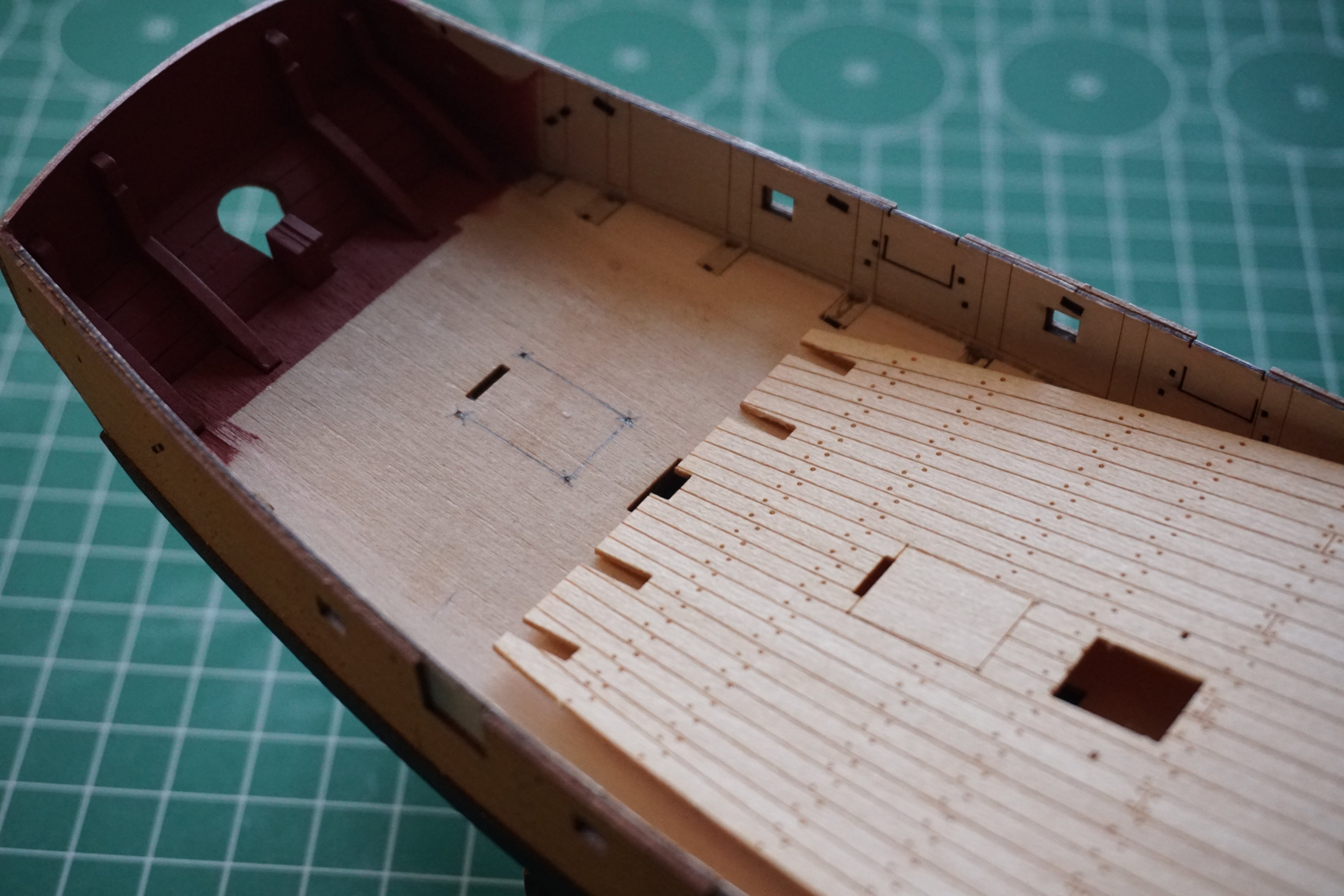

Before I glue the deck on, I'd like to explore the possibility of opening the companionway, as it could be a fun little project. Maybe the doors only, or the roof as well.
 There seems to be a lot of wood underneath it, but maybe that could be removed with Dremel engraving bits to make room for a ladder.
I keep finding small errors in my photos that I hadn't noticed in real life! This time it was the port-side wale that was a little too low. I re-attached the entire thing and it's better now.
Getting the wales on properly was a struggle for me, and I'd recommend shaping them with steam until they're a perfect fit. I only bent mine in one direction before putting the paint on.

That's probably deep enough. I could have just drilled down, but I opened the front as well, so that some light from the LEDs might shine into the companionway. I'll paint the interior black, if building the open companionway works out.
