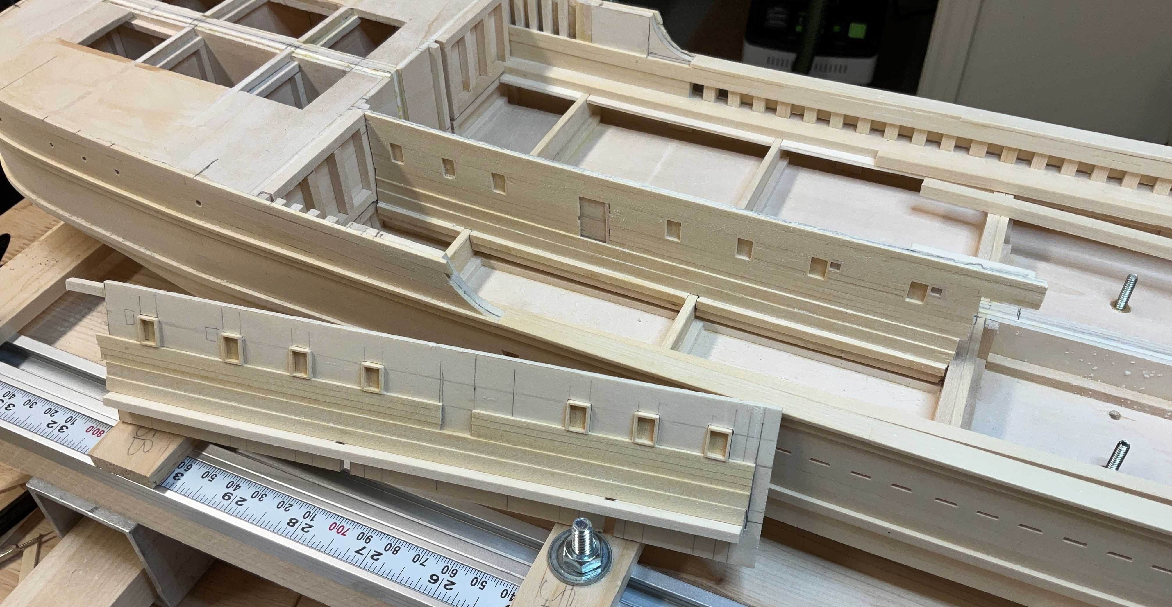

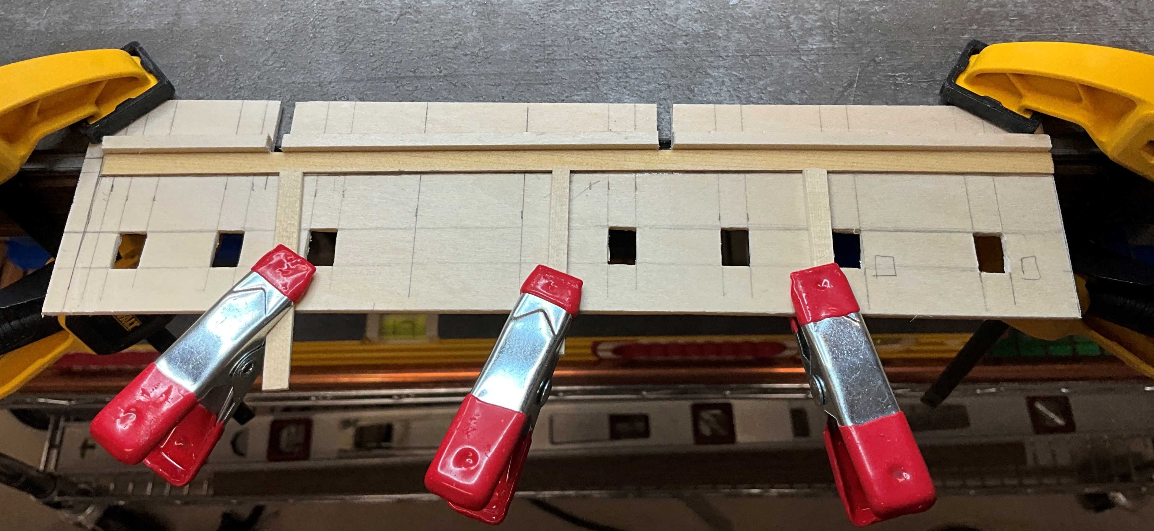

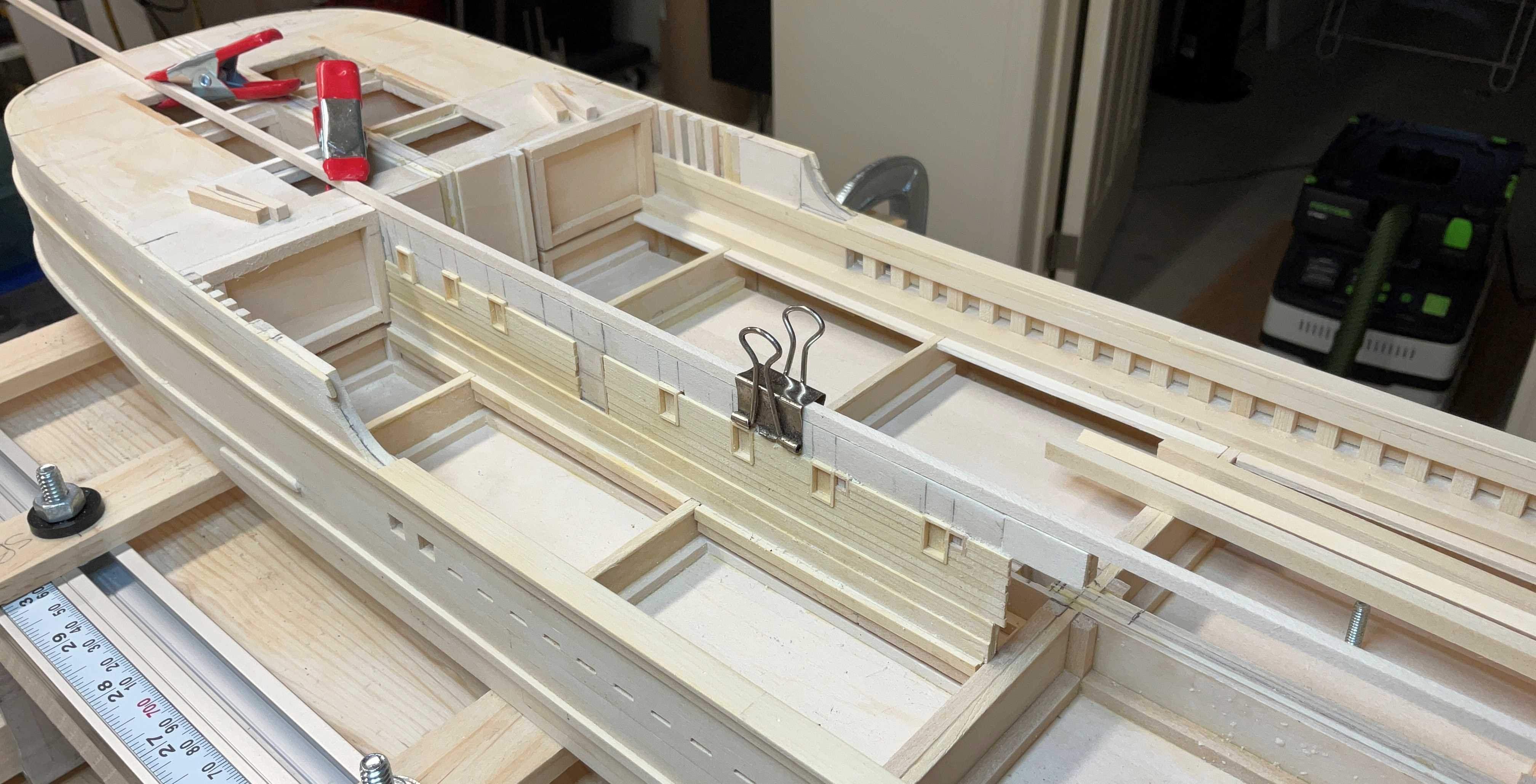

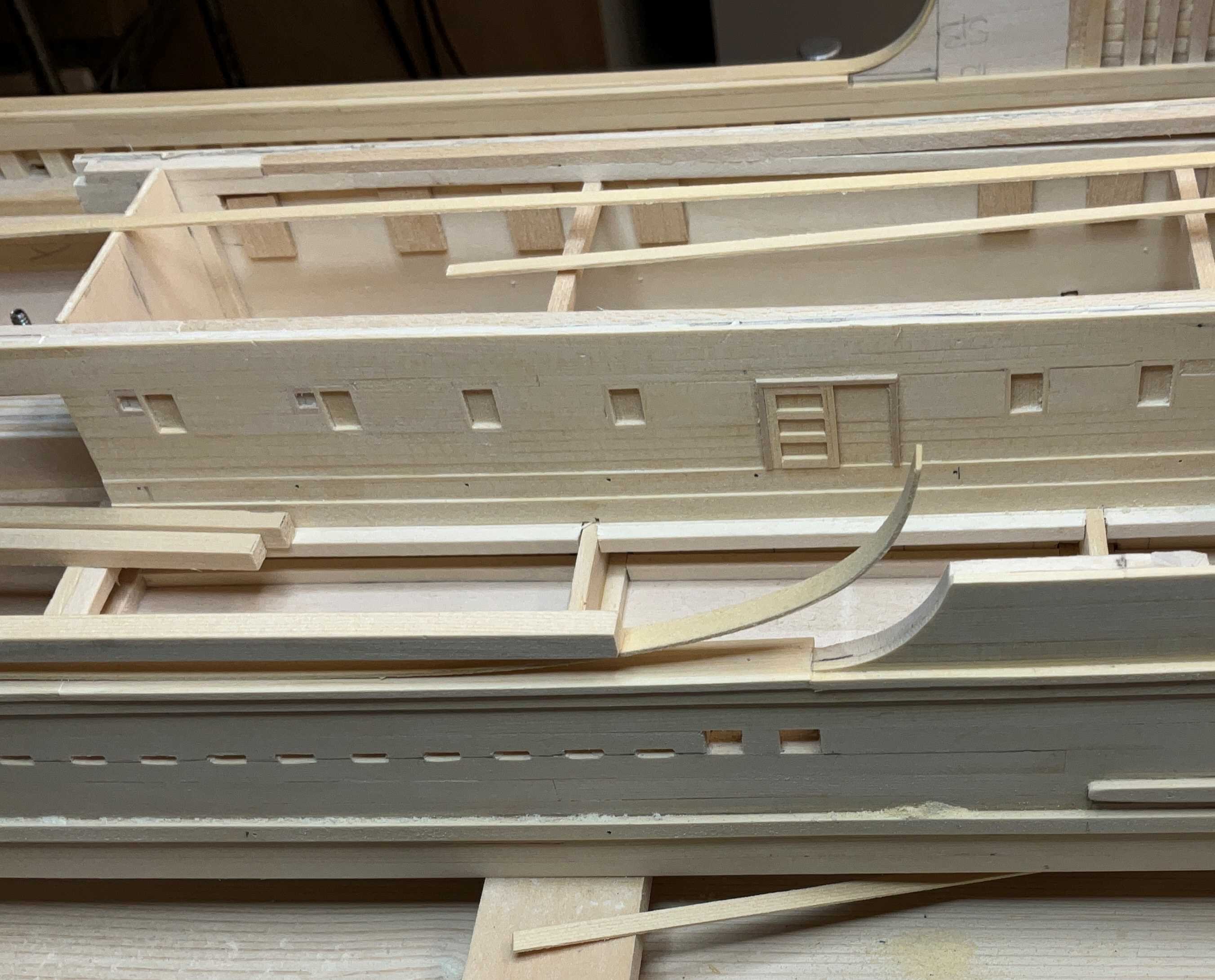

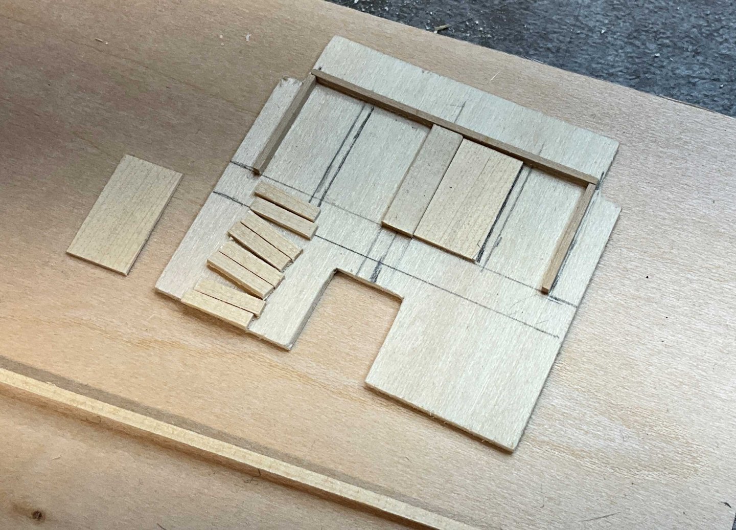

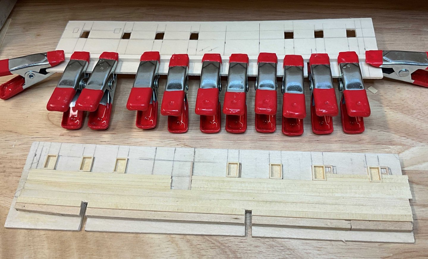

Hey Everyone, Hope you are all well. Thank you very much for your Comments and Likes.  The main deck house is close to completion. The house sits on top of the side stringer which sits on top of the main stringer so these stringers are being faked by using built-up planks. the main stringer is 3/32" thick and the side stringer is 1/16" thick. The siding is 1/32" thick. The window frames were made and put in place when the siding reached the bottom of the rough openings.
Once the siding reached the top of the windows the section of wall that extends out to the pillars had to be added. A length of 1/8 x 1/8" was clamped in place to get the proper sheer for this extension.
Some sanding was done to get the window frames flush with the siding.

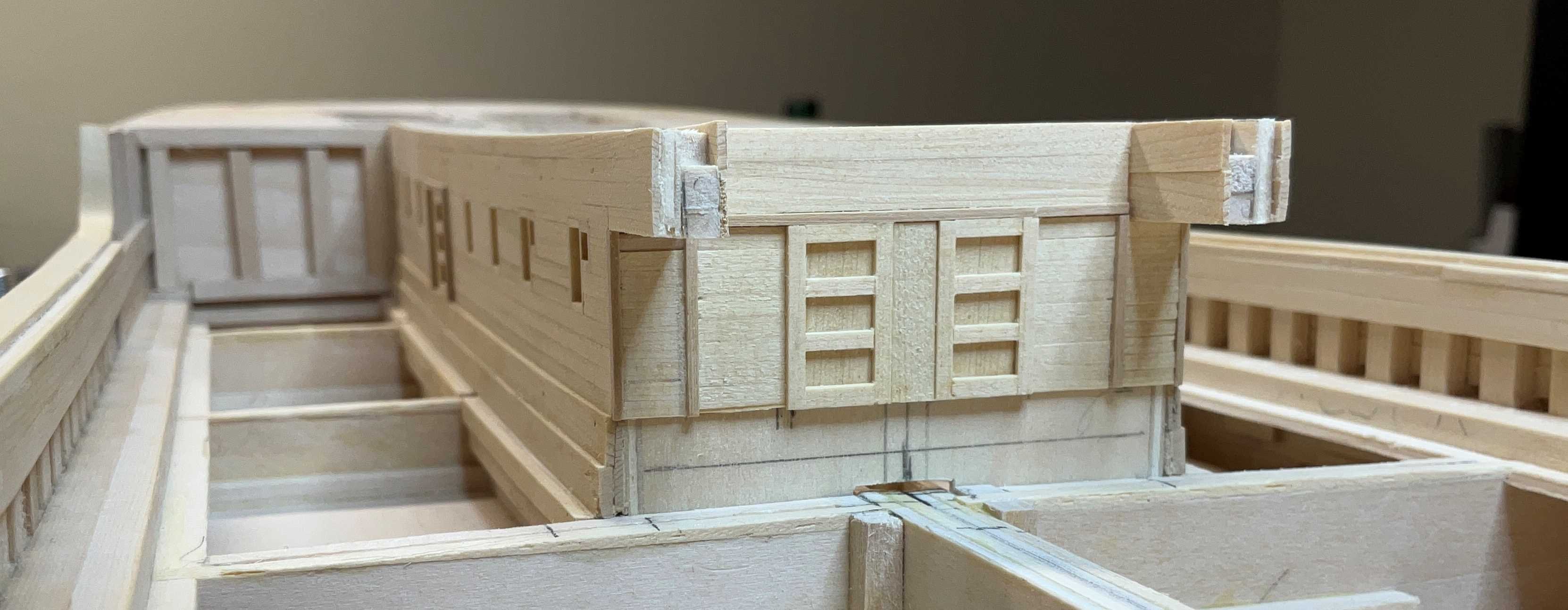

The sliding doors and some of the siding was was applied to the forward end of the house because it is easier to do it now.
Then everything is dry fitted

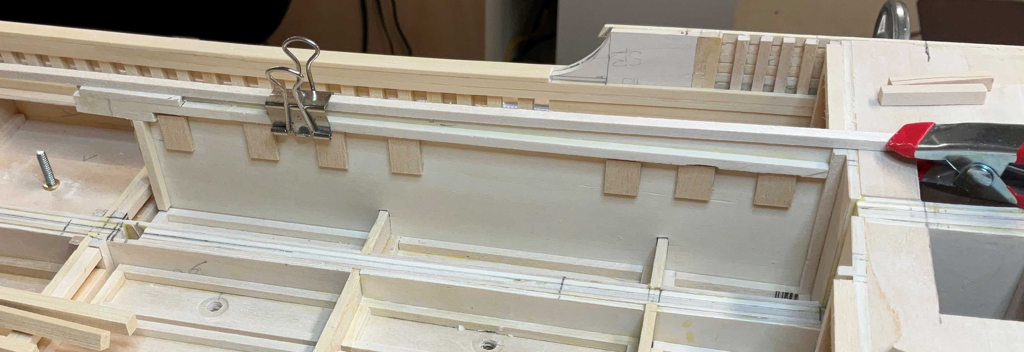

The stanchions that support the boat deck were made from 3/32" x 3/32" cherry. They needed to have 1/32" removed from the lower end where they overlap the side stringer. A 1/8" thick clear plastic 6 inch ruler was used to help file the wood to the proper thickness. You can file on these rulers all day and they just keep hanging in there.
These stanchions will be pinned in place and then removed before the house is permanently mounted.

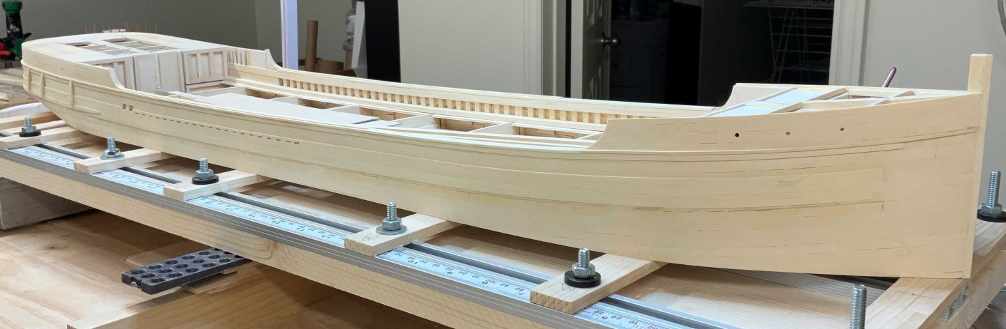

This is her now. Next I think the main deck house will be glued together, sanded, painted and mounted so that the stringers can be installed.

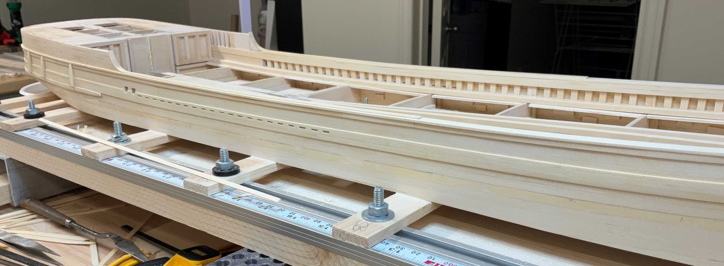

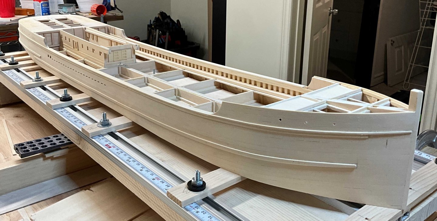

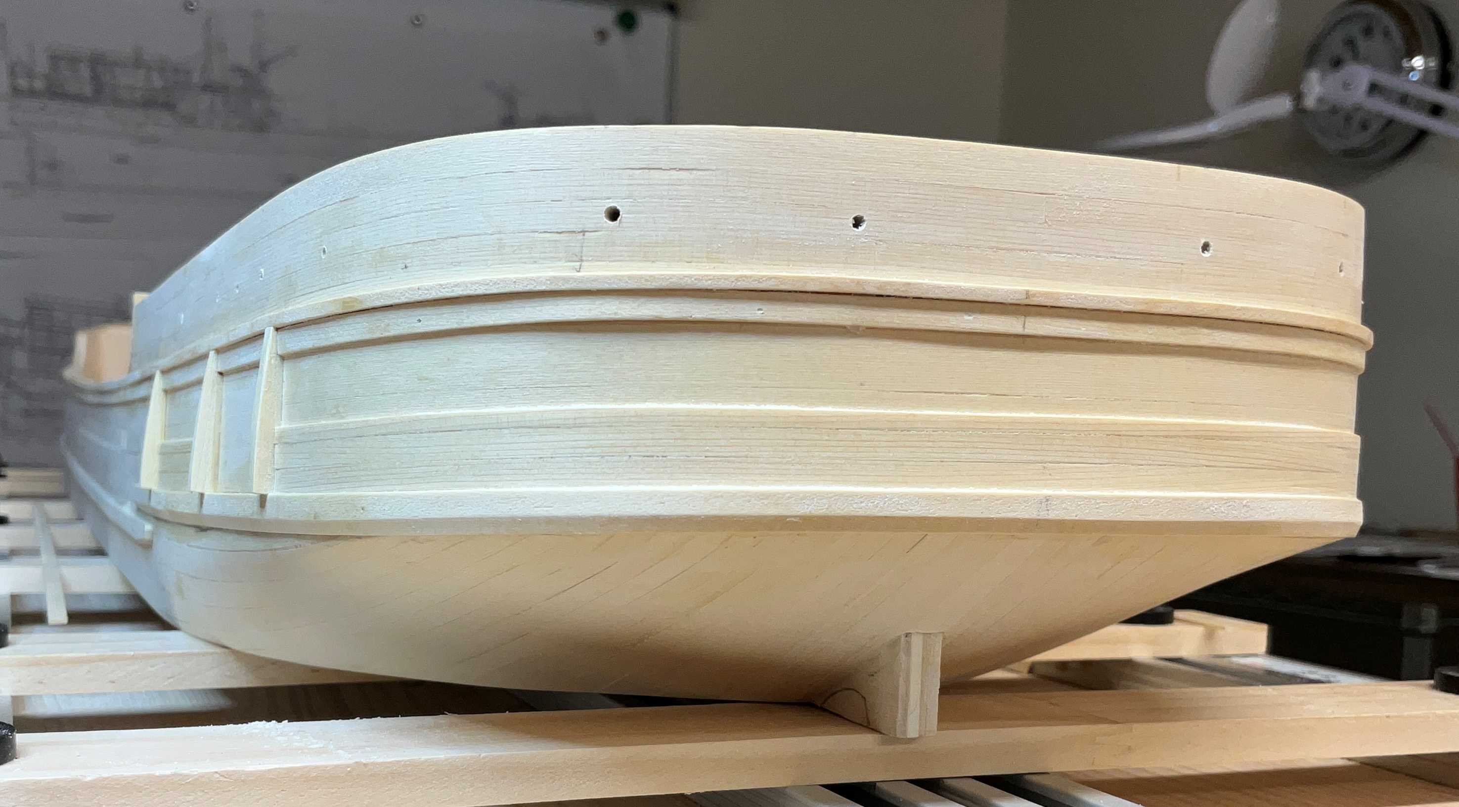

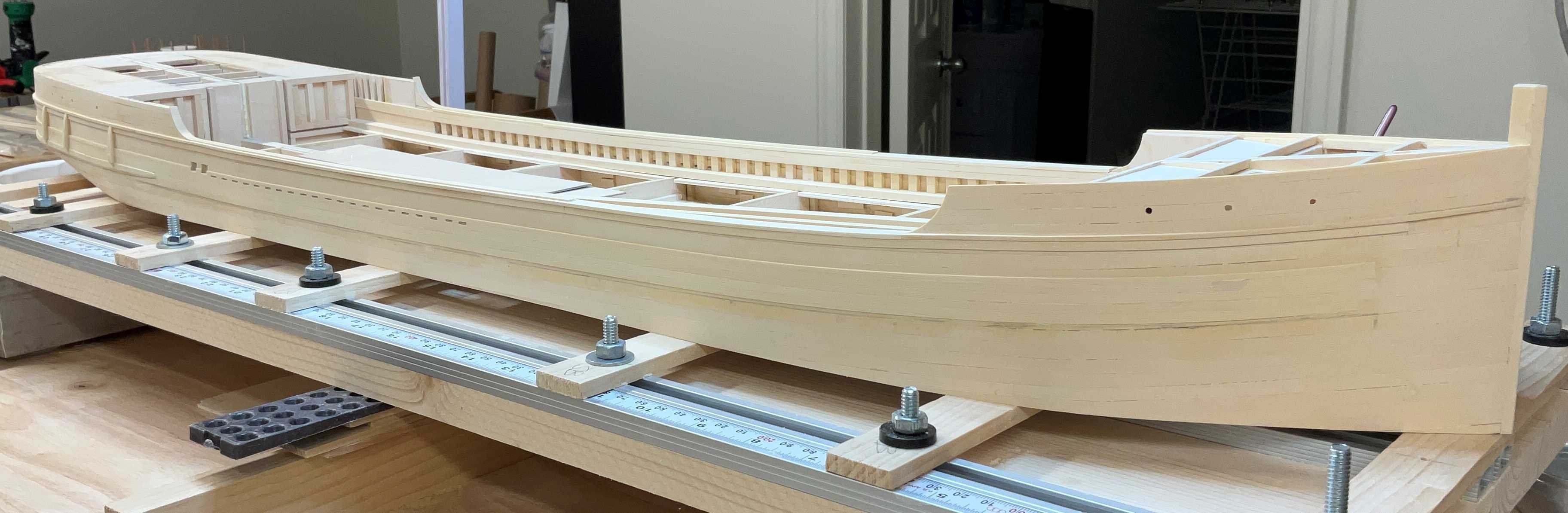

Hi Everyone, hope you are all well. Thank you for the Comments and Likes. I had a bit of a setback last week. This is part of a photo that Phil @Dr PR posted in his SS Wapama 1915 Steam Schooner thread. I had not noticed in other photos or drawings how prominent the planks just above the guard at the stern were.
Wapama1.jpg.3d553e8eef5b03ff5d0124b48e035247.jpg.dfbe5e6f635975e07dbb1dba5e11f755.jpg

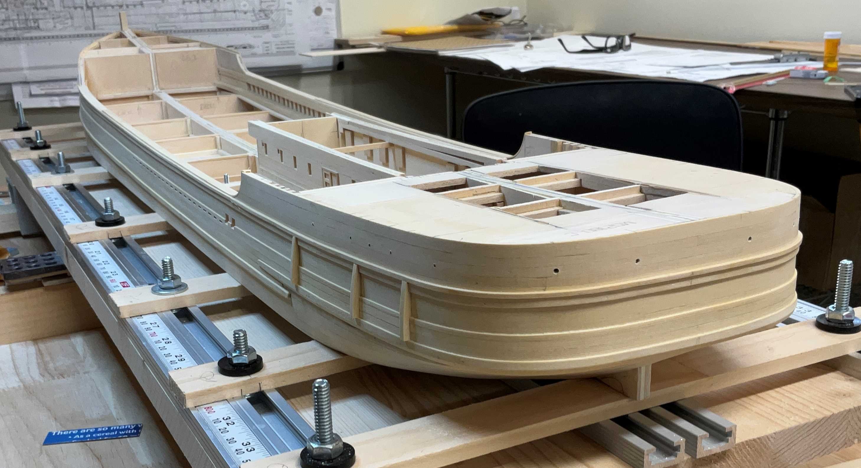

The drawings show that the bulwark planks are 3 3/4" thick and the hull planking is 4 1/2" thick. Adding this detail would mean that these planks would have to extend down to the guards all the way to the bow. The guards would hide the fact that 1/32" planks were added. Well that's the hope anyway.

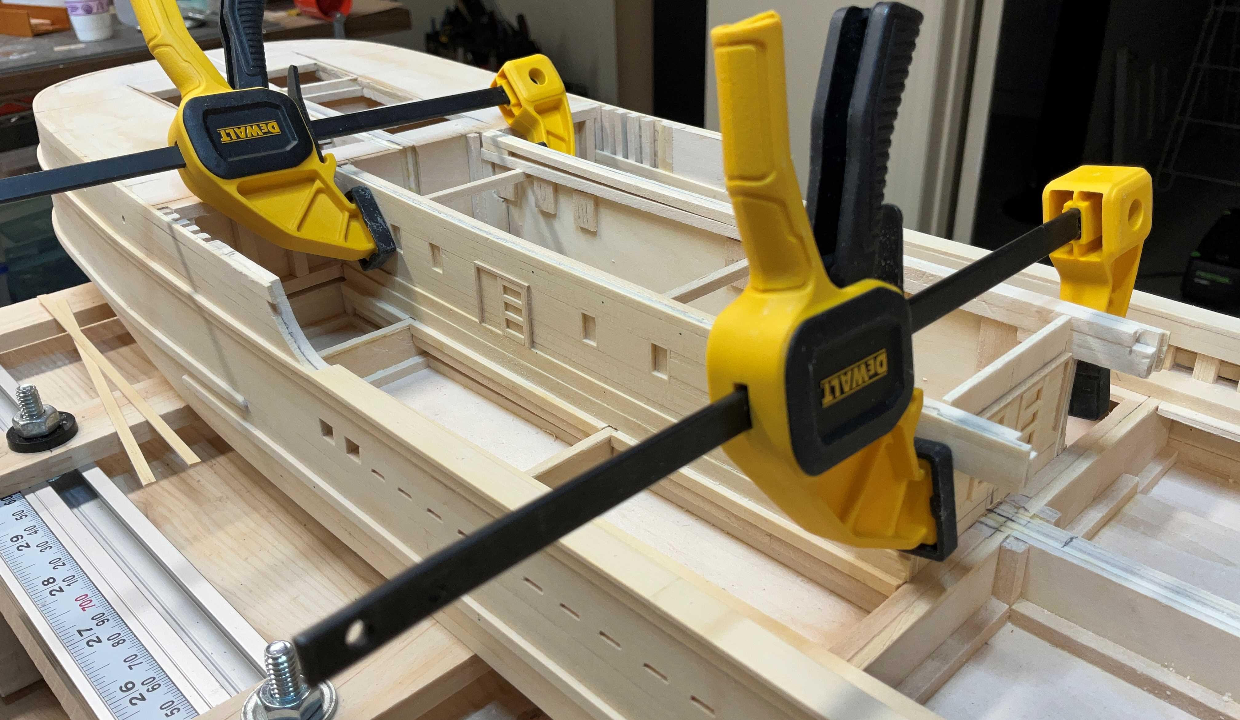

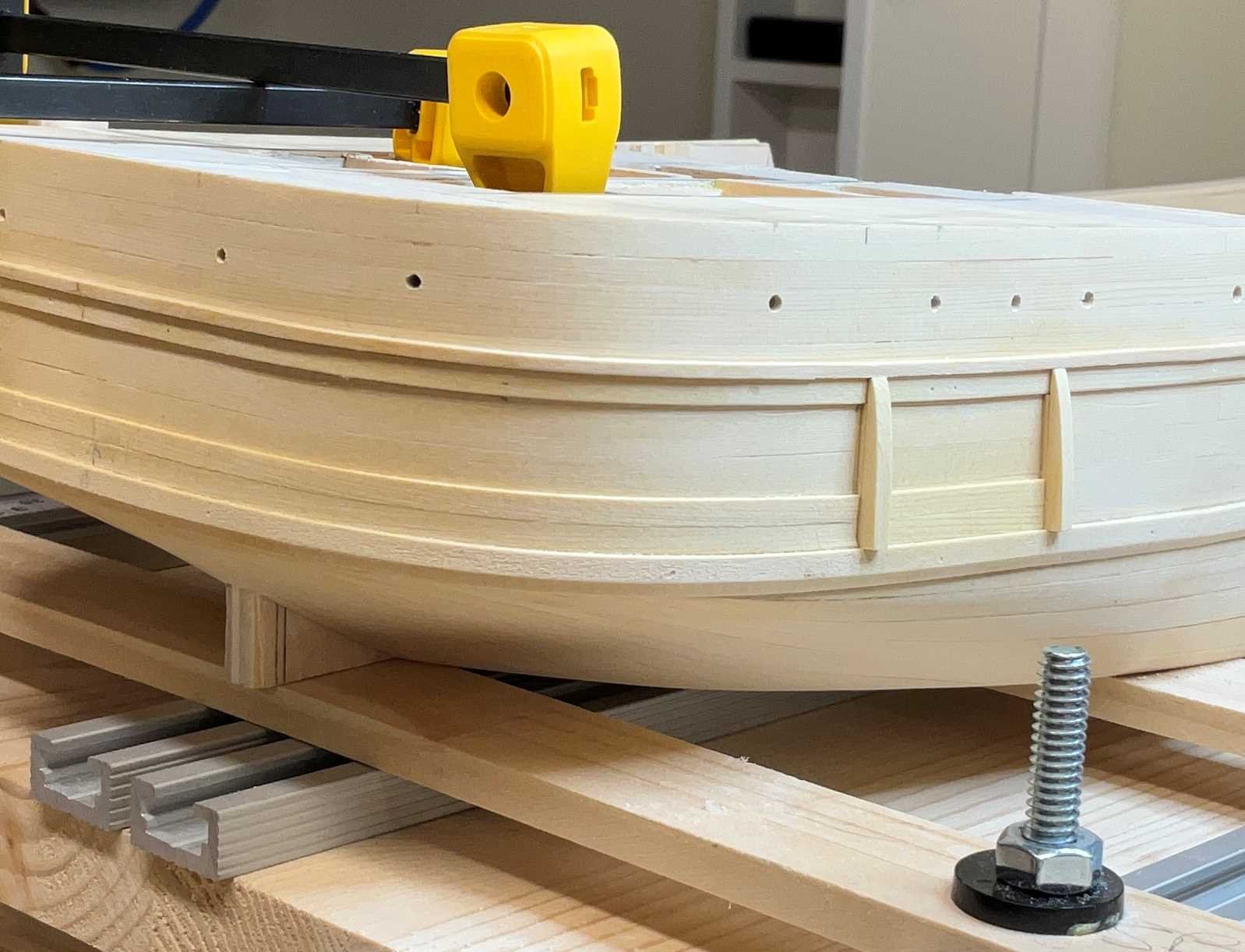

Starting at the stern, three strakes were added. Two @ !/32"x1/8" and one @ 1/32"x5/64". The scuppers had to be filed into the new veneer planks.

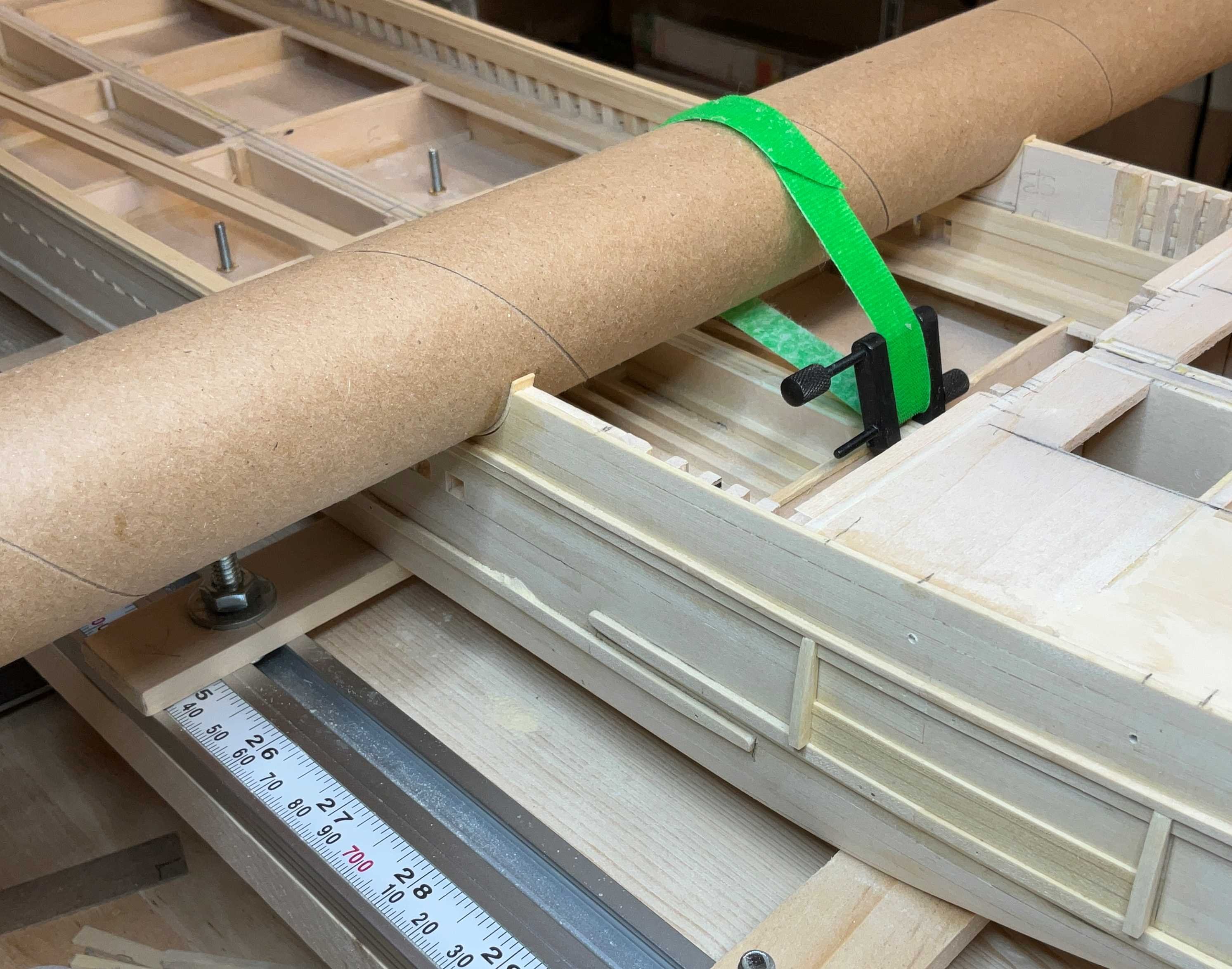

I decided to remove the guards port and starboard because they drifted down a bit at the bow. Gluing the new guards back on under the new planking went a lot easier. The new planks were feathered into the hull planks at the bow before they get to the metal anchor protection plates

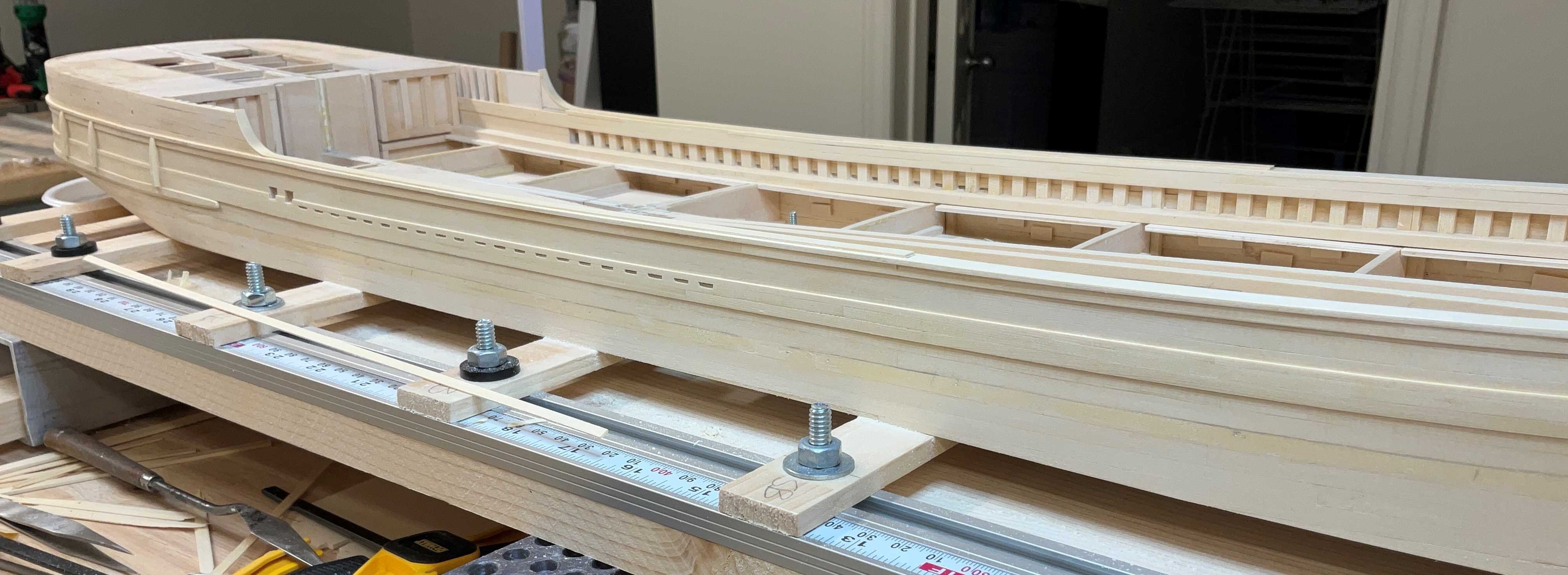

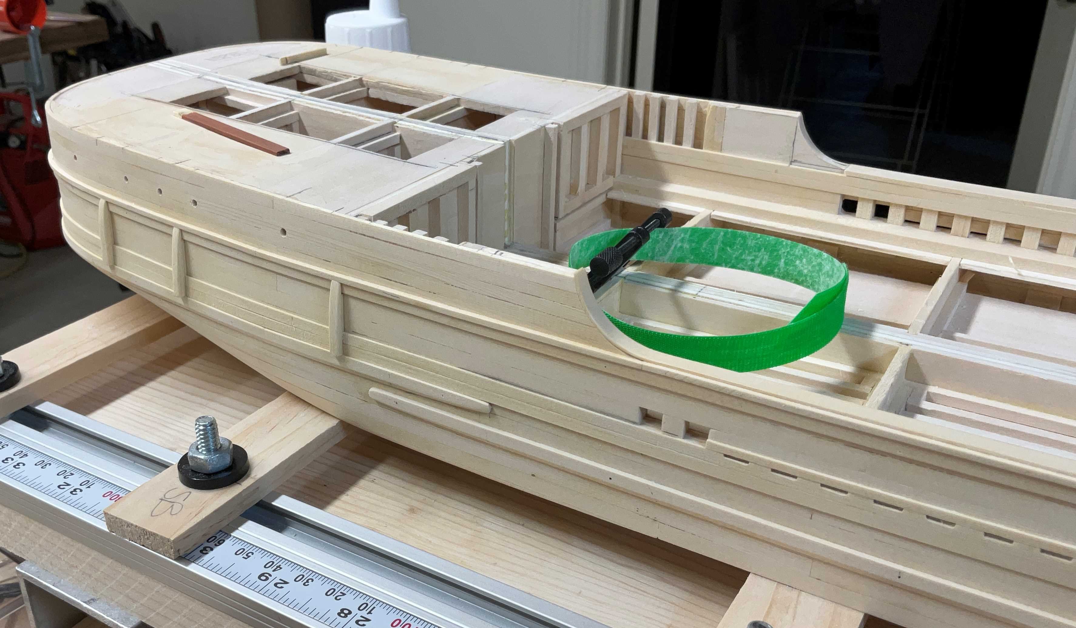

While this was going on the chafing planks were attached to the main rails. I just happened to have a rigid cardboard shipping tube that was the right size to hold it at the curved part.

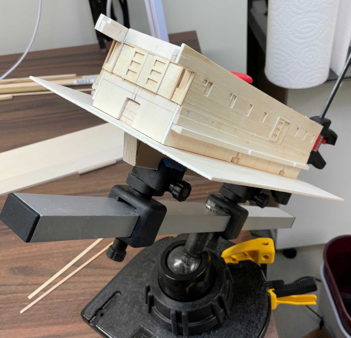

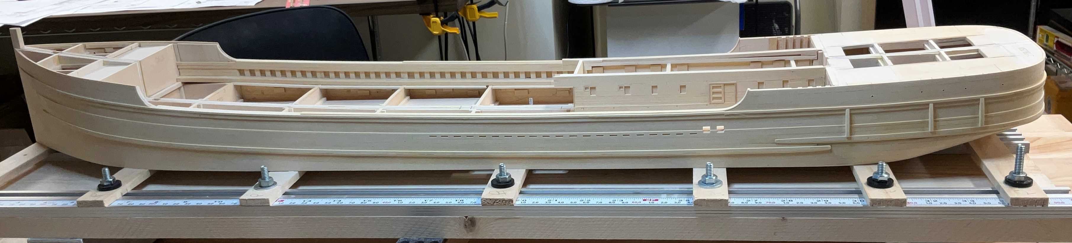

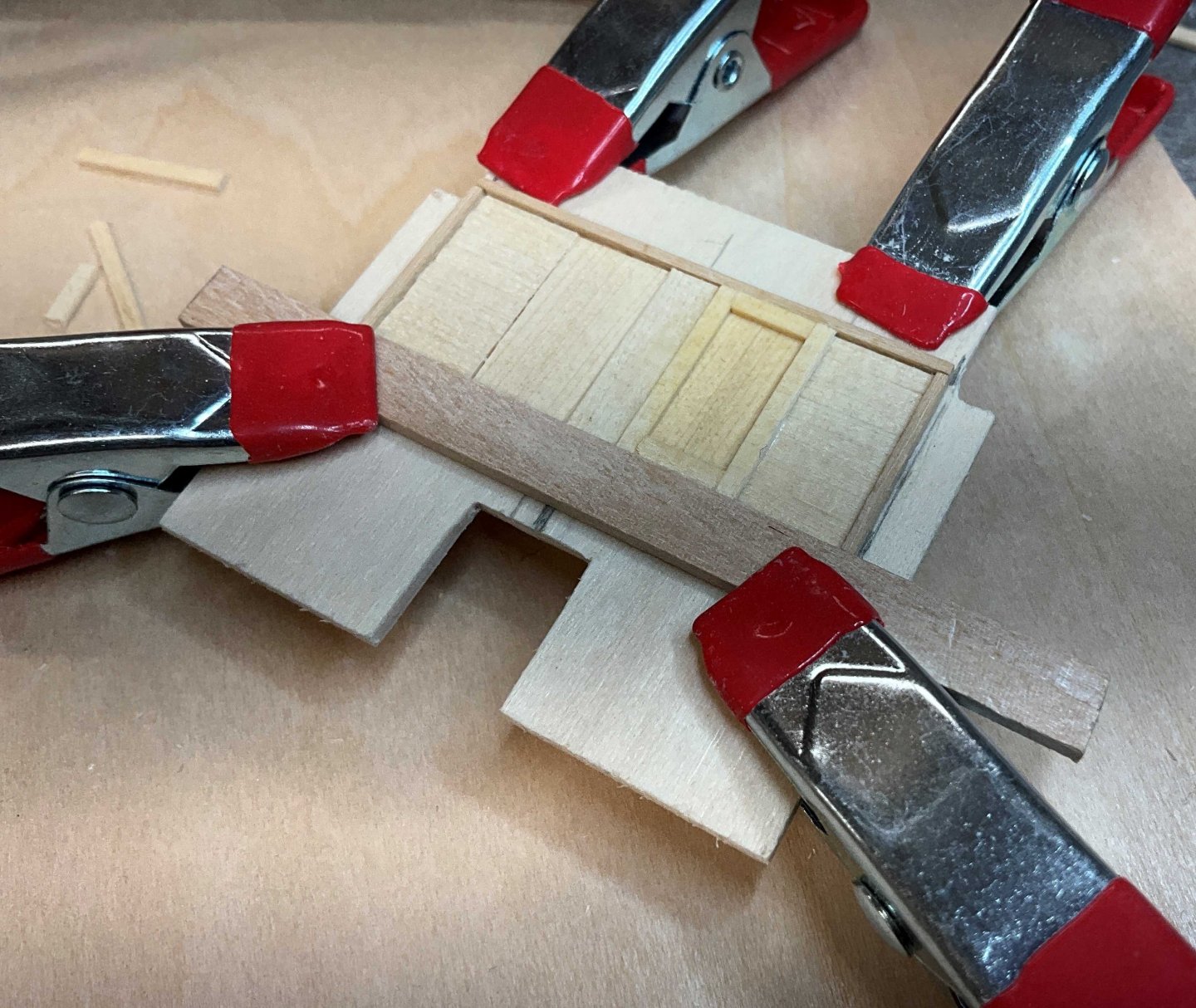

The main deckhouse was glued together and placed on a jig in order to complete the doors and siding.

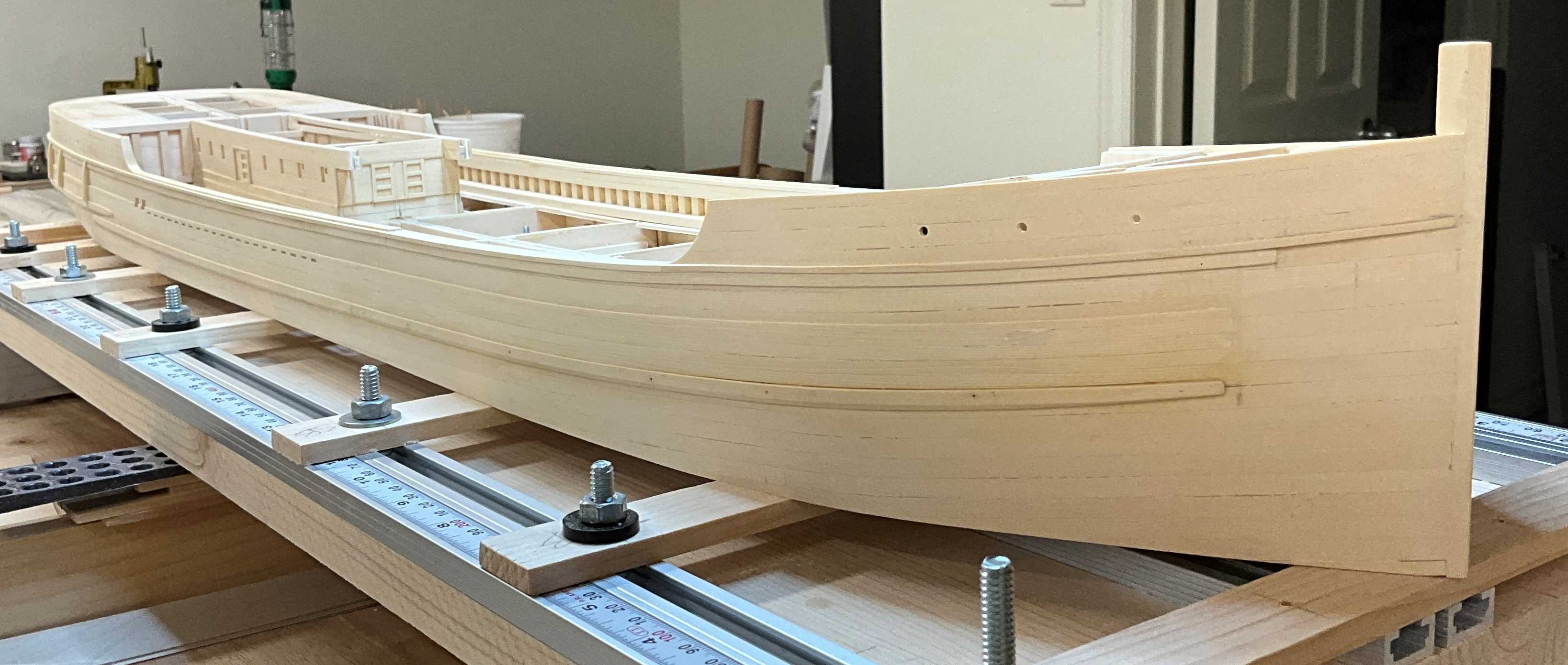

This is what she looks like today.
Next will be the hawse pipes and portlights. Hope to see you then.
Best Regards……..Paul
