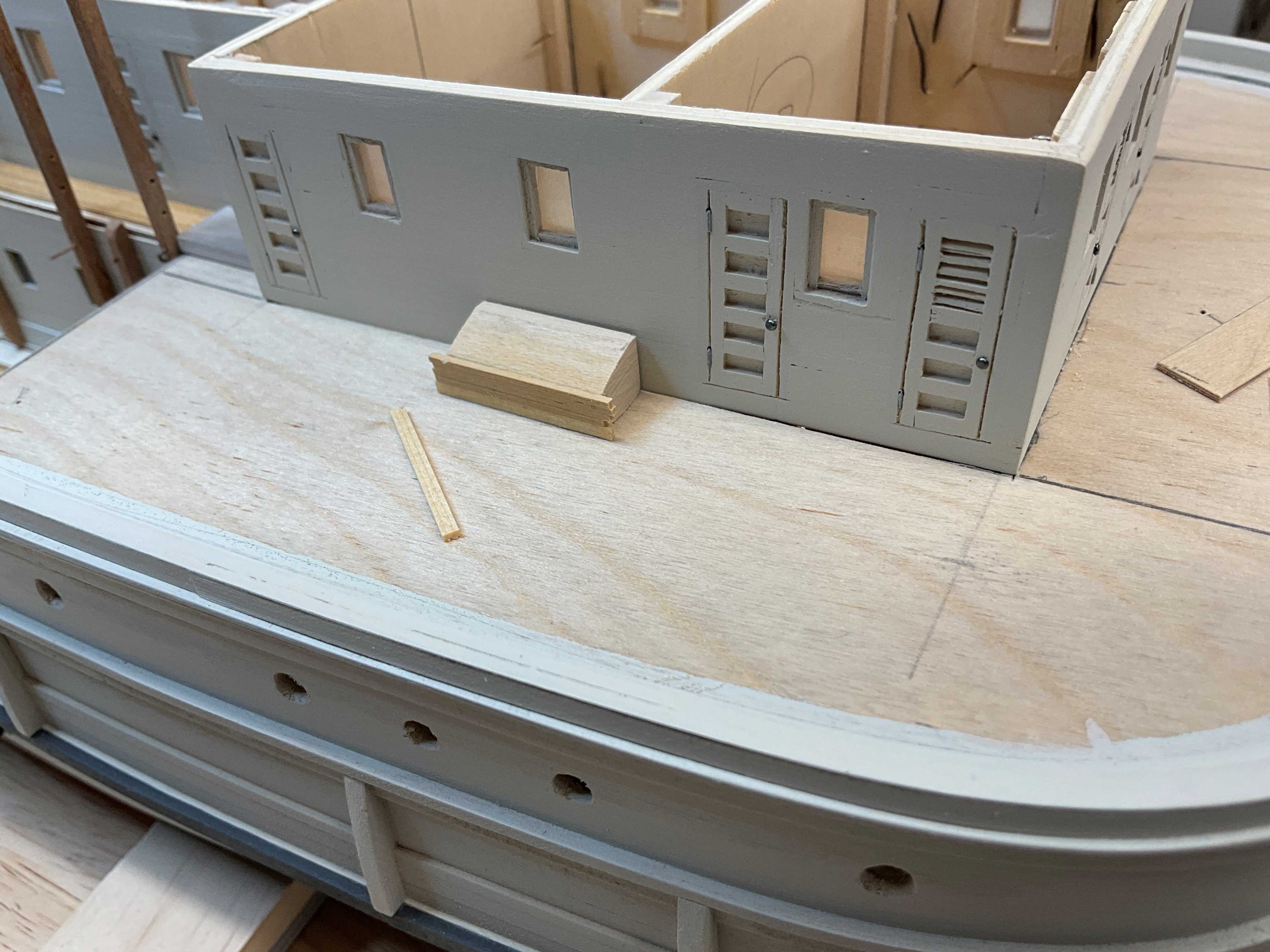

Hi Keith, thank you. The hinges were made from 26 gauge wire. The paint was burned off and and then it was bent into an L shape. The long end was pushed through the hole and bent over. It was glued with E6000 glue to keep it from turning. I didn't like the way they looked. They were all different colors so I gave the whole wall another light coat of paint. The door knobs are steel pins with the heads reduced in size and then heated red hot. they came out a grey color. As usual by the time I do the last one I'll have it figured out

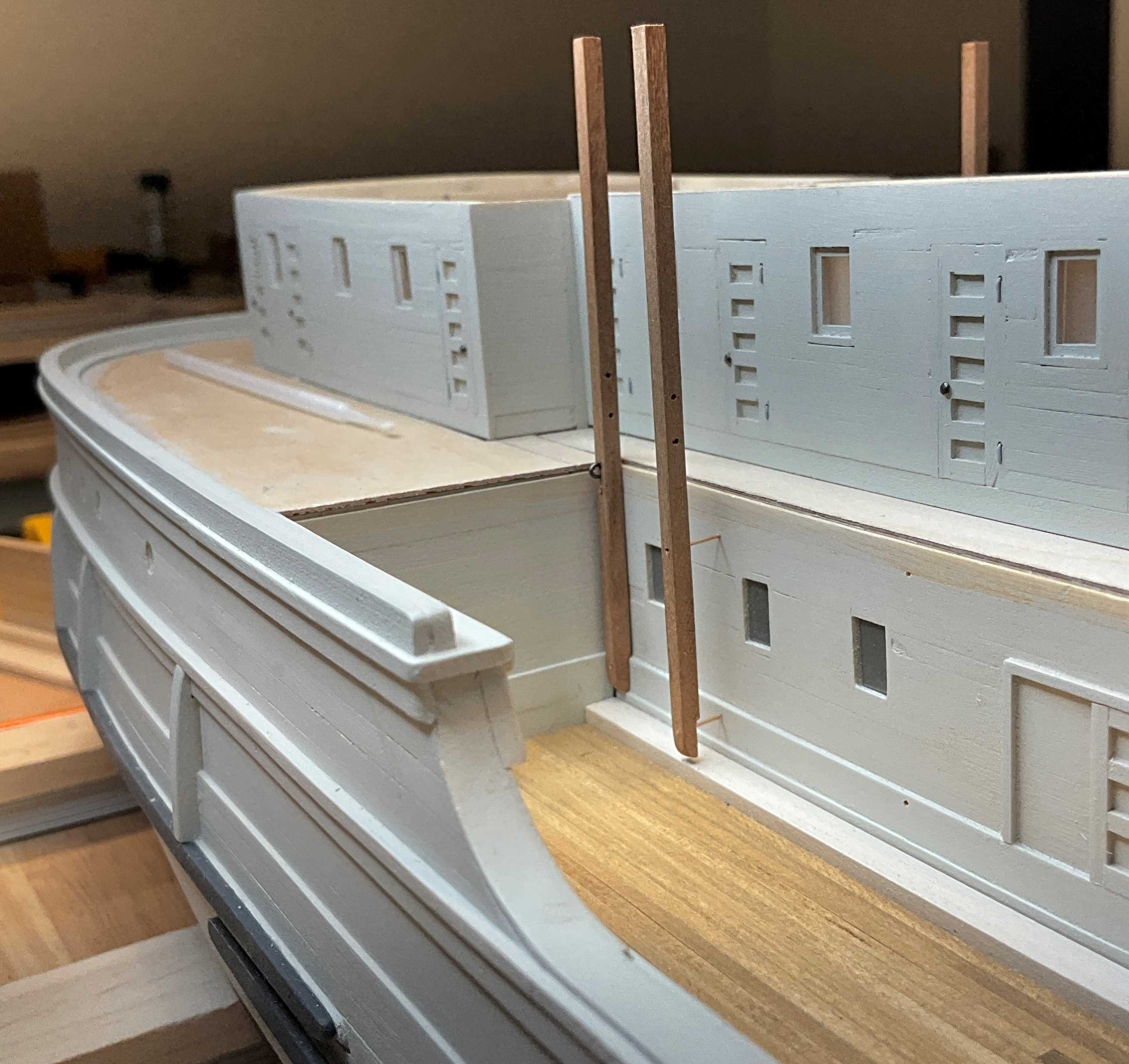

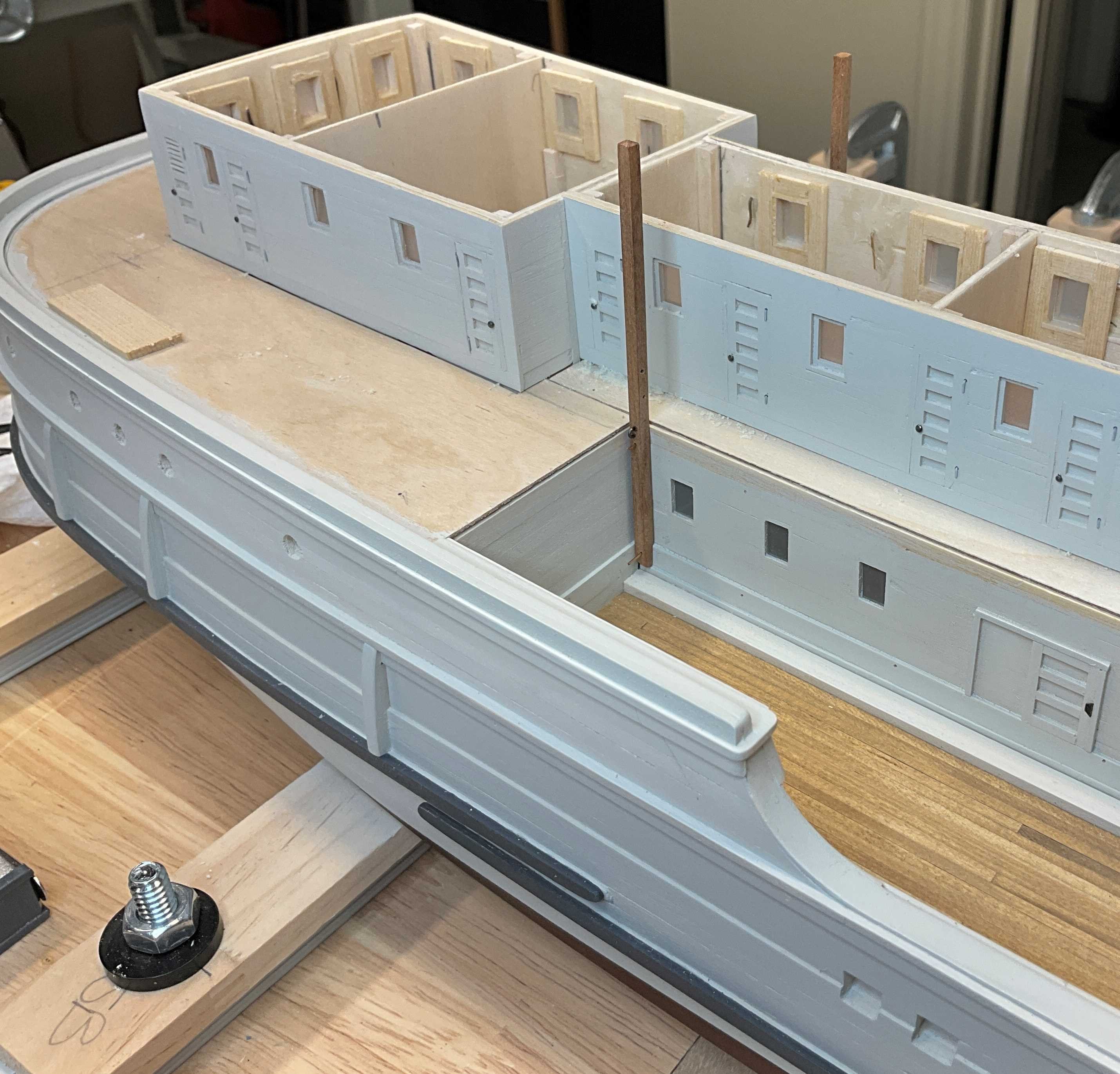

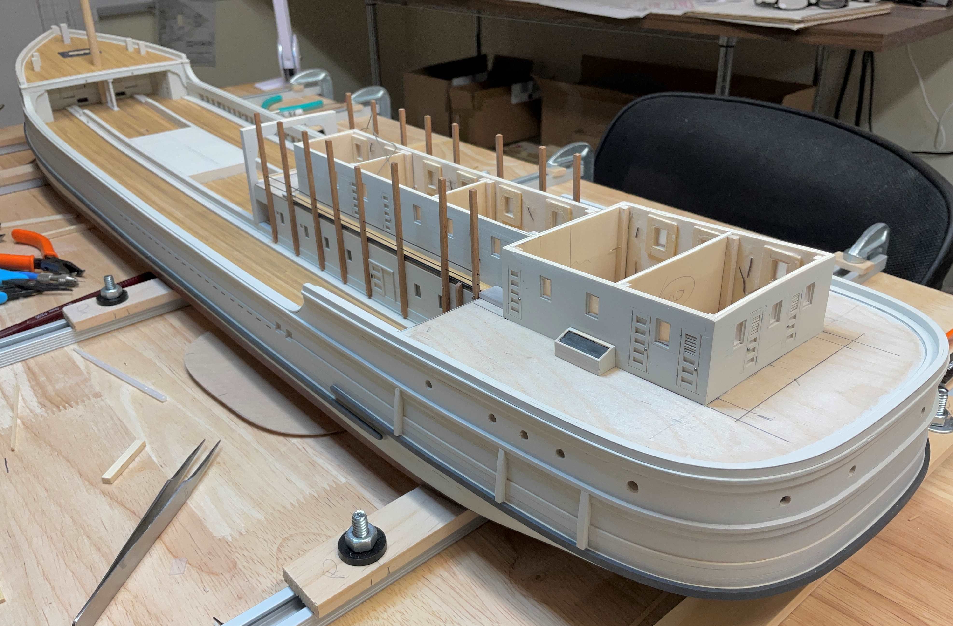

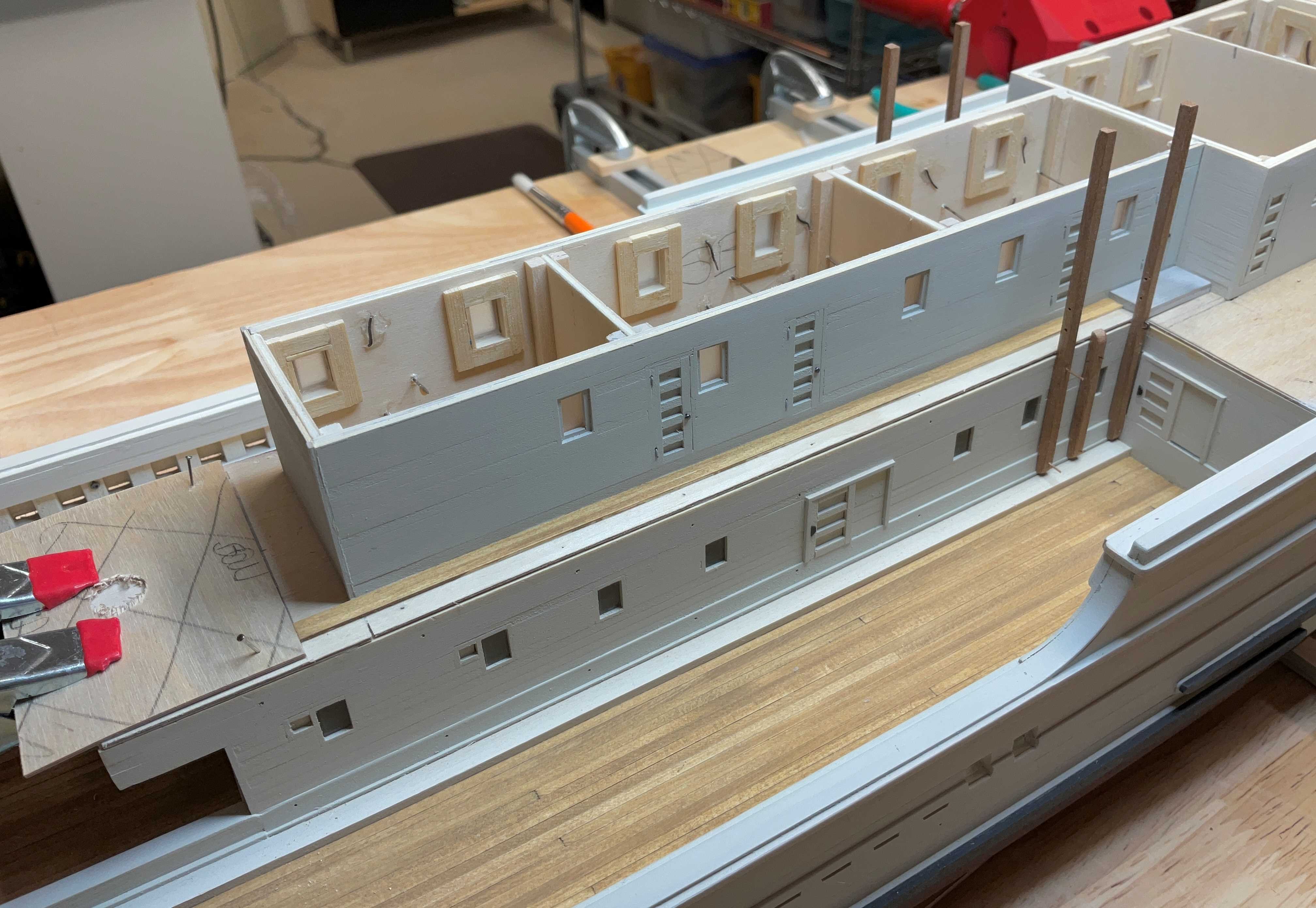

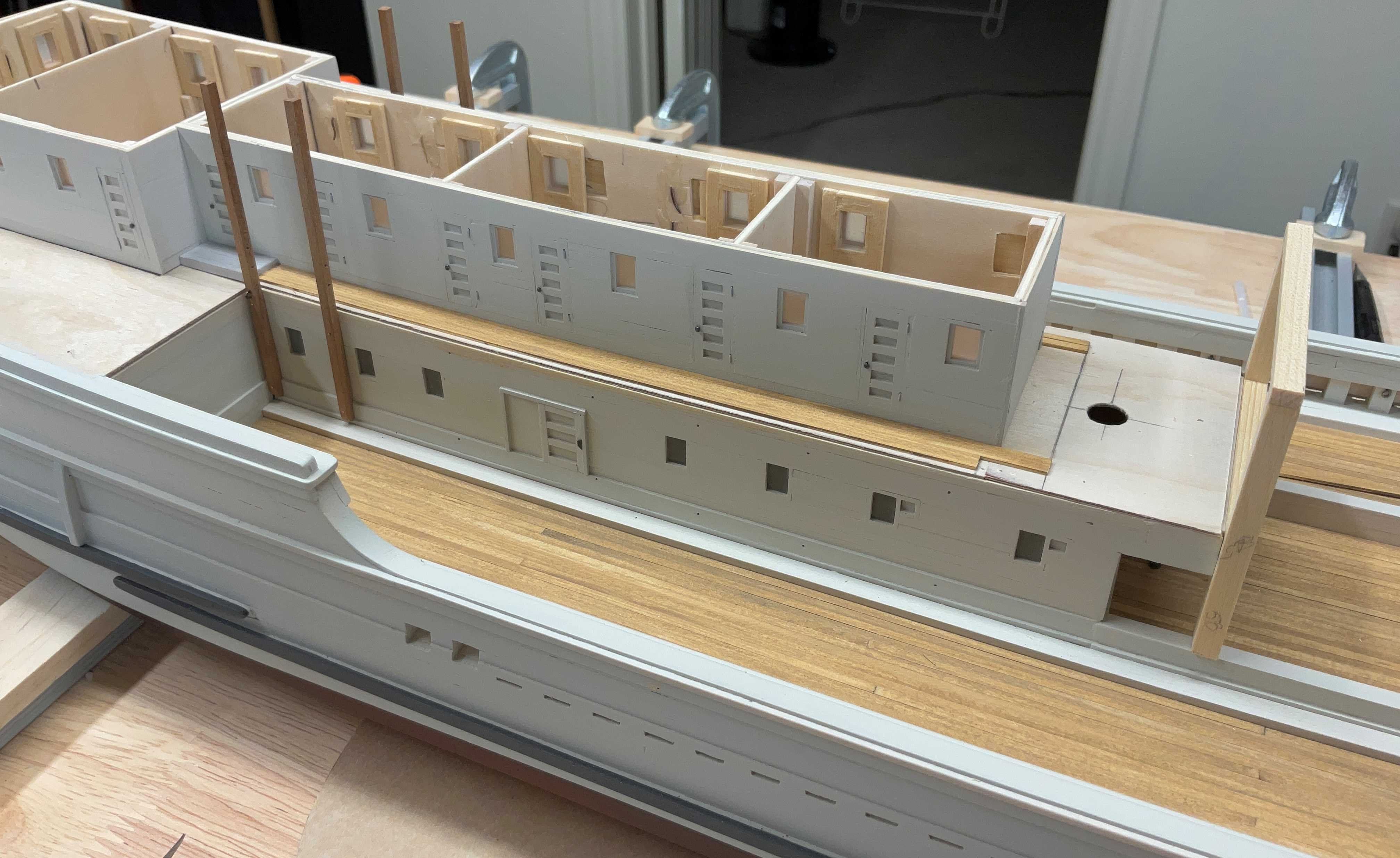

Hey Everyone. hope you are all doing good. Thank you very much for the Comments and Likes. This update will be about the completion of the aft cabins. Once most the siding was installed, the parts were dry fitted in place to check for square.
The parts were then glued together and weighted down for a day.
The structure was then removed and the siding was finished
After a couple of coats of paint the cabins were installed
I guess my mind was elsewhere because I forgot to glaze the windows first but it still went okay. The glazing was made from a divider from a spiral wound notebook. One side is glossy and the other side has a rough texture so the glossy side faces out. They were a friction fit but white PVA was still used to hold them in place.

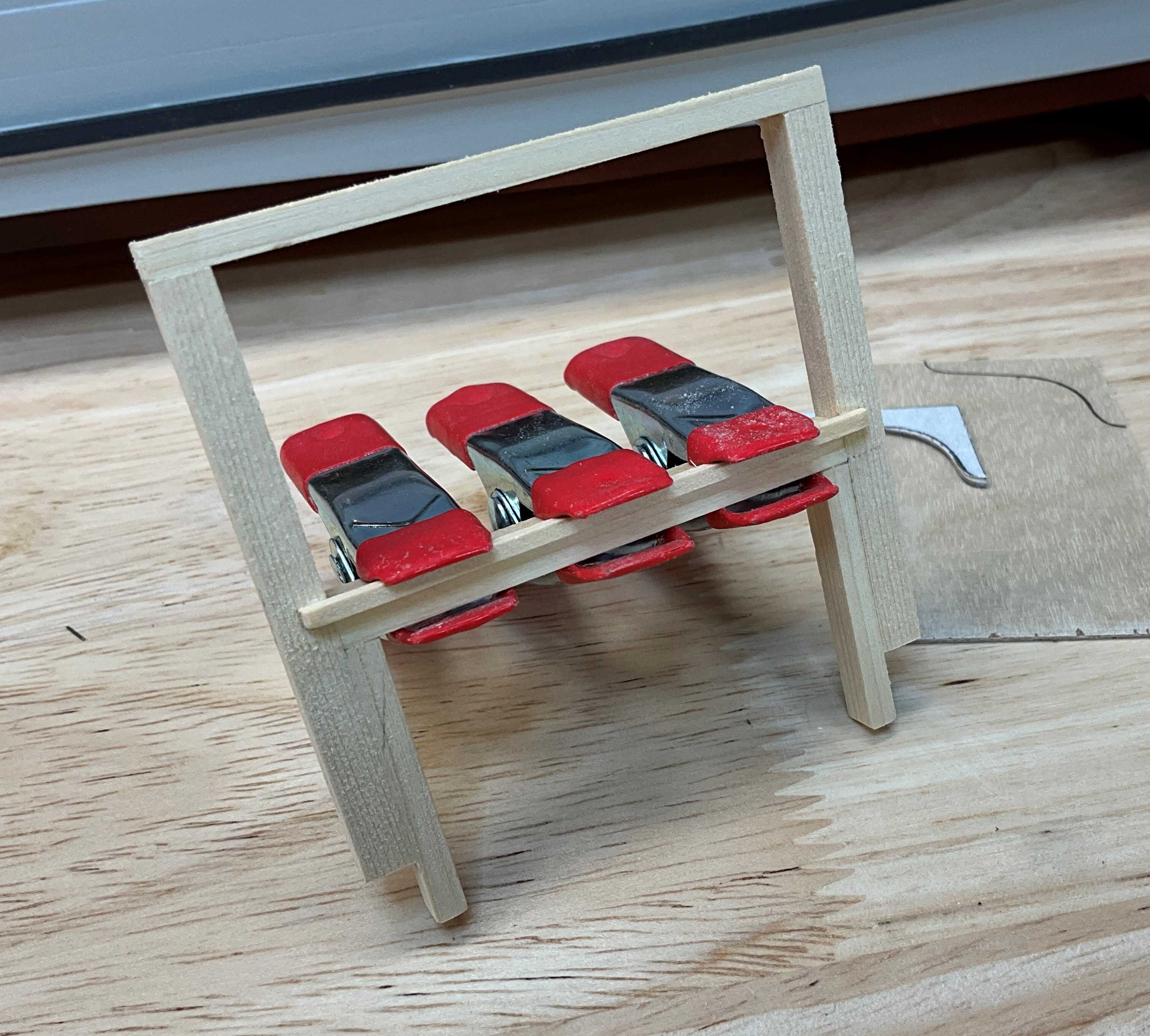

The next items that needed to be addressed were the pillars at the forward end of the superstructure. A sheet of 1/16" basswood was laid on top of the cabins to get the height of the boat deck. After getting all of the measurements the pillars were assembled and and just dry fitted in order to get more measurements.
I have been using Glad Press'N'Seal to line the jigs when gluing is involved. It slicks well to everything but is easy to remove. The door hinges and knobs are glued on the inside of  the cabins with E6000 glue. This is what I have been using when I don't want to use CA. And here is that notebook divider.
There is a lot of stuff going on with the cabin deck. I am starting to install the stanchions that support the boat deck. Hope to see you soon.

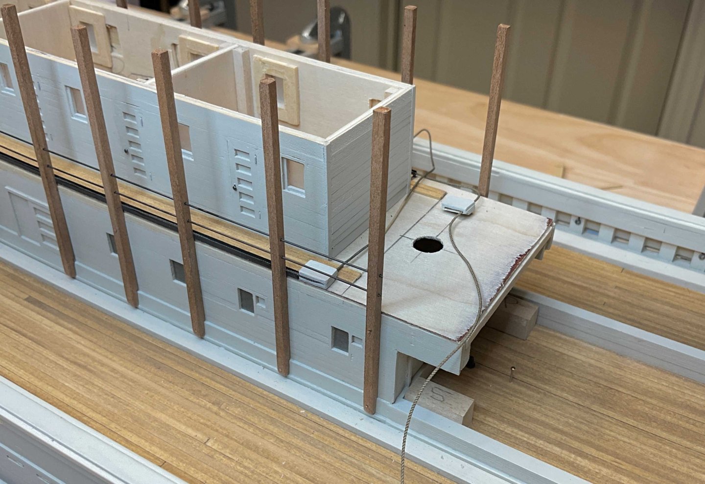

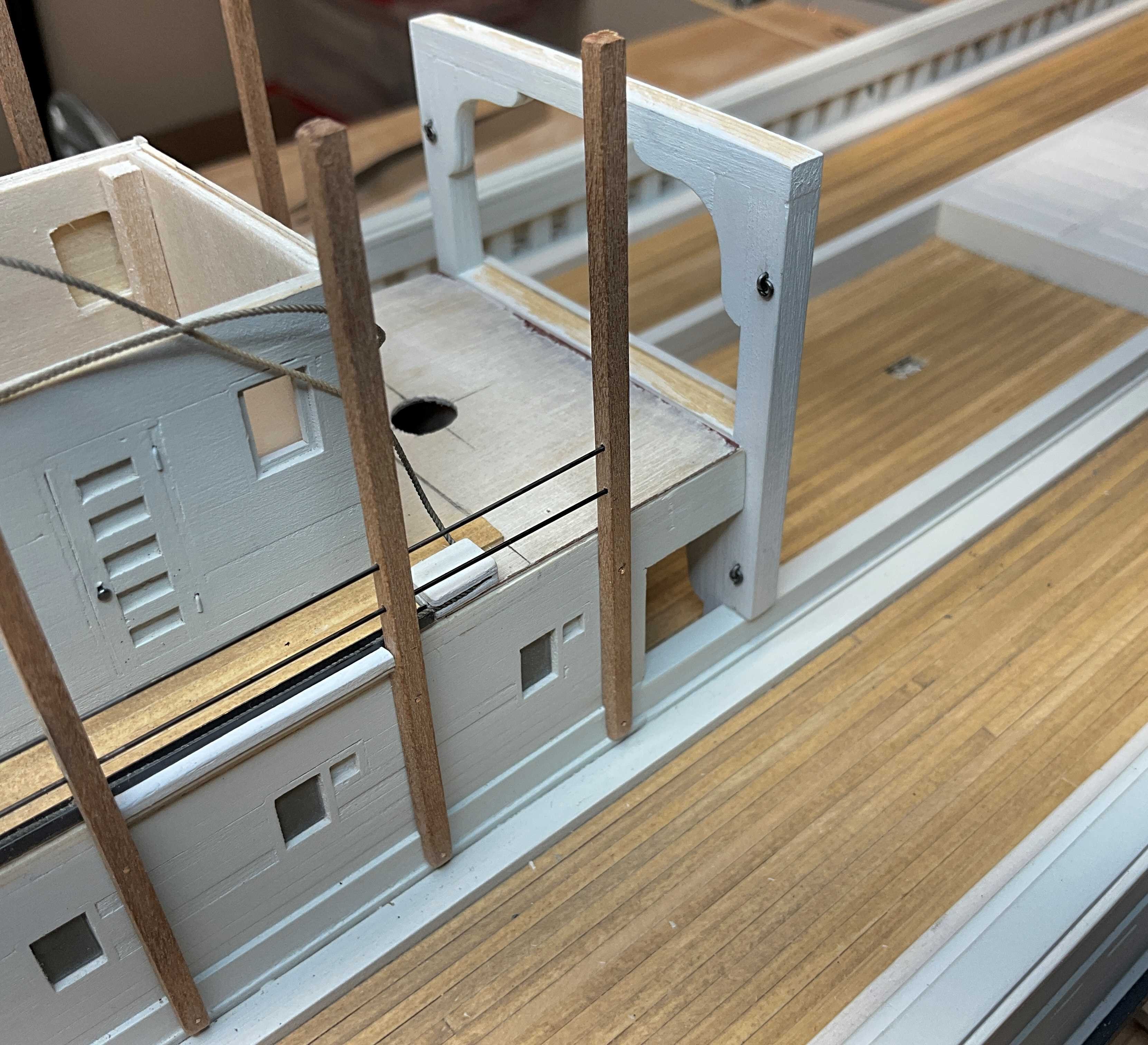

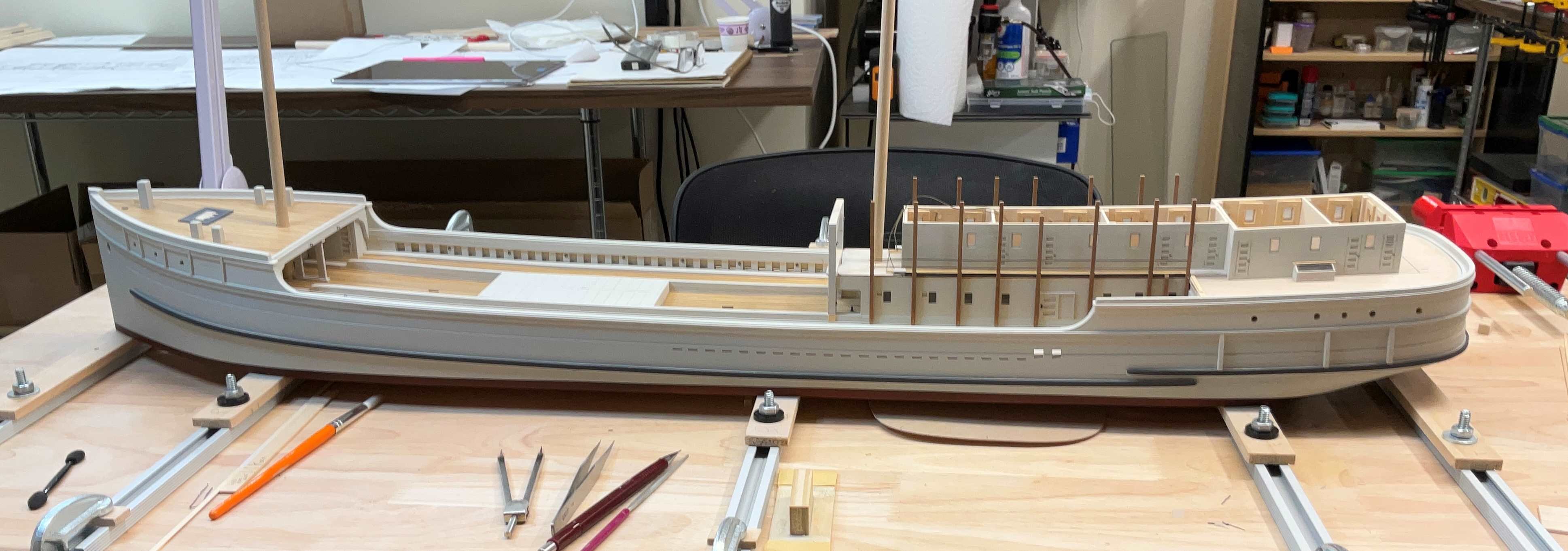

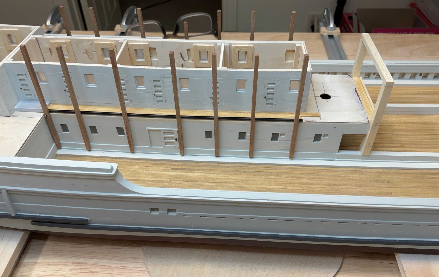

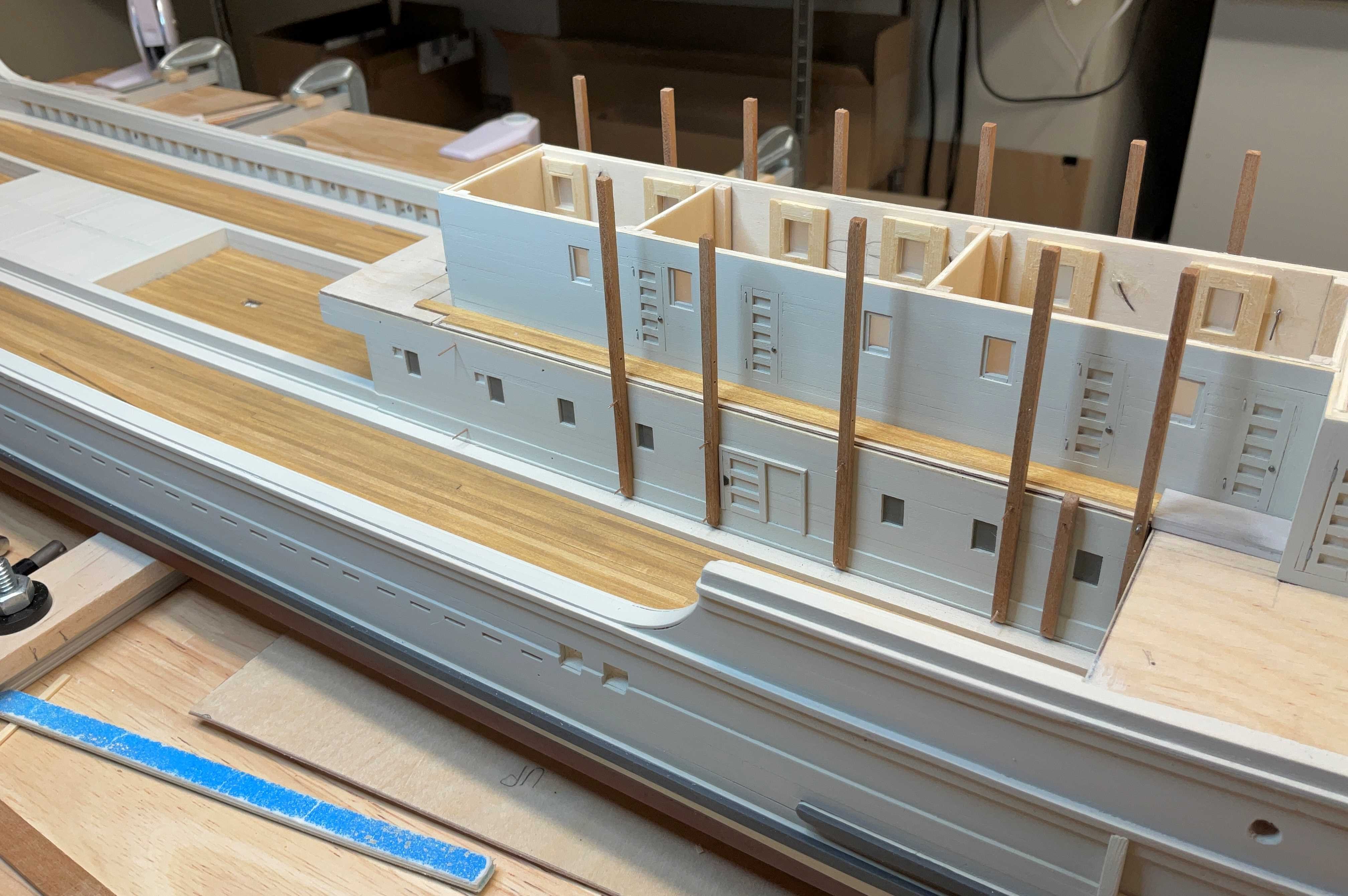

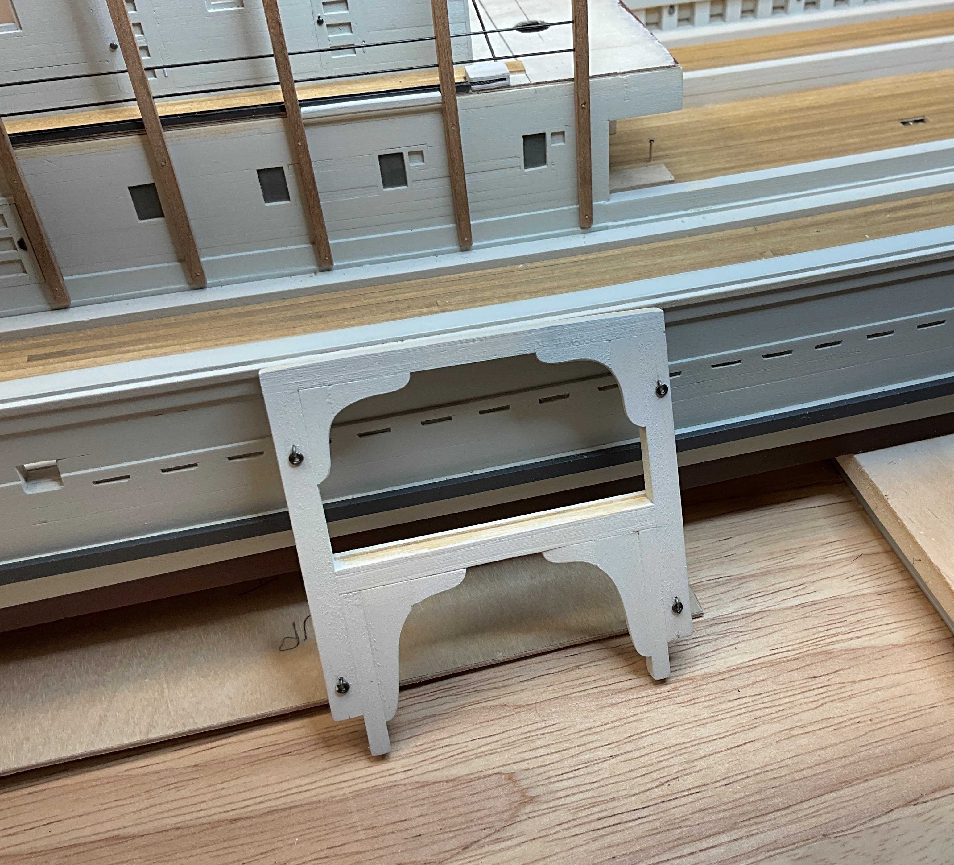

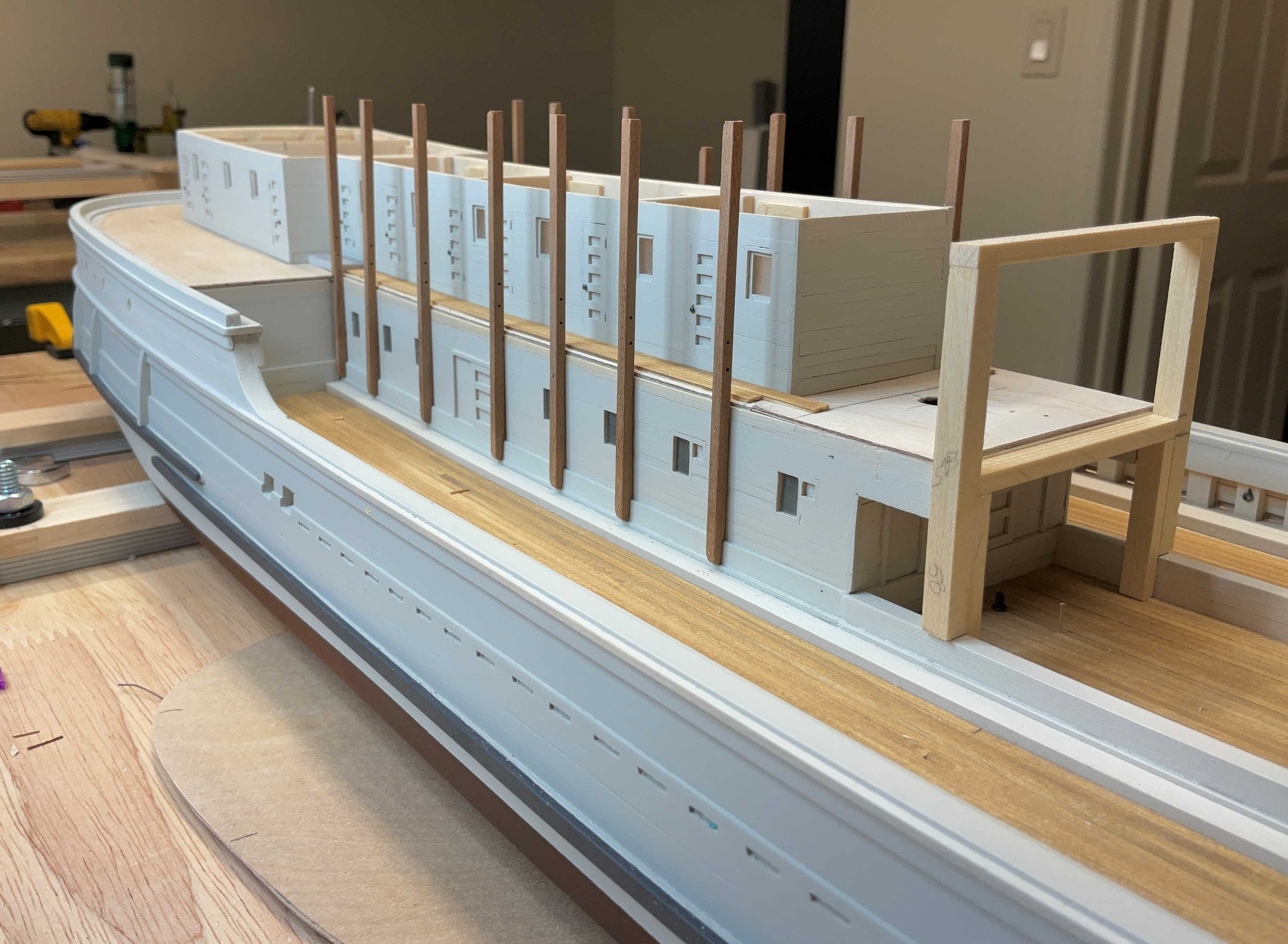

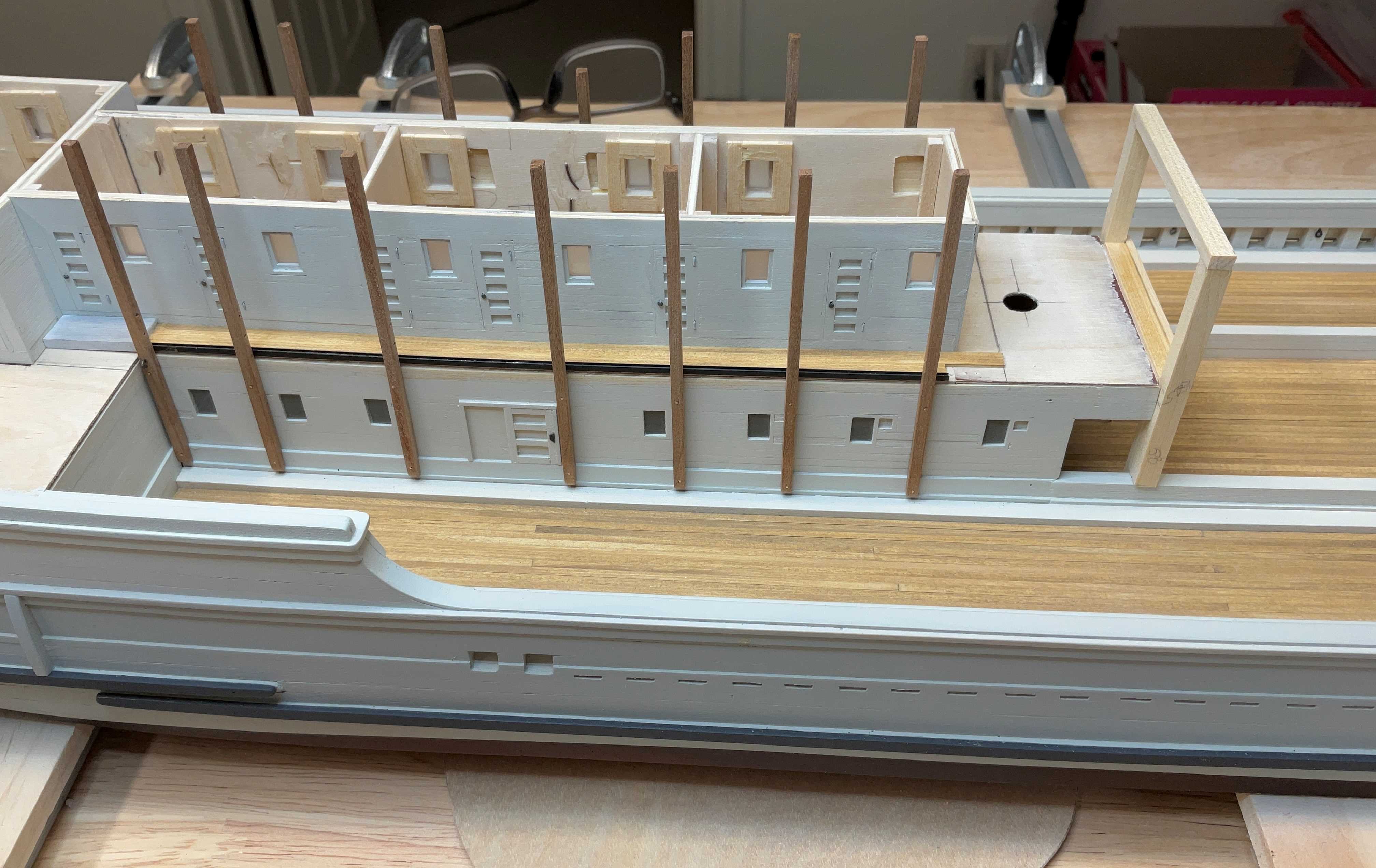

Hi Everyone, thank you for your Comments and Likes. Tis update starts with the stanchions that are attached to the main deckhouse and support the boat deck. They were made and test fitted before the main deckhouse was installed. Gary @FriedClams recommended the Tichy phosphor bronze wire in his Pelican build so I picked up a variety of sizes and used the .020" wire to pin the stanchions in place.
The pins were CA'd into the pre drilled holes and then the stanchion was slid in place and the holes for the wire rope handrails were marked. The stanchion was removed and the holes drilled. The stanchion was slid back on the wire and CA was applied to the wire. The stanchion was then pushed into place.

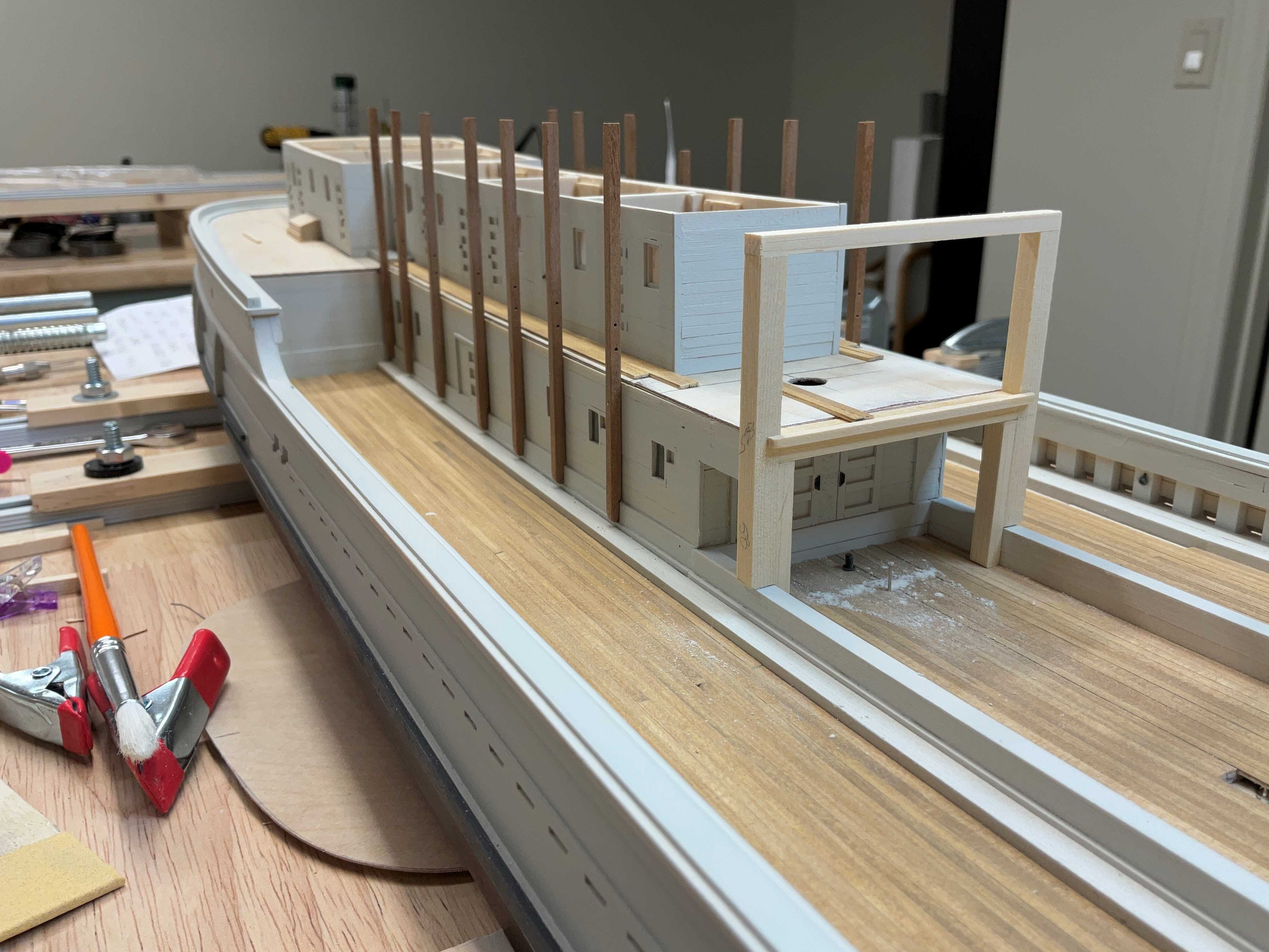

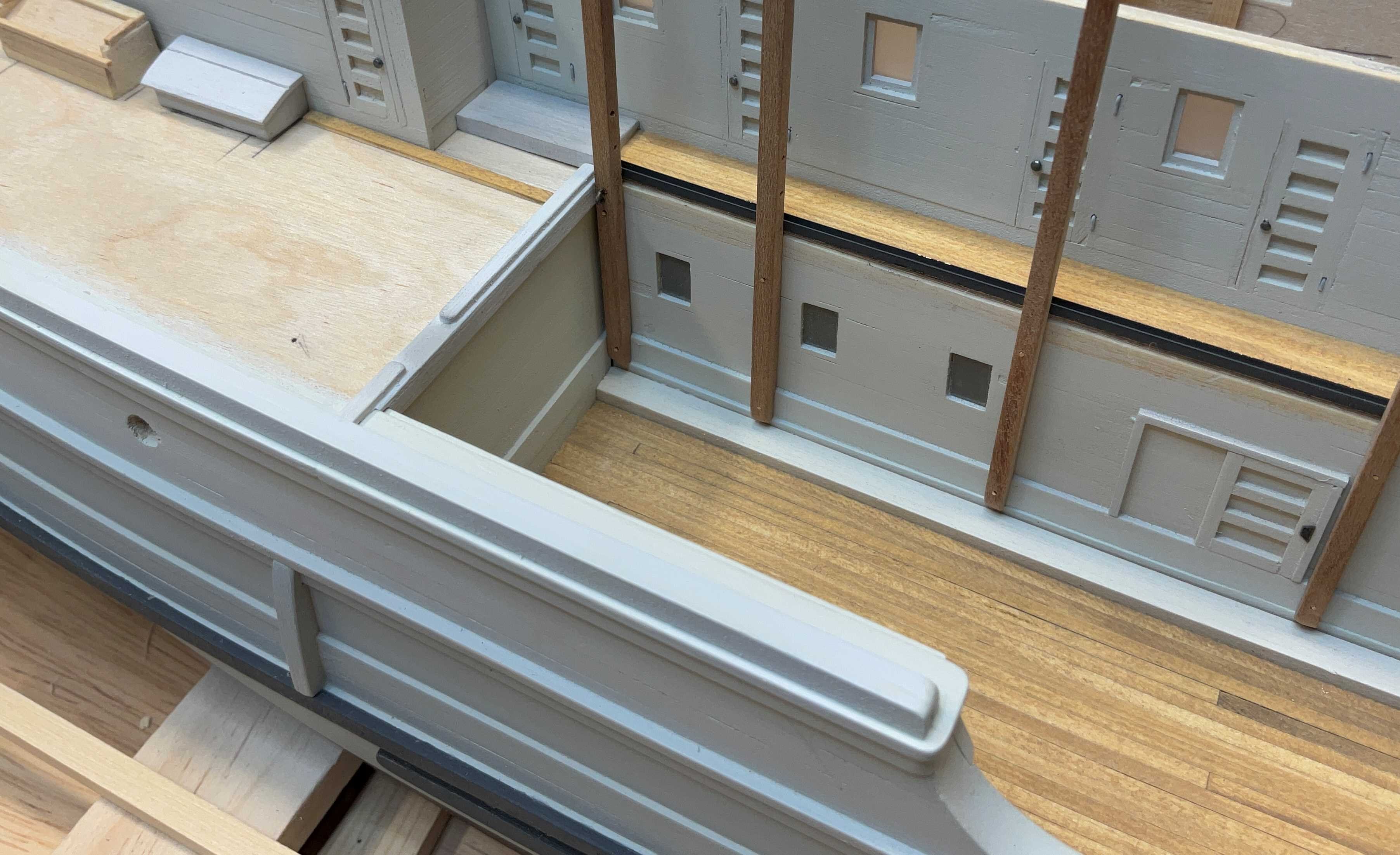

Once the first stanchions were in place I was able to measure the size of the platforms that sit outside the smoking room doors port and starboard. They cover the steering rod which gets converted to a wire cable after it enters the trough that runs inboard of the stanchions
After the platforms were installed the deck planks were laid and the rest of the stanchions were fitted.

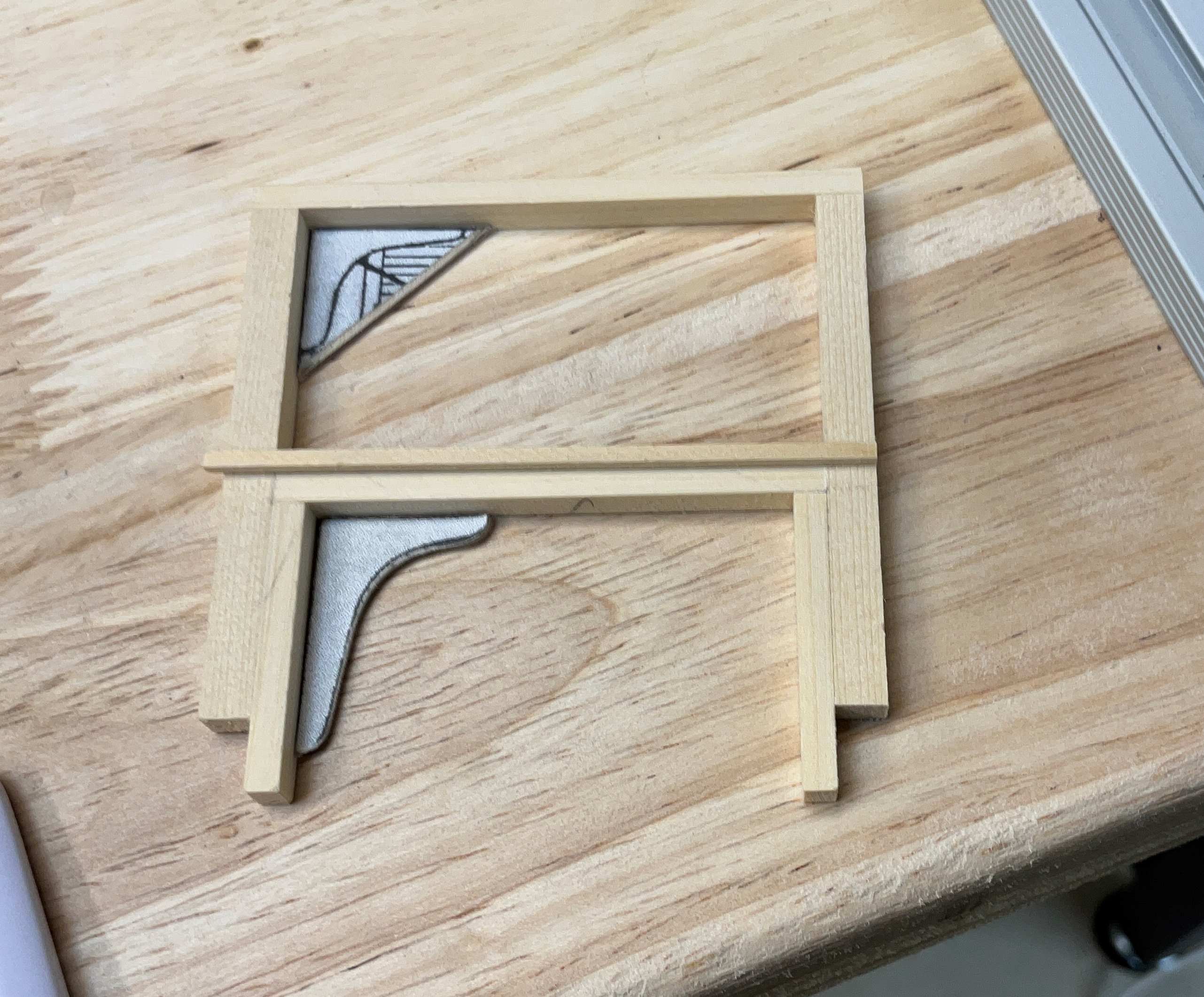

The pillar structure was next. A strip of 1/32" x 3/16" wood with a 1/16"x 1/16" glued to it's length was added to the top of the lower beam to match the height of the subdeck and cover the ends of the deck planking.
While this was going on a piece of 1.5mm x1.5mm x 1.5mm brass channel was glued between the last plank and the stanchions ( with CA ). This will represent the steering cable trough.

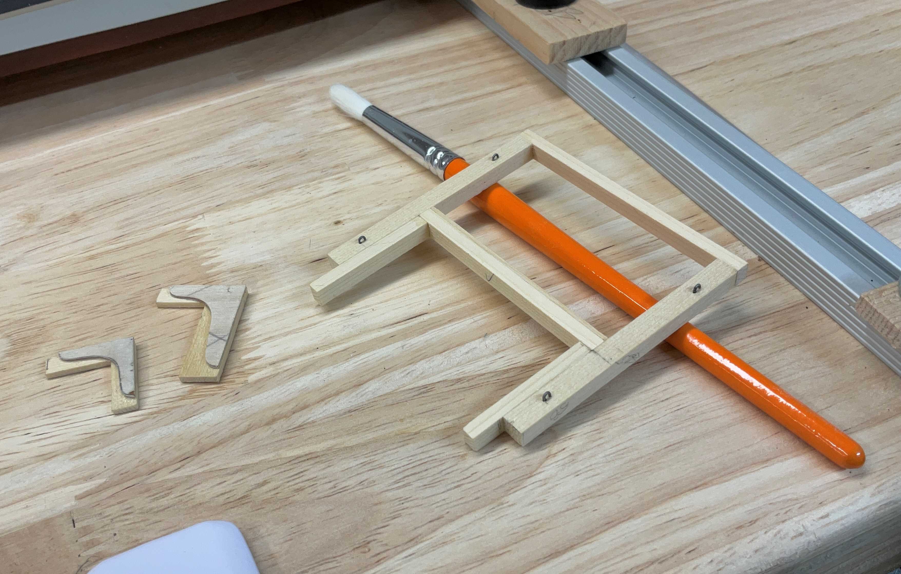

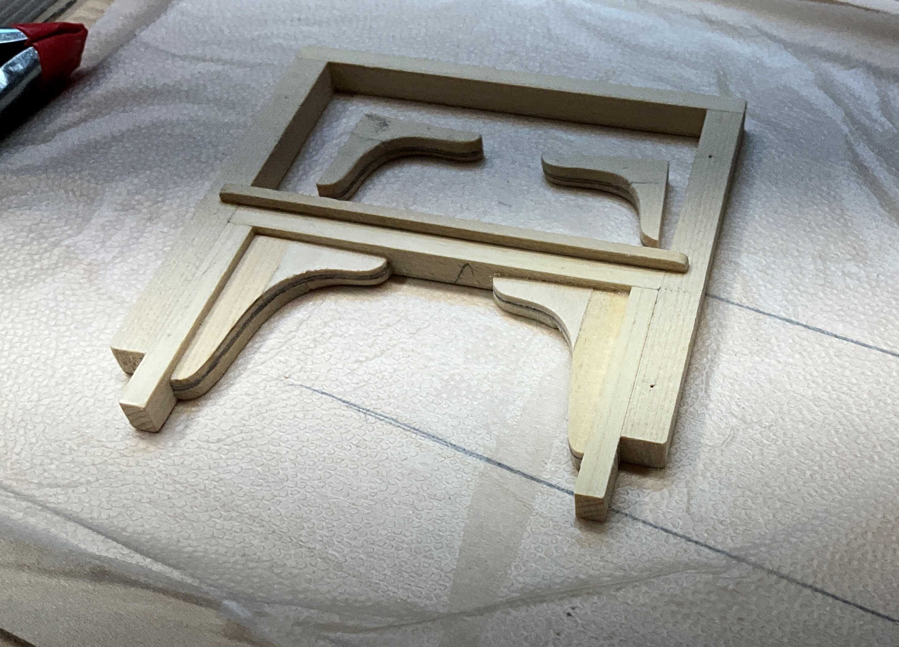

The knees for the pillars started as a shaped piece of 1/32" plywood. Then  1/16" AYC was glued to one side and sanded back to the plywood. The same was done on the other side but with 1/32" AYC
The iron work was attached after the pillars were painted

The sheaves at the forward end of the trough for the steering cable look to be housed in a wooden assembly and protected by a wooden step/cover. My version is supposed to represent that
Brass wire was used for the hand rails but it may get changed out for rope

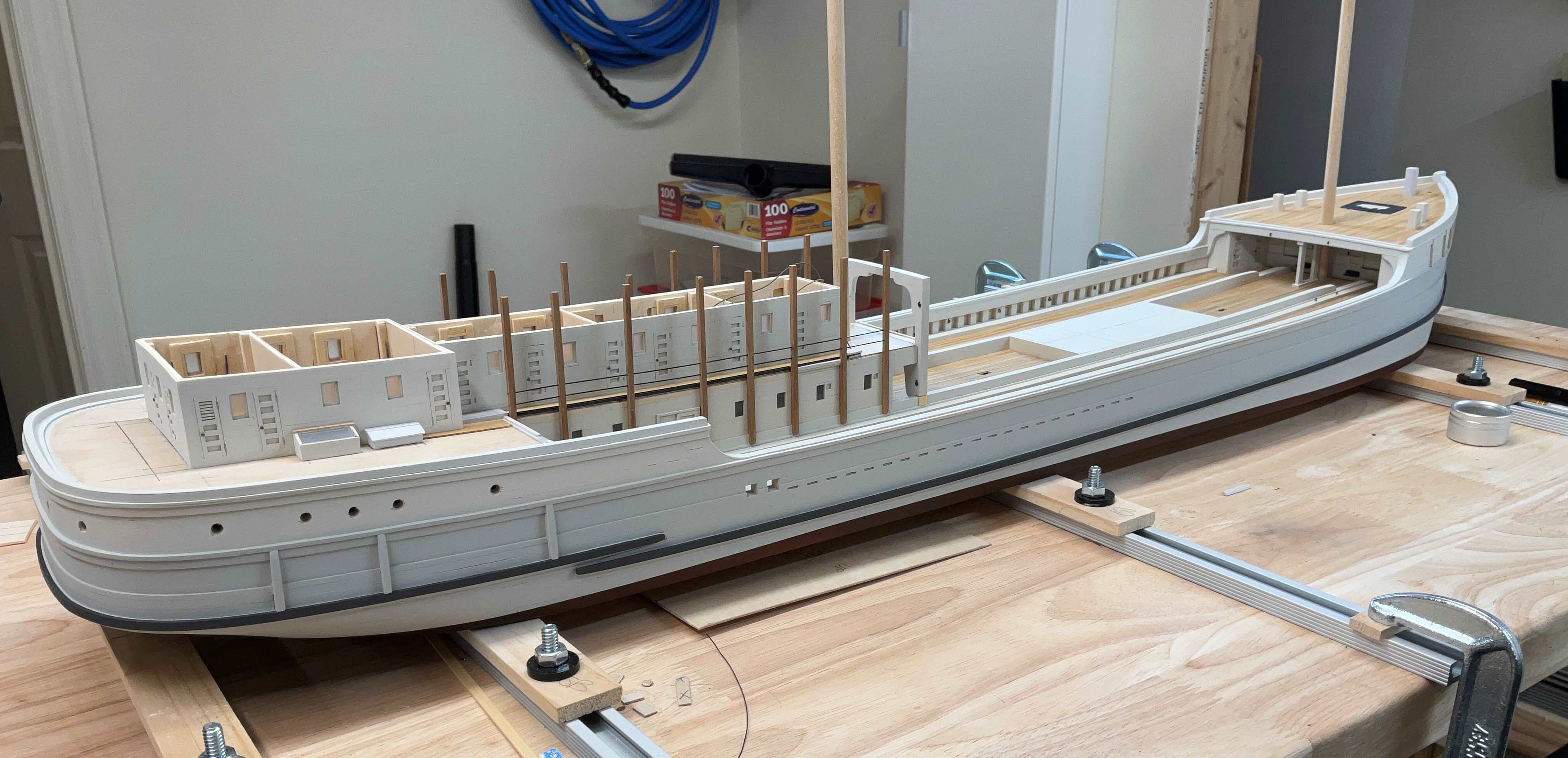

Hi Everyone, this is an update with a bit of everything. Thanks to all of you for the Comments and Likes. Last week I picked up the base which was made from solid surface counter material by a local countertop company. These companies make stuff like this out of remnants so choice is a bit limited. It can be drilled with a regular HSS drill bit, is very straight and fairly heavy. Overall I'm happy with it. First though came the windows for the port and starboard skylights. They were made from 1/32"x 1/32" boxwood which were then clamped to the table that was covered with Press n Seal. Mod Podge Dimensional Magic was used for the glazing whish also kept the frame from falling apart.
The deck planking was started once they were glued to the subdeck.
The timbers that the cargo winches sit on were next. They are made from 3/16"x 7/32" AYC so that they look square once the deck is laid.
The sheaves that send the steering cable up to the wheelhouse were made. I don't know what they looked like so I made something that they might have looked like. I picked up a die punch set from Amazon that I thought would be handy for making winch parts so it was tested out here on the sheaves. They are made from 1/32" plywood.
Once the deck was completes around the timbers, the 1/32" plywood mast partner was made, installed and tested with the mast.
The large tapered bitts were made from 3/16" dowel shaped with a file while chucked in a battery powered drill.
They were painted with Vallejo Steel Grey and glued to the subdeck. Then the planking continued. At the same time the frames for the raised panels covering the steering gear were laid out and attached.
The cover Panels will be planked on top of 1/32" plywood.
The rudder was made some time ago and of course I forgot to install it before mounting the model to the base. Here it is after removing and remounting the model
A second set of bitts are in the works and then the deck planking can be completed. Hope to see you soon.
