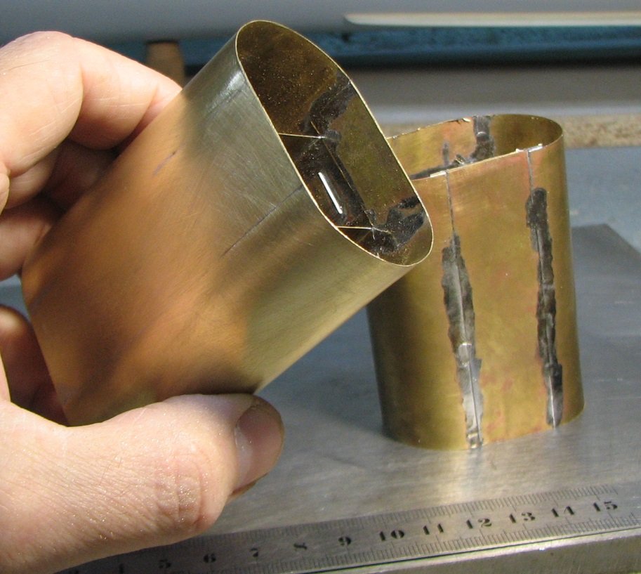

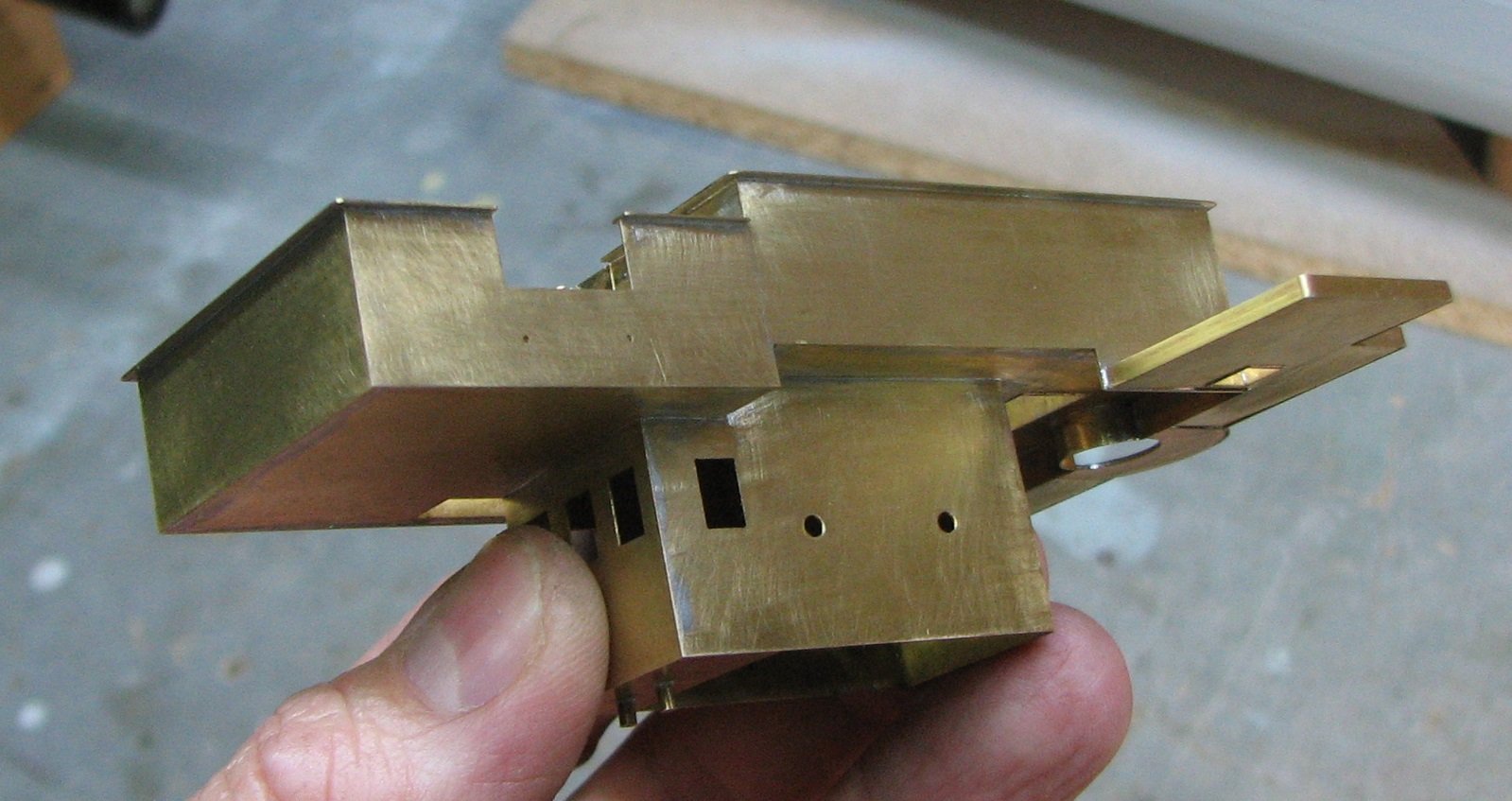

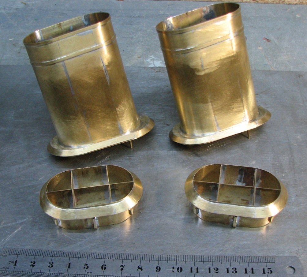

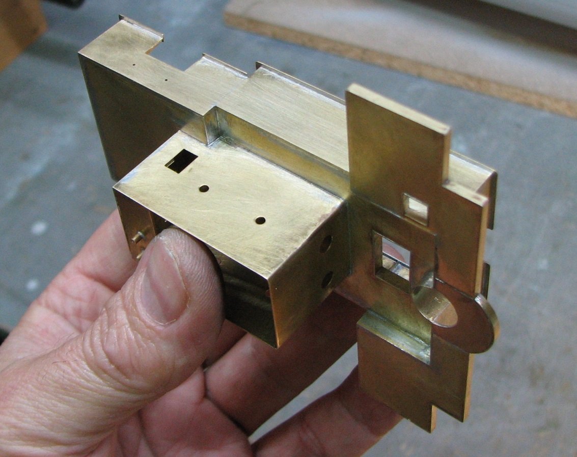

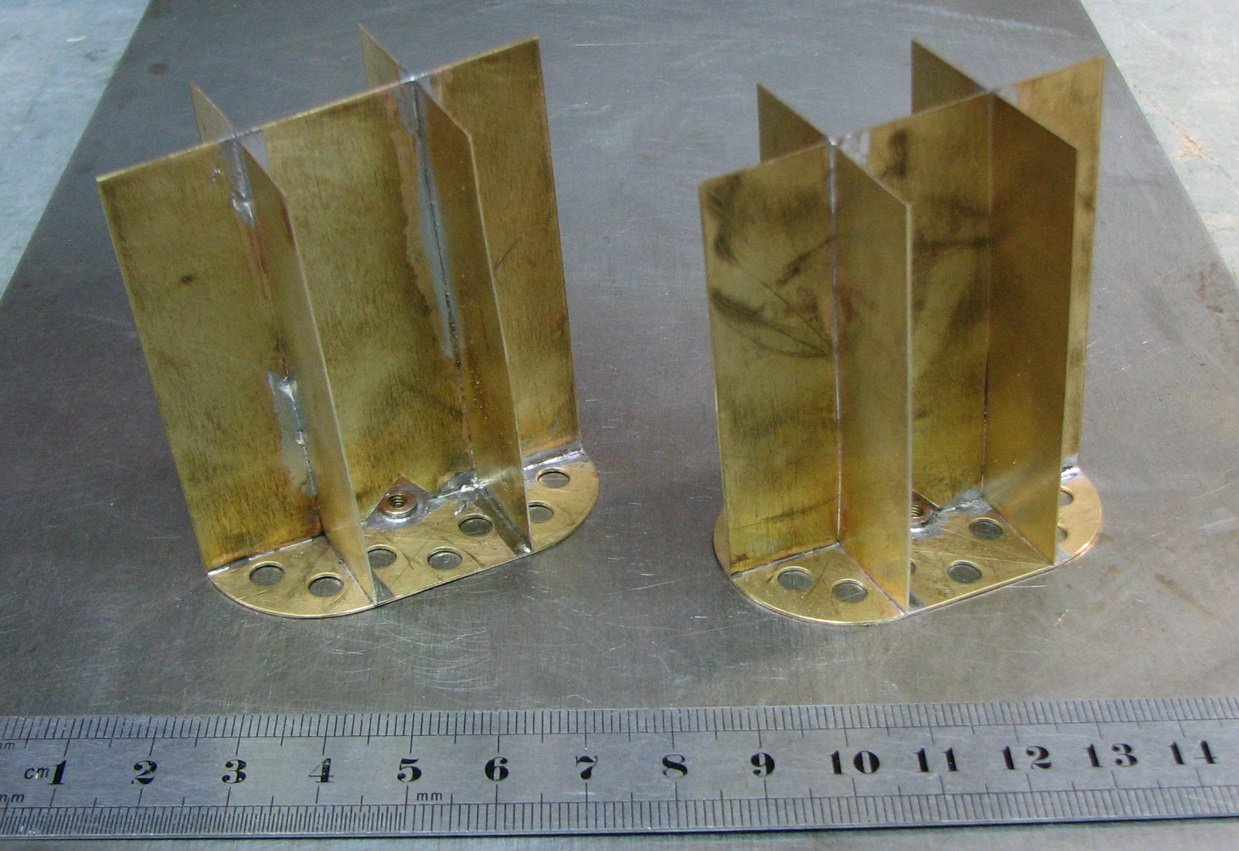

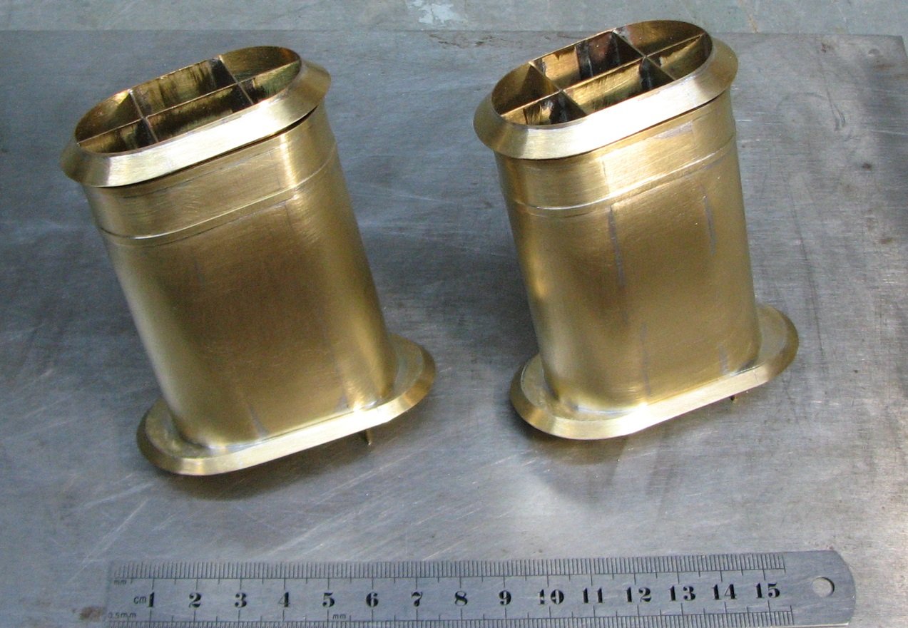

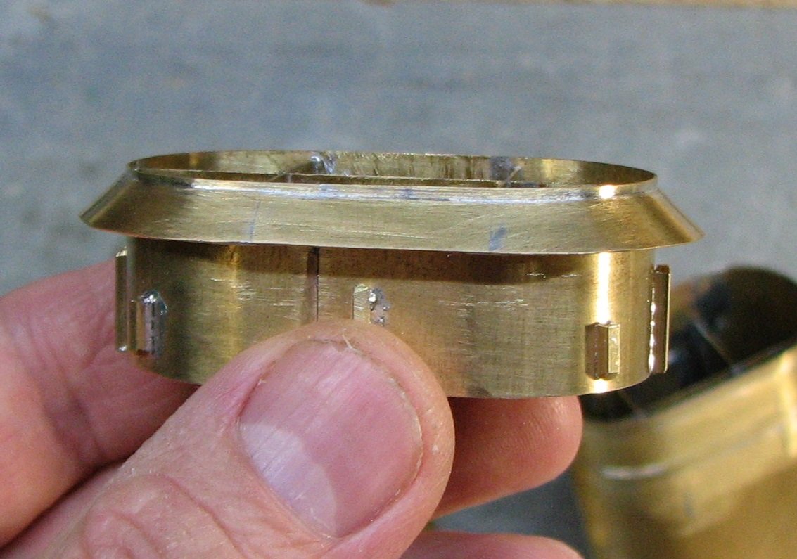

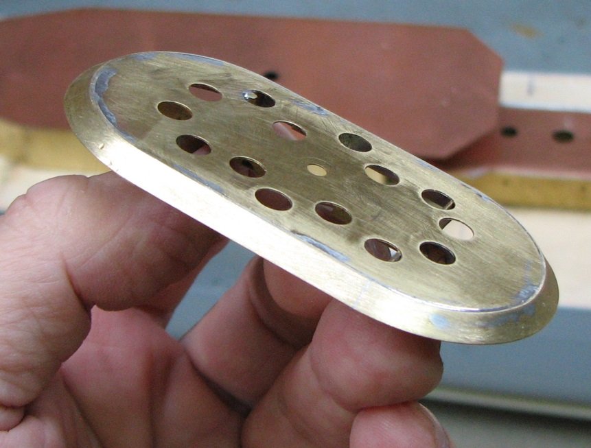

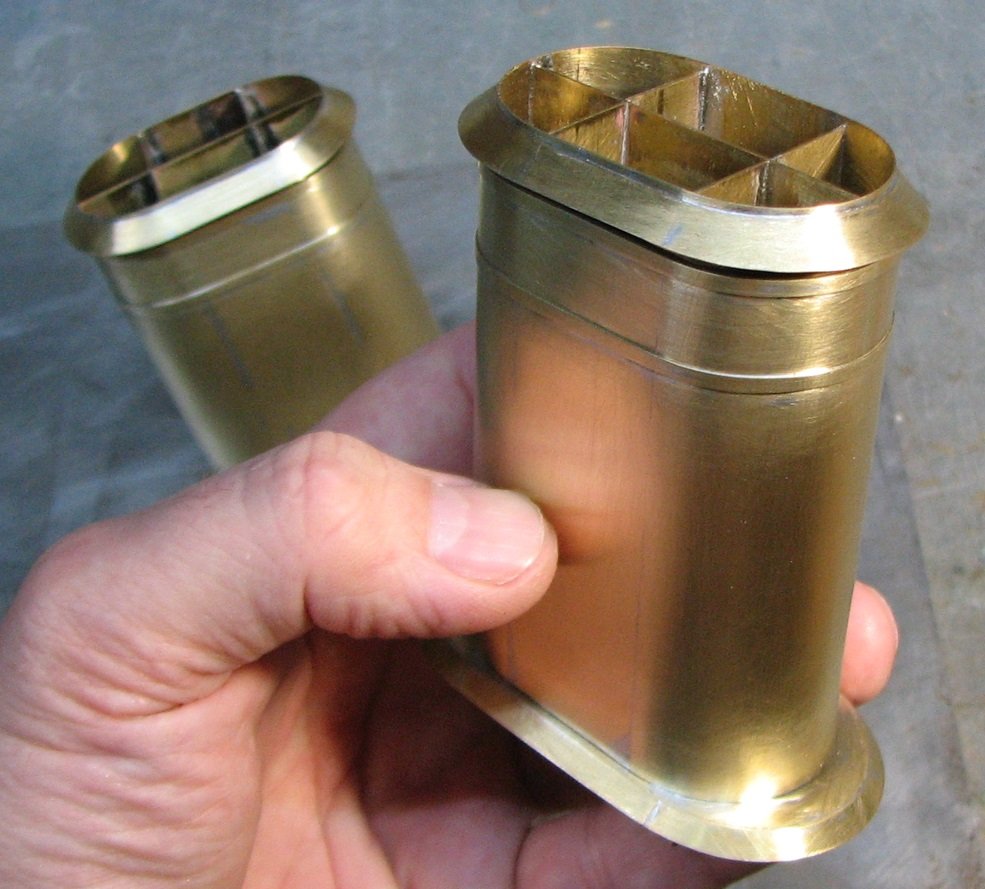

Everything shown in the photos is soldered without using a radiator. I very rarely use a radiator.
In this process, you need to determine the correct soldering sequence. First, the most massive parts are soldered and only after that the small parts are soldered. In this case, you can do without a radiator.

Nice work. I notice that you brush the metal. I usually do this with a motor tool and wire brush to remove excess solder. But does it also give enough "tooth" or roughness for paint to adhere?
Or do you etch the brass before painting?

Thanks.
I know some people "pickle" brass with Sodium Bisulfate (SPAREX NO. 2) to clean the surface and provide a bit of roughness. It is an acidic solution. This is usually done before using a blackening solution.

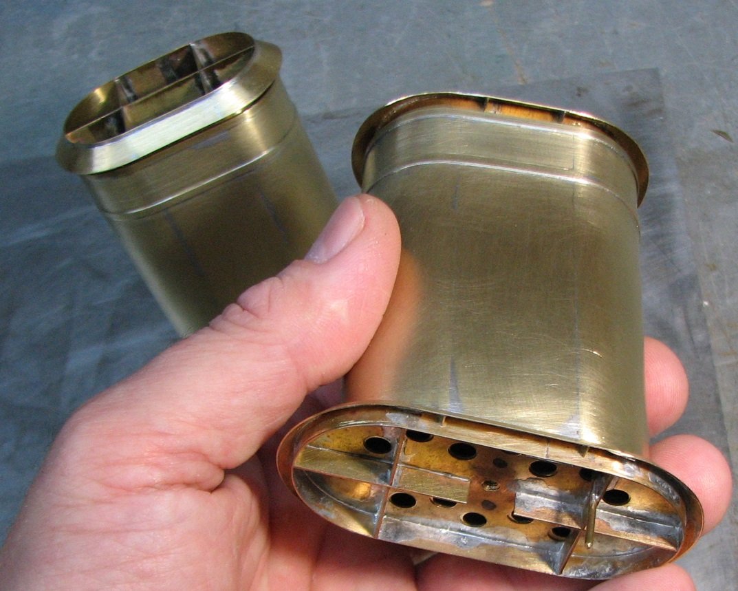

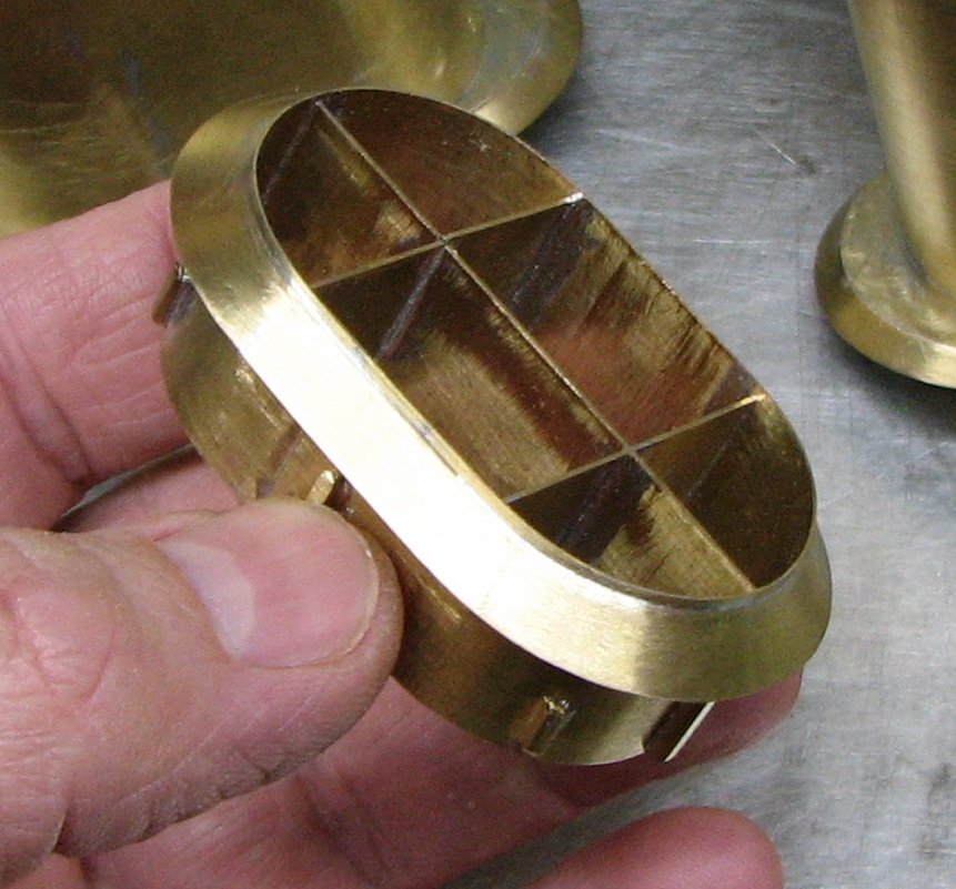

How have I missed this build until today?  Another great subject and masterful craftsmanship at every step.  Once again, Valeriy, your brass work is a tour de force and so instructive to follow.  The geometry of the ventilator visors realized as a flat strip of brass (even if pieced) strikes me as rather tricky.  Fantastic work!
Gary
Completed Scratch Builds
Which reads a bit as ‘for a gifted modelbuilder like me, it is not as difficult as you think it is’ :)
You can tell us that it is not as difficult as we think it is, but we keep looking in astonishment and awe, and tell you your work looks / is perfect.

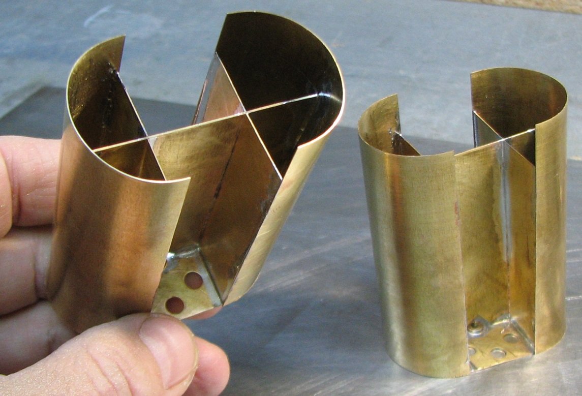

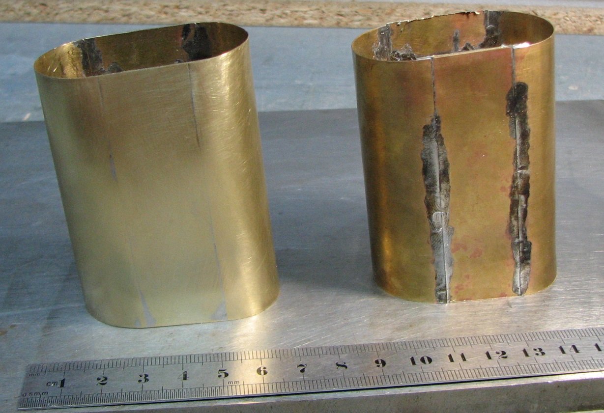

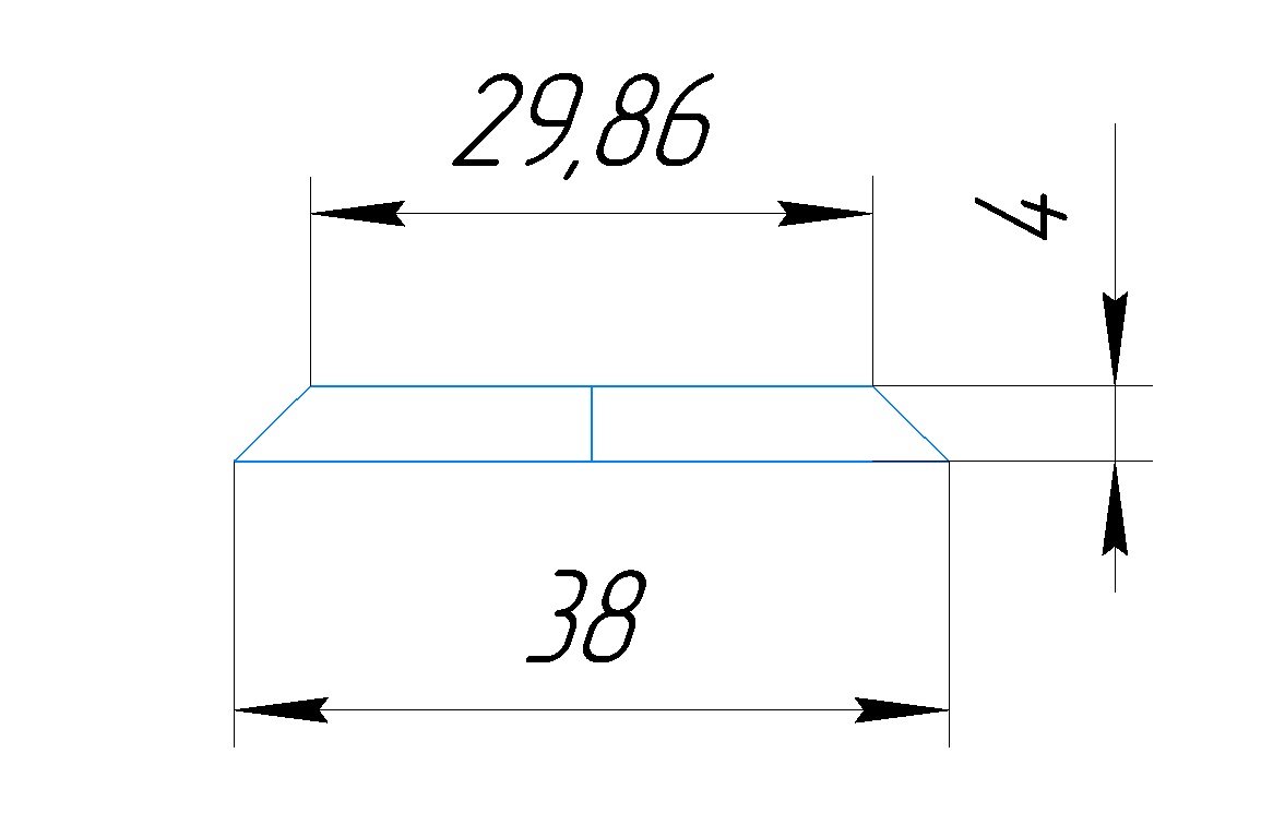

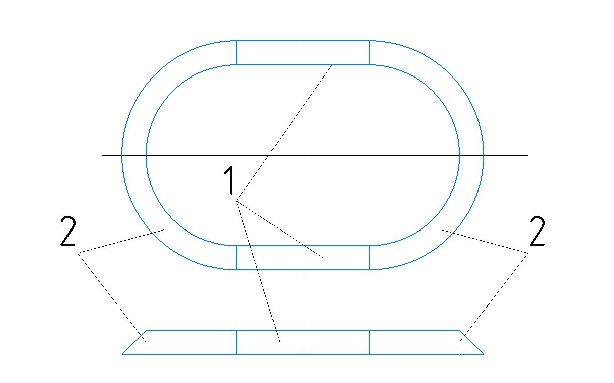

The geometry of the "ventilator visors" is not trivial. It looks like he made them from four pieces - two curved ends and two straight sides. Those curved ends are halves of a conic section, and anyone who has tried to figure out the correct "flat" layout for a conic section knows it isn't trivial. Try cutting a truncated cone with specific angles from a piece of paper and you will see it isn't easy!

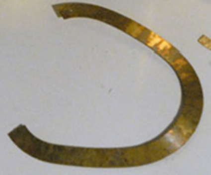

I designed this single piece "visor" in 3D CAD and that takes a lot of patience. In this case the smoke pipe had different radii fore and aft.
I had to flatten the 3D model into a 2D plane, one facet at a time (the program didn't have a "flatten" function). That was very tedious!
Then I photo etched the part (sorry for the blurry picture).
It was a lengthy and non-trivial process that took several days.
Valeriy is very good at this sort of thing and makes it look all too easy!

In this situation with the manufacture of a sloping visor, everything is also quite simple.
If the part is of a rather complex configuration, then I try to apply the following principle:
- divide the complex part into several very simple ones in configuration
- concentrate your efforts not on the manufacture of one very complex part, but on the assembly of several simple ones into one single and complex part.
