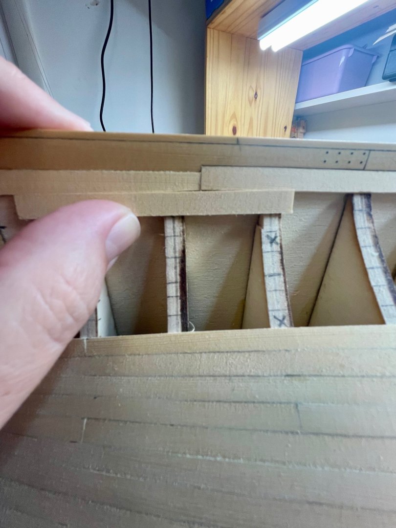

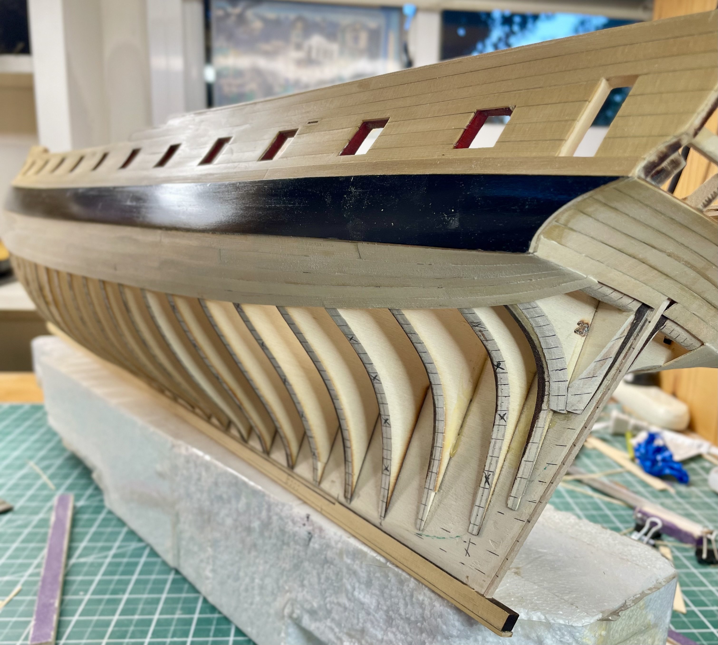

Finally got back to work after about 3 weeks.  Spent about 4 evenings getting my lower counter to bottom planking sorted out.
As a reminder, here was the issue.  I had made a mistake in the placement of the lower counter planking, aligning the bottom edge flush with the edge of the stern frames, instead of having the planking extend below this edge to accommodate the bottom plank thickness.  I compounded this mistake by not stopping when the first bottom planks didn't align correctly and instead trying to force it to work.
You can see where the lower counter planking is even with the framing, leaving no space for the bottom planks.  The blocking behind the counter is also way too high and not close enough to the counter to support the ends of the bottom planks.
I received a lot of thoughtful recommendations on correcting this.  The first step was to remove the narrow lower planks on the counter and replace them with with full width planks and see if that would close the gap.
Lower planks on the counter removed.
The blocking behind the counter was also a mess, I removed it and also cut some notches into the lower stern frames to give me some more room to work with replacing the blocking.  Not strictly necessary but made things a little easier to fit.
The wide plank alone was not quite enough to fully take up all the gap that I had.  I needed to pop the bottom planks off the aft bulkheads to fair things a little more to get the planks a little lower.  I also lucked out on the port side that the plank lengths were correct for the new mounting position.  Just needed to glue everything back in place.
Not so lucky on the starboard side.  I cracked the inboard lower plank when I tried to remove it from the aft bulkhead so I needed to replace it.  The lower plank adjacent to the wales was a little to short to reach the counter in its new position and I misplaced my plank stretcher so I needed to remove and replace the aft portion of this outer plank as well.
Starboard counter plank, blocking, and outboard lower plank all back where they belong.
Finished result, I'm much happier with this now.  Only 4-5 evenings to perform this rework once I settled on a plan.

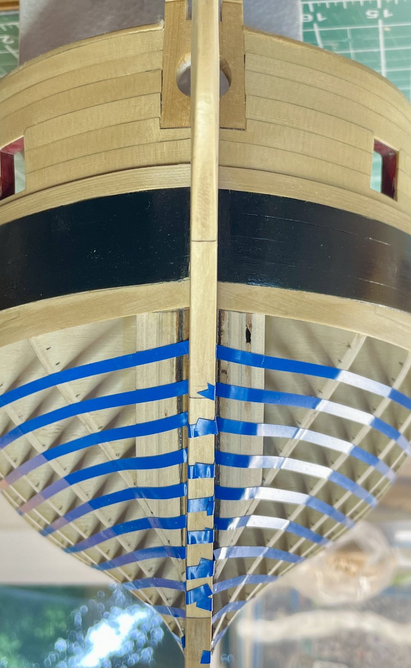

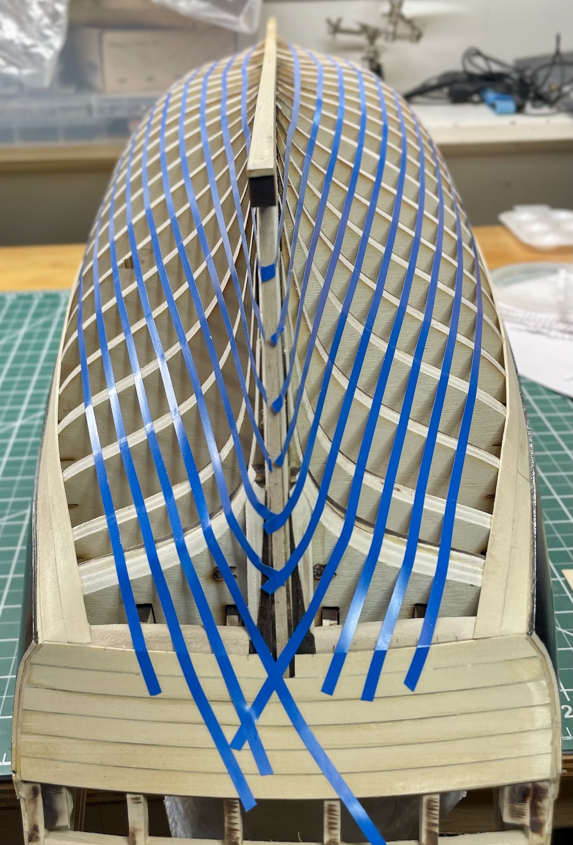

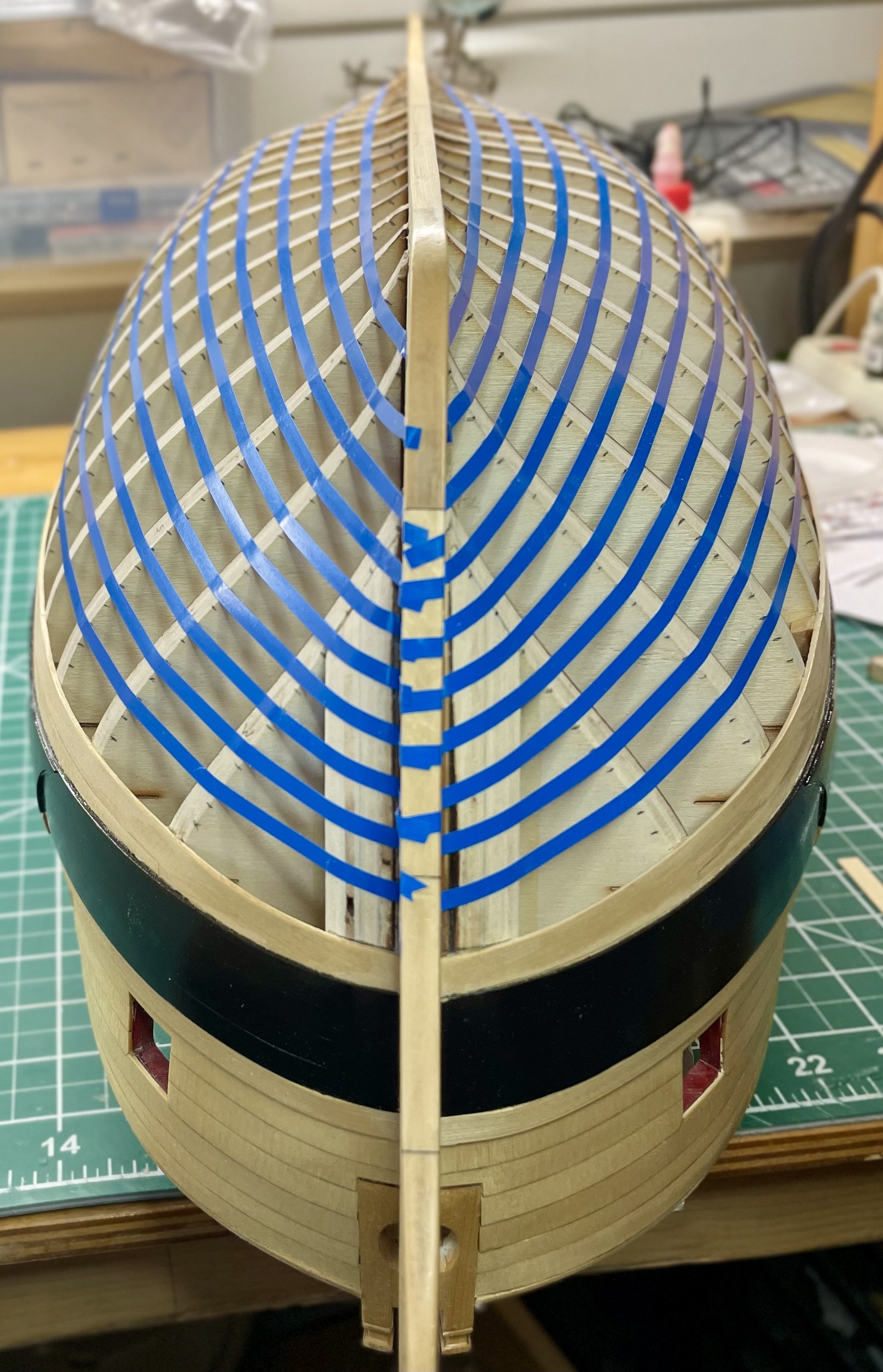

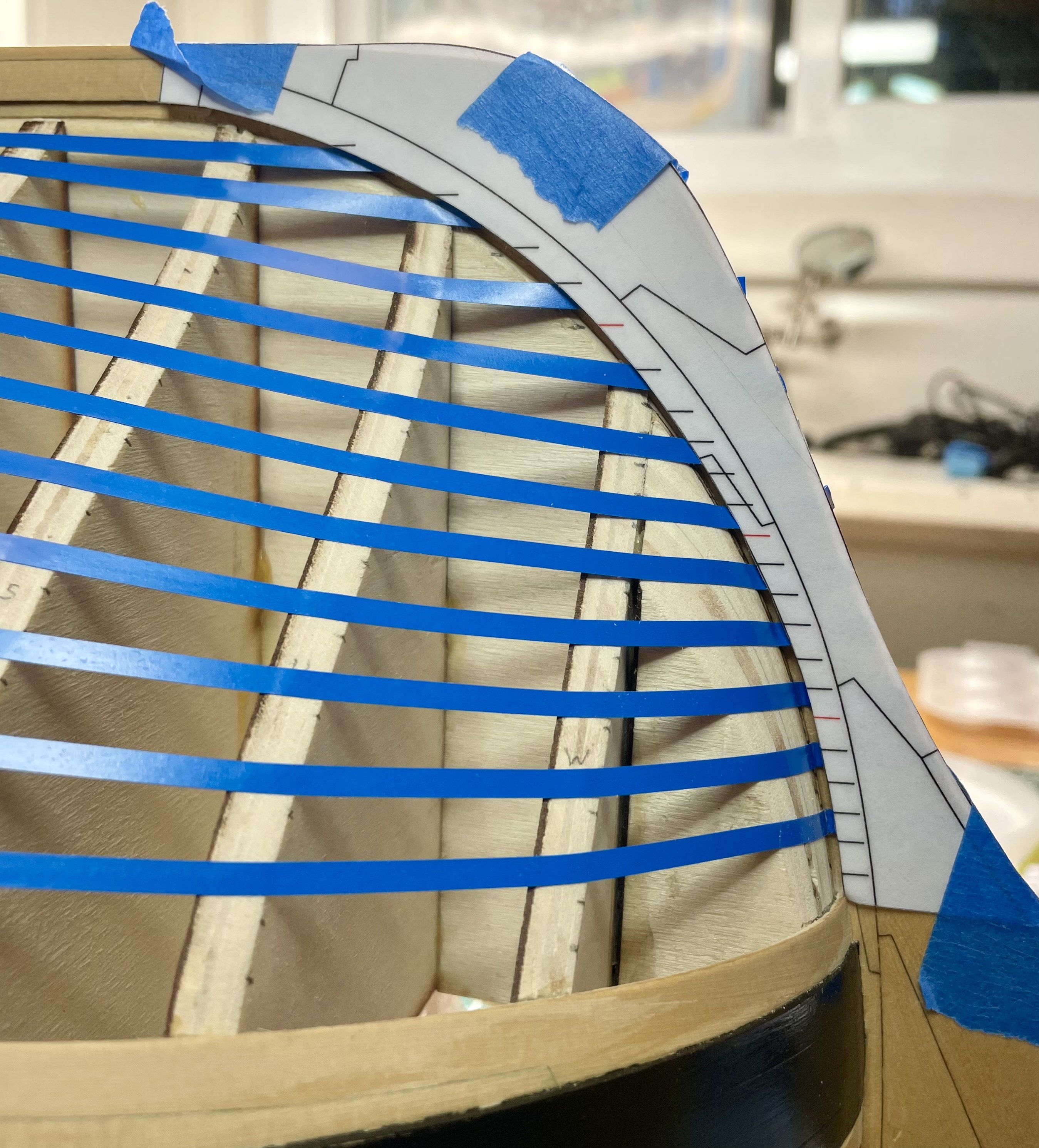

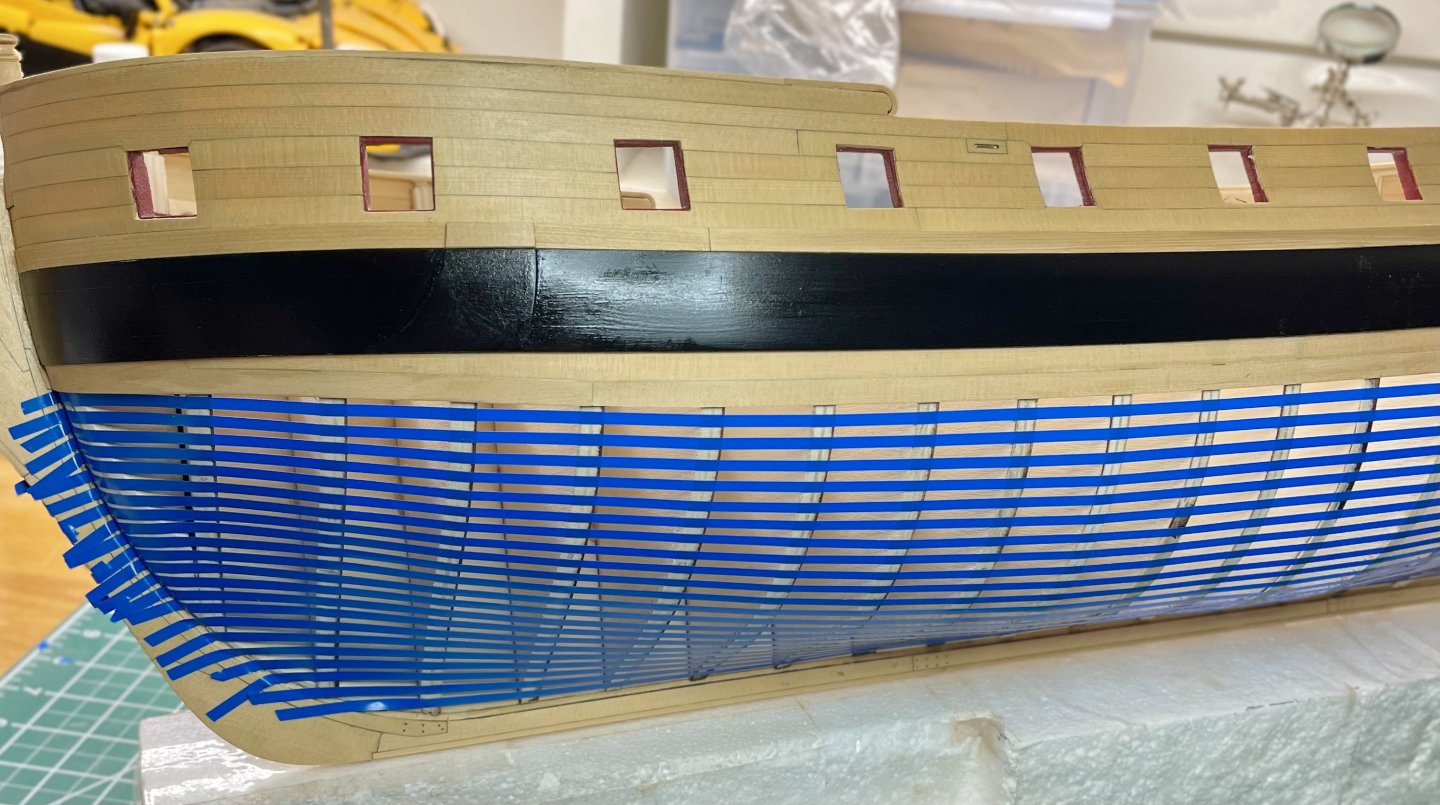

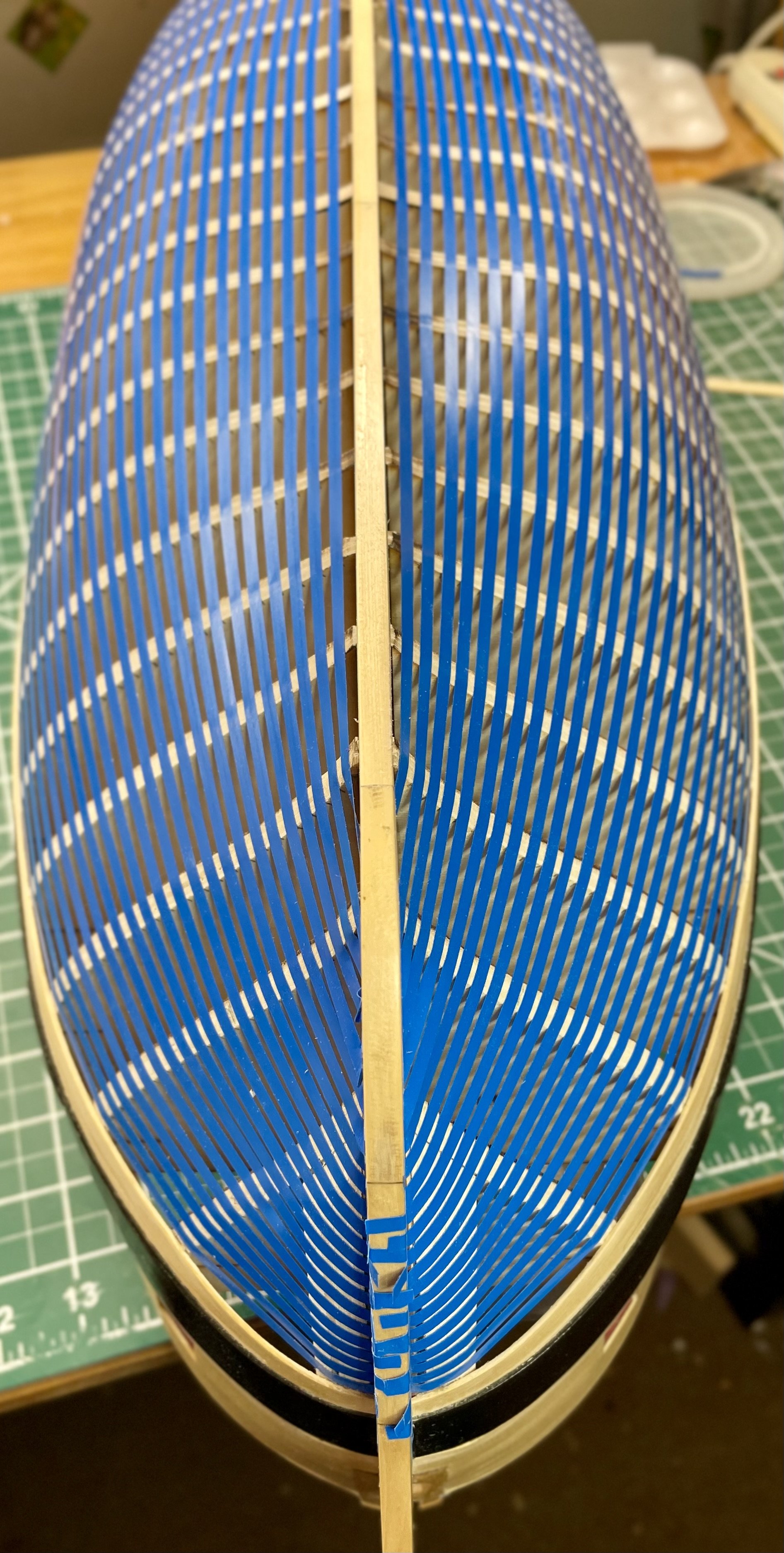

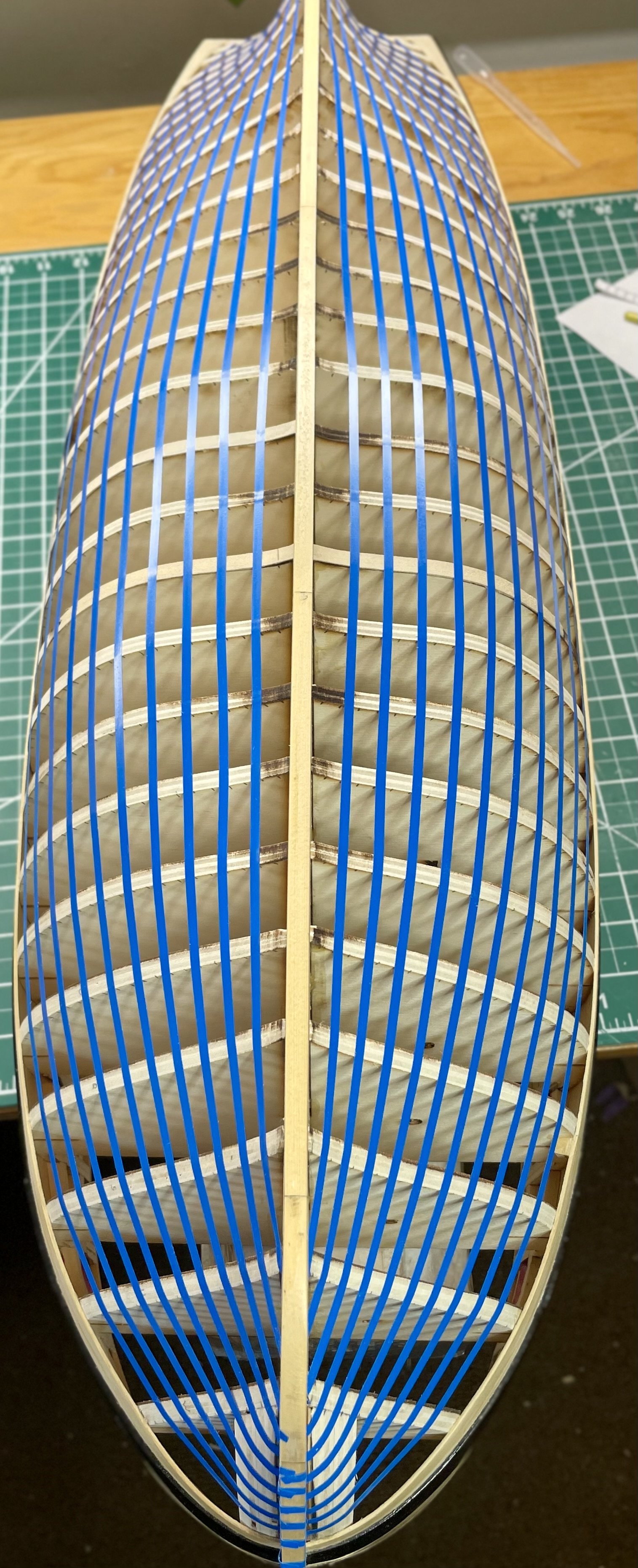

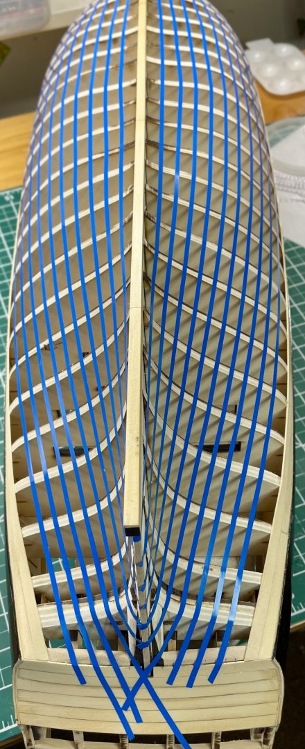

Working on lining off the hull.  Pretty happy with how the lines are running for the most part, except for the lower bow area.  Looking for some opinions on what needs to be adjusted.
Looks like I need to remove some more material from the bow blocking, especially in the lower portion of the bow.  Any other opinions?

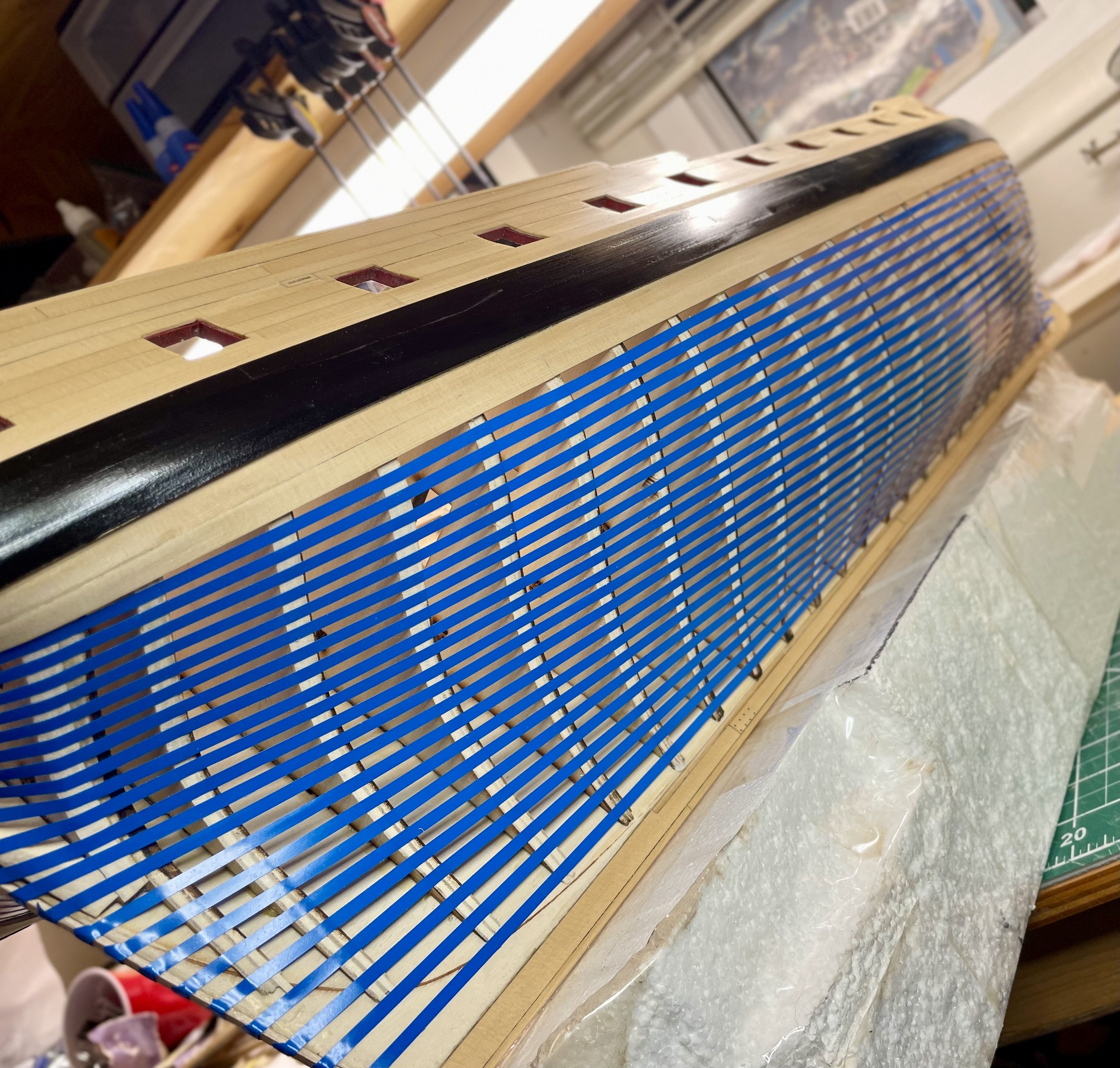

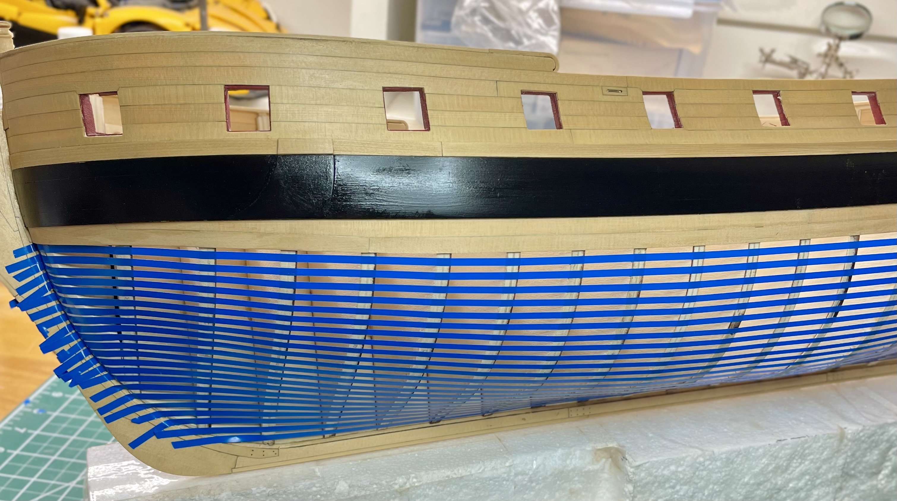

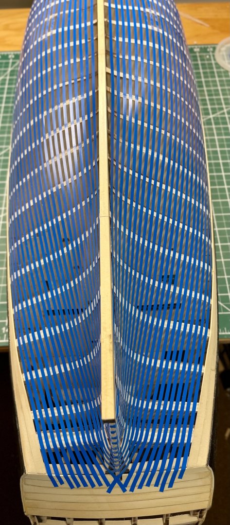

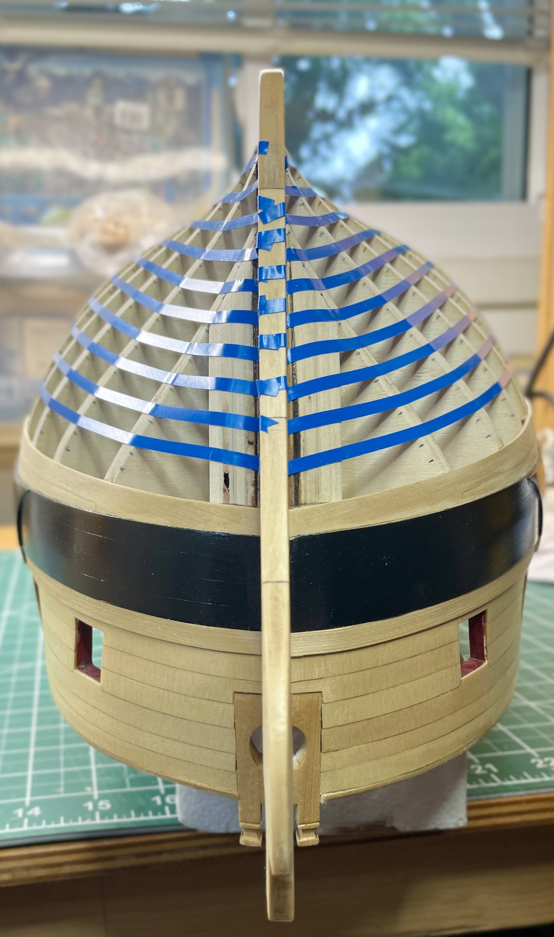

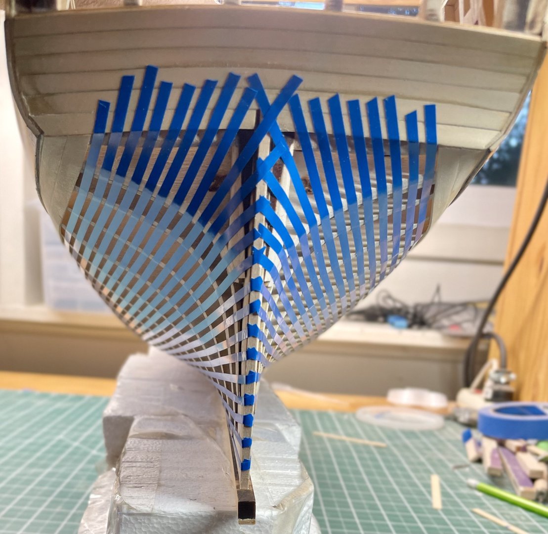

And several other angles.  I ran tape for every other strake.

Shauer,
To my eye, I think the garboard strake needs to extend farther forward towards the bow. Unfortunately, you'll have to adjust several of the strakes to accommodate the adjustment.
Look closely at the pictures in chapter 2 and look at other Winnie build logs.
Best Regards .... Rick
Thanks for the reply Rick,  I appreciate the input and was hoping you were correct as that would be an easy adjustment.
I double checked thinking maybe I got off by 1 strake at the bow since I was only running the tape every other strake.  Unfortunately all looks about right unless I have fundamentally misplaced the template.  The garboard strake comes up between bulkheads S and U which matches what I can see from the directions etc.  I added a tape for the garboard as shown below.  Anything look off?
Going to sleep on this.  Right now looking at it from a few different angles I still suspect that my blocking is a little too proud and rounded down low.
 Steve

You cant fully judge with the hull upside down.  It is more important to view the hull right side up as it will naturally be.  You will be able see the run more accurately.  If the run dips or if what appear to be dents which is an optical illusion caused by the run of the strakes or tape.  Flip it over!!!
Very good fix at the stern, but maybe is your frieze print not to small now?
Luckily you can enlarge it a little on your computer later.
A lot of work taping the run of the planking, but it pays of a lot, so that's time very well spent.
Take your time, enjoy it and flip it over to check it with your carpenter's eye (left or right 😉) the run of your tape lines!
You're definitely on the right track to build an awesome Winnie!
Frank.

Spent a couple mornings over the weekend working on adjusting the run of the planking and fixing some low and high spots.
Chuck, I did flip it over :)   I was surprised at what each perspective on the hull was able to show.  I found several spots that needed some touch-up on the fairing that were only visible from one angle, and also some areas that were an optical illusion as you stated.  I had thought that simply inverting a photo would be sufficient, that was very wrong.  The other hulls I have done were smaller vessels and 1:64 scale so I'm learning how to spot more subtle issues across a much larger hull area.
Starting what is hopefully a final taping this evening.
Frank, thanks for the comments on the corrections I made to the stern.  I'm really happy with it now.  Good suggestion on checking the frieze, I'll check that tonight.

After going through this 2 1/2 times I'm pretty happy with the lining off and run of the planking.  The spacing is not 100% perfect in all areas but I'll adjust that as I add the actual planks.  I found and corrected at least a half dozen areas of the hull that were either high or low, worth the time it took.

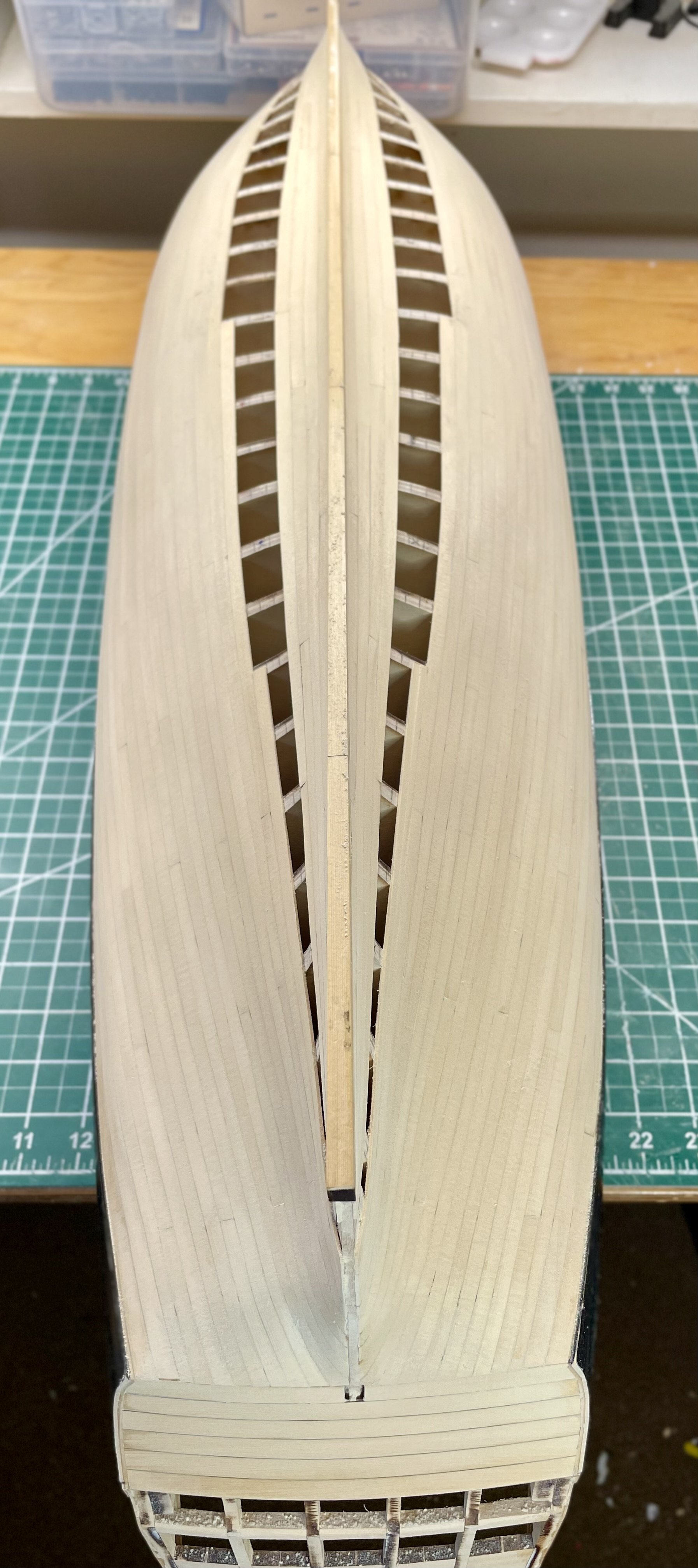

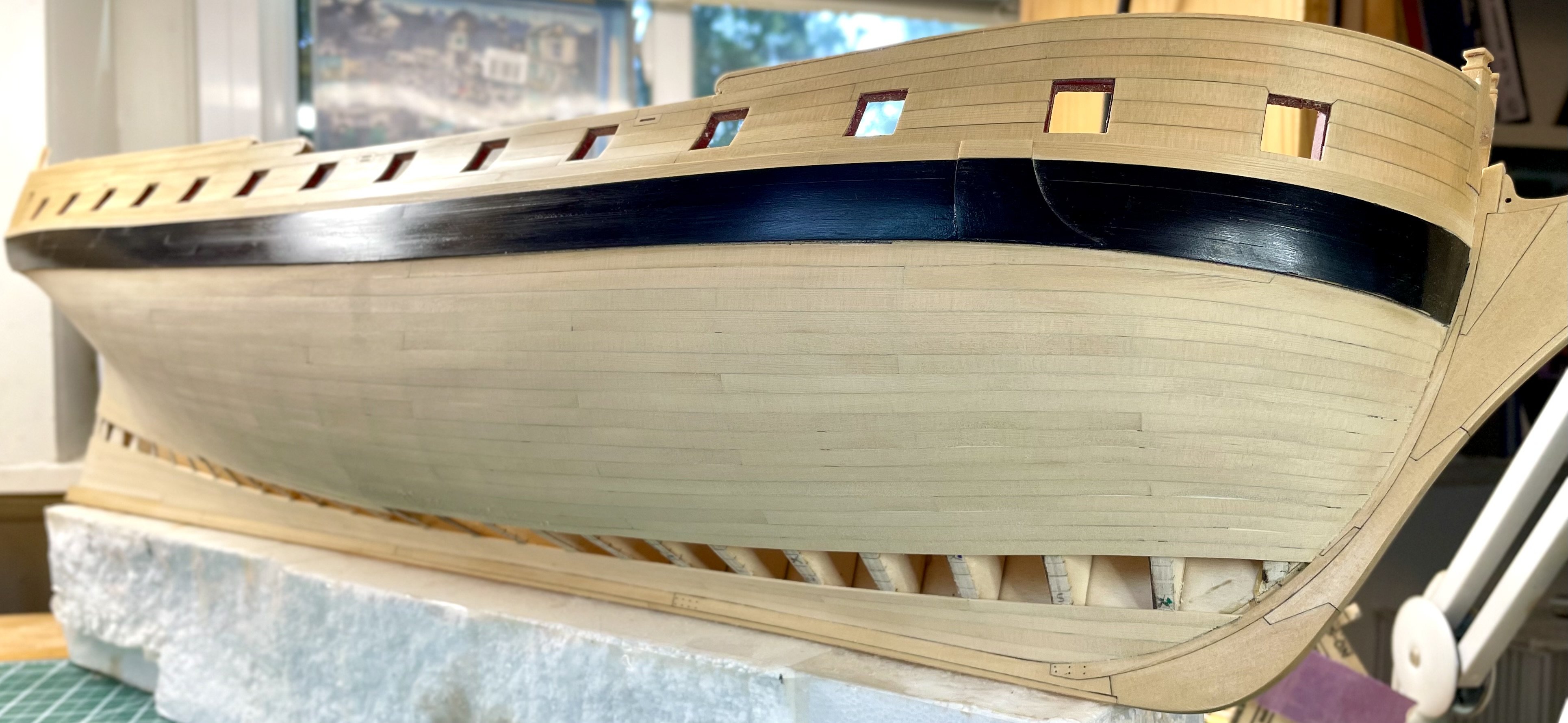

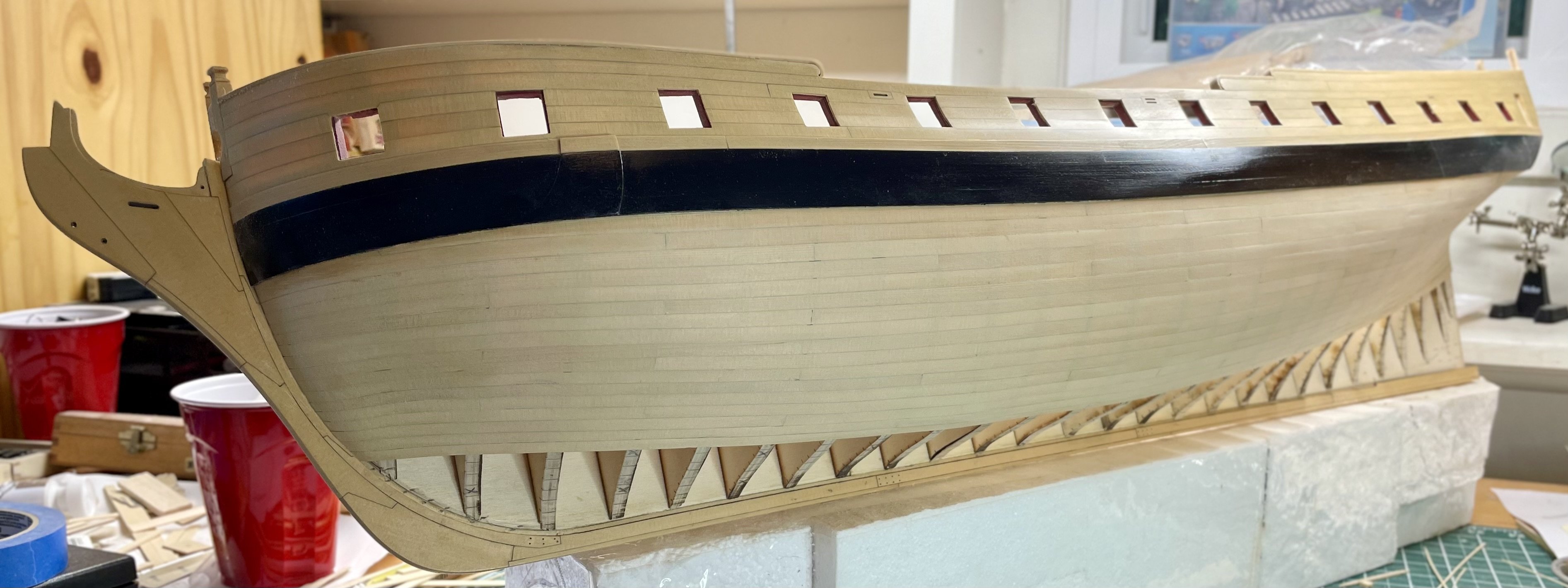

Finally got back to work.  Was able to spend a couple of solid days over the weekend and completed a little over 8 strakes of planking.  I decided to plank both sides at the same time, working in pairs of strakes to help me keep things symmetrical.
Using Chuck's planking method and it's going really well.  For planking, I'm using gel CA glue that I can apply with a toothpick to each bulkhead.
Progress pictures with just some light fairing to even up the edges of the strakes.
Steve
Current Project:  HMS Winchelsea

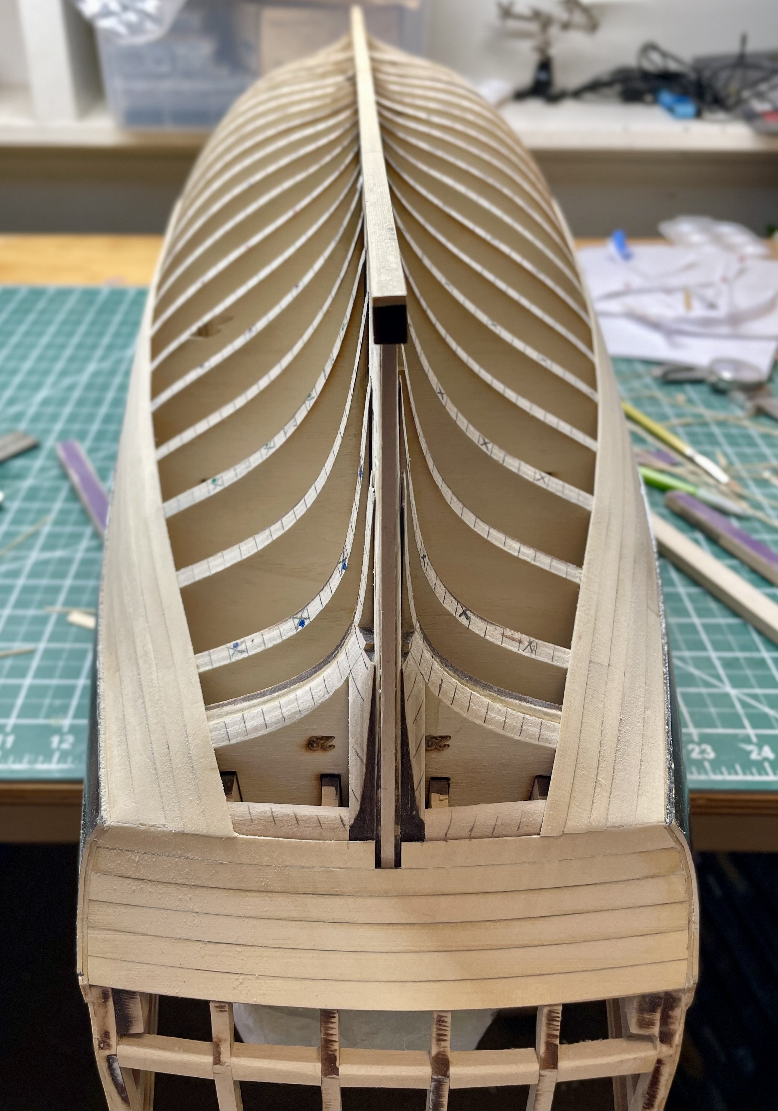

Another update.  I'm almost half way done with the planking of the lower hull.
Finished the tuck at the stern.  This was the most technically challenging area.  It came out okay, not perfect but about as close as I'm going to get it after re-doing about half of my first attempt.  The edge set on some of the planks is pretty extreme and I ended up shaping as much of the curve into the plank as I could prior to applying heat and water.  This yielded a more consistent result for me.
I do some rough fairing as I go along.  Only enough right now to blend the edges of the planks.  I won't attempt to ease any high or low spots until the entire hull is planked.  I also take care to leave the leading edge of my work untouched with the rough fairing as I work along.

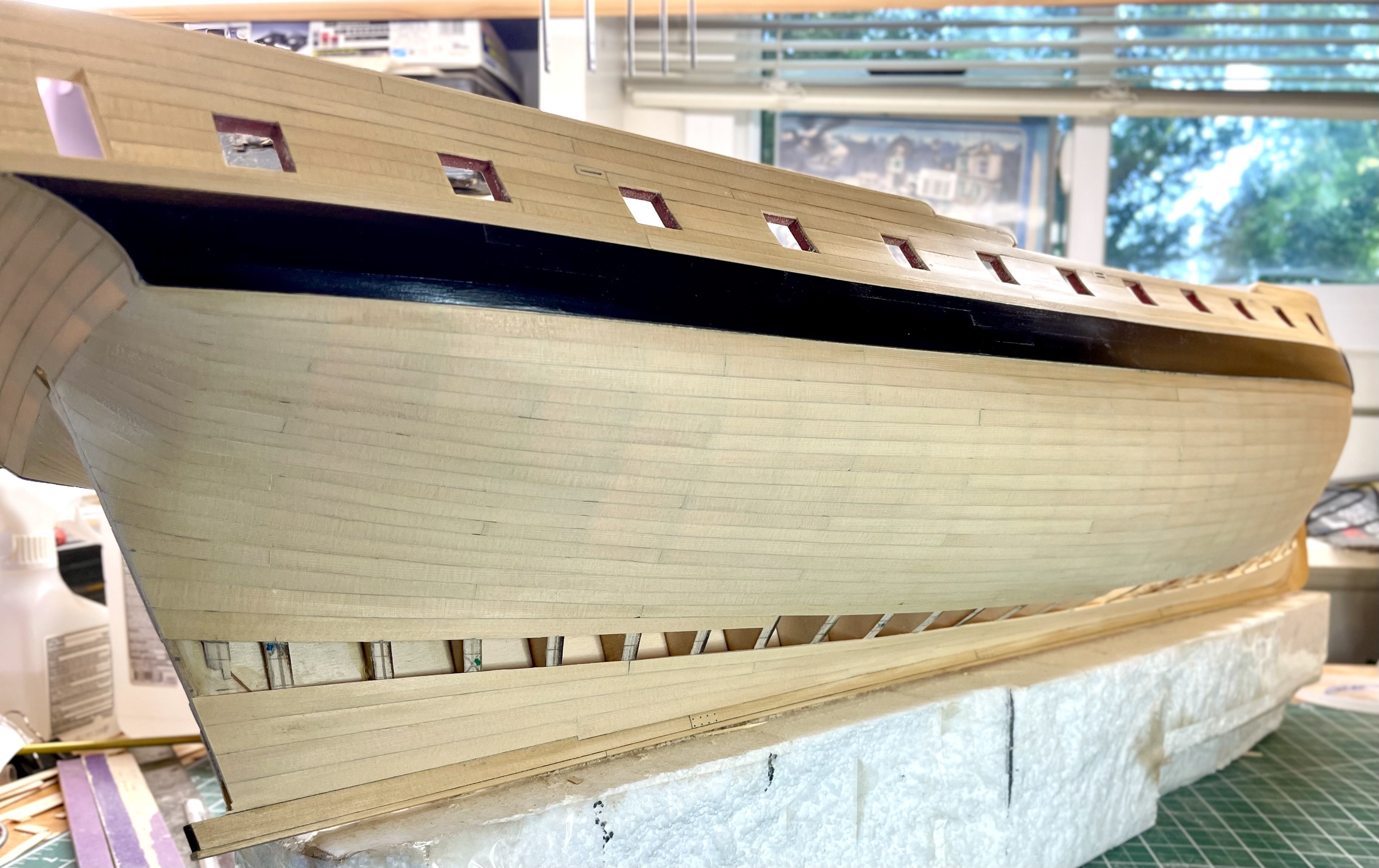

A quick update for the week then back to work planking.
Got another 4 strakes completed on the port side, spending the afternoon / evening doing the same on the starboard side today.  Already have the stern on the starboard side planked to match, need to complete the bow and midships.  Really happy to be finished with the tight compound curves at the stern.
After I complete that work, I'm going to start working my way out from the keel.  Hoping to start the garboard maybe tomorrow.
At the pace I'm going (about 4 strakes on each side per week) I should have the hull planking complete in about another 2 weeks.
Things are going pretty well.  I'm happy with the results so far.  First planking I've done in about 25 years.

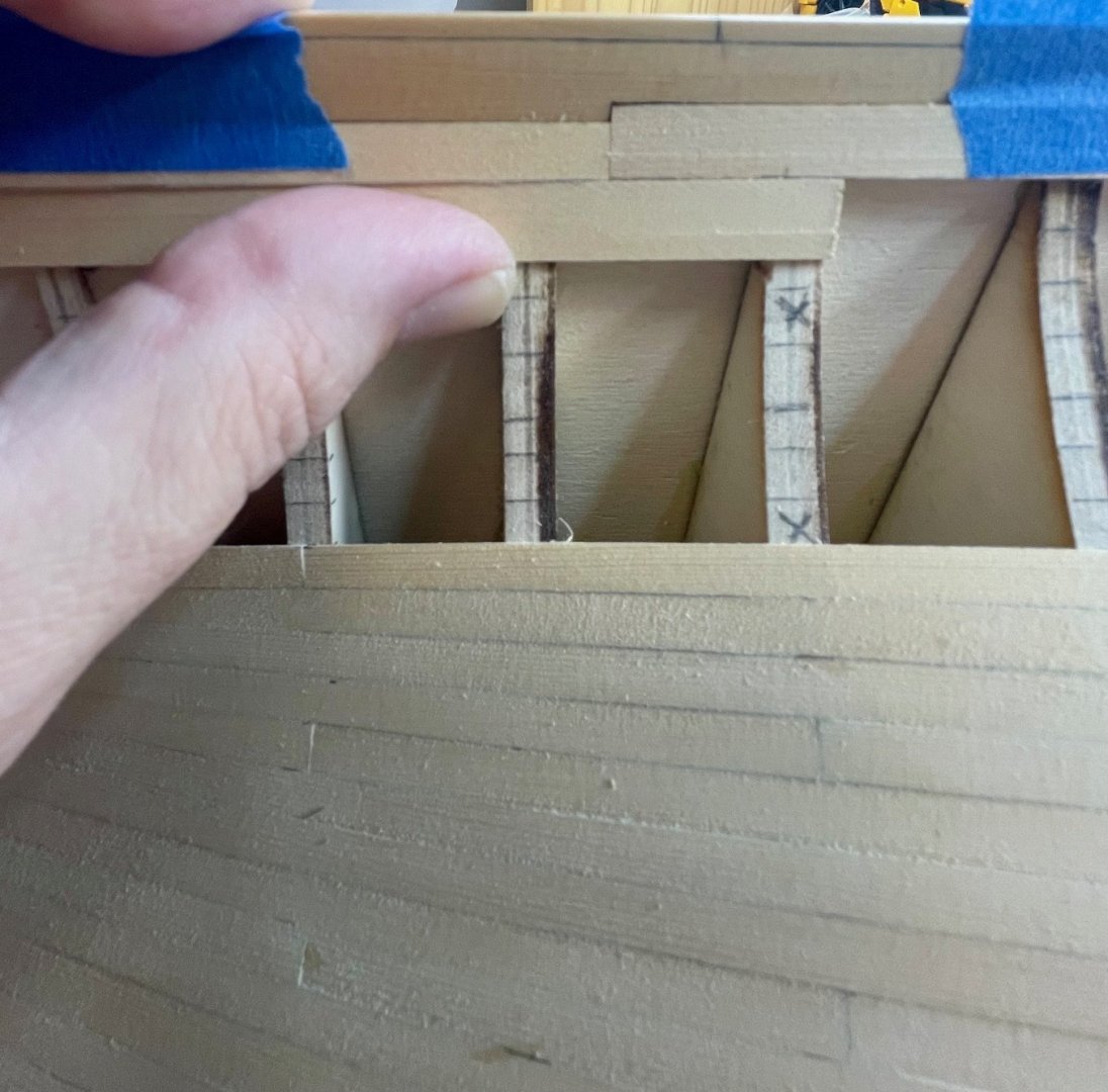

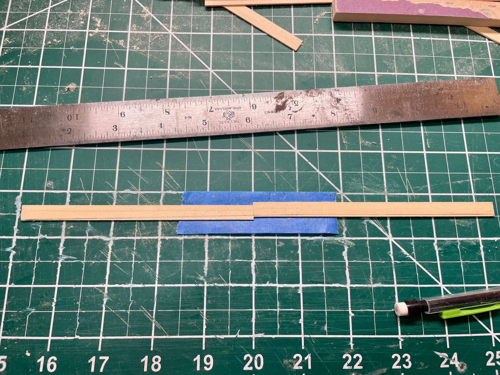

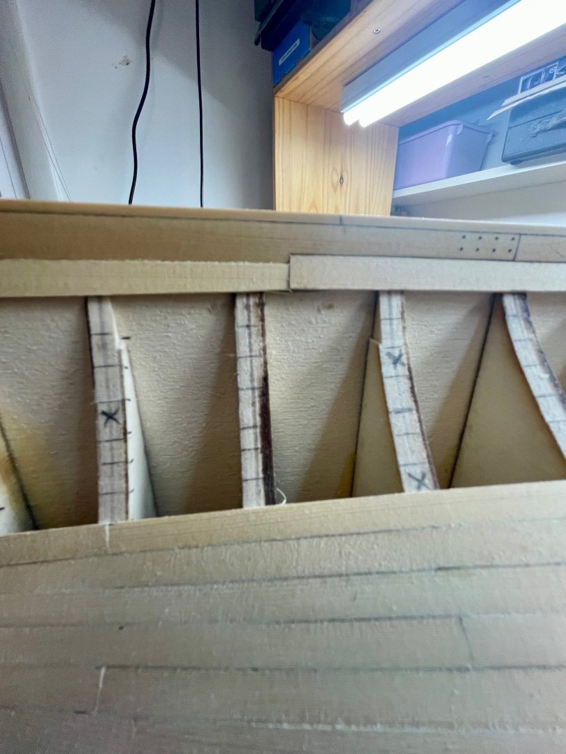

Another example of "don't be afraid to rip it up and do it over"
This is admittedly pretty basic planking technique but might be of value to someone.  Better to do it more than once and be happy with the results.
Started on the garboard strake at the stern and shaped the aft-most planks separately.
There is a taper that continues across the two and I messed up the dimensions when shaping them separately.  Result is an ugly gap when the next strake is placed along side.
So I removed the planks and started over, this time placing both unsized planks on the model and holding them in relation with each other with some painters tape.  Then cut both planks together to ensure a smooth transition this time.
Much better the second time around.  The dark shadow at the joint is a pencil line and not a gap.

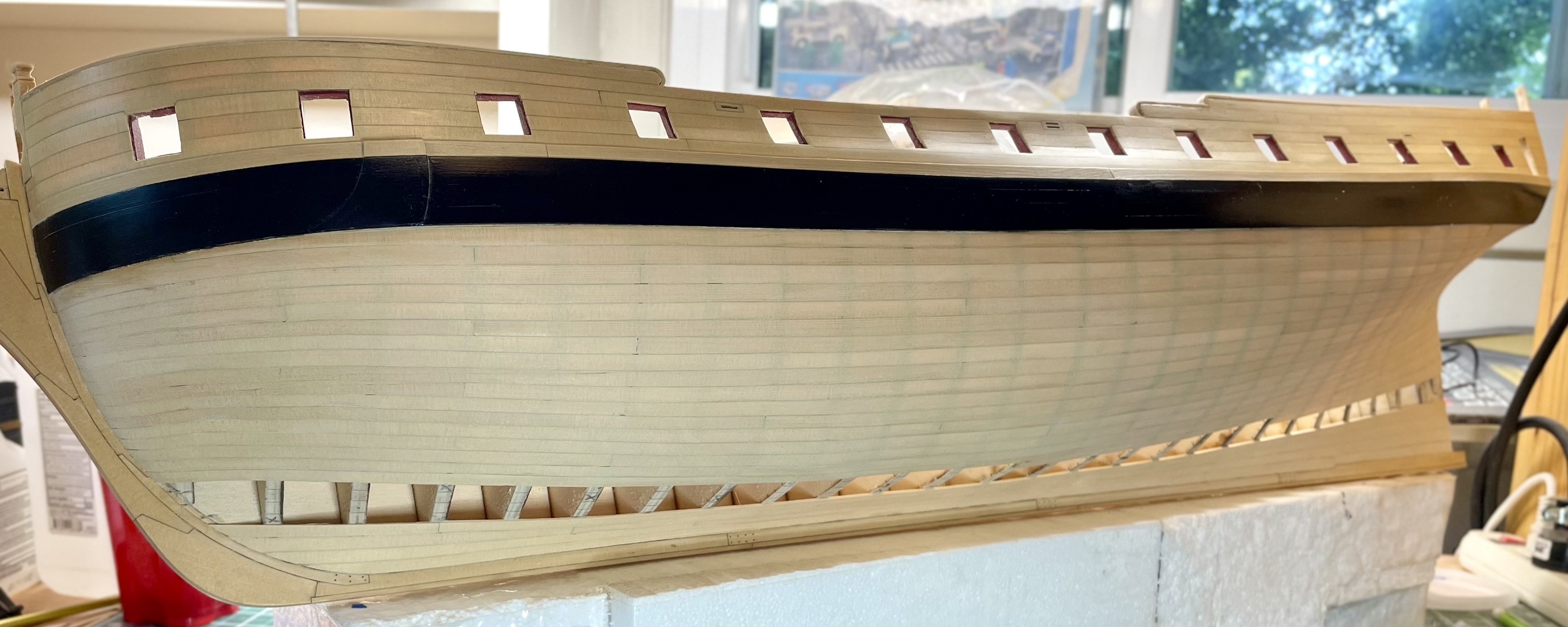

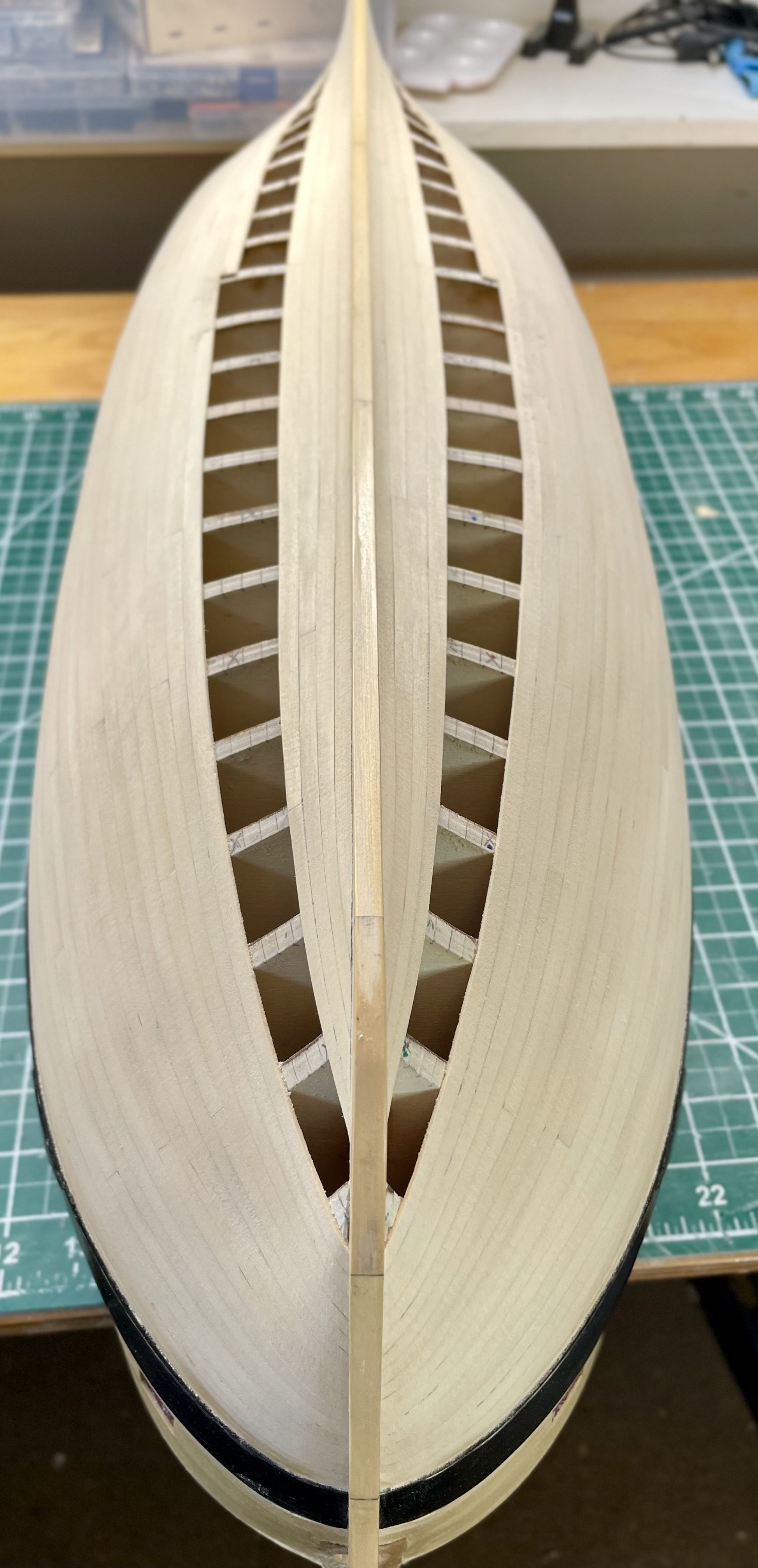

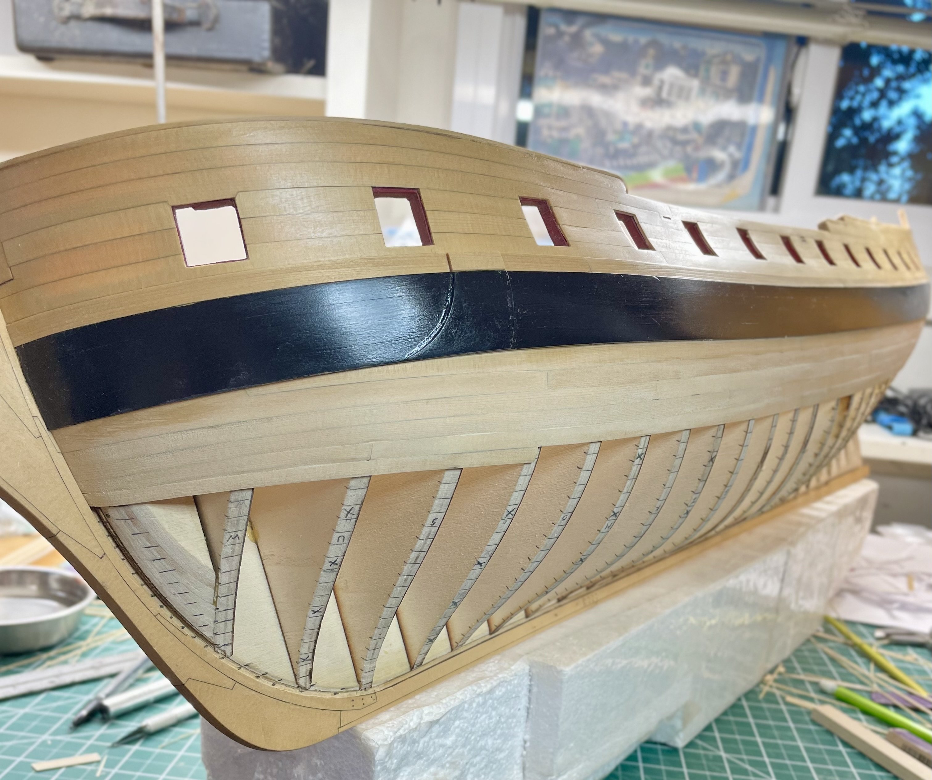

This week's update.
I made better progress than I thought and am down to under 4 strakes on each side to finish.
Had a couple false-starts on the garboard, I documented one above and also took a few failed attempts to figure out a method of getting the forward ends of the planks tucked into the lower rabbet at the bow that worked for me.
Spending all the time on lining off the hull and working with the tape has paid off.  With only 2-4 plank widths remaking down the length of the hull, I have some pretty consistent spacing on both sides.
I've started studying chapter 3 and related work in the build logs.  Looking forward to a new challenge.

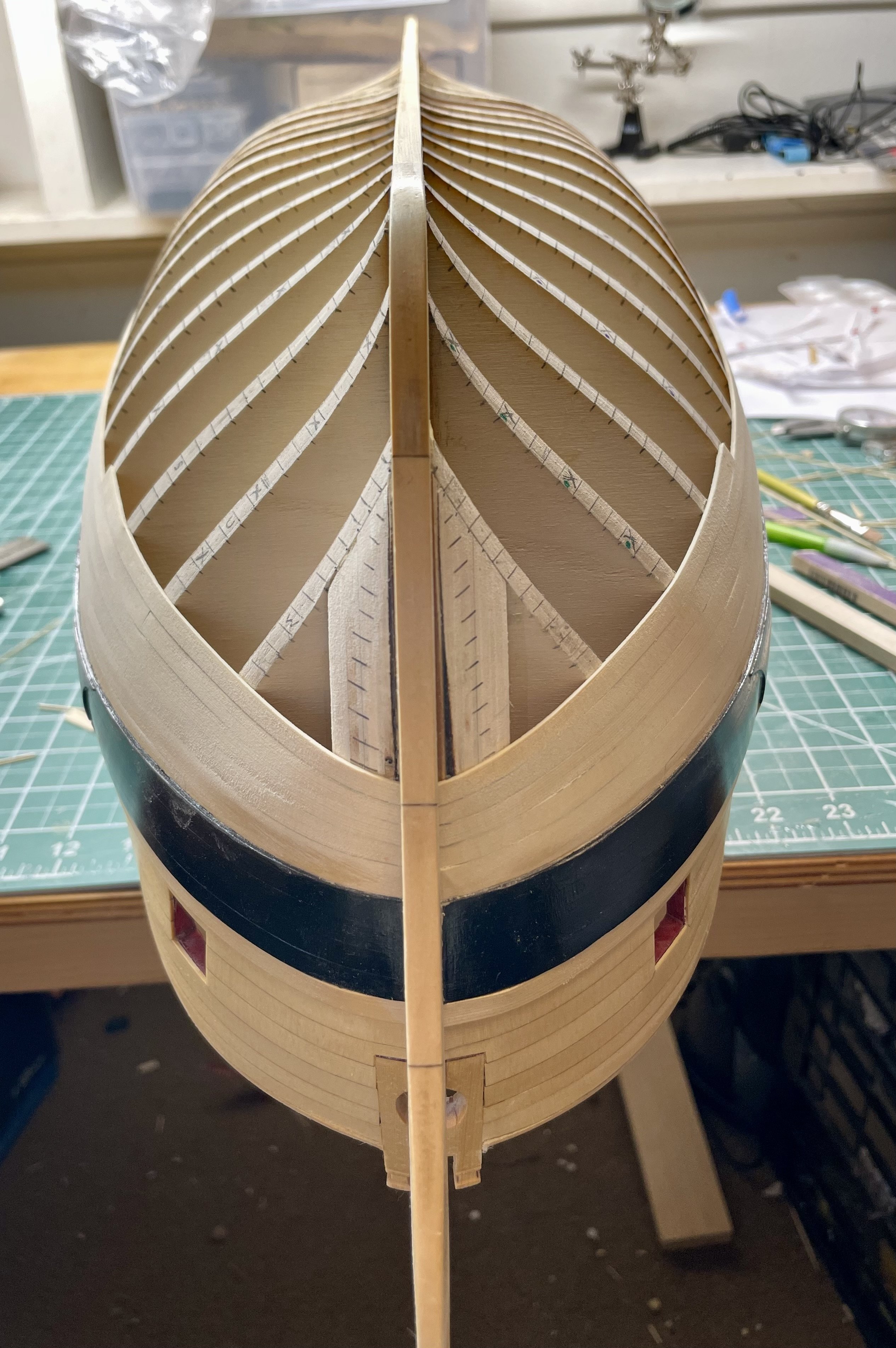

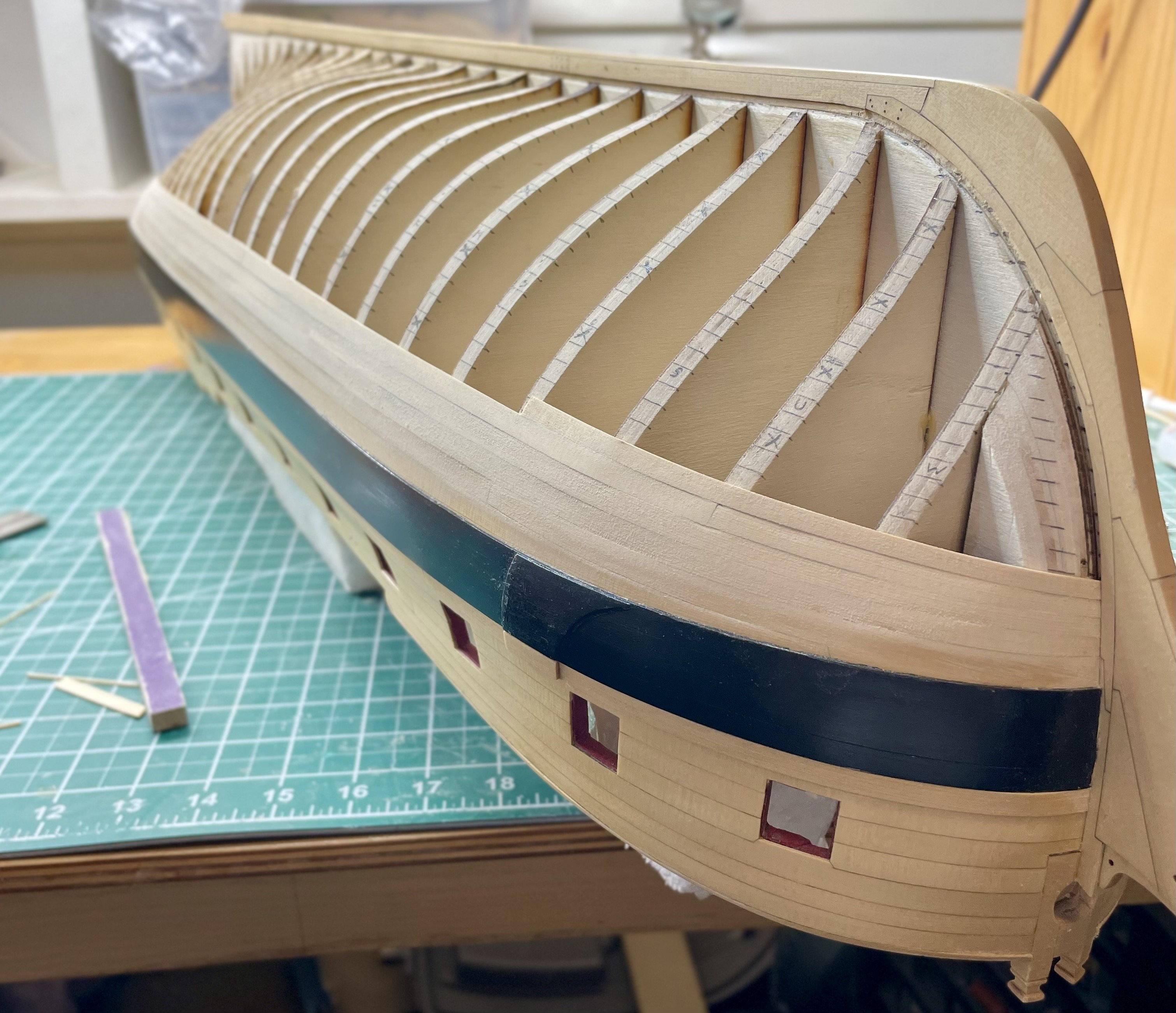

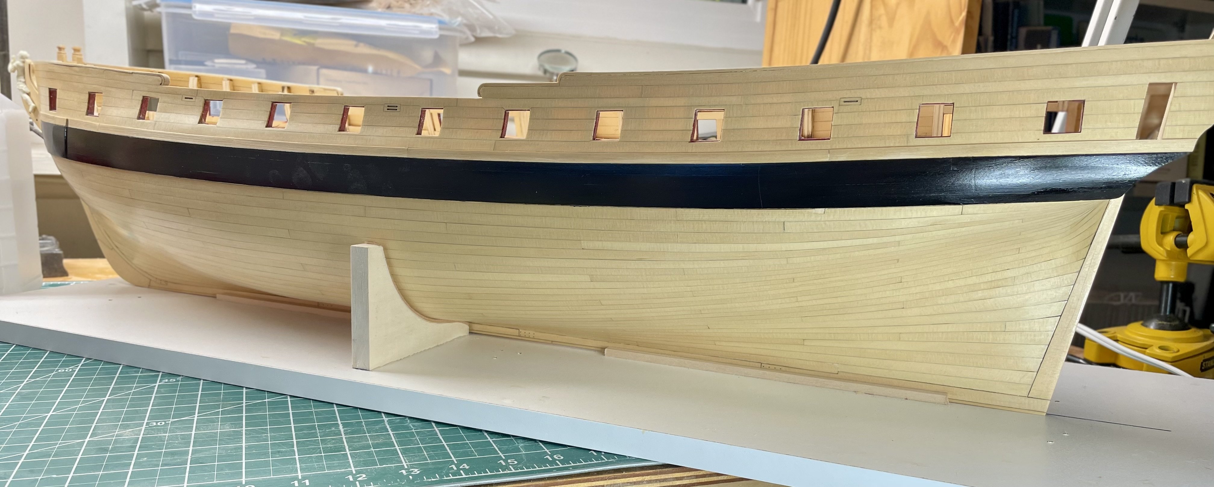

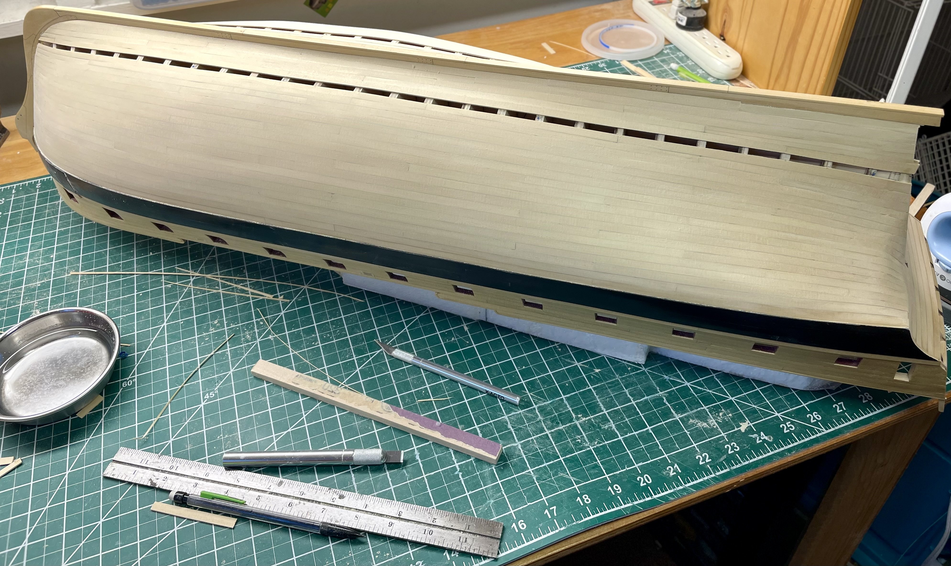

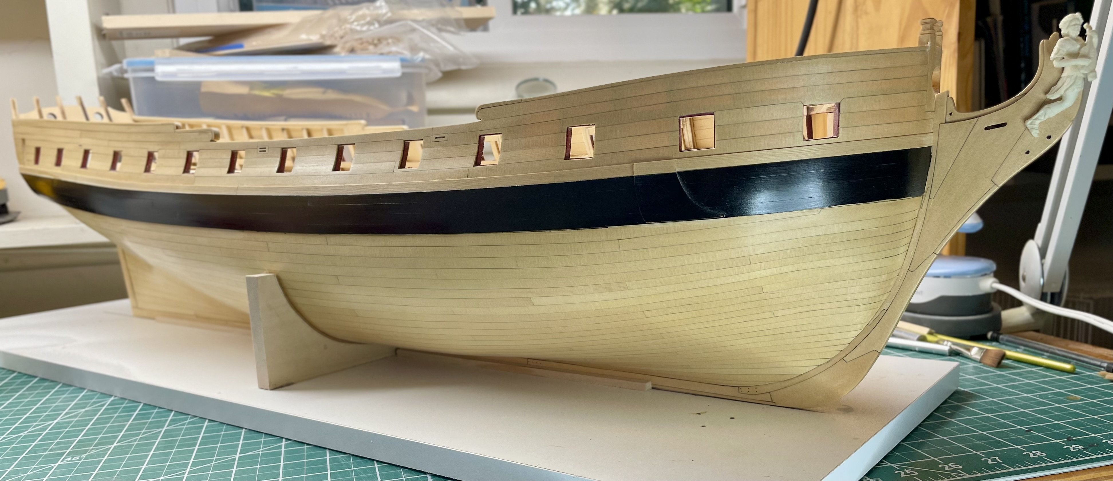

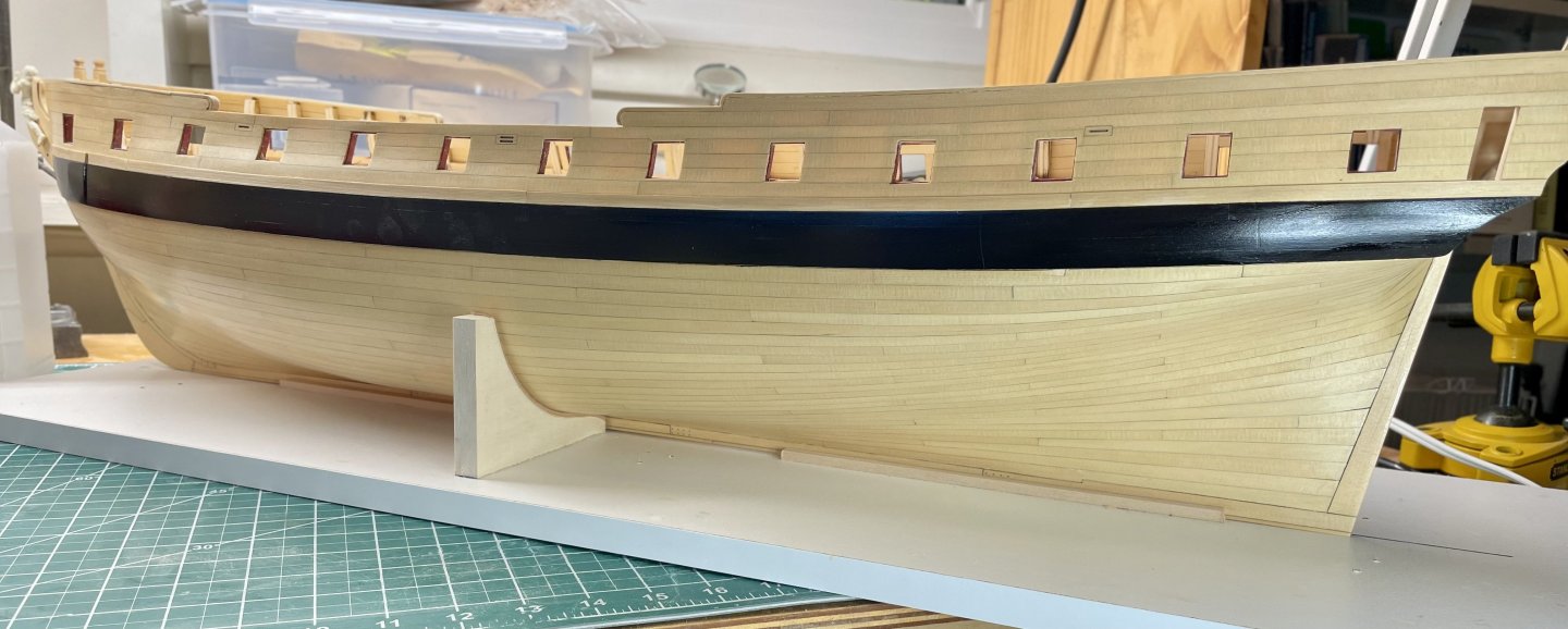

Chapter 2 complete (mostly)
I completed all construction on chapter 2.  I need to spend some more time on sanding and re-applying some wipe on poly.  Pictures below are with 2 coats applied and I didn't wait long enough between coats and the second coat softened the first coat making it too thick and glossy.

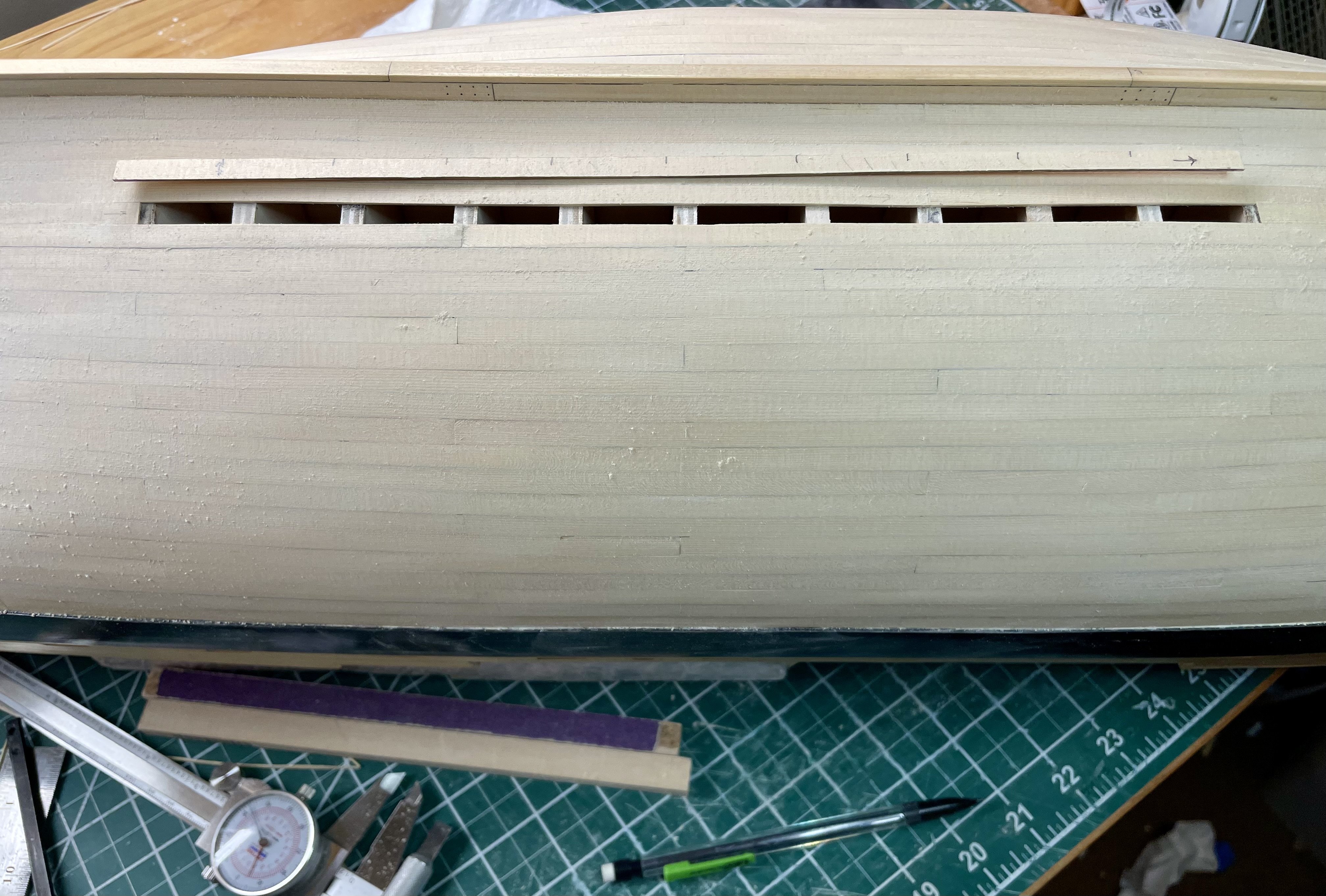

Down to the last strake on each side.  Showing pretty much all the tools I used for the planking.  Steel ruler, pencil, a #11 blade and a chisel blade, some sanding sticks, and a little water to use with my hand iron for edge setting.  The short scrap of plank is a critical tool used to check the width of two planks butting up to each other.
Last plank going in.  Marked the locations of the bullheads and transferred the dimensions using my calipers.  Then slowly sand and check the fit being careful to only remove minimal material each time.

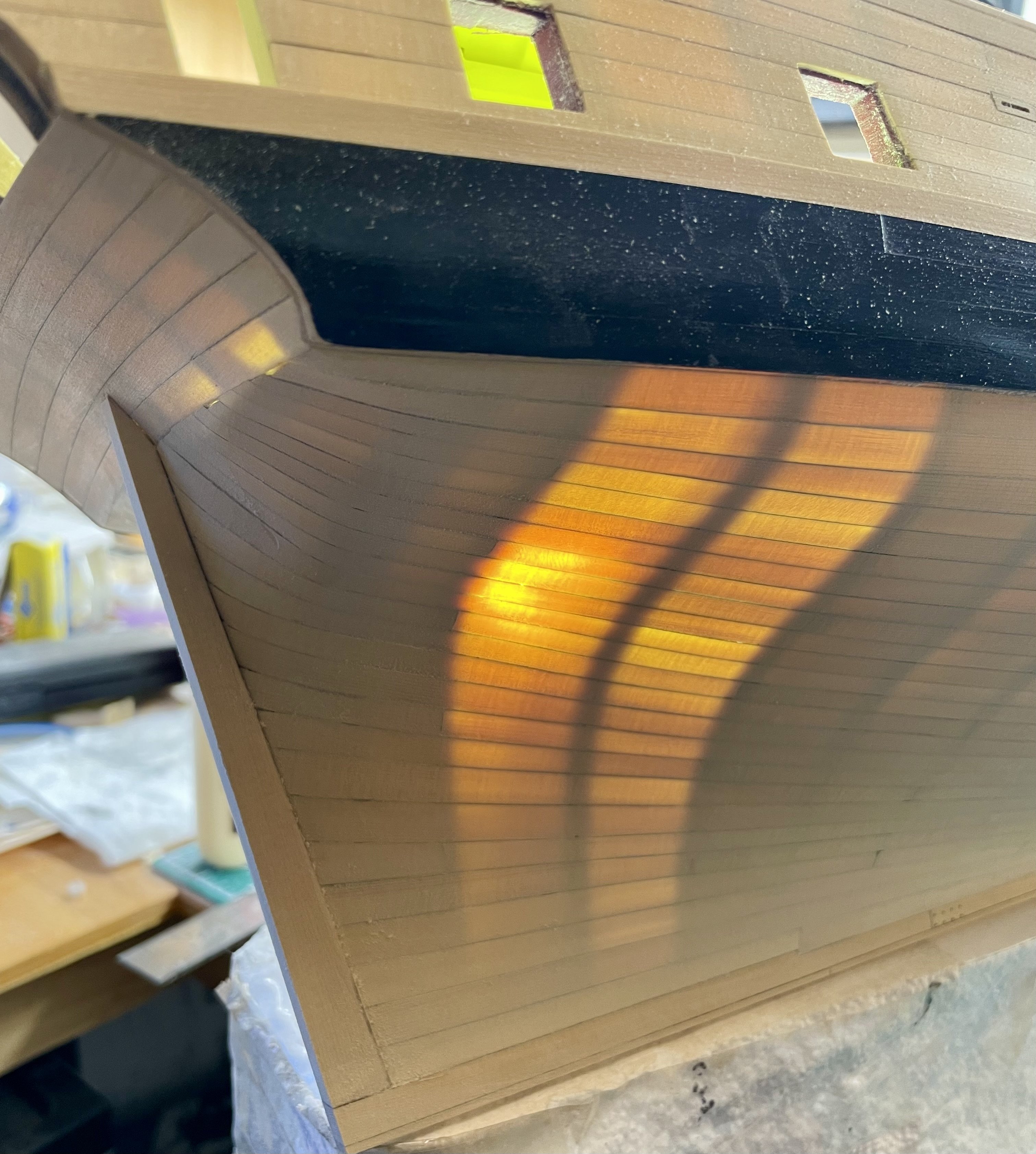

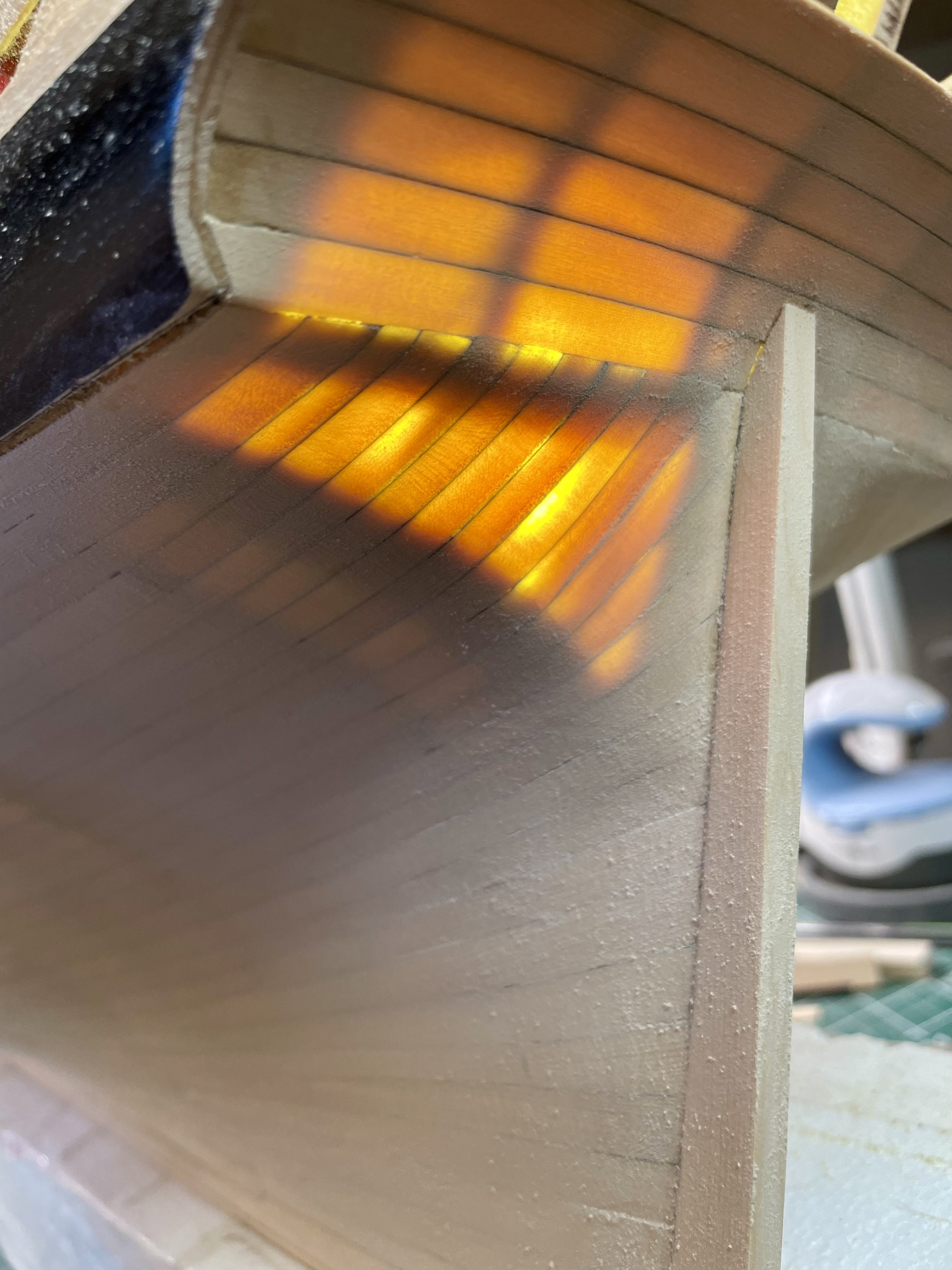

I used a flashlight to backlight the planking while I was fairing the hull.  It makes it easy to see when you are getting too thin in a specific area of the hull.  On the second picture showing the stern you can see where a couple of planks have become very thin.  I've also added the stern post.
image.thumb.jpeg.fa596b8b65ba1ad75a756b551f3b58d6.jpegimage.thumb.jpeg.b96e3cba4b6b0867781973326c6bbf5f.jpeg

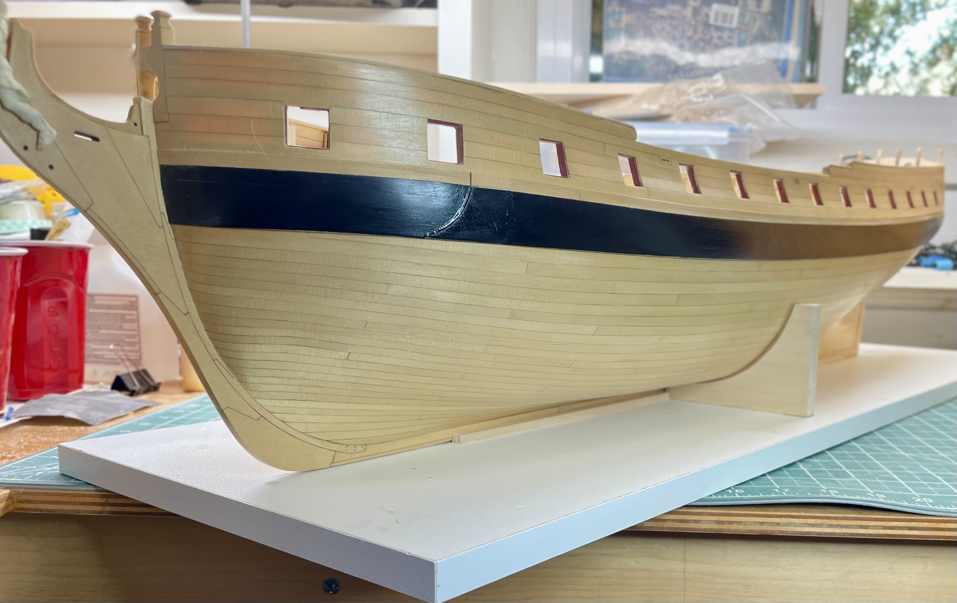

All chapter 2 construction complete and back on the build board.  I need to fabricate a couple more pair of supports but the model is surprisingly stable and level with just the one support midships.

Thanks Chuck, yes it feels very nice to have this step behind me.  Of course I know where all my mistakes are but I'm overall pleased with the results.
If I had one thing to do differently, I would have fully blocked the bow and stern areas 2-3 spaces deep each.  I have seen really great work from some using only the bulkheads to control the shape of these areas, but I struggled.  For me, I think having the solid blocking to completely control the curves in these areas is the way to go in the future.
