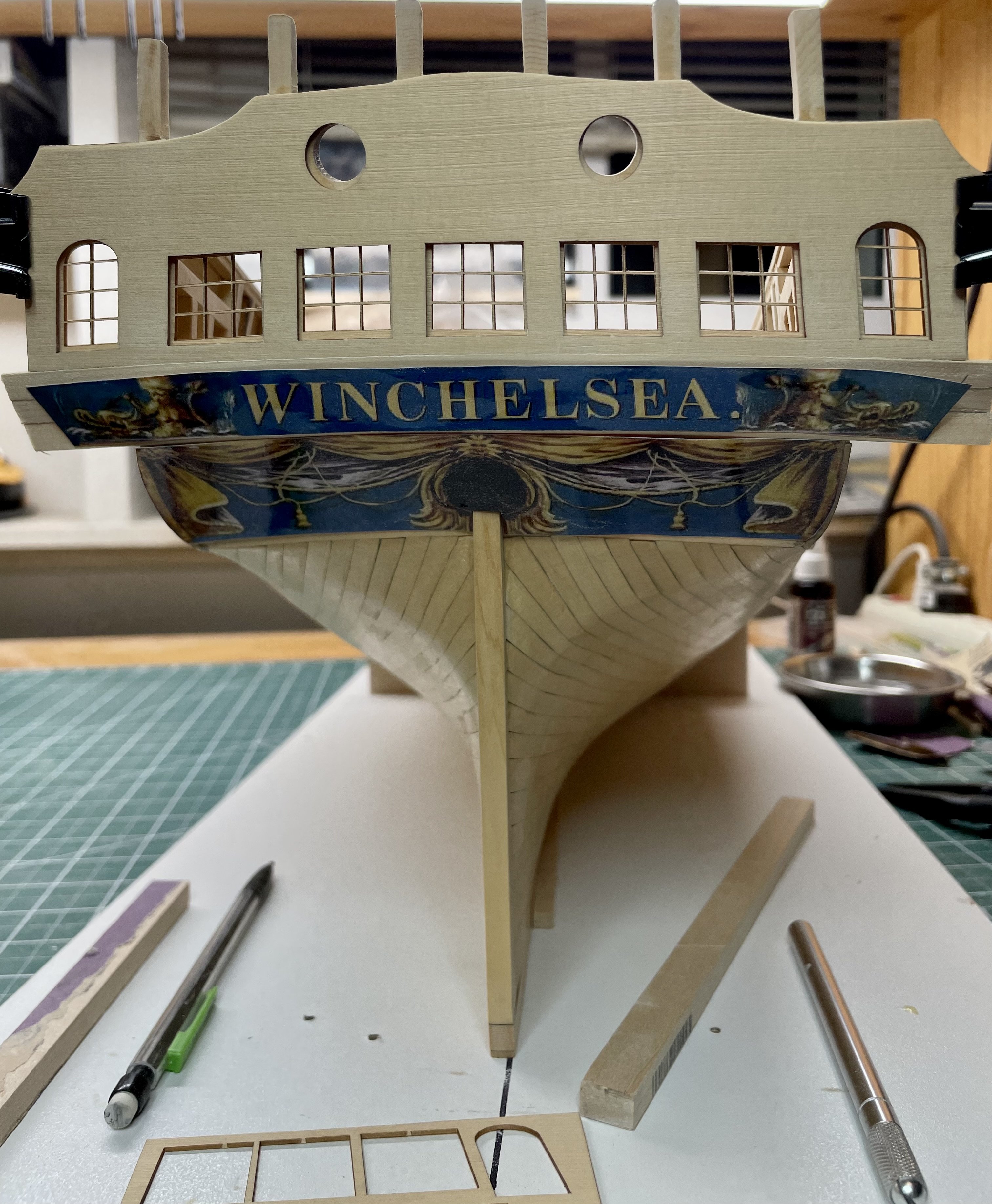

Having some fun with chapter 3 already.  Have the transom and upper counter installed and working on fitting the 3/32 thick quarter gallery pieces.

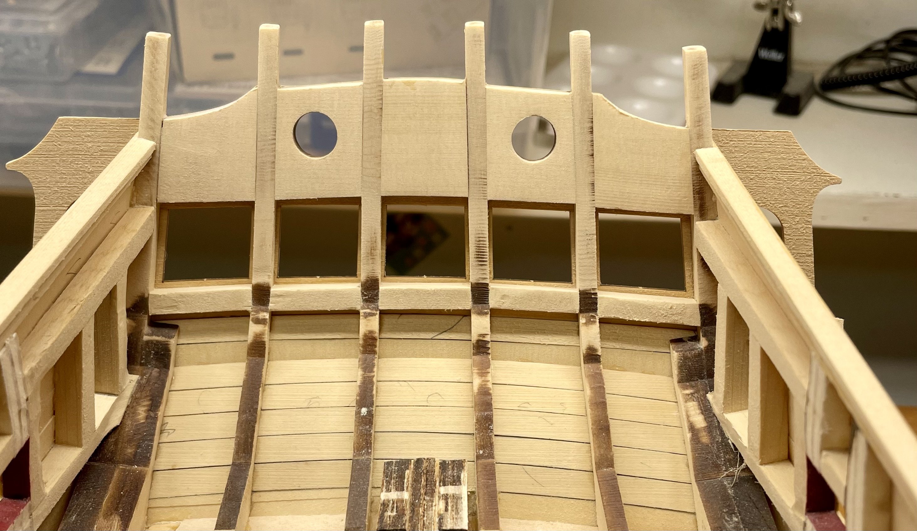

Transom installed and centered as good as I could get it.  Spacing from side to side is even and the top of the transom has been rough sanded to fit.  Upper counter planking is also installed.

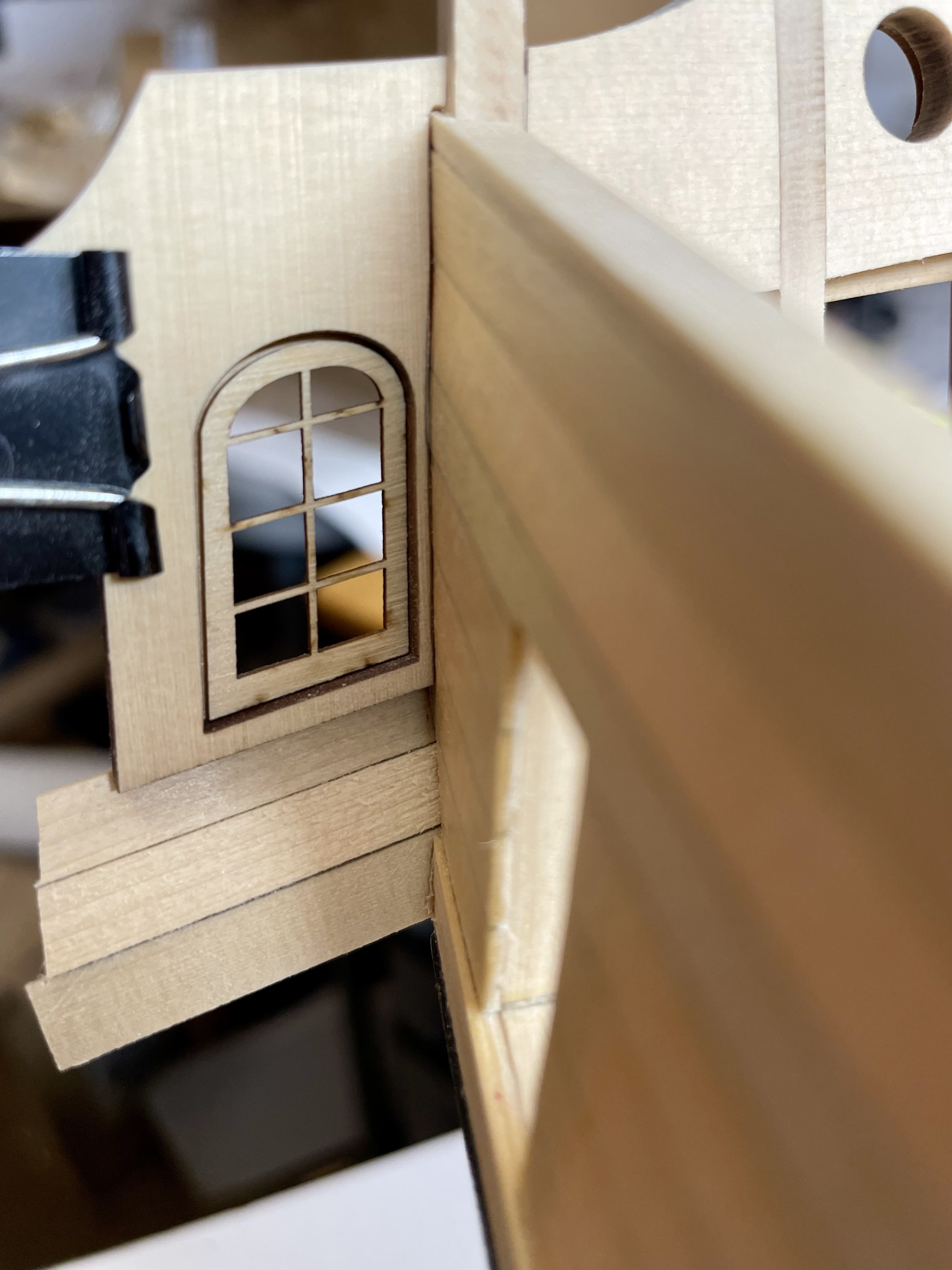

Fitting the quarter gallery pieces to the side of the hull to get the window spacing even from side to side.
And a picture with all the window frames in place.  Looks like the window frames sit a little high.  Should I leave them alone or risk cutting about 1/32 off the bottom edges of the window frames to get them centered?  Otherwise they all fit really nice.
Friezes are laminated templates I made to check size and placement, just held on with tape.
I really need to sand down the finish on the hull and do it again.  The glossy hull is killing me...

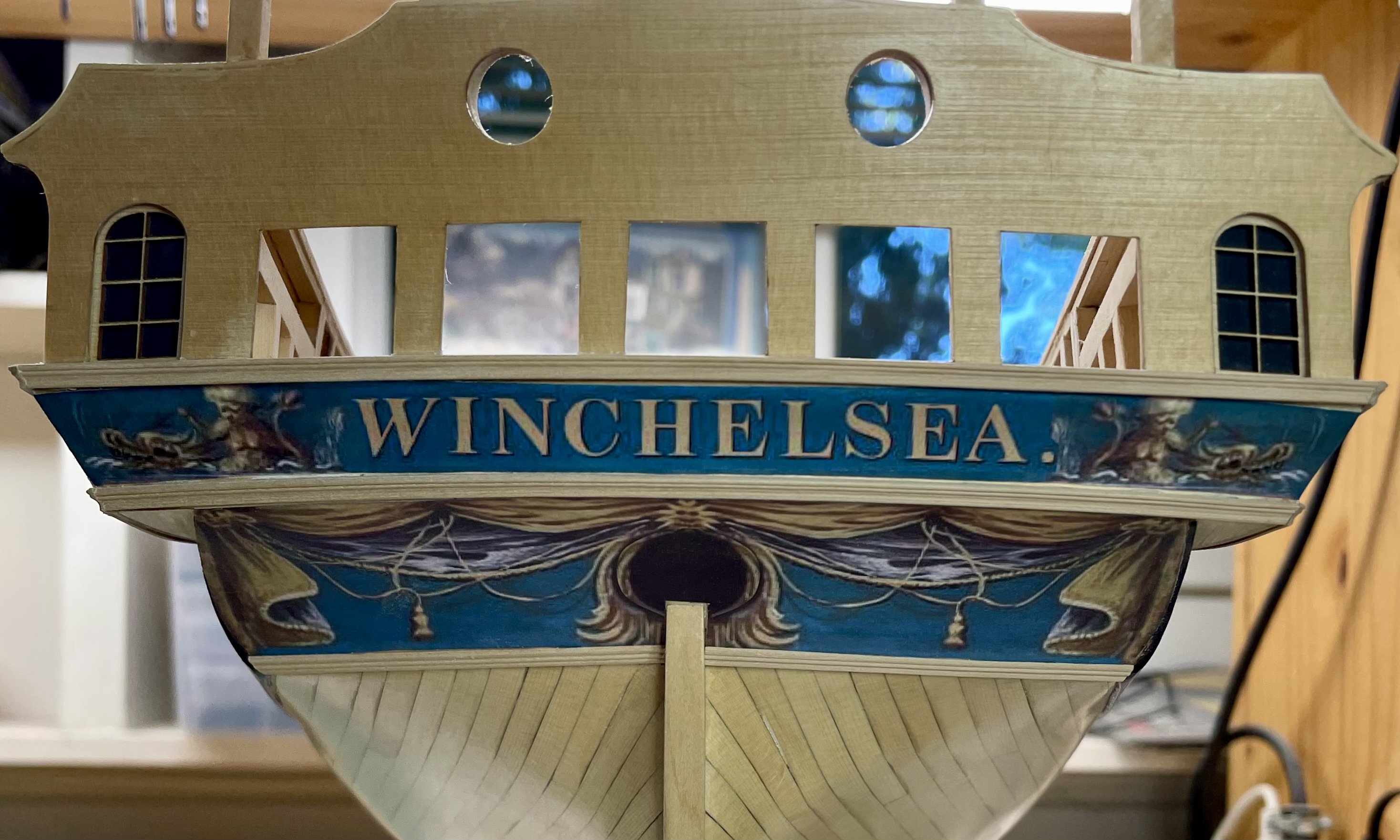

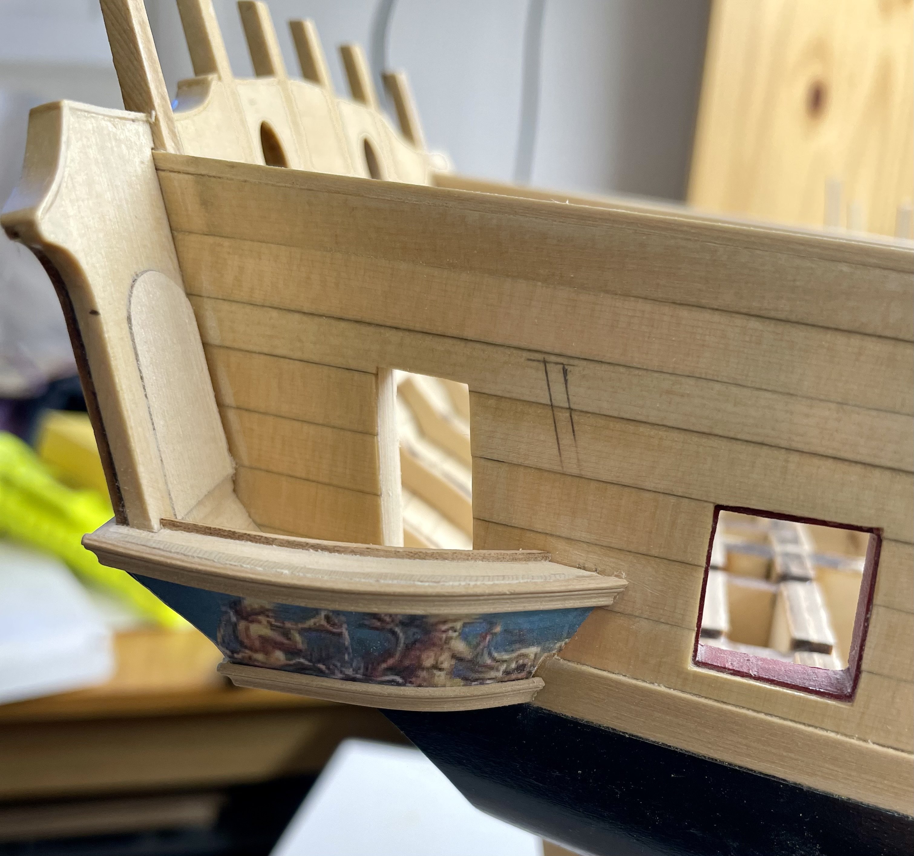

Some more progress on chapter 3.  I've got the transom and upper counter pretty much complete and started on the quarter galleries.
Adding the cap pieces to the top edge of the transom.  I had to learn the hard way to use some scrap wood as pads under the clamps to prevent marring the thin cap pieces.
The obligatory picture of the quarter gallery templates in place to locate the forward edge of the galleries on the hull.  This port side gallery lands exactly where shown in the instructions.  The starboard side is around 1/32 - 3/64 if an inch higher.  Looks like The angle of my transom is off just a little bit from side to side.
Fit and installed the top frames of the quarter galleries.  Fairing the frames to match the intersection of the upper counter on the transom was a little tricky.  Going to stop here tonight and sleep on it and see if I'm still happy with my work in the morning.  If not, I still have the spare set of frames provided in the kit if I want to do them over again.
And a picture of the stern.  You can see the transition from the upper counter into the quarter gallery frames on each side.
If I'm still happy with this in the morning, I'll add the lower frame and maybe the lower planking to the quarter galleries tomorrow.
Steve

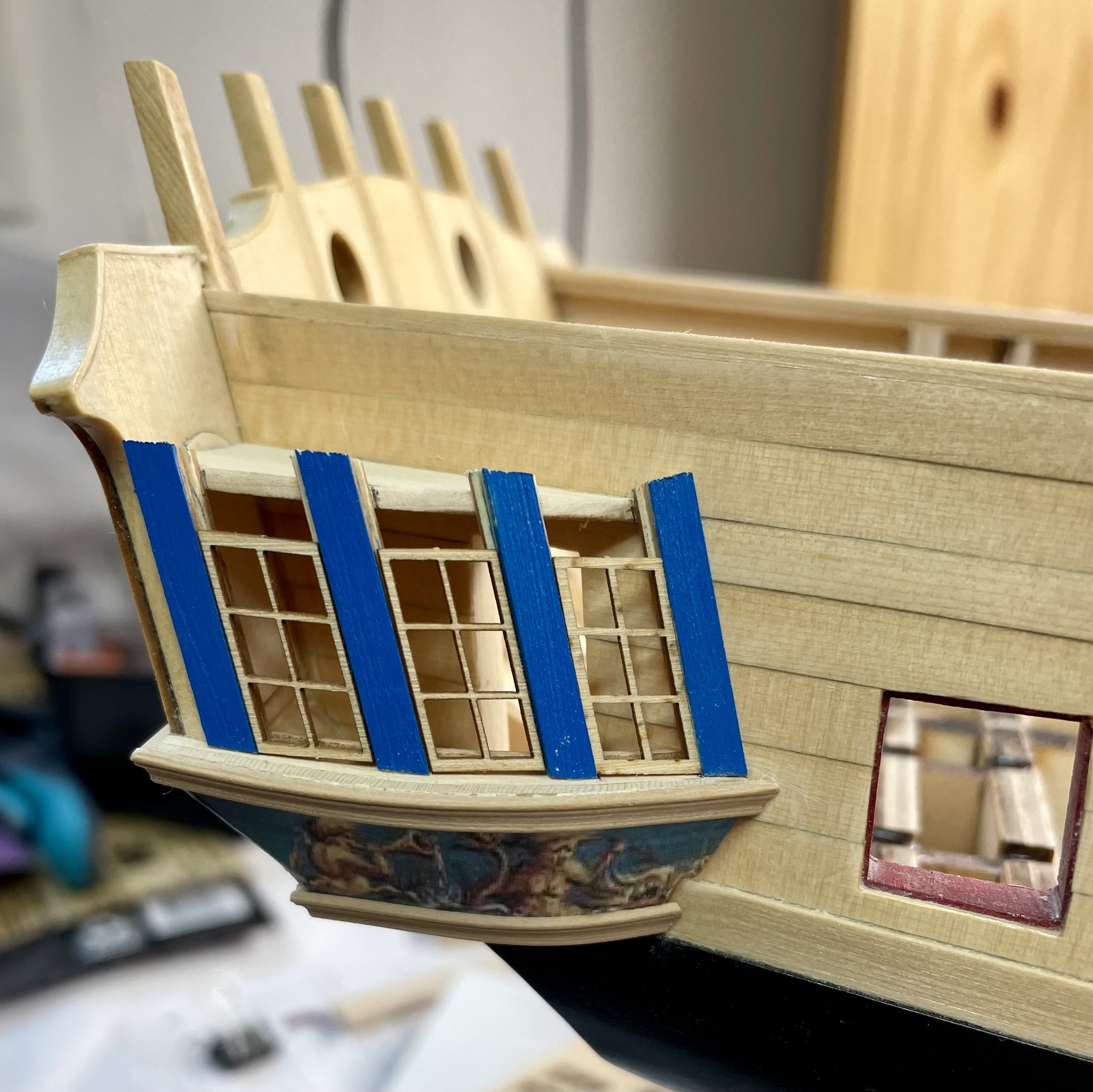

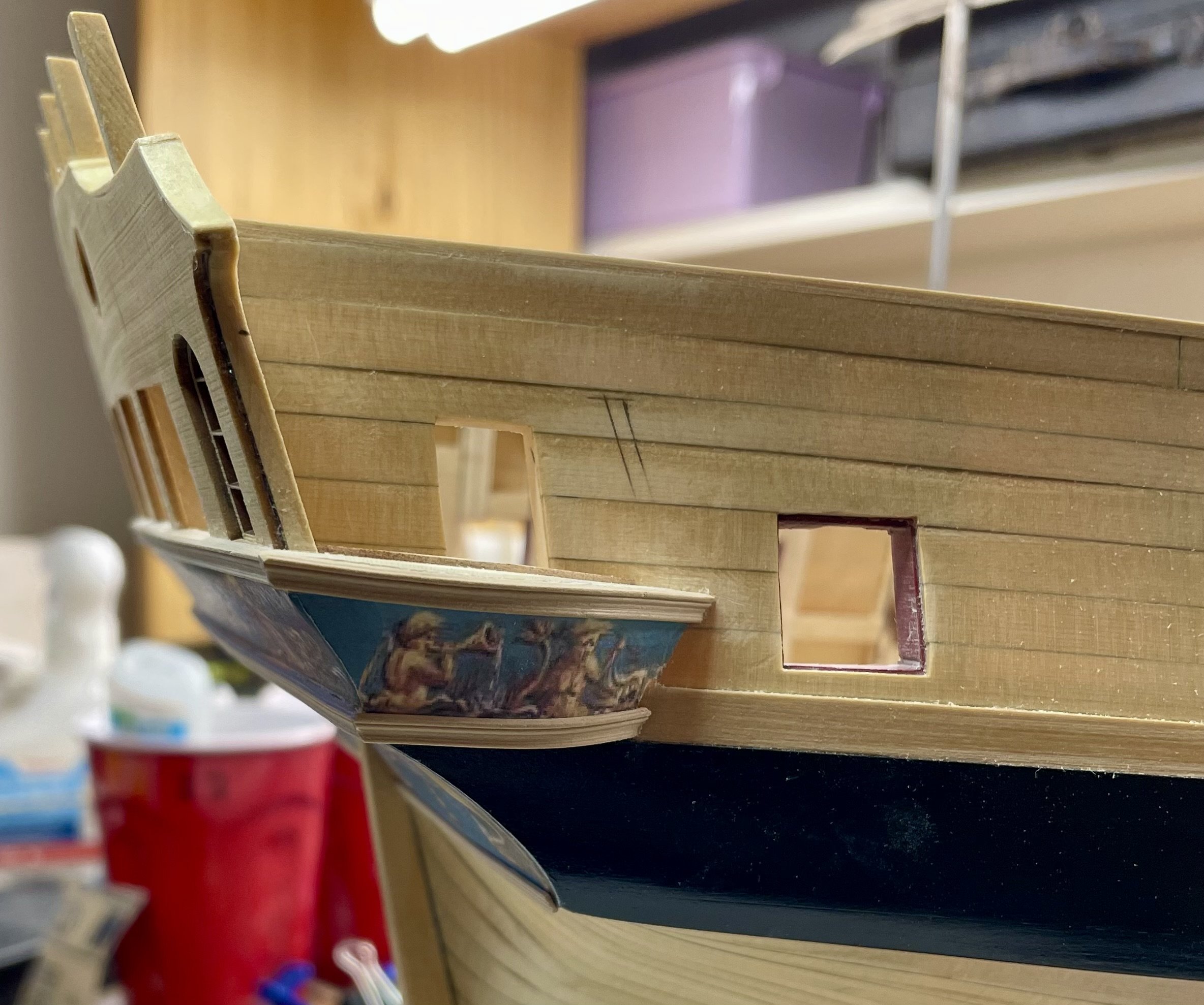

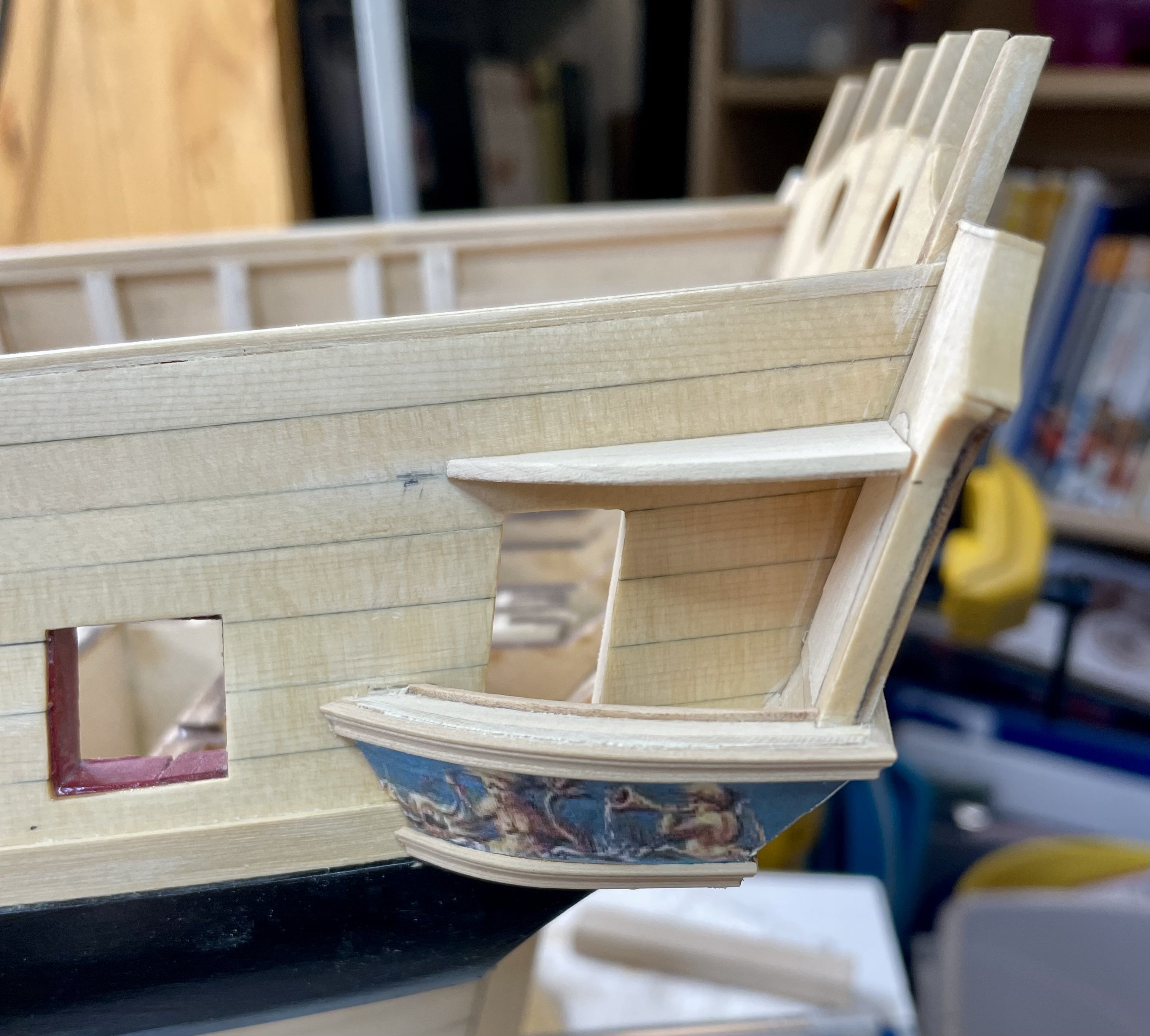

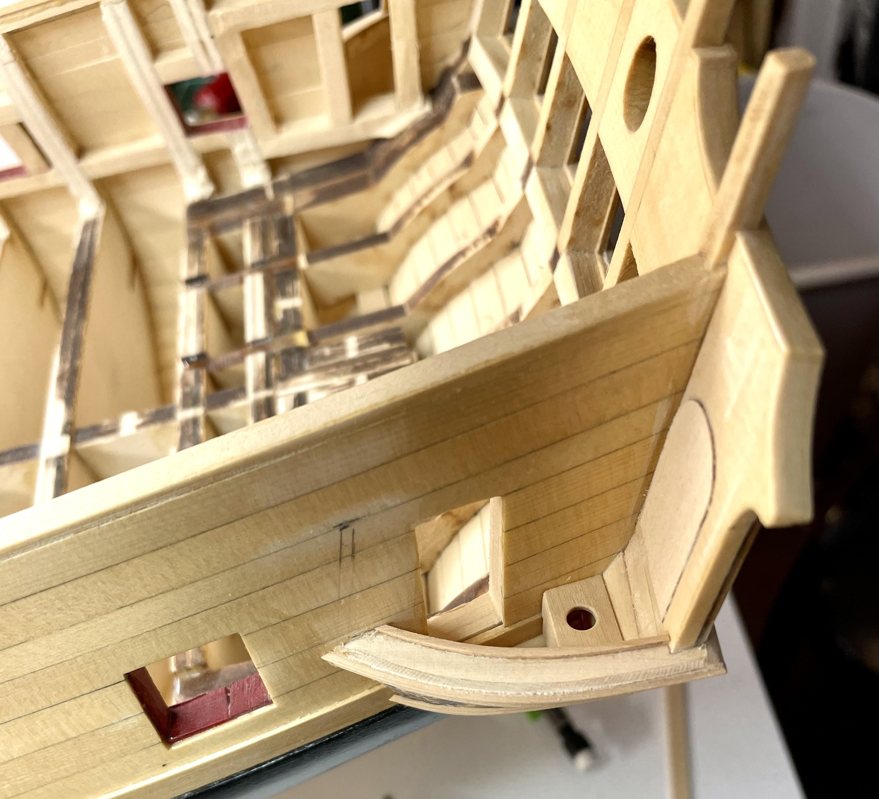

More progress on the quarter galleries.
I have the uprights installed on the port side QG and about to start that process on the starboard.

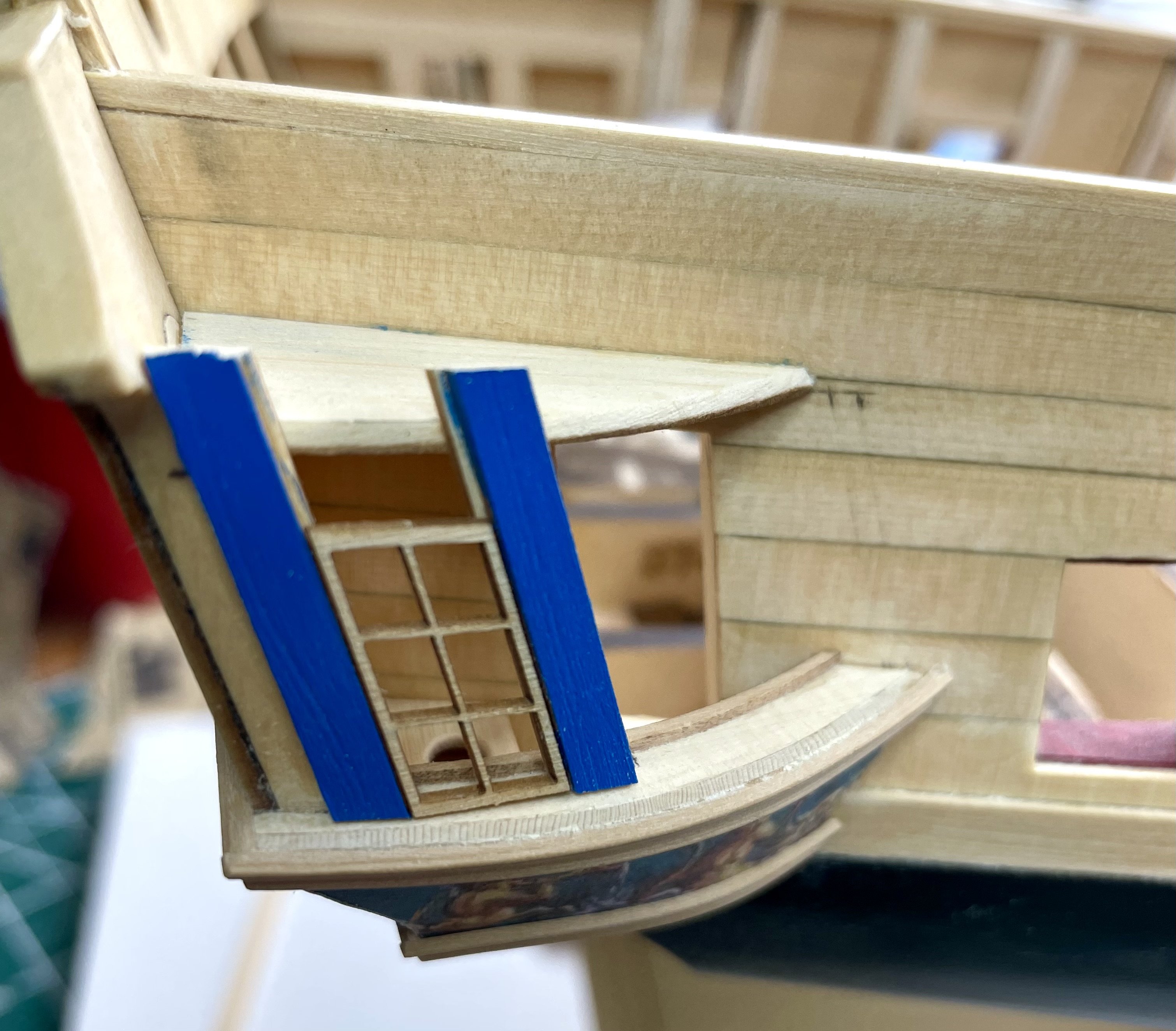

Definitely a fiddley bit of work getting all the angles correct on the base of the uprights and along the side of the hull.  I went back and forth a couple times and got all 3 windows to fit but it was a really tight squeeze to accommodate the width of the uprights and the 3 windows along the arc of the QG.  I ended up cheating a little by making the upright along the transom slightly narrow and really drastic bevel on the forward upright as mentioned in the instructions.
A few pictures taken along the way
Got the seats installed.  Easiest to assemble the seat and seat front outside the model and then place in the QG.
Then added the top piece.  It looks like most of my measuring back in chapter 1 paid off as I was able to use the planking lines as a guide for the angle of the top piece.
Working on adding the uprights and using the windows as spacers.  I temporarily tacked the uprights along the top piece but this step was similar to building a house of cards.
Port side uprights with windows placed as spacers.  I still need to try the other windows provided to see if I can get a better fit but this is pretty good.

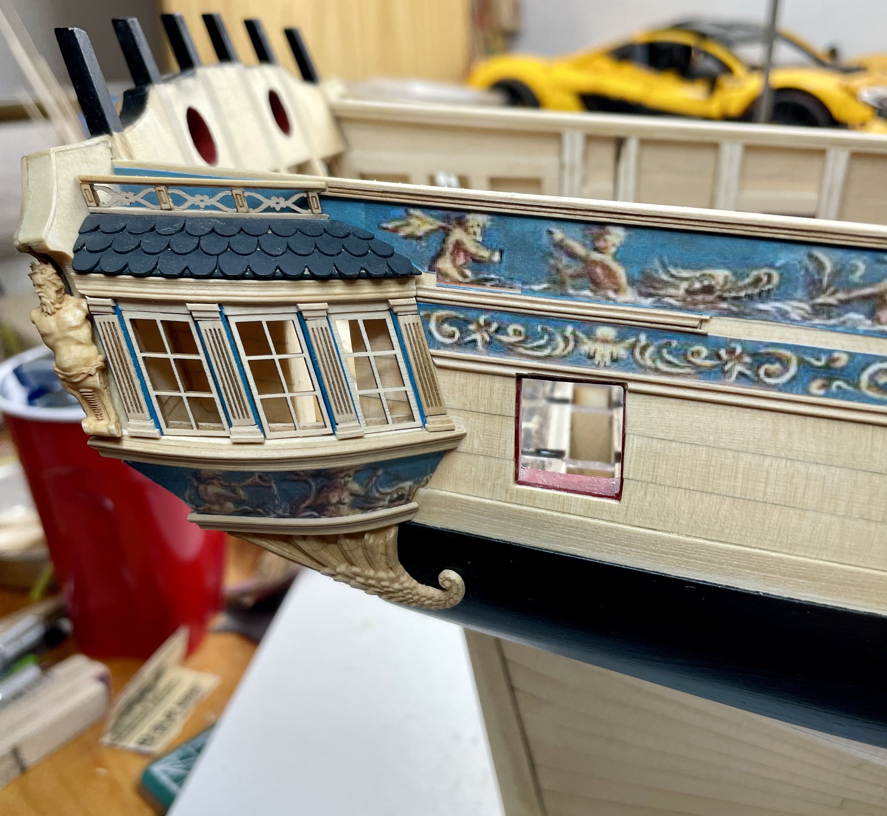

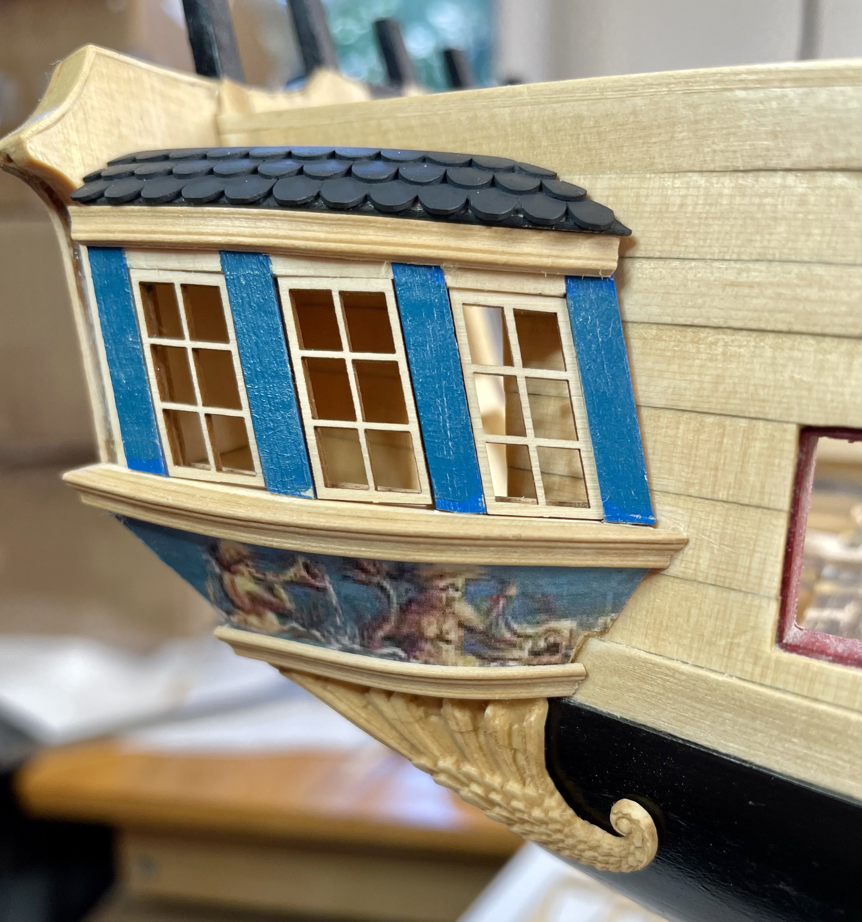

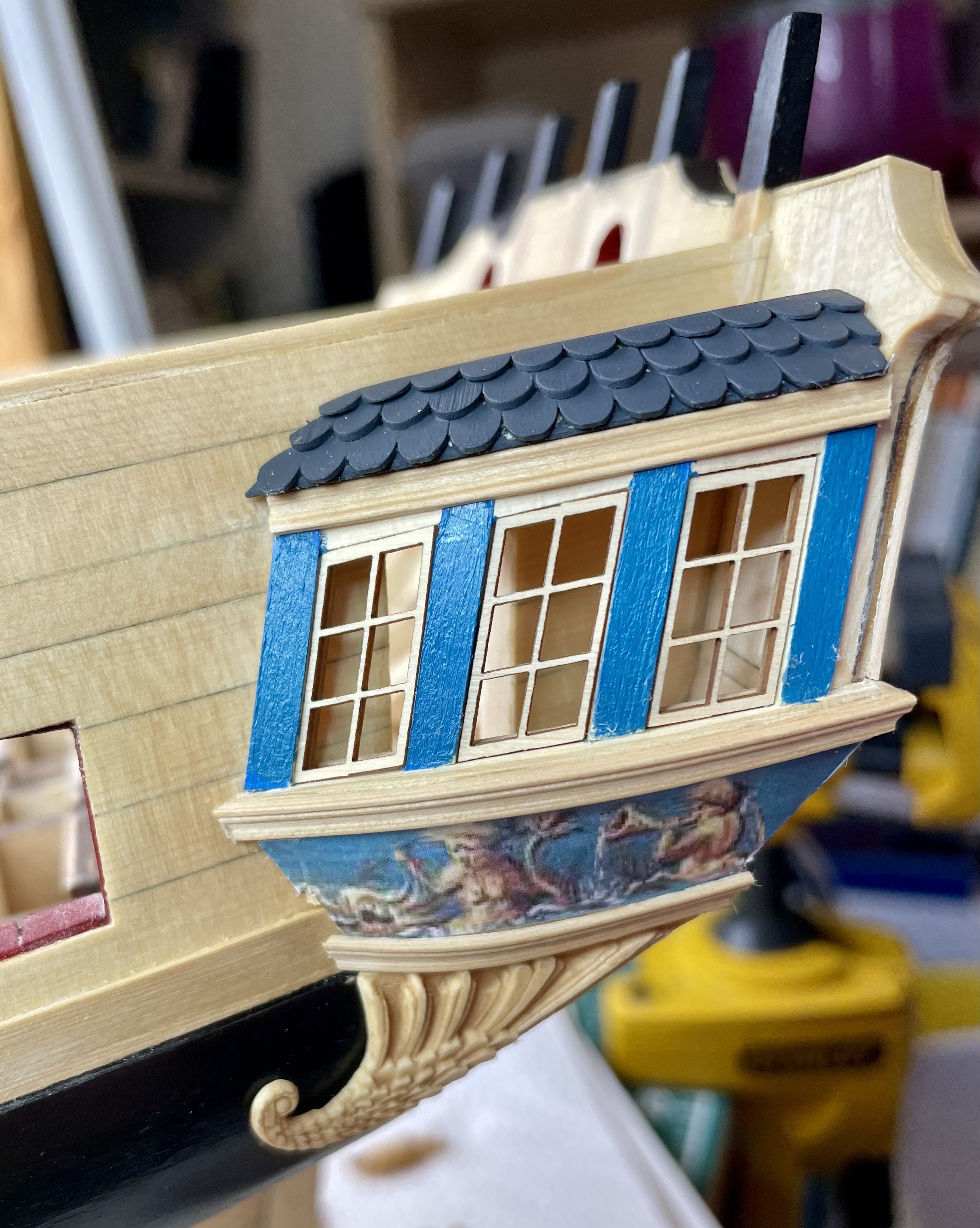

I have the QG closed in and all trim complete with the exception of the the fluted columns.  I'm going to hold off on these until I can do the same detail on the transom at the same time.
Also have the shingles on the roof as well as the drops installed under the galleries.  I'm pretty happy with how things have turned out so far.  The window fit is good.  The windows are just set in for now.  I'll be removing them and waiting to install them at a later time.

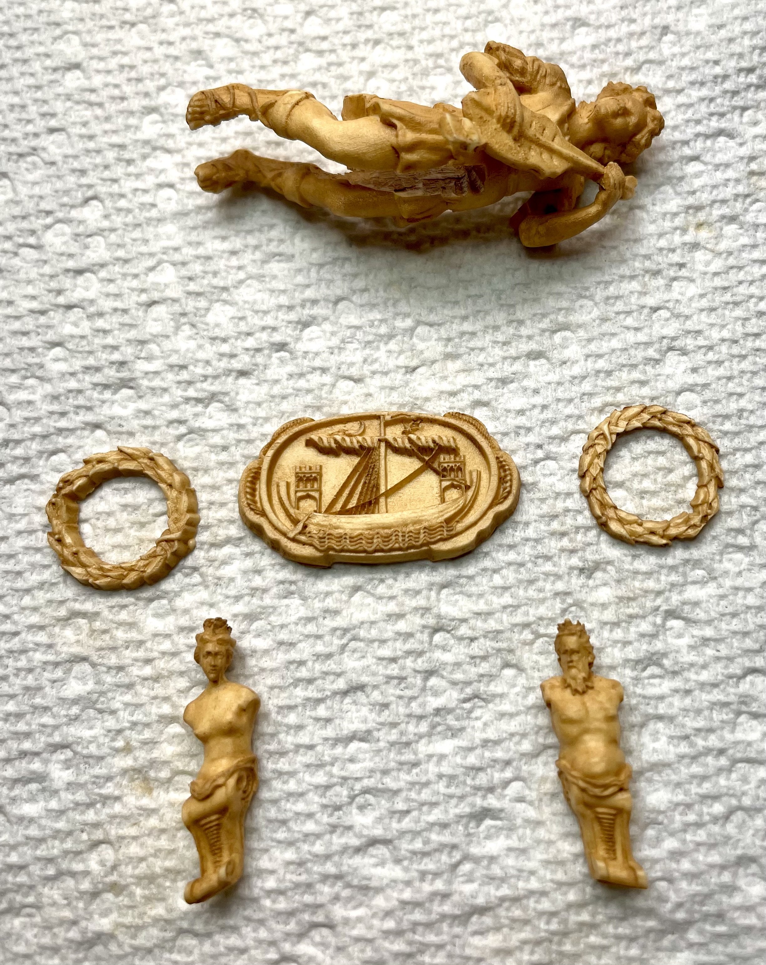

Also prepping some more of the resin carvings for placement on the model.  I have been very pleasantly surprised at how well these look after following Chuck's instructions on using the fruitwood gel stain.  I brush a liberal amount of stain on the piece and wipe it off with a clean rag about a minute later.  I then found that if I work the piece with a clean dry brush a couple times over the next hour or two that the stain evens out and lightens up a little more.  The more you work a spot with the dry brush, the lighter it gets.

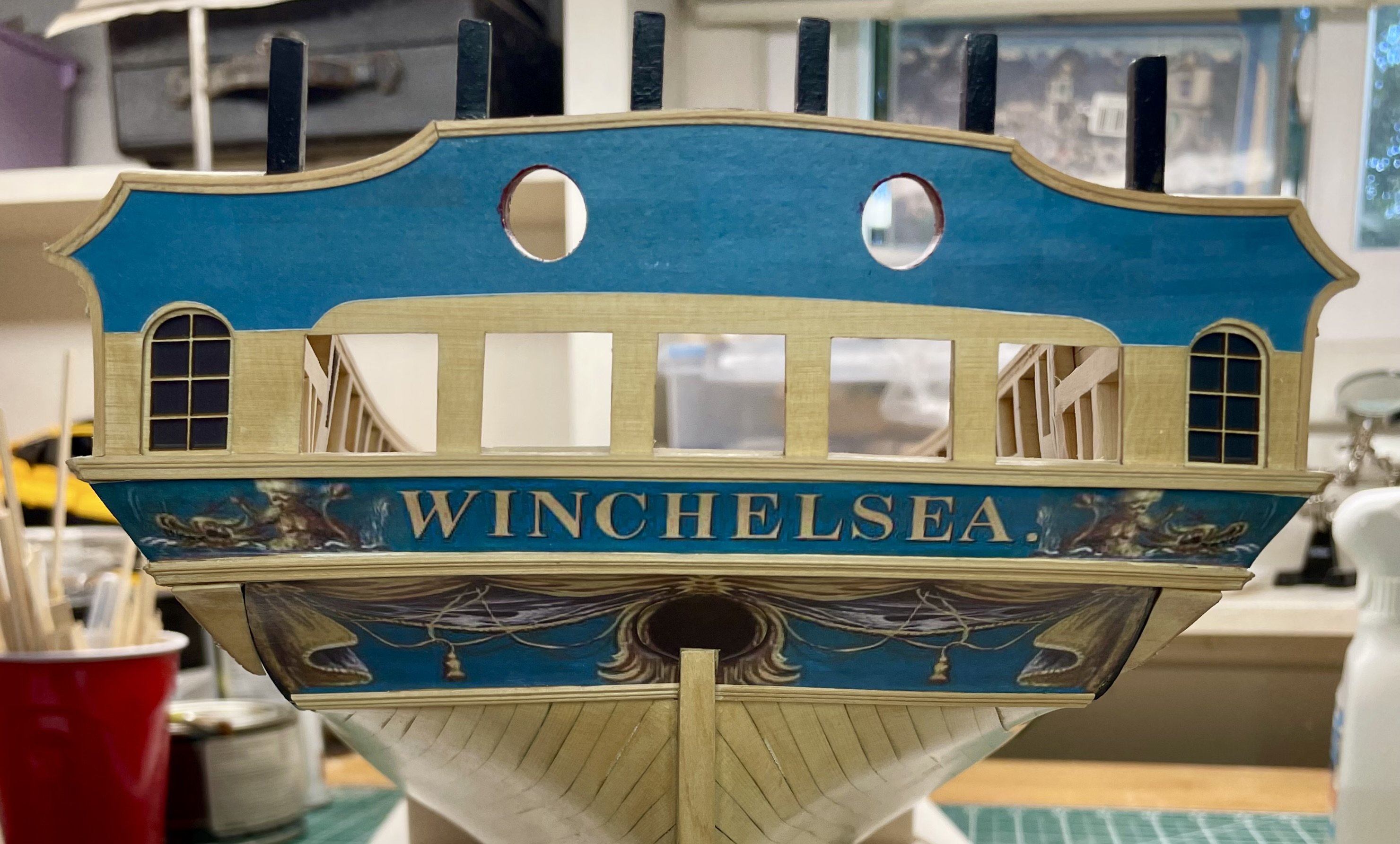

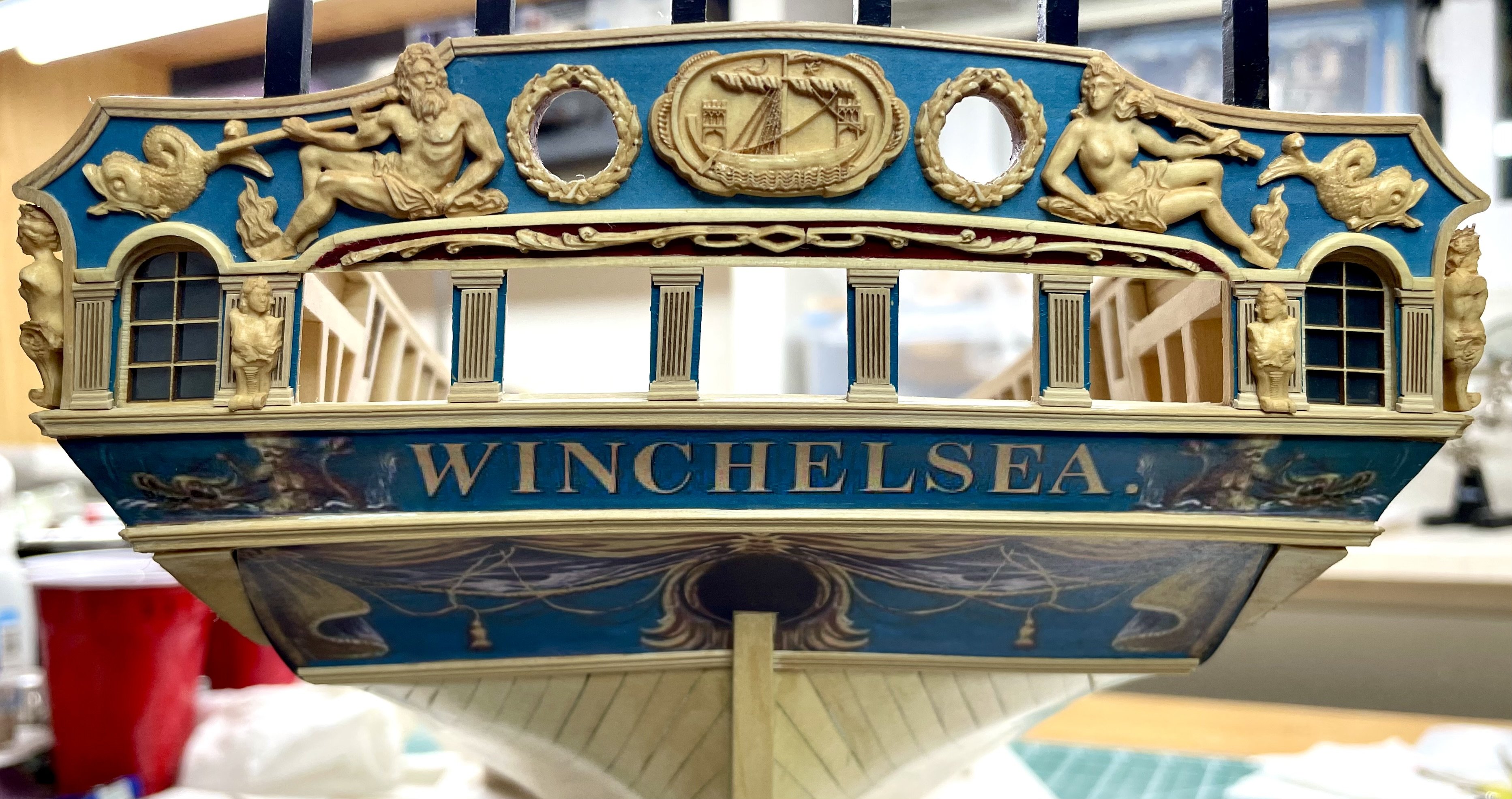

Spent the week and much of Saturday this weekend working on the transom details including the cove and related trim around the false lights, and the resin carvings.  I also completed the fluted columns on the quarter galleries and started the same details on the transom.
Almost done with the detail work on the stern.  Still need to add the rails on the QG roofs and complete the fluted columns on the transom in the next few days.  Then I need to work on the fancy moldings and friezes along the sides of the hull.

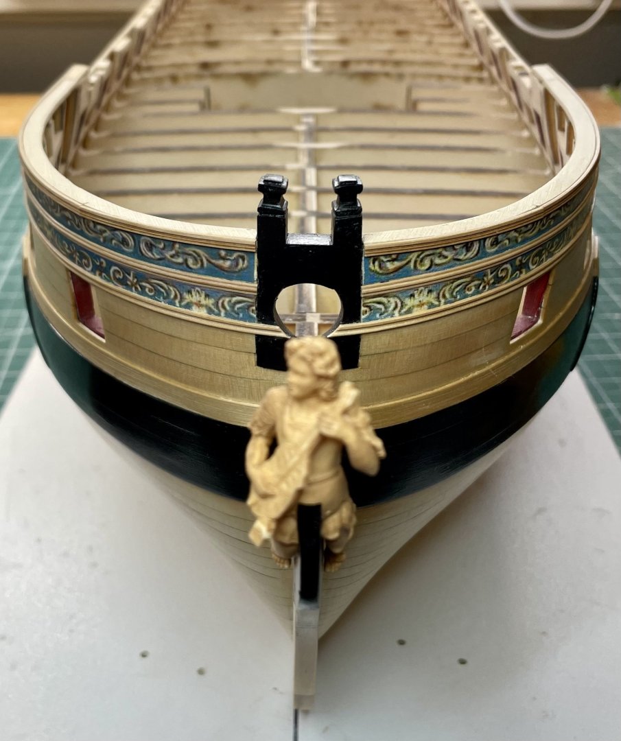

I also painted the stem and bollard timbers black so that I won't need to work with black paint so close the the friezes in the future (I hope)
Progress on the transom details.
I'll call out one of my mistakes here.  I completely messed up the painted edge along the upper portion of the cove.  I fixed it by applying a very thin veneer strip of cedar over the mess and sanding it down to paper thin,  You can see the edges of the fix along the ends of the upper cove.  Overall this looks 100% better than having crimson splotches along the upper edge.
scraping the base and top of the fluted columns.
column details added to the QGs.  This was a real trial, I think I dropped and lost one piece for each 3 that I placed.  The instructions suggest using needle files to shape the sides of the base and top moldings.  I found it was easier to use a fresh chisel blade and cut downward across the grain along the sides to remove the material.  The material parts along the grain cleanly and leaves nice clean edges.
I think I may add some left over fancy molding along the tops of the QG windows in between the columns the way that Frank has done with his build.  I really like that look.
And where I am currently at.  Started the fluted columns on the transom.  These are so much easier to work on than the QG columns.
Steve

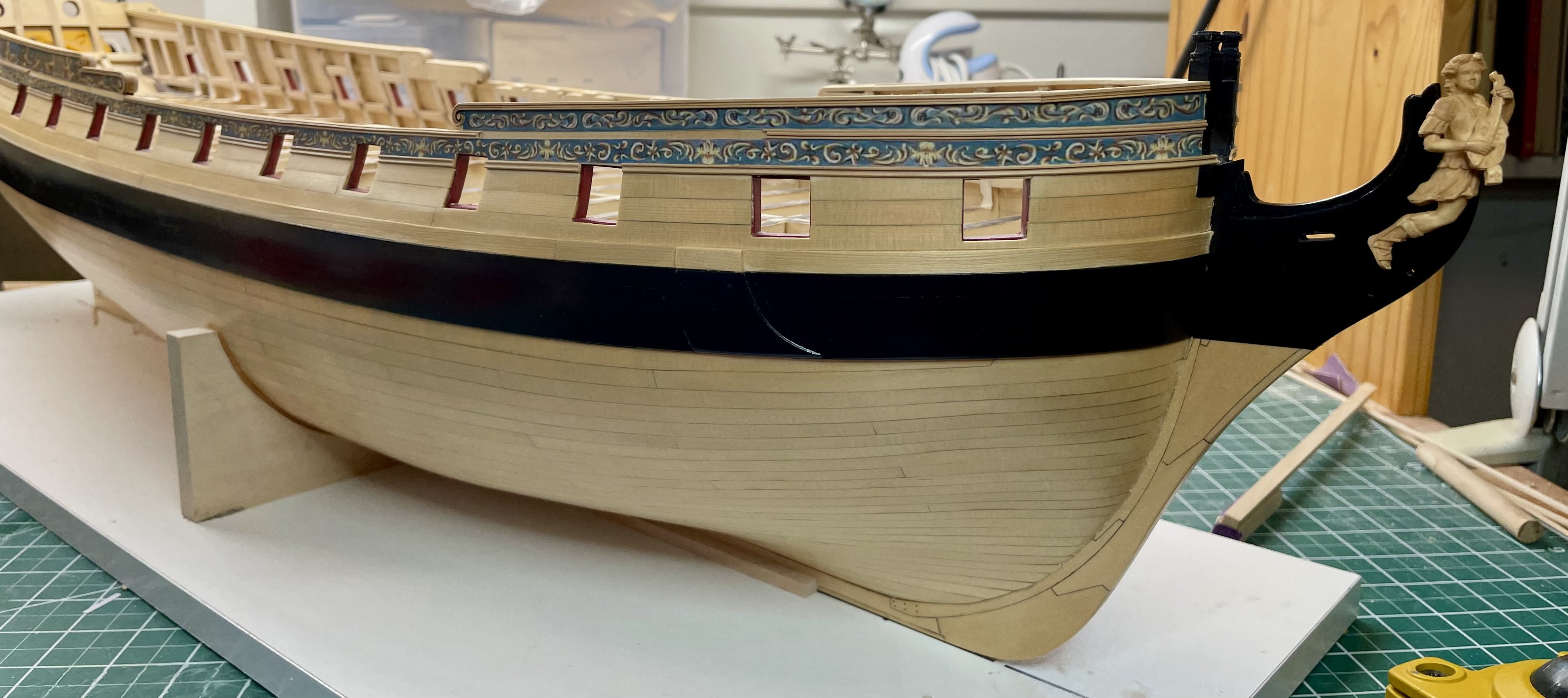

Working on my build today and decided to take a break from applying the friezes and post some progress pictures from the past 10 days or so.
I completed the fluted columns and remaining transom details.

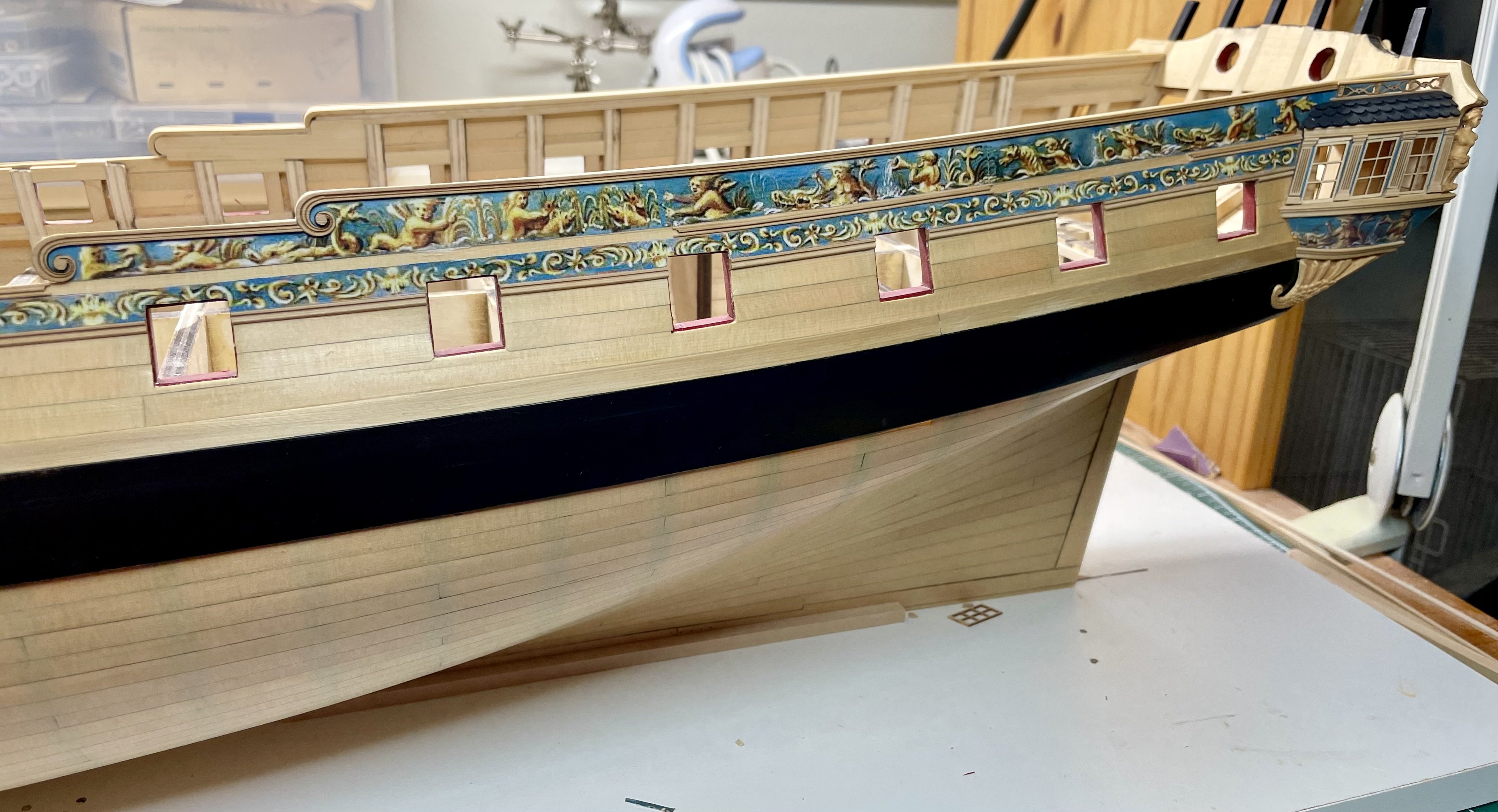

Then jumped into working on the fancy moldings and friezes along the sides.  I liked the approach I saw in both Frank's and Greg's build logs where they built up the  channels and used them to lay out the placement of the center molding to prevent needing to remove large pieces of glued-on molding later.
I built up the channels from the chapter 11 parts per the instructions.  Never used the spray mount before but it was really easy to use and worked well.
I then made up some patterns from the assembled channels to use in placing the center molding.
Back to scraping the center molding.  This one took 3 tries to get the width of the scraper correct.  I kept making it too wide.  I now clamp the work piece on my table and push the scraper along with both hands to control the angle of the scraper and make nice smooth linear passes.
Locating the channels along the hull and positioning the spacers.
Mounting the center molding.  Testing to see if there is such a thing as too many clamps...

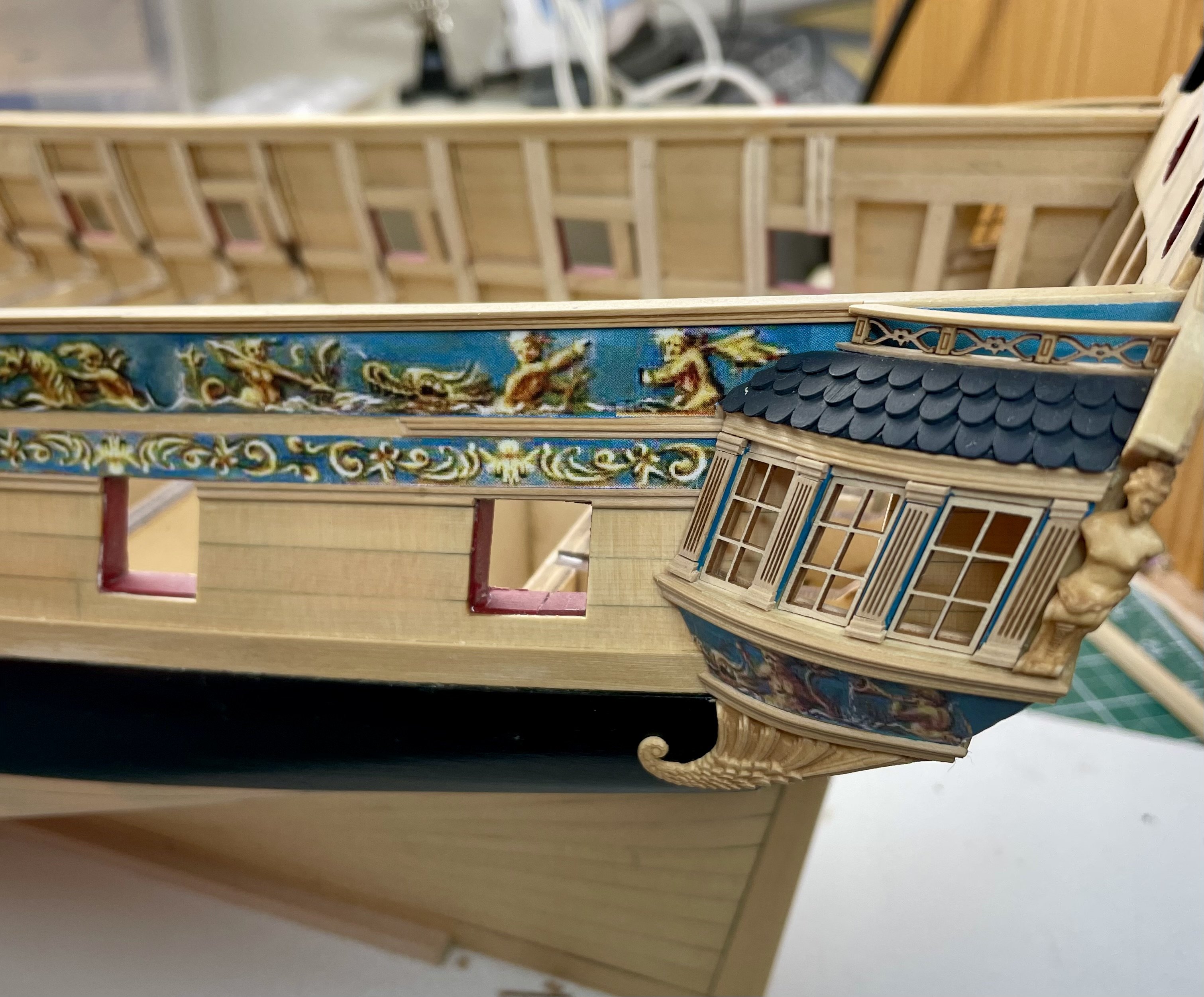

Friezes mounted on starboard side.  Still need to mount the lower frieze on the port side.  Between the slight stretching of the paper, and the fact that the port and starboard sides will be slightly different lengths, I'm going to need to squeeze or stretch the segments a little to match the start and end positions to match the starboard.  I'll pick aspects of the frieze design that are forgiving to this adjustment and hide them under the channels.
Next steps will be to wrap up chapter 3 with the lower & upper moldings and the rails on the QG roof.

Chapter 3 is now complete, took about 6 weeks to work through it.  I had a lot of fun learning how to create and use scrapers for the first time to make the fancy moldings.  It was very satisfying to work through this chapter as almost every part added brought the exterior of the model to life.  However my patience was tried more than once with all the tiny pieces involved in the tops and bottoms of the fluted columns.
QG shots showing the now complete look with the rails in the roofs added.  I will likely come back and add fancy molding above the windows once I permanently install the windows much later in the build.  Right now they are just placed in position with friction holding them in.
Included previous picture of the complete stern.

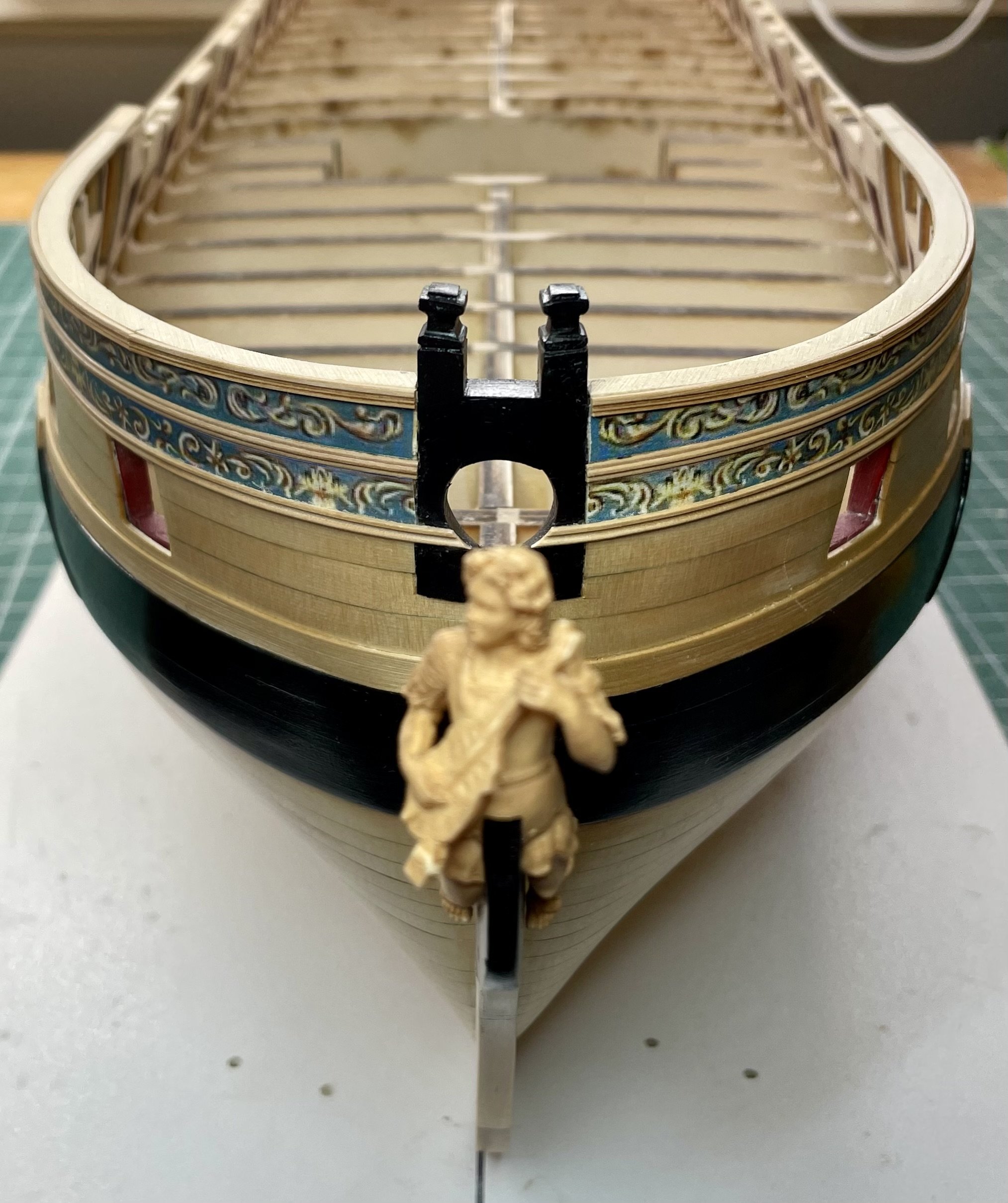

And some pictures along the sides of the hull.  I've known that my gun ports are slightly high since I completed chapter 1.  The friezes and moldings worked out but I will have a little more work cutting in relief for the gun port hinges into the molding on a couple of these in future.  I also placed the joints in the upper molding at the catheads on the bow and at one of the swivel gun locations at the stern.  You can also see where the channels will be located.
Another minor mistake from chapter 1 is that the bollard timbers are a little low.  I lined up the opening for the bowsprit with the top of the stem in chapter 1 which ended up being a little low.  I ended up removing a little material from the bottoms of the timbers when I should have just left it alone.    The bottom side molding therefore lands a little high on the bow.  Only those who know what it should look like will ever be able to tell.
