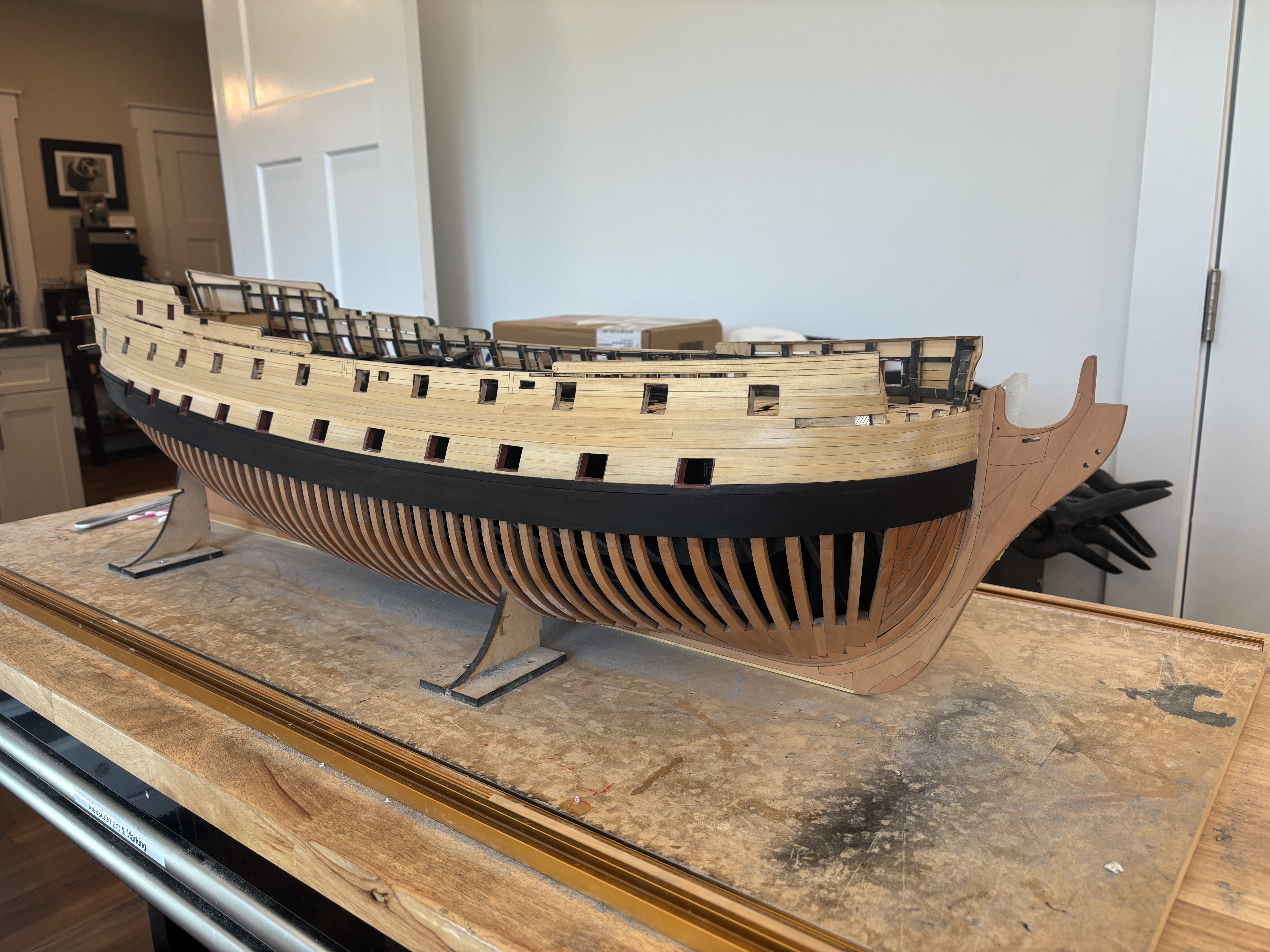

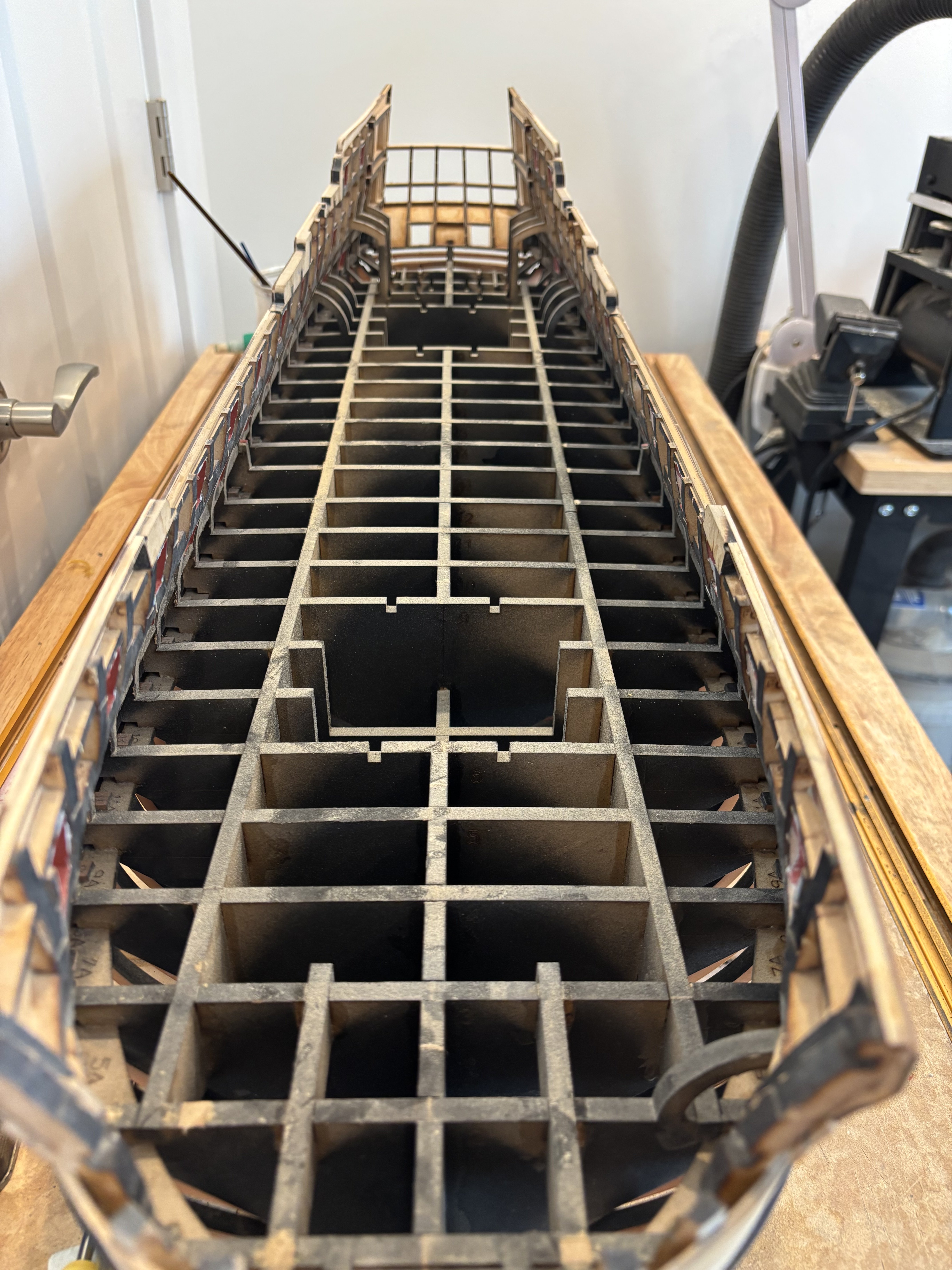

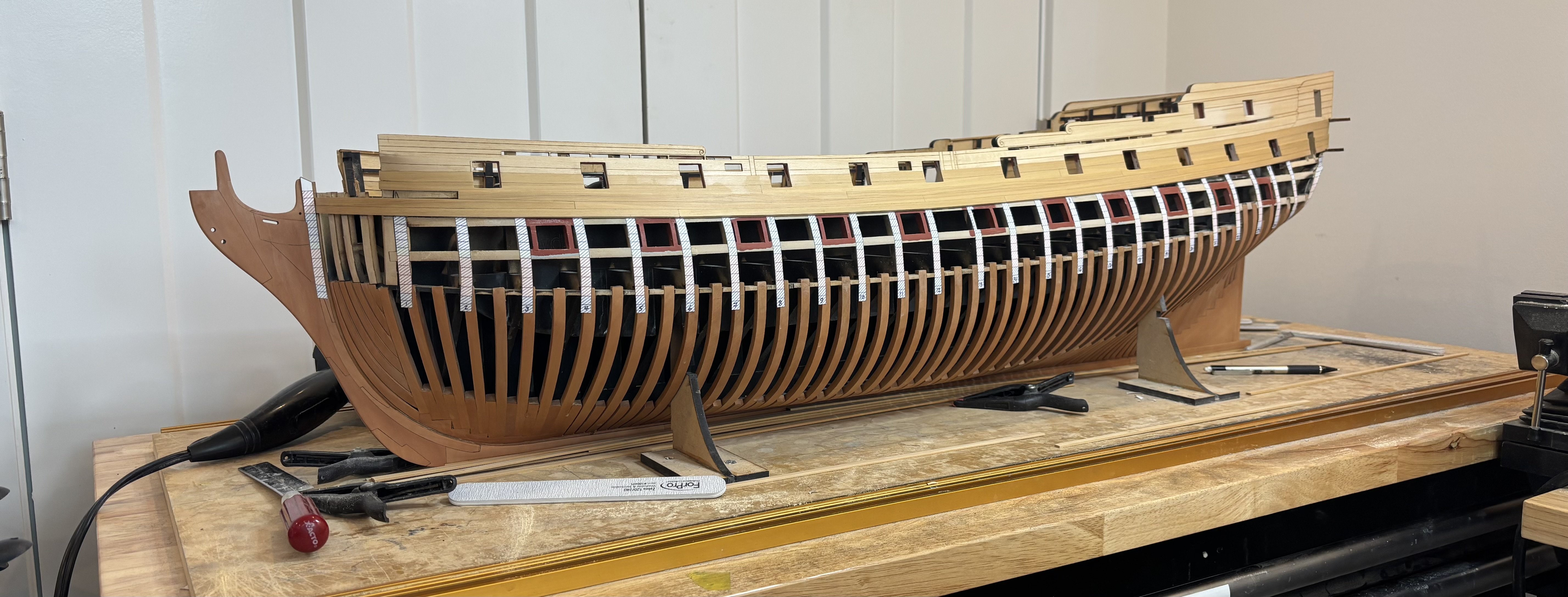

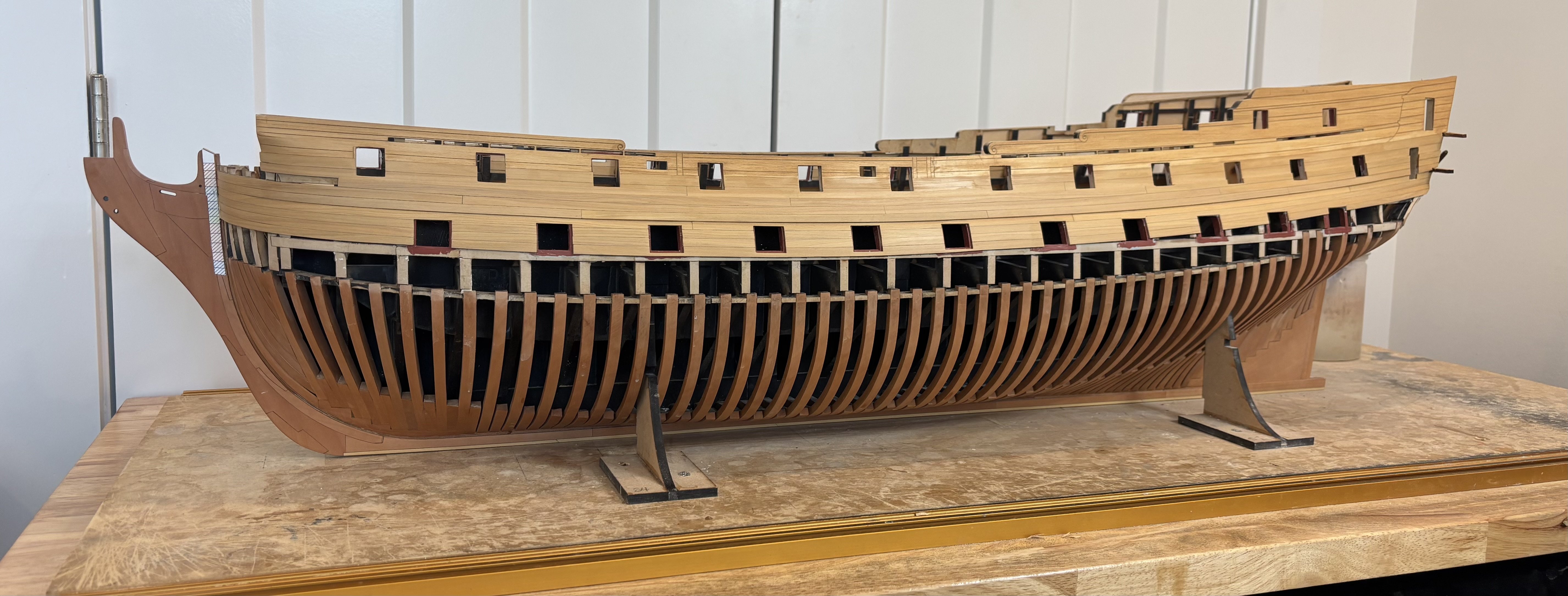

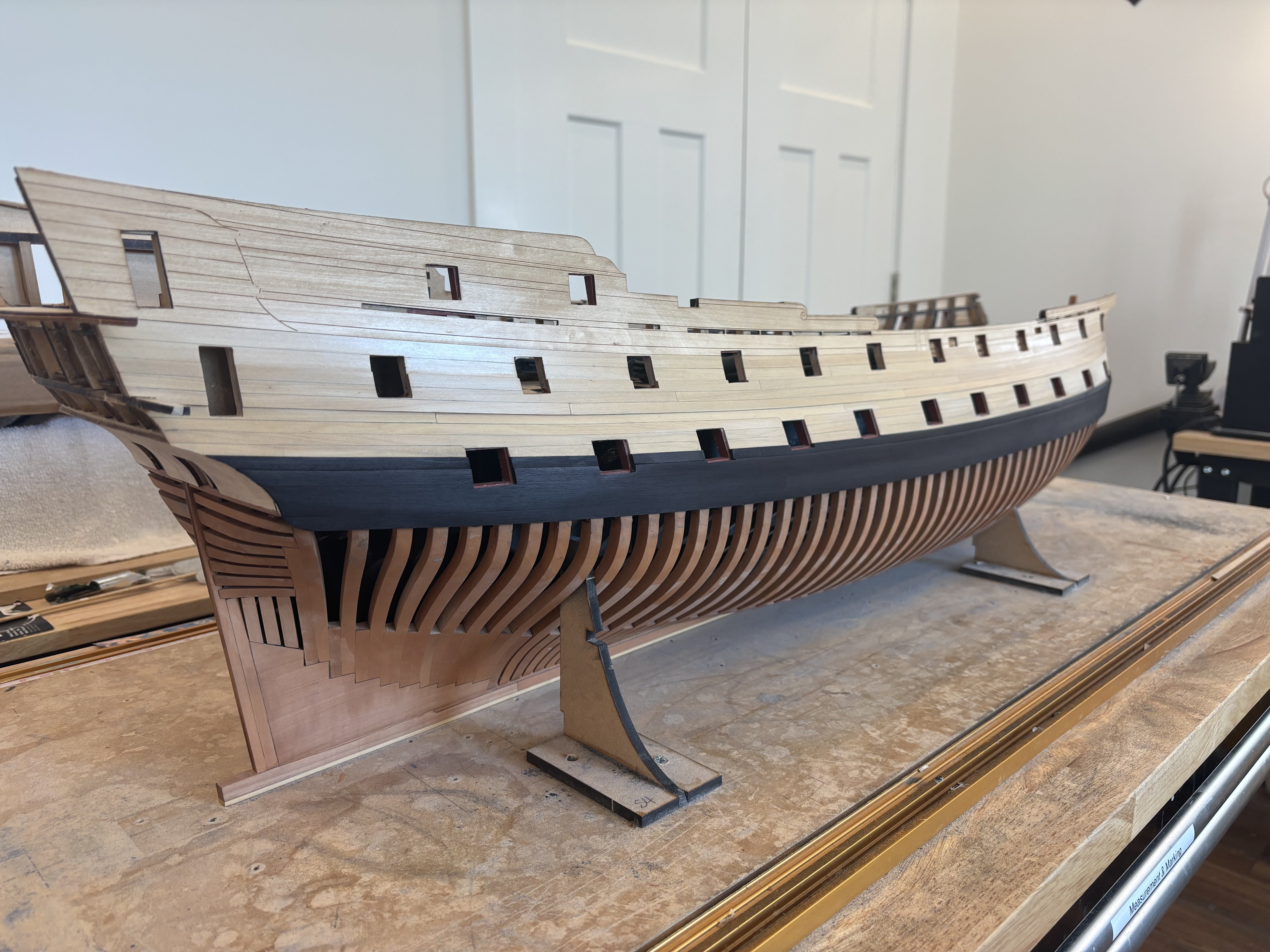

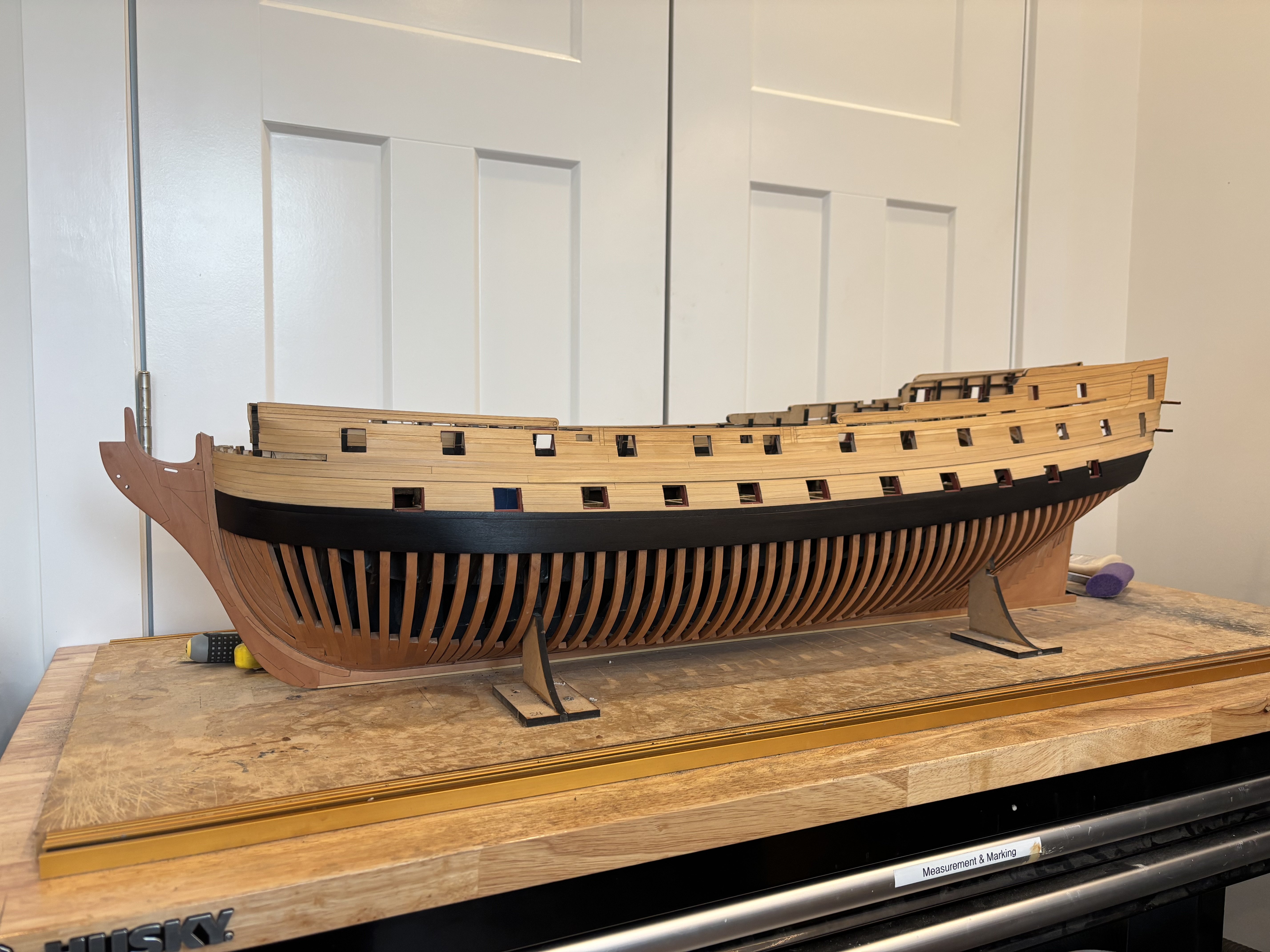

Port side Wale planking completed, and all of the inboard jigs that were supporting the bulkhead extensions have been removed.
I need to complete the two missing pieces of the channel wales and then add the two strakes of boxwood planking below the wales, clean up and paint the gunports to basically complete chapter 2.
IMG_8255.thumb.jpeg.af0986d56ba9f6cd65ac37d2a10f29e2.jpegIMG_8256.thumb.jpeg.821dcc3e3f0b64a76feb27d9087a8255.jpeg
1 hour ago, scrubbyj427 said:
Beautiful work Ben! It’s looking really good. Did all the inner support structure
come out easily?
Hi JJ
Surprisingly it came out just fine - I was expecting issues but no problems - I didn’t mistakenly glue anything to the jigs.
