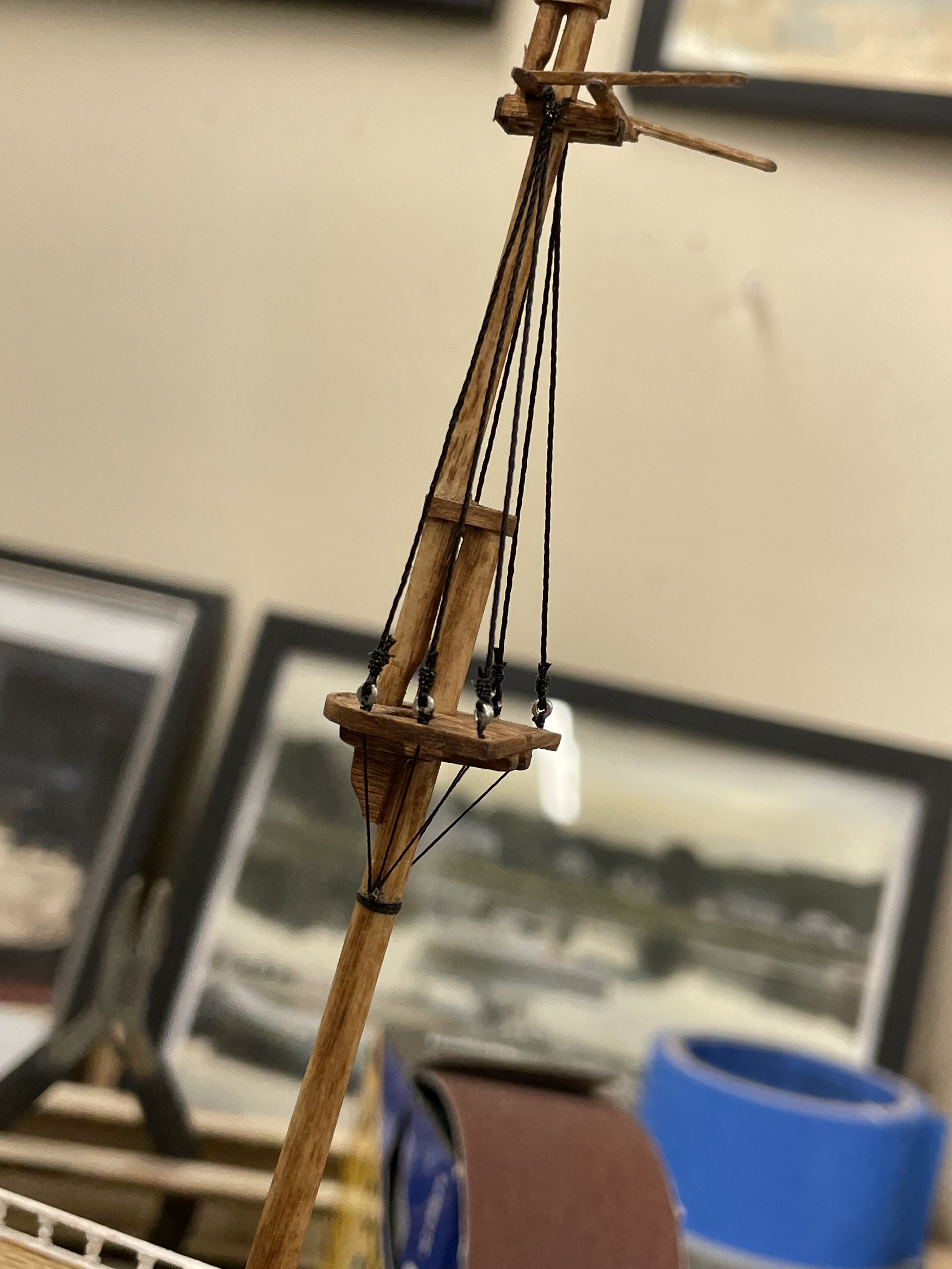

Agreed… here is a look at my first attempt at the mizen mast upper shrouds. I have line from HisModel.
I’m still considering a rework of these shrouds. Darn OCD… LOL 😆

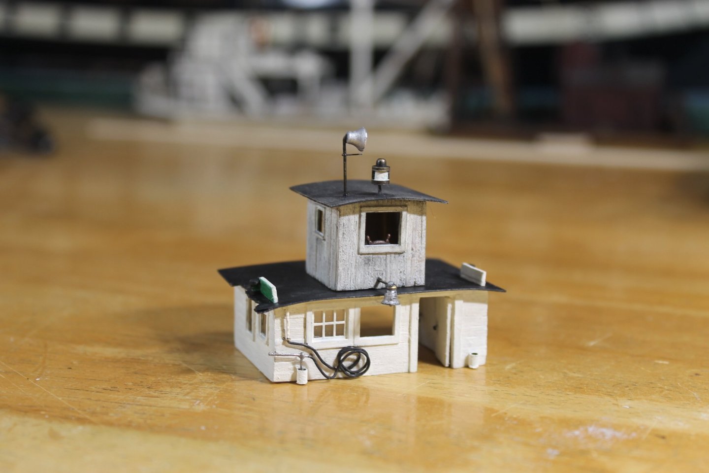

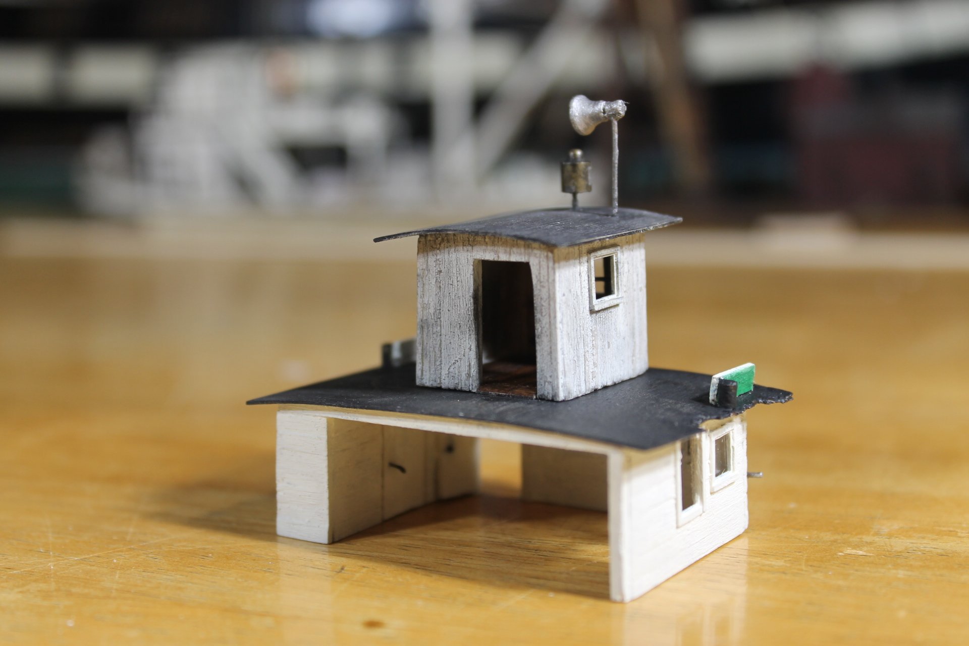

 Thank you to everyone for the comments and likes.
 Between doctors, caregiving, and getting the yard and house ready for the 4th there's been little time to work on the model.

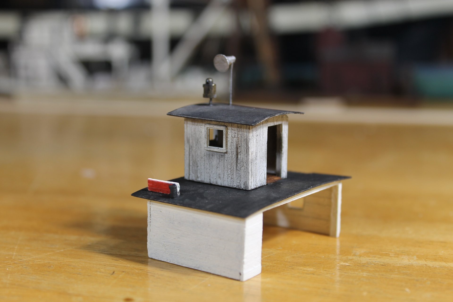

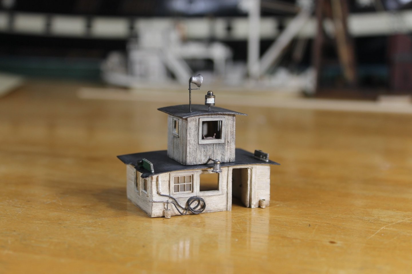

 Some good progress and some not so good progress. Say bye to the searchlight, stupid thing looks like those old loudspeakers that were carried on top of trucks in the 30's.
 The searchlight housing is a bell I received with the crown broken off. I tried adding a one hole stanchion top but that made it too long. i'll remove and rework, we'll see what I can come up with.
 I'm happy with the hose and steam gun made from 24 gauge annealed wire. The cut off pipe that holds the steam gun handle and light board lamps are made from the same jewelry findings. The fore lamp is okay, it's one of those it is what it is items.
 I am not happy with the ships bell. It was the smallest bell I could order (I ordered two) and both came with the crown opening filled. I tried to drill out the hole but couldn't as the hole is a .015 inch opening and my tiny drills were not up to the task. As a work around I made a hole in a pice of wood that the crown would fit in and glued the crown into the hole. it works but it doesn't look near as elegant as it would have had the crown had a hole. The more I look at it the more I want to rip it off as well. That's another "we'll see" item......sigh.
I'm pleased with the "bite" out of the starboard side roof, by the size and shape, I assume was made with a miss aimed bucket loader.
 I think the enclosed area on the port side wall was for isolating and running a gas engine to run a electrical generator. I know that they had to have a generator because of the lights but there were also water pump/pumps and the furnace's automatic coal feeder. If there was more space and there wasn't an open flame (the furnace) I'd say they were all belt driven by a single gas engine so I'm thinking electrical motors would make more sense. If the enclosure did in fact house a gas motor they would have wanted to put that behind a closed door away from the furnace. If you look at the original photo above, in front of the cut off pipe holding the steam gun there are what appear to be old fashioned gas cans (?) and that's as far away from the furnace as you can get on this tub.
 Only after I'm happy with the alterations will I weather the engine room. The pilothouse is not yet glued to the engine room roof.
 After the engine room is finished I'll start building the hull as there are items inside the engine room that need to get made and installed.
 Thank you to all for your support and for following along.
   Keith
Edited by Keith Black

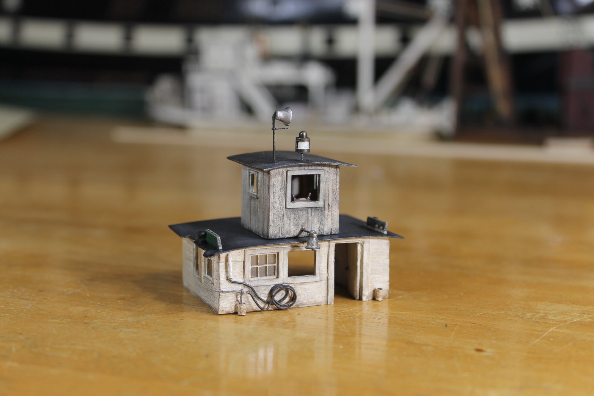

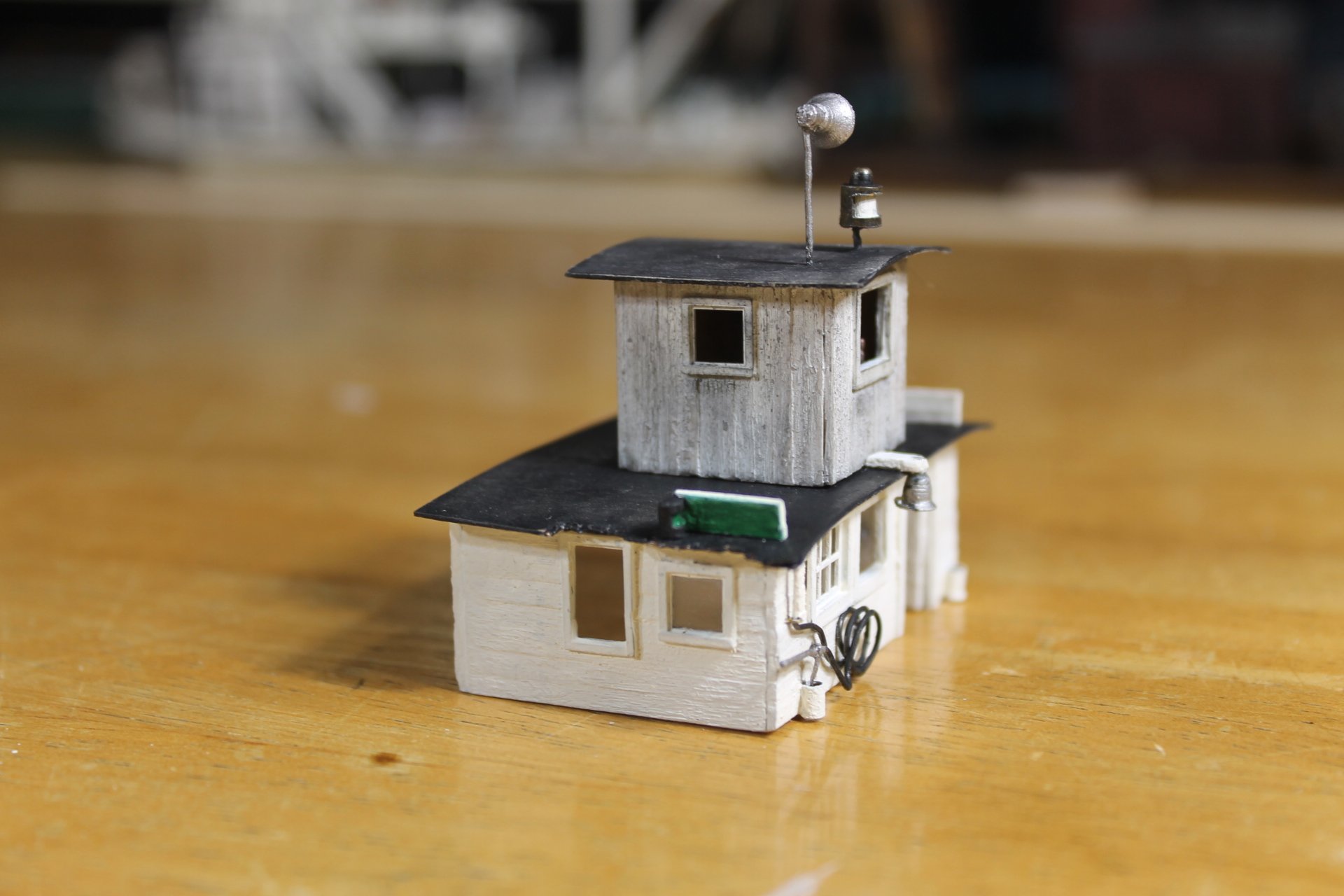

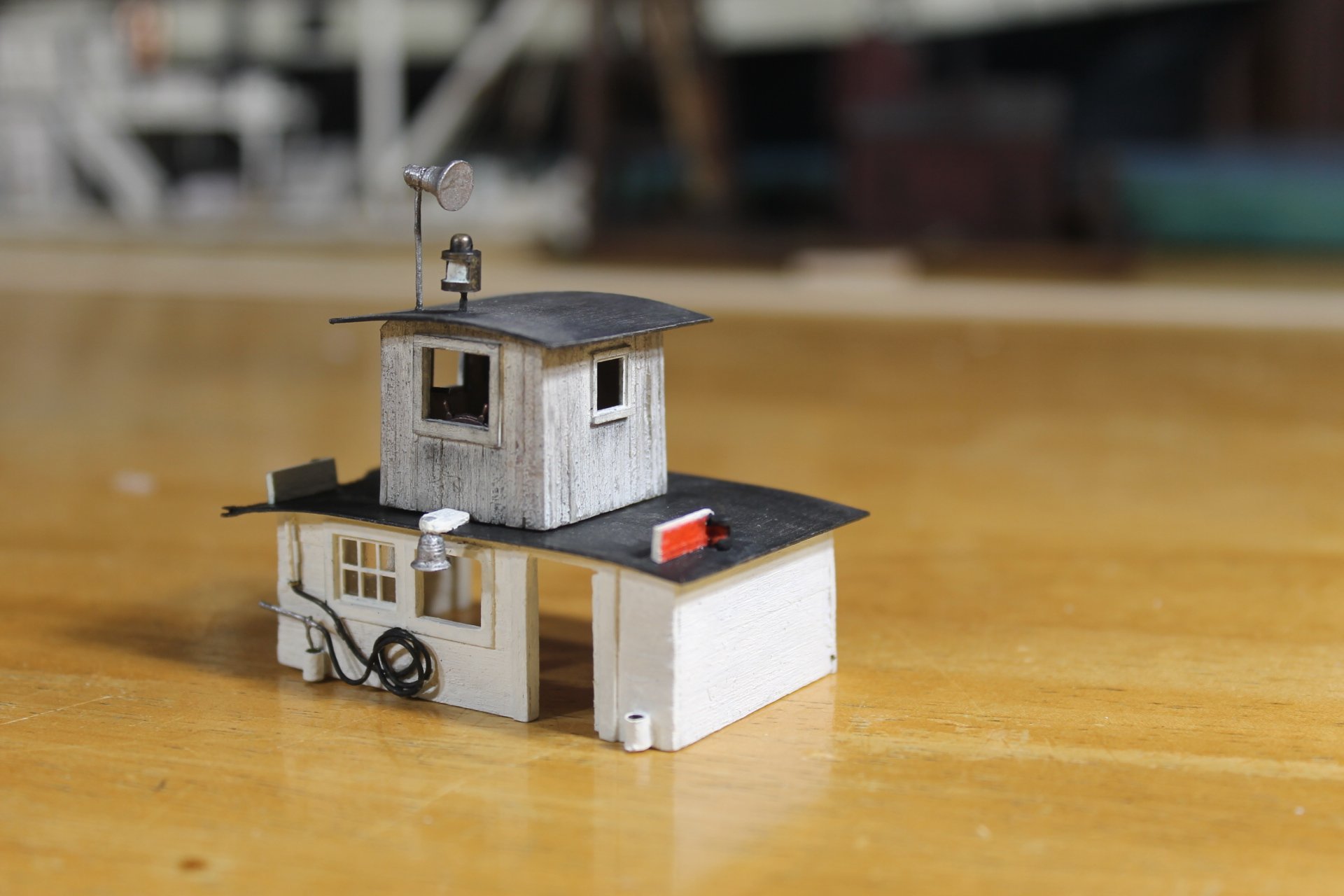

 Let the weathering commence!
 Before. 😢
 After. :D
 It's not perfect but it's a lot better. I think I was so disappointed in the quality of the bells I received that my efforts matched the bells.
 The ship's bell sits at the correct height and looks much much closer to what the original photo shows. The searchlight looks more like the photo  searchlight and less like a loudspeaker mounted atop a 1934 Ford van blaring out propaganda to the masses. The bell I'm using for the searchlight is 0.15 inches in length.
 Thank you guys for being part of the journey and for your support.
   Keith

 Thank you to everyone for the likes and the comments.

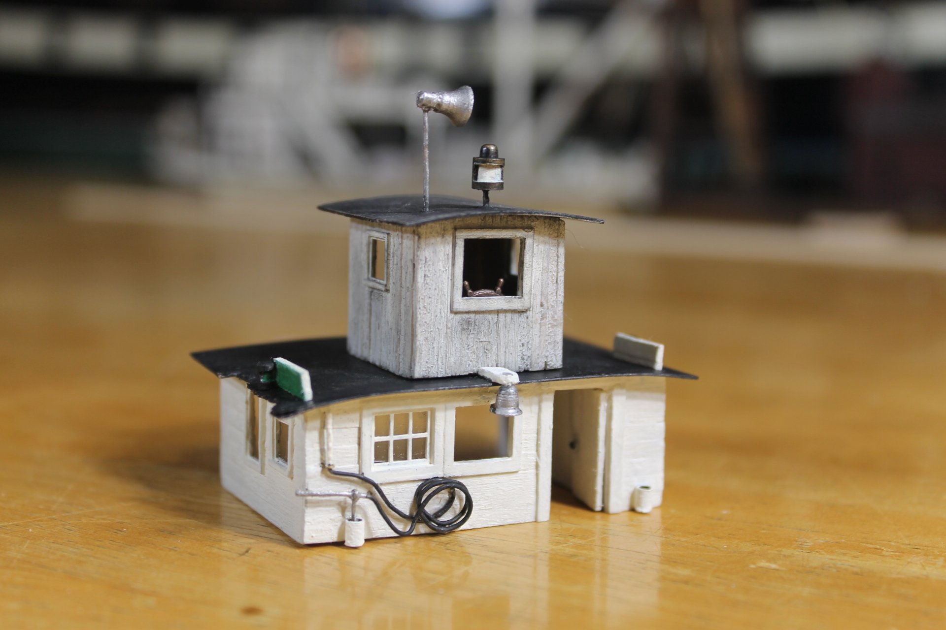

 The first attempt at weathering is done. I say first attempt because I'm not keen on the results. Too much on the pilothouse and not enough on the engine room me thinks. I've got to get the pilot painted and in position not that it will make a difference but it delays repainting the pilothouse and starting over on the weathering.
 Thanks to all for your support and for flooring along.
   Keith
Current Builds: Sternwheeler from the Susquehanna River's Hard Coal Navy
