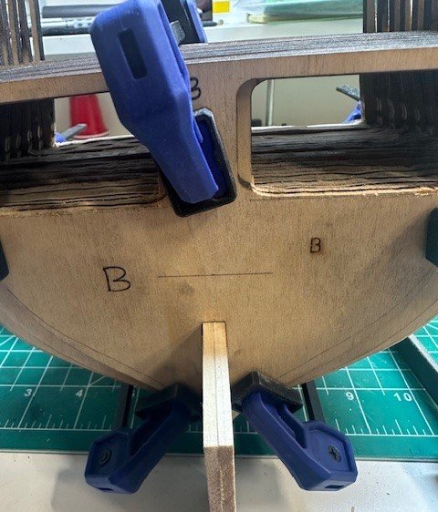

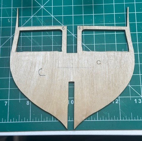

Well, I’ve had a little bit of shipyard time even while the grandkids are visiting, so thought I’d provide a short update.

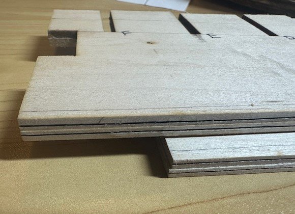

Of course, like everyone else has done, I had multiple copies of the eight-page plans made and will use one of those copies for my “cut-up plans”.  So, I cut out all of the bulkhead and bulkhead former drawings in order to transfer the various markings and reference lines to the ship’s applicable pieces.
On the plans for the bulkhead former, I cut out the bearding line so that I could trace that line directly onto both sides of the bulkhead former pieces so that a rabbet could be made.
As I had stated in my initial post and like several other builders had done, it is my plan to bash a detailed gun deck.  So to do that, I will need to trim 3/32” from the bulkhead former pieces and from the gun deck level on each of the bulkheads (1/32” for the basswood sheet base plus 1/16” gun deck planking strips).  I grabbed my compass that has a point on one end and lead on the other for markings.  However, it is only able to squeeze down to a 1/8” distance, so it would not work for this.  I was able, however, to find a really nice, heavy compass on Amazon that worked well in scribing the necessary 3/32” lines.

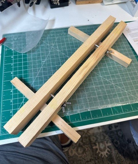

After I marked the 3/32” cut lines on each of the bulkhead former pieces, my initial thought was that it would be easier to trim the individual bulkhead pieces separately, before gluing each of the halves together.  So, I cut a few of the 3/32” pieces off of the starboard side of the front bulkhead former piece and… SNAP.  The back-and-forth motion of the saw on the thin layer was enough to break off a part of the area between the F & G bulkheads.  OK, ok… Time to glue the bulkhead former halves together in order to make it thicker and more solid.
250627g-SnapFix.jpg.f114eebd85e50463d7cabbbce897f8f5.jpg    250627h-GluingBHF2.jpg.9131376964297b099a8c4c6c7e5f2509.jpg
Having thicker bulkhead former pieces made it much easier to trim them down to their required height.  And, as has been discussed before in other build logs, although not technically necessary, I also trimmed the mast hole areas by the 3/32” amount, as well, and will make those adjustments to the masts when I get to that point.
250627i-CuttingBHF.jpg.80b80f25ce8d13ab9e9a2452ae75dddb.jpg    250627j-MastCuts.jpg.f8885718af5088e24141ddc0e4f391a9.jpg

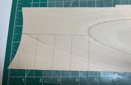

As I did with the bulkhead former pieces, I also used my new compass to scribe the 3/32” lines onto each of the eighteen (18) bulkheads (although I don’t think Bulkhead R will be shortened but I’ll verify again beforehand).  I also want to verify how Bulkhead B will be addressed with its bowsprit notch.
I think it is important to note that, as seen by the picture with the ruler, the scribe line is not a straight line across the entire bulkhead width.  Since the deck is curved slightly, the beams are not a straight line and we need to maintain that curve as best we can when we make the cuts.

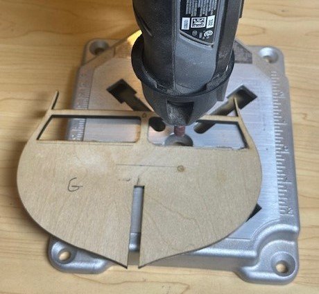

I will use my Dremel and the Dremel stand to trim the gun deck levels from each of the bulkheads.  I am thinking, though, that I will not fully remove the spar deck beam supports until after the bulkheads are fixed in place on the bulkhead former.  That update will be provided in my next build log entry.

As for trimming the gun deck levels with Dremels and a Dremel stand, I'd like to see some details on that when you get around to doing it.  My thoughts were gravitating to a router table solution, maybe using a guide registered on the parallel edge of spar deck.  Not having a Dremel tool or stand, I can't really picture what you'll be attempting.

Ah!  So, the Dremel is basically being used like a drum sander.  In the instance where Jon has removed the spar deck beams, I think I'd prefer to use my belt sander.  Not having "kit bashed", I don't know if removing the spar deck beam is part of the process.  The belt sander would be useless if it remained.  In the end, use whatever gets you closest to the finish line (double entendre intended)..

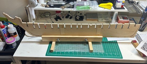

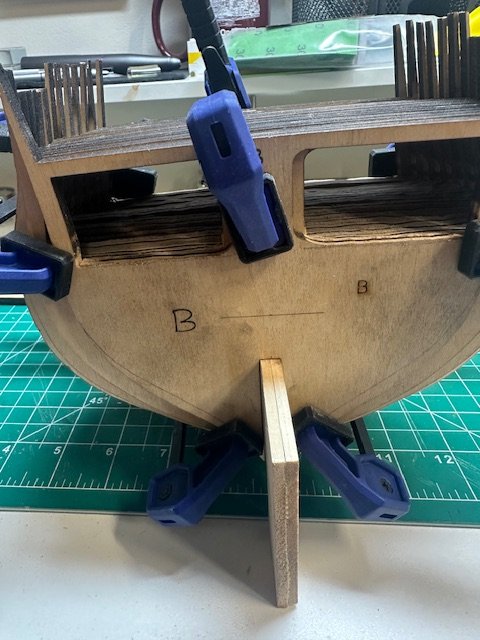

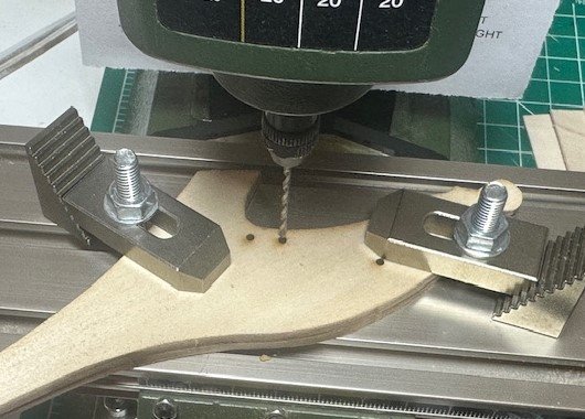

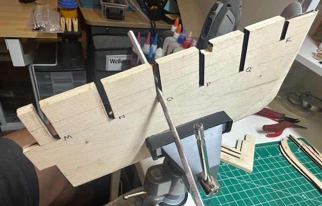

Well, another (fairly brief) update as I’ve done a bit more work and taken a handful of notes.  We spoiled the grandkids during their extended visit for this summer and, of course, the grandkids wore us out.  The house is back to being quiet, so I’ll try to get back down to the shipyard more frequently again.
I left off my build log having scribed and drawn the 3/32” lines to reduce each of the bulkheads, in order to compensate and allow for the detailed gun deck.  So, time now to get the Dremel on the drill press workstation and sand down all of the bulkheads.
The process worked out pretty well, although I had to use one hand to pull the workstation handle down to lower the Dremel and the sanding drum and the other hand to guide the bulkhead across its sanding path.  The sanding really took it out on the sanding drums, too, chewing them up pretty bad, and I had to replace the drums after each bulkhead.

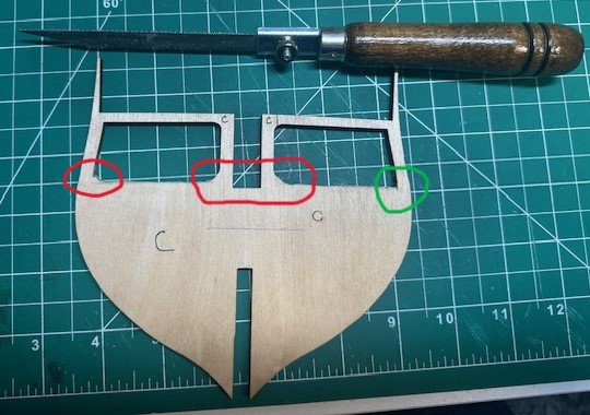

Also, even though I was using the smallest diameter mandrel and sanding drums I had, I was not able to get tight into the corners of each bulkhead, so I used my Zona saber blade to trim the corners.  That worked out well.
250712b-BH_Trim.jpg.5f6421b84764f4f110a9eb01e3858bf2.jpg   250712c-BH_TrimClean.jpg.39fc129614589f061db60a5ed9bbe317.jpg

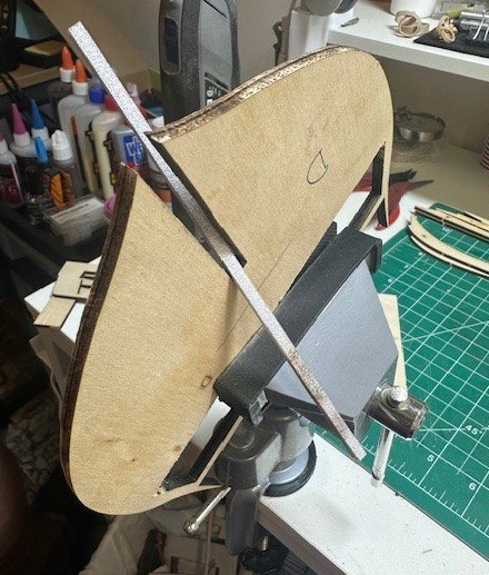

I also used my Dremel and sanding drum to taper the bulkhead former at the bearding line.  I scribed lines on the bottom of the bulkhead former where I needed to narrow the thickness for the rabbet and sanded down to those lines from stem to stern.

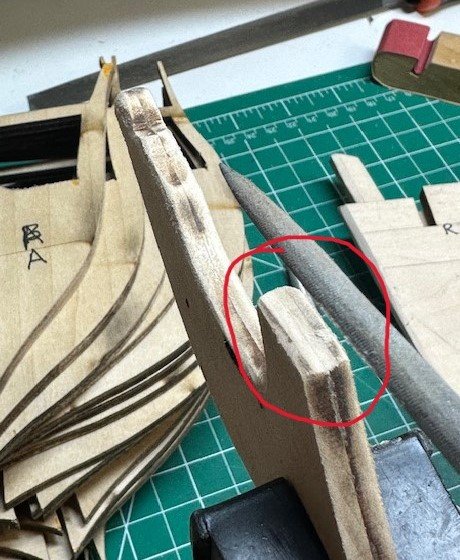

I also sanded and cleaned up, as best I could, the laser char from each bulkhead slot and bulkhead former slot piece (clamping them in a vise).
250712e-BH_Char.jpg.63a15c52cef8b0204f25bc362b1a825c.jpg     250712f-BHF_Char.jpg.5c70abc080ffb129641fd2039771af8a.jpg

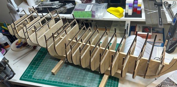

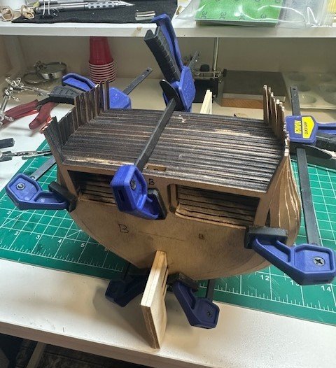

Then, using a technique I saw Tom (usedtosail) use in his build, I placed all of the bulkheads in a scrap piece of ¼” thick basswood and lined up all of the gun deck level beams so that I could then see how my “adjusted” spar deck levels were across all of the bulkheads.
I took a long file to smooth them all down as best I could to an even level.  There are subtle visible changes in the before and after pictures.
250712h-BH_LineUp-Before.jpg.1c25d2d31d0ea563d37b81475e17375b.jpg   250712i-BH_LineUp-After.jpg.99fb27aadb1ac751fa5b57f8635bbeec.jpg
Also, as just about everyone else has done and as recommended in the practicum, I placed a piece of 1/32” x 1” x 2” basswood on both sides of the bulkhead former joints in order to provide additional reinforcement support.
One of the definitive differences between the 1812 Constitution version and other periods was the use of rope for the gammoning on the bowsprit and stem rather than chain.  So, since my goal is to be “1812-ish”, and whether this is actually correct or not, I placed the stem piece on my mill and widened the two simple holes at the top of the stem piece to eventually accommodate the rope that will hold the bowsprit to the front stem.

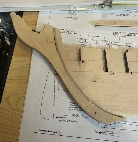

Also, before securing the stem piece onto the bulkhead former, I used a round file to shave a small groove at the top of the stem for the eventual placement of the bowsprit.  Seems like a good time to do this while the stem piece is free.
Although I have probably forgotten some important task, I think I am ready to secure the stem, sternpost and 3-piece center keel assembly to the bulkhead former.  Using some Titebond CA glue, a couple palm-sized 3.3 lb. dive weights and some clamps, I attached the keel framework.
250712n-Stem_BHF_Attach.jpg.5045501d338460efe1ce05b2b91be8a0.jpg   250712o-Sternpost_Attach.jpg.5fbfc4c0662cecc5f05bbd235daf5258.jpg

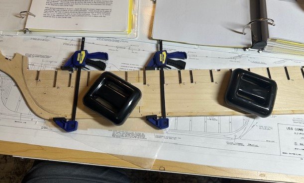

Since I first started this hobby, I have been using my Amati “Keel Klamper” vise to hold my boats while under construction for as long as possible, and it has worked out well.  However, the vise makes the ships sit fairly high off of the table and, with the Constitution being a big (and long) ship to begin with, I thought it would be good to have a different keel clamp.  I had seen on some other build logs, like Mustafa’s, for instance, that a small clamp had been constructed, so… I did the same.  A couple of 15” x 1½” x ¾“ strips along with two (2) legs at 8” x ¾“ square and some ¼“ bolts and nuts.  At some point, I may move this ship to a cushioned cradle, but for now, let’s try this keel clamp.
250712r-KeelClamp2.jpg.04e9d918a0ff0505cb64cee2c6a7dbd5.jpg   250712s-BHF_Clamped.jpg.66a6488d30ed1a156bd02a9d3bd1d669.jpg
So, I have “test-placed” the bulkheads in their appropriate BHF slots.  As was suggested in the practicum, I have placed Bulkheads A-K with their printed letters facing the stem forward, and Bulkheads L-R facing the stern.  I need to do more work on Bulkheads K, M, N & P to get them to fit in their slots.  And, although I have penciled the bevel marks on each of the necessary bulkheads, I have not done any beveling and am weighing the alternatives about doing some of the beveling now before they are secured vs. waiting until they are in place.
I am also considering making some cuts into the appropriate bulkheads and keel locations in order to properly display the ladders that will be going from the detailed gun deck down to what would be the berth deck.  That is my next project to be completed.
As always, appreciate the likes, comments, criticisms and advice.  Thanks…
If by "beveling" you mean "fairing", I would wait until everything is glued into place. Otherwise, please explain what you mean by beveling.

250712l-GammoningStemAfter.jpg.f8375601e861ac40766d47ec33696124.jpg.9eaeaa97c88e813b26d23f1e6dc43583.jpg
Aha!  Well done. You are reaping the benefits of your copious research at the onset.  Sadly, it's a little late for me - on two fronts.  Not the least of which is that the head supports are in the way of any gammoning.
And worse!!! I even forgot to drill out those freaking holes. I guess I'll be dealing with this using a pin vise. (I believe I noted in my own log that I don't remember why I put dowels there to close those holes, but I do remember saying to myself, self, drill those holes out!  The old grey cells, they ain'twhat they used to be.)
You sir, are well ahead of the game.
Yeah, that's pretty much what I meant, Peter.  Thanks for the correction! 👍
Gregg
Then, by all means hold off fairing until the bulkheads are solidly in.  Then proceed with caution. Use a strip of whatever material you plan to plank with as a tool to help you visualize the curve of the hull fore and aft as you fair. As great as I thought everything looked at the fairing stage, when I got to planking, I got a heaping dose of reality.
However, given what I've seen in your build logs, I think you'll do just fine.
