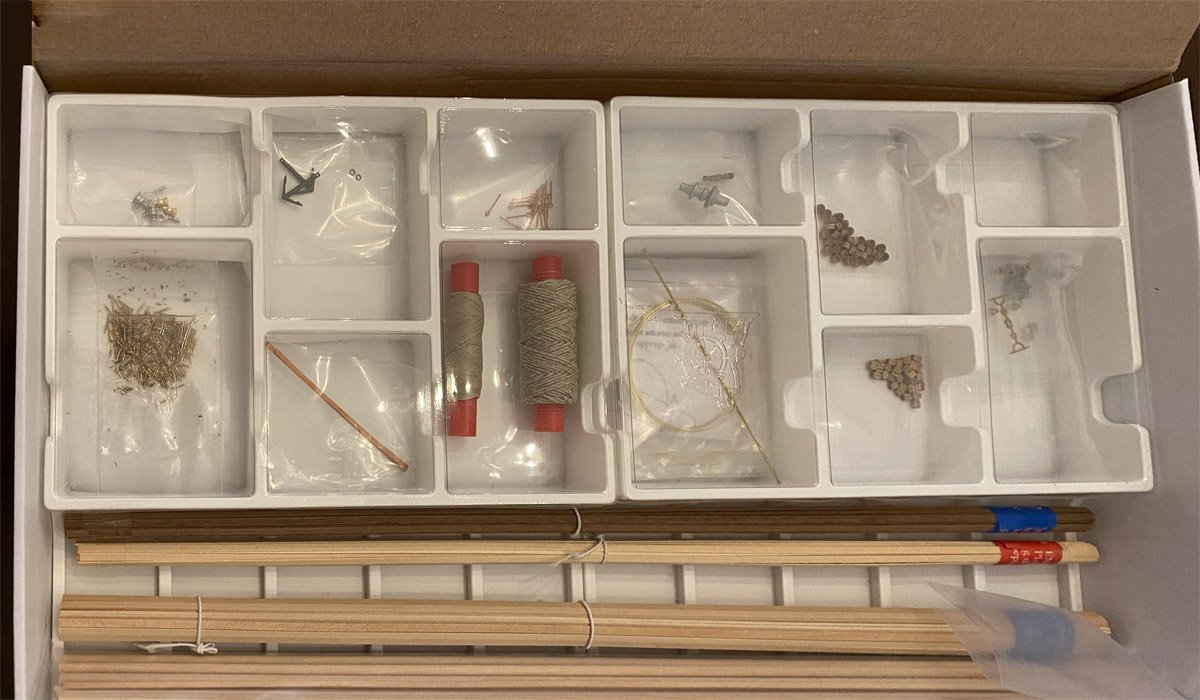

What's in the Box
Seems like not much for €106.99, but that's what kits cost anymore.
I love the "EASY TO BUILD MODEL" text on the box. Easier than many of the models I've built lately, but with a planked hull and full set of sails this will be anything but easy.
Planks, dowels, thread, blocks, and a few miscellaneous parts.

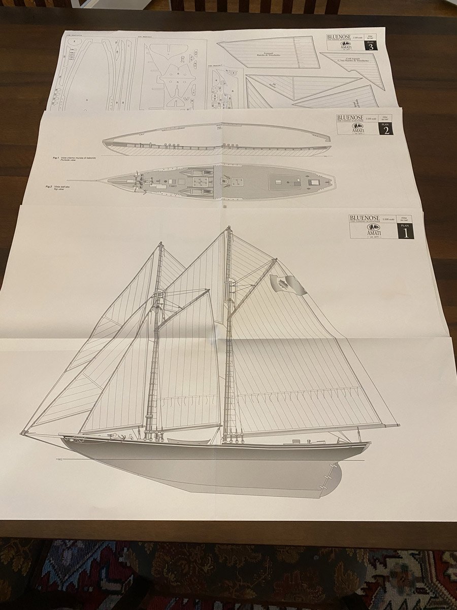

Three pages of full-sized plans.

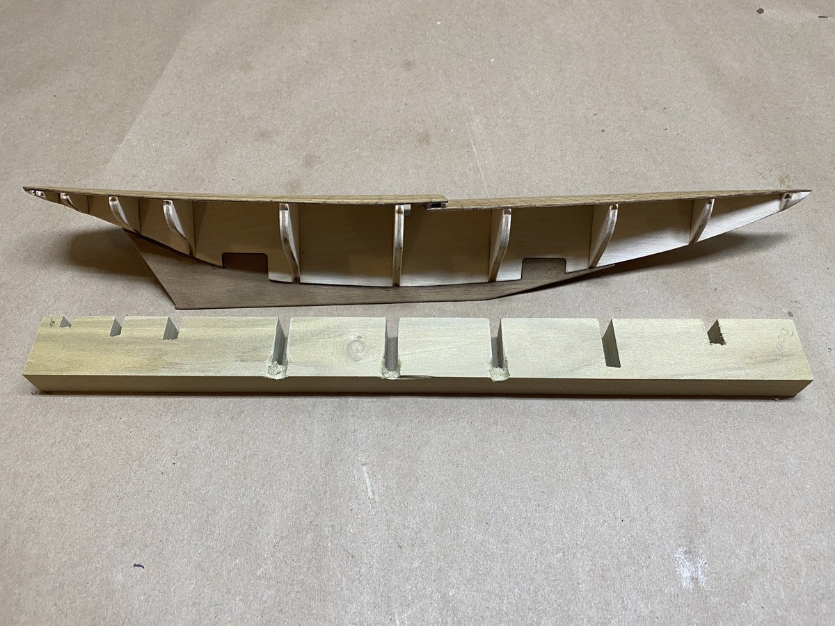

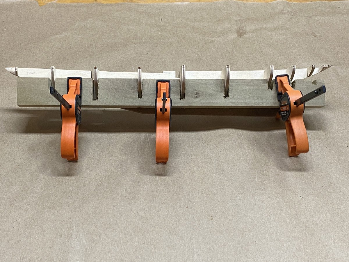

The frames popped out of the laser-cut ply and fit perfectly on the keel. I planked the two thin plywood sub decks by gluing down full-length strips and then notching them with a chisel to make individual boards. The technique is described here. I stained the decks with two coats of Minwax Golden Oak and finished them with Minwax Polycrylic satin from a rattle can.
When I test fit the decks on the keel they didn't line up in the center. Low and behold, the keel was warped about 4 mm off straight. Darn, I wish I had noticed that before I added all those frames. I ended up notching a piece of poplar to go around the frames. Clamped to the keel from below it held it straight while I glued the decks in place. The decks held the keel straight afterwards.

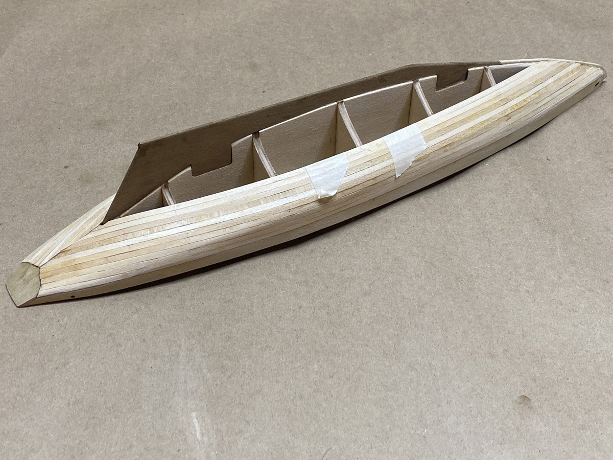

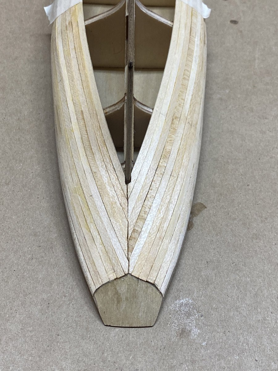

I've started the planking using the technique described in the book Ship Modeling Simplified: Tips and Techniques for Model Construction from Kits by Frank Mastini. Basically you glue the planks to the frames with CA, and glue the planks to each other with PVA (carpenters' glue.) The CA hardens in a few seconds and holds the planks in place, no nails needed. I do about three frames at a time. Oh yeah, I have a hot plank bender now and am using that to roughly shape the planks before attaching them.
planking01.jpg.0da0b0efcd2a0d4c4dd4fd215f8561e7.jpgplanking02.thumb.jpg.740d5cd54705518b5d97bd58b27a8c1f.jpg

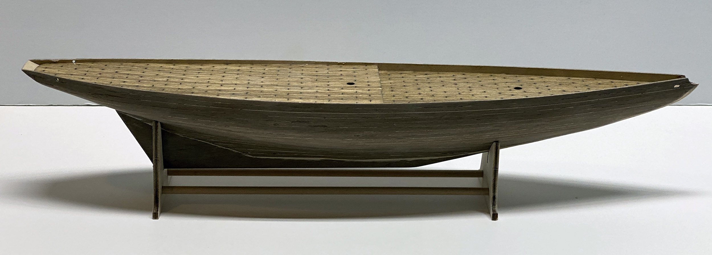

The kit comes with a simple stand, but I usually prefer to mount my models on a permanent base - much easier to handle during construction and afterwards. But the sub keel on this model is just 2.25 mm thick, too thin for screws. I don't know what I'll do - maybe turn some wood pedestals and glue in place later?

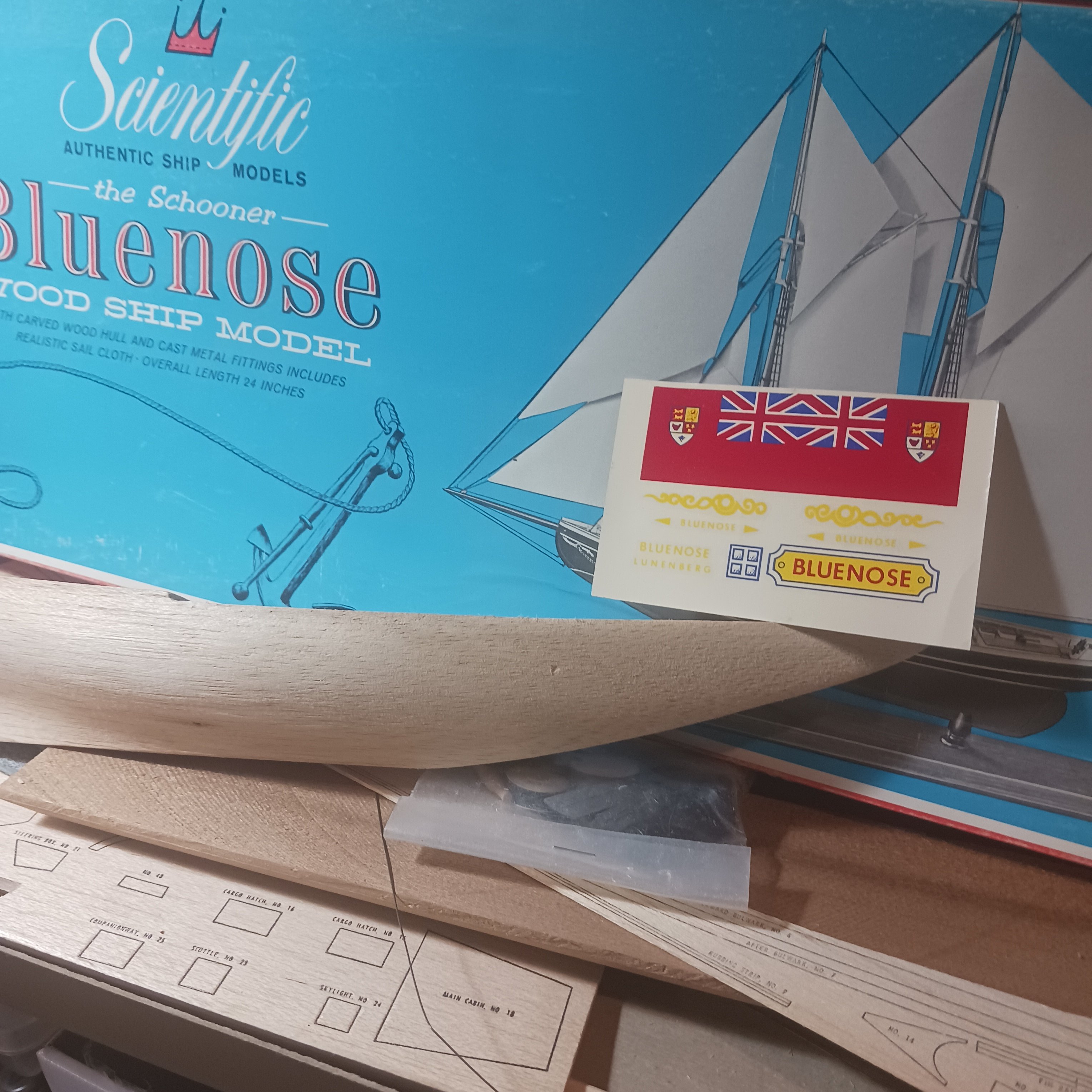

I will be building this Scientific Bluenose kit, it doesn't even have any maple leafs on it. I have a Billings Bluenose to do as well, no flag with the kit, but it shows an Ensign  on the Mizzen mast , no maple leaf either.

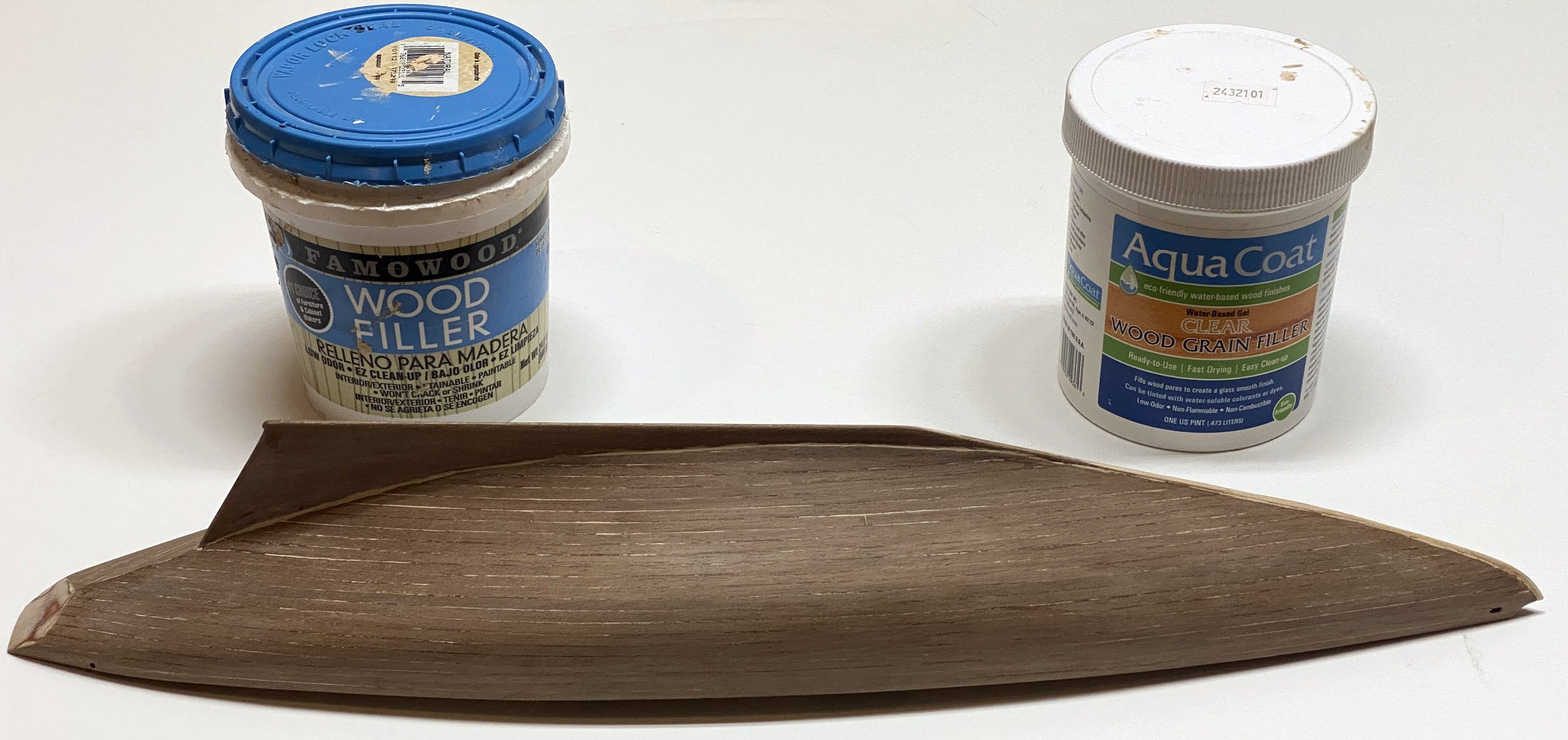

The second layer of planking is walnut, 3mm wide x 0.55 mm thick - not much material to sand down when I screw up. And why walnut if it's going to get painted anyway?
Second Planking Complete
I started at the top rail and worked towards the keel. The thin second layer of 0.5 mm walnut planks were amazingly flexible. I just glued them directly to the first layer with CA. No tapering necessary. After lots of sanding, crack filling with Famowood, more sanding, two coats of Aqua Coat, and more sanding, I think I am ready to paint the hull. At least I'll see how it looks after a coat of primer.

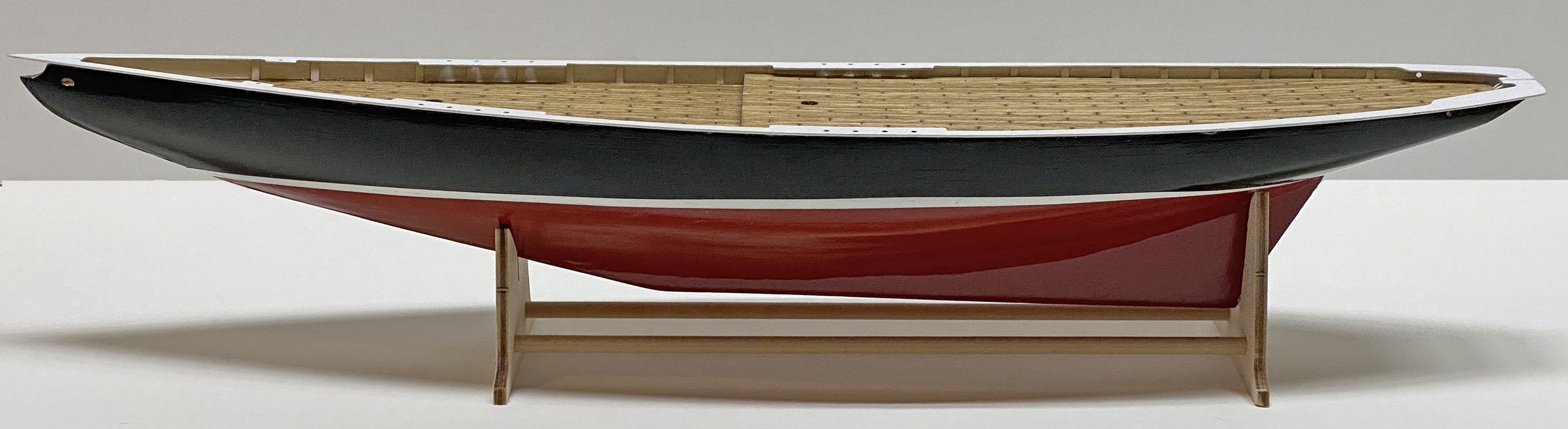

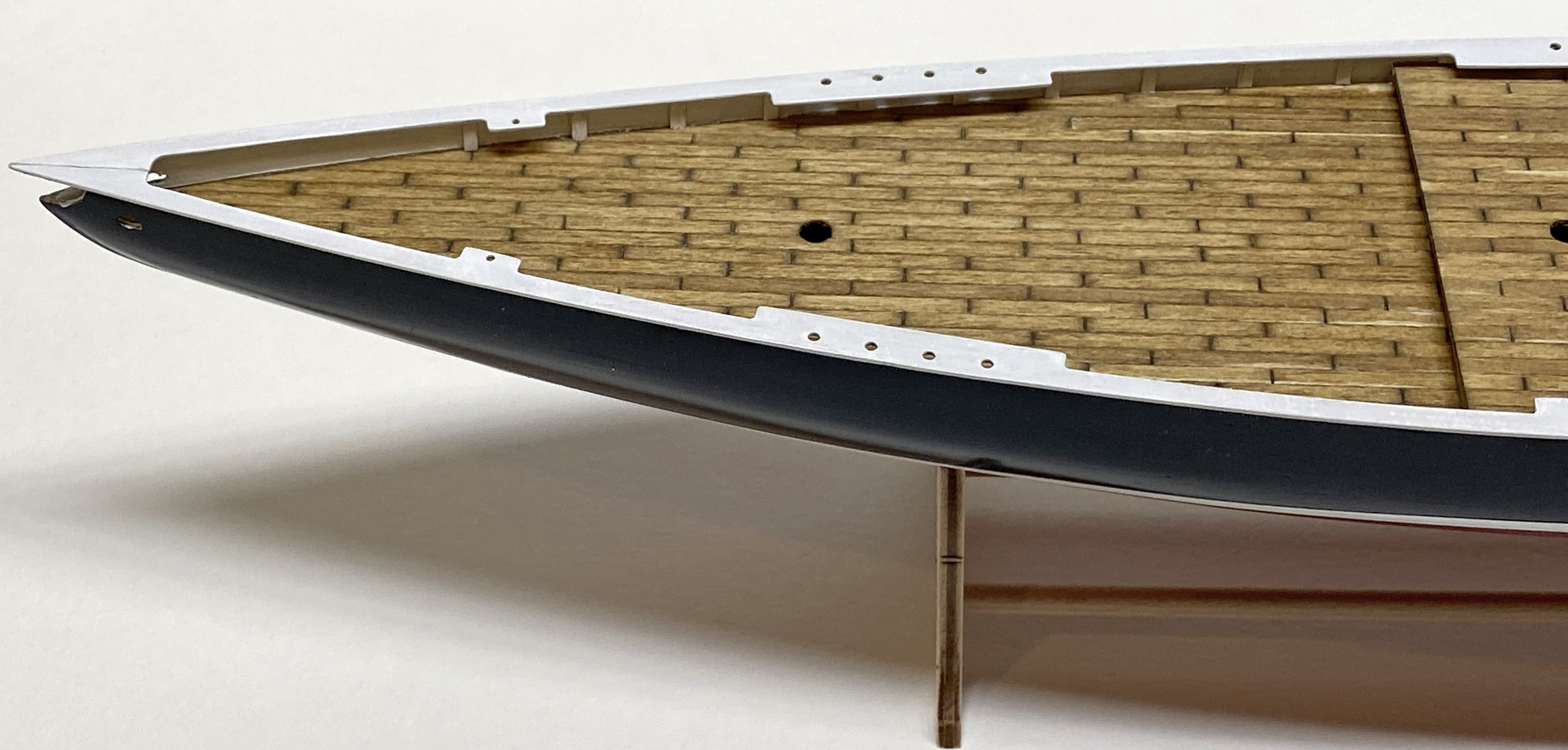

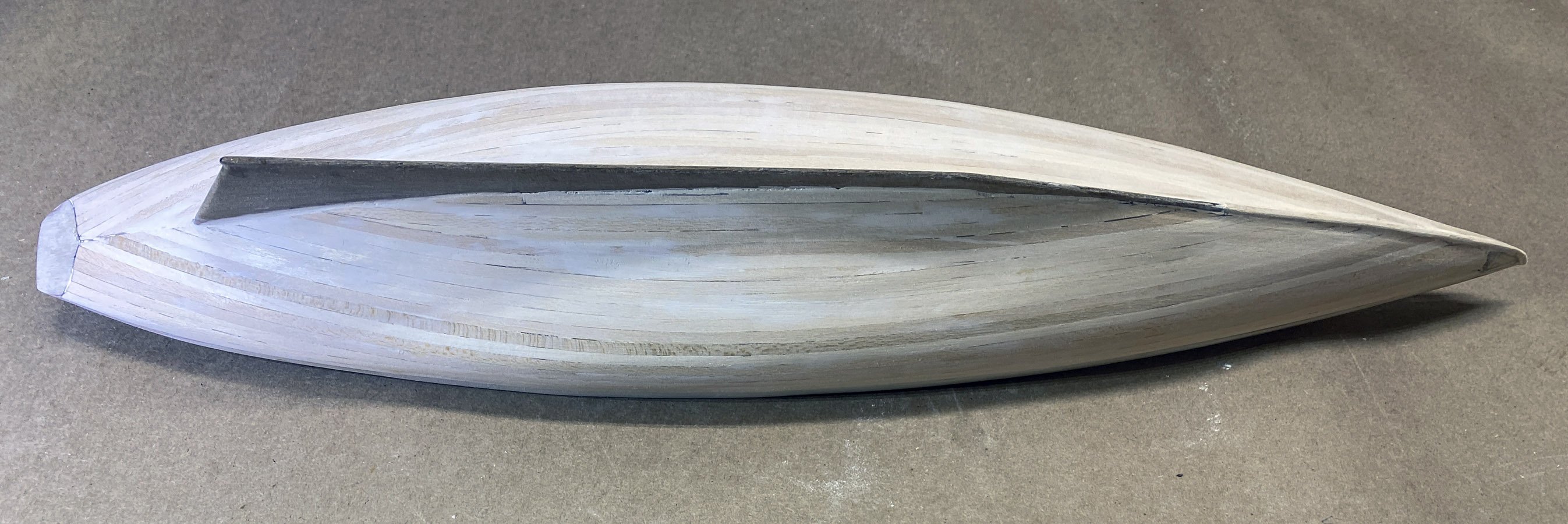

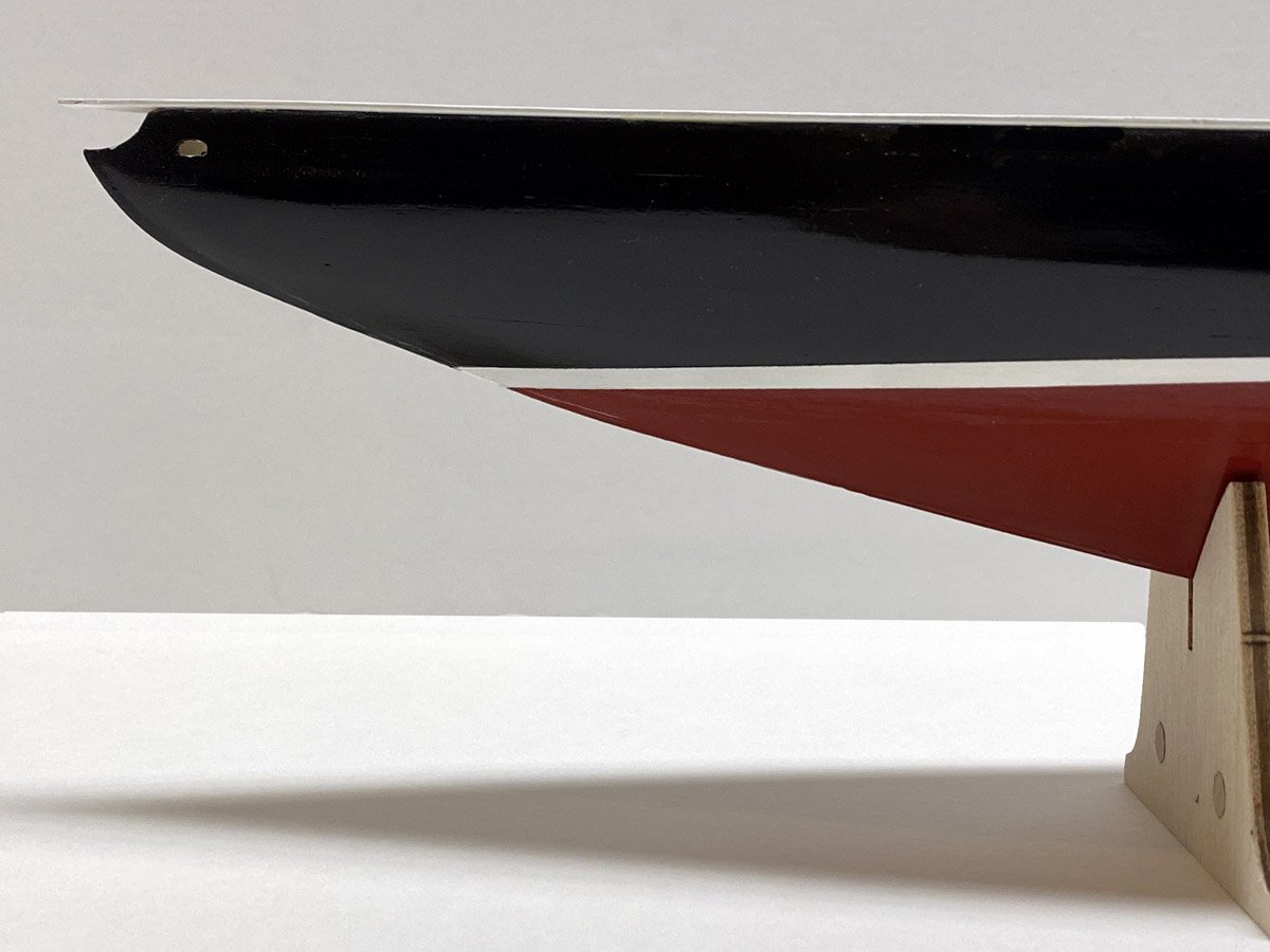

Hull Painted, Railing Installed - 23 days, 55 hours
The hull was painted with three coats each of Rustoleum Colonial Red, Krylon gloss white, and Krylon gloss black from rattle cans. The rails and interior were brush painted with gloss white acrylic. I am leaving for Europe in a few days and rushed to get this all done, but probably should have taken my time. I can see a few seams between boards and a few fingerprints on the black areas. Not bad but I could do better.

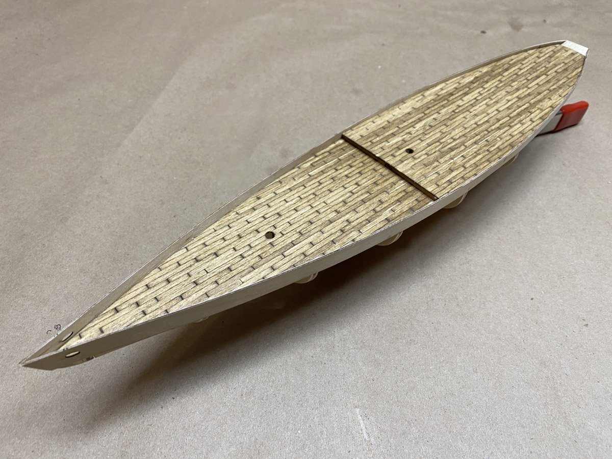

The instructions say to wrap the deadeyes with fine brass wire. That seems simple enough but it took a few tries to get the hang of it. I darkened the wire with Novocan brand patina for stained glass.
The wires go through the rails and into the deck, and are attached with CA. The remaining holes are for the ropes, but there are no belaying pins with the kit! The instructions just say to run the ropes to the appropriate holes. I hope I have some belaying pins in my spares box.

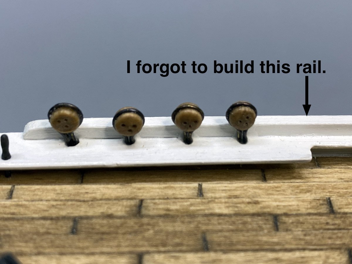

Oops, Missing Rail
I've been working on hatches, cabins, etc. and realized that I had neglected to add a second layer of railing around much of the hull. It wasn't hard to add, except where it interfered with 8 deadeyes amid ship. I had to wiggle them all loose, add the railing, paint it, and replace the deadeyes.newrail.jpg.395eee4c398890d79d919c00bf3441ad.jpg

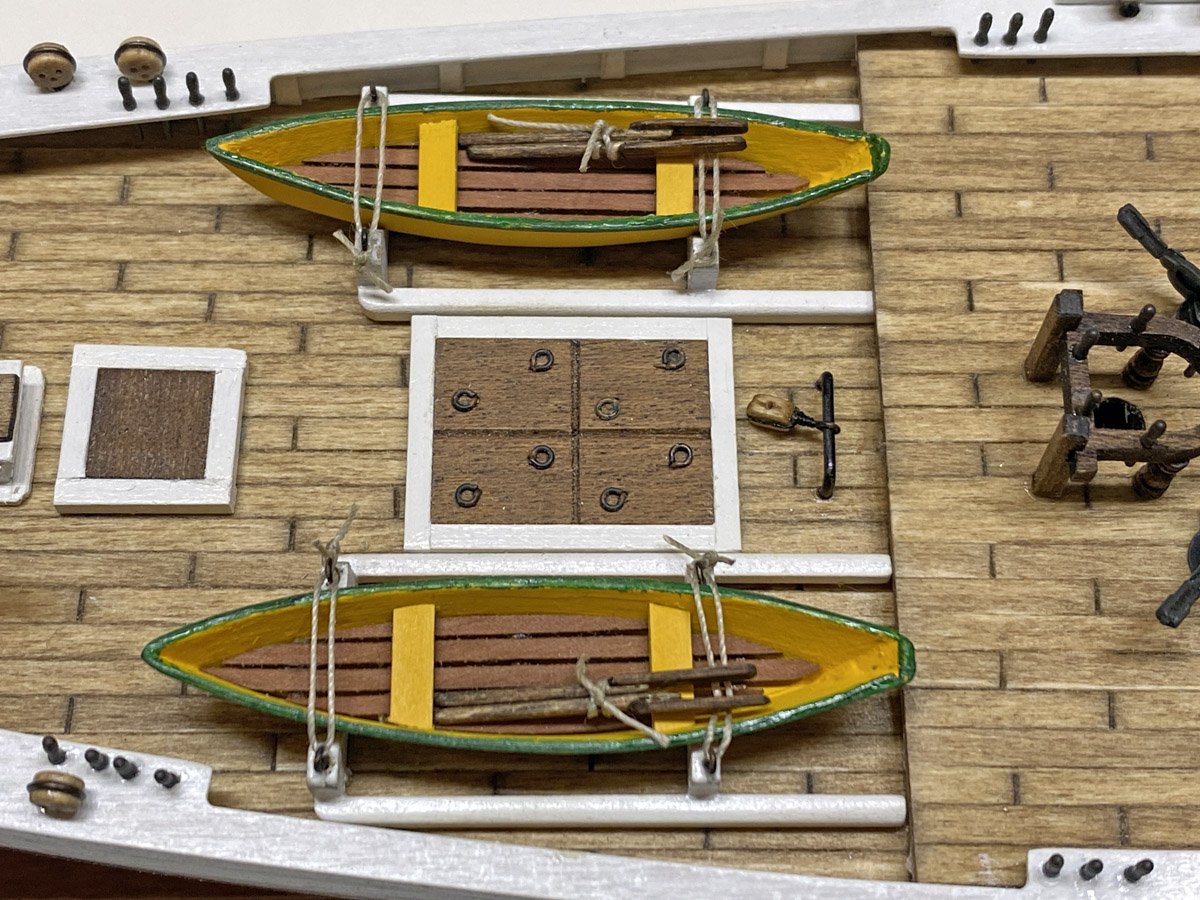

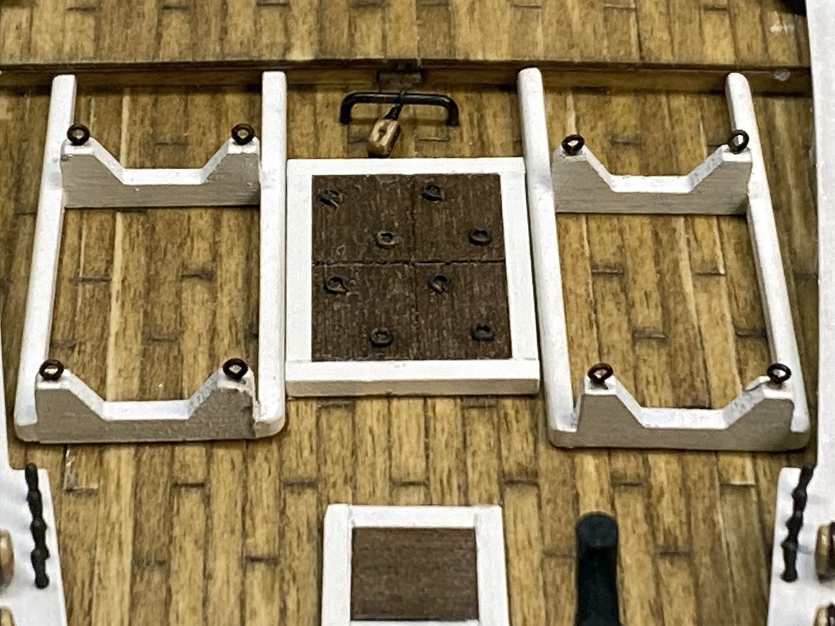

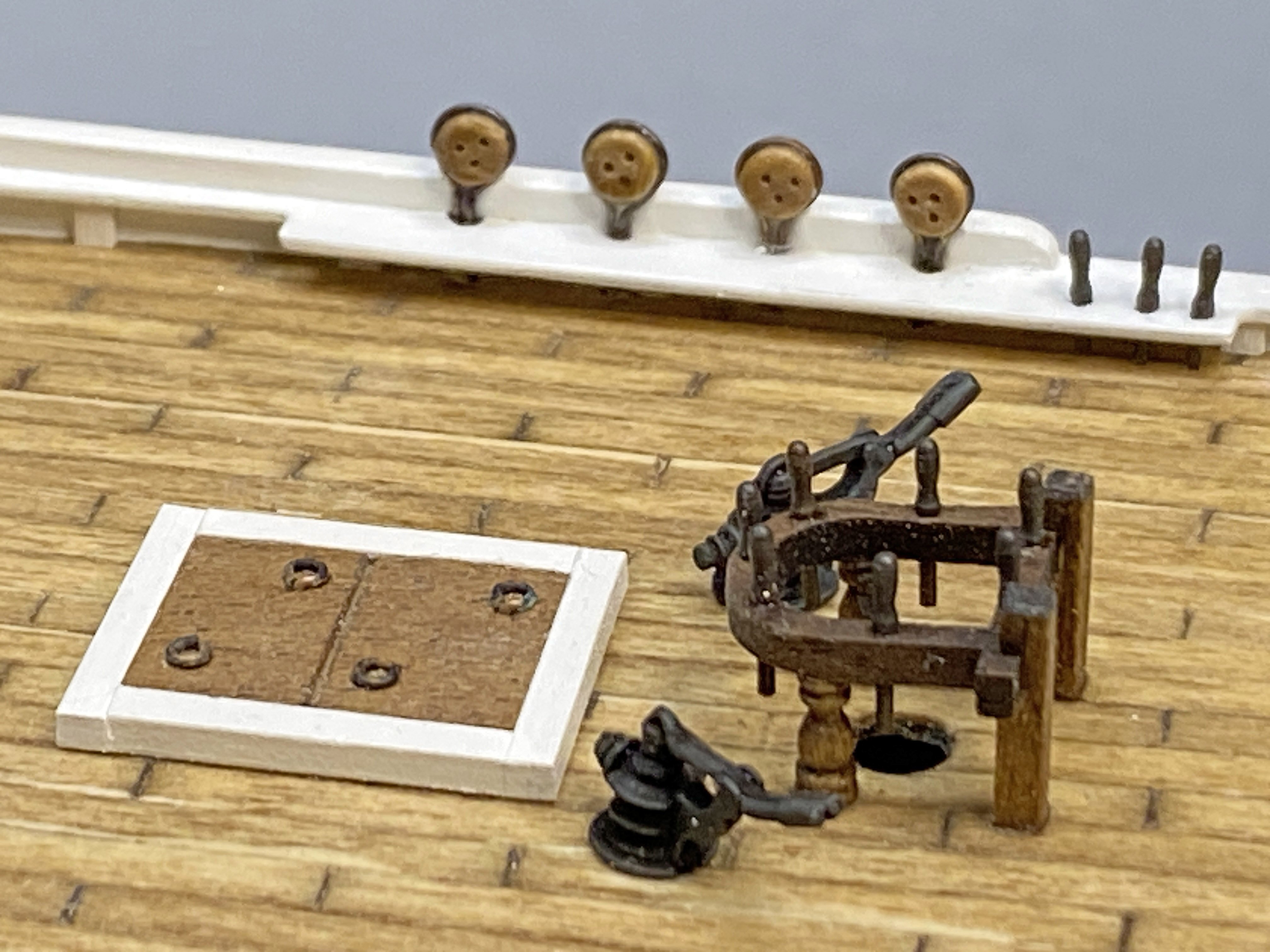

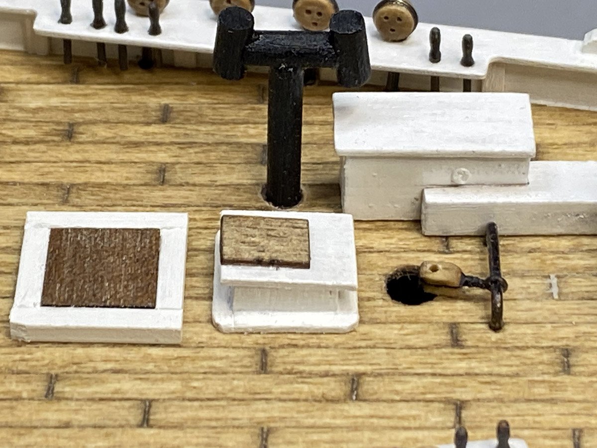

Hatches, Cabins, etc.
The tiny cabin is about the size of a Monopoly house and difficult to hold while working.
The rings on the hatches are actually eye bolts folded 90 degrees and glued in holes. I did find some belaying pins. They are a bit long where the railing is a bit low, so I will have to improvise when tying lines to them.
Main hatch and dory racks. The dories are built and currently being painted.

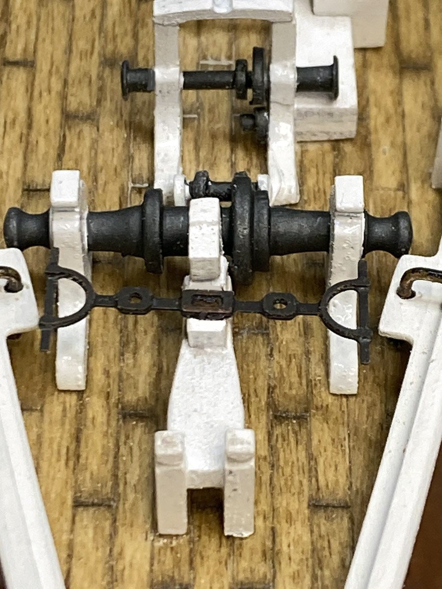

The winch was made from several random pieces - aluminum tube, tiny round disks, 2 cast metal pieces, 2 turned brass pieces, and a piece of photo etched brass.
Great work, Rod. The winch assembly was probably one of my favorite parts of the Bluenose build.

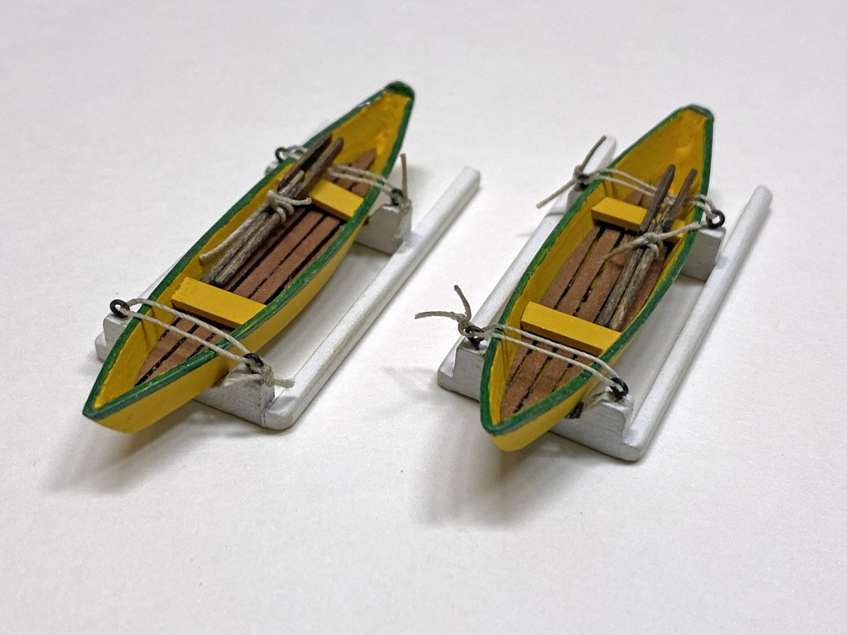

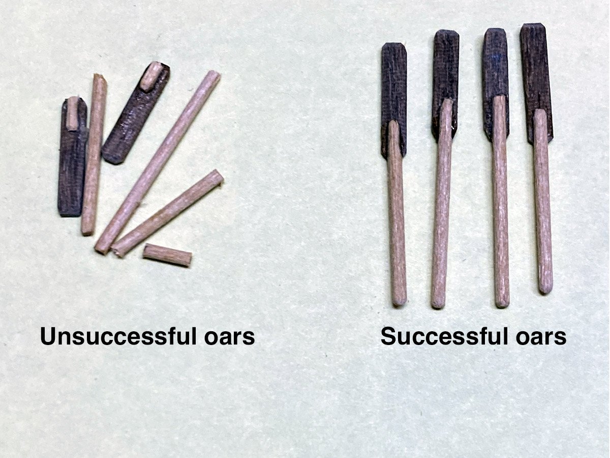

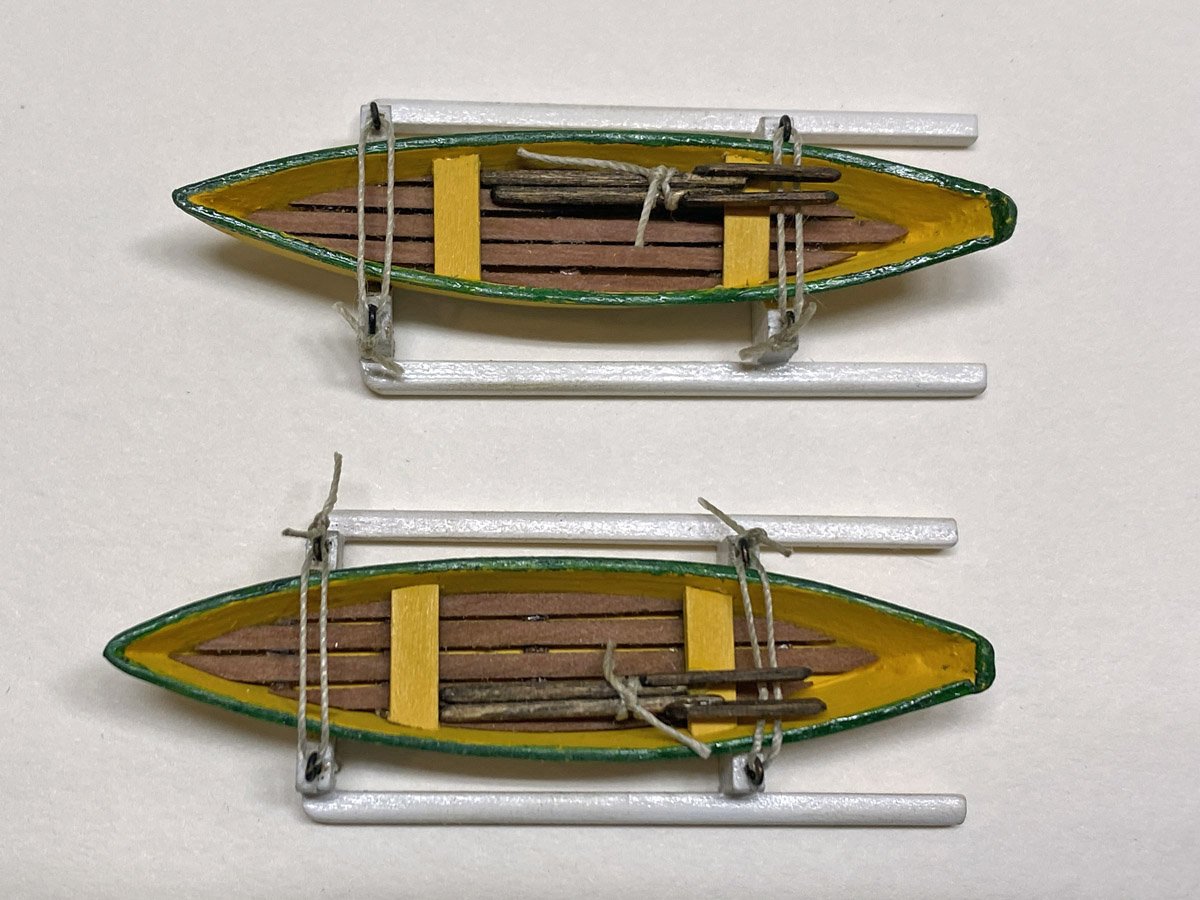

Dories - 13 hours over 4 days
The dories are made of 4 pieces of laser cut plywood assembled over a 4-piece form. The actual construction was pretty simple but I added some details that took a lot longer. Like these oars. They're 25 mm long and the handles are 1 mm dowel. They tended to break where the handles attach to the blades.
Dories02.jpg.53b0169f6a9cd0209c9859abcb30ff6e.jpgDories01.jpg.3f1cc67391d110705fc0b59b0a75f620.jpg
The floorboards are thin walnut strips. The spacing between the strips is exactly the size of my push pins.
I attempted to paint the dories by hand to avoid setting up my airbrush. When they still looked uneven after 7 coats of Model Master insignia yellow acrylic, I got out my airbrush. In 10 minutes they looked great. The green was masked off but drawn with a permanent marker.
The Bluenose often sailed with 12 dories stacked 6 high. but 2 was enough for me.

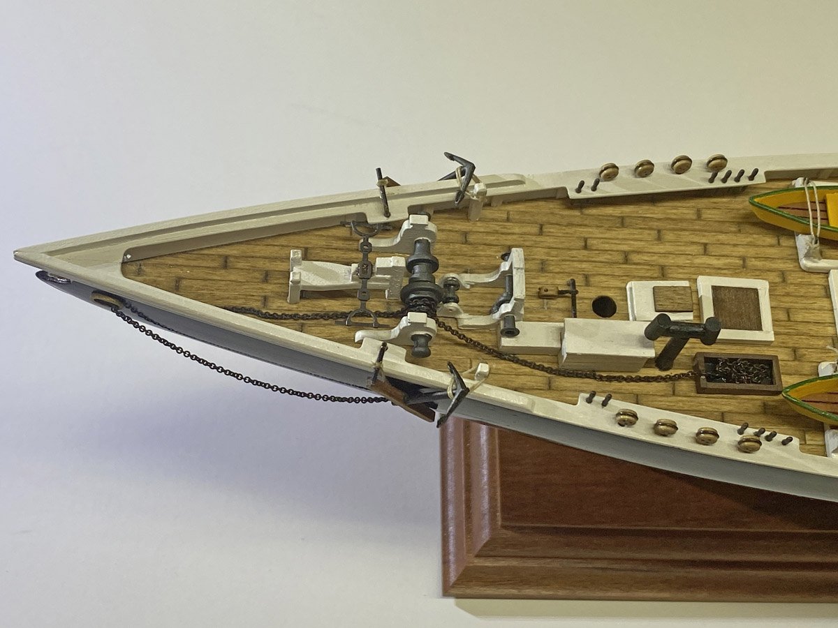

Anchors

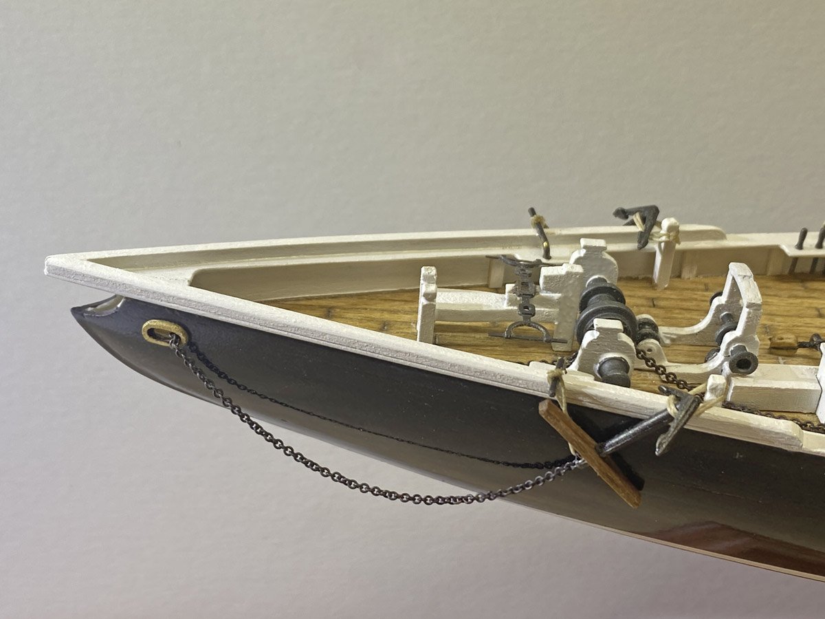

The Amati kit came with two cast anchors but no stocks or chain. I made stocks from some scrap walnut, and I had a long piece of brass chain that I blackened. The instructions show the anchor tied to the cathead by the shank, and a rope from the ring to the hawsepipe, where it disappears. I searched several Bluenose builds on MSW and saw chains leading to the winch, around the engine box, and into a chain box (or possibly into a locker below the deck?) I made something like what  GGibson shows in this post.
On 7/26/2025 at 6:42 PM, GGibson said:
Anchors01.jpg.33eedf13d9ee8caad3188ed6ab94a277.jpgAnchors02.jpg.a5199cc96671c4162530285e88eeef14.jpg

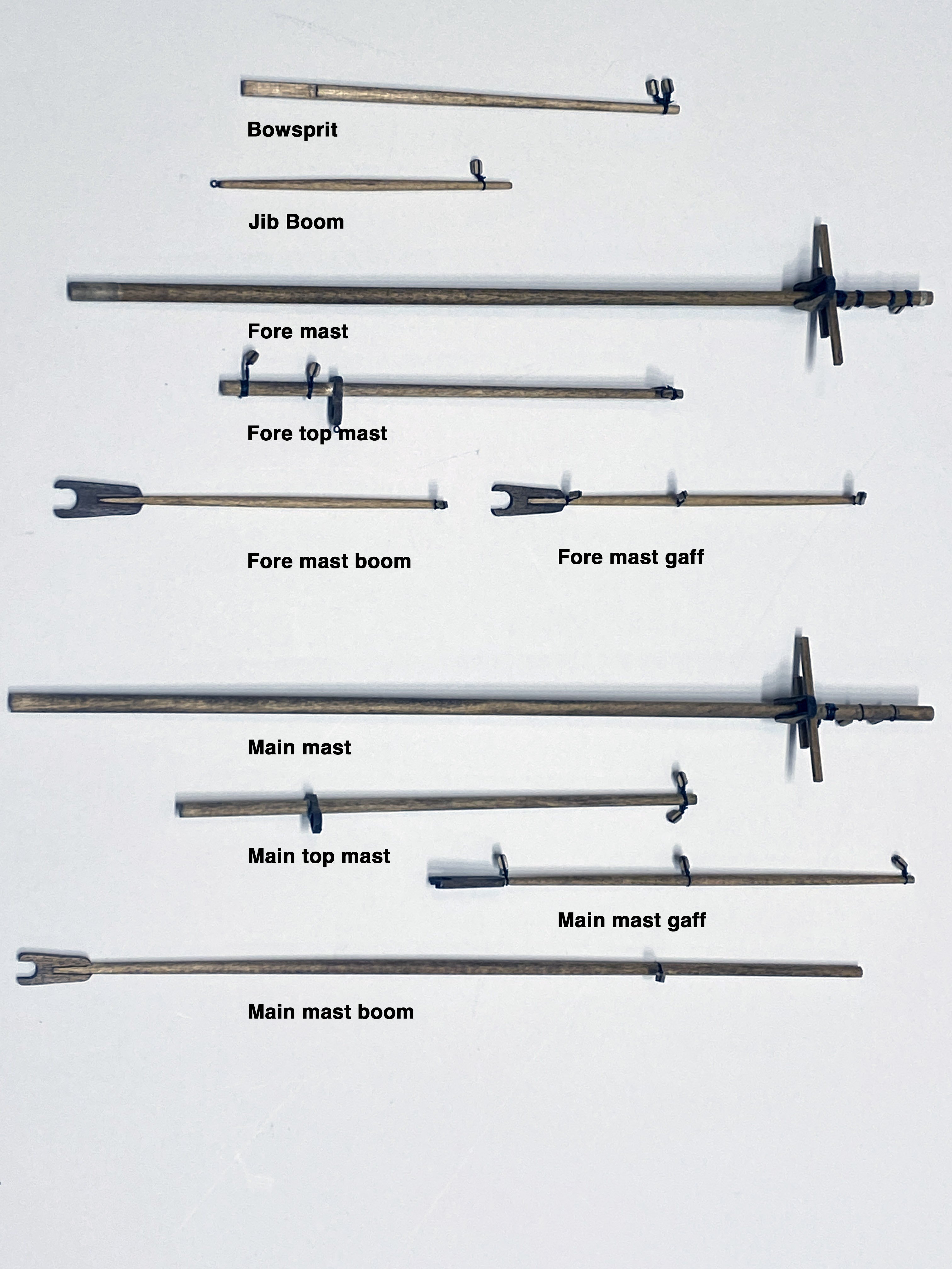

Masts, Gaffs, and Booms

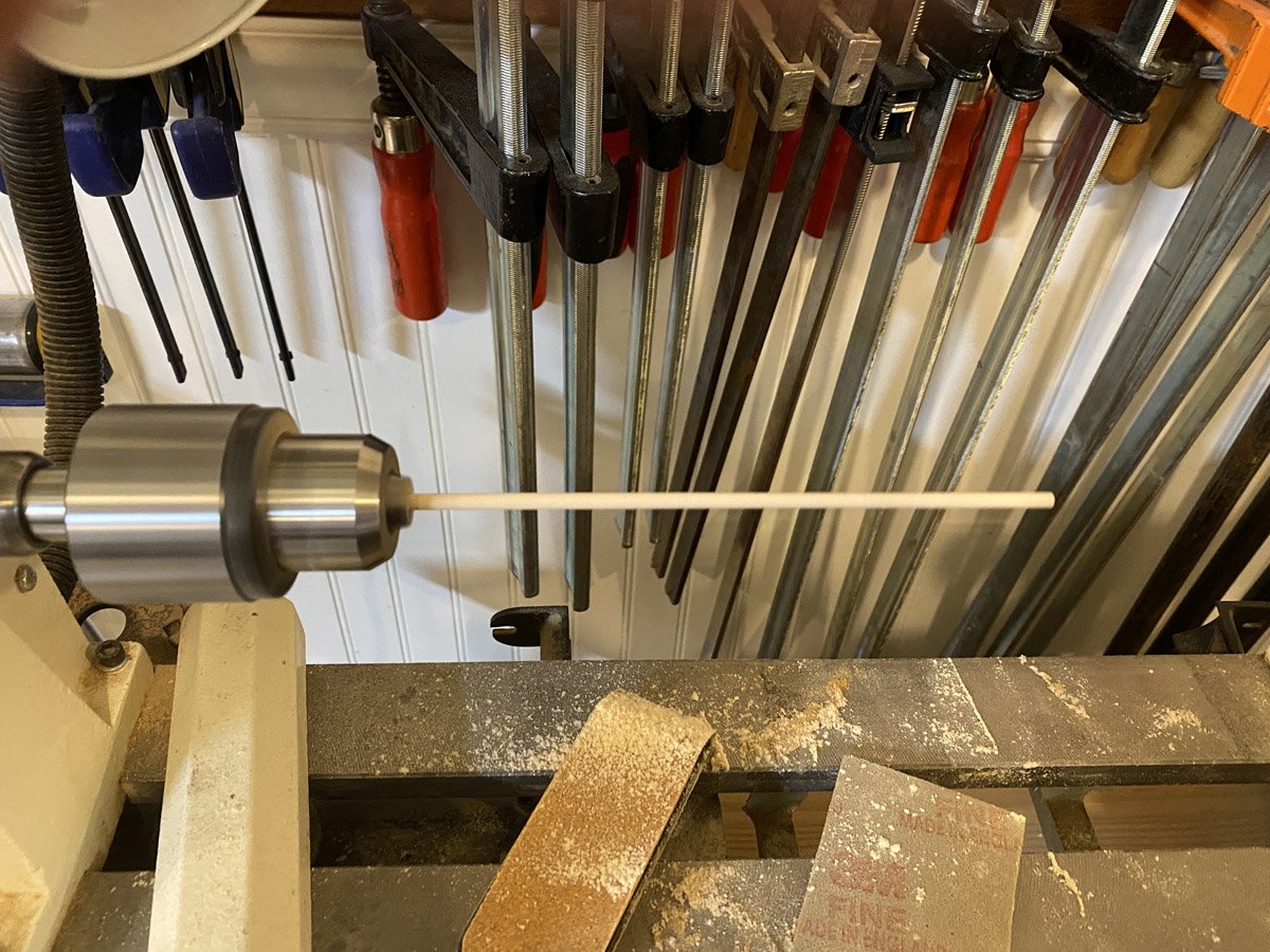

I tapered the masts, etc. chucked on a lathe using sand paper. At first I struggled with how to seize a line to a block and attach it to a mast, until I remembered that I had posted a very simple way to do that under my Endeavour build. It's cheating but it looks fine, goes fast, and hardly wastes any line. All those pieces are done and ready to install.
masts01.jpg.8d2df459c1cfa5408f7ac21b47dbd6ec.jpgmasts02.thumb.jpg.7c9922a42a8b478757b51523d0b89939.jpg
On 7/28/2025 at 6:23 PM, Snug Harbor Johnny said:
1:100 is a relatively small scale to work in (as it tests my skills)
That's for sure! After looking at some of the 1:64 Model Shipways Bluenose builds I've realized that Amati just left off a LOT of small details on this kit. I'm kind of sorry I didn't go with the larger model.
