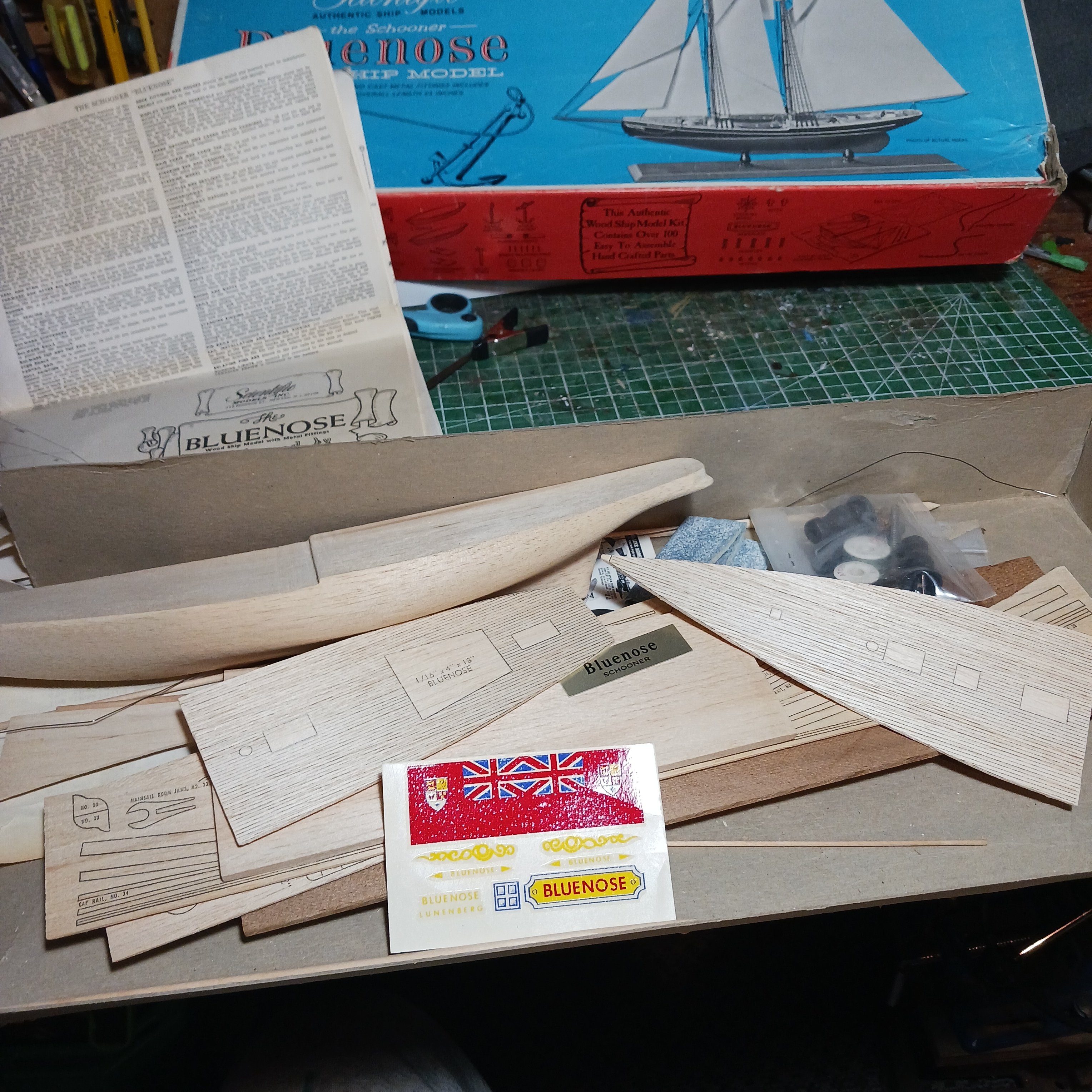

  The Scientific Bluenose.  It is a solid hull kit with old lead deadeyes and dories. Both have the same history..
First up is to open the box and see what I got.

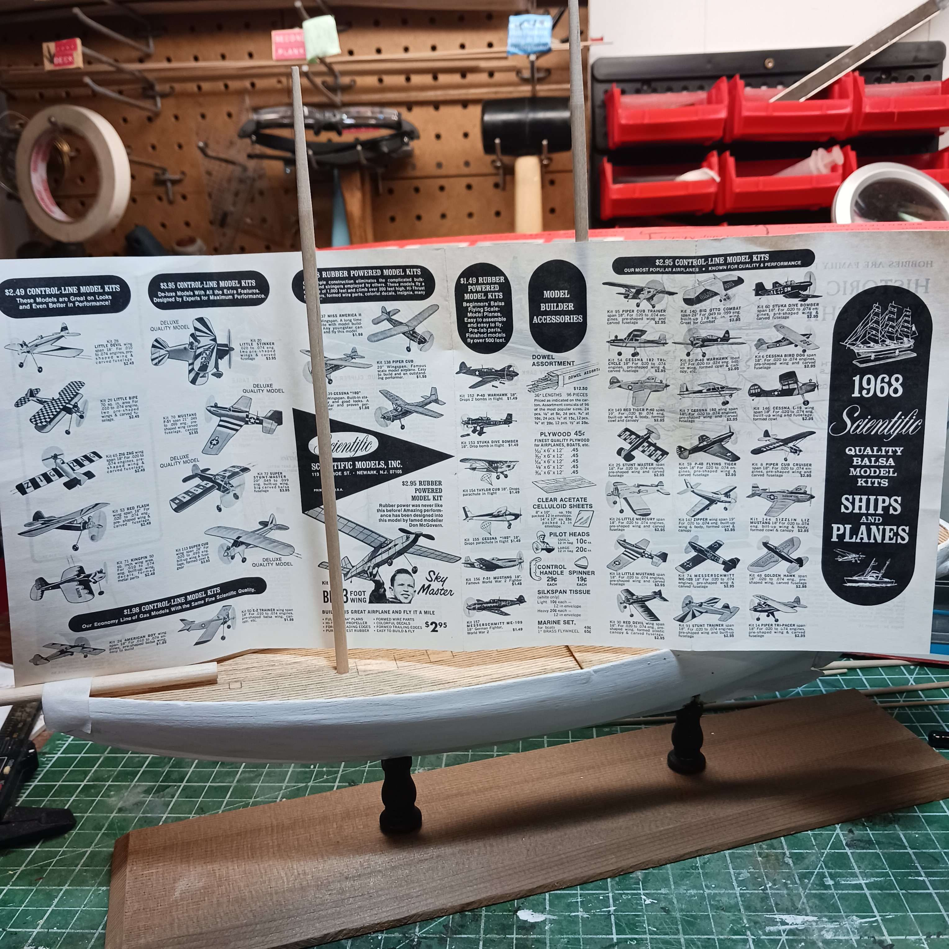

The kit cost $16.95 in 1968, I paid $10.00.

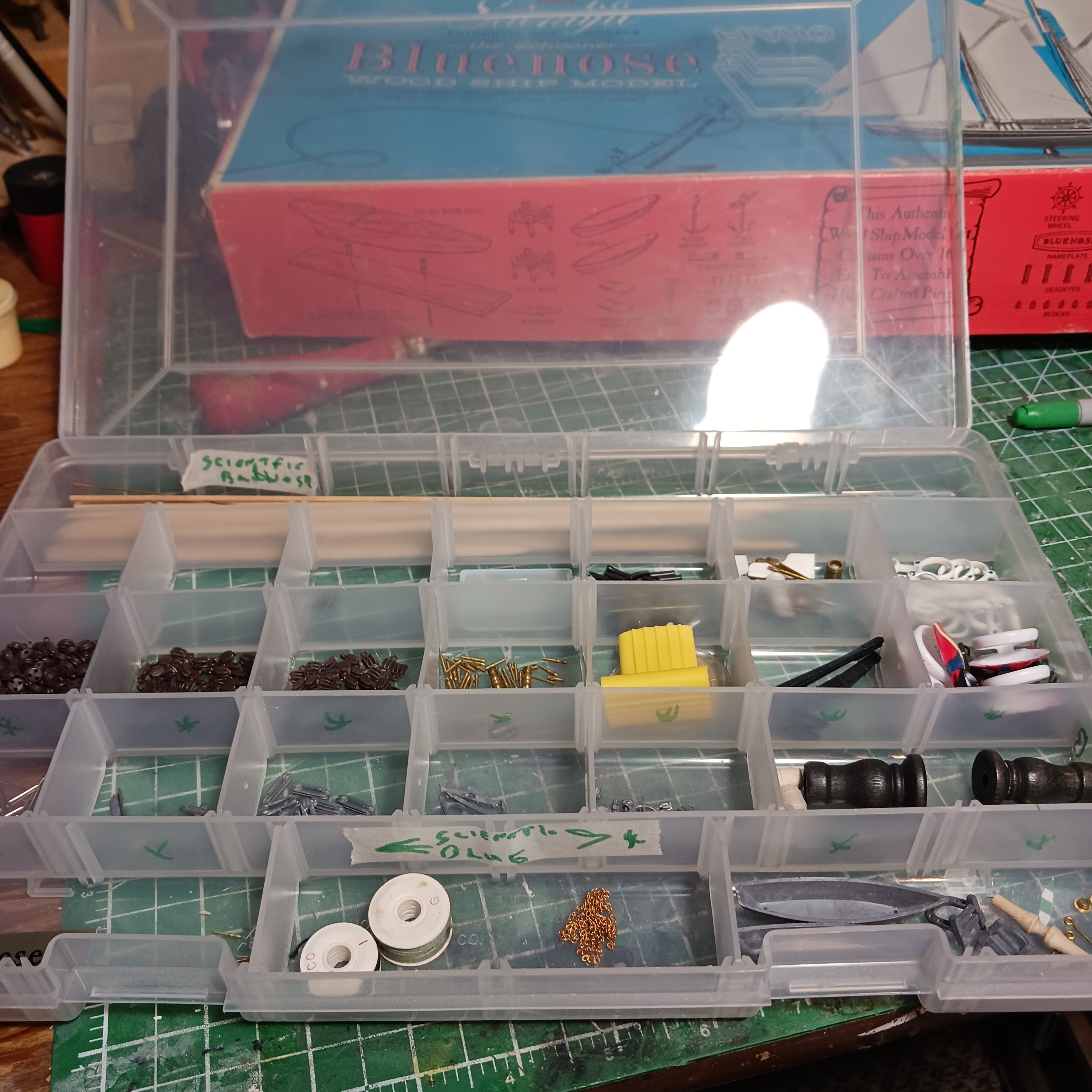

I put everything in separate containers,  and looked at the plans .
The plans say to use a utility  knife and cut out the pieces.  I did one and then used the scroll saw for the rest.

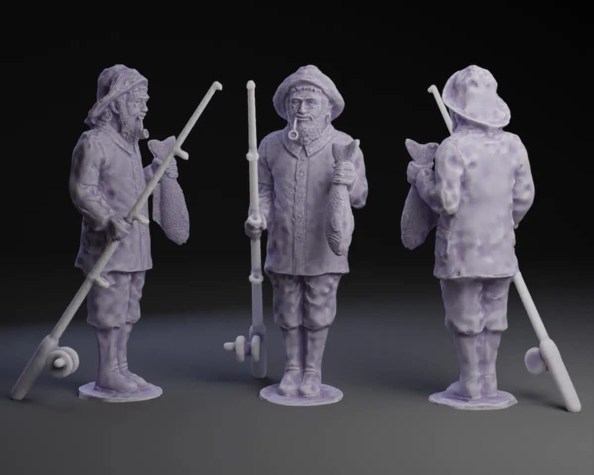

 It is glued down for the night, and meet Freddie Fisherman, my new ships inspector,  my good freind @Gabek printed out this for me, he had a pipe but ,,Gabe had a bit of a problem with it and pipe never printed right,  internet files not his lol. Anyway I personally like the non smoking Freddie,  more on him later.

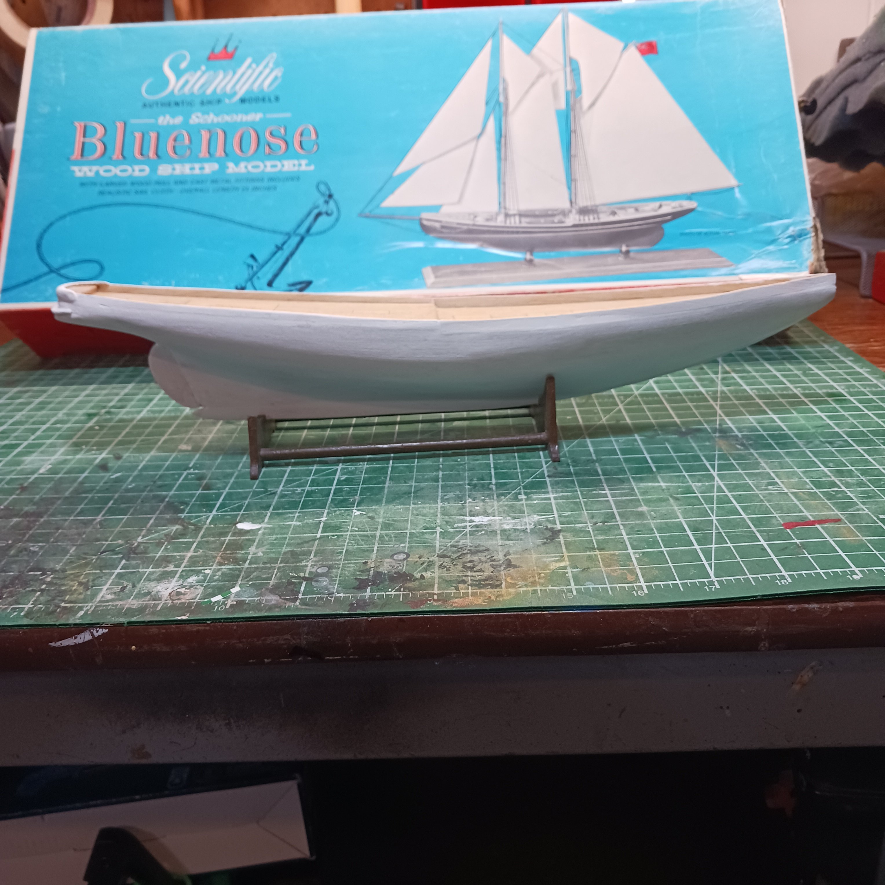

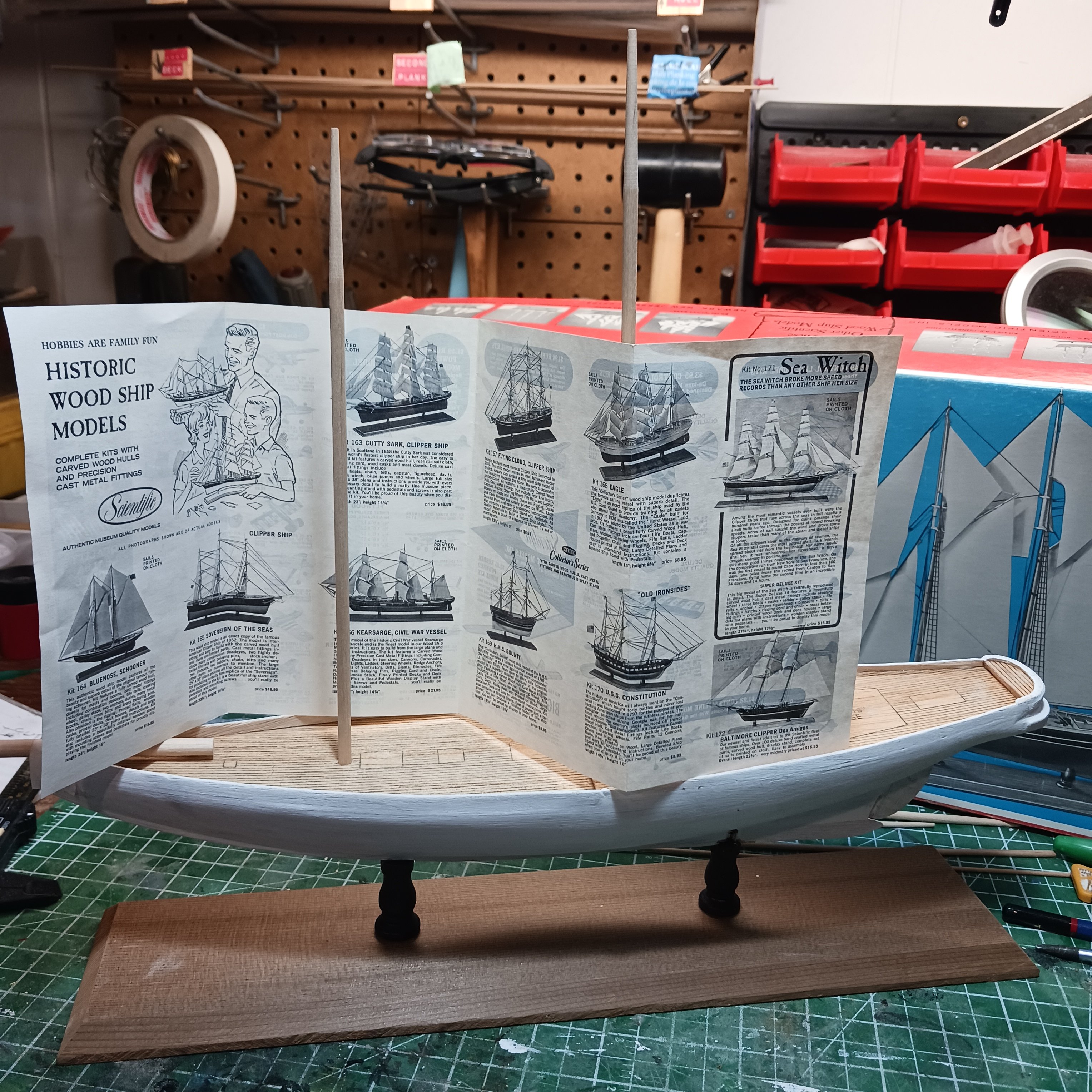

My Dad built this kit before I was born, and I remember it being in the basement for a long time ... but no one can say whatever happened to it.  Most likely he gave it to someone as a gift.

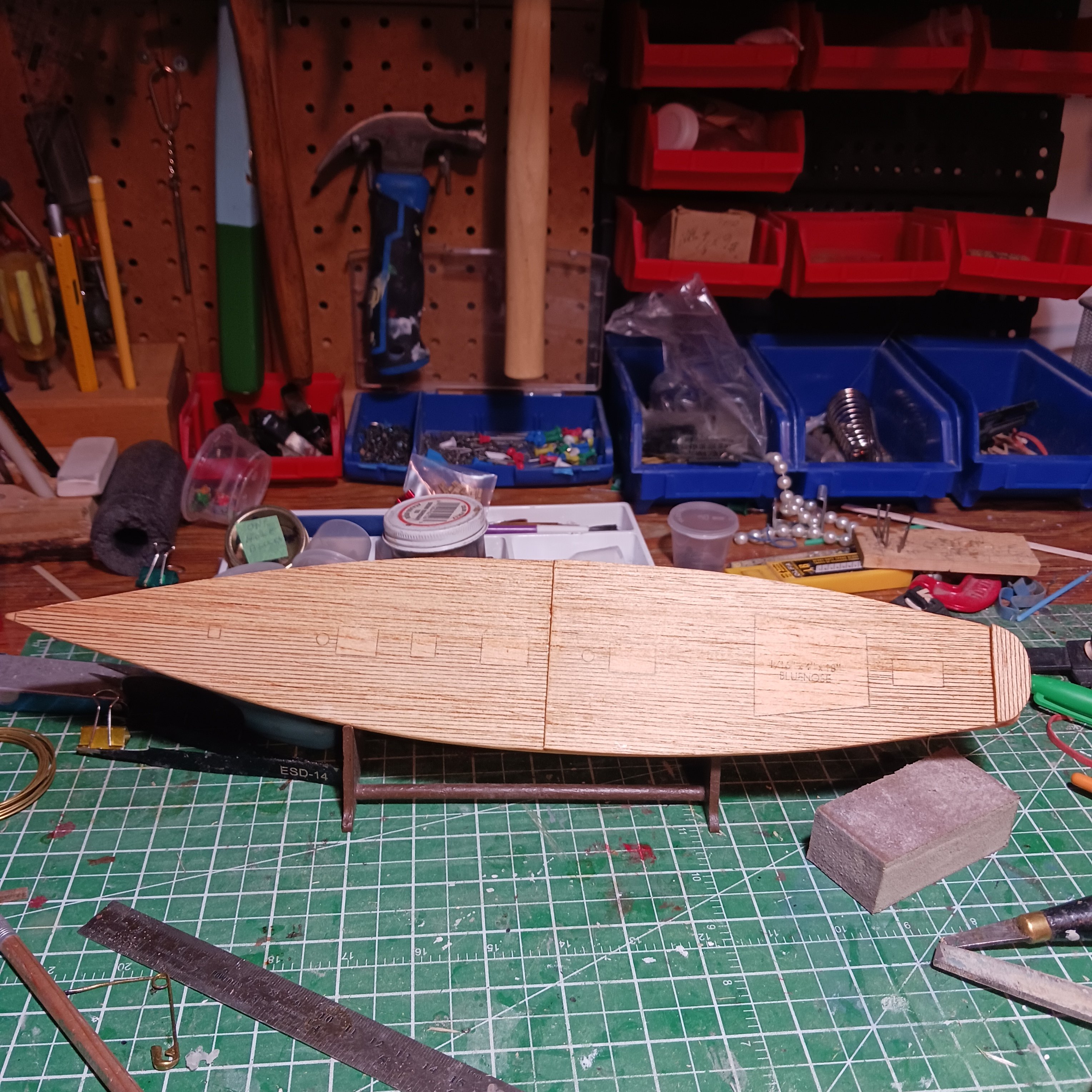

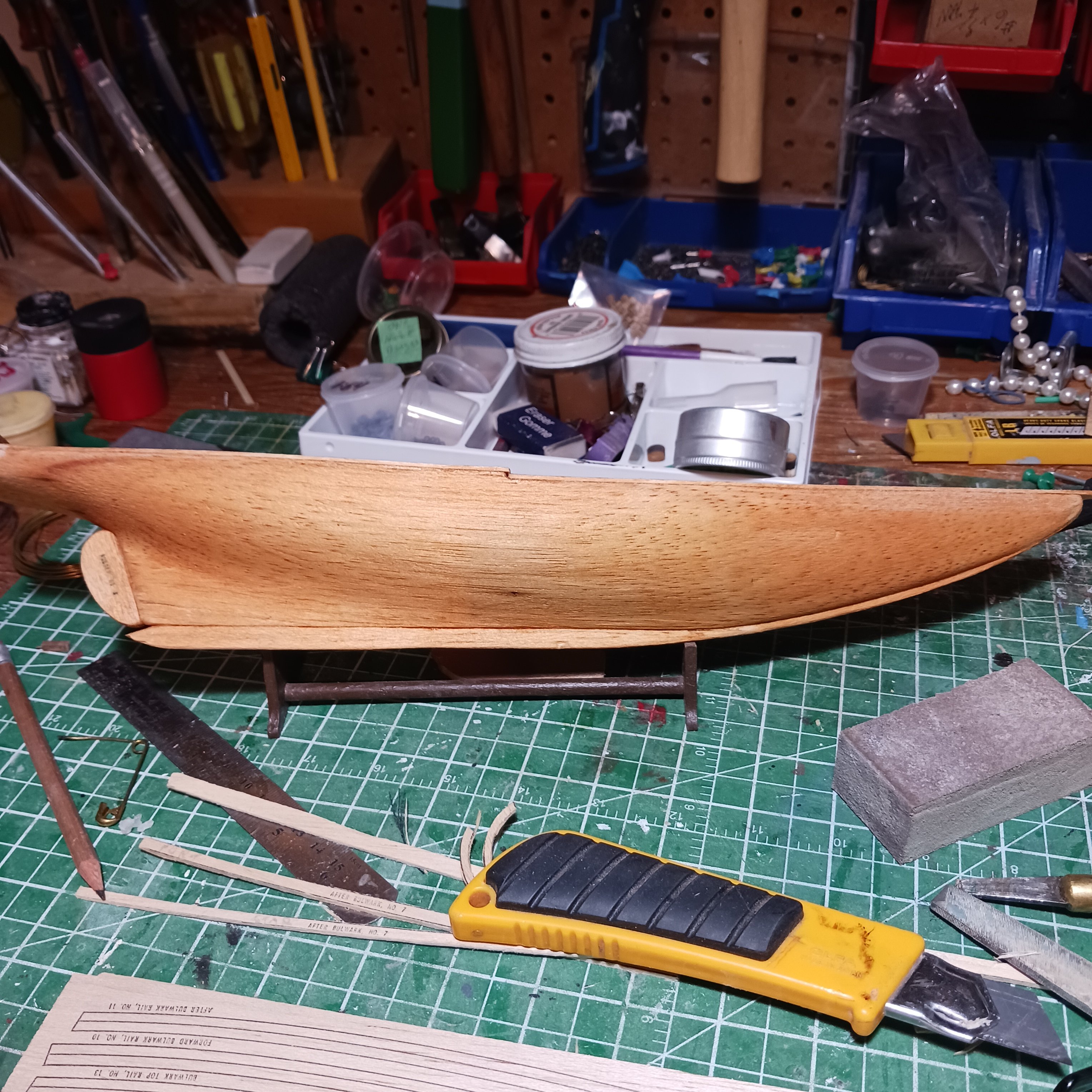

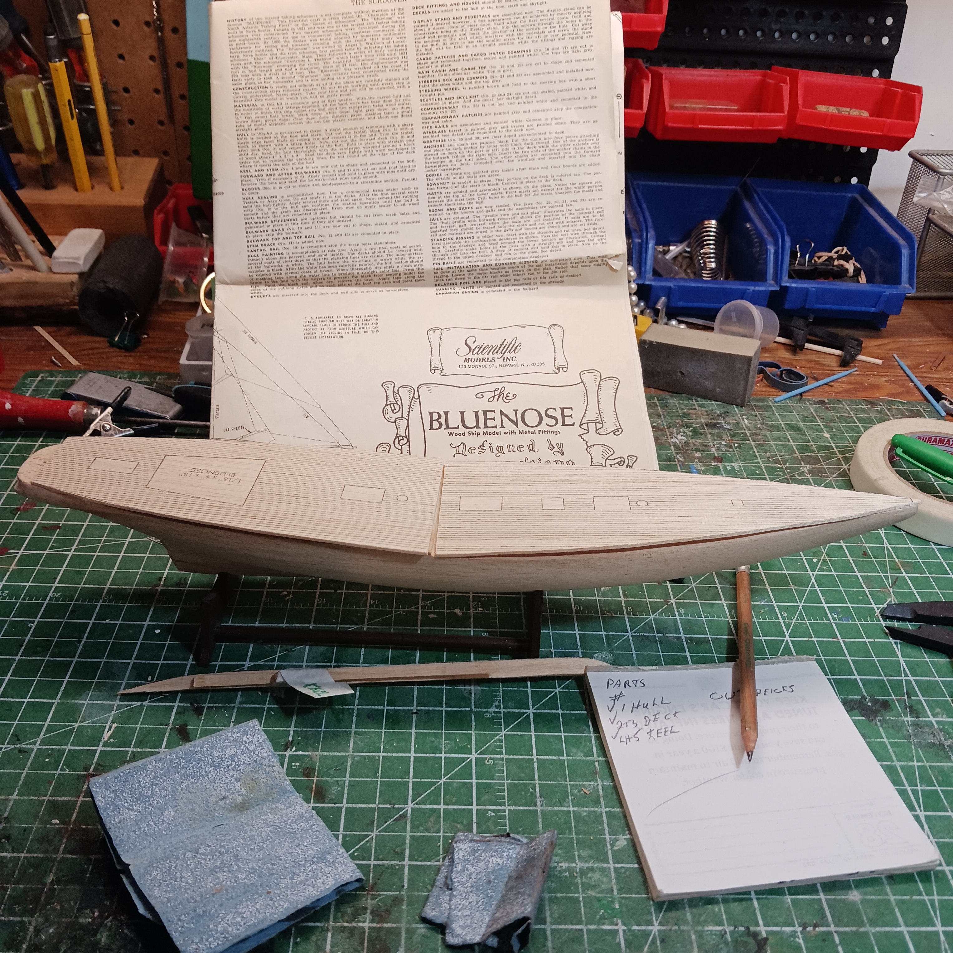

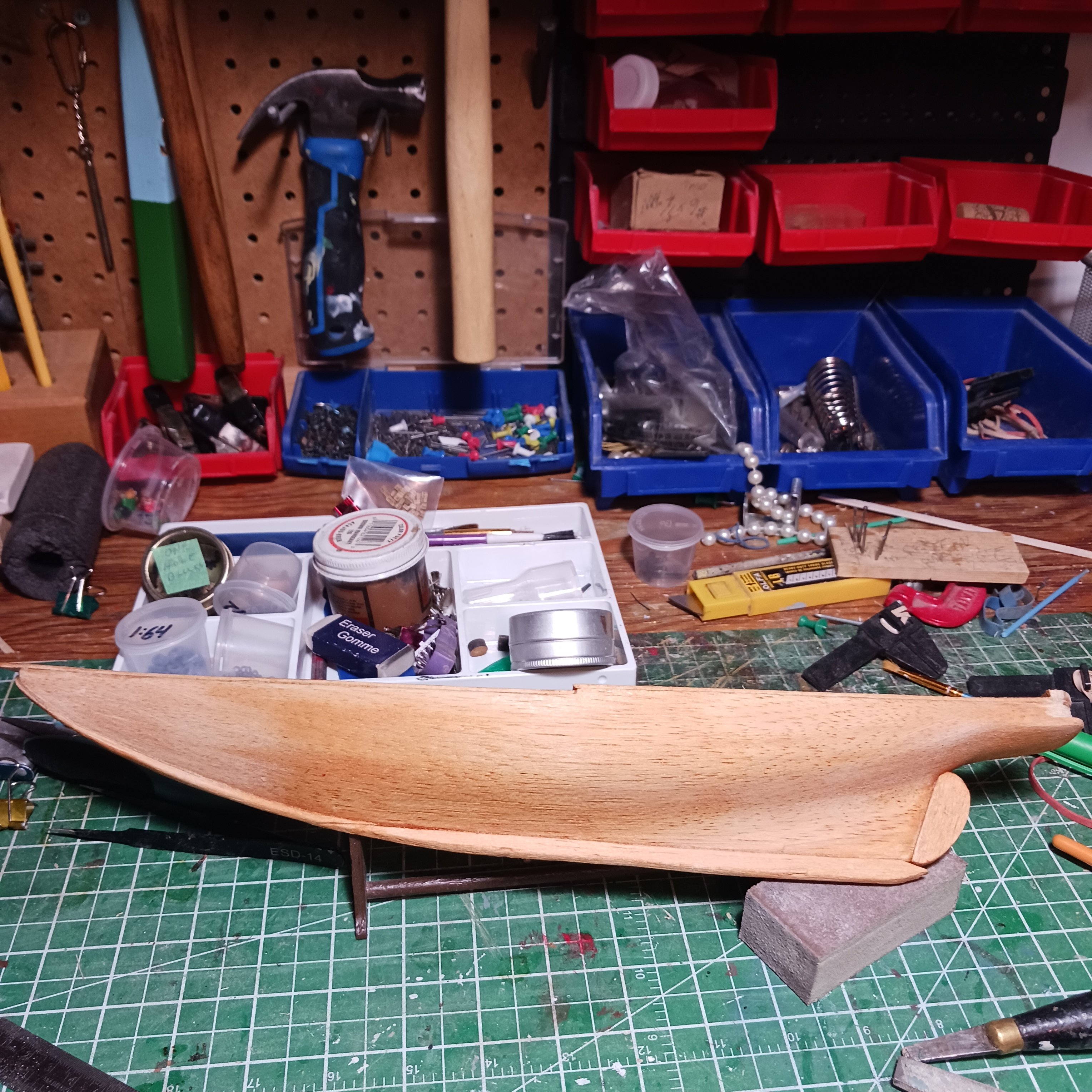

I stained and sealed the deck, I also gave a coat of shellac  to the hull.   Now I can sand the hull and then apply some filler. The reason for the sealer before I filled it, is because if we filled first,  the wood sucks the moisture out of the filler and it may fall out latter.20250626_223703.thumb.jpg.d0a8e077068861d7384630927d205df3.jpg 20250626_222700.thumb.jpg.cca65d4d86f3be940d61e564c50a7242.jpg
Sanding just  this little  bit, she going to be smooth. Lol.  The wood is balsa, and very soft and dry, brittle a bit but I have lots of filler.

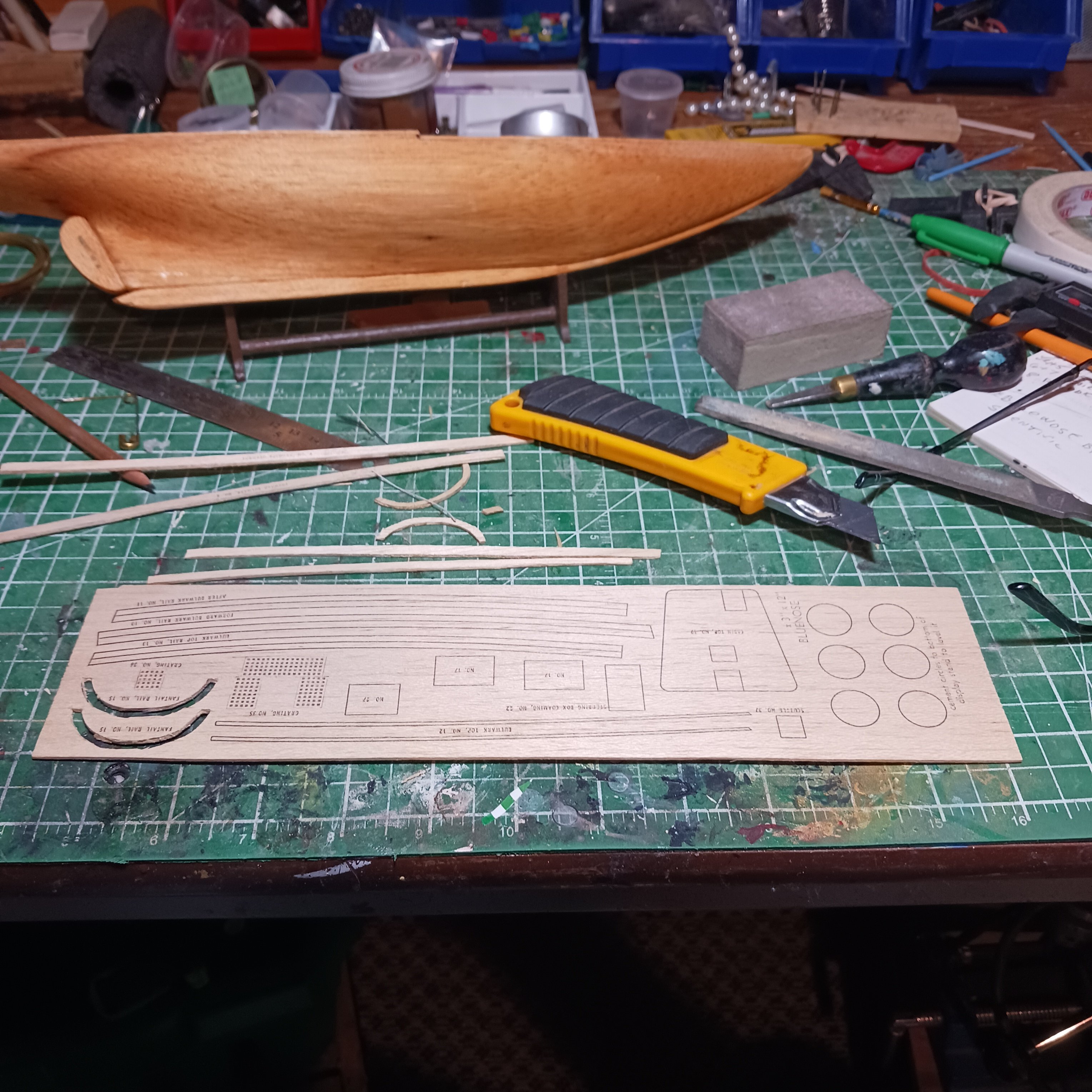

  I cut the fantails out, broke one but fix able. It is going to be a slow process,  but I take my time and cut slowly  with many strokes , not just one cut.20250626_224714.thumb.jpg.4cbc68b13ca889d80c4d1585376061ec.jpg
This wee kit is turning out to be a lot of fun. If I can  I take My time , but I just want to build and build, there are ratlines  to tie , sails to make, right after I learn how, lol. But the is a wealth  of info here on MSW on sails, I am excited  to try to make sails for this ship. It's an older model, but hopefully I can make it a little  beautiful ship   🚢 ️.
.  Thanks for looking in,
Knocklouder     :cheers:

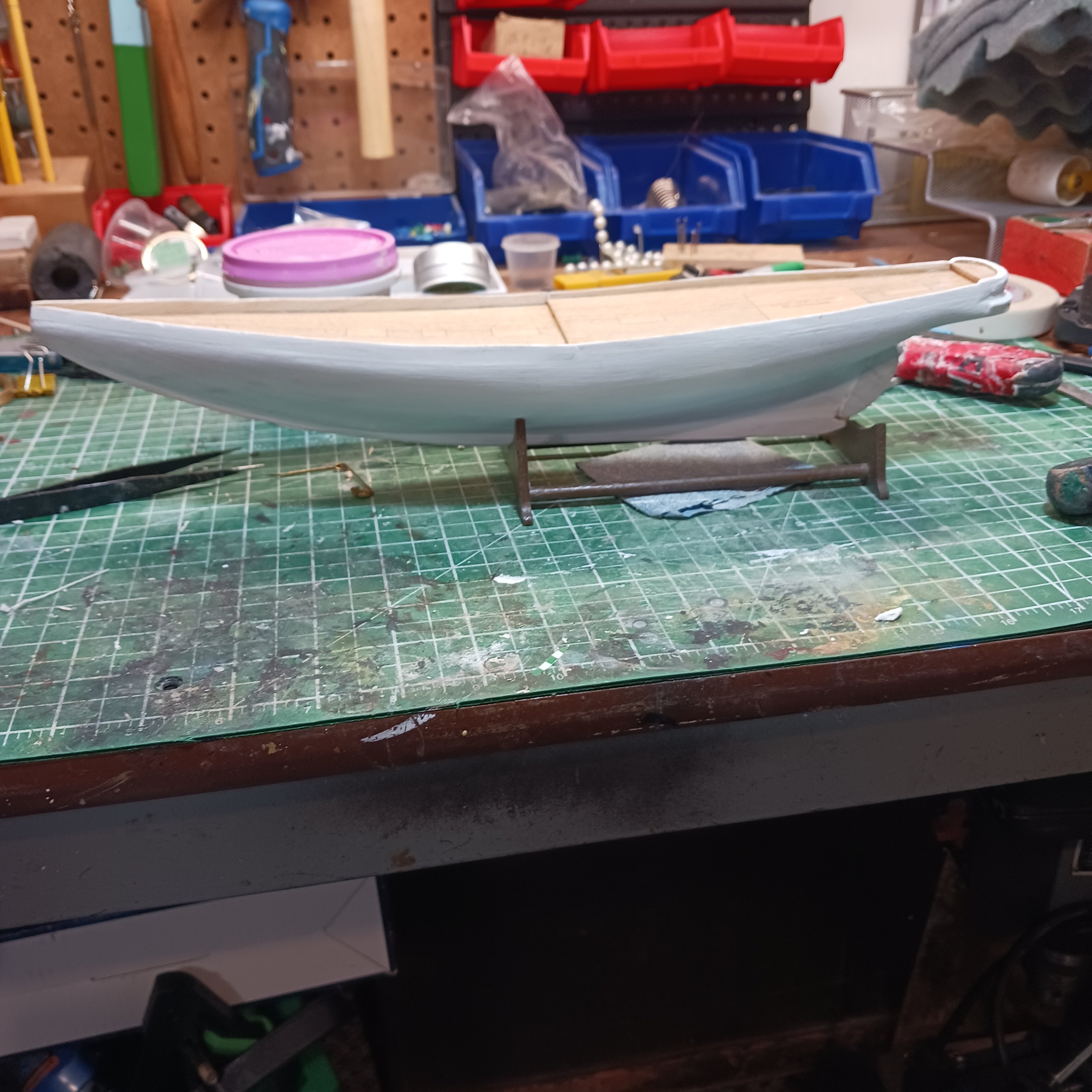

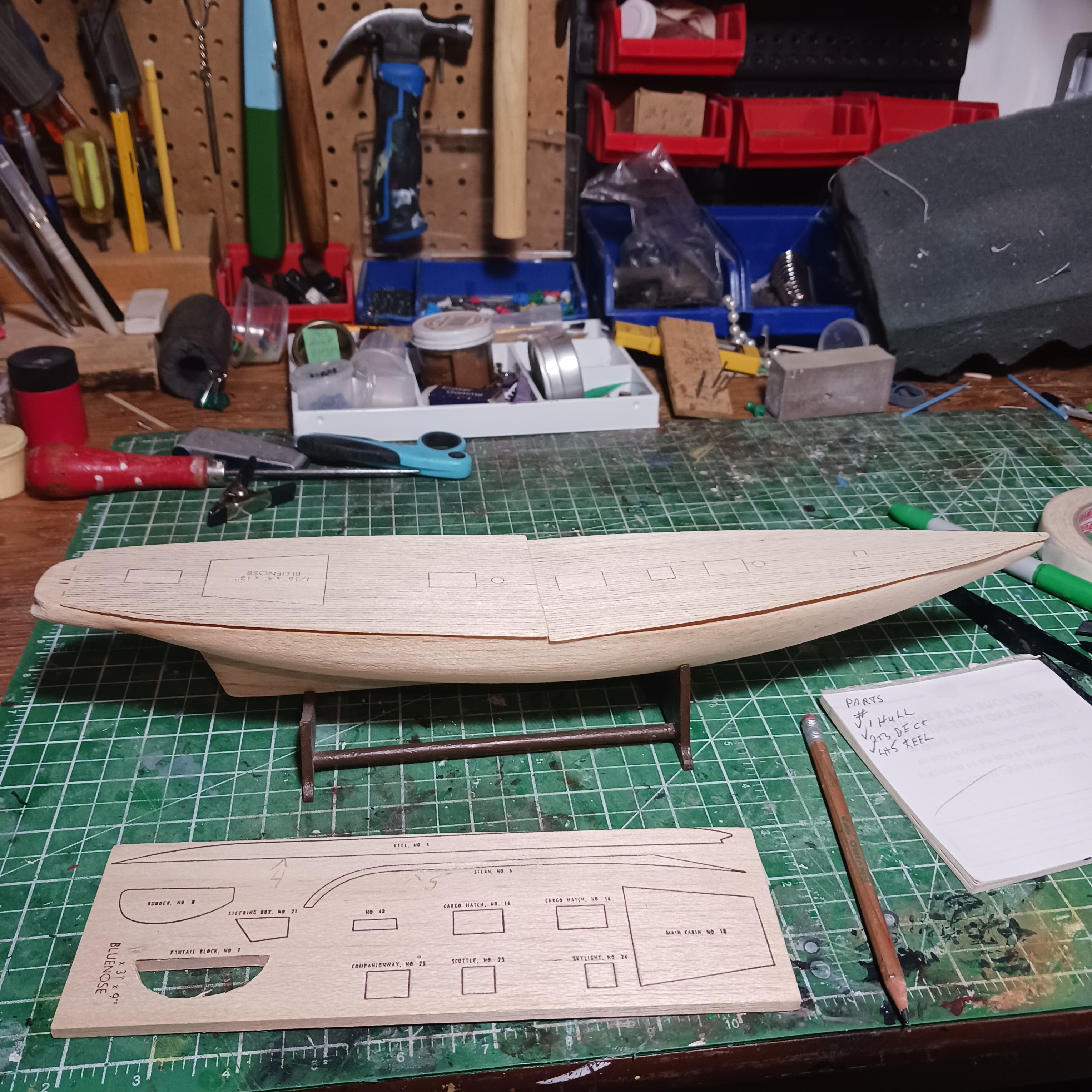

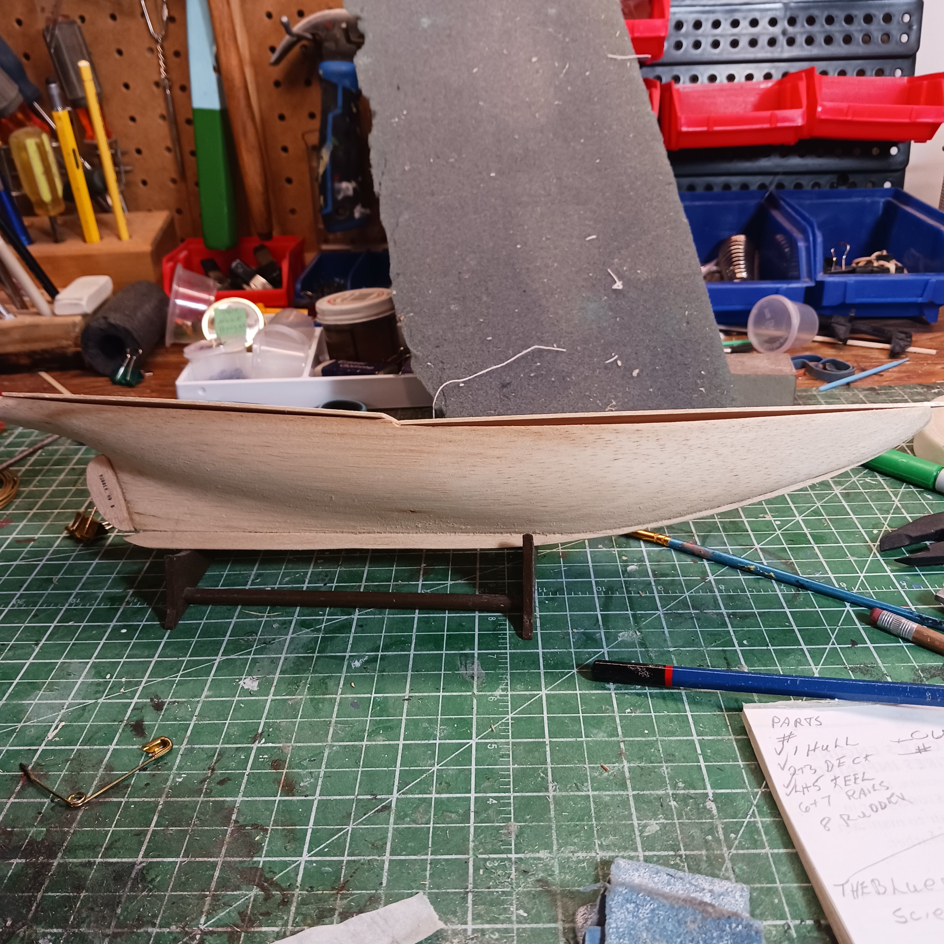

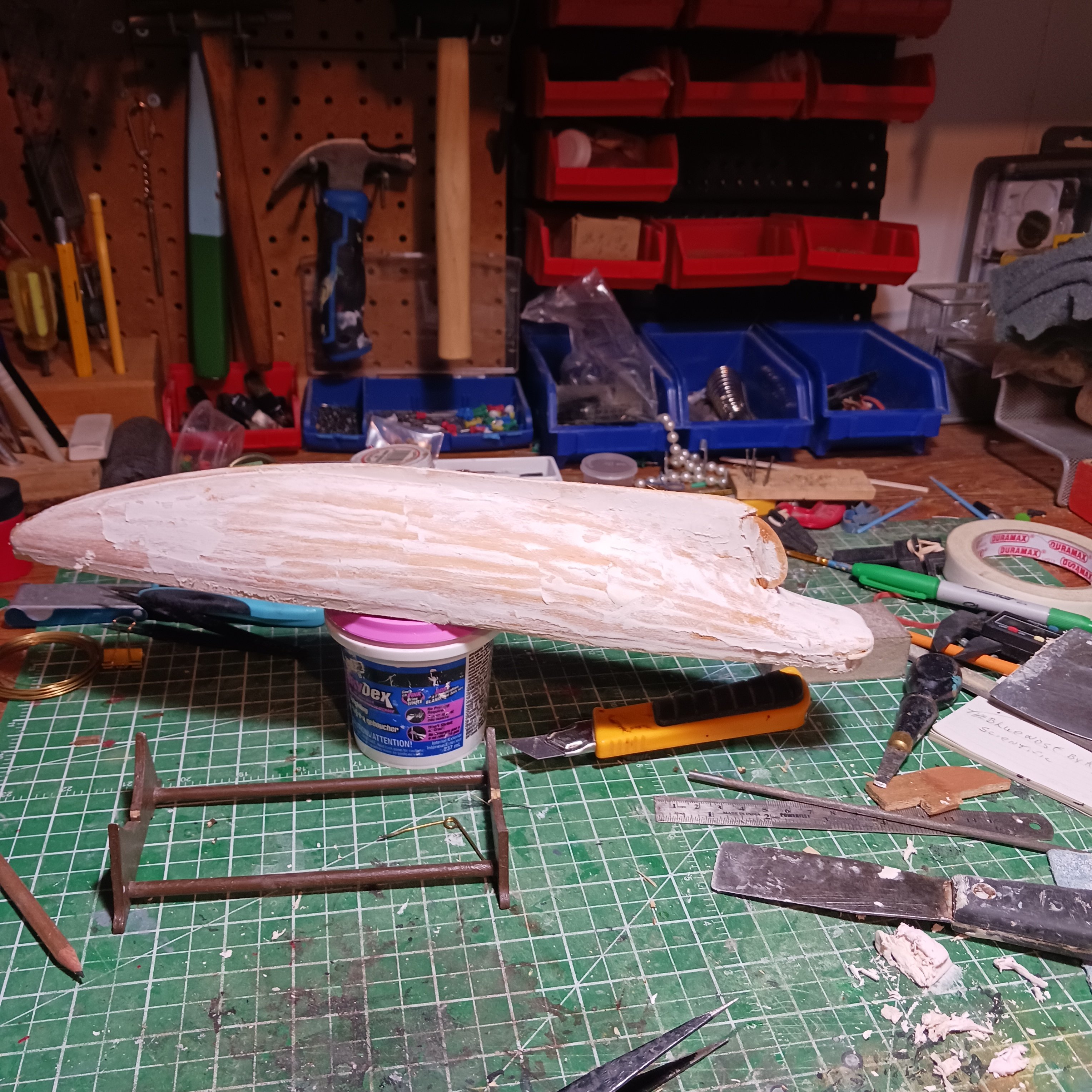

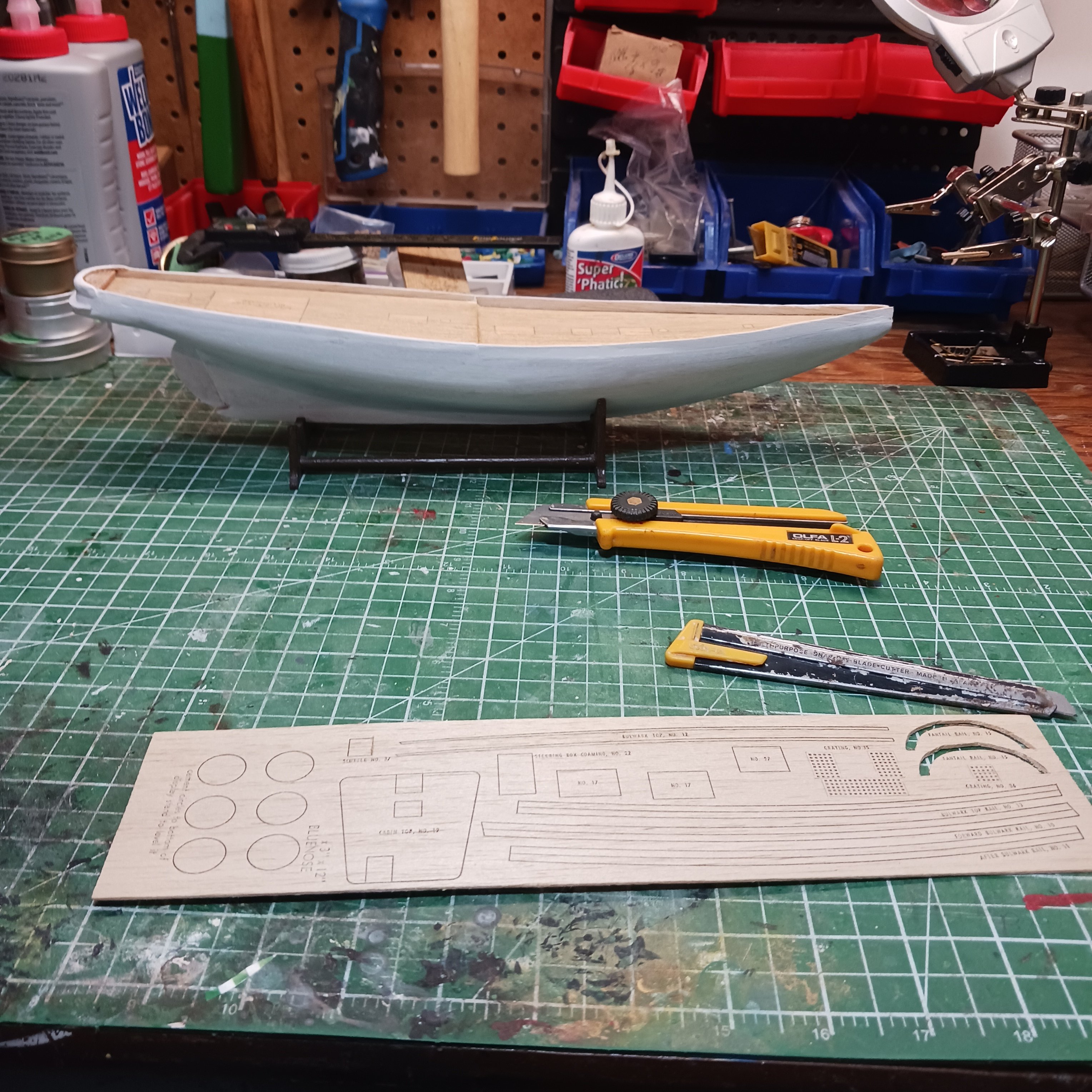

The first coat of filler was applied  last night. This morning  ,I  sanded it and gave it a coat of primer. I just brush on the frist primer as I know more filling  then a spray coat  of primer later, when she just about ready for the final  coat, but lots to do before then.
So letting  the primer  dry  I will cut and number all the parts.some look pretty  tiny.
I find the bigger  ofla knive works better than the smaller one.
 Lots of filling and sanding to go but loving  every  moment  of the build. There are a lot of Bluenose  logs here on MSW so I should not have any problems that's can't be solved by looking at them

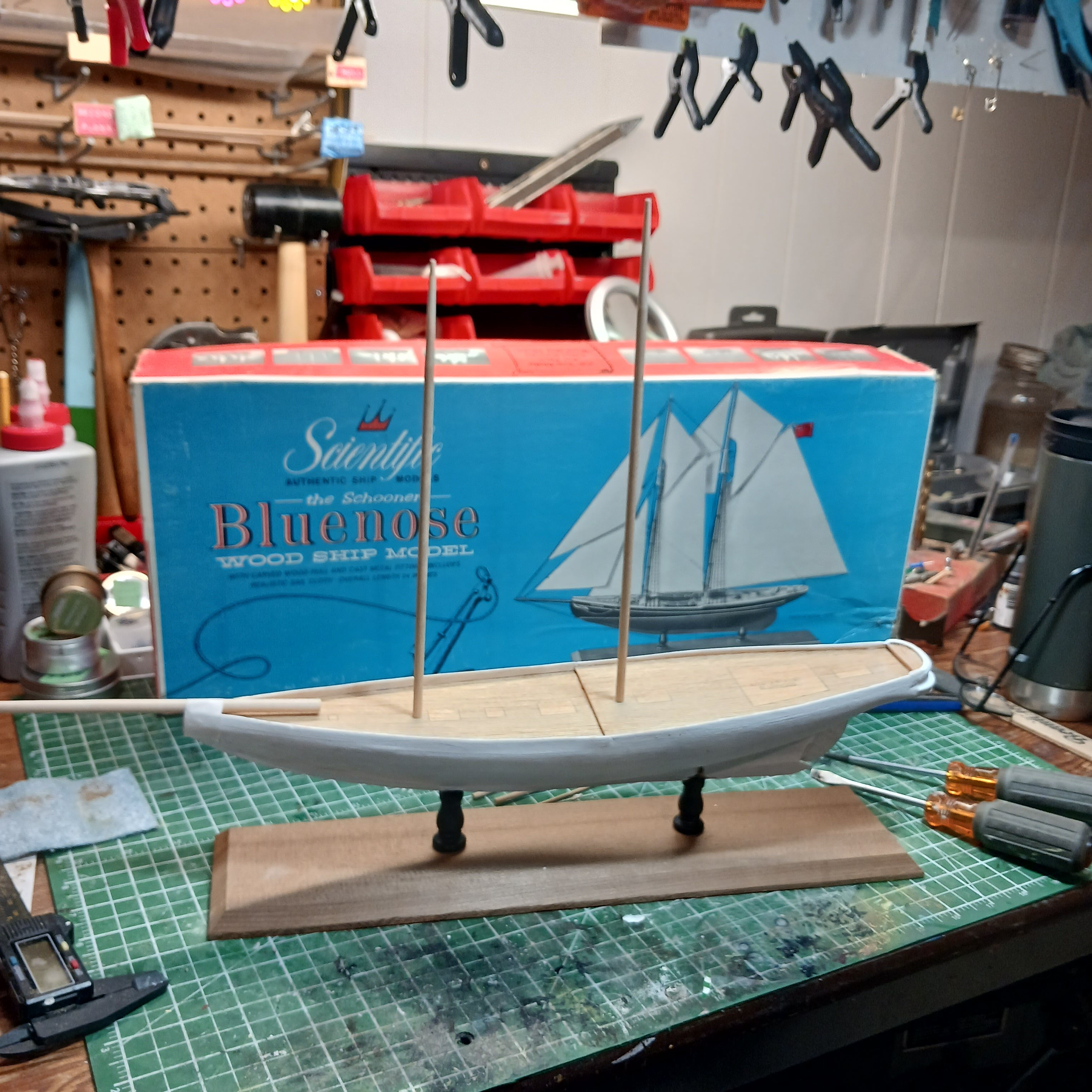

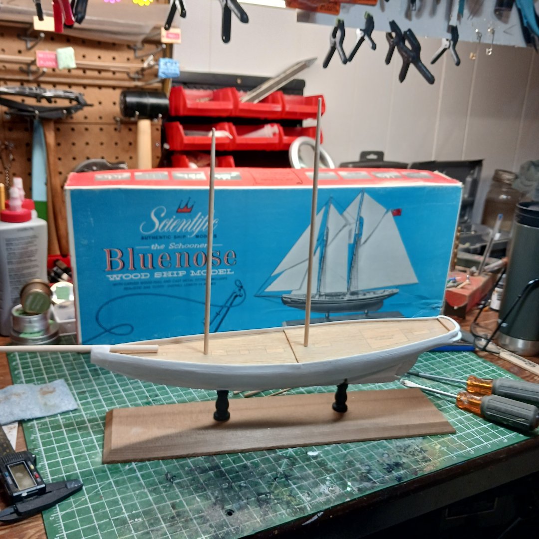

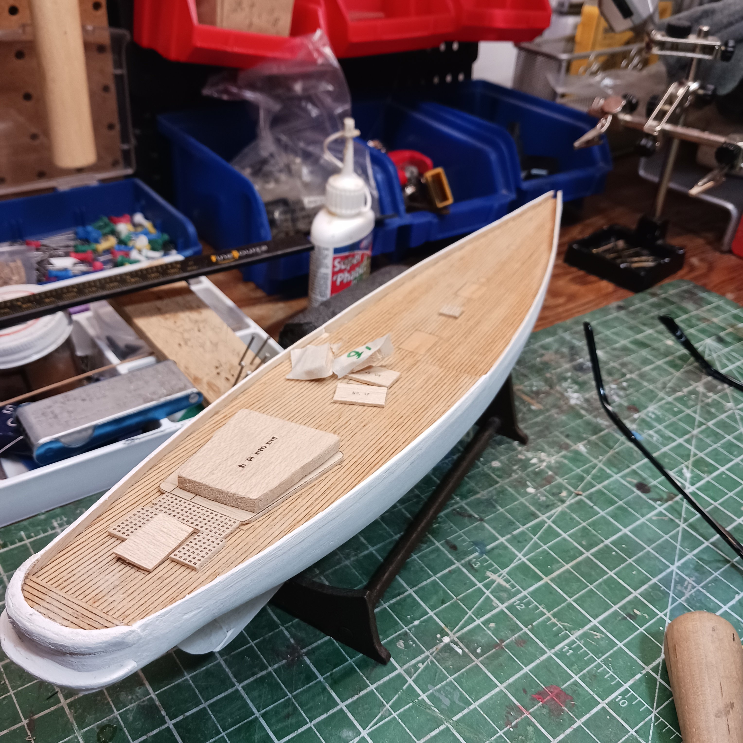

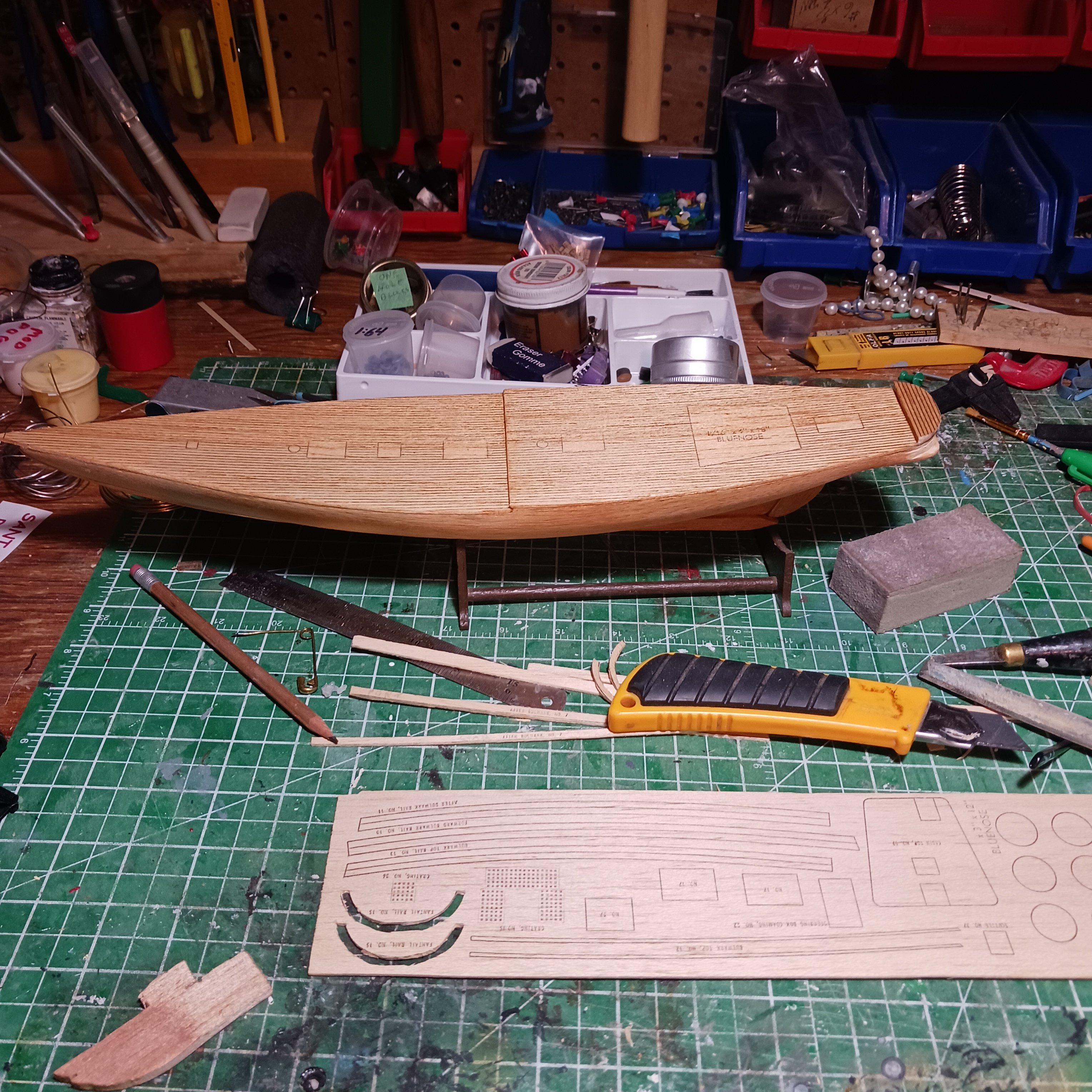

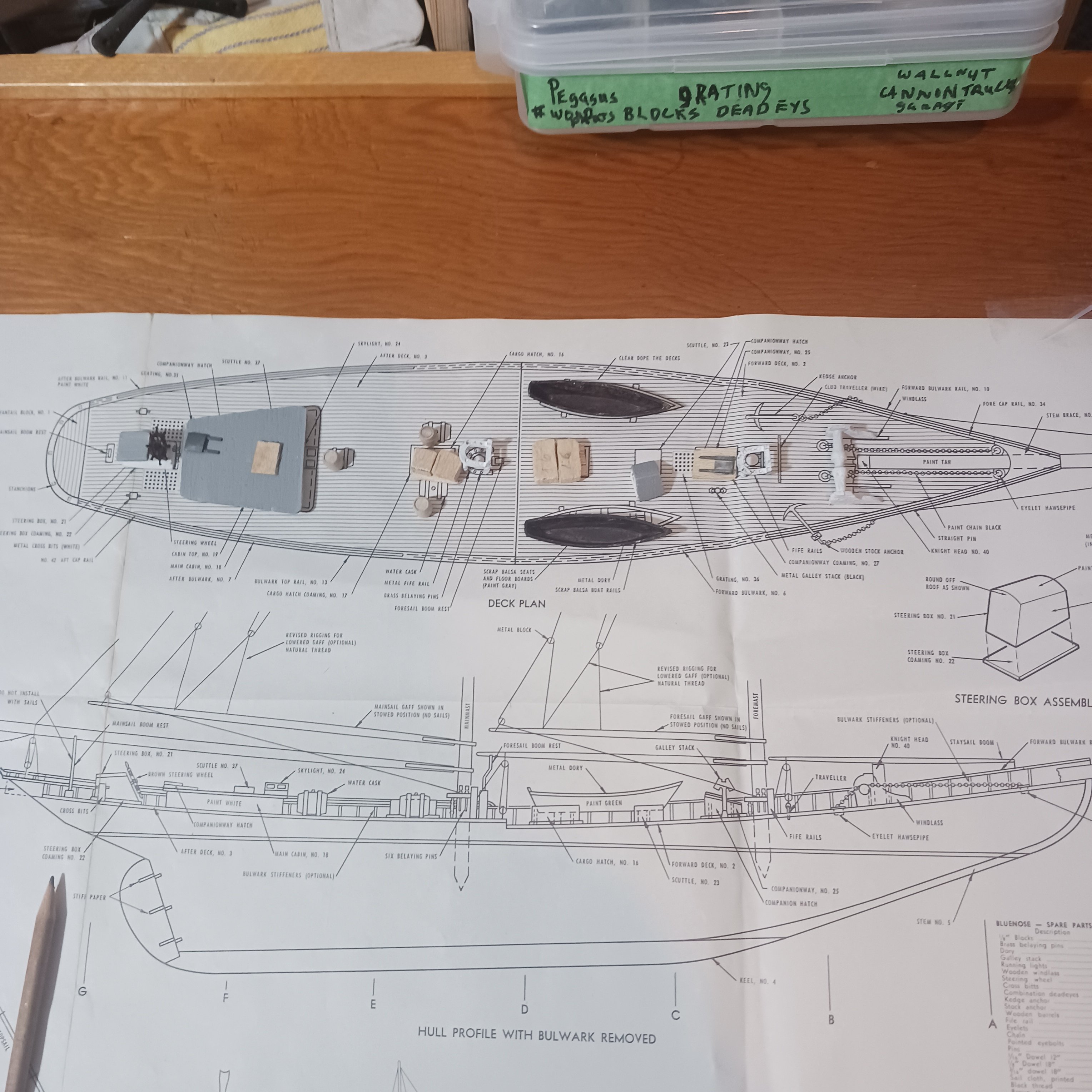

Yesterday I  cut all the pieces  out and numbered  them.
Then started placing the pieces on but not glued down
Soon ll the deck parts were placed then put away for later.20250627_131457.thumb.jpg.090e2e6fa78cfc3267fa114f3f8b8a2d.jpg

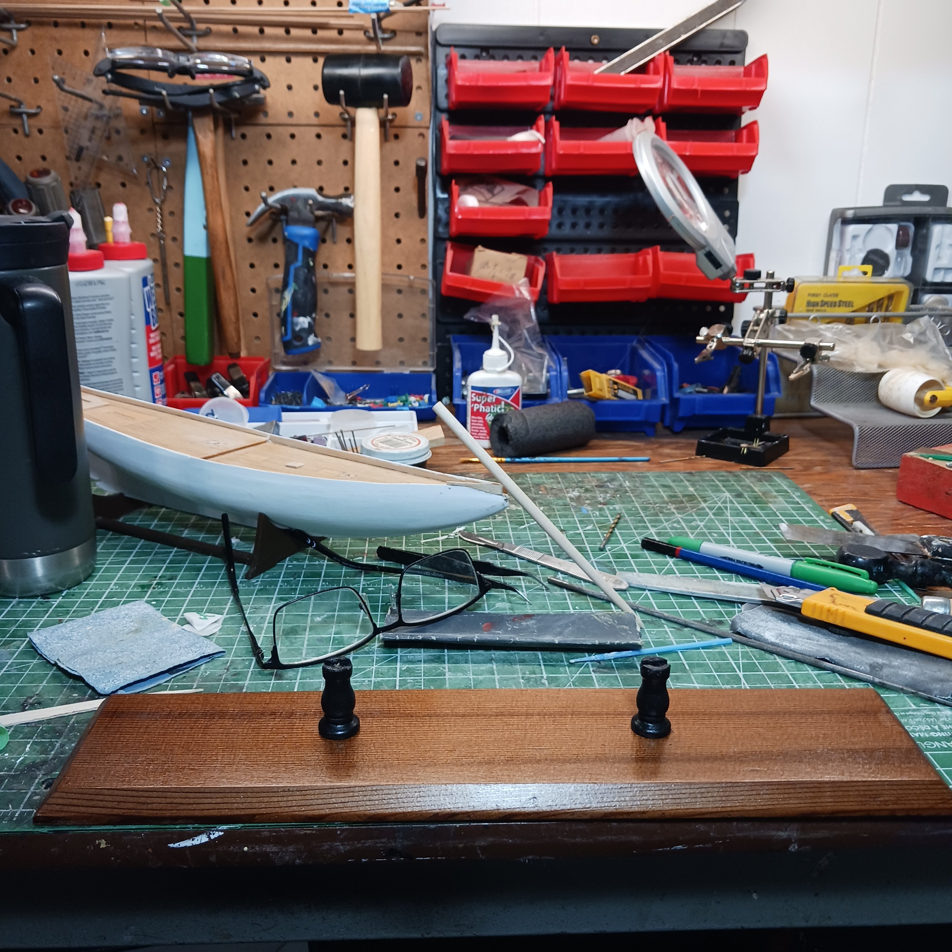

I made and attached  the stand, I figured  if I attached  it now then take it off ,I could repair any damages if needed , yes they were needed lol.
Here is my stand waiting for the final installment.
Coming  together,  time to get ready to paint .:D. A few more things to look after then I will start by painting  the black first.

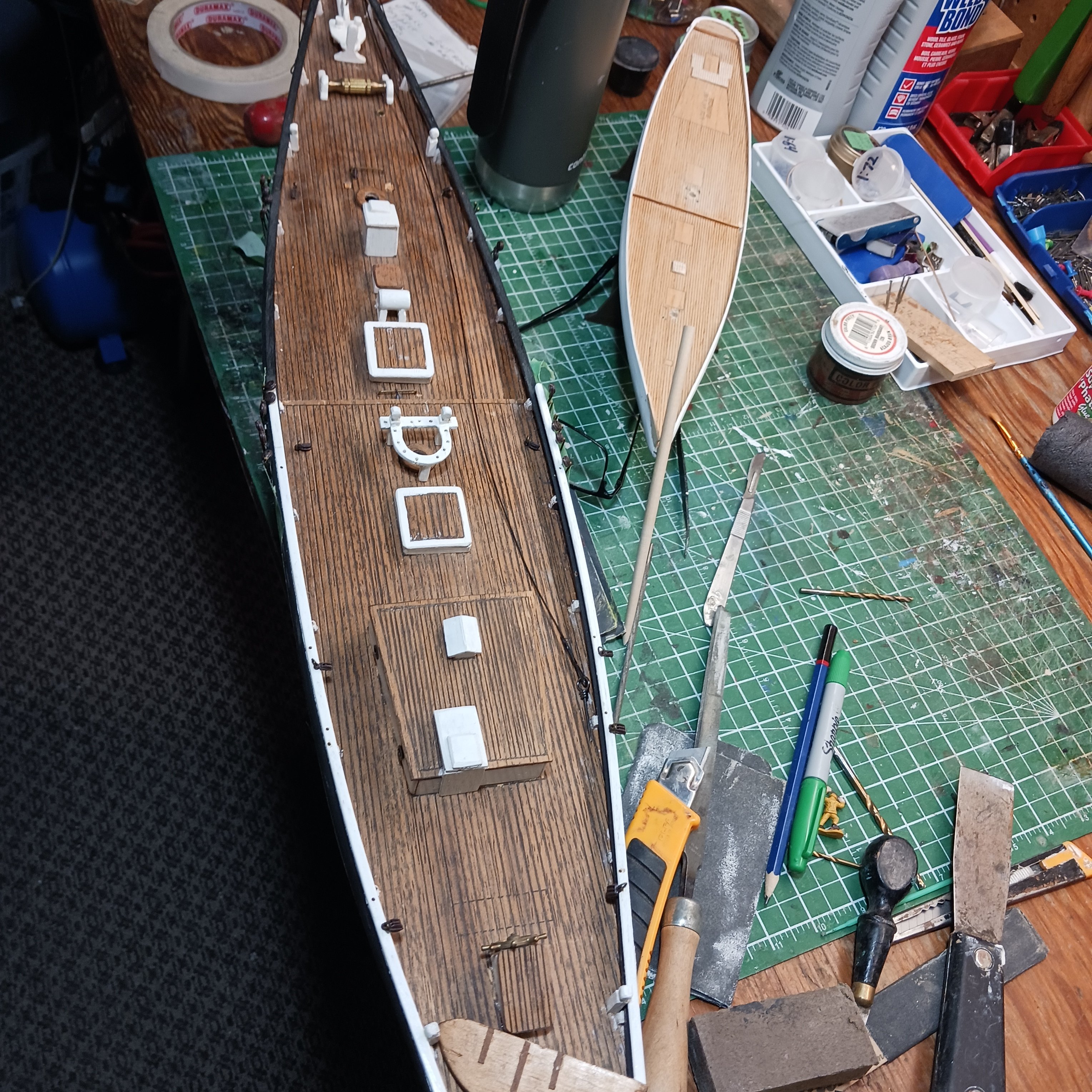

Most of deck furniture  is installed, everything  needs repainting
The Billings Boat hull is finished  like I say, just repainting  what is there ,it  is Rodney's  work and  I will leave it as is.
Once the  black is done both ships will be sprayed.

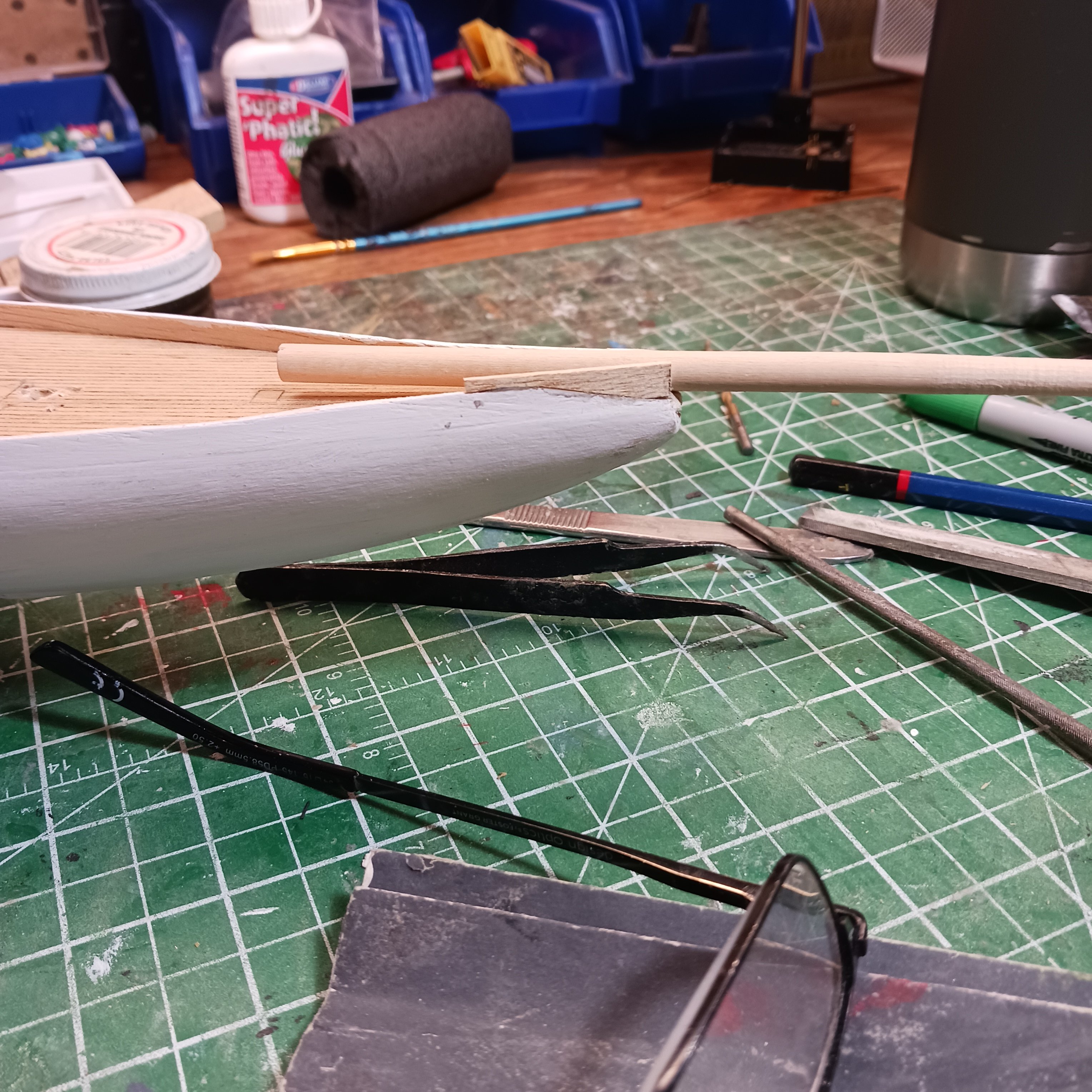

 I have a bit of a fix to do on the dreaded bow spirit mast,  it starting all ready lol, at @Keith Black erging  a nose guard  will be made very shortly, lol, I  will not breaking this one of 4 or 5 times.:D
It is an eazy  fix, once done the black on both ships.will start.

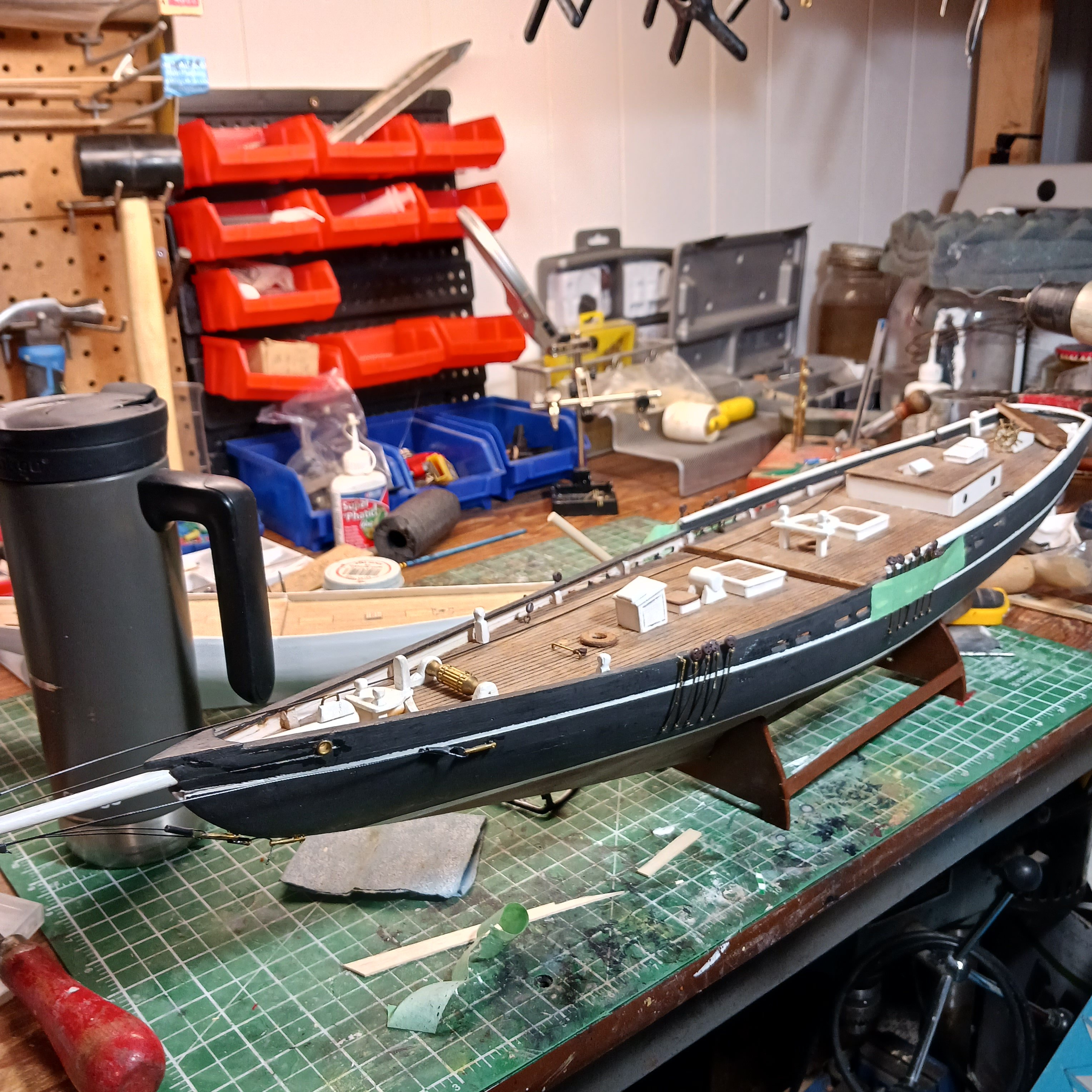

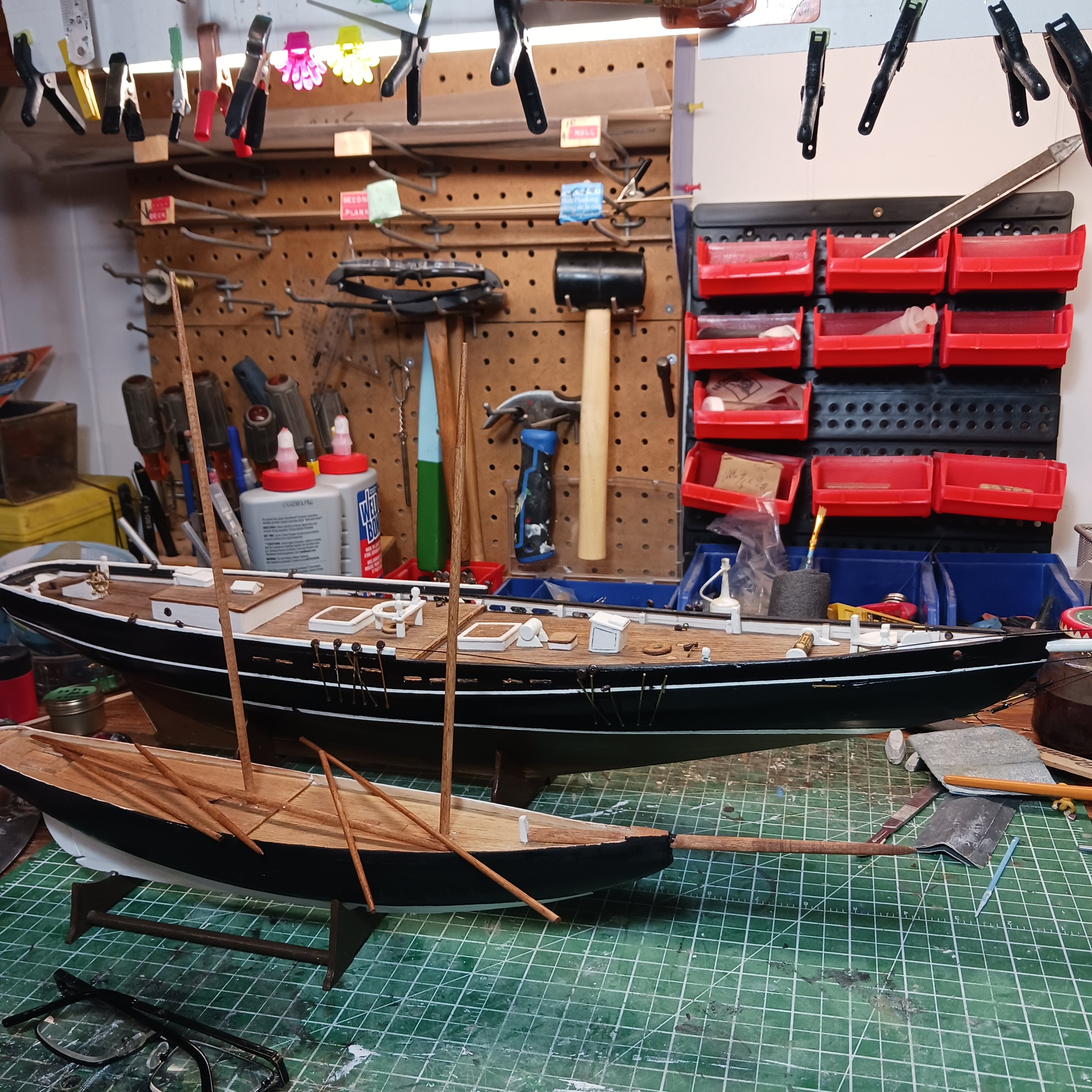

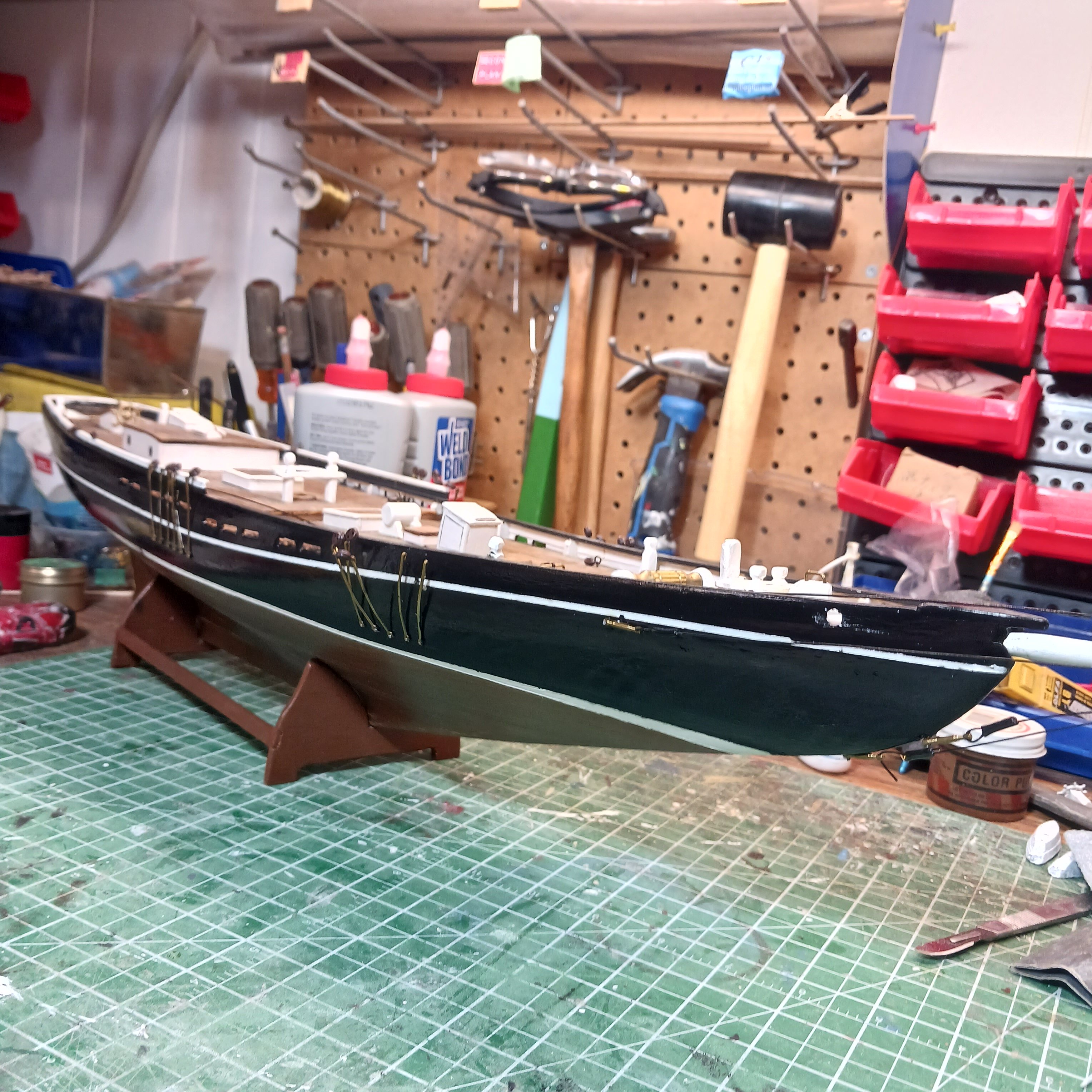

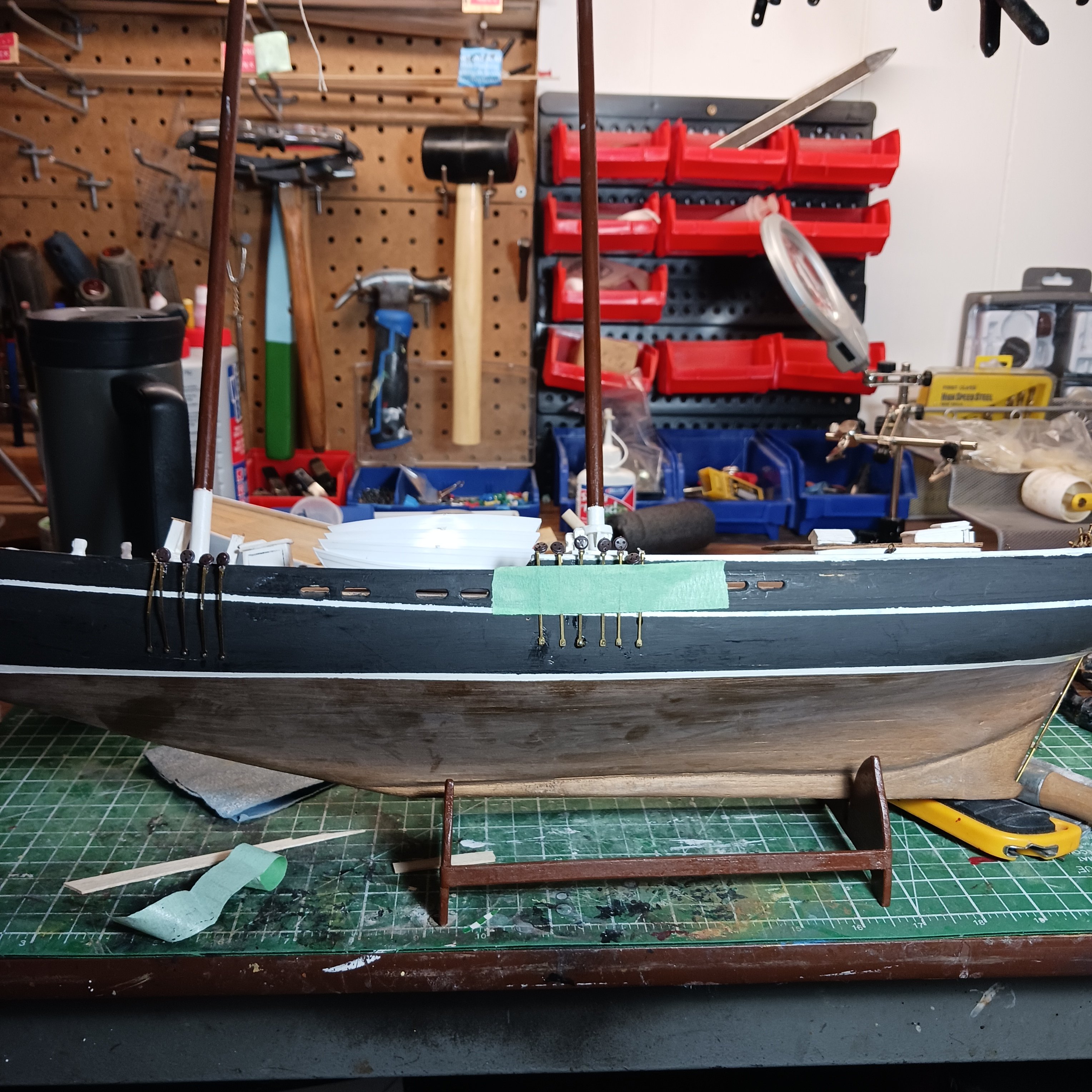

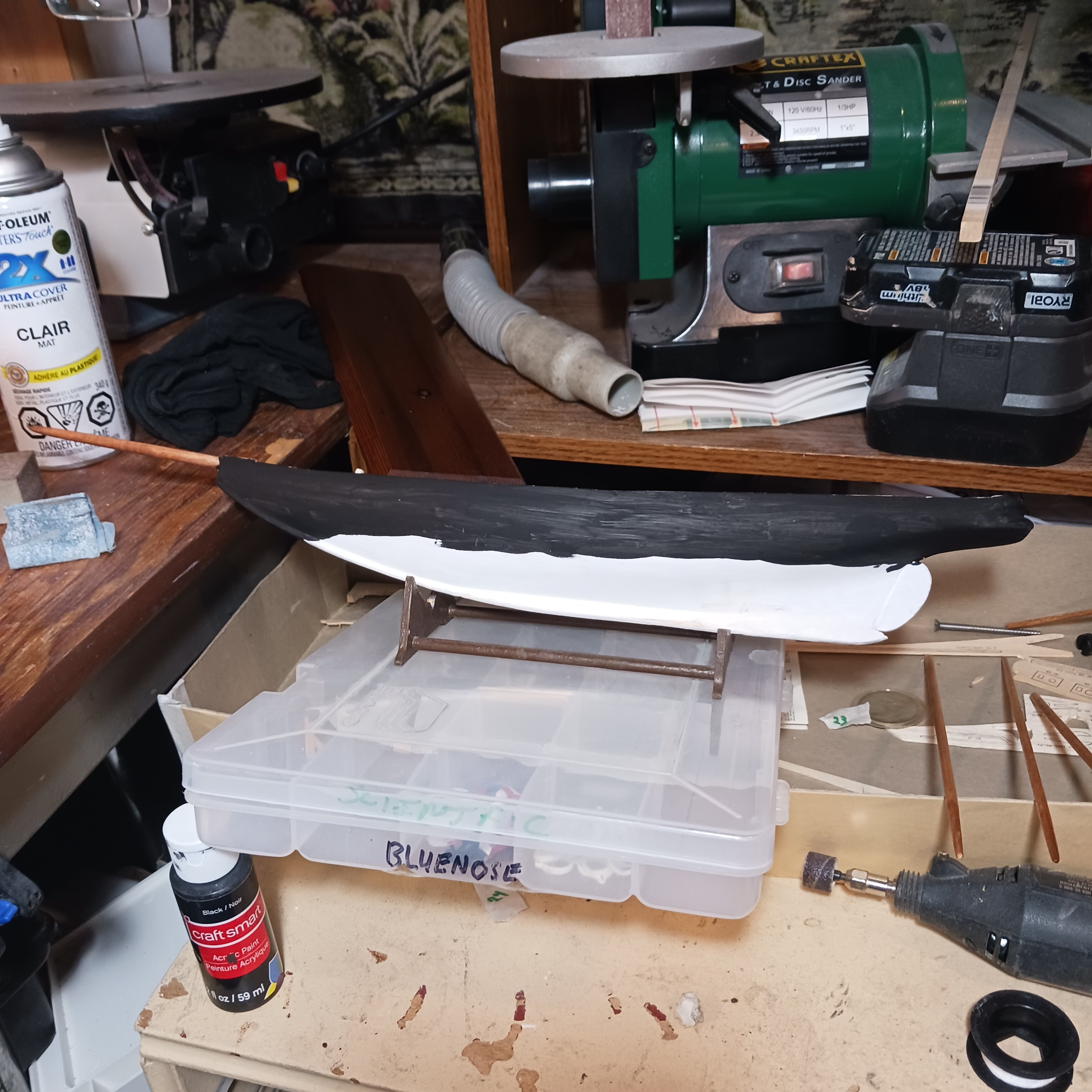

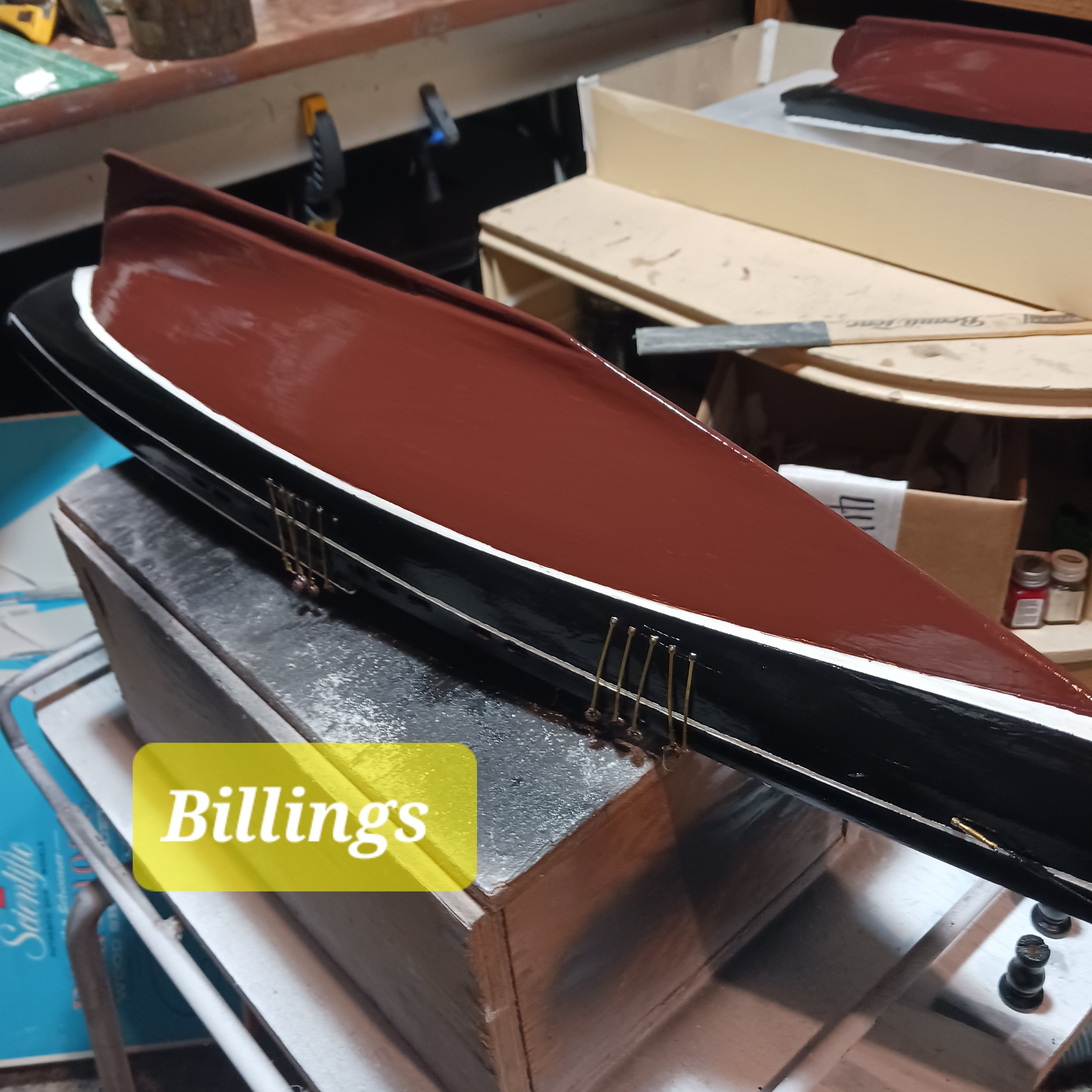

 So painting  is going full out today. Starting  with the Billings,  repainted  the black and applied  a clear coat.20250628_142330.thumb.jpg.36e7a48885104e55e5638d1094e1548a.jpg
The Scientific  is still in the paint shop waiting for second  coat on the black,  then clear coat,  after that I going to leave it for a few days to really  dry up. They is lots of deck things to make and paint.
Once the black is done and the copper color is finished on both ,I think I will rig the Billings Boat frist,  then the Scientific.
Rodney  has tray full of blocks, deadeyes, one hole blocks Up to four hole blocks  . These blocks  are way better  than the ones in the Scientific,  so I use then for it after , I am sure I will have lots left.
 Back to the paint shop, rudder  repairs on the BB. the SM. Is good to go , this is so exciting,  the spray gun is warming up, as soon as I read the instructions  lol.

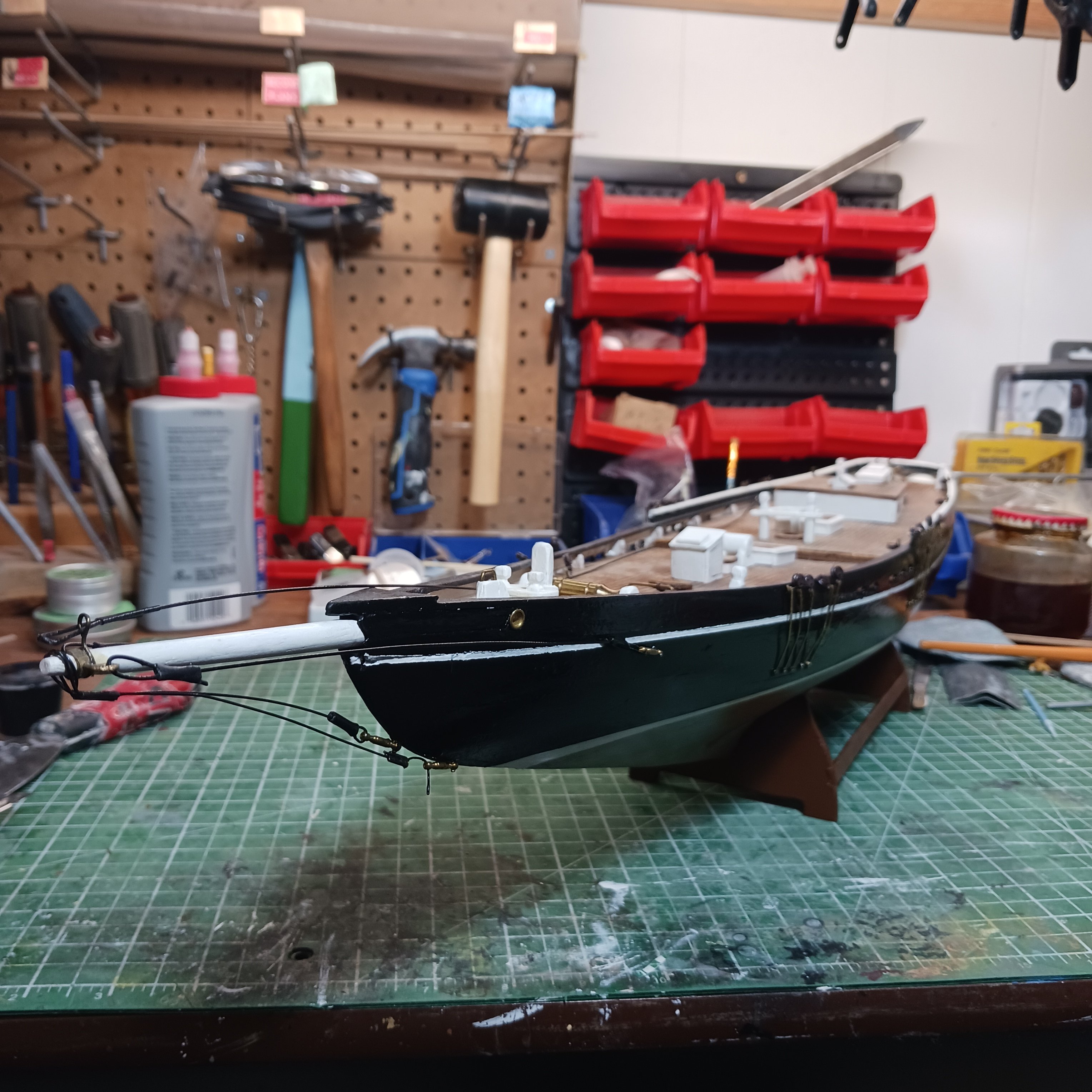

The ship's are back from the paint shop, so far I am really happy with the work.
I thought today I would spray the copper hull red  from Tamiya Color, but decided to wait  till Monday to give it more time to dry.
I will  put the cap rails on the SB, and paint them white  Rodney  has  the cap rail white on the stern and black on the forward  one. The SB has them all white, I don't  know which  is right, but I will look into it and make them the same.  Another difference  os the Bowsprit mast,  white on the BB but stain light brown on the SB.
  Oh well they will look good when sprayed.
So I will start to put the deck furniture together,  the Billings Boat  needs a few grates put in and all the pieces  repainted white and the Scientific Bluenose  has to be made and painted ,so lots of fun stuff to do. And I can start work on the masts as well.  Thanks for the likes and incouragement  as I journey  on.   :cheers:       Knocklouder

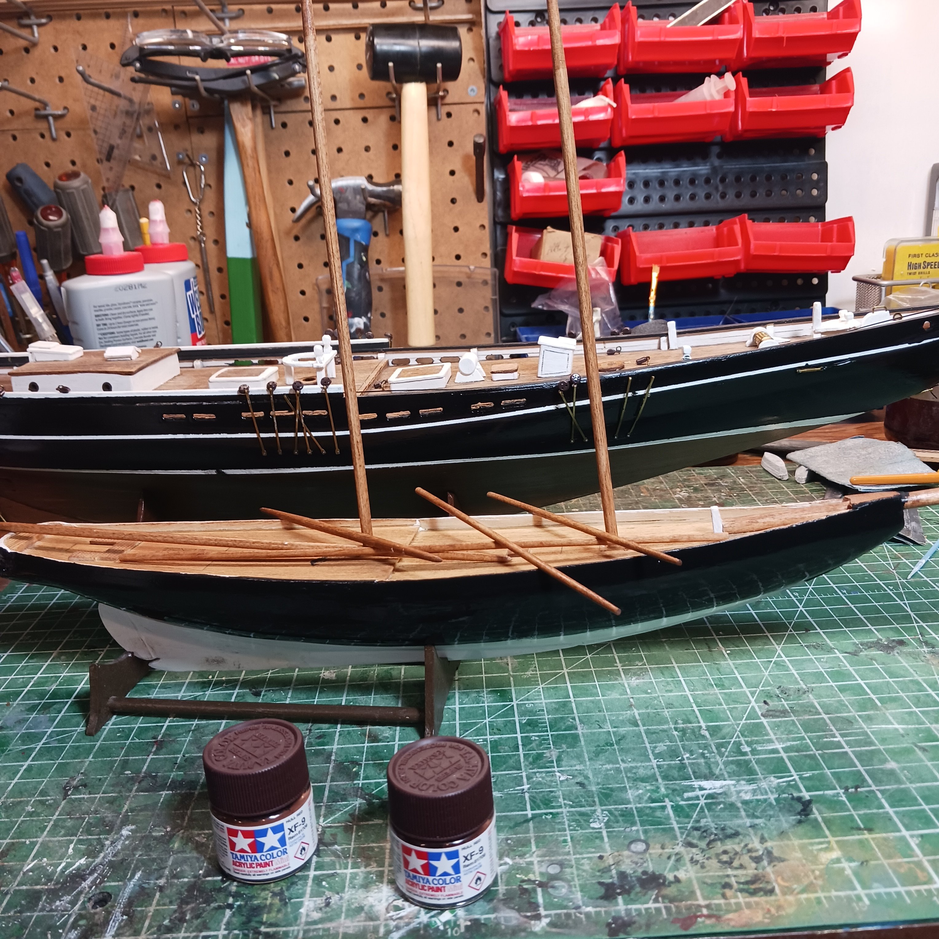

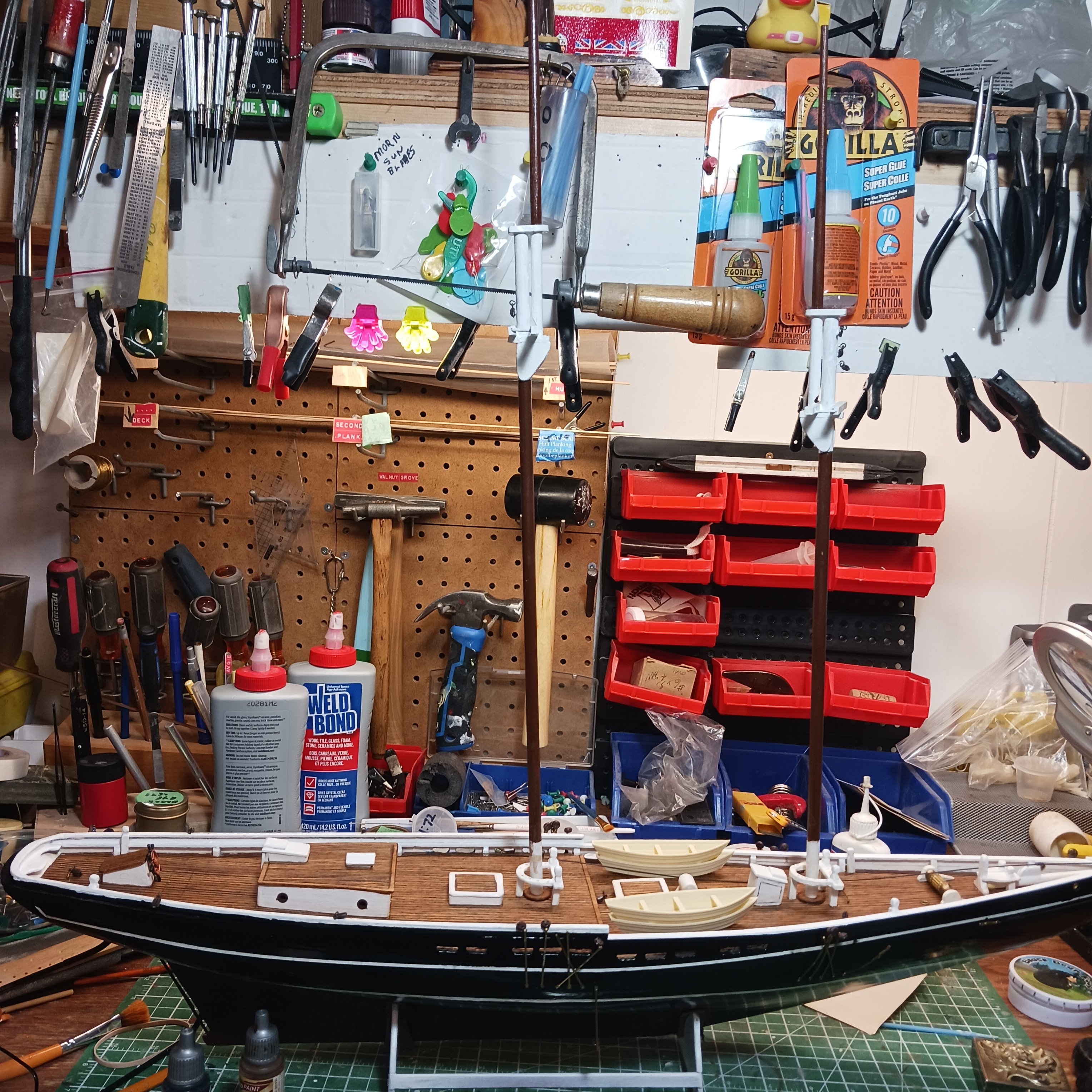

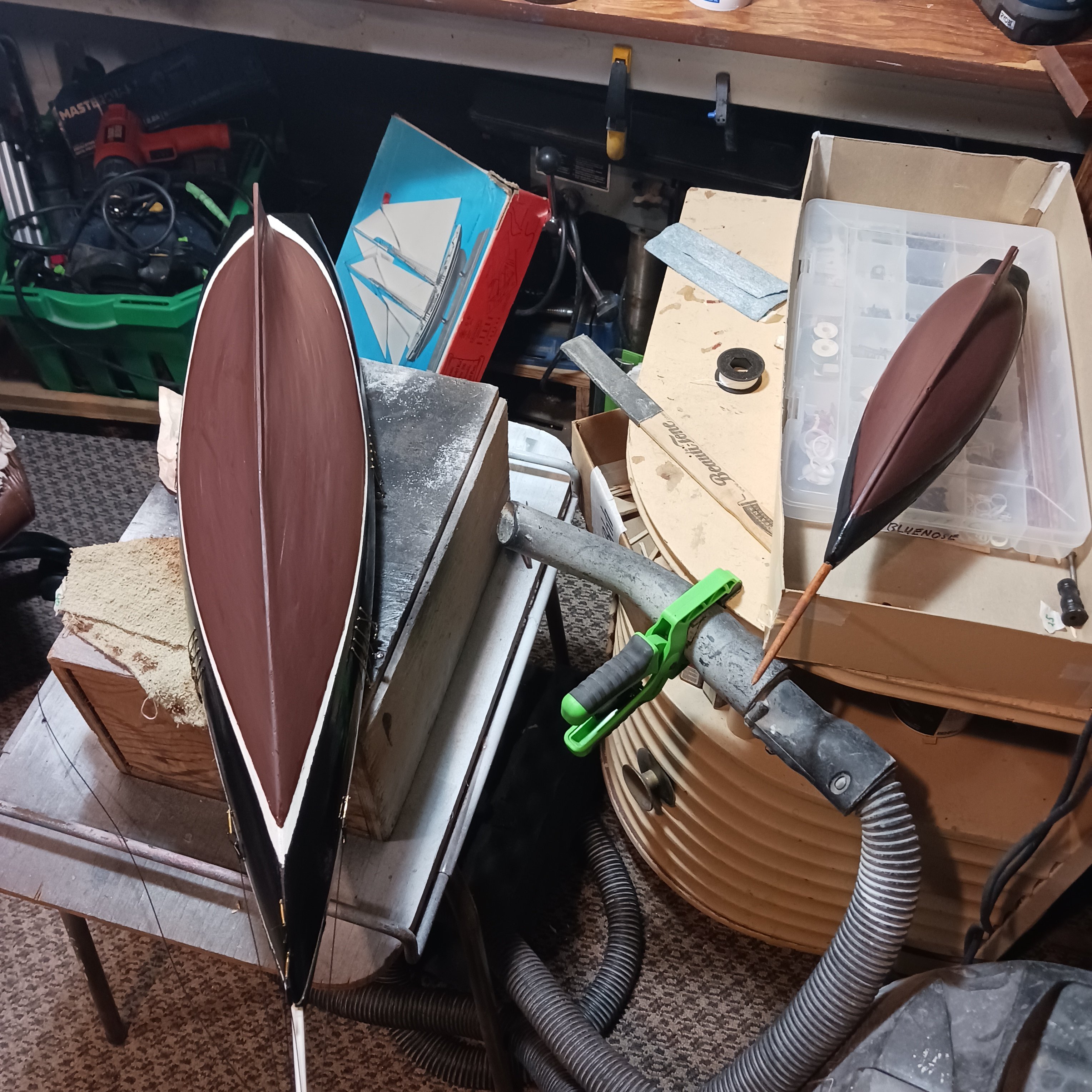

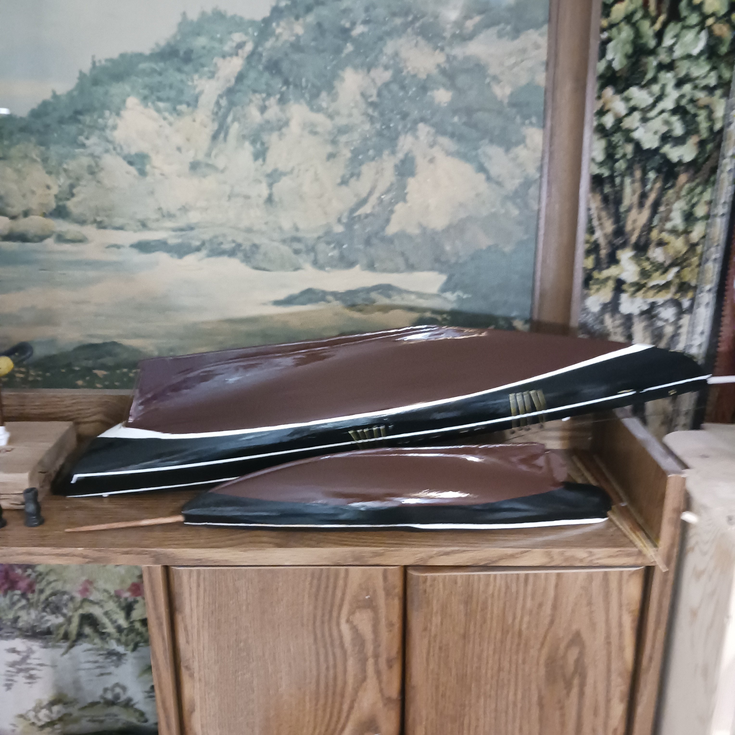

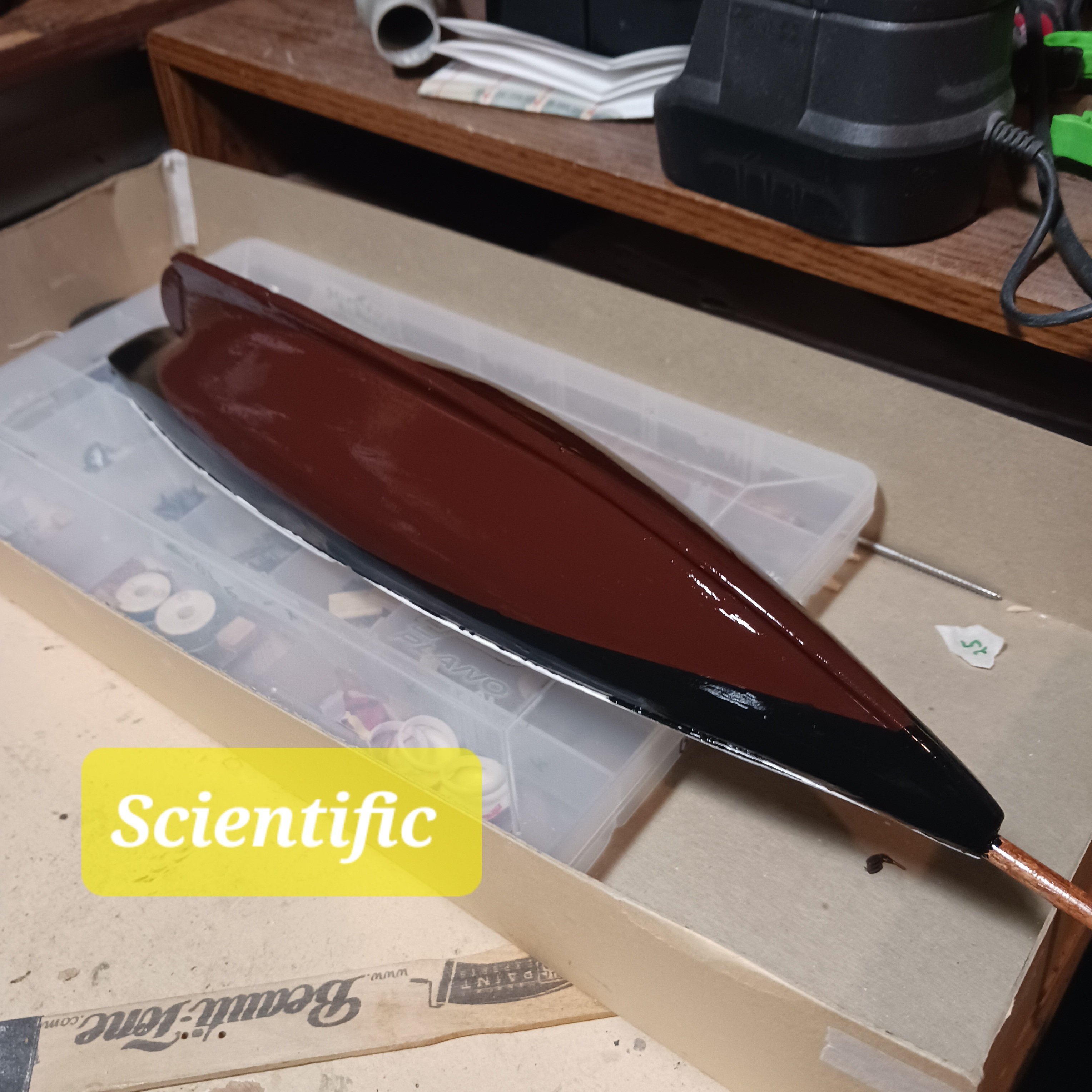

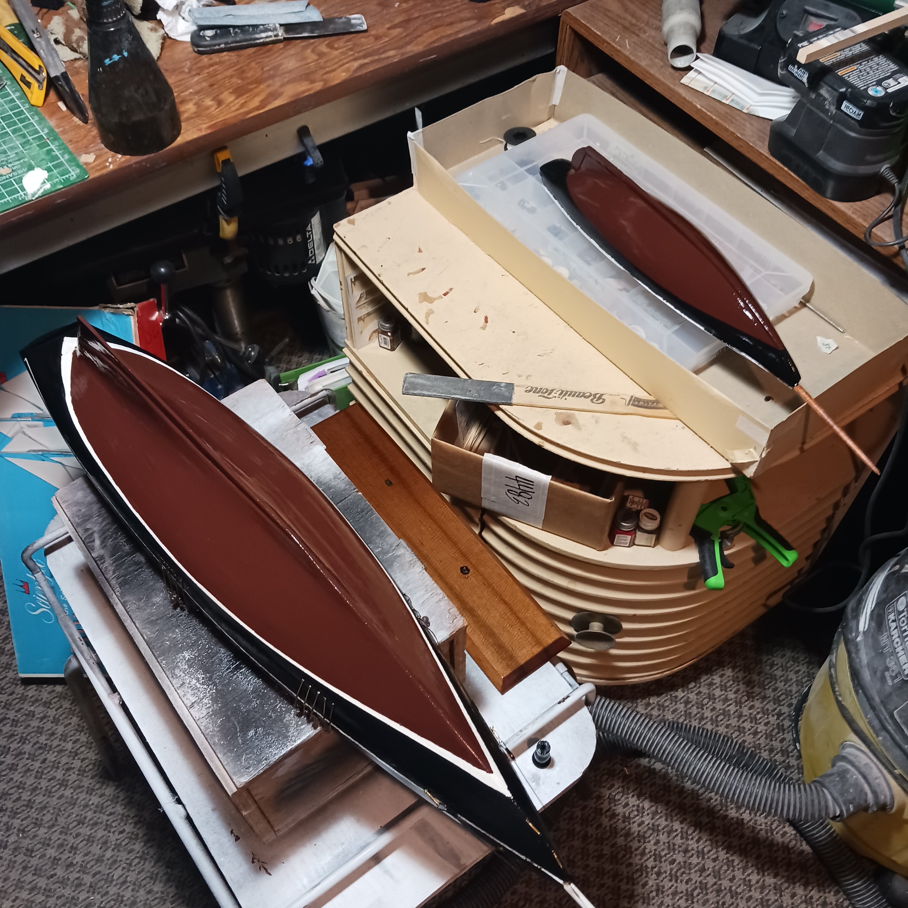

Well the hulls are painted and they really look good to me. My only complaint  is the color,  I used Hull red from Tamiya ,instead of Copper Hull Red from Model Expo, Me does not ship to Canada, Pity.  Lol
It is a little  browner  then I  wanted but, It will do. :D. The paint is excellent,  it the first time I used  that brand, it flows really  nice.
Here they areright out of the paint shop.
I labeled  them so you can tell the difference  between the little  Scientific Bluenose and  the larger  Billings Boat,  lol.
Then I put them up on the self so they could dry for several days, before  touching them.
Most of the deck furniture  on the Billings Boat is made up, just going to repaint them, all the deck furniture  has to be made for the Scientific Bluenose,  plus I will start on the masts for both ships, so I have plenty  to do and the longer you let the hulls dry the better.
 I will repaint both cap rails on both ship white,   Rodney  painted his Bowsprit mast  white so I see how eazy it is to sand it off and stain it brown. He also painted  his mast a darker brown but I will change  it to a lighter wood color  later.

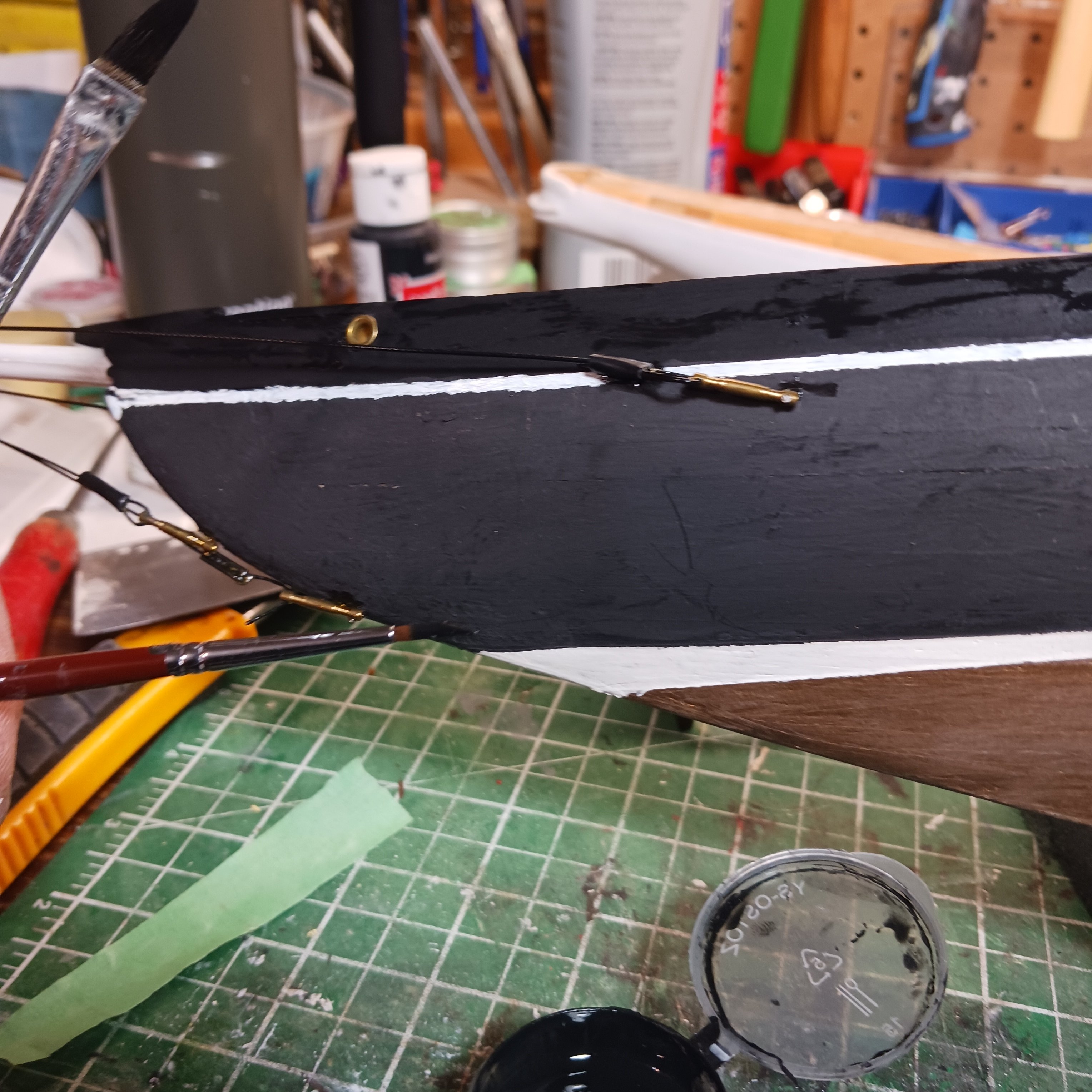

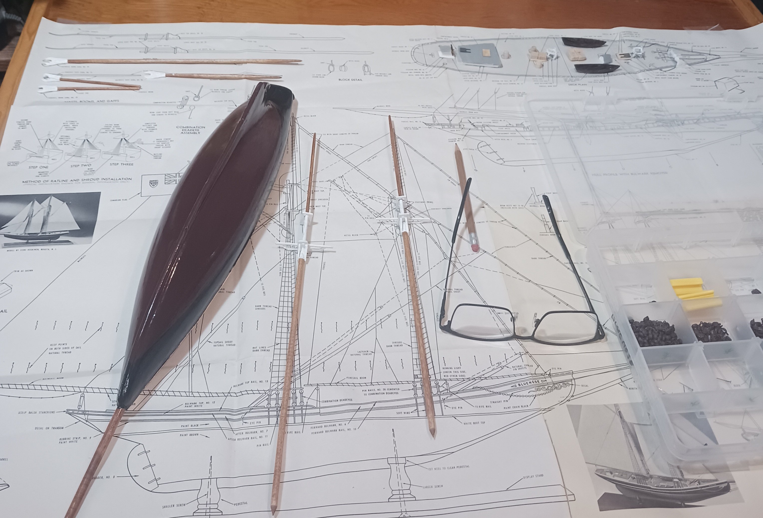

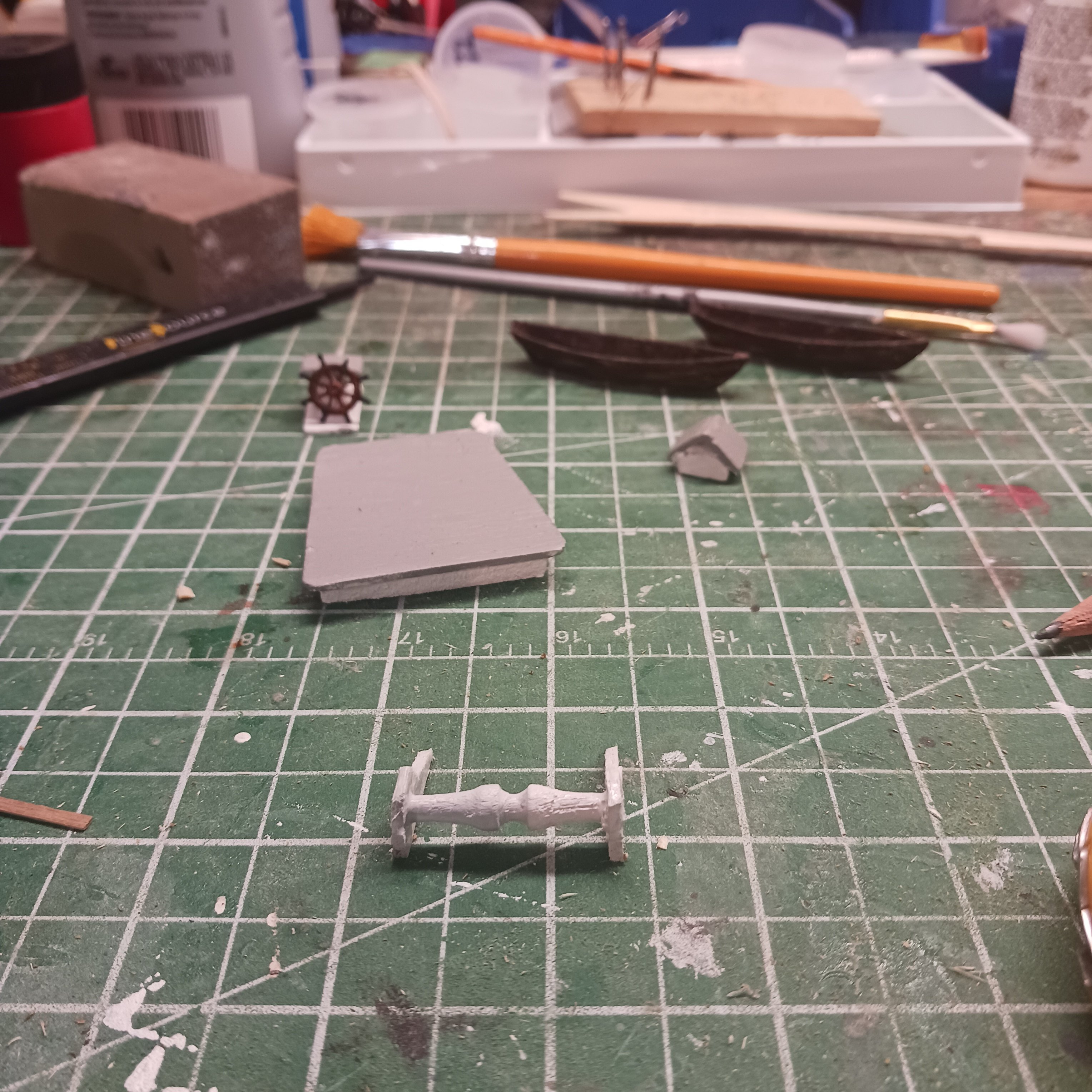

Work continues on the deck furniture , I will change the color  of the dories though the plan say green on the out side and tan on the inside. Plus you have to use scrap balsa to make the stand and the boat rails, scratch building lol.
repair to the windlass are need, as well as to the  masts. The balsa wood is very brittle,  I had to cut new mast tops out of pear wood, the balsa just crumble in my had as I work on them.
I looked at Rodney's masts, I think I have to take them apart  to get  the rings on. That's a problem  for another day.

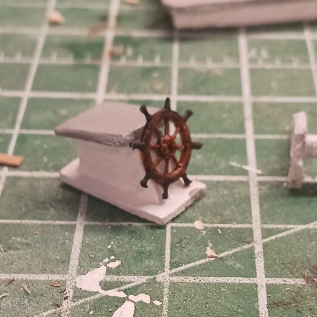

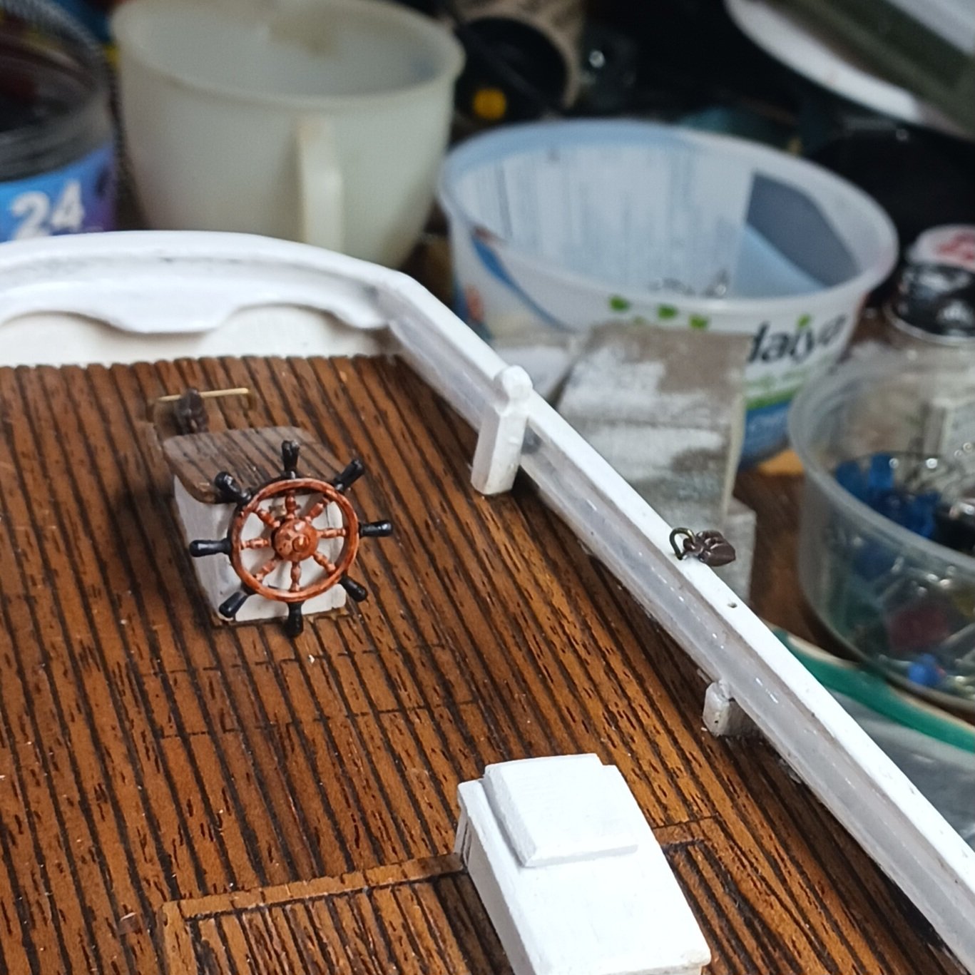

I like my little  ships wheel, it is not historical correct but it will do. I see Bluenose ships wheels that have a life perseveres on them, but that's a little  to detailed for me.
more fun tomorrow, dare I say I be doing ratlines  befor long :cheers:

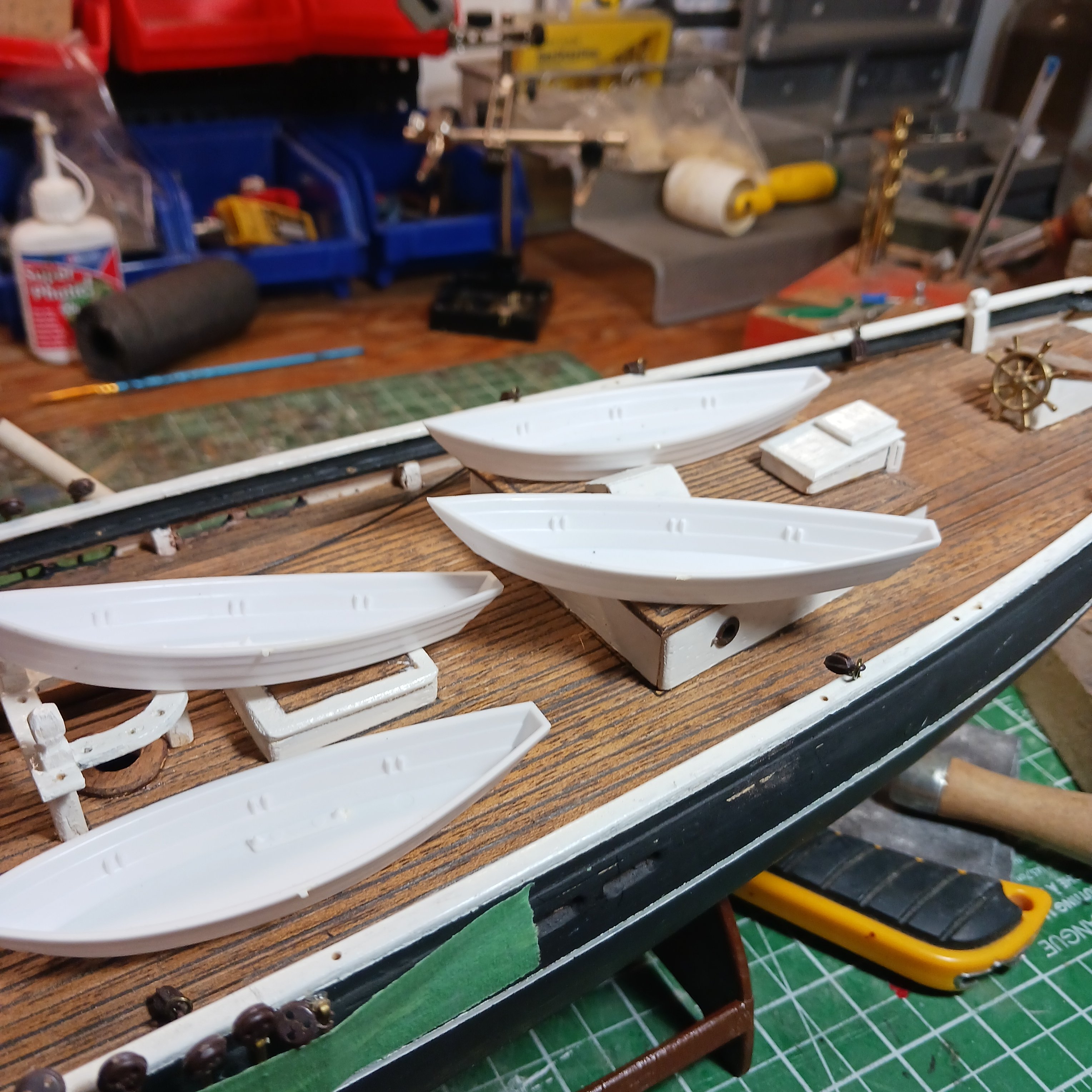

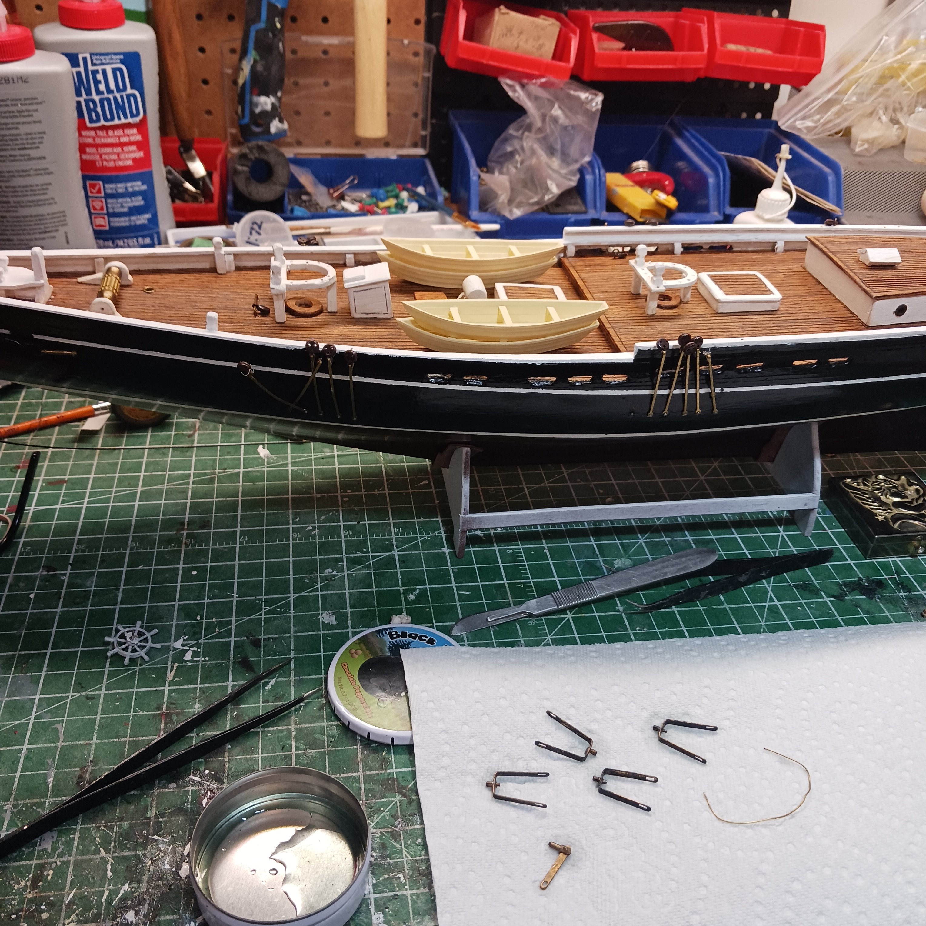

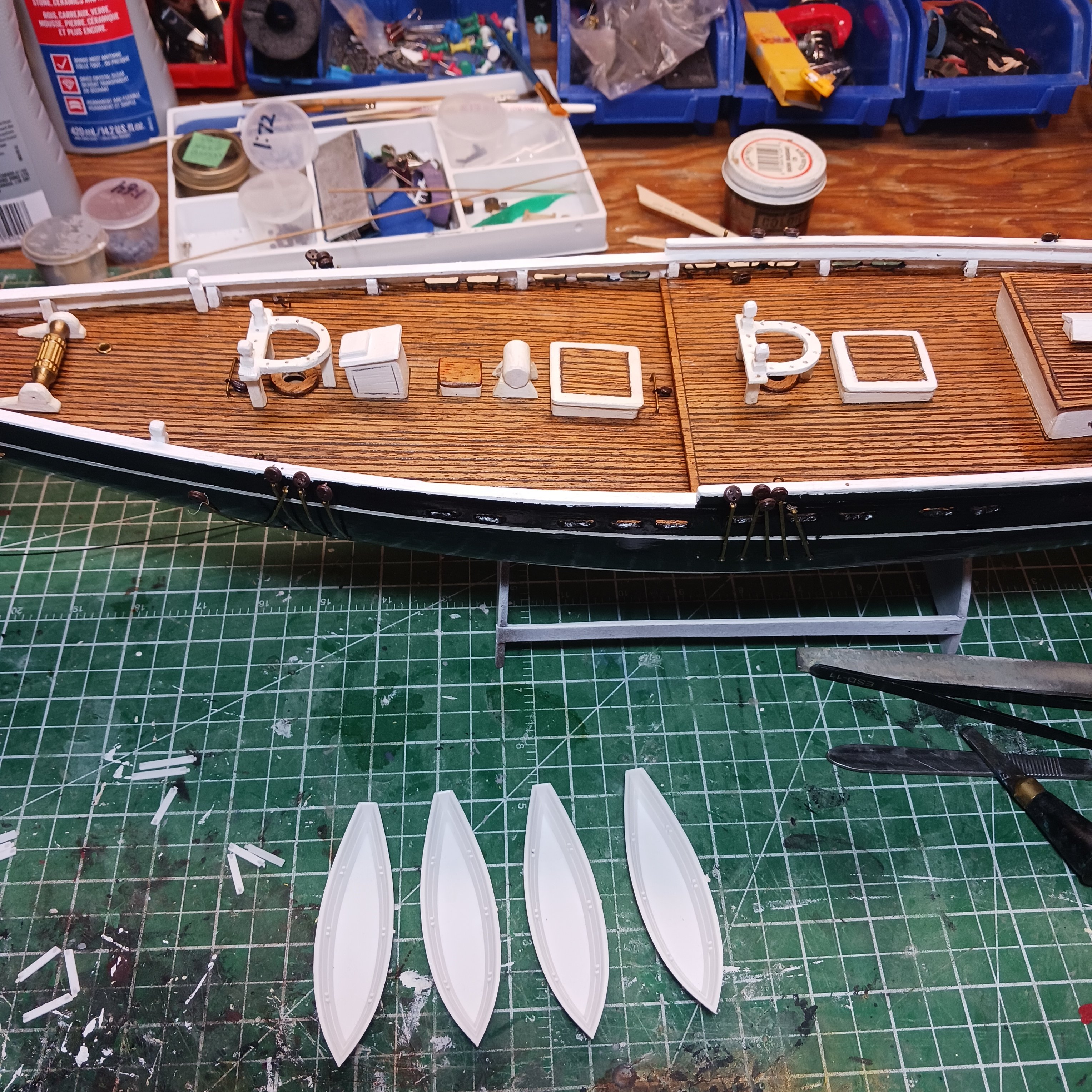

20250701_184744.thumb.jpg.40577cd629d4d8717c6bf565e7896259.jpgI made up these little dories, and painted  them up.20250701_221318.thumb.jpg.482214f927b8ca80c4a128560585a264.jpg

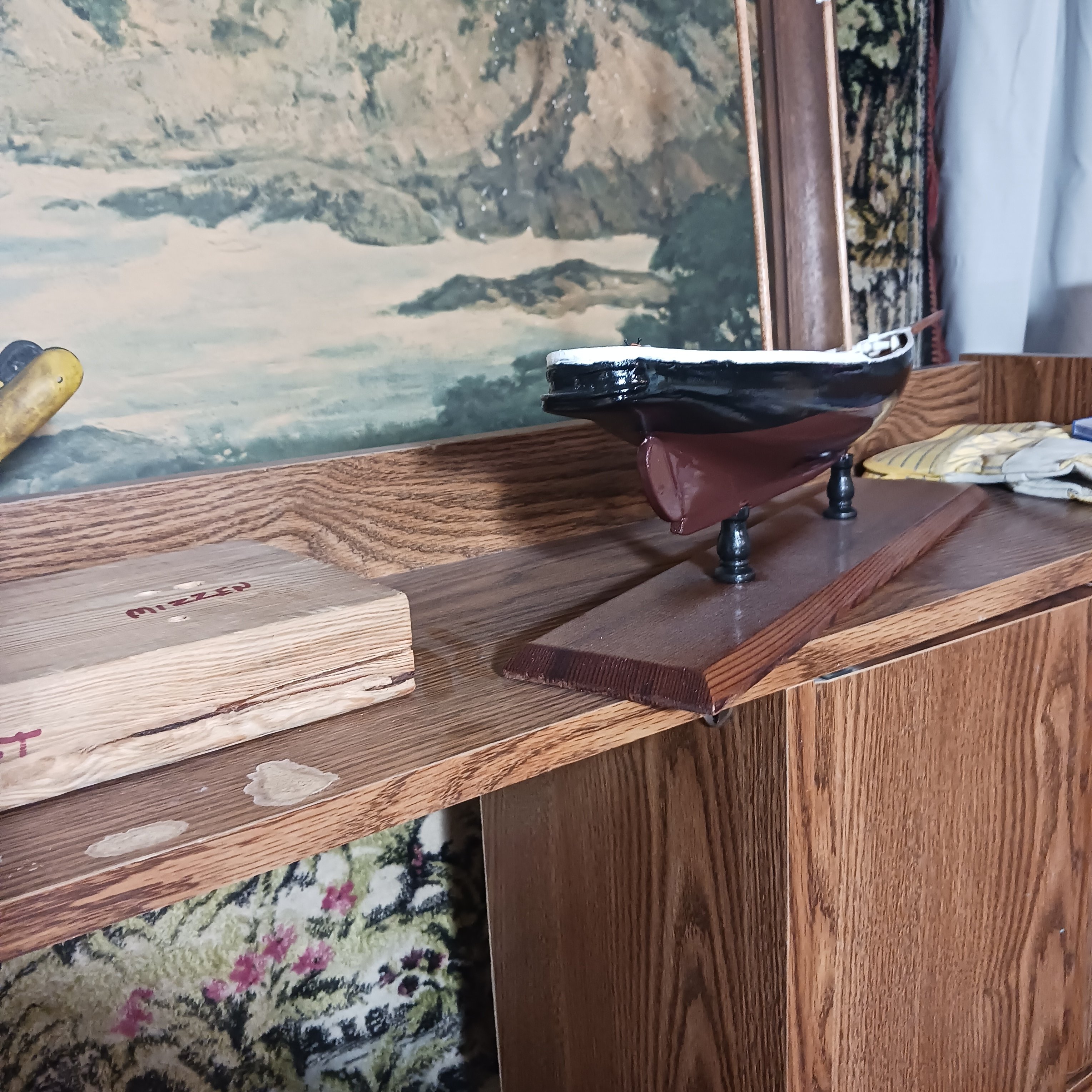

Next up was to put it on the stand, slite damage to the hull It is on the wall side so I may not fix it, only if I have to redo the clear coat for what ever reason  lol
The decal is old and is in three peices  but passable. Loving  the shine ,the Bluenose coin shows up really nice.
Double your fun , build  two ships in one lol. I put the Scientific Bluenose up on the self for awhile. Going to work on the Billings Boat today, repainting the deck furniture  as well as the deck.
Right after the deck is repainted,  I make up the dories for it, this one has four plastic  boats, it will be fun.

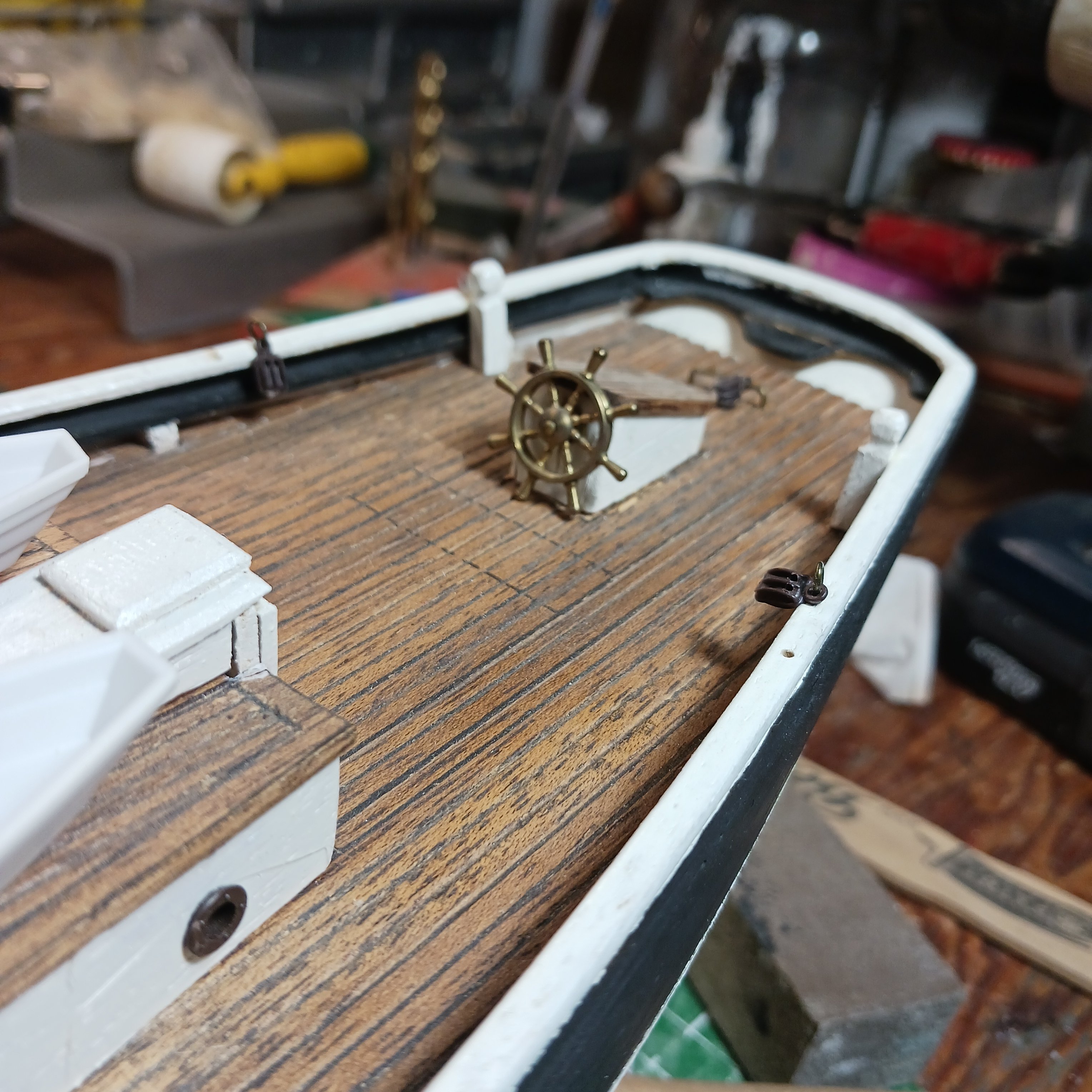

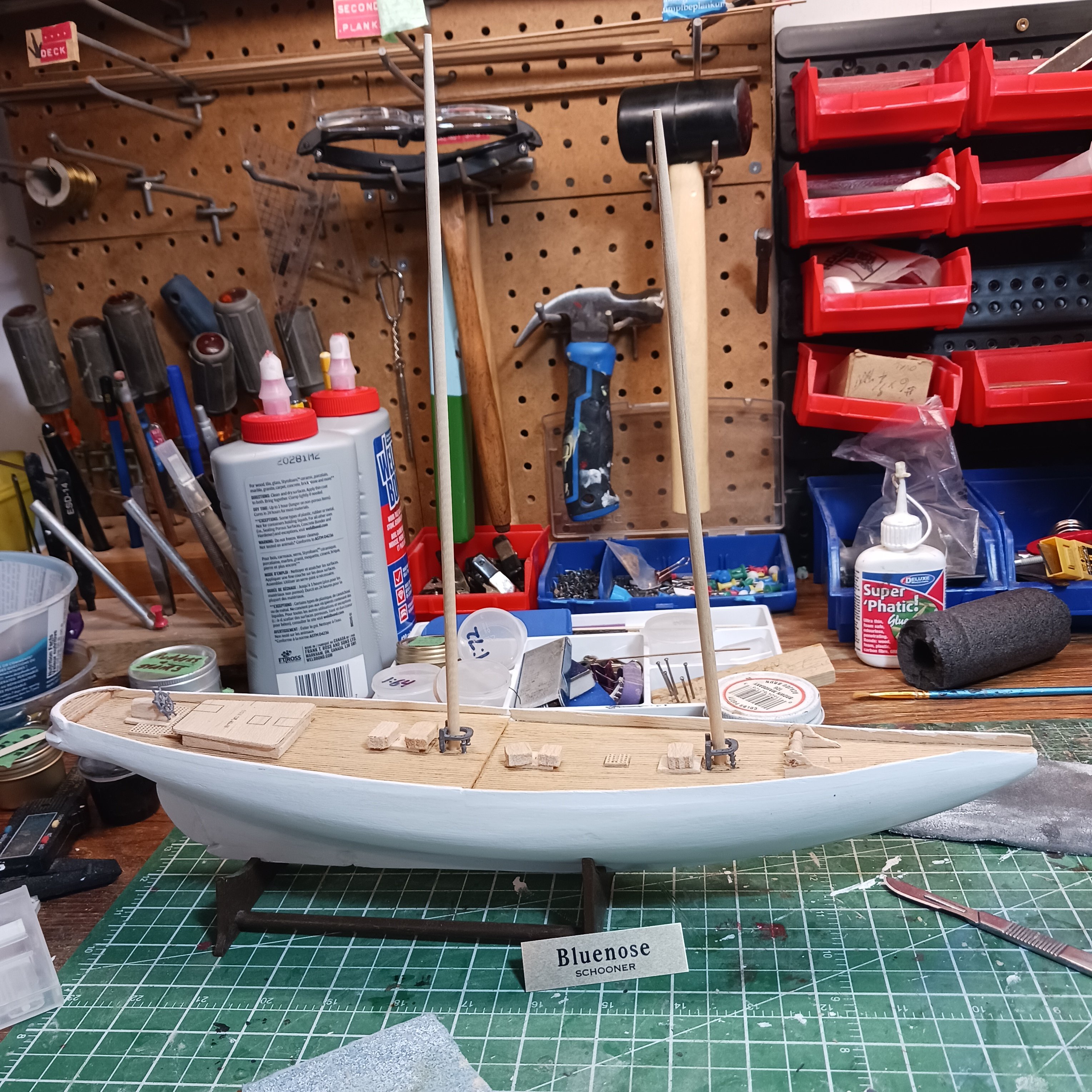

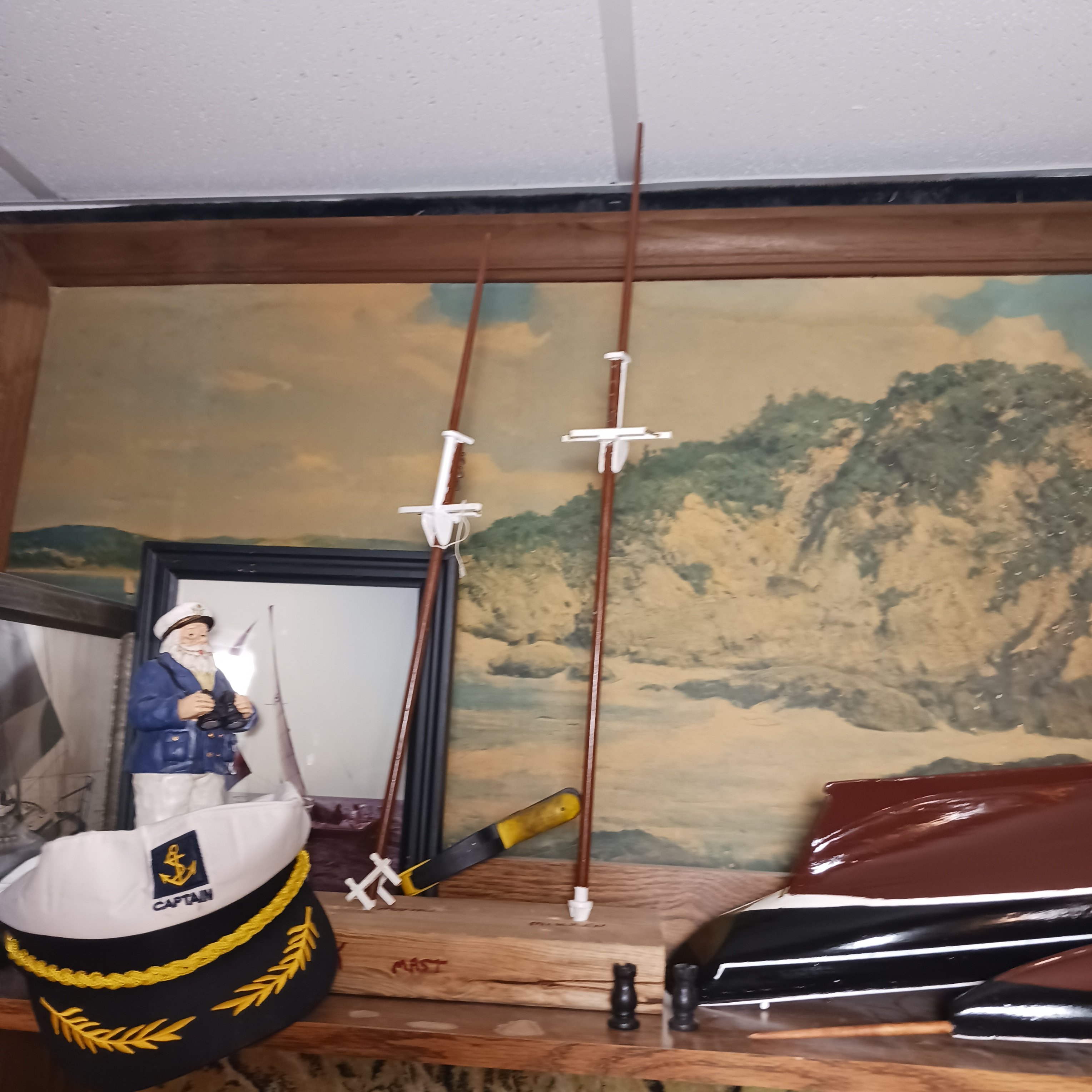

20250702_202426.thumb.jpg.e87ccbc249c4bee490500fa30fe50c69.jpg After advise from @John Ruy I peeled the decal off the back. He pointed  out that that decal was for the stand not the stern,  he showed me what he did so thats what I will do.20250702_150449.thumb.jpg.a5ff727e3834c04fae53582641680b2e.jpg
Looking  to my left I see this big picture  of a Dory,  so I says make them look like this. I painted  them all the same, will trim them  tomorrow. 20250702_191224.thumb.jpg.f13ee7b1b8221dfd1b956e0e5ed601cf.jpg
I had to change the look of my ships wheel, I like this.
I blacken a few things and a wire for the ship's bell. The masts have all the holes for the blocks  drill in  . I want to put another  coat of white paint on the mast tomorrow,  then attach the  blocks and brackets, then they should be ready to set them in place.

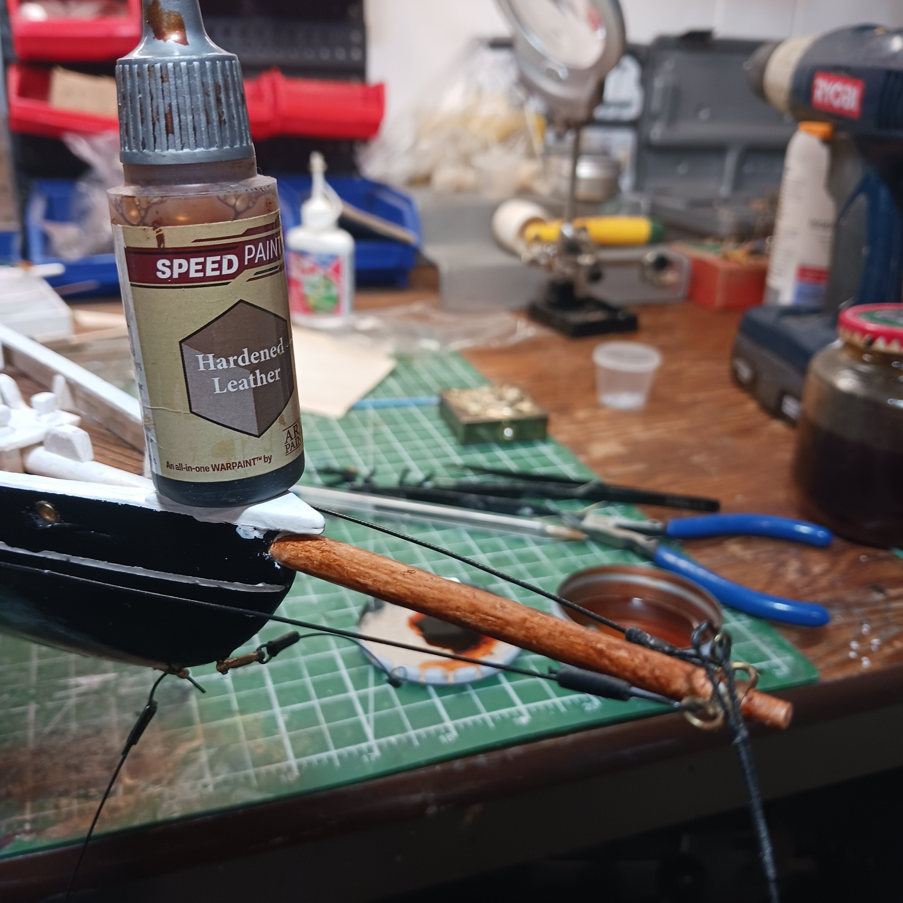

This picture  is the same as the last picture, 20250702_202426.thumb.jpg.fee2c68bd0dbf9ace4c39c5b83284f64.jpg
But the more I looked at it today, the more I didn't  like it. The masts were a brown color,  and the Bowsprit mast was white.
 So I changed it.20250703_210109.thumb.jpg.b1833ba29ea476c91c9483726a78b13f.jpg
First, I primed it, then I speed painted it to something  I liked.20250703_212442.thumb.jpg.deb8f154f4f84dd2d5a339930fcc5529.jpg

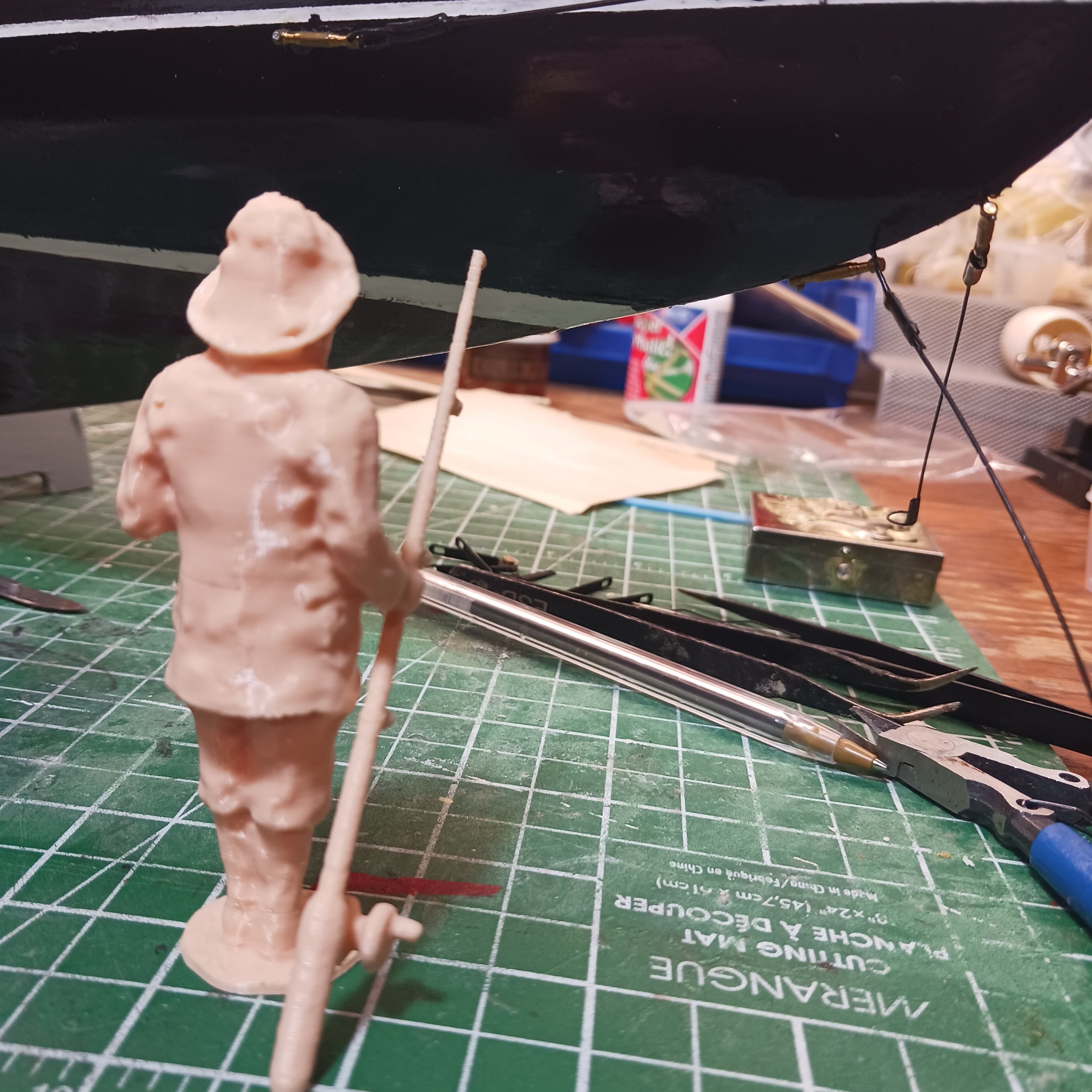

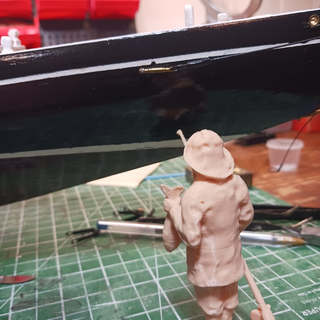

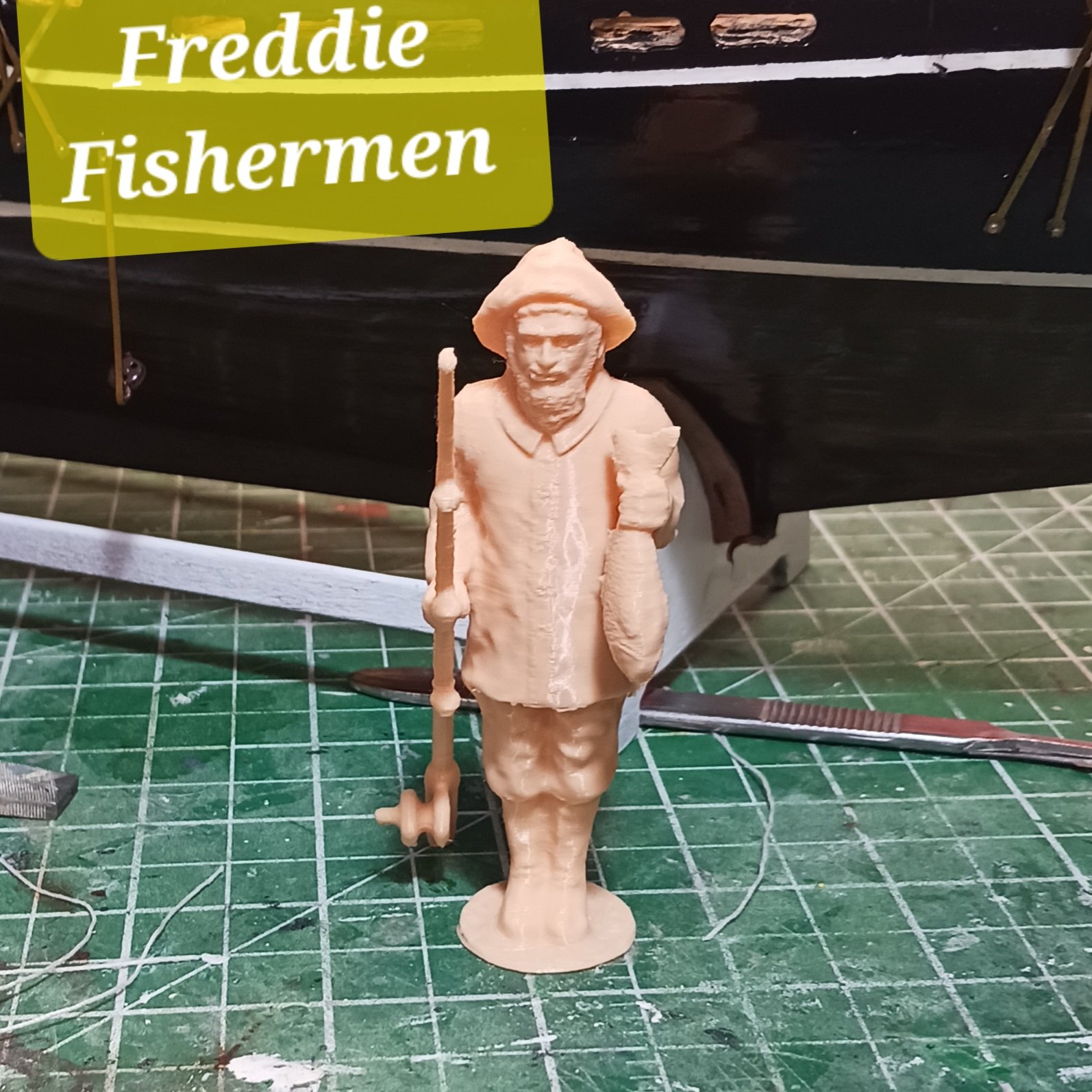

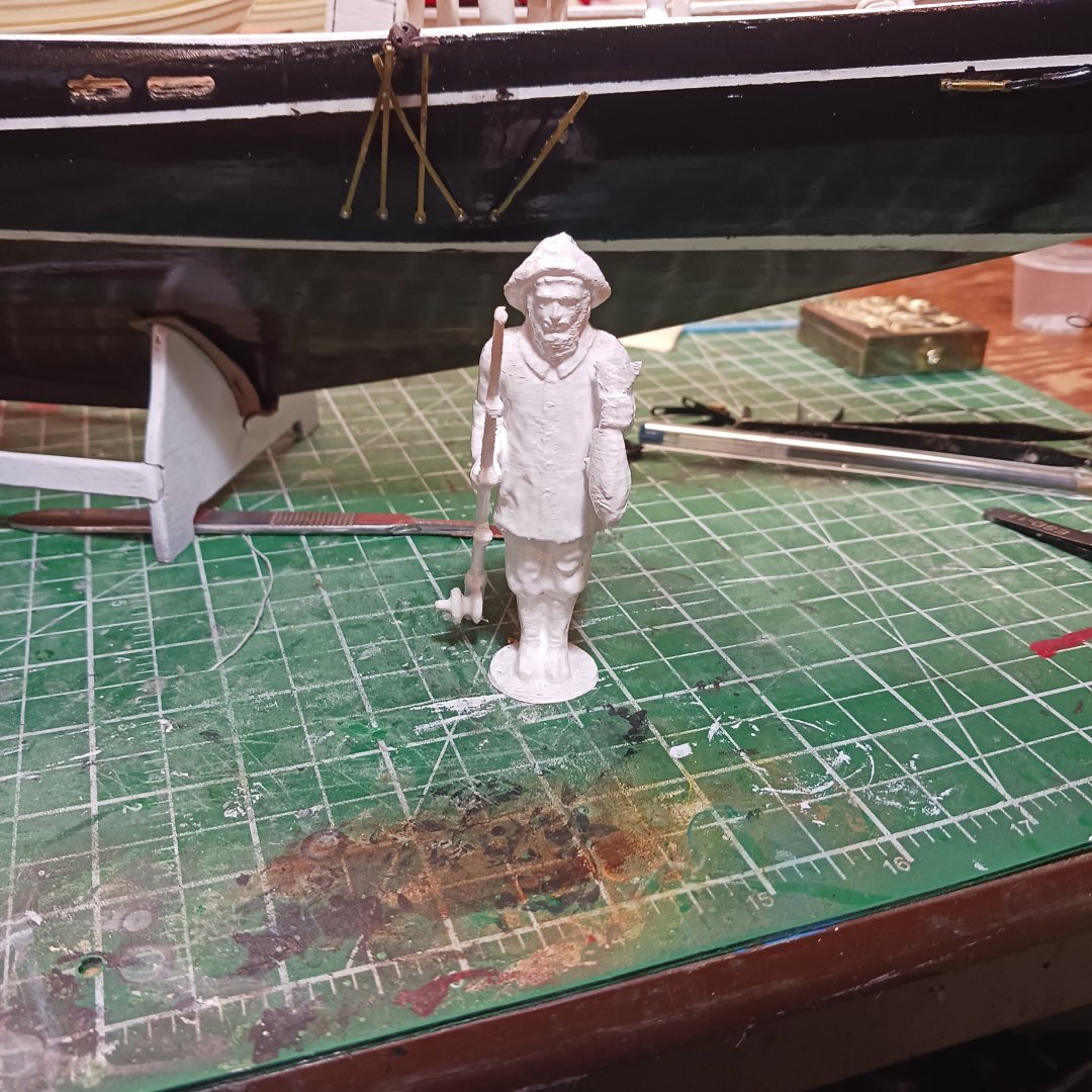

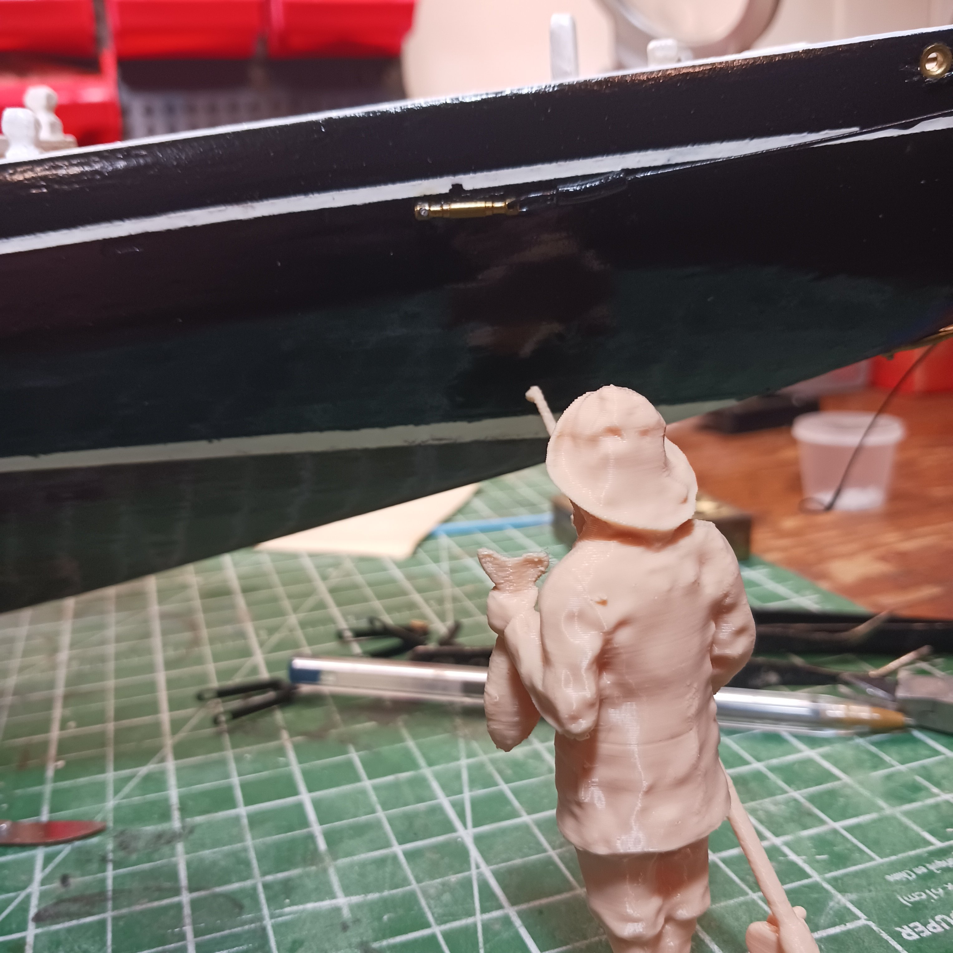

Now I have to let it dry over night then seal it tomorrow. So I hired  this fellow  to help out.
And right away he starts pointing out things, shees,
so I filled  his mouth with paint, lol. He was made by my good friend @Gabek , we met up today and he unloaded on me. To many  things to show, lol. And he told me , look,  just to let you know I am busy till winter, ...of 2027 so make a list  lol.

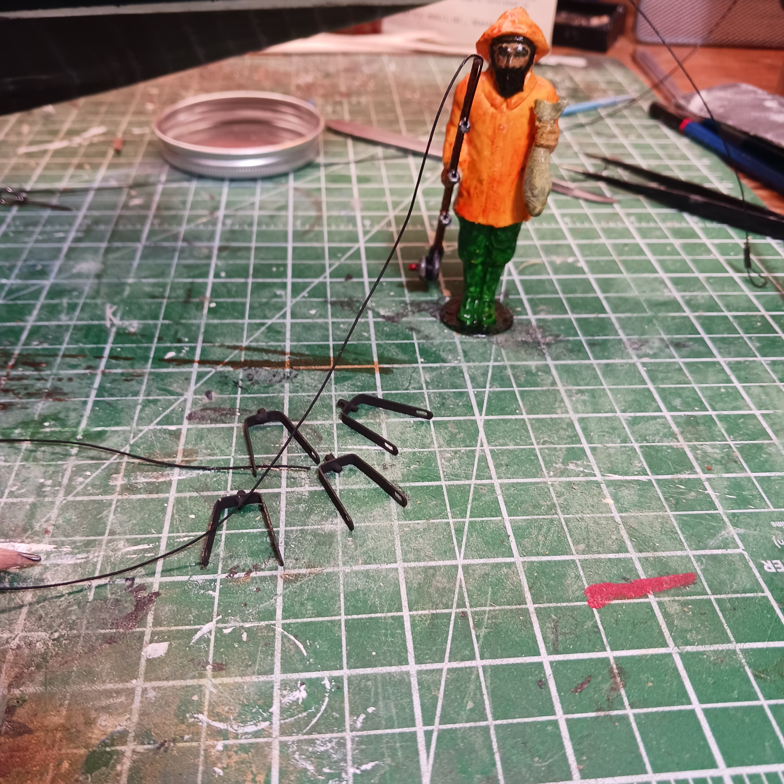

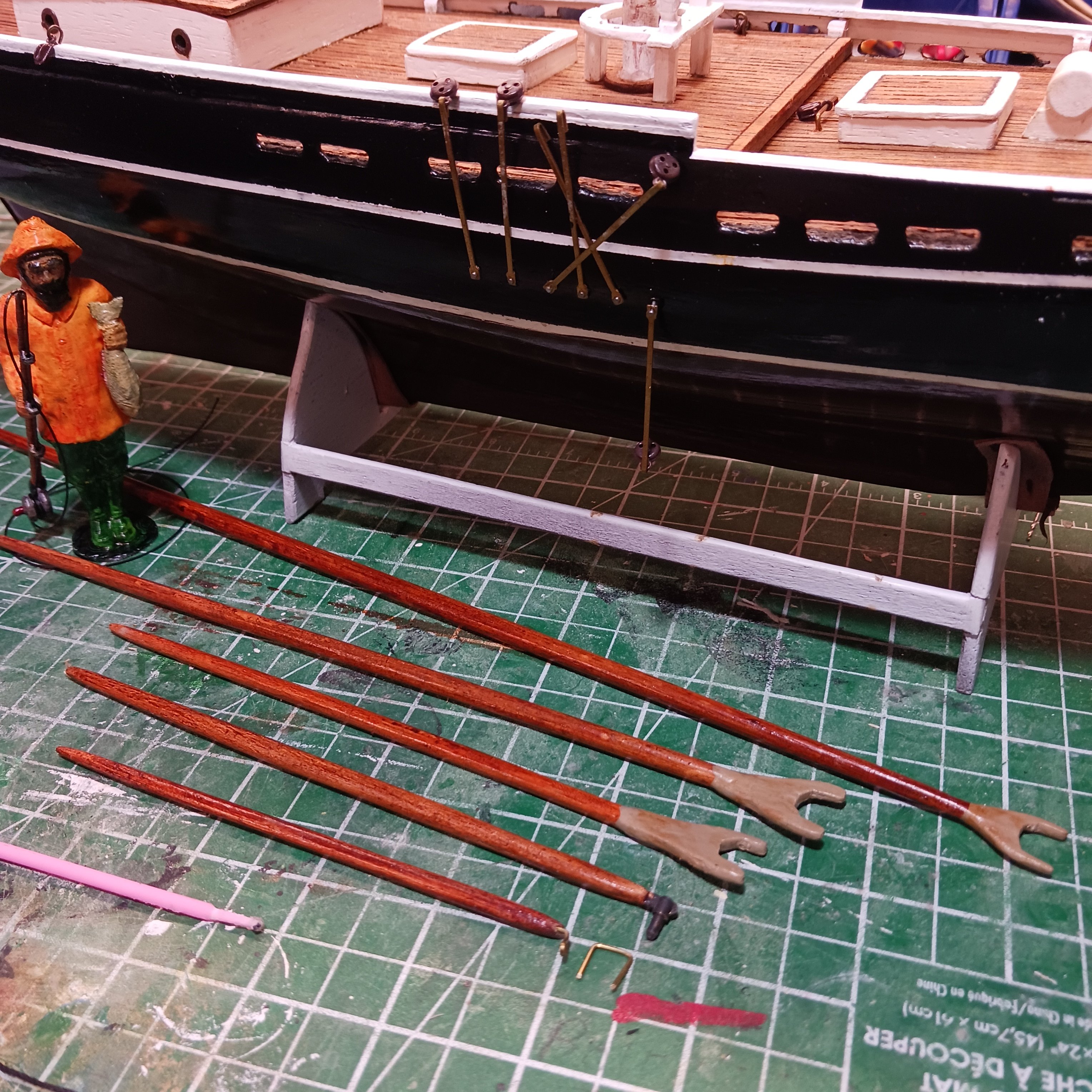

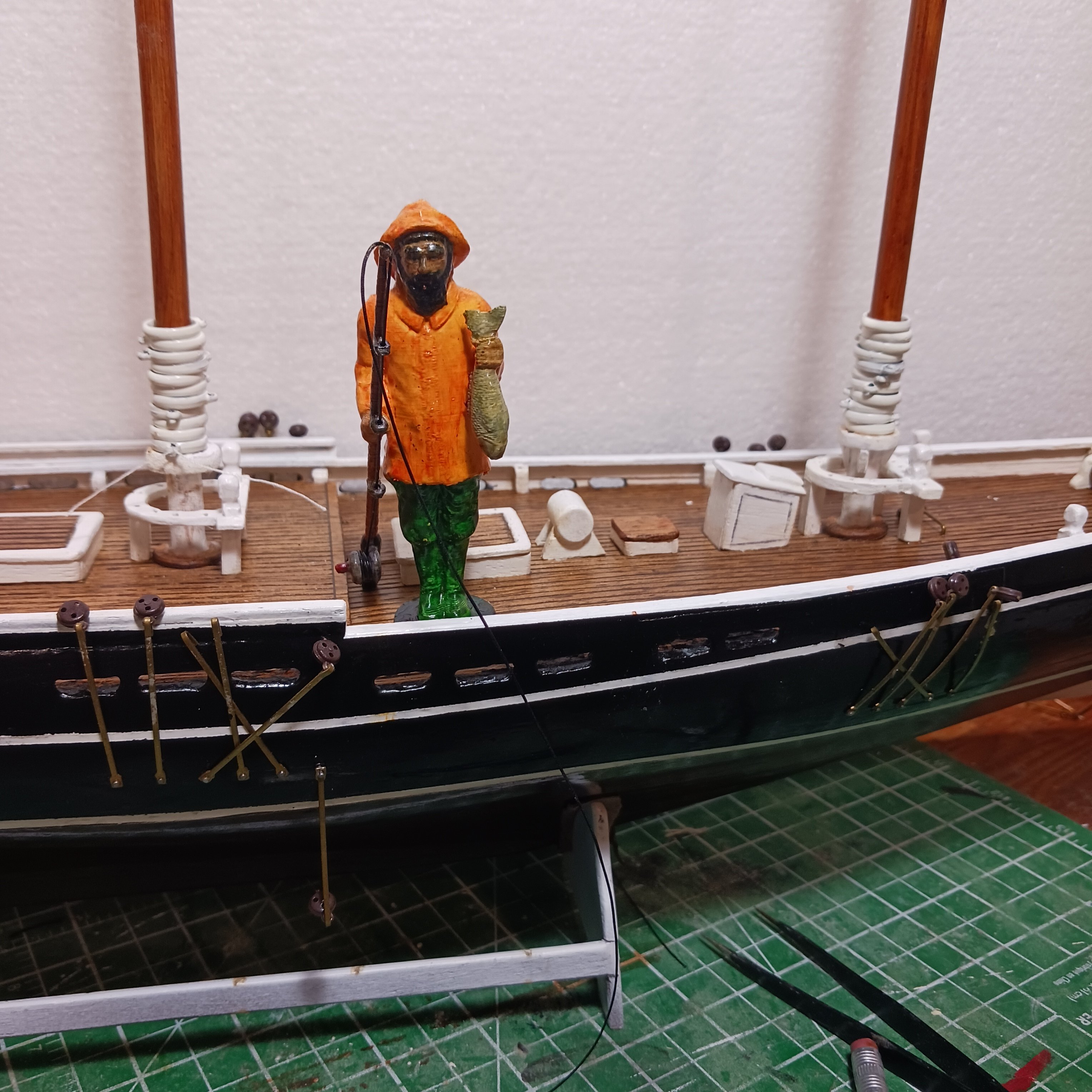

 Freddie  is ready to start his new job as Building Inspector. 20250704_145849.thumb.jpg.dbdf953b237989e8340766c2f8b2f2c7.jpg
But first  a few casts, line fishing on the Bluenose.  😊.
Now that John Ruy has supplied  all the information  I need to move forward  it has been  write down and stowed away , Freddie  says it's time to reel in the booms and gaffs.
Freddie  went over all the plans, says we are in good shape. Just keep the compass  pointed to:

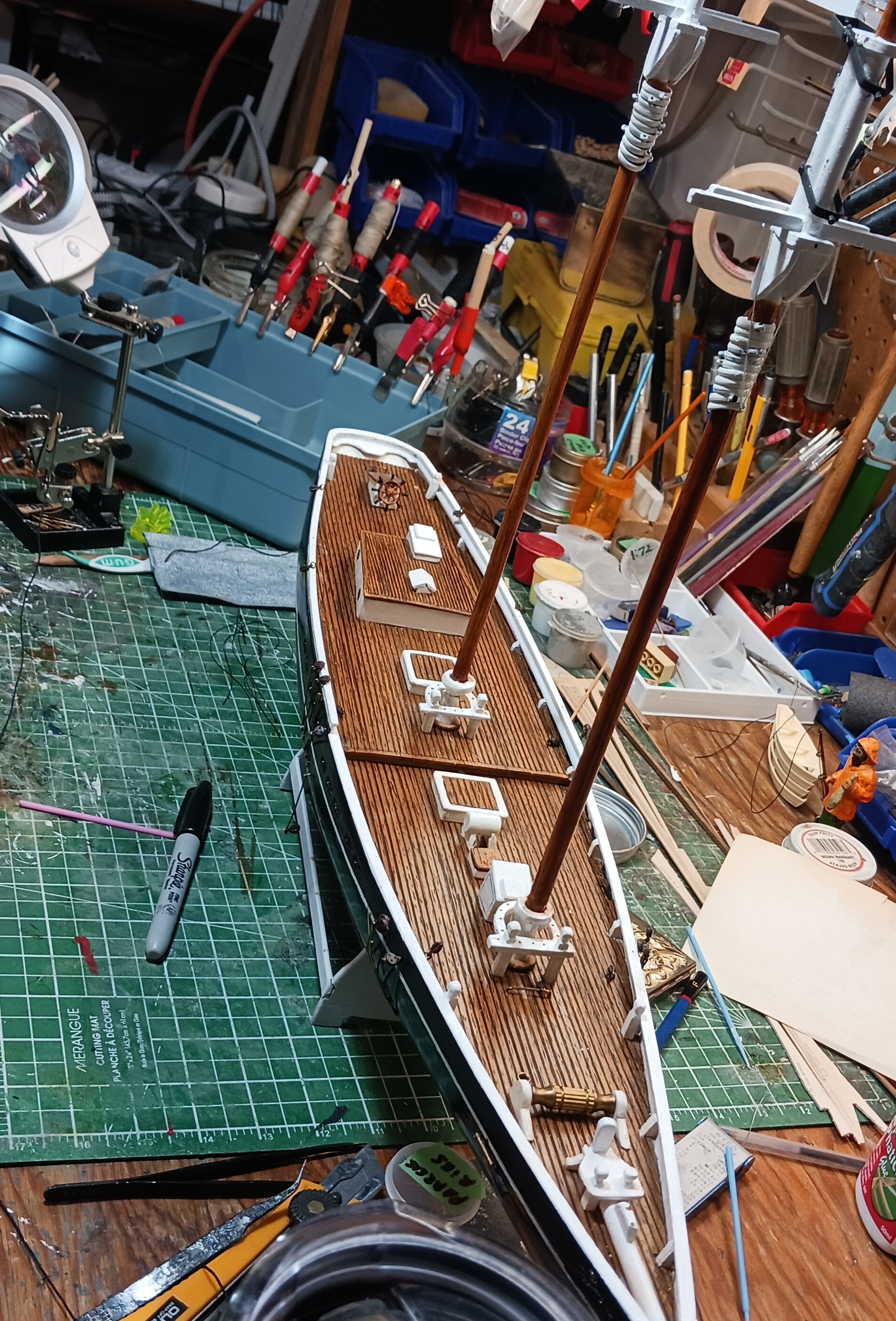

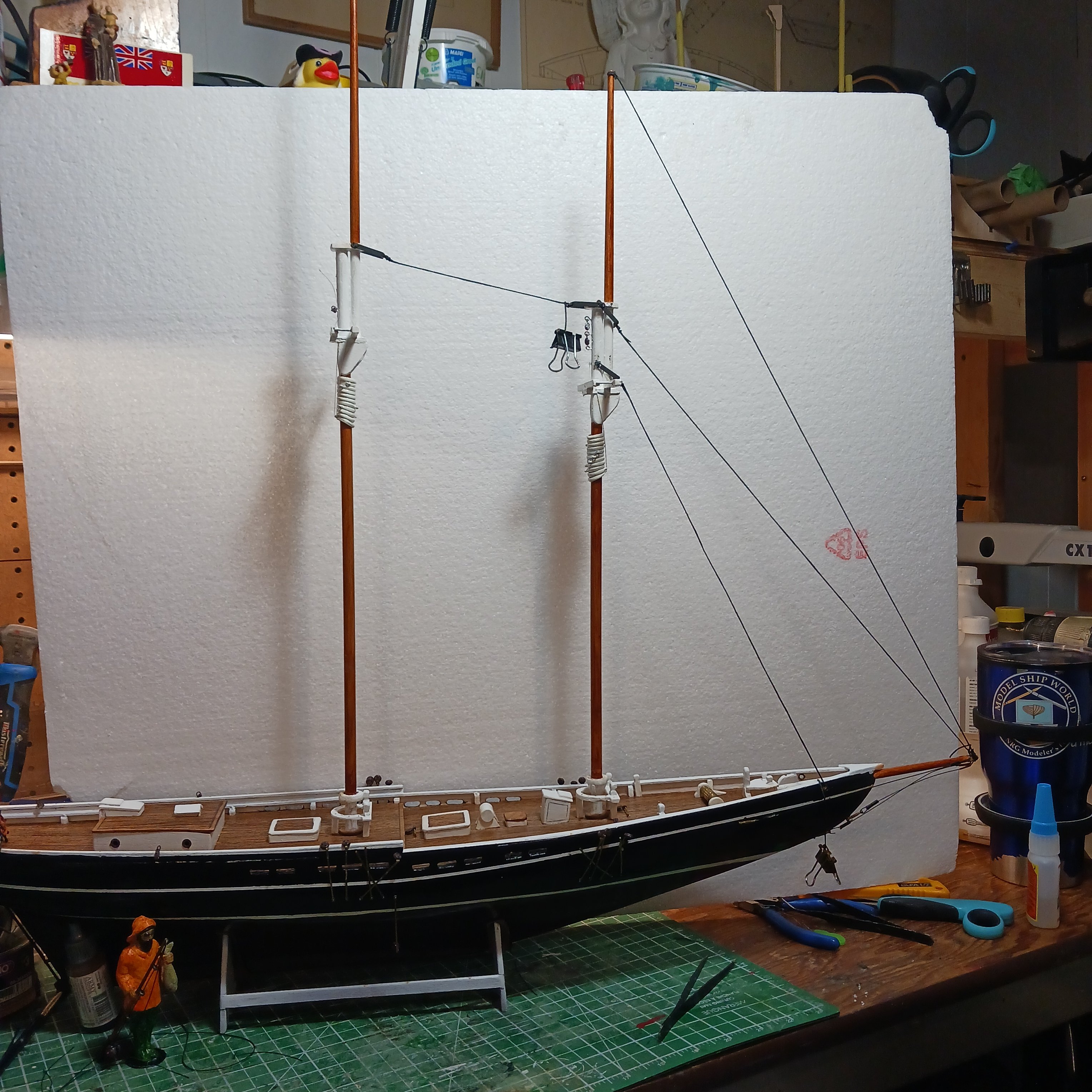

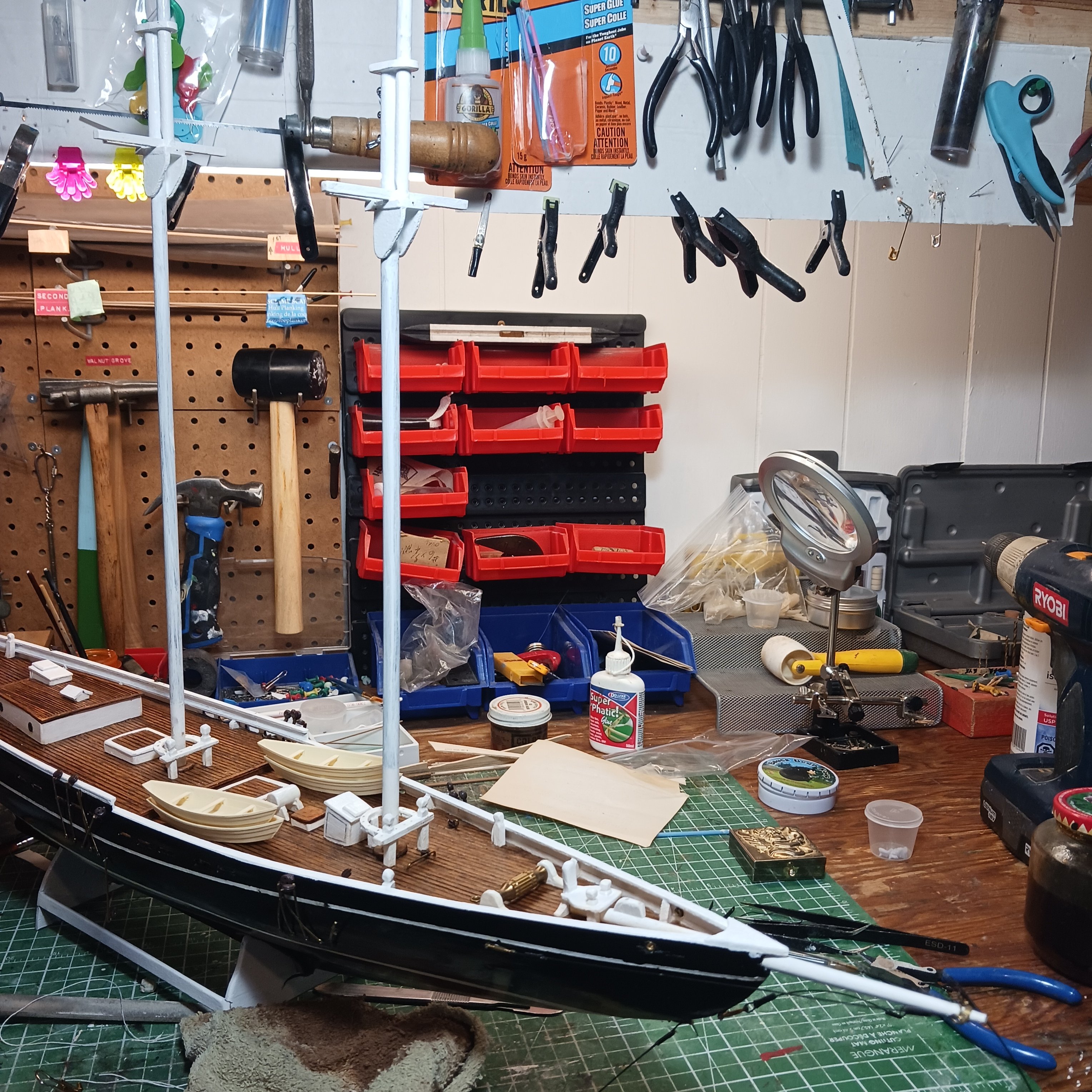

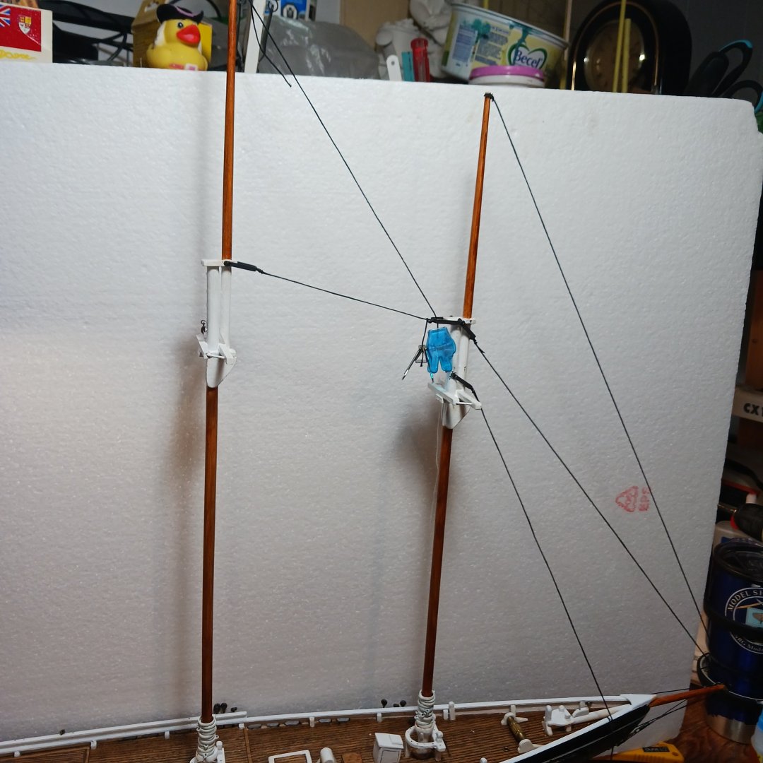

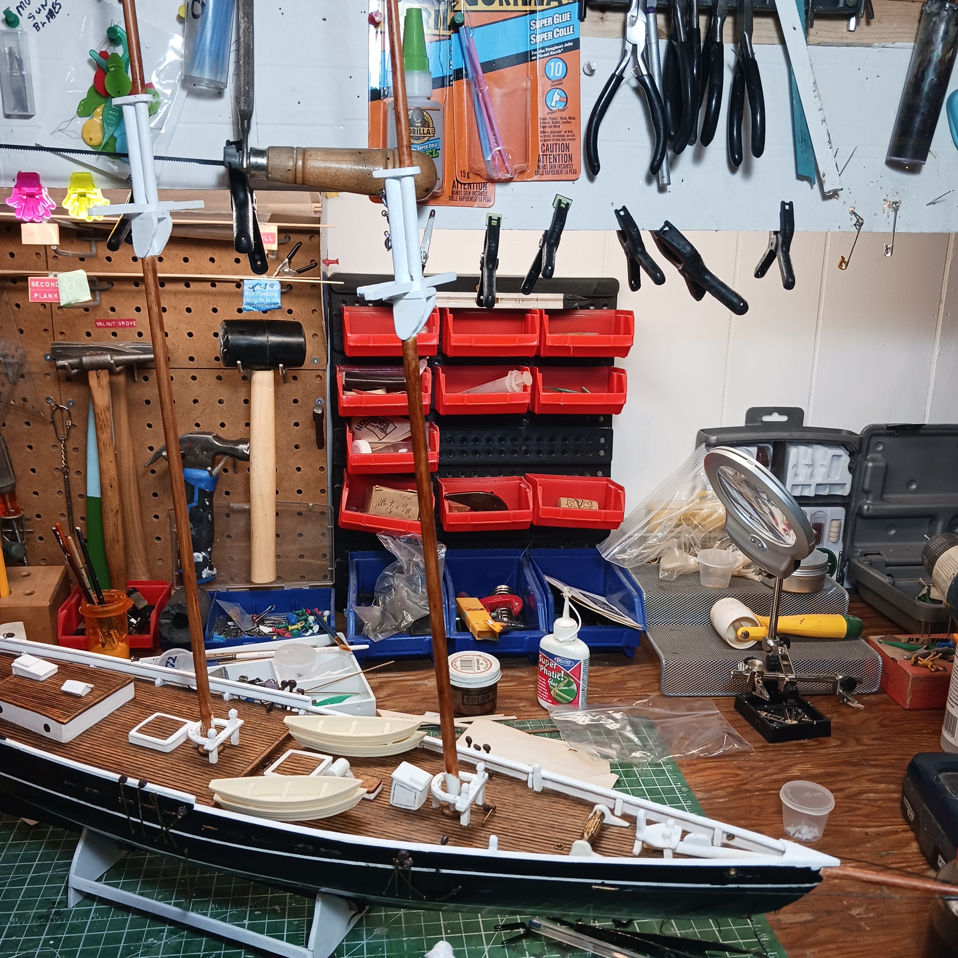

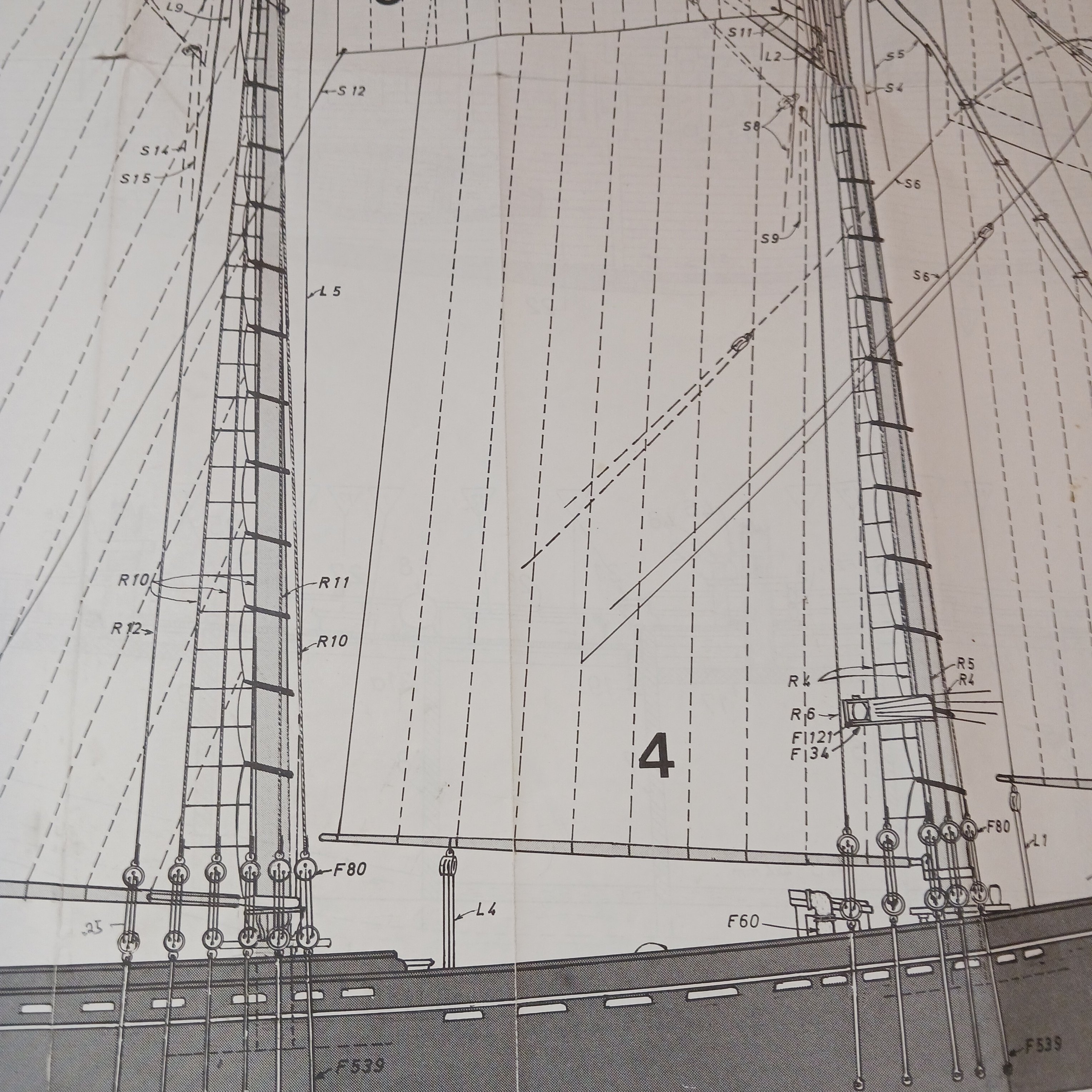

When you have a plan, and diagrams  to follow it to you just grin. 😁.  All the booms and gaff still need a block or to but we'll on the way.

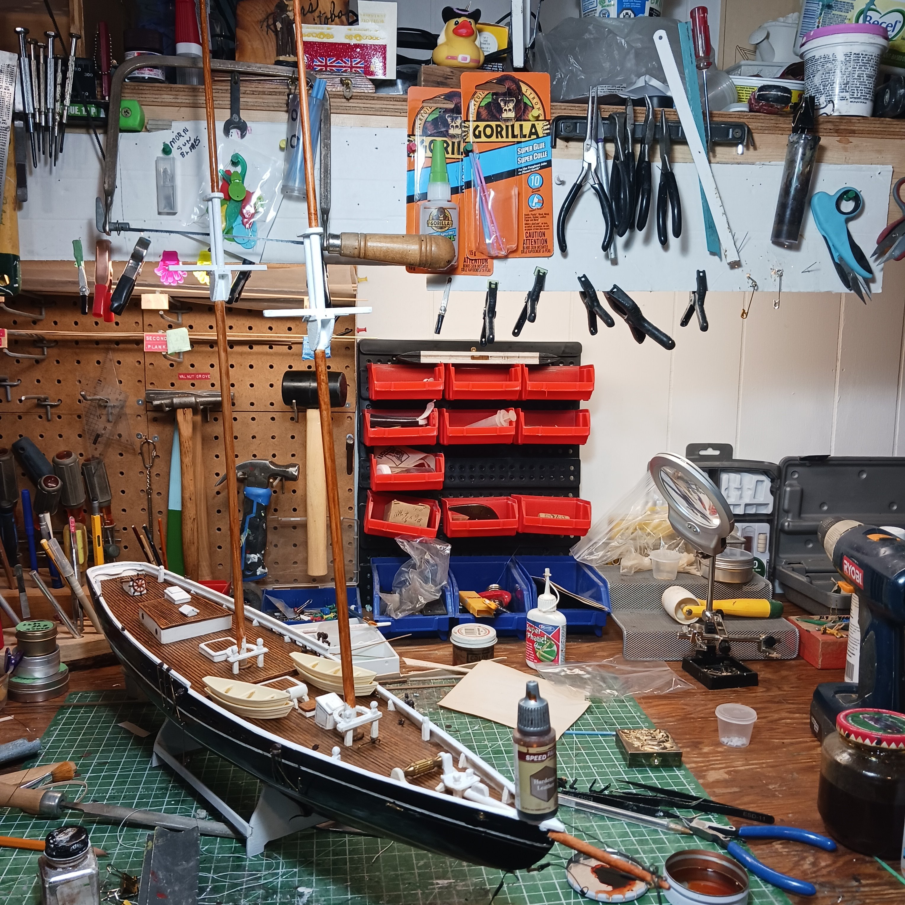

Some of the mast fitting  installed, paint thouch ups  all around  , but I will do them all latter.
Time to start running  some thread, I am so glad . The cat points out all the rigging  line are in stock. I set up my rigging  department, let's rig.
Shrouds are ready  to rig as well, plenty  of blocks and fittings .
So on to the shrouds,  then ratlines,  lol I wonder if I can tie all the rstlines in one day lol.
 Well that my ship, I think I will run the shrouds  and the rat line on the Billings Boat then do the same on the Scientific  model,I am finding it confusing to follow  both plans they are different.

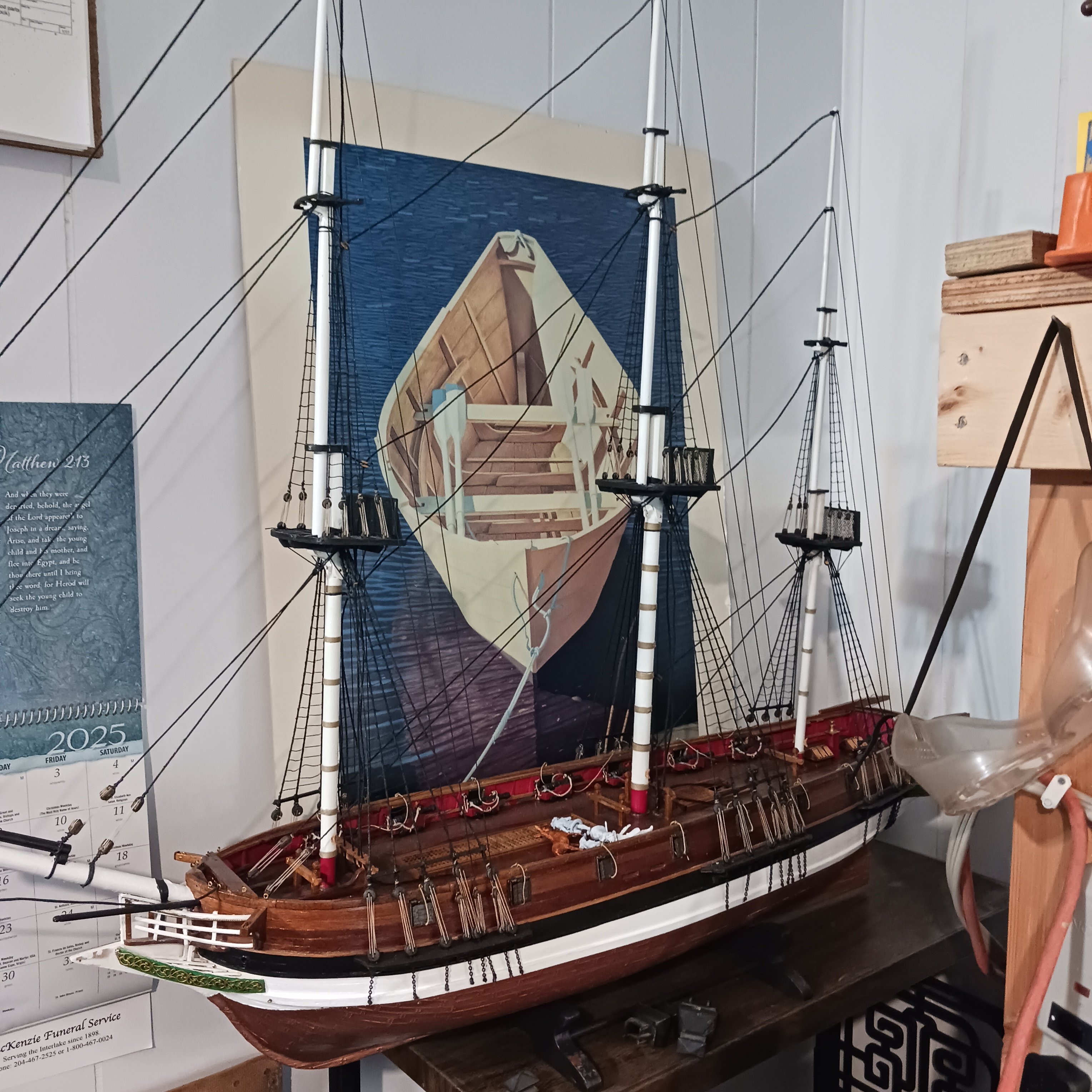

Work on the lower deadeyes was painful, the plastic  deadeyes  have to go in a piece  of brass and crimped on. I broke four, but Rodney  has a box full of these , no shortage  here. Lol.
I have the holes for the rest of the blocks  but will install them latter.
In my haste to get'er done I, after the upper  ratlines  were done I tied the stays. Now I will have a hard  time with the lower ratlines. Freddie said just take the back stay off,   and then you will have lots of space. Looks that way, I  will remember  to do all the ratines first  before the stays as I go forward.
Freddie  is looking  over the plans for the Scientific,  he says let's finish  the Billings Boat first because  there are too many  numbers  and different sizes  for everything  and it too confusing,  and it doesn't  take much too confuse me  these days lol.
 So, we will consider  the idea,  it is so much fun building a schooner,  I may look for another one to do latter.
 Rumor has it that there is a ship in the mail headed my way, Freddie says  I am the luckiest  guy he's ever meet. Lol. I will let you know when it gets here.  :D.
 Back to the ratlines, my happy place .

 Looks good, Bob. Better to back up and make another run at things instead of trying to plow through and make yourself miserable.

  Mean while Frank the fire man is getting  ready to  put the stay back in place.
And with one chop of the axe, everything  fell back into place. So I painted up the chain plates and will move on to the foremast,
