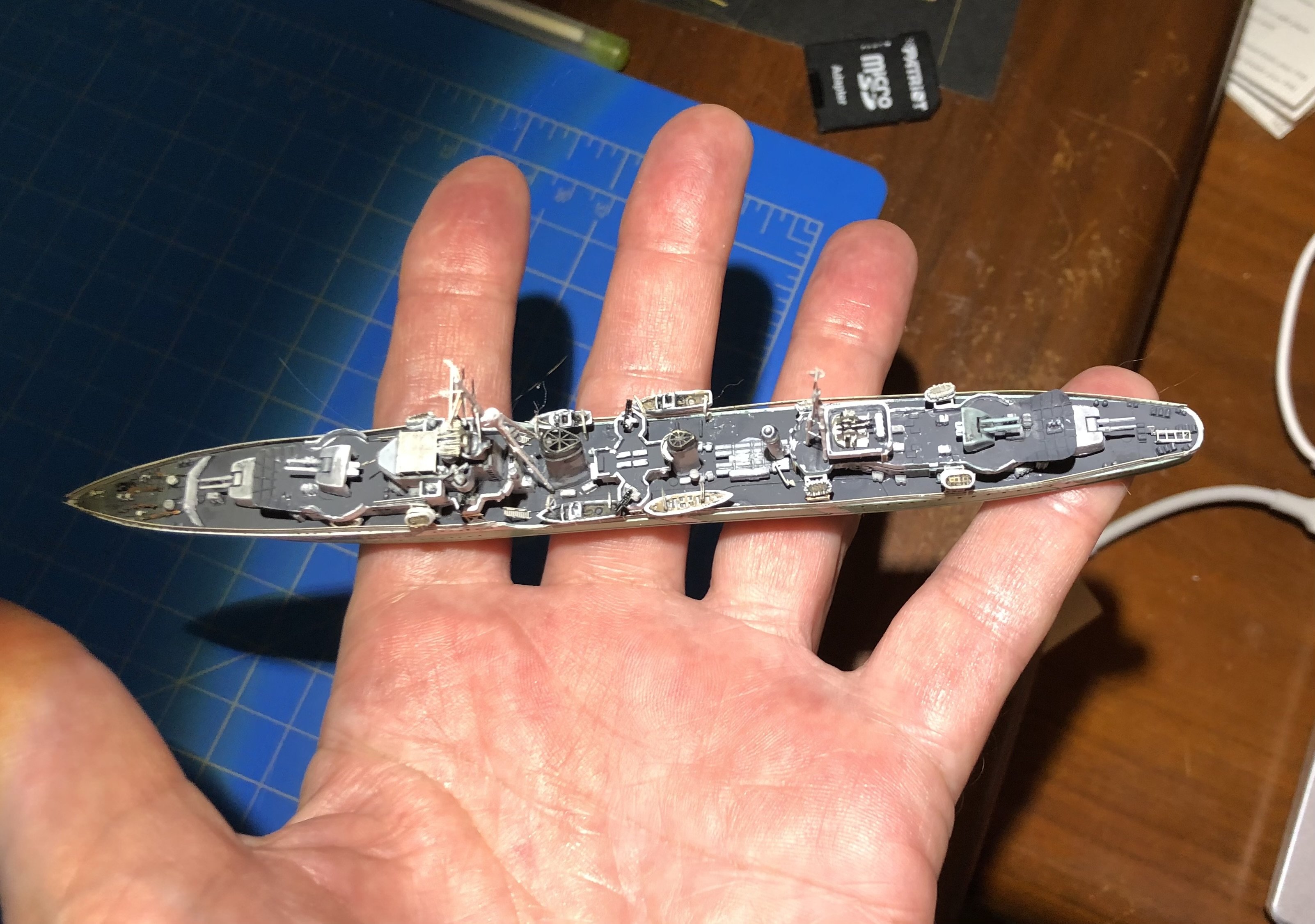

I think Huron is finished. I added the radar and DF gear to the masts and touched up the paint. I added a grey wash to the hull to tone the colors down a little and then weathered the ship, mostly the hull. It’s always easy to overdo the weathering at 1/700 but I think I reached an appropriate level. According to White Ensign they only provide three sets of davits because Tribals had three or less boats. I haven’t been able to confirm that so Ive stuck with four.
IMG_2236.thumb.jpeg.1acc7052c1b3a8eb1dff89cb4bfa997b.jpegIMG_2238.thumb.jpeg.9b86d70c0650da44134bdfdbd5f02684.jpegIMG_2239.thumb.jpeg.0664ca2c2b654dcd66bf6462d40b9f46.jpegIMG_2240.thumb.jpeg.7edfebc2c7c887ac9d3ee07d70d57508.jpegIMG_2241.thumb.jpeg.cc13e6cdb189edbb6f52850ab93aabee.jpegIMG_2245.thumb.jpeg.0673804ae8382249ba411b14eff158c6.jpegIMG_2246.thumb.jpeg.f8c9cdf8254168623766b96471ef7214.jpeg
 I have a lot of PE bits left, hopefully some will get used on the upcoming builds. Out of curiosity I built Huron using ca instead of the usual white PVA type of glue. I found it easier to apply very small amounts of glue and the faster setting time was an advantage. It does result in a brittle bond and a few small parts got knocked off and had to be reattached.

I pretty much only use medium CA for PE.  I've tried PVA type glue like Gator's Grip, but I don't really see the attraction.  I find medium CA gives me a good 20 seconds to align parts, and if I need a quicker bonding time, I just use some accelerator.

Thank you very much Mike. I think I’m a convert to Bob Smith Gold. It’s medium thickness, plenty of time to adjust and no odor. I was finding that the regular stuff was making me rather unwell if I used it for any length of time.

I haven't tried that one yet, but probably should.  I use Starboard, which I've also used as a CA finish when turning pens.  I learned to wear a respirator when turning pens and applying all that CA - it's nasty stuff.
Nice liitle model
I agree the CA glue is less messy than PVA. I use liquid and get type. However their rapid drying time is a problem as they are not forgiving, therefore some are using retarder. For resin parts is a different story.
There is a also a PVA called tacky which supposed to be as strong and fast as a regular glue but I haven't tried it yet

What an amazing result Alan and it´s 1/700 :omg:, I can imagine how it is to work at it with tweezers and shaking fingers. I like the weathering and paintjob full of contrast.
I also use a lot of CA, not only for metal parts like PE or white metal, but also for pre painted parts, where plastic glue can ruin the finish. My go to is Colle 21 which is odorless and I didn´t feel more airheaded then normal, even after using it for hours.
I use water thinned PVA or Future only for tiny parts, which need to be glued flat onto larger parts, like an 1/12 dial, or for transparent parts, where the CA fumes can fog the clear.

I imagine wiping ca onto a pen body generates a lot of fumes. My nose getting irritated just thinking about it
The BSI Gold is pricey but they changed the cap and it does give you a sporting chance of finishing the bottle before it solidifies

Thank you Mike, I think I’m going back to ca glue for the most part. I need to try Future for small bits. I bought something called Tacky for the Loarre castle build but never used it. I’ll break it out and try it.

Thank you very much Rob, These little ships pack a lot of enjoyment into a small space and take a bit of pressure off the display area.
I found the railings went better with the ca glue because of being able to use less and a quicker grip.
I was finding regular ca after a while gave me streaming eyes and nose, sneezing like a bad allergy. So far the BSI Gold (odorless) doesn’t so I will accept the extra cost and continue.
