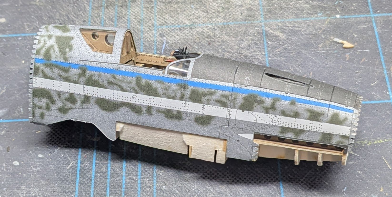

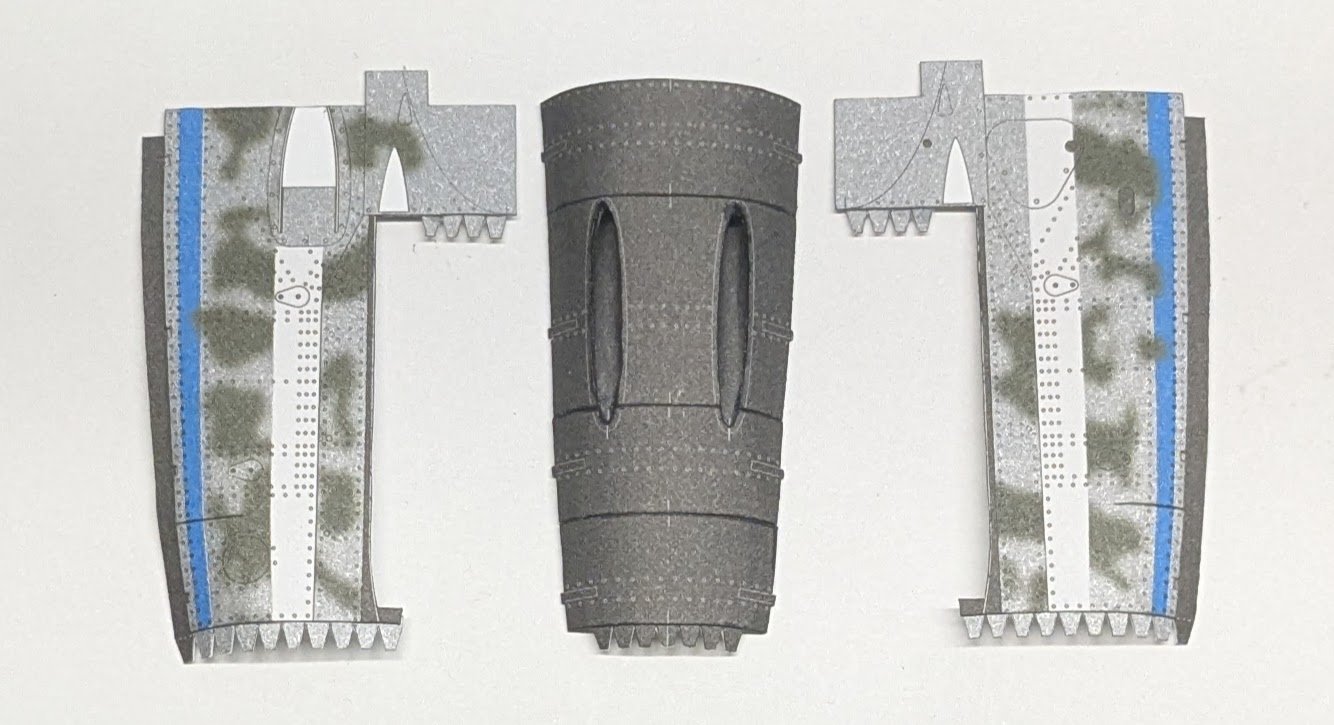

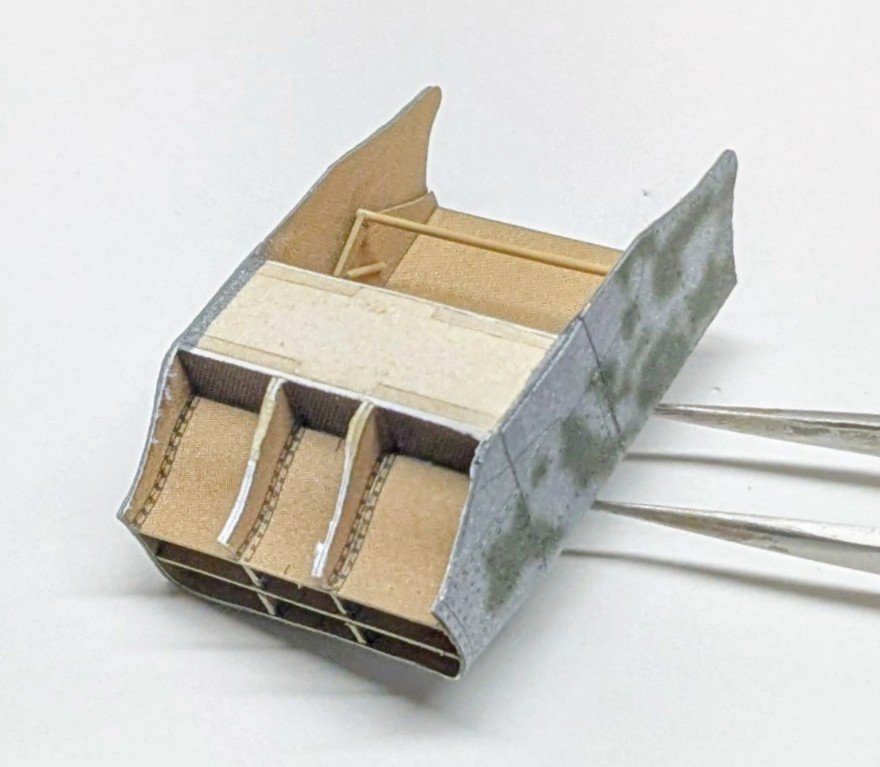

Next it was on to the fuselage cowling! Here are the two sides and top all prepped and assembled. These are some of the nicest machine gun channels I have yet built.
The three sub-assemblies have been glued together and are ready to go on the fuselage.
One thing you absolutely cannot do with a Halinski kit is simply throw the frames together and start skinning them. Every Halinski kit I have ever worked on (and, to be fair, this is true of many other kits as well) has required some fairing of the framing before skinning, and some Halinski kits have required a lot of fairing. This is one of those kits! So, it's a case of sand-fit-sand-fit-sand again-fit again-repeat. Finally, though, the job was done.
I noticed after I got this finished that one side is sanded down a little more than the other, but hopefully this will not be too noticeable on the finished model. And yes, all of my man-handling of the fuselage broke one of the frames where the wing will eventually slot in, but that will be easily repairable.

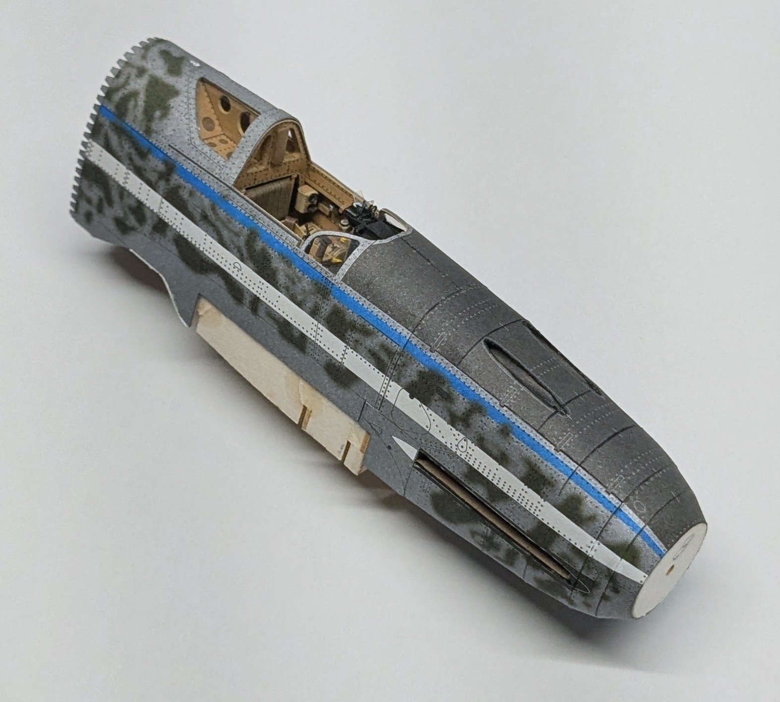

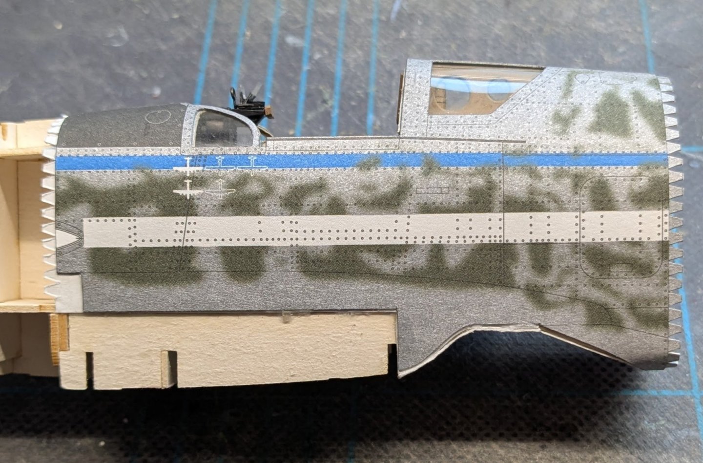

Forward fuselage skins done.
What wizardry is this?
Ongoing:

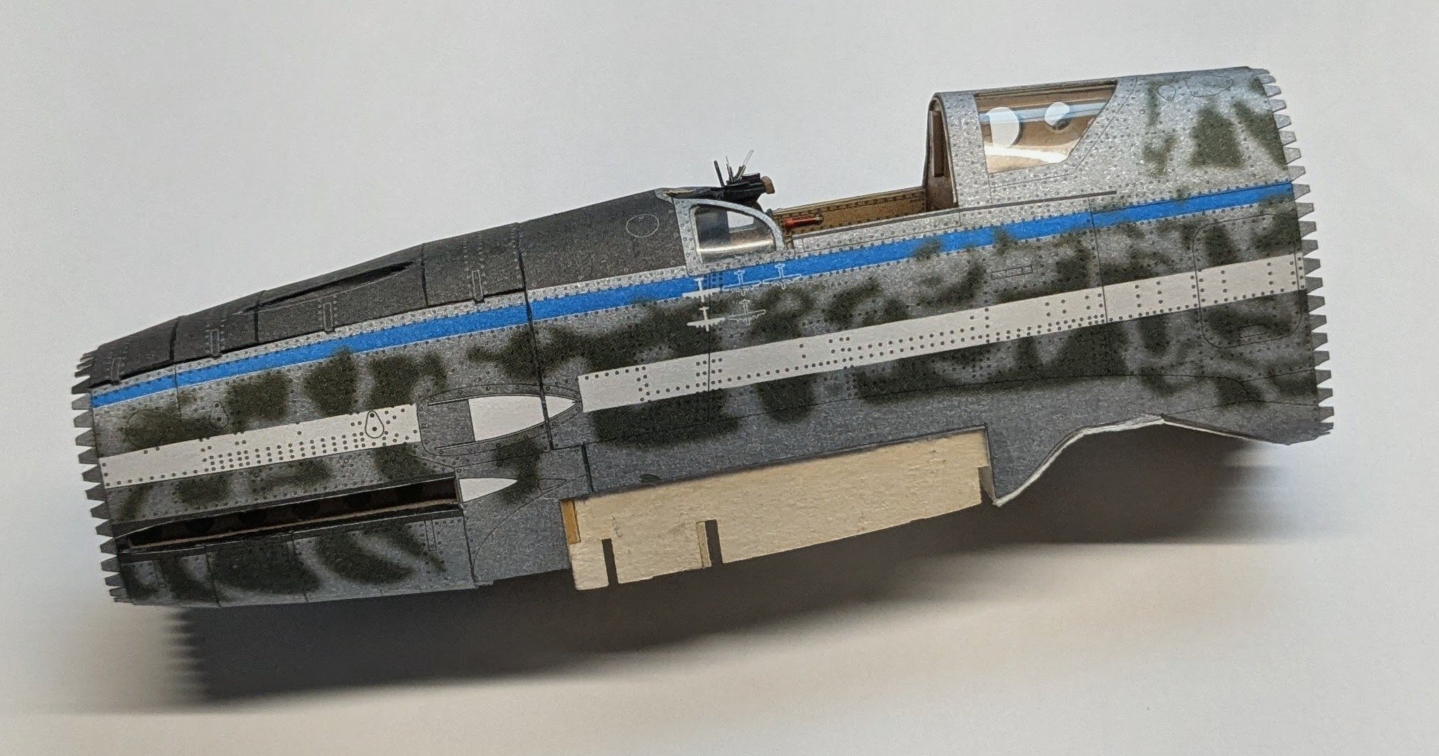

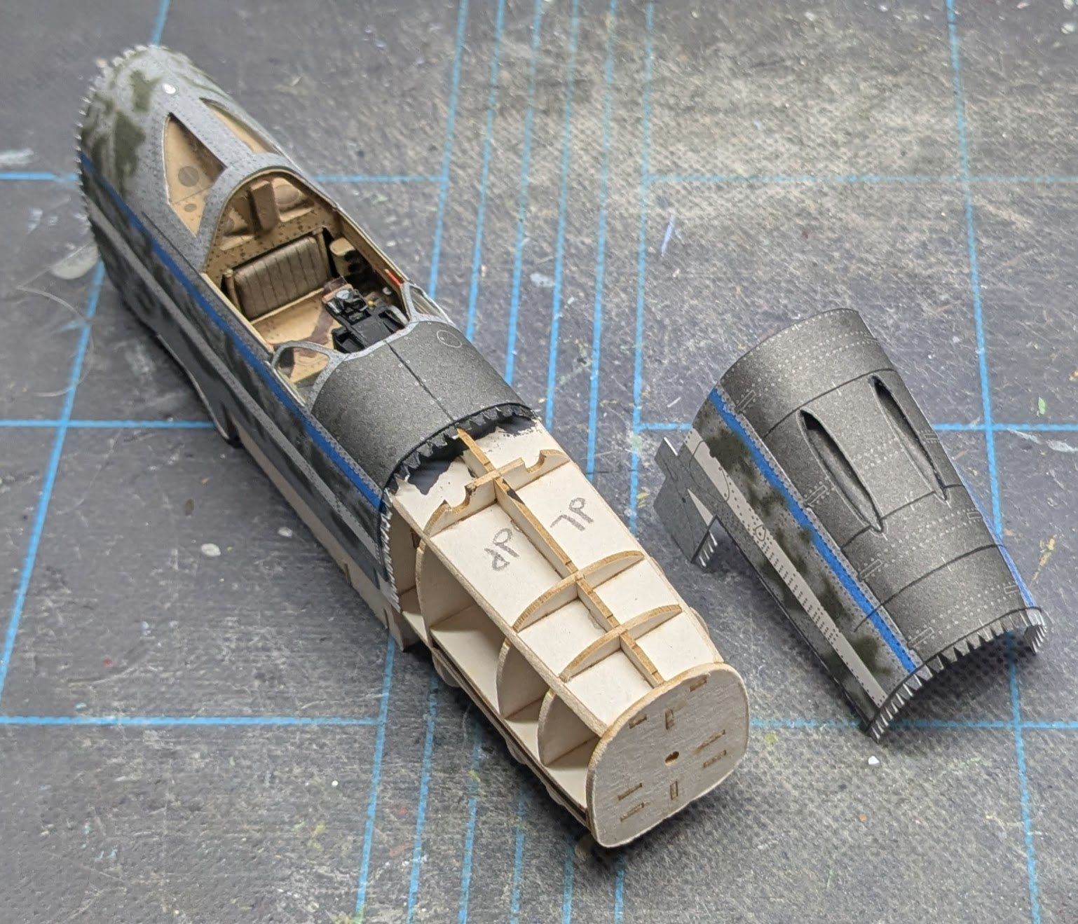

One more fuselage section added. The fit between the two sections was extremely tight -- too tight, in fact -- the result of not adequately beveling the aft-most cockpit frame. While wracking my brain about how to fix this, a 'new' idea popped into my head, except it's probably not new, since our Polish friends have likely thought of this already. It occurred to me that the frames are made of pulp board (duh), and pulp board can easily be deformed. So, using the flat end of a pair of tweezers, I simply burnished the offending parts of the cockpit section until the aft fuselage section fit properly. We're talking about only a tiny amount of deformation needed to do the job, and it worked a treat.
You may recall I was worried earlier about some possible registration errors between sections as a result of not getting the cockpit skin aligned 100% correctly on this port side, but I'm very happy with how well the two sections have gone together. Overall I am very pleased with how this kit has gone together so far.

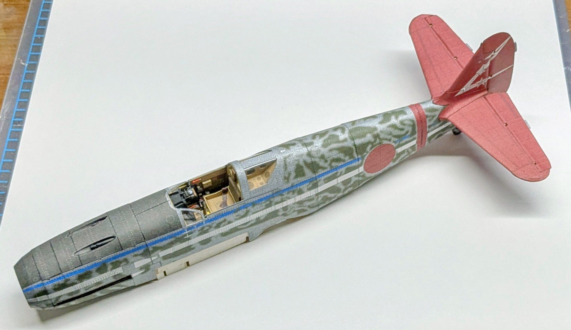

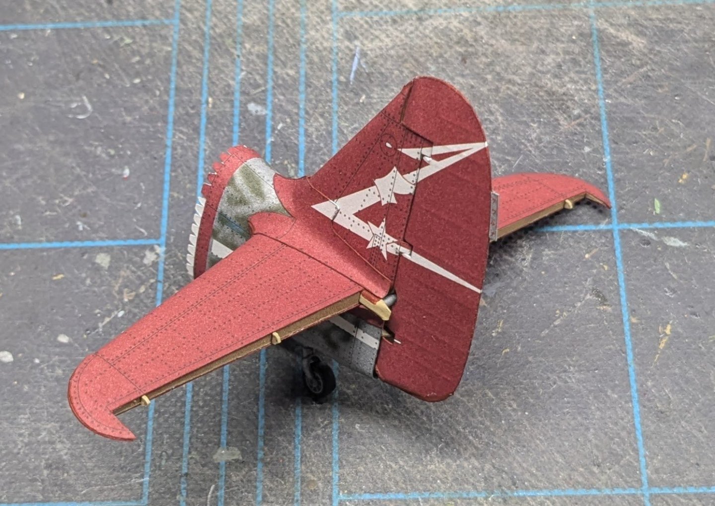

Got the tail wheel section skinned and the vertical stabilizer completed (except for a few tiny parts that I'll add later). I forgot to snap a picture of the stabilizer framing, which in typical Halinski fashion was quite robust.
 The skins lineup right on the money, very nice, Chris.

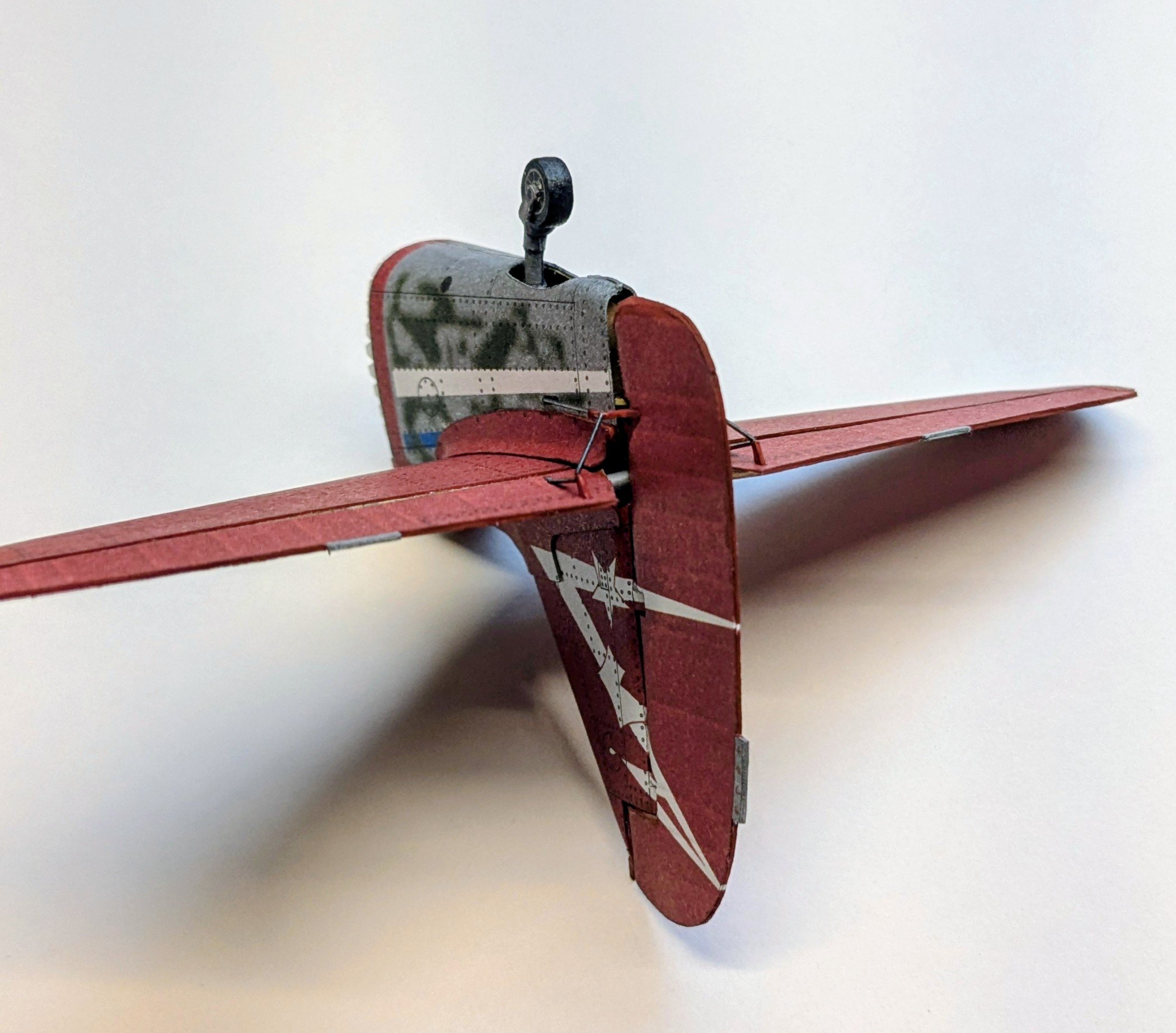

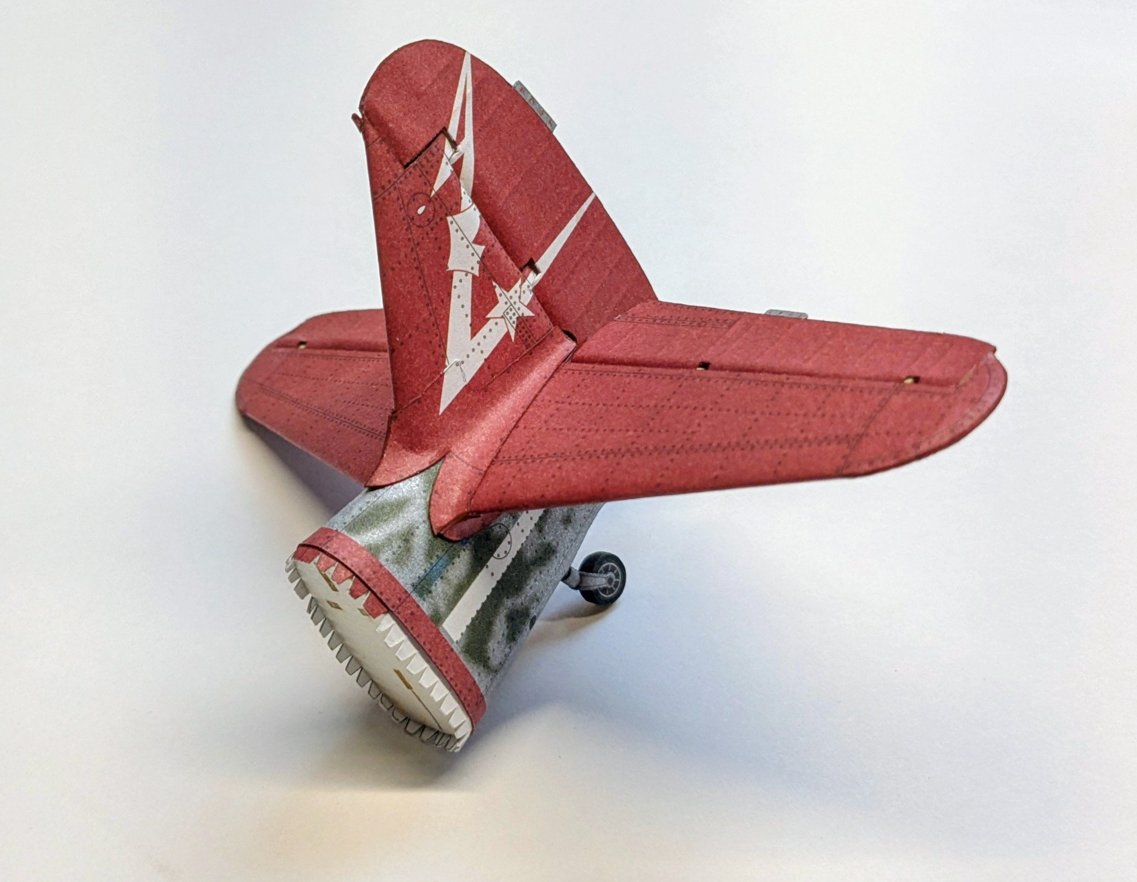

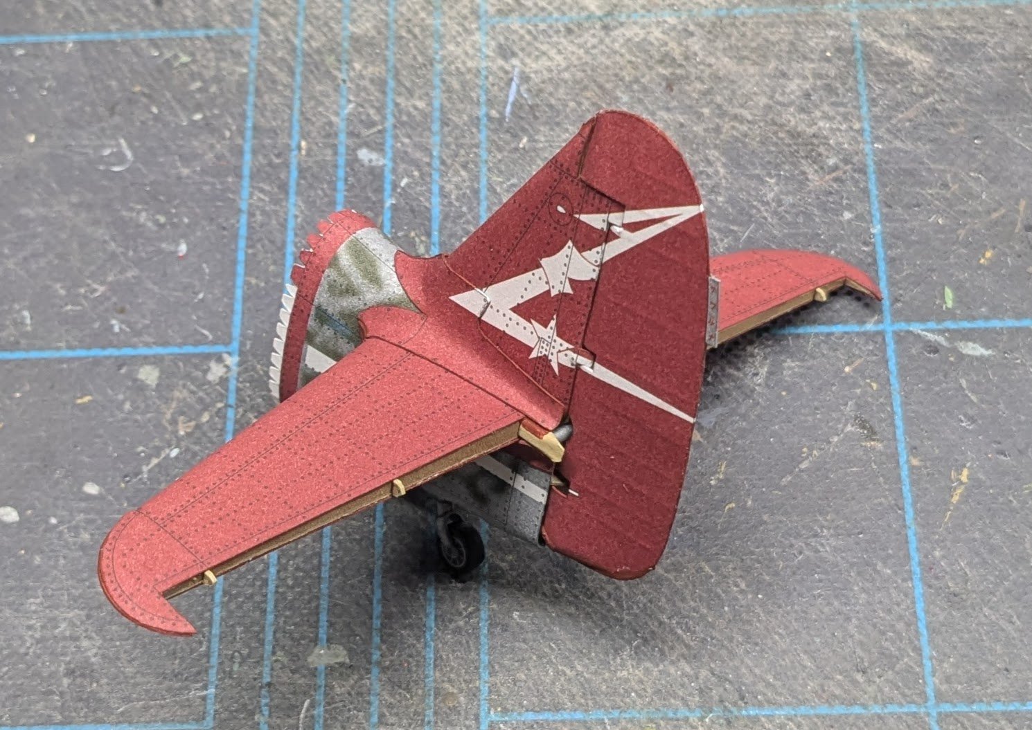

The empennage is complete. An odd thing on the Ki-61 is that the elevator and rudder actuators were linked; on the model this required six very small pieces of wire, along with the usual "special words" that such tiny parts invariably conjure. At least two attempts disappeared into the Carpet Monster.
PXL_20260117_162605243_MP2.thumb.jpg.be9bc97368f1362a4ea13b4a924e105c.jpg PXL_20260117_162634668_MP2.thumb.jpg.cab07814a28c0cd70181bad789de1a25.jpg

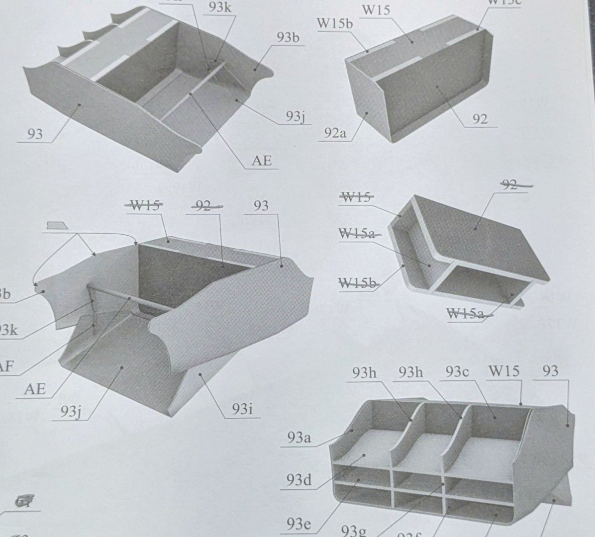

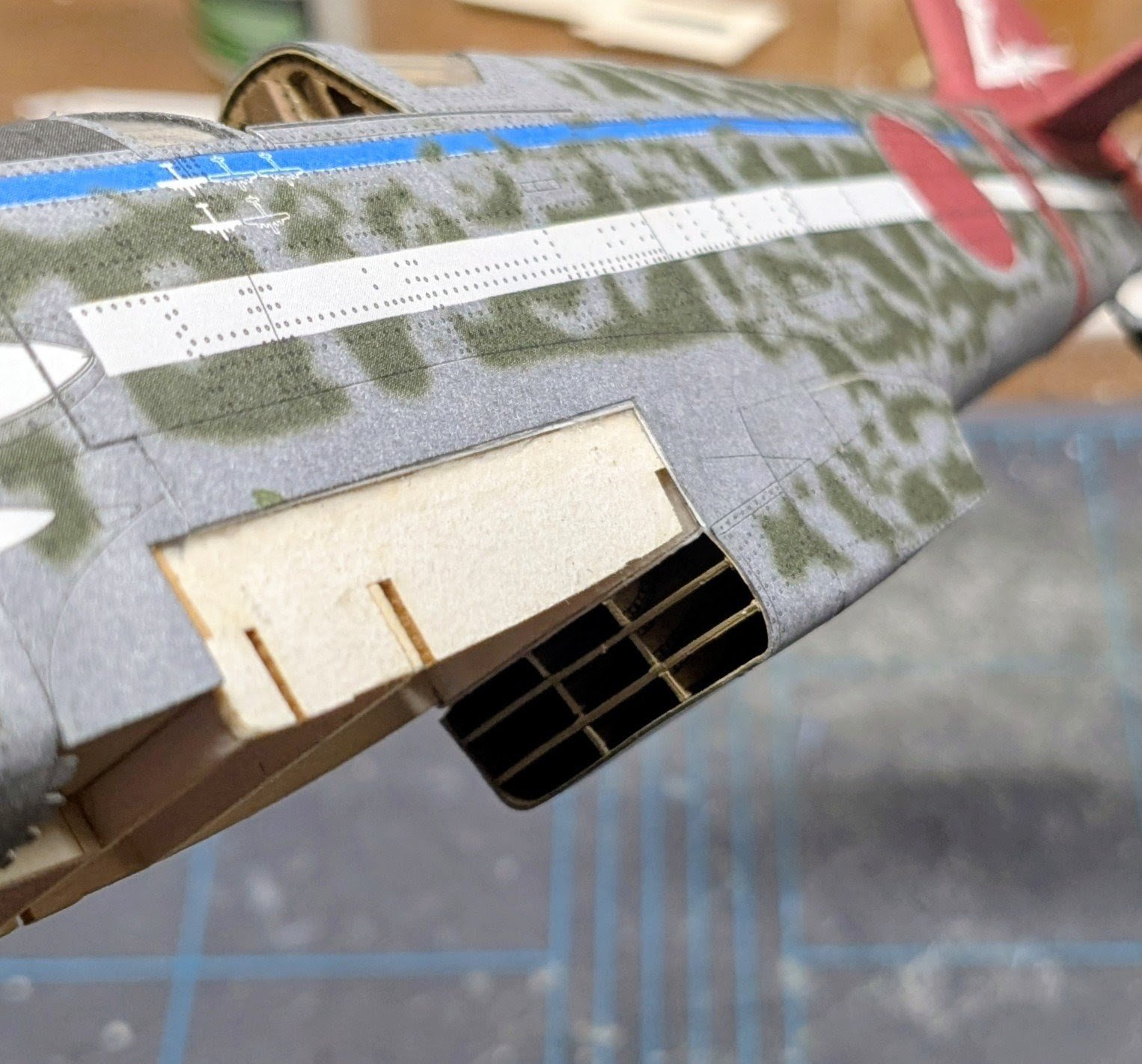

The radiator is finished. Looks simple enough, until you look at the diagrams.
One can build the model with the radiator air flow control flap open or closed. I chose to show it closed. I realize that if the flap is hydraulically controlled, that it may drop open if the aircraft loses hydraulic pressure when the engine is cut off, like when the aircraft is on the ground, but I just like the closed look better. Same thing goes for flaps, when I get to those; they can be built in the open position, but at the cost of a LOT more work!
Here is the finished radiator.
And the radiator on the model:
That hideous seam is partly the result of the little bit of error that cropped up when I skinned the cockpit. Remember when I said I hoped it wouldn't eventually bite me in the butt? Well, it did -- but ultimately not too badly. Most, if not all, of this will eventually be hidden by the wing.
Just for fun, here's what the seam looks like after being treated with my phone's "magic eraser" editing function:
As The Old Man in Das Boot would say, "Clever trick!"

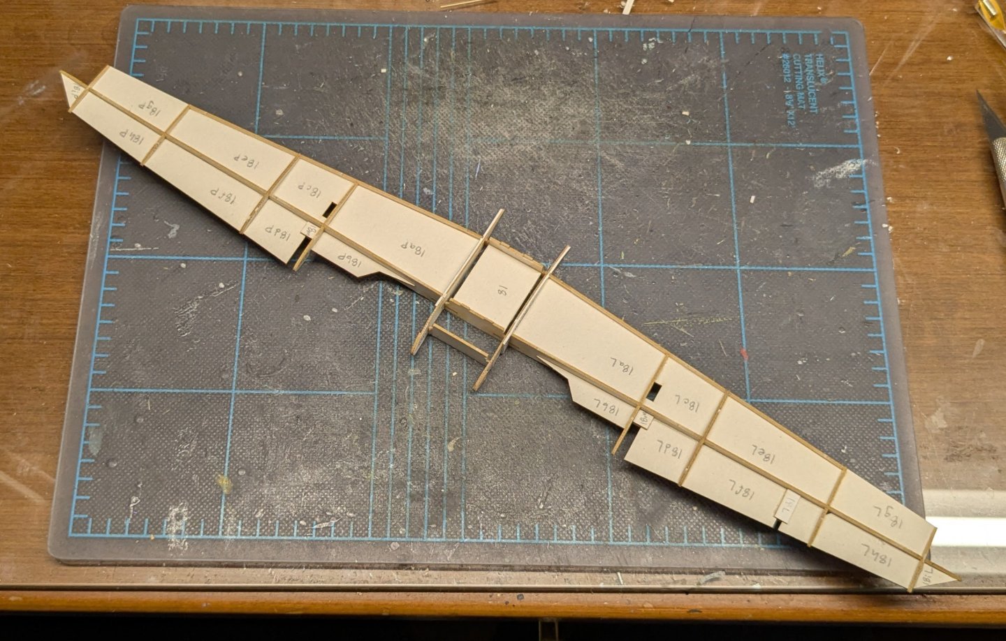

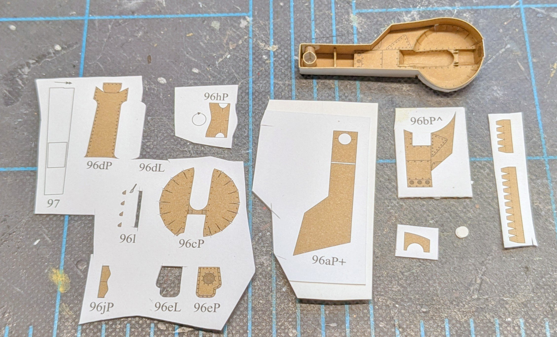

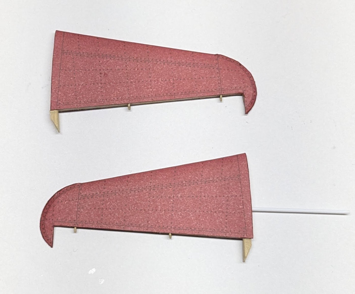

Wing framing begins. I might have had the wing framing done today except for the fact that I glued the first half-dozen parts together incorrectly and had to gently disassemble them before I could start over with attempt #2. I'm just glad I discovered the problem before I had gotten any farther! 😮
Here's the left bay completed, along with the parts for the right bay. Although time-consuming, the structure is not as difficult to build as it might look. One of my dapping tool handles has exactly the right diameter to neatly fold the petals of the actual well. Normally I dislike petal structures, but this one went off without too much hassle.
