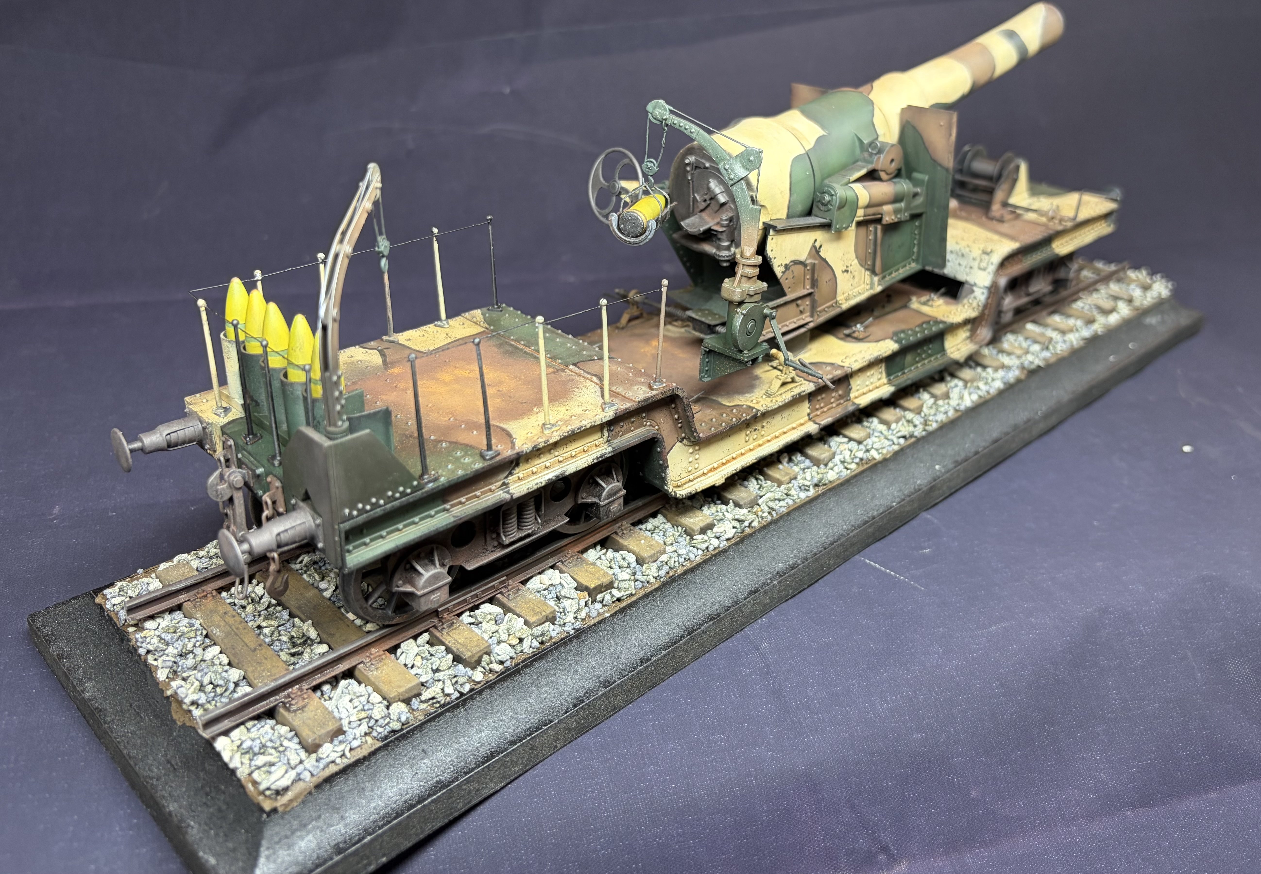

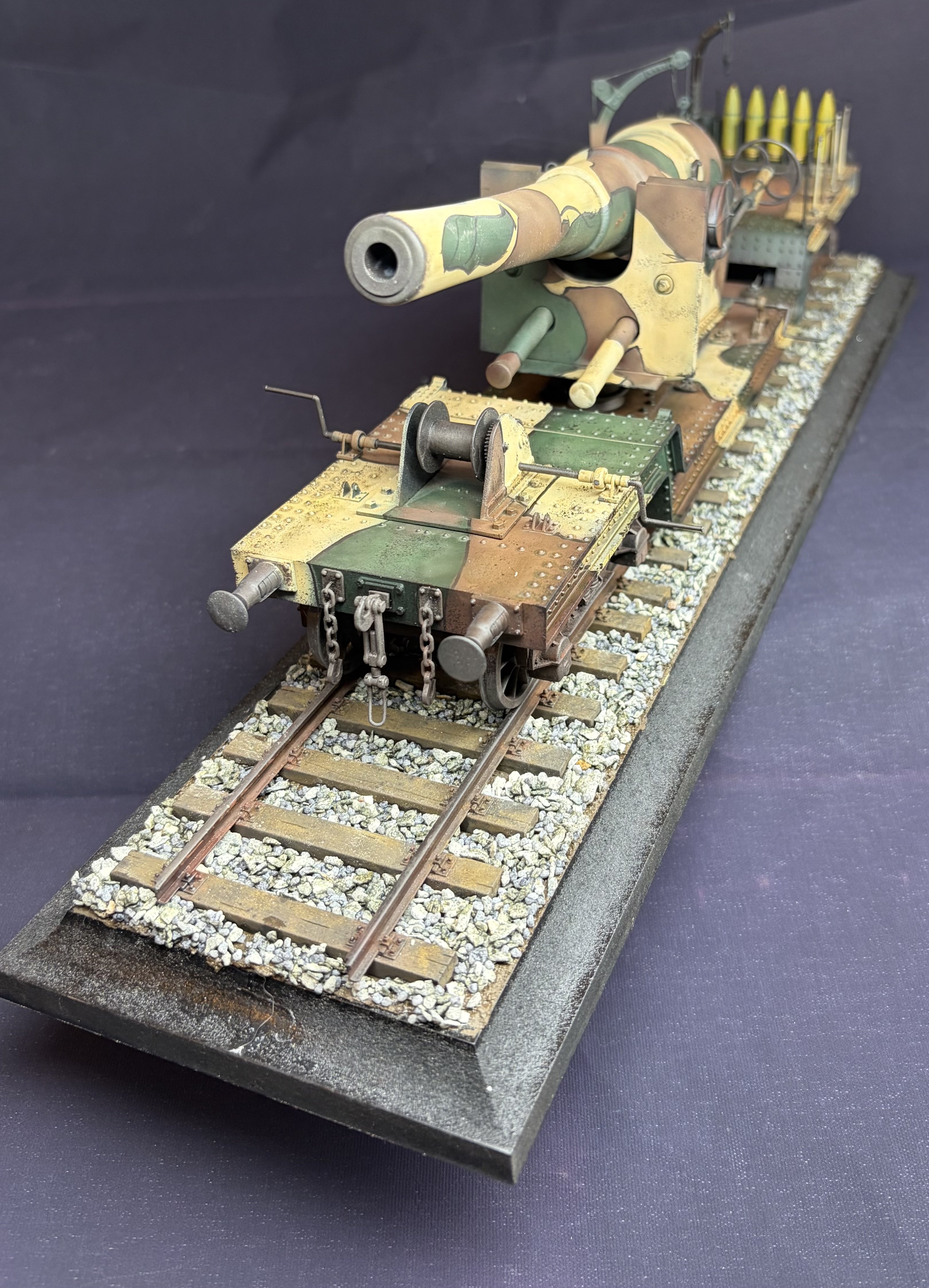

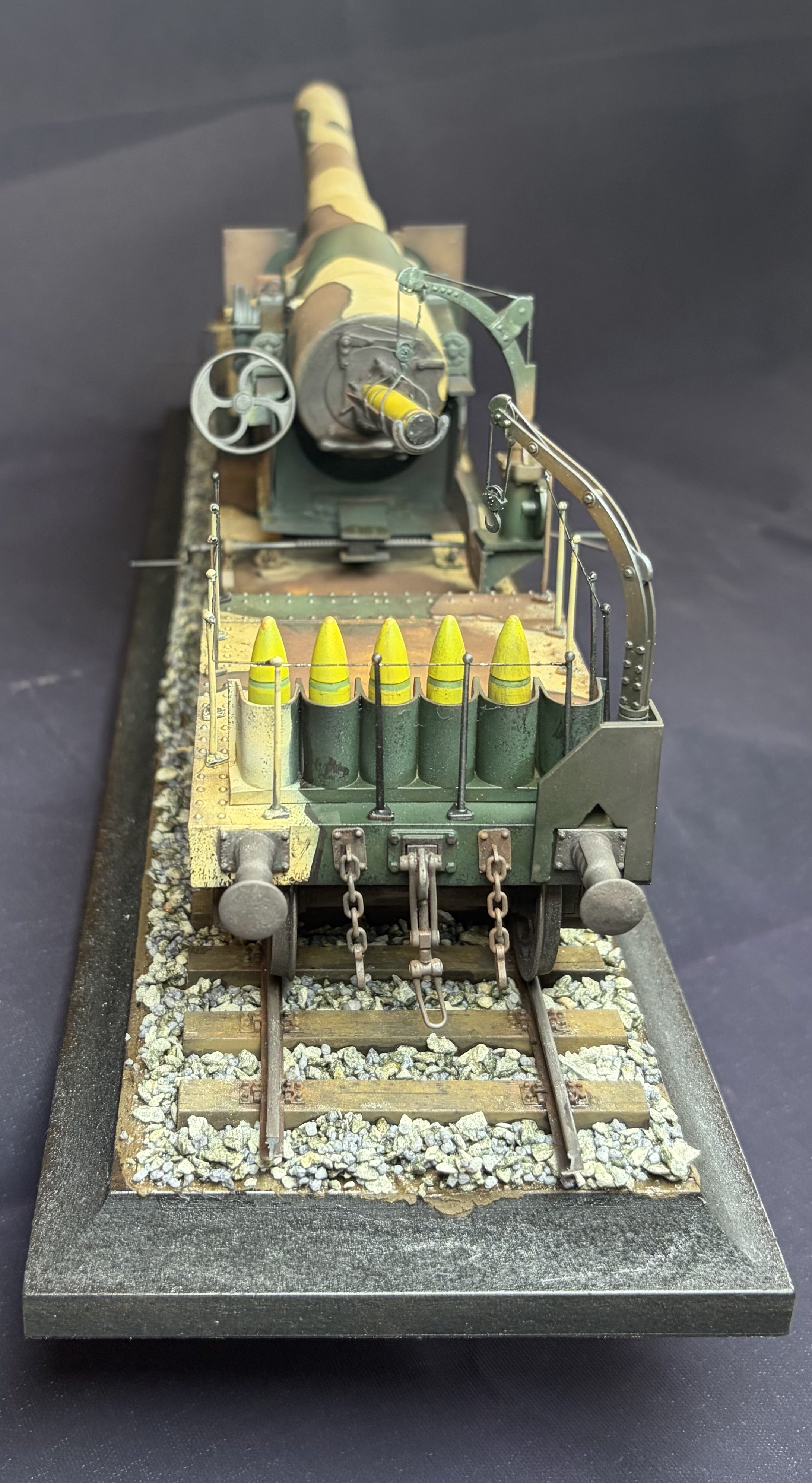

British Railway Gun Series 9.2 Inch Gun Mk1 (1916) by RGL - DModels - 1/35 - RESIN

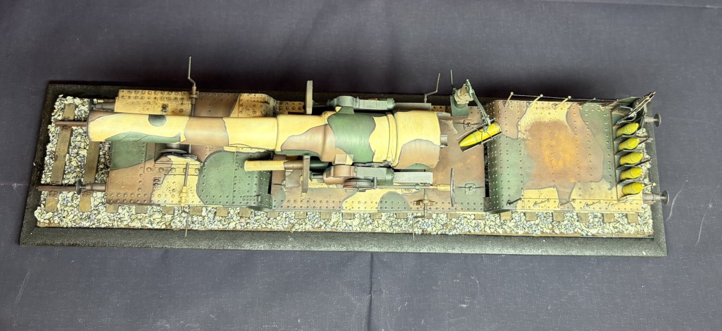

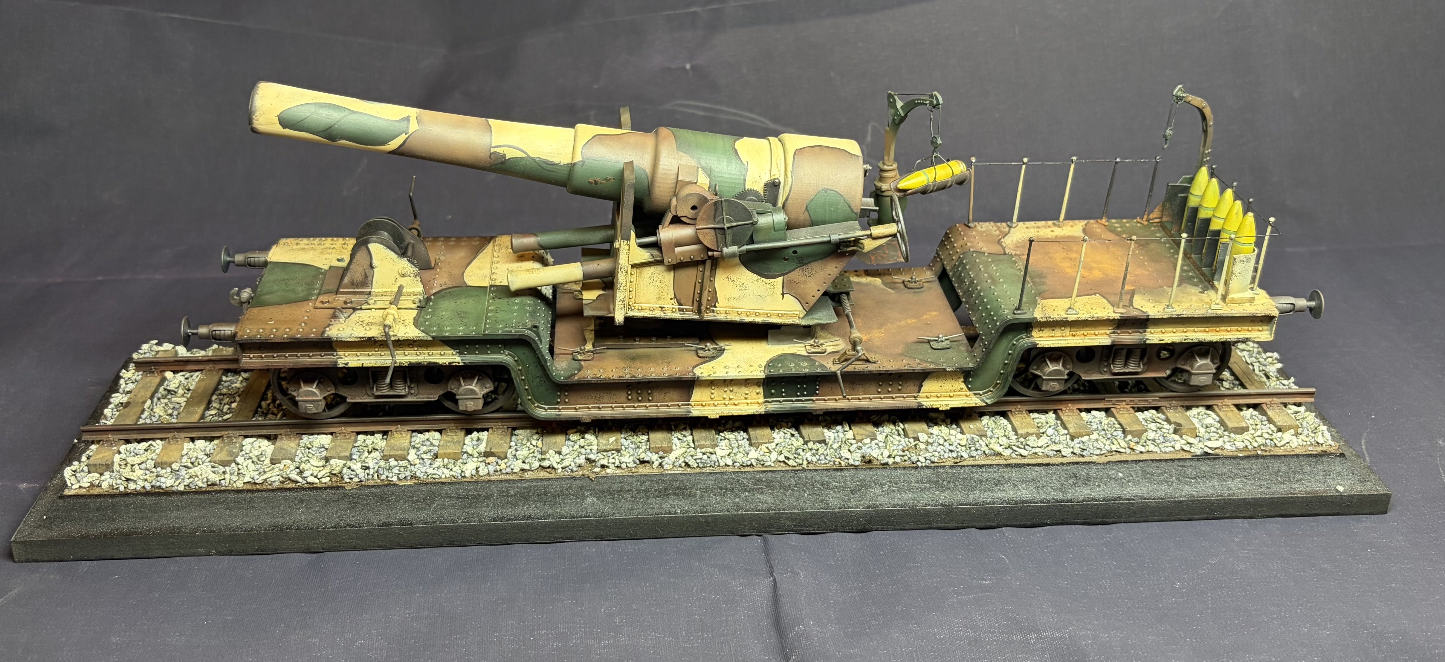

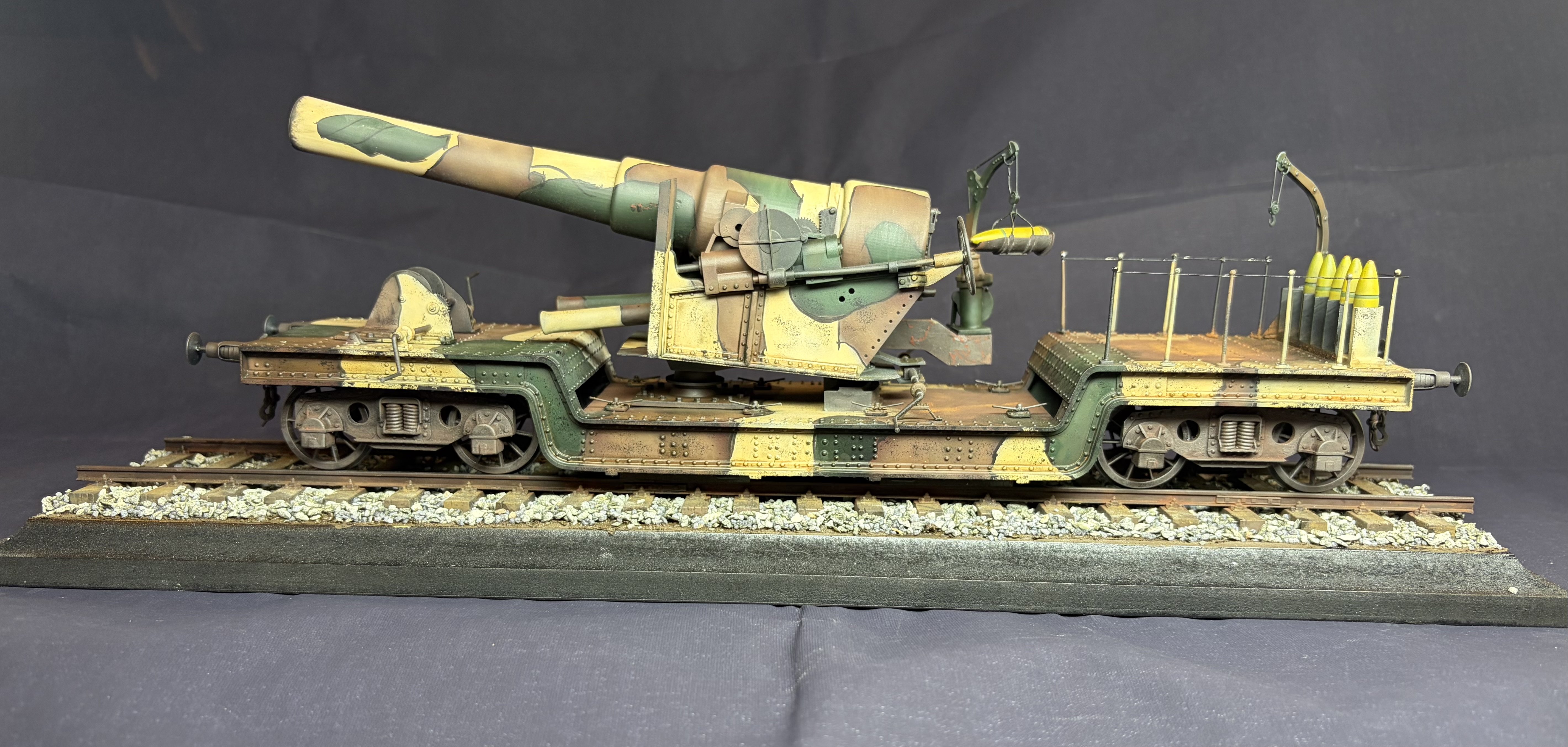

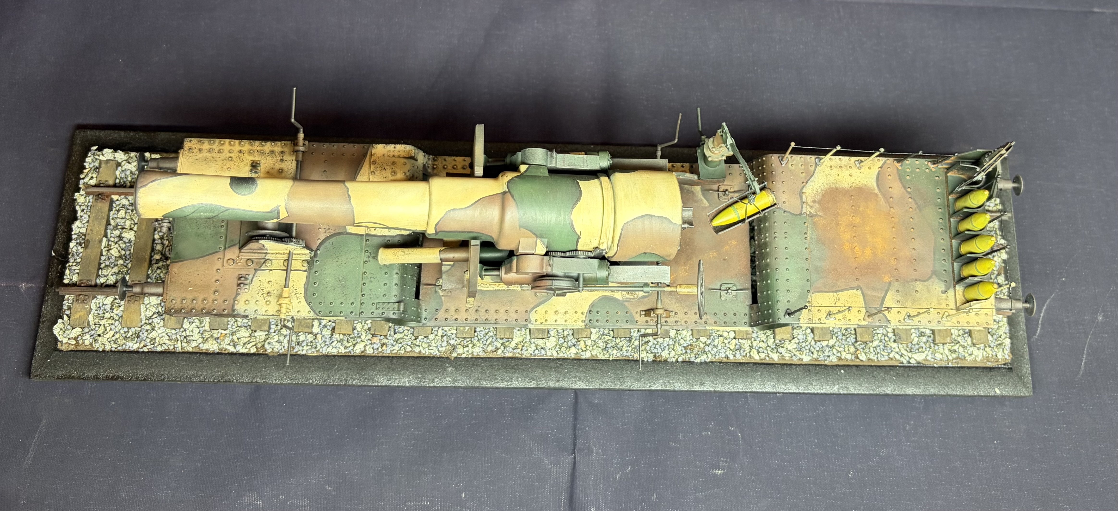

I got this off a Facebook Buy/Swap/Sell for about half of retail. It a very big 3d print. Missing was a traversing arm and bracket and some deck fittings which the owner of the rights to the kit was good enough to send the Stl’s which I got printed locally. It fits perfectly on an old base for a tribal class destroyer and I got a set of railway tracks to sit it on.

How were these guns trained? I know larger one were put onto curved tracks, but in SE England coastal valley, there doesn’t seem to be much space. Or were they rotated? But then one would need some lateral supports on the rail-carriage to take up the recoil forces.
Nice paint job, btw.
Quick scan on wiki: theMk1 truck allowed for a 10 degree left-right traverse and a 28 degree elevation. Therefore: limited range and limited possibilities for proper aiming….
(And my guess is that the railway didn.t take the recoil very well, especially when the gun wasnt parallel to the track)

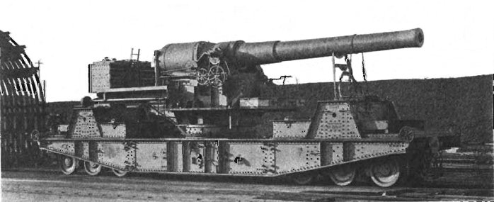

This was coast defense railroad artillery.... And the D-Model designation is Mk I which is the designation of the carriage not the gun itself... The Gun itself is a Mk III to a Mk VI  adapted to the Mk I deep well railroad carriage...

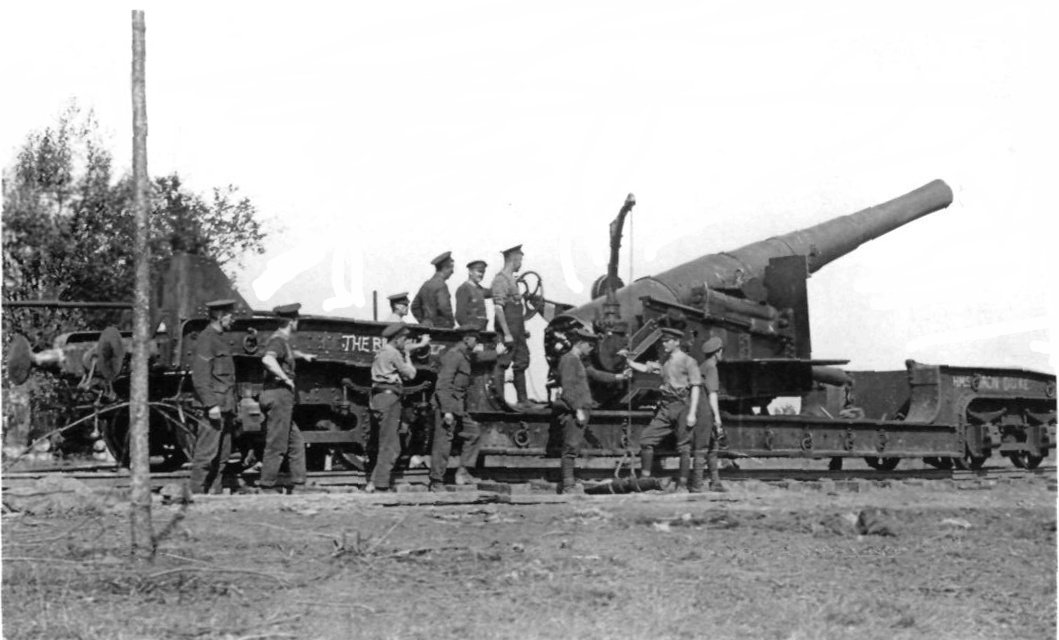

Here is a picture of one in operation in France....
BL_9.2_inch_Railway_Gun_Maricourt_September_1916.jpg.a838def07c814272b67a4e455dfdf606.jpg
from "THE FIELD ARTILLERY JOURNAL". VOLUME VII NUMBER 2. April-June 1917. THE UNITED STATES FIELD ARTILLERY ASSOCIATION WASHINGTON, D. C. Downloaded from http://sill-www.army.mil/FAMAG/1917/APR_JUN_1917/APR_JUN_1917_FULL_EDITION.pdf This photograph Q 4280 comes from the collections of the Imperial War Museums.
Photograph of British BL 9.2 inch gun, Mk III* or Mk VI HMS Iron Duke, mounted on Mk I railway truck, in action at Maricourt, France, during the Battle of the Somme Sep. 1916.
There were no  Mk I guns produced in 1896 as they were deemed deficient.... Most of these guns were reclamations from the Royal Navy as they replaced them on their capital ships...
The Guns had a 10 deg traverse left to right on the mounting any further traverse was accomplished by moving the gun on it's curved track to change it's bearing on target... It's elevation was 28 degrees which was improved to 35 degrees sometime in 1916...
All of these guns were scrapped after WWI... The only ones that were saved were the Mk XIII model and those are the ones that served into WWII... They were mounted on a straight back carriage.....

Beautiful model Brother....
