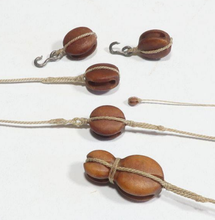

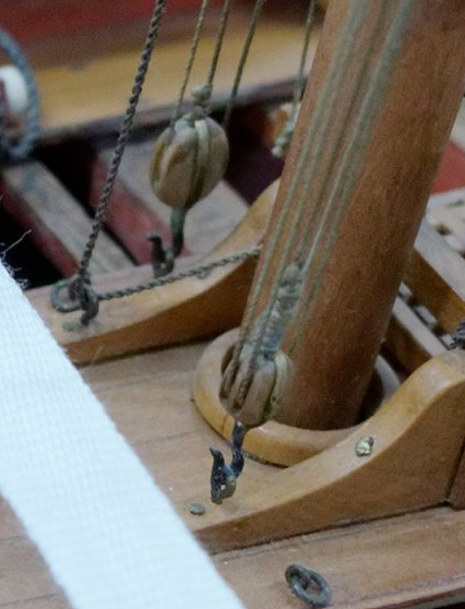

Dziadeczek's comment is one of the best you will get. While you are looking to get it right, you might note that blocks, being part of a tackle would not have been stropped to an eyebolt on the deck like shown in your instructions. There would be a hook on the block and it would hook into the eyebolt. You will see how to strop a block with a hook in the tutorial Dziadeczek posted. From the tutorial.
