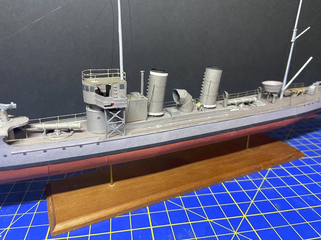

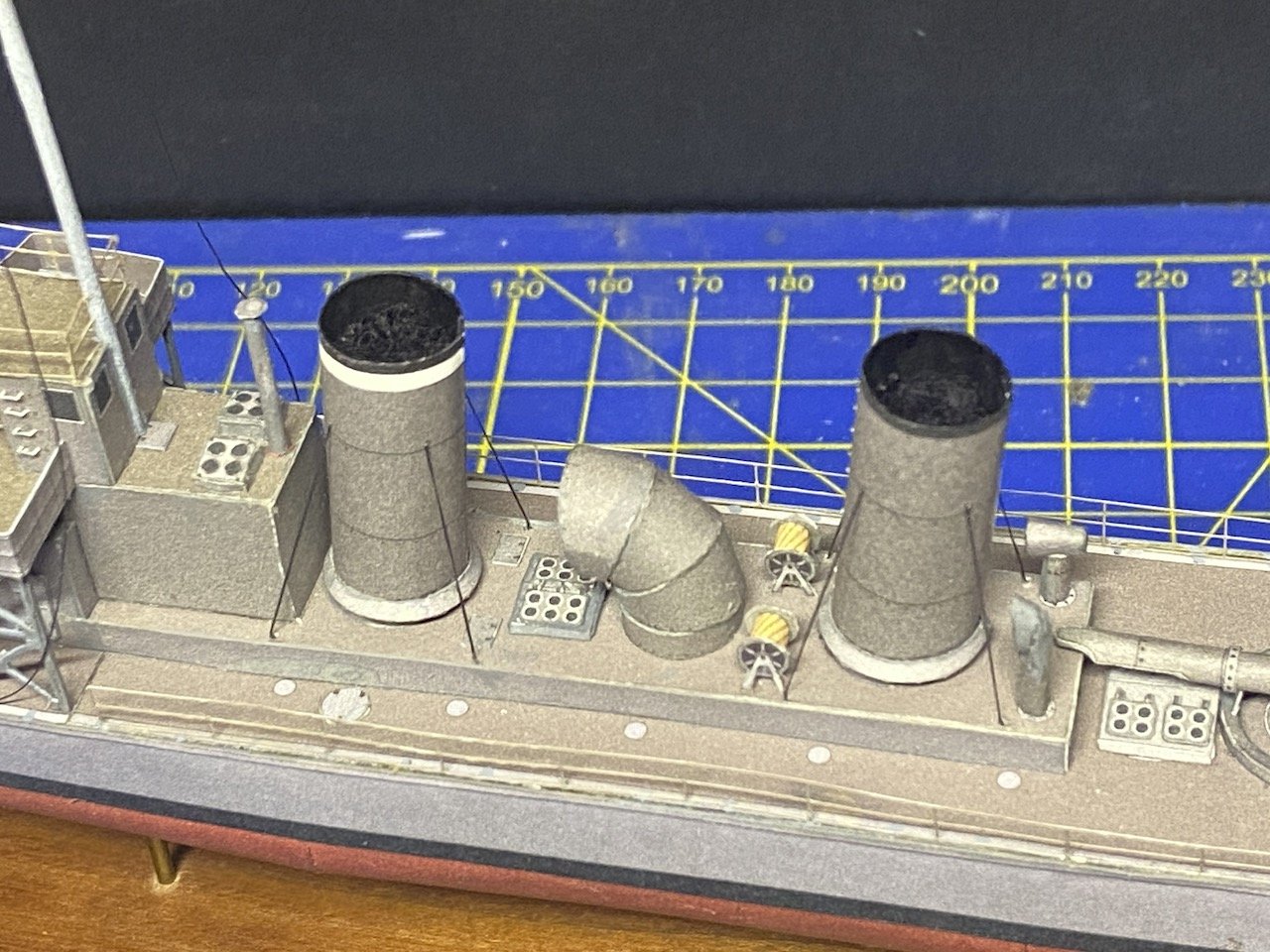

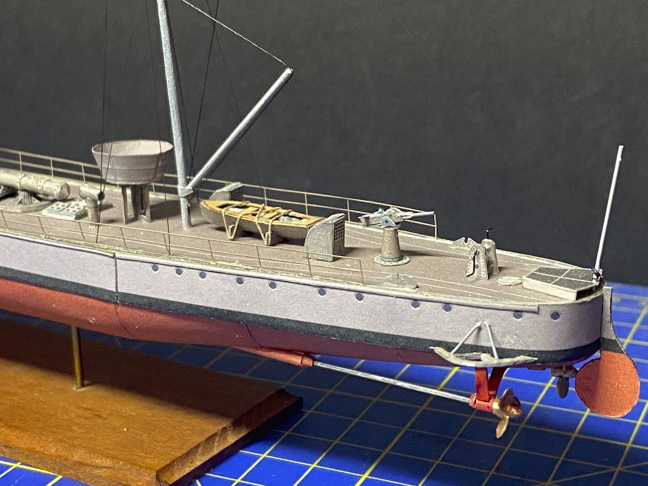

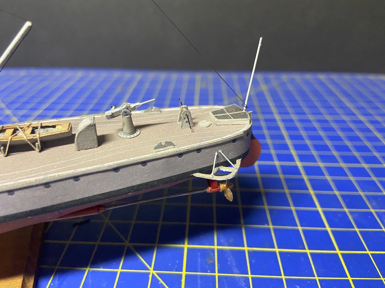

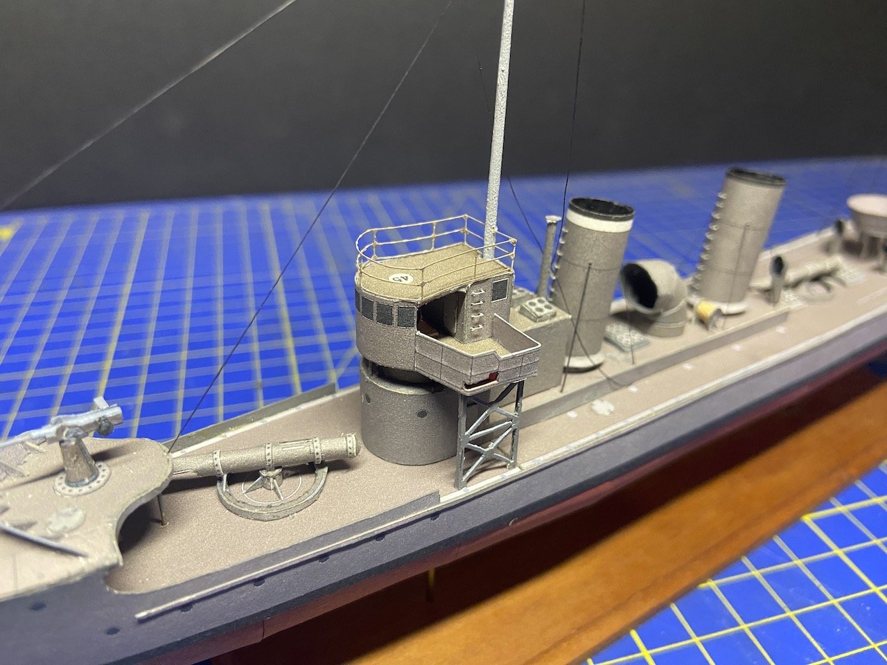

Having just finished my first steel navy paper model, the German WWI torpedo boat V108, it seems appropriate to start a blog on this new paper model project, USS Bagley on Pearl Harbor Day. I say appropriate, because the destroyer Bagley operated in the Pacific and was moored at Pearl Harbor on the day of the Japanese attack. Bagley's crew manned her .50cal machine guns and claimed to down a number of Japanese aircraft, though this couldn't be substantiated with all the anti-aircraft gunfire taking place. By mid-morning, she headed up the channel and out to the open sea under the command of a junior officer, as her captain, XO, and gunnery officer were still ashore at the time. The ship was the lead ship of her class, built in 1937, as a "Treaty Era" destroyer, which limited her displacement to 1500 tons. She had an active wartime career and earned 12 battle stars. The ship survived the war and was decommissioned in 1946. The Kit This kit is published by the Ukrainian company Avangard, and depicts the ship in her 1944 configuration, with camouflage. She was armed at this time with 4x 5"/38cal guns in single-gun turrets, 6x 20mm anti-aircraft mounts, a twin 40mm mount, 16x 21" torpedo tubes in four quad mounts, and 2x depth charge racks. Some of the printing, particularly of the decks, seems to be a bit too dark, and it’s hard to distinguish some of the printed details. I suspect I might end up having a hard time placing some of the parts because of how dark things look. I contacted the publisher about this, as I didn’t know if this was normal. As it turns out, due to the war in Ukraine, the company has been limited on available paper supplies, and the paper they have been able to get doesn’t absorb the ink the way that they would like. This may be too much of an issue for some. But, I think I will be able to manage. It will help that there is a jpeg image of this sheet posted on the company’s Facebook page, with the printed part numbers appearing more clearly. One thing that threw me, which had to be explained to me by someone at Avangard, is that there is one page that is clearly out of place. It’s a second page for the lower hull of a ship, but it’s different than the Bagley’s hull, and even has a label that says IJN Asashio. Apparently, this is not a mistake. There was a measurement error in the earlier Asashio kit, and there was extra space in the Bagley kit, so the publisher just stuck in the revised sheet. I’m just glad it wasn’t a error in my kit. The kit has almost no text, except the ship history. But, what text there is, is in English. The drawings seem clear enough. Of course, only an actual build will determine if there are any construction issues with the kit. Along with the basic kit, I ordered the laser-cut frames set as well as the details set, which is basically all of the railings, ladders, and other fine parts. All told, I think I spent less than $60 for the kit and accessories sets. I had a very hard time purchasing this kit, but no fault of the publisher. Living in the US, I discovered that it’s almost impossible to get any paper model products from Europe. I tried to buy this kit from Fentens (Germany), GPM, and Orlik, but none would ship to the USA due to tariff and customs issues. I only got lucky when I contacted Avangard directly about my situation, and they were able to help me out on a one-time basis and get this kit and accessories sets to me directly. Many thanks to Avangard for their help! Instructions and Parts I don't really have much experience with most paper models, except Shipyard kits, which are kind of their own animal I think the Avangard kits are pretty typical in terms of instructions and parts. There is no written instruction at all, only diagrams are provided. Interestingly enough, the only text is on the inside front cover and back cover, which are only written in English. Building Begins... The beginning stages of construction of paper models, seem pretty straight forward. These parts are from the laser-cut frames set. At 1/200 scale, this is a pretty good sized hull, just about 20-1/2" long. I'm not sure if I did this the way I should have, gluing the upper and lower hulls together at this stage. But, it's all a learning process. Don't know how much time I'll spend on this model, so it may be a slow build, but construction has begun...
Thanks, GrandpaPhil! I had a lot of fun with the build – Certainly learned a thing or two!
