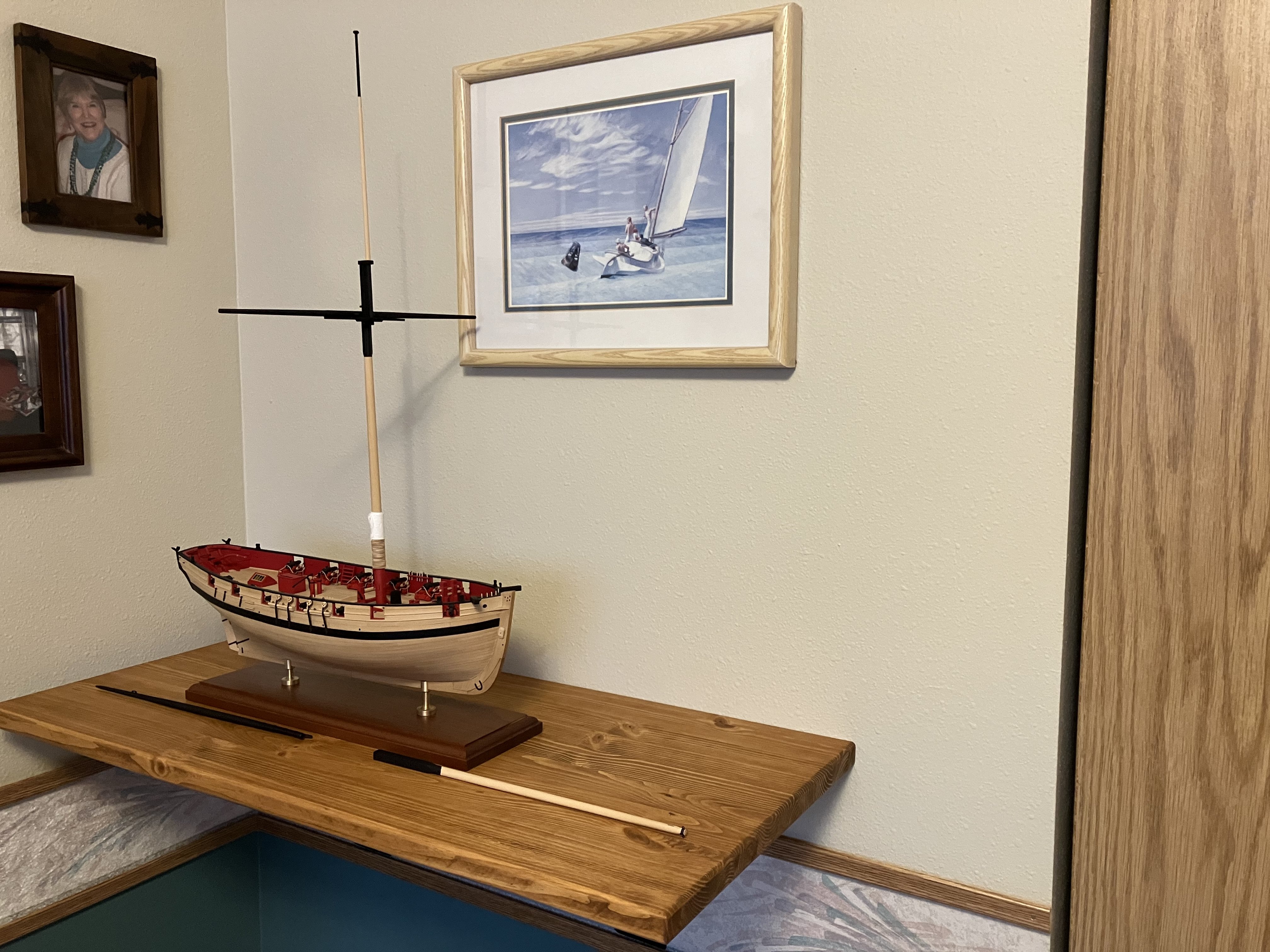

I haven't posted an update in a while.  With warm weather and long days, I've been enjoying springtime outdoor activities, so work on my Cheerful has been on a seasonal back burner.  I have found some time to get the shelf built where Cheerful will eventually live.  I'm using a shelf that is made from edge glued pieces of wood,  I've sanded it down, rounded the edges, and stained it using an oil based stain.  It's an odd size of 33 1/2 inches long by 14 3/4 inches wide.  It looks big compared to the hull of the ship, but as you can see from the spars I've temporarily laid out, when fully rigged, the ship will be much larger.  The shelf is a couple of inches longer at both the bow and stern than the length of the ship with the boom and bowsprit installed, and an inch and a half wider than the main spar.  I located the studs in the wall and attached the shelf with two 10" x 10" L shaped steel brackets screwed into the studs with 2" screws.  As a fan of overkill, I think the shelf would easily hold 100 pounds.  The goal was to have it be as solid as possible so that when the ship is finished, if I ever bump the shelf, it won't move at all and damage the ship.  I'll just have to live with a bigger bruise if I bump it.  Haha!  Also, I put a lot of thought into what height I wanted to display the ship.  After much measuring, and taping the fully rigged plans to the wall, I settled on a shelf height of 46 1/4 inches, which when the Cheerful is on it's base, puts its cap rail height at 52". The photo is taken from my eye height.
This photo is a quick grab shot with my phone.   When the ship is finished and ready for display, those pictures on the wall will be moved.  Also, it's hard to see in the photo, but there is a 2 inch gap between the stern end of the shelf and the wall.  I didn't want to center the shelf between the wall on the left and the edge of the closet door on the right, because with it sticking out almost 15 inches I'm concerned it would be too easy to bump into.  That, and it will be easy enough to view the ship from straight in front of it as is.
