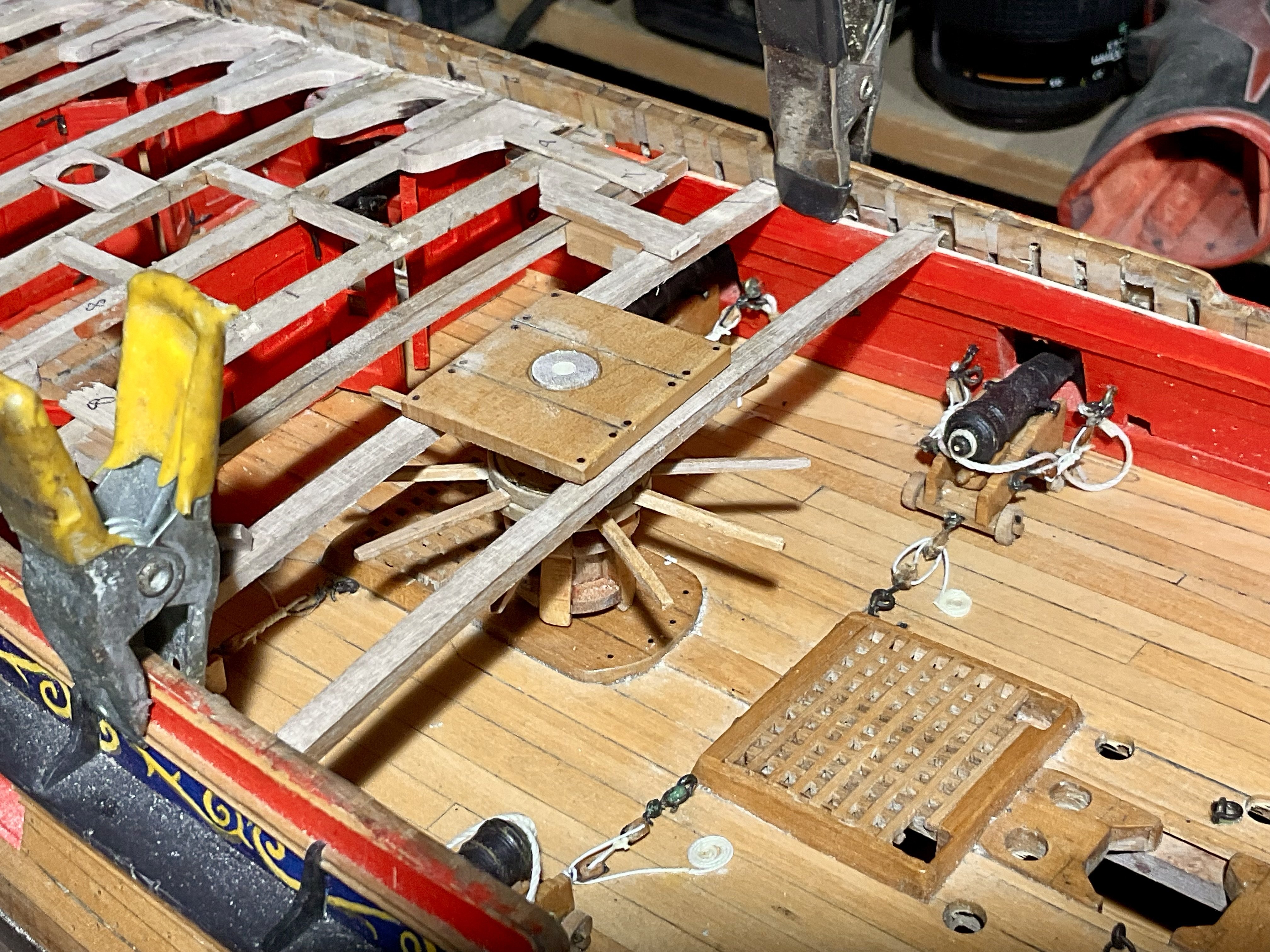

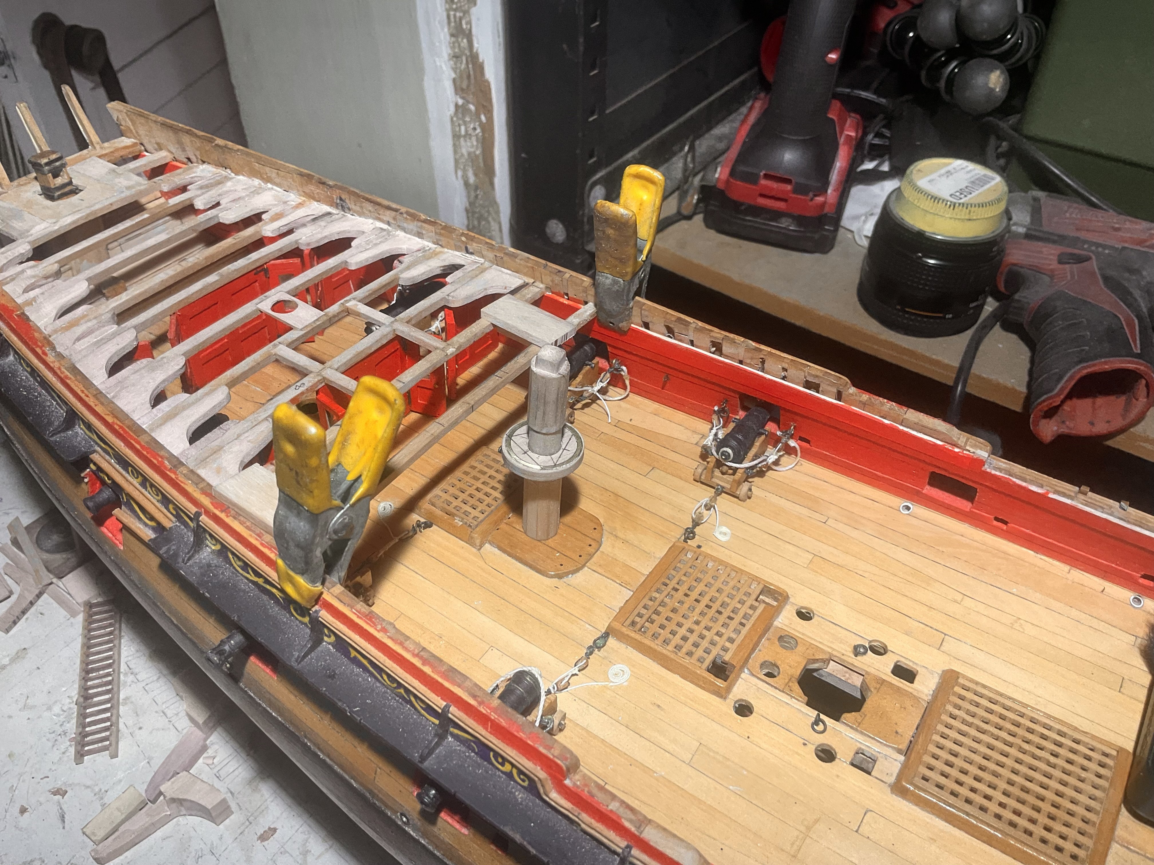

Not sure what I am supposed to see. I did sleep in so maybe I'll need a moment.
A moment later..  I see it, the ring on the too of the lower capstan. Looking good!

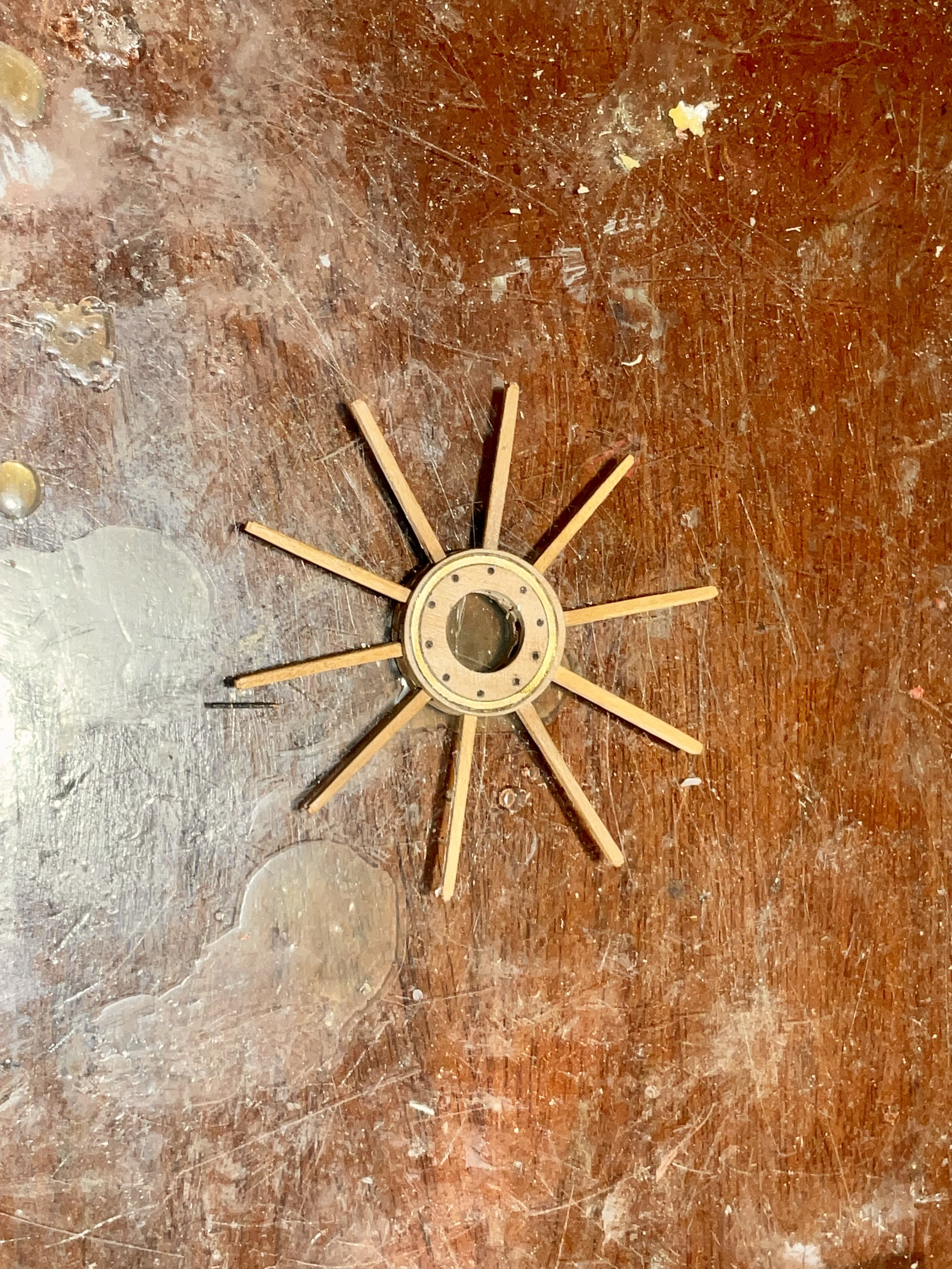

I did not have the correct size mill ends to cut the square holes. This is my first attempt. I will pick up some when i am in New York in 2 weeks time. I am not unhappy with this 1st try and know ill get it better. Some of the markings on my rotary table  have worn off so it makes it difficult to cut the holes   spot on. Trying to solve that issue.
They can easily be cleaned up with a very narrow chisel, if you have one.
If not, possibly I can bring you one  😃
Alan O'Neill
forgot to mention is was very cold this morning up here.
Alan O'Neill

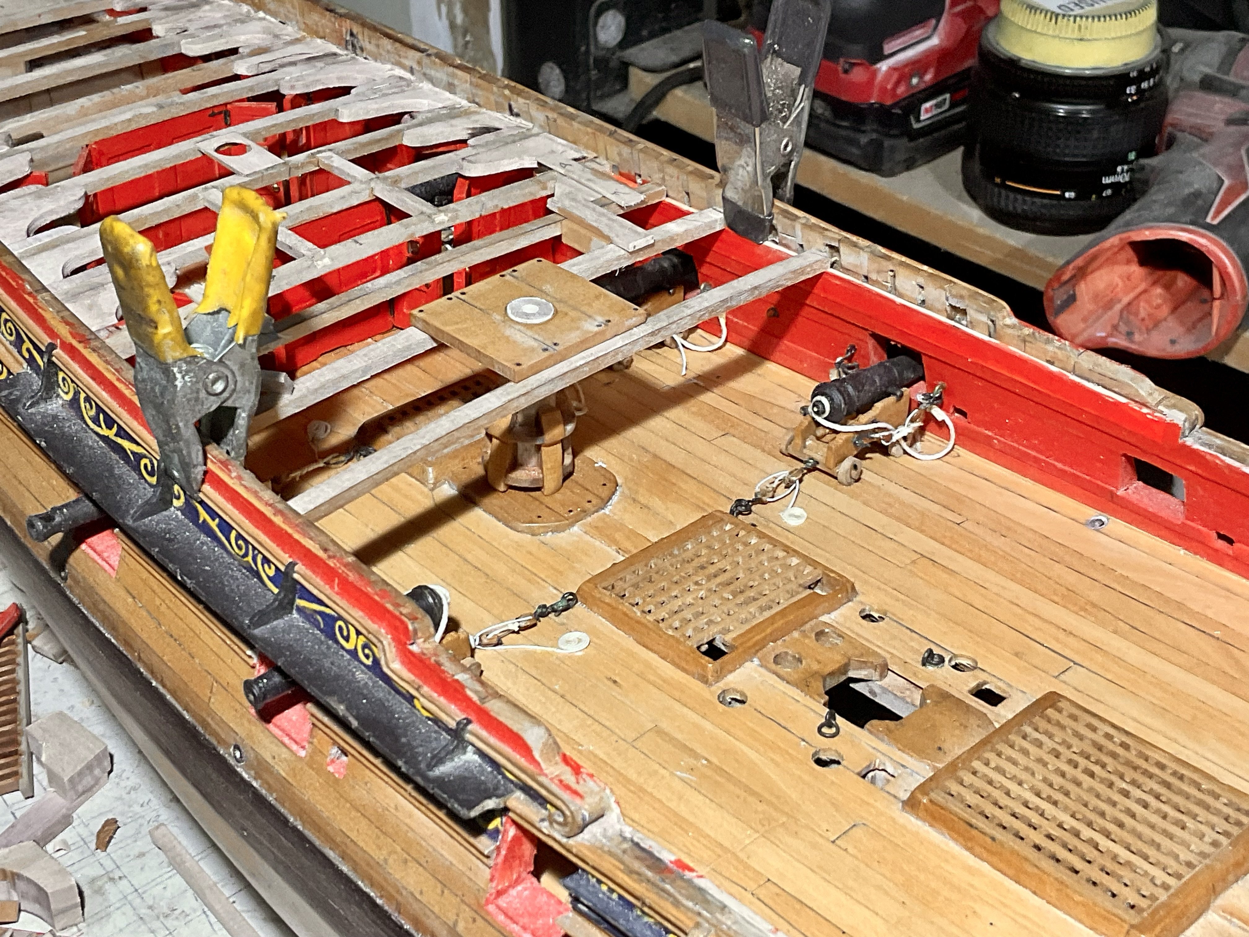

She’s coming along! Nice.  I like the
 white deck framing. Makes that really pop. I have a grandson who’s handy with a 3-D printer and was happy to print me up a ring in black for that capston.
Henry
Yes Alan i do have very fine chisels. But i want to horn the technique to film it so that i can share what Greg showed in the book. The reason i had trouble cutting the squares is that i did not have a mill end the exact size so used a center end instead. I was more interested in the technique than in the exact finish. I also  went about constructing the part different than what Greg showed in the book. Stretching my skill to try figure it out my self. . Next  time i will construct  it the way he built it and then decide which method is better.  I need some  new mill ends to do it his way.
I only have a few days left before i leave for New York so the next video will be last week of January next year so i  have time. Also my rotary table has most of the numbers missing so i have  written to  Sherline  to see how i can have them replaced. perhaps with a sticker. Failing that i will just have to mark the major stop points temporarily.  Thats the only way to get them to line up exactly.
also Greg used a dark wood insert, Ebony, i used a brass strip which was not the correct width. I may stick with that as it worked well, but might try cutting it out of a brass sheet.

I think those markings on the rotary table are laser engraved, Kevin. I've had my rotary table for almost twenty years and it still looks new. Have you tried contacting them for a solution? They are very responsive and once repaired my lathe for a minimal fee as well as replacing numerous old parts without charging me.
As for those square holes you need to fix I could envision using your smaller mill end and making a very small second cut a half a degree away or so. You only see the outside opening so the inside shape really doesn't matter.

i wrote to sherline and they did say it was laser etched and that i  could send it back and they would redo it for me for only $60. Plus freight. When this is all over i will send it up some time next year. I was hoping they had a tape that i could stick  on the side, they thought it was a good idea but have not been forthcoming.
The square hole were not done that well done  because i did not have the correct size mill end and i used a center drill which i knew i would give  trouble.  When i get back in January i will be redoing everything and filming the process as i  will have all the correct tools.

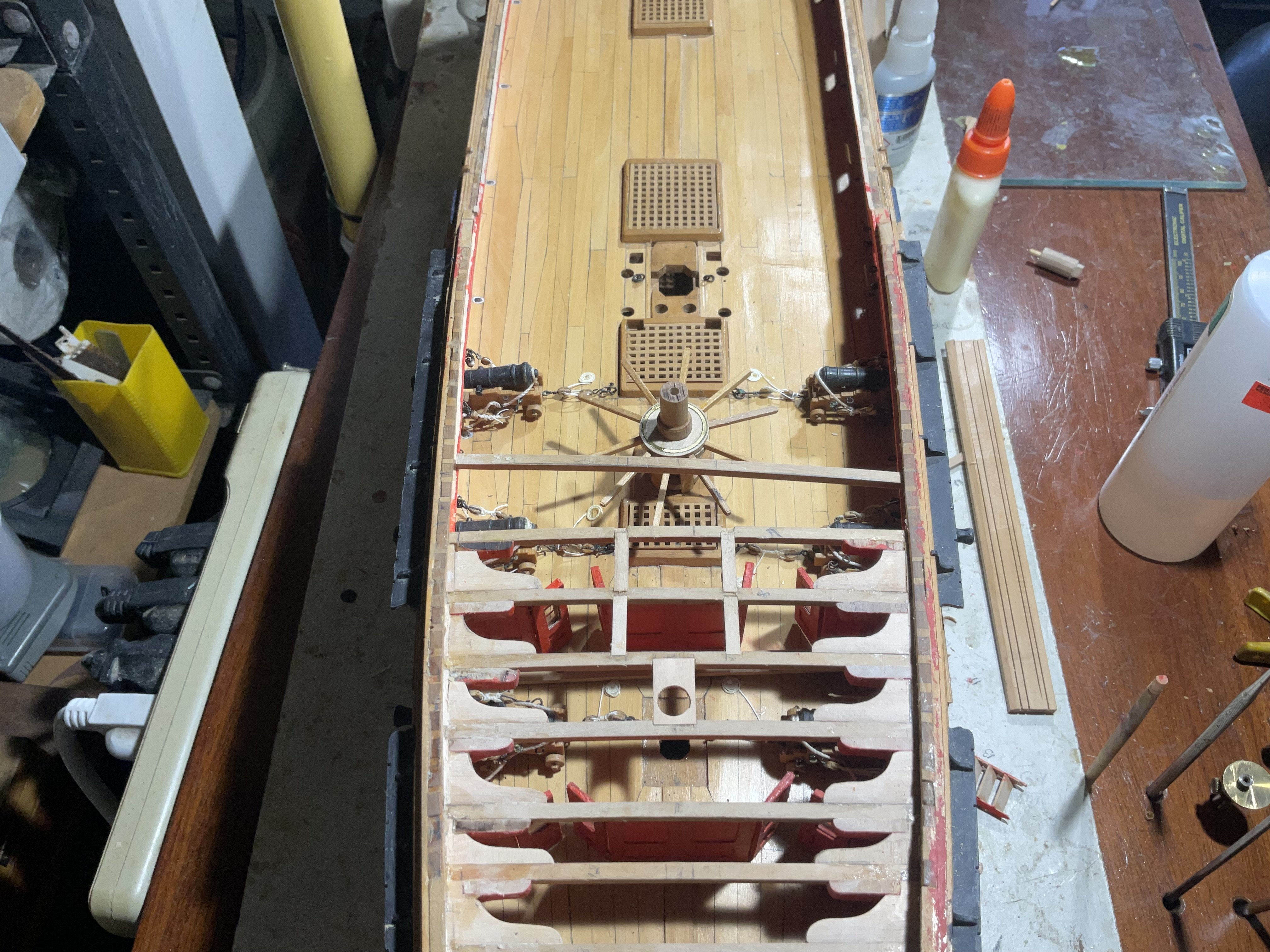

i also had some creap with the deck beams so have to cheat a bit, the Capstan center hole lines up perfectly, so at least that good.  Its nice to get back on the mill and lath.

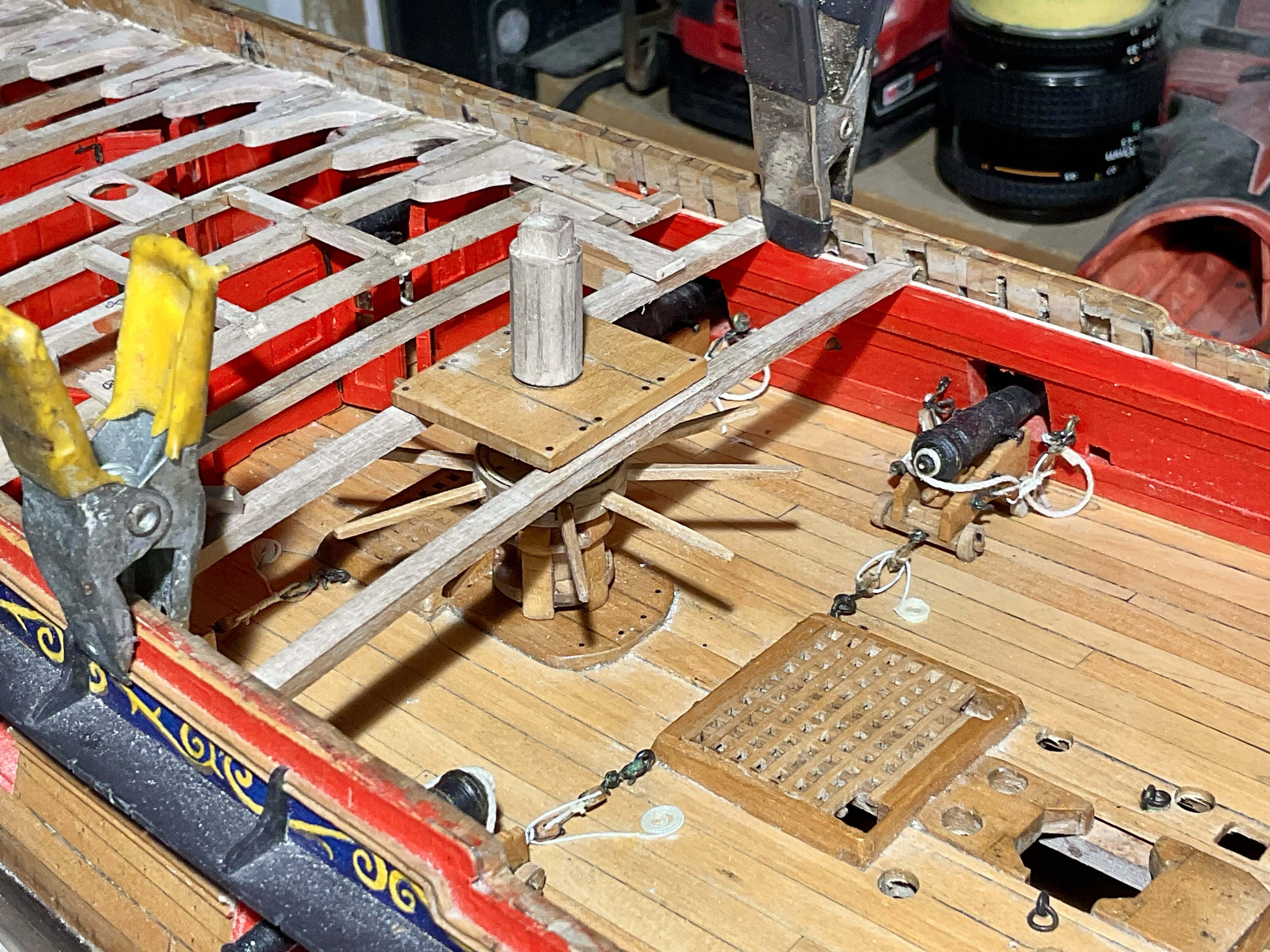

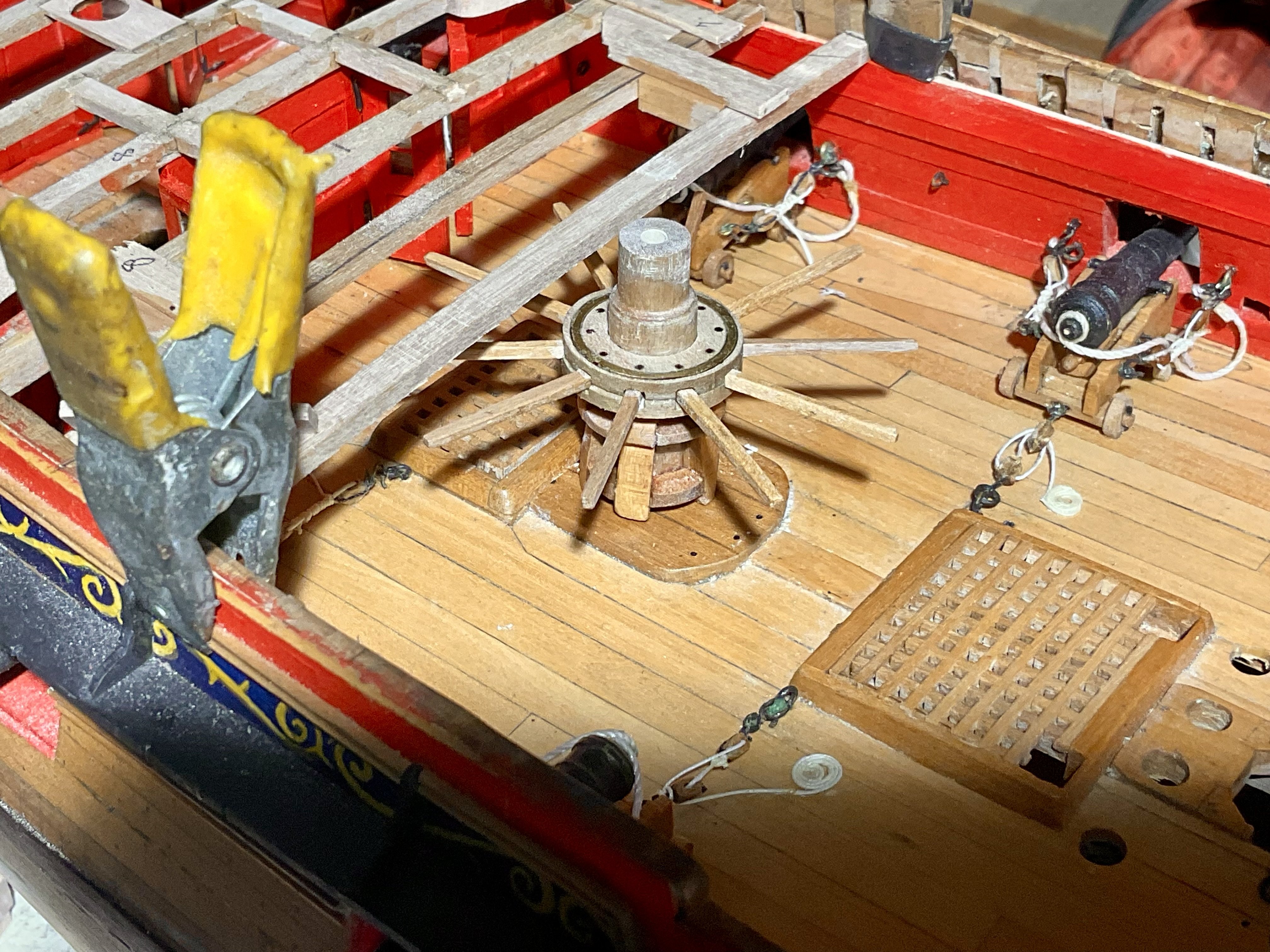

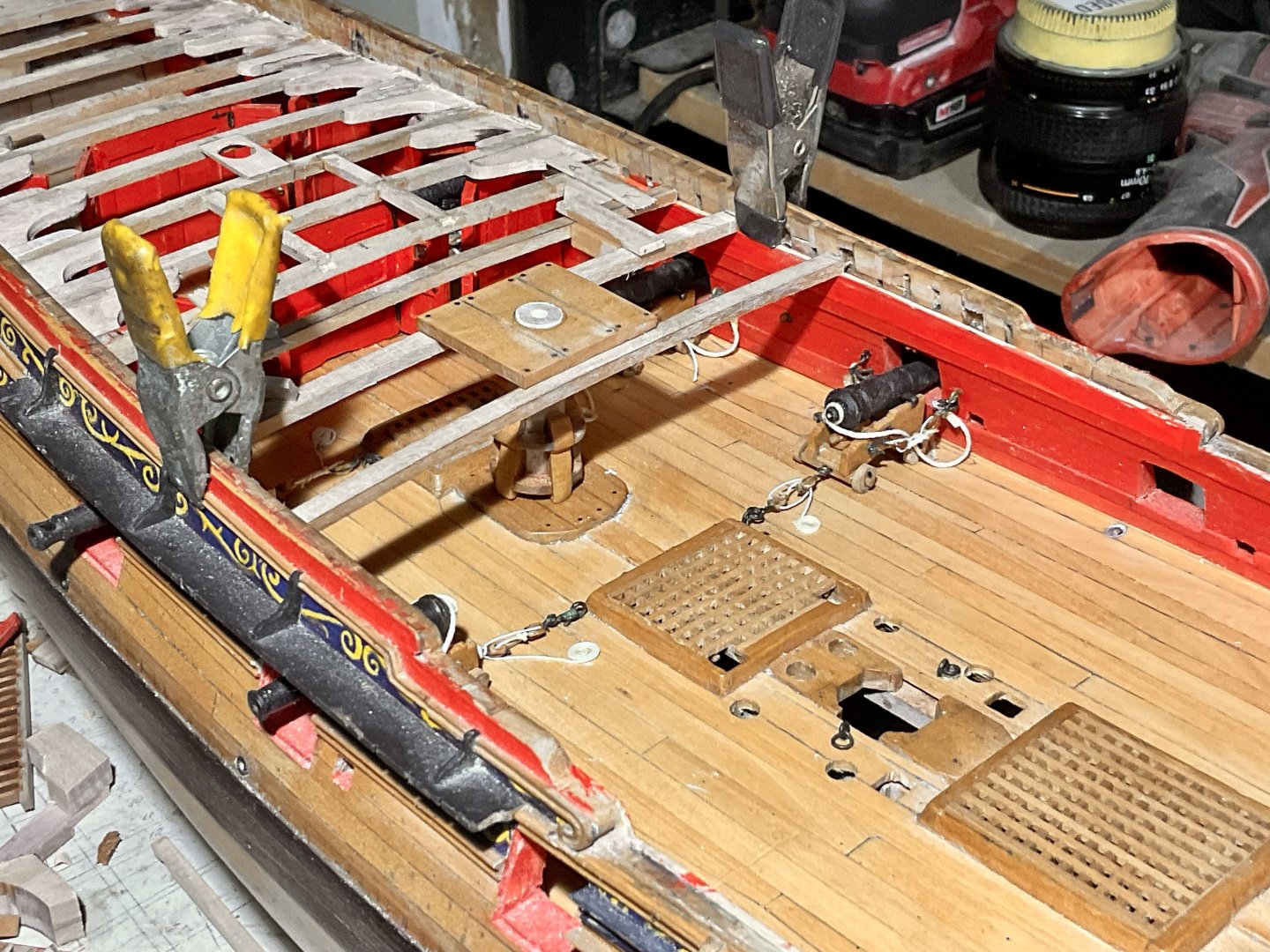

Finial fitting of the lower Capstan. I had to fit the last two beams which are slightly wider than the rest to be able to get the finial height of the barrel. . Then added the partner and adjusted the Barrel so it is just above the level of the partner. That is it for the year as I am off to NY to cut down a christmas tree and role in the snow. Thank goodness for alcohol.
