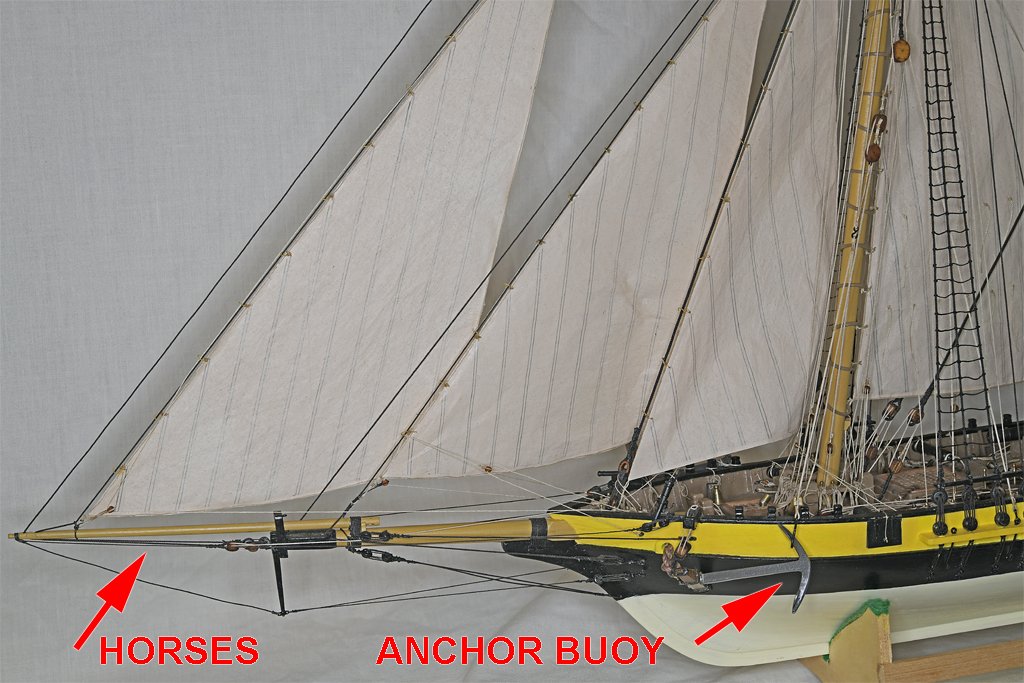

Here is a bit more progress. I have added foot ropes to the bowsprit. Apparently these ropes were called "horses" up through the end of the 1700s (in English). Then they were called "man ropes." Today to be politically correct perhaps we should call them "people ropes." Horses, manropes, people ropes - they are all silly. Obviously they are foot ropes (or footropes)!
Footropes1.jpg.22201526510a2bdd1e09256bb6ca5dd5.jpgFootropes2.jpg.4c23a2602414fc9b38cc187f8c3ffcb2.jpg
When I started investigating how these ropes were attached I found varying opinions - probably all correct for particular ships at a certain places and times. Lee's Masting and Rigging of English Ships of War says the ropes were attached to eye bolts on the sides of the bowsprit cap. But he talks about large square rigged ships of the line and doesn't belittle himself to talk about the other less important ships like schooners. But I have seen foot ropes on schooner models rigged this way.
Lever's The Young Sea Officers Sheet Anchor, Marquardt's Global Schooner and Mondfeld's Historic Ship Models all say the rope was looped around the jib boom behind the bowsprit cap and lead forward to the end of the boom. This is how I have rigged it on this schooner model. The forward ends of the lines could be attached to the end of the jib boom with a cut splice or two eyes. I used two eyes.
The books say that often knots were placed at intervals to give the sailors better footing. Again there are different opinions. Depending upon which author you read the knots were this type, that type or some other type. But most say overhand knots were sometimes used, and this is good enough for the model. However, bosun's mates like to tie fancy knots. Left to themselves they often tie elaborate knots to escape the boredom of life at sea, or to look busy when the bosun is looking for someone to do real work.
Now I just need to train the foot ropes to hang in a smooth catenary.

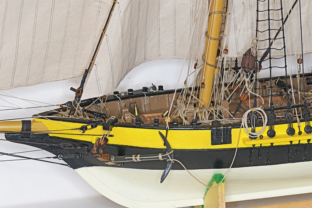

I rigged the port anchor buoy about the same as the starboard buoy, mainly because I couldn't think of a more reasonable way to deal with the buoy while the anchor was being fished. In this scenario after the anchor was hauled up horizontal the buoy was pulled in, tied to the forward shroud, and the rope coiled and tied in place to get it out of the way.
Now I just need to add the flag.

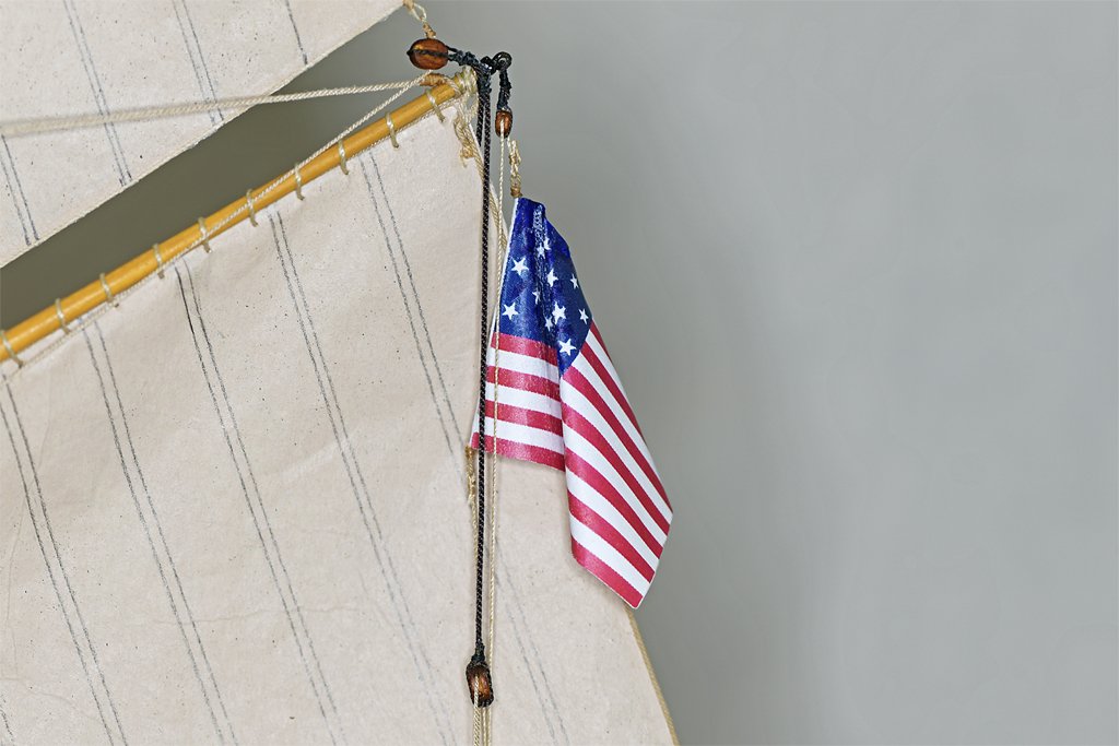

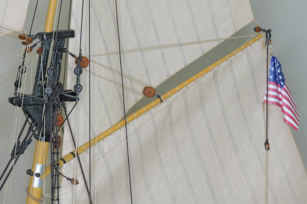

The schooner has a flag! This means this build is finished!! At least for the vessel. I still need to make a better support stand.
Flag.jpg.9c5103932c6be917043b6f5dd0e6b443.jpg15starFlag(17951818).jpg.62a782a0b520d2e0098ebd470b7f3939.jpg
The US used a fifteen star and fifteen stripe flag from 1795 to 1818. This is the original "Star Spangled Banner" from the War of 1812. I guess I had forgotten that the flag ever had more than 13 stripes - if I ever learned it. But I have a 15 stripe flag I received from the Buffalo New York, Buffalo and Erie County Naval and Military Park to commemorate the War of 1812 - guess I never counted the stripes! As more states were added the flag returned to 13 stripes for the original colonies and more stars were added to the blue field for additional states.
I printed the flag on ordinary 24 pound printer paper, with the two sides on one side of the paper. It was folded over and glued together with white glue, with a strand of 0.008 inch (0.2 mm) rope captured in the fold. I made eyes in the rope at top and bottom, and tied the flag halliard to these eyes. The flag was folded over conical files to produce the curves in the flag. It didn't fare too well wit the folding and some of the printed ink flaked off. I had to do some touch up with colored markers.

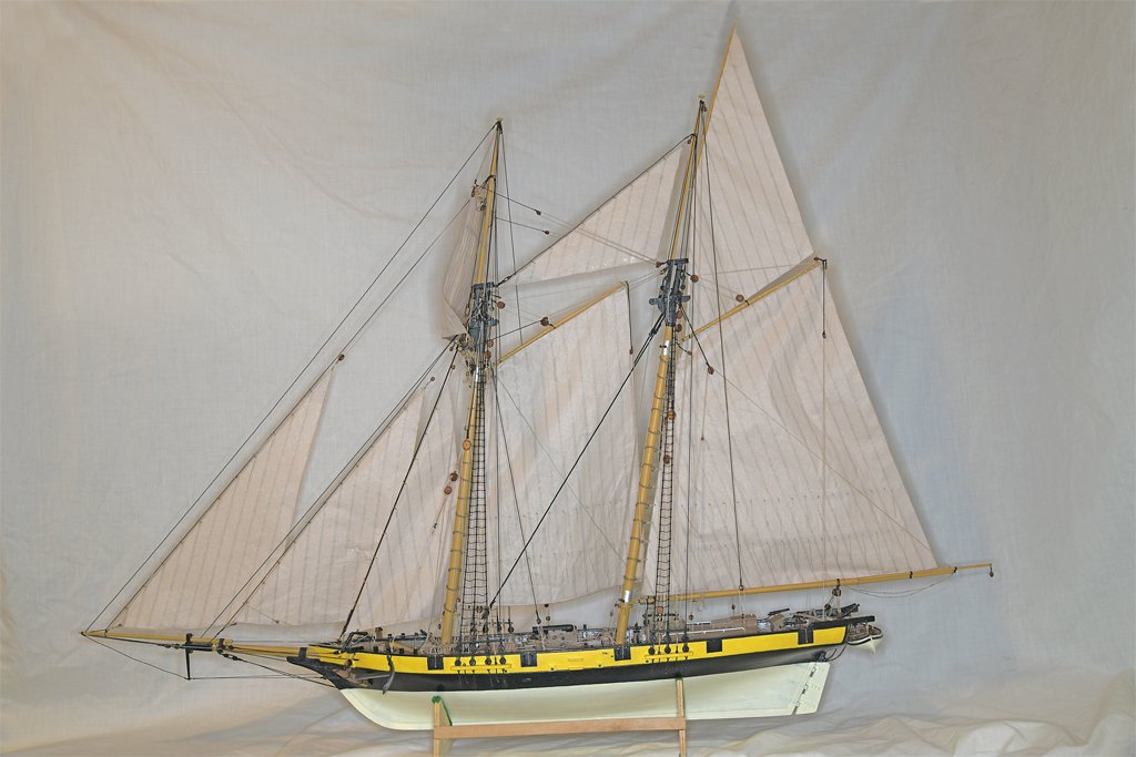

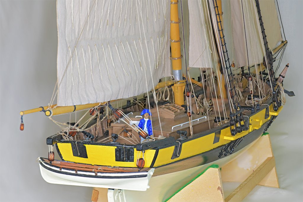

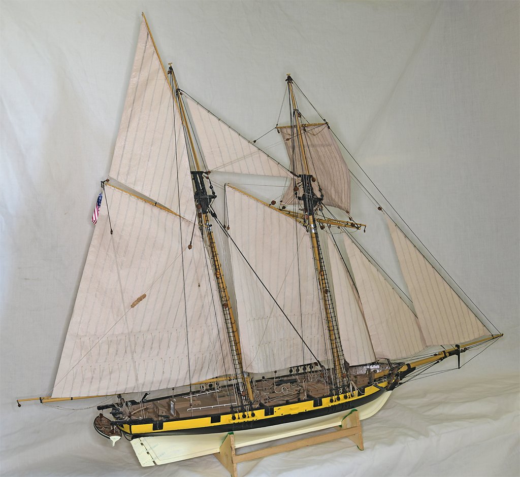

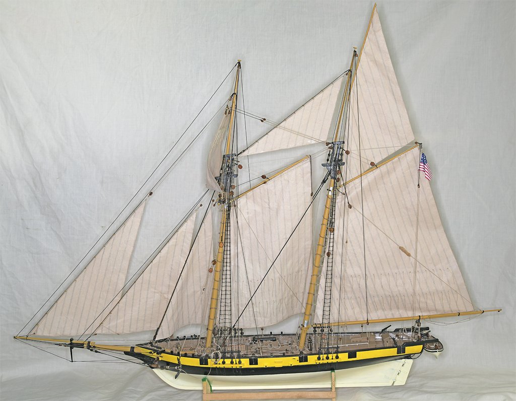

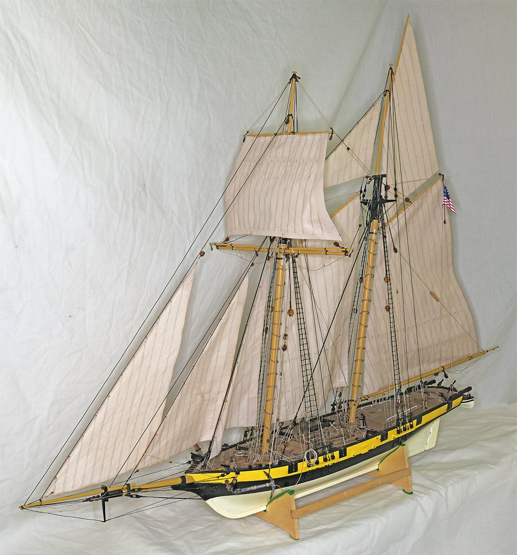

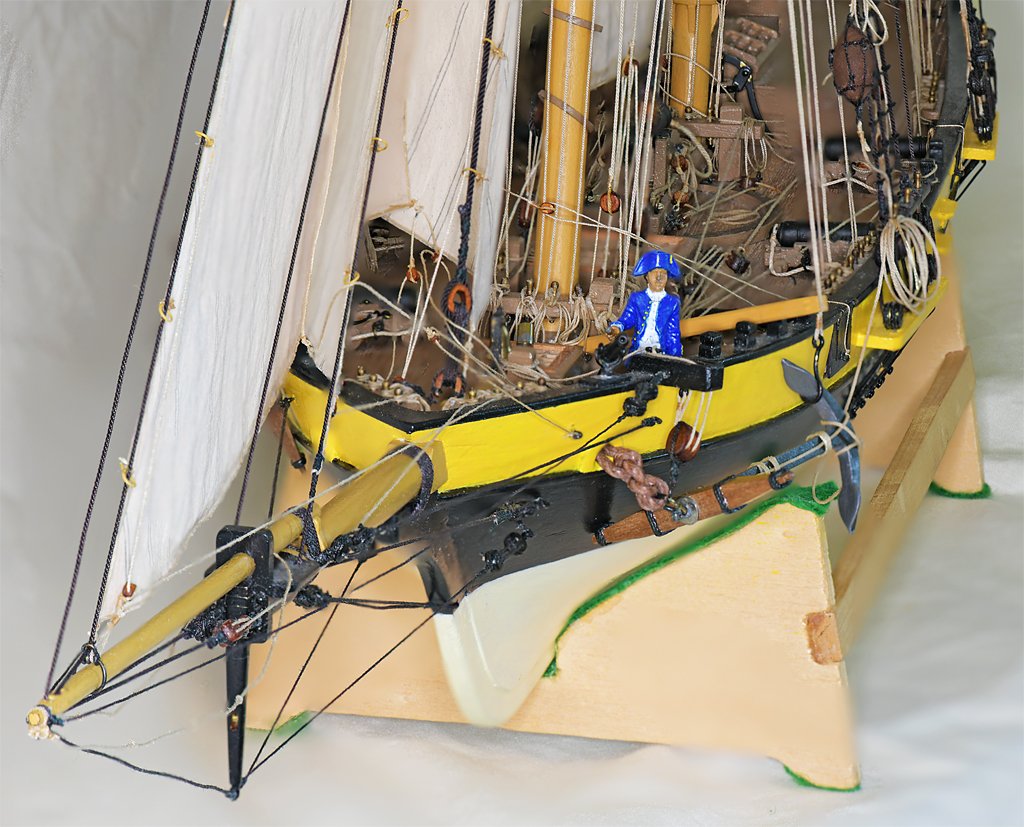

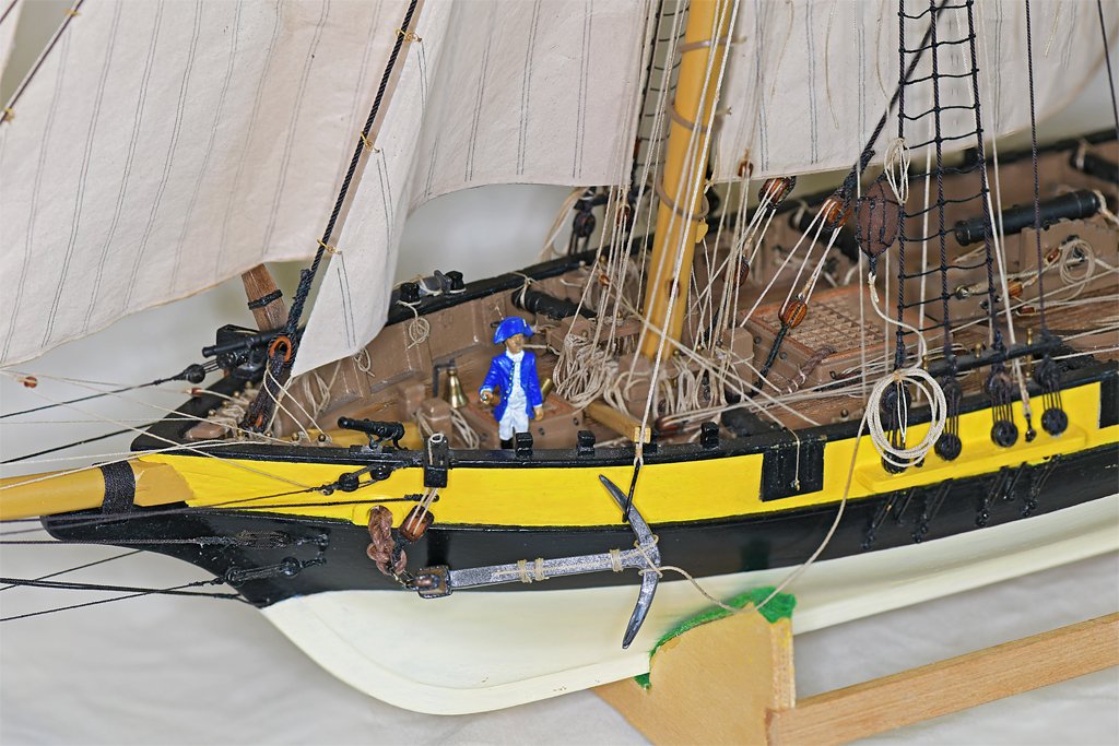

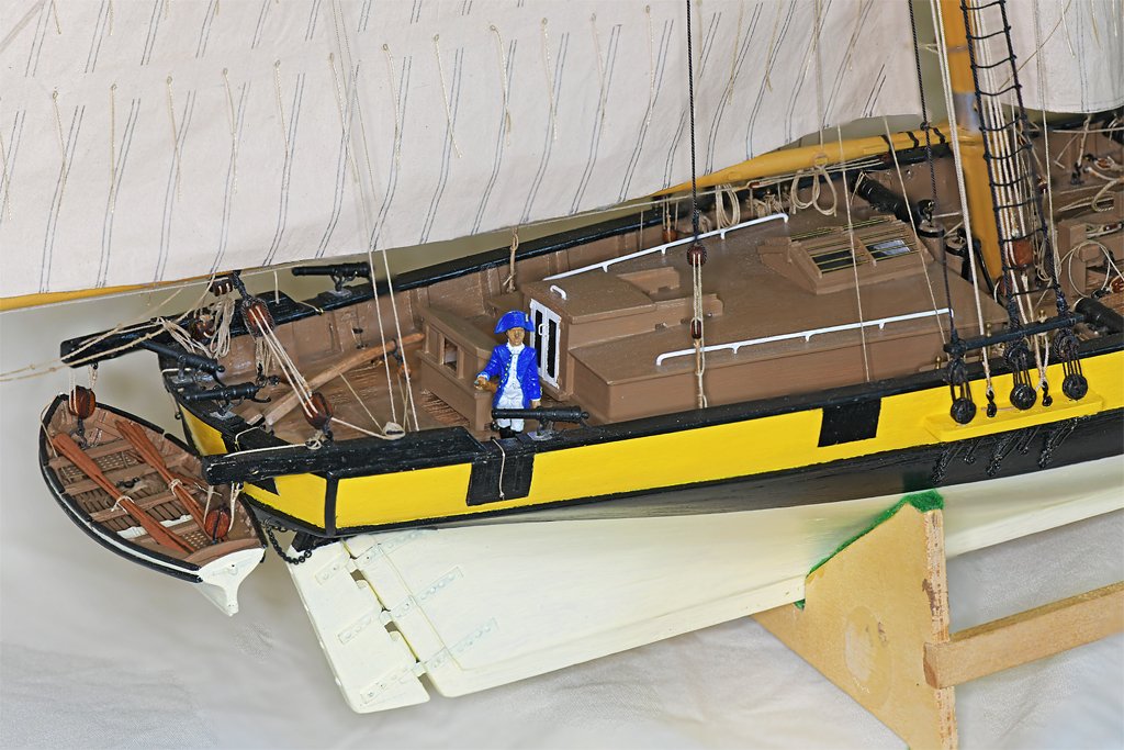

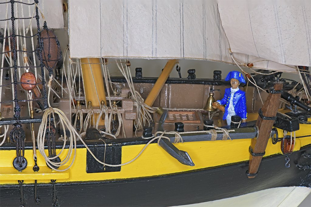

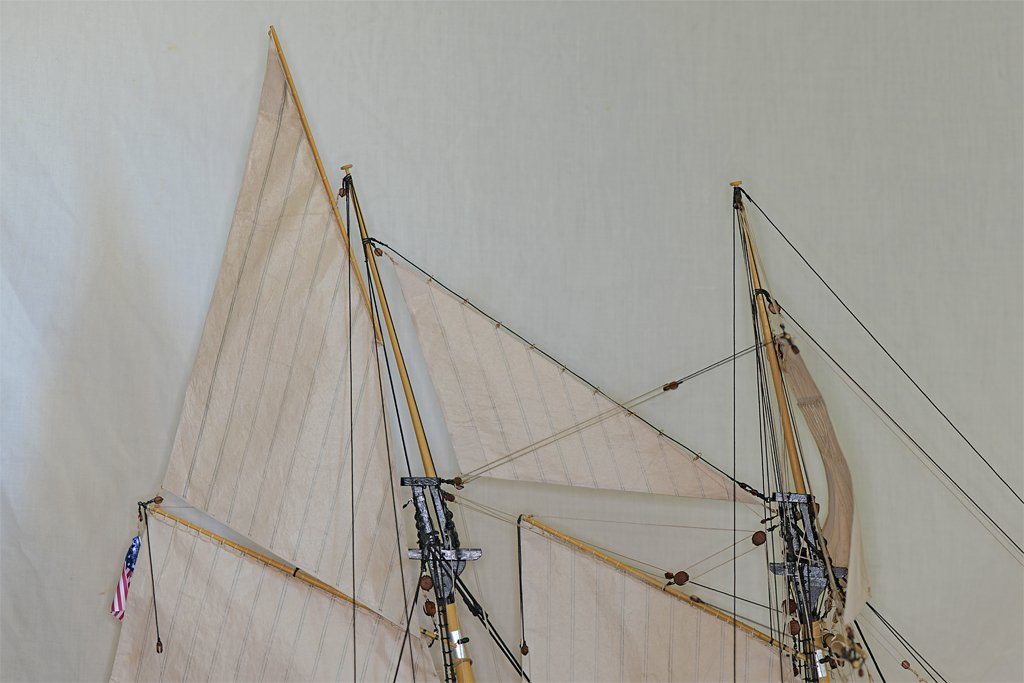

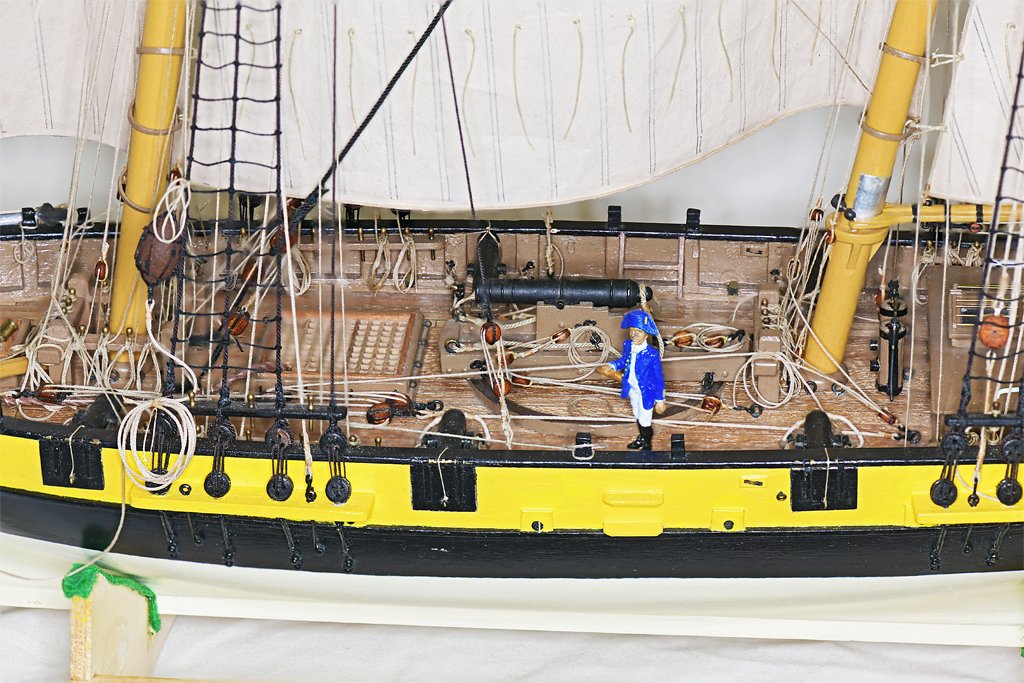

Here are some photos of the finished model.
Portbow.thumb.jpg.5499ab8a8a509dff9ddf1acfd2d8e1ed.jpgStbdquarter.jpg.cf116bc104e36cf07f0d3183e6326874.jpg
Port bow and midships views.
Portfocsle.jpg.3c6e06a7884eec43bb62440a96b48955.jpgPortmidships.jpg.a66ba97c1358005227c2f269b3b675cb.jpg

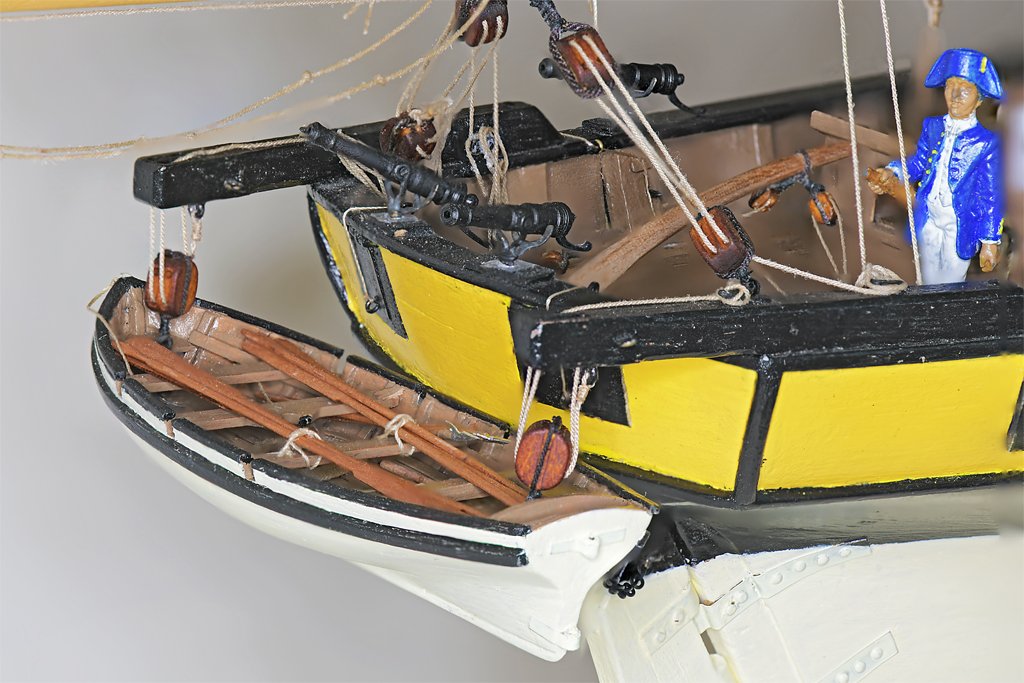

Quarterdeck view and the ship's 16 foot cutter.
Stbdquarterdeck.jpg.65e8f2b2efa7a258667ff746a03d4d48.jpgCutter.jpg.cea4431767a560931b1fa2e76a2c354c.jpg
Bow and stern views.
Bowview2.jpg.c860ff0e16f39765088c1ddcb1ae880a.jpgSternview.jpg.4ab98a69115ab9dc6987501c20516f49.jpg

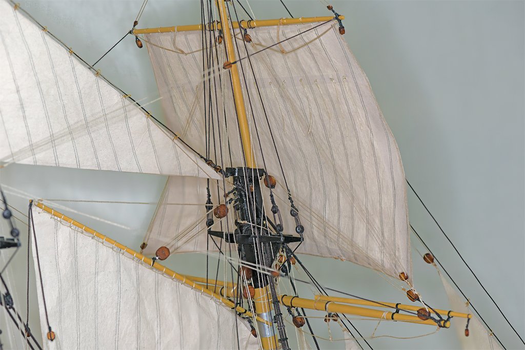

Fore top and fore topsail, and the main top and main gaff.
Foretopandtopsail.jpg.6ef8b471744afc85ab5207c34e2262ef.jpgMaintopandgaff.jpg.86c63ec0f27169268df3a97579d1e884.jpg

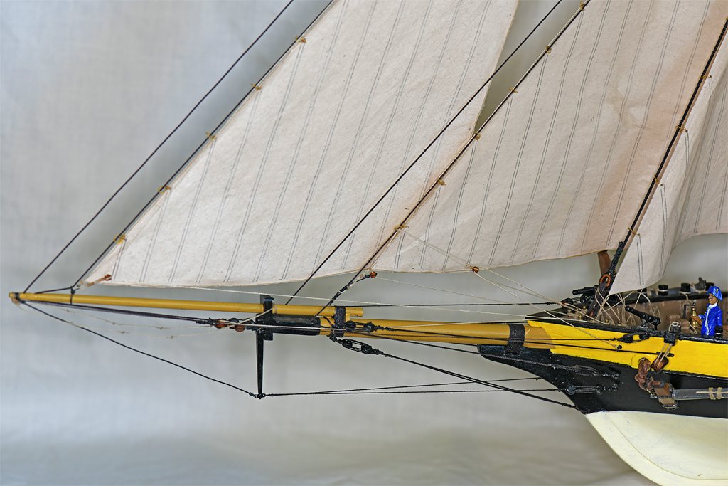

Topsails and a close-up of the main gaff yard topsail yard. Americans raised this yard almost vertical as shown, but the Europeans hoisted it nearly horizontal, with a trapezoidal sail that was almost square.
Topsails.jpg.0899e2bf670f9719187f9d41ce167402.jpgGafftopsailyard.jpg.f0291ff8e010f1c0af1df43e45bde5c1.jpg

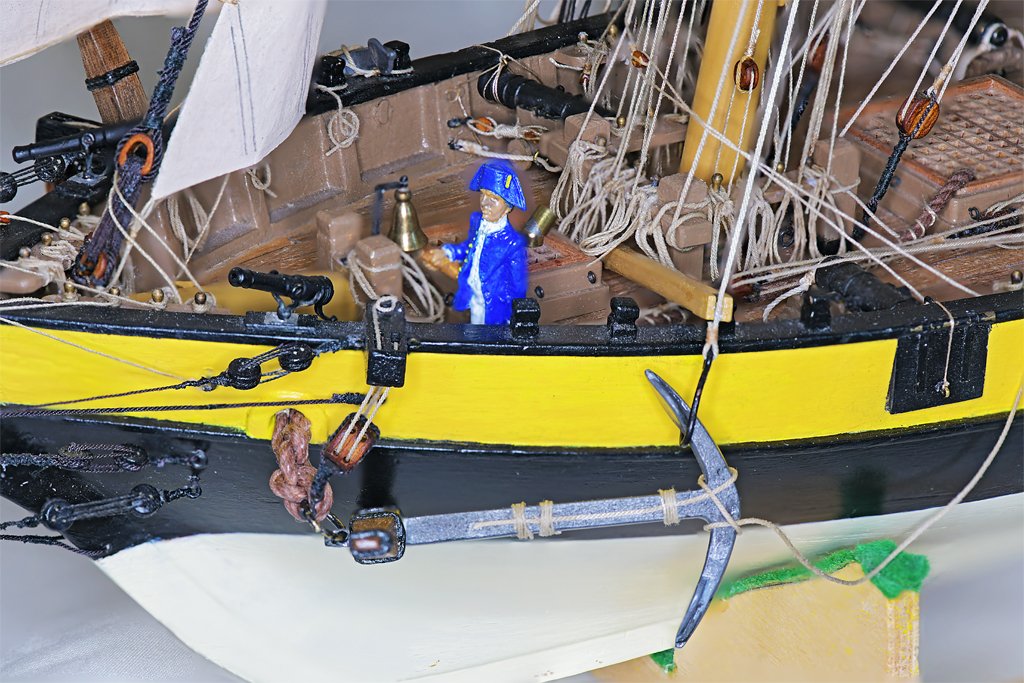

Port anchor being fished and the starboard anchor in the stowed position on the rail.
Portanchor.jpg.e0ccc54f34132f5769ad5410d6c0a8b3.jpgStbdanchor.jpg.14cdb4f63d564b873c3e9c811b4d03ae.jpg

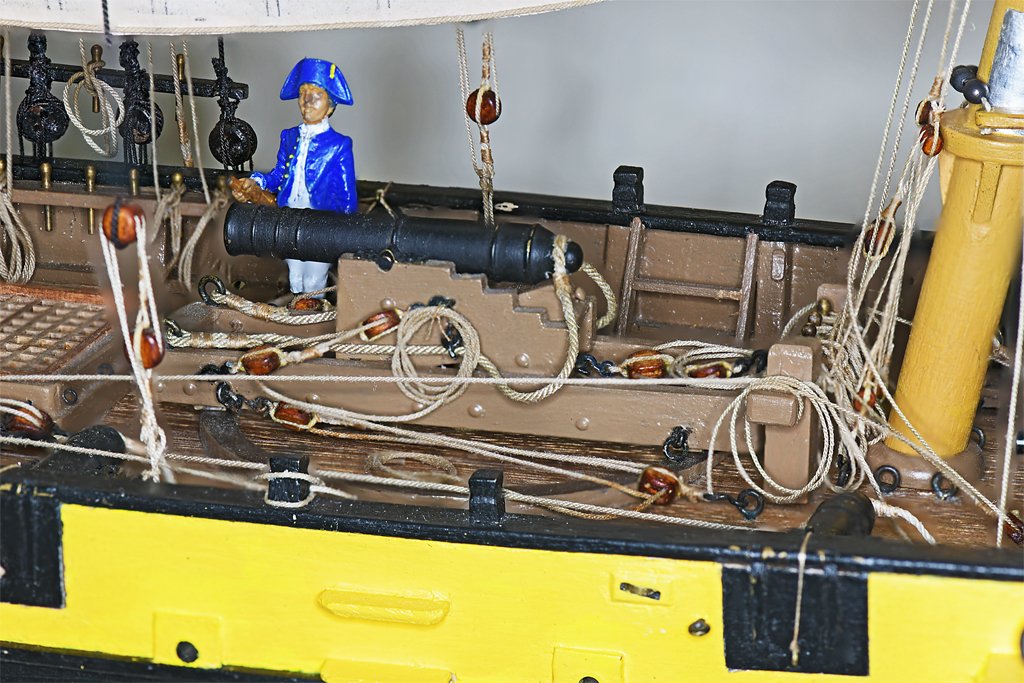

Pivot gun and the bowsprit and jib boom.
Pivotgun.jpg.03f151198210882875e98735b33ba8da.jpgBowsprit.jpg.863199b0bd26c98c97cb49182adaa56a.jpg
For now the build is finished. Someday I will get around to making a better stand for the model, and I will post more photos when that is done. But now I will be working on the MSI model.
Edited by Dr PR
