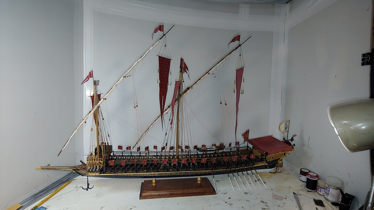

All 40 flags and associated tassels are now completed along with the fire pit base. Work continues at a snail's pace on the oars and although I only have 7 fully completed with the estropes installed and bearded to the benches, I'm starting to see a glimmer of light at the end of the tunnel. Thanks for looking.
Michael D
Thank you Frank. Well somewhat of a crowning moment in that the portside oars are completed along with the fire pit, I used some aged redwood bark that I had painted lightly with a light grey and sprinkled some flour over the top then sealed with a flat clear.  I also added the portside canopy tassels and swivel guns to complete the portside of the Galley.
Michael D.

Thank you Phil. Well the ole Reale De France is done, I completed the starboard oars and all in all I think the galley came out okay, as with all these builds and I know many will concur that there's always something you know you wished/could've done better after it's finished and this build was no exception. Thanks to all who took the time just to look or make comments...much appreciated!.
Michael D.
