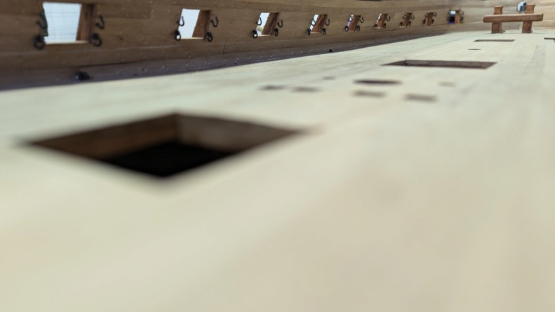

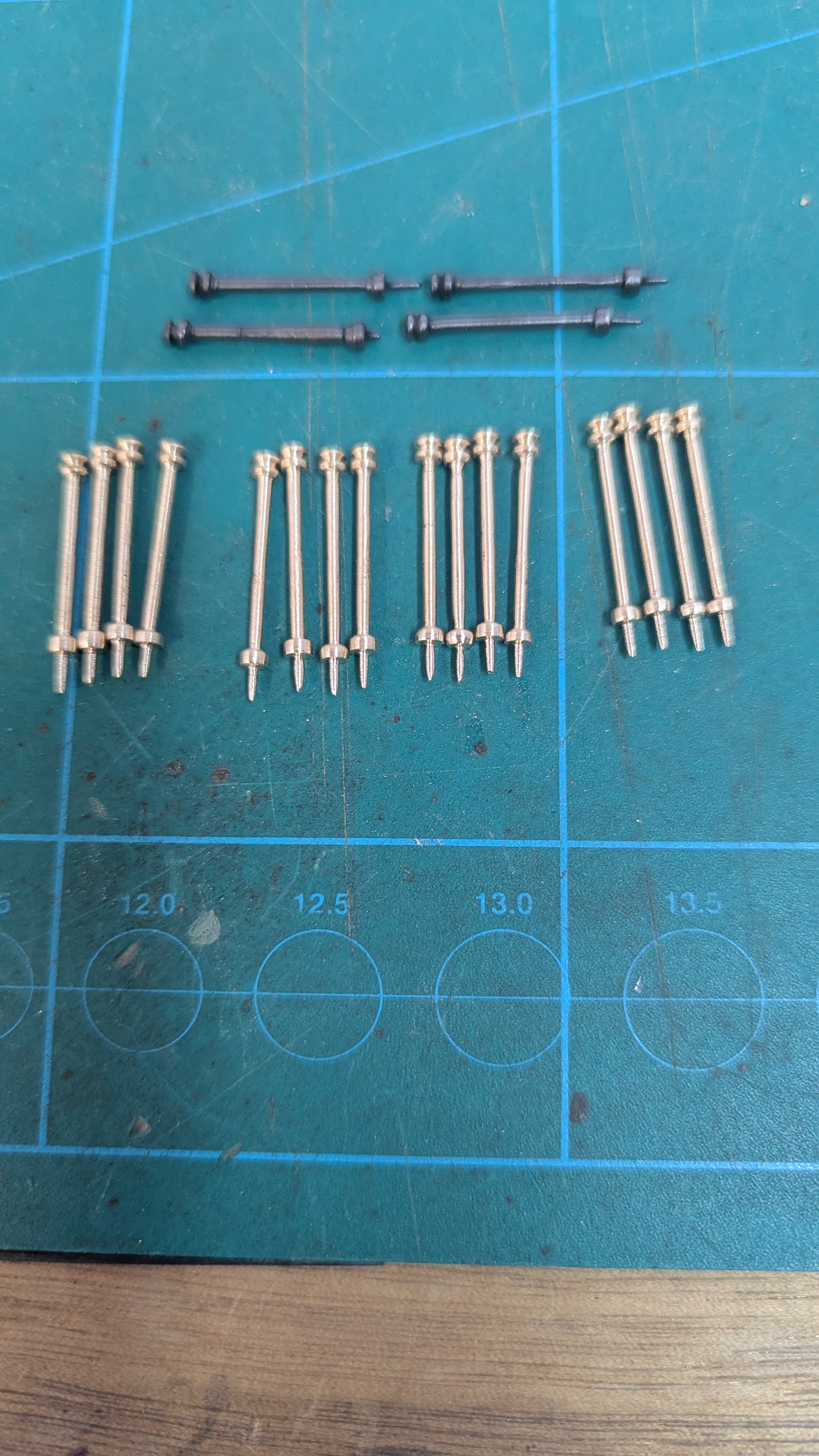

This post, deals with the realization and installation of artillery bolts in gun ports battery
Due to the complexity in the realization of the bolts, given the differences in thickness of the ship side, although the hole is through from outside to inside, I relined the bolts in two pieces.
thank you

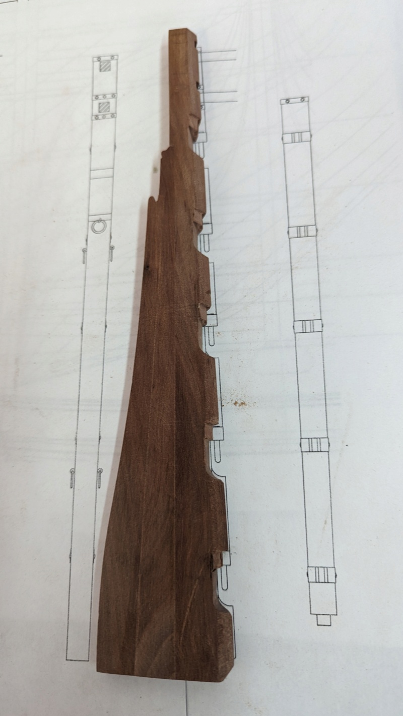

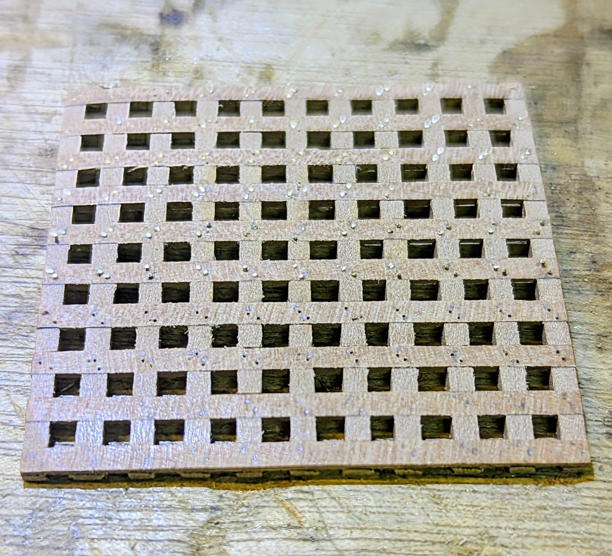

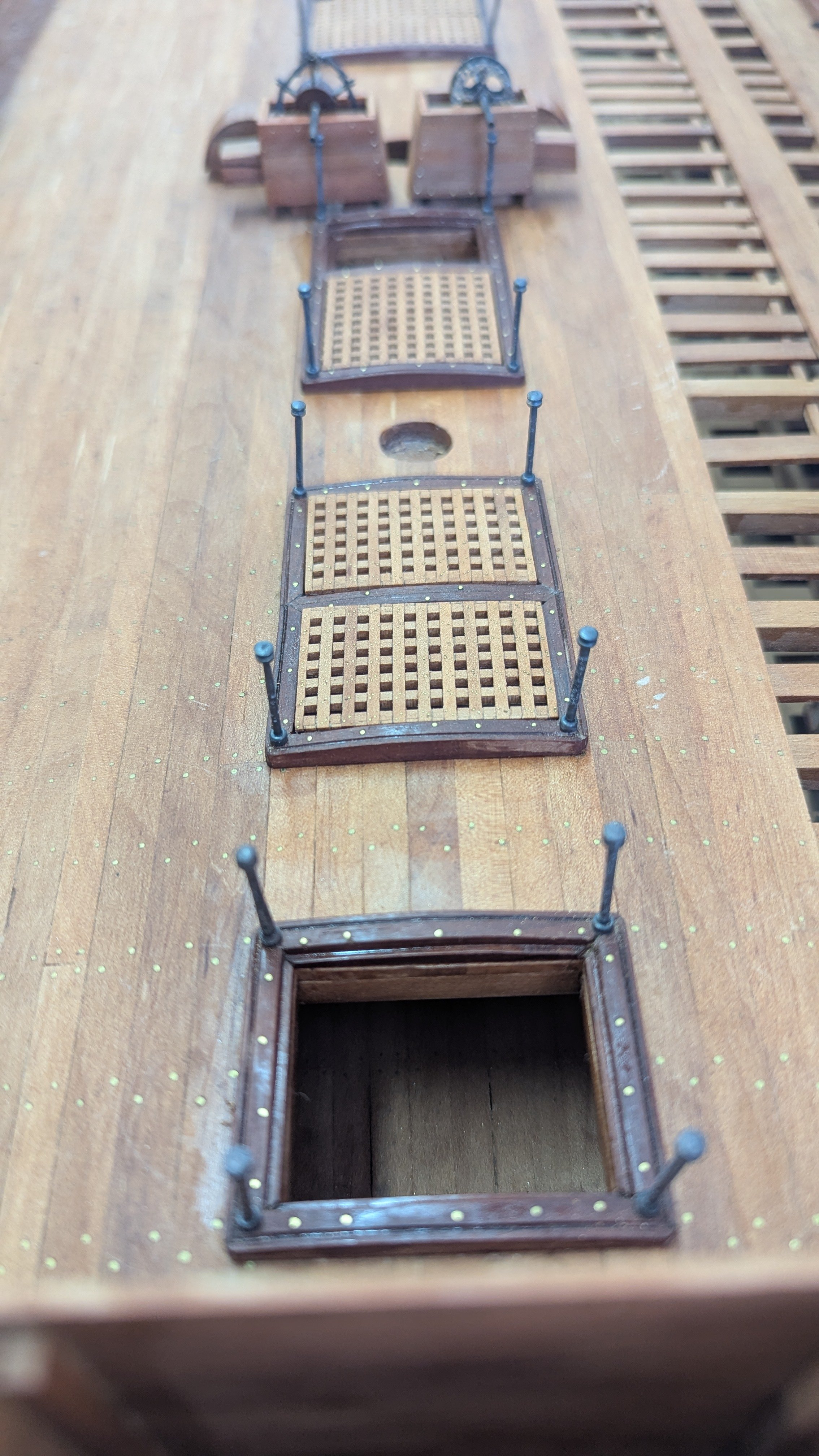

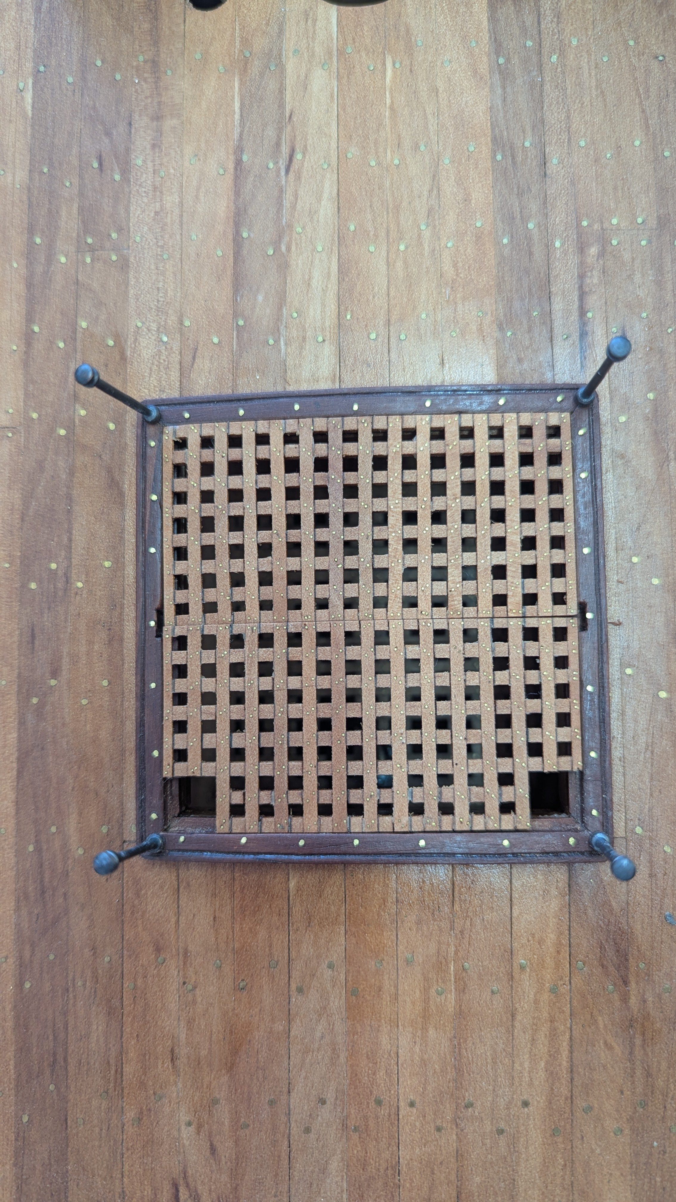

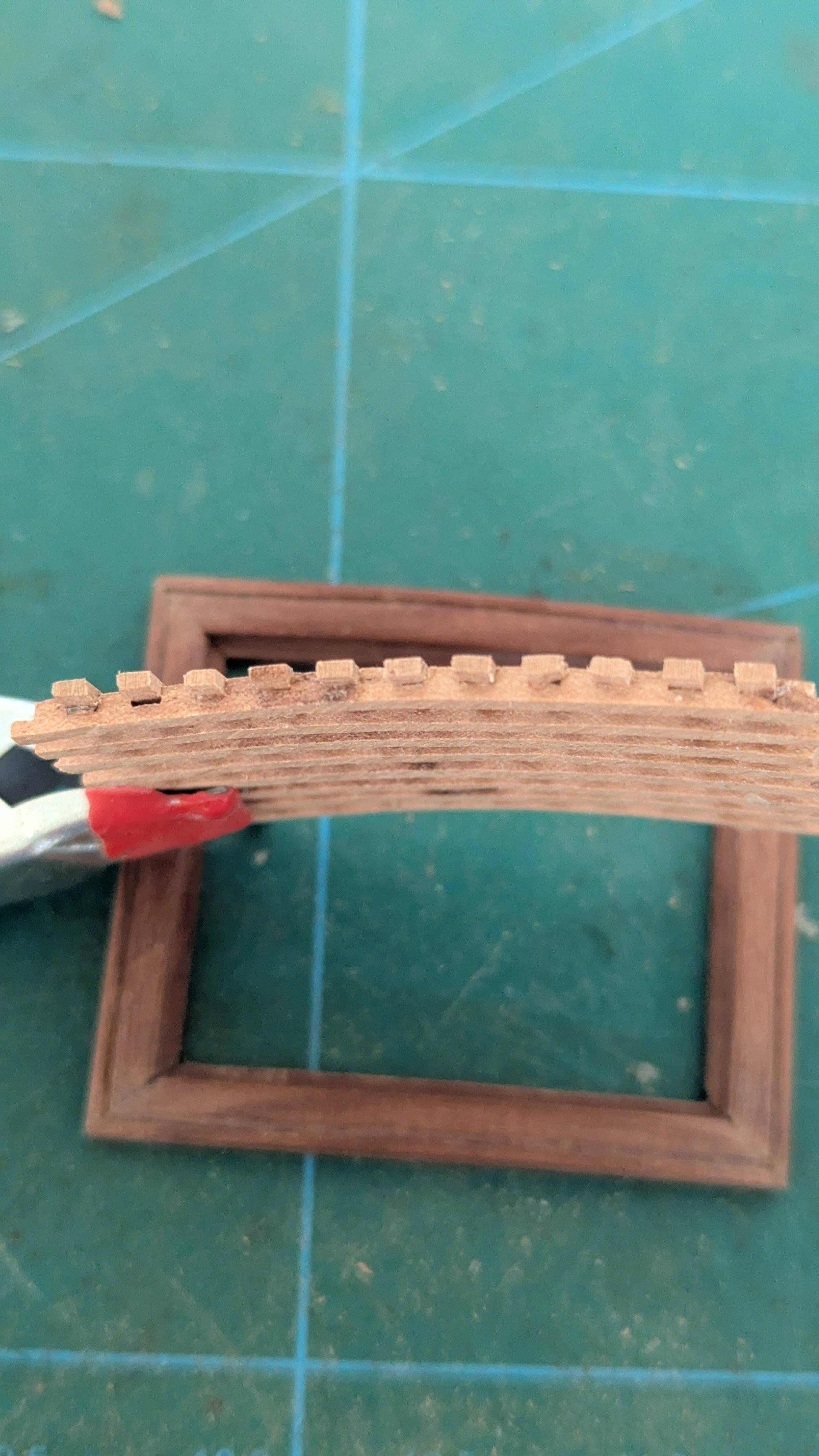

Now the manufacture and installation of chain wales, channels the masts.
We begin by making the tables, which are composed of several boards.
Construction of reinforcement curves
In the previous photo you can see the profile that the table has to have, which is flat at the water line and with a slight slope towards the outside on the upper side, so that the rainwater comes out.

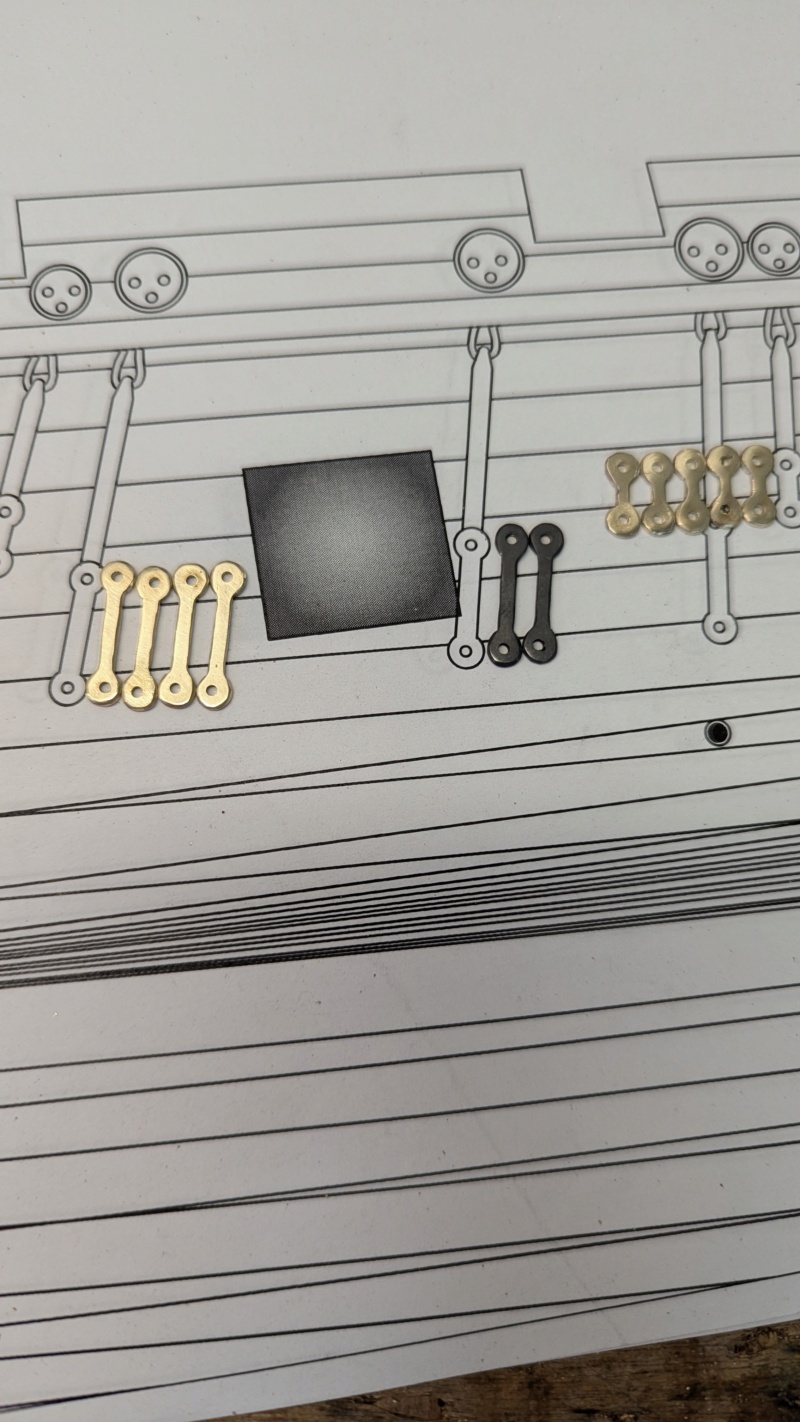

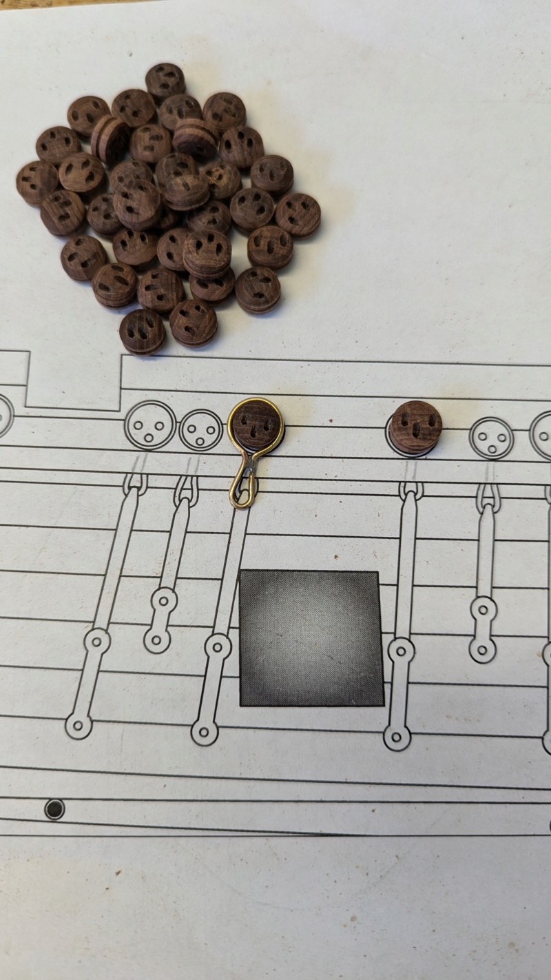

Next, manufacture of the dead eye:
Manufacture of bindings:
The technique is to use a printing with printer toner and transferring the drawing to the brass tape, with wetting the back of the paper with some solvent liquid.
thank you
I am posting many photos to follow the construction process of this model, as a supplement to the monograph, if they can serve the modelers colleagues who are working on this beautiful frigate, but if apart from these photos anyone needs further clarification can contact me sending a private and I will respond without delay.
Adrián Sorolla

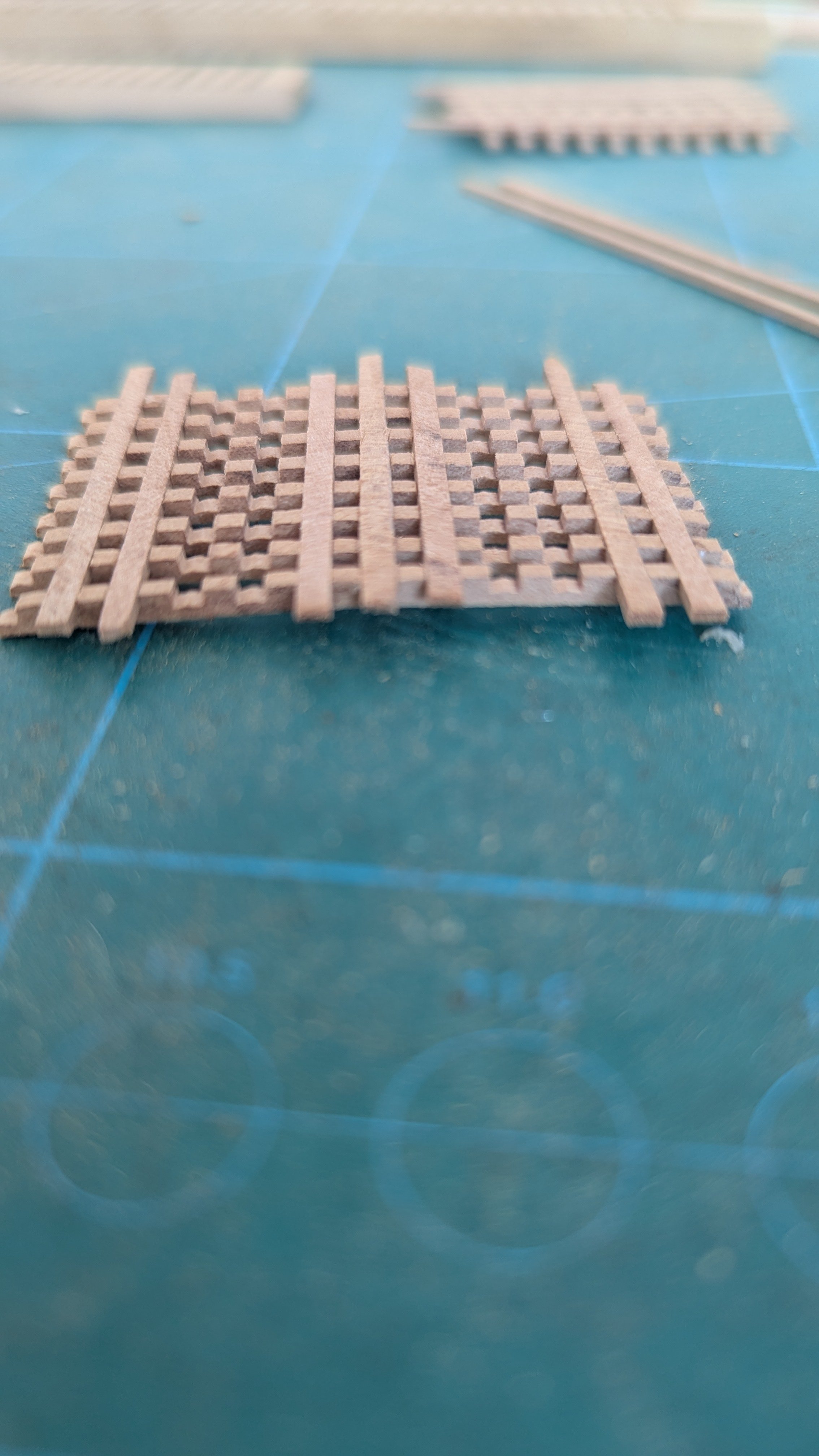

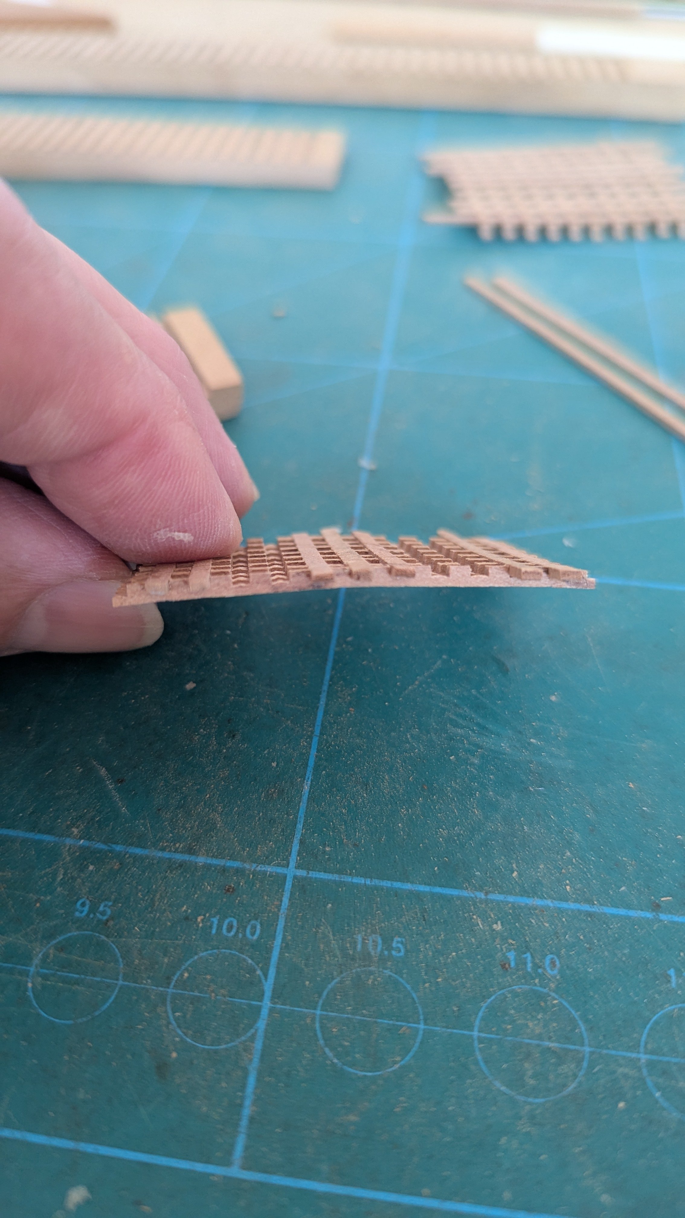

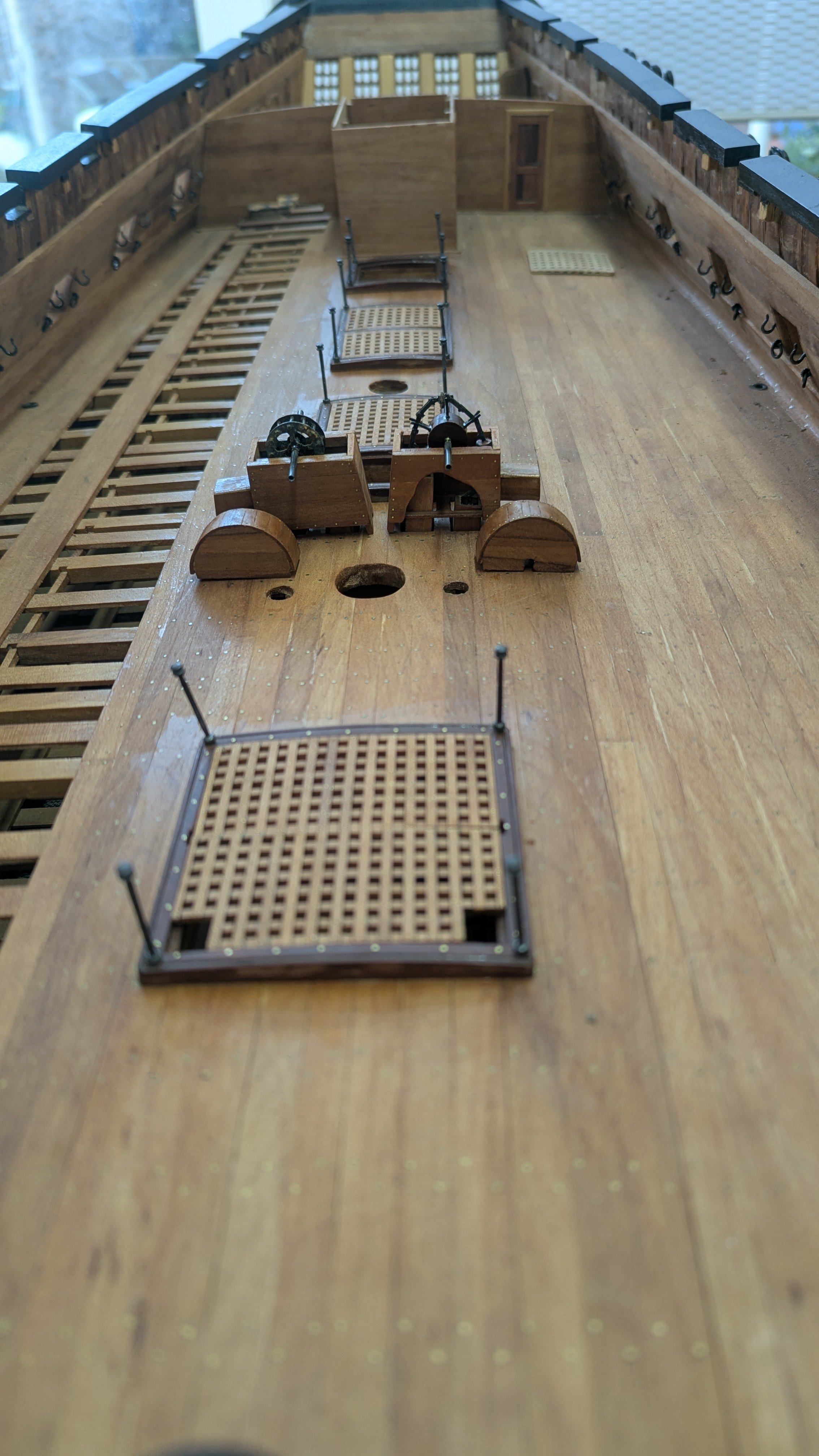

Hi
I present some advances in the construction of the frigate La Mahonesa,
This time it is about the construction of the chain pumps, I put photos of their realization as a complement to the explanations that appear in the monograph
If anyone needs more information about this realization or any other, you can ask me, I facilitate the explanations that are
