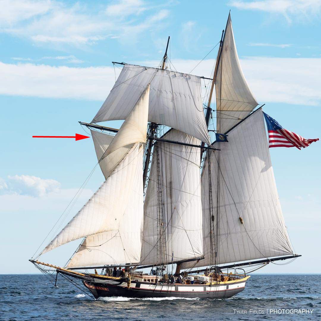

Just when you think you have seen it all, something new pops up. Look at the sail marked with the red arrow on this nice photo (by Tyler Fields) of the modern replica of the Lynx.
What do you call this sail? It might be a studding sail, bit it isn't attached to the studding sail yard. It is attached to the course yard (spreader). Is it a "half course" as opposed to a "full course?" It might be a triangular sail.

I have seen triangular forecourses, but set in the middle of the yard, with the foot pivoting on an eyebolt in the deck. I think in German it is called 'Faulenzer' = idler. It was used on courses werde frequent gybing was required, as it involves less work.
Haven't seen such half-forecourse, however, before.
wefalck,
I have seen the triangular course as well. And there is a triangular topsail (rafee topsail).
The sail in the photo is flown on the windward side where it would have some effect. Because the fore staysail is also raised a full course would probably chafe against the staysail. So from a functional standpoint this makes sense.
Or maybe they were just drying laundry?
When I started this thread I naively thought there was a "way" to rig a schooner. But after finding 10 different ways to rig just the main gaff topsail I realized that if a way to rig a sail is possible someone has probably tried it!
