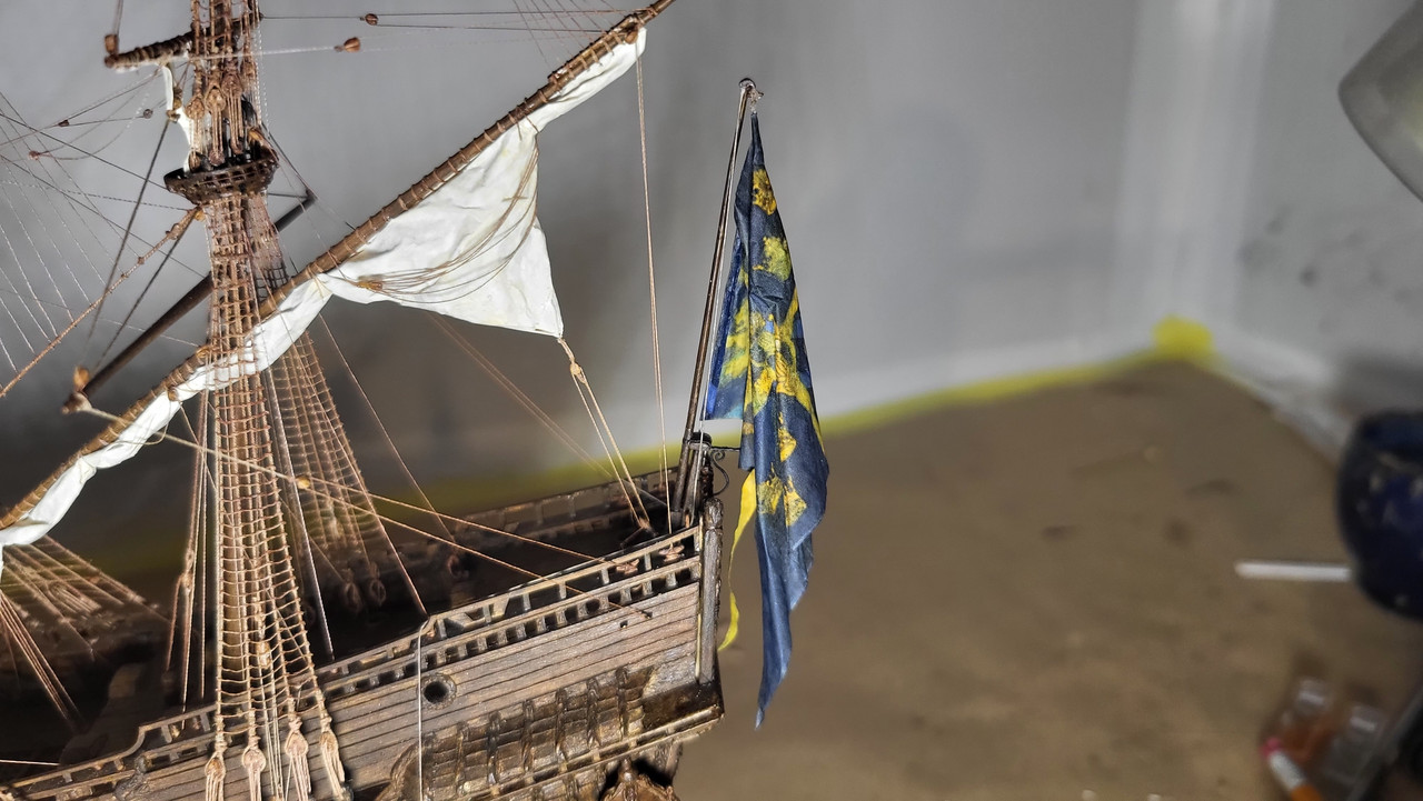

You do bring up a valid point Kirill but I think once the flag is installed  it'll partially be hidden anyway. The lantern is still a WIP at this point as I want to add some detail to the lower section and tone the gold down just a bit to achieve a more metallic bronze look and maybe try to add the mesh to the panes, we'll see how that goes but I do want it stand out. As always gentlemen your insights, compliments and critique are very much appreciated.
Michael D.
Sounds as a good plan!
Would You like to Try artificial gold potal ? it is not expensive staff ... еasy for application and could be  found in any artistic shop...
but it will make much more intersting effect than any other metallic paint...
 Considering that this lantern is a WIP and will be the only gilded element, then plated with golden potal, it will be mysteriously and  warm flicker as a jewel on the aged wood in the light of the fireplace or candle.. this effect couldn t be reached with any other metallic paint...
When applied, it could be covered by gloss acrylic varnish and stained/ softened in gold shining by apllying light deluted bitumen...
Edited by kirill4
First, congratulations on this beautiful model.
To add a lantern or not, difficult question.
This is how I made my lantern. (Post 24)
Edited by Baker
I will look for the artificial gold and give that a try, hopefully Michael's will have it, thanks for that tip Kirill. Patrick I was actually checking out your lantern the other day, very, very nice job of it by the way👍. I originally added wings but the result looked more like flowers, so I removed them inspired by yours.
Michael D.
This is a magnificent model.
Personally, I think the lantern is already looking like the most out of place item, getting far too much attention.
As suggested, once the flag is installed, the lantern becomes almost irrelevant.
Thank you Shipman, in the end I went with what was the right decision, I really appreciated everyone's suggestions, on one hand I really liked the look of the lantern initially but the longer I starred at it the more it just looked out of place.
I did include the reworked mount though, I attached the toggle at the top of the flag and ran the line to make it look like it's lead through a simulated truck and down to a cleat on one side of the staff, the lower line is lead to a cleat on the other side, all in all I feel it looks as it should with a weathered looking flag. Thanks for looking.

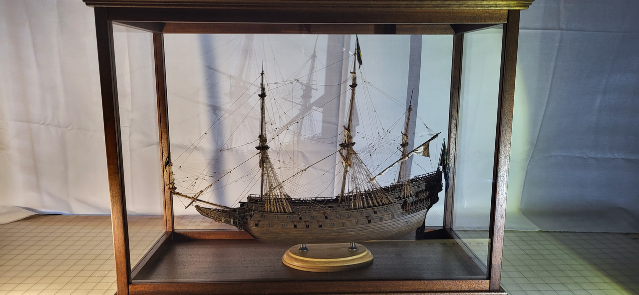

I finally completed the portside gallery and with that, this build is completed, I just want to extend my sincere gratitude to everyone's likes, comments and input that were very much appreciated.
