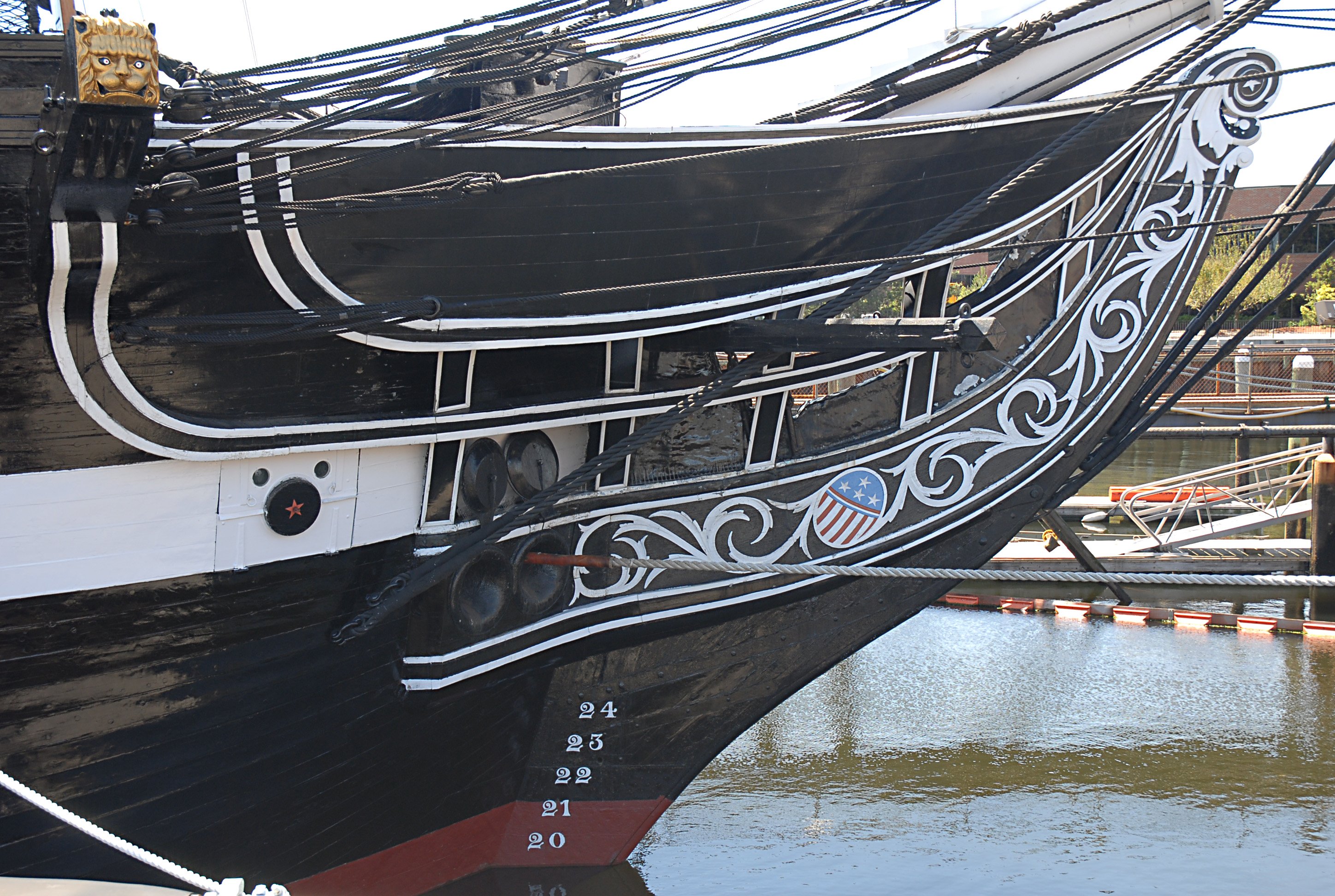

The problem is that nothing is straight, parallel, or square. You've got angles, curves, and foreshortening from the cameras. The best I can advice I can give you, is let you eye be your guide. Here are a bunch of images from different angles which might provide some insight.
Jon

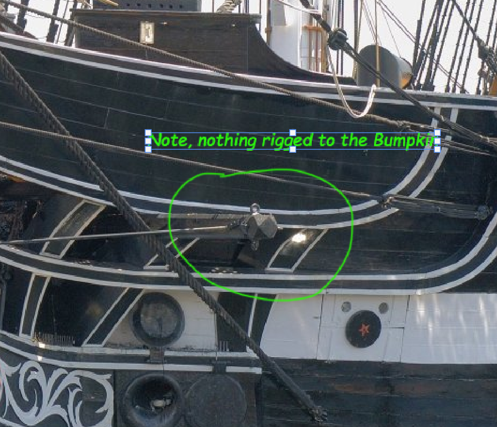

Mustafa,
Looking at the photos submitted by Jon above,  I noticed, yet again, that the bumpkin is absent in all but one.
And in the one where it does exist, there's nothing is rigged to it.   I remember that you said you would add this anyway, but I guess my question is,
why bother?

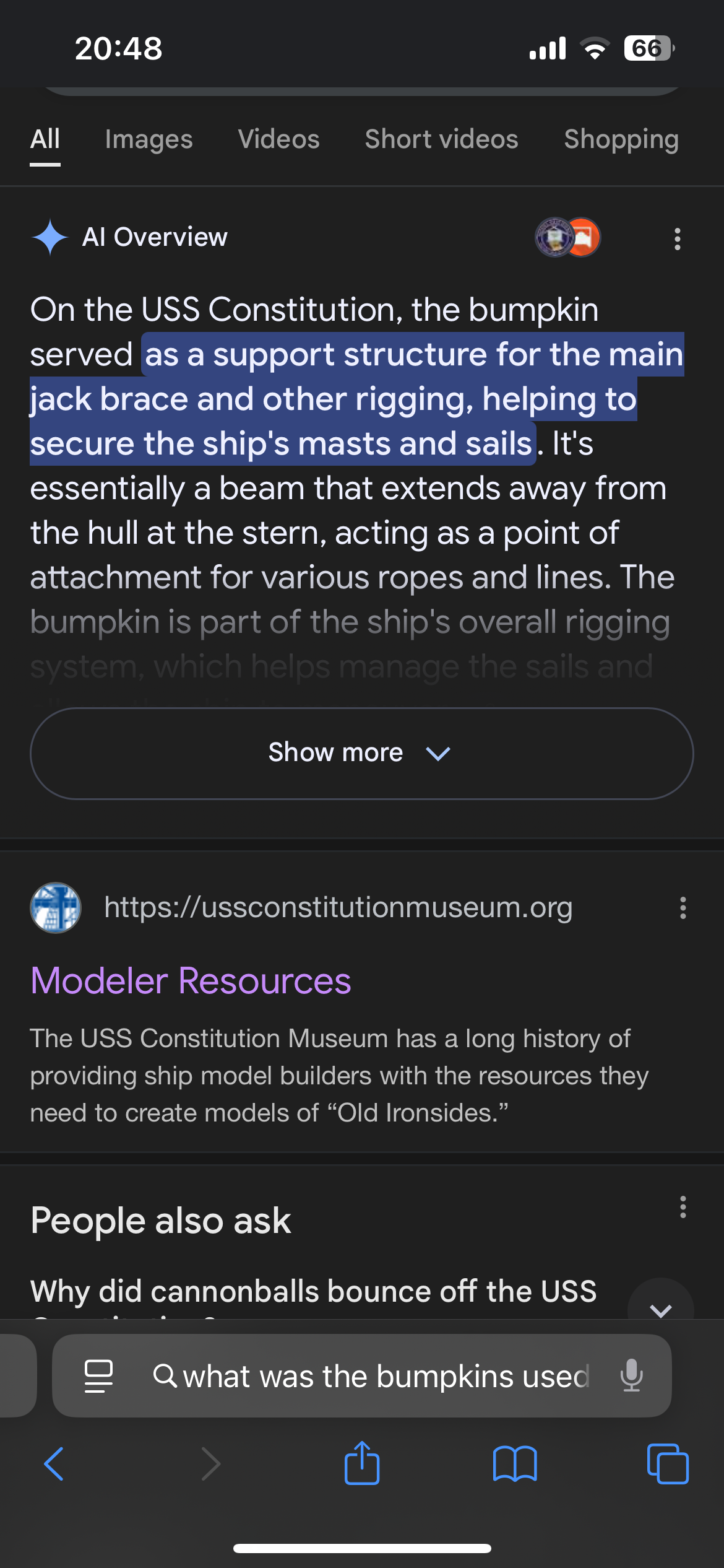

IMG_9075.thumb.png.5625ff0735f415de37cc369d1d99a94e.pngI’ve seen a picture that had the Bumpkins rigged, but I’m not seeing it at the moment. I’m also wondering if they were removed because they weren’t historically accurate to 1812 or not?
I can see where they would be helpful when backing with the wind to keep control and move the for mast main sale.

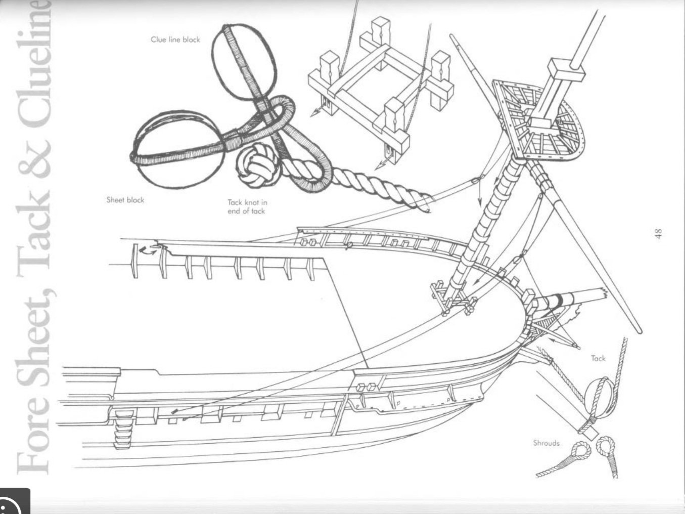

I found a picture in “Anatomy of the Ship The 44-Gun Frigate USS Constitution”.IMG_9084.thumb.png.dd453d0333d668276f392b7ba90a9e55.pngIt looks like if you’re not going to include sails the bow boomkin is not required. Interestingly, the stern boomkins look to still be in place.

I had a simple choice for the bow bumpkin, the actual ship has it, therefore I have on my model. Whether the model is being rigged for sails or not is immaterial for me, it's there now on the real ship, so it's on my model. And, it was not difficult to install. I still haven't added the stern ones yet.
Jon

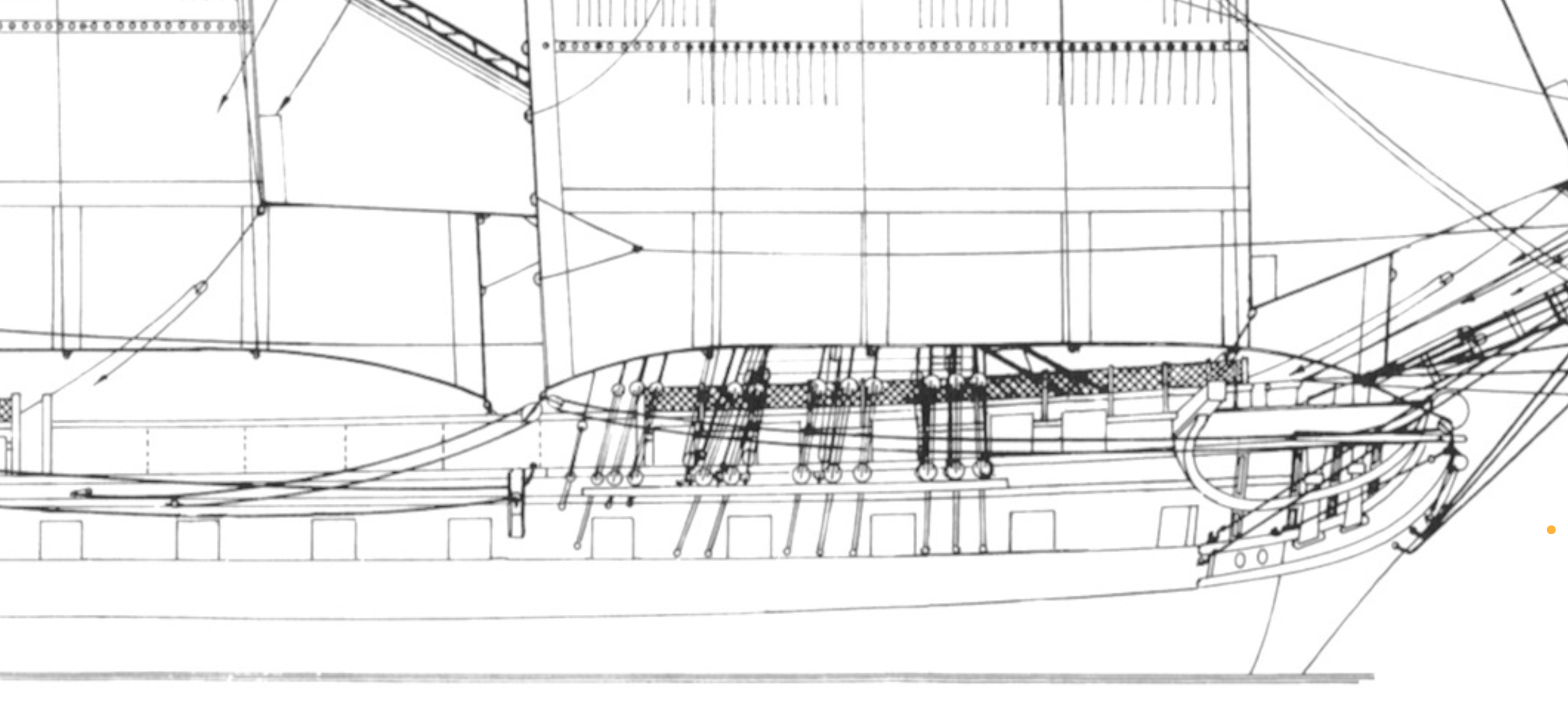

If you are not going to include the fore sail you will not need the boomkins. Drawing shows how the boomkins were used.

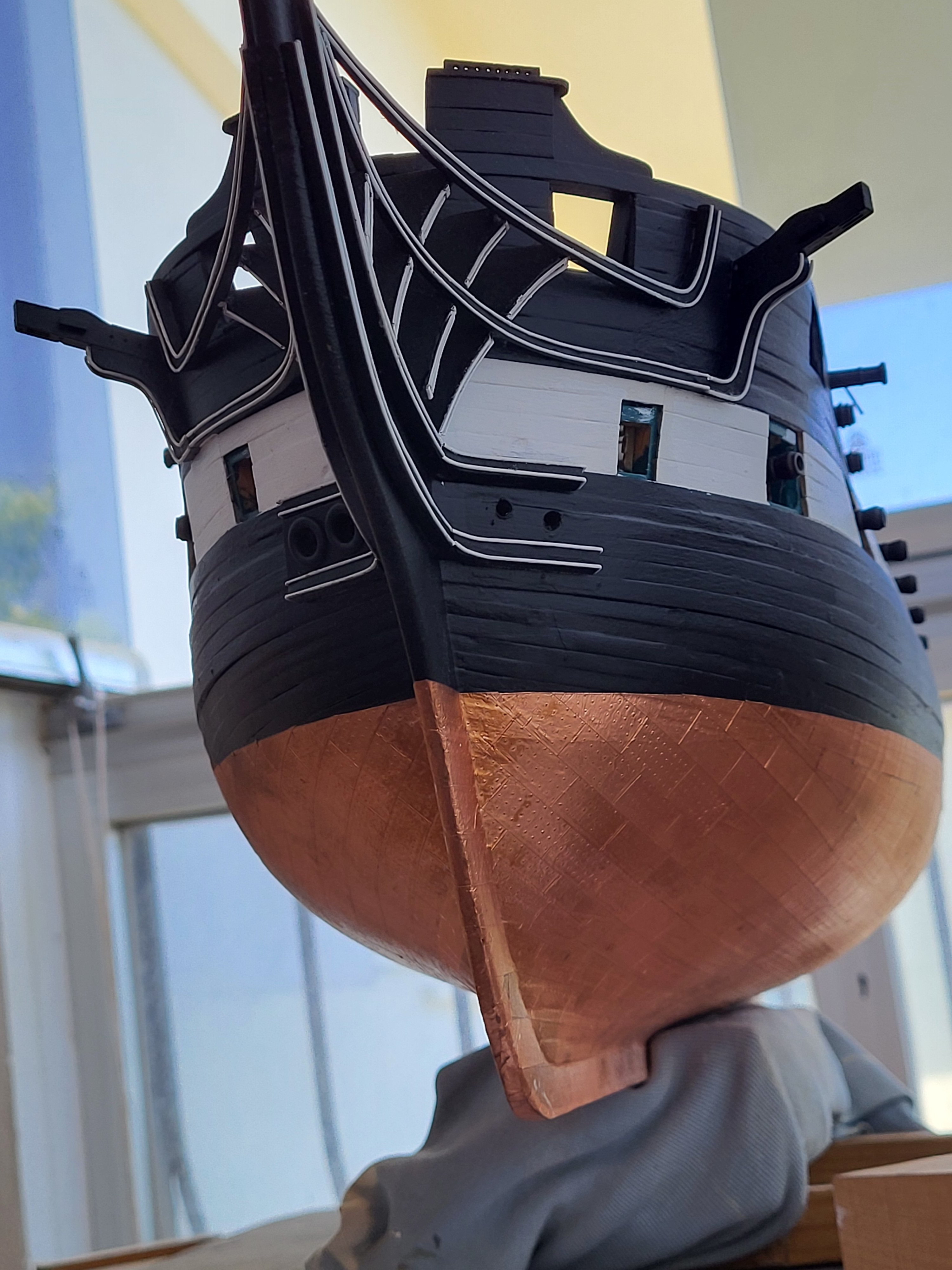

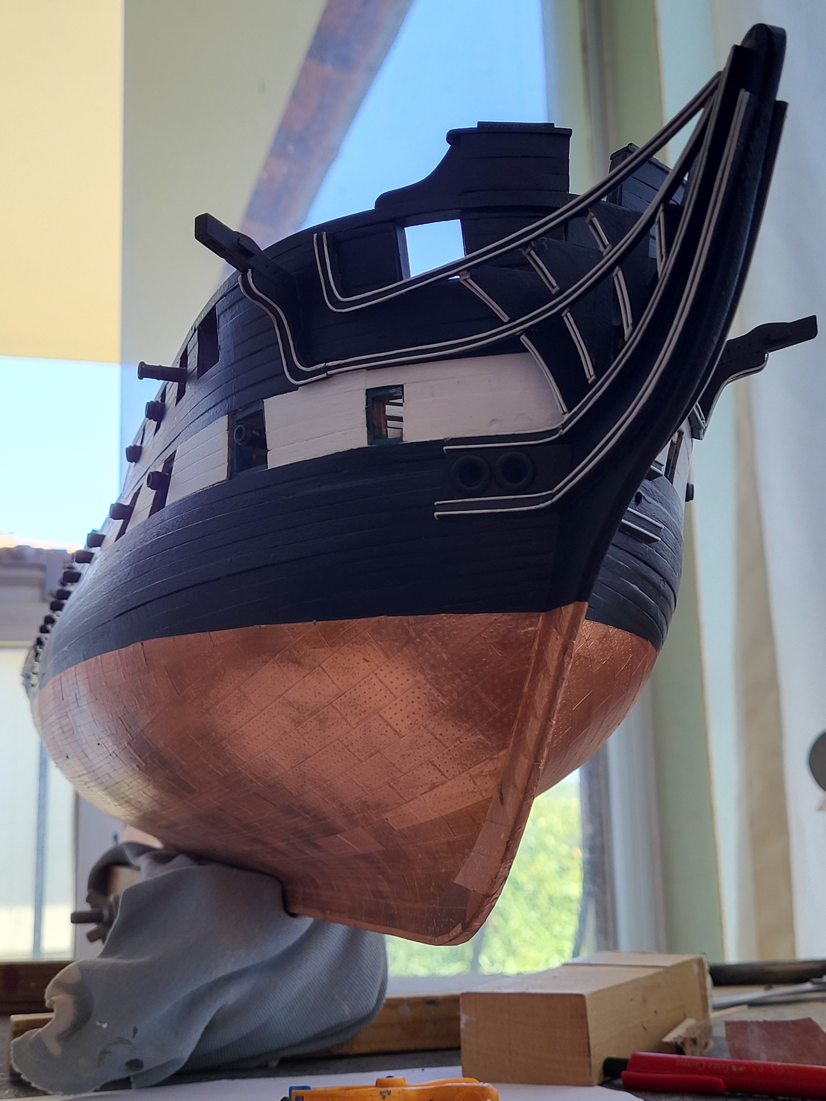

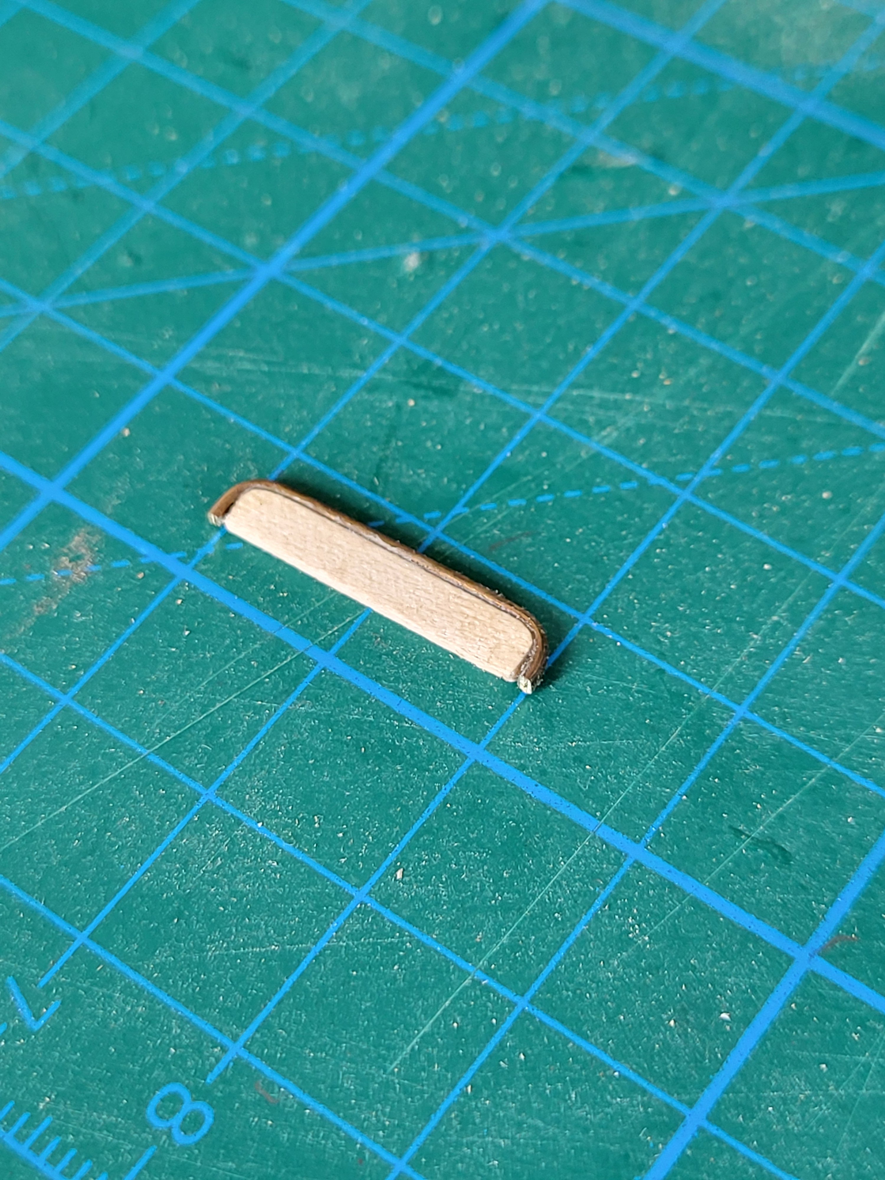

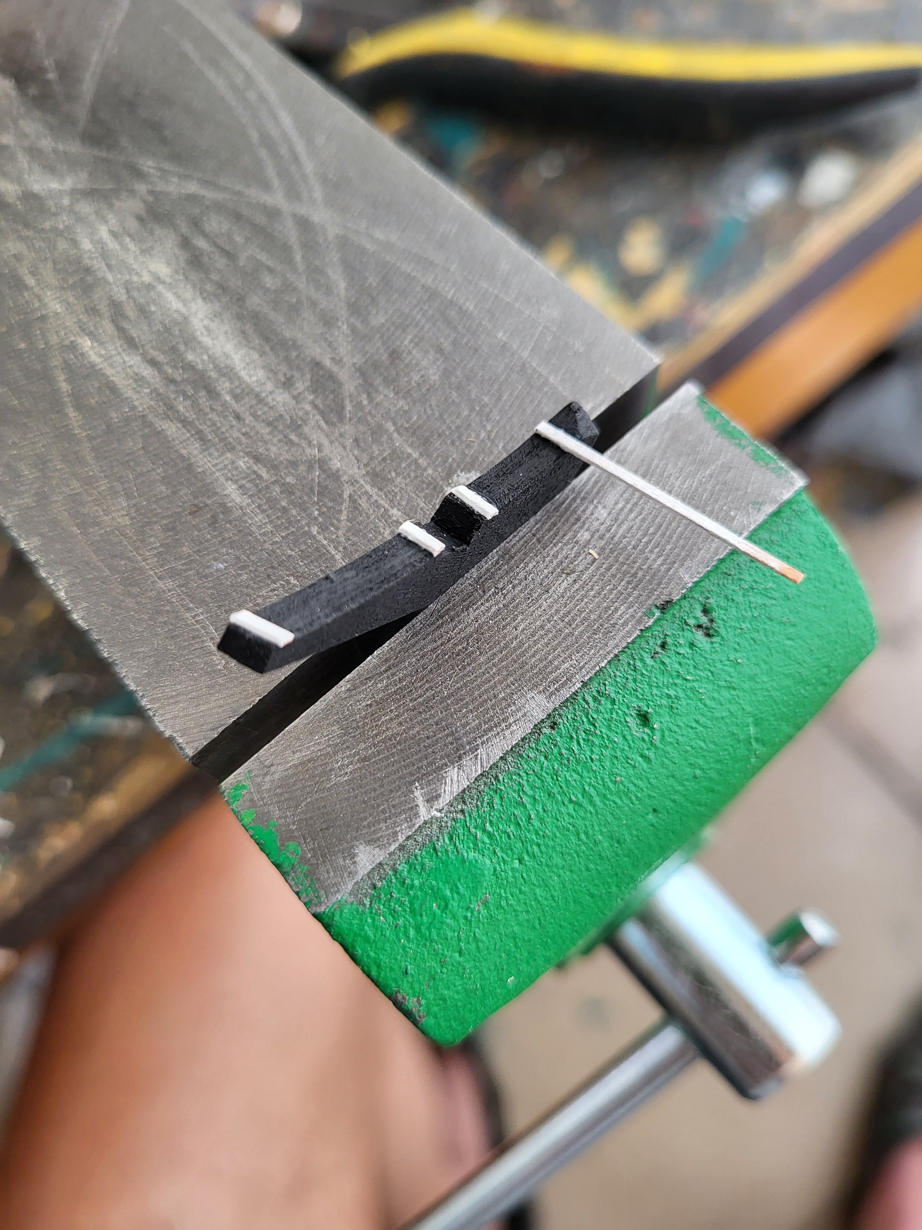

I glued a plank to the top head rail to make it easier to attach the plank stiffeners between the rails. This will provide a larger surface for gluing the stiffeners.
Edited by mtbediz
40 minutes ago, mtbediz said:
I glued a plank to the top head rail to make it easier to glue the plank stiffeners between the rails. This will profile a larger surface to glue the stiffeners to.
Awesome work, Mustafa!  Did you paint and stripe these last planks off-ship before gluing to the top head rails?
I know your summer break is coming up quickly.  Enjoy your vacation! 🏆👍
Gregg
Thanks Greg. Yes, the unpainted rail in the first picture was not glued yet. Like the other rails, it was painted and striped before being installed on the ship.
Blast! I wish I'd seen this post 2 hours ago. I am dealing with the remaining port side rails today. Unfortunately I already glued the top head rail in place and it may be difficult to add that backing plank, but I'm going to give it a try. Anything to make gluing those stiffeners in place is going to be a huge plus.
Great work as always, Mustafa.
Edited by Der Alte Rentner

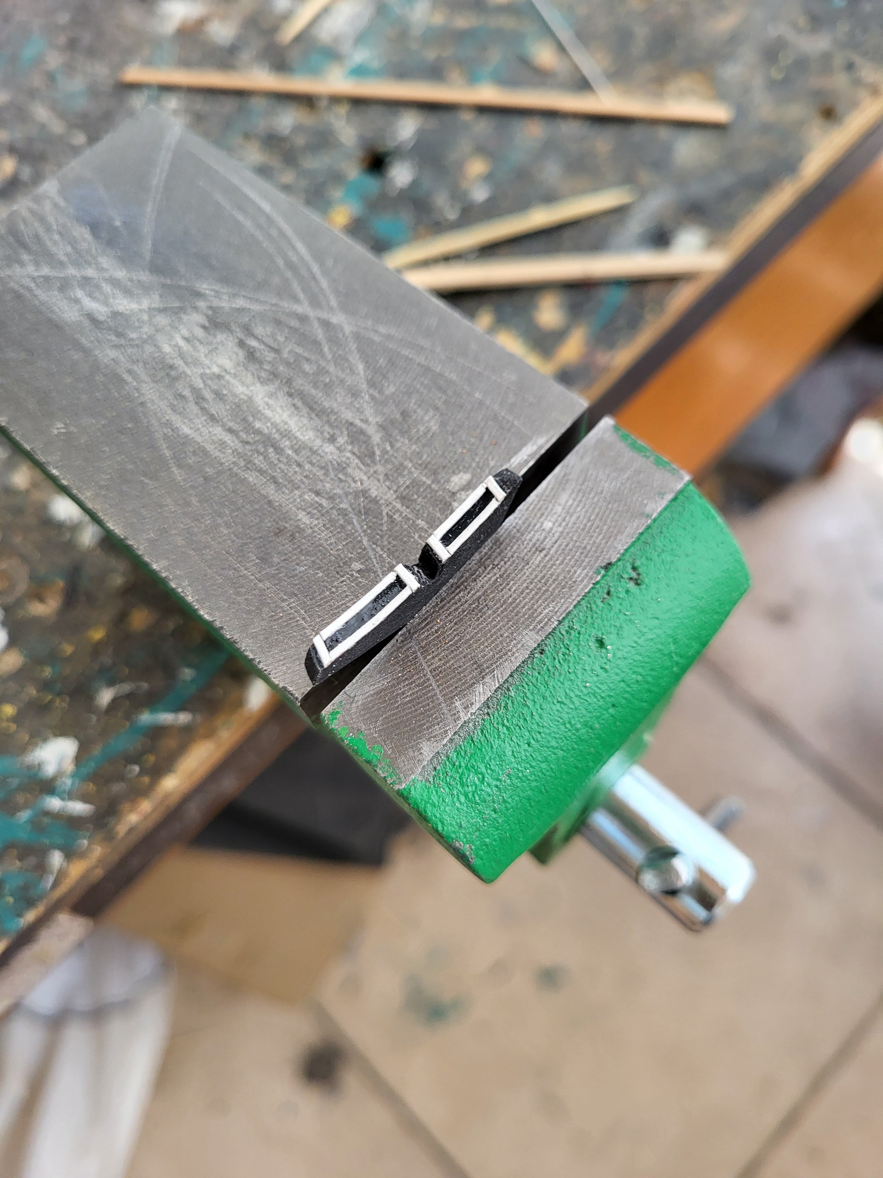

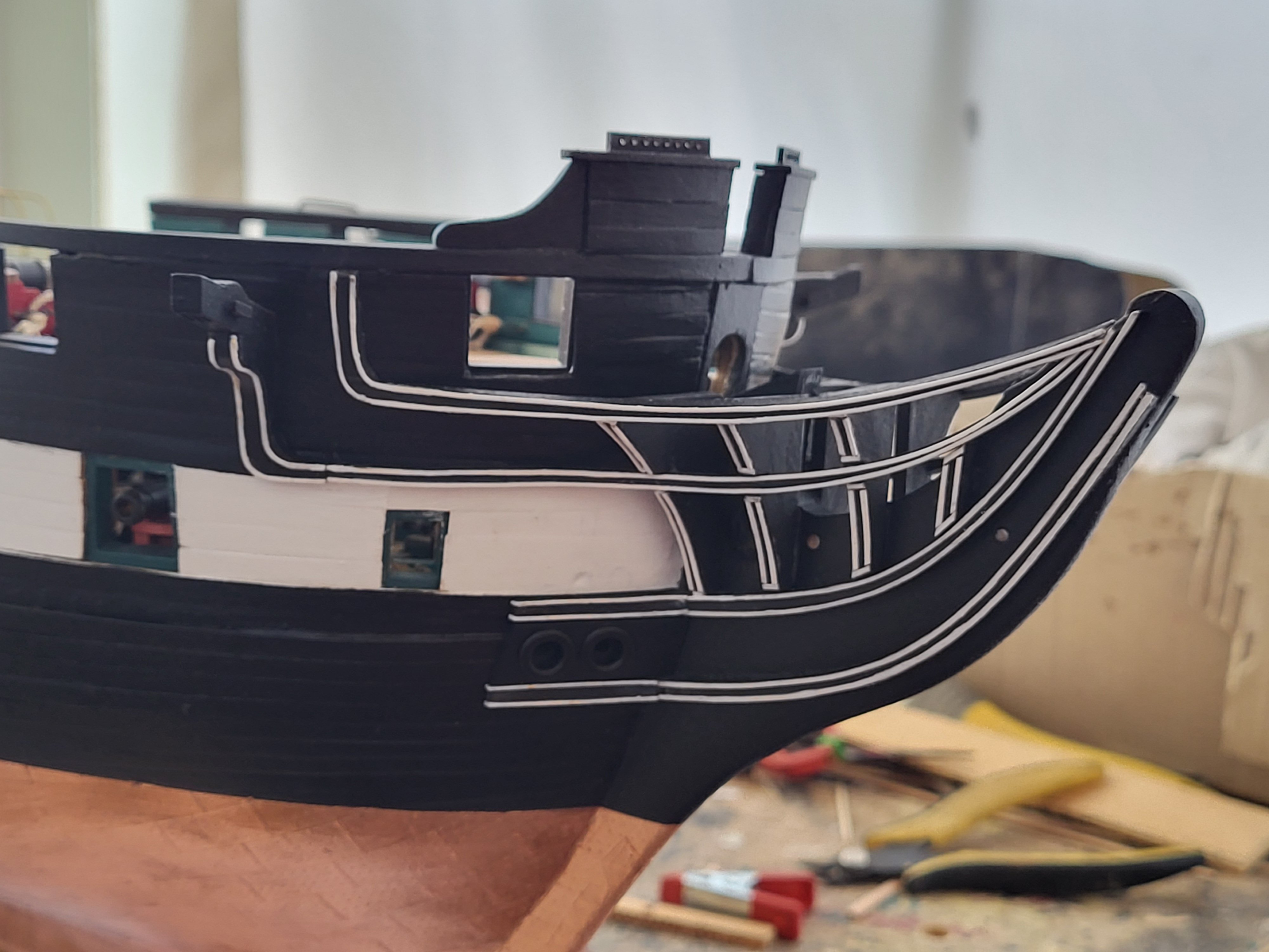

Thanks, Peter. When I noticed that you were having difficulty securing the stiffeners in place, I made something like this. It really made the job easier.
Edited by mtbediz

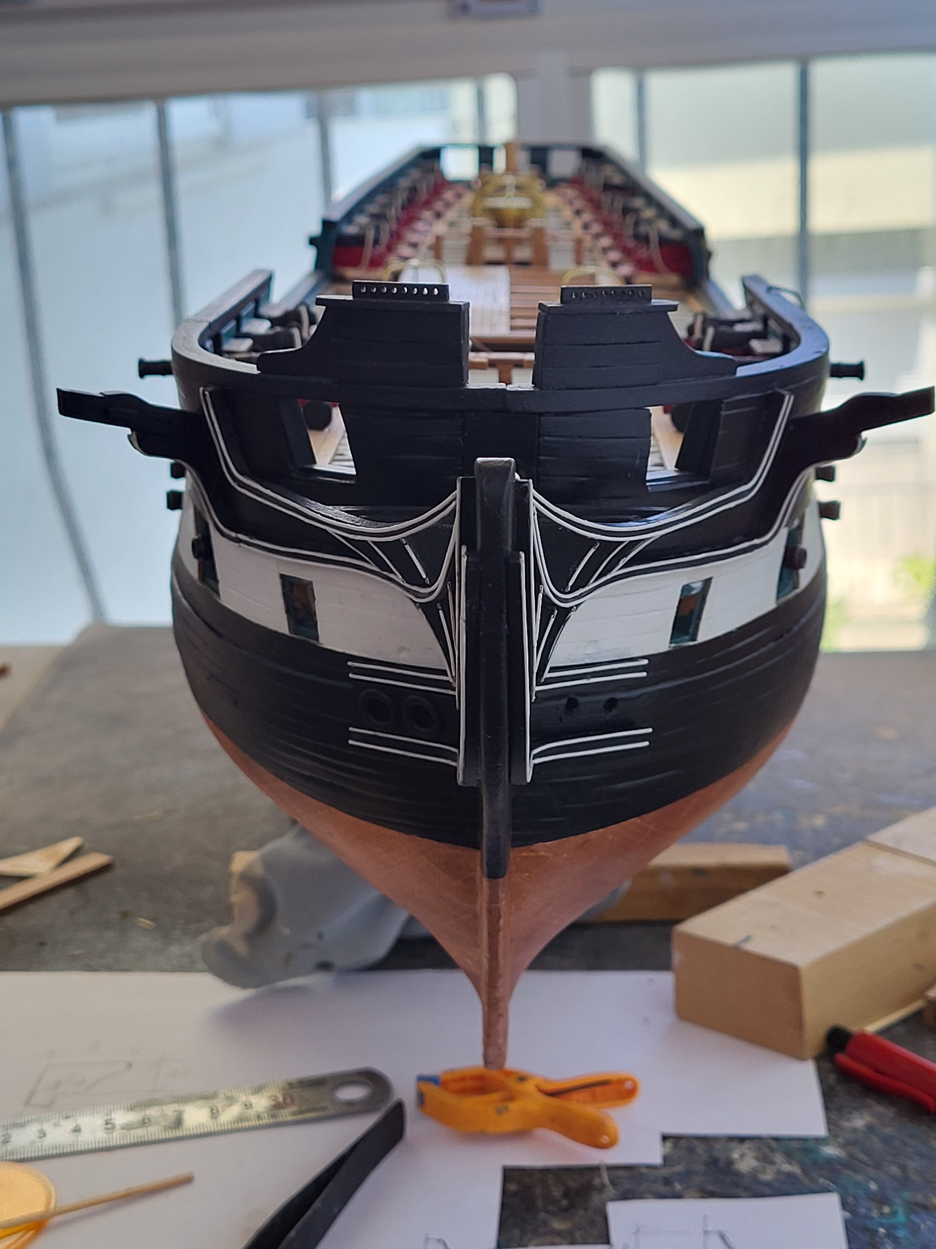

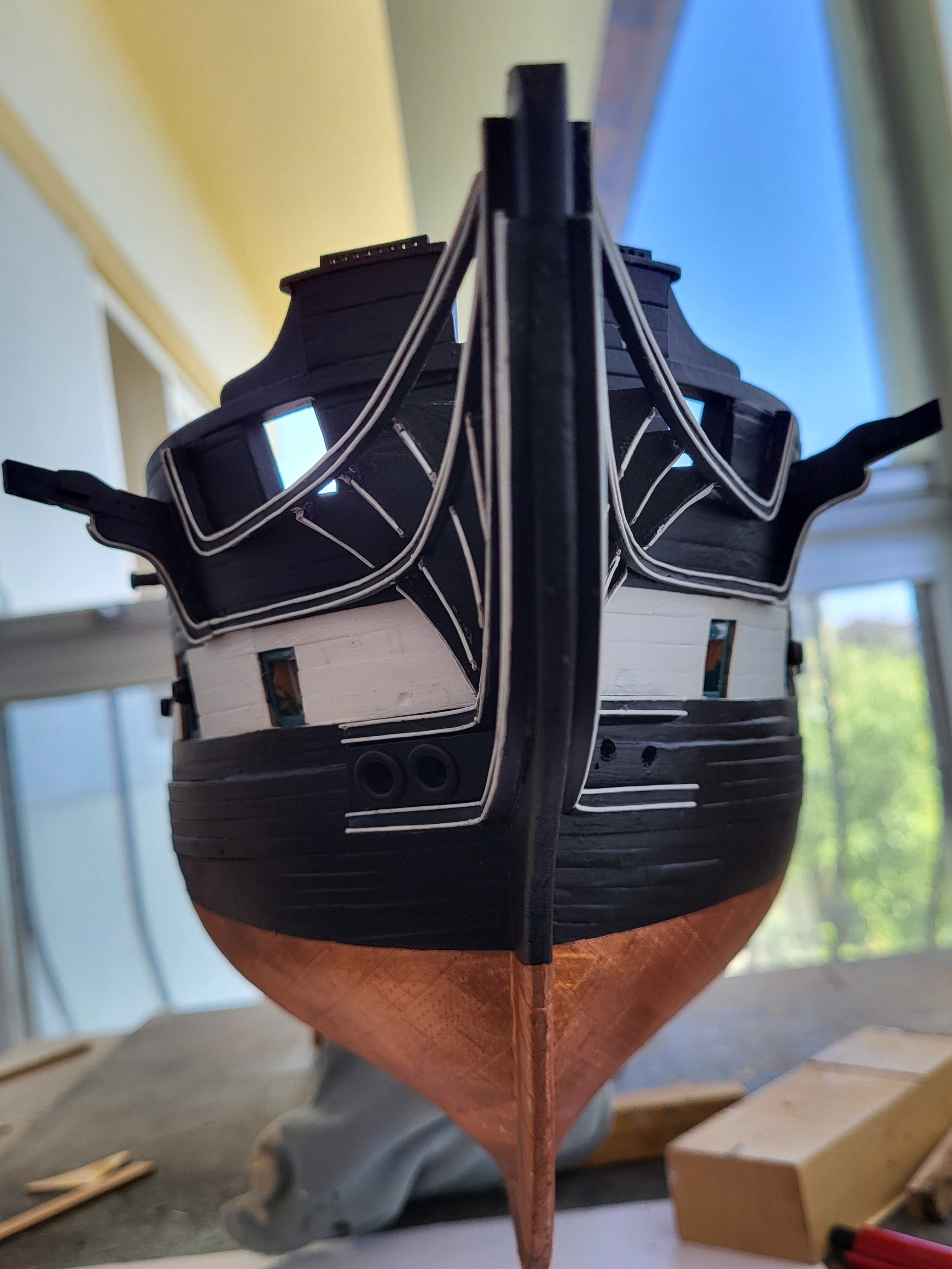

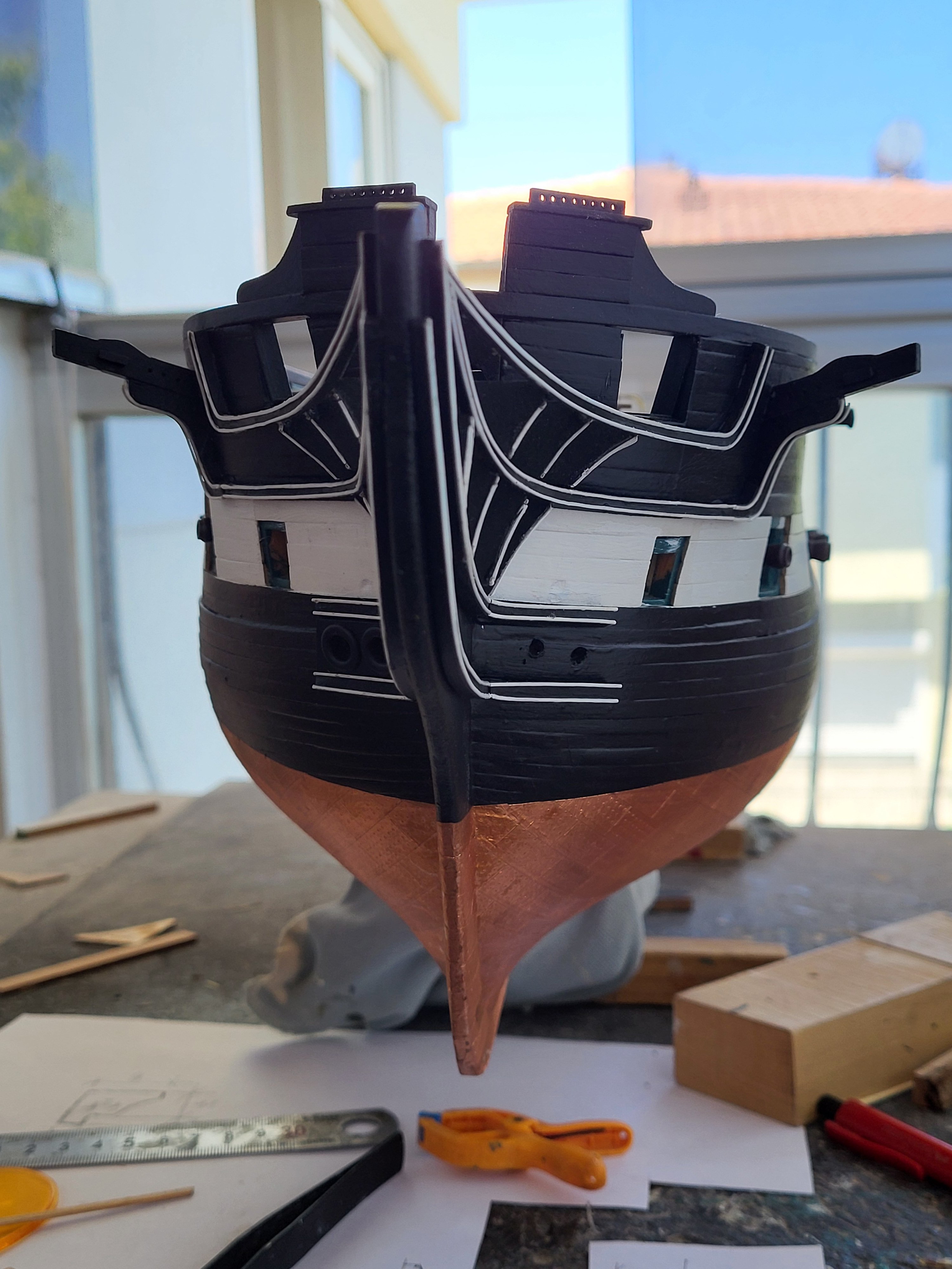

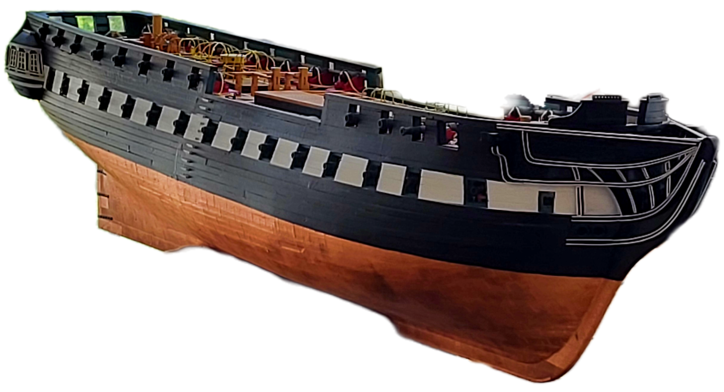

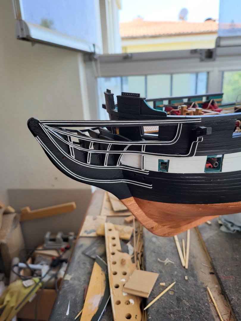

Both sides bow planking completed. The ship doesn't look bad at all with the edited photos. :)
I'm finishing up the bow decoration for now. I'll come back for the trailboard later.
Edited by mtbediz
