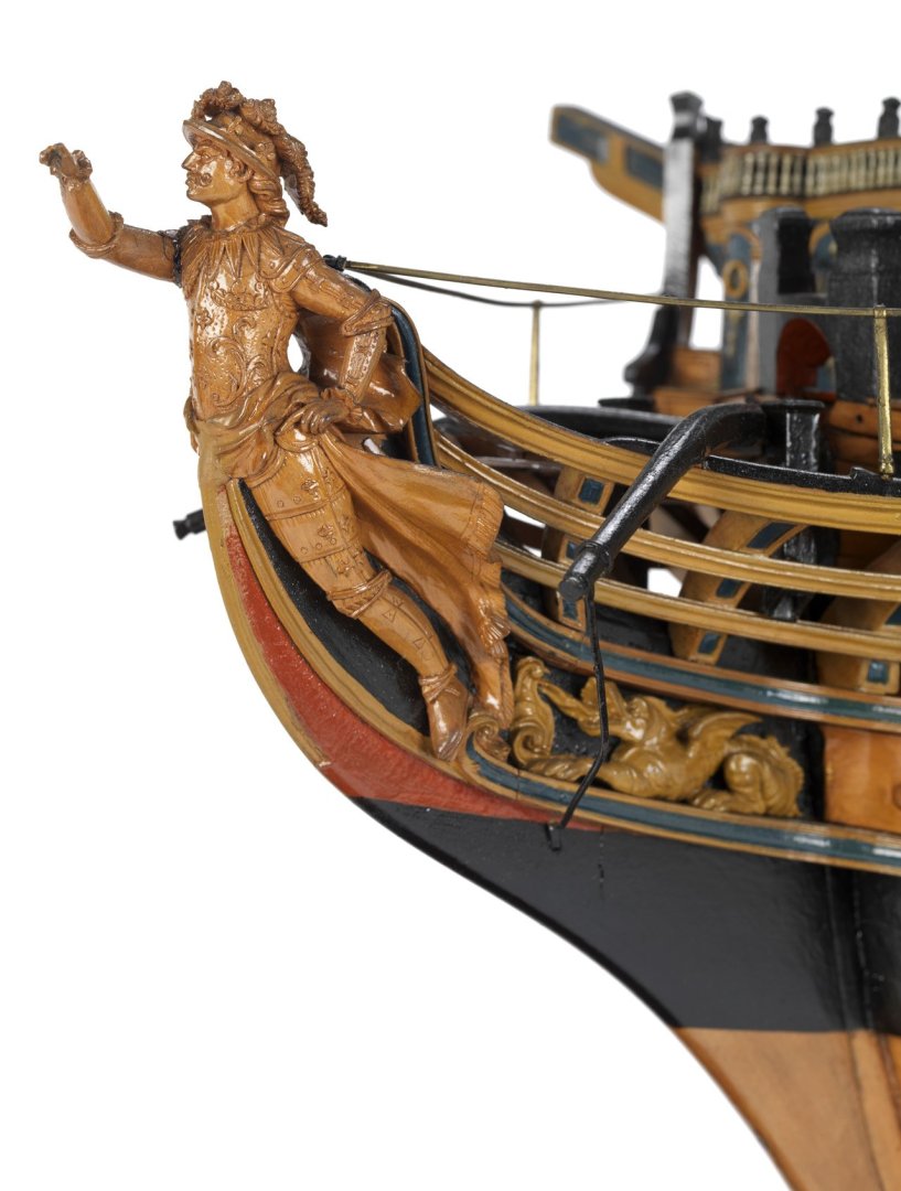

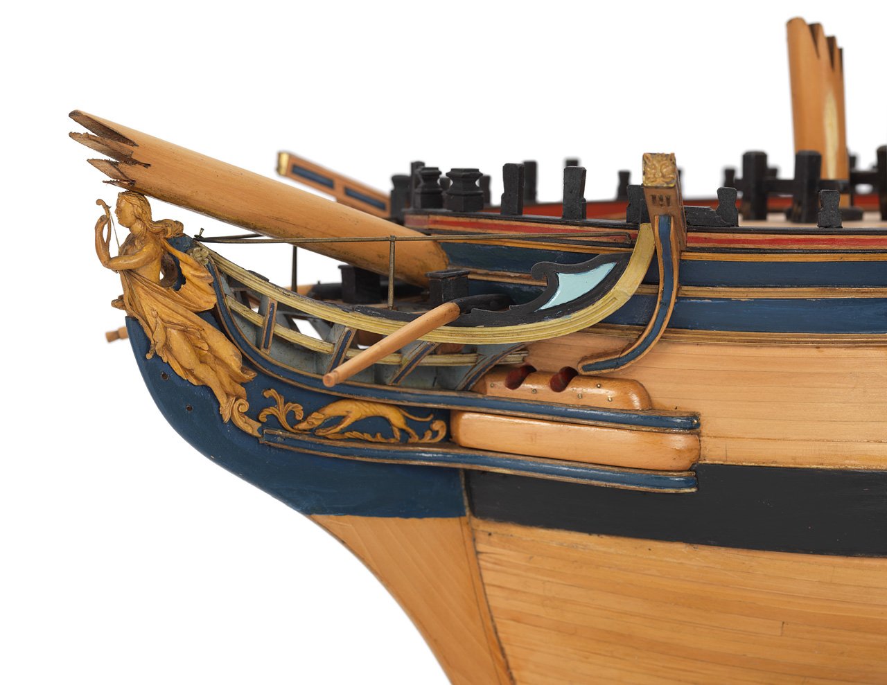

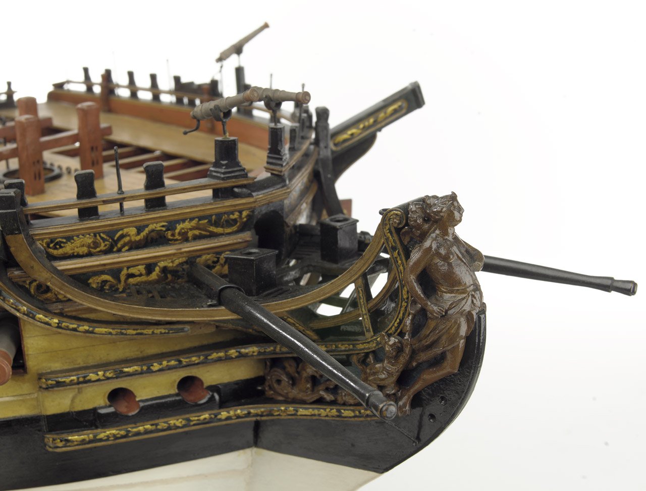

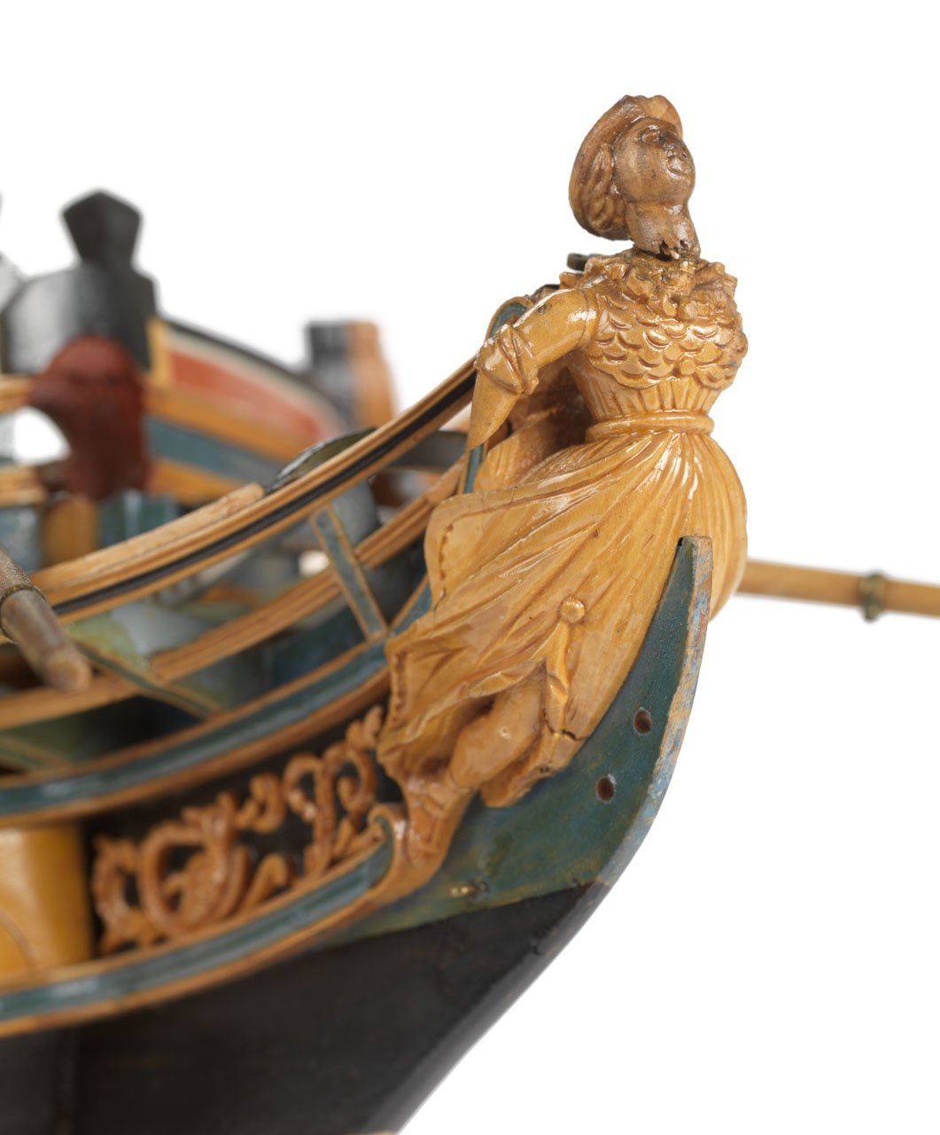

Here are a few reference photos for the bow color scheme. These are contemporary models and the Marshall painting of the Sphinx, and there doesn't really seem to be a set color scheme, but rather, everyone has their own interpretation. Only the Marshall paintings seem to have some consistency, but that doesn't say anything at all :D
I do like the color scheme of the Marshal painting and we have seem a fine example of this with Blue Ensign his Sphinx...so i'm leaning towards that :)
(pictures are from the Royal Greenwhich Museum)
Diana 1794
Marshal painting Sphinx 1775
Amazon class 1773 (not sure which ship)
Second rate 1775 (not sure which ship)
Minerva 1780 fifth rate
Edited by Ronald-V

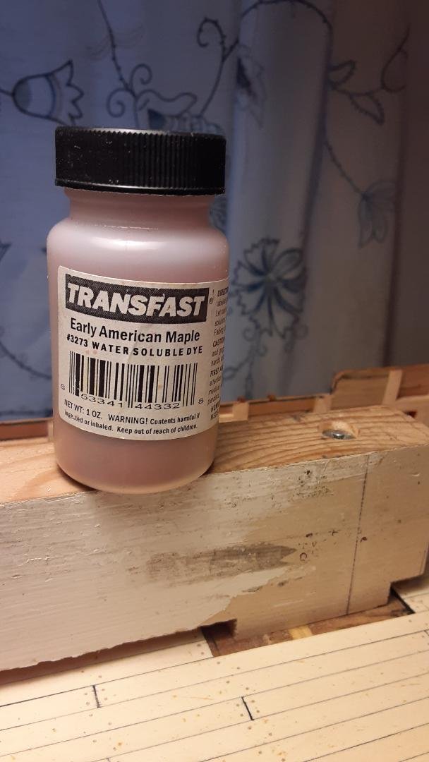

I personally find Boxwood (or similar light color) so difficult to work with.  Either you leave as is, which often stand out with the rest, or you stain it.  I had bad experience with staining in the past. I find it very difficult to match with the remaining ship or just look natural.  Most time I just settle with no staining at all, just varnish.  I never tried adding a little bit of stain to the varnish though, just to darken it a tiny bit.
Are you referring at the figurehead? Because that is a resin/plastic piece with this kit, so that needs color anyway. I was more looking what colors the prow and rails need, because there are quite some variations :)
Edited by Ronald-V
I've also been contemplating the color scheme for my Resolution, 1777 and finding little help from paintings or more modern art.  The TFFM Swan class book series says that sheer rail and waist rail moldings , for example, were "bright", ie. unpainted.  And, as far as I can tell this applies to head rails and stern galleries/ taffrail as well (with some painted decoration.)  But this may mean for Admiralty models and not the actual ships.  Someone recently asked on this forum:  "Do you want a model of a model or a model of the actual ship?"  Were the Admiralty models built to represent the actual ship or were they an idealized representation made to impress the Board?  Would they leave so many unprotected wood details on the outer hull exposed to the elements?   I'm thinking of painting the headrails and stern features mostly yellow ochre but have no reference to substantiate this choice.   That's still a long time off and I could change my plan, agonizing over it all until the brush goes into the paint.
As to mixing boxwood and other species,  I've also unsuccessfully tried to stain boxwood and instead used wood dye. (mixed with isopropyl alcohol rather than denatured which yields a different color.)   In the photo, the moldings and volute are boxwood, the planks and chesstree are Swiss pear.  Although  every thing was installed, I dyed the moldings first, then matched the color when dyeing the planks.
Good post! Yes i'm in that sense not to strict, also not really a "researcher"in that regard...because with building a kit like I do, there are already shortcuts made. So i'm just choosing what looks most pleasing to my eyes and what looks convincing like a real ship from that era. And maybe it's pretty close like it was :D
This is a very important consideration. Models need to be treated as any other primary source piece of material and judged as such. There is also the question of the art of what you are doing. Very few of us can actually fully accomplish modelling every detail so in some respects every model is an interpretation of the actual vessel. Even though I tend to fall on the research it and get it as accurate as possible side of the modelling continuum I still believe that asthetic considerations are very important part of the decision making process, especially when it is unclear what the ship actually looked like.
One thing to note with the Marshall painting is that there is no evidence that the painter ever saw the actual ship and the painting is not even based on an actual model. The painting was done based on a perspective drawing of the ship which was done by drafters based on the plans. The plans themselves have none of the painted decorations on them. Given the aesthetic similarities between the many of the Marshall paintings I suspect that the decorations were simply a product of his imagination and he chose to make the various ship models he did paintings of have a similar aesthetic as they were all meant to be displayed together.
That being said it is possible he saw the actual ship and I suspect he knew better than I do what was typical for a ship of the period….
Great post as always Thukydides. Yeah I suspected that with the Marshall painting due to the similarities between them. I suspect also that  the colors look more "vibrant" then they actually were in real life, just to enhance the model on the painting.
Yes you are likely right on the vibrant part. I did choose to paint my alert in that manner (vibrant colours and painted decorations the ship almost certainly didn’t have) purely because I liked how it looked.
Another thing I forgot to mention is that figureheads were often painted. I haven’t come across anything concrete on Sphinx, but the yards would tend to paint them yellow ocre, but then the crews would almost immediately paint them in more “lifelike” colours. This was often a major source of pride for them. So Sphinx as launched may have had a yellow figurehead (as in the painting), but Sphinx in the first year of service may very well have had a more elaborately painted figurehead.
So far as I know there are no records of how ships were painted and for the most part captains could paint it as they wished, using their own money for the paint. As none of my models are destined for the Smithsonian I choose to paint them as I wish. I would say though painting beautiful boxwood should be considered a crime 😁

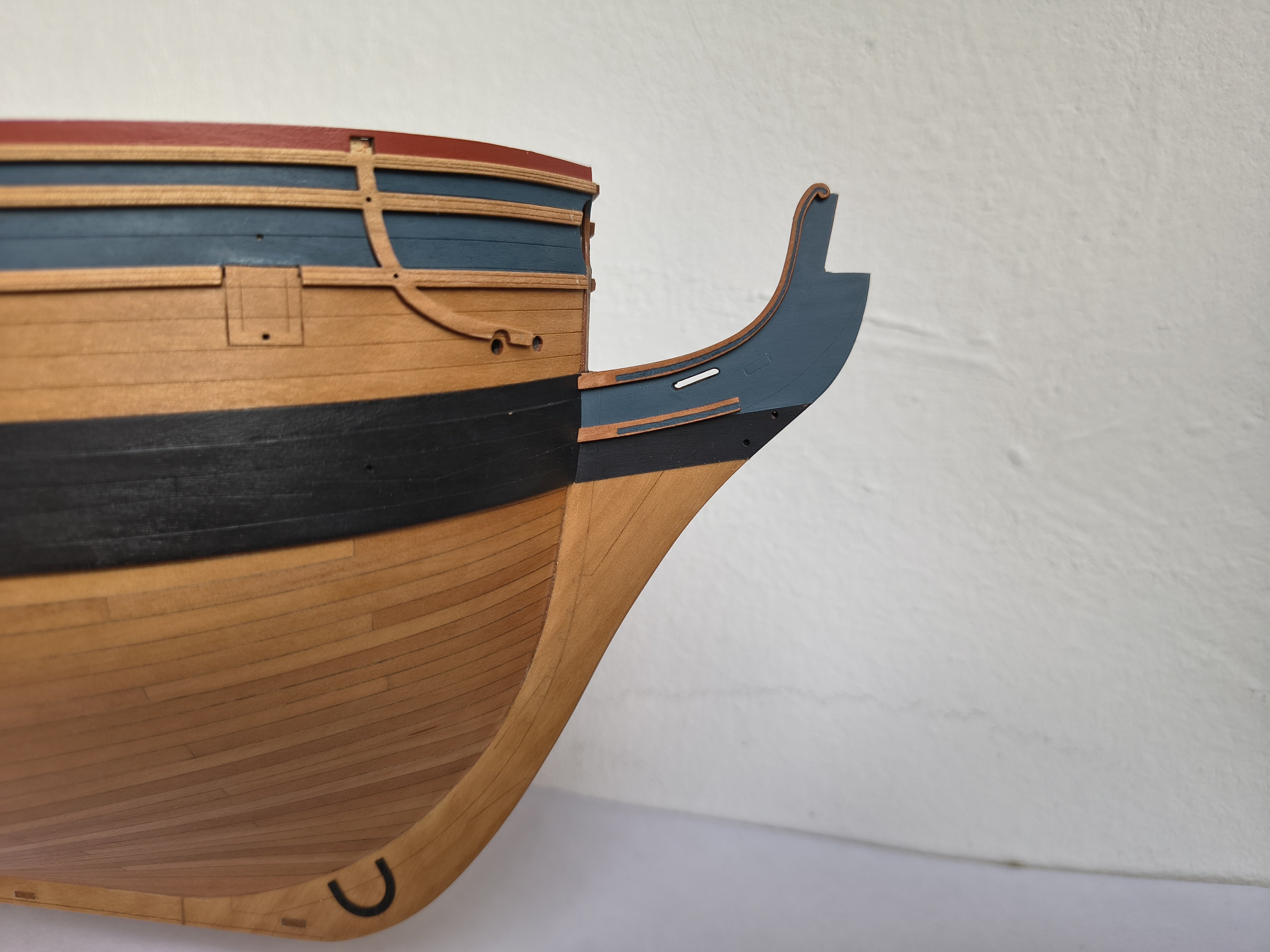

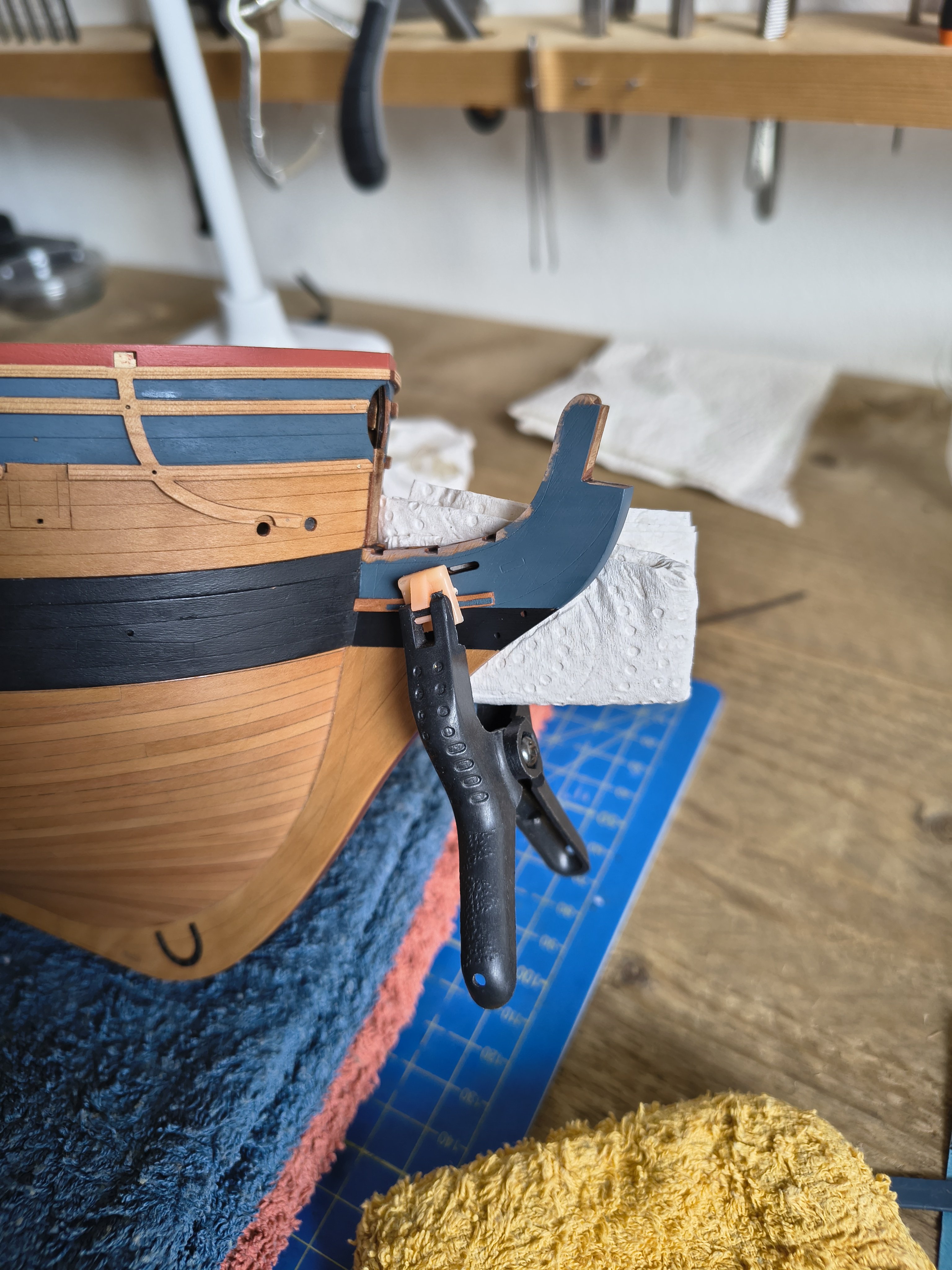

I actually wanted to post an update only after I finished the entire bow...but I had so little time to actually work on the ship, so I thought...might as well post a small interim update. Otherwise, it'll be a very long update.

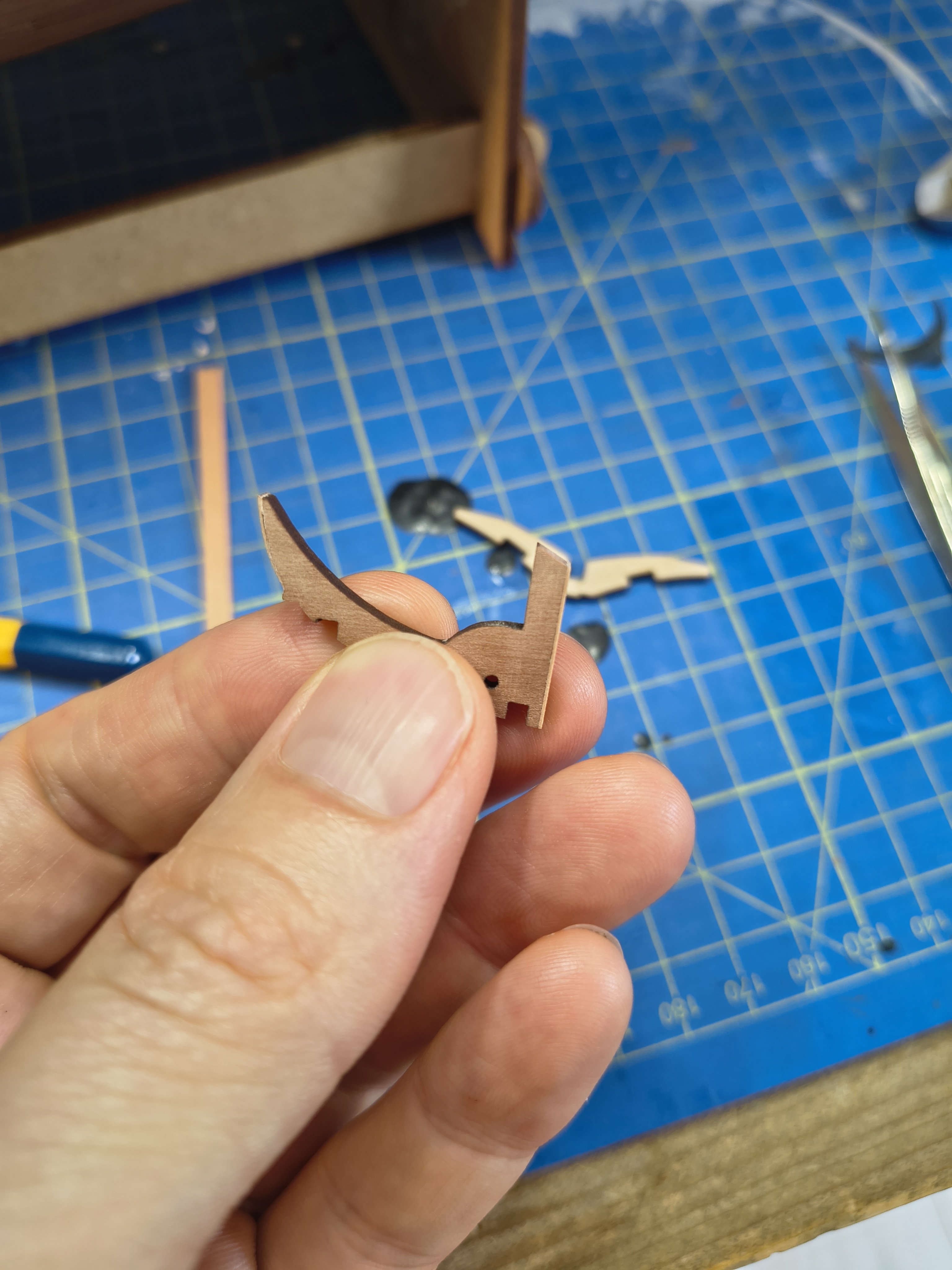

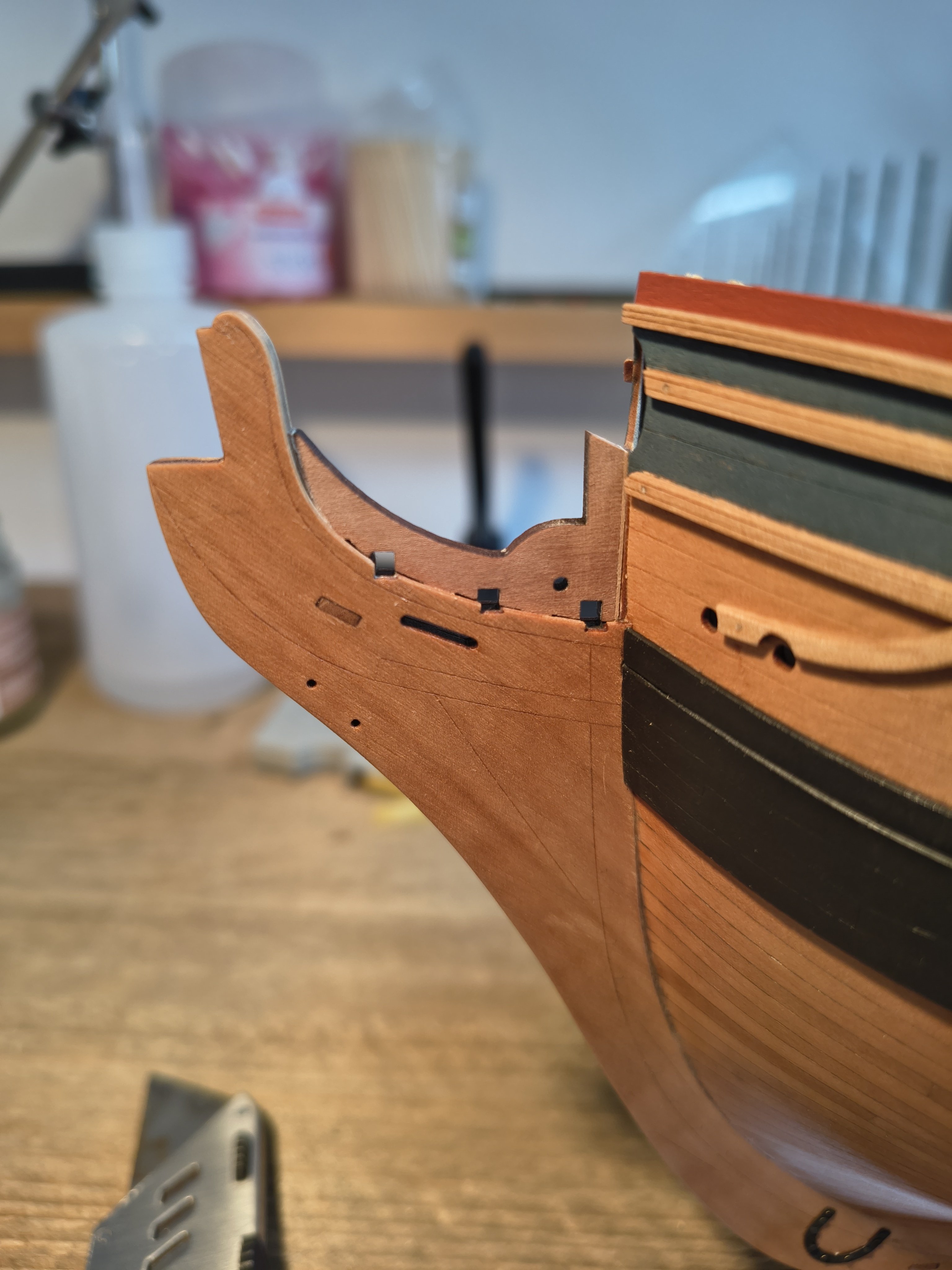

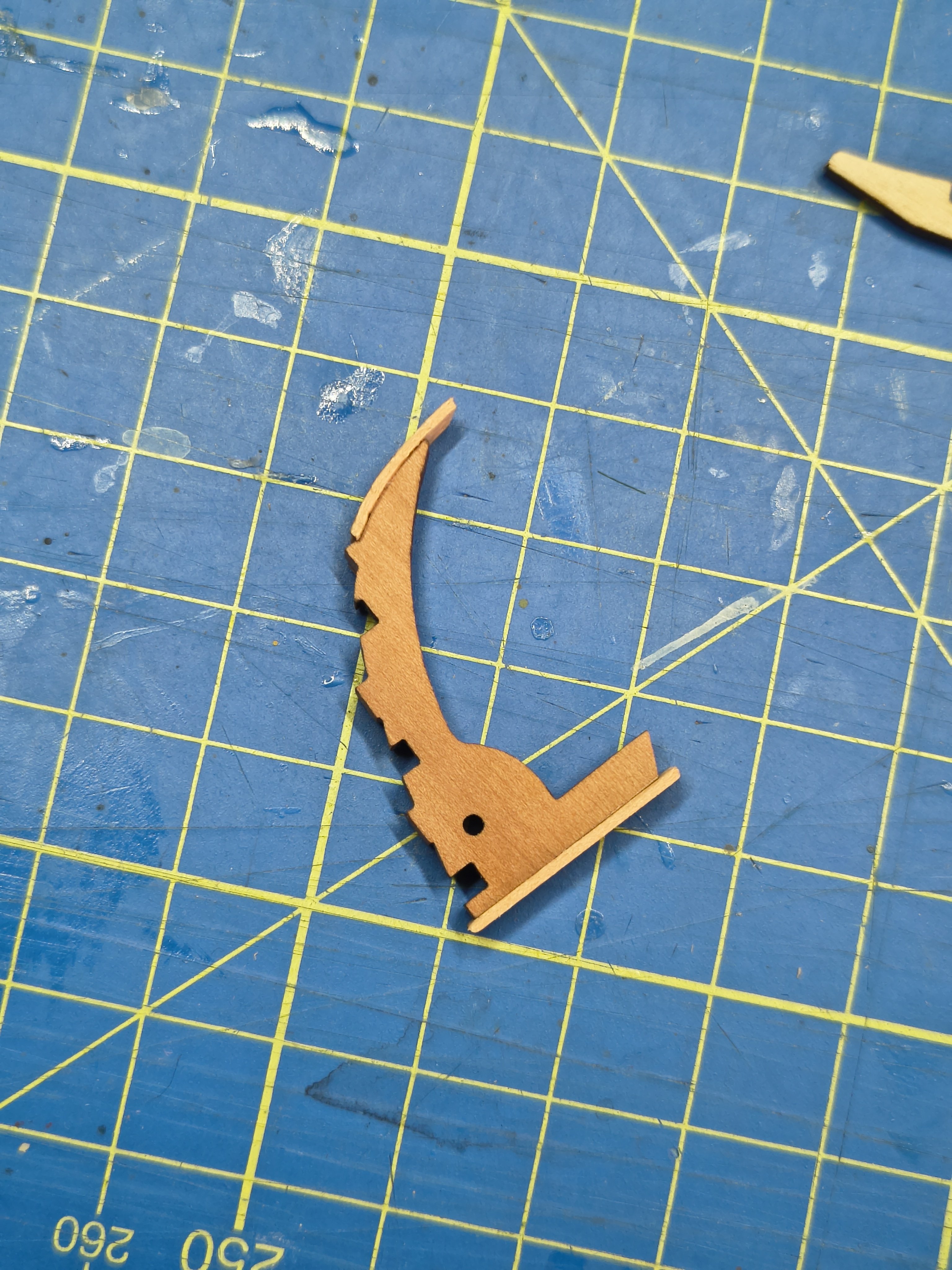

First, I had to fit the gammoning knee. I noticed it didn't quite fit the curve of the prow. I probably sanded away the char a bit too enthusiastically. So I glued some scrap wood to the knee and then sanded it into shape.
Supervisor 🥸

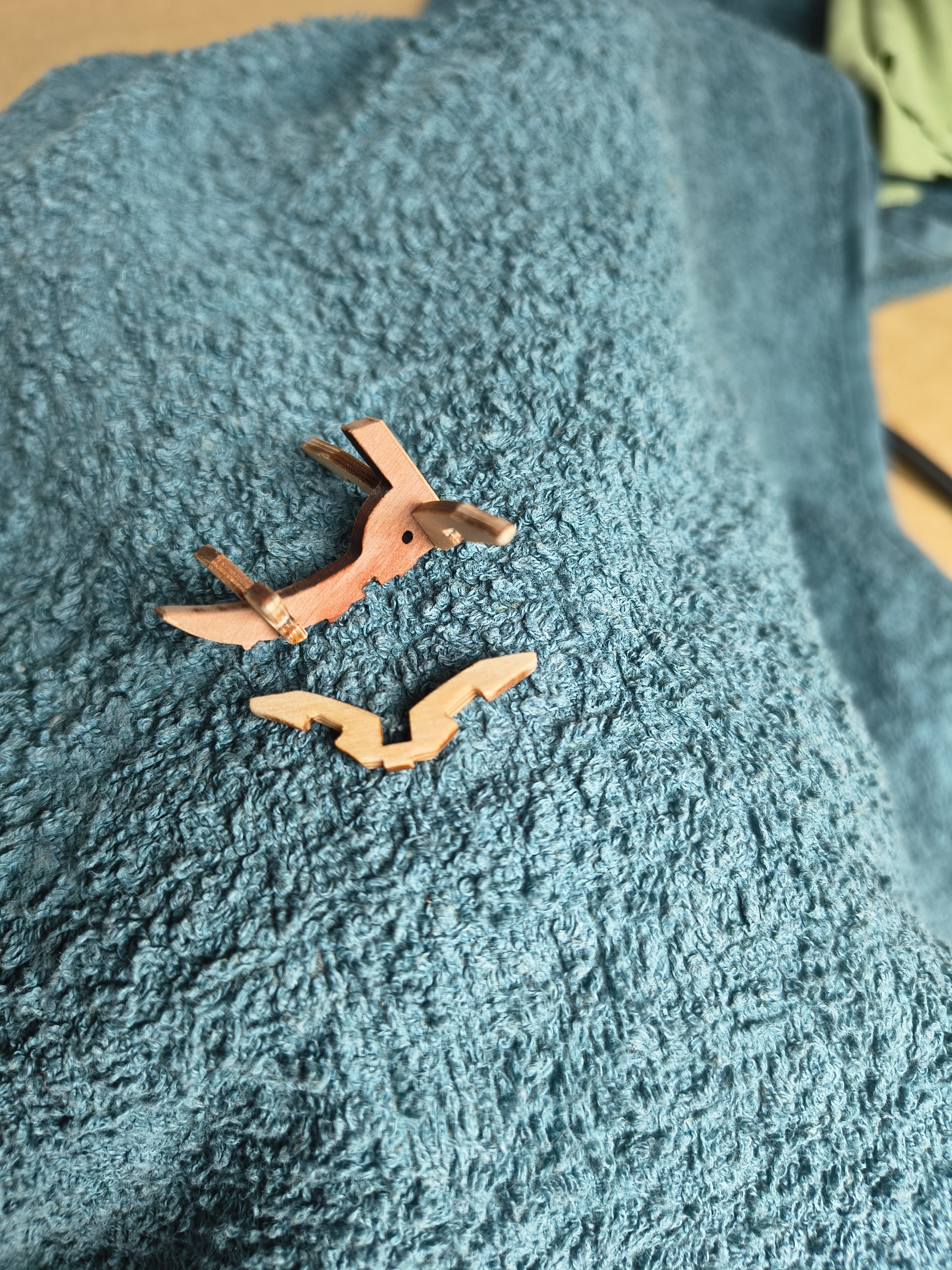

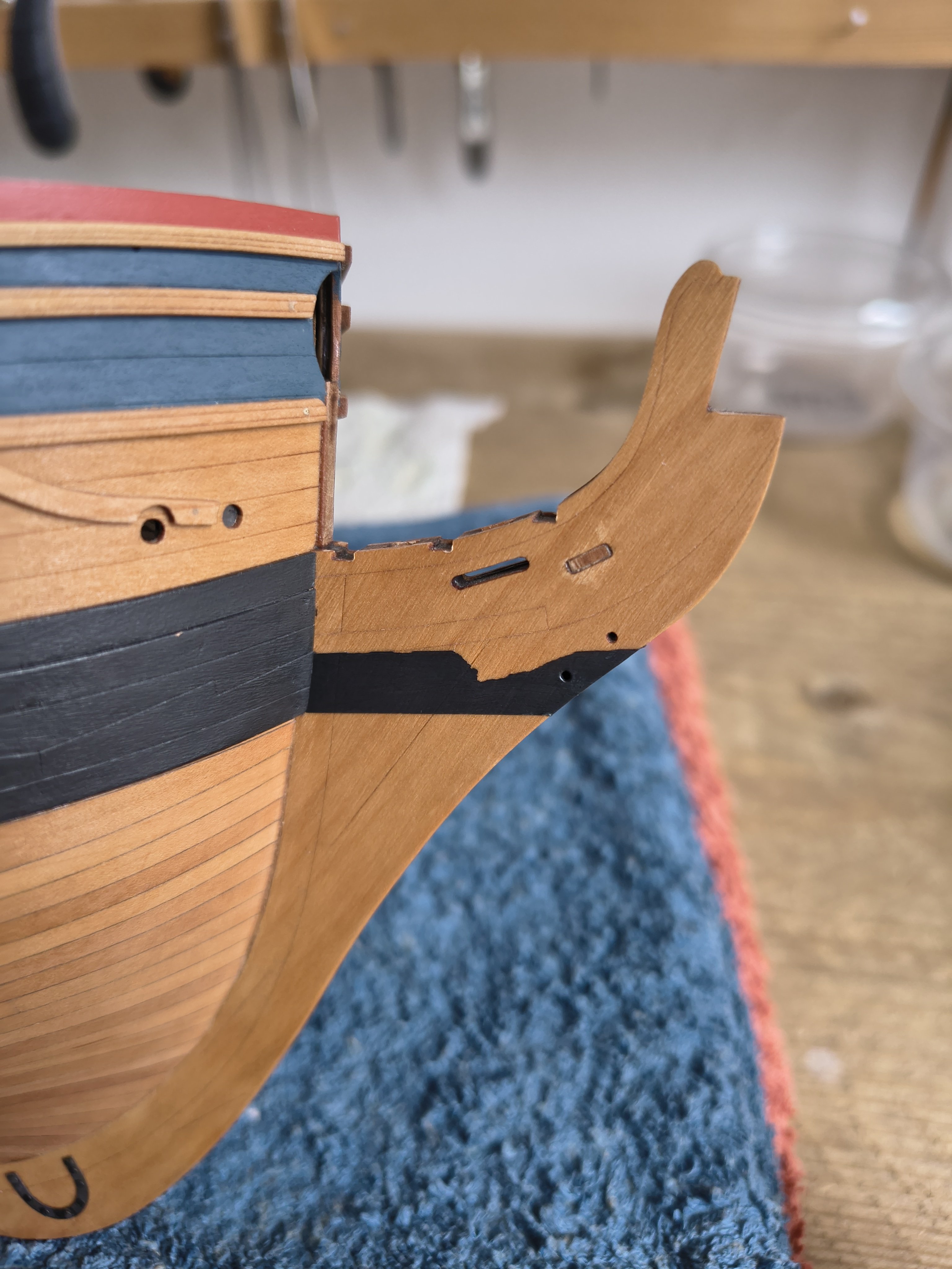

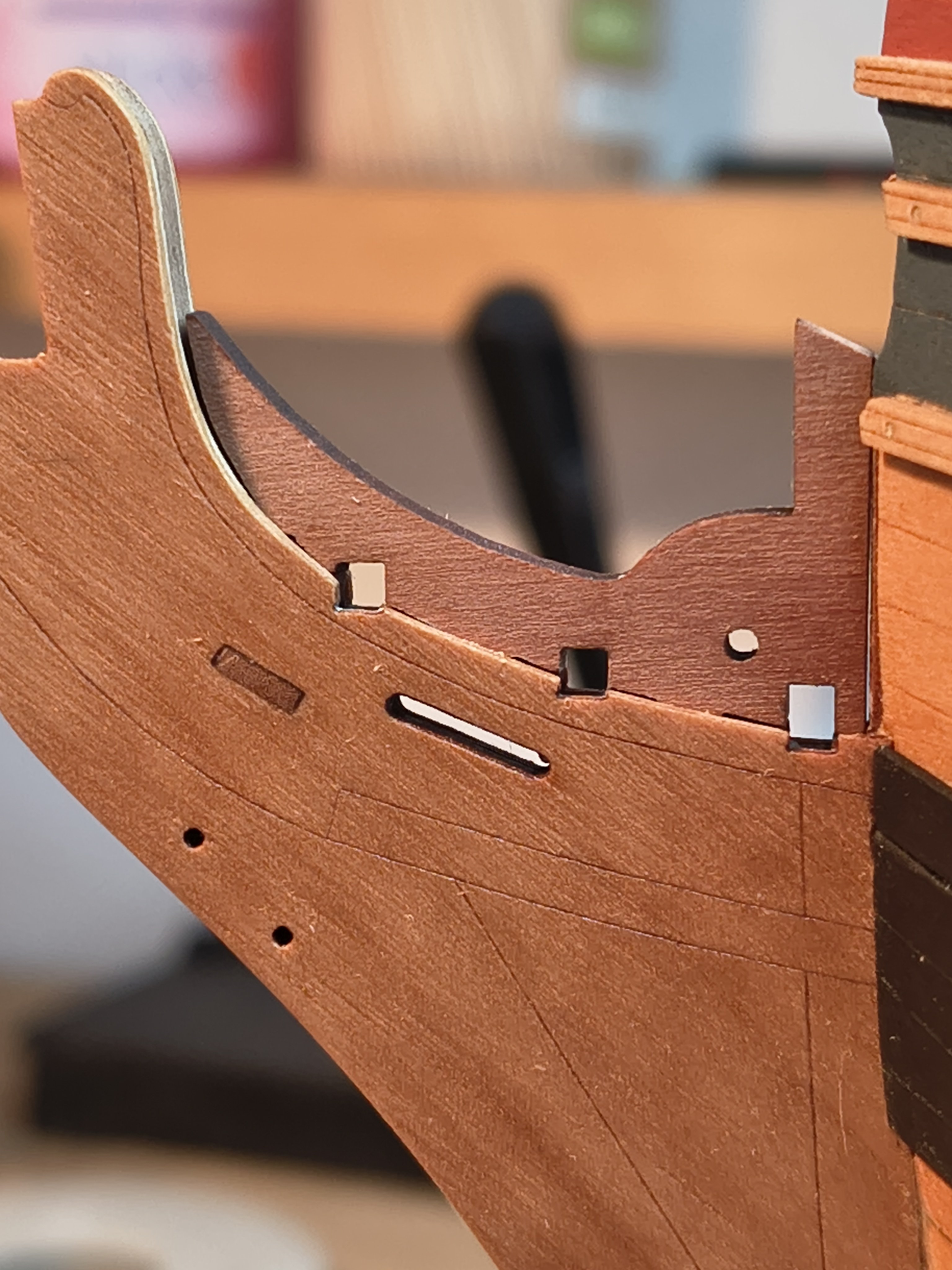

Next, I glued the V-brackets to the gammoning knee, but discovered that the middle one wasn't completely straight/level, which would cause problems. So, I loosened it with some alcohol and re-glued it.
Dryfitting as much as possible, nothing glued here

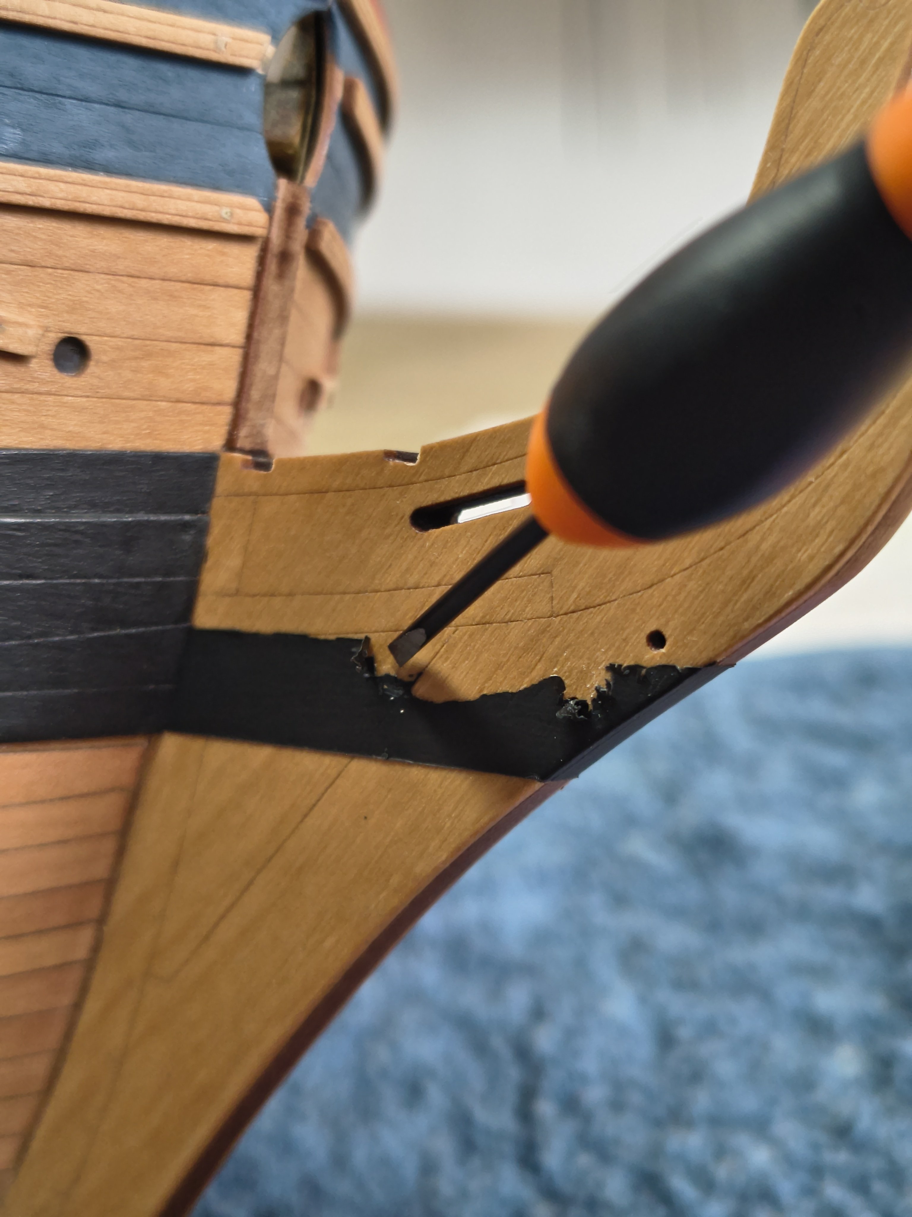

Okay...this part wasn't so good, haha. I was too hasty here. I had everything nicely taped off before painting, but I didn't do a good prep (sanding), and with the WOP already in the wood, removing the tape didn't go well. That was just stupid of me and way too hasty. Prepping is very important, especially if the wood has already been treated.
I pulled off a nice chunk of paint while removing the tape ;)
But with a sharpened screwdriver I was able to remove the paint again and this time I did it properly with the right pre-treatment

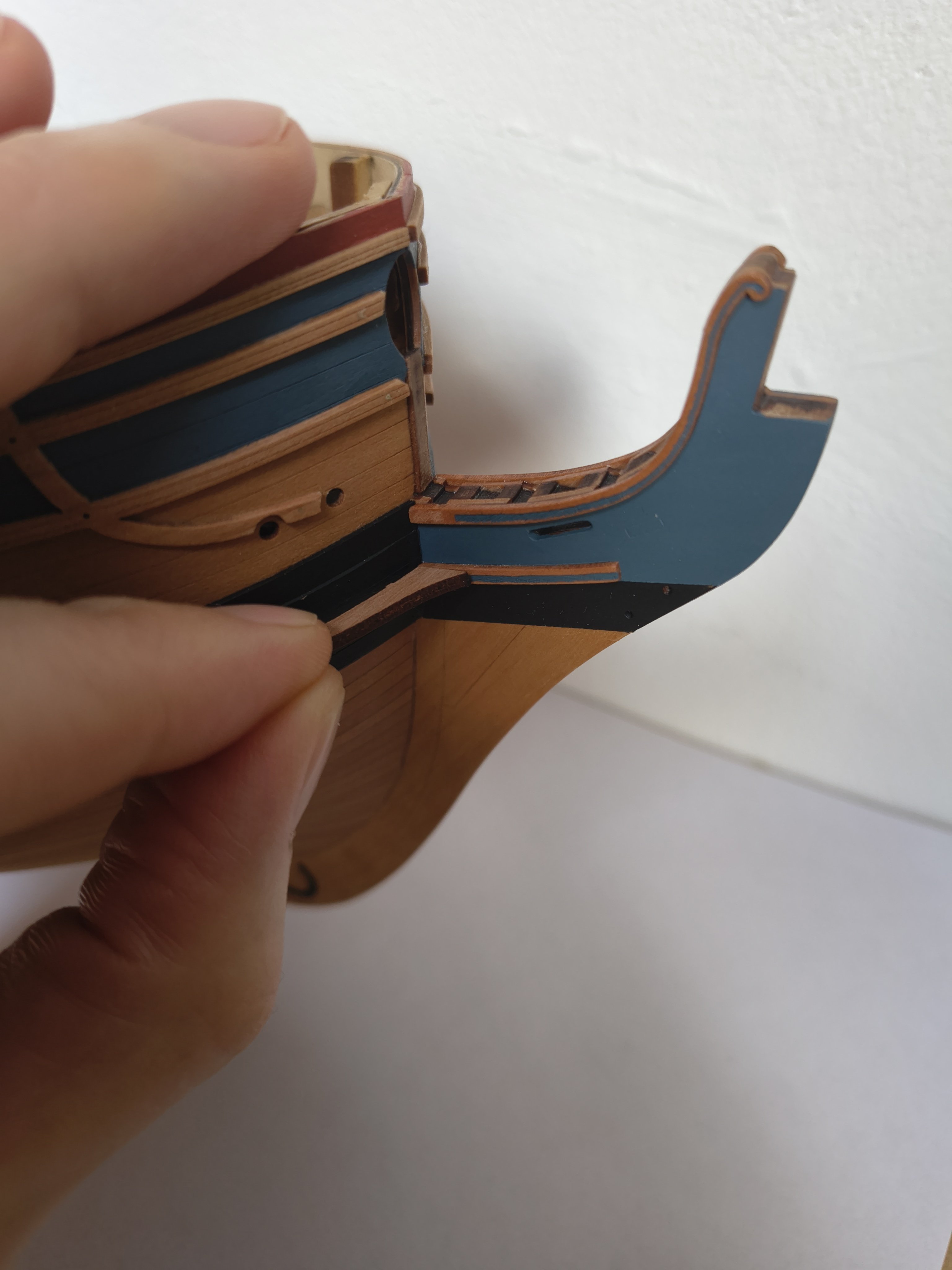

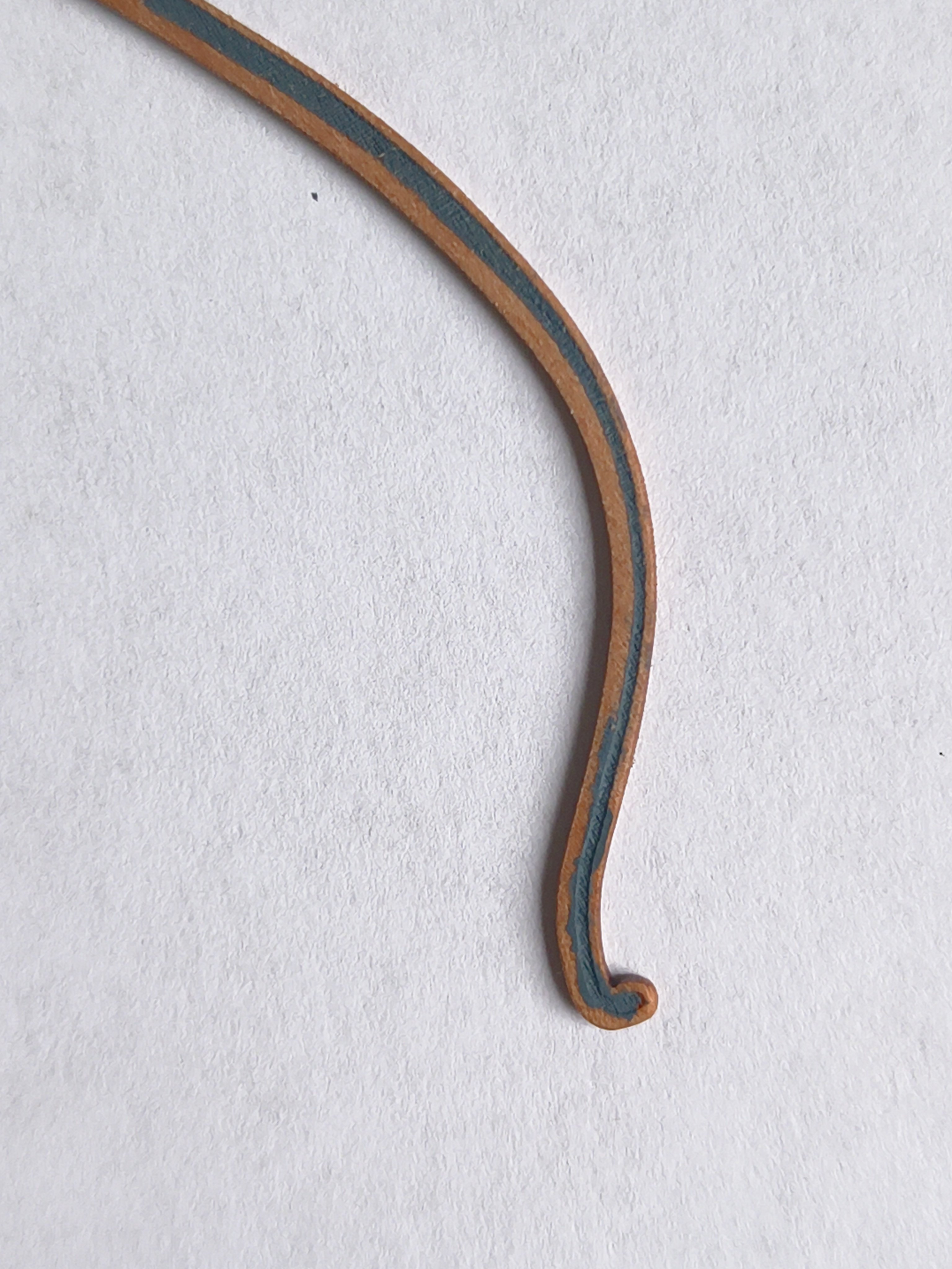

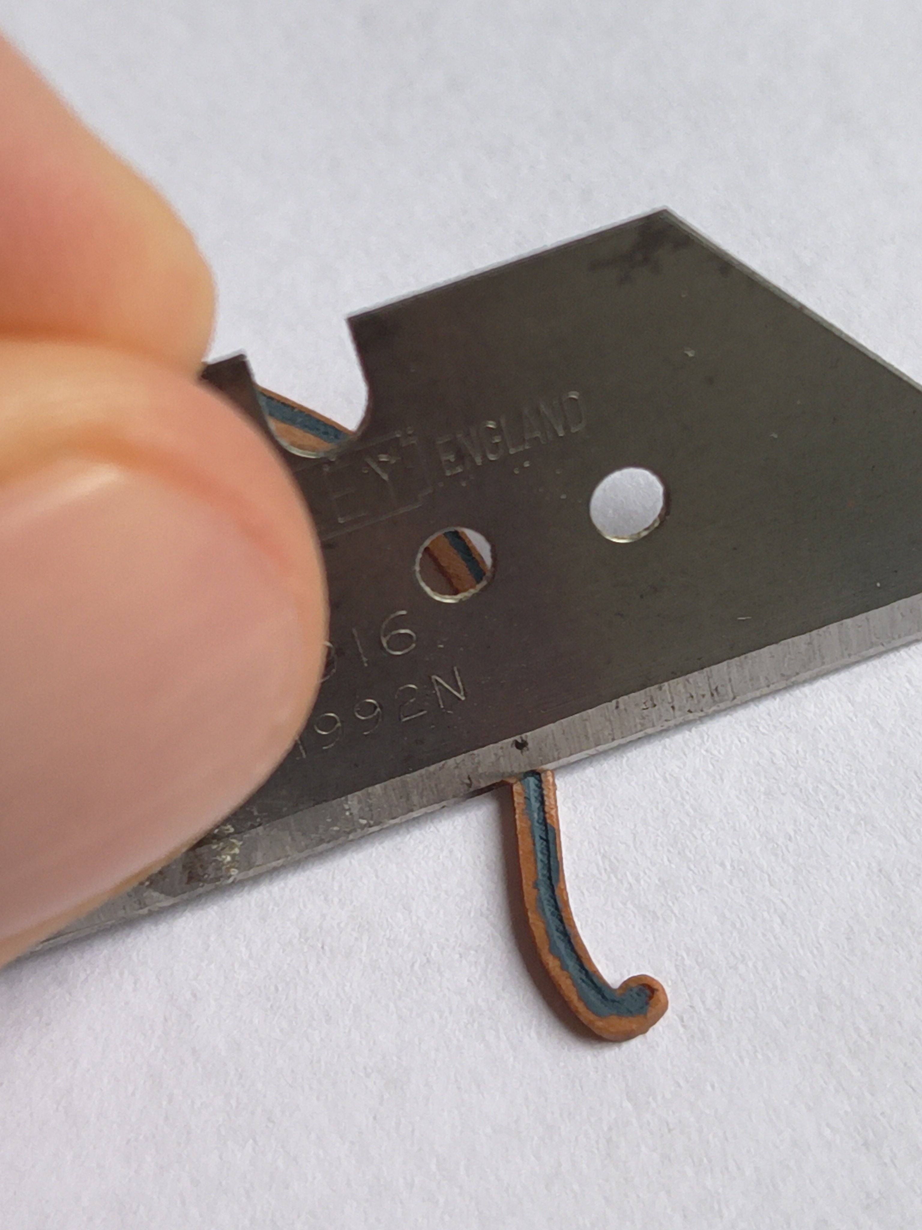

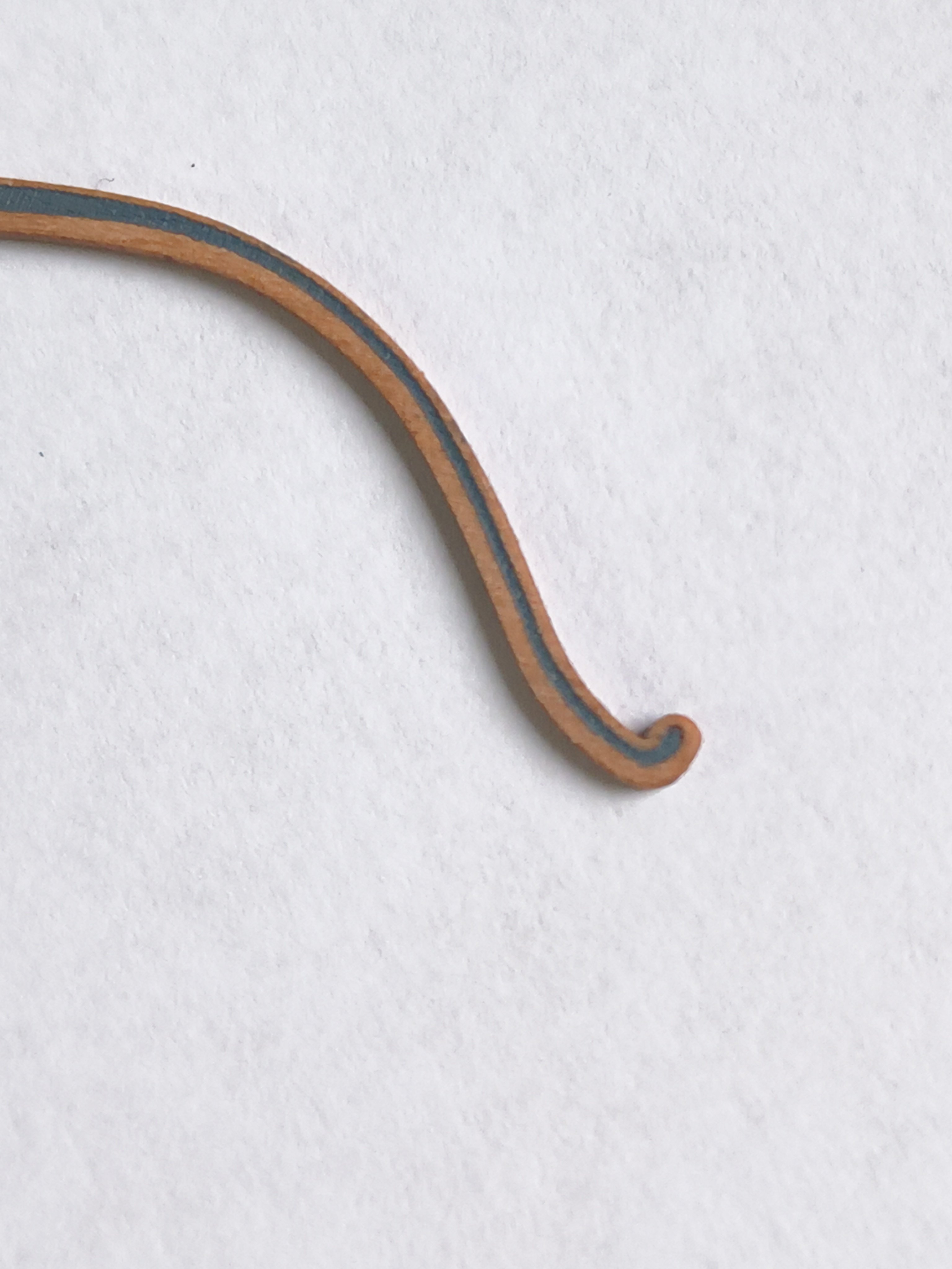

The bow hair brackets were relatively easy to paint because I could scrape off the excess blue paint with a knife. This gave me a nice, clean decorative line in the center, as the laser-etched decorative lines are slightly deeper than the rest. I did, however, paint the "raised areas" that weren't going to be blue with WOP first. This made the blue paint adhere even less, which was an advantage.

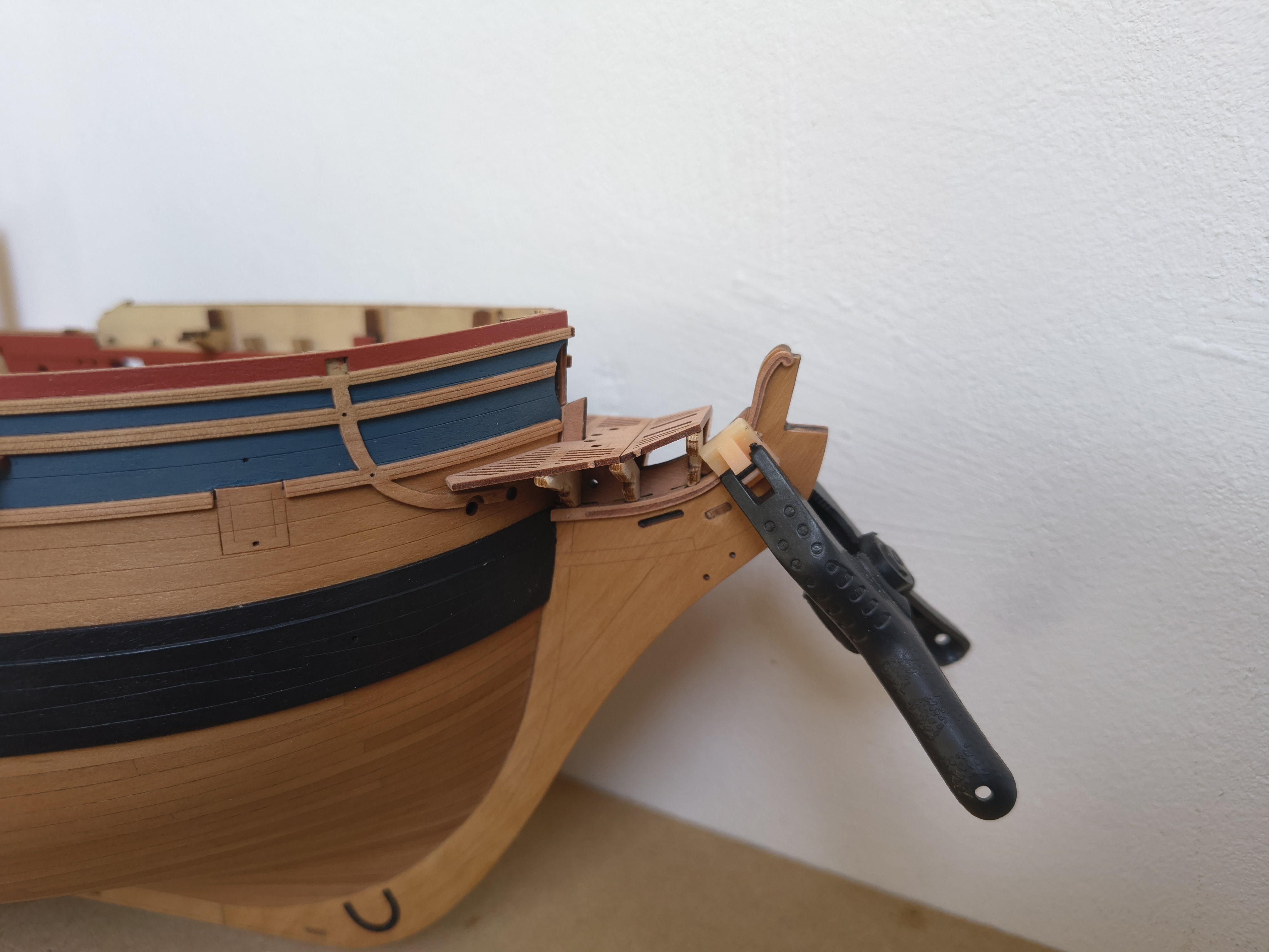

Glued the bow hair brackets onto the now painted prow.
It looks like this now :)
I painted the black line at an angle, this seemed to be the case with almost all the contemporary models I've seen.
From the side it then appears that the wales continues at the same angle towards the prow.
I've already finished the bow grating, etc., but I'm still unsure whether I should do anything about the bow lower rails that will be attached to the sides.
Blue Ensign indicated in his log that the slots in the V-brackets could be smaller. But perhaps I'm too far along in the build to do anything with this. It doesn't seem very visible in other build logs, so I might leave it as is.
Later I will continue with sanding and attaching the bow cheeks :)
That's it for now...I hope I can make some more progress in the near future :)
