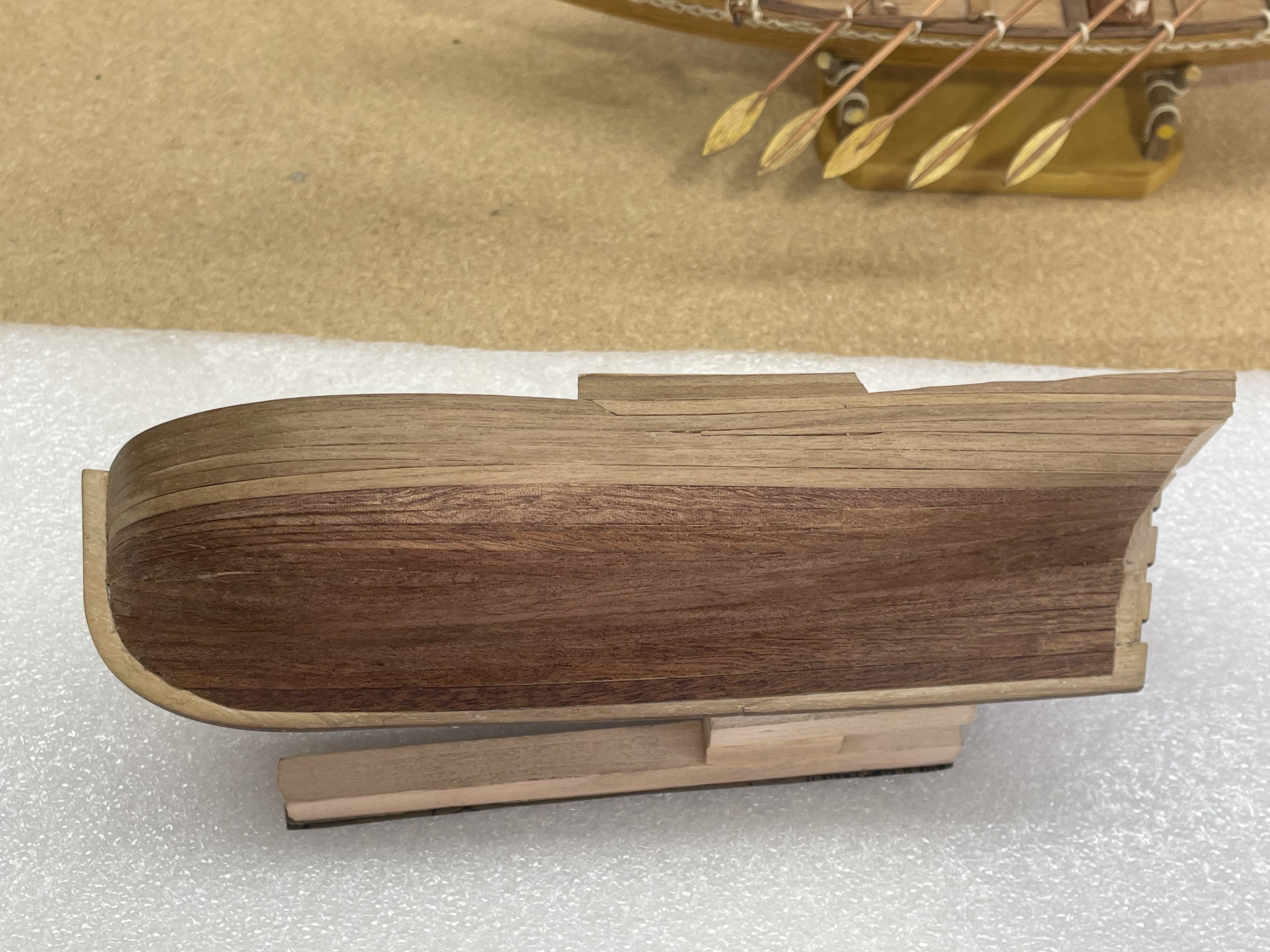

I haven’t forgotten the Gretel. I need to devote more time learning, but sometimes that means less building:-) I did sand down the first planking and put the second planking on the transom.
one of these days I get back on it. Here how it stands.

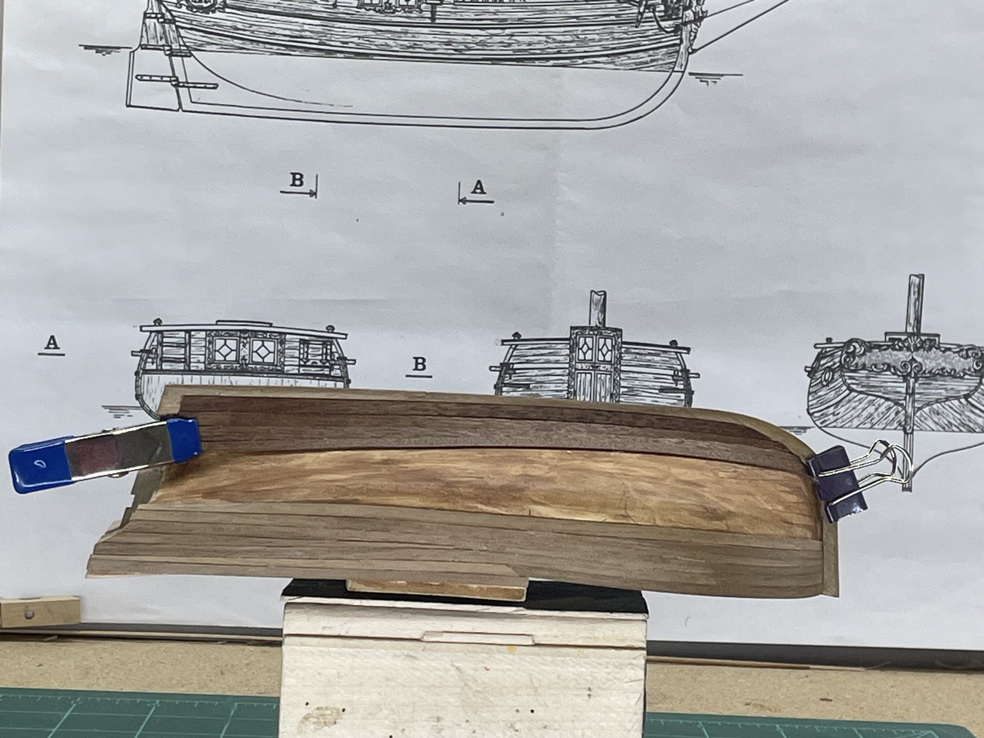

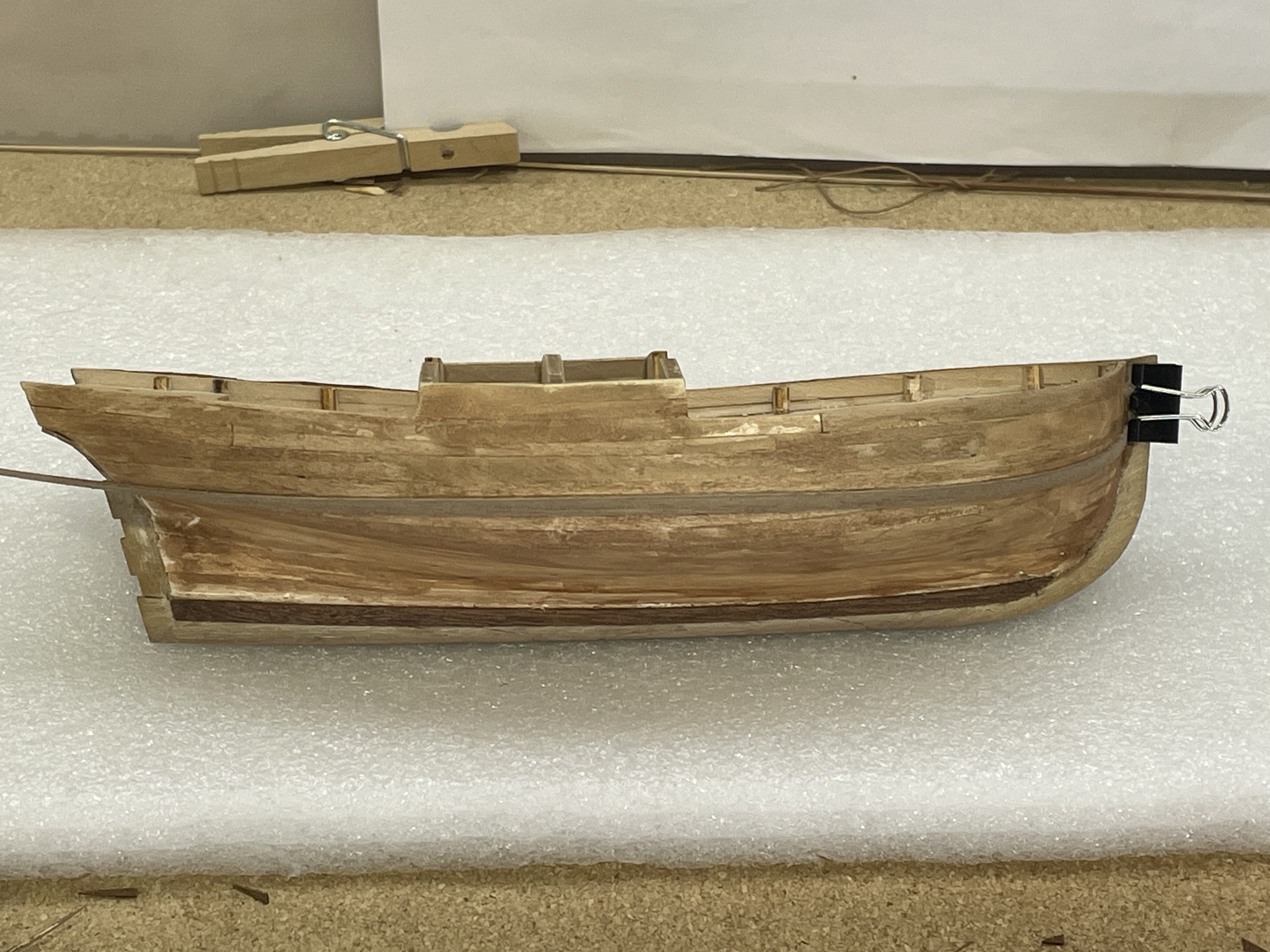

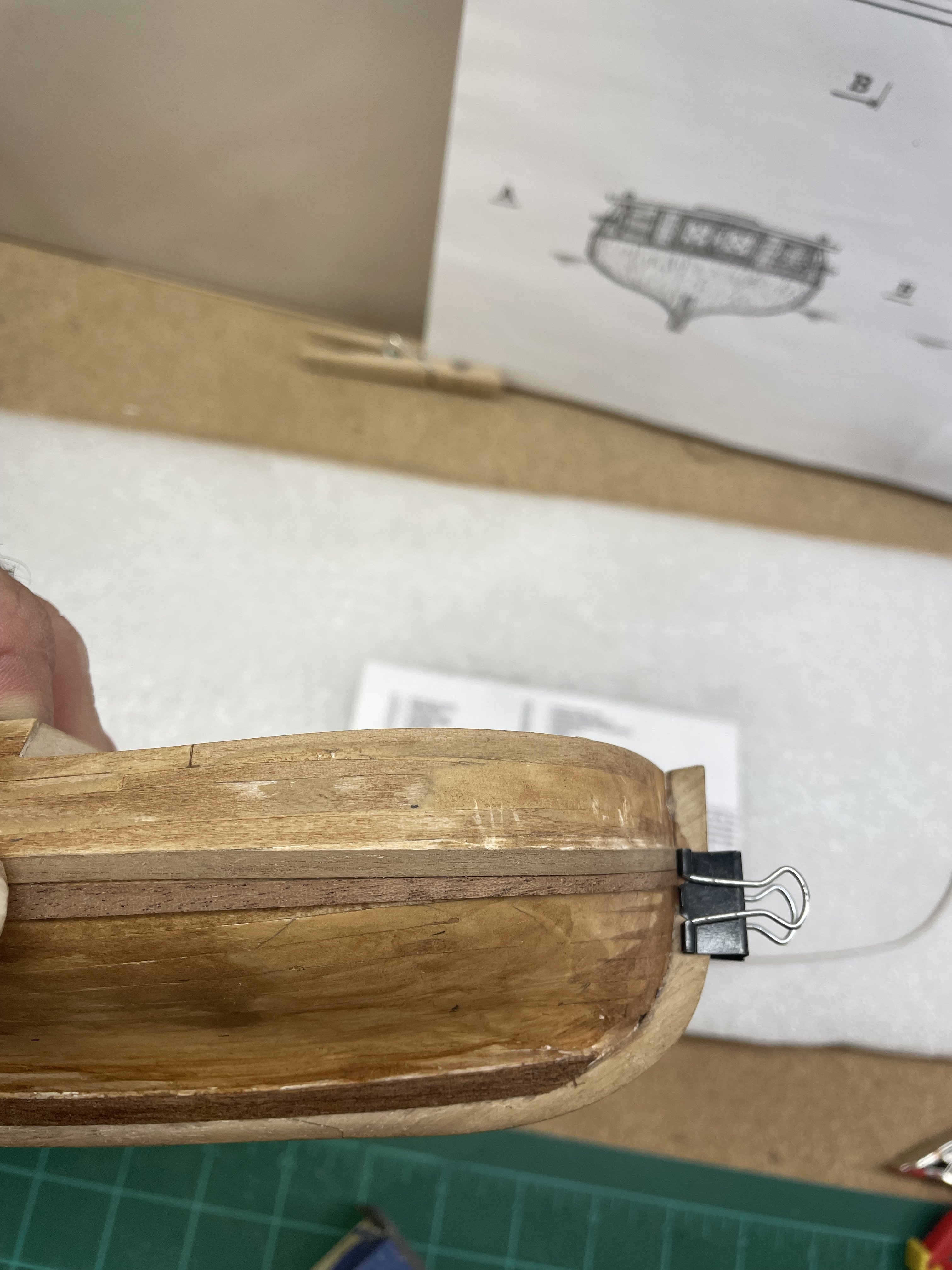

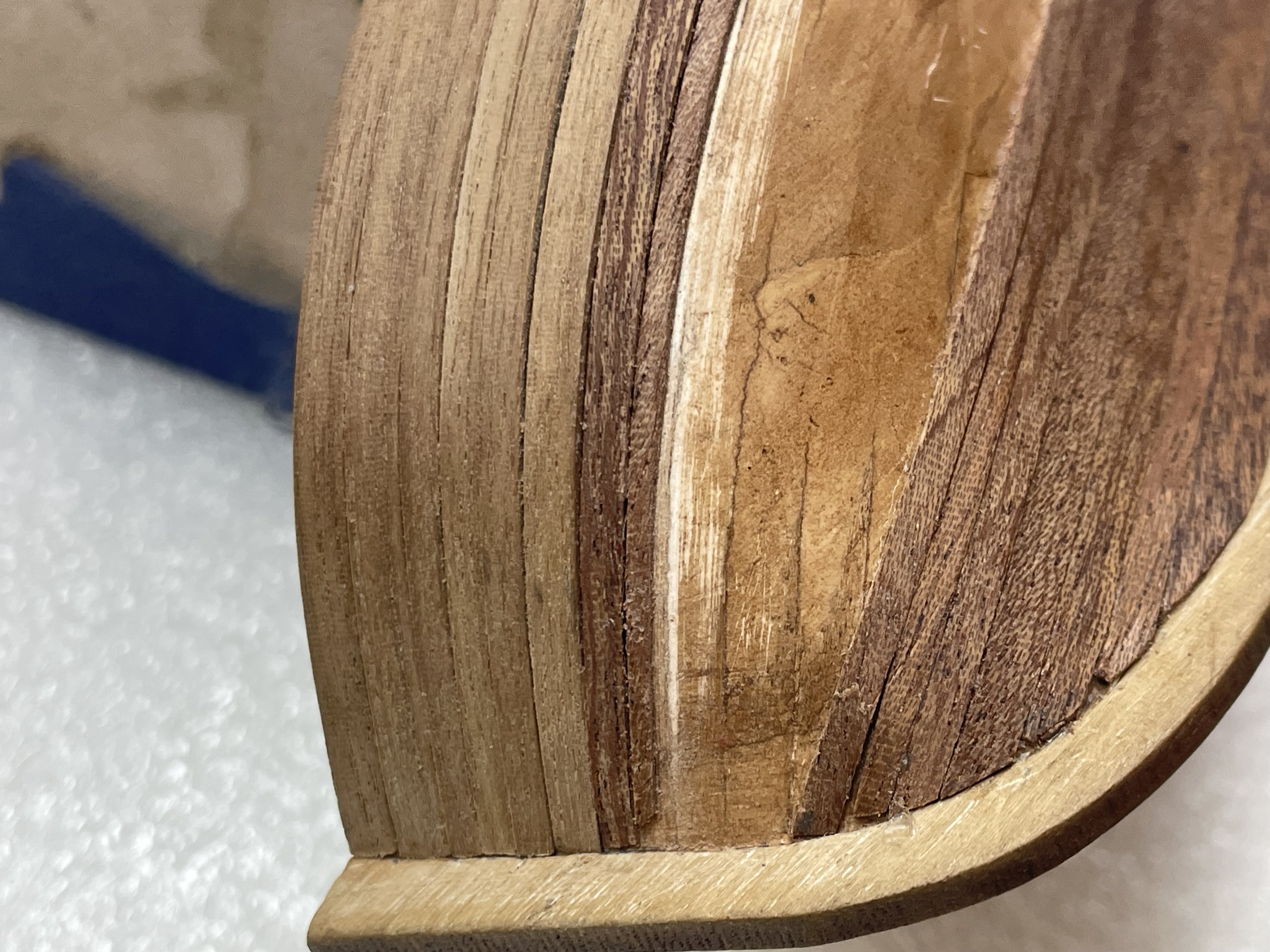

Gretel is back on the bench. I’ve gain no more knowledge on planking , so I’m determined to learn by error. I’ve set down several times at it. Sometimes a plank gets glued and sometimes I walk away. Here’s where I’m at. Comments are welcome:-)
I do measure, but I don’t know why, I just guess at the taper size. I’m only doing the port side now, just in case. Maybe one side will look ok.
Edited by Bryan Woods
Everything started so good:-) Then the reality of my lack of knowledge set in.
I think I’ve worked myself into a tight squeeze:-) Right now my only plan is to go thin at the bow.
That’s probably going to end up as a weird shape in the middle.  And I hope the edges aren’t up so far they can’t be sanded down. But until a better plan, or any plan comes to mind, I’m going to keep cutting and gluing.

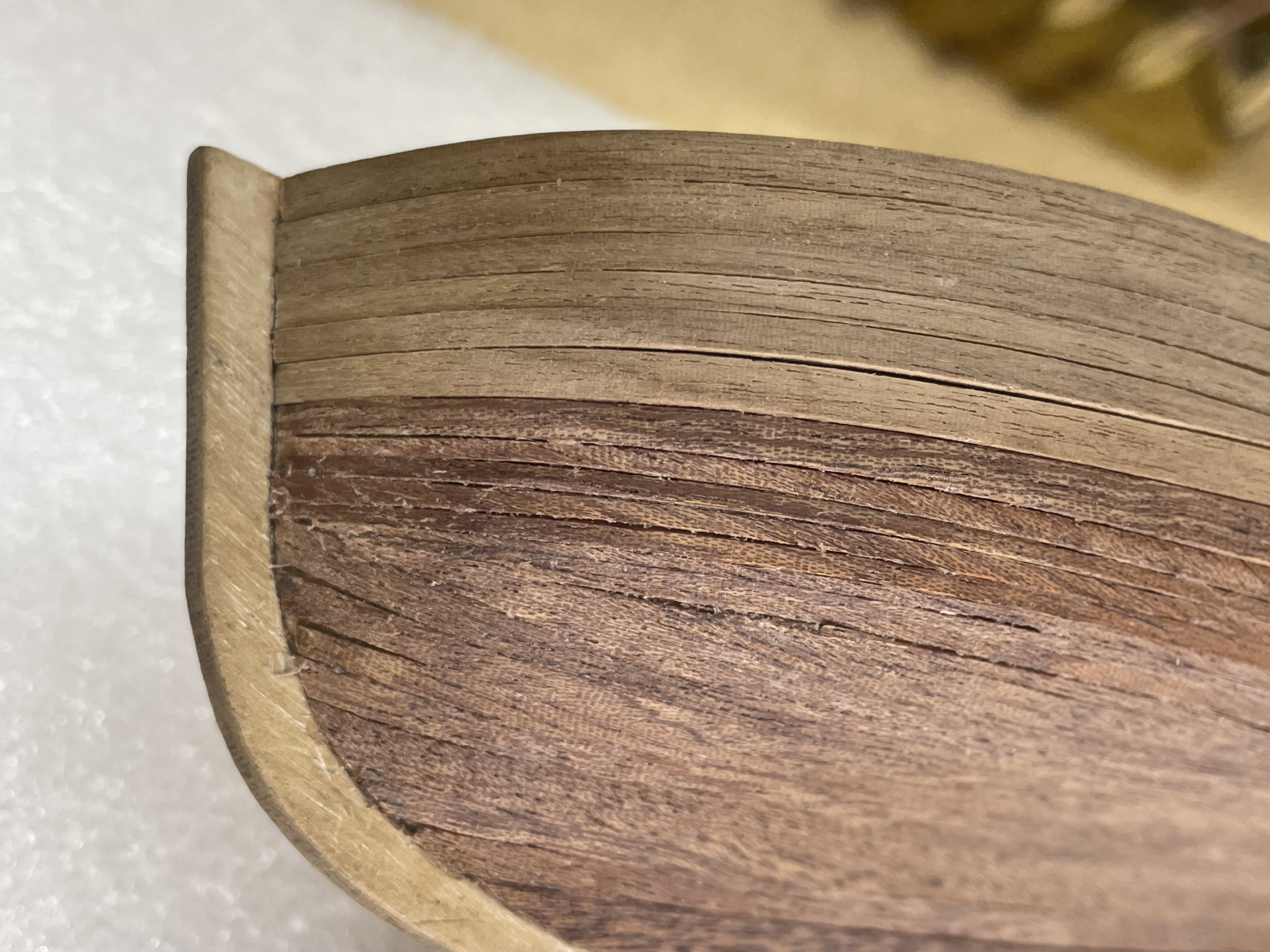

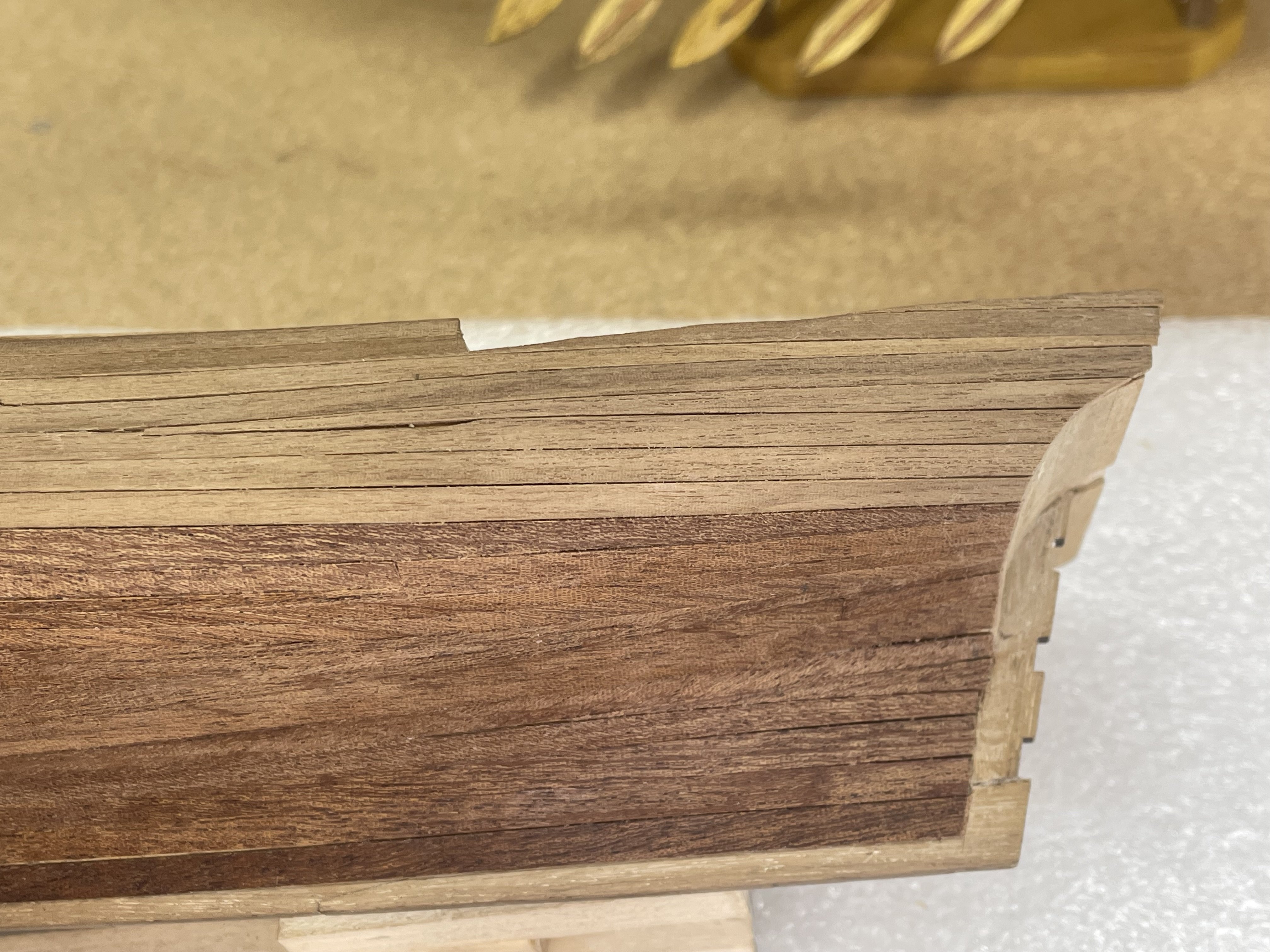

By grace I finished the port side planking.
This little boat had me thinking I was planking a ball:-)
That sapele wood used for second layer planking isn't very forgiving if you need to bend it any direction other than across the very thin side.  The nice thing about it is that you can small splinters and wedges to fill in any little gaps that you don't like.  It usually isn't very noticeable once it is sanded down a bit.  Personally, I think your second layer planking looks pretty good.

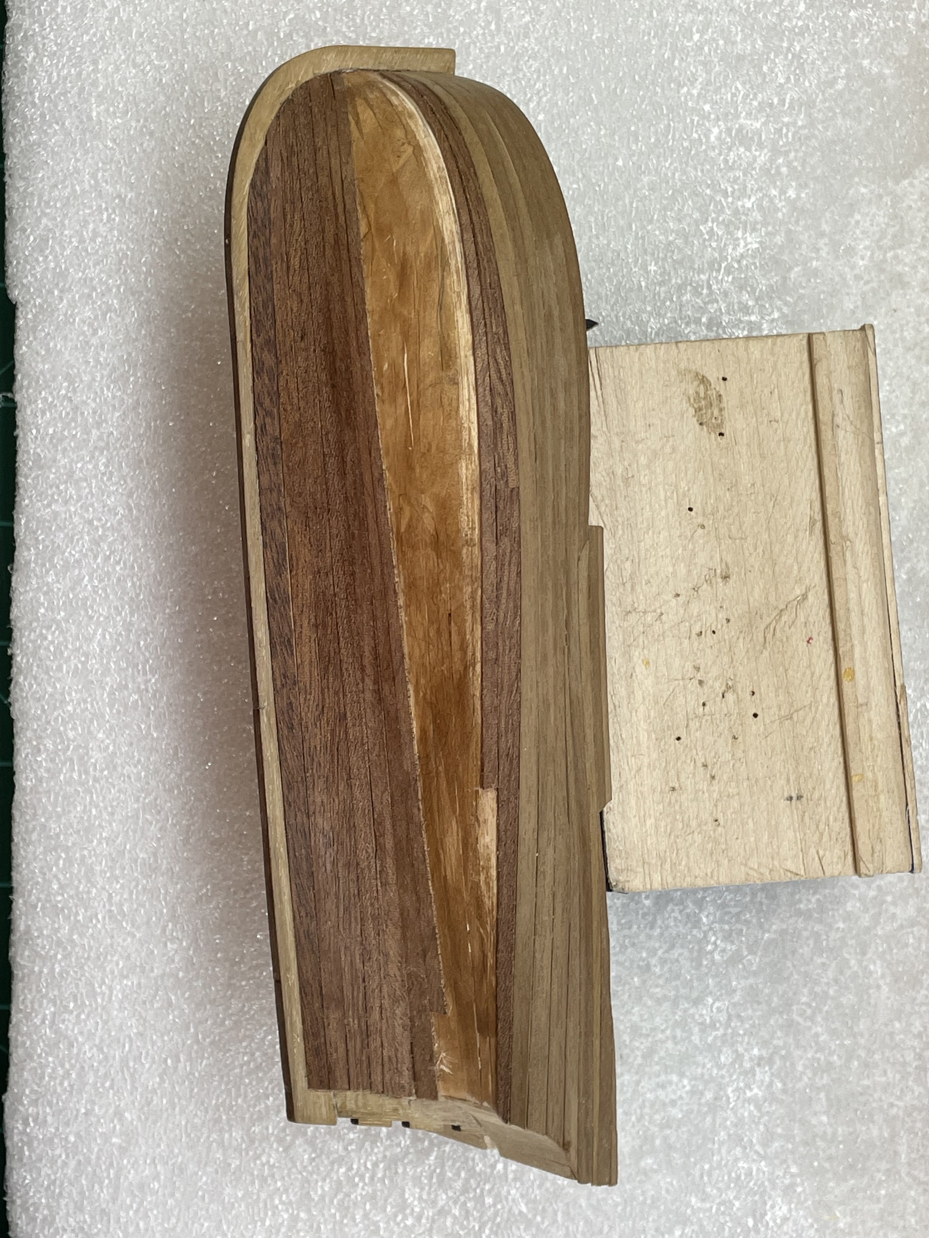

Below, which I’ll probably do later. I tapered the 4mm plank to 2mm and ended it at about 8cm. We’ll see if that works.

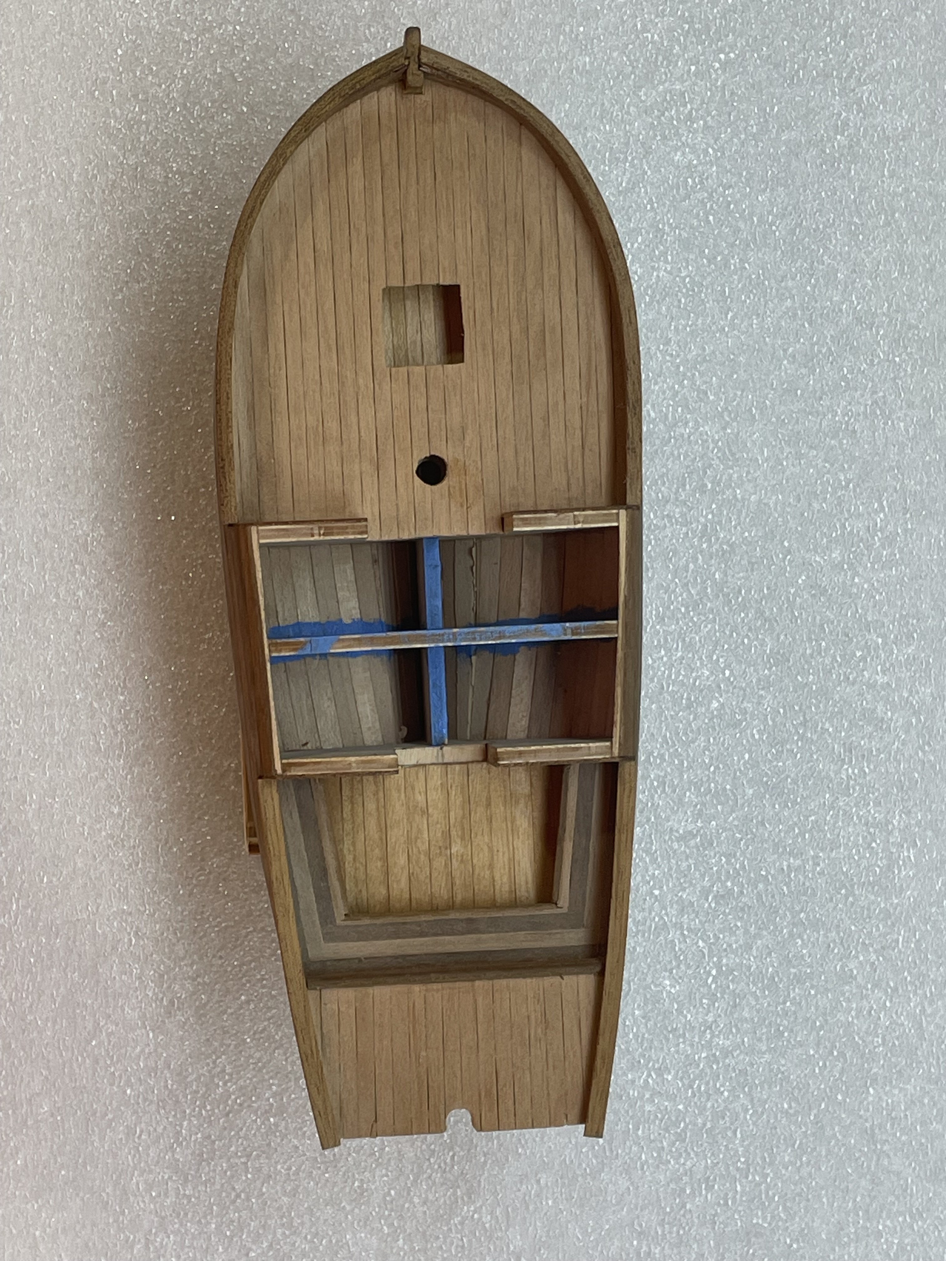

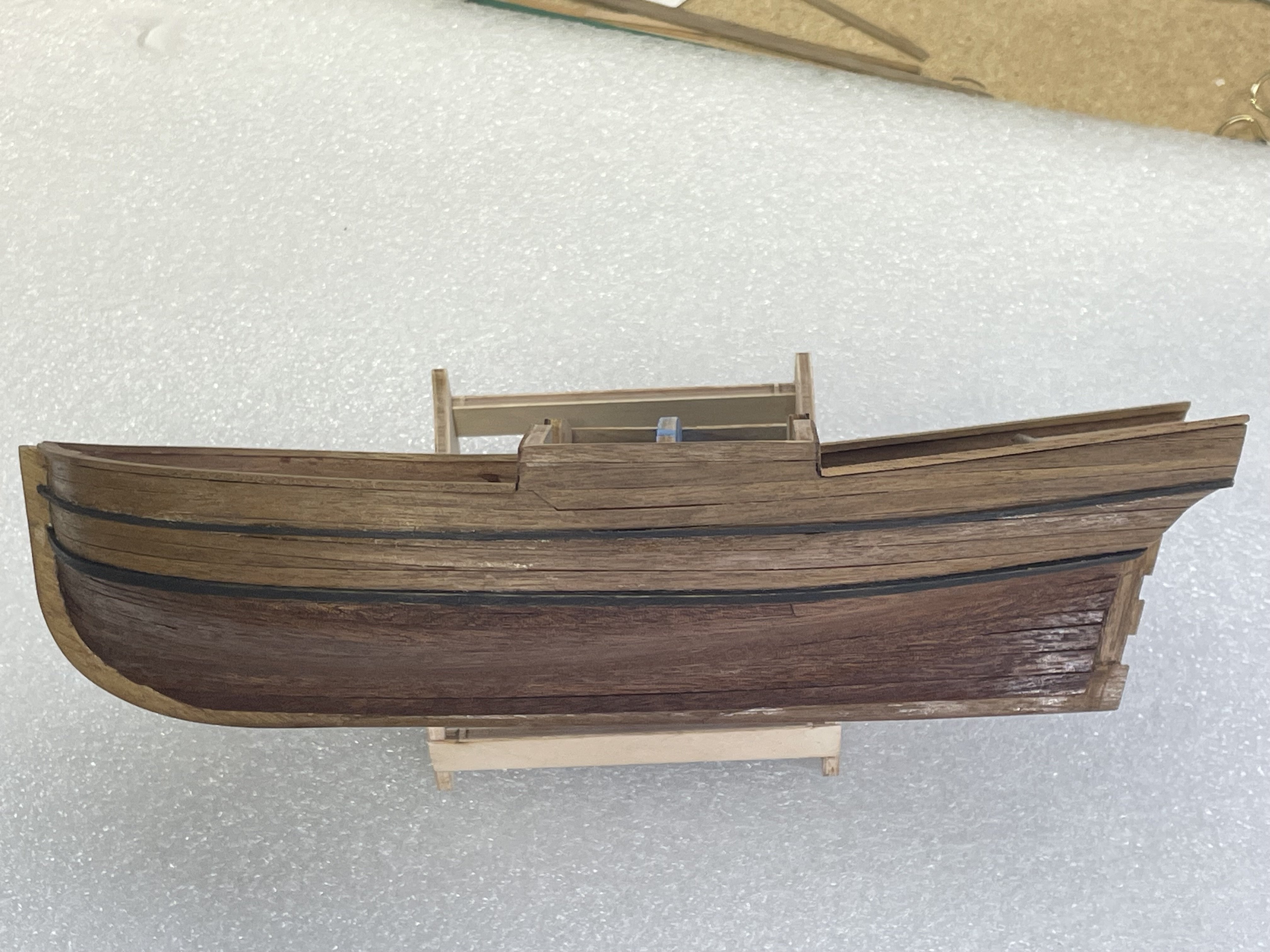

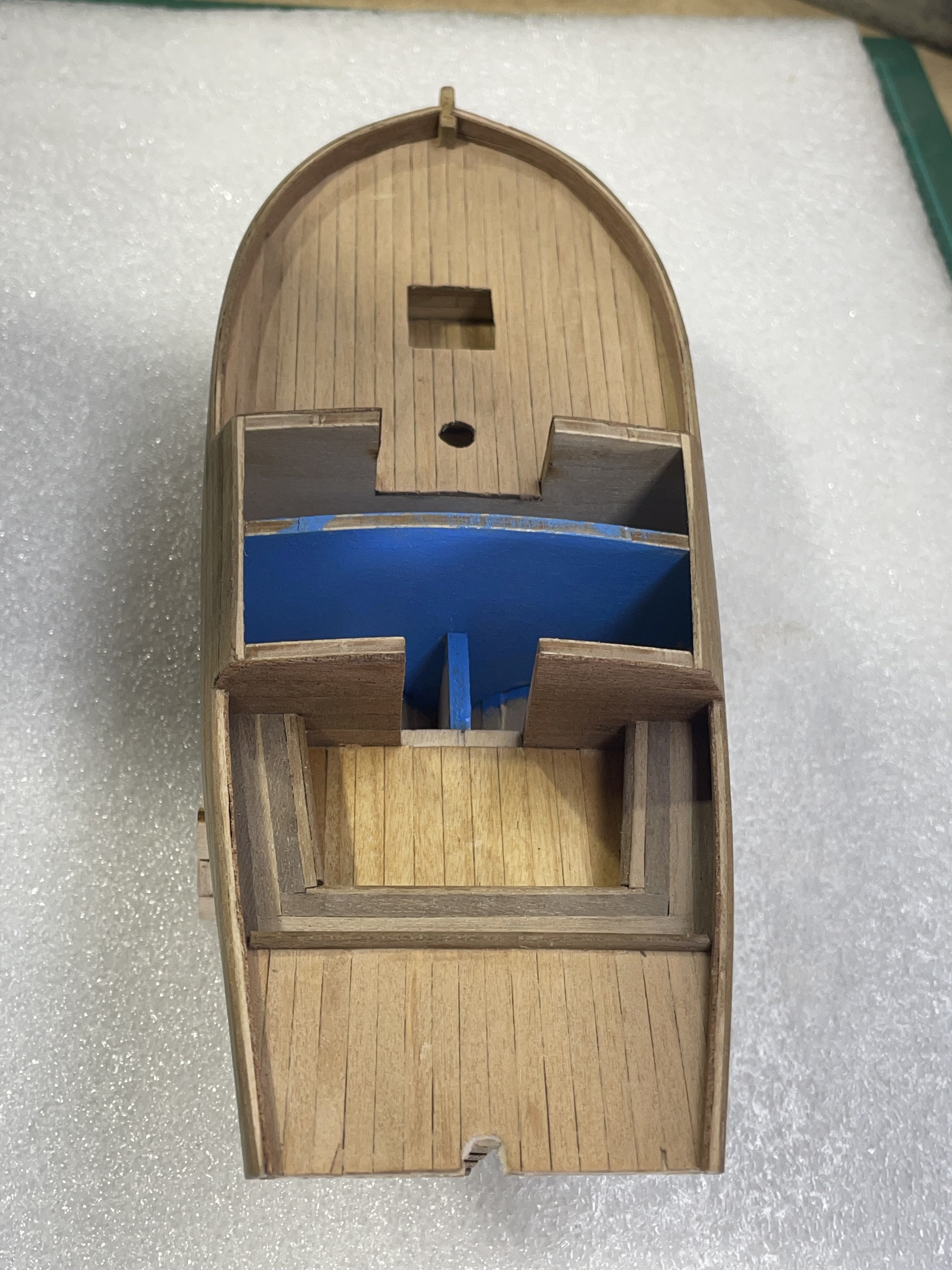

I finished the second planking. I pretty much just decided which plank to do next and what shape it needed to be. Thinking to whole time there’s a better way of doing it:-) But it all turned out.

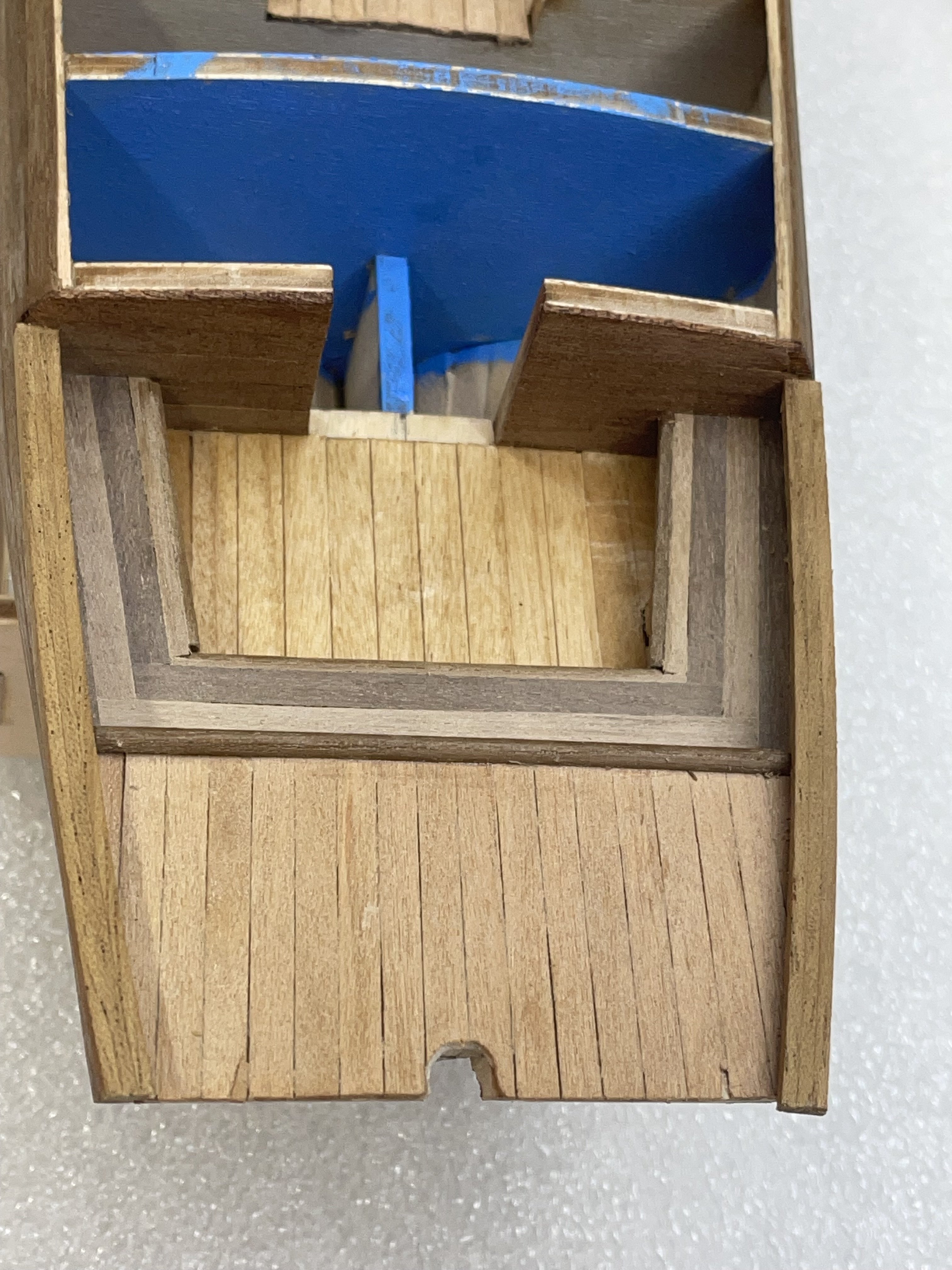

I’ve also removed the bulk head ends above the deck. I’ll be ready to start the deck planking as soon as I decide what wood to use on what area.

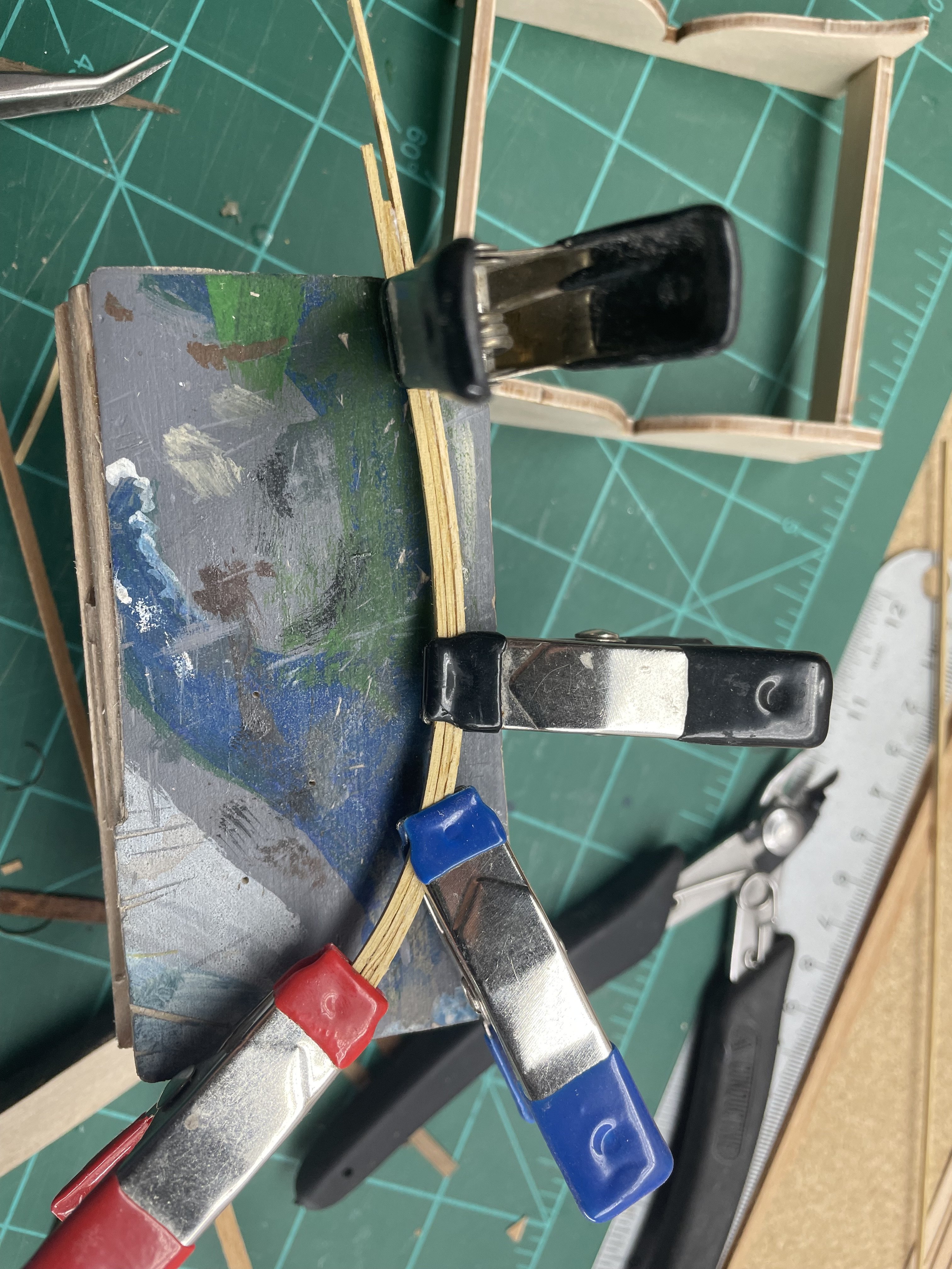

For the last few weeks,( except for 4 days and nights that I stayed with my brother to help him build a tree house for his grandson) I worked on the veneer topside.

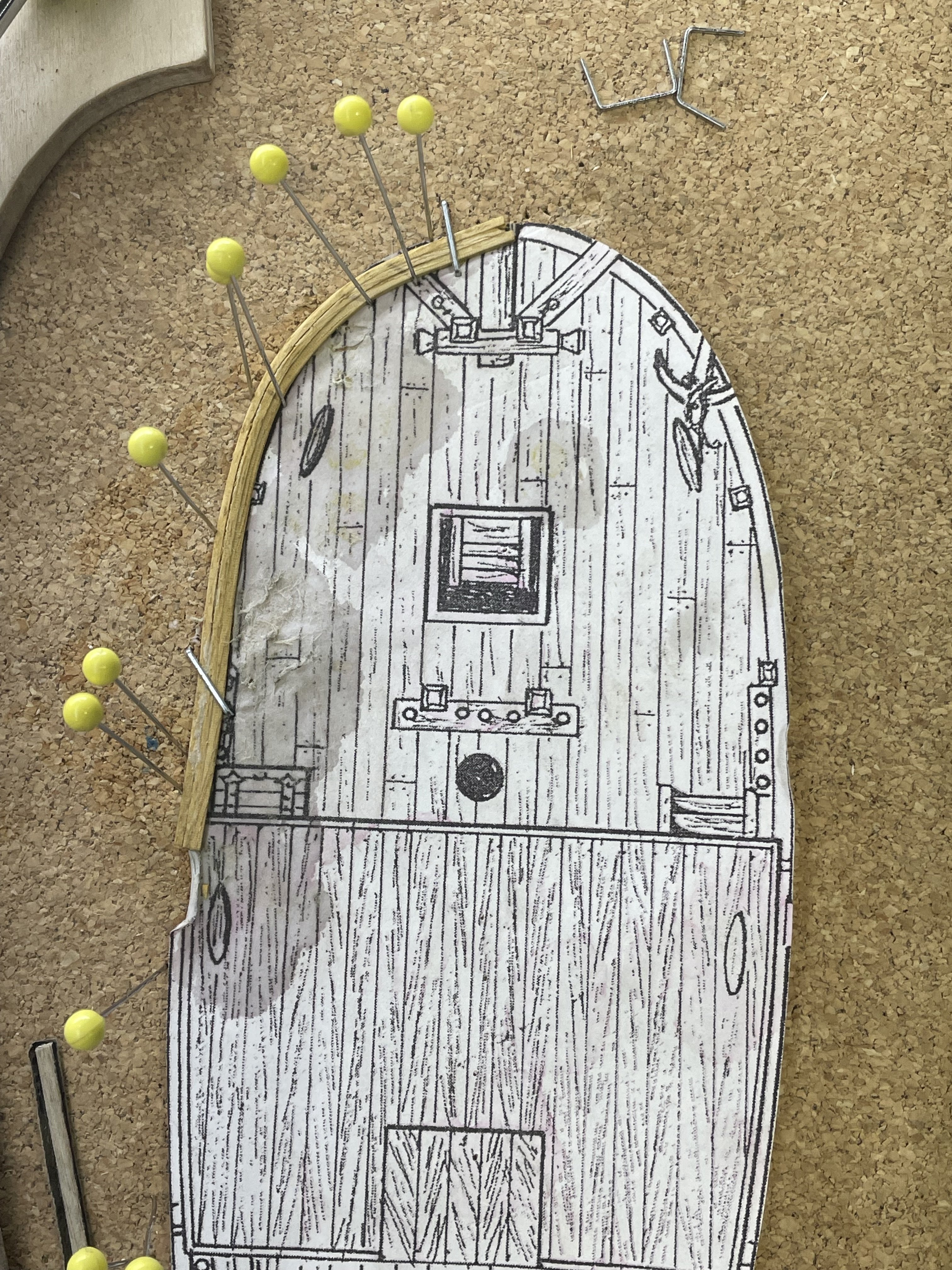

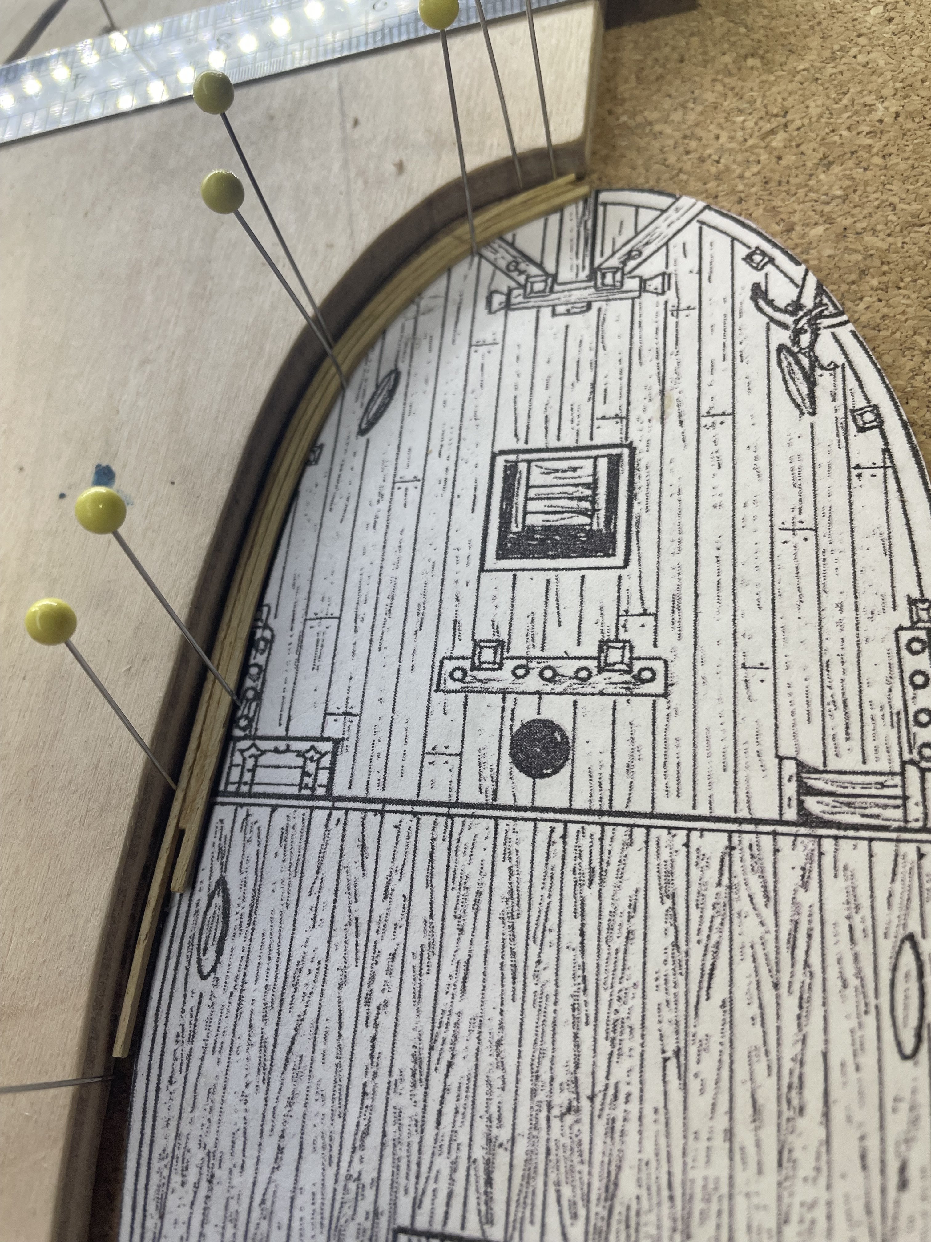

The top rail is made up of three 1 x 1 strips bent and glued together.
They didn’t retain their shape after glueing them together, so I tried bending them glued.
This worked on one side but the other seemed to fight me. So I just stapled it down to my work bench overnight.
Next up, I need to make all the little things that glue to the deck, doors, windows.
First off, I’d like to retract “the stapling the work to the bench”. It was a desperate attempt with ugly results. I had some other kind of wood. I can’t remember the name, I had never heard of it:-) Anyway it was 1 x 2 mm, instead of  1 x 1 mm. I bent them first then using pins glued them together. I sanded them down to about 1.2mm. It was difficult to keep the 1 x 1 flat after being bend, to glue them together. So I’d do that again if needs be.

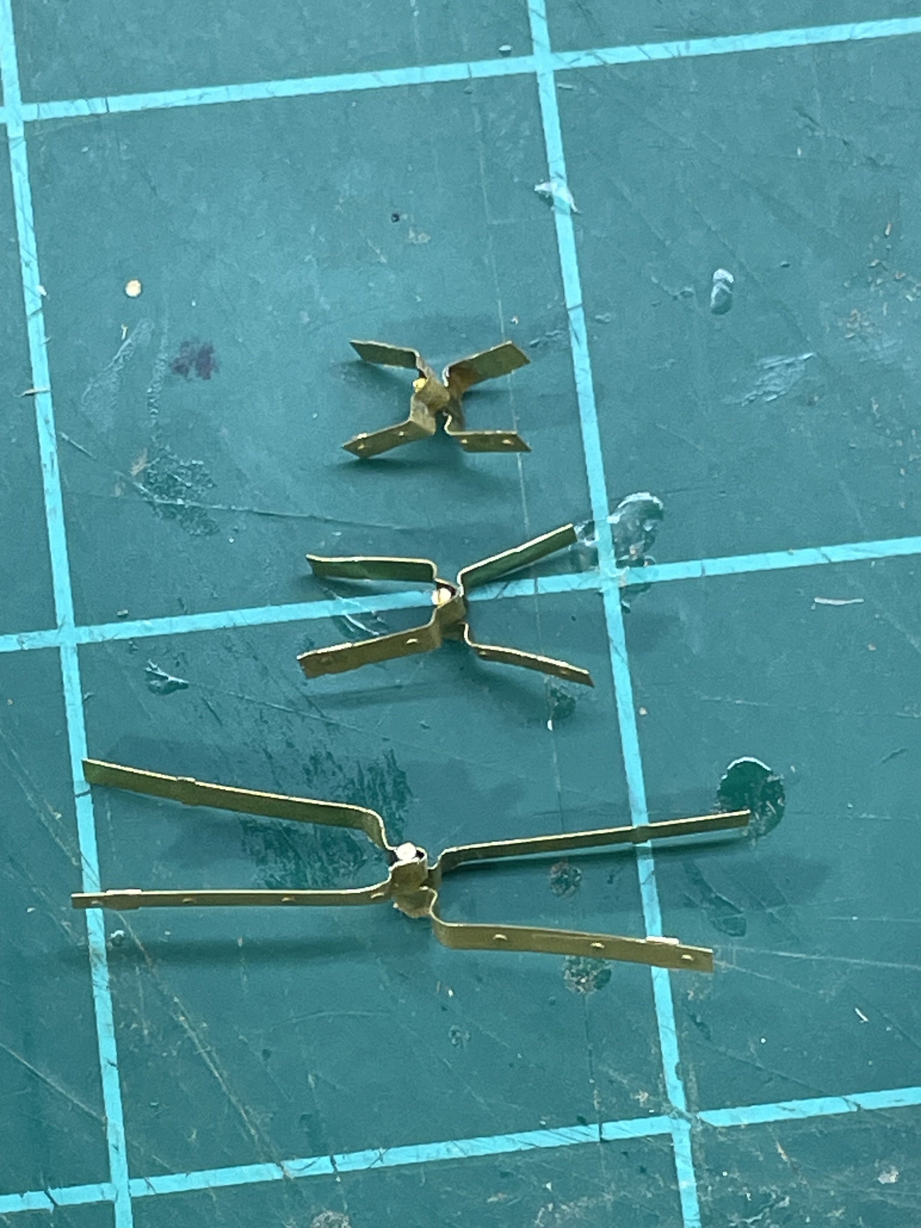

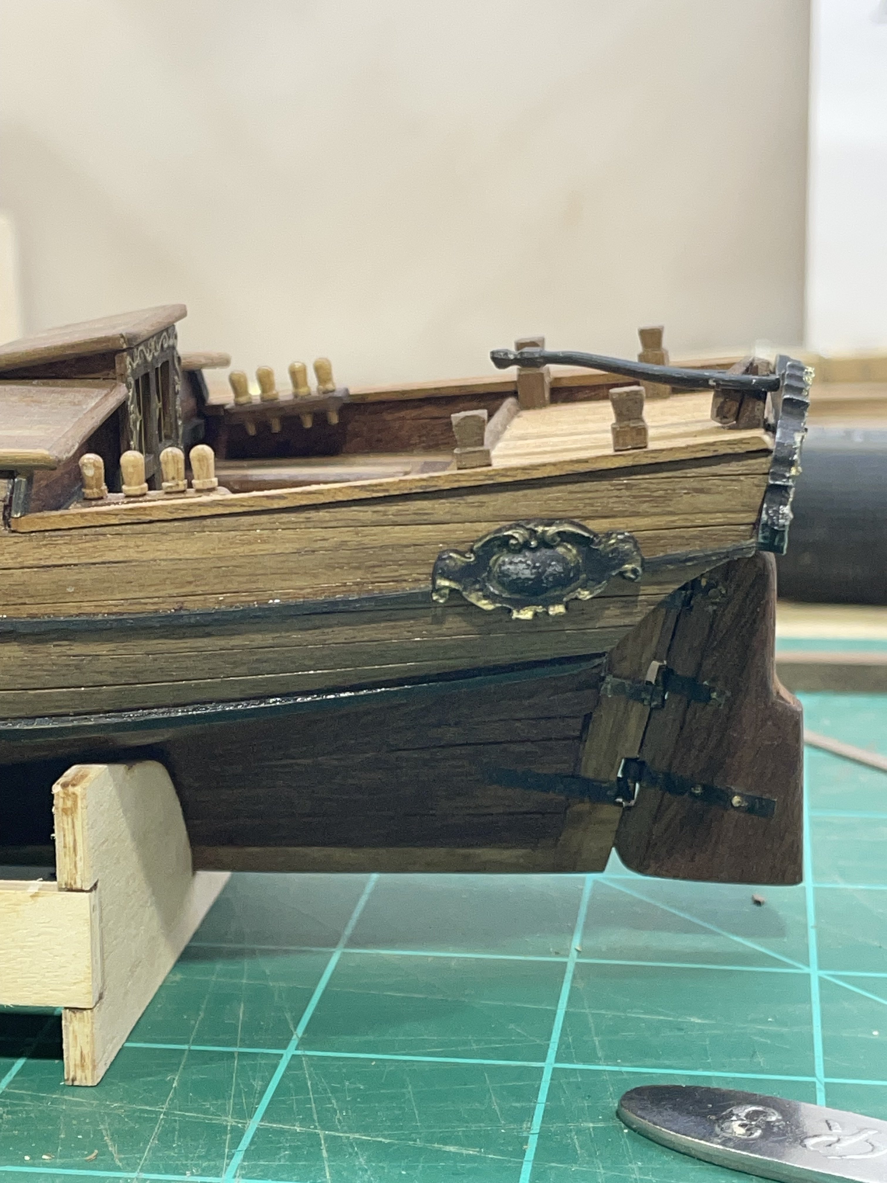

Just to change I looked in to the hinges for the rudder. They are .1mm brass. One finger spasm would turn them into a brass nugget. I decided then I will glue them together. Then glue them on the rudder. Then glue the wood on rudder to the hull. Maybe it will stay on at least till it makes it to Auburn Alabama.

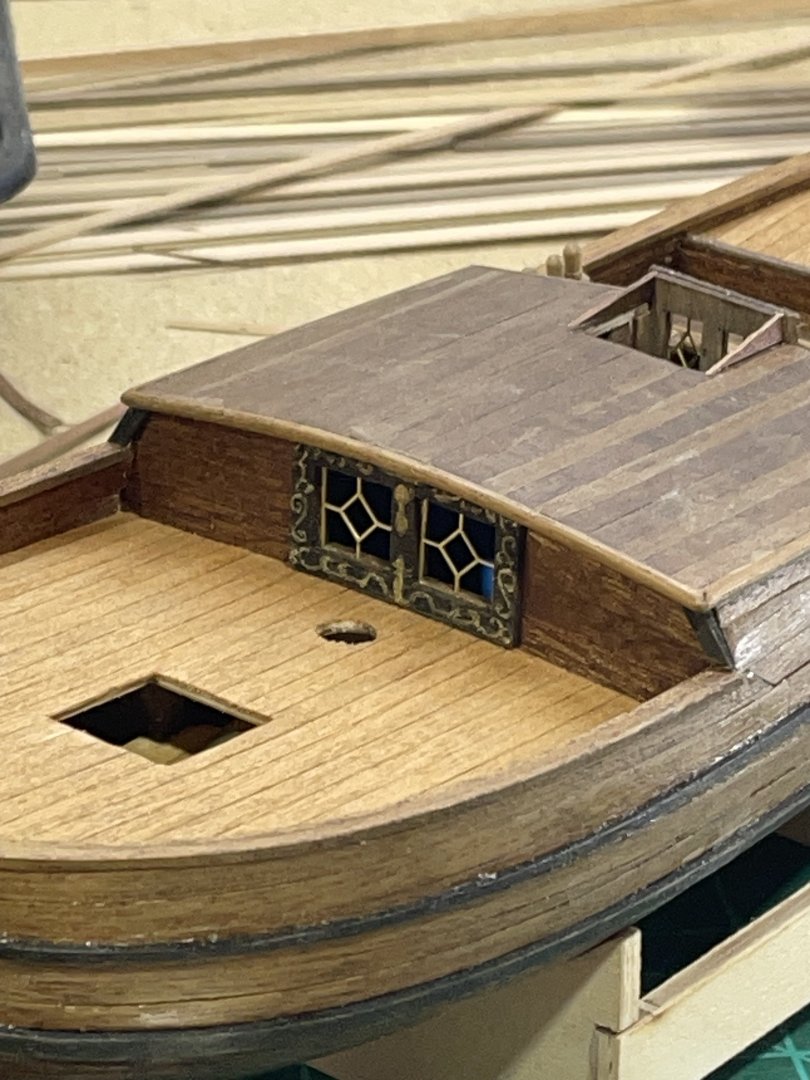

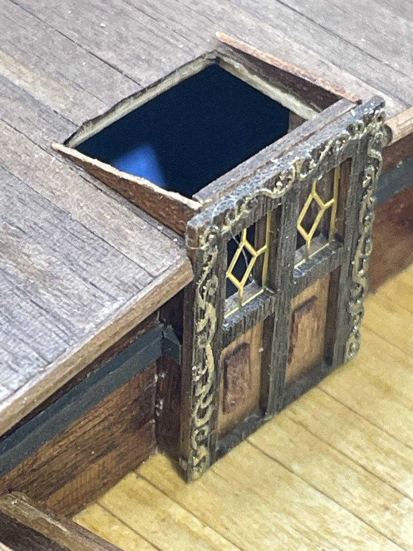

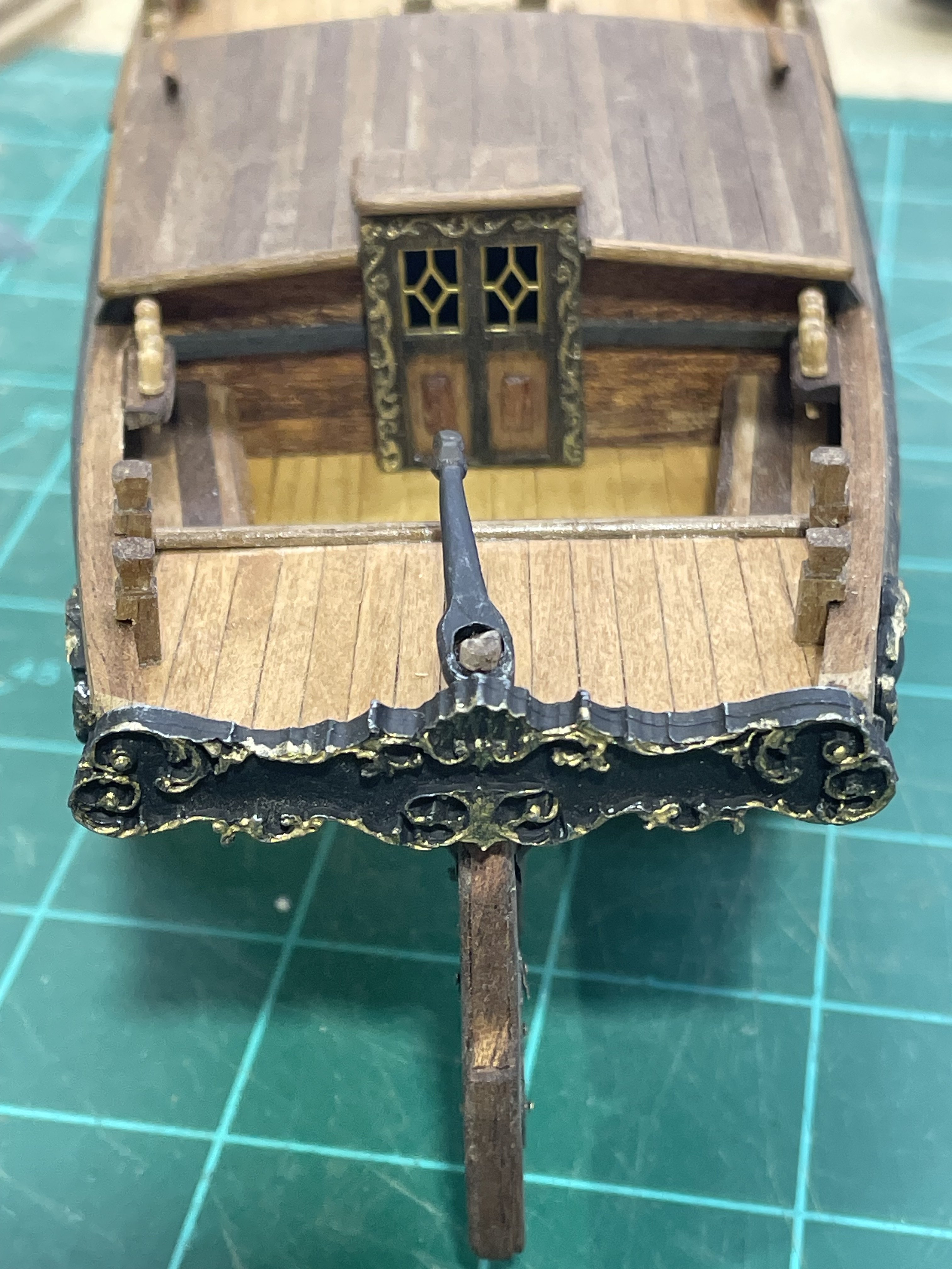

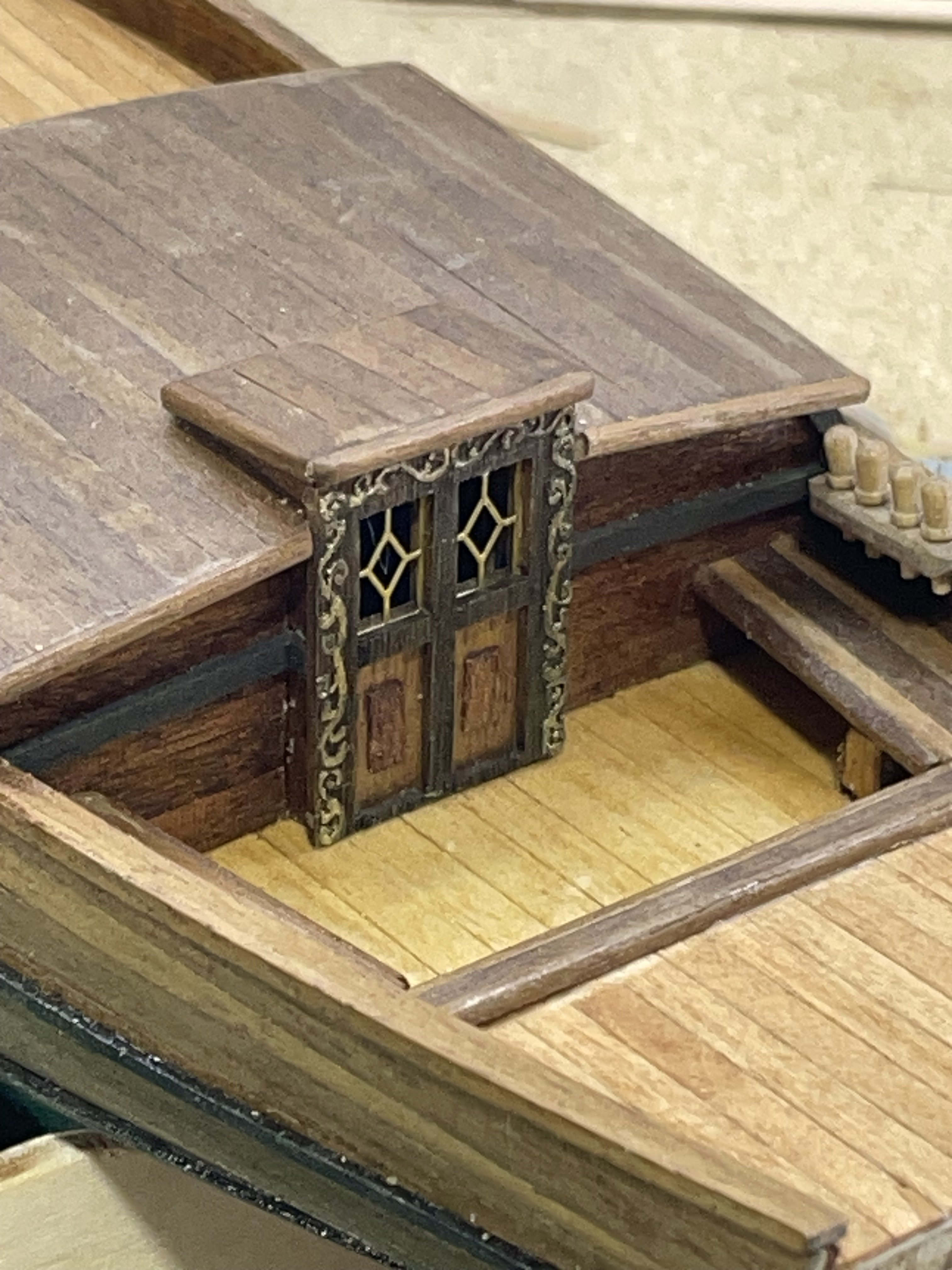

The doors and windows were a nice challenge. I did them only a few minutes at a time over several weeks.
Here’s where I’m at now.
 Thinking I’ll finish the rudder and see if I can get the cast metal stern piece to stick to the wood.

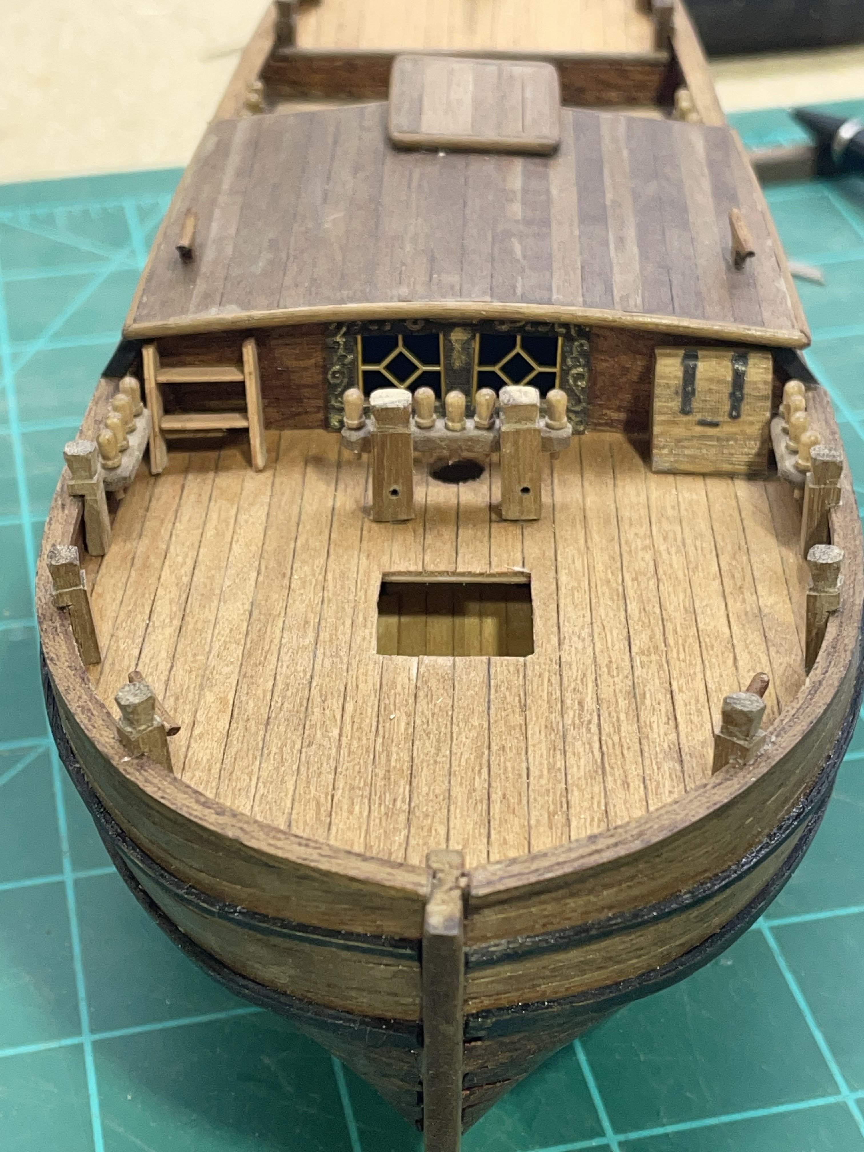

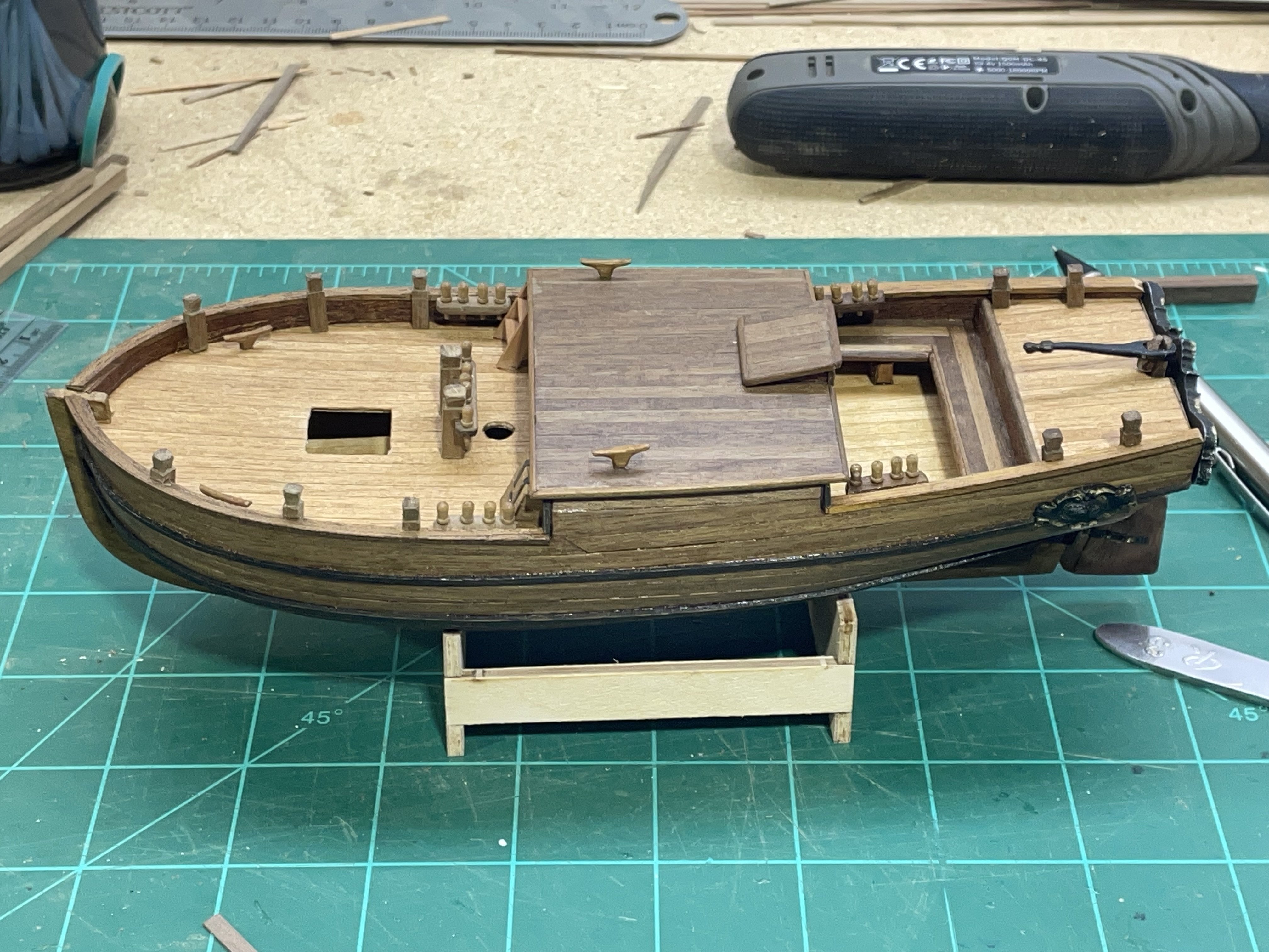

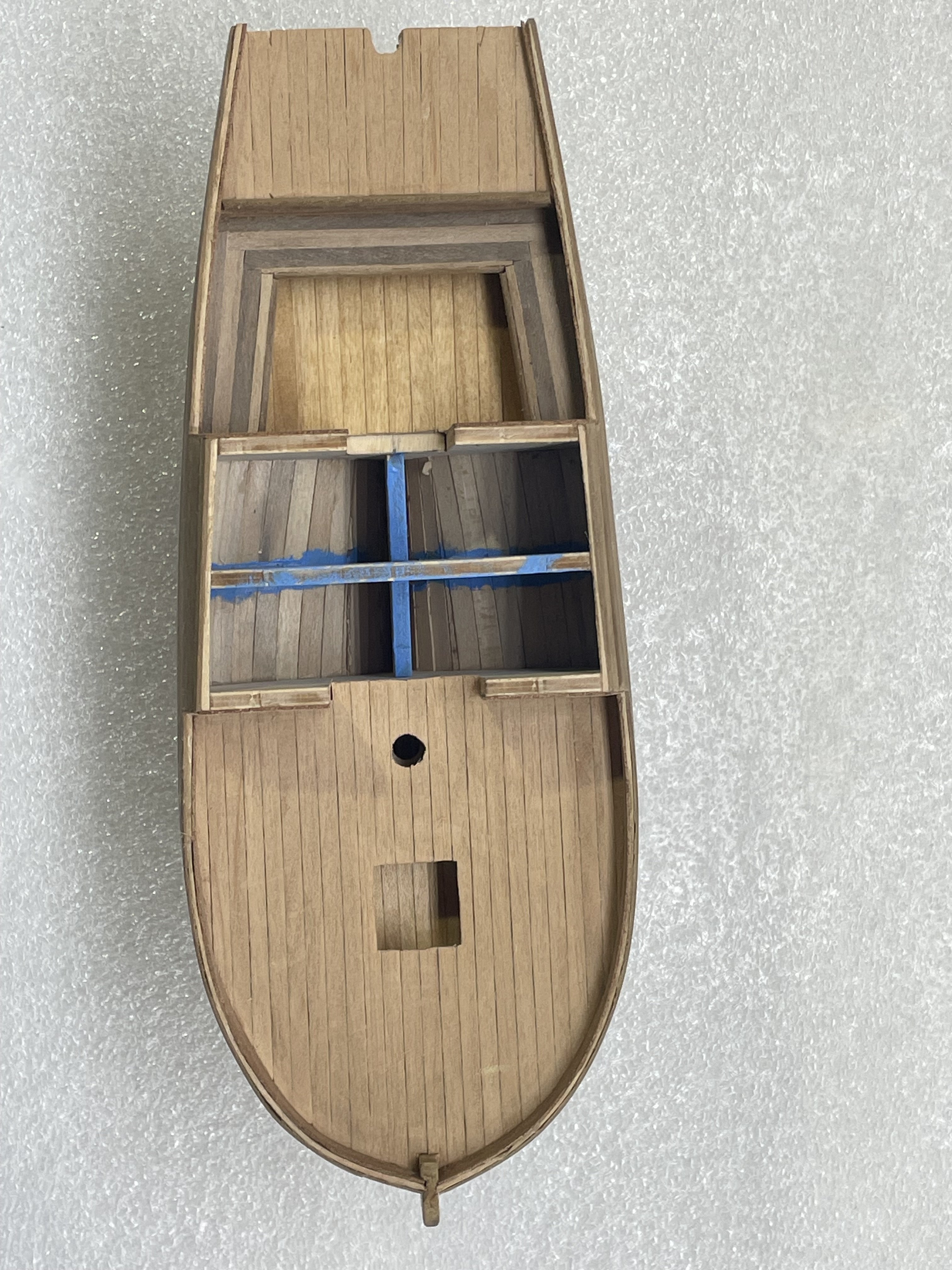

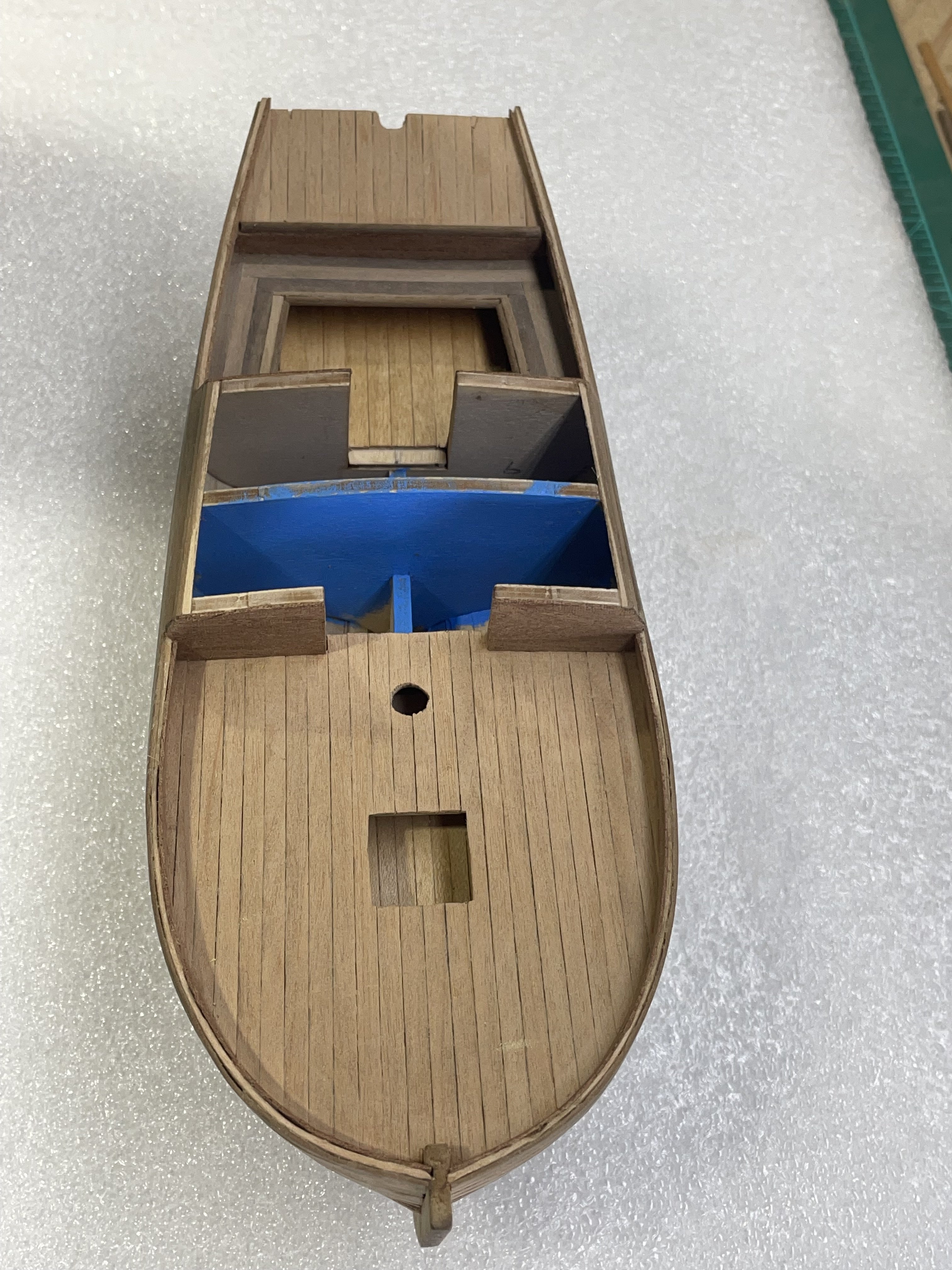

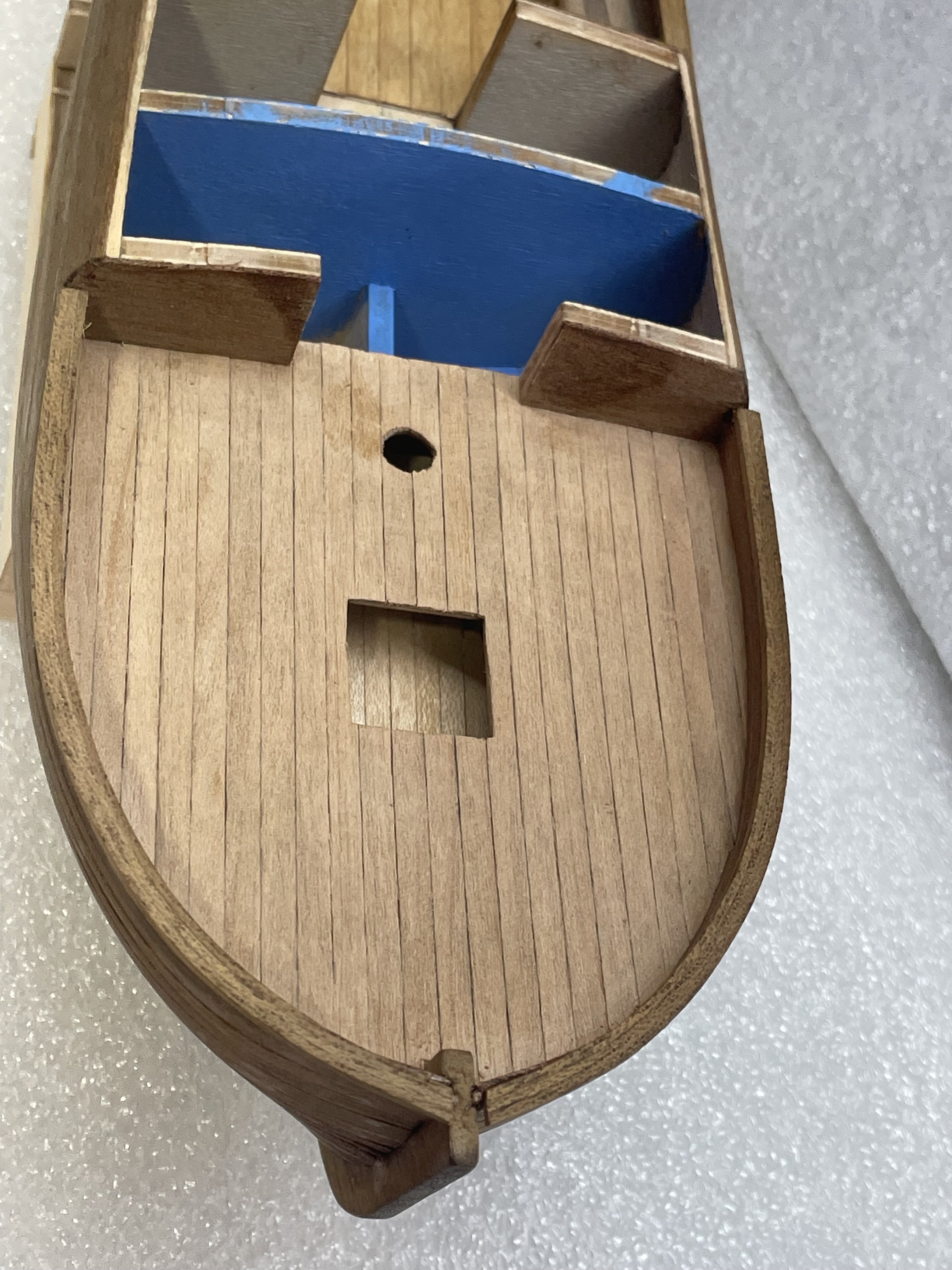

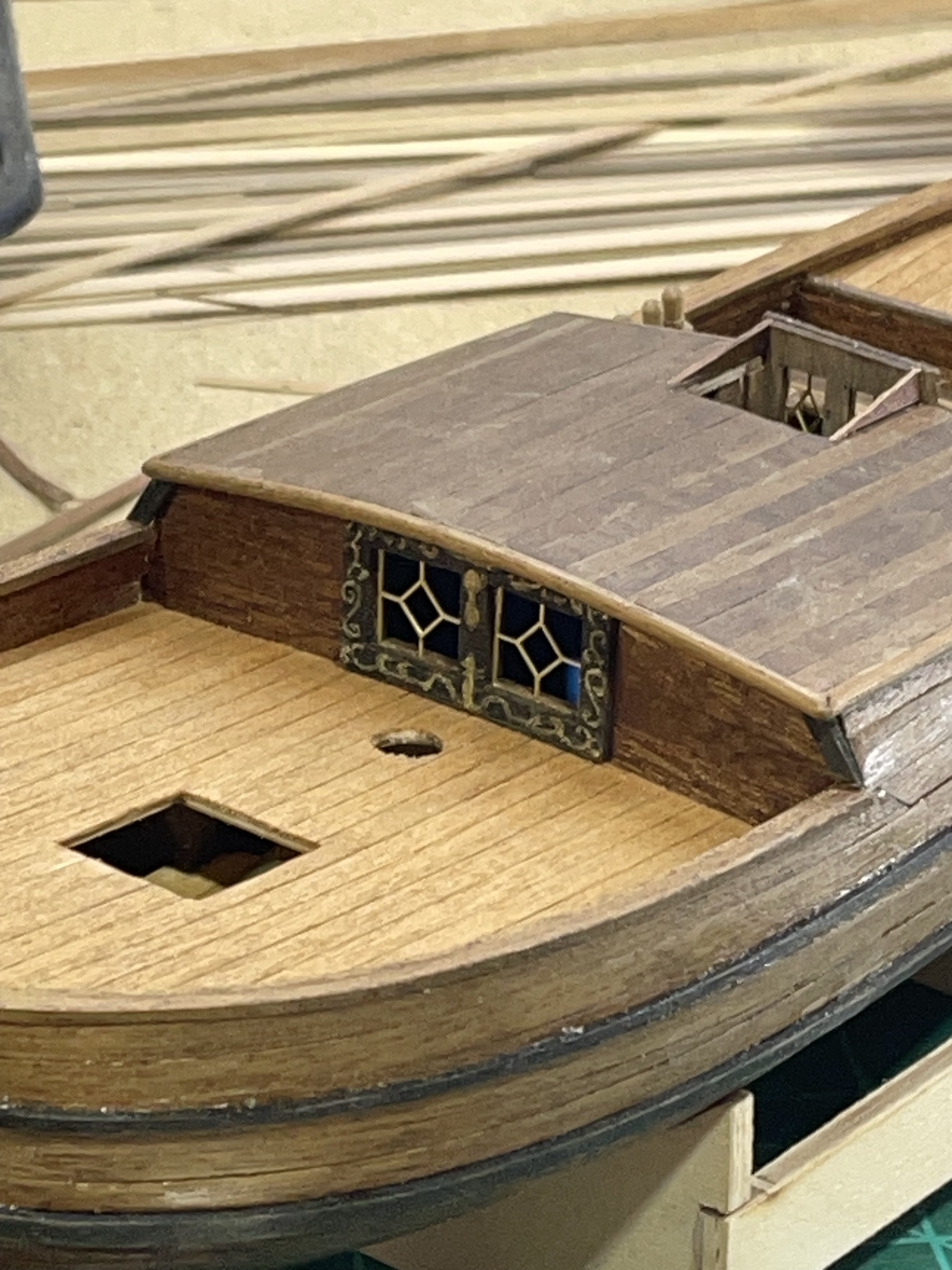

The last week I’ve been making all the little things that go on the deck.
i still have the side windows and the bow to finish. Then I’ll be starting on the mast and yards.

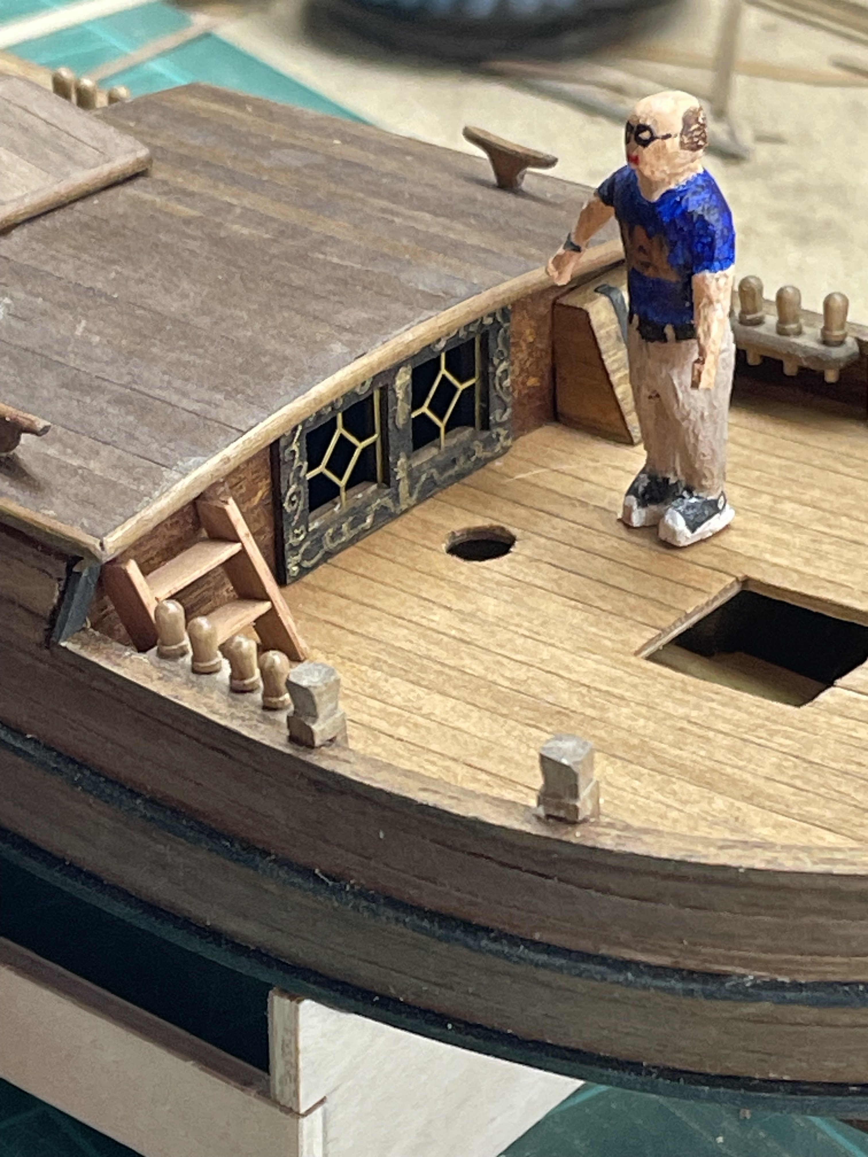

Oh, here’s Josh checking out the progress earlier this week:-)
This week I tried to get everything glued down except the things that maybe in my way when the rigging begins. Pretty much all the measurements for the different parts are given. And the supplied wood has been a very good quality, in a novelist opinion:-)  Here’s a few shots.

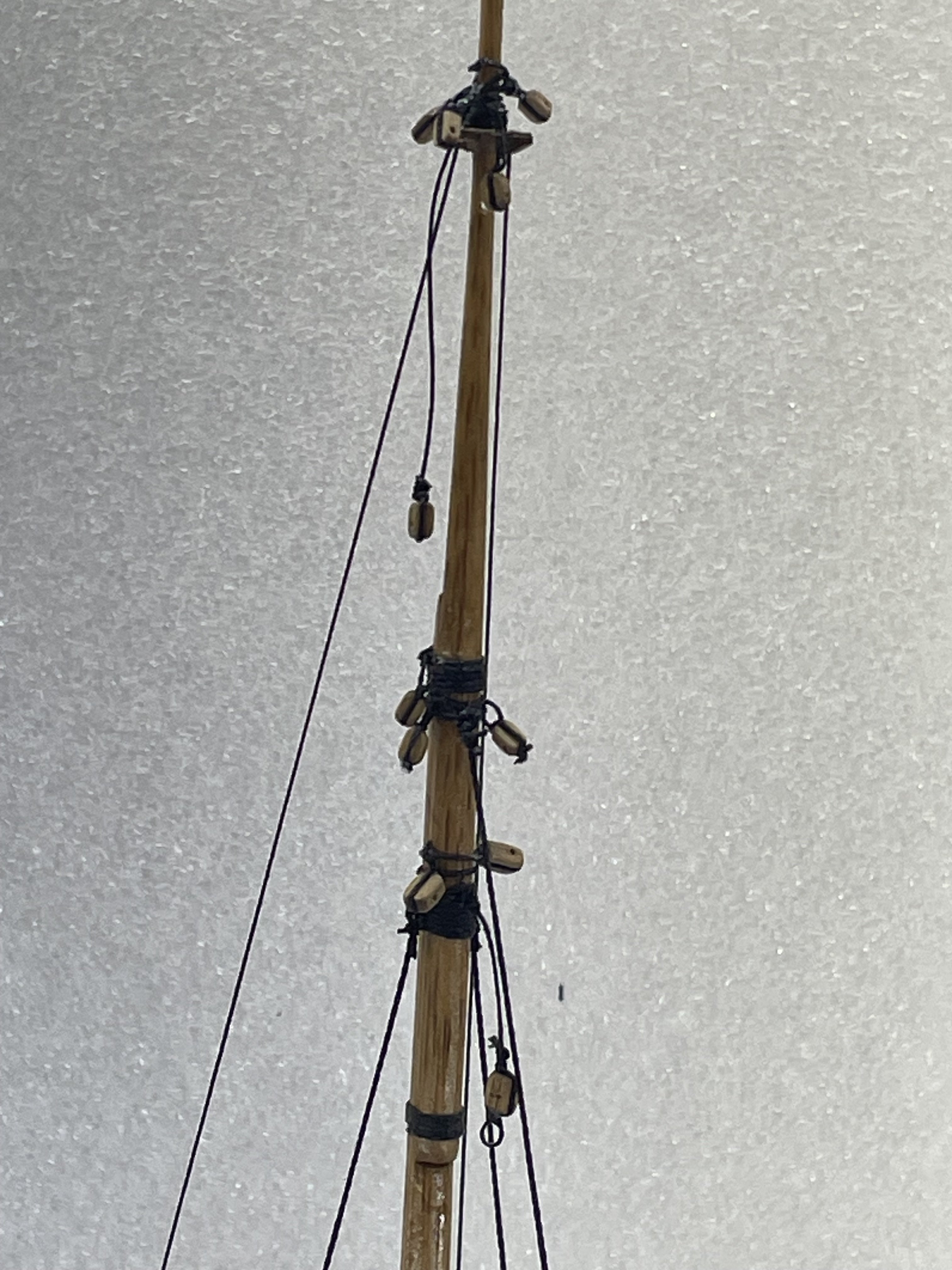

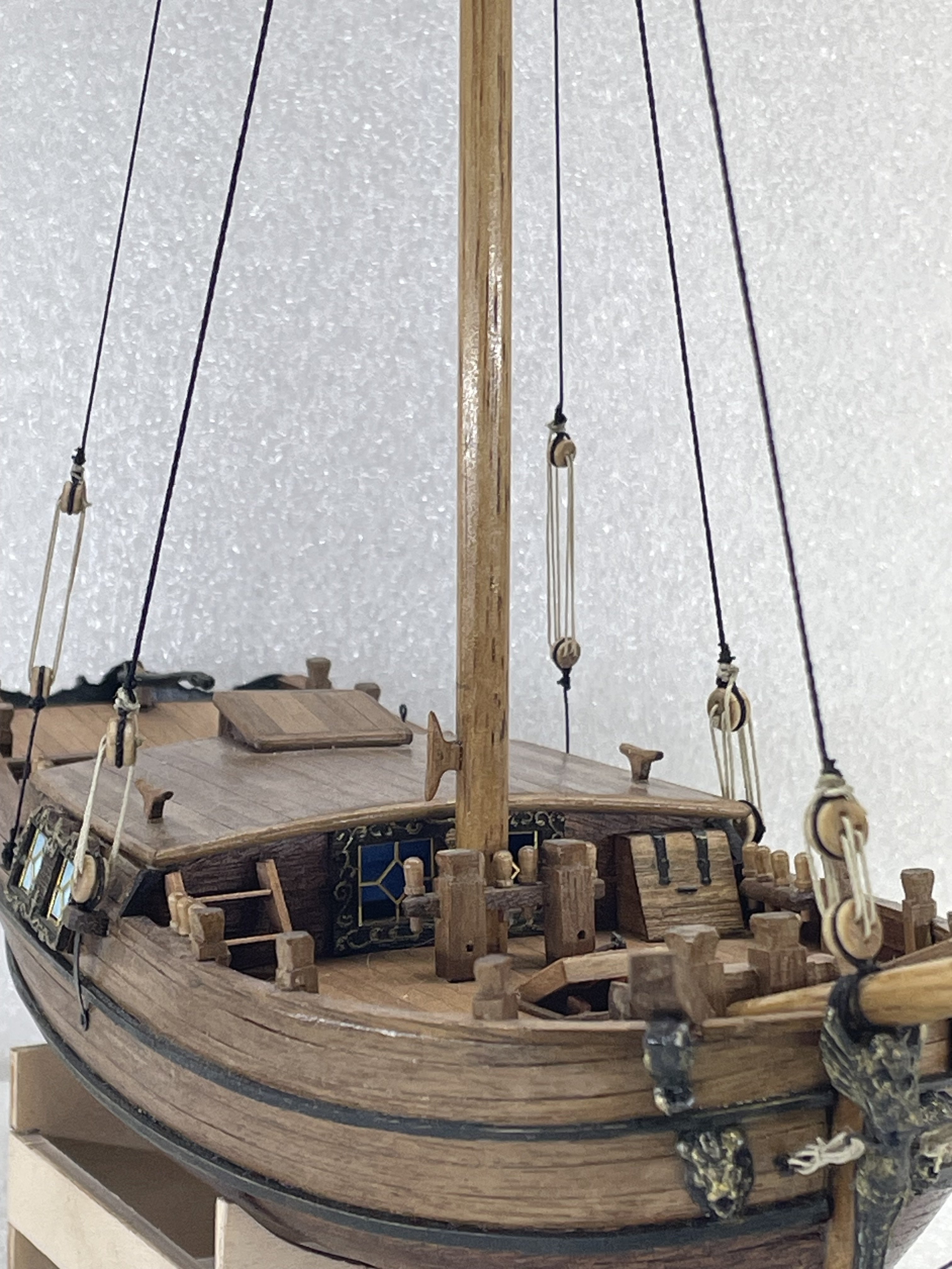

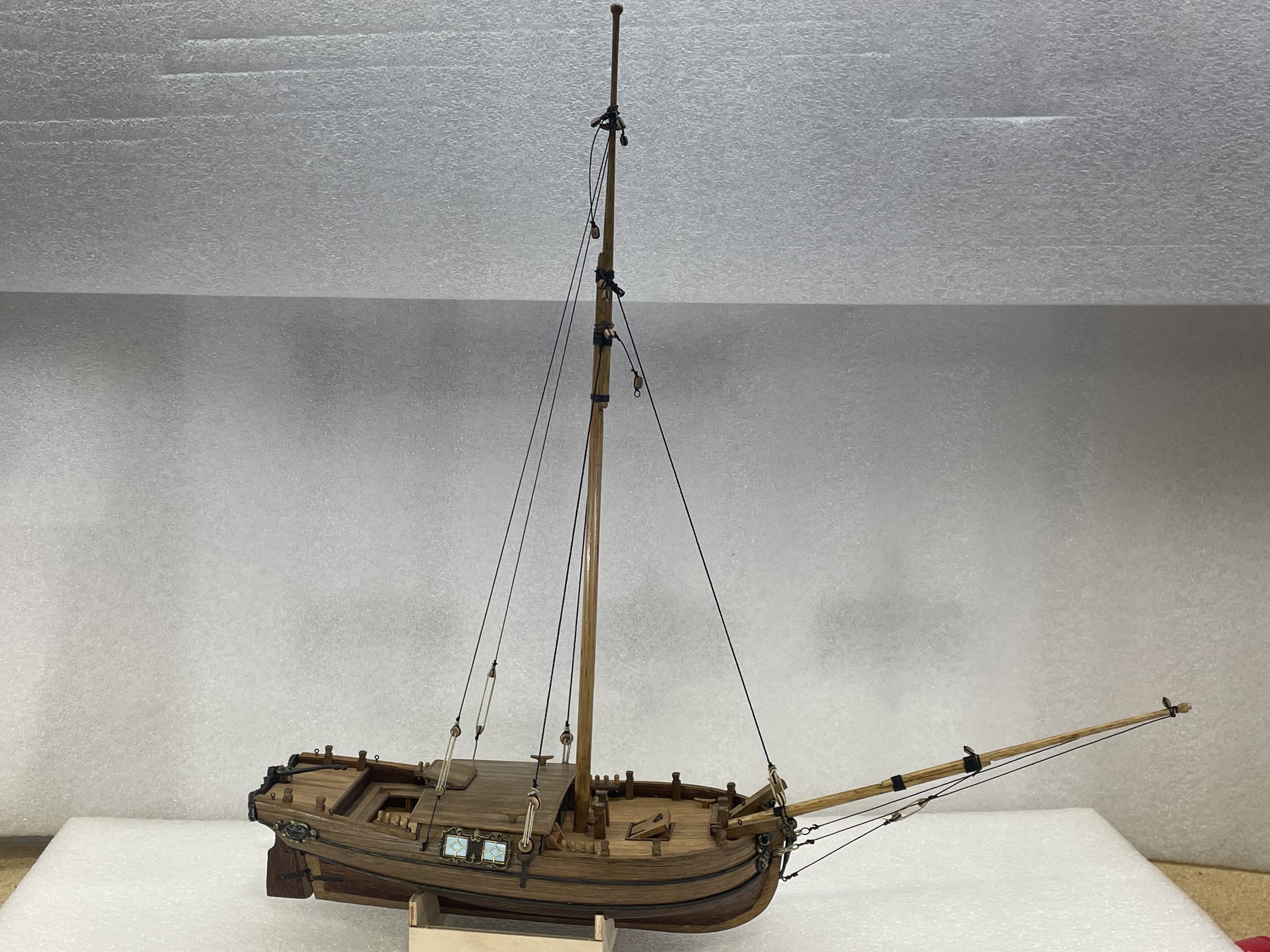

This week I’ve tried to tie all the blocks on the mast and the stays. It got easier each time I sat down.

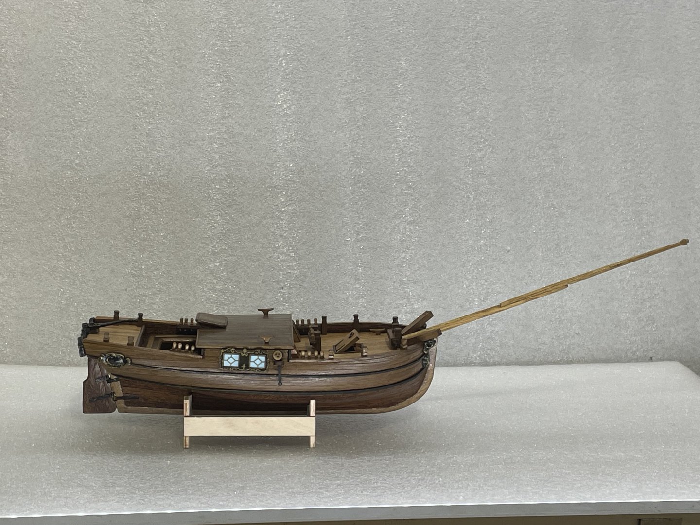

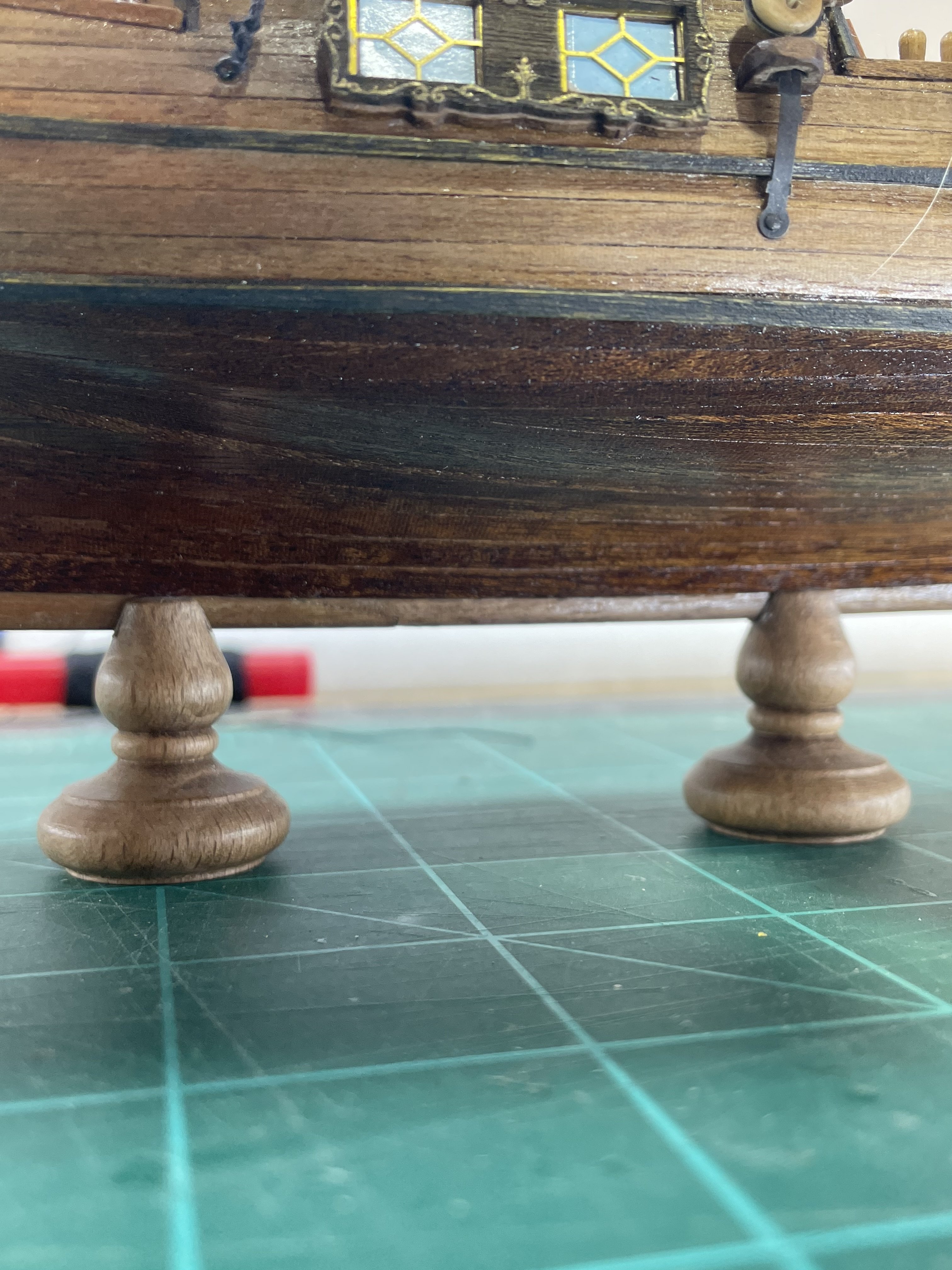

one question I’ve been thinking about is the stand. The one that came with the kit has been good because it sets sturdy for me to work on it. But I thinks it hides the nice curve of the bottom of the boat.  I added several pedestals the last time I ordered a kit. I liked the brass ones but because when I was fairing the hull long ago, I rounded the bottom of the keel at the bow. I tried grinding the brass to fit but it didn’t look very structural. So I went to wood. My question is , will I be able to just glue these on, after they are attached to a board. The stern fits pretty tight, l didn’t mess that end up as bad:-)

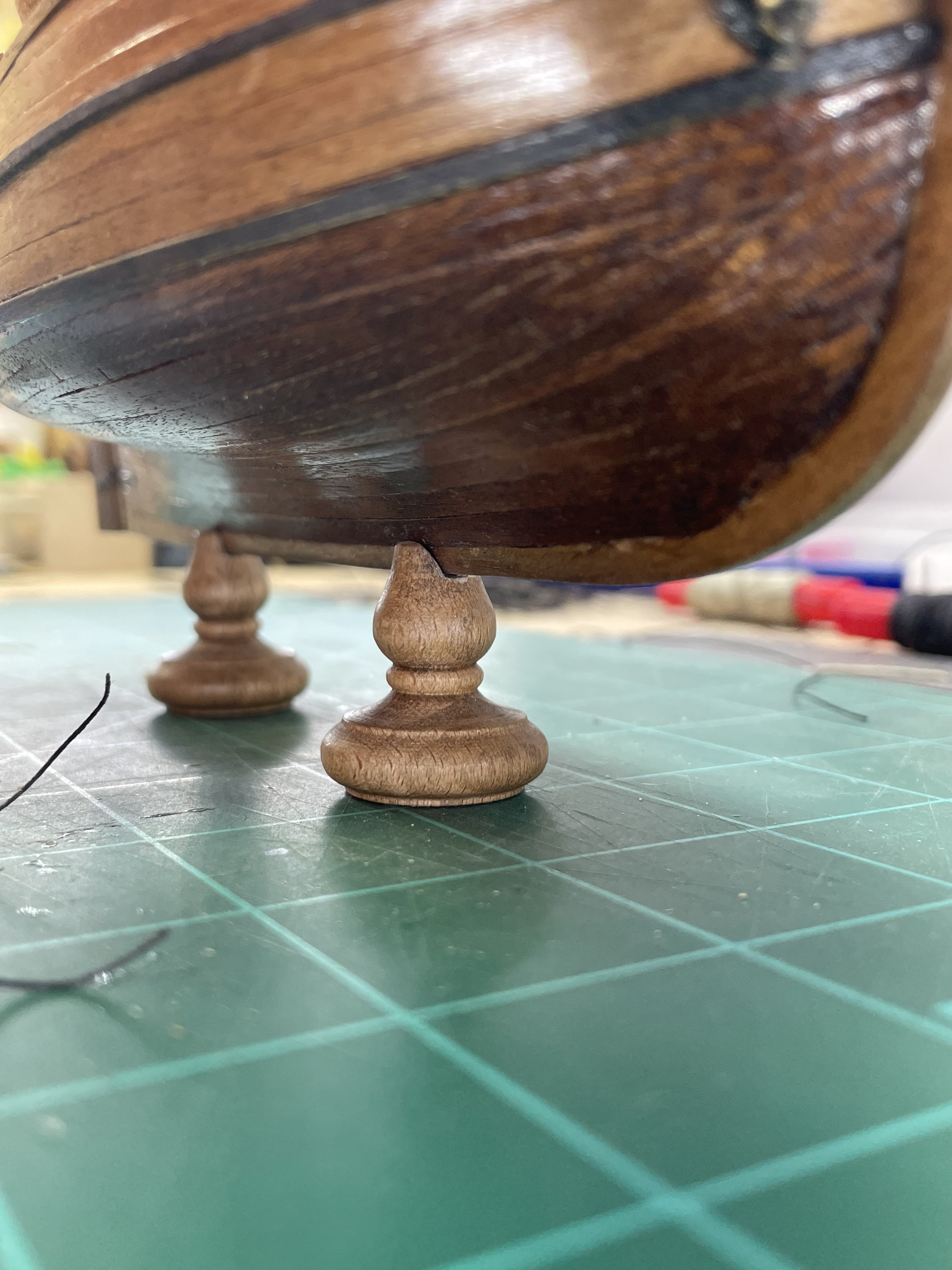

But the bow is a bit wobbly, because it’s not a perfect fit and isn’t ever going to be. Should I try to drill through the top of the pedestal and through the keel and put a brass rod?
Here’s a better shot of the bow.
The next thing I’m planning on doing is tying the blocks on the yards.
Nice work! The pedestals definitely look better than the stand that came in the kit--it's a beautiful hull, so why cover it up? I personally would drill a small hole for a brass rod or something to stabilize the pedestal, but I don't know how difficult that will be with the mast already in place. My understanding is that it's not a huge model, so maybe just glue will be fine?
