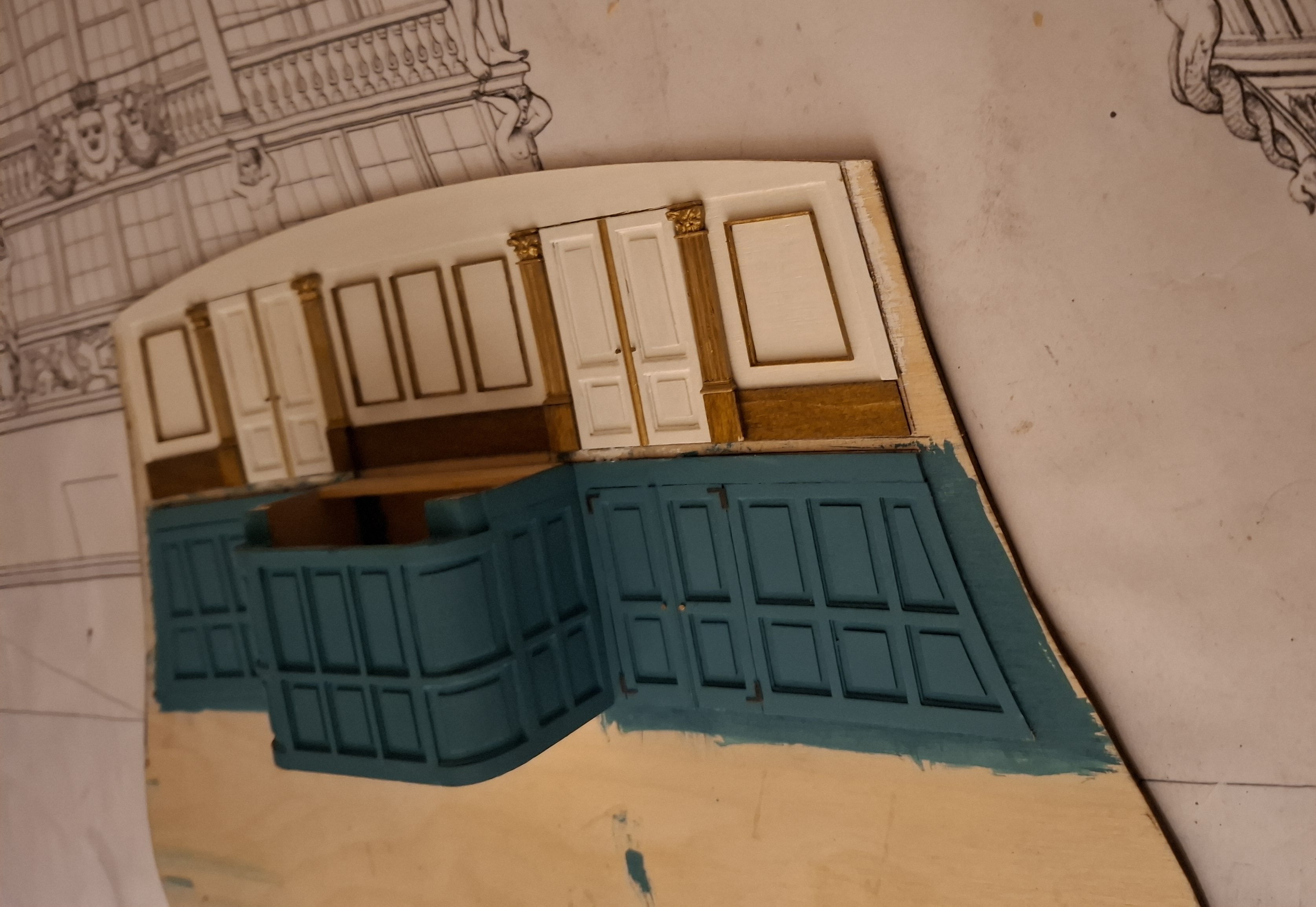

Hello everyone,
Thank you for your encouragement, the work is continuing with the interior work on the upper deck, where the paneling of the “Store Kajüt” (great cabin) described above is now in progress. This also involved some initial carving work. I have now decided to build more or less on the original 18th century interior of the Amphion in Stockholm.
I started with the carved garland below the deck beams:
I laser-cut the rather filigree part with supports and screwed it to the table, then the tools can be used freely with both hands.

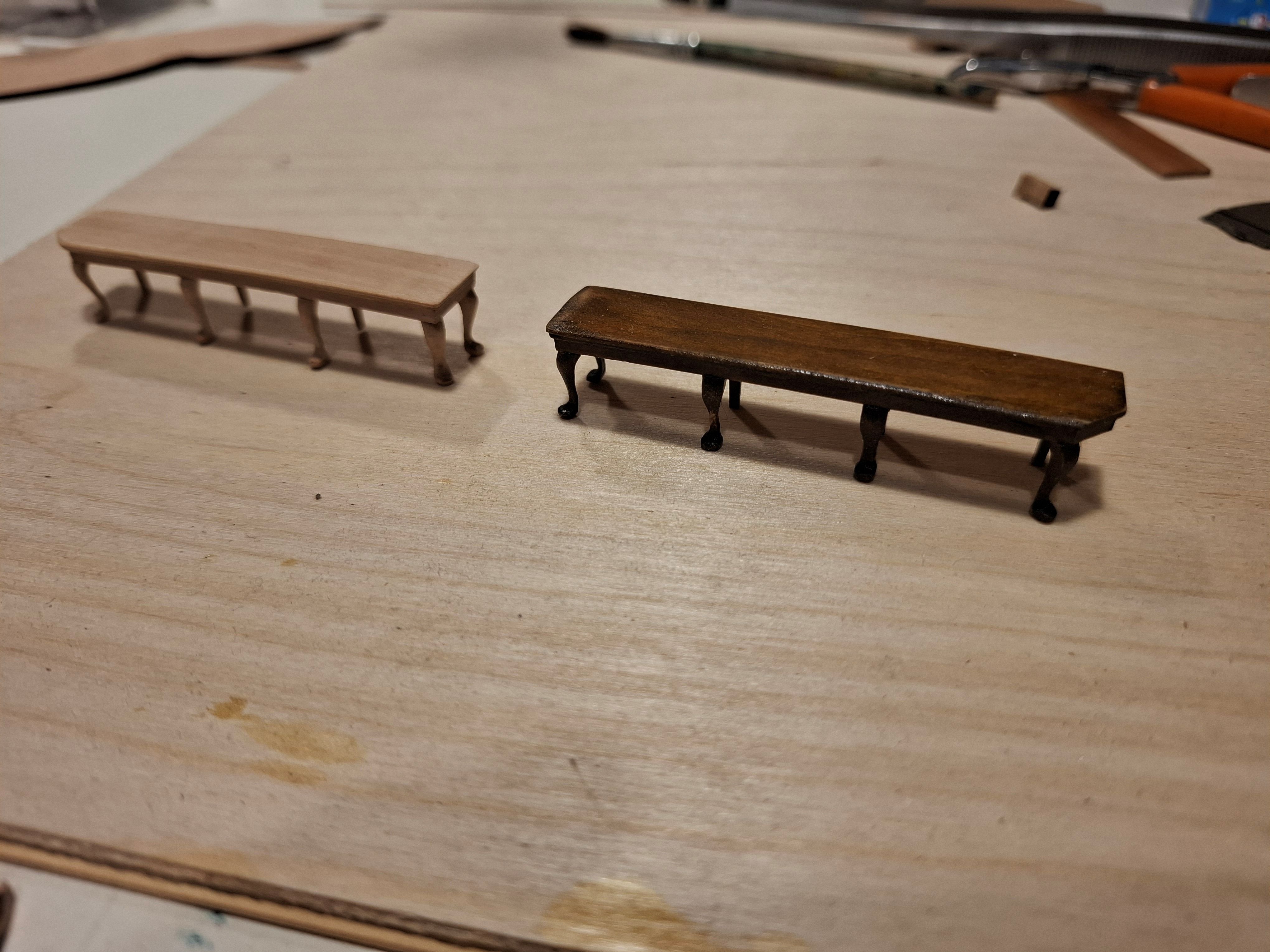

Then the flat columns as a structuring element, here of course the capitals as the first major hurdle.
and here they are put together
You could also leave the result in wood, which might have been more discreet and more appropriate for a warship, but I went for a pot of gold paint...
Best regards,
Matthias
Edited by Beckmann

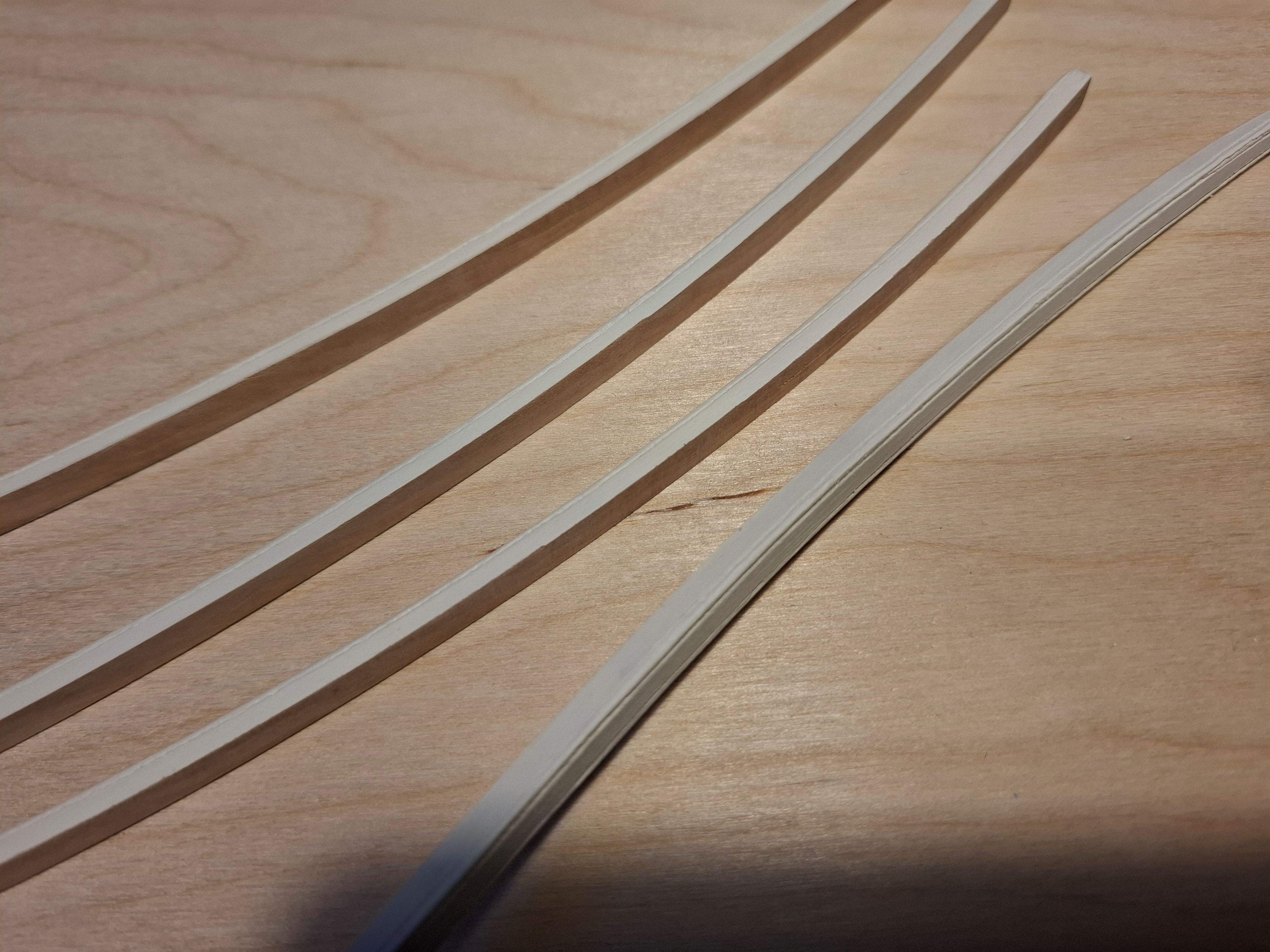

Work continues with the window front of the great cabin. The curved profile was finished with wood filler and profiled.
Here you can see the moulded cornice, I finally went over it again with some paint filler to make the surface fine enough.
And here is the result.

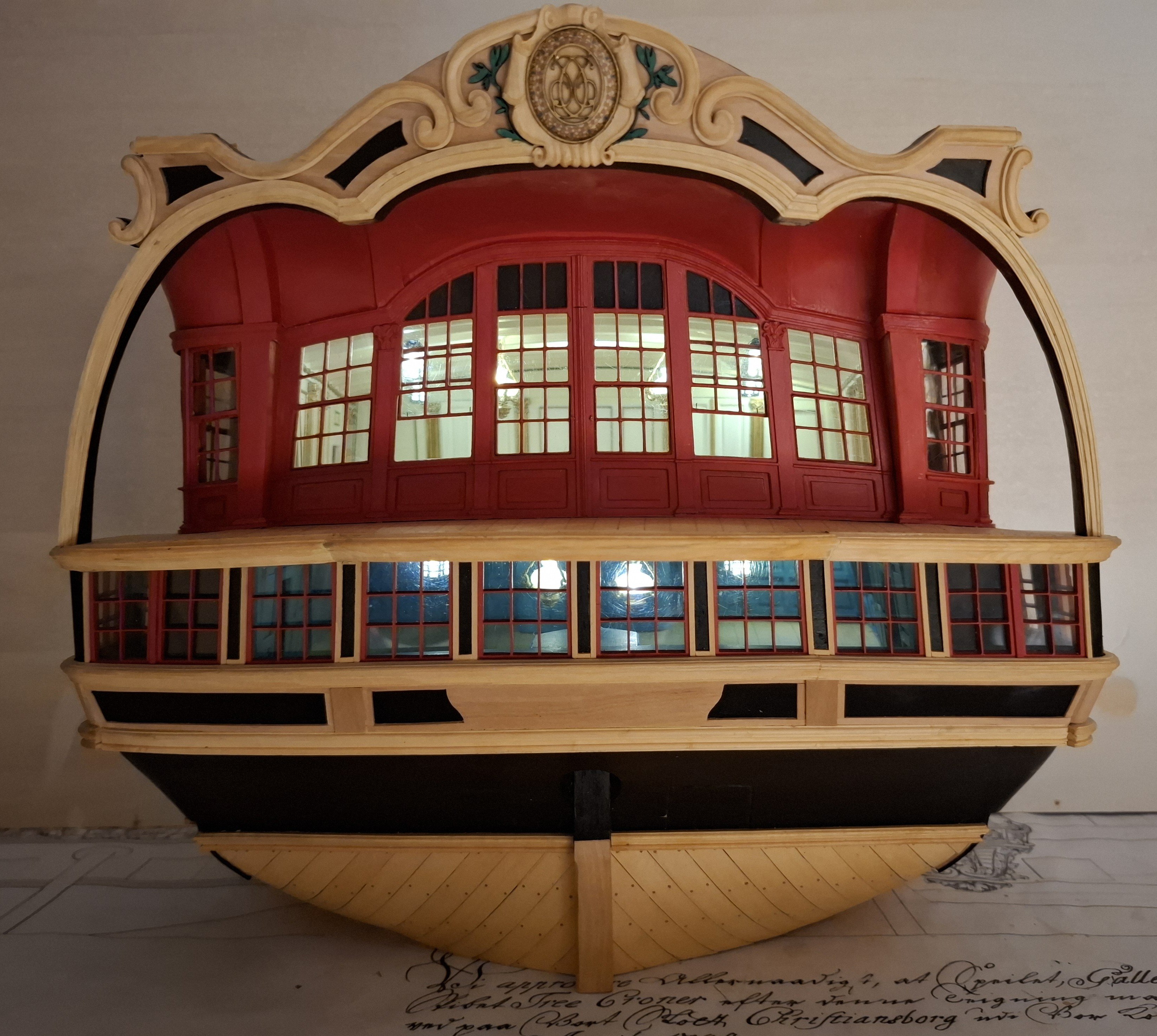

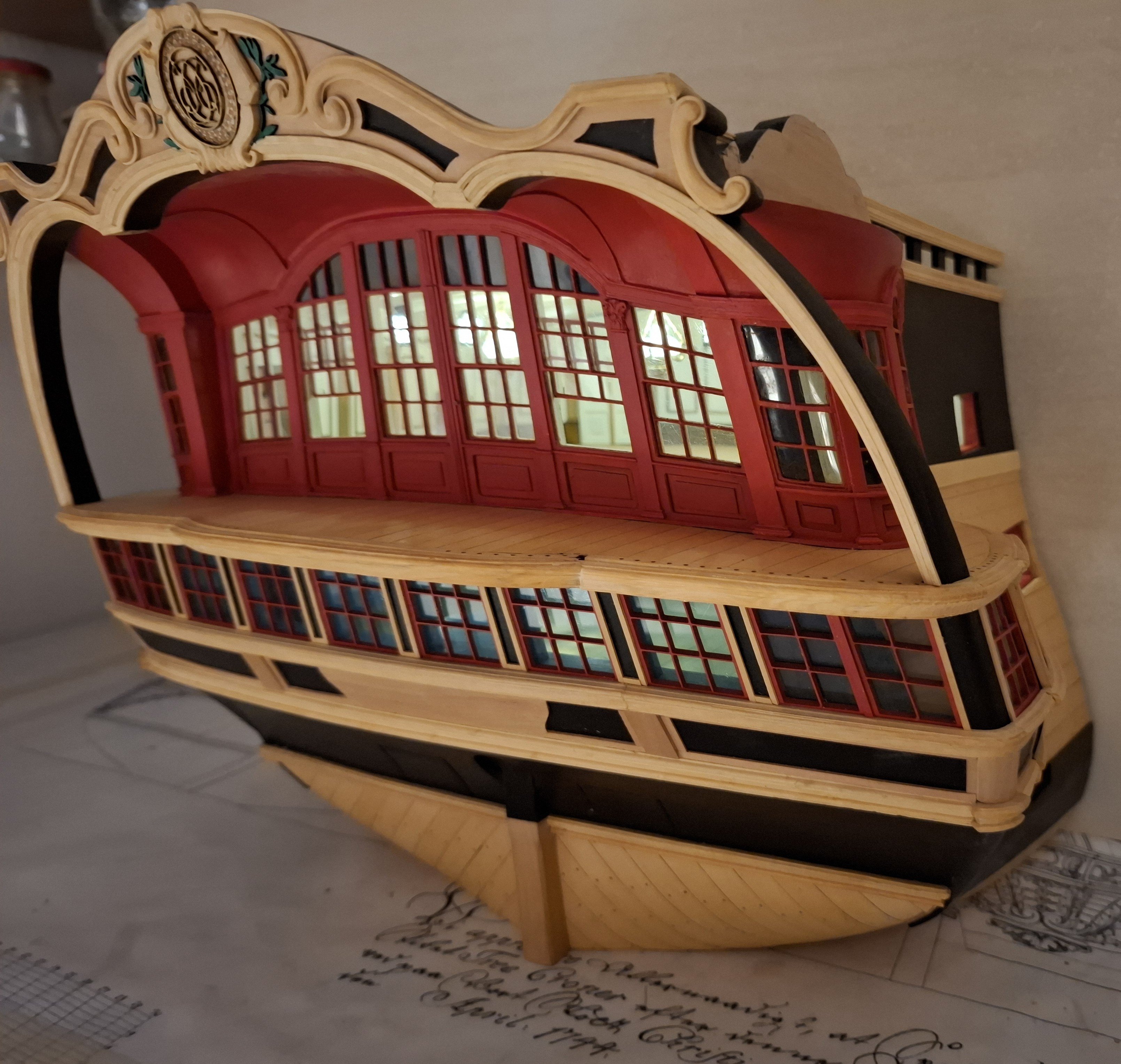

Dear fellow modellers,
thank you all for your comments and likes.
Over the last few days I have been working on the canopy above the stern gallery.
It is an imposing vault, interrupted by four supporting ribs, which swings upwards from the window front of the main cabin almost like a domed vault in a church and then descends again on the inside of the transom arch to end there. All in all, a beautiful but, in my opinion, somewhat unusual construction that raises several questions.
First question: How was the vault constructed?
Second question: As it protrudes very far above the aft deck, how was the poop designed here?
Third question: What might the ship's carpenters have been thinking when they were asked to build it? They probably rebelled at first.

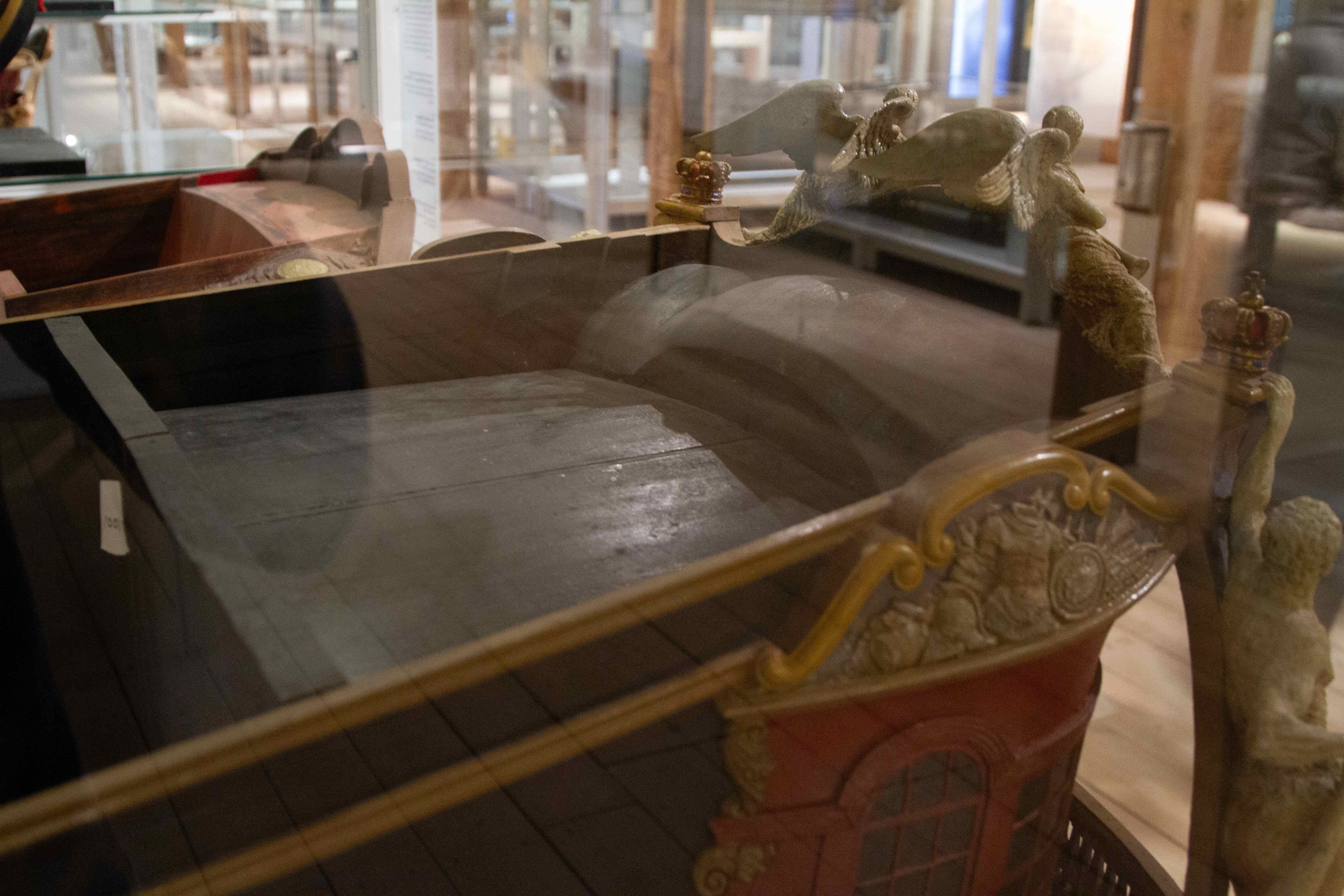

I'll start with a few photos of the original model to illustrate the problem:
You can see here that in the model the vault shell has obviously been carved out of a block and fitted into place. You can also see in the last picture how far the vault protrudes above the poop deck.
There are some historical models and drawings that show vaulted canopies over the stern gallery, but not to these dimensions.
Here are two pictures of the stern model of a Swedish ship of the line from the first half of the 18th century:
and the drawing of a French ship of the line, also from the first half of the 18th century:
Both show the end of the poop deck above the window front and a construction of knees supporting the canopy and reaching up to the transom.
This is exactly what this English ship of the line from 1735 looks like.
Here you can already see a solution for a raised deck level above the canopy; I will end up with something similar.
I decided not to make the canopy out of knees, support ribs and planks because of the complex shapes, but instead, as the construction will no longer be visible from above, I also chose to carve the vaults out of solid wood and insert them as a block.
Let's start again with my paper templates to find the shape:
then the wooden blocks were cut to size, the vaults worked out and fitted:
Here you can see the centre vault:
The inside is puttyled and sanded before painting so that the surface can be smoothed out nicely and the unavoidable dentswich appear, when carving out the curvatures can be levelled out.
...and finally everything is fitted to the model.
9.thumb.jpg.4192db39a8cafa9447a1abbe8cf406f1.jpg10.thumb.jpg.46c304872936935345fe4e09ad9d4d95.jpg
...then the transom could finally be fitted.
Finally, here are some pictures of the result:
Best regards,
Matthias
Edited by Beckmann

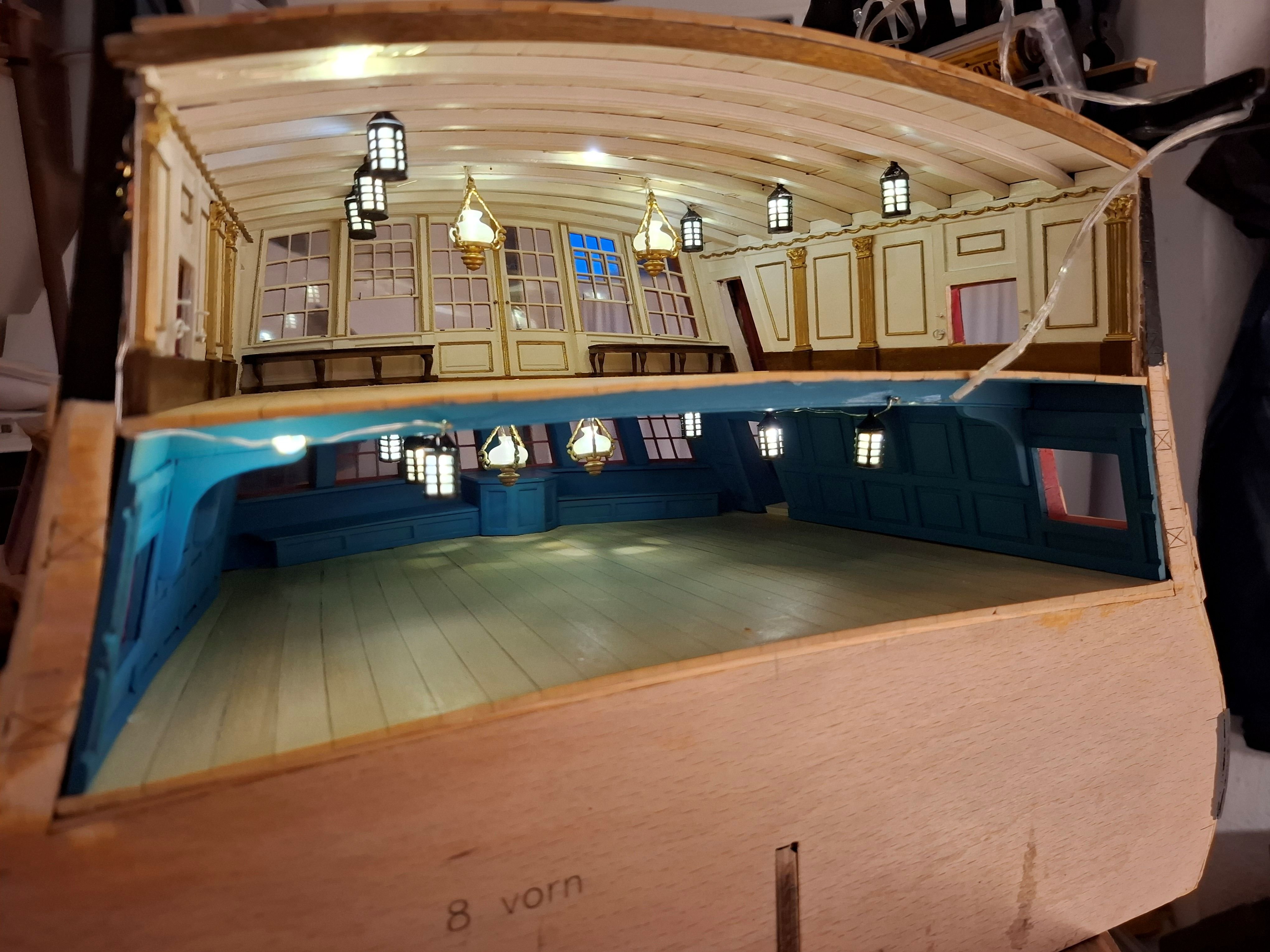

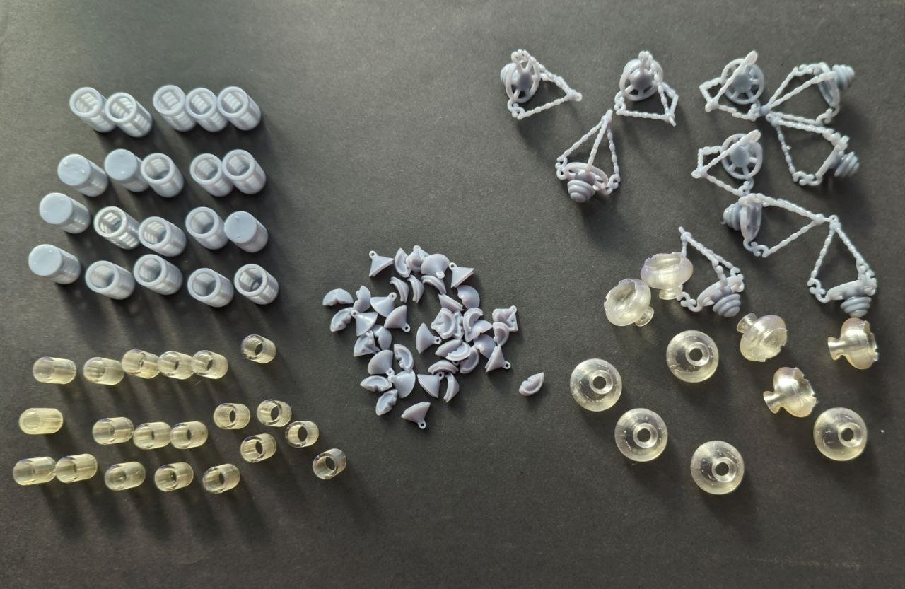

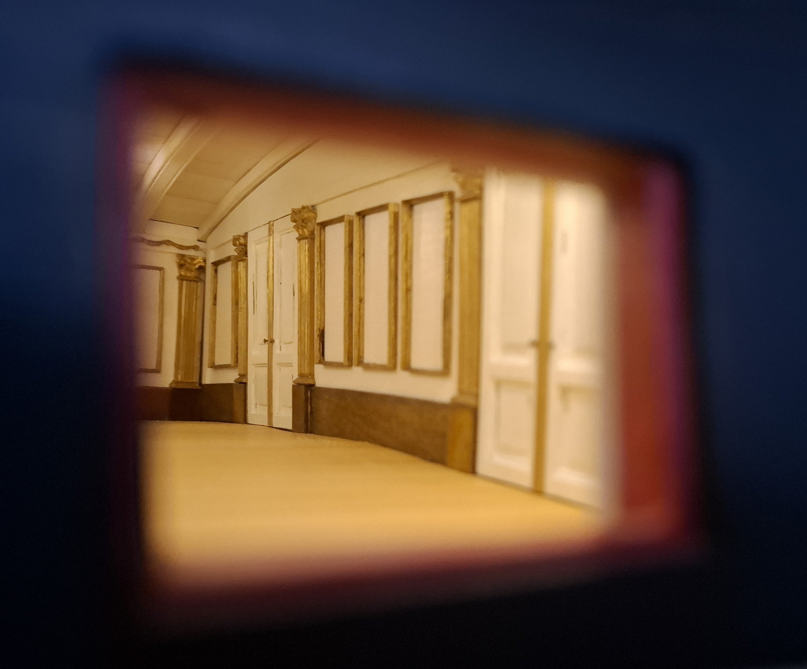

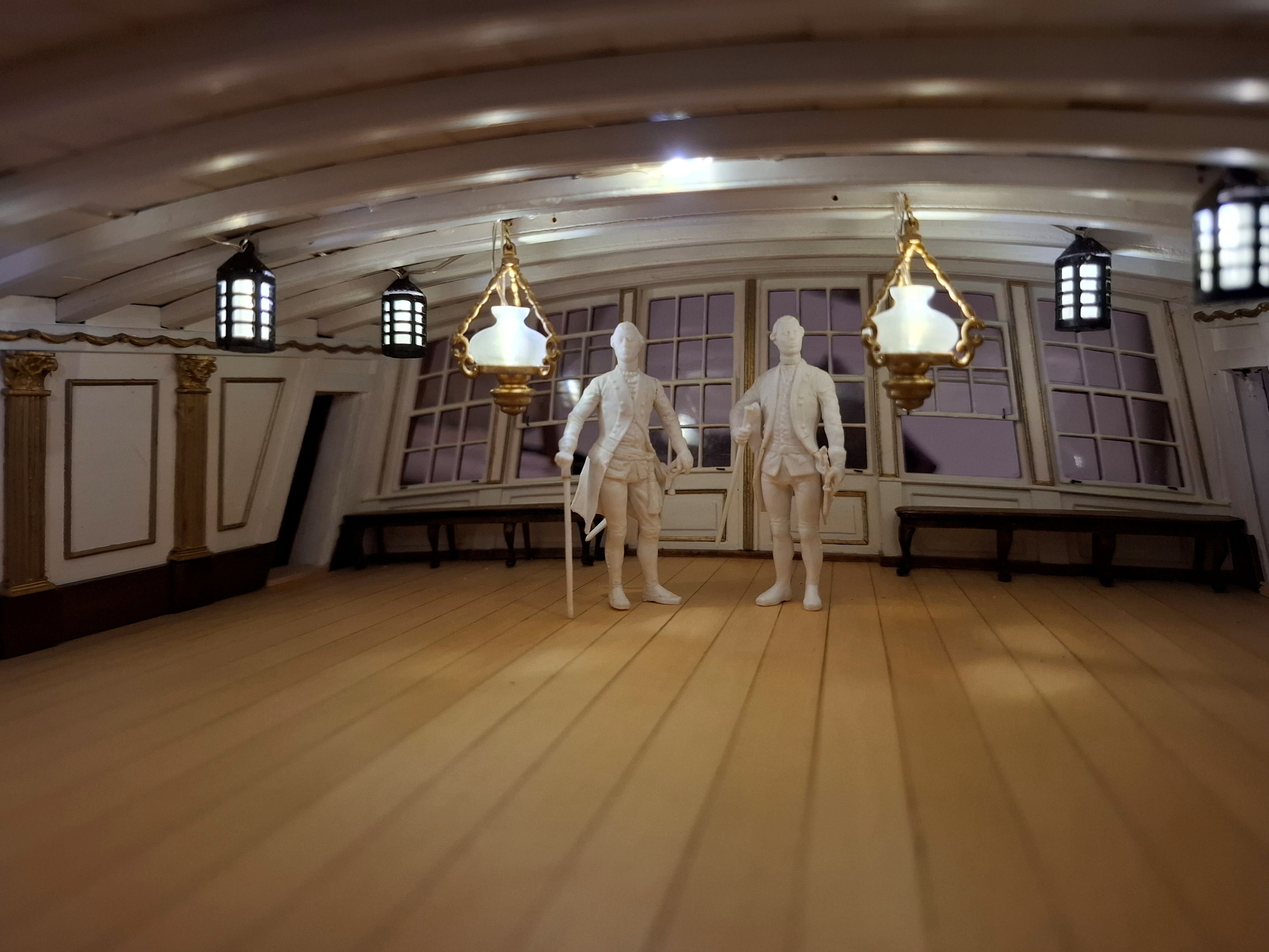

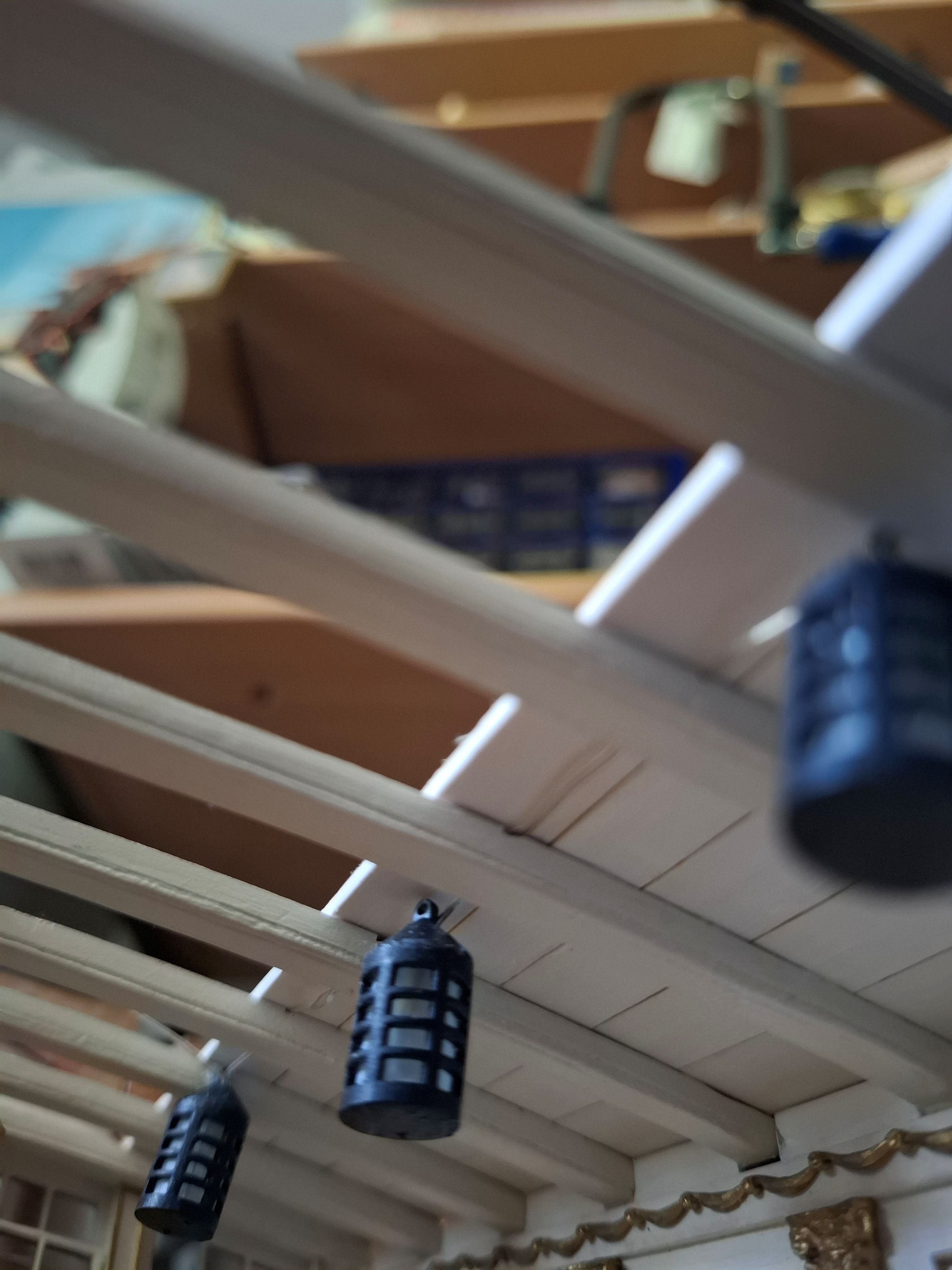

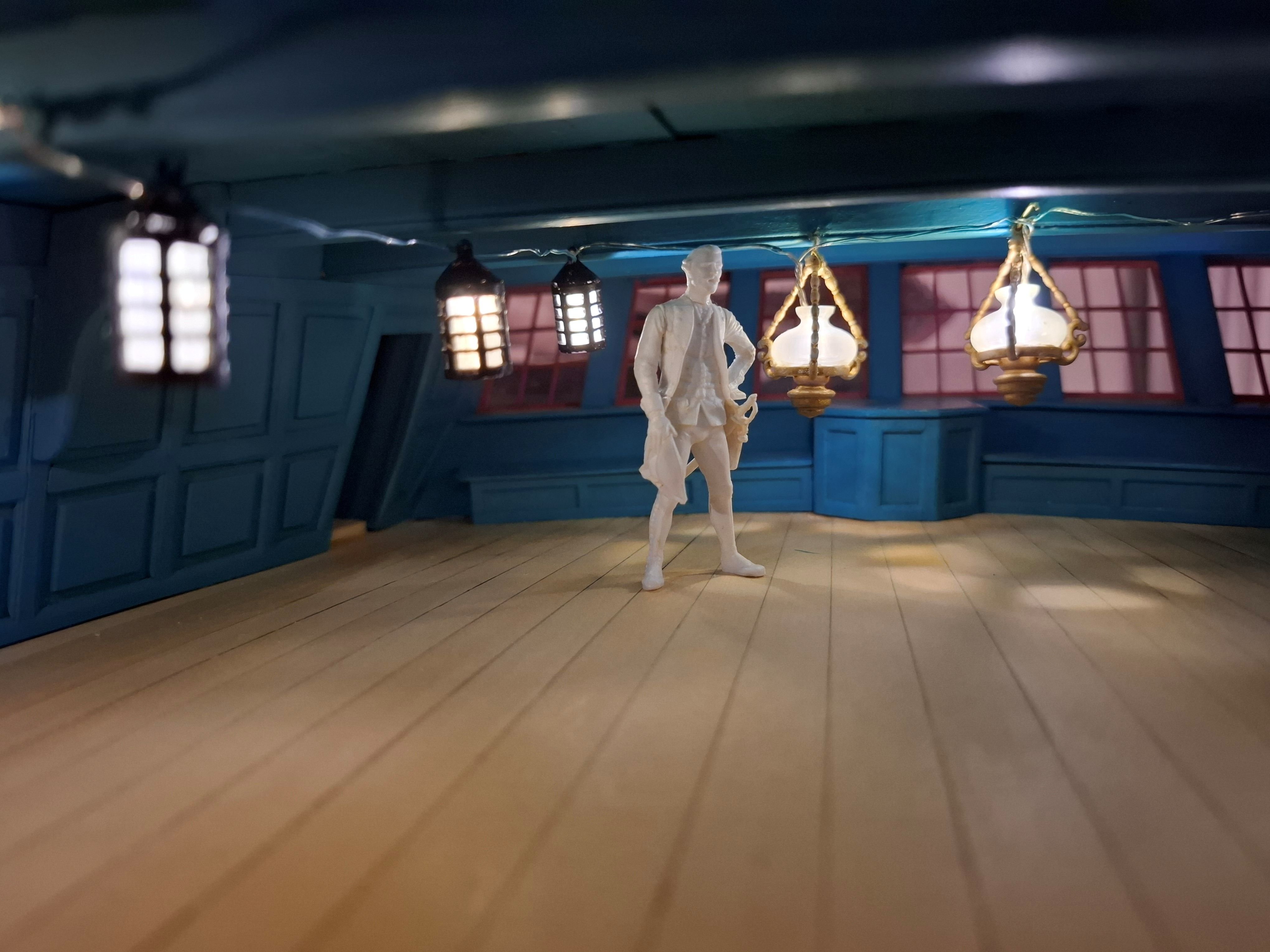

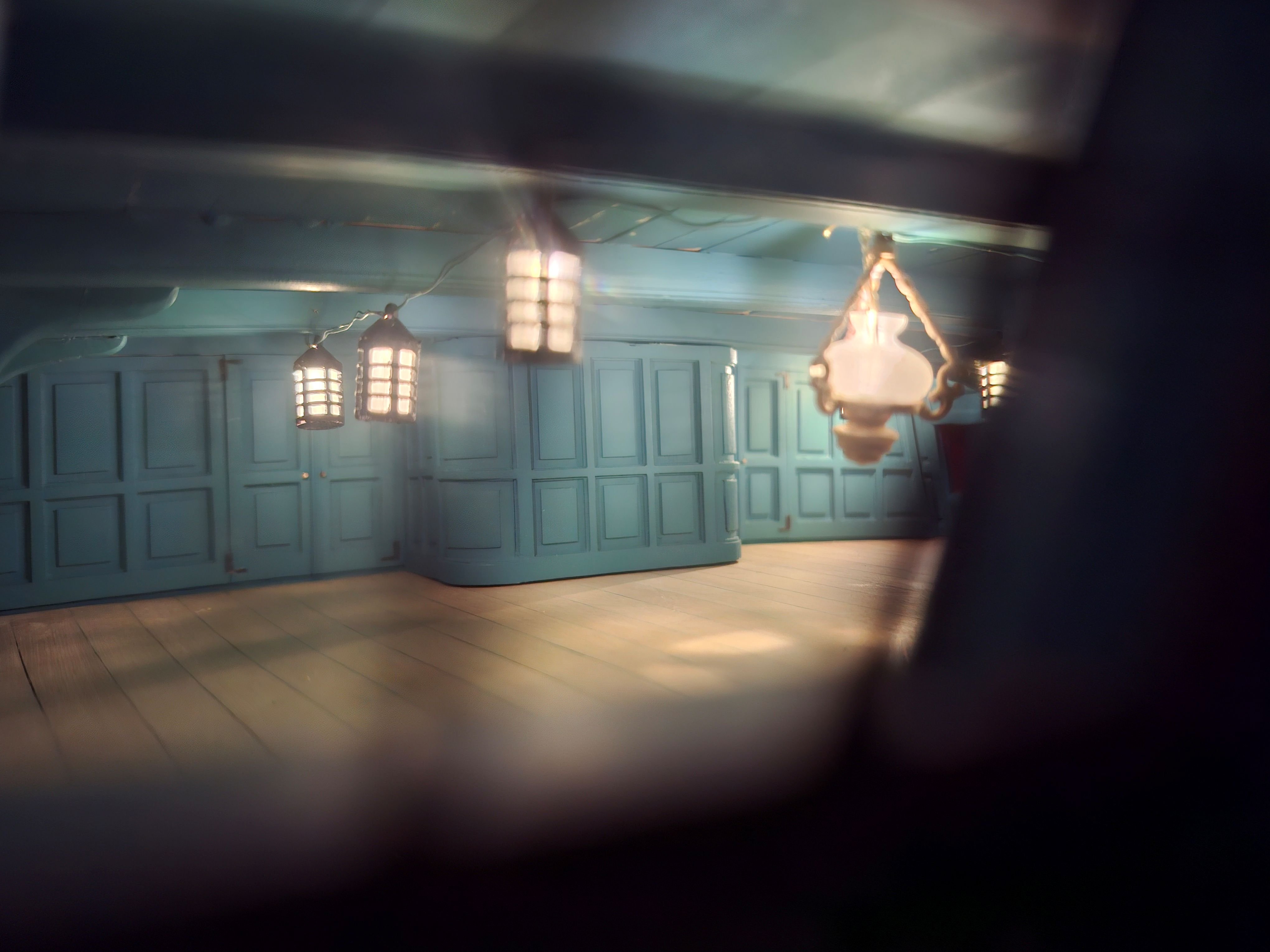

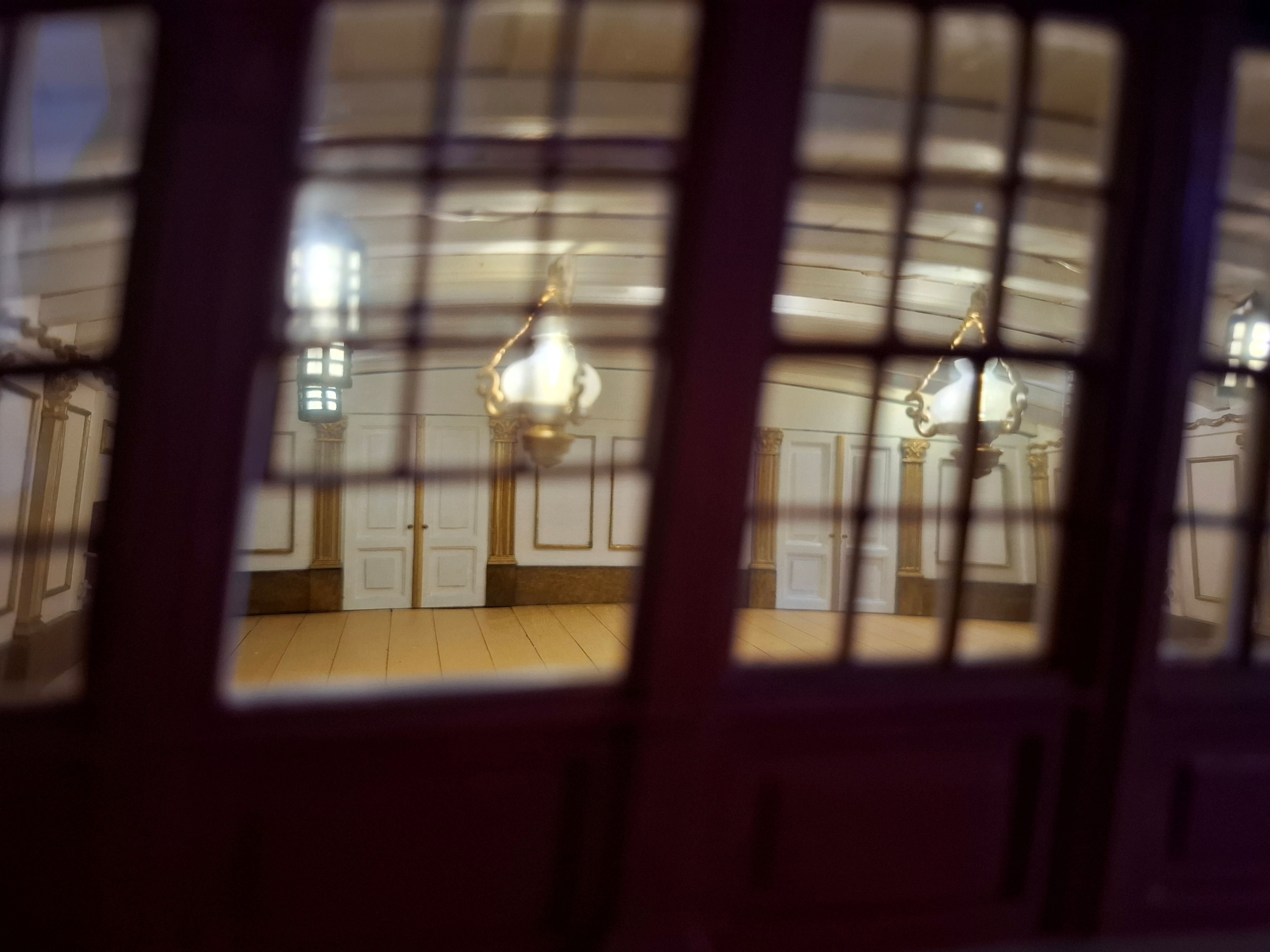

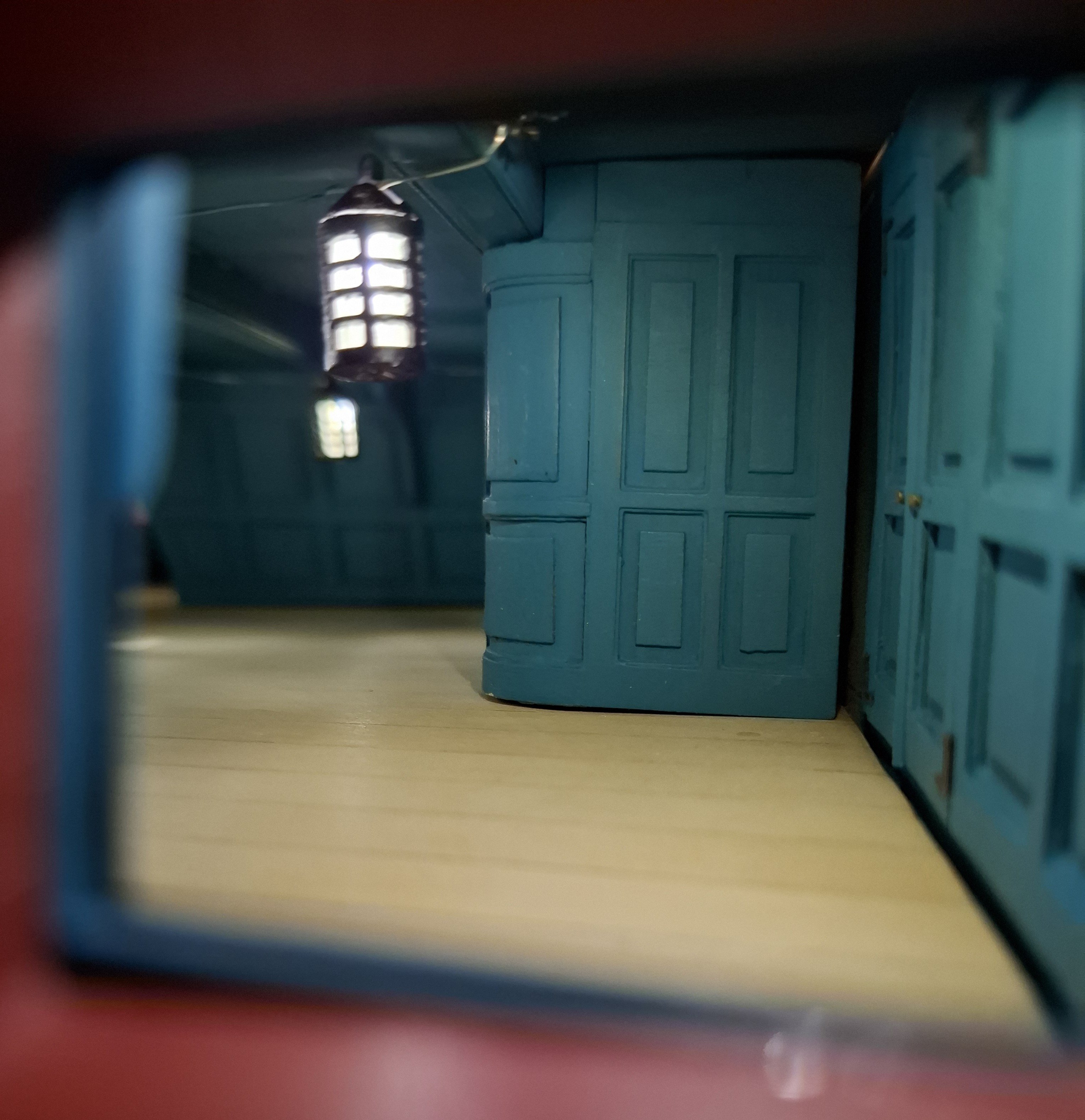

After quite some time, I now have some progress to report on my part.
Since I am building a transom model, it will later face the viewer with its stern facing forward. I was a little bothered by the fact that when looking into the model through the stern cabins, you are looking into empty space, so to speak. To remedy this, I added a rear wall to form the missing bulkheads to the ship's interior. Below are a few pictures of the first stages of construction with the bench in front of the upper gallery windows, the deck beams and the rear wall:

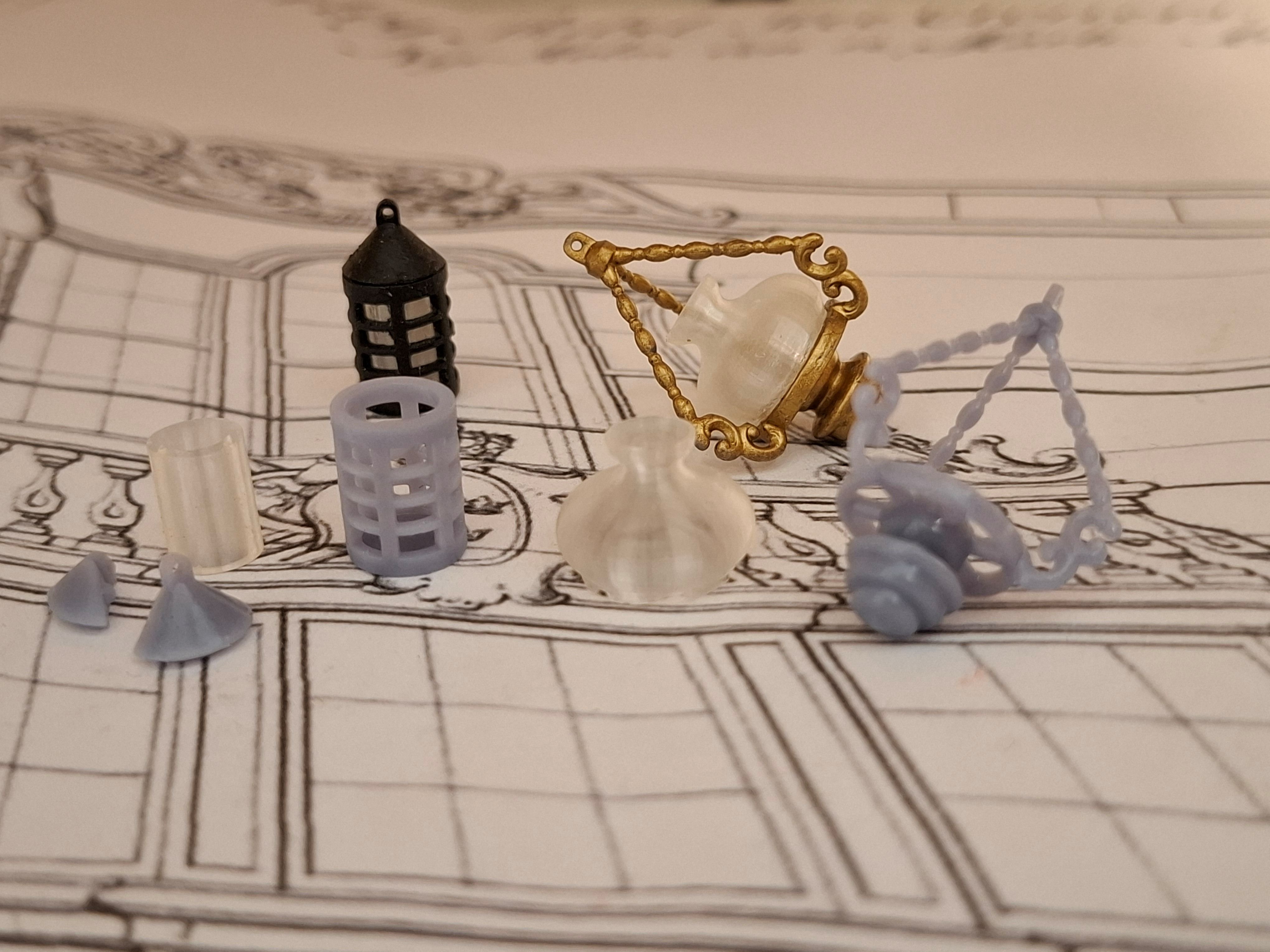

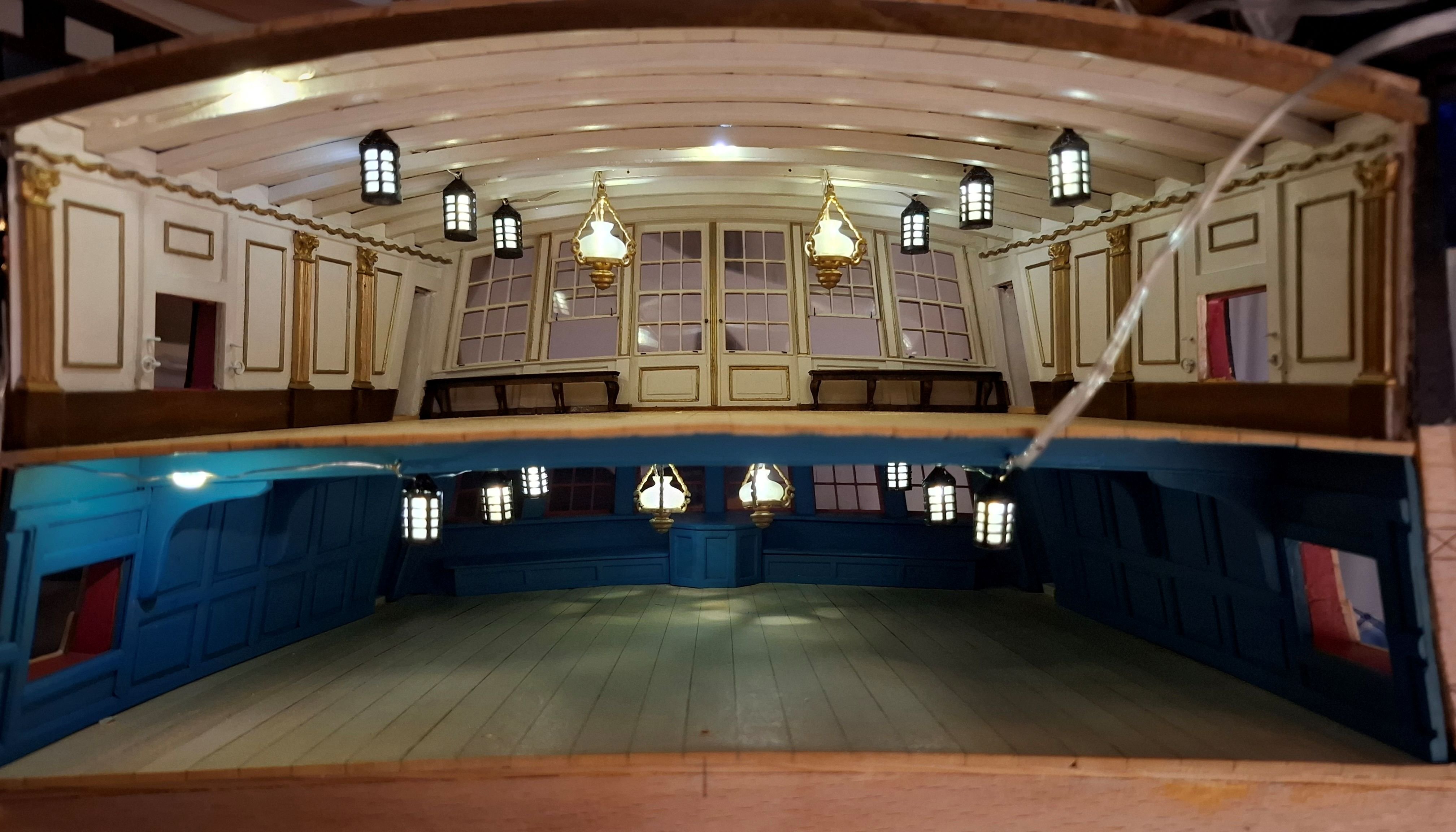

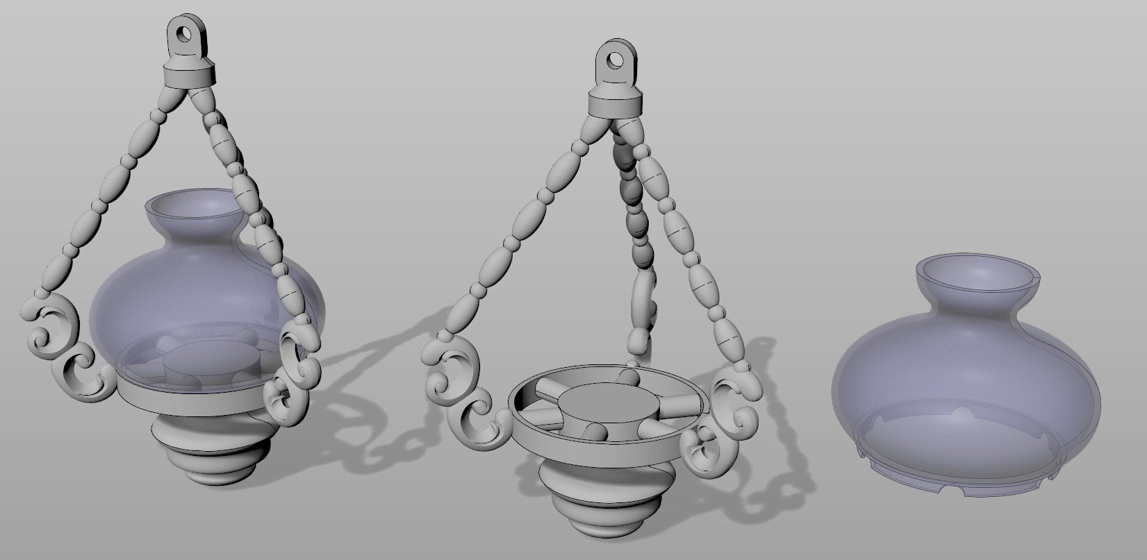

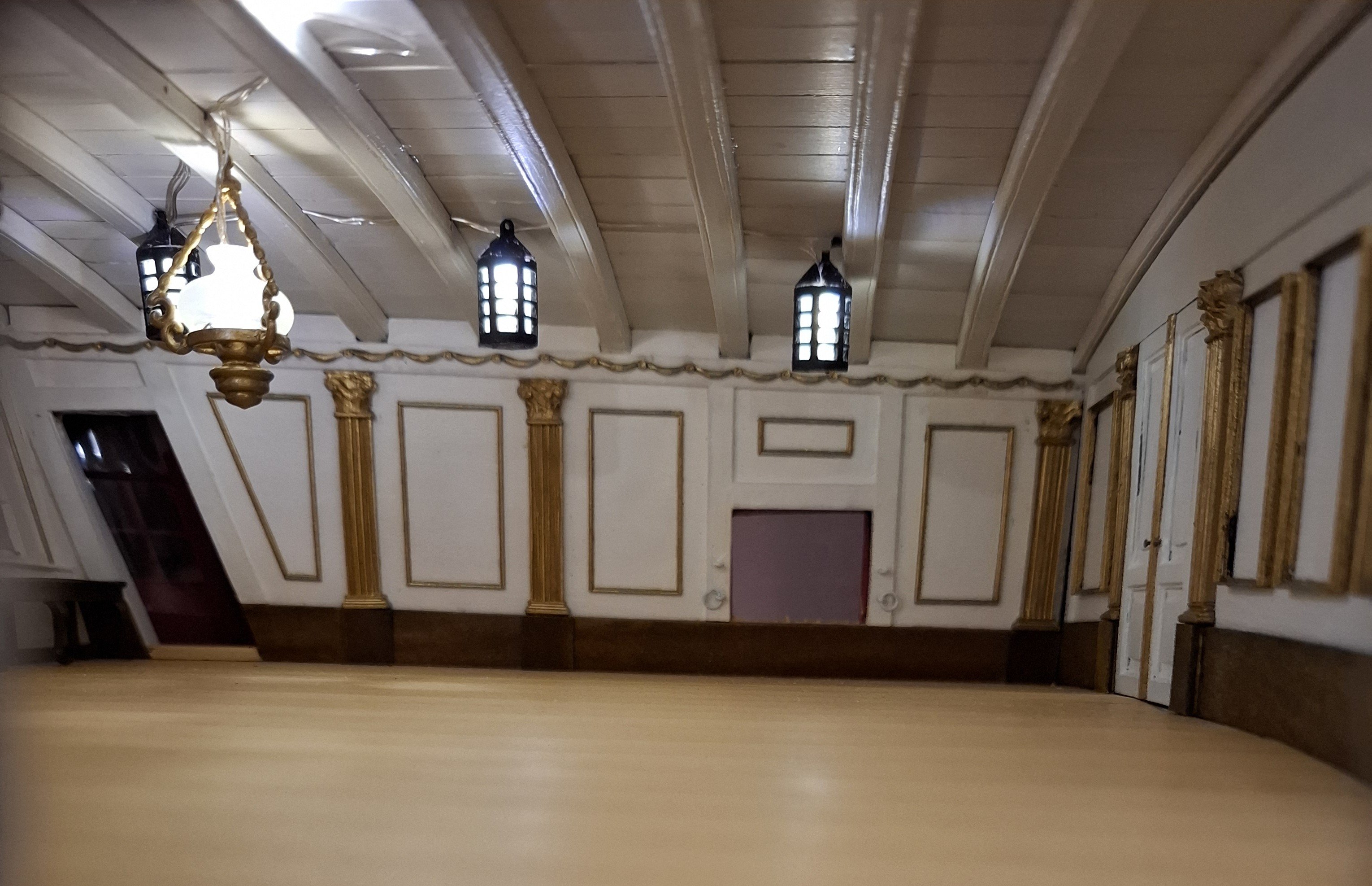

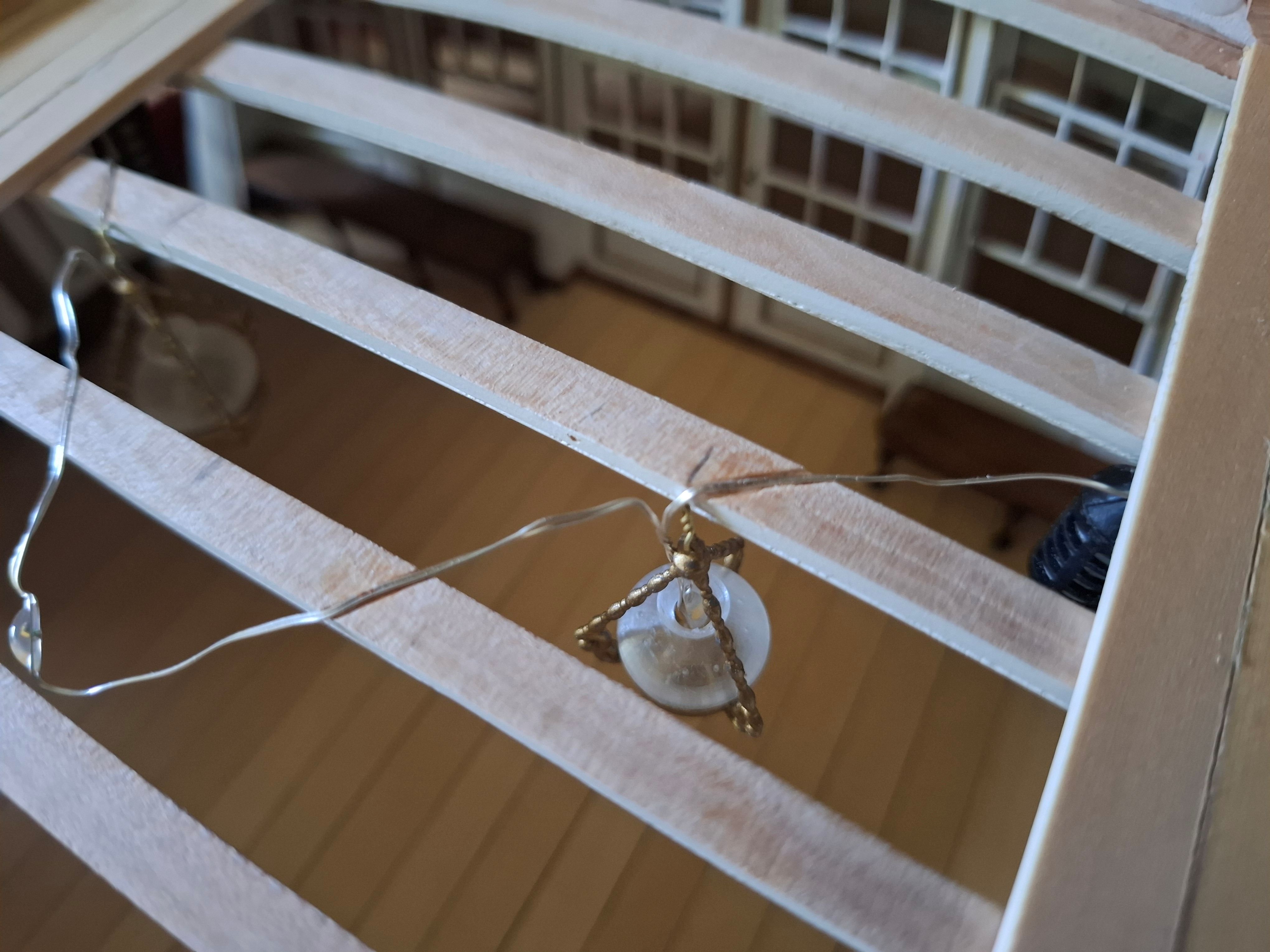

In order to get a good view of the interior later on, it was necessary to provide lighting. There are numerous options for model making here, which are more or less complicated, time-consuming and expensive. In the end, I chose the most primitive option imaginable and purchased a string of lights from Roßmann for €2.95. The small LED lights have a diameter of approx. 3 mm, very thin cables and are spaced 8 cm apart. I made a drawing of the lanterns and petroleum lamps that I had in mind as fittings and asked Igor Capinos to draw and print them in 3D, which I think he did very nicely.
Installing the lighting in the upper part of the model went quite well, as I still had access from above, but in the lower cabin it was a compromise, as I had to run the cables under the ceiling beams, which of course is not so nice.
Here are some pictures of the installed lighting on both levels:
I still need to work on the fit of the rear wall here.

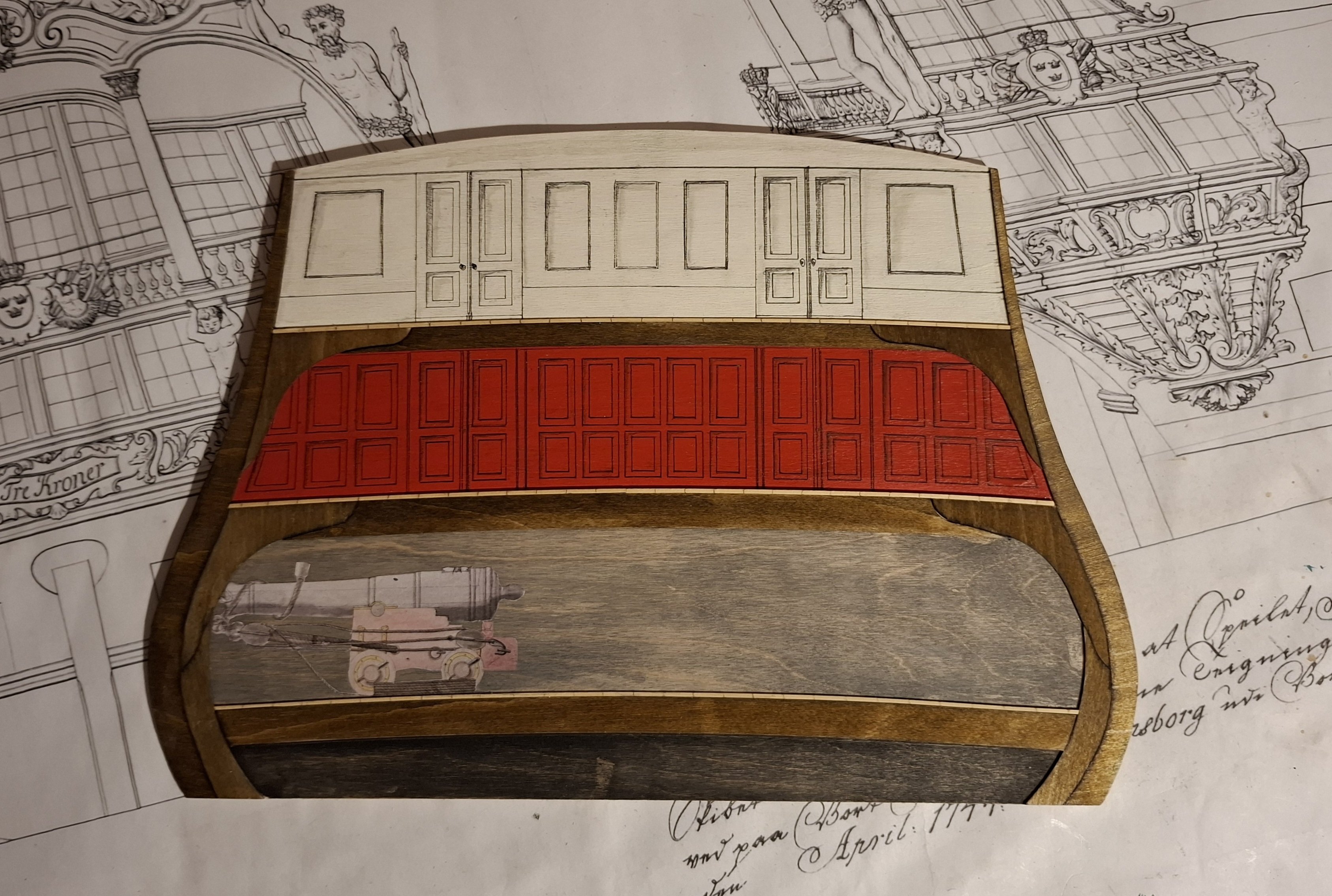

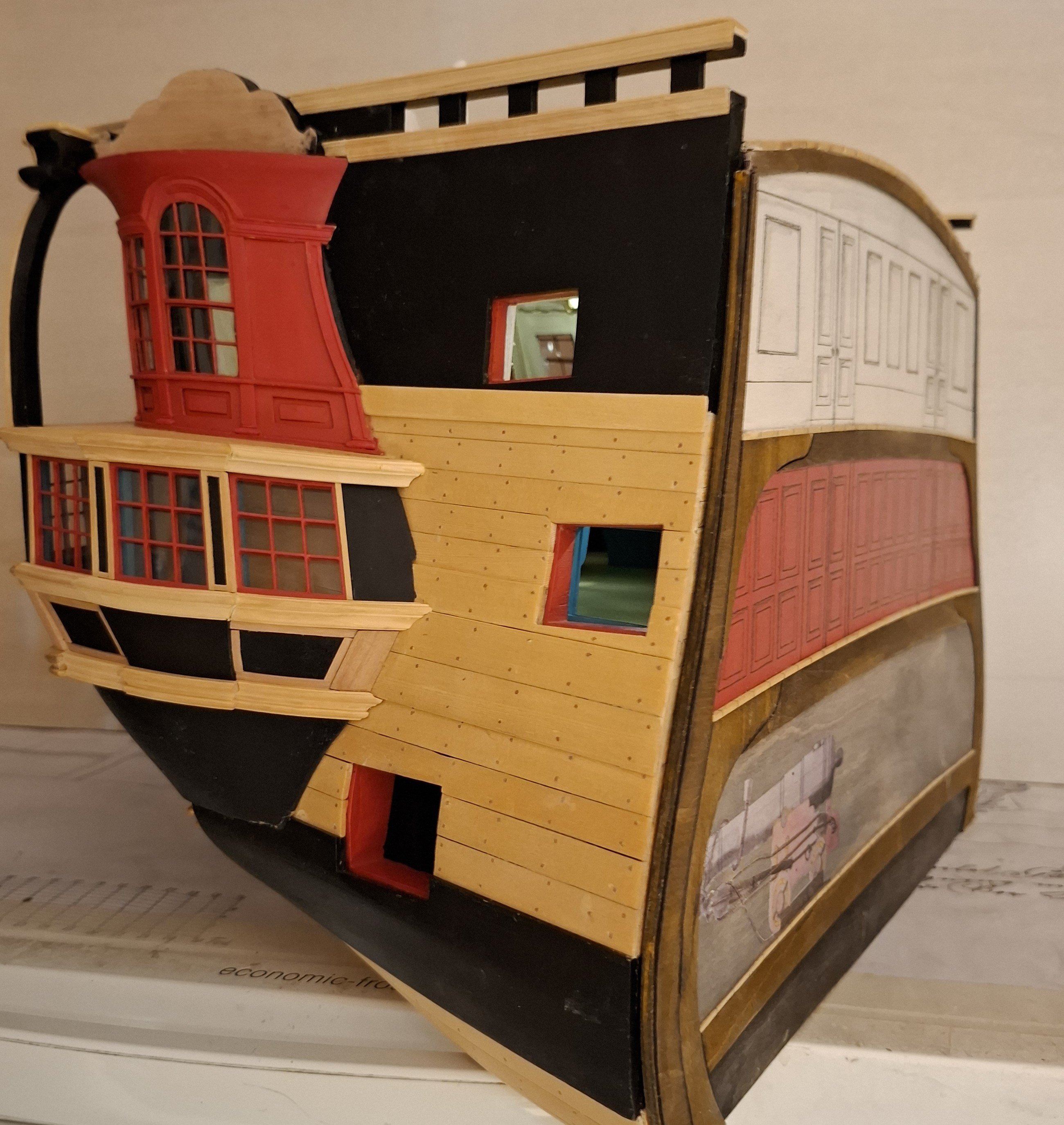

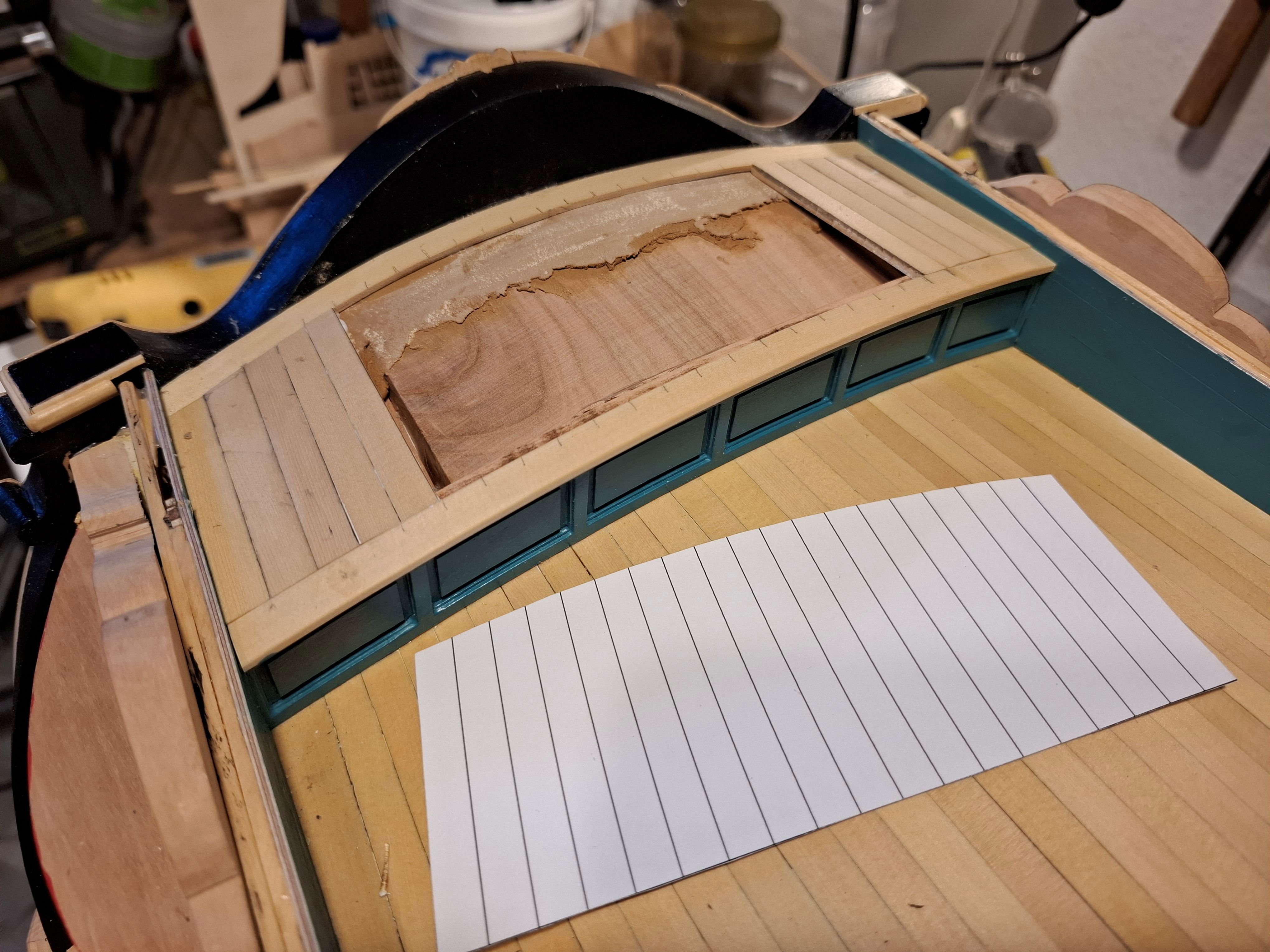

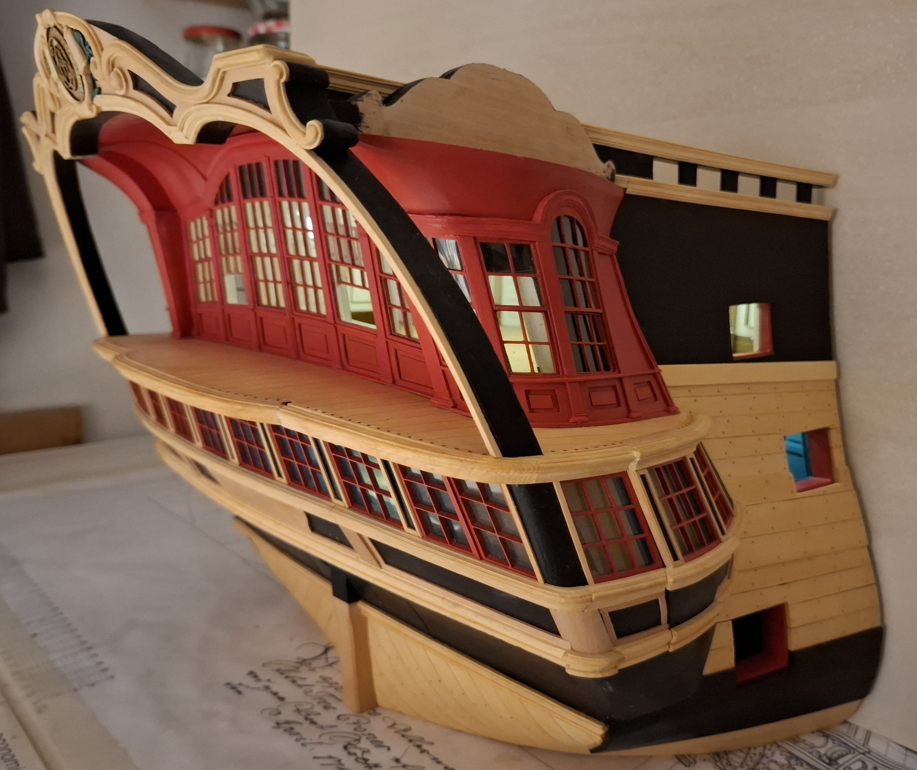

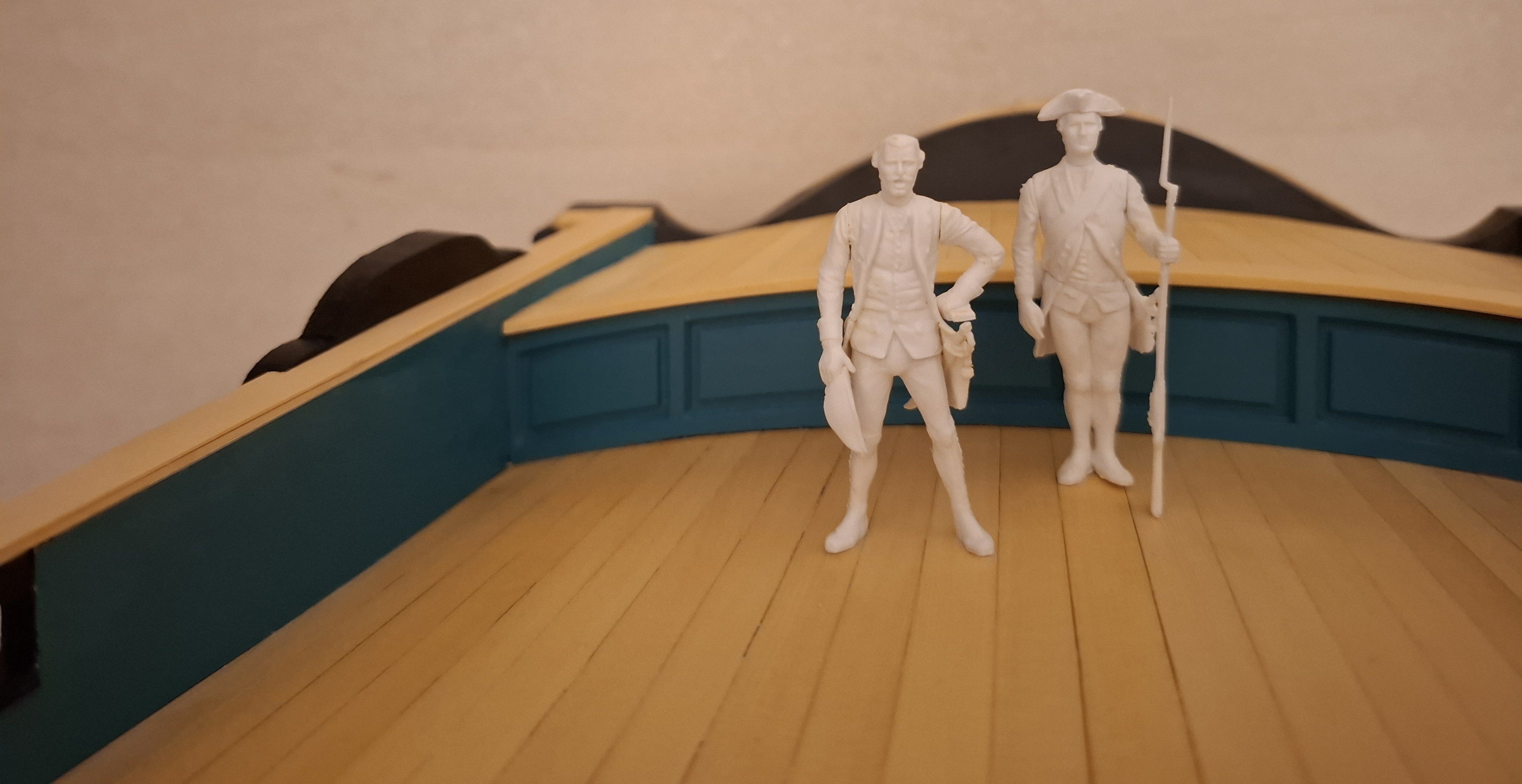

This was followed by the completion of the aft deck with the offset above the arched canopy. My design here is speculative, as the original model does not show the built state here.
I inserted a bulkhead in the front area and added a deck to the upper platform.
Later, ladder ascents and brackets for the hackboard will be added there.

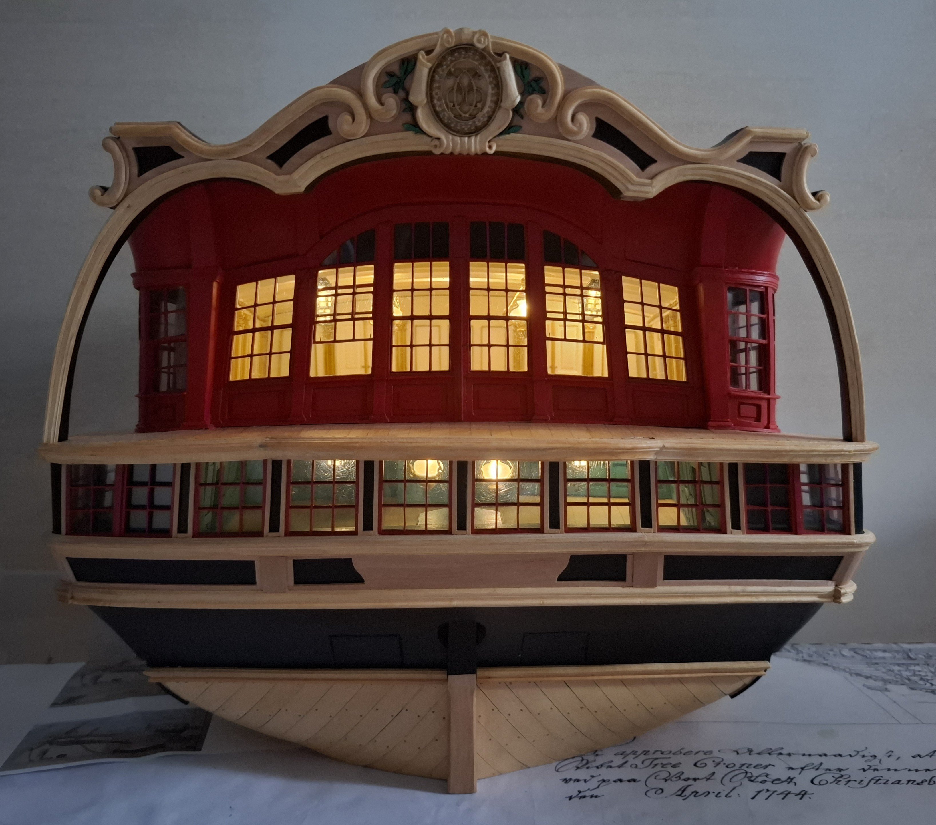

Finally, a few pictures of the overall model as it looks now.
The LED-light seems to be extremely bright, that is an effect of the camera of my mobile-phone. In reality it is more warm-white.
