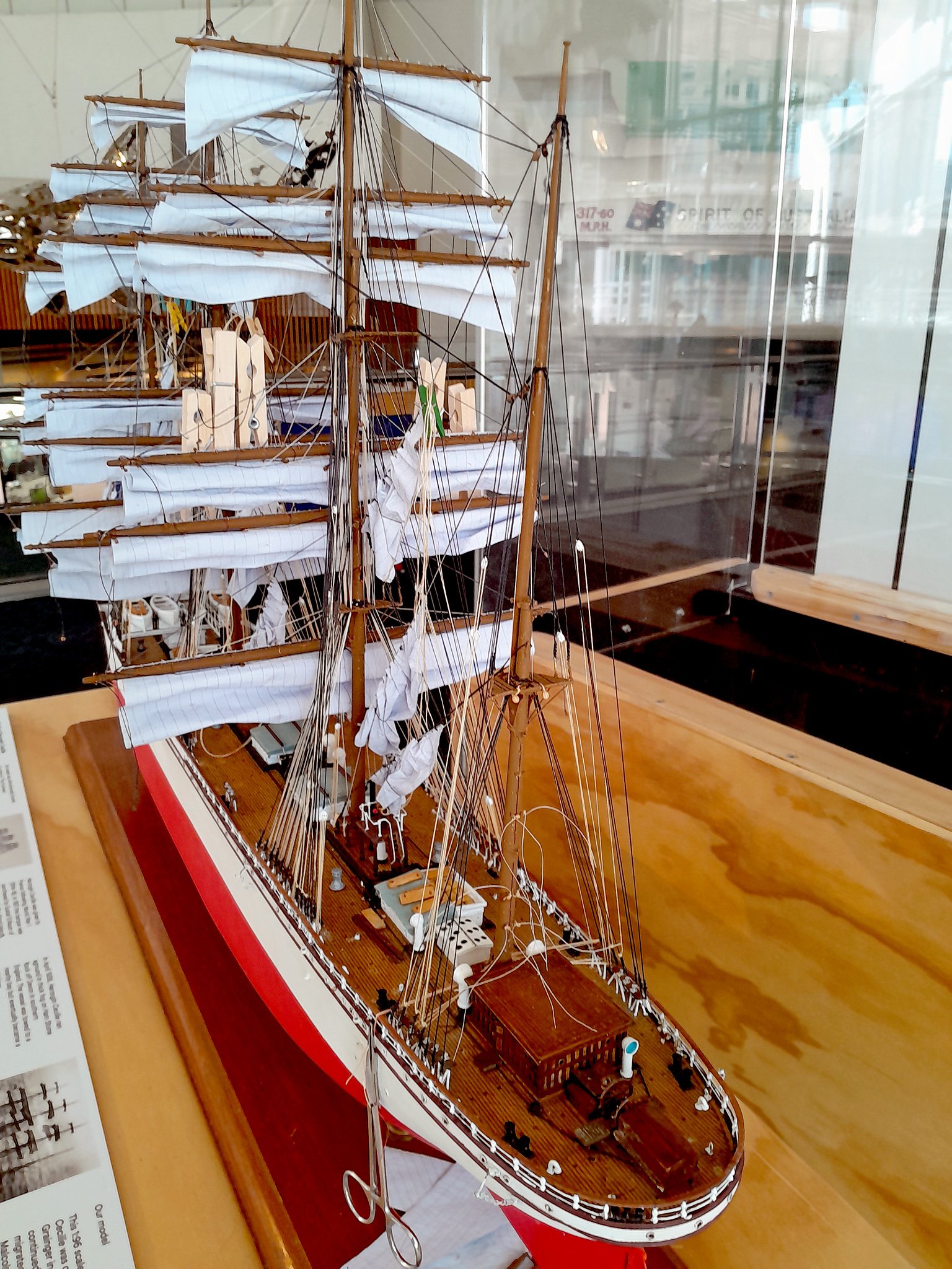

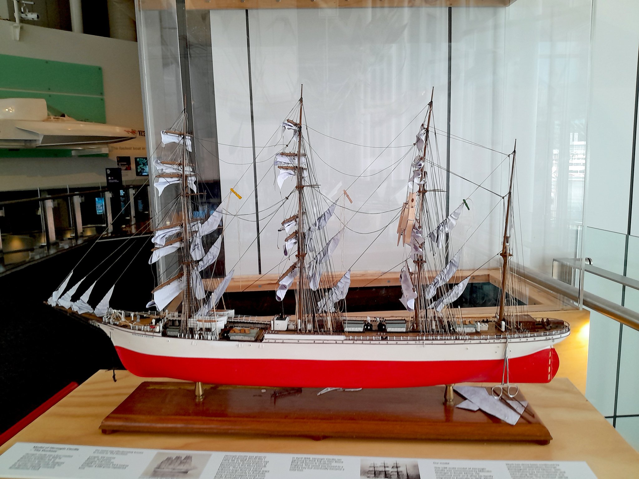

On 7/5/2025 at 1:29 AM, Jim Lad said:
Another update. The 'Duchess' continues to grow sails. First two on the mizzen mast. The cro'jack is rigged, the lower topsail merely crossed at this stage, but at least she looks a little more balanced with sails on all three of the forward masts.
John
177256-HerzoginCecilie(2).thumb.jpg.1de4b64aa53157d57ff22b64c9b19600.jpg177256-HerzoginCecilie(1).thumb.jpg.3a090acf5f0d85f5ccd180044b546d10.jpg
Oh my... "That's NICE!" "Beautiful!"

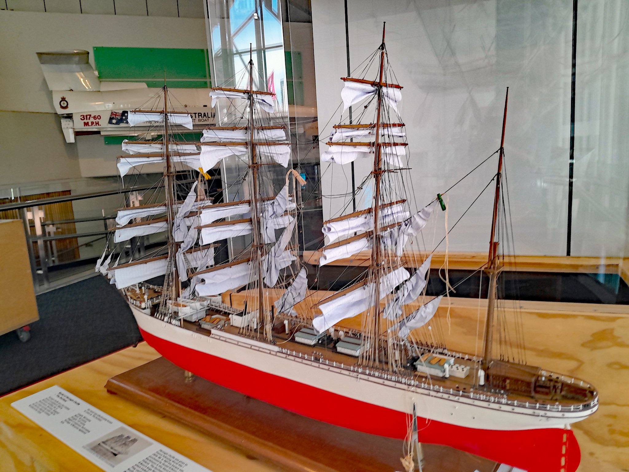

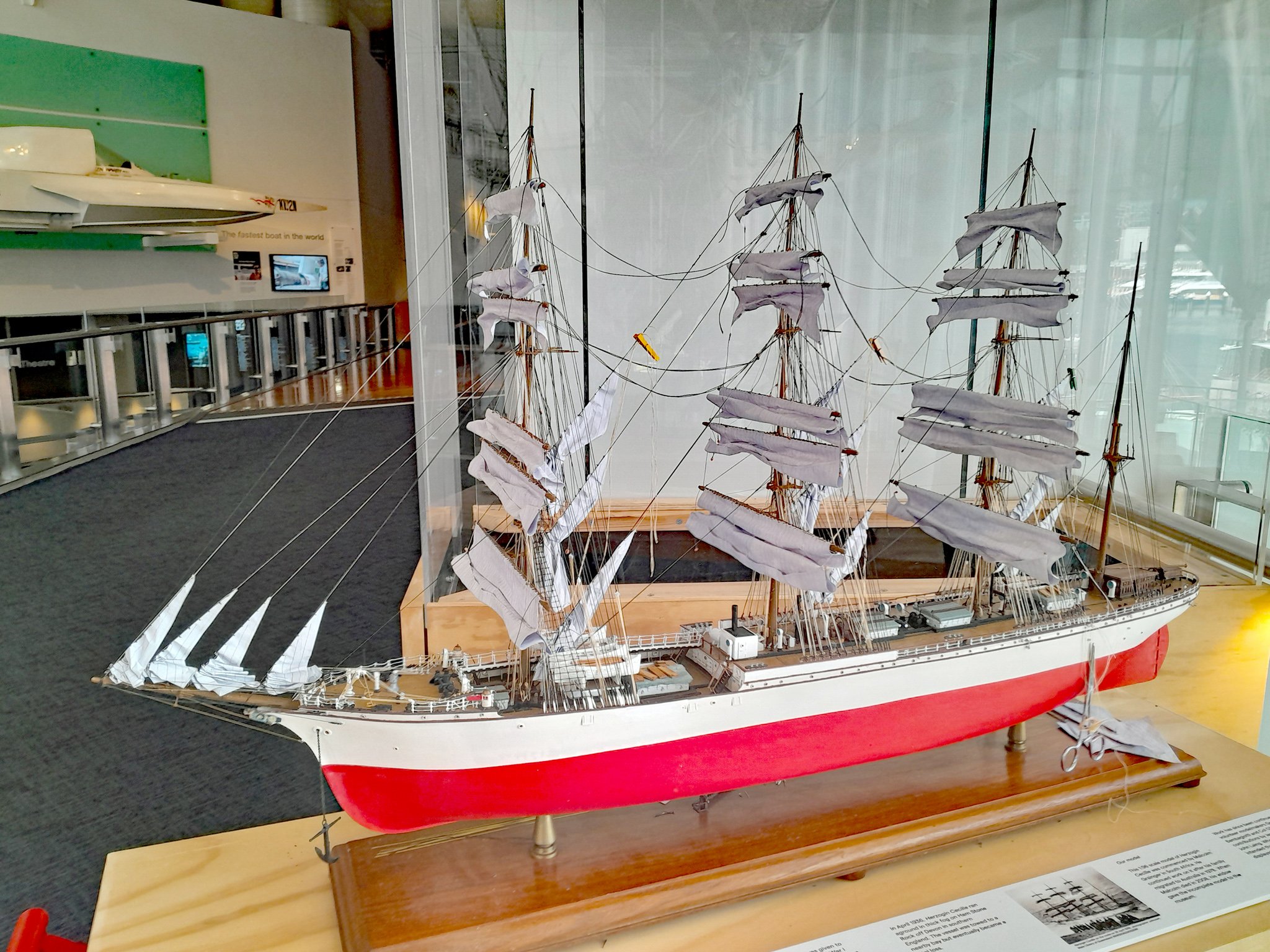

Not a lot of progress on the 'Duchess' of late. The last couple of times I've been at the museum I've spent most of the day talking to interested visitors rather than working on the model - but that's a good thing - I continue to wonder at the number of kids and teens who say things like, "That's so cool" when looking at the model and asking detailed questions about the building process.
The mizzen topgallant and royal braces have now been run, but not rigged to the yards, so that's now the total rigging on the square sails until I get the ratlines on and can finish off the braces. I've also started getting the lead blocks on the jigger, as can be vaguely seen on the image below. Ther's still a bit of fiddling about on deck needed before I actually rig the spanker boom, as the spanker sheet is tucked in behind the steering box and gratings.
John
177782-HerzoginCecilie(1).thumb.jpg.5f5b6fa06d5d271d49d7f76bc0864ca0.jpg177782-HerzoginCecilie(2).thumb.jpg.e1dcf2c2dc07bb0fd427c295d69ea0b6.jpg
 That last photo is absolutely stunning, John. It sounds like you've become the star attraction. :)
Beautiful work John! Happy to hear that you are helping to spur on the young ones.
Best Regards……..Paul
