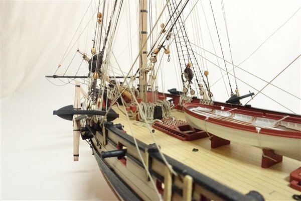

Lees has saved me from the tricing lines. He says that they were usually removed once the tackles were in place – that’s good enough for me.
Before access is made even more difficult, I fix the ship’s boat in place.
Although I had marked up the cheek blocks on the plans, I had forgotten to add them so had to make them now. I used some 2x2 boxwood reduced to 1.5mm and cut two notches to represent the sheaves. They were painted black before being glued to the topmast heads. The jib and flying jib stays and outhaulers are added, using 0.25mm rope. I think I have attached them to the travellers the opposite way round but I have trimmed them off and now am short of rope to replace them.
I hope that no one will notice.

Moving on to the Main and fore course sheets and tacks.
Steel says sheets are 3”, Tacks 4” and clews 2” ropes. I have used 0.45, 0.35 and 0.25 respectively as the nearest that I have available. All the 5 mm needed were stropped with a becket the lines prepared and threaded in one go. I tried to make a tack knot rather than use a toggle shown on the plan but couldn’t quite get the interlacing right but have ended up with a reasonable approximation that looks OK to me when rigged.
The clew line is tied to the yard with a timber hitch and feeds through the block on the yard down to the already overcrowded bitts.
The fore tacks lead through the blocks on the boomkins and are tied off at the knightheads at the bow and the sheets lead aft through the fixed blocks and tie of to the large cleats.
The main clews were threaded in a similar way to the fore course. The tacks lead through the fixed blocks just behind the forward stools but there was no provision for the main sheets to tie off.
The cleat is shown on the rigging plan but not shown on the drawings of the inner bulwarks nor could I see a slot provided for it in the inner bulwark patterns. However, it was a simple matter to modify a cleat and pin and glue in place just forward of the aftmost 6 pounder.

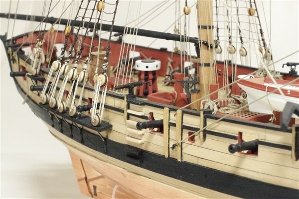

Braces – I am running out of 0.25mm rope from RoS, so I have used 0.35 for the topmast, topgallant and spritsail yard braces. Although oversized with reference to Steel, I think that they look fine. The main issue with the braces was again finding space for the topmast yard braces on the bitts. I count that there are 23 ropes tied off to the forward bitts and 13 at the main bitts. How the crew could find the correct rope in time before incurring the wrath of the officers is a miracle.
There was also the difficulty of adding a pair of blocks to the fore topmast head at this late stage to take the main topmast braces. Like Derek, @DelF I resolved the issue by using a single long strop for the two 3mm blocks needed.
I have left some slack in the braces which will need some small weights and dilute matt varnish to give the catenation that I’m looking for.
The spritsail braces are threaded through the inner sheave of the double blocks under the foretop. I was struggling until I used a fine broach to align fore and aft blocks and then I could slip the end of the stiffened rope through easily
