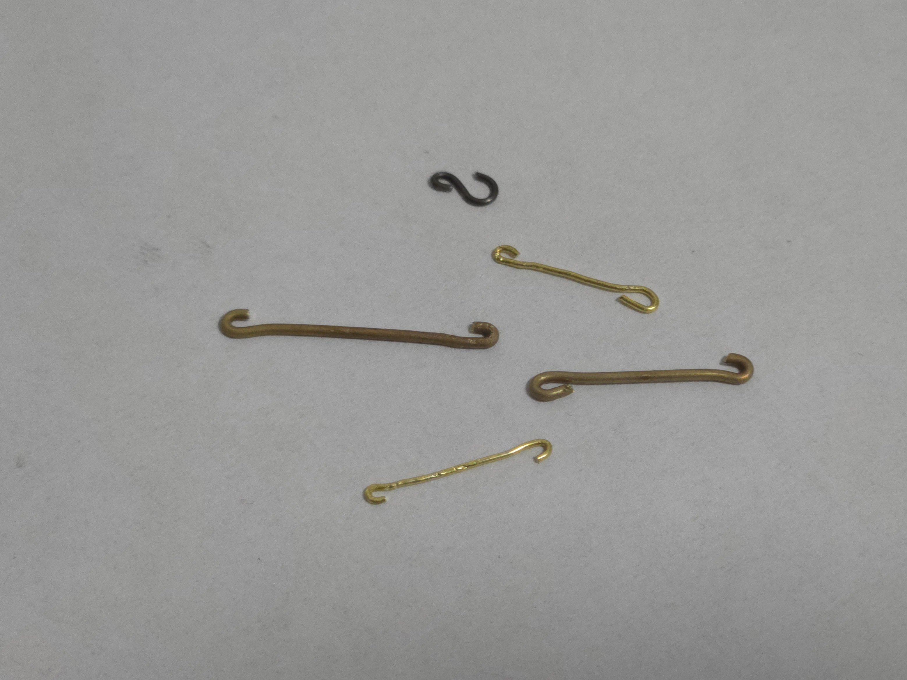

It was then time to try stropping a block with a hook--in this case, the peak halyard block, as I already had a double block stained and ready. Once again, I followed Chuck Passaro's stropping instructions, which I'm finding to be very clear and relatively easy to do, with the modification of doing a few half hitches instead of just wrapping the seizing. I also had some difficulty getting the super glue (which you mostly wipe off immediately) right, as it was very easy to either wipe off too much and have nothing stick, or to not wipe off enough and end up with a shiny spot (which I'll try to take down with a bit of matte varnish). The false splice turned out pretty neat. I'm using .45mm rope from Ropes of Scale for the blocks, and 140-size fly tying thread for the seizings.
Sharp-eyed viewers may note that I accidentally used the wrong hook for this--I should have used one with a perpendicular eye instead of twisting the eye of the stropping 90 degrees. Oh well, I think it's hard to notice unless specifically looked for.
Now that I finally have the necessary hooks, I'm finding block stropping to be pretty fun. I know this is all pretty basic information to be documenting here, but it's new for me.

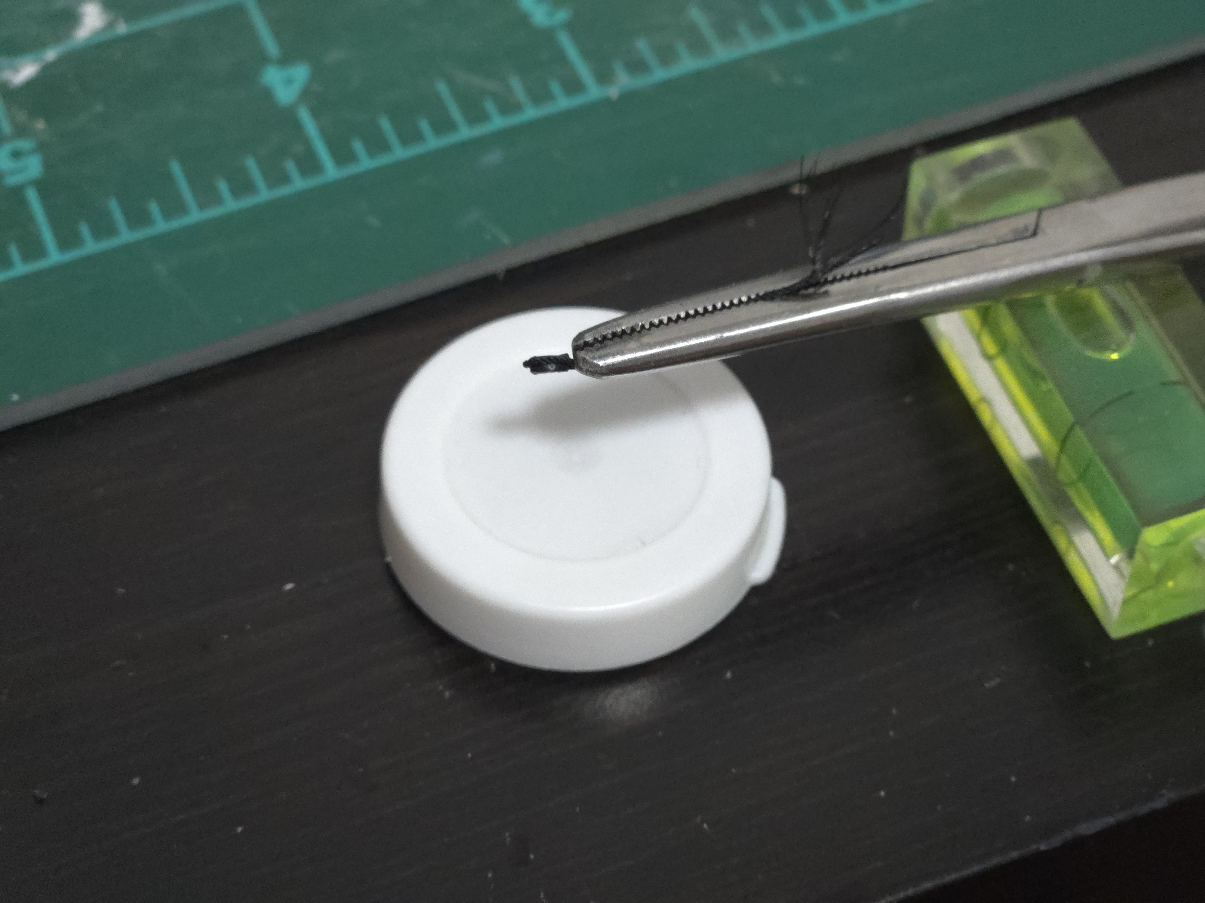

I had discovered decades ago that making half-hitches eases the seizing of blocks etc. a lot and keeps the rounds in place. The only issue is that one can see this on one side, so strategic placing of the 'hitch' to become mostly not visible is a good idea.
If you are averse to using an organic solvent-based varnish (e.g. diluted clear nail varnish) for securing rigging, you may want to try the cement they use in nail-studios to stick artificial nails to ladies' real nails. I recently discovered that this is a mixture of CA and metacrylic monomers: it sticks quite fast, but you have several minutes to adjust things before it fully cures. It is not as 'nasty' as pure CA and forms strong bonds. It should be readily available in your part of the world.

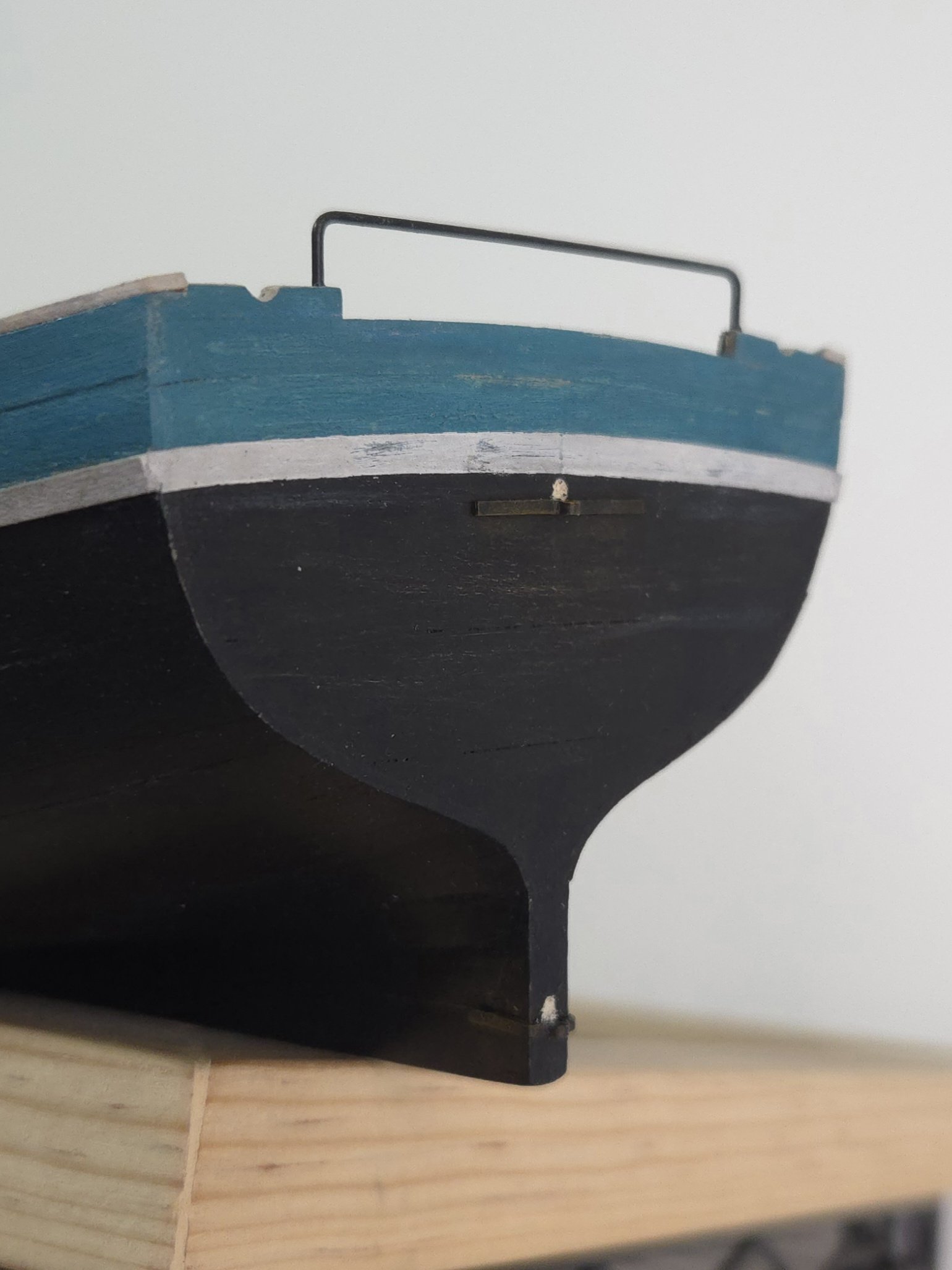

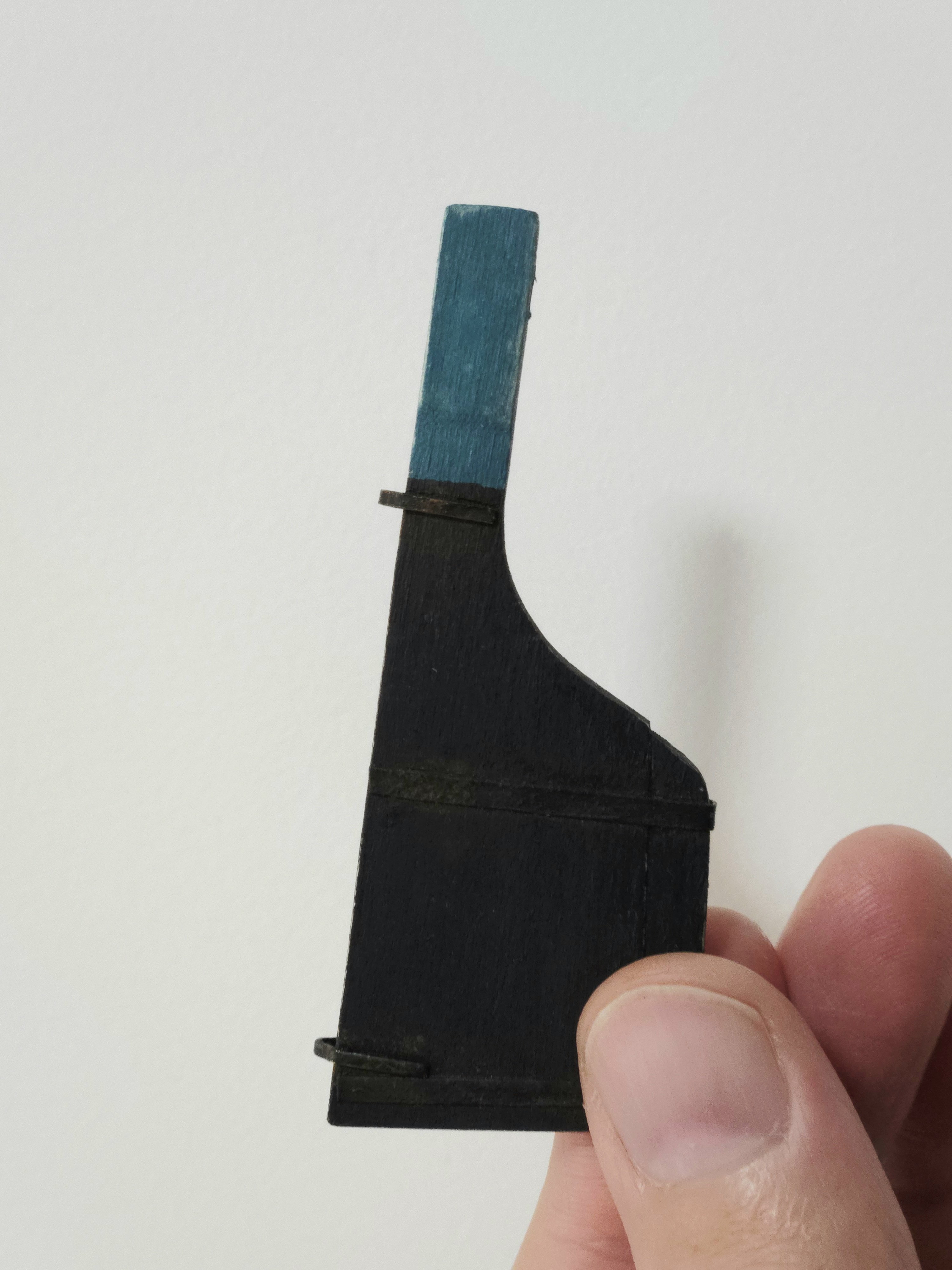

I started work on the rudder hinges, making one out of 1/64x1/16‐inch brass strip. It ended up protruding about 1/8 inch beyond the rudder, which is a bit more than I would like--as can be seen below, the gap is a bit excessive.
I still have a hard time making precise bends in brass, which is part of why it sticks out too far. As can be seen below, the 90-degree bends aren't very precise, and the bend for the pintle is simply too big. I'll have to try again.
That said, it occurred to me that this piece could also potentially be used to replace the eyebolt on the end of the boom, as seen below in a test fit. This would fill a little more of the excess space between the gooseneck eyebolts. The main issue is that the loop for the gooseneck pin is quite large, so the boom will bounce around quite a bit more than with the eyebolt unless I pinch the loop closed or something.

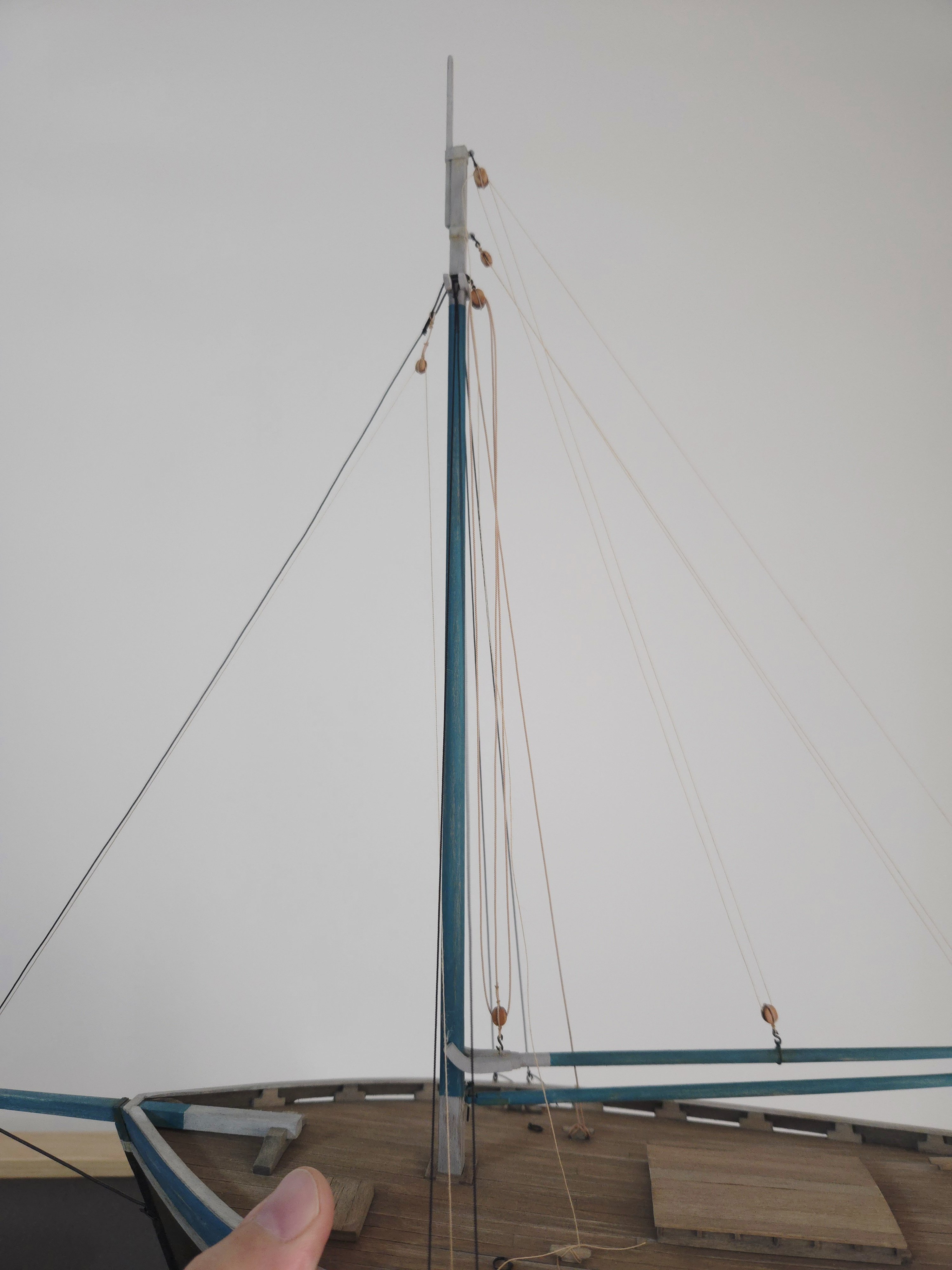

With the metalwork (real and faked) on the mast finished, I was able to add all the standing rigging to the masthead. The shrouds were put in place and seized together with black fly-tying thread, first the starboard pair, then the port. Then, the fore stay was added. I made sure the standing rigging was snugged down against the crosstrees, clamped the lines at the bottom of the mast with clothespins to add a slightly bit of tension, and then applied watered-down white glue to hold everything in place.
It was then time to add the throat halyard block, which, instead of being hooked to an eyebolt like the other masthead blocks, is stropped around the masthead. This proved tricky to do. First, I served a short length in the middle of a bit of rope.
I then looped the served portion around the masthead and tried to seize the loop closed. This was very difficult for me to do, as there were a lot of moving parts to juggle--the rope, the seizing thread, and the mast itself were all sliding around. Eventually I used a dot of glue to secure the rope to the masthead in the proper location, but it was still tricky to seize it shut. I ended up deciding to seize it a bit further down the line first, as shown below, and then to seize closer to the masthead.
While this certainly made it easier to add the closer seizing, unfortunately, that first seizing wasn't quite centered. I therefore added a further, properly centered seizing between the two I had made, to be against the top of the block, and then cut off the lower seizing, carefully removing the glued fibers as best as I could. I was then able to finally add the block, as can be seen below, which I held down in the proper position with sewing thread before adding watered-down glue to hold everything in place around the masthead.
With all the blocks added, the masthead is now complete!

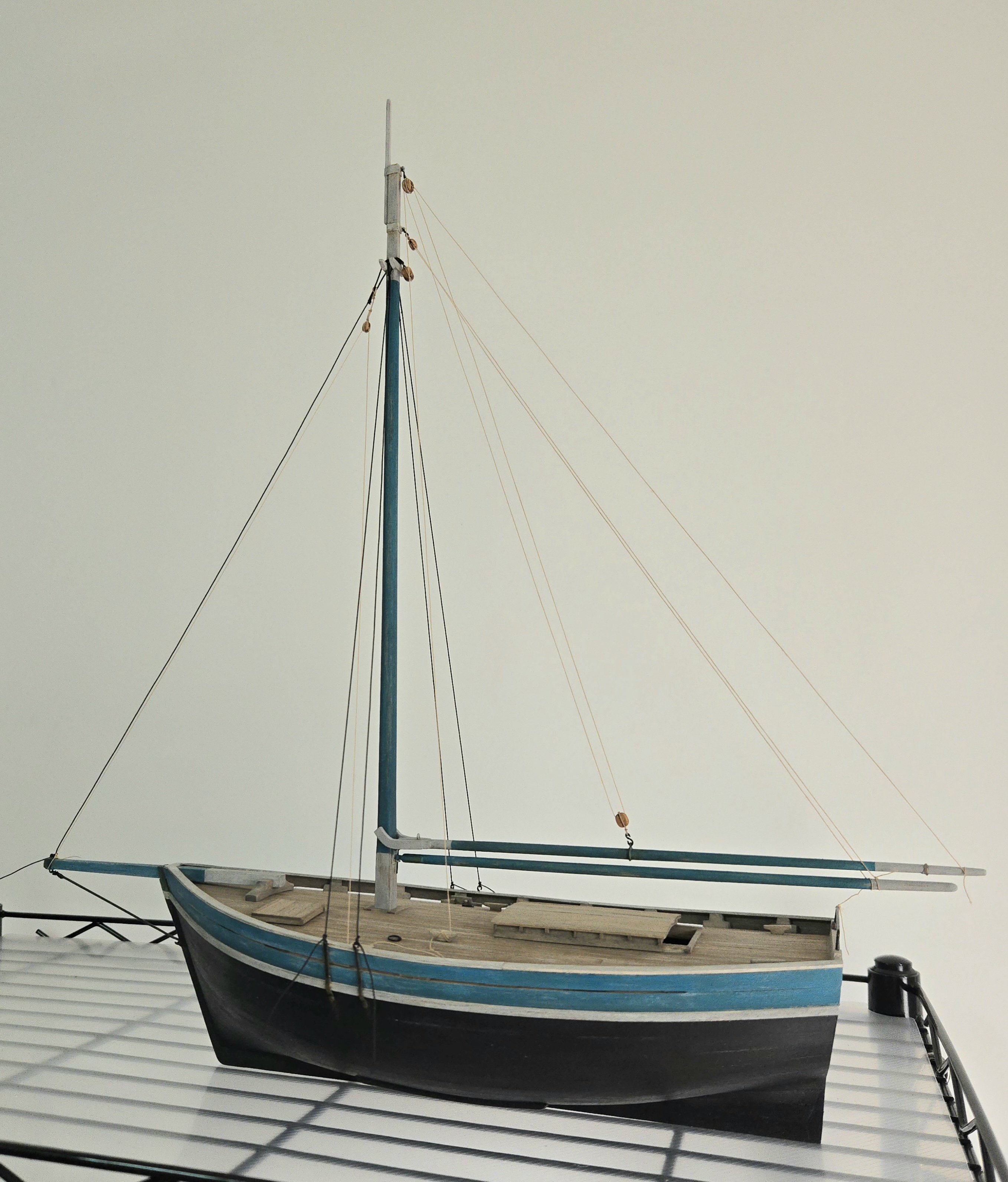

I similarly tied off the fore stay, and took a look at how the build is coming now that it has more rigging (also temporarily adding the boom, which still needs paint). I'm liking how it's coming together so far.
And with the failed gaff temporarily added, giving a sense of how it would look if I don't add sails.

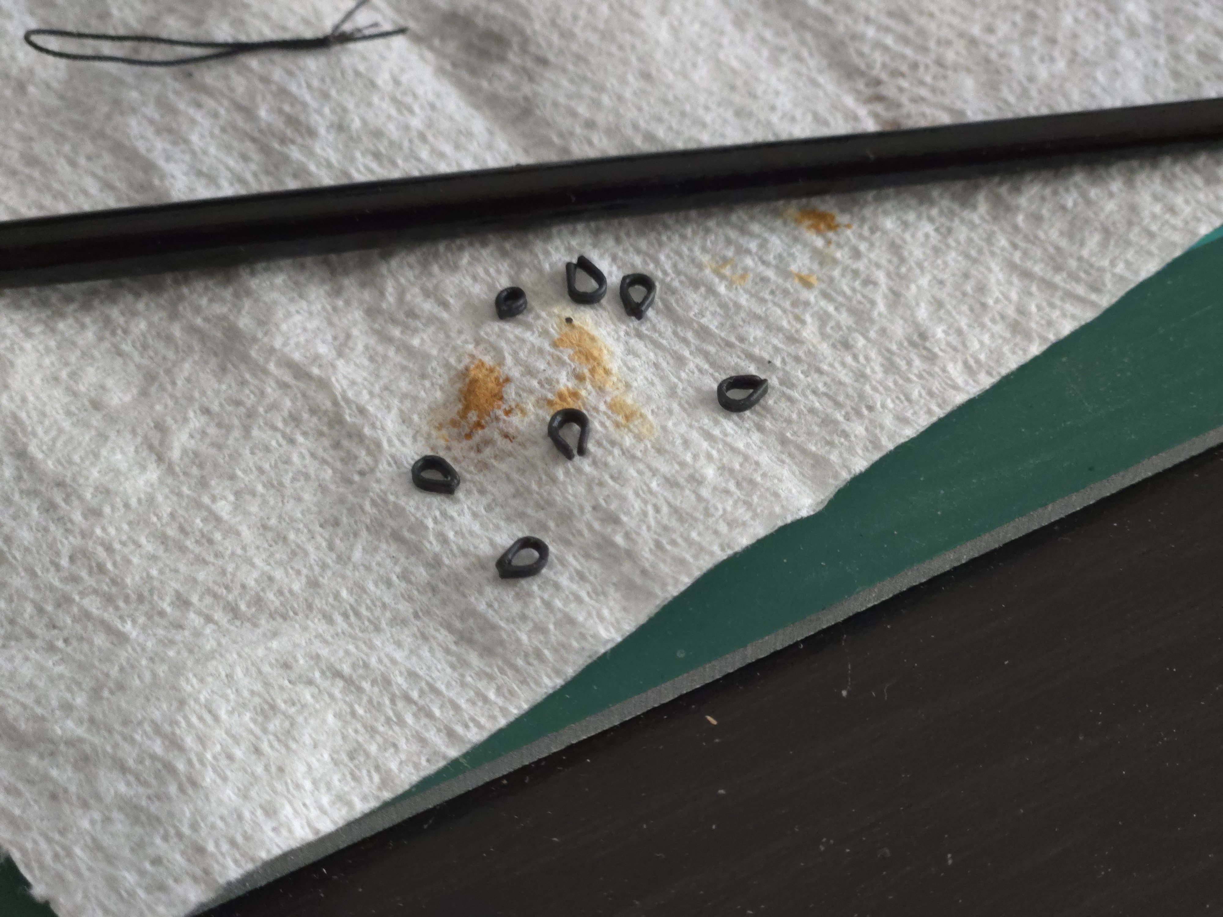

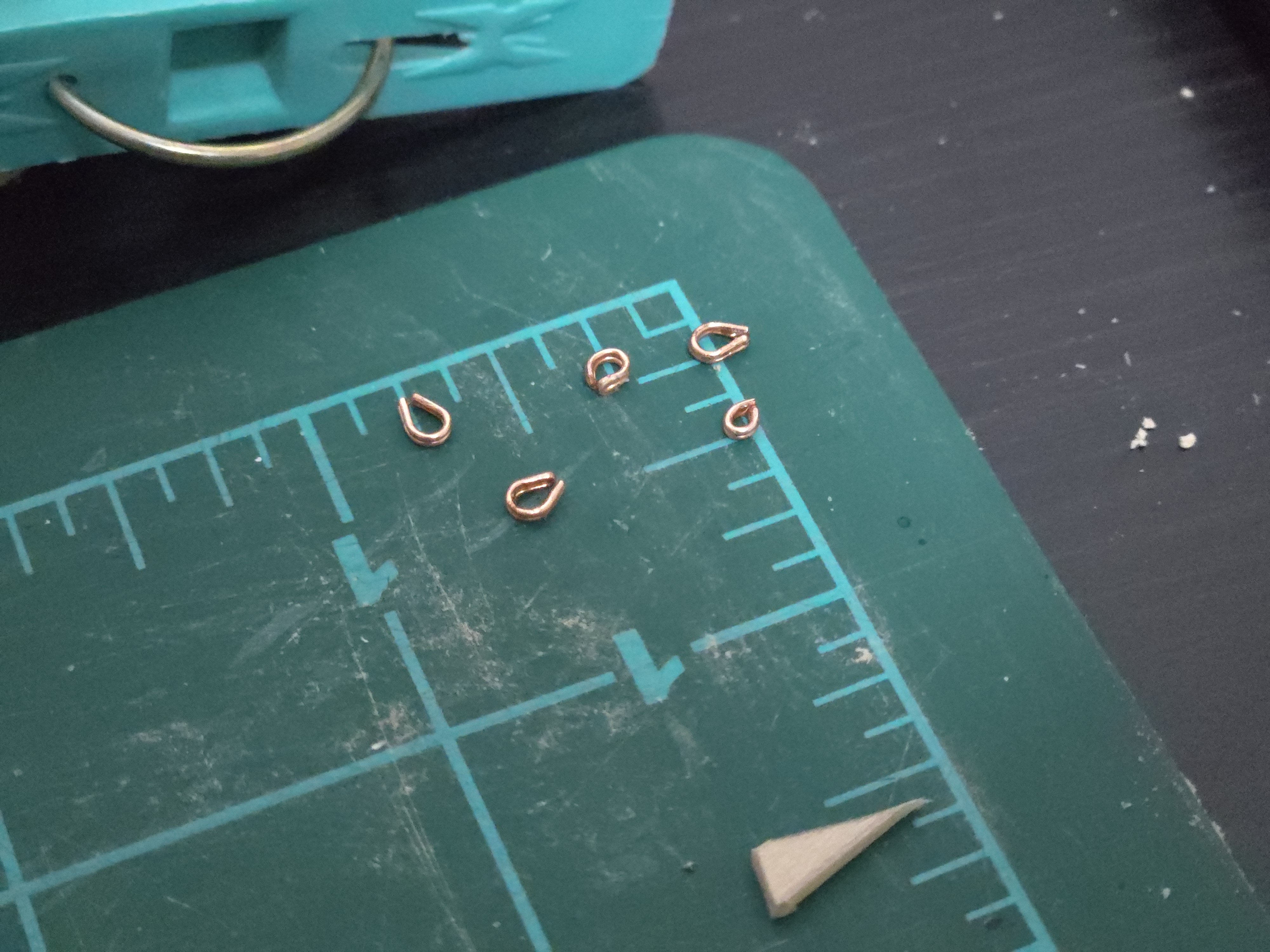

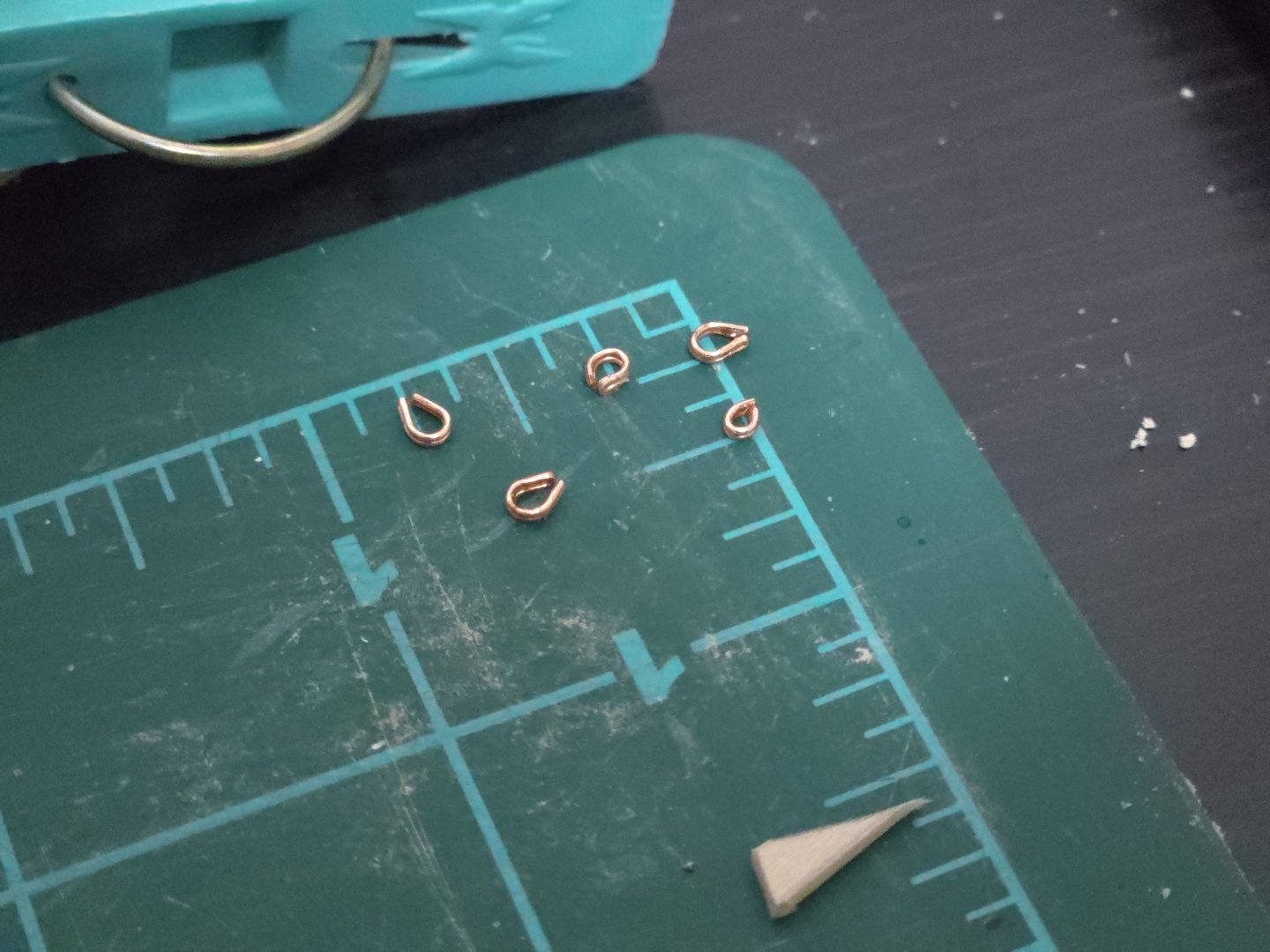

A little more progress. I wasn't thrilled with how my flat brass strip thimbles turned out, as they don't have any sort of groove and thus don't really look right.
Searching for ideas that could be done with the tools and materials I already have, I saw this post about making thimbles from doubled wire:

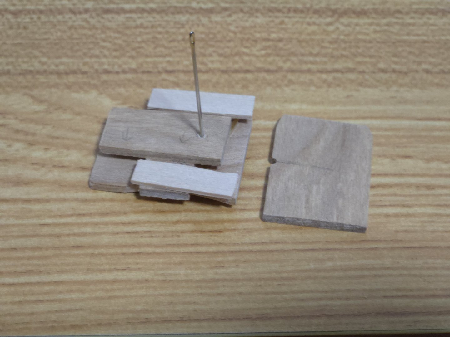

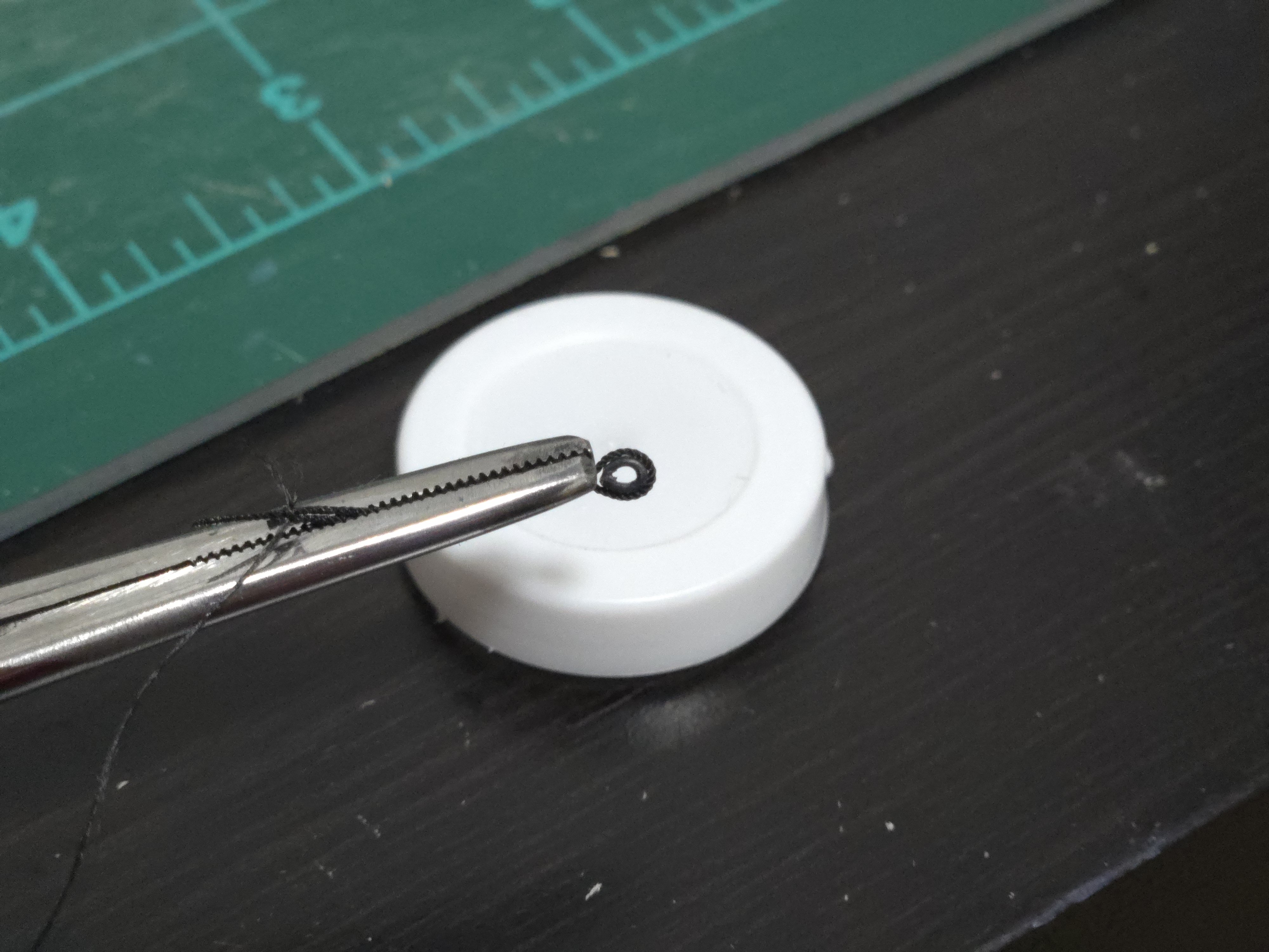

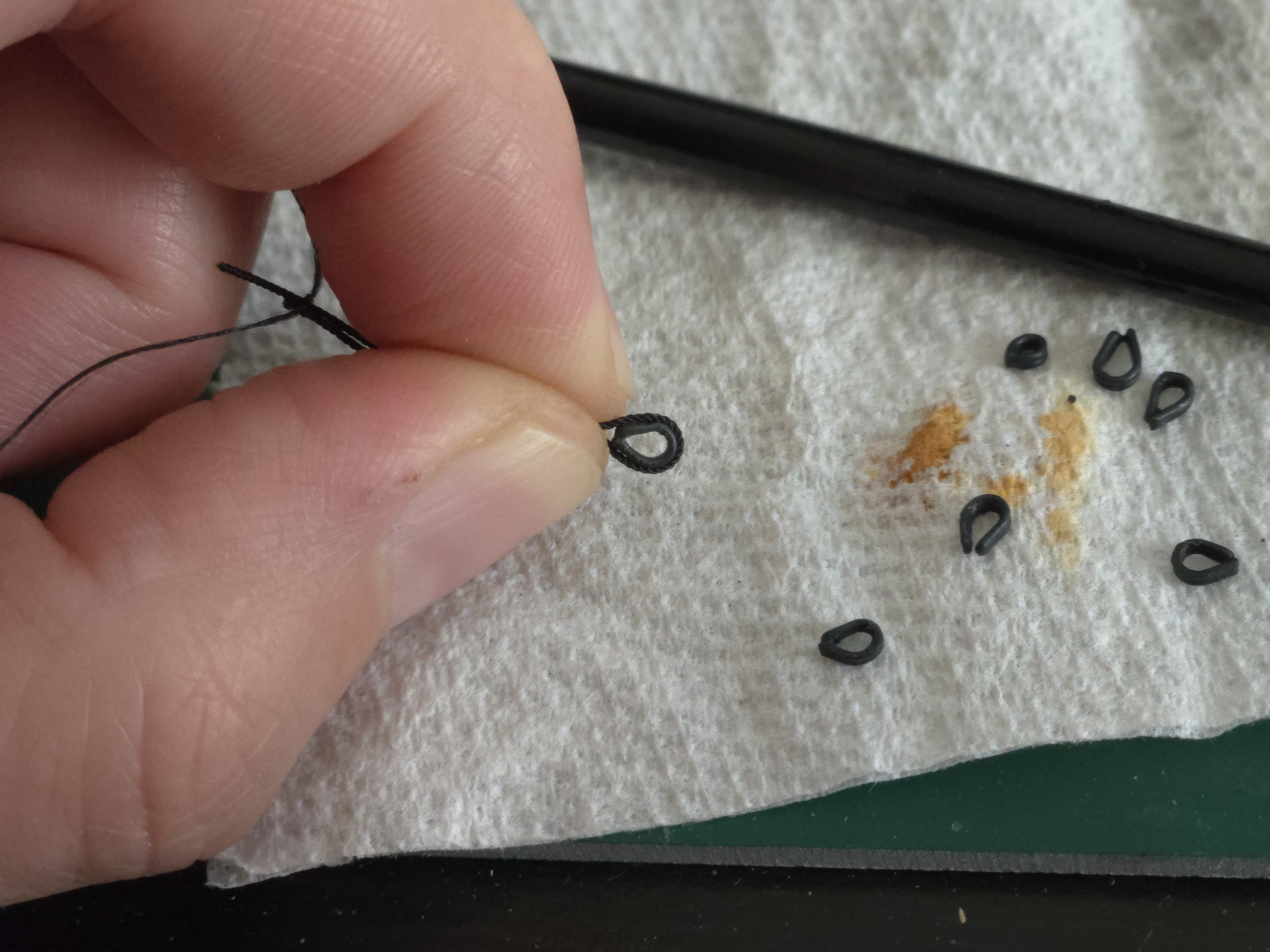

I thought it was worth a try. It was very simple. First, you fold and double up a little bit of wire:
Then you roll it into a loop, trim it, and add a drop of superglue to secure it. The doubled wire creates a small groove.
Then it's a simple matter of painting it (note: you'd need to solder if you're planning on blackening rather than painting).
The groove is subtle, and its not a huge difference, but I think it was worth it. The thimbles will be stored for now, to be added to the stay and shrouds once I know how long they need to be taking the turnbuckles and hooks into account.

Meanwhile, I'm procrastinating on making the rudder hinges. I had trouble with these on the Canoa de Rancho build, and in hindsight wish I had gotten less space between the rudder and transom. Making those tight turns in the brass strip is still tricky for me. I should probably try making a simple jig with scrap wood and tiny nails or something...
10 minutes ago, Jim Lad said:
A cunning thimble solution!
John
Thanks, I never would have thought of it on my own. This site is such an excellent resource, I'm amazed by the ingenuity that so many display and very grateful to those who take the time to share their methods.
Between travel, work, and some other projects, I haven't had much time for the build. I was able to get a bit of work done in the last few days, though.
First, I added the throat halyard. While the mast-side double block for the halyard is already in place, I still needed to add the gaff-side single block. In hindsight, it may have been more accurate to use single blocks for both, as that arrangement shows up in most photos, while I followed the plan which has a double block. Fortunately, I did find a photo of a working lancha rigged with a double block on the throat halyard, so doing it this way is plausible. But it's still a good reminder to double-check everything, including the number of lines passing through each block, rather than just trusting plans.

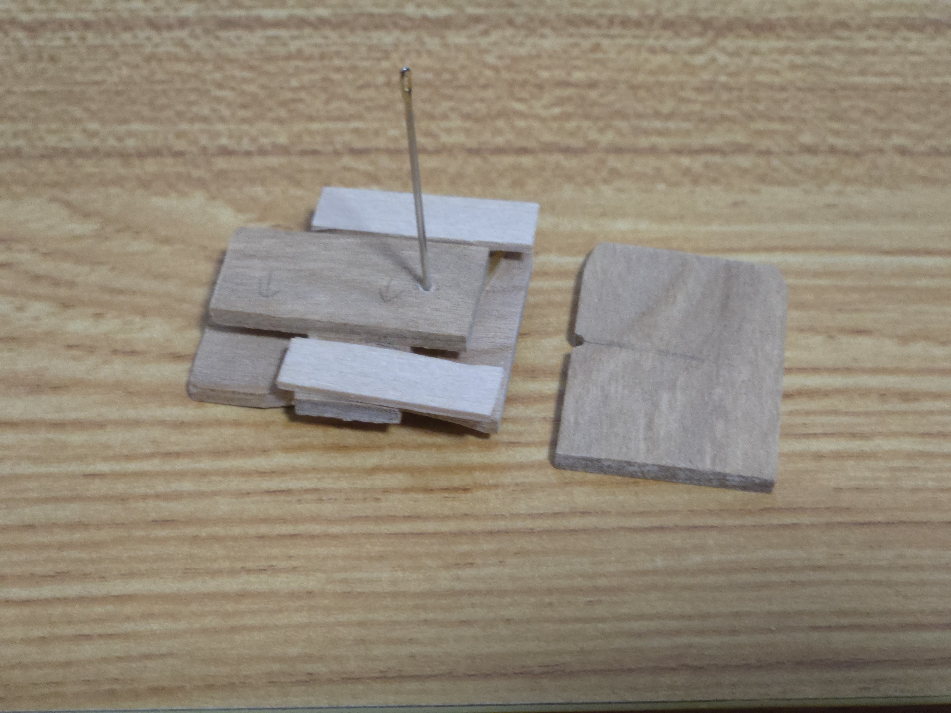

Then it was time to remove the mast and rigging, leaving everything still attached to the mast, to work on the rudder hinges. I tried to make a jig to get a tighter, more consistent bend on the rudder hinges, which are made of brass strip. I used some paint stir sticks that were made of a surprisingly hard wood, as well as some scrap and a thick steel sewing needle as a pin (held in holes in the top and bottom of the jig). The basic idea of the jig was to place the brass strip centered at the pin and to press the notched wood against it, shaping it around the pin.

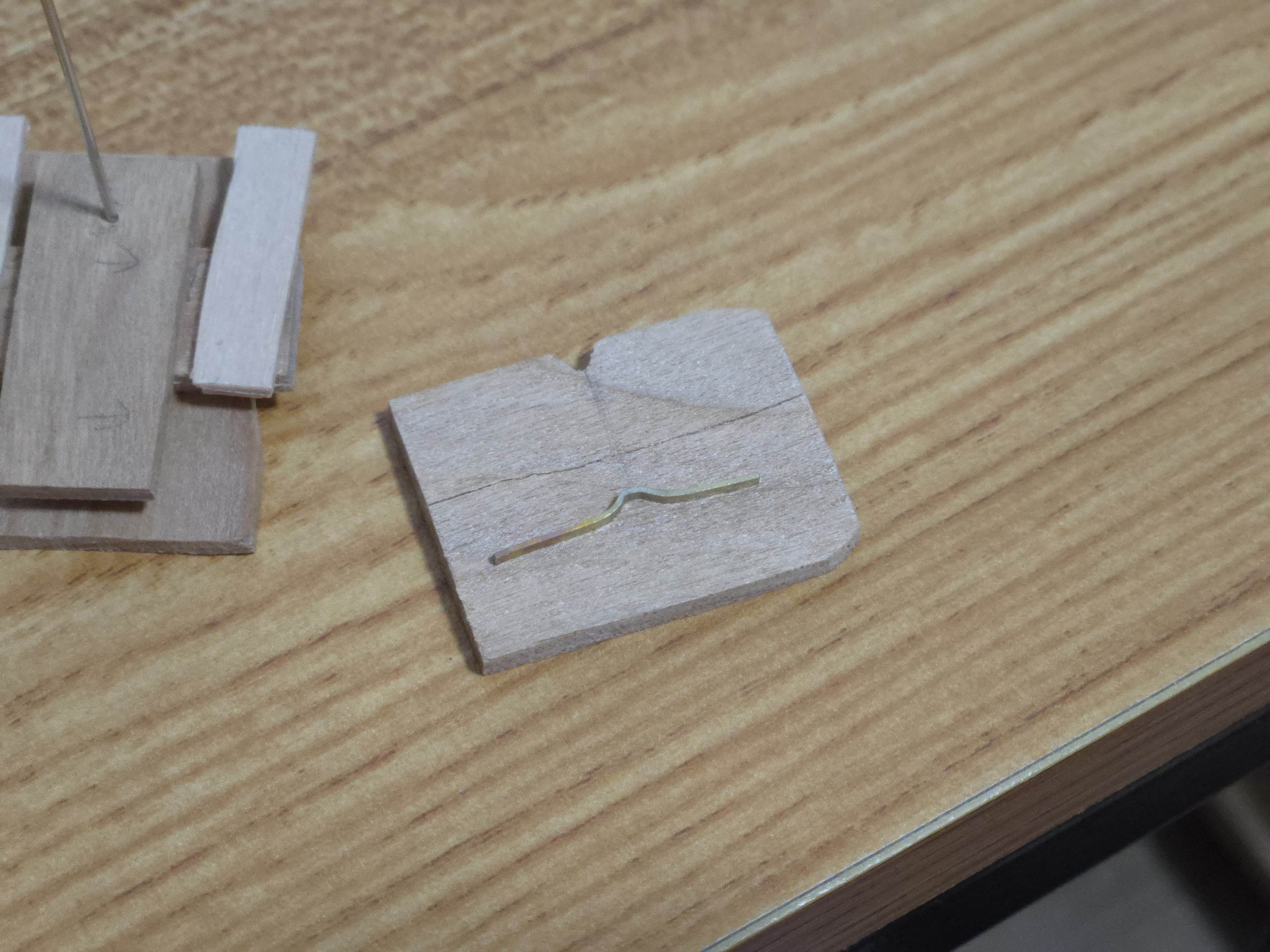

Unfortunately, the jig didn't work very well. The brass strip--even after heating it red-hot, and using the very thin strip that I used to make the chainplates--just didn't take very tight bends with the jig.
Instead, I ended up just bending the hinges by hand. With a lot of care, I got them a good bit smaller than those on the Canoa de Rancho. (Unfortunately I forgot to take photos).

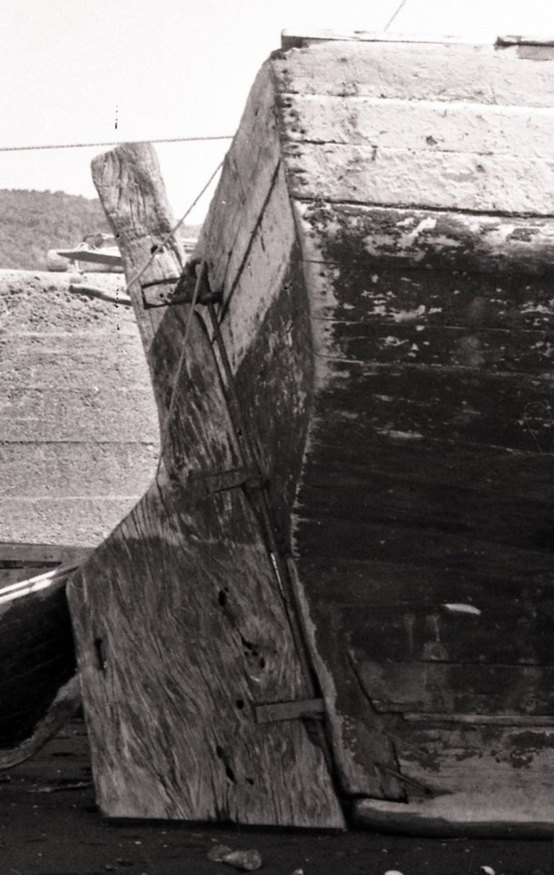

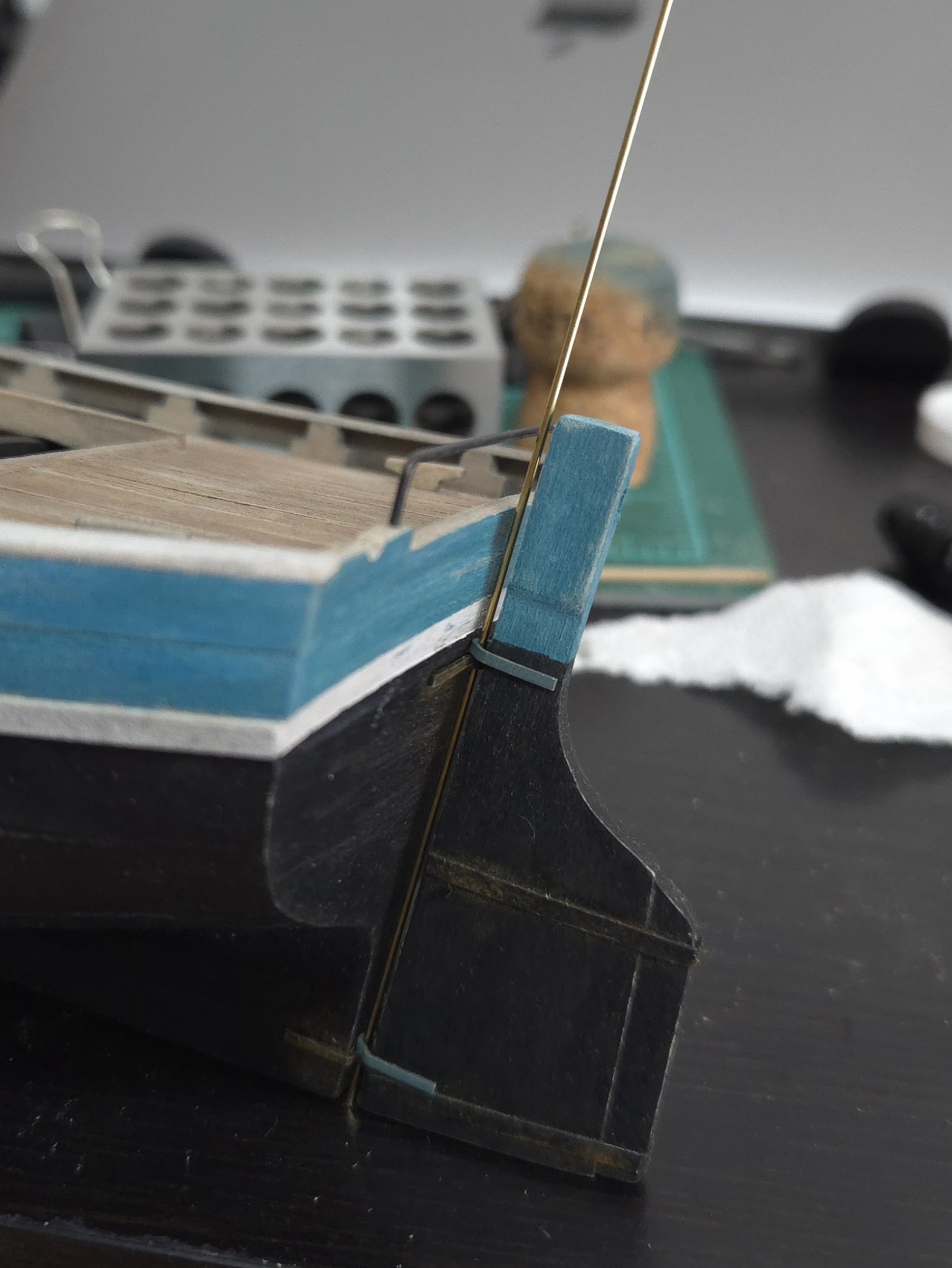

Photos like the one below show that Lanchas used a single long pin threaded through all the hinges, although my build follows other examples in having two rather than three hinge pairs and in using hinges rather than eyebolts on the hull side.
Source: https://www.flickr.com/photos/luchinmardones/5312311416/

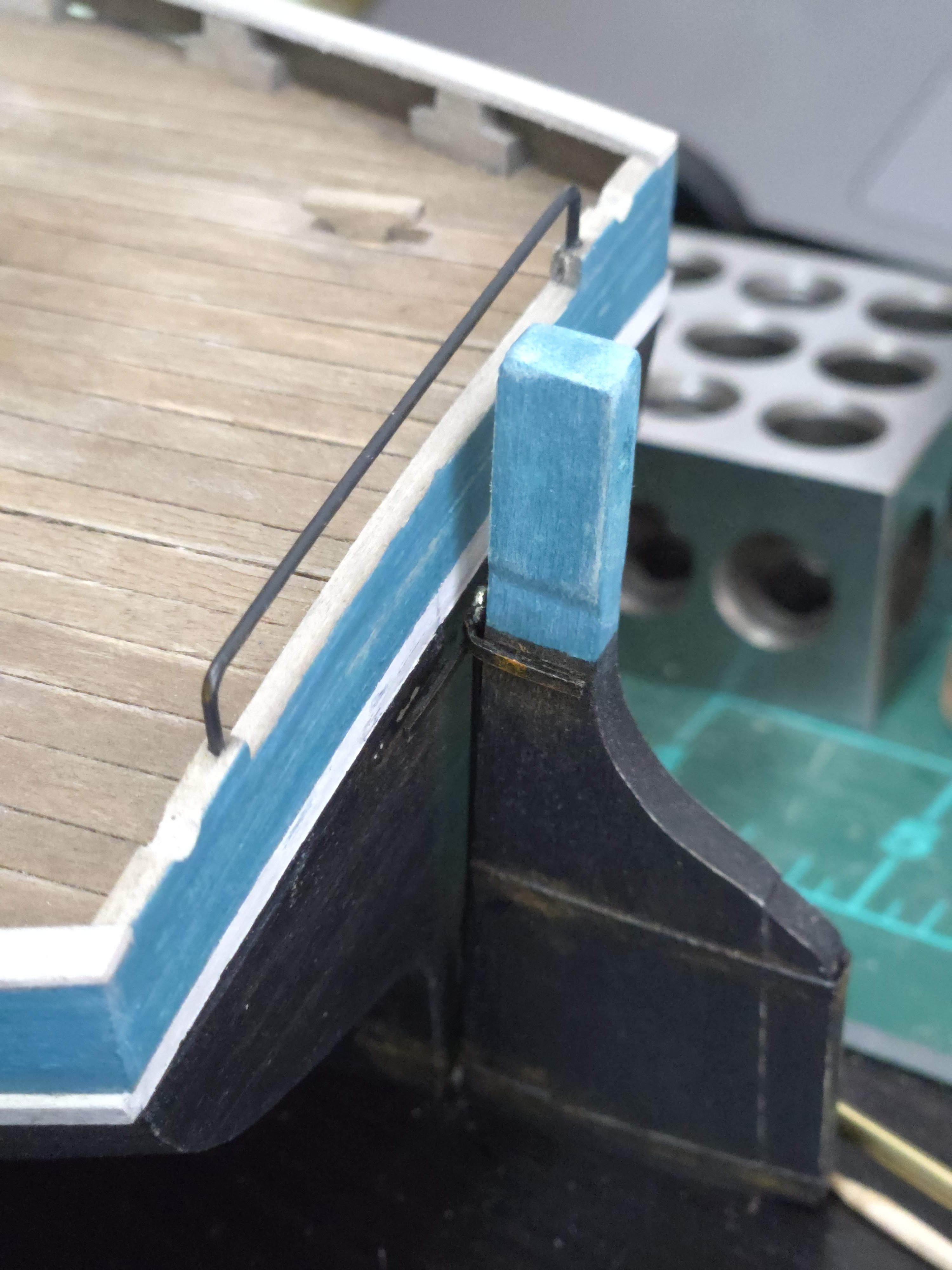

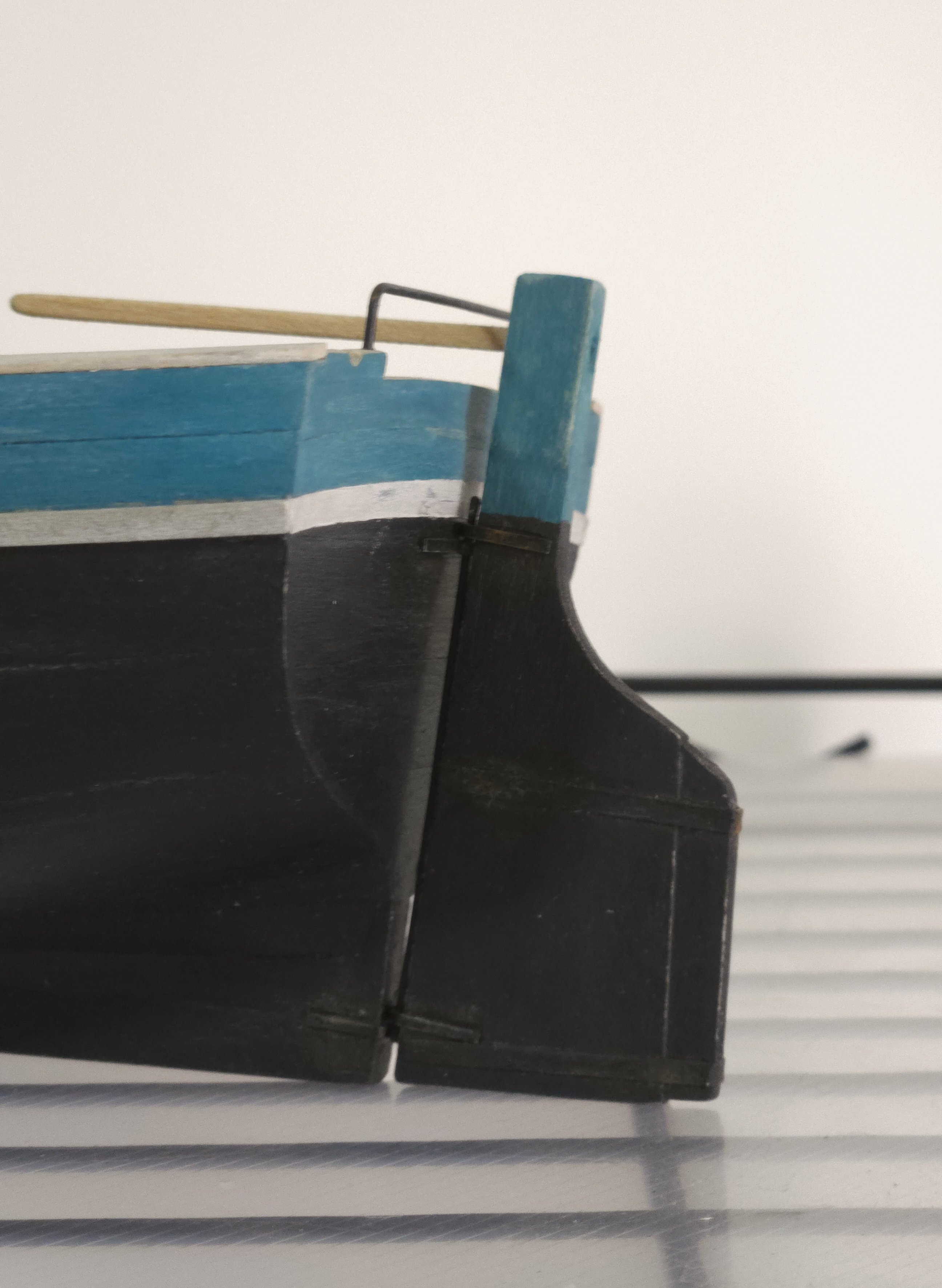

After cleaning and priming the hinges, it was time to attach them and hang the rudder. I began by gluing the hull-side hinges in place, using a brass rod to ensure they were lined up properly. I then looped the rudder-side hinges around the rod, slid them into place, and dry fit the rudder. I found that my efforts to make small hinges seemed to have paid off--if anything they were too small, and there wasn't enough space between the rod and the transom/sternpost to fit the rudder hinges. I decided that the best way to deal with this was to carefully cut a little divot where the hinges will go so they have space, as seen below. The divots were then painted to match the hull, becoming nearly imperceptible.
It was then time to glue the rudder-side hinges in place. In order to make sure they were properly positioned, I glued the bottom hinge in the correct location off the hull, then hung the rudder, threading it on the rod, to get the top hinge in place. This was quite difficult, as there was very little space even with the divots. In order to add superglue to the inside of the top hinge, I had to tilt the rudder back, but after gluing the top hinge I found that this had popped the lower hinge loose from the rudder, so I had to carefully re-glue it. After some frustrating minutes, though, it worked out.
I then removed the rod and painted and weathered the rudder-side hinges, below. I also made the long rudder pin with a length of brass rod that I put a small loop into one end of, and then primed and painted that.
At this point, I was ready to finally hang the rudder. I lined it up and began to pass the pin through the hinges. Of course, the added paint made the pin thicker than it was before, and it got stuck. When I pushed it down a little harder, the top hinge popped off the hull, as can be seen (kinda) below. At this point I remembered that I should have scraped the paint off the gluing surface for a better hold...

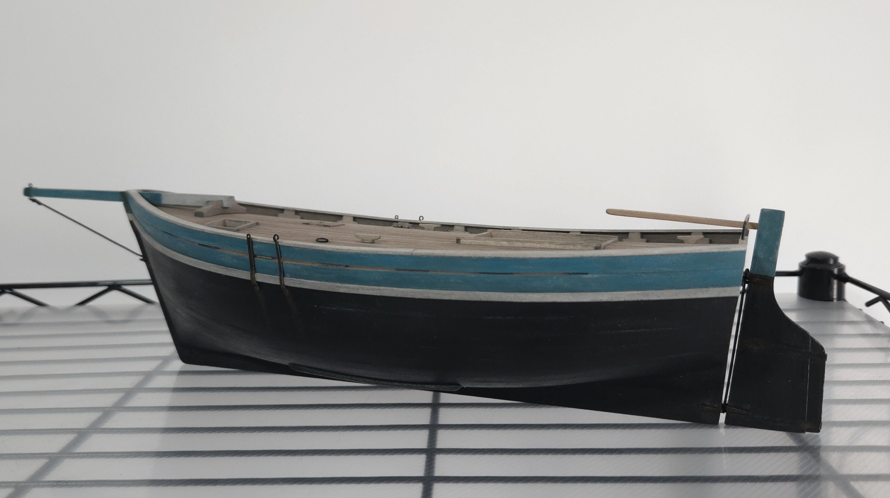

Finally, I was able to re-glue the hinge and to touch up the paint. The rudder is now in place! It does rotate about 45 degrees to each side, although it's pretty stiff. Overall I'm much happier with how these hinges turned out than I was with the Canoa de Rancho's hinges, but I clearly still have a lot to learn. Hats off to those of you who can make nice hinges and otherwise do great metalwork!
While I had been hoping to have this finished for the NRG photo competition, I've taken on some other projects and don't think it will be ready in time (at least not with sails...). That said, I've been really enjoying getting into other sorts of woodworking. I'm nearly done making a ring box, below, from cherry, walnut, and maple. It's interesting how even a small box like this changes your perspective. While I previously considered anything over 1/8‐inch to be thick wood, that's really quite thin for this sort of work. Getting things perfectly square is also much harder than I thought (especially with limited tools). These sorts of projects are really challenging me, but I'm learning an entirely different style of woodworking from what I do with models. It's very fun, even if every project takes a lot longer than I think it will.

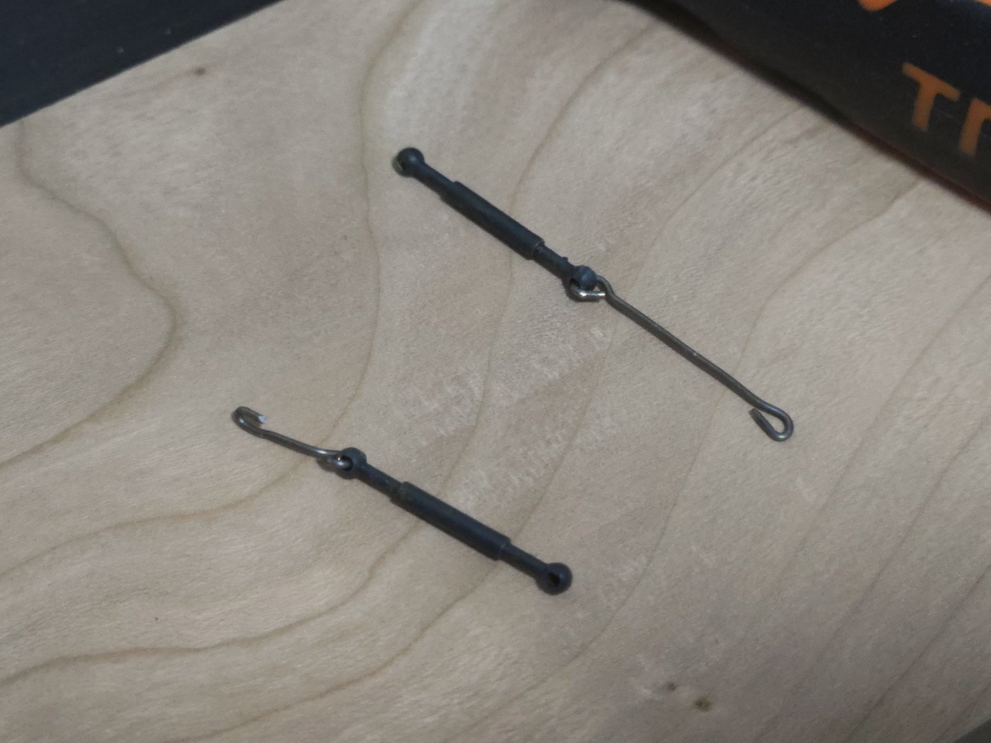

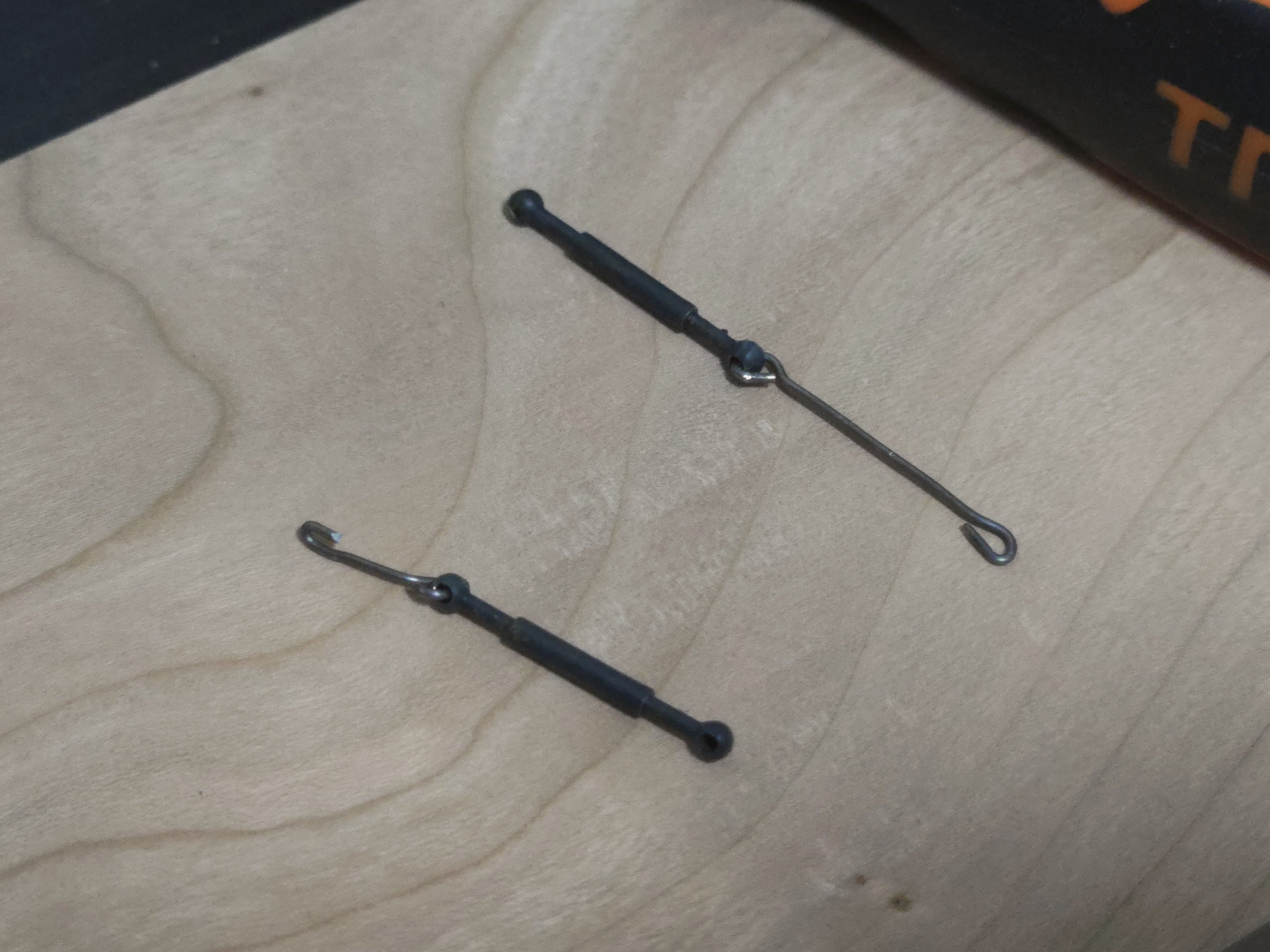

Next on my list are the metal hooks that, with the turnbuckles, join the shrouds to the chainplates. As has been seen in a lot of photos I've posted earlier, the exact arrangement of these could be a bit haphazard, so I decided to make the metal hooks in different lengths and thicknesses of material. Initially, I made two out of some brass eyebolts, and two from a thicker brass rod. The four hooks are seen below, along with a smaller hook to serve as a traveler. This latter piece is made of annealed wire, which has the advantage of naturally being a nice gunmetal color, but I don't want to use it too much in order to better match my existing metalwork, which is painted. However, I made an exception for the traveler, as after the block is stropped, I'll need to squeeze it tight into a loop around the horse--something that would be impossible to do to a painted piece without requiring a lot of touch-up.
However, when I went to prime the pieces, one of the smaller brass hooks flipped away, off the wire it was suspdnded from and off my balcony. I decided to redo the smaller hooks in annealed wire, but to paint them, and to attach the ends directly to the turnbuckles (unlike the larger hooks, which will be tied). This will hopefully add to the rather improvised look I'm going for (as will the size difference in hooks).

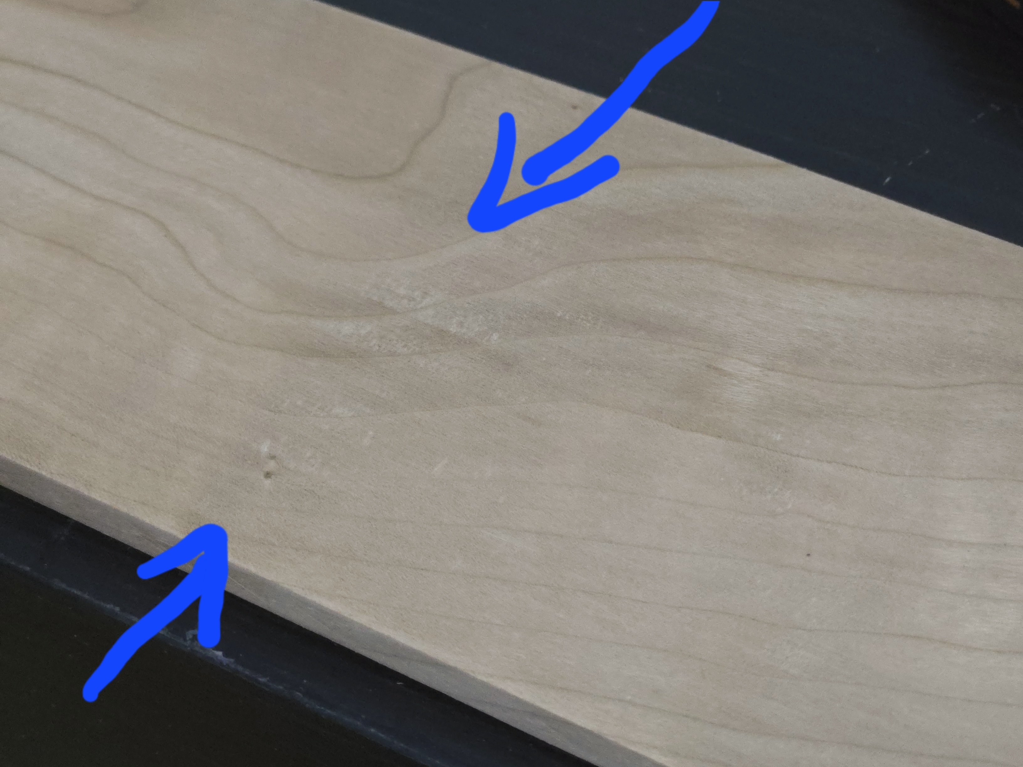

While the paint is drying, I've also begun prepping the display base, which will be a 1/4x3x10-inch cherry sheet. However, after a lot of sanding, there's a section that feels as smooth as the rest of the board, but looks white-ish, almost like a rough patch (but, again, it feels perfectly smooth). I take it the board just needs more sanding?
A distance diagnosis on the wood is difficult ...
Looking forward to how you will walk the tightrope between imitating the haphazard look of the real thing and an unintended look of shoddy workmanship.
