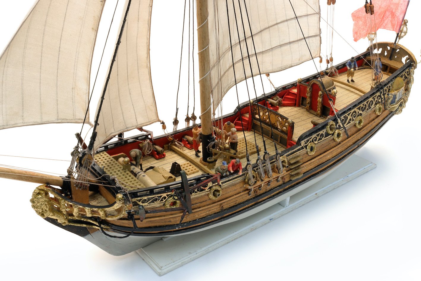

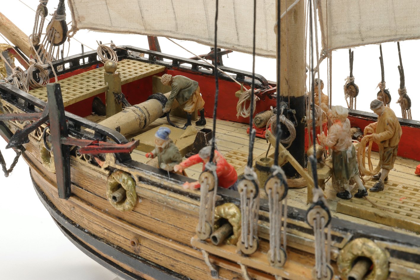

Anyway, the model approaches its finishing stage, after which I will come up with better pictures than these.20250430_132532.thumb.jpg.756c7f4525e25cde83ea50ebd6734925.jpg20250430_132607.thumb.jpg.19c4cb06128f8180b5f5c7ed18bc892d.jpg20250430_132646.thumb.jpg.80b1ce1e70c2025dea2da1b2885cacde.jpg
There is a lot to say about some choices I made, but as a whole I think I am reasonably satisfied with the result. For a ship with a totally different background the result could have been worse (and better for that matter).

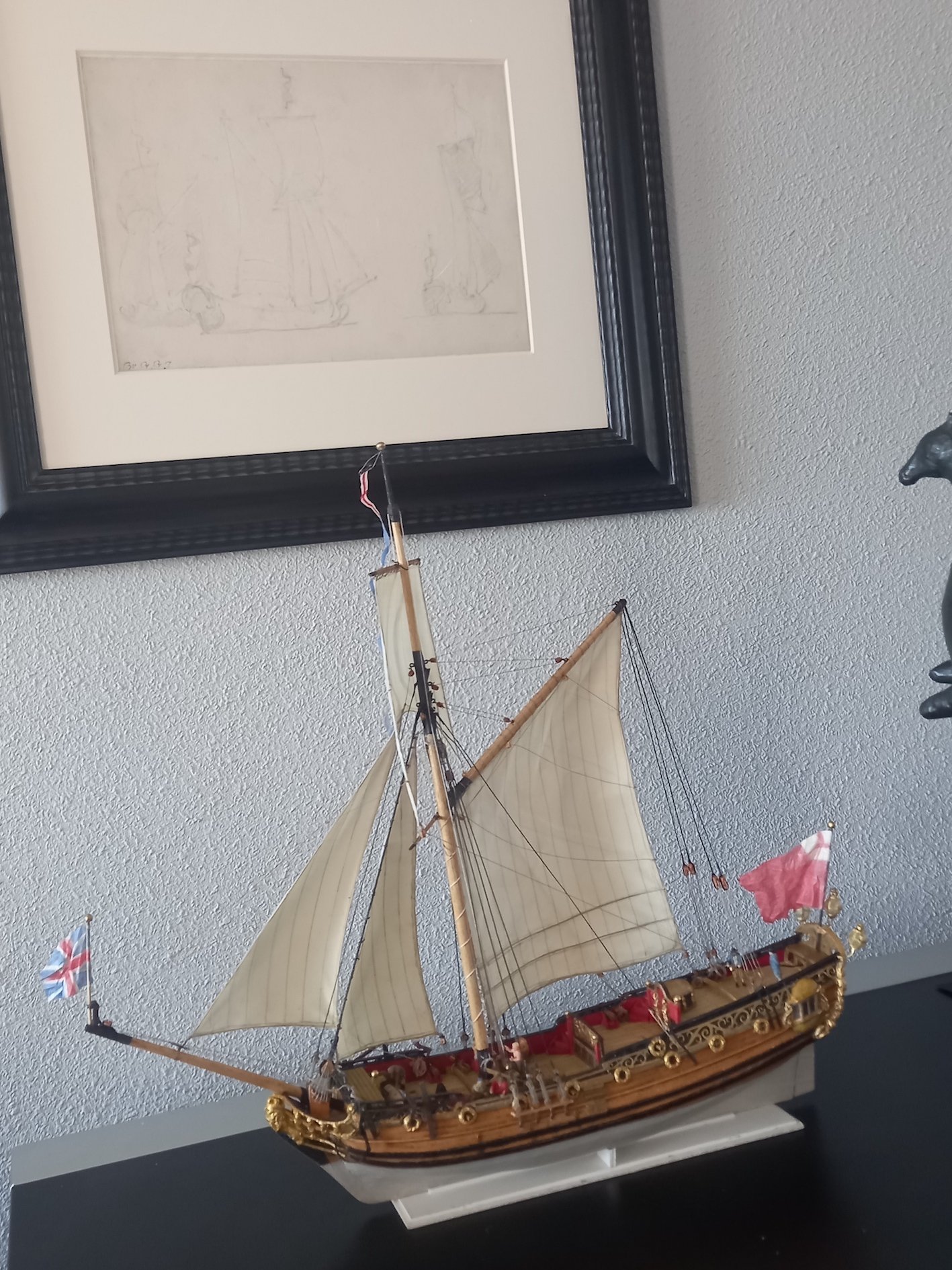

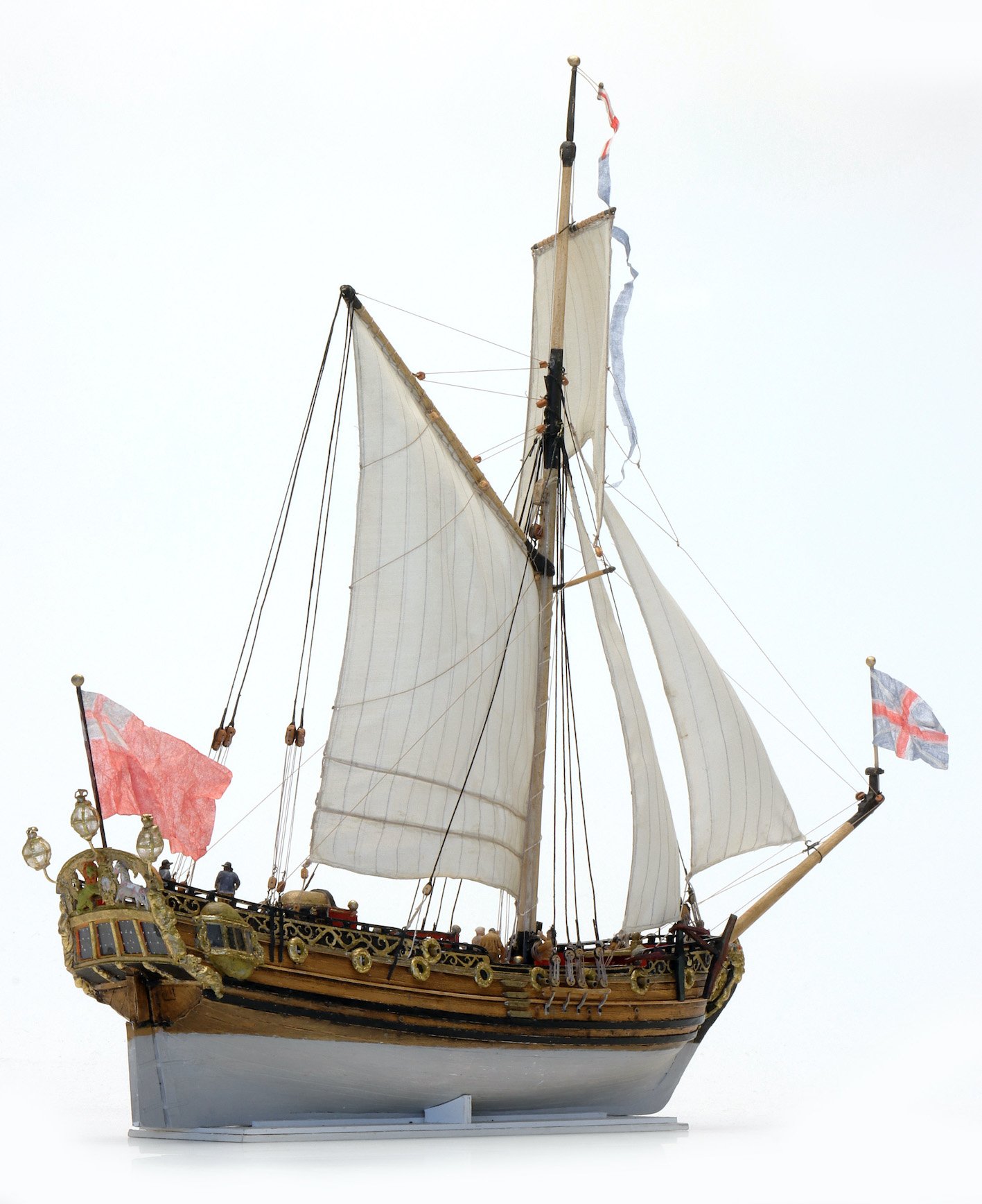

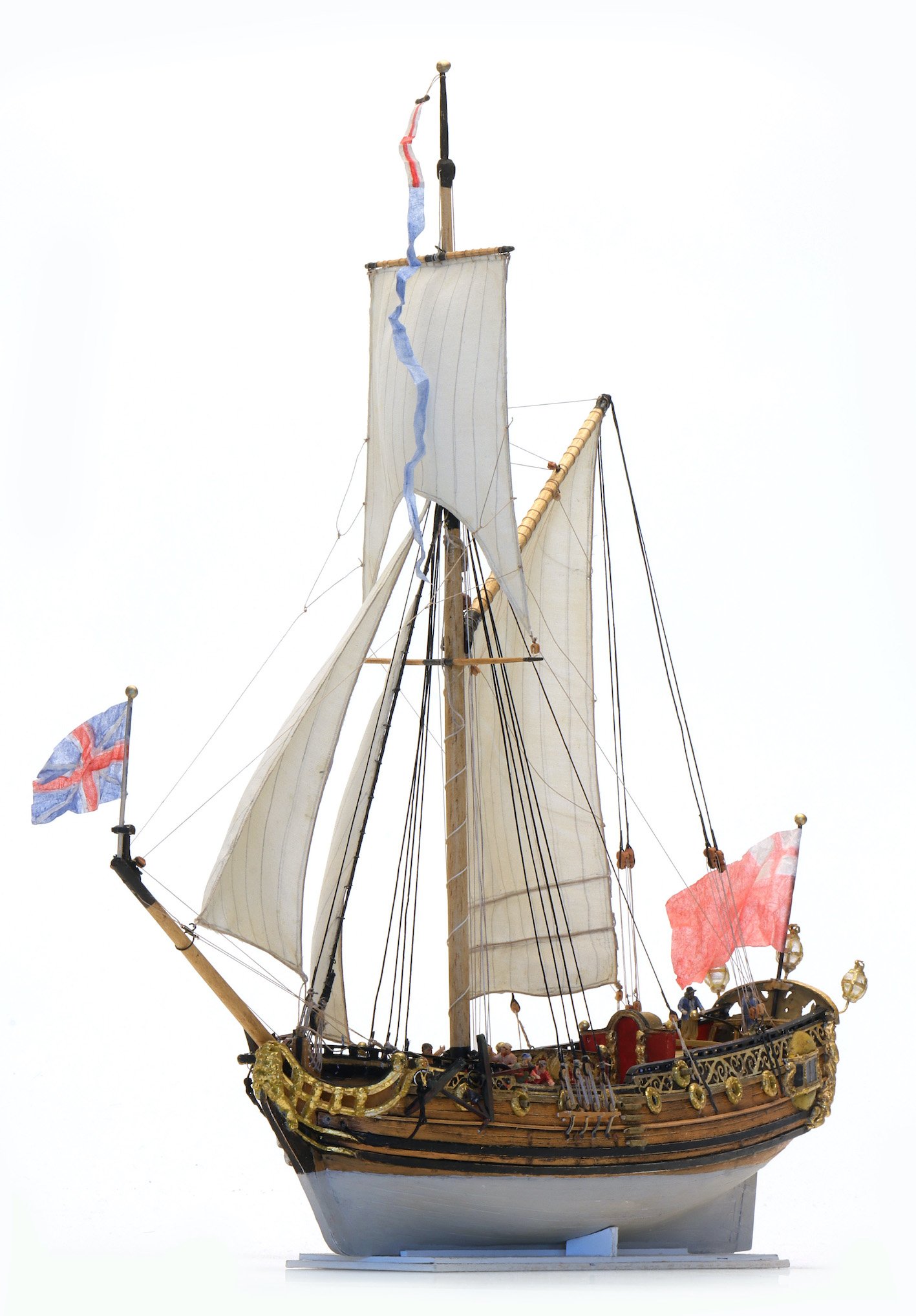

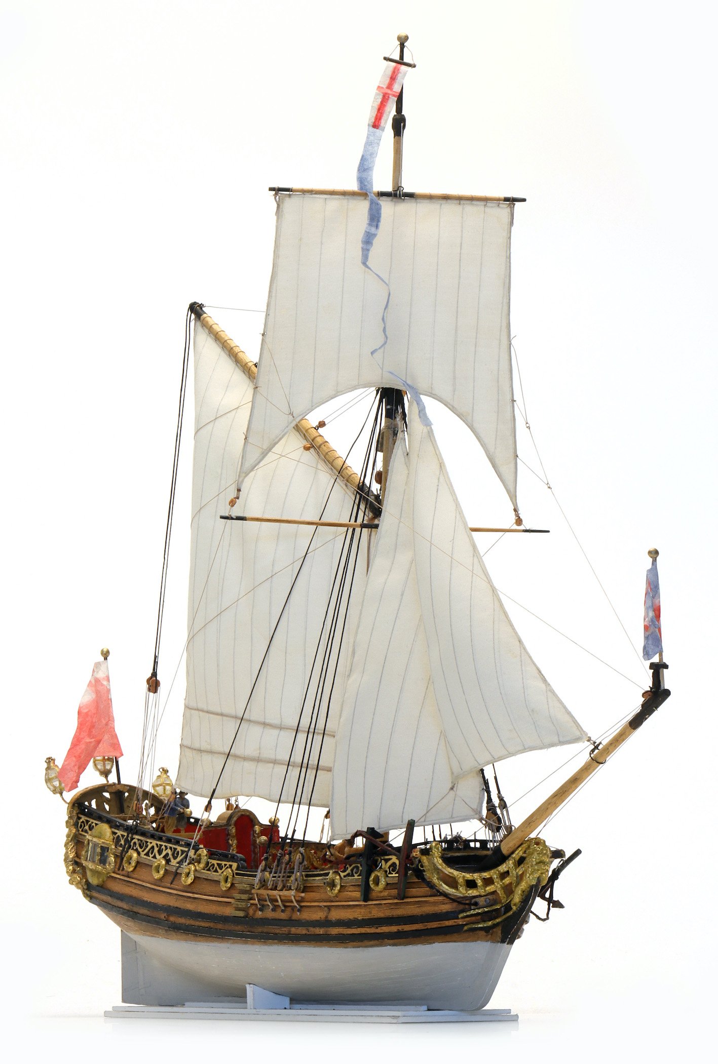

I finished the yacht last month. Here is the result:
Engels_jacht_1_HRkopie.thumb.JPG.37d8cc5444f624f2294eecb8c27c0e01.JPGEngels_jacht_2_HRkopie.thumb.JPG.4f16610bbf394f88bc9b988770c18df6.JPGEngels_jacht_3_HRkopie.thumb.JPG.eec4494cabe69d969b2d69d7664865bf.JPGEngels_jacht_4_HRkopie.JPG.b13866dfcde586f01f8f37662ced15e1.JPGEngels_jacht_5_HRkopie.JPG.f268ce25ef0fc98c8e05d271cc560d06.JPG
The model is exhibited below the drawing hanging on the wall in my living room:
Emiel tried to match the pictures he took with the drawing. It looks as if I was not far off:
Once he is finished with his photoshop painting I will present the result.
Thank you for all the likes.
Many thanks for @Baker, @druxey, @wefalck, @GrandpaPhil, @ccoyle and @Michael Mash for their positive response. Too much honor.
